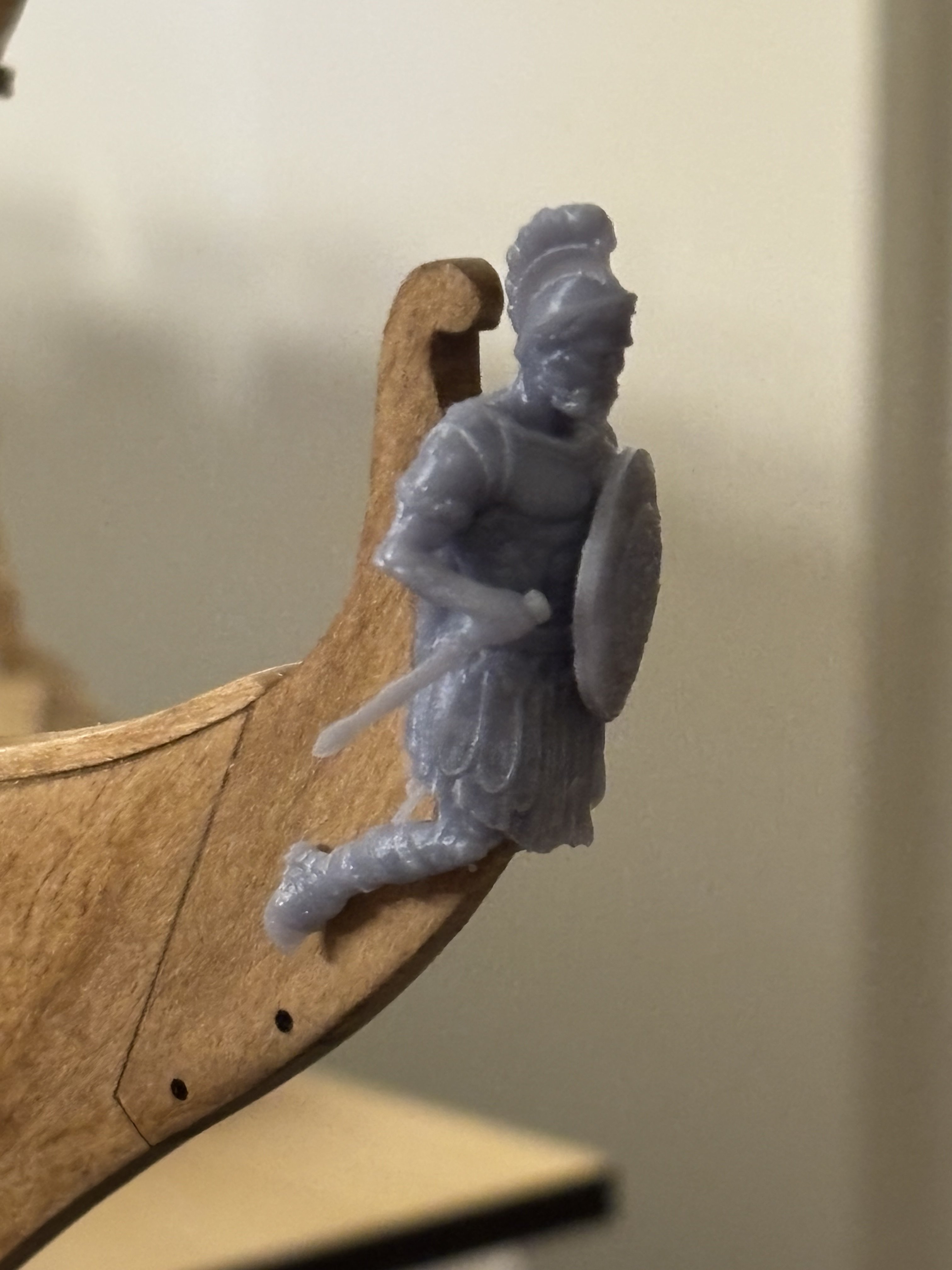

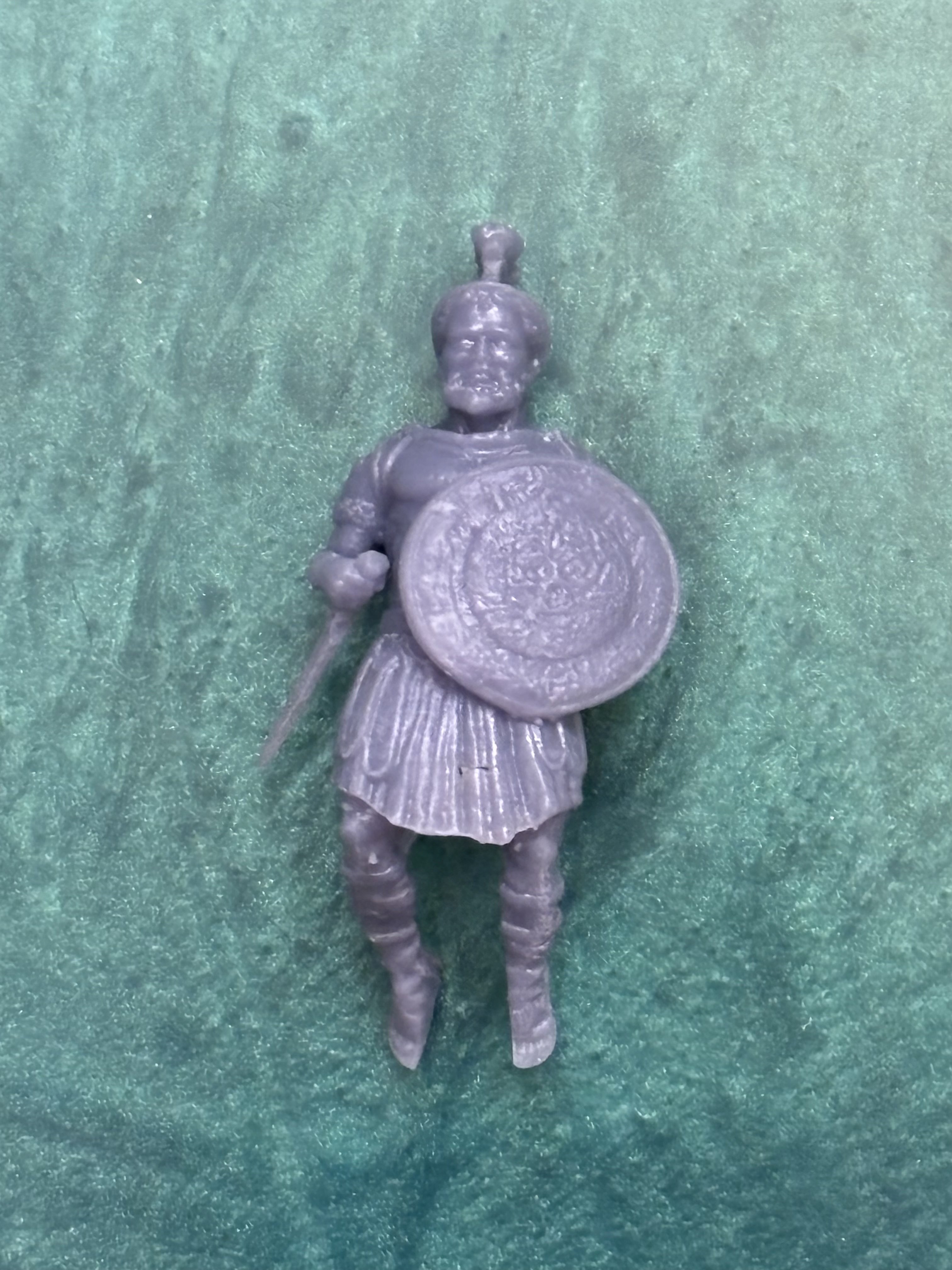

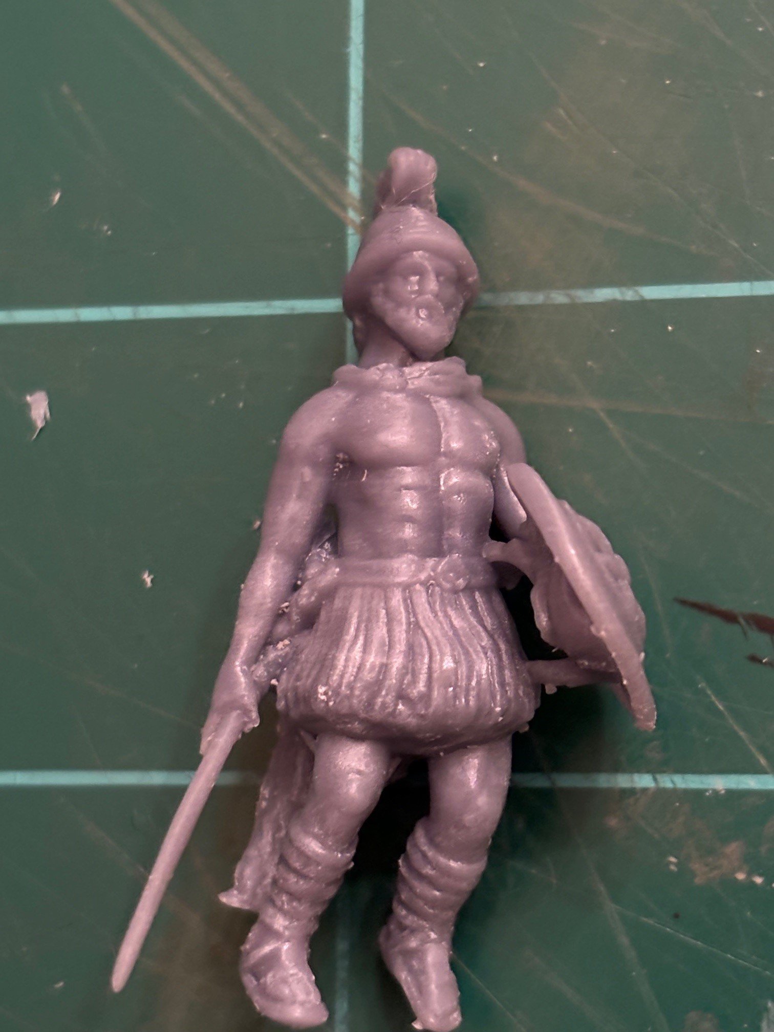

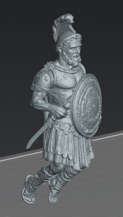

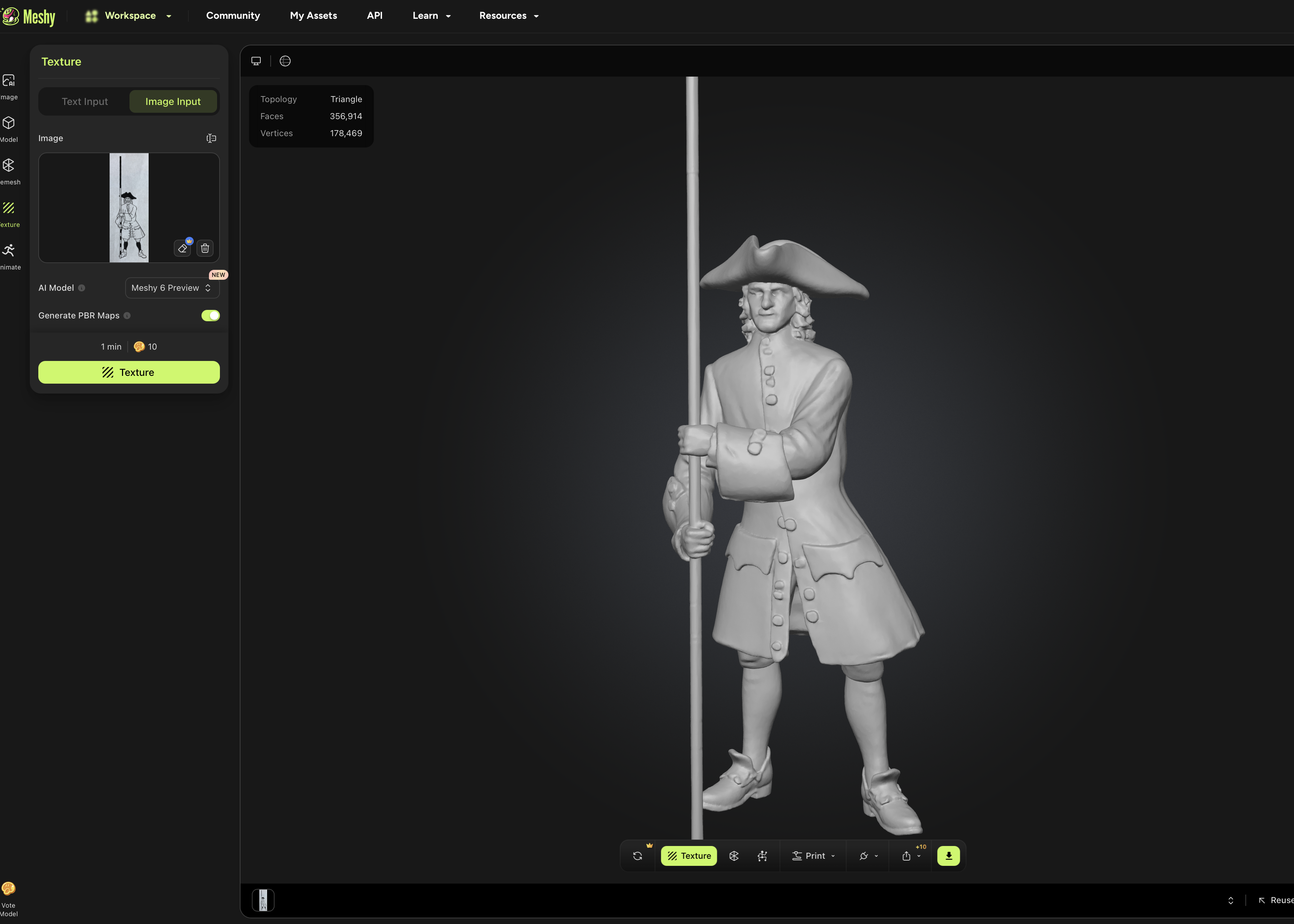

Switched gears and decided to try to tackle the figurehead for Confederacy.  I'm pretty happy with how it turned out and will be attempting to print it soon.  First I need to find some resin that is tan/wood colored.  All I have at the moment is gray and black.

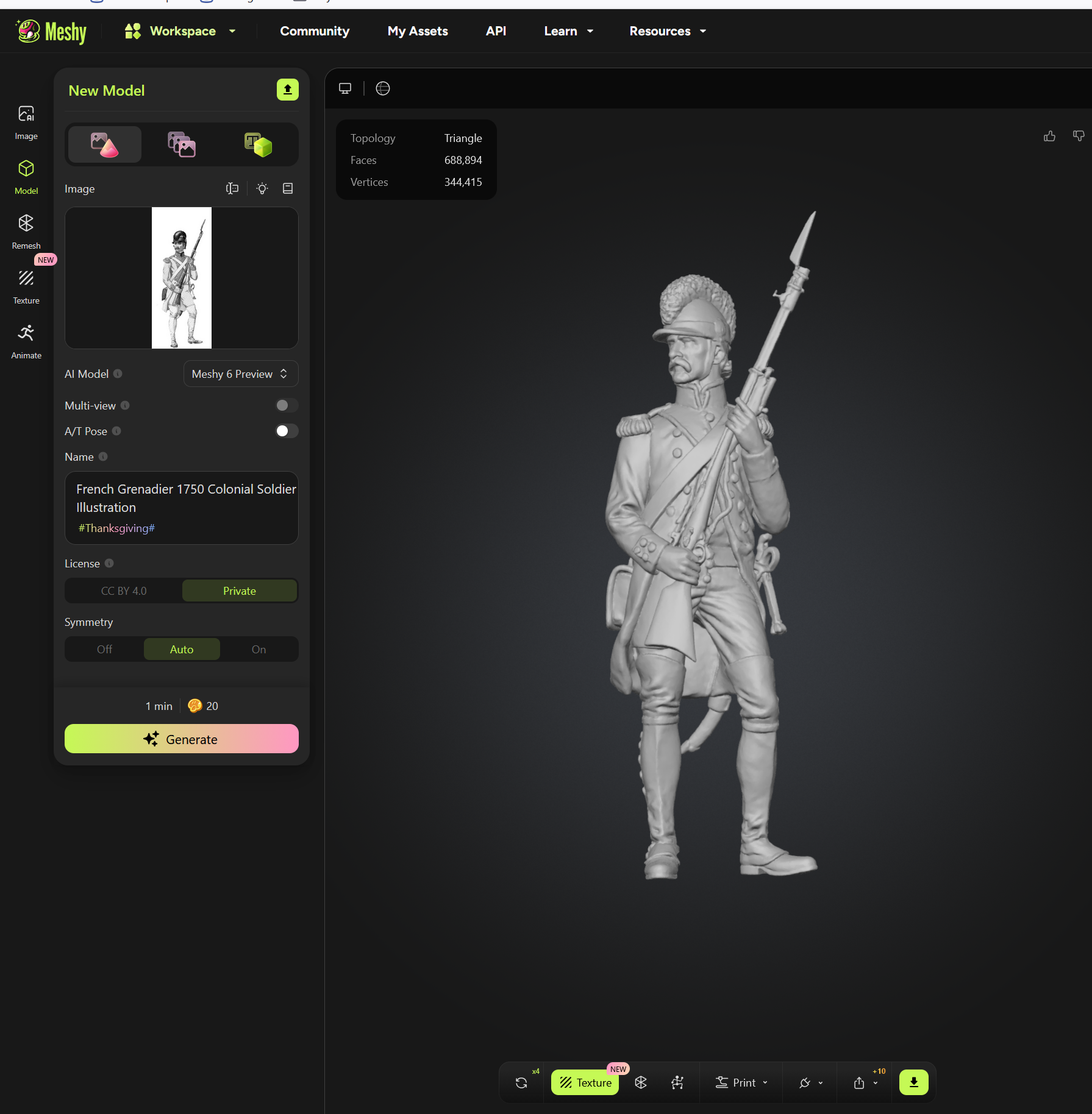

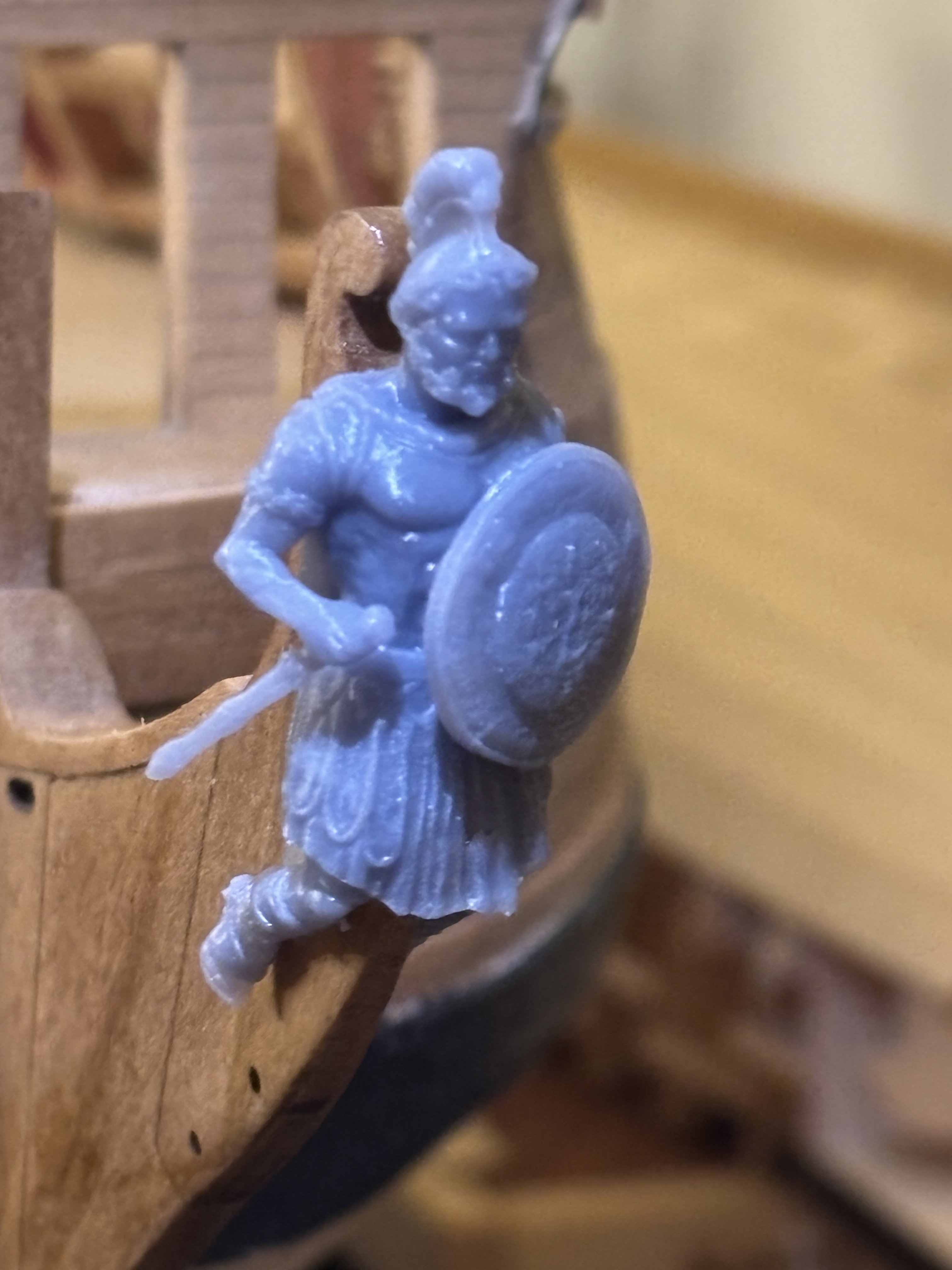

I ended up using the picture of the figurehead from Chuck's tutorial on how to sculpt one using polymer clay (first pic).  The second pic is what meshy 6 had generated and the third pic is of the model in LycheeSlicer.

On 10/29/2025 at 9:23 PM, Dziadeczek said:
I played a little with this software and, for the experiment's sake I uploaded a drawing of a French naval officer from Mr. Boudriot's book on the 74 gun ship to see, what would develop...
I was pleasantly surprised to find out that their 3D rendition turned out sooo good! - see the pic (it is only a 2D screenshot from a full 3D conversion, which turned out nearly perfectly, certainly good enough for me!
I am thinking about 3D printing of a dozen or so small figurines (about 3.5 - 4 cm long, which is about 1.5 in.) to populate my 74 gun ship model I recently finished building.
The problem with this free version of Meshy 6, I see, is that you can only upload your pic (photo or drawing) and convert it into a 3D sculpture, but you cannot further download this 3D sculpture elsewhere, to print it. To do that, you'd have to sign in for it and pay a minimum 8 dollars/month for a subscription (despite the statement from Meshy, that you can do it for a free trial - just to see how it goes (and if it satisfies you, then you can pay them and do your projects).
So, that is this limitation..., unless I missed something..   🤔
I managed to 'color' this image (texturize) in Meshy6 - that's how far I was allowed to go there free of charge.

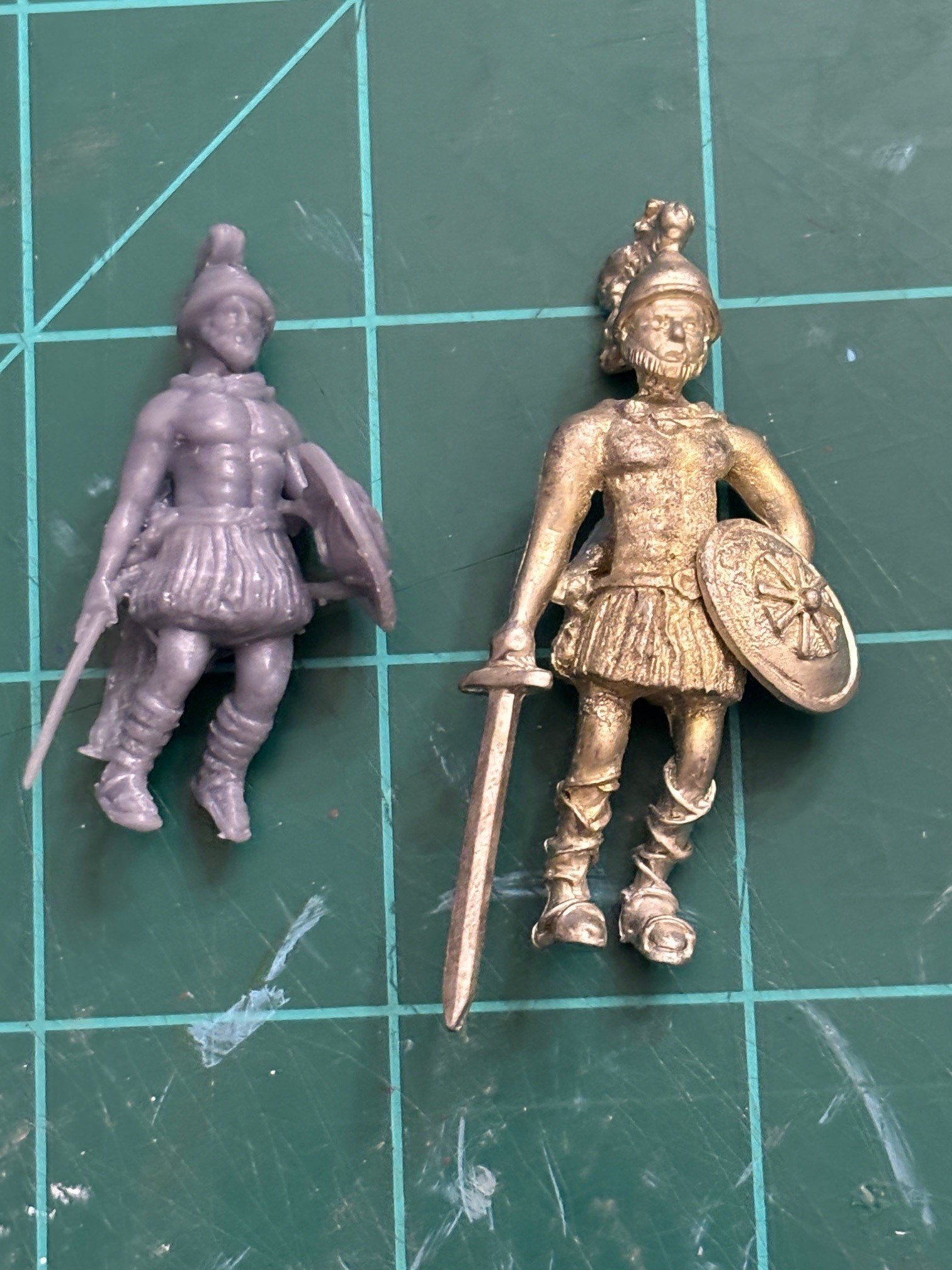

I have been playing around with meshy as well and think that I have come up with a better figurehead than the white metal one suppled by Model Shipways for the Confederacy kit.  I did a test print and am happy with the results so far. although I need to make him a little taller.  The final print will be done in a beige/tan color.  I may also try to model in the indention for the stem before doing the final print.
ConfedFigurehead.thumb.jpg.e40fff350266d93ee472bfd8374e3984.jpgAs you can see, the meshy product is 10 times better than the kit supplied one.

@Chuck I printed out your file of the figure and it is a perfect fit; looks great too.  Now to get all of the stern carvings made into stl files and printed out. Once I have everything in stl files, I will print them out in beige resin.IMG_0191.thumb.jpeg.1d11951d08786cc571ecee4242368e81.jpegIMG_0194.thumb.jpeg.999d2b884d9d562759264f5c442e3750.jpegIMG_0192.thumb.jpeg.59c1baa04a414abb170403d75e718408.jpeg

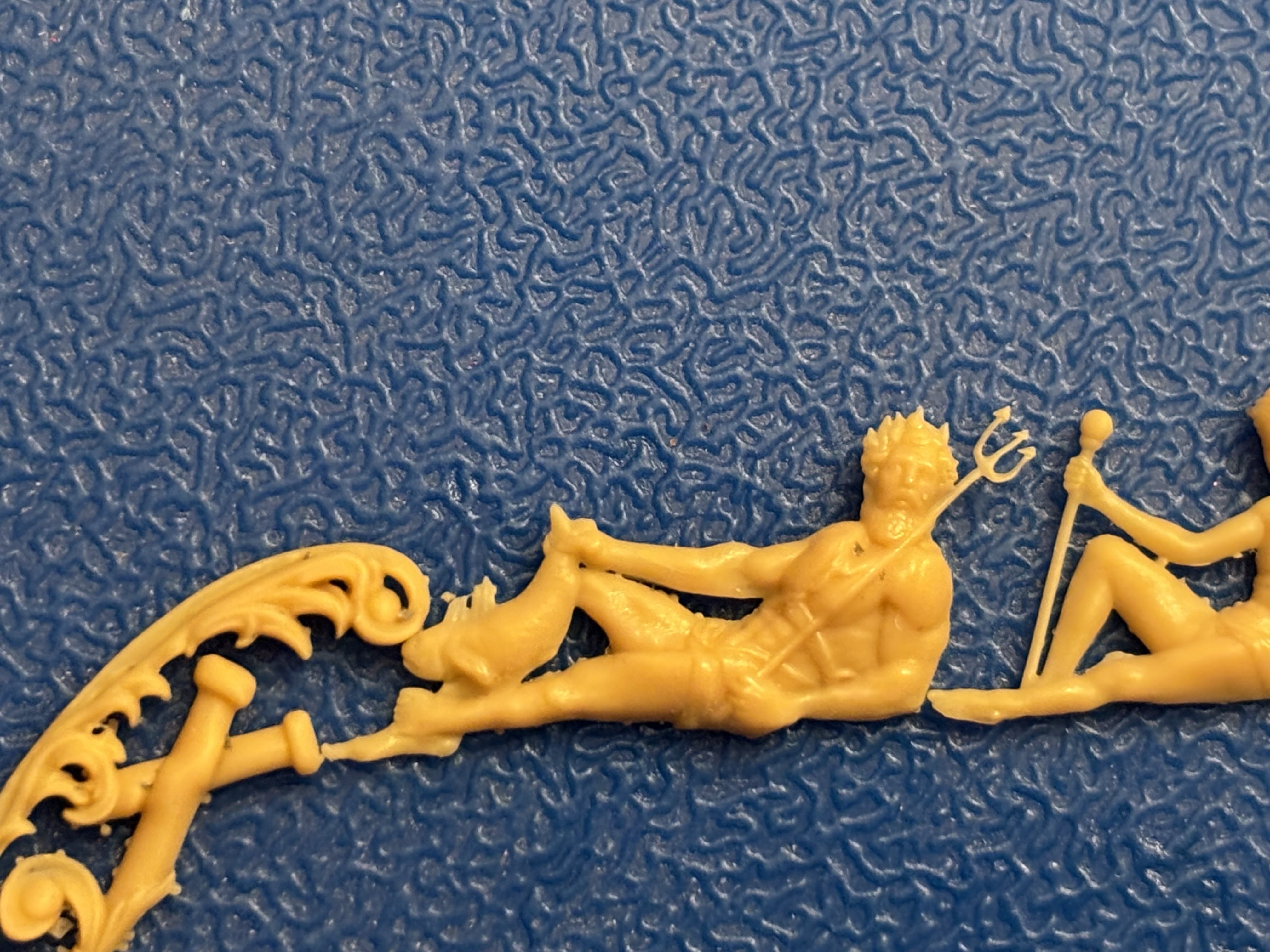

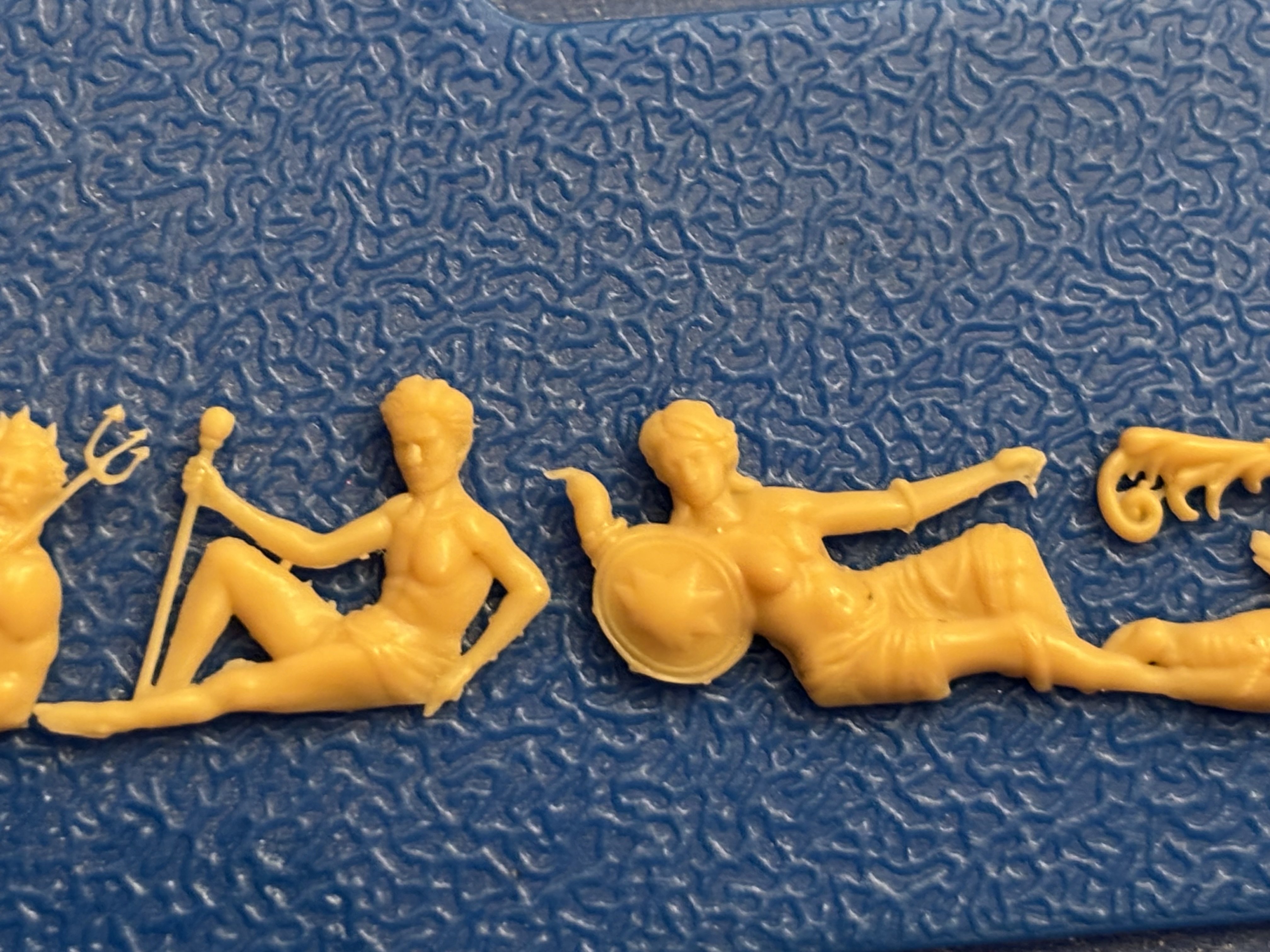

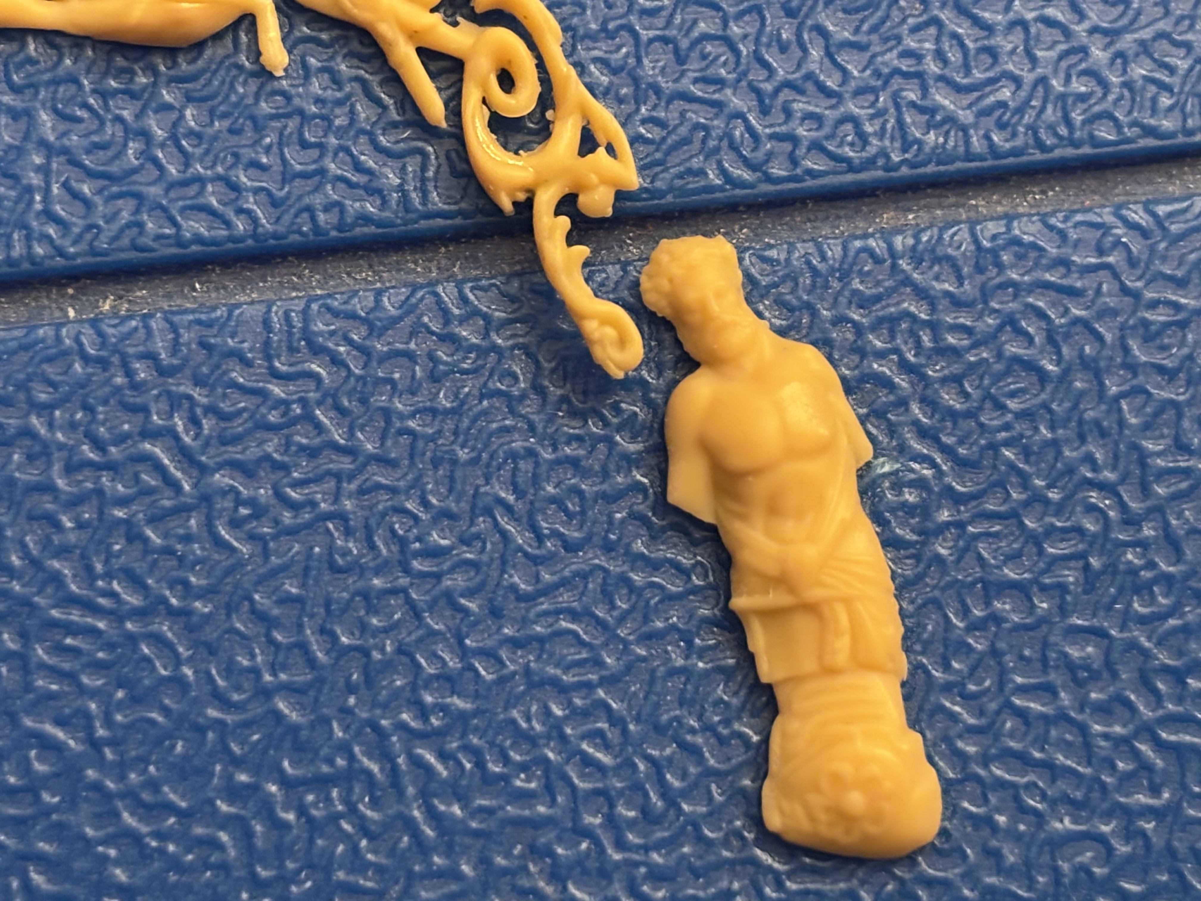

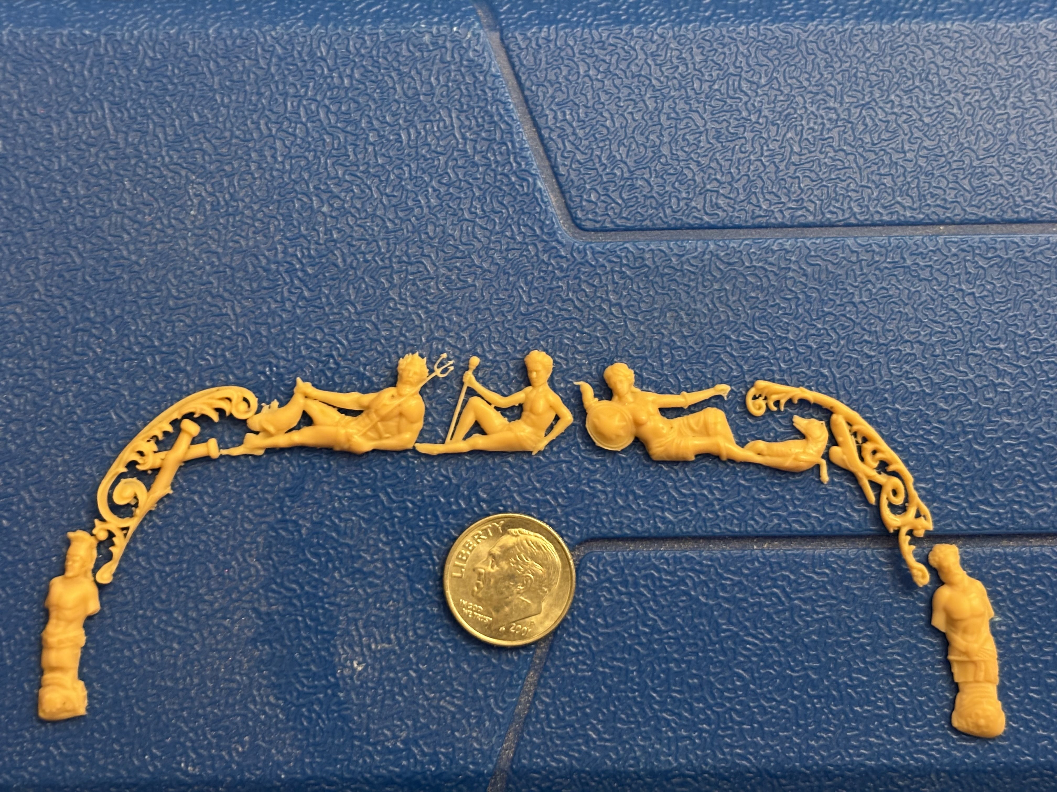

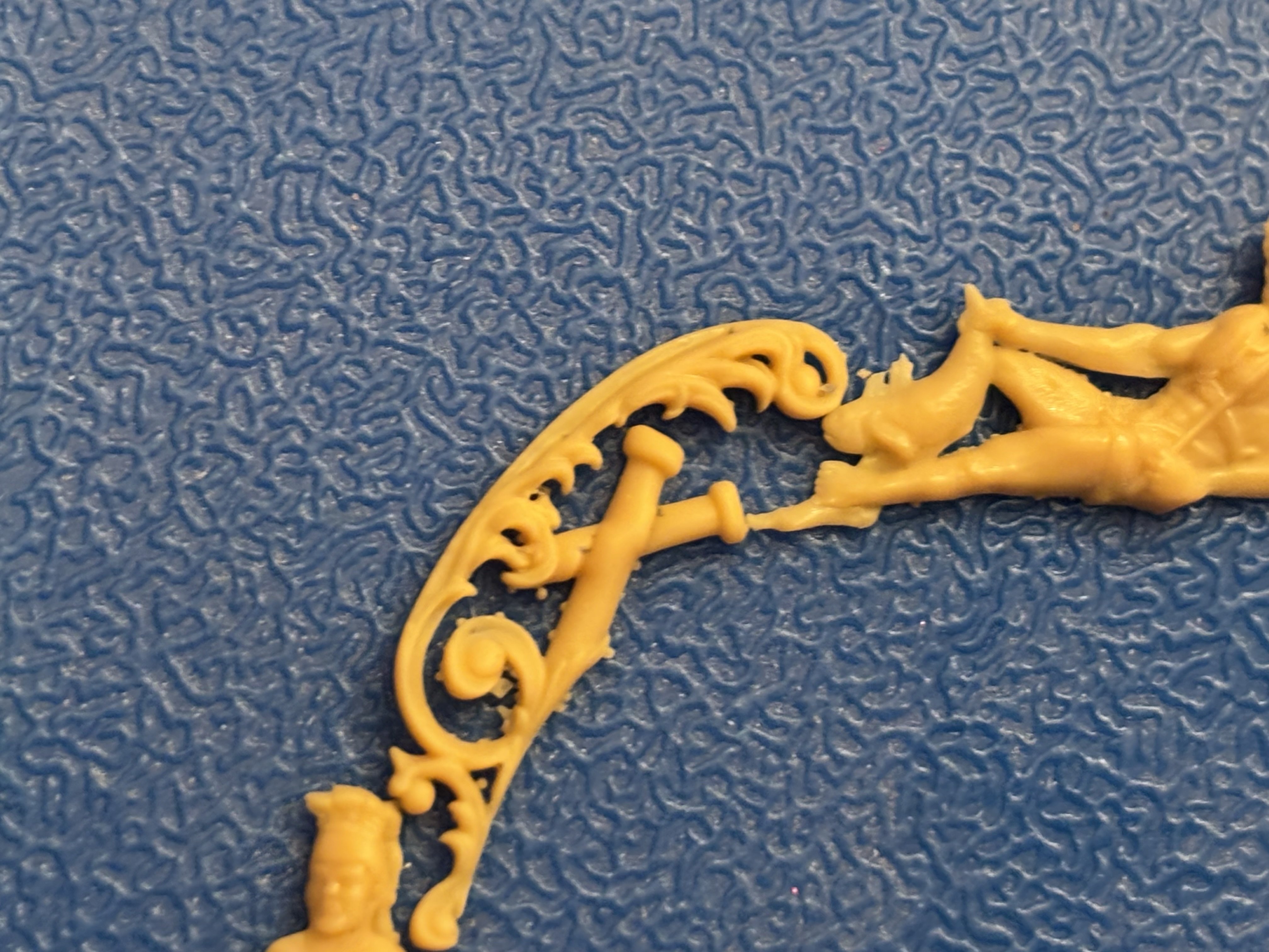

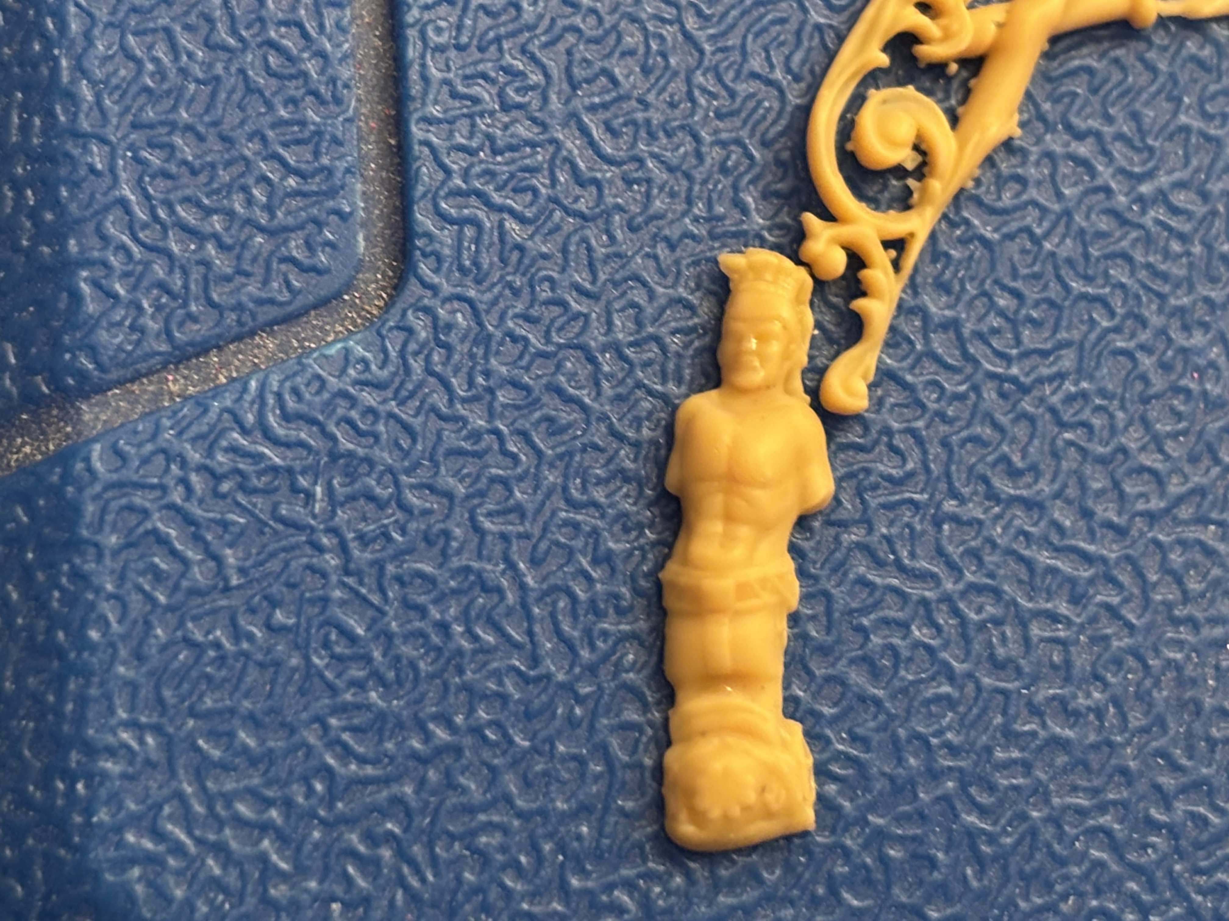

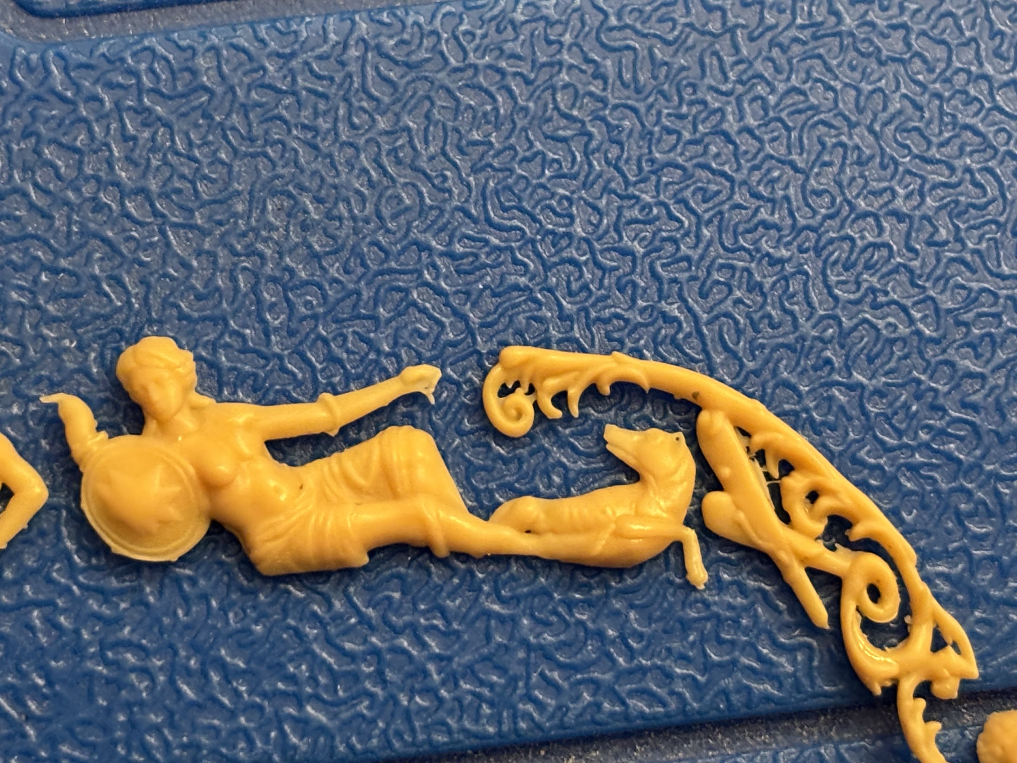

Printed the stern carvings for my USF Confederacy build on my Anycubic Photon Mono 4 with Inslogic Oak colored resin. Used meshy and relief maker to generate the stl files from the plans.
Big thanks to Chuck for sharing the information on how to get started with all this in this thread.

That looks just fantastic.   Well done.  If you are willing to share the stl files here that would be fantastic too.  I want to set up and area really soon where folks can upload stl files they want to share in a library.  That will be created after Christmas.

Here are the files for the 7 main carvings on the stern of the USF Confederacy.  Let me know if there are any issues with them.
