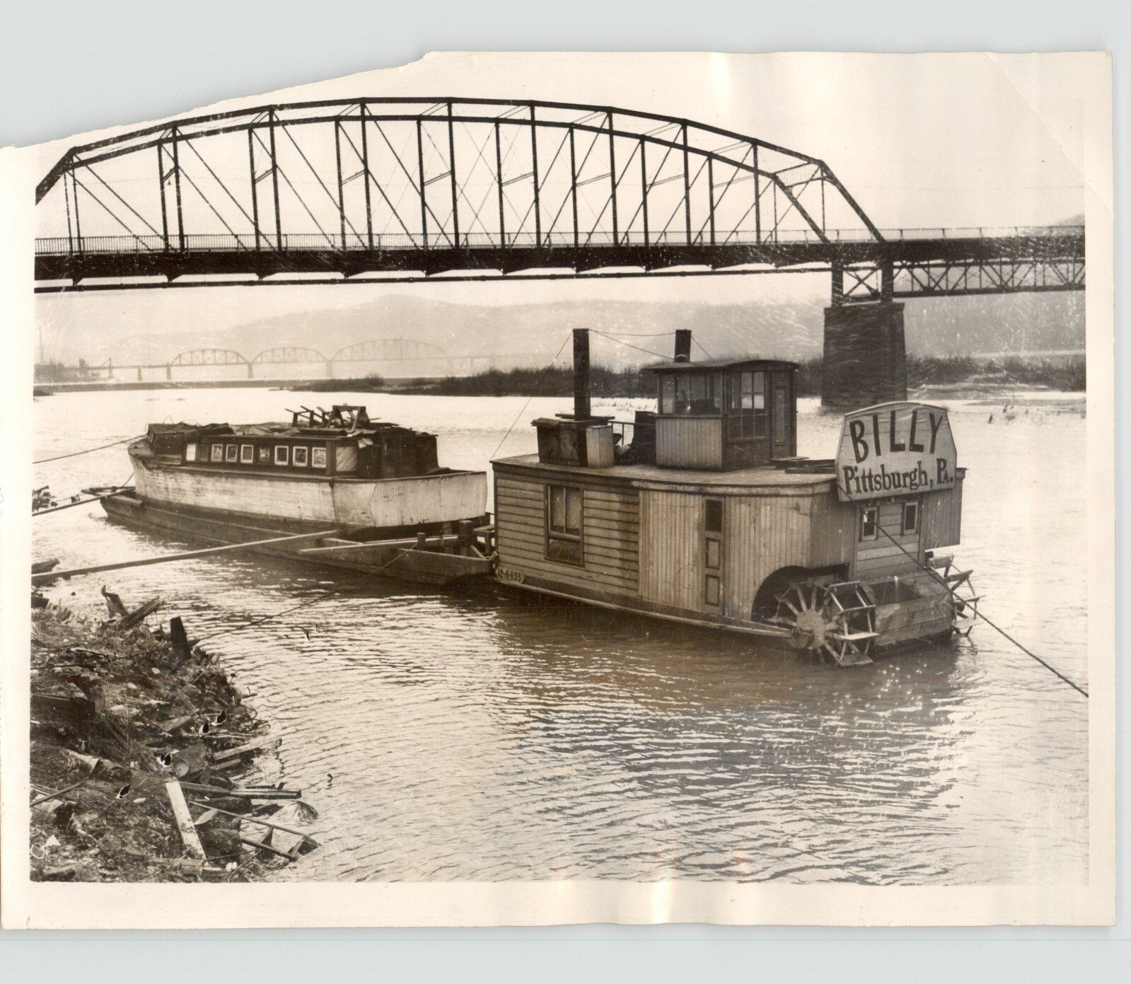

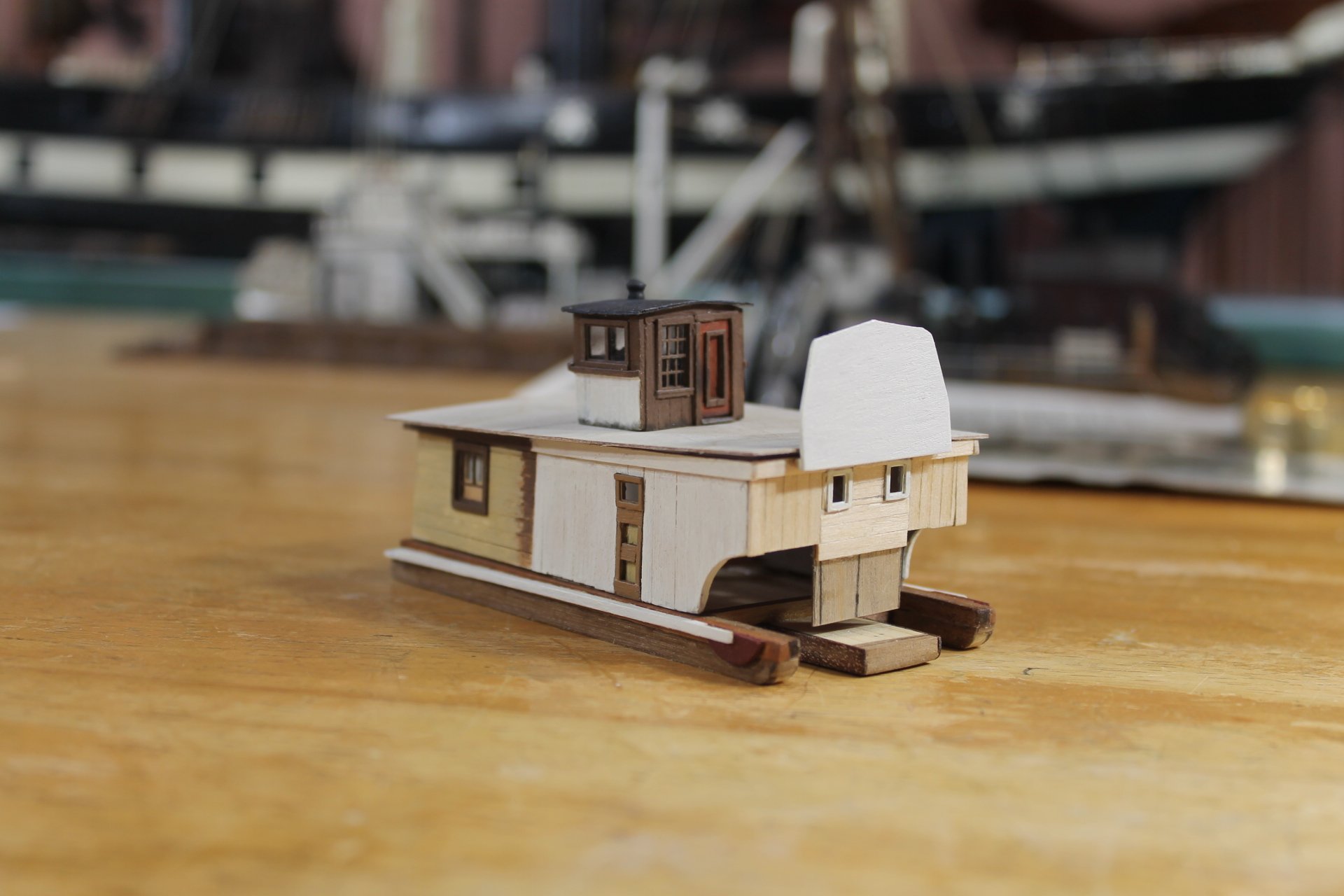

 The stern is starting to take shape. I set the windows about 0.05" too high but I'll have to live with it. Billy's name board's width is okay but the height needs to be lowered about two feet. It's easily removable and made so as i'll need to remove it to add the lettering. I'm a pretty good painter but I can't do lettering for beans. :(
 Attach, remove rinse and repeat is all part of the process on the stern as it is so complicated.

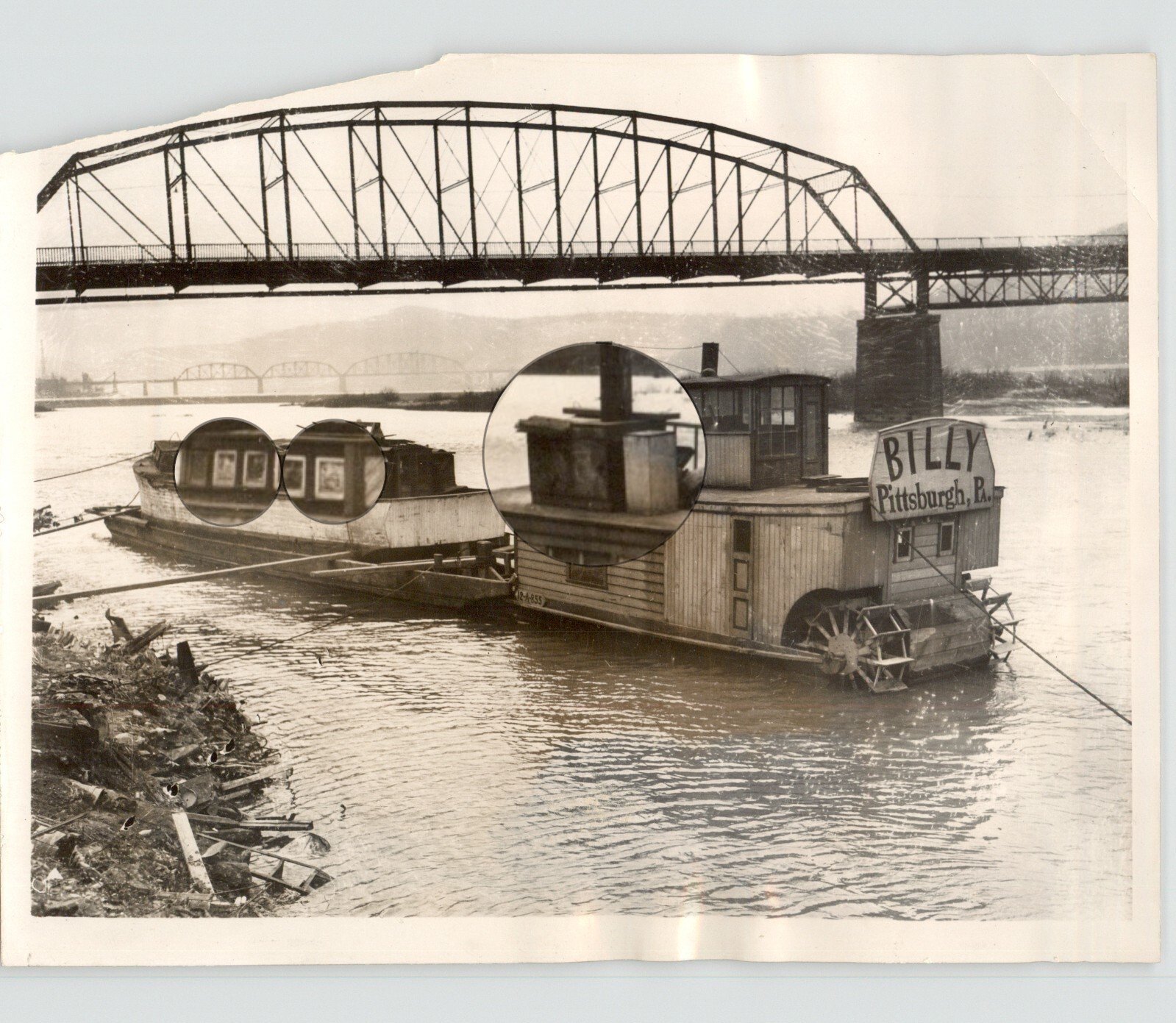

 Question....... in the enlarged loops, are those heavy cardboard or porcelain signs? I"m not going to try and replicate them, it's just a question to satisfy my curiosity. Thank you. s-l1600-13.thumb.jpg.1241c86f2ad3a317332c84dbcec6b120.jpg

I thought the same thing, looks like curtains,  🤔  As far as painting goes,  we are in the same boat  , good painter, not so good lettering  But  print them to the right size and mod-podge them on. Kinda like  make your on decals. Just a thought. Or make a stencil  and spray it on.

Perhaps neither, but sheet-metal ? At that time die-pressed semi-relief sheet-metal ads were common. The design was added in form of decals and then burnt-in, as was done for porcelain.
The type of signs is unimportant, it's, are they signs?
25 minutes ago, Cathead said:
Keith, on the houseboat/barge, aren't those windows?
 Yes they are, Eric. But going back to the press wright up, Engel's boat had been damaged in a flood and Billy was his ticket to getting the boat down south to make repairs. It looks to me like they are signs put in as temporary replacements for damaged windows. I think ole Engel was a scavenger so putting in signs as a temporary fix seems plausible.
23 minutes ago, wefalck said:
Good point 😉 Could be just printed calico-curtains.
 They don't look like like curtains to me, Eberhard? They could be but the window shades in Billy's windows are plain Jane.

They could be wooden signs that he has scavenged to close up broken windows to keep the elements out.  Maybe Engel found himself near a reclamation yard and found old shop or advertising signs that suited his purpose.
 Geordie, I think every junkyard in Pittsburgh was Engel's oyster. :)
Honestly I don't see anything that looks like signs. The patterning looks like anything from curtains to plywood to cardboard, with arguably the distorting effect of refraction in glass in a blurry image.

 As far as the windows go, you're correct, Eric. The windows could be treated any number of different ways and we'll leave it at that.

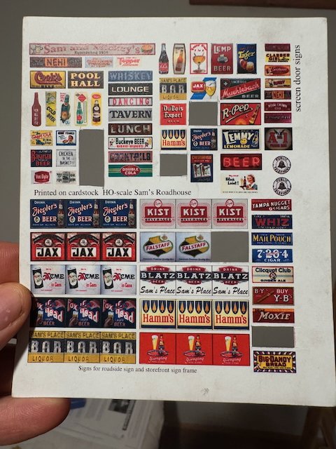

Also, an idea occurs to me. I have a sheet of printed signs left over from the last  model railroad building project mentioned on my log. They're on cardstock and quite nice. I could easily slip some of these into an envelope to you if you wanted a few of them for this project. I could see doing some window coverings as plain and a few as signs just to add to the creative quirkiness, since we're none of us sure exactly what he used. Wouldn't cost more than an envelope and a stamp. Here's what the sheet looks like, most of these would be appropriate for the 1930s:

 How very kind of you for the offer, Eric. I may not do the barge and canal boat and if I do the signs would need to be close to the window sizes. Should I decide to build the barge I'll revisit this with you in a PM. Thank you again.
Cardstock for printers is about 0.011" thick, or about 1 3/8 thick in 1/120 scale, so you could use that as the sign, and just print the lettering on it. You can buy acid free cardstock, so it would not yellow on you, and would not need to be painted.

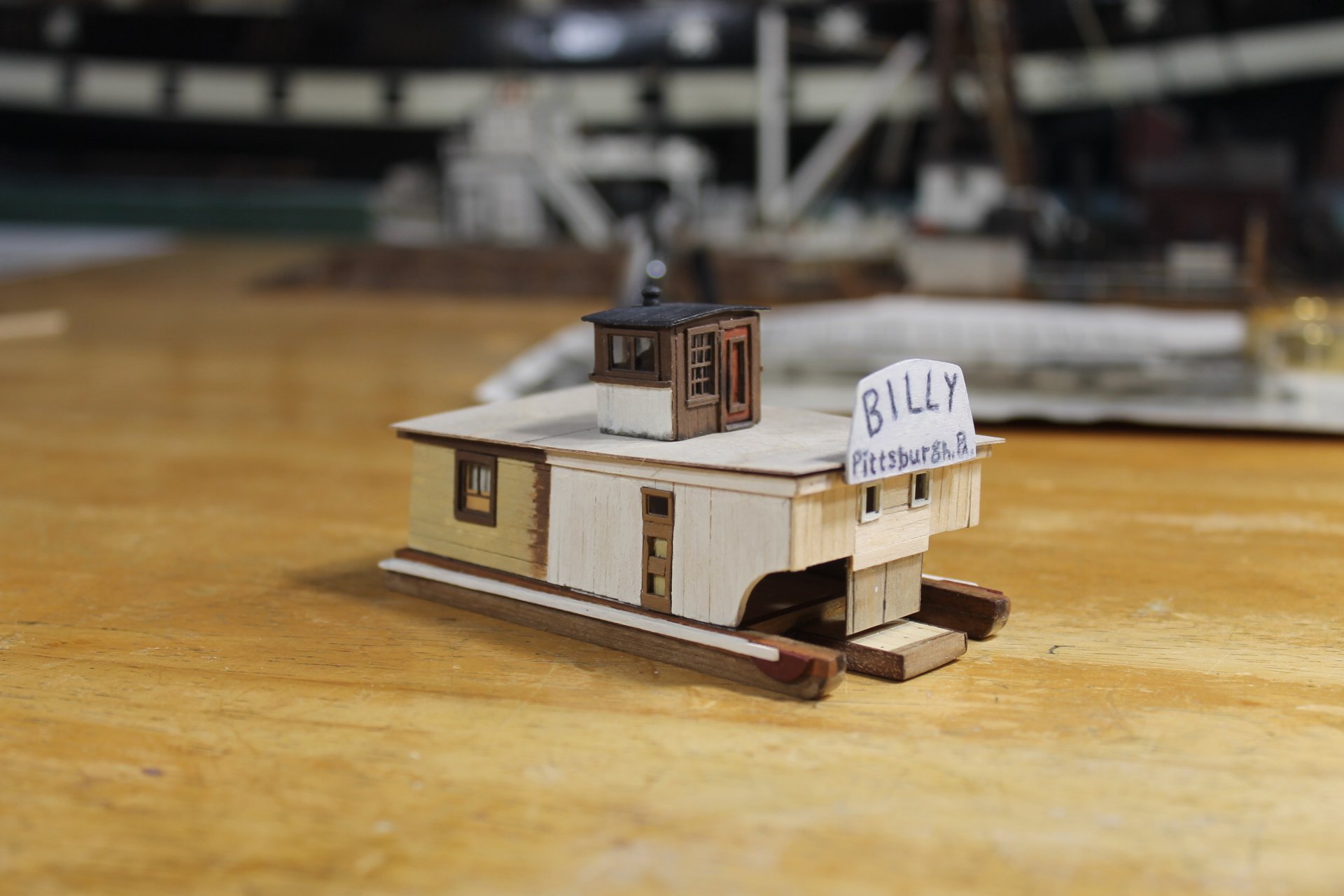

 The name board height has been corrected.  I tried doing the lettering freehand, I've gotten close but not there yet. 3CEEF4BD-6136-4CC2-9B97-78DDA9D56AA5.thumb.jpeg.42f0aeea3b2e005ec4b53b46e6178a9a.jpeg

1 hour ago, Jim Lad said:
suppose you've thought of printing the name on paper and pasting it onto a more solid backing?
 John, thank you for the idea, Bob @Knocklouder suggested the very same earlier. Depending how this looks when I cry uncle I may give the printing idea a shot.
Looks pretty good to 'me'! What is it that you don't like about it?
How's about posting a repeat image of ol' Billy so we have yours and 'his' close by to look back and forth at?
 Thank you, Tom. It's just not 'there' yet, you know what I mean.
I agree with John and Bob that printing on paper and then applying would be a good solution.  You've got 2 different fonts to deal with and the lettering on the original has sharp lines which will be hard to duplicate freehand at this small scale, especially the serif font of the "Pittsburgh, PA".  I believe you could easily create a graphic with the lettering on slightly weathered/off-white background for printing.  You could even add that faint dividing line that runs thru BILLY if you wanted to get crazy!
I'm also wondering what causes those wrinkles near the top.  It almost looks like a stretched canvas that's not quite tight enough - like how my bed looks after I put the sheets on it!  That's the cool thing about these projects of yours - trying to figure out what's going on by just studying these old photos.
Just coming aboard a long way into this build.  Very interesting as usual.  I love the one of a kind builds you do Keith.
As to the wrinkles at the top of the aft sign, I think they might be paint blisters almost ready to flake off.  Can't be a fabric - the line through the name is a separation gap between two boards - in my opinion.

What about making water slide 'decals' of the letters on your computer/printer?
