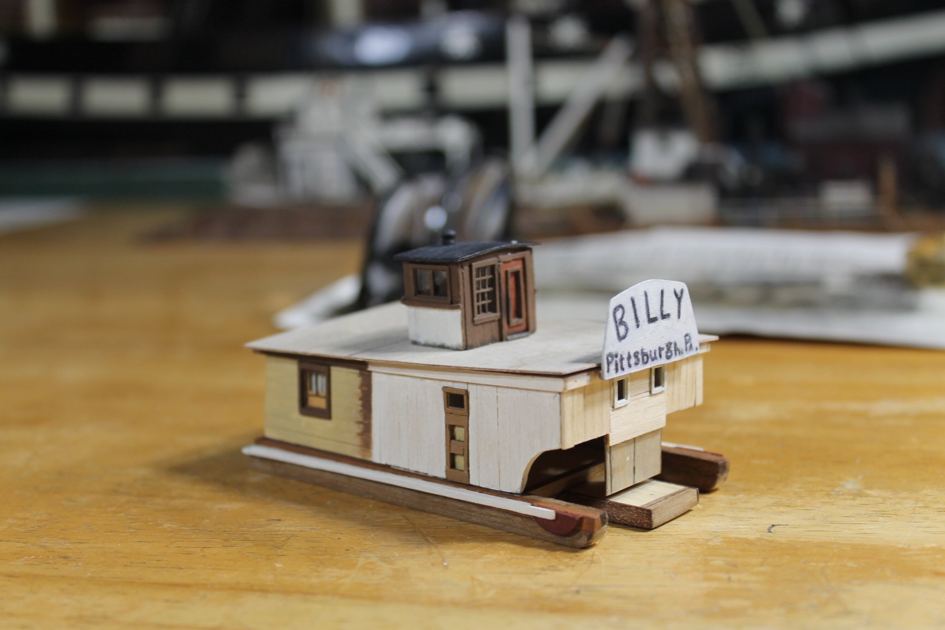

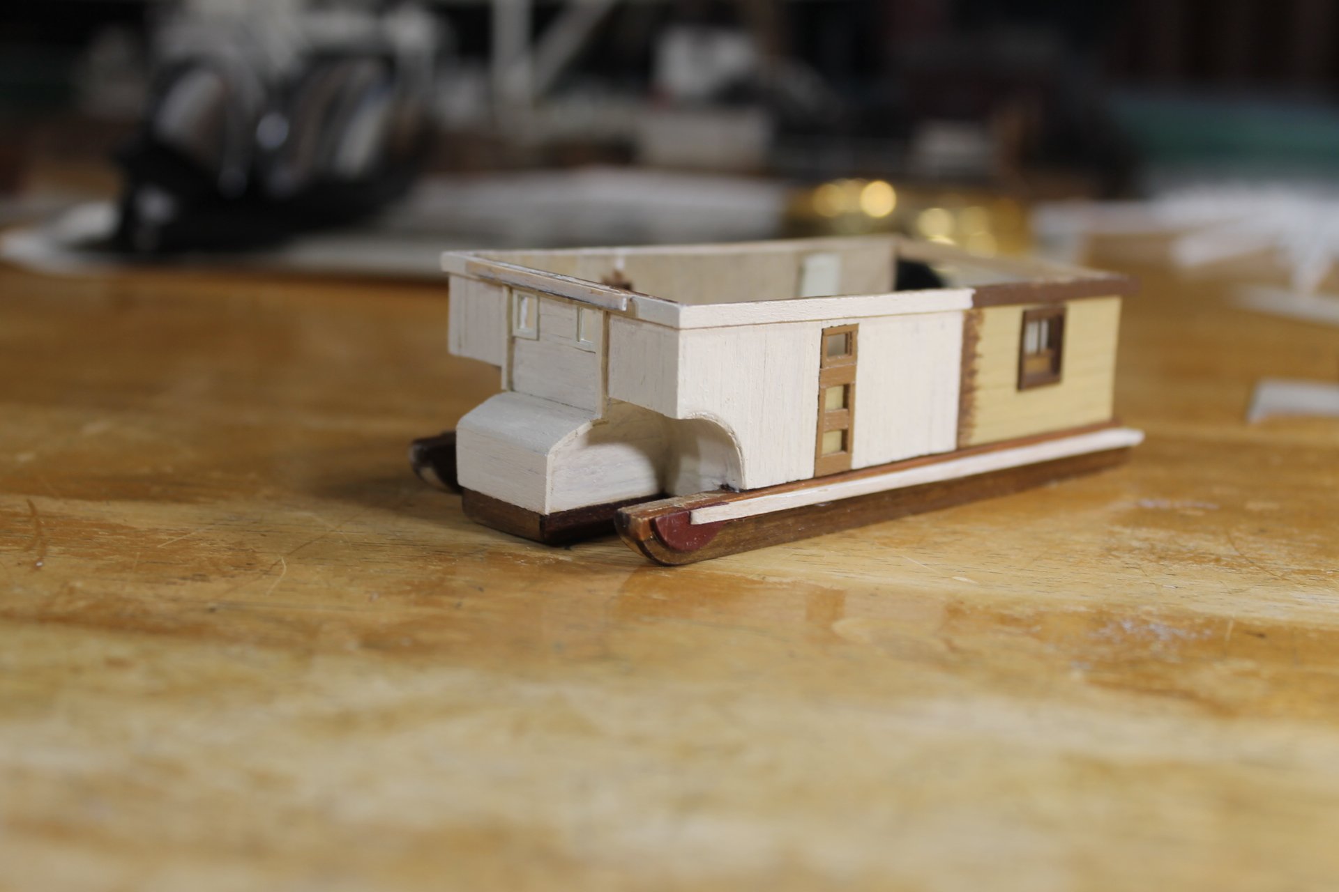

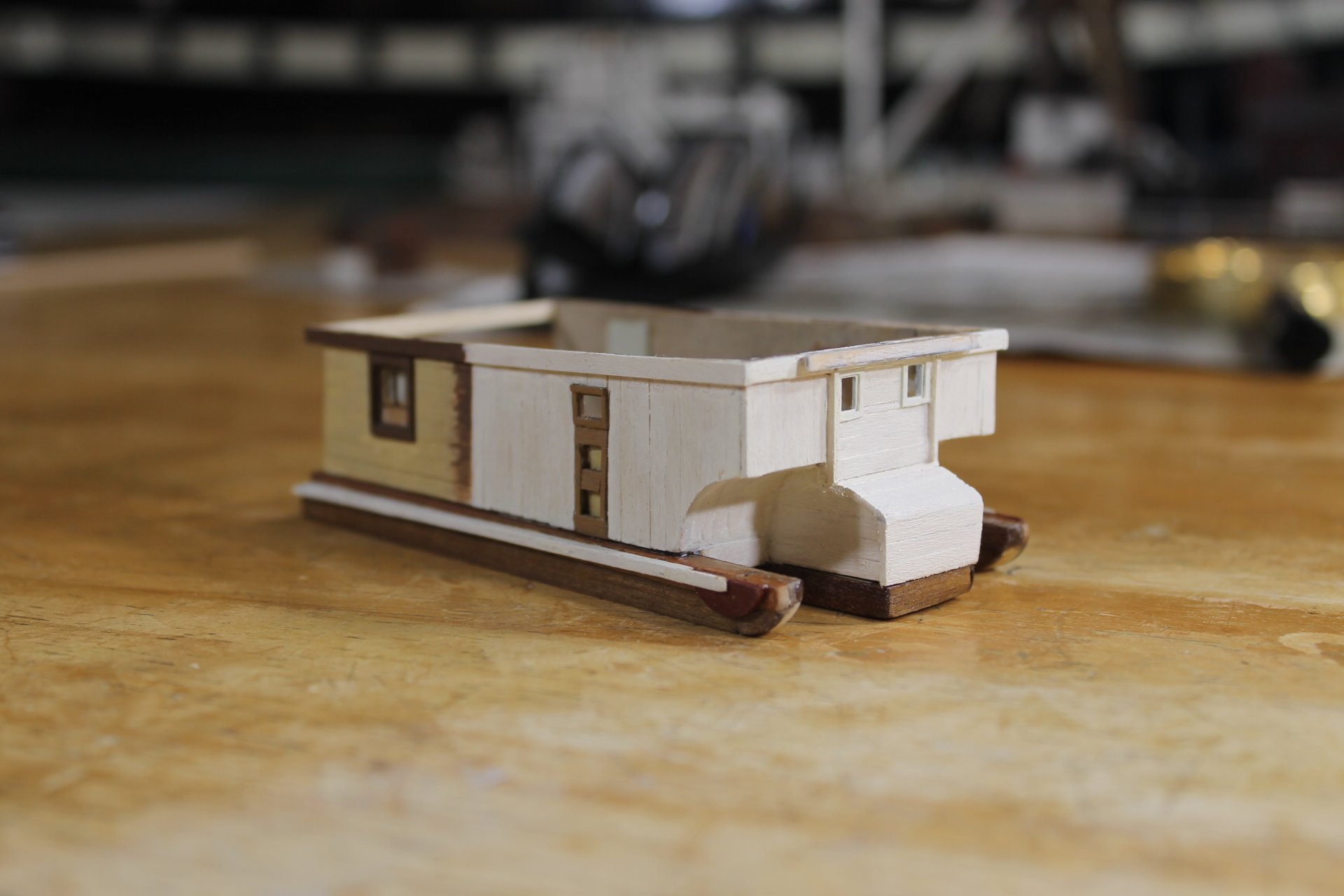

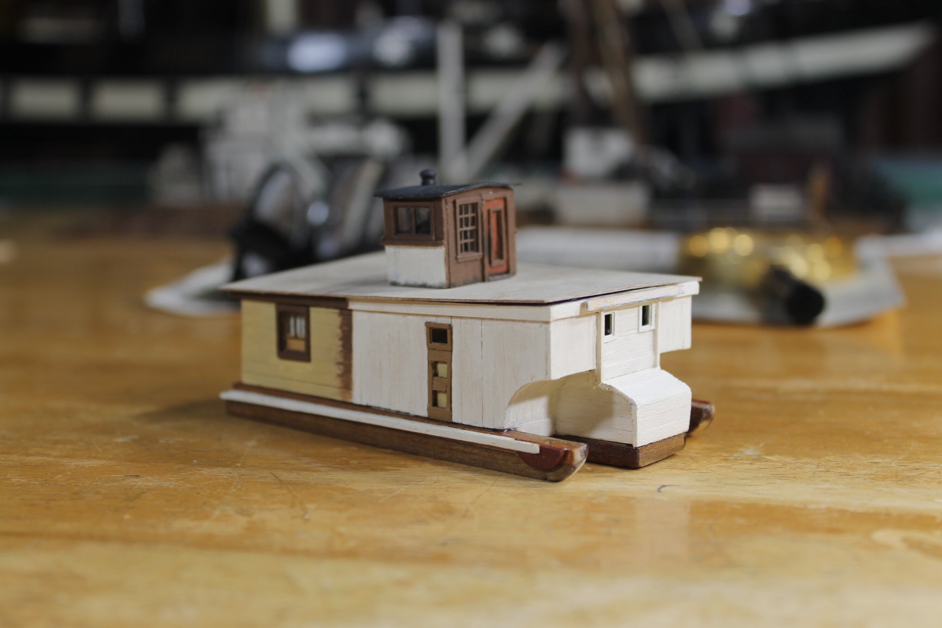

The arches and engine room are made and attached. In fact, the side walls and the stern wall including the engine room  are attached to the hull.C00B188E-58E7-414A-AAD9-72CF3D36F5C1.thumb.jpeg.a4e009c31a391d13ebfb367d23c7f100.jpeg
 I struggled with how best to make the arches and finally decided the easiest way (also the most sturdy) was to drill a hole in a piece of scrap one by with a Forstner bit , cut the hole in half, and then cut the half hole to the correct width. I trimmed off the outside portion of hole to fit inside yet leave enough wood to glue to the side wall. Making the engine room's little side walls was a fiddly process as the boards meet the arch instead of going past the arch. Going past the arch would have been a lot easier but getting the arches to meet top and bottom points were hard enough without trying to accurately make the width correct.

I definitely like how the tricky wheel wells came out.

 Thank you, Eric. It's far from perfect but I'm pleased with the way it turned out. In the original photo I can't see boards in the arches/wheel wells plus it's darker (I think) than mere shadows. It's possible and would make sense that Engel lined the inside of the arches with canvas. Just a thought. I'm leaving the arches white and will weather them with pastels.

Looks really good, Keith! A very interesting solution to the wheel arch problem. Can't wait to see her with the paddle wheels fitted.
 Thank you, John. Yes, I to look forward to the paddle wheels being installed as that will be the last major hurdle to cross.

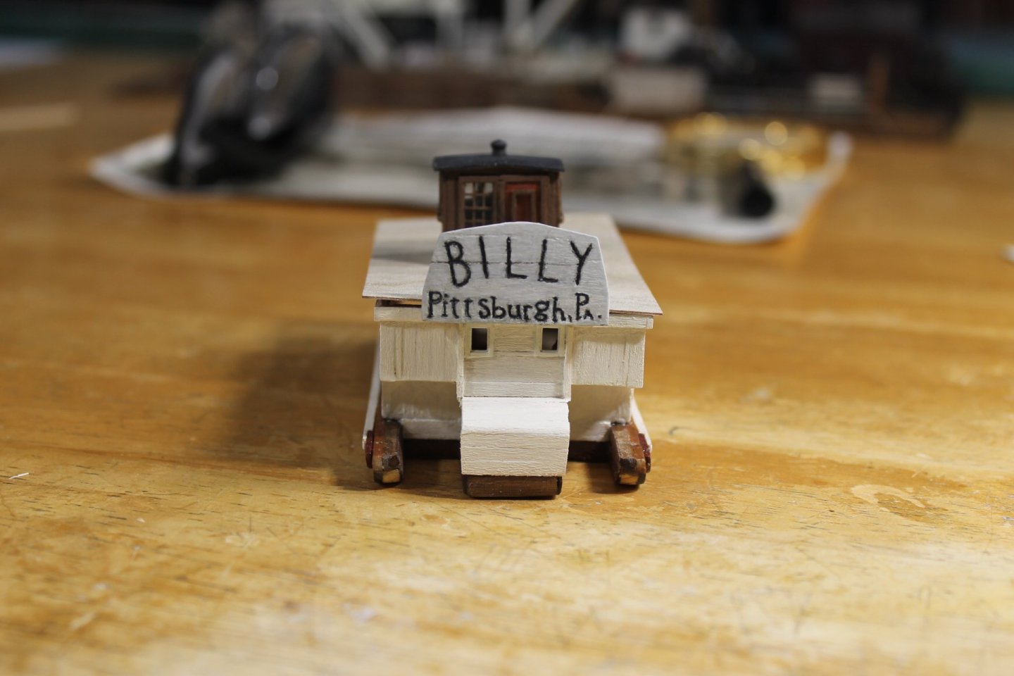

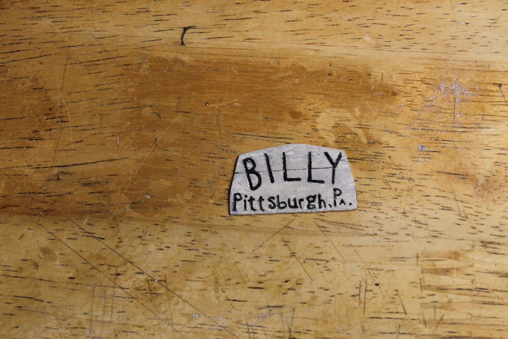

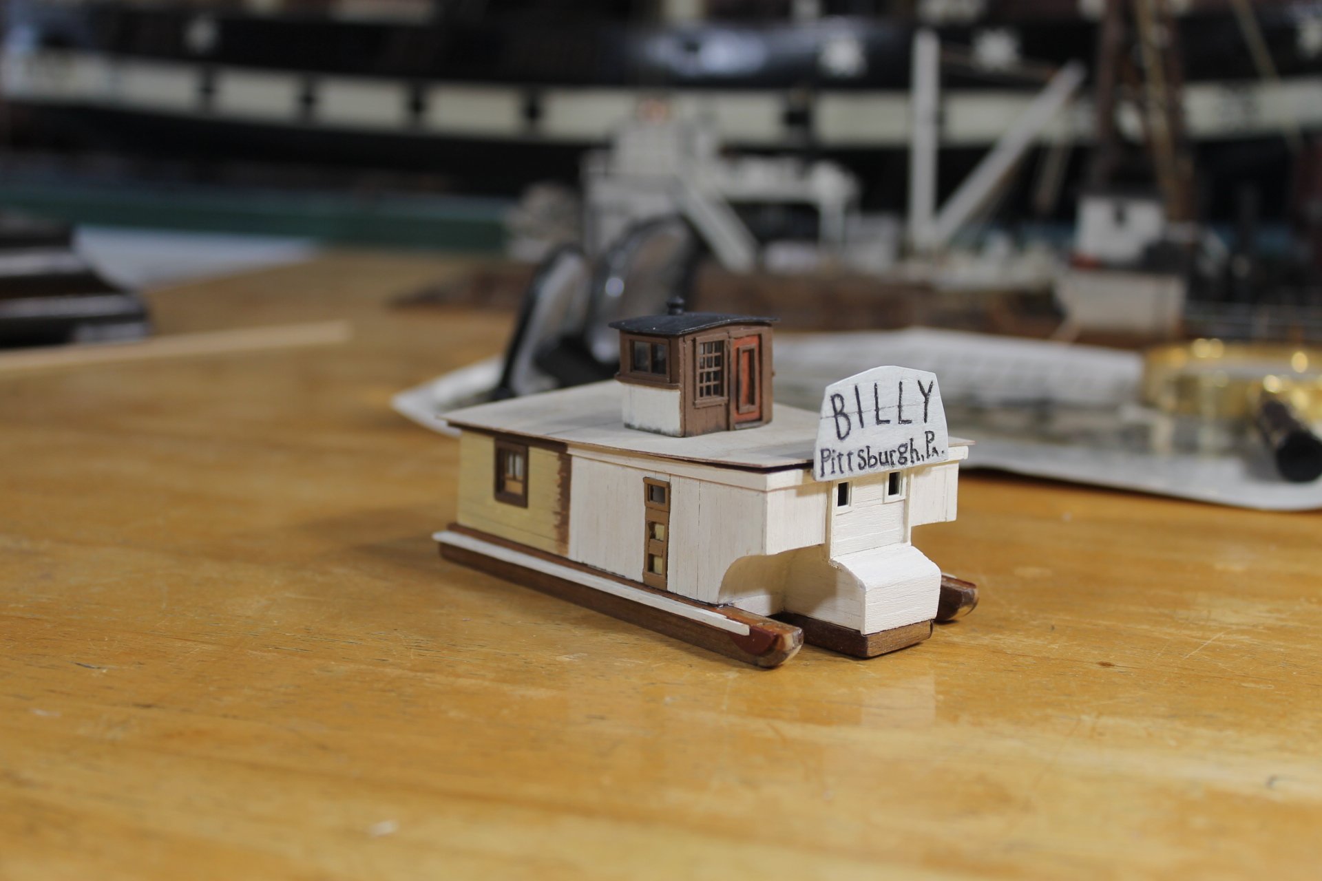

Name board 4.0
 Name board 5.0. I had such high expectations yesterday when I started on 5.0 that once finished I was so disappointed with the results I didn't even put it on the model.075B5032-E5F5-4AB0-867E-05057F006382.thumb.jpeg.d31041f20d8a8b380d335dffdd6a9b9c.jpeg
 Name board 6.0. I've attached 6.0 to the model in anticipation of it remaining there till CA do us part. I am far from happy with the results but at some point I have to move on. If I every get my order of dry transfers I'll see how those work out but my thinking is 6.0 is as good as I'm going to be able to do.  3656FCCF-36D4-47B8-8862-F76EB14C3FEE.thumb.jpeg.8136f8092c8d8aefc61440b7acf75a0f.jpeg

Your practice with the miniature lettering is showing clearly in the very much improved sign 6.0, Keith.
 Thank you, John. Maybe if I did two a day for the next month I might get to a point where I'd be satisfied with the results but unfortunately I don't have that amount of time to devote to this small part of the build.

Ver 6.0 looks pretty good to me Keith, I think the scale (including scaling the tones etc of the paint) look about right, certainly it is very acceptable.
cheers
Pat
Edited by BANYAN
V6.0 looks really, really good! The scale is there, font looks proper, it's sooo dang close! Looks can be deceiving. I think you are there! simply darken the interior of your letters and if you want to get 'real' picky crisp up the outer edges of those letters just a teeny-tiny bit (don't clean up the edges so much that it looks professional) and you'll be spot on, just like the photo!

 Thank you, Tom. Once the name board has been attached due to it's size, there's no additional work that can be done to the lettering. It is what it is. My dry transfers have finally started moving the the USPS system and should arrive sometime this week. Since I've had a day I see the possibility of a 7.0.

I think you've successfully captured the look of that hand-painted letter board.
 Thank you very much, Ken.

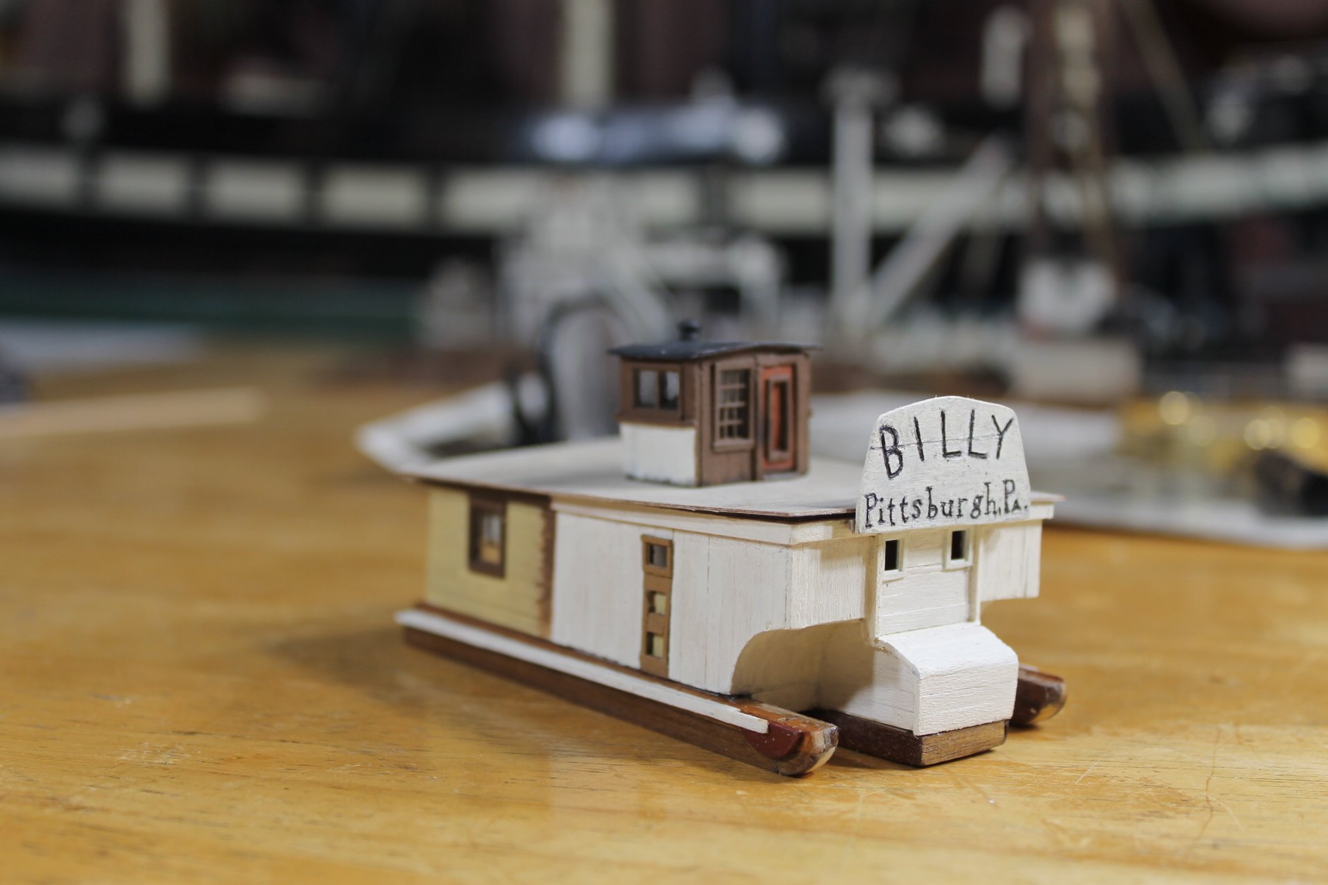

 Lucky number 7!

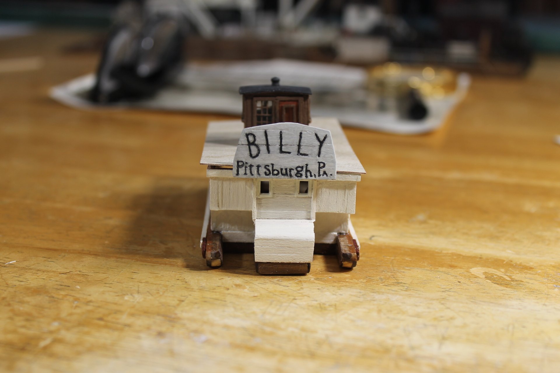

 When I threw my little tantrum with myself on 5.0 I immediately set it aside due to my disappointment for it not being "perfect". After looking at 6.0 for a couple of days I revisited 5.0 and reworked the lettering. Name board 7.0 is actually 5.1 but it looks ever so much better than 6.0, IMHO. I am at peace with 7.0, I am really done with the name board this time, once again it's far from perfect but I can happily live with it.
 I am real pleased with the scaling, note where the letters are in relationship to the two windows below.

9 minutes ago, wefalck said:
don't want you spoil your efforts, but could you make the letters in BILLY a bit bolder still? They have the right shape, but look a tad skinny.
 You're a hard taskmaster, Eberhard. :)  As I said, it's far from perfect but as I also said, I'm done, no mas.

1 minute ago, wefalck said:
Fair enough, forget, what I said. I fully understand that version 7 is enough.
 Eberhard, you deserve an explanation as to the why of it.
 I am using 6X glasses to work by but those letters are very small. While the pen points are small landing the pen points exactly where they need to land and not be on either side of the line but dead center is difficult even with as steady of a rest as I can make. As is I had to trace the letters with a dull point where the pen tip had a channel to follow and I still ran off course occasionally. For myself, there comes a point where it's okay as is, better leave well enough alone. I would rather the lines be less than perfect width wise and somewhat straight than try to make them wider and in the process have wiggly lines. Does that make sense? :unsure:
