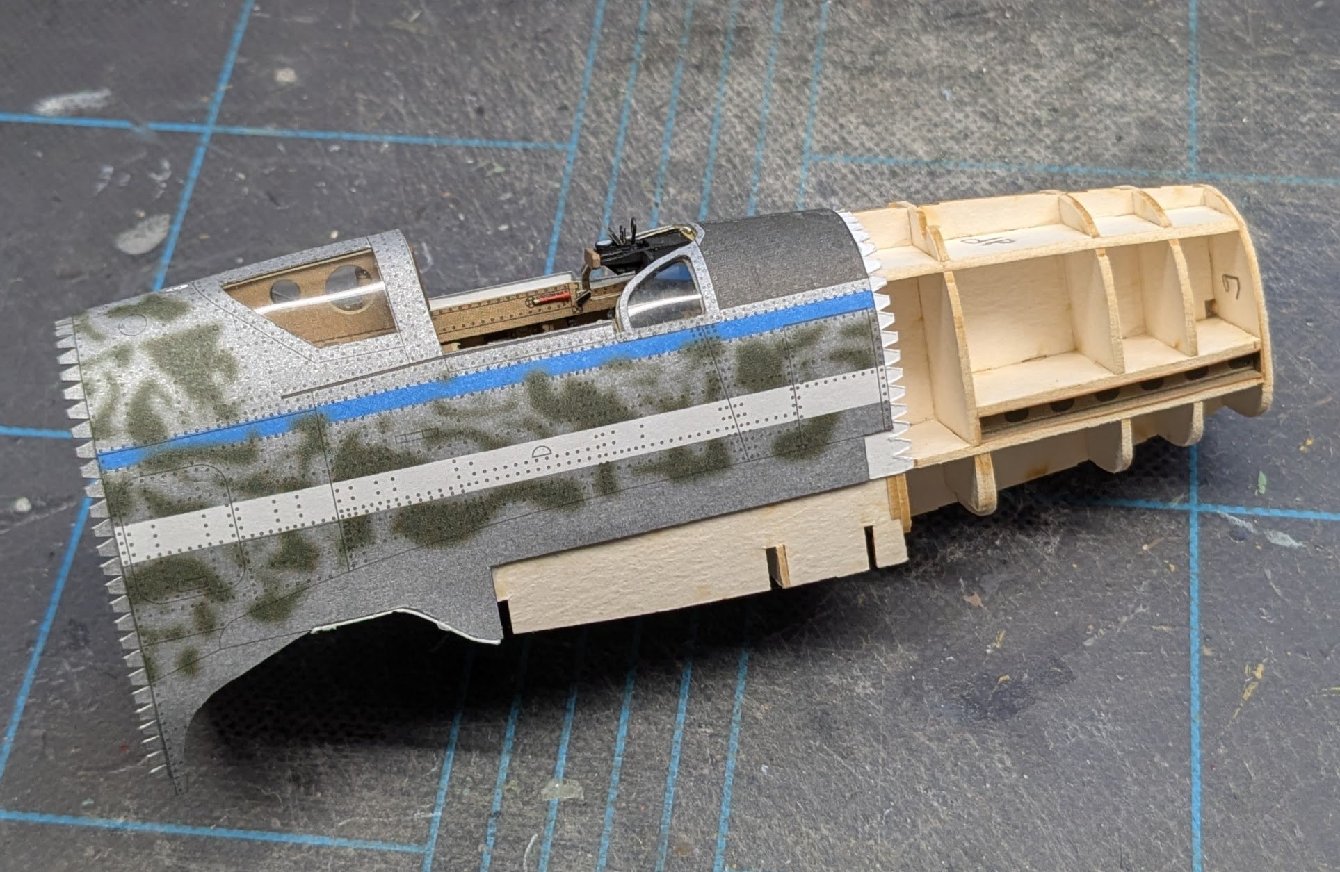

Next bits. For reasons which I will not rehash here, I tend not to include internal framing on my canopy glazing, but for this model I will. Like the Curtiss P-40, the Ki-61 has glazing behind the pilot, and it also has two small glazed panels at the bottom edges of the windscreen. The internal framing provides additional substructure for gluing down the faux glass cut from an overhead transparency sheet. The frames are painted silver on their reverse sides just in case any should be partially visible once the exterior skins go on. You have to squint hard to see that the glazing is finished in this image, but it's there!
Believe it or not, I can FINALLY start work on the cockpit walls now, hooray!

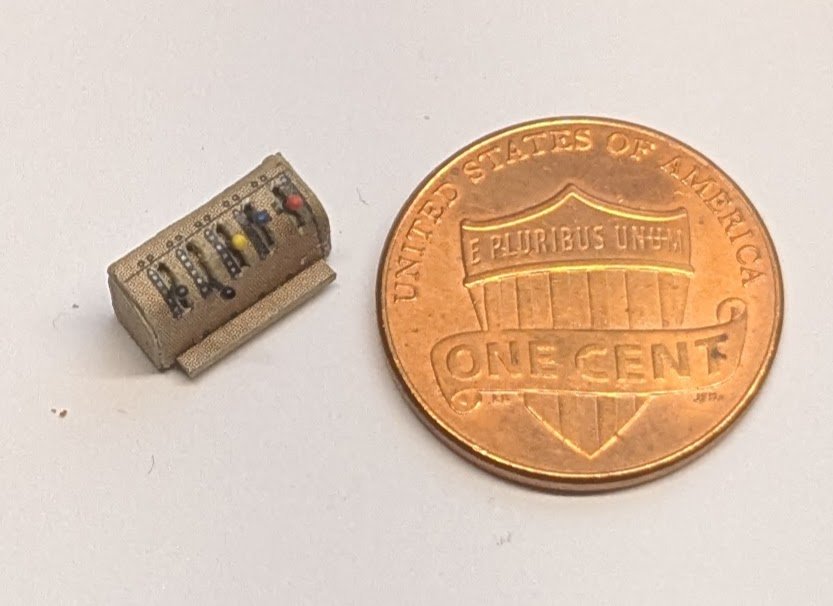

Remember the old adage about treating every sub-assembly as a separate model? Takes time, but it works. Here's a bank of setting levers. What do they control? No idea. 😂

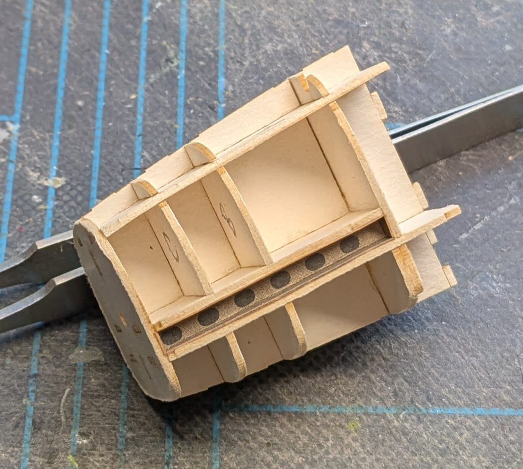

 I can see doing the fiddle part of bending and rolling and getting sub assemblies made and ready to attach to the main assembly but hitting the exact mark necessary for alignment with parts that small is a bit mind boggling. Chris has to have either a very steady hand or a very good rest.

Big milestone today! Take a good look, because it's now time to zip up the cockpit.
At long last we can work on something different for a change! The forward fuselage framing is next.

If you still wanna know what the levers do, here you go:
From left to right, they are
 - emergency hydraulic pressure (not sure myself what this is)
 - flaps
 - fuselage gun loading (maybe safety)
 - radiators control
 - landing gear safety (this is the small black plate between the slot of red and blue tipper lever, it should be metal casing with a slider with a notch to lock  the landing gear lever (rightmost lever on your model) and have a very short purple tipped lever)
 - landing gear
So landing gear one should be down, guns down, radiator and flaps depending on your modifications, but would be closed when parked and no clue about the hydraulic presure, but would guess up as well.
- source: Maru Mechanic - Mechanism of Military Aircraft 2 - Type 3 Hien & Type 5 Army Fighter - Type 99 Light Bomber

1 hour ago, Danny_CZ said:
Very cool what you can do with paper!
Thanks for the compliment and info! Generally, I don't worry too much about the what the doohickeys are and what they control -- for me, the outside of the plane counts far more than whatever detail happens to be on the inside. That being said, I do look for info online regarding appearance, color, settings, etc., and if that doesn't help out, then I just go with whatever positions are indicated in the diagrams. This is why, for example, my Spitfire Vb, has its gear selector in the 'up' position, even though the gear are very obviously down!
