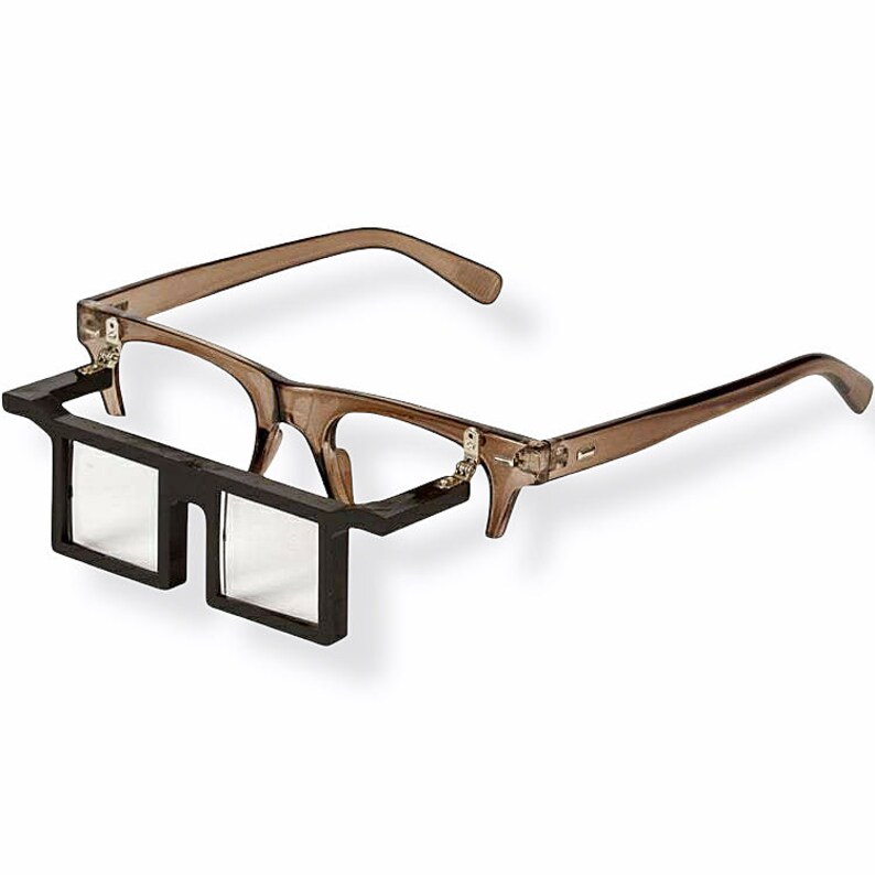

On the subject of magnifying glasses, I am not a fan of the headband style. I do not wear prescription glasses but at age 57 I do now use reading glasses. A Jeweler I know turned me on to the type of magnifiers I have been using for more than 10 years: Telesight half-frame magnifying glasses. They flip up out of the way, and come in different magnifications. Very comfortable -- not heavy. http://www.telesightmagnifiers.com/catalog/i169.html
They make a full frame version for your RX lenses if needed, and a clip on version.
Also available on ebay....
BrianK
Telesight Half Frame Magnifier 2.00x
