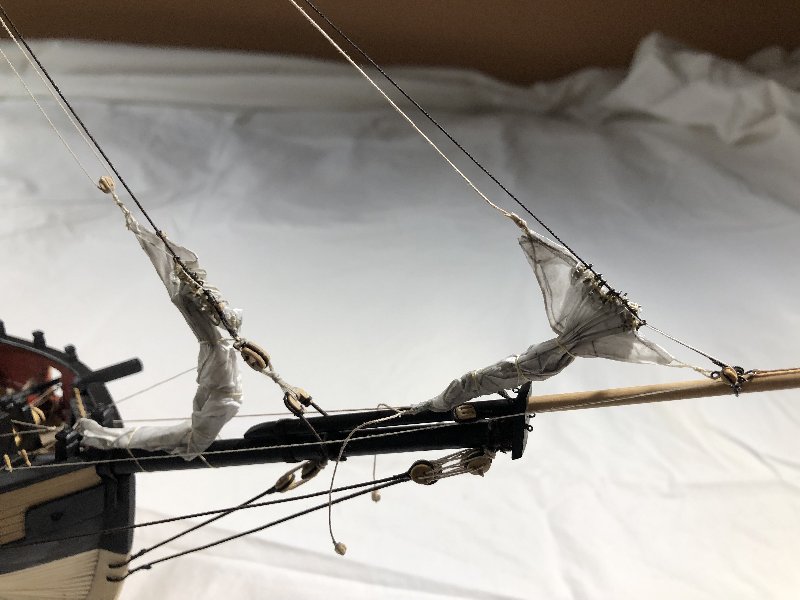

I finished furling the jib.  It looks OK, but I’m not yet sure how I will belay the staysail and jib sheets.  I added (not glued) two timber heads, but I may not use both.  I’m still thinking and trying different solutions.  There aren’t many books on fore and aft boats.

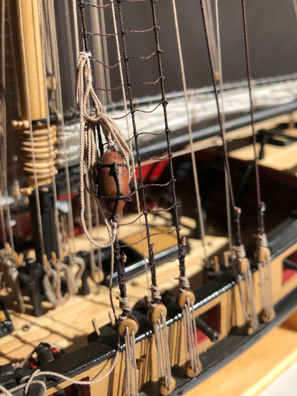

I made some changes to the rigging of the traveler to reflect my research.  I just added a long block which enables the line to lie further away from the jib down haul and the bow sprint cap.

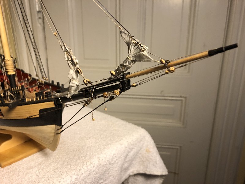

I’ve been remiss with my posting, but my current status has the rigging, for the most part, done.  I still have a few lines to do; and, of course, I need to trim all the excess and add rope coils. I also have to make adjustments so the yards are positioned correctly.  That will be done as I tie the lines down permanently.
The whole mast structure is surprisingly tall.  I’m told that is common with American boats.
I also drilled the sweep holes into the hull.  I was very reluctant to do that, but it turned out O.K.  The oars even fit through the holes (oar blades as well).

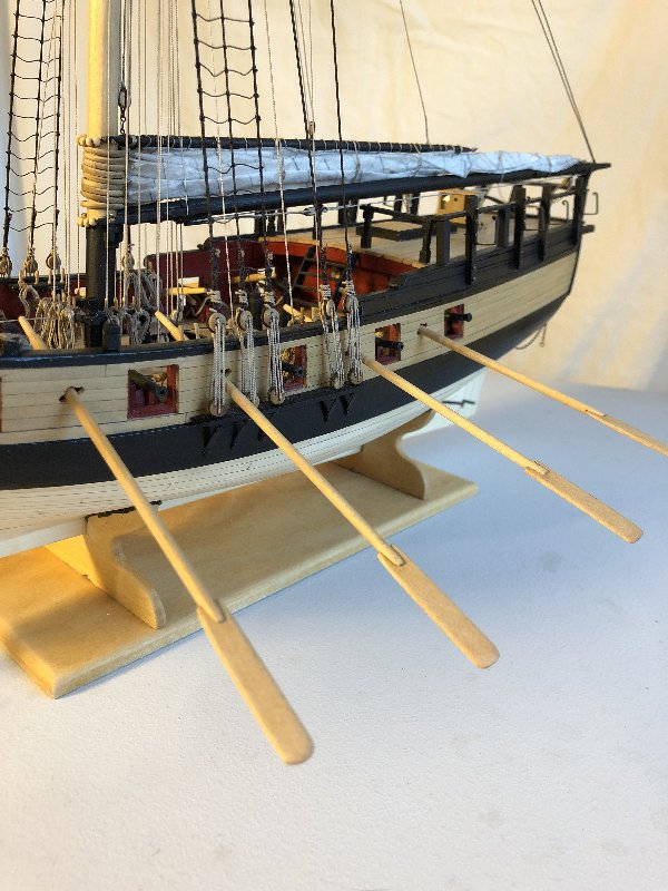

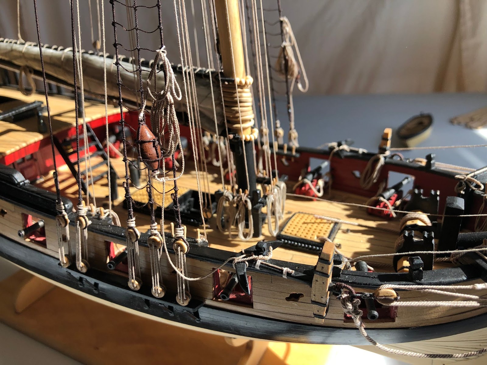

I have made the rope coils and glued down all the lines to their belaying pins.  The shrouds and back stays are also tied down.  I still don’t like the coils, but these are the best I’ve done.  I’ll try some new ideas for my next model.
I also redid the photo of the boat with the sweeps out.  I realized that the jolly boat also has oars.  So I put those oars on the small boat and edited the last post.

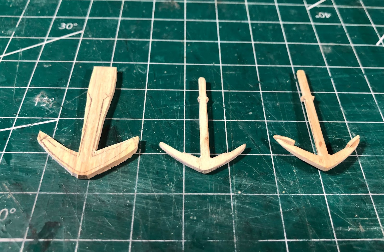

The latest update is the carved anchors.  I carved them from a 3/32 sheet of boxwood.  I once tried to carve anchors out of basswood but always got the inevitable split along the grain.  Anyway, an attached photo shows the steps in the process.  The anchor on the left is cut from a jeweler’s saw.  I use files to reduce the anchor so it looks like the middle one.  And sand/file some more and add the carved ‘blades’.  The second photo has the completed anchors.  I still have to make buoys and the lines for them.  And, of course, attach them to the boat along with the anchor cables.  So much to do.

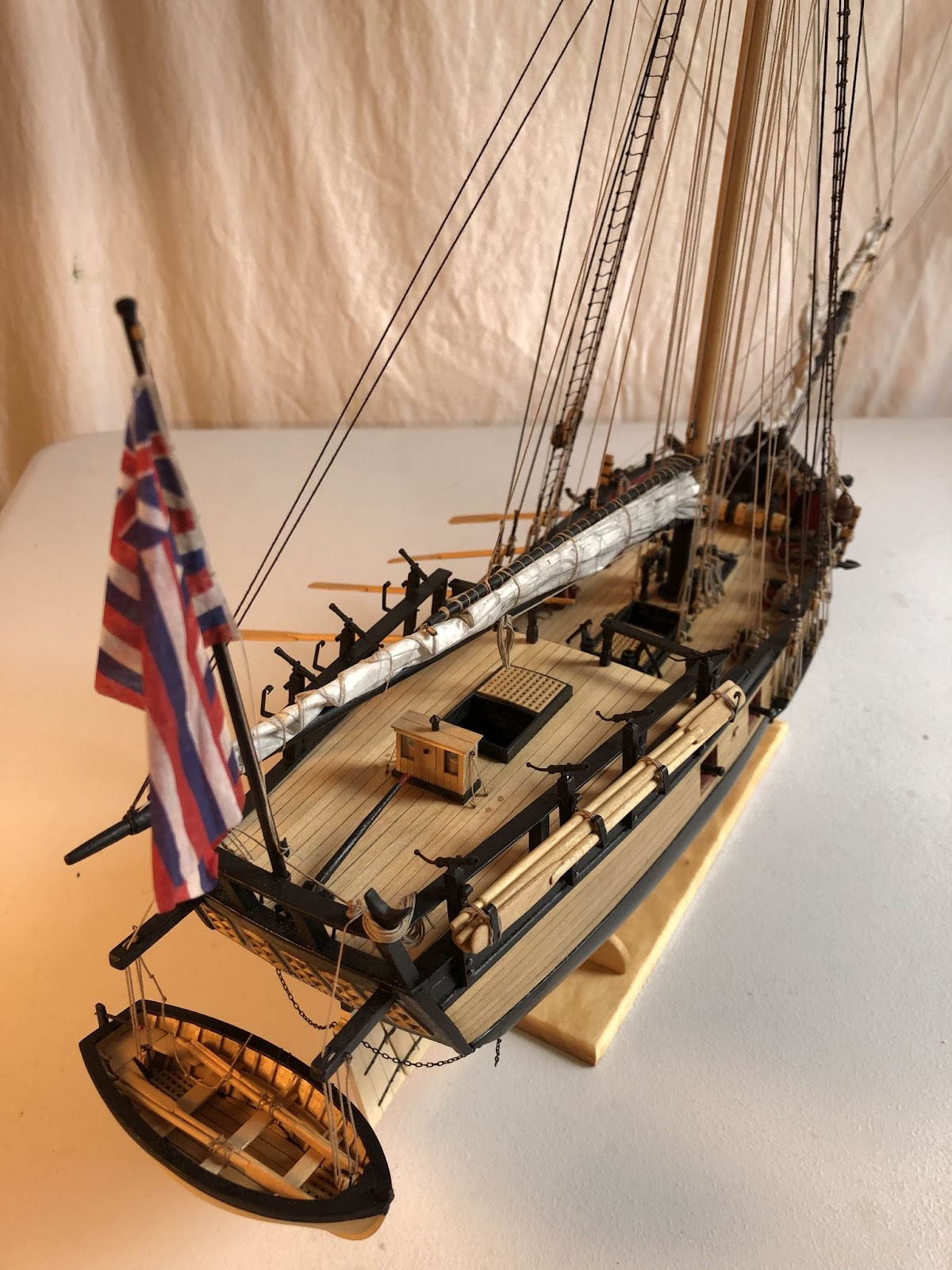

I completed the installation of the anchors.  That included making and rigging the buoys.  I based my anchor design on, “Historic Ship Models”, by Wolfram zu Mondfeld.  The buoys are modeled after the Cheerful blog of Chuck Passaro.  The buoy line is long enough to reach seventeen fathoms; the anchor cable is attached to the anchor using a fisherman’s bend.

Last Night I presented the completed model of the Providence to my ship model club.  The updates I made since my last posting were to add the ensign on a staff, and to rig the ship's boat from davits at the stern.  The ensign is a variation of the Grand Union Flag that was in use by both the army and navy from 1775 to 1777.  I chose the variant with red, white and blue stripes as seen on the 1777 Holman painting (see my first post).  The ship's boat rigging was simple; and I am hanging the boat so it will be in the water.  There is a knotted line for the crew to access the boat without the need to raise it.
