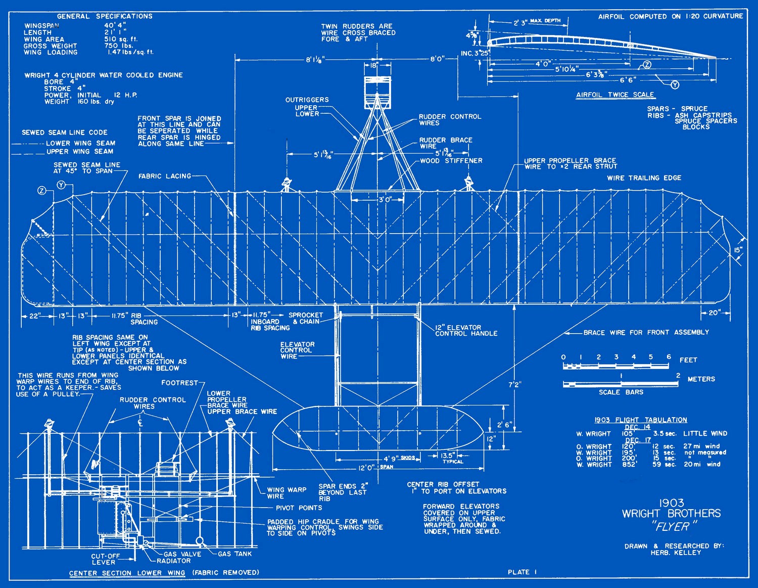

Well there are options my friend....
https://www.ebay.com/itm/304081343834?_trkparms=aid%3D1110006%26algo%3DHOMESPLICE.SIM%26ao%3D1%26asc%3D233120%26meid%3D3c1f7c8b699541af925f65f6781a0502%26pid%3D101113%26rk%3D1%26rkt%3D12%26sd%3D233182387549%26itm%3D304081343834%26pmt%3D0%26noa%3D1%26pg%3D2563228%26algv%3DDefaultOrganic&_trksid=p2563228.c101113.m2108
And
https://www.ebay.com/itm/334089683020?_trkparms=aid%3D1110006%26algo%3DHOMESPLICE.SIM%26ao%3D1%26asc%3D233120%26meid%3Df16eab3e57384280830ff24fbcdca488%26pid%3D101113%26rk%3D1%26rkt%3D12%26sd%3D304081343834%26itm%3D334089683020%26pmt%3D0%26noa%3D1%26pg%3D2563228%26algv%3DDefaultOrganic&_trksid=p2563228.c101113.m2108
No info on how complete the first one is but the second appears complete.... And they are both the first version which matches the one you have.... The second looks complete compared to the one I had....
Probably the best you can do for an original.....
Then there is always these....
you can scale those to whatever size you need....
Hope it helps....

thanks Egilman.........I have been doing the virtual cha-cha with these ya-hoos :angry:  they sent me the PDF....but it doesn't give me the specifics that the diagrams show.  thanks for posting them.  I'm almost to the point of giving up on them.........I'm not asking them to send me parts.  I did find out that I'm missing quite a few parts........I only have two sheets of parts,  what I should have four sheets.  I'm probably missing wood strips as well.  not a big deal,  since I can get them at Hobby Lobby.  if I showed you the email exchanges,  you'd understand,  but I seem to be getting the run around.  the last email came from a fellow named Dave {I think he's the owner}........and he seems to think I have these diagrams.  I told them from the beginning that I have nothing,  no instructions.....nadda.  I'm getting more help here..........and I appreciate it!  I sent one more request for the diagrams.......if they won't help me,   then I will go other routes.  but these will be neat to study....I'll see if I need to adjust their sizing.   I copied them.......I'll see what I can do.

I'll look into it........the prints Egilman posted will work,  but the build templates would be better.   without them,  I would have to transpose the lines onto the build board in which to gauge the rib placement.  the PDF does give most of the numbers I'd need.......it can be done.
