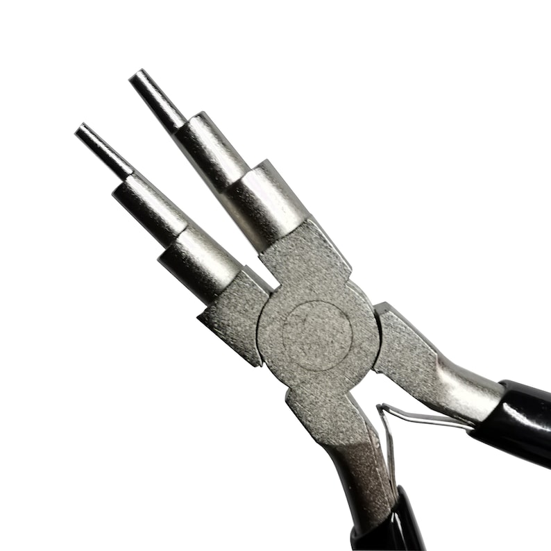

The twisted wire method of making eyebolts pictured above works wonderfully for small eyebolts. I find, however, that as the wire size increases, the twisted shaft's diameter increases as well and can easily require a drilled hole much larger than you want on your model. (Sometimes too large to work on a slim spar, making them too weak and likely to break.) Really, what you will find easier, and useful for many purposes, is a jeweler's round-nosed pliers such as Allan pictured in his post above. They are not expensive at all, although I'd urge you to buy the best tools you can afford because they will last you a lifetime and these will get used a lot. They come in various sizes, some with very slim points.
See the source image
They are also made with stepped points which will ensure that you easily make the same sized diameter loop at each step.
6-in-1 Bail-Making Six Step Pliers Loop Making Round Jewelry image 0
And, last but not least, there are pliers which have a round point and a concave anvil point for making perfectly half-round bends which are really handy for making hooks:
ROUND-AND-CONCAVE-NOSE-PLIERS-JEWELRY-MAKING-FORMING-JUMP-RINGS-HOBBY-WIRE-WORK-251634347658.jpg
Having the right tools for metal work is pretty important. This last tool is really what you want for eyebolts that are open. Cutting the "twisties" may work, but you'll probably end up with twisted shanks that are too fat and you don't need them, anyhow.
Check out online jeweler's tool and orthodontic instrument retailers. You can get these various pliers for as little as five or six bucks apiece, on up to fifteen or twenty bucks in brushed stainless steel for the fancy ones. "He who dies with the most tools wins!"
