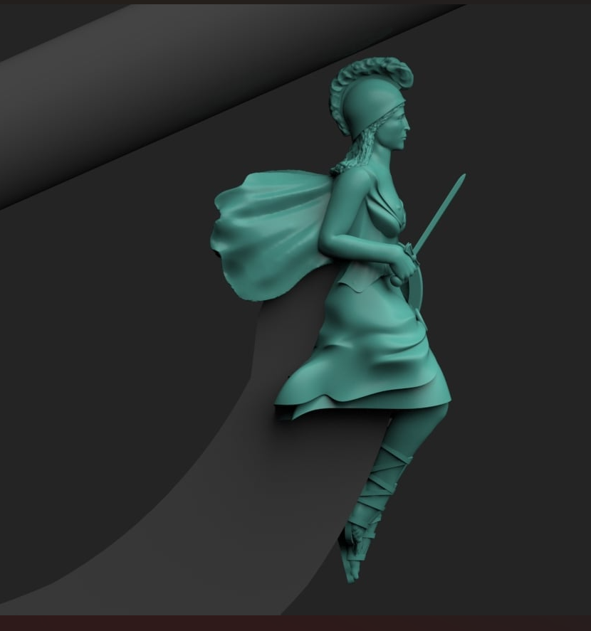

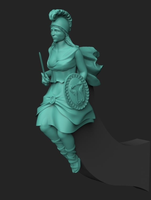

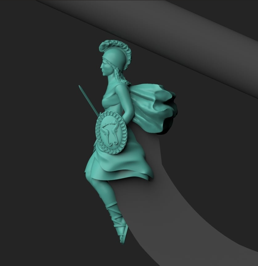

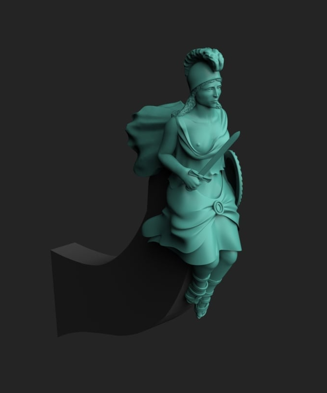

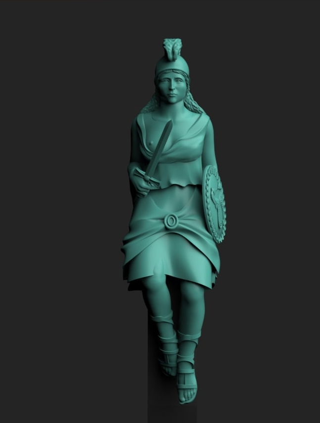

I confirm it's a pleasure to be backstage. Regarding the figurehead used for testing, I assume it's the original ? When you mentioned it matches the original, did you mean the one from La Tourterelle

Yes, we used the one from La Tourterelle as it is a lot more detailed than that of the Unite/Surprise, It seems the only real difference in overall shape are the flags angled upwards on each side. To make it more or less what the Surprise plans show, it would just be a simple matter of removing the flags. (I always assumed most will use the other figurehead anyway):
Another figurehead will be included that is more in line with the fictional version from the novels and film.
