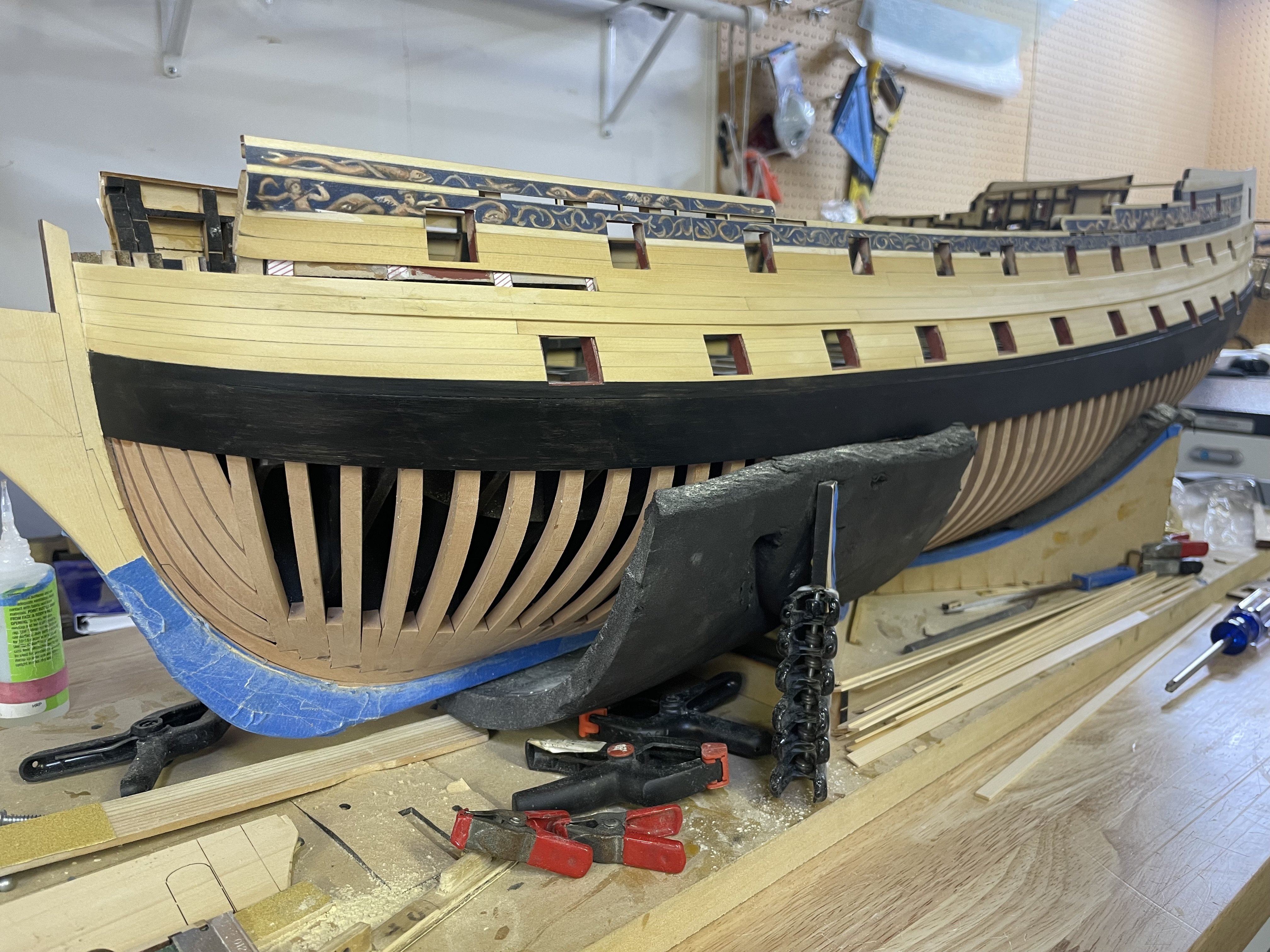

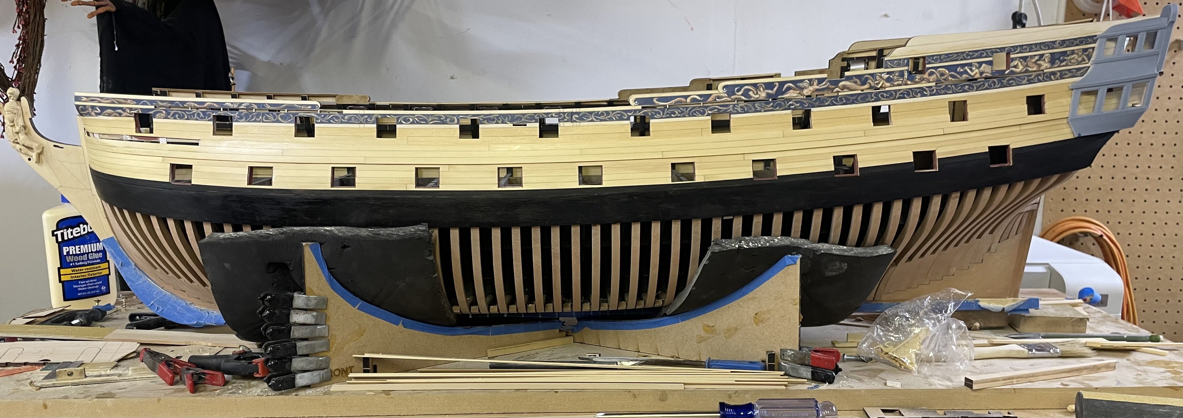

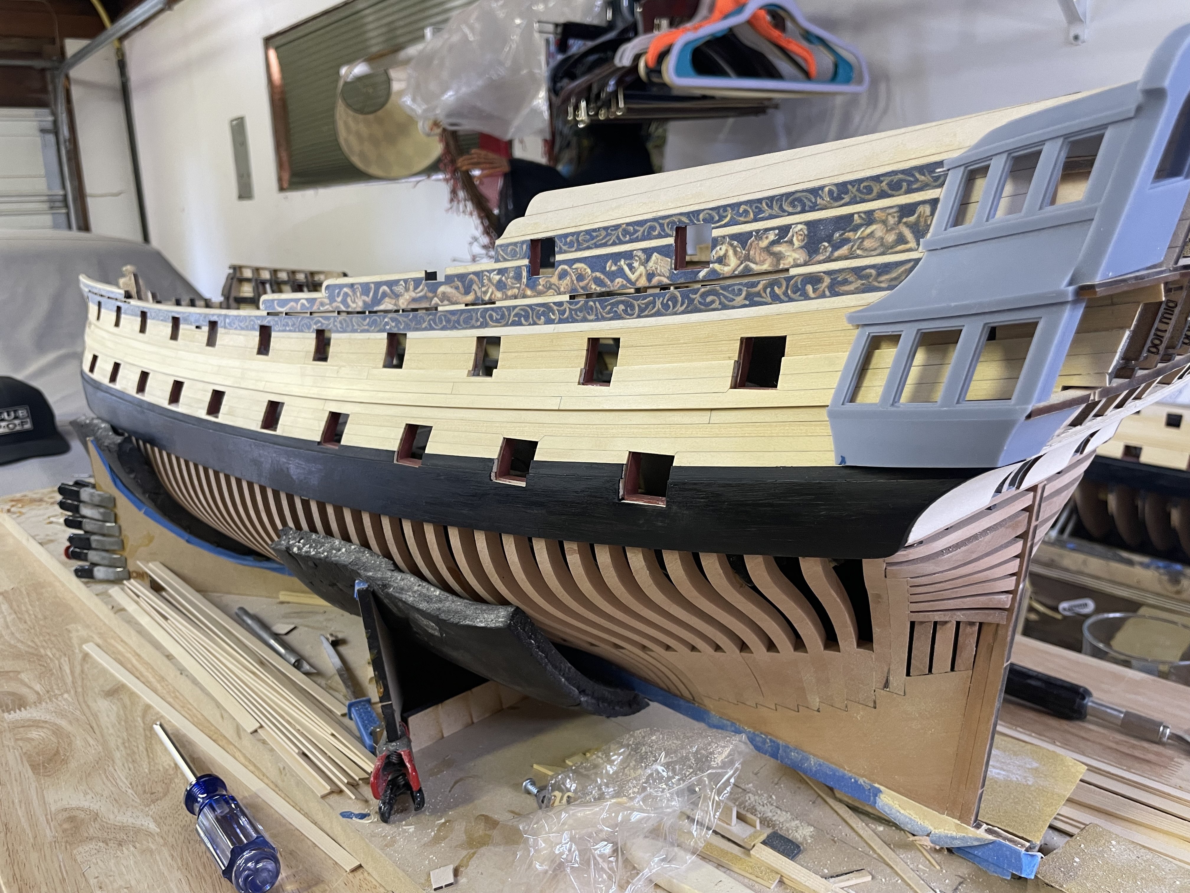

Back at it today with Portland, right off the plane and into the garage! I finished the port side hull planking, got it all blocked out and coated with WOP, now I can move onto the black strake and then the wales.
Also some goodies shows up, the remaining carvings for the model. These are the first production run in boxwood and look pretty good.
With each set of boxwood carvings you order, a set of stainless scrapers are included. These moulding profiles are taken from the drawings or Portland and the contemporary example of Bristol. The instructions will have a key that shows where each profile belongs on the model.
I couldn’t help myself and had to take a test run on a few of the rejects. These are just taped on and fitting pretty rough but you get a good idea of how it will look. There’s still a long way to go on the quarter galleys and the stern of the model. Before the rest of the carvings can be attached.

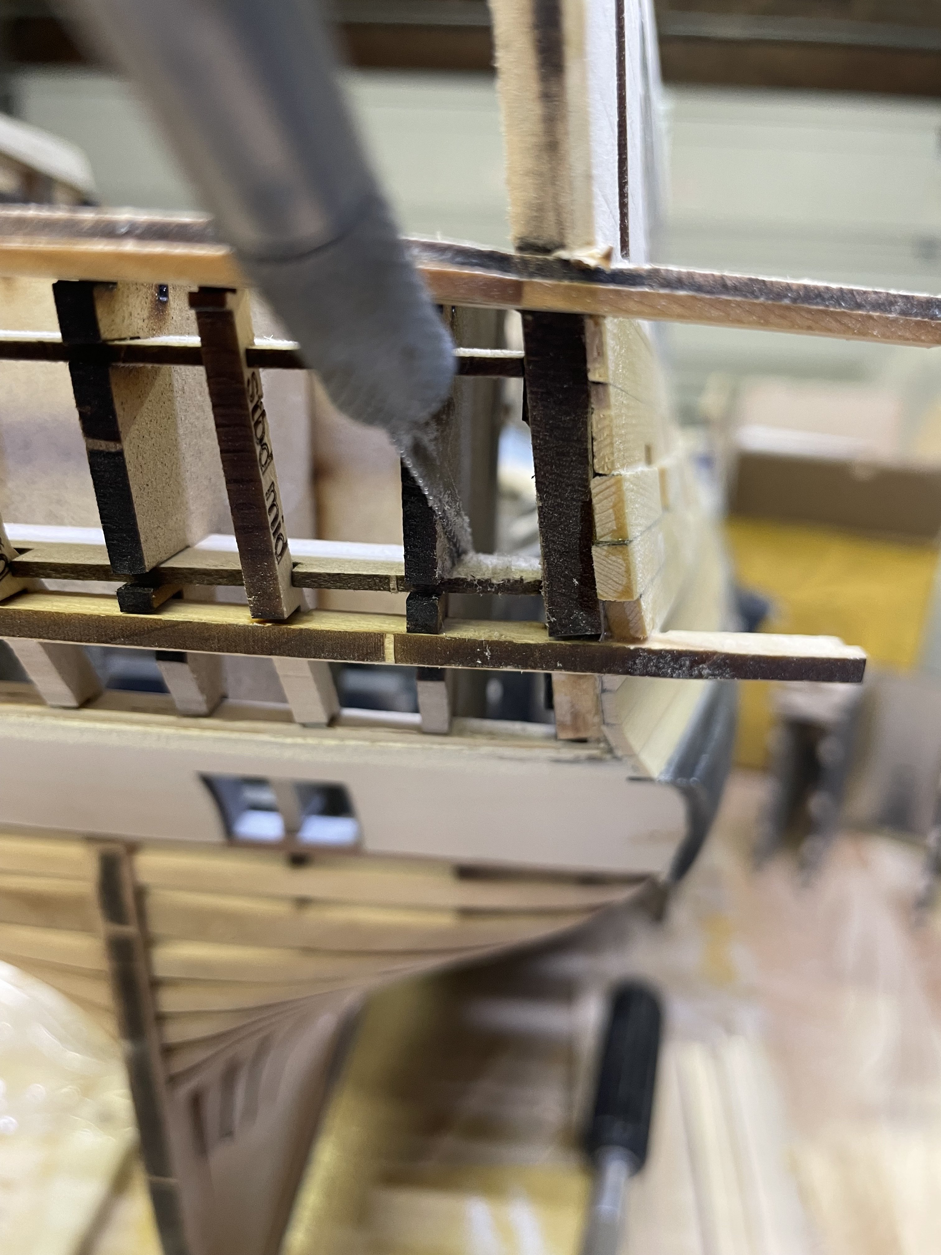

Last night I completed the port side main wale. I also began removing the frame jigs in order to fiar up the inside, especially the bow area so the beak head beam can be permanently installed and the remaining channel wale plank can be installed. I will be removing the stern frame jig soon and that requires a few steps in order to carefully extract it. Will be going over that soon
IMG_9885.thumb.jpeg.20a9aa042757154e9198eaef645c45bc.jpegIMG_9887.thumb.jpeg.2c2ece752bdbf861992c3a1b656b0a41.jpegIMG_9886.thumb.jpeg.9f44a6056358f6b2d2a74679d196a2a0.jpeg
you’ll notice a slight notch was made in the hawse piece to slide the beam by.
with the jigs removed and the planking completed (aside from the last channel wale planks), the hull is quite ridged now and will hold its shape without worry.

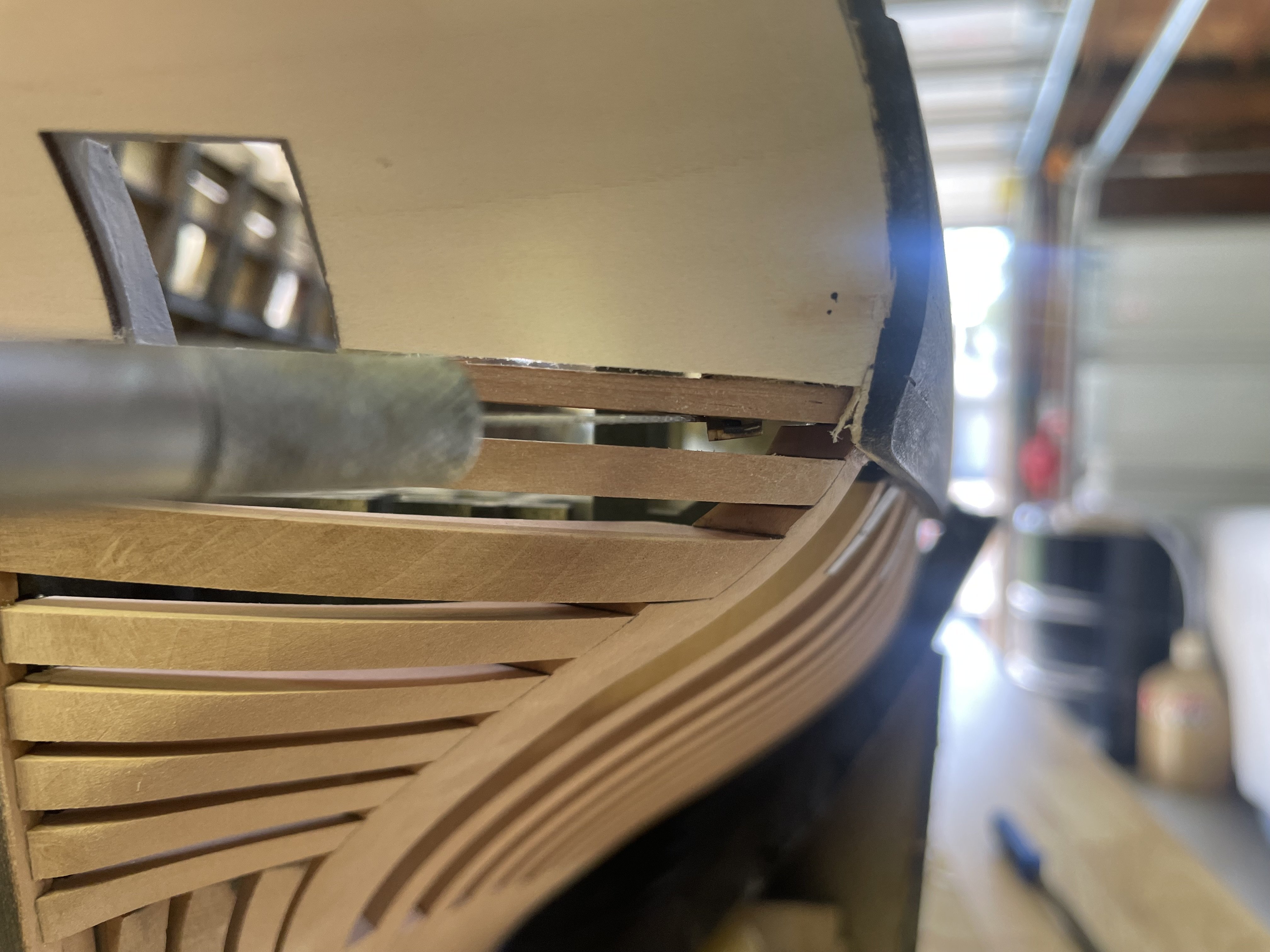

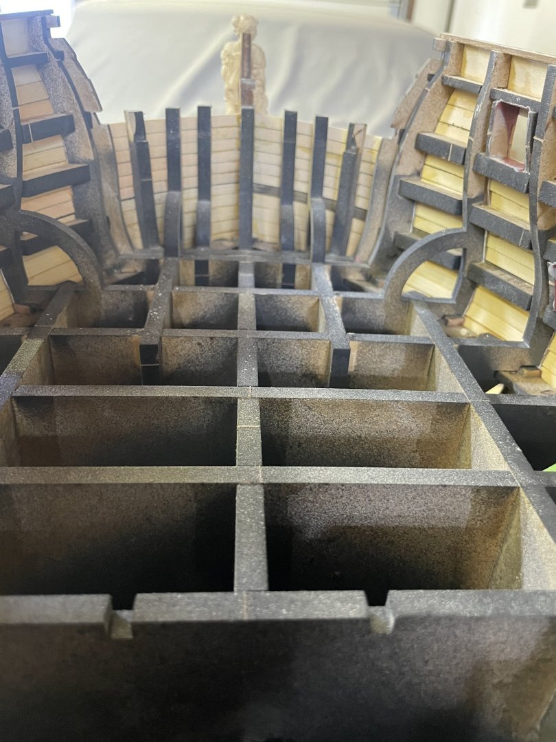

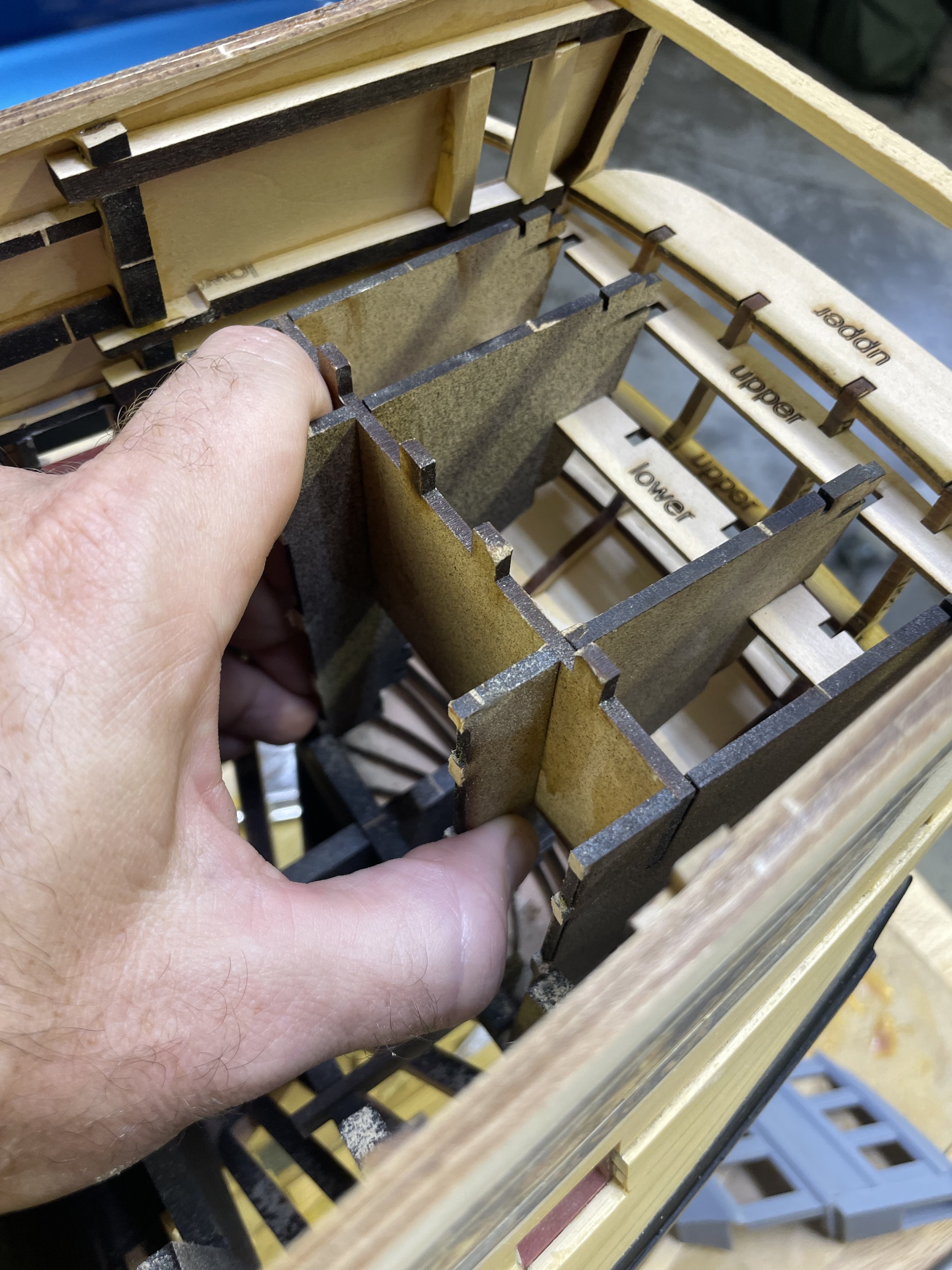

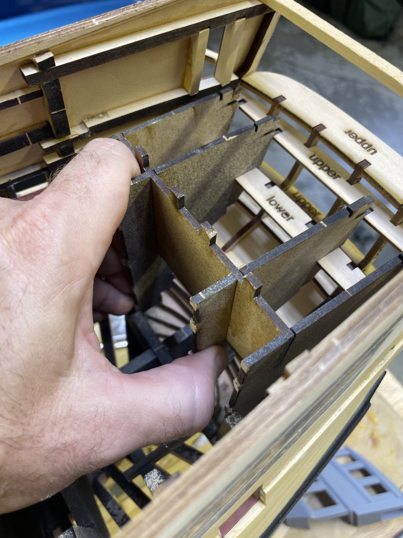

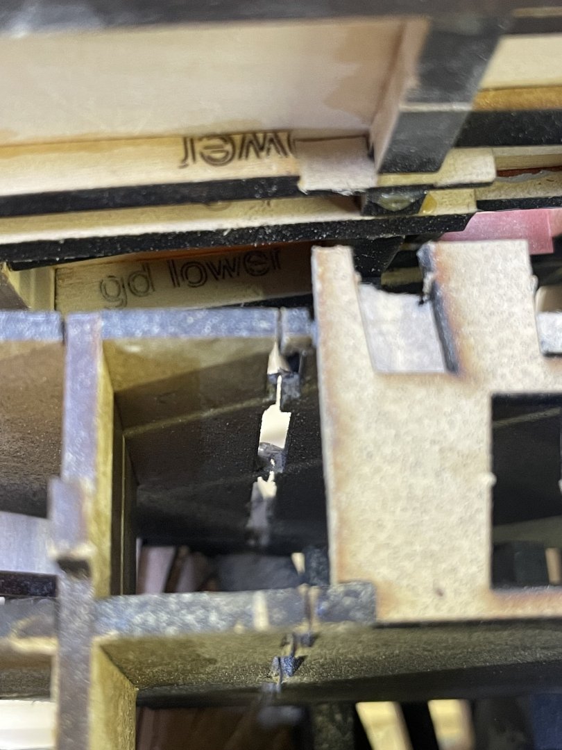

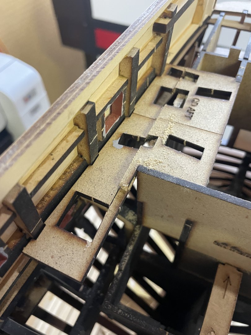

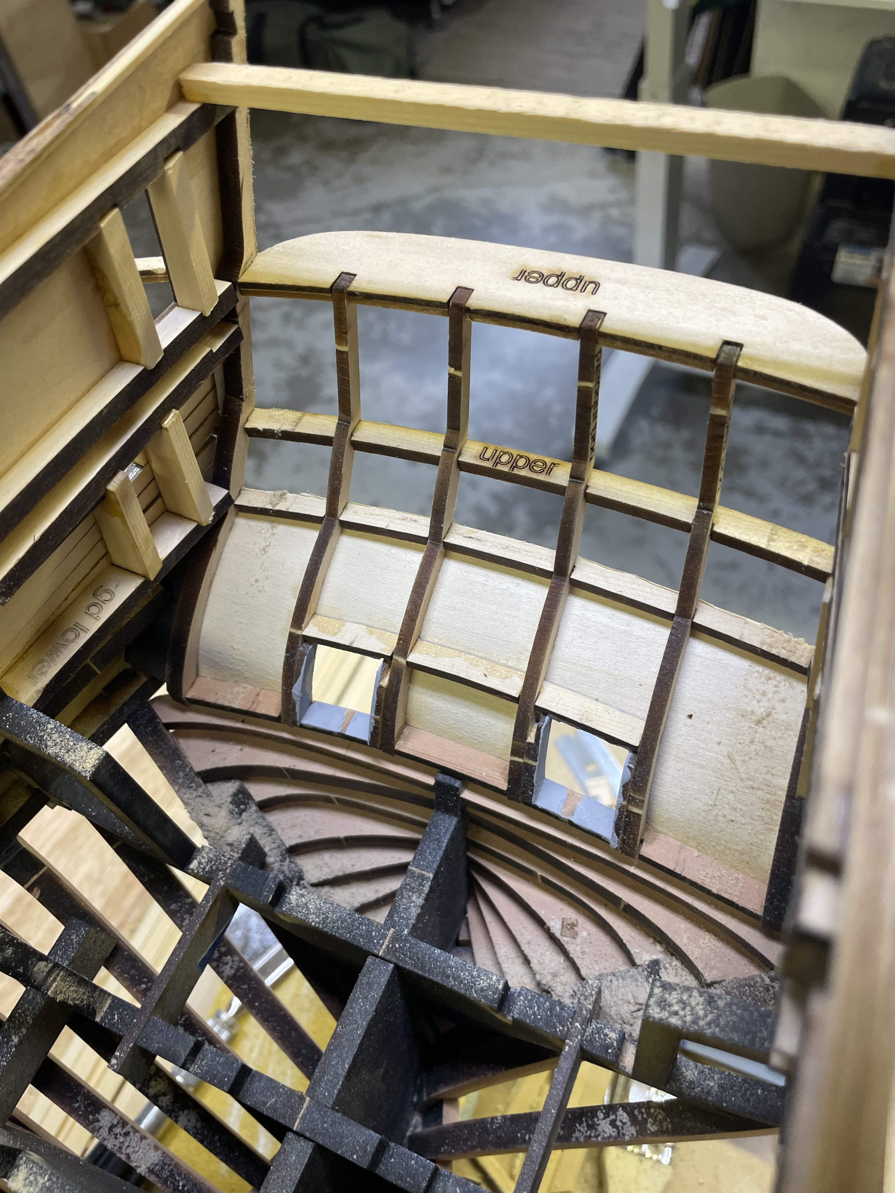

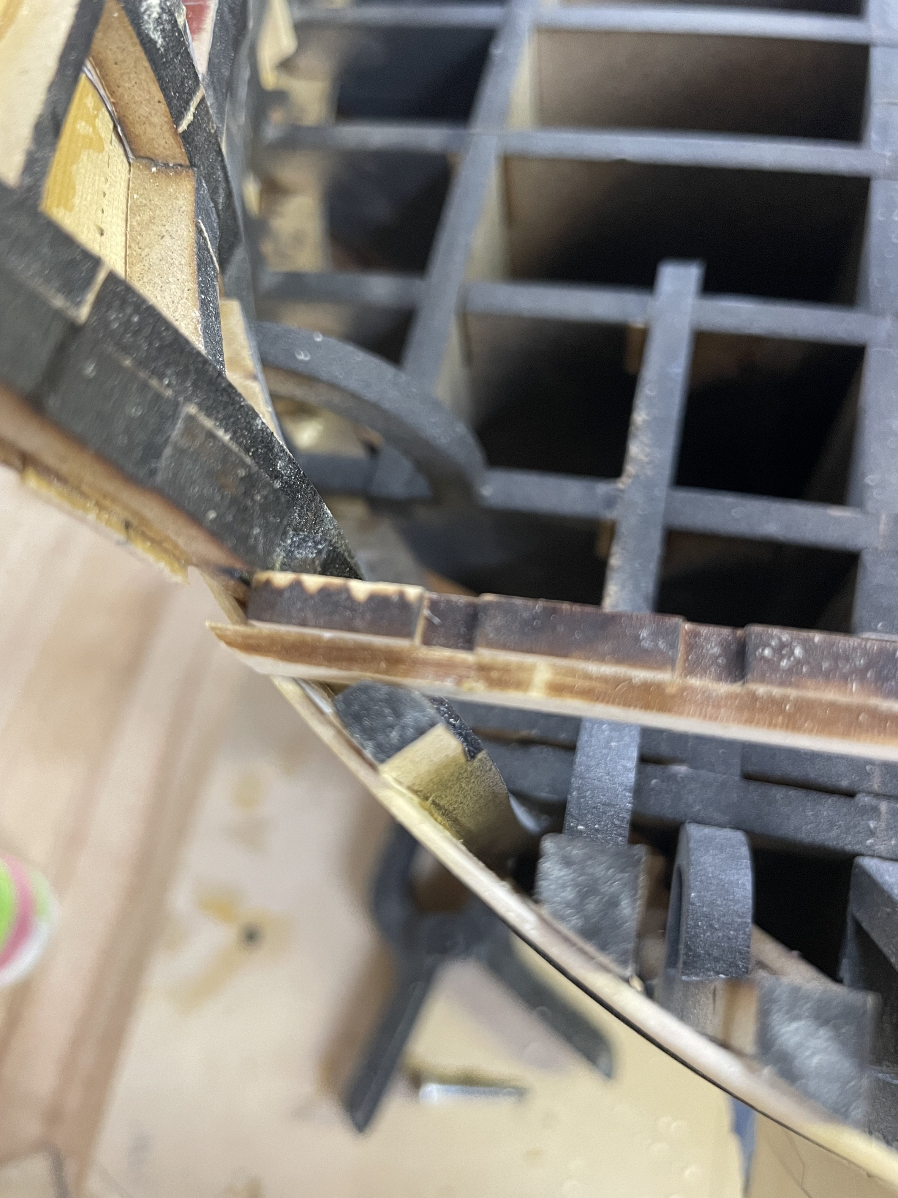

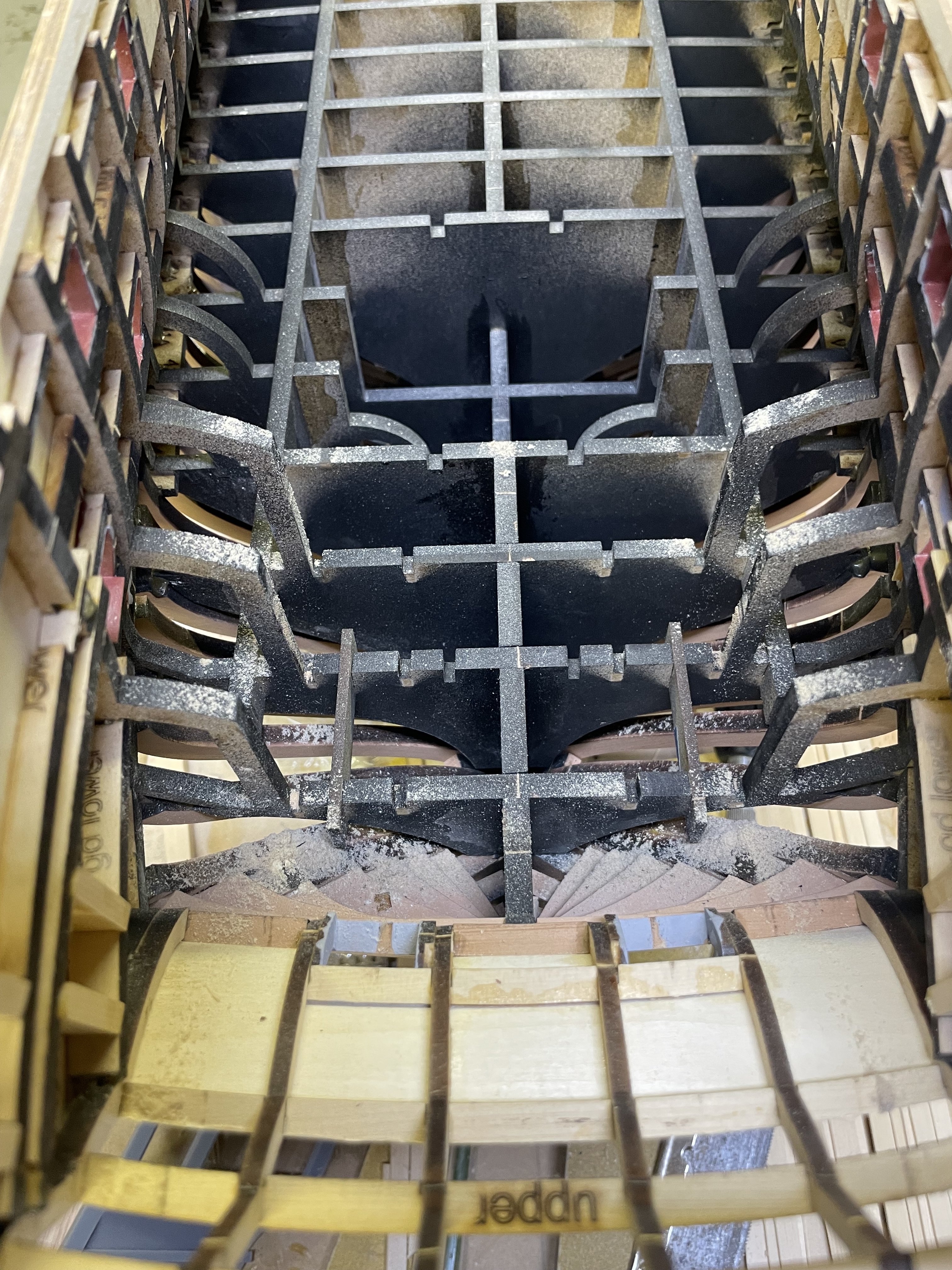

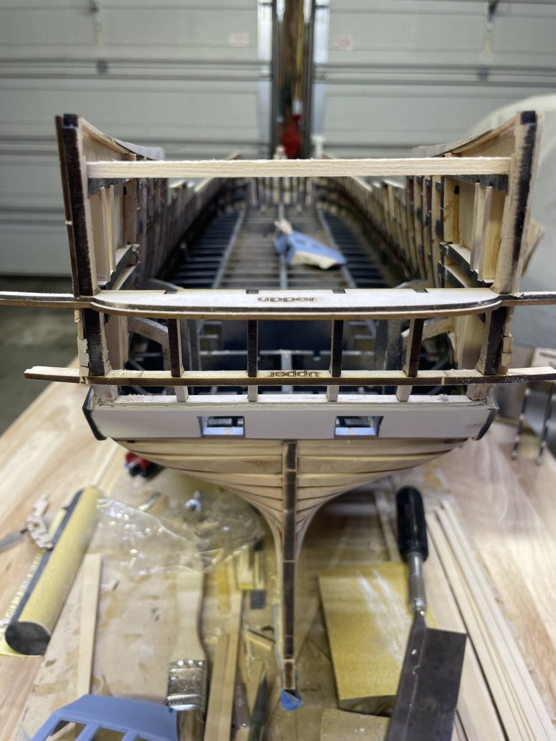

Today I just released the stern frame jig. Now this is a little more complicated than the other parts. It required some cutting, since the main structure of the jig sits down into the bulkheads it needs to be lifted up for removal but we have stern structure that runs across horizontally into slots in the brackets, if we lifted the whole thing it would rip the stern apart. So I added some perforation on the brackets.
start by removing the upper extension wing brackets. IMG_9882.thumb.jpeg.aab34e7b30d178858571855ca5bb45d5.jpeg
I just sawed them right down the middle and removed the bracket.

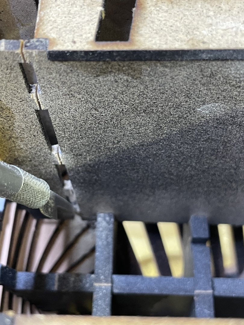

From here go ahead and start cutting the perforation
IMG_9906.thumb.jpeg.6a5921c2c92317da6e201c3e97d1f9fb.jpegIMG_9907.thumb.jpeg.cb3b52776ced2ec329b47bd49b751caa.jpeg
I used a micro saw blade on my xacto blade holder and cut them all on each bracket. It’s MDF so it cuts pretty easy.
once you have the main part of the Jig cut free it should just lift straight up and away.

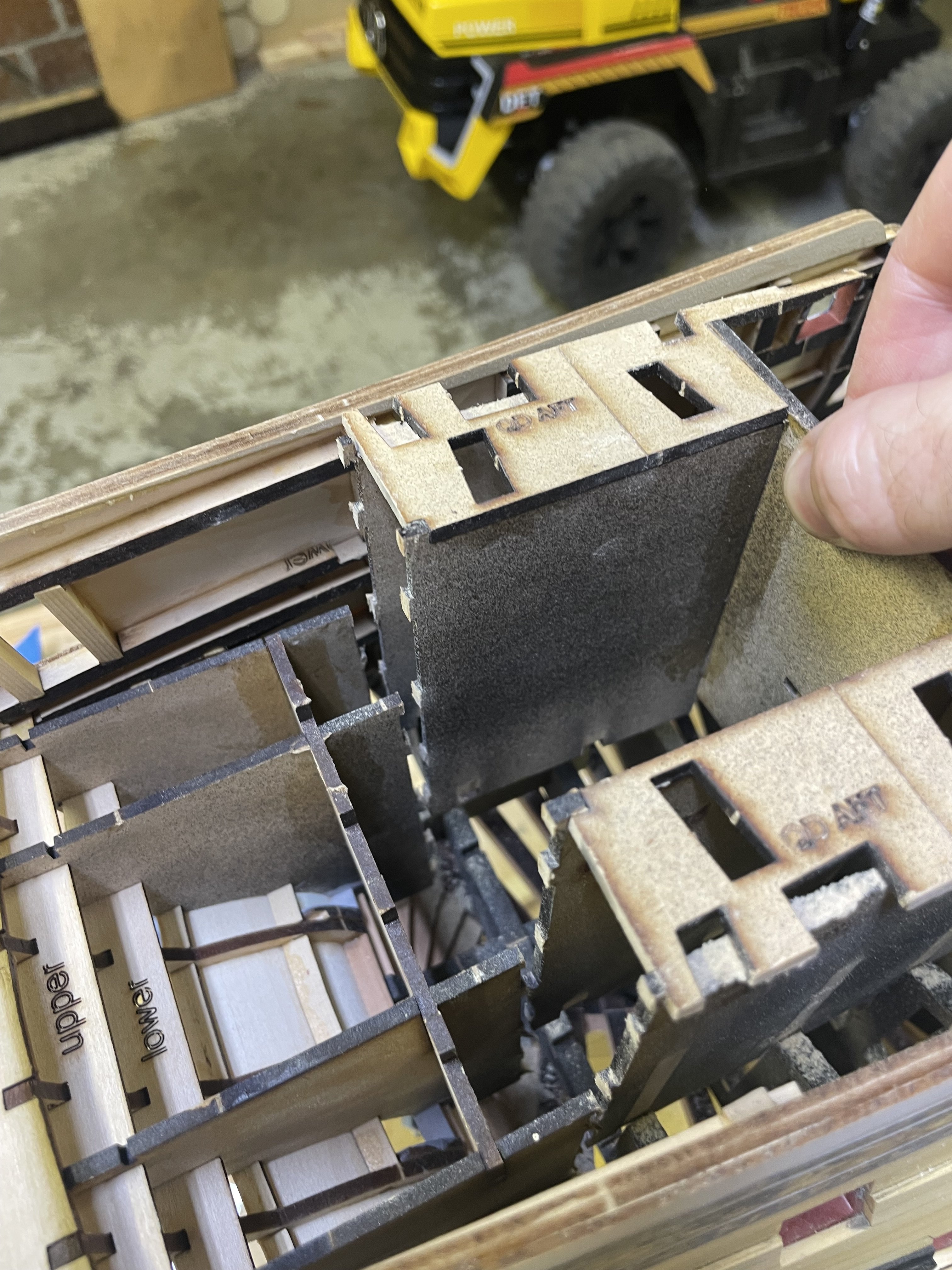

From there the remaining jig is meant to slide out forward, note that the lower parts of the jig must pass through the slots on the bulkheads that the other part fit in.
you may need to saw off the ends of the horizontal frame brackets to help it out easier.

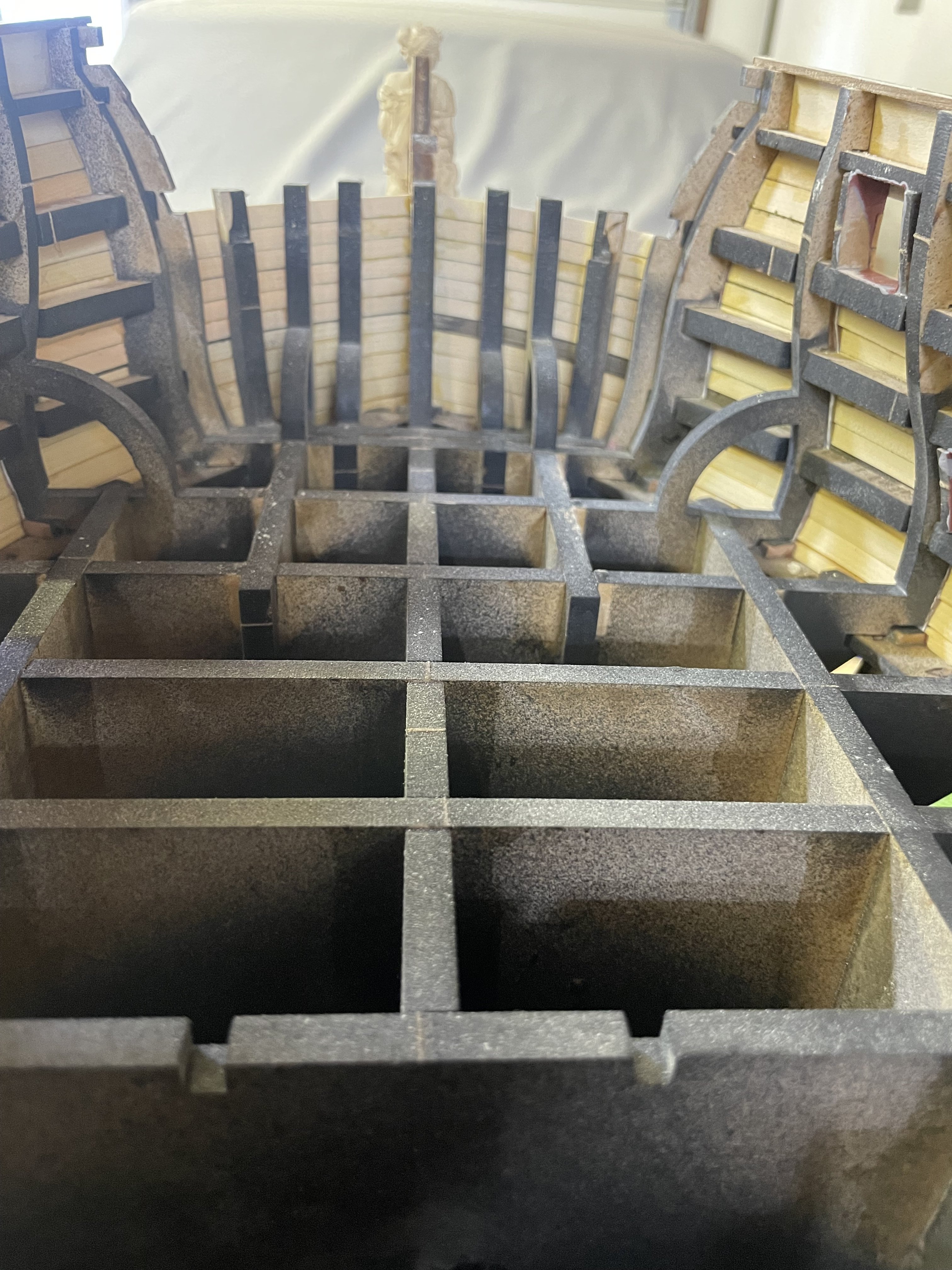

If you made it through the stern assembly without gluing any parts to the jig then it should wiggle out gently and then pull right out.
IMG_9912.thumb.jpeg.6a891efc19c196bb2c045240cbaccfd6.jpegIMG_9913.thumb.jpeg.429c22dec820d7cf82bcc977247aba53.jpeg
now the bulkhead reinforcement hoops can be removed and we can begin fairing the inside of the hull.
10 hours ago, Trussben said:
She looks a lot different without all the jigs there!
It lost a ton of weight too, surprisingly. It’s ok though, we are going to stuff it full of deck beams, planks and guns!..soon.

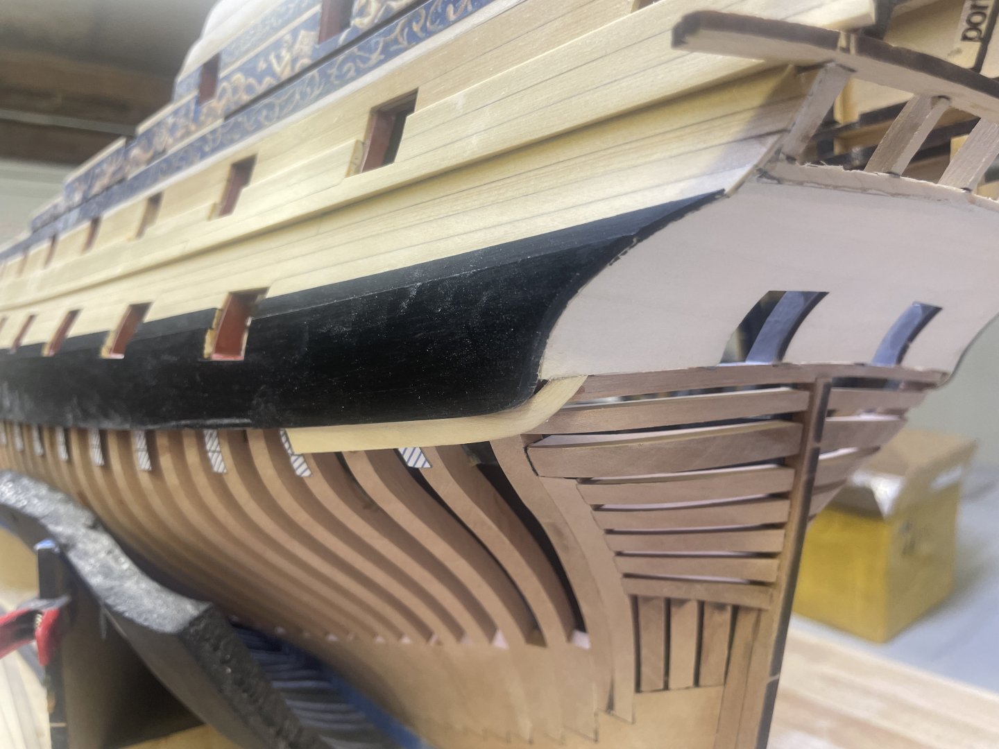

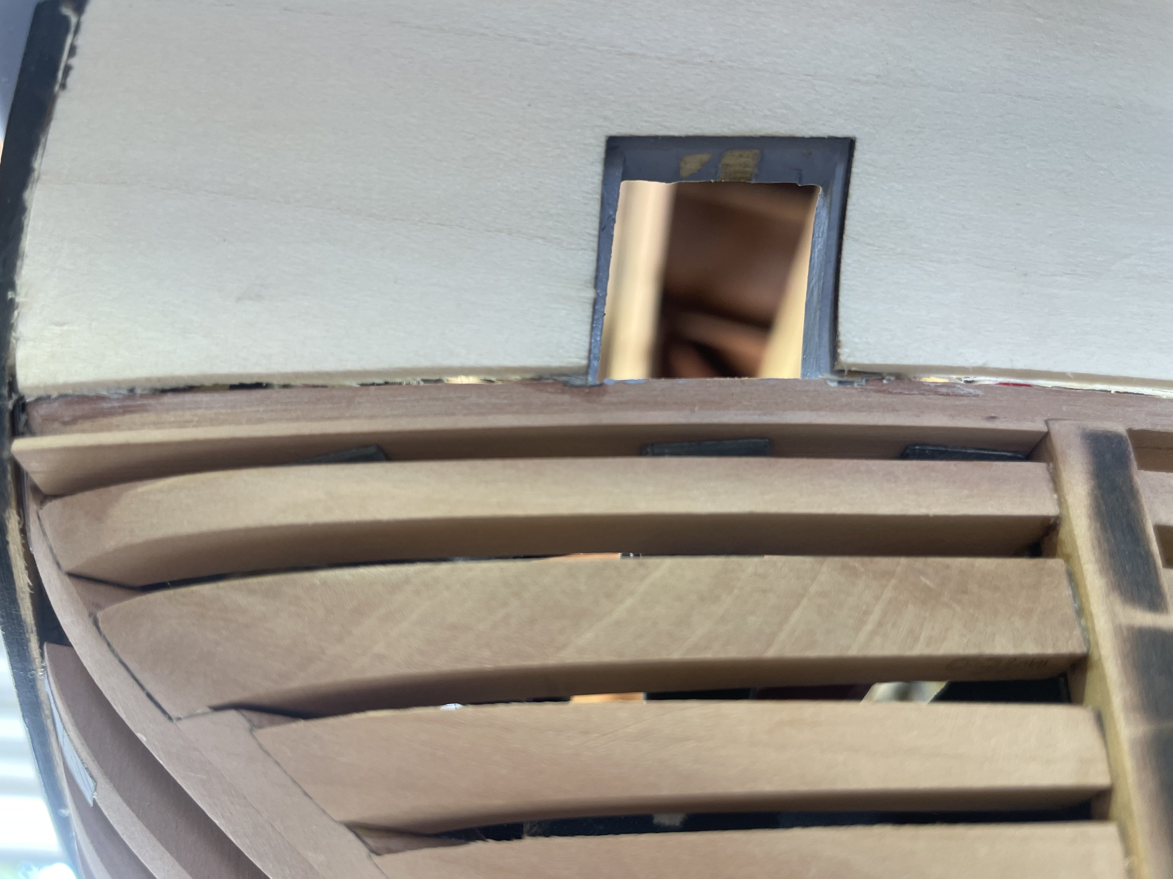

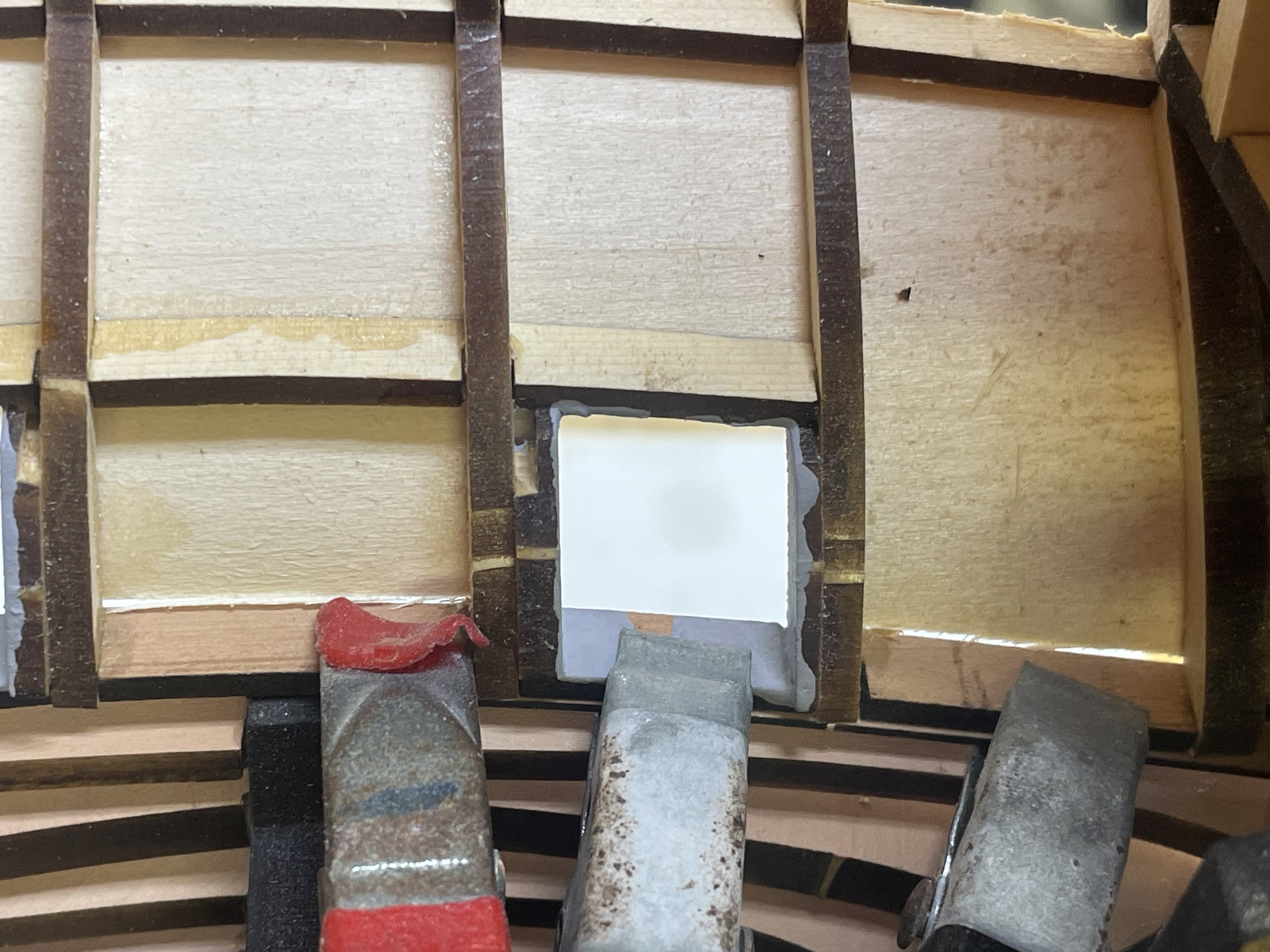

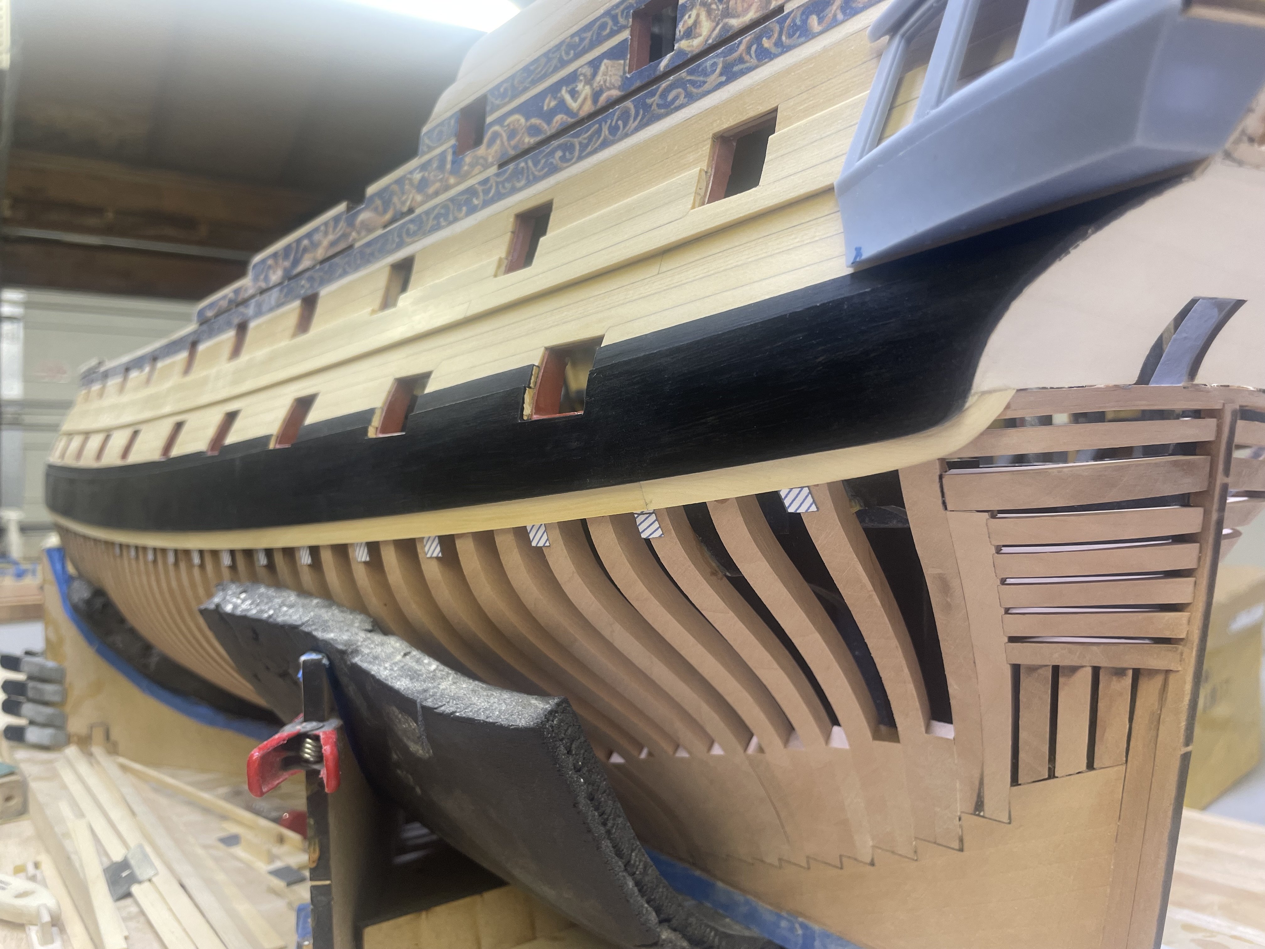

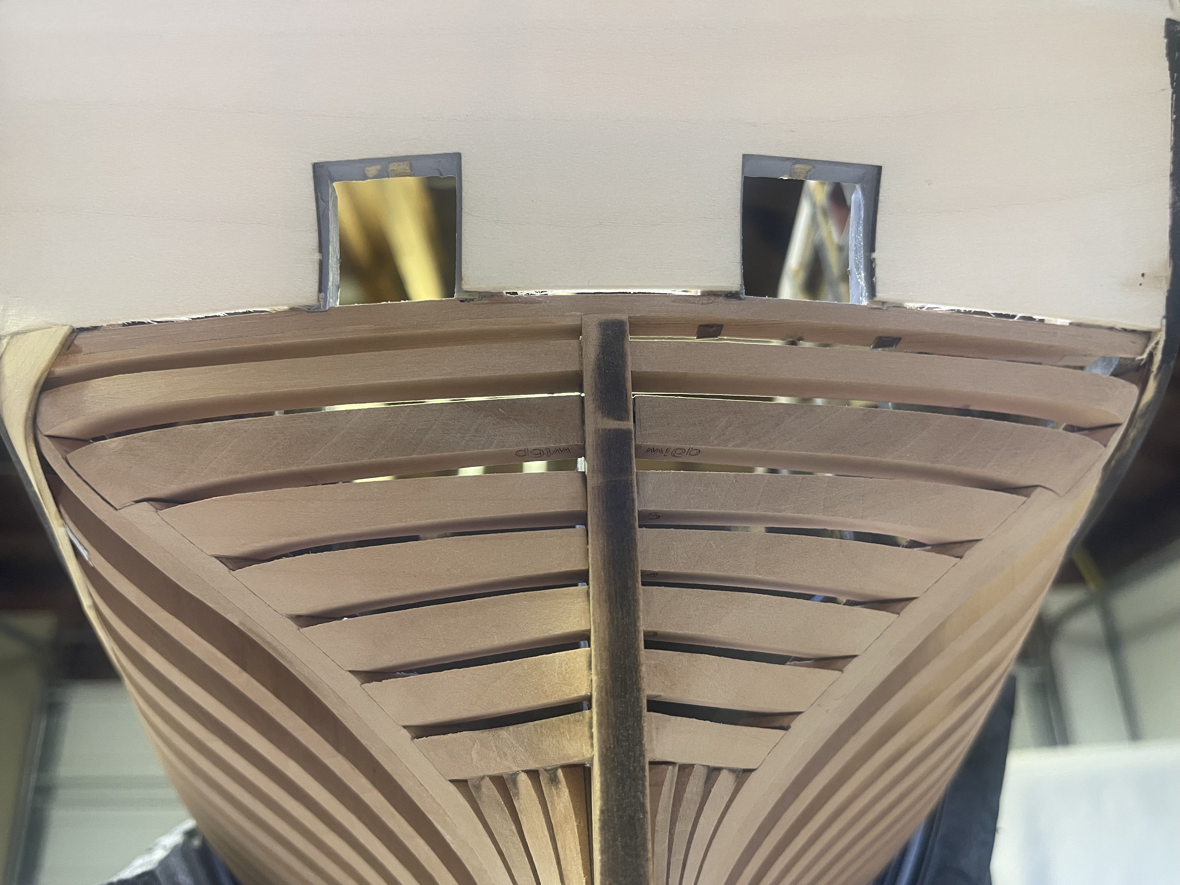

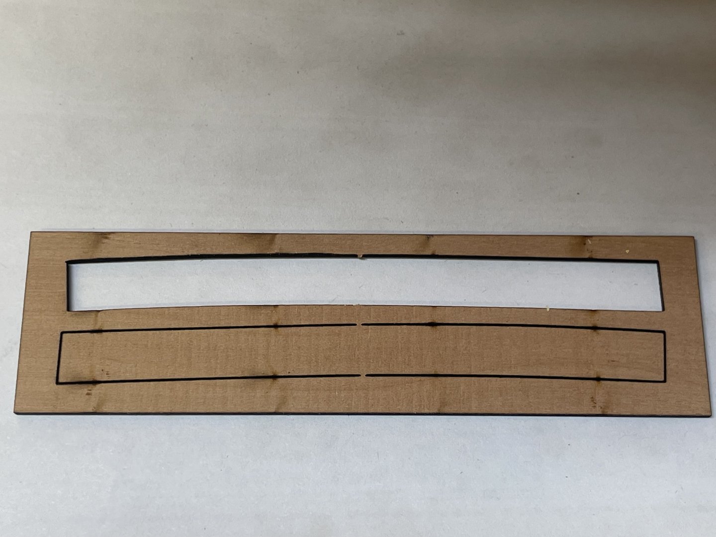

Today I completed the first of two strakes below the main wale. I began with a laminate pear wing transom, this is added to the bottom of the chaser wing transom. First I trimmed up the lower counter so that the bottom is just at the top of the wing transom I then removed the bottom of the outter stern frame with a small razor saw, I then sanded what was left of it flat with a small stick sanderIMG_9914.thumb.jpeg.3522a14bea25a188eb8009f741d6198b.jpeg
the laminate for the bottom of the transom is 3/64” and laser cut
Go ahead and clamp the piece in place and test fit a few times, it needs to be up against the inner post nice and tight. The outter edge of it is not as much of a concern as it will have planks covering it.IMG_9918.thumb.jpeg.0f8d41a23f5aafb1fac60043dcf9205f.jpeg
once satisfied with the fit I just coated it in pva and clamped it down. I also used
some small wedges on the outside to help with the bond. Once dry it can be block sanded down to match the other transoms, once completed it’s hard to tell it’s even there. There will also be a molding covering the original piece so you will really only see the laminate piece anyway.
Now you can begin adding the first strake, I just started from the front and tapered the plank to fit the printed guides.
I find it much easier to close up those tricky planks that terminate at the counter by leaving a gap open on the plank just before the last one, after that last plank is fitted then it’s just an easy run between the two ends
Once completed a small filler piece was added between the plank and wale, it’s not really necessary as it will be covered by scraped molding but I did it anyway, I saw it done on a contemporary model.
Im going to add one more plank after this one and that will be all. But you can see the completed laminate piece compared to the one on the stbd side.
if you look up the slots for the stern framing are now covered and the gap is closed up between the two transoms as shown in the drawings.
