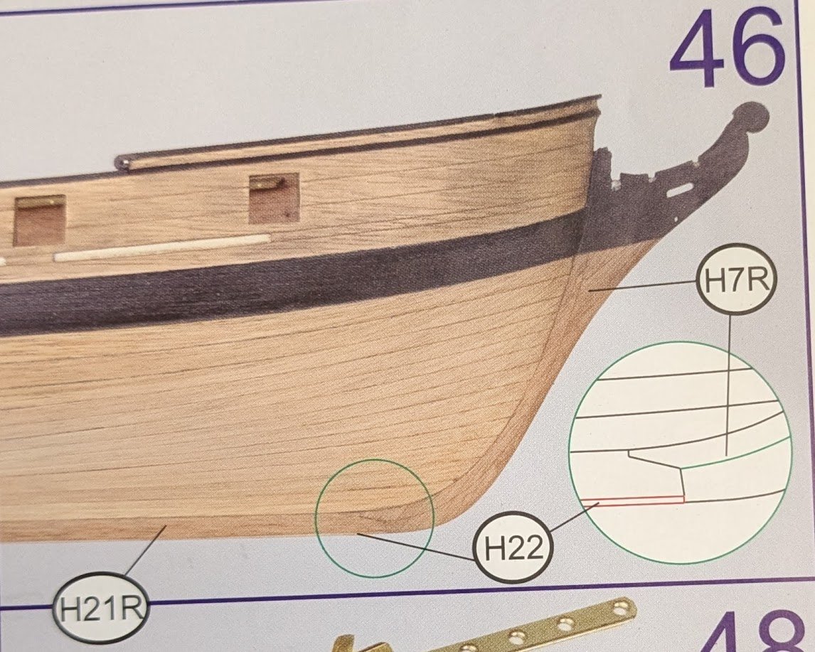

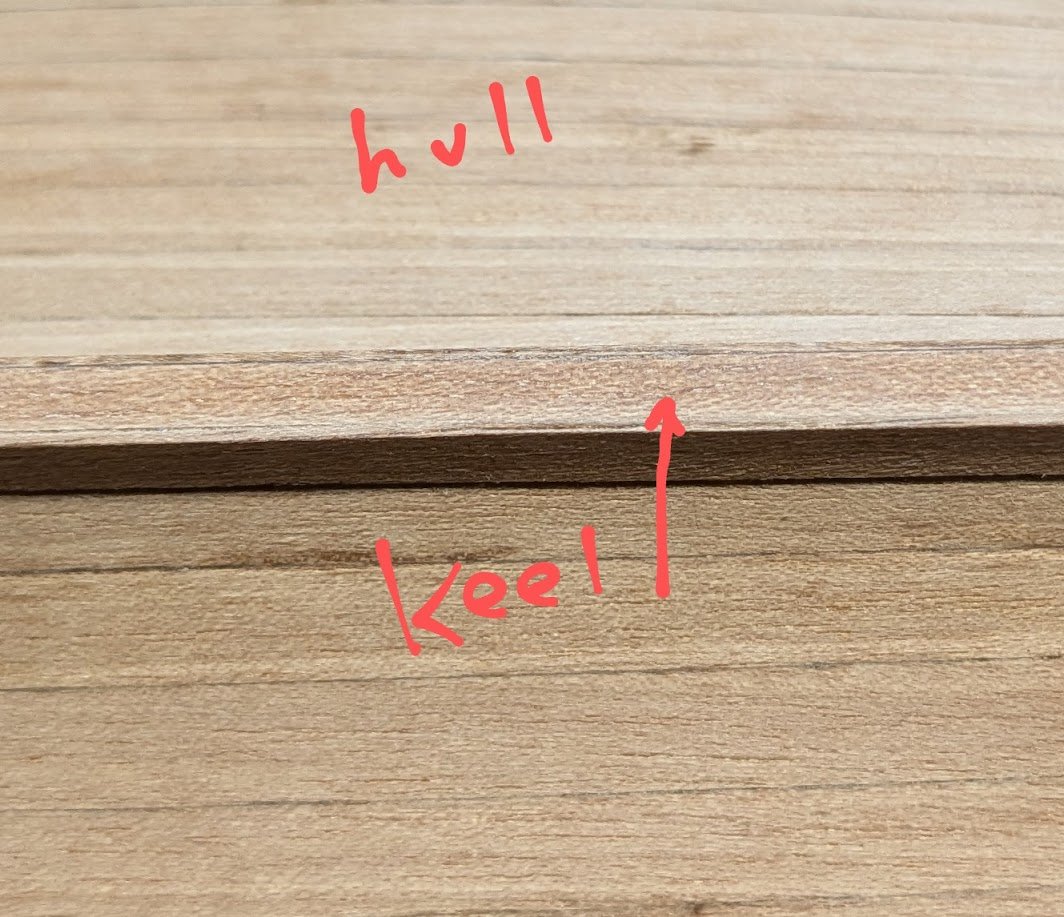

One thing to be aware of with MK kits is that they only mostly fall together by themselves, but not totally. There are instances where parts don't fit as indicated in the instructions, usually as a result of error creep during the build, and some thought has to be given as to how to proceed. The keel veneers are one such instance. In the Step 46 inset, you can see that the bottom veneer, H22, is supposed to sit atop (i.e., directly beneath) the two side pieces, H21.
But there are problems with that suggestion. First, it doesn't match the construction sequence of the corresponding veneers on the stem. Second, on my particular build the side veneers overlapped the false keel too much, i.e., they stuck out too far, and laying the bottom piece atop them would have made that piece stand proud of the veneers on the stem. I had to choose between trimming the side pieces to allow the bottom piece to sit flush, or else trim the bottom piece to fit between the two side pieces. I chose the latter option, because it results in the exposed, thin sides of the veneers facing toward the bottom of the keel, where they won't be seen on the finished model.
Hope that all made sense.

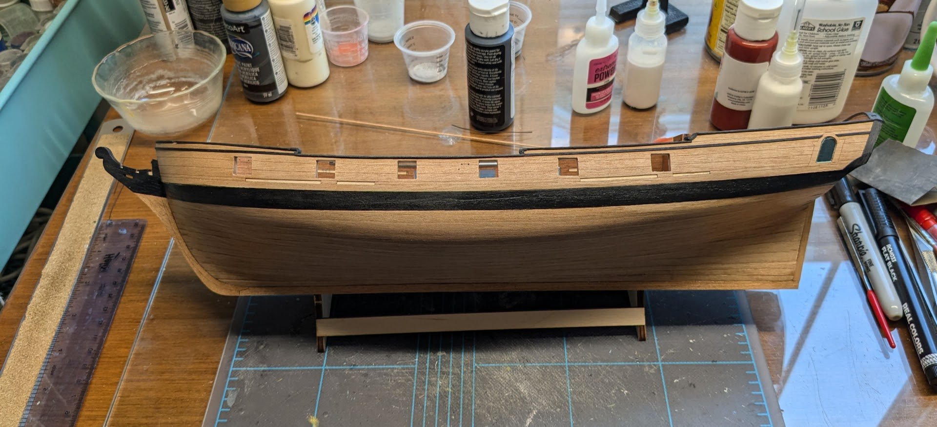

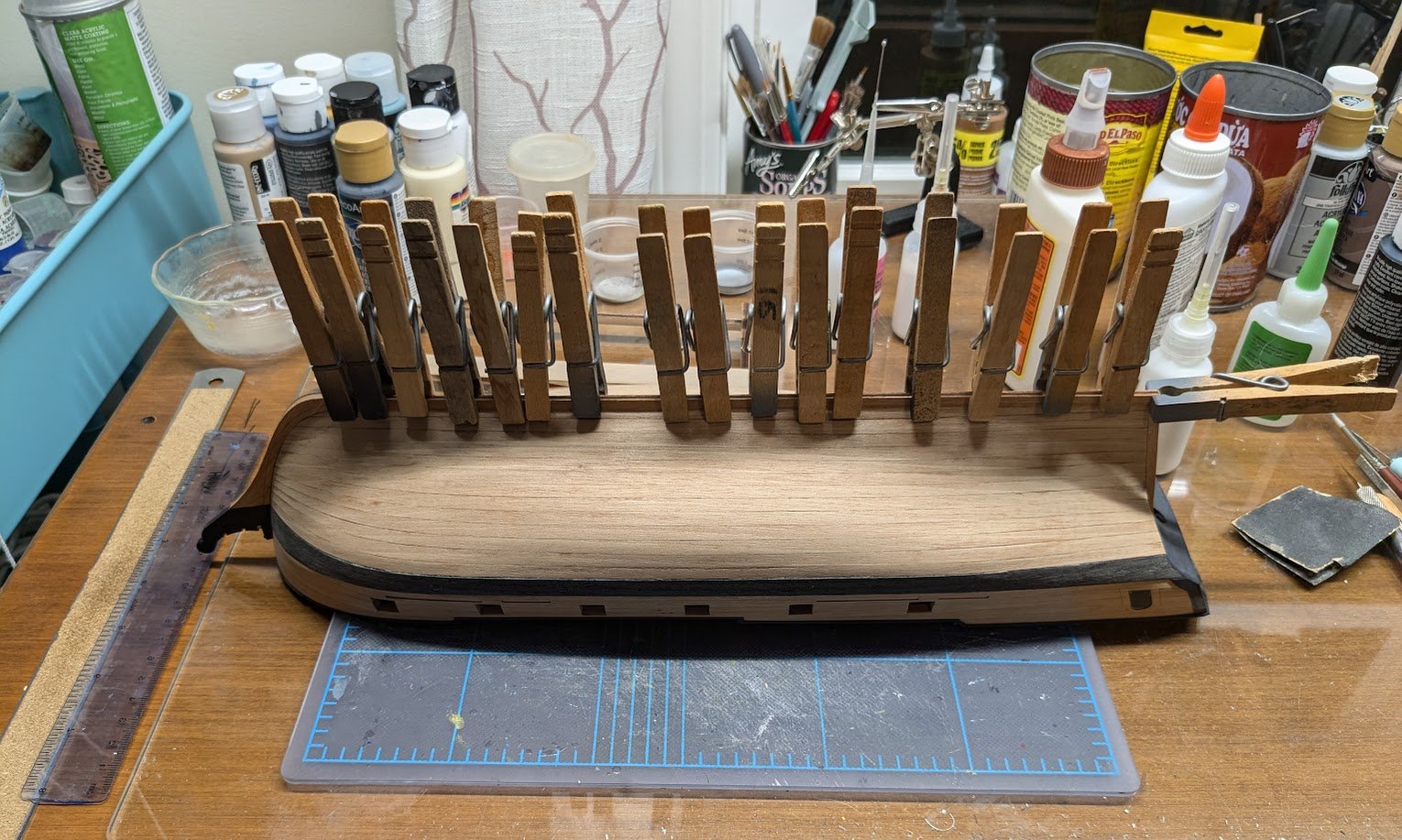

I got the bits of molding along the outer bulwarks added.
I then set about adding some clear semi-gloss polyacrylic to the hull, and things got a little dicey. Most of the first coat went nicely, but then the polyacrylic acted as a solvent on the paint on the wales, leaving several smudges. So first I had to clean that up. Then I sprayed the entire hull with matte clear spray to hopefully seal all the existing paint. While that was drying, I worked on painting some of the hull ornamentation. Moving on to the second coat of polyacrylic, the matte clear had done its job of sealing stuff, but somehow I had managed to get a couple of dabs of the ornaments colors on my freshly painted hull. 😡 So, I had to clean that off before proceeding. Finally got it all done.
Now I'm not 100% happy with the tone of the 'orange ochre' paint I had on hand for painting the aft carvings. I made several attempts to mix up a batch -- each ended in abject failure. I will probably dash off to Hobby Lobby to see if I can't find something.

Have you ever considered using shellac as a clear coat?
 It was worth all the trouble, Chris. The hull is beautiful.
Nope. Never used the stuff. Wouldn't know what to do with it.

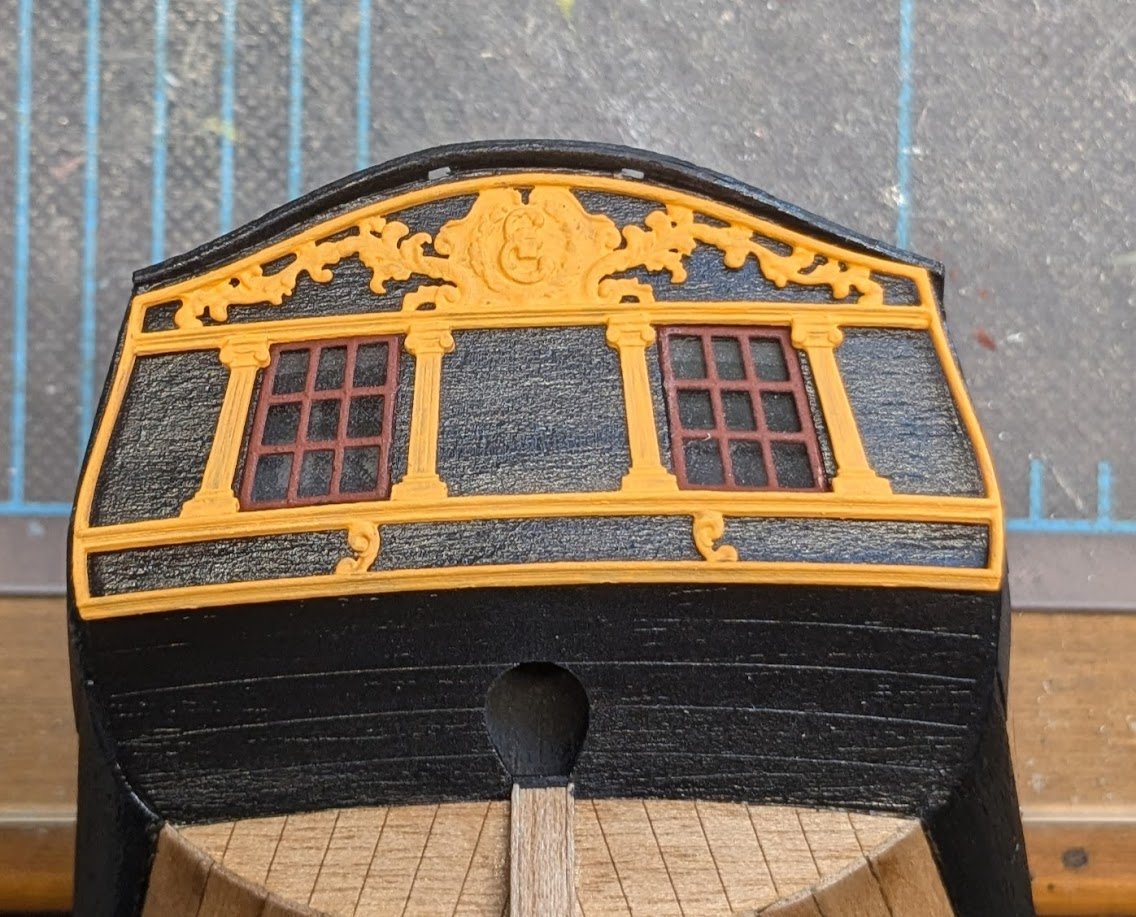

So anyways, back to the carvings. I found a color at Hobby Lobby that I think will do. This is the stern piece in a test fit -- the piece still needs work.

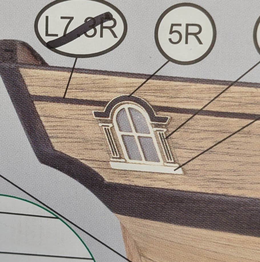

But lo and behold! This is what the piece is supposed to look like:

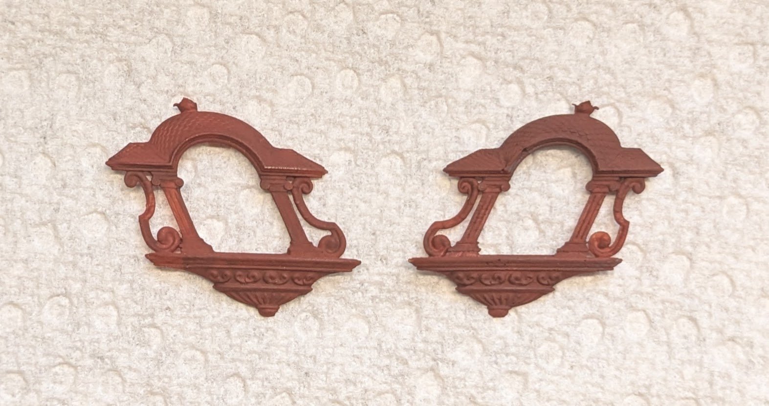

And these are the quarter badges pictured along with the version shown in the instructions:
image.thumb.jpeg.54d8ed124823dc9547c38f970bce2783.jpeg image.jpeg.ed7aa89e30c0c780fca6fa9bcbd0b467.jpeg
Now mind you, I think the pieces in the deluxe kit look better than those in the original kit -- but I'm not certain they're a more accurate representation of whatever was on the real Phoenix.  It's possible that both are equally speculative. What I do think is certain is that the monogram E on the deluxe piece stands for Ekaterina, i.e., Catherine the Great, who reigned from 1762 to 1796. I don't intend to fret much about the accuracy of the pieces and will just  forge ahead and use them.

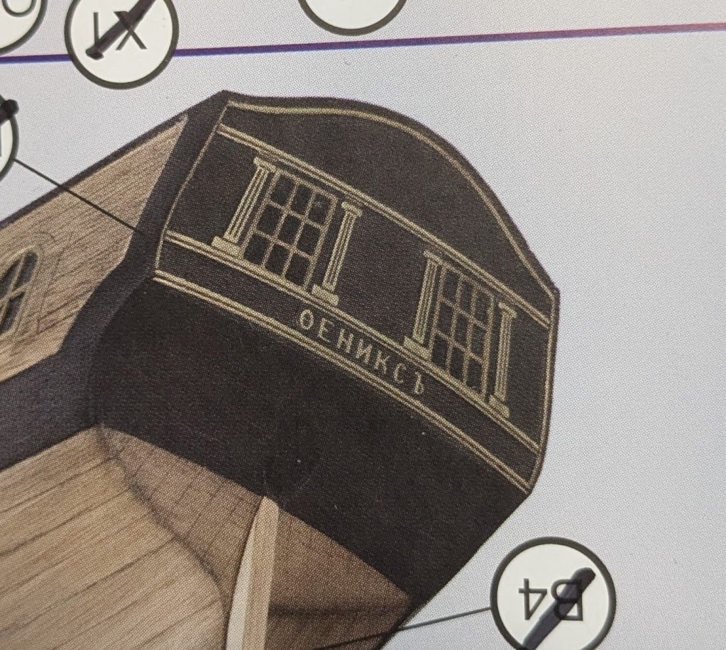

Chris, here's another question about accuracy, as a former student of Russian. In the "what it's supposed to look like" photo, the stern has what's obviously supposed to be the ship's name in Russian, Phoenix (феникс). But that first letter looks totally off; it looks like a plain "o", not the Cyrillic "f", "ф", which can be scribed various ways but must have a vertical line through it. Sometimes it looks like a sideways 8, sometimes a circle, but always the vertical line. What they show would read as "oenix" in English. It really threw me until I realized it was an incomplete f. Unless I'm missing something about 18th century Russian script, which I admit to not being familiar with...
What does the lettering look like in your kit?
 It doesn't. As far as I can find so far (unless I overlooked it somewhere), the regular kit had the name as part of the PE stern detailing, but the deluxe kit has nothing. I had already been thinking about how I'm going to tackle that issue. Looking ahead to the possibility of painting the name, I had already used Google Translate to make a copy of the name in Russian, with Cyrillic characters. But thanks for checking! 😉
The highlighting makes em pop, Chris. Much better than a flat ho hum surface lacking detail.
Yeah Chris.  Much improved 3d effect.  I find with plastic models that a wash after picking the highs and lows can blend and soften in a way that is pleasing to the eye. Too bad you don't have extra pieces to play with though.
Steve
San Diego Ship Modelers Guild
The Admiral is always right, and in this case very nice improvement!  That is a beautiful transom (correct term?)!

2 hours ago, Cathead said:
Yep, THAT'S the correct Cyrillic!
Which is good, cuz the designers are Russians, so one would hope that they are familiar with their native tongue!
On the flip side, there are plenty of native English speakers who ain't so good at readin' and writin' their Muttersprache😬
Well sure, you'd think so, but the reason I got involved in this particular theme was that one of the earlier kit images you showed had what sure looked like the wrong Cyrillic letter, or at the very least a really poor rendition of one, so I was just celebrating that the part you showed this time was right.
