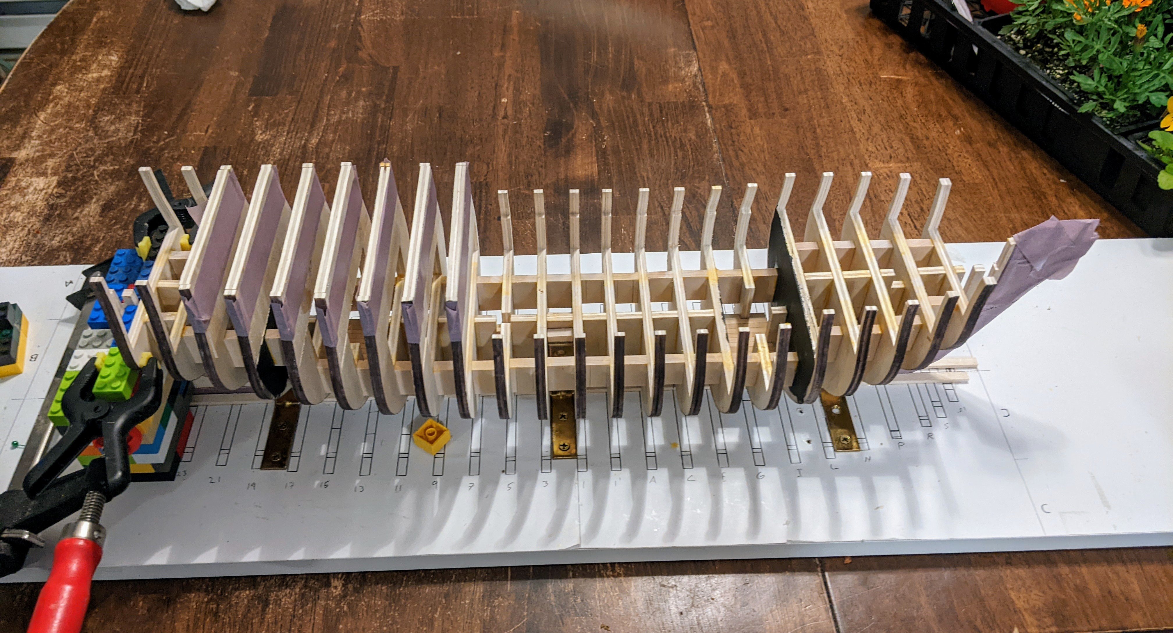

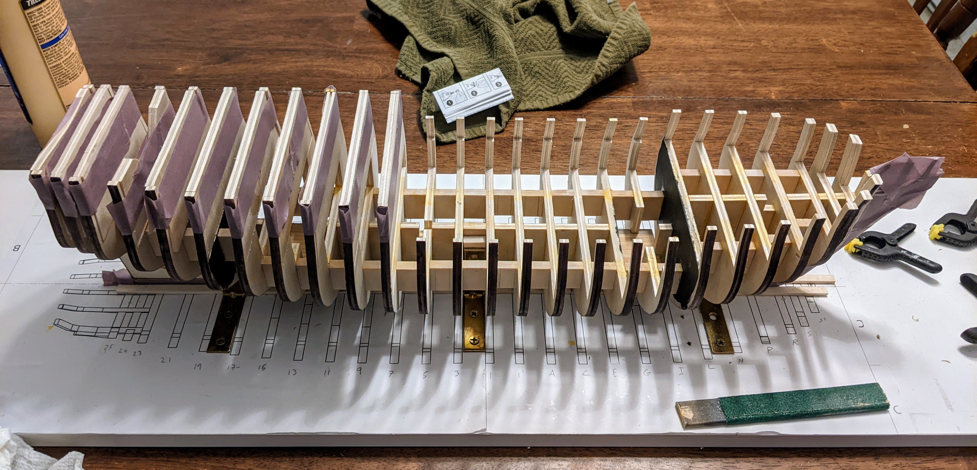

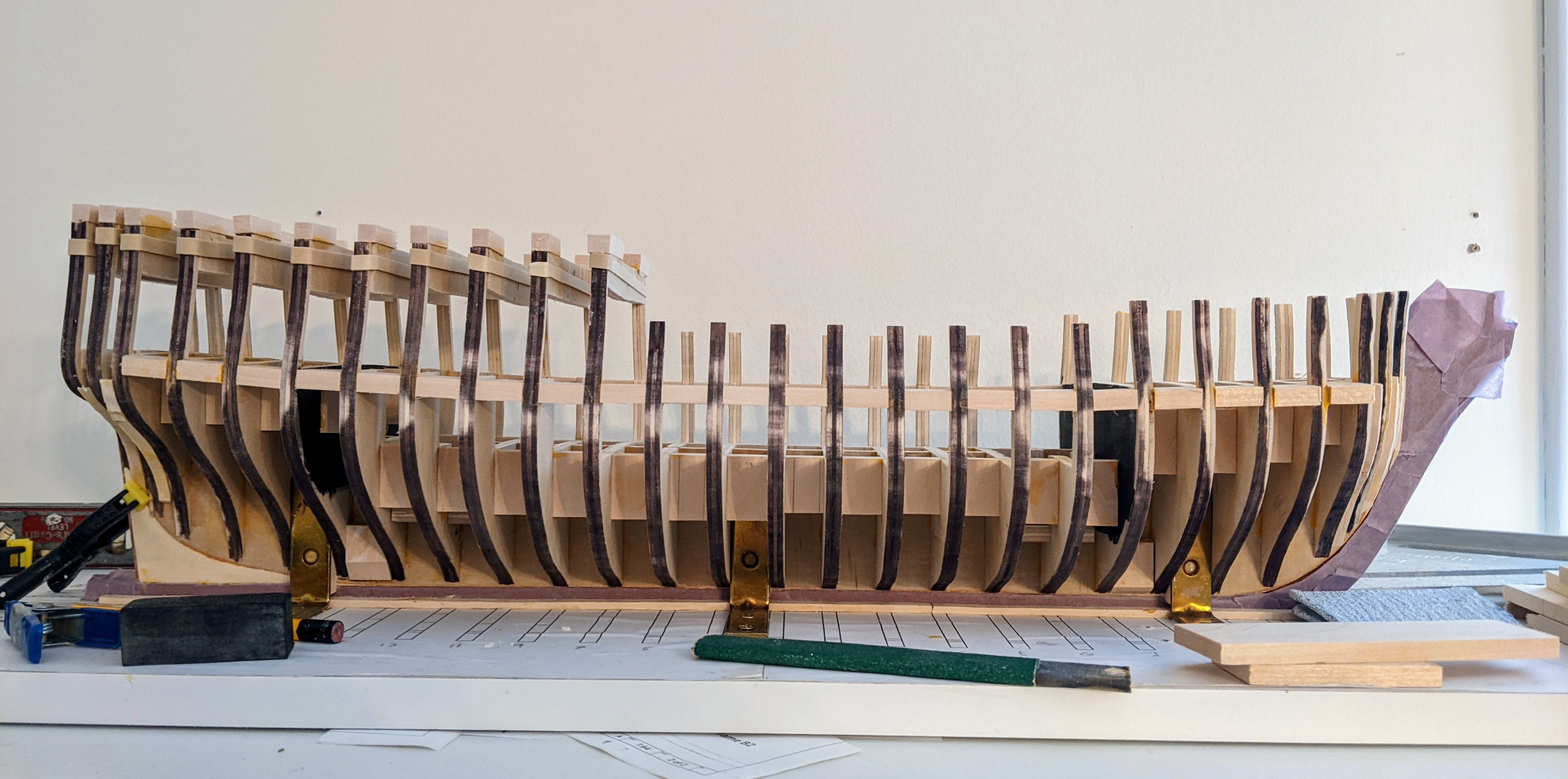

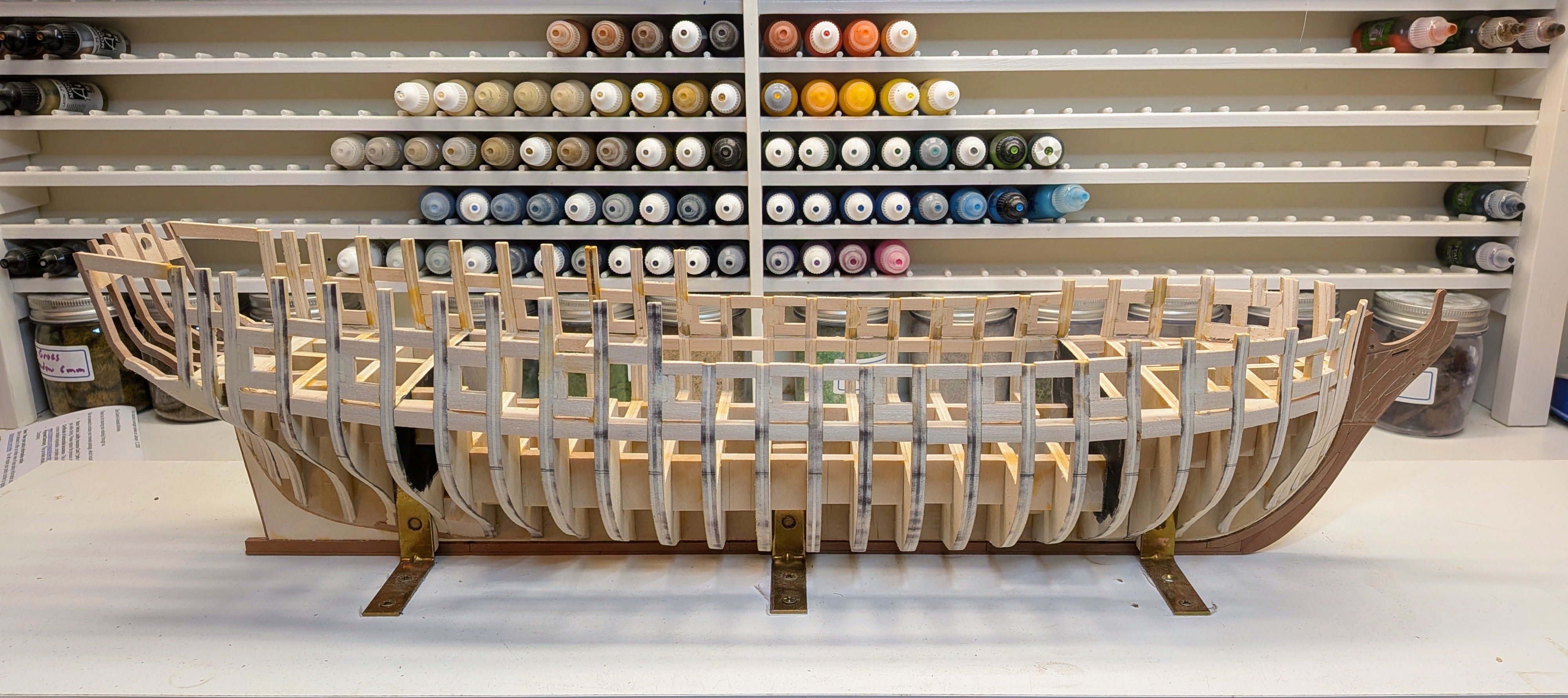

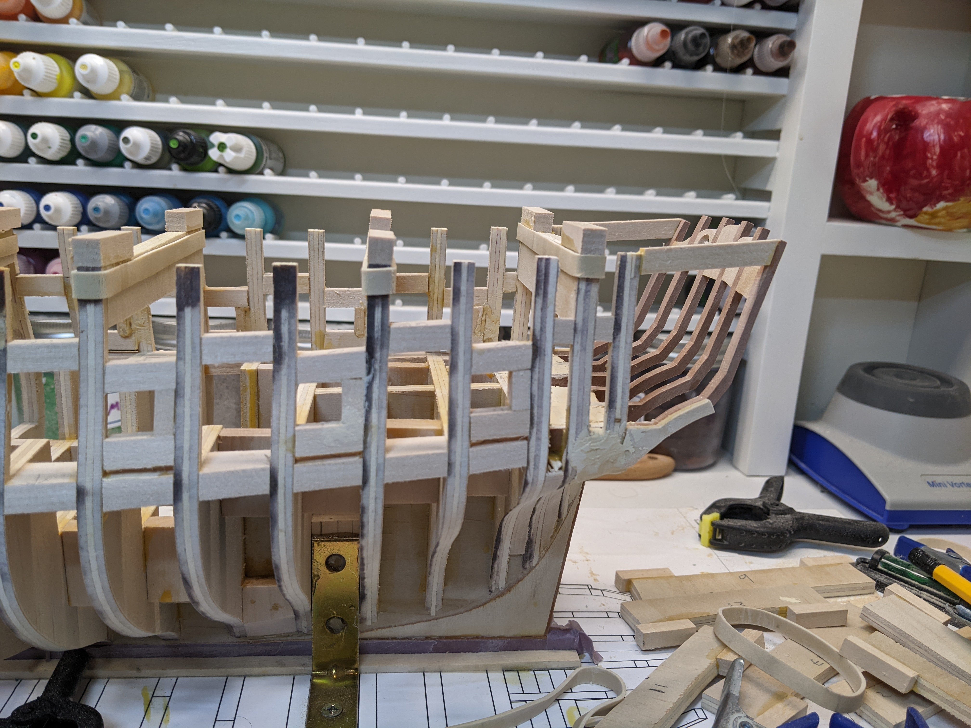

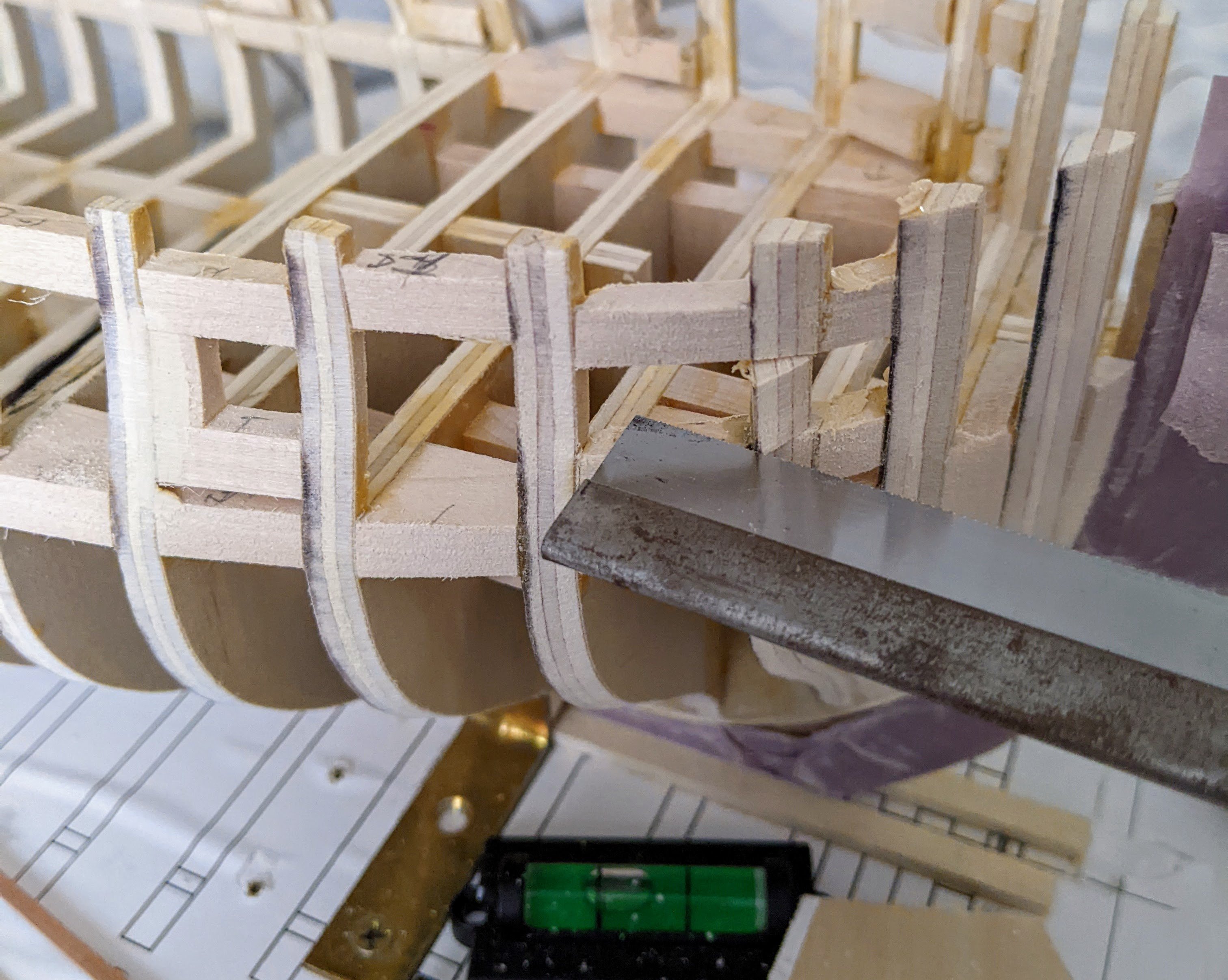

On the model itself, I have now got all the bulkheads in place. You will notice that the front two and stern two bulkheads do not have any bracing pieces as they are closer together.
The reason for the omission is that I am planning on filling in these sections fully with filler blocks. First I cut the bow filler pieces and glued them in place.

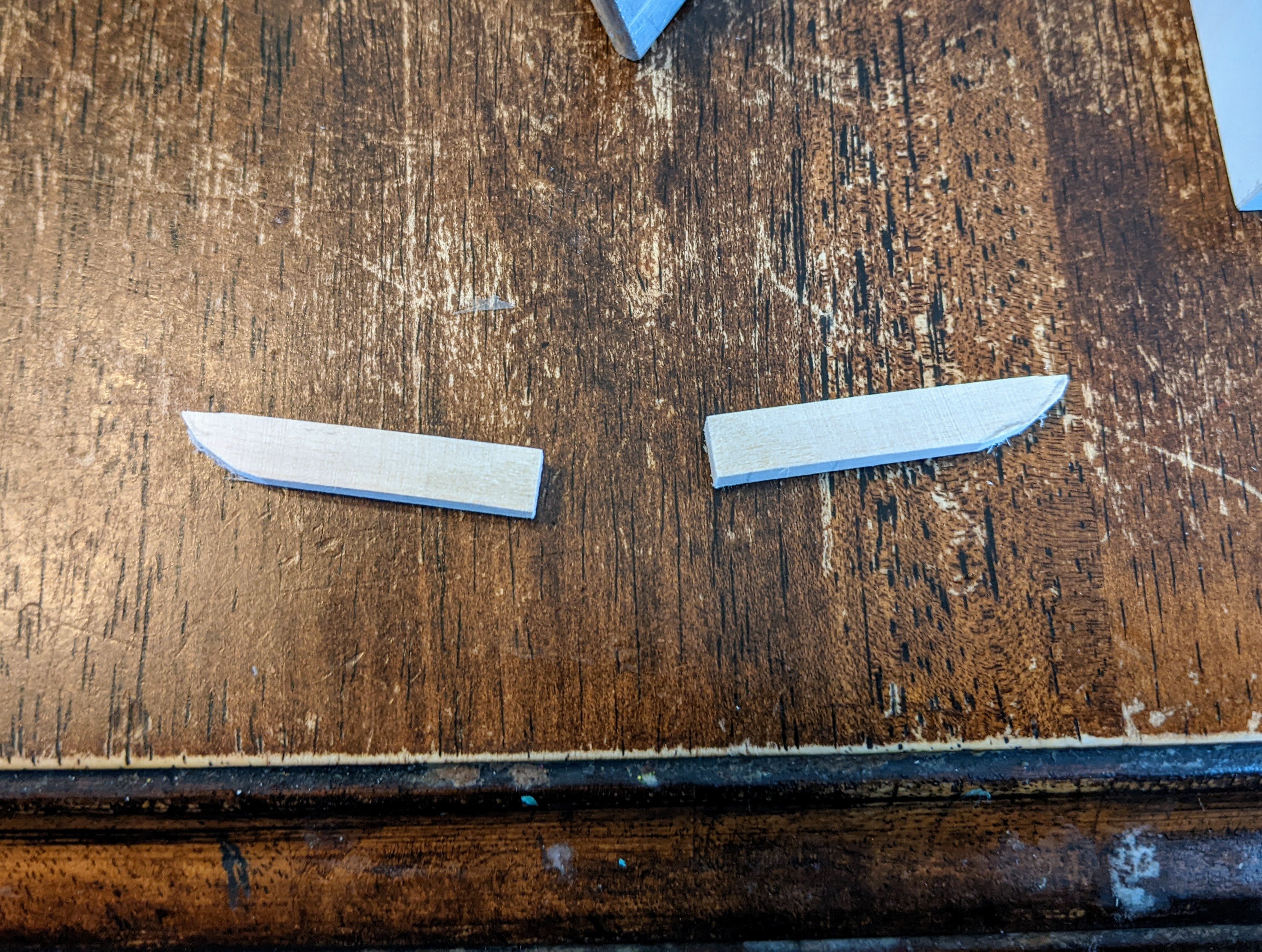

Then once that was dry I slid pieces of basswood which I had thinned to the appropriate thickness into the gaps between the bulkheads and marked off with pencil the approximate size they needed to be before cutting them out on the scroll saw. There is no need to be particularly accurate here so I have erred on making them oversized as this will all be sanded in the faring process. The most important part of this was making sure the bulkheads remained square through this process.

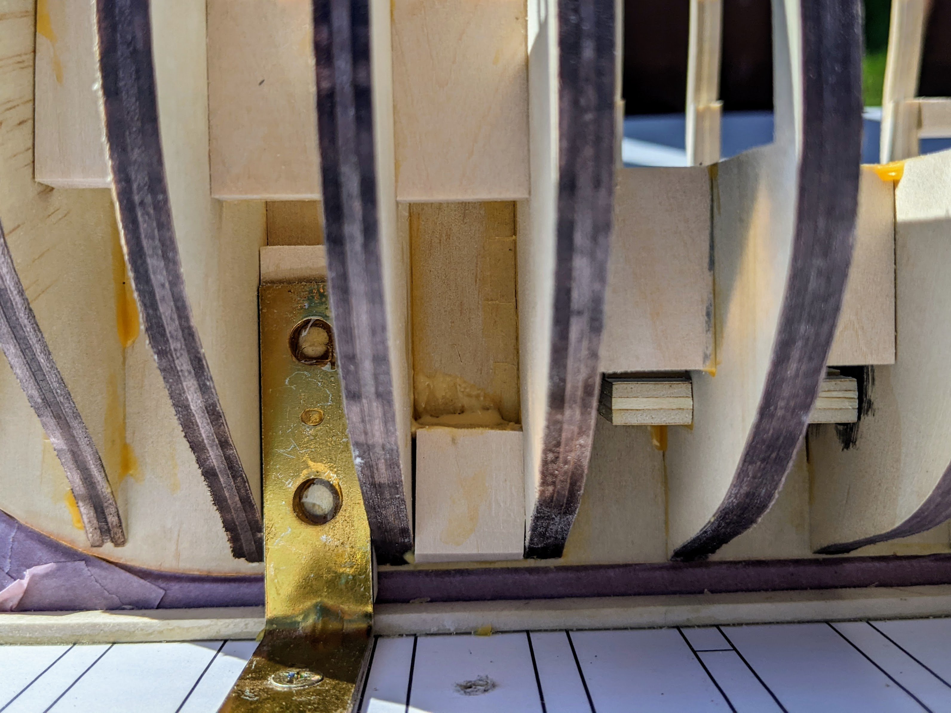

However, it was around this point that I realized I had made a mistake with one of the bulkheads. Essentially the slot was not deep enough and so it was not far down enough on the center bulkhead. It was only off by about a mm, but this is enough to throw off the lines of the ship. So I had to break out the isopropyl and slowly work it free with a knives and solvent. It was particularly unfortunate that the offending bulkhead was at just about the worst possible location (the stern platform also had to be removed). However after a few hours of working slowly and carefully on it, I managed to get it out.
Then I sanded and dry fitted it back in place, making extra sure of the positioning this time :).

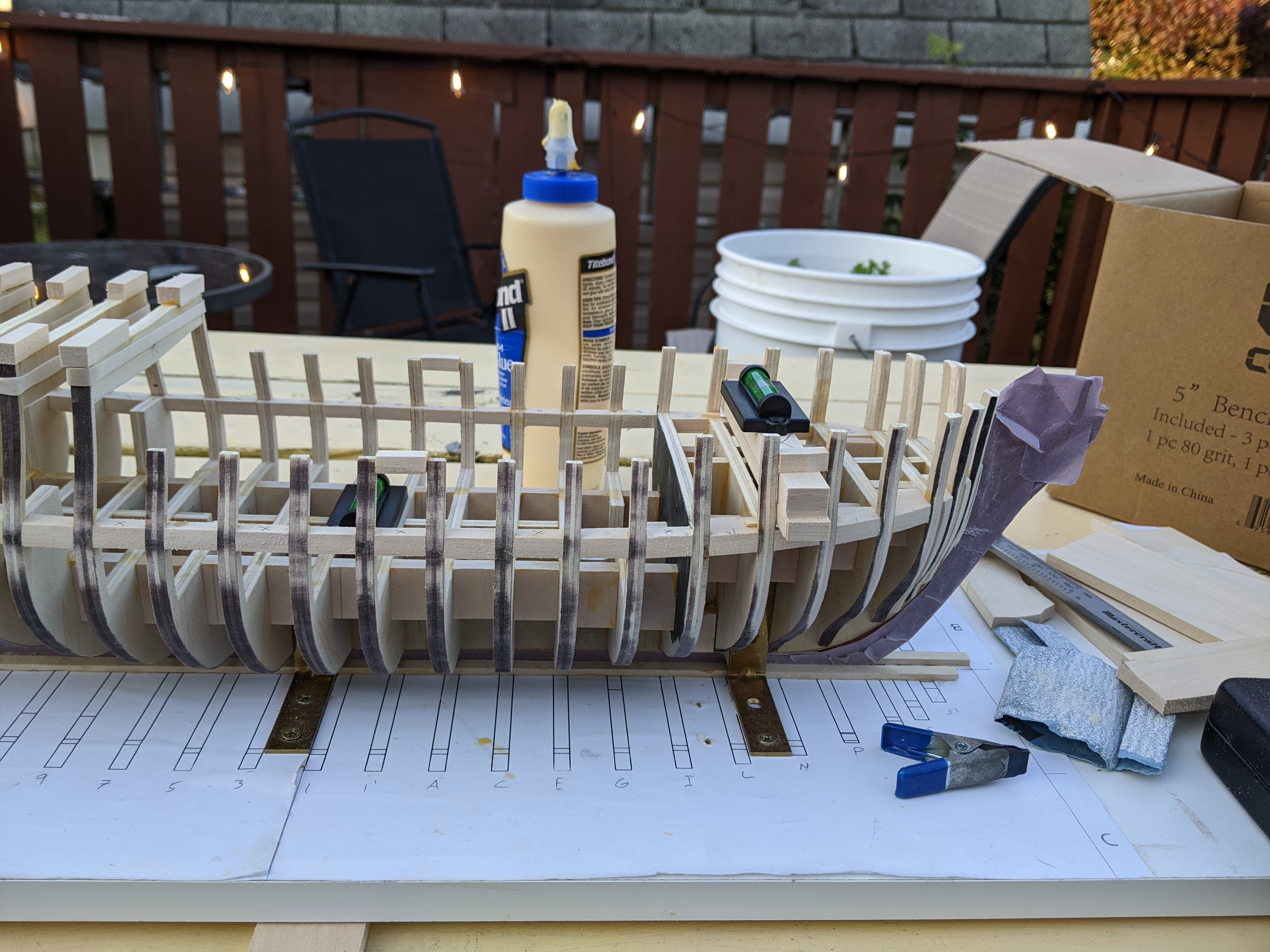

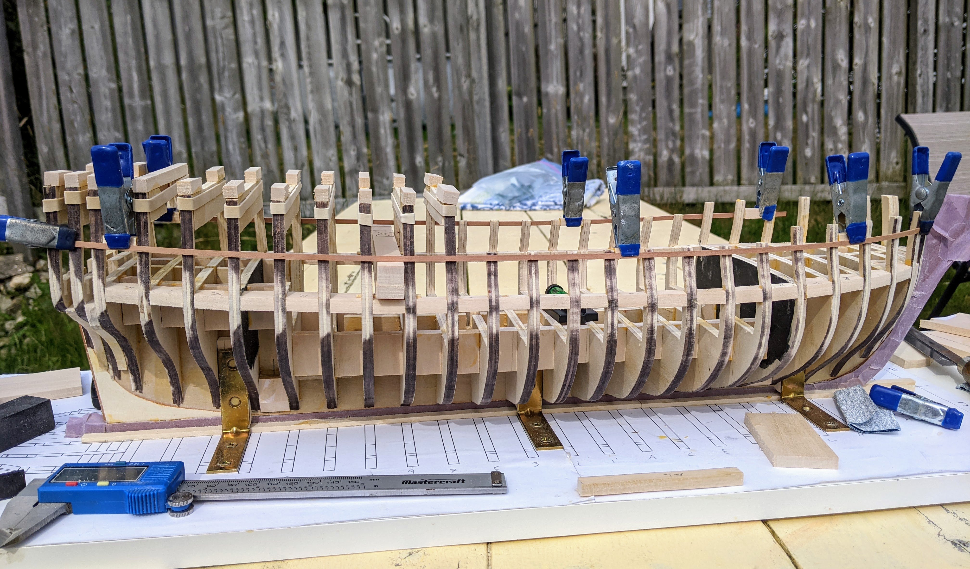

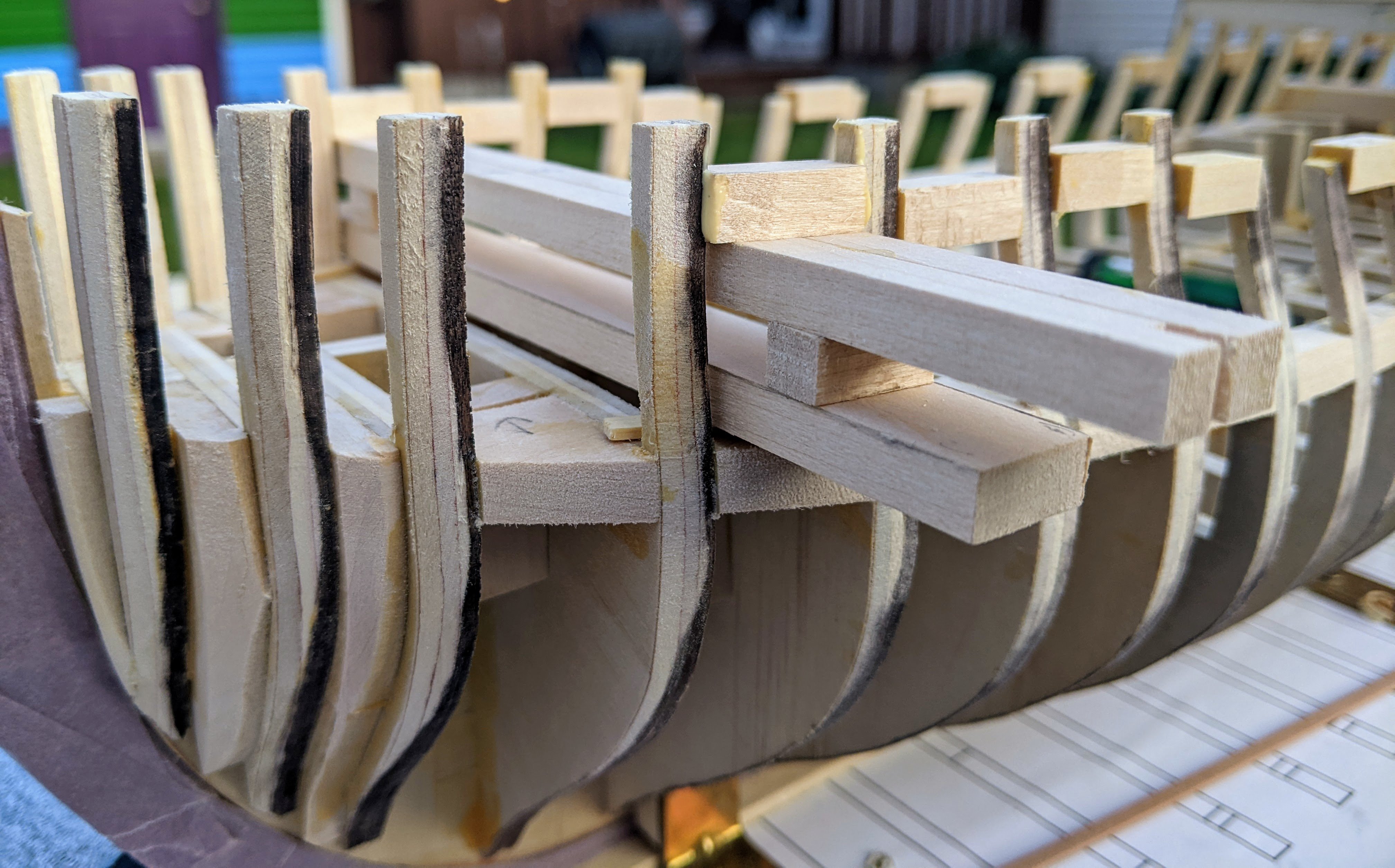

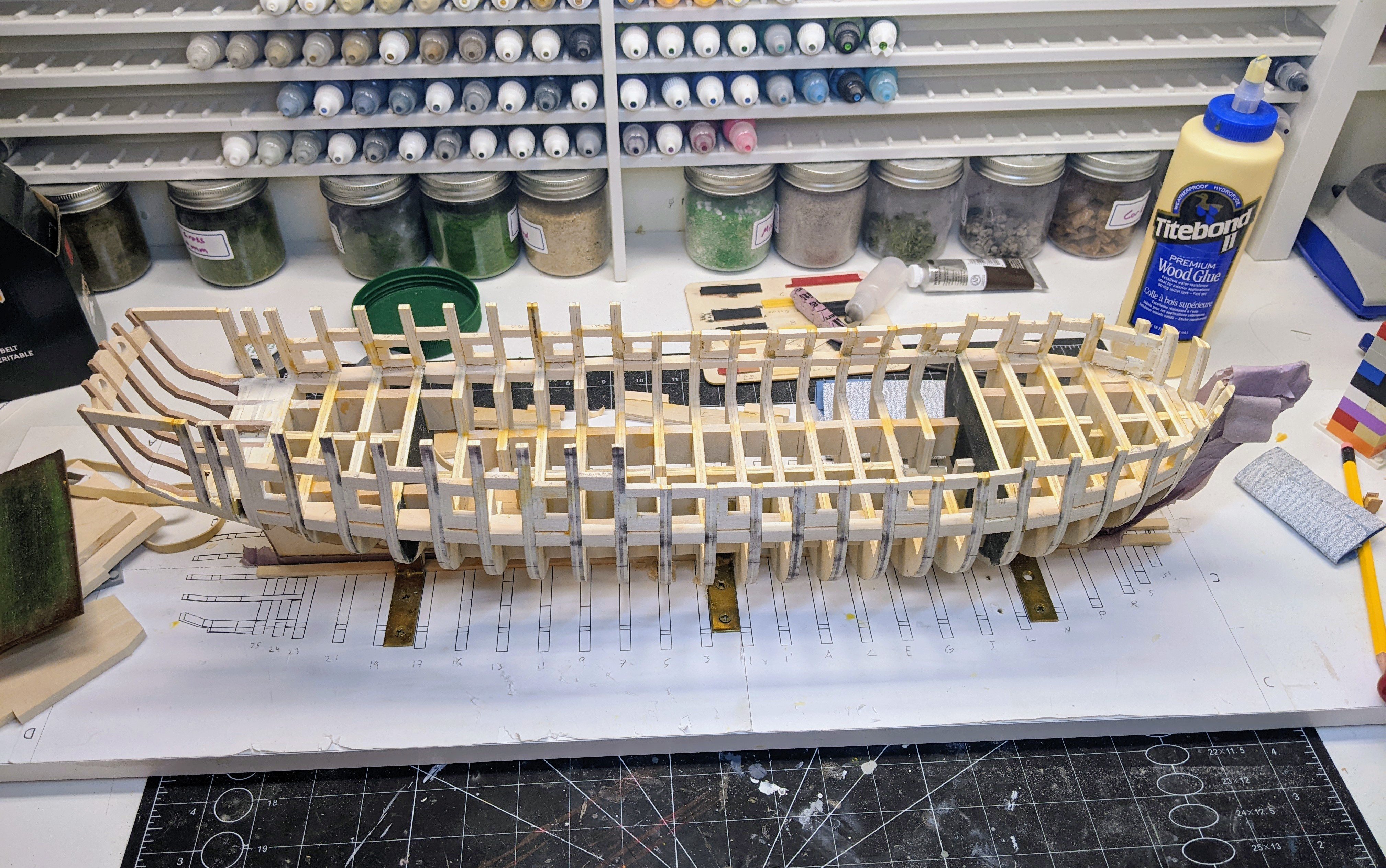

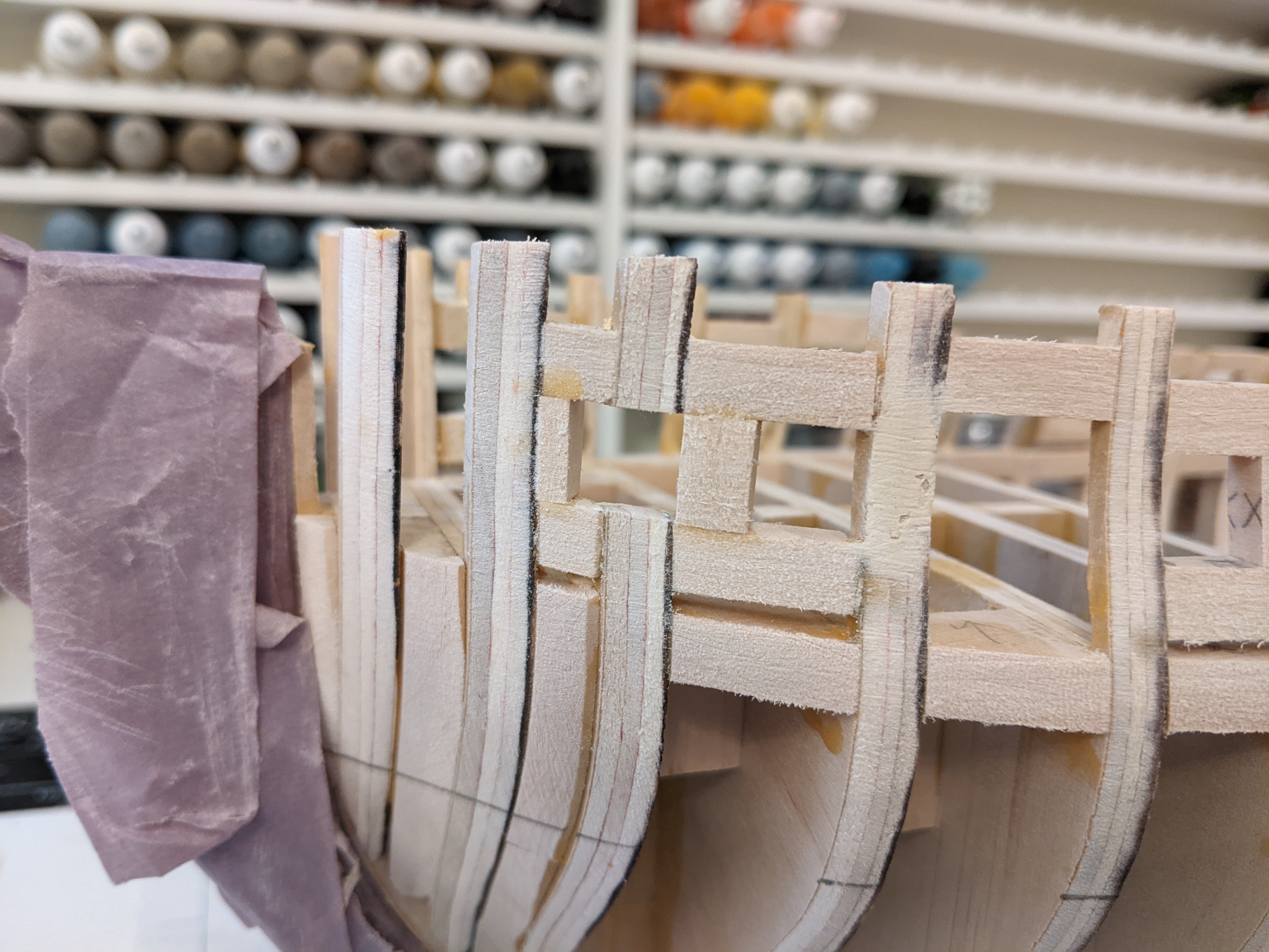

Finally, I have also been starting the outer structural supports.  This is a line of bracing pieces which run along the upper deck line. These serve three purposes:
  1. To allow me to correct for any warped bulkheads which might be square at the base, but are not square at the upper deck bulwarks.
  2. To strengthen the overall structure.
  3. To allow me to better see the line of the main deck to determine if I need to make any adjustments.
These pieces are inserted square to the bulkheads, but at an angle such that they follow the sheer of the deck. I will then use a combination of planes and sanding to trim them back in line with the frames.
Getting the sheer of the main deck right is crucial as it will determine the height of the gun ports.
It feels like this structural work is taking a really long time, but I am trying to avoid future problems by making sure I am constantly checking to make sure everything looks good now while it is easier to fix.

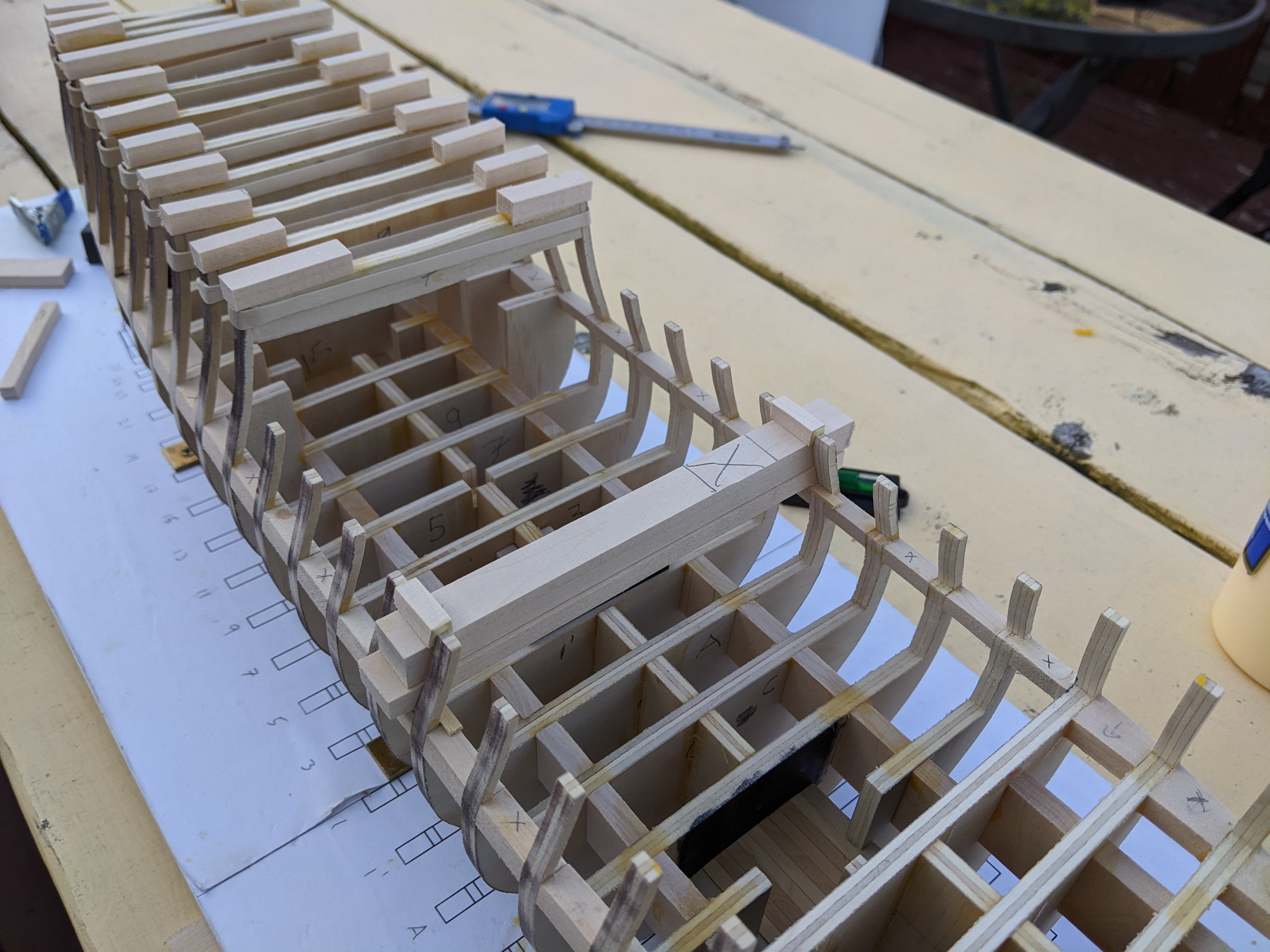

Along the way I realized that the existing inserts I had taped in place to support the thinner bulkhead extensions were in the way and so I cut off the bottom of them and added glued pieces above them to hold them in place. Then I place rubber bands around the whole upper part of each bulkhead to hold it together. This is actually more sturdy than what I previously had done and it also keeps the supports out of the way.
I have been doing some preliminary faring as I add the bracing pieces along the sheer of the deck. The bracing pieces are now all in place, though the ones near the bow and stern have not been fared at all yet. As you can see from the below picture, the sheer is not perfect and so now I need to make small adjustments inboard to make sure the line of the deck is right. Then I can use that line to measure the gun port heights.
The sheer will also allow me to measure and mark the height of the quarterdeck and forecastle and I will likely add bracing pieces to mark their locations before I start faring in earnest.

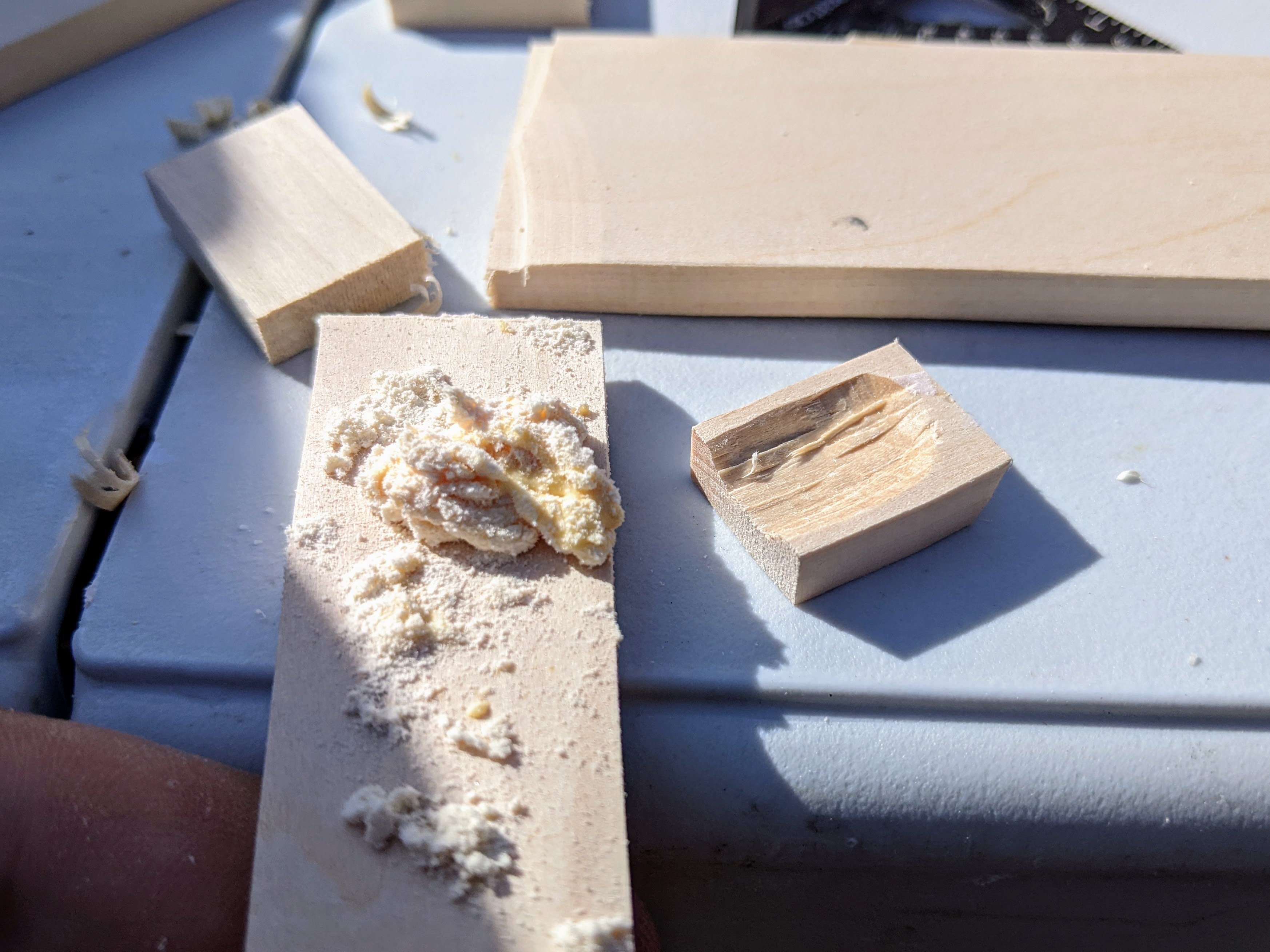

I have also taken the opportunity to reinforce the area where the nuts are glued to accept the bolts that will attach the model to the base. To do this I cut pieces of basswood and then used my mini chisels to hollow them out. I then filled this hollow with a wood glue sawdust mixture.
This was then pressed in place over the area of the nuts until the excess sawdust-glue mixture started to squeeze out indicating the area was fully filled. This is probably overkill, but as it didn’t take much time, I figured it was worth the effort to make sure that these don’t come loose.

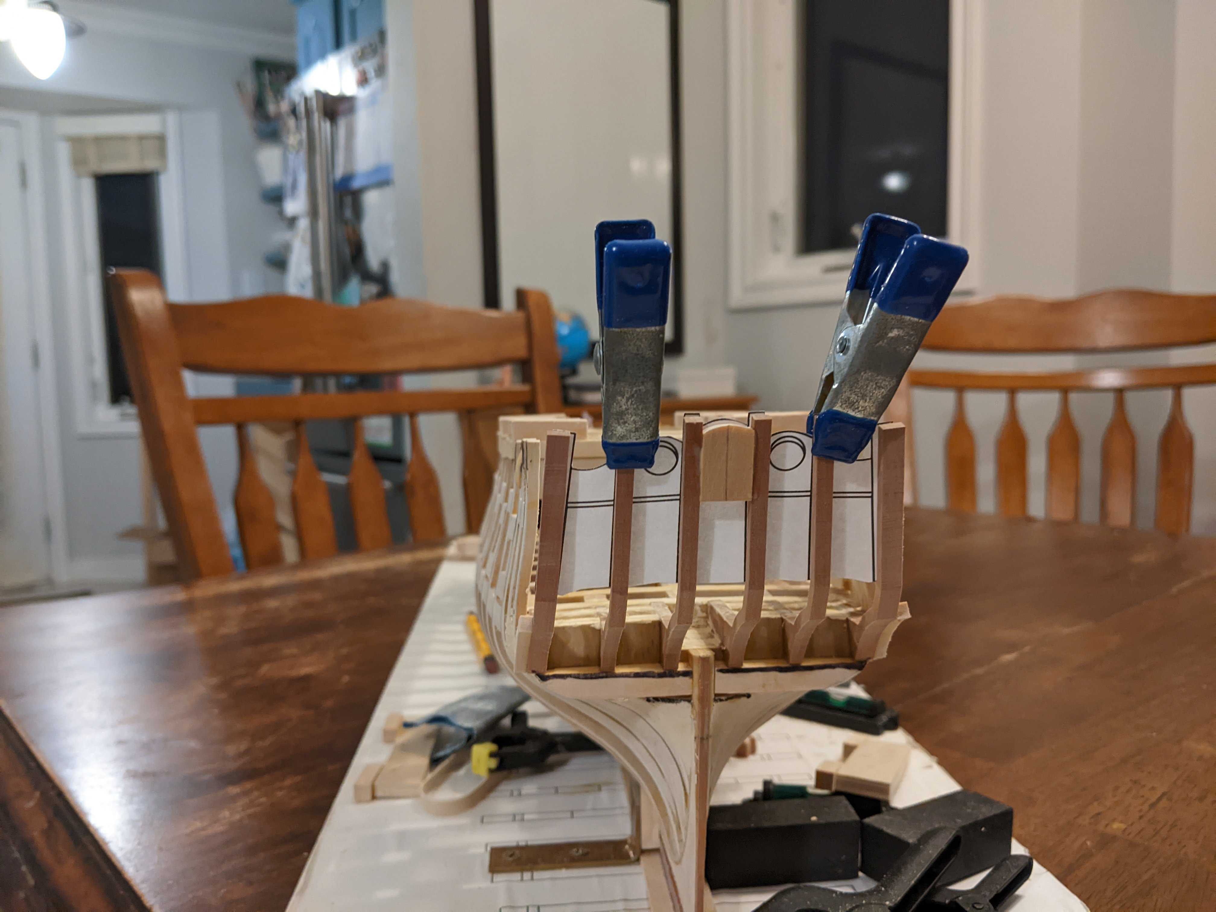

Log #26: Framing the Gun Ports Part I

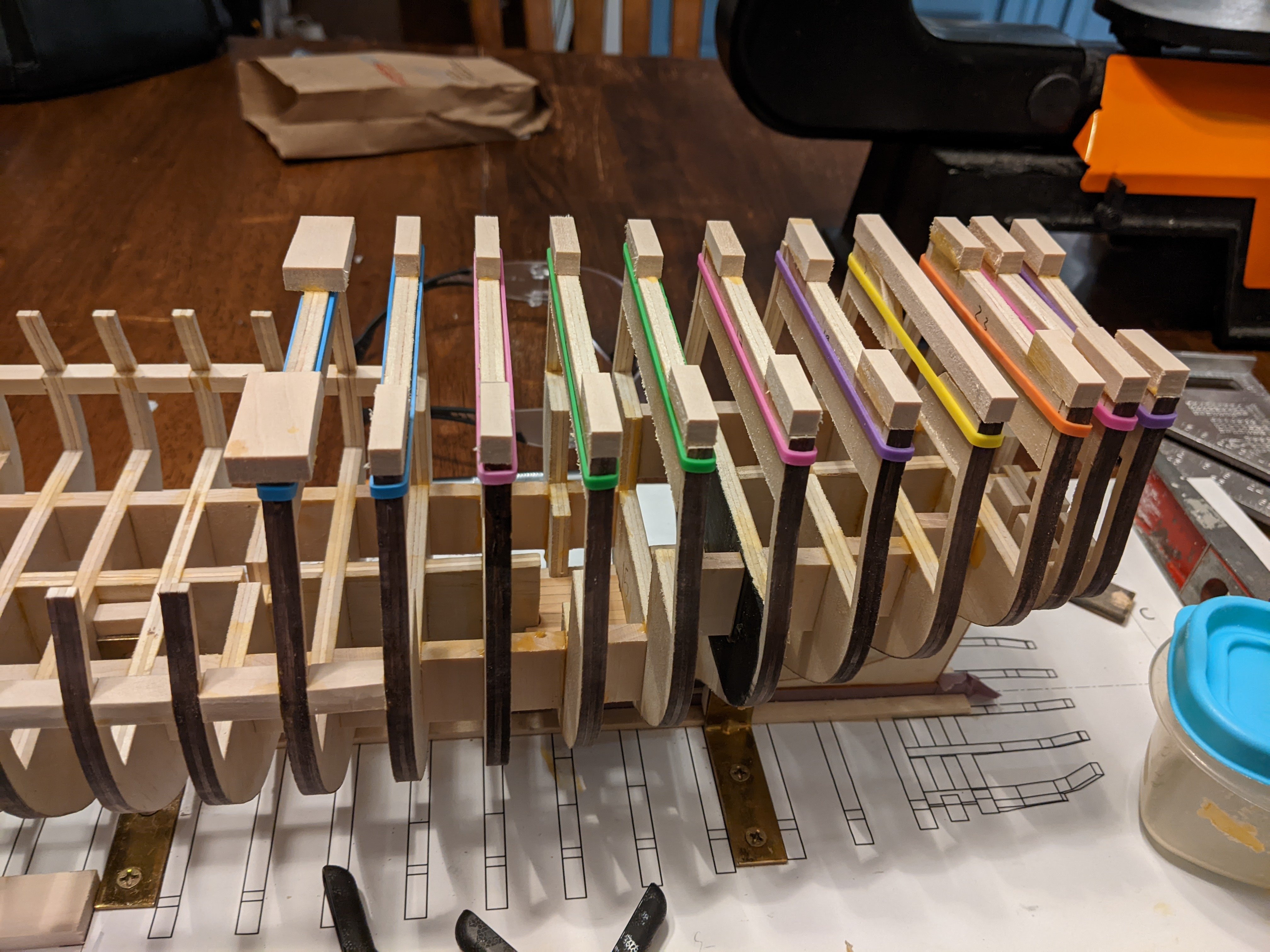

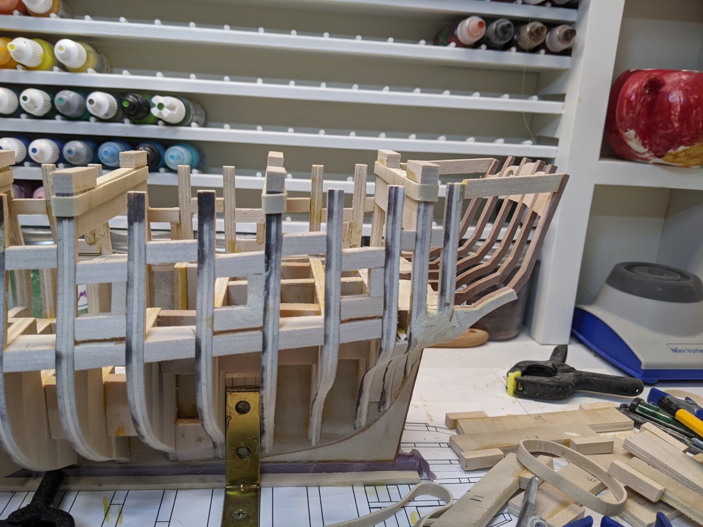

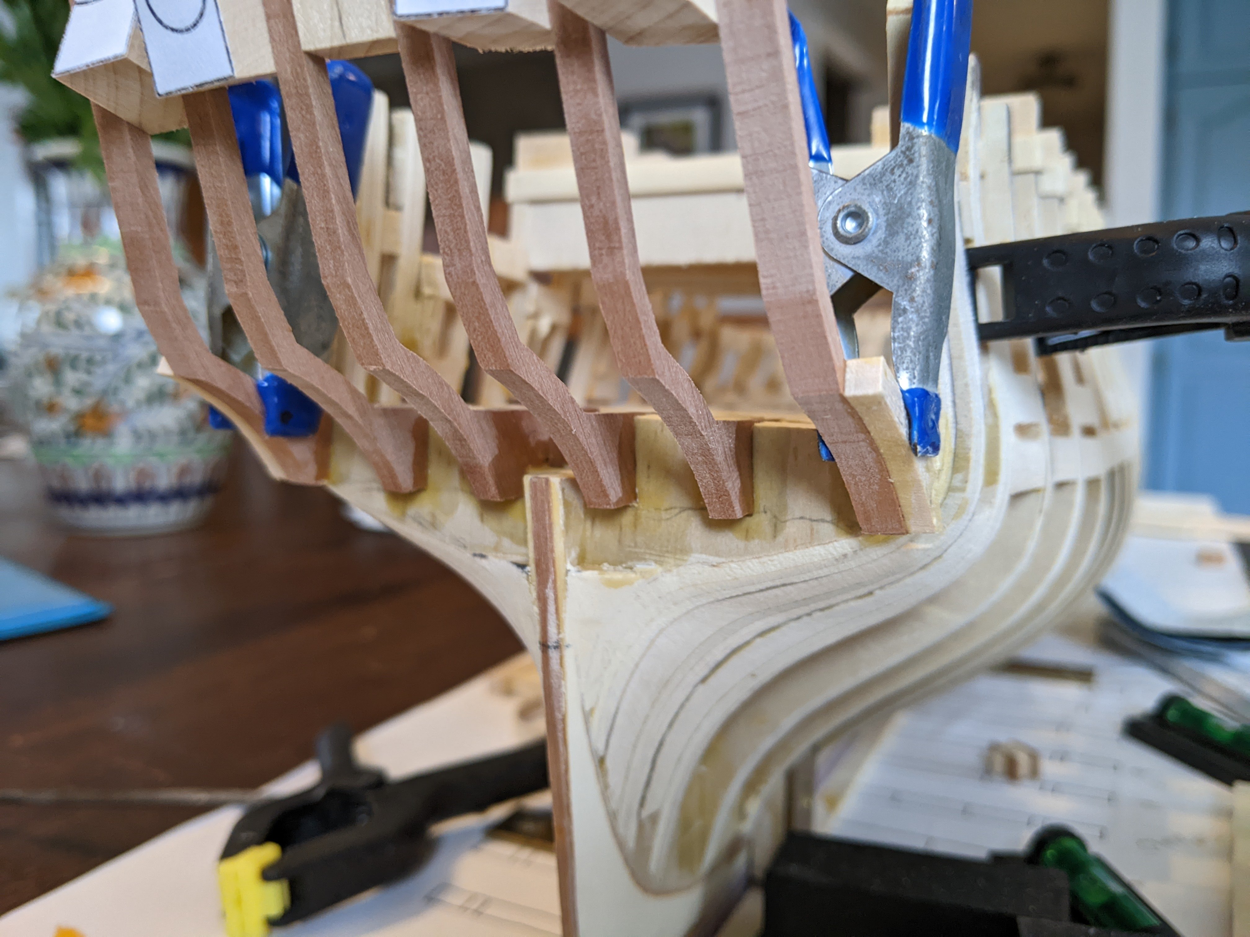

I have started work on one of the more consequential parts of the structure of Perseus, the gun ports.
These represent one of the one of the visual focuses of the model. The line of the gun ports catches your eye so getting the sweep of them right is important to making the model look right. As I mentioned in my last post I have been working on getting the inboard sweep of the deck right and that was my starting point for measuring the ports.
Given the size of the basswood I was using for the framing (1/4 inch), there would not be much space below the lower port so I decided to start with the top of the ports.

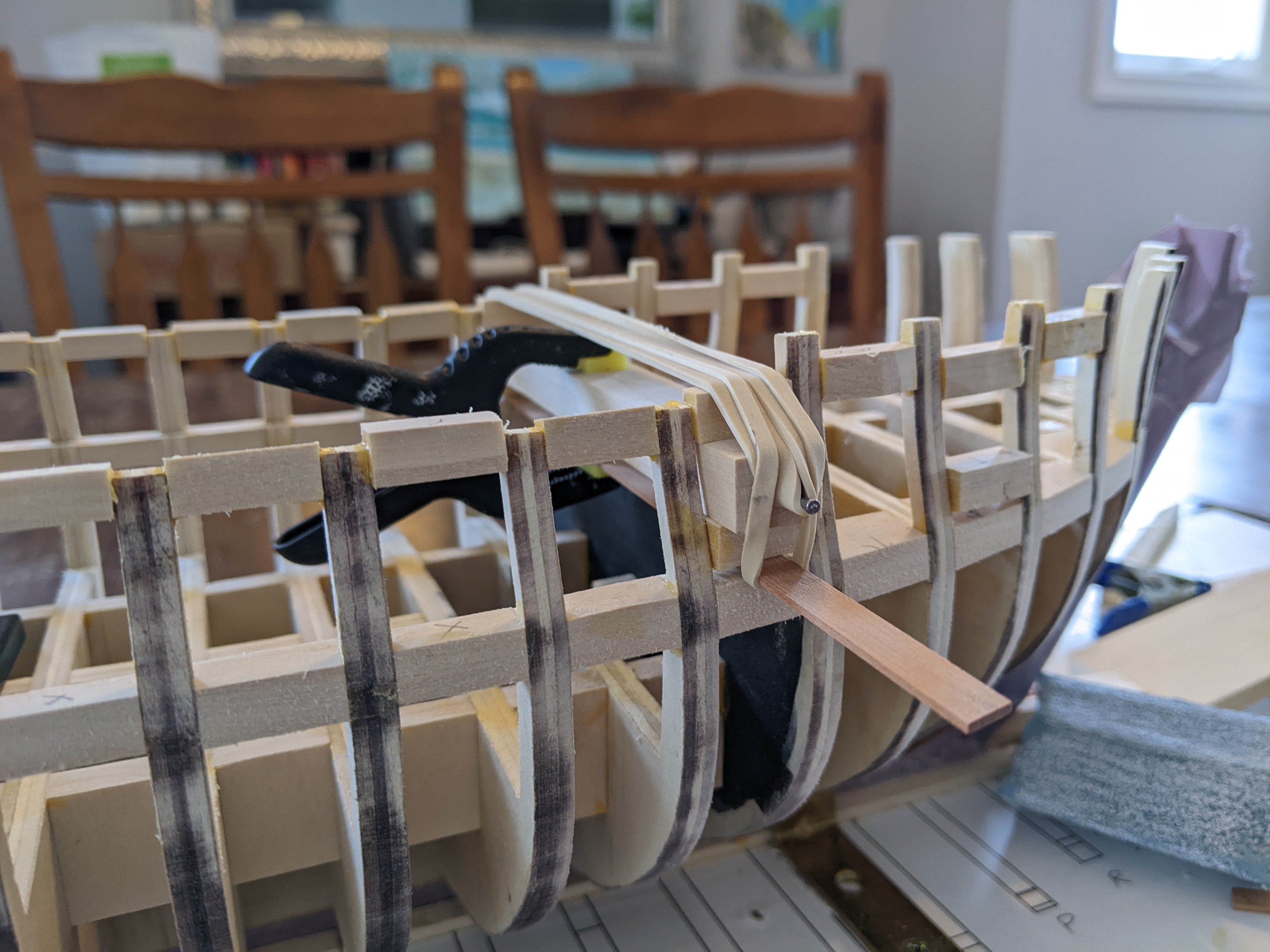

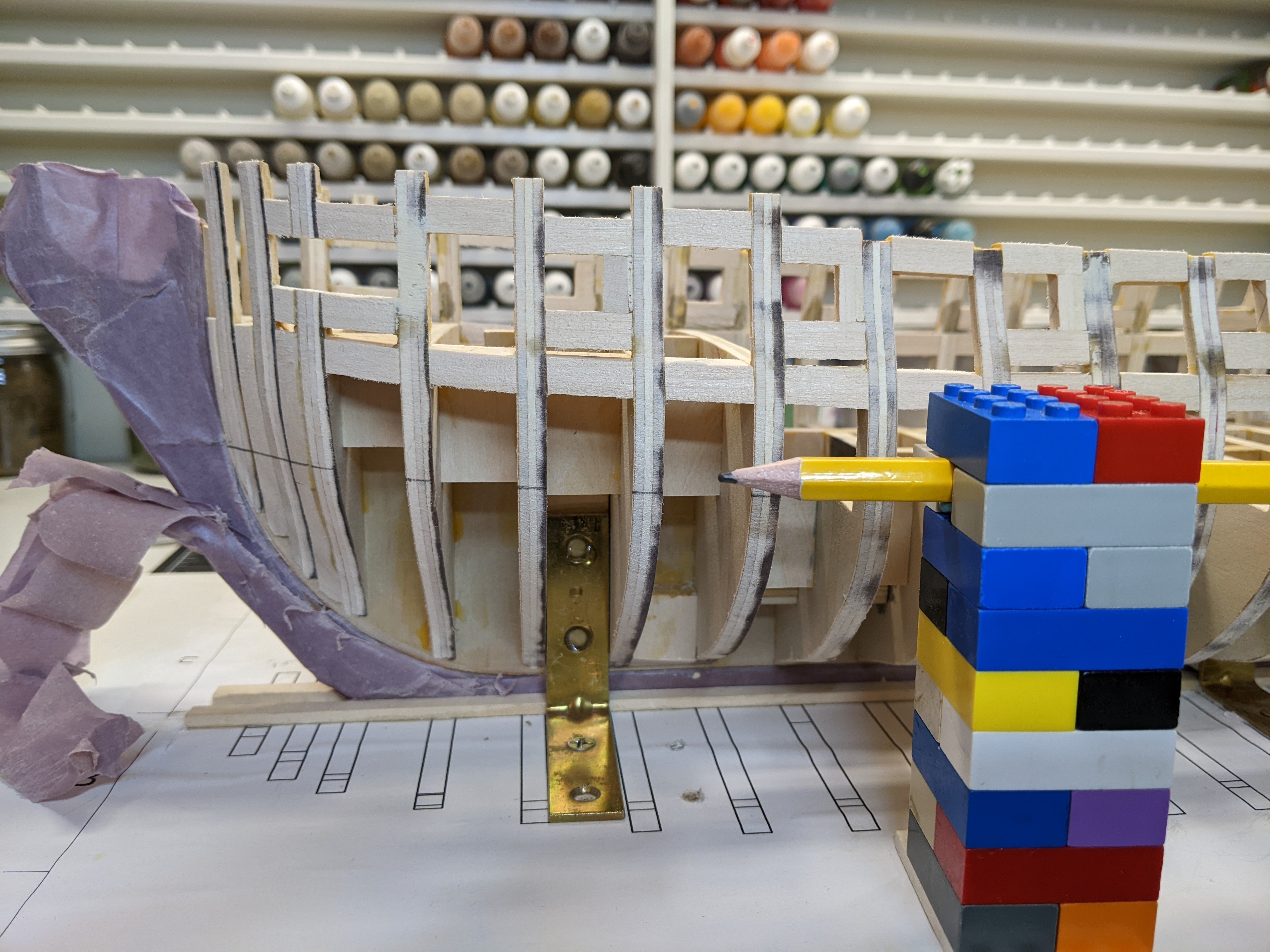

Starting in the middle of the ship, I used a jig to measure a consistent height. The jig is built from 3 layers. First on each side I had a small strip of wood which was used to line things up with the sheer of the deck at that point. On top of these were some folded paper (as this was the easiest way to add consistent small amounts of thickness to get the height right) followed by a spacer piece 1/4 in thick. Above this was a piece of wood the exact height of the ports. This also allowed me to check using a level that the ports were the same height on both the starboard and larboard sides of the ship.
I then glued the upper port frames to the bulkheads using the jig to position them at the right angle and height. I did one of the middle ports and the ones at each end before using a batton to check how things looked. Every time I did another port I would check how it fitted with the batton and adjust the inboard profile of the deck as necessary.
At this time I also placed cross bracing pieces between the bulkheads at the height of the forcastle and quarterdeck beams. For the forecastle I used spacer jigs (similar to the ports), but for the quarterdeck I had to be a bit more creative as according to the contract, the fore end is a different height than the aft end. So I measure and marked the two ends and then used battons to make a smooth sweep. This is not as important to get perfect as these heihts can easily be adjusted later and the main point of these bracing pieces is to strengthen the structure in the space between bulkheads that don’t have ports. You can see below a picture of the jig used for the quarterdeck.
For the lower pots I used my jig for the port heights held up by a rubber band. I then used an old piece of scrap wood to apply pressure to the bottom of the port framing to hold it against the bottom of the jig at the correct height and angle.
And this brings us to where things currently stand. I am still working on the lower framing for the ports, but the strengthening structure has allowed me to remove some of the bracing pieces I had in place.

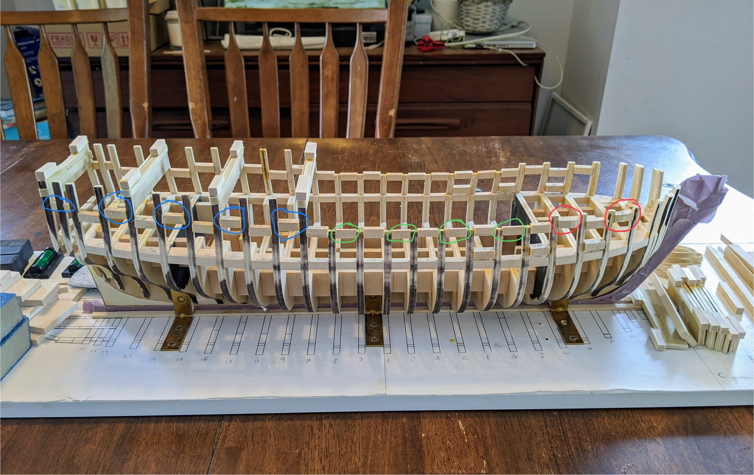

The top of the quarterdeck beams follow the line of the top of the pieces circled in blue, the forecastle the ones circled in red and the green ones are just extra pieces I added to strengthen the structure. You can see that I have 3 of the ports framed (though I still need to add vertical pieces to set the width). I also still need to prepare the framing of the foremost port, but that will first require some more faring as it is on the curve of the bow.

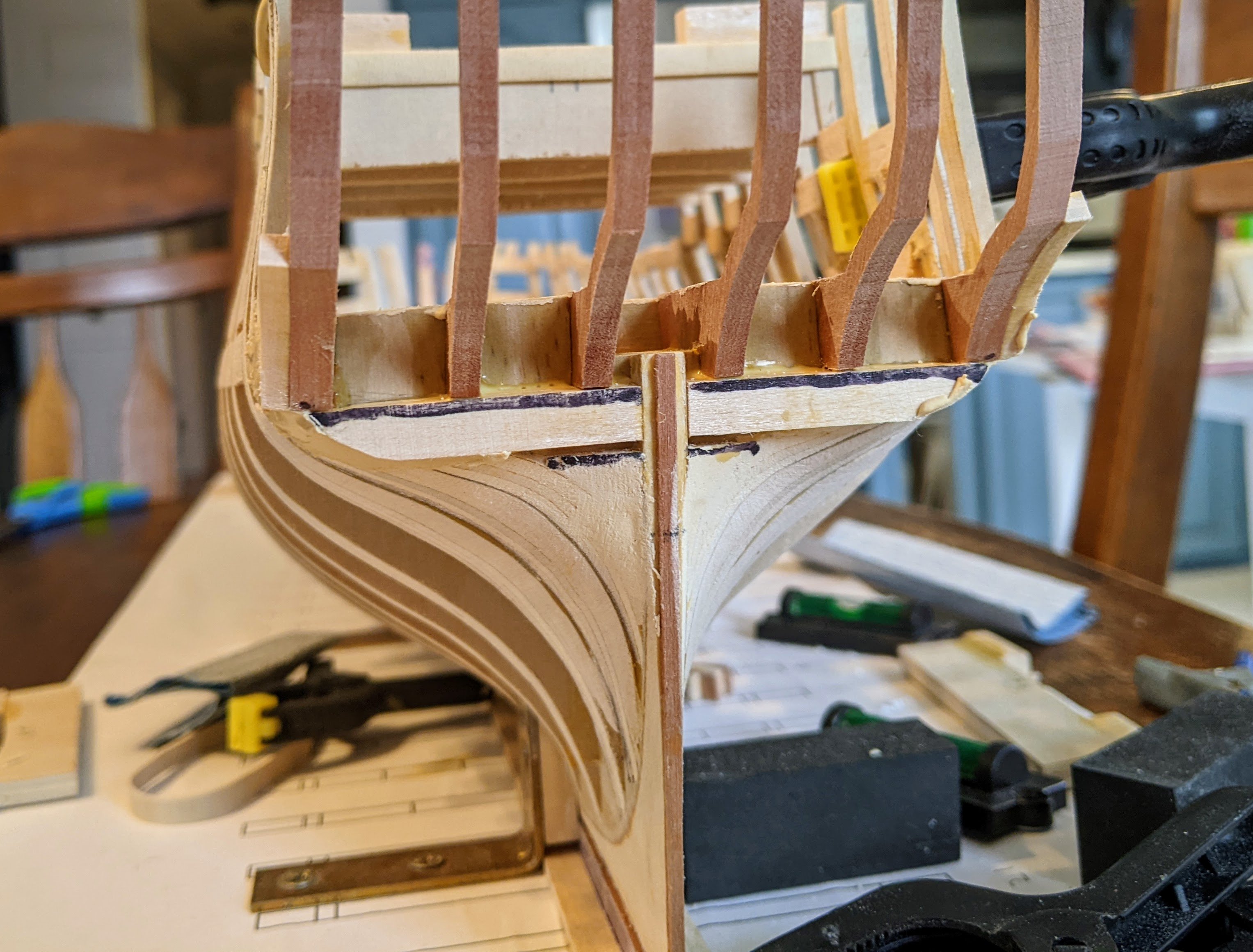

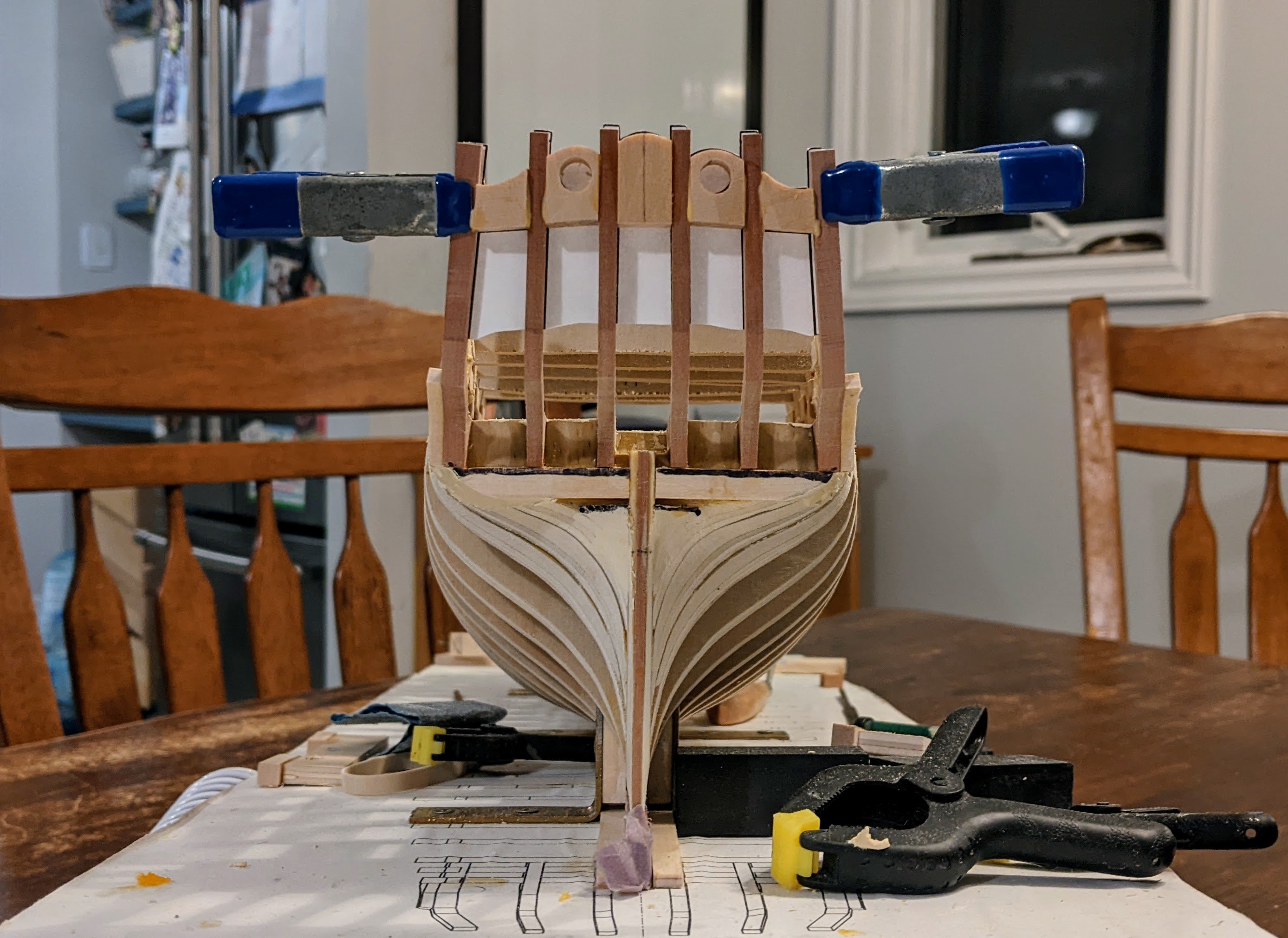

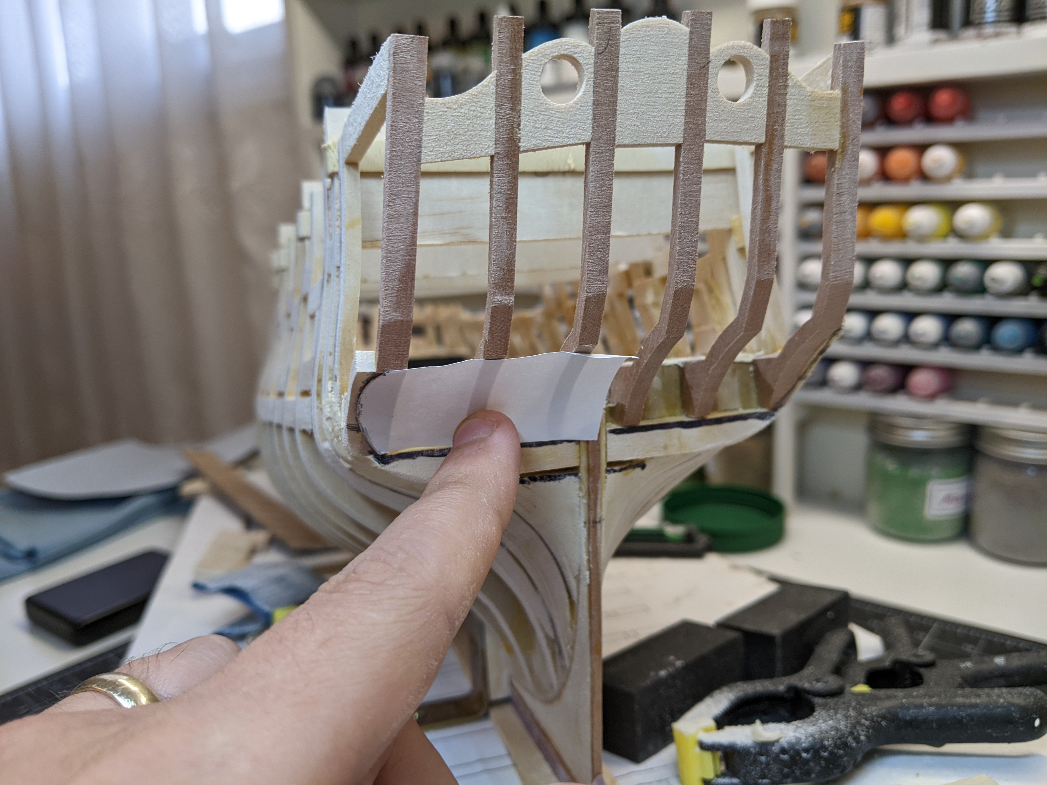

Over the past few weeks I have continued my work on the gun ports.
One happy coincidence of my plans is the fore side of all of the gun ports (except for the first on each side) lined up with a bulkhead, so my task with the ports was made much easier than it could have been. I made some jigs to allow me to place the other side of the port in the correct position aligning with the frame. The sides of the port are always perpendicular to the keel, but the angle of the top and bottom of the ports changes depending on the sheer of the deck at that location.
The jig was essentially two pieces of wood which I precisely cut to the width of the ports (28 in according to the contract or 7/16 in at our scale). These were then aligned on a spacer bock and then a small piece of wood to hold the jig off the floor of the port to allow it to rotate to the correct angle for the bulkhead. You can see the jig below aligning one of the gun ports.
As a general rule I used more material than was necessary as I would sand it all off later. You can see below what things looked like once all the ports (except for the most forward ones) were sided. This also represents the first time I have taken the ship off of the build board since I started construction. The hull is now rigid enough with all the bracing pieces I have added that it shouldn't twist anymore. I still keep it on the build board for storage, but faring is much easier if I can hold it on my lap.
This brings us to the faring. I don't think much needs to be said about this as this topic has been covered by many logs in the past, but I will note a few things that I encountered which may be useful to keep in mind for other first time scratch builders.
  1. Slower is better - Faring is such a lengthy laborious process I am tempted to rush, but it is very easy with a few misplaced swipes to take off too much material. Thankfully I caught all of my mistakes along this line before they went too far, but something to keep an eye on. Having the marker on the outside of the frames so I could judge easily how much of them I had sanded was invaluable for this.
  2. Keep an eye on finished areas - The masking tape I have on to cover the keel and knee of the head needed to be replaced a few times (particularly around the bow) as it was easy for sanding to rub the area.
  3. Use the right tool for the job - Something I found helpful in avoiding oversanding was to make sure I was using the correct shape of sanding stick / block for the area I was working on. At midships you can use a large block and sand in all directions as the curve is convex, but in concave areas you need to carefully choose the size of your sanding stick and sand in very particular directions to get the correct run of the lines.
And here is Perseus with one side preliminarily fared. Once I do the framing of the stern then I will do a final pass, but I don't expect to have to remove much more material. You may also notice that I filled in the gaps between the port sides and the next frame to strengthen the areas after one of them got a bit loose.

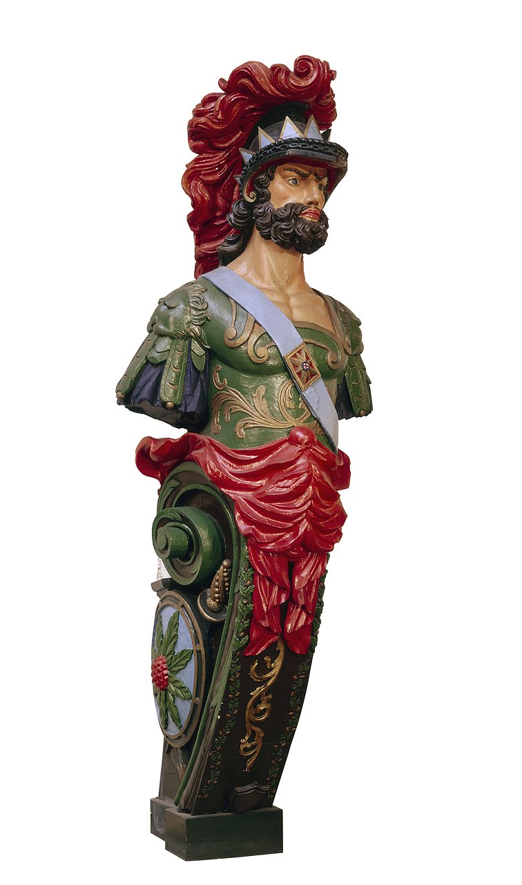

Figureheads are in many ways one of the most striking parts of the 18th century sailing vessel. In the 17th century the majority of Royal Navy ships had a lion as a figurehead, but towards the later part of the 17th and into the 18th century the figures began to increase in complexity.
By the late 18th century figures relating to the name of the vessel were the predominant choice, but at times the relationship to the name was tenuous at best. This was sometimes the result of renaming, but in other cases it is unclear why a particular figure was chosen. In his book Old Ship Figureheads & Sterns Carr Laughton recounts one particularly egregious example where the frigate Blonde was given a figurehead of a bearded warrior.
Figureheads in the late 18th century were looked on with great pride by their crews. Even during the economy of Lord Spencer in 1794, when most new construction received only scrollwork in place of a figurehead, crews often took it upon themselves to add figureheads to their ships. There are accounts of crews adding painted detail to their figures with one captain writing that the figurehead of another sloop was “painted in colours with a bloody nose and a real broomstick in her hand.”
National Maritime Museum, Greenwich, London. FHD0120.

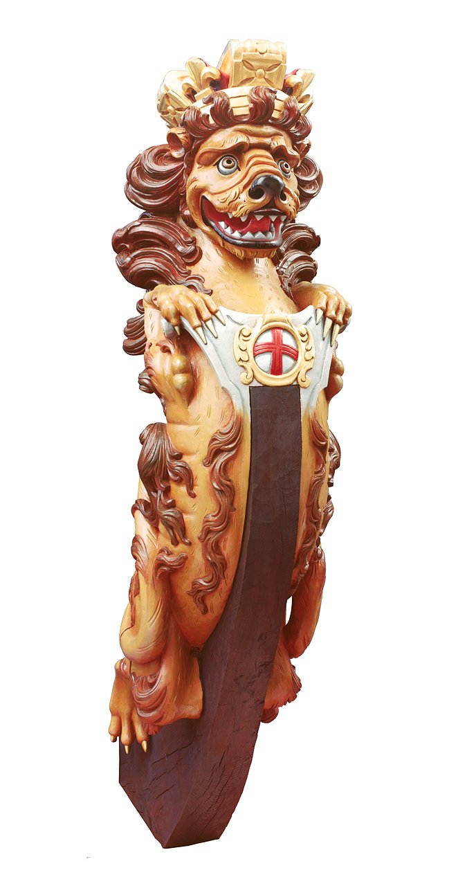

Despite the prevalence of figures, the lion remained common and there is no definitive evidence in the primary record to indicate what sort of figurehead Perseus was given. The contract for Perseus and Unicorn states that the ships were to receive figureheads, but does not specify beyond stating that they should be “lion or figure with a double trailboard as shall be directed.”
Lion figureheads had a long history in the Royal Navy by the time Perseus was constructed and there are numerous examples in the historical record documenting them. One of the few figureheads that have been preserved from the 18th century is of a lion, likely the figurehead of an English 4th or 5th rate circa 1720.
National Maritime Museum, Greenwich, London. FHD0088.

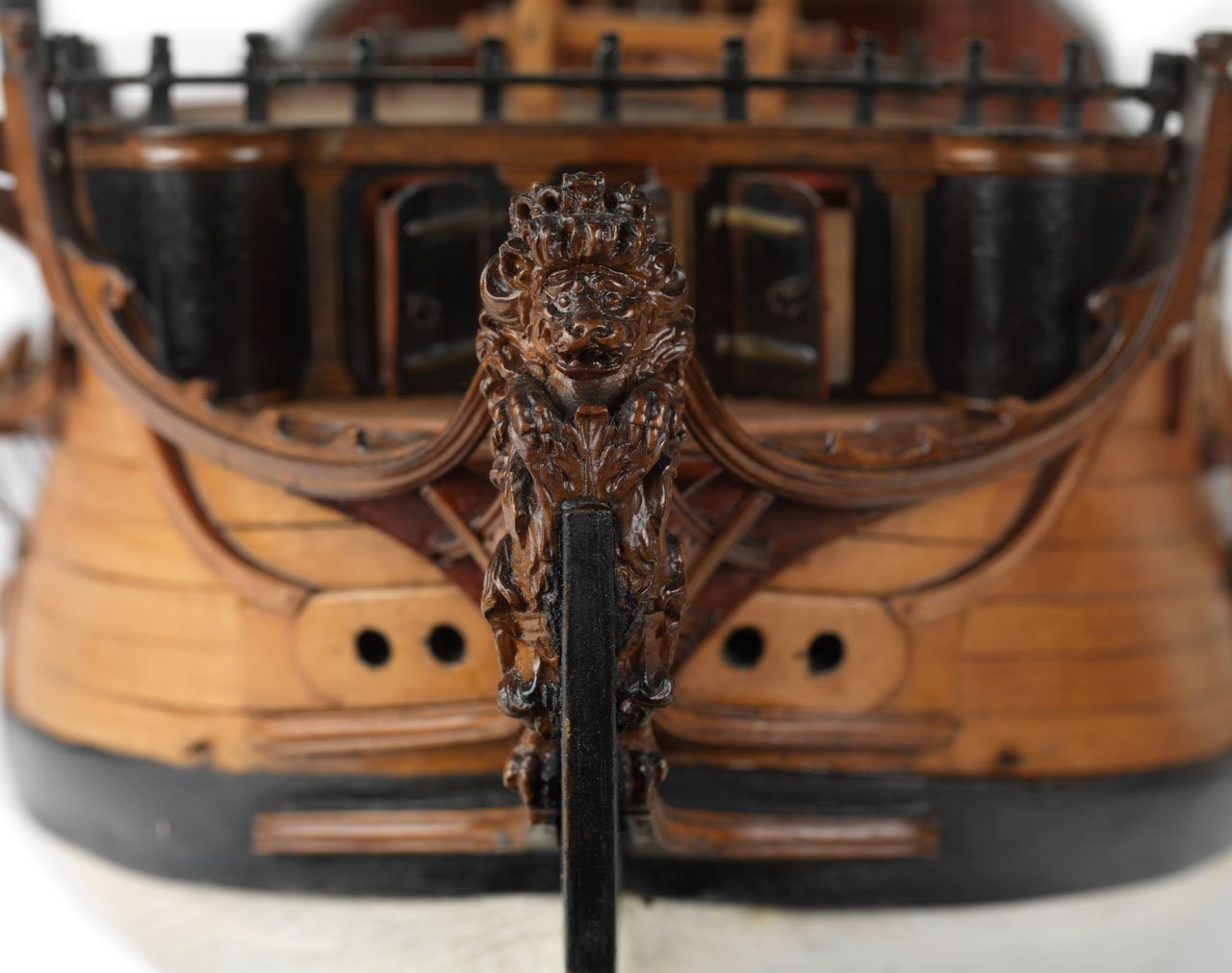

A similar depiction can be seen in a 1741 model of a 24 gun sixth rate sloop. Most contemporary models seem to have depicted the figureheads painted gold or unpainted. However,  many of these models were created by the shipwrights and the painting of the figureheads in more realistic colours was often done upon request or after launch by their crews.
National Maritime Museum, Greenwich, London. SLR0461.

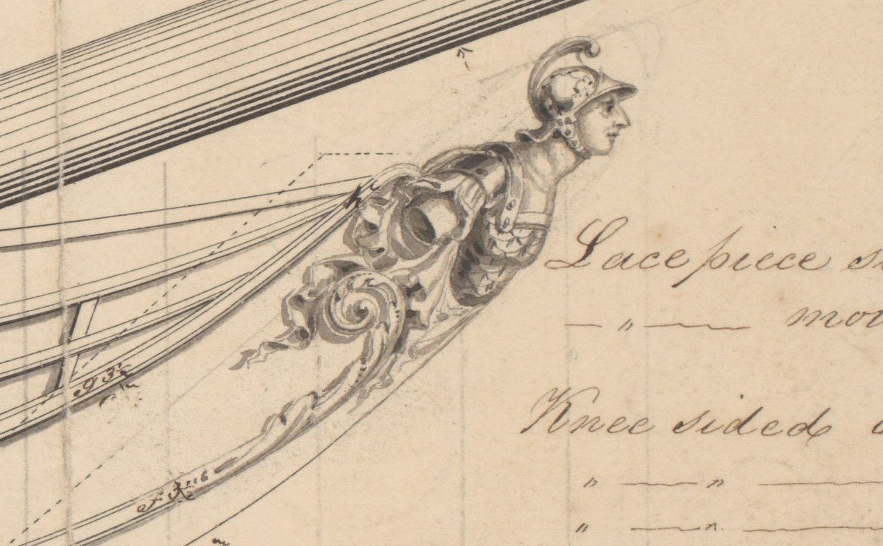

Probably the most compelling evidence for a figure of Perseus is the blurry figure visible in the image of Perseus on a bowl from 1790. Though it is impossible to say definitively, the figure in the image appears to have an extended arm. Classical depictions of Perseus tend to depict him with the head of Medusa held out in front of him. It should be noted that the idea of having a figure with an extended hand was not uncommon in the period. Termagant, a 22 gun ship launched in 1780 , features a figure with their left hand extended forward as did Leopard 1790.
National Maritime Museum, Greenwich, London. AAA4434.
Perseus was a Greek mythical hero who is most famous for killing the gorgon Medusa using a polished shield given to him by Athena and winged sandals lent to him by Hermes which allowed him to fly. Perseus cut off Medusa’s head and Pegasus (a winged horse) and Chrysador (either a giant or a flying bore) were born from the severed neck. Perseus rescued Andromeda the daughter of Cepheus, the king of Aethiopia from being sacrificed to the sea monster Cetus before marrying her and founding the Mycenaean kingdom. Pegasus is often associated with Perseus as many later depictions show Perseus riding to Andromeda’s rescue on Pegasus.
Contemporary artwork available from the period appears to universally portray Perseus holding the head of Medusa. In most of these examples he is portrayed as clean shaven. The stern carvings for Pegasus 1776, a 14 gun sloop launched the same year as Perseus, portray Perseus as a clean shaven man with a sword in his right hand and the head of Medusa in his left.

Log #30: Framing the Stern Part I
As I alluded to in update 28, there were a few cases where I took too much off with the faring. One of those is visible in the last image in the post. I had been overzelous in my sanding around the reinforcement for the stern fastener and took too much off of one side. This was actually fixed just after I posted log 28, but I was waiting till my next progress post to show the correction.
You can see I used a combination of scrap pear and wood filler to build up the area before sanding it back down. This time I paid careful attention to the run of the battons in the area and checked from the stern frequently to make sure the bulkheads were the same on both sides.
With that correction done, it was time to turn my attention to the framing of the stern. I was pretty apprehensive about this part of the build as even slight issues are much harder to correct (can't just stick some filler on it). Cutting the stern framing pieces turned out to be much easier than I thought. I guess all my practice on the rest of the build has made me much more precise with the scroll saw, but I didn't have issues cutting them apart from the usual very small touchups needed with a file.
I cut them out of pear for two reasons:
  1. Strength, the pear is much stronger than plywood of basswood.
  2. I have not yet fully decided what I am going to do finish wise around the stern galleries and so there is a chance that I might want to show bare wood.
I tried to arrange them so as to minimize grain issues on the thin protruding parts of the pieces.
You can see in the above picture me arranging the two inner frames. I have a basswood filler piece in-between them which represents the shape of the top of the transom. This serves two purposes. First, it will define the shape (though it will ultimately be covered by planking and a thin rail piece). Second, it helps me correctly adjust the spacing on the frames.
I spent a long time getting these in just the right place. You can see how in the above picture I am using a square to make sure they are aligned properly with the build board. I would say I spent at least an hour making micro adjustments and looking at it from every angle. Once I was happy I then brushed watered down wood glue into the joints. I did this because I was not confident I could get the alignment done properly before the glue began to set, so it was better to get everything in place and then add the glue.
And above you can see the state of affairs after the next two frames have been added. The filler pieces have not yet been thinned down for final installation, but they work fine as spacers for the moment. The process for adding all the subsequent frames was the same as the first and took place over multiple days. I waited for each set of frames to dry and brushed glue into the joints a second time for each to make sure there was no risk of things shifting.
And here is the current state of affairs. I have added the final two frames, but they are not yet complete as I need to add some basswood filler pieces to the outside of them to represent the complex curve that the outer frames were made of. This technique I am copying from Chuck's Winchelsea instructions which I have relied on heavily in this structural phase of the project. You may also notice that the outer frames are slightly thicker. This is because they need to be sanded to have a slight curve, but this will not be done until the rest of the stern framing is complete.
Thanks again to everyone who has stopped by to take a look and for all your encouragement.
Log #31: Framing the Stern Part II
It has been a while since I last posted as much of the work has been incremental small pieces and so I didn't really feel I had a cohesive narrative to share. So while I have titled this post as concerning the stern frames (which do make up a bunch of the work), in general this is more of a collection of odds and ends I have gotten done over the past month.
Stern Framing
The first step in finishing the stern framing was to add on the filler blocks to the outside of the outer frames. These blocks provide the material for me to shape the curve of the lower part of the frames. The we made using basswood so they can easily be sanded down.
Next I needed to add filler pieces for the transom. These are designed to help with the shaping of the flow of the planks up to the stern which I figured would be much easier to do by faring as opposed to trying to perfectly design the pieces. To start with I cut two pieces matching the shape of the bottom of the lower counter from my plans.
These were then glued in place with the upper edge darkened with marker. I do this to help avoid overfaring.
Once the filler blocks were in place I started the process of gluing in the filler pieces for the upper part of the transom. First I had to sand down the various pieces at an angle to make them conform to the shape of the upper frames. I don't have any pictures of this process, but it was mostly just a bank and forth process making sure I was taking off the right amount of material at the correct angle. I then took a perspective plan of the transom perpendicular to the angle of the upper framing. I then held it in place with clips to allow me to adjust the positioning of the filler pieces.
And here you can see all the filler pieces in place. I should note that I did leave a bunch of material on the filler pieces to allow me to sand them while on the frames to conform the shape to the proper curve.
Then I turned my attention to the lower counter. I drafted a template for the shape of the outer curve which I used to mark where I needed to sand to. I used the same template flipped to the right to get the other side correct. You can see from the below picture that there is a minor issue with the position of the filling blocks for the upper transom. However, I am not really concerned with this as it look correct on the top and I left sufficient room between the bottom of the filler pieces and the upper framing of the windows to allow for me to make adjustments. The main point of these pieces is to correctly space the frames and define the shape of the upper quarter gallery. In the end they will not be visible as they will be fully covered.
Then to stabilize the frames for the sanding I added two support pieces joining the final bulkhead to the stern frames.
Bow Gunports
The bow gunports also needed to be worked on. I had previously shown how I had added the bottom and tops of them, but now it was time to cut the bulkhead to make room for the port.
I then carefully sanded the area before using the plans to mark the location of one side of the ports. These could not be done with the others as they need to be perpendicular to hull at that point since they are sided by cant frames. The same jigs as previously shown were used to make sure the port size was consitant.
Waterline
I also took this opportunity to mark the waterline. As previously mentioned the waterline is not actually parallel to the keel so I had previously measured and marked the point at the bow and stern to get the correct angle. Now tipping the model with the little bit of wiggle room available on my build board I used my trusty Lego + bluetack combo to mark the consistent waterline along the bulkheads. I need to do this now as I  will need to know the position of the waterline as I plank. Also it will help with properly positioning the Wales as they touch the waterline around midships.
Current State of Affairs
And here is the current state of affairs after a whole bunch of sanding. I have not fully sanded the inside as I am probably going to wait until the external planking is complete to help with stability. However the rough shape is now correct. Next up I need to frame the quarter gallery doors.
Edited by Thukydides

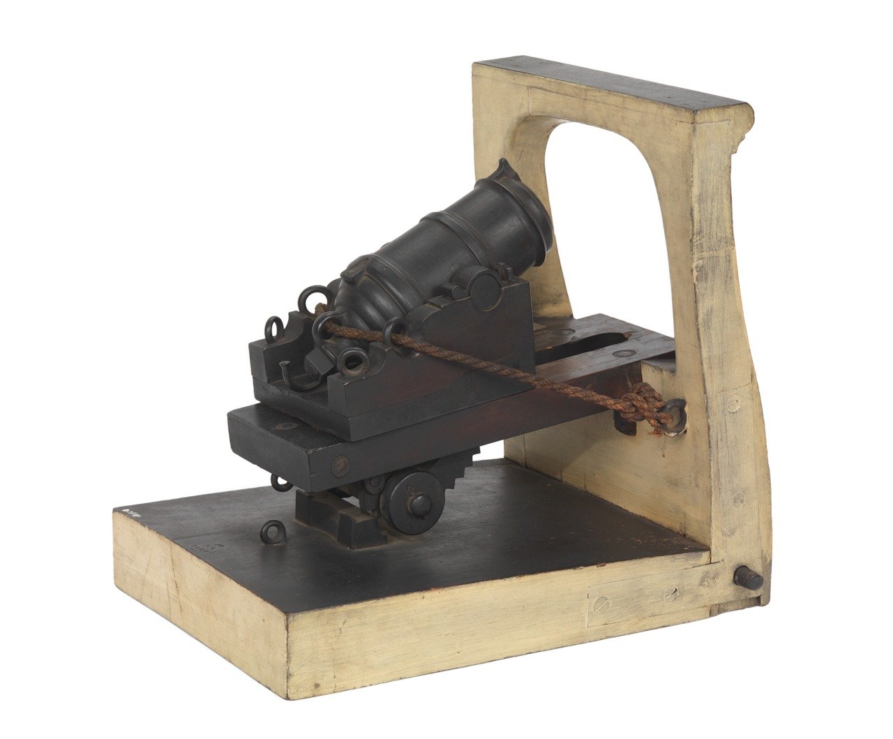

One of the most significant visual features of a ship model are the guns and in the case of Perseus in 1780 (the time period in which I am depicting her), there is a degree of uncertainty as to her exact armament. What follows is a discussion regarding the number and nature of carronades that were likely present on Perseus. When I publish the next update to the research document, it will also include discussion of the other Sphinx class ships in the section as well as the usual detailed citations for the primary sources referenced.
Carronade Model Date Unknown
National Maritime Museum, Greenwich, London. SLR2915.
One of the most common early uses of the carronade was to upgrade the armament of the quarterdecks and forecastles of 5th and 6th rates. It should however be noted that carronades were not considered part of the official armament of the ship. Perseus would still be referred to as a 20 gun ship despite any potential carronades on board. The order in council recommending the use of carronades on Royal Navy ships is dated 28 July, 1779, but it is clear that the implementation of this was varied.

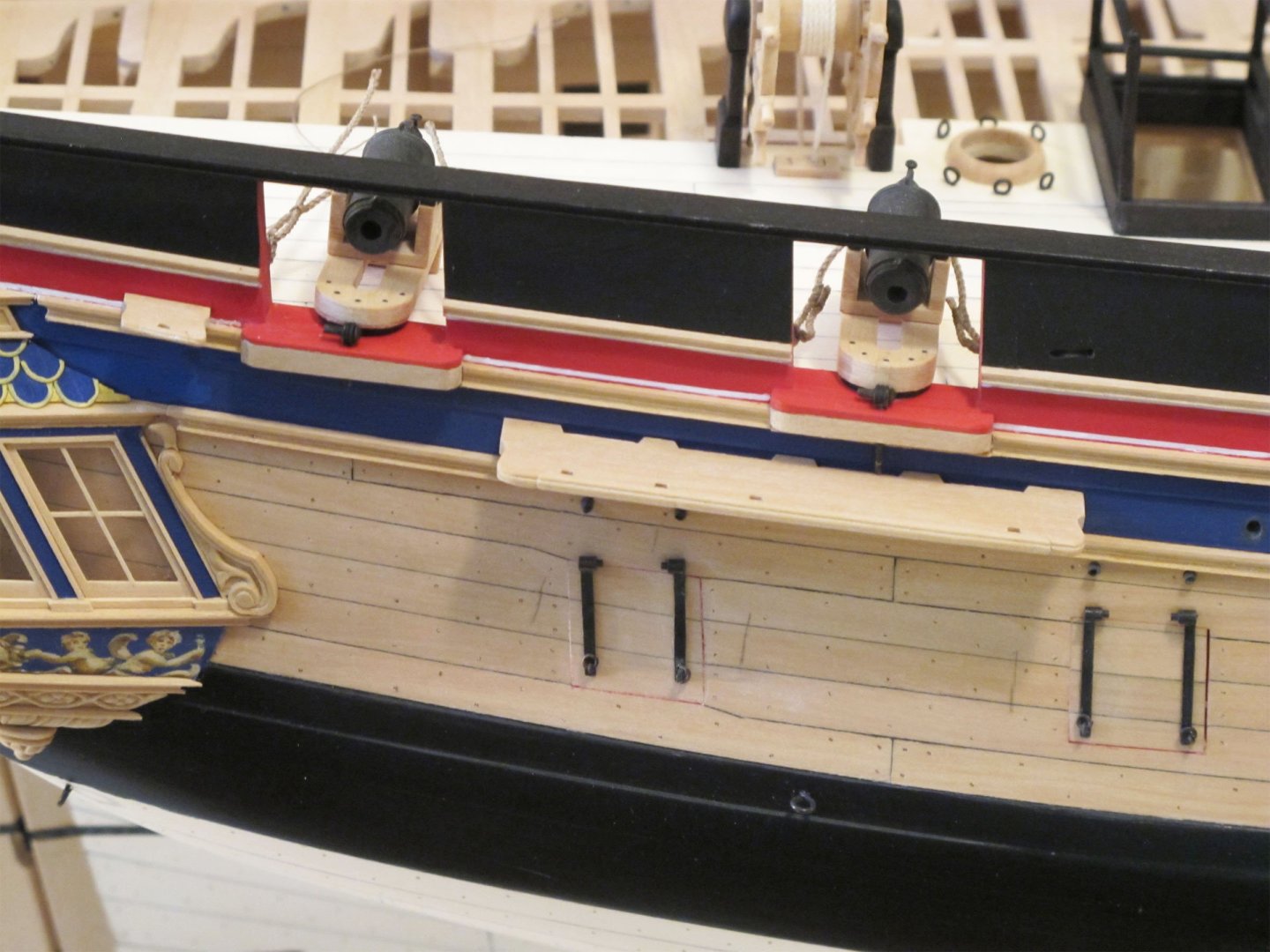

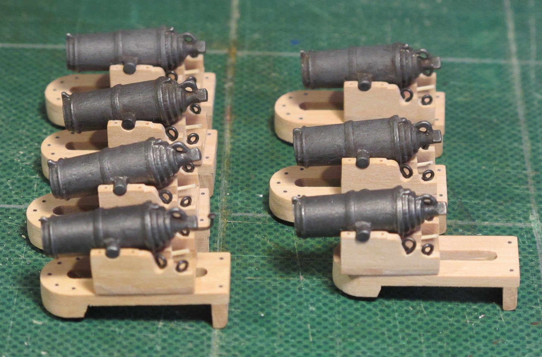

Early carronade mounts are a subject in themselves. This was something I delved into some years ago for a 1782 fireship. From the evidence I could uncover in Caruana and elsewhere, the early carronades were mounted on the 'outside principle' and had no muzzle extension to limit blast spread. Also, there were no wheeled trucks on the inboard end of the slide.
I'm about to read your pdf and may have some additional comments later.
So all my carronade and gun talk is in my internal draft (you won't find it in the file I posted in my previous post). The carronade section is mostly done, it is just waiting on my cleaning up some of the references and adding in some illustrations on my todo list, cleaning up the language etc. If you want to see a rough draft of what I have done, I am more than happy to send it to you, just it will have a few placeholders, incomplete citations, and missing images.
Yes my research says pretty much the same thing regarding carriages, though for the really early adopters things are less certain as there was lots of experimenting going on. I have found some evidence of wheeled trucks, as well as inside principal methods being used in the very early days, but I think they were not common. I plan to depict the carronades using the outside principal. I am mostly settled on the carriage design for the carronades based on the National Archives drawings reproduced by Caruana (I assume that is where your design came from because they look pretty much the same).
