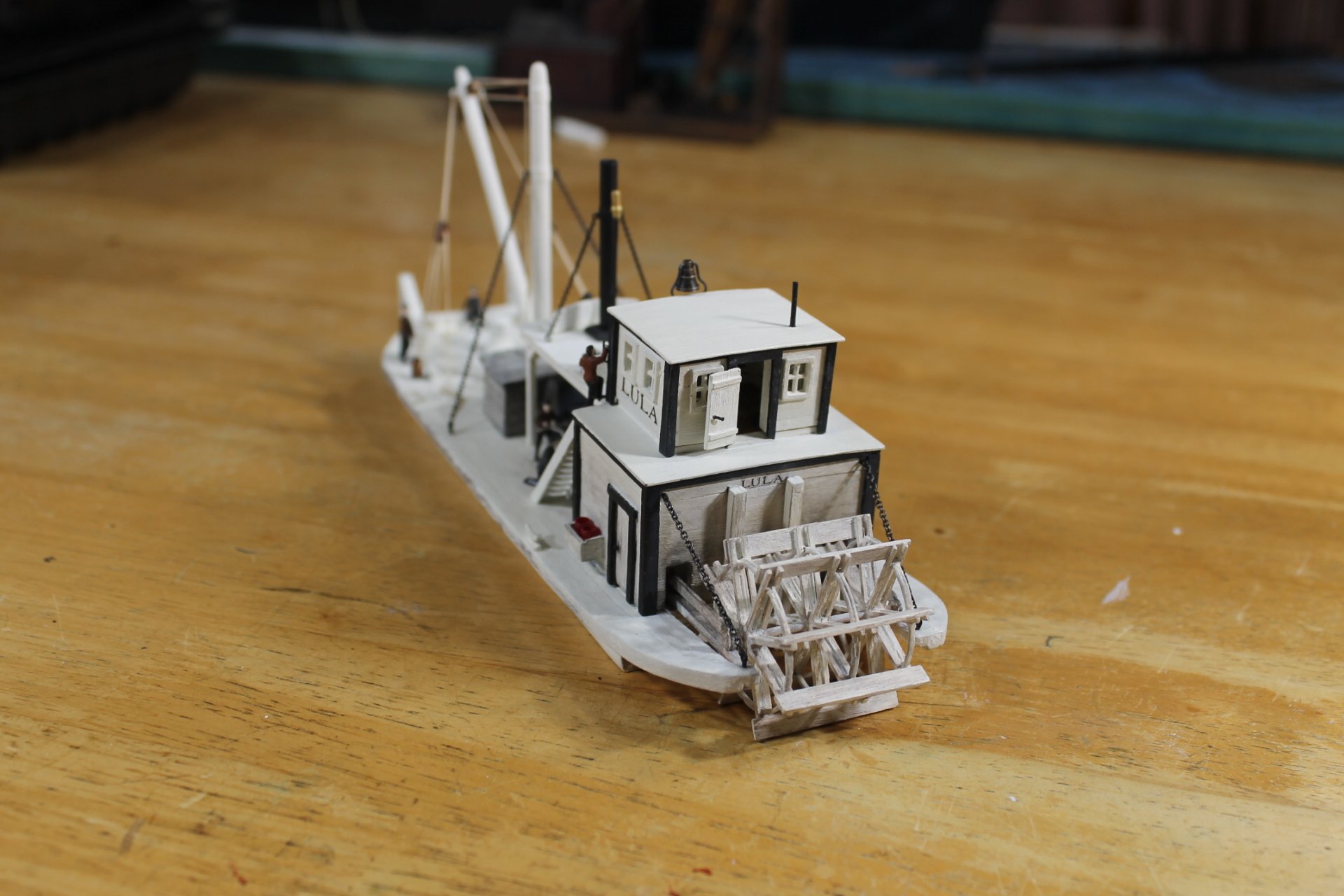

Looks like you have just the correct amount of tension on those chains. We'll sit here waiting to hear the sprong of the tension. 🤞
And it looks like you have a leg up on your starboard side weathering. 😉
Ken
Started: MS Bounty Longboat,

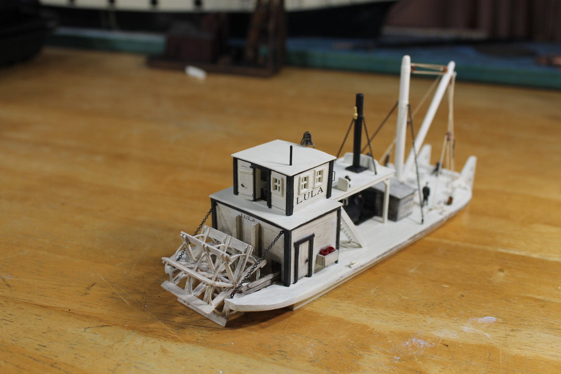

Agree with Ken and Jim about the nice tension on the chains.  That had to be harder than you make it sound to get it just right.
Also, if you're looking to kill 2 birds with one stone, here's a suggestion for the onboard animal and broom.
Yep, installing chains properly tensioned is not so trivial, as they do not stretch. On the other hand, in full-scale they have the same problem and one would normally have a turnbuckle there.
Looking at the design, I was wondering, whether there shouldn't be another set of chains on the other side of the deckhouse - its structure alone would not be able to balance the strain from the sponsons, I think.
If you look at the very first photo in the thread you can see that this chain/cable doesn't go to the deckhouse at all -- it goes through it to a vertical post and then on to another set of posts at the other end of the boat and back down to deck level.  The deckhouse is just built around it.

 I messed up when I installed the stairways. I knew I wasn't going to route the cylinder timber supports as was seen in Lula the car ferry when I built the engine room. To account for the cylinder timber supports anchored end, I was going to run the chains underneath the stairways from the top to bottom edges. But I had a moment of unchecked exuberance when I installed the stairways and forgot about running the anchoring chains first. Once the stairs were glued in place there was/isn't anyway to run the chains. 😦
 Soooo, we gotta pretend a bit. We gotta pretend there's ample metal structure in the port and starboard engine room walls to carry the load and act as anchor points for the cylinder timber chains attached at the top of the engine room's stern wall. Are you wid me or again me?  :)
 I do apologize for waiting till now to bring clarity to the situation but I thought, "well, maybe they won't notice"...........yeah right, LOL.
Edited by Keith Black
Honestly there's an even better pretend option; just assume that the angled hog chain post within the engine room doesn't extend up through the boiler deck floor as on the real thing, but is a bit shorter and set further back, such that the chains you have meet it right at the stern wall. In other words, it's there but hidden from sight.
Yeah, this doesn't fully transfer the weight forward, but that's a detail only the most technical observer will notice. Your current way deals with the more obvious visual question "what's holding up the wheel?".

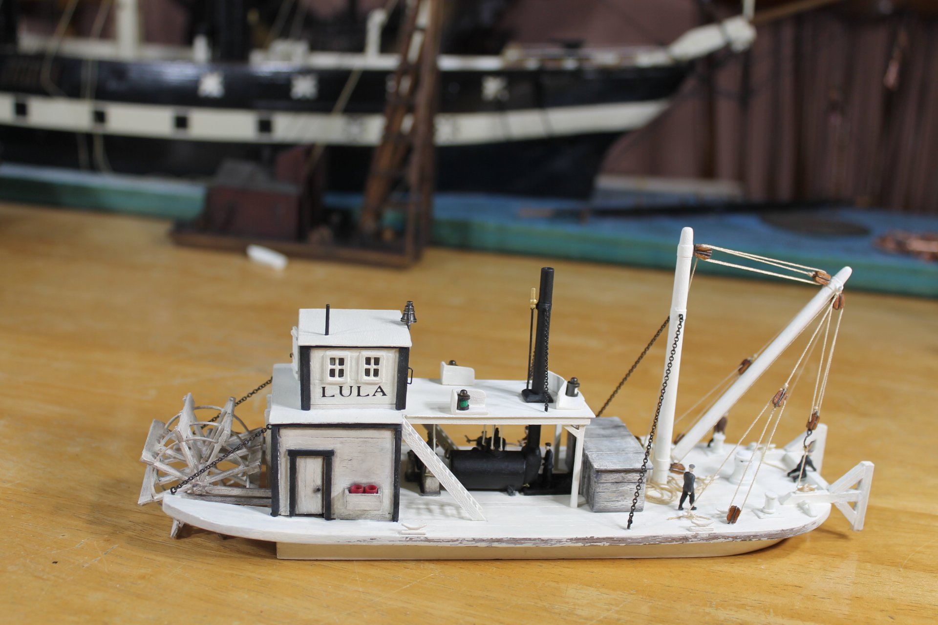

4 hours ago, wefalck said:
Sorry for having tread this loose ... you could run a pair of chains (or solid bar stays) from the forward end of the canopy over the boiler further forward, say towards a point at the hull left and right of the mast.
 Too much is in the way plus Lula is getting to be a delicate little thing.  Now, I hold my breath each time I pick up Lula to work on her.
 Eric, I think you and I are both envisioning the same thing and I agree with you. It's the easiest solution to the compromised situation I've created.

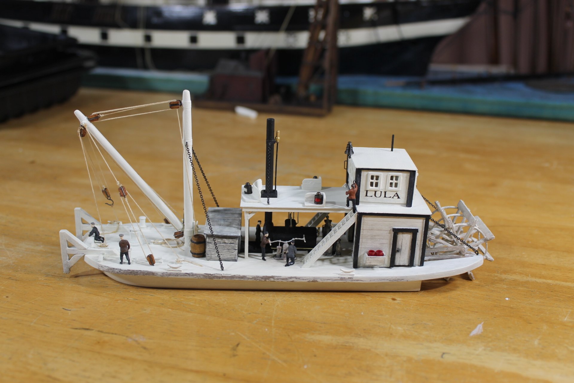

 All this all brings up a question I've had regarding the hog chains running from the ends of the cylinder timbers up and over the length of the hull anchoring at the bow..... on some sternwheelers. Not all sternwheelers had that lengthy hog chain run.
 It would seem that the lengthy run was unnecessary for just cylinder timber/wheel support? Was there another reason for that run the full length of the vessel? Was it also intended as a lighting rod or some other reason? As I said, not all sternwheelers were built that way so it doesn't seem as if it was totally necessary or all would have been built the same.
Well, the 'hog-chains' are there to prevent exactly that, the 'hogging' of the boat. It has the same function as the girders/trusses on a bridge above the way. Shallow hulls without (external) keel may not have sufficient strength against bending/hogging, so they need these trusses in the same way a girder-bridge needs them.
These trusses are not necessarily chains, but could be iron rods or connected wooden beams. A girder structure of wooden beams could be hidden in the constructional arrangements of superstructure without being so obvious as in the old-time river-boats.
Extending the trusses/hog-chains beyond the pivotal pole of the derrick, however, could limit its range of movement. So I would doubt that in a real case they would have been extended further, though from a mechanical point this would be advantageous.
 Thank you, Eberhard. The reason is obvious after your explanation as to the why.
 Lula's a bit different in that her hull construction is different. Lula's hull is built around a large water tank so she can deliver water to the pile drivers.
Can you show an example? To the best of my knowledge, and as wefalck implies, this was an integral part of steamboat structure (stern or side wheel) and not easily dispensed with. They're sometimes not easy to see, but until the development of metals hulls were pretty essential. They keep the lightweight hull structure from essentially folding up like an origami construction and so have to run most of the length of the hull. I've never seen a traditional stern or sidewheeler that didn't have longitudinal hog chains and often latitudinal ones as well.
Now, to be more specific, that's true of RIVERboats, because they needed shallow, lightweight hulls to navigate shallow river conditions, and so couldn't afford the hull bracing typical of marine vessels. Your original Lula was indeed a riverboat with hog chain bracing, but your modeled Lula is a harbor vessel with less concern about draft, so you could also assume that it has a stronger hull than the typical riverboat.
