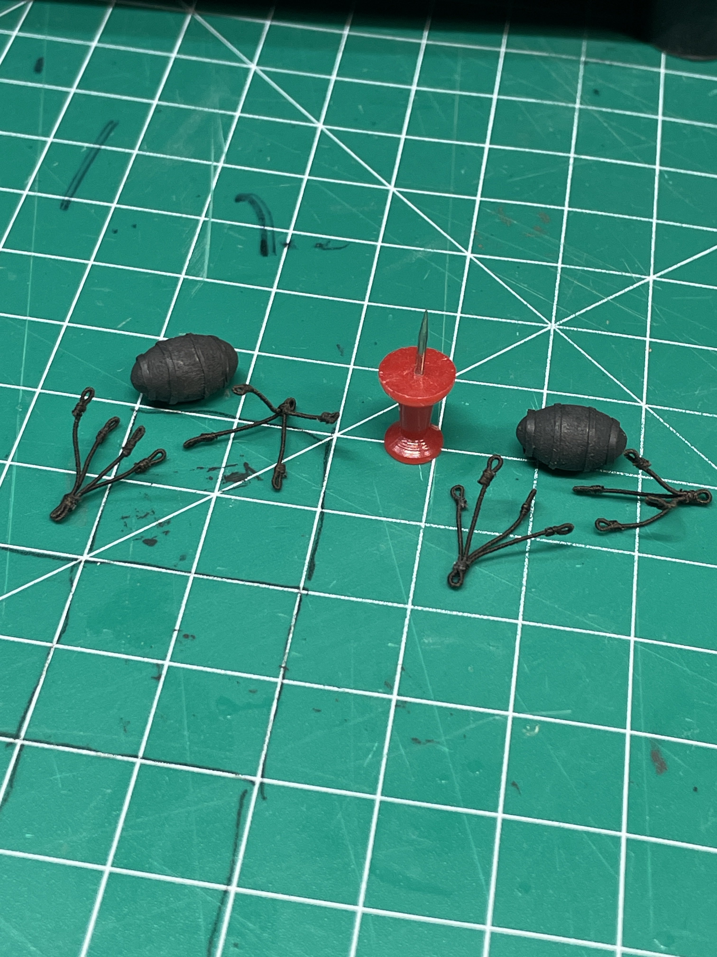

I decided it was time to install the cannon ball racks. I decided I would paint them red. I copied a little jig I saw here in order to keep them at a consistent height of 3mm above the deck.

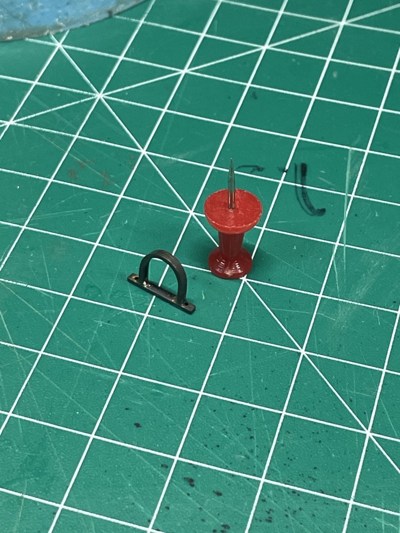

I also made an additional one as I saw in the other builds mentioned. I blackened the hinges later.

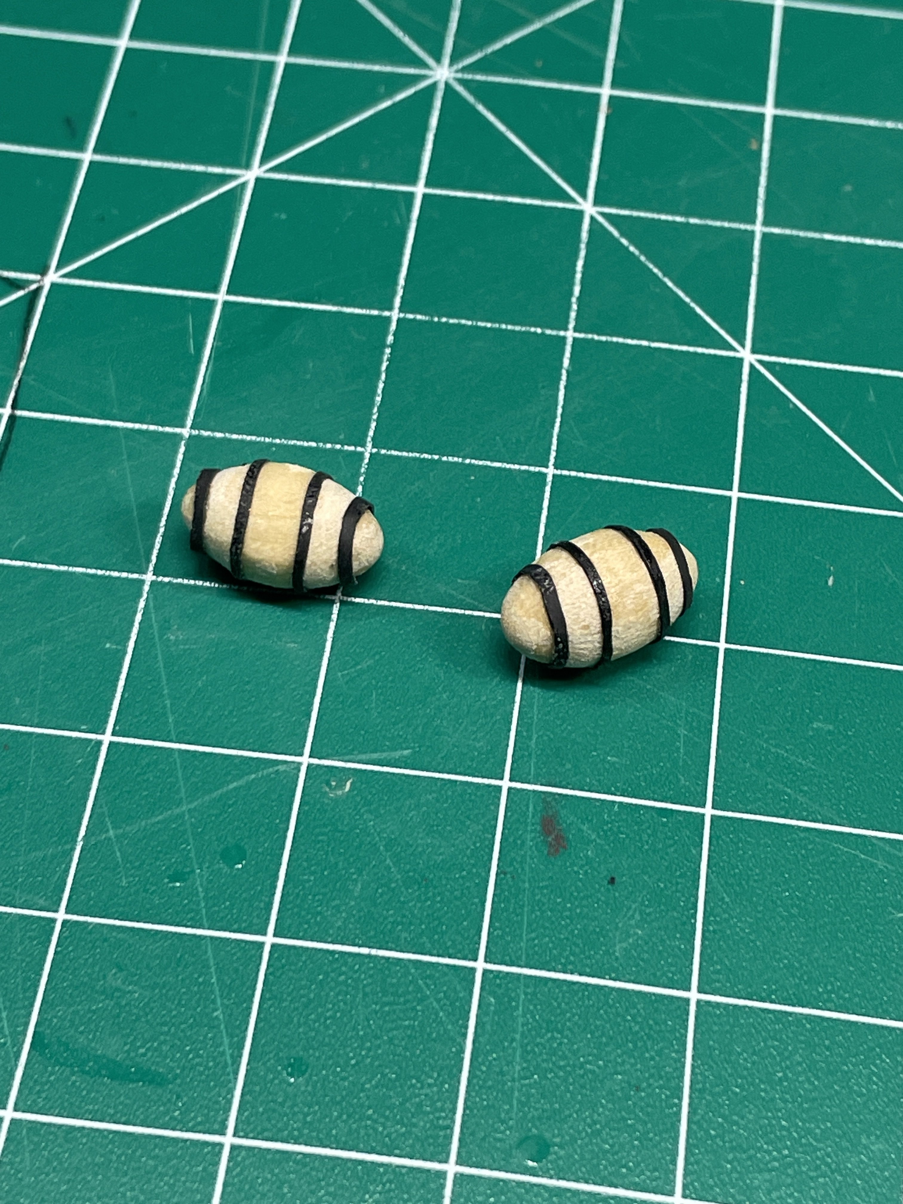

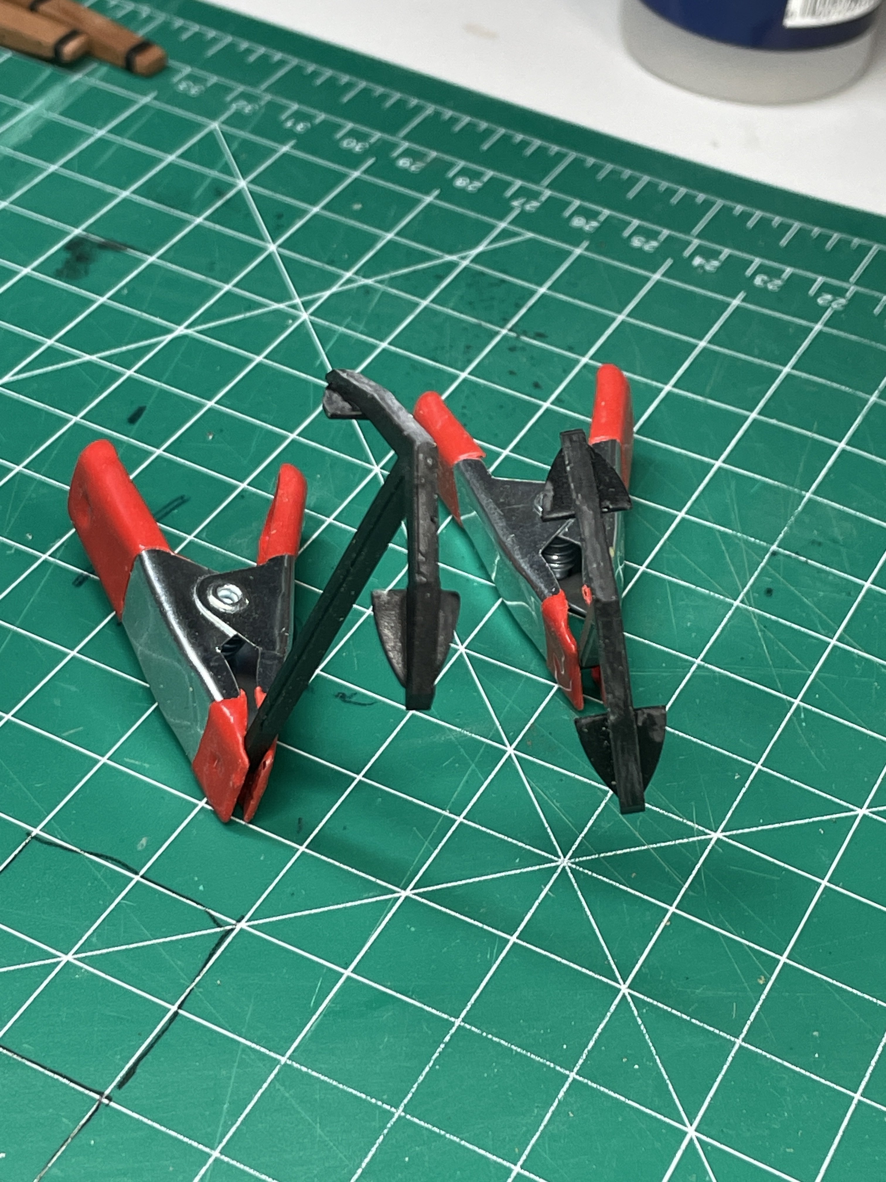

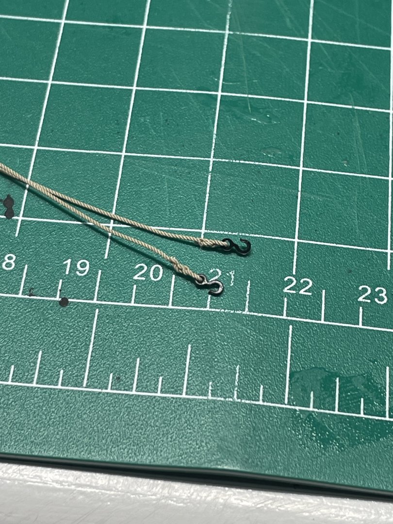

In the absence of available hooks, decided to make my own. Since I was worried they would not be small enough and be too long overall I decided to insert the hooks into the blocks and wrap the base with thread to make the seizing. First I drilled all the blocks on one end then inserted a wire to ensure I didn’t fill the cross holes with glue. Glued the hook with CA. These are 3mm blocks.
I did these in two batches, the first batch I didn’t blacken first. That was a mistake. But I learned.
**BTW** Chuck @ Syren now has 3d printed hooks available again! I got some but they will have to be for the next one…
I think it was on Blue Ensign’s build log where he mentioned to try to keep them under 6mm overall. This is what I ended up with.

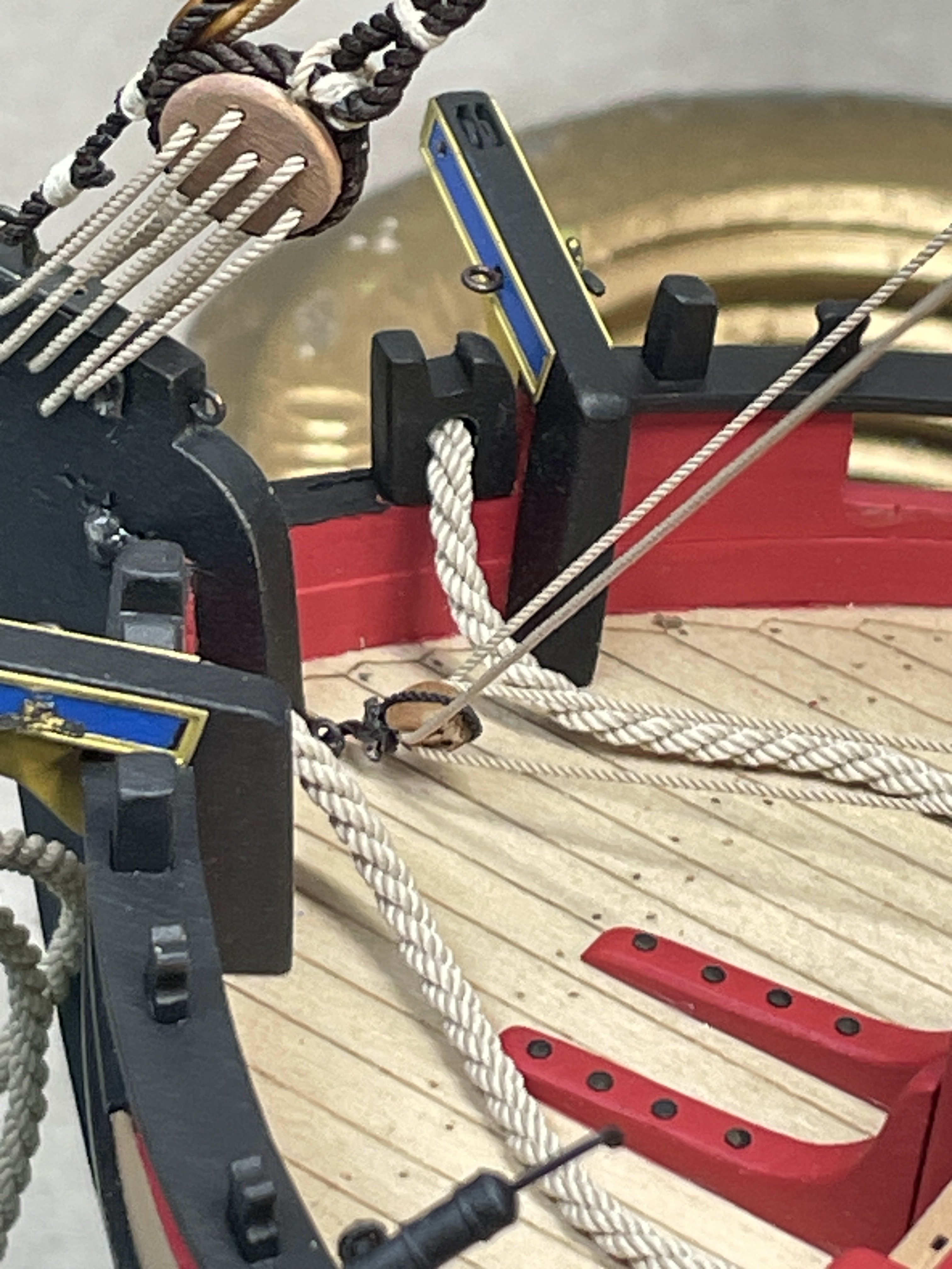

Now it’s time to start the cannon tackles. If I am ever using incorrect terminology on any item. Please kindly correct me.
First I rigged up the mock up in order to measure the distance between the hooks. I don’t have all the fancy books that many others have so I just have to use their information. So I weigh the instructions and build logs together, plus what I think looks pleasing.
From the mock up I made a marking jig, it is asymmetrical to make way for the racks of cannonballs. I just had to mention terminology so the the name for those would fly out of my head…
*Hint drill these holes wayyy before to permanently glue the deck furniture down. Just saying. (Especially the ladders)
Drilling the racks is probably way easier before they are installed also….just a thought.
I started to rig up the tackles on a jig to hold it still. The shorter one is for the shorter tackles.
And the coils. I used watered down matt varnish on the rope after using CA to get it in place.
And here we are in place. I used medium CA to hold things down. Later it will get sprayed with Vajello acrylic matt varnish to get rid of any shiny spots.

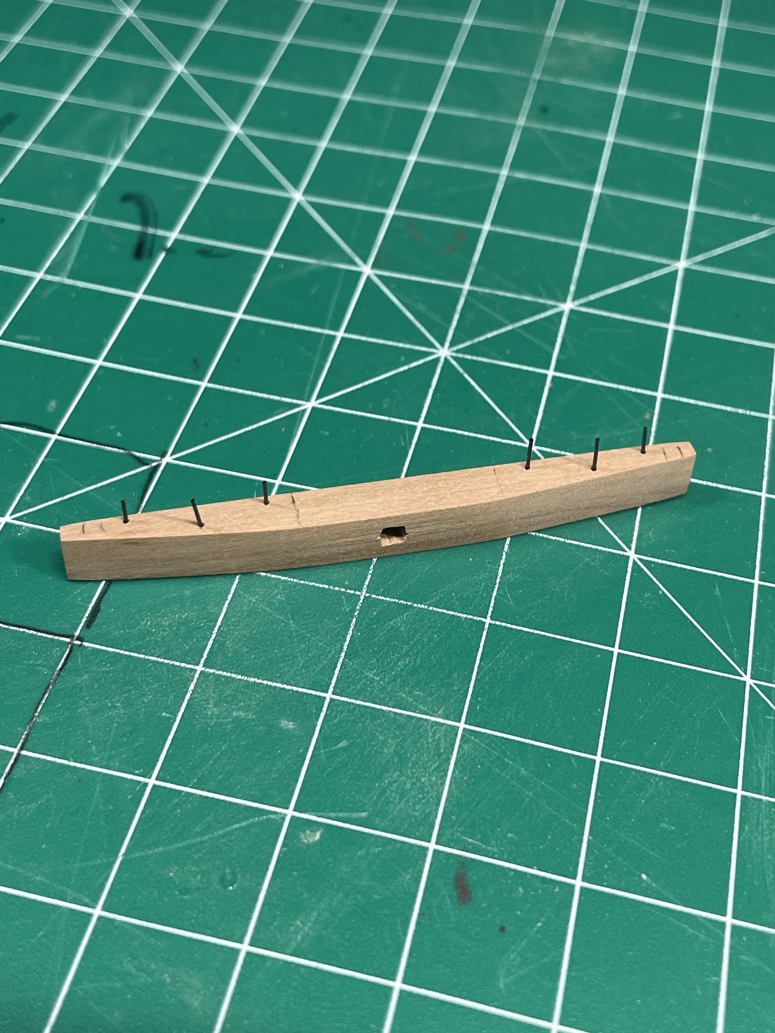

I completed the trestle trees and cut out the flat areas for the cheeks and even tree nailed them in with some toothpicks. You can’t really see the treenails after painting, I wish they showed up better. Any tips on that?
**Note to future builders. Don’t put this all together until after you have done the shrouds.

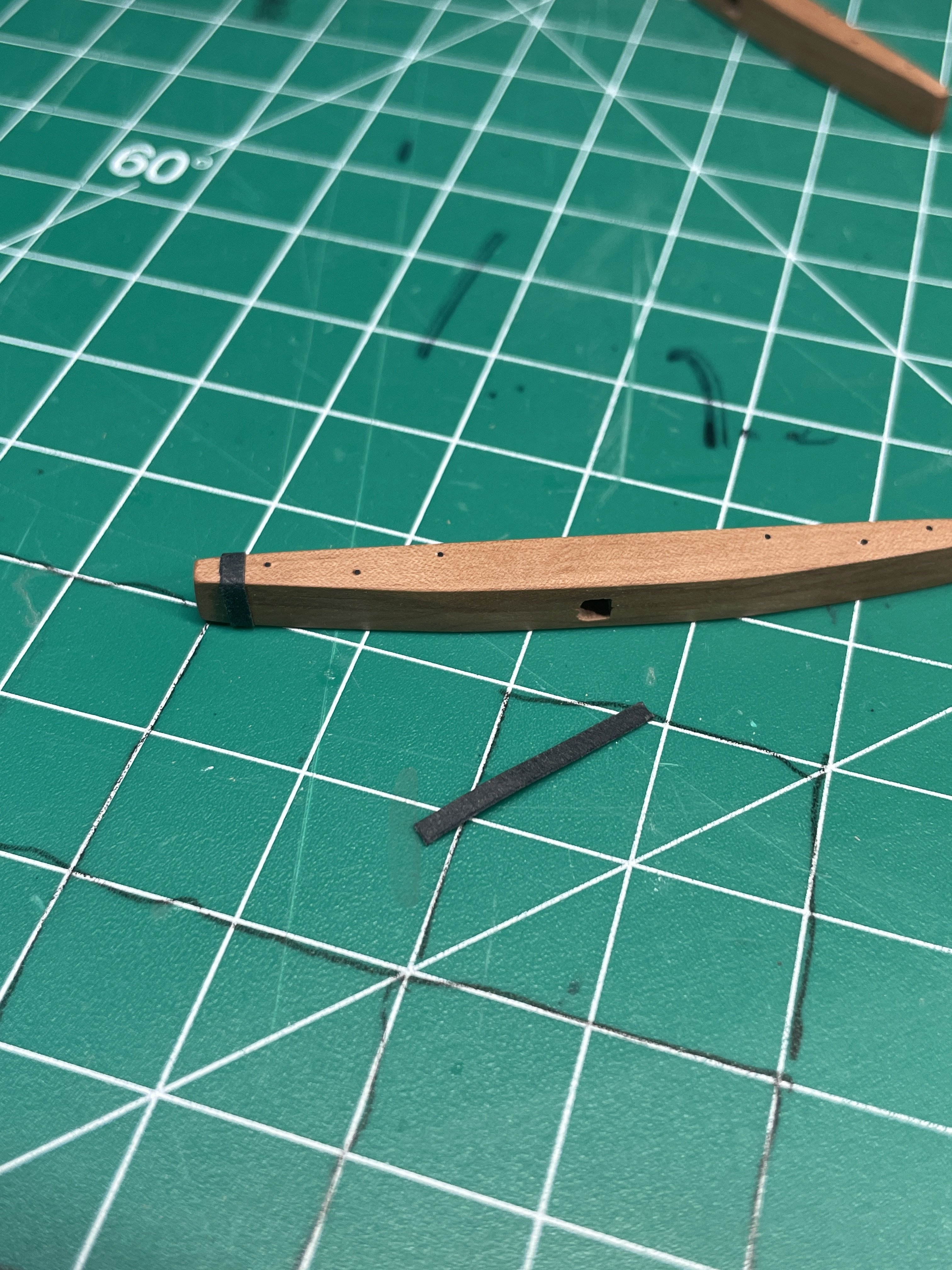

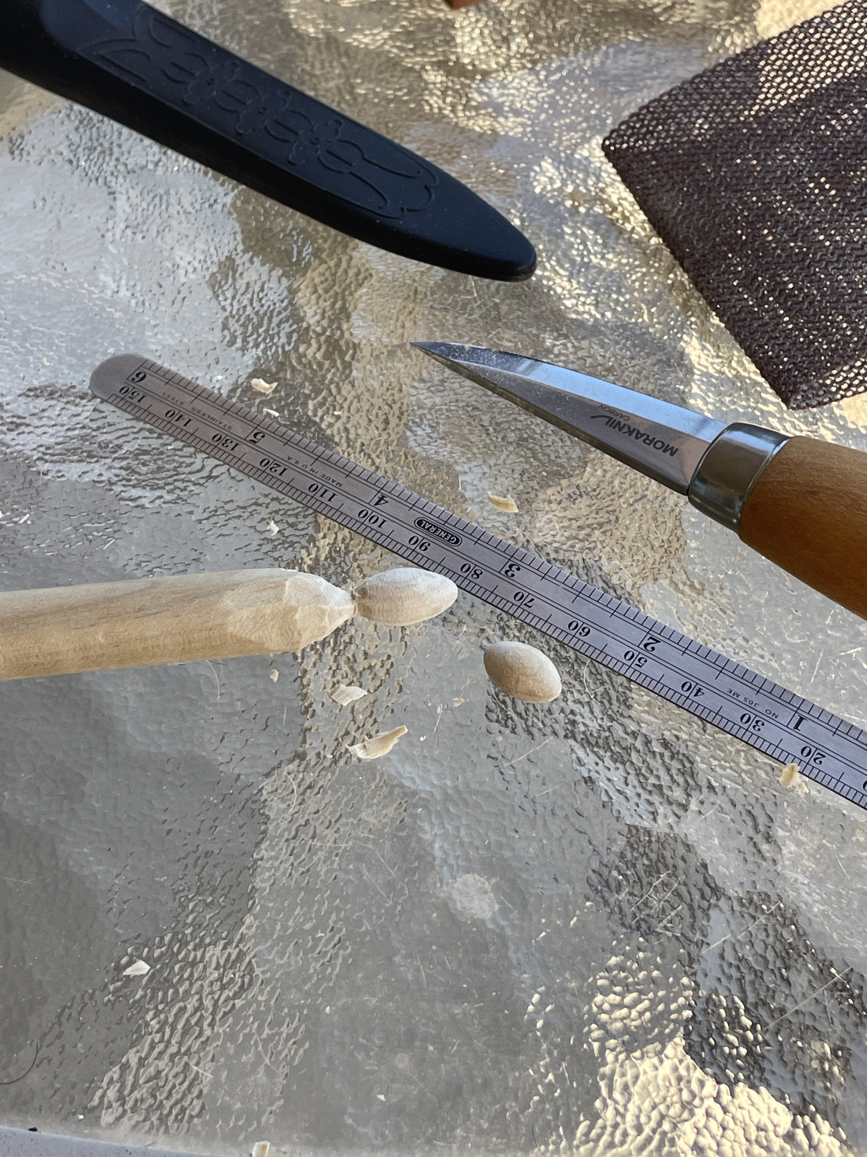

I shaped all the yards with a variable speed drill and some sandpaper. After marking them out from the plans I would make some notes on various dimensions along the length, then I would roughly followed that. I would grab my calipers and sit on the porch and make sawdust. Thank goodness for Arizona weather.
I would start with 100 grit and get the rough taper then 180 would shape it quite closely and 220 to fine tune the taper. I have to say it was pretty simple to get a nice taper on them. Easier than expected so that’s always nice.

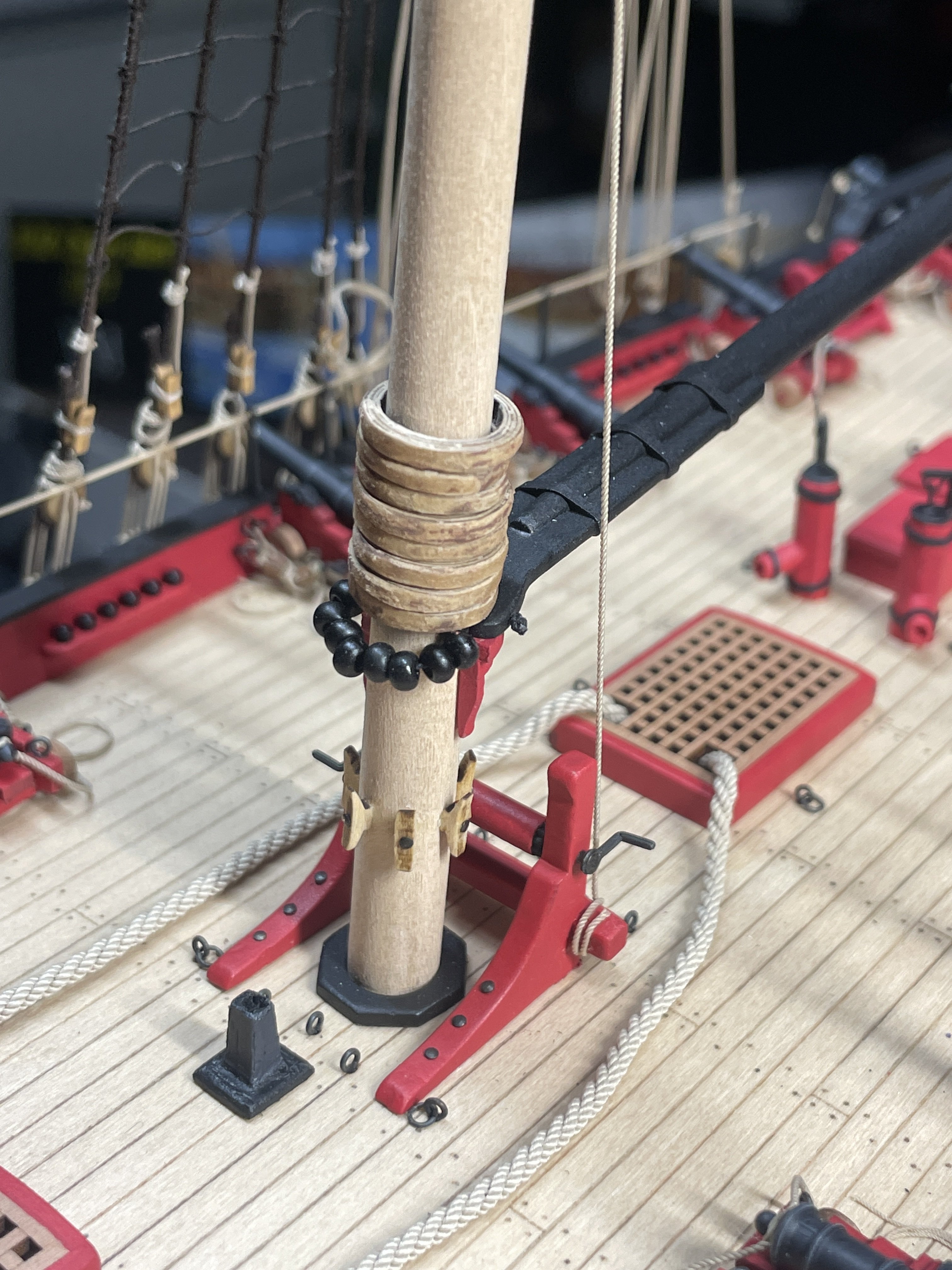

I thought I had a genius idea for mast rings once while perusing the hardware store. These small rocket engines seemed to have about a 10mm id turns out the end is kind of crushed to the clean part of the tube was too large. I did use the paper and CA and make some rings from that. I sliced some rings off then used rubber cement to glue them to the board and then sanded it face down until they were about 2.5mm thick. I then painted them but later remove it and sanded the outside flatter than I originally had it. These photos show most of the progession.

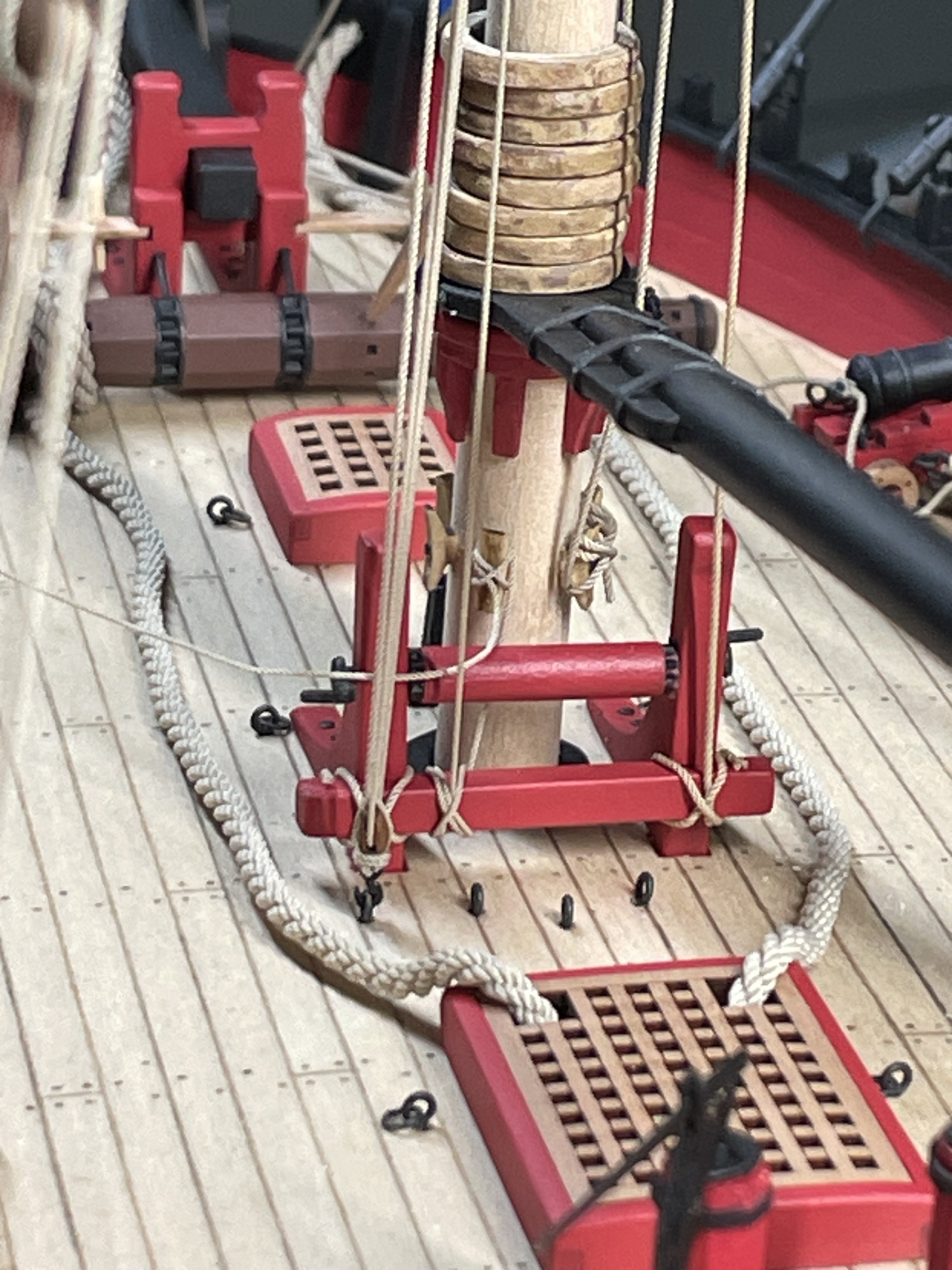

Now has the swivel guns, stanchions (sp?) and the tiller. The tiller  was epoxied and pinned. That is such a long moment arm with so little surface area, I was concerned about that joint ever giving up.
Thank you for stopping by. Next up I start some prepping for the rigging. We’re pretty close to real time now as the rigging has really slowed me down.

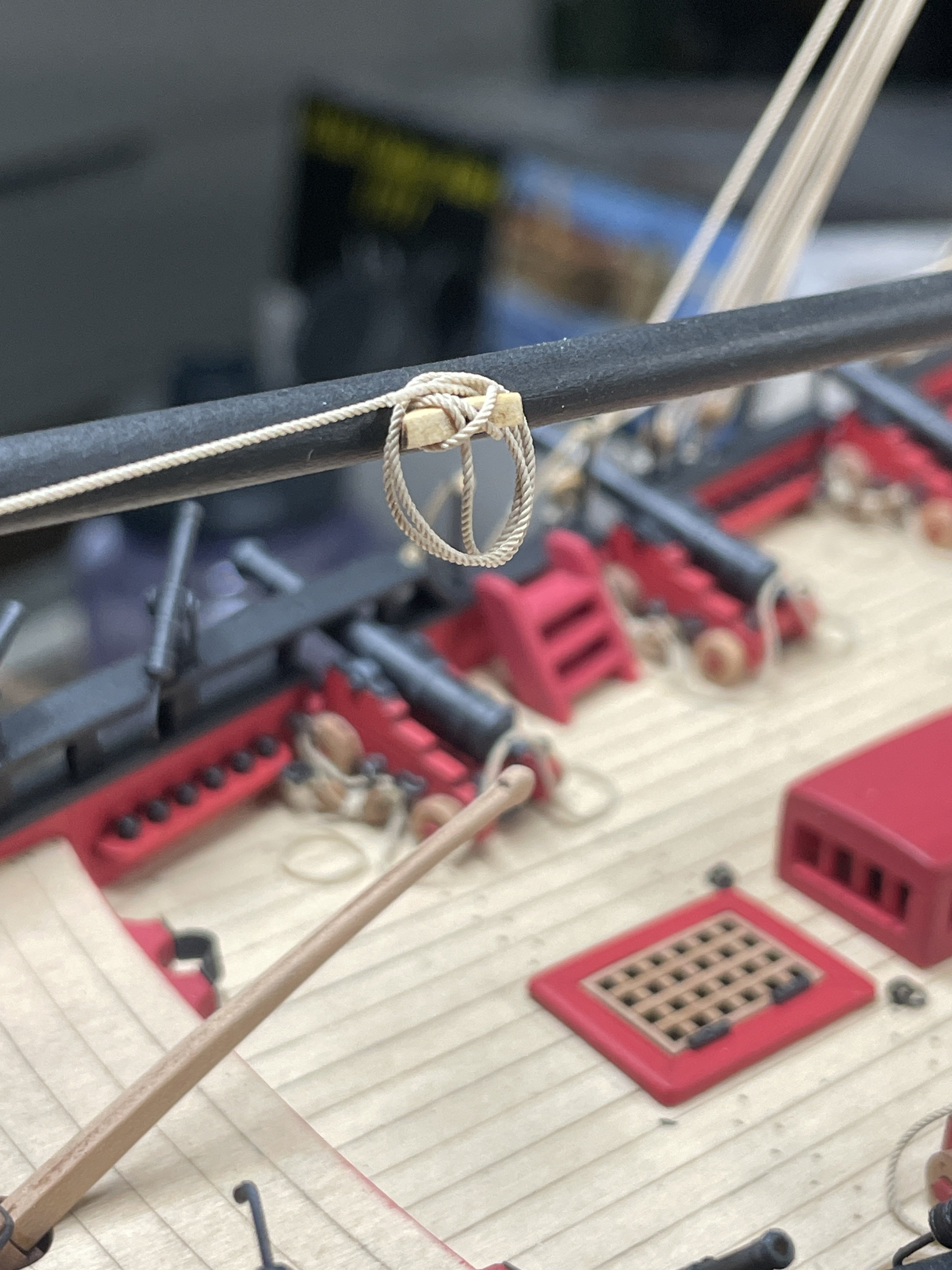

So time to learn to serve! I decided I’d set up the machine and try it. It worked really well, not a surprise. I served up what could be a pendant if it’s usable. After playing around I watched a video and learned I should have done it left to right, while I did it right to left.
The mast is together but not secured in the deck. I needed to come up with a plan to serve the shrouds on the ship. I again tried with the same pendant. I looks ok to me. We’ll revisit those later.

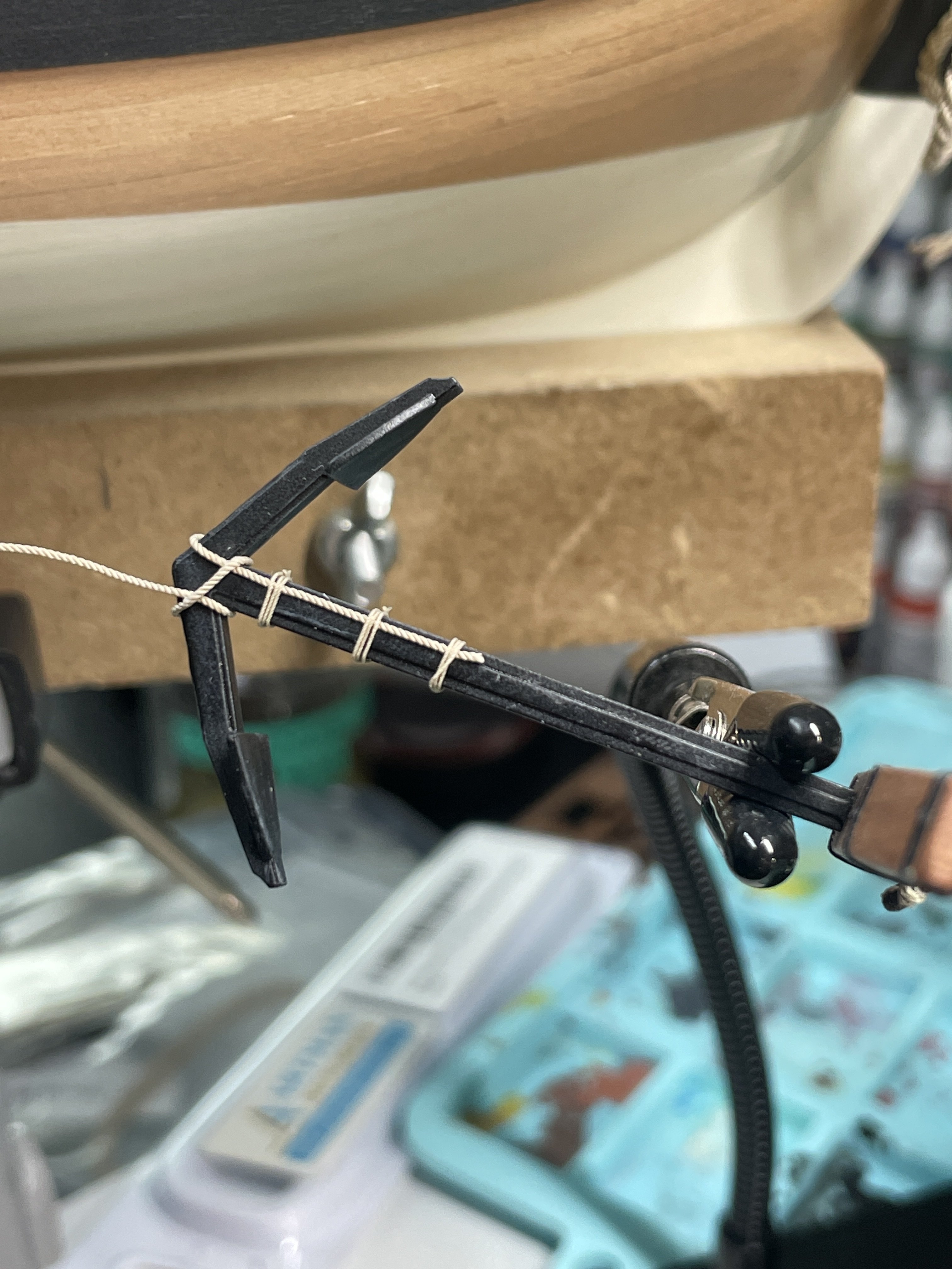

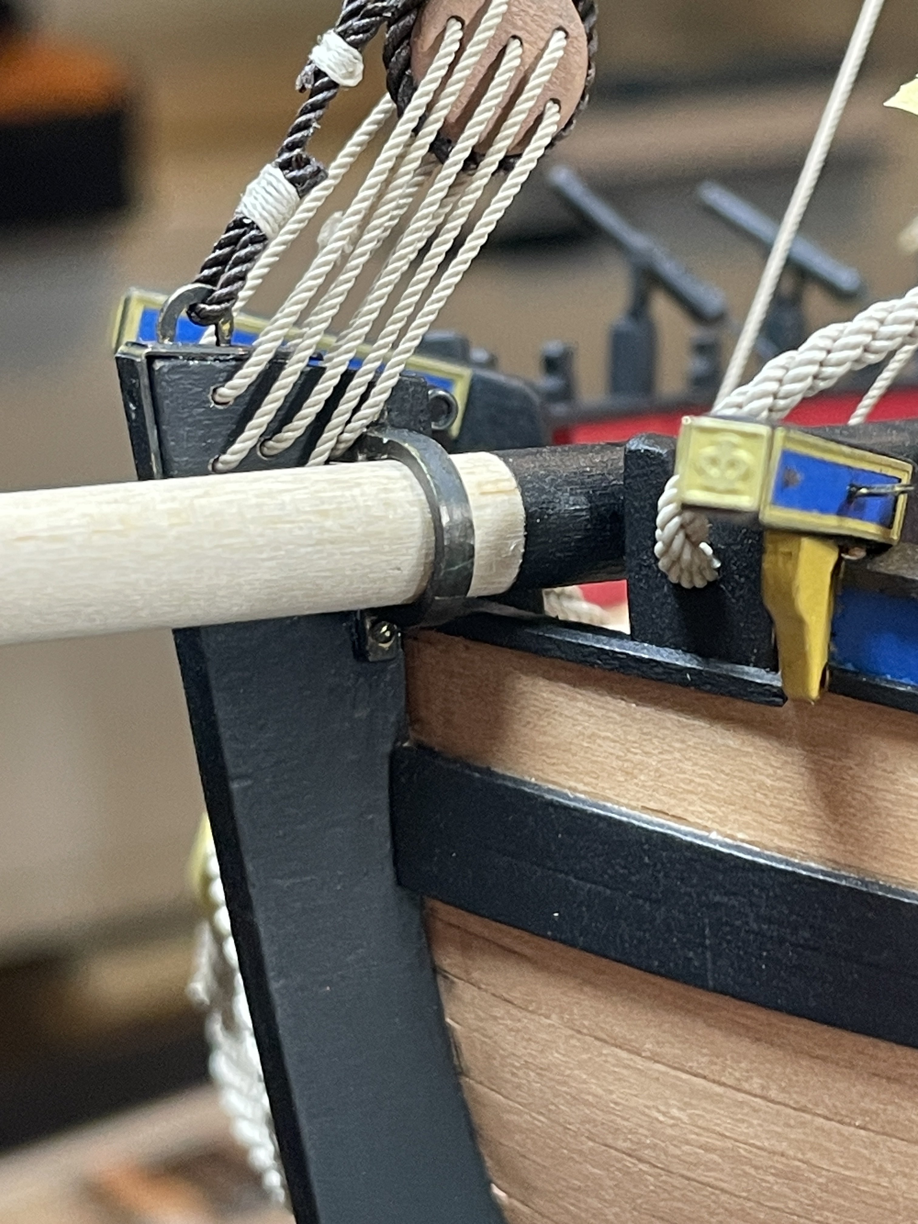

I next wanted to make a band with the rings on the tip of the bowsprit.  I used some brass tubing that happed to be a perfect fit and some photo etch eye bolts.
I also made the bracket for the bowsprit from scratch.
I can never get over how brutal close up photos are!

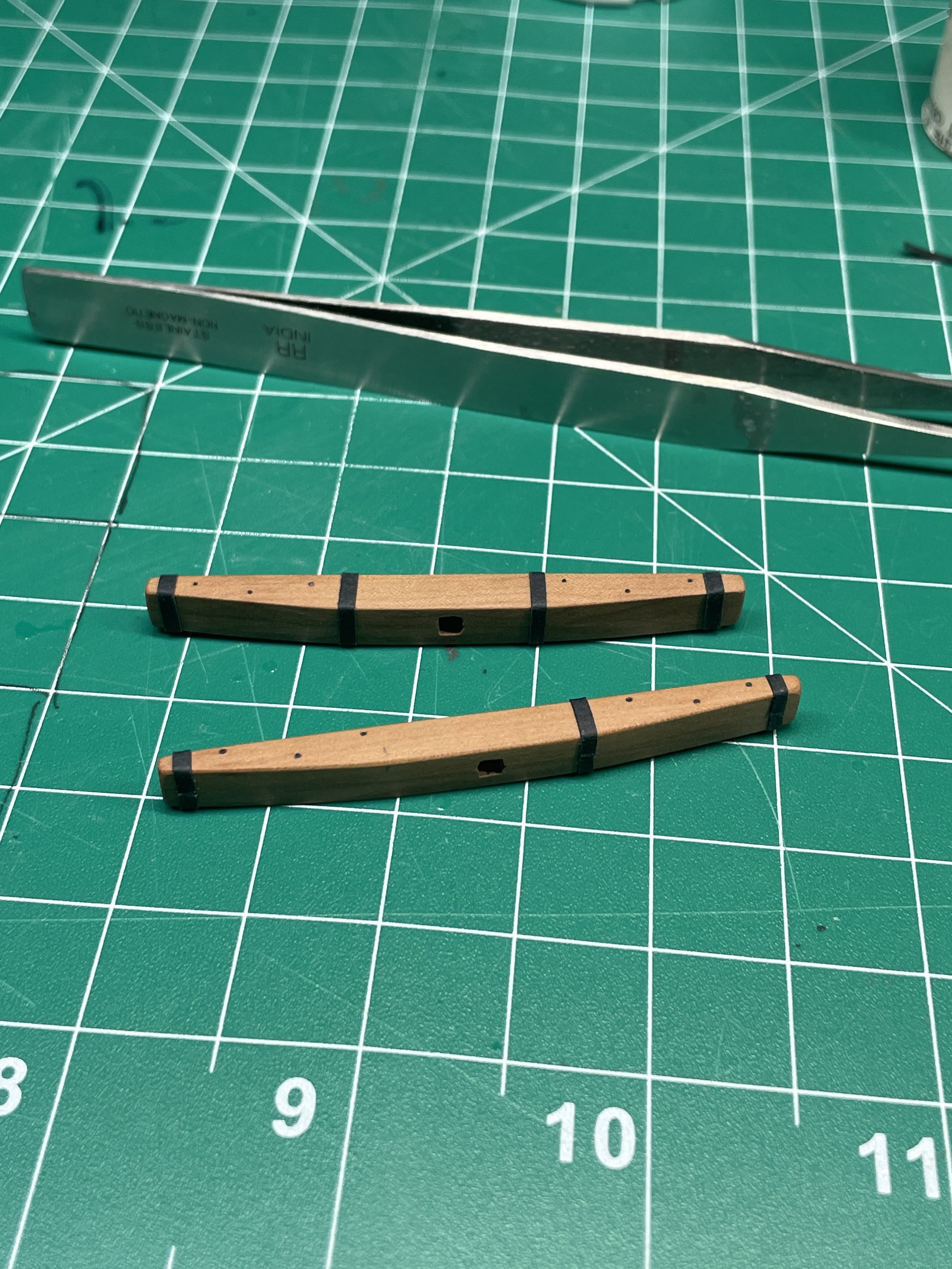

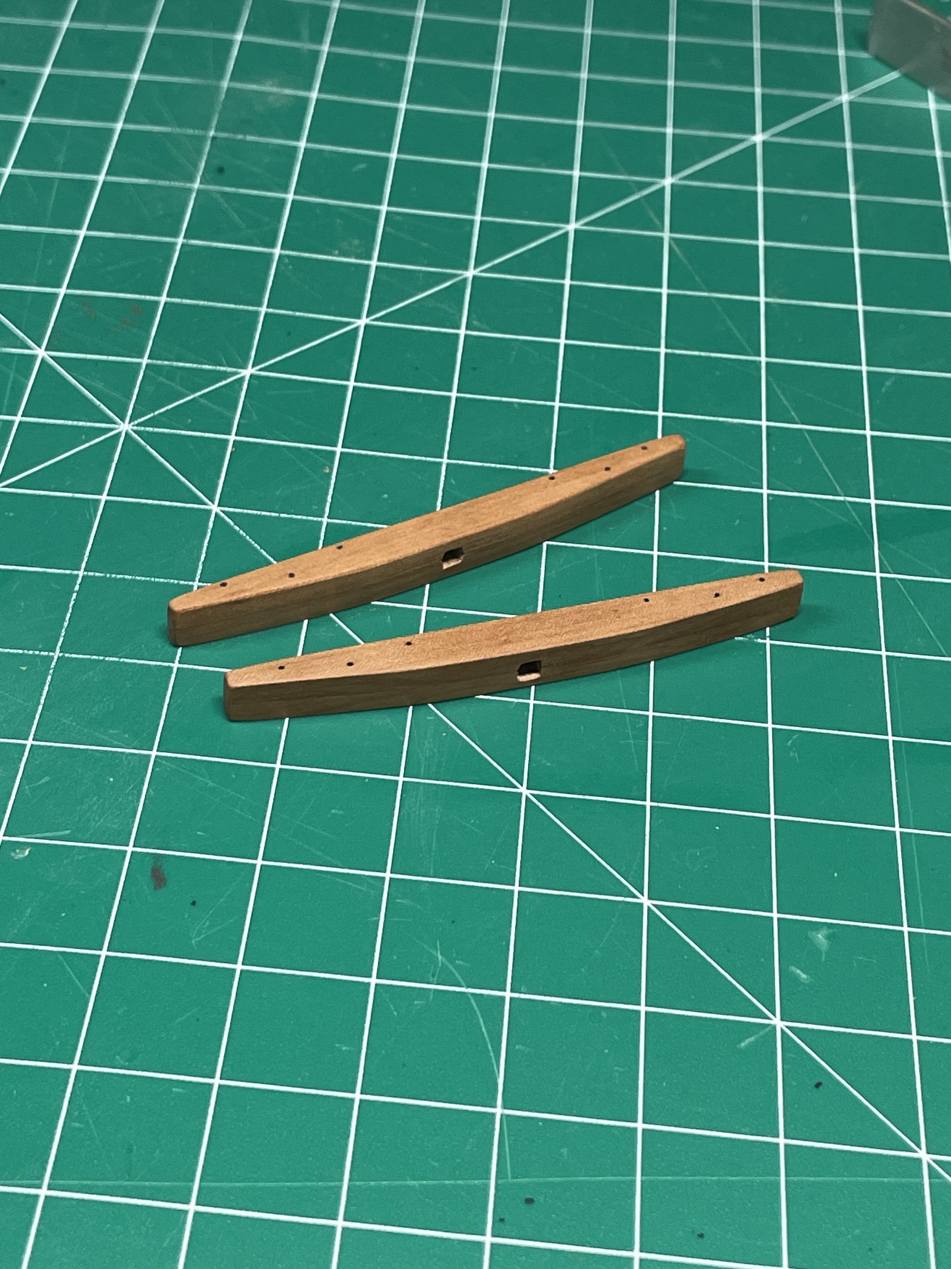

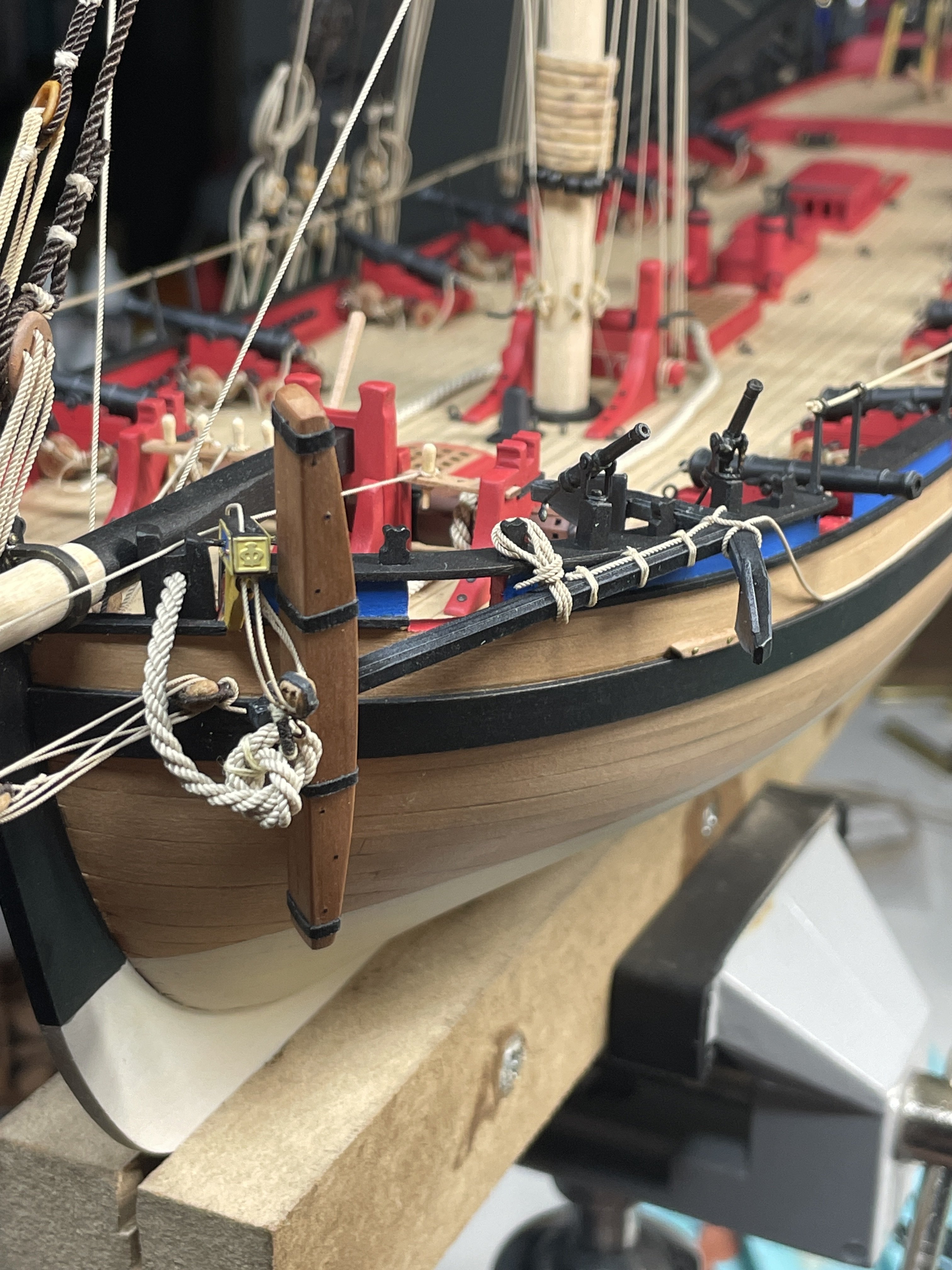

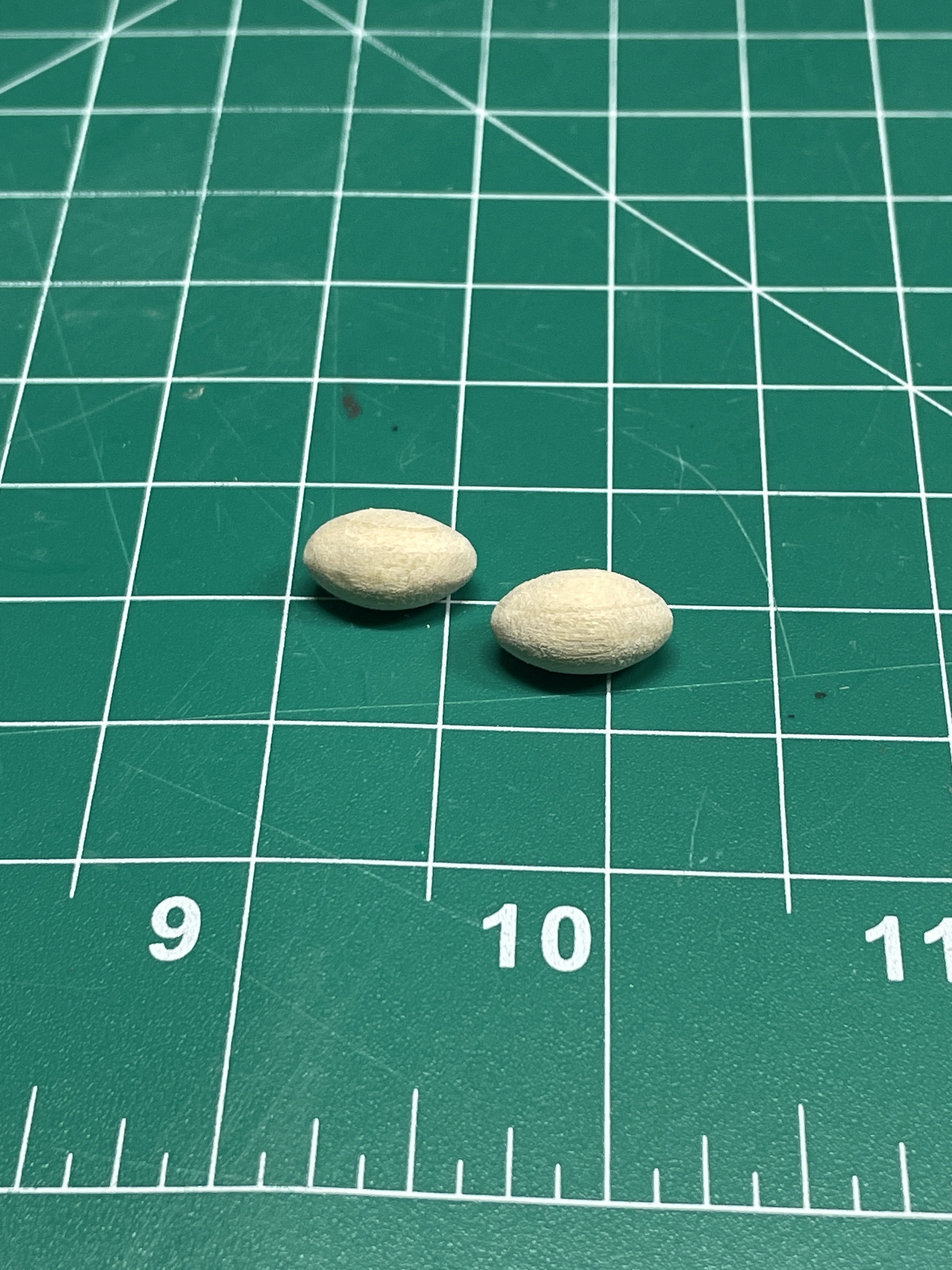

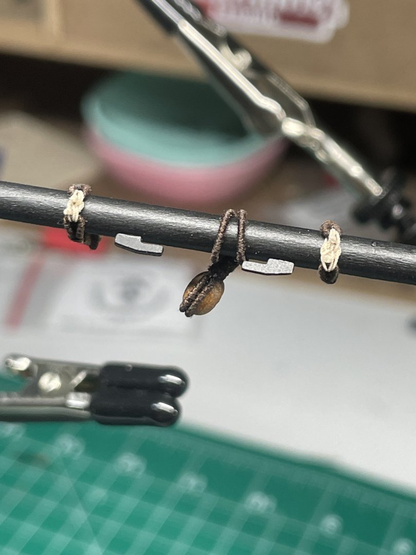

Now I was faced with a dilemma. I didn’t add any sheeves to the catheads and I am pretty sure I want one of the anchors hanging as in other build logs. So I simply decided to get going on them. Mask the rest of the ship and see what happens.
I drilled them and then used a scroll saw blade held in my fingers. I pretty much used that to shape the slots and then used a strip of 220 sandpaper to clean them up.
I used some round plastic stock and after drilling I sliced off several discs until I got 4 I could work with. Squared them up but sanding under my fingertip.
I inserted them and pinned them in place.
Then some Vallejo flat black paint.
I am pretty happy how these turned out. I will find out how they work when I get to the anchors.

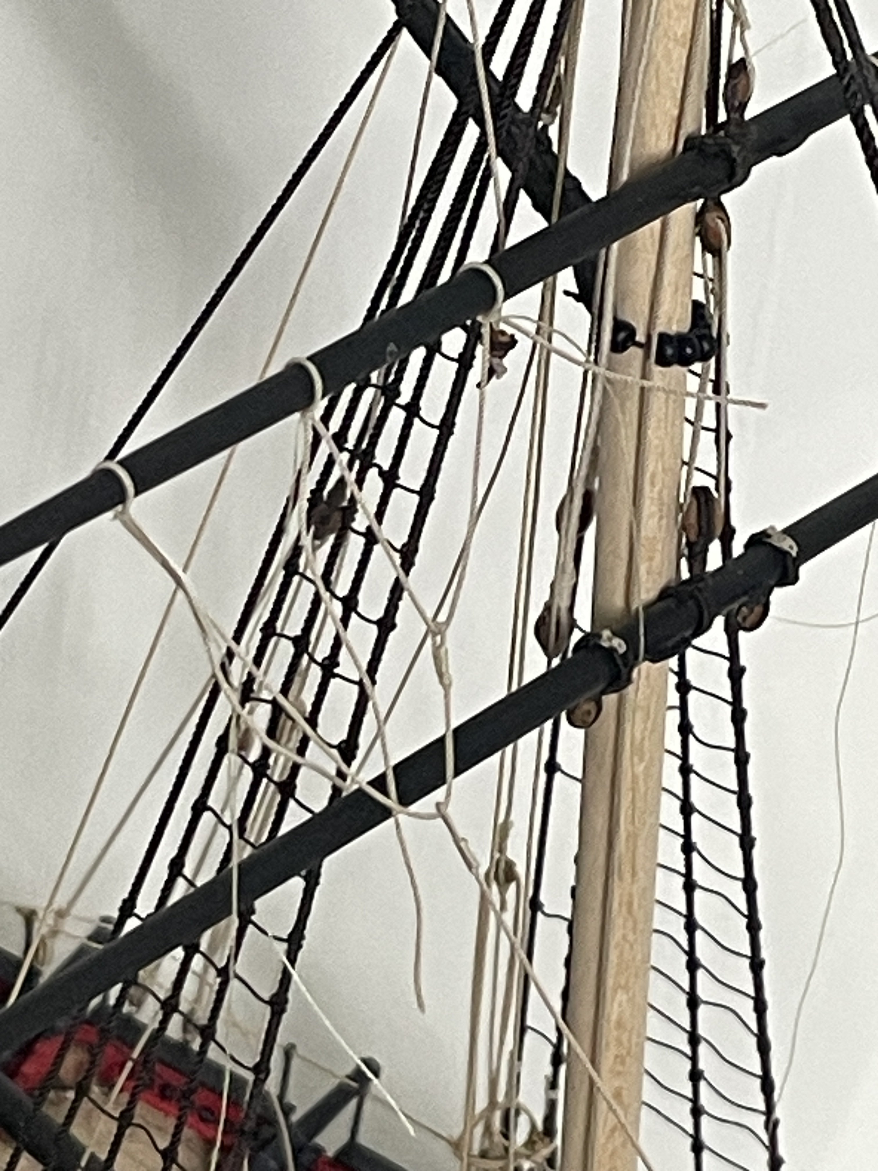

Its time to work on the shrouds. We are in brand new territory for me with all this rigging. As I’ve stated previously I’m just going to go slow and try to follow some other builds.
I believe I pointed this out earlier, but it begs to be said again. Don’t complete the top of the mast before putting the shrouds on. It will make your life much easier. At least this part of it.
As my mast was complete I had to serve the shrouds in place. I leaned my vice way over and had the mast mostly horizontal in order to do this.
Here are some photos of the serving of the ends of the shrouds.

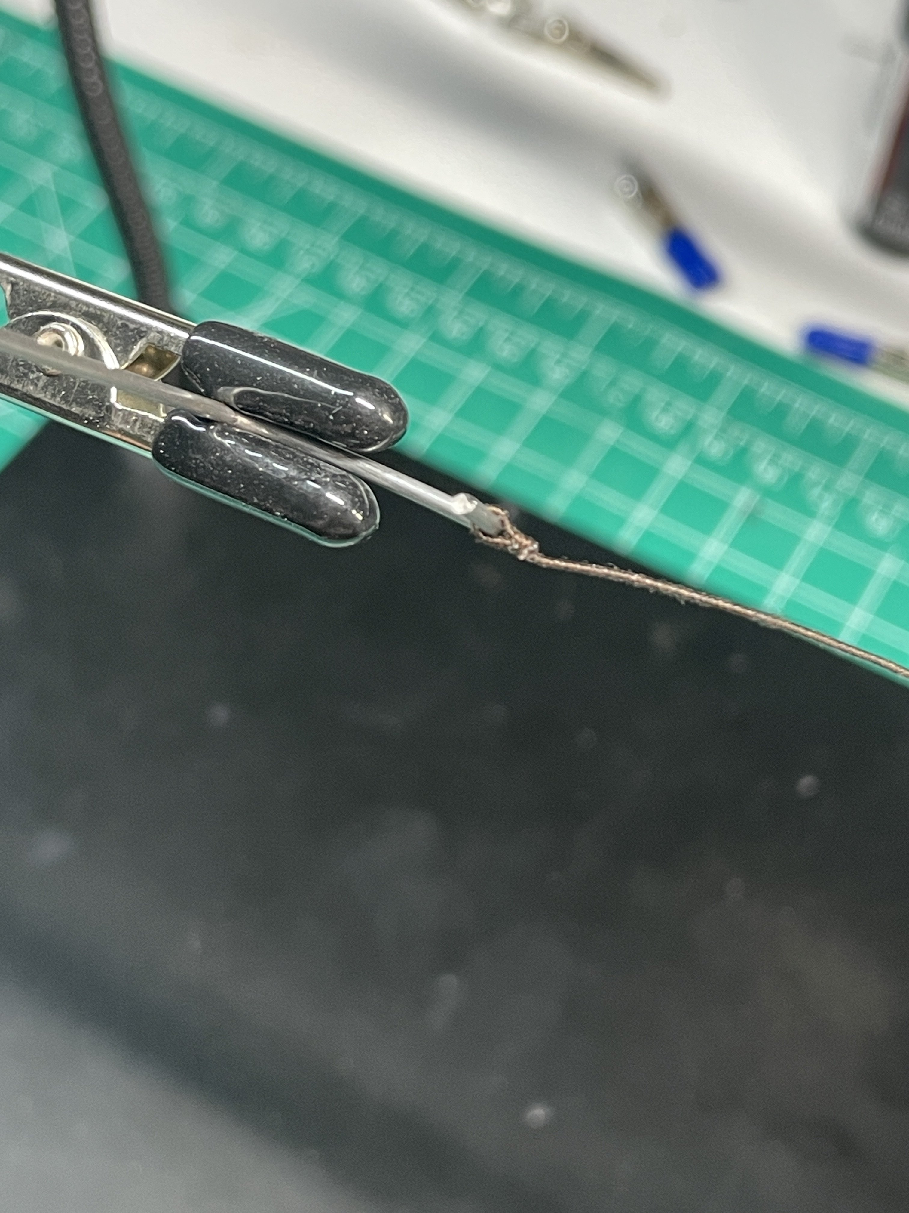

This is how I spliced the ends of the thread in. I would pull the thread through twice. Then a dab of medium ca and a quick rub with my fingers.
Here is some of the manual serving done around the mast.

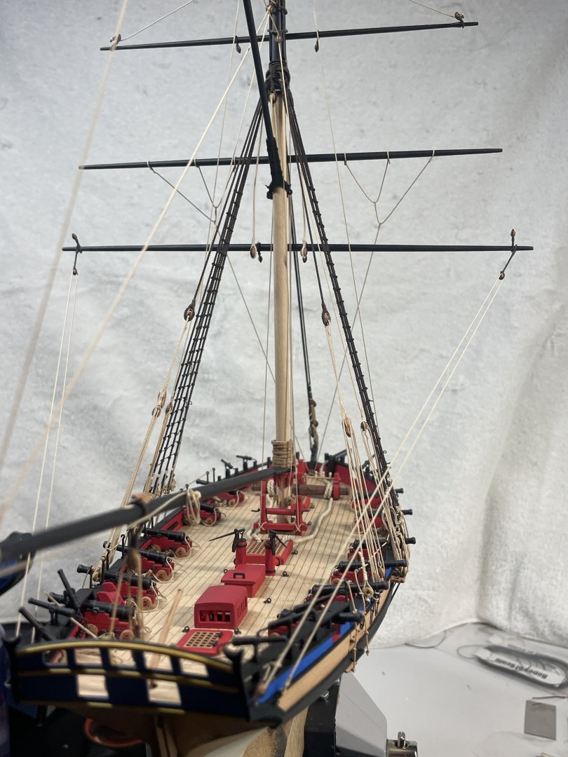

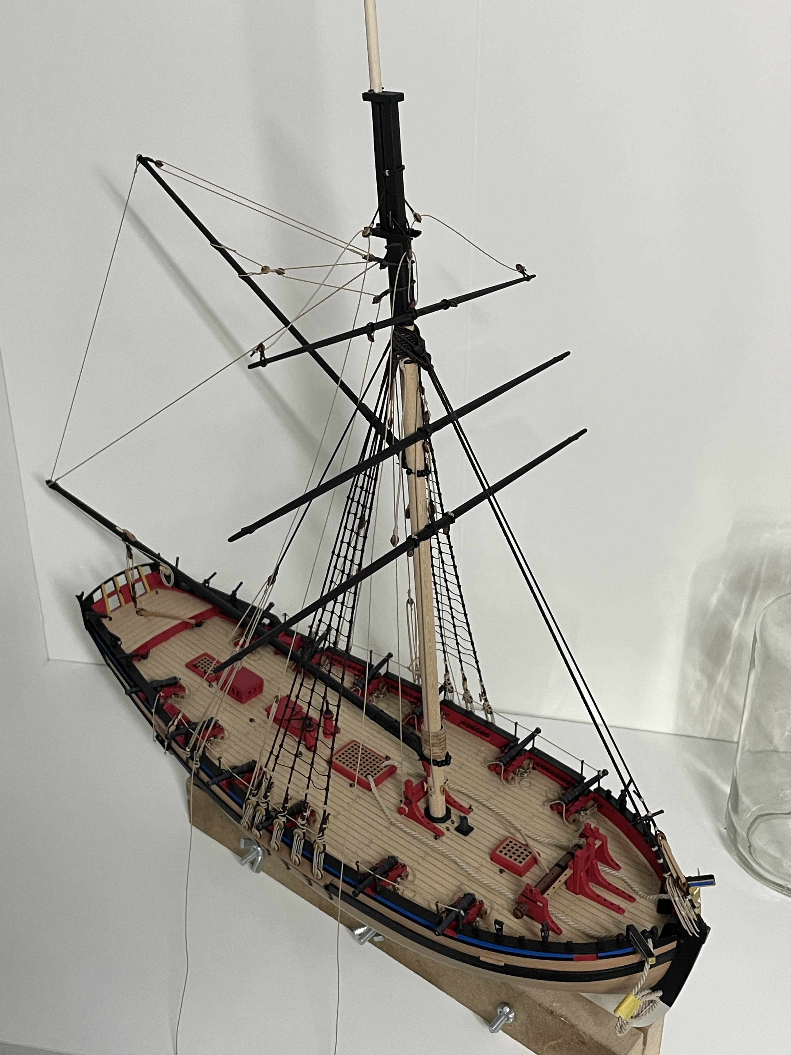

Finally, here is a glamour shot of her so far. I am quite happy with how she’s looking. She lives in an Ikea cabinet to keep dust at bay, once the bowsprit is on I don’t think she’s going to fit.

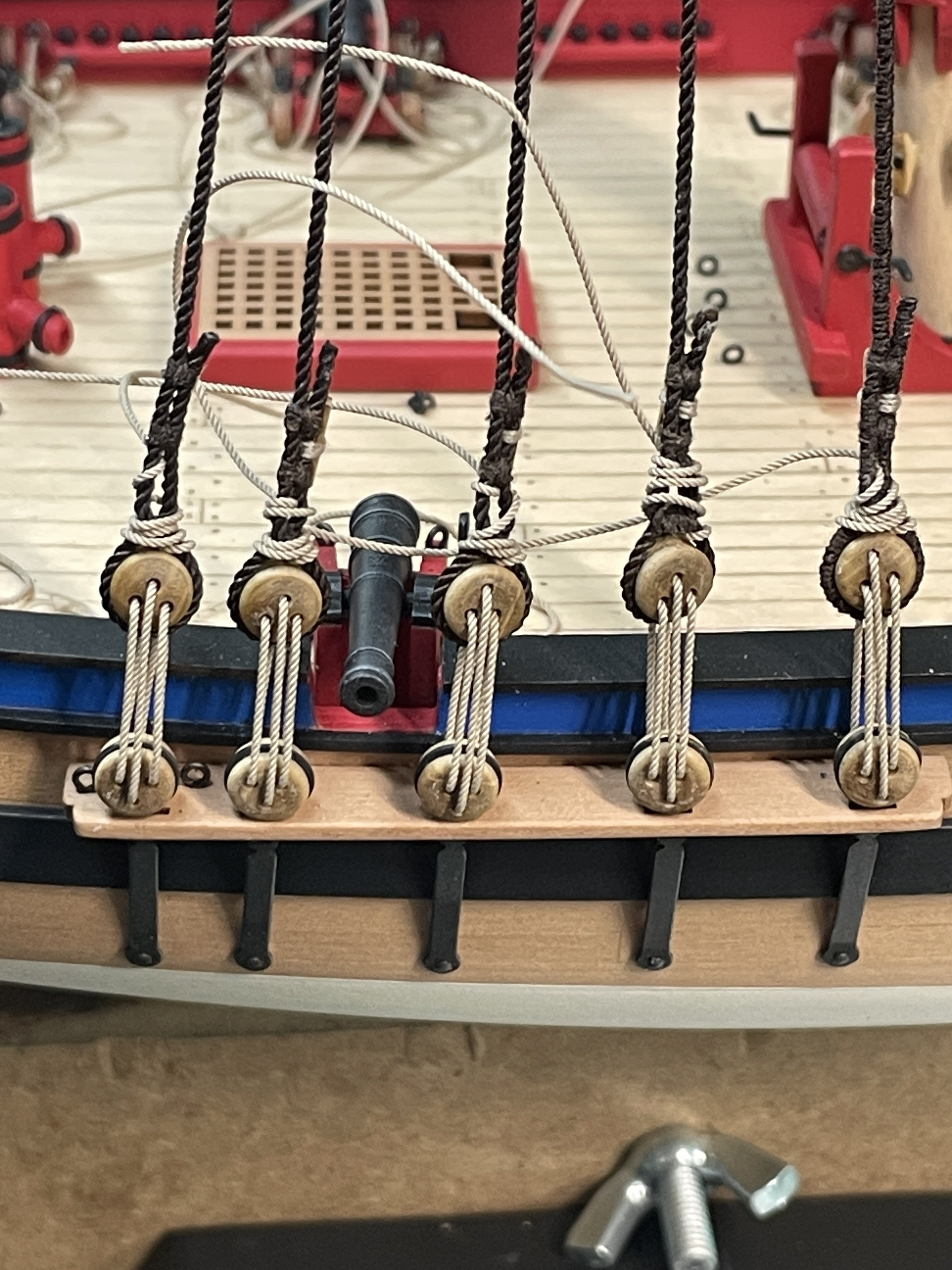

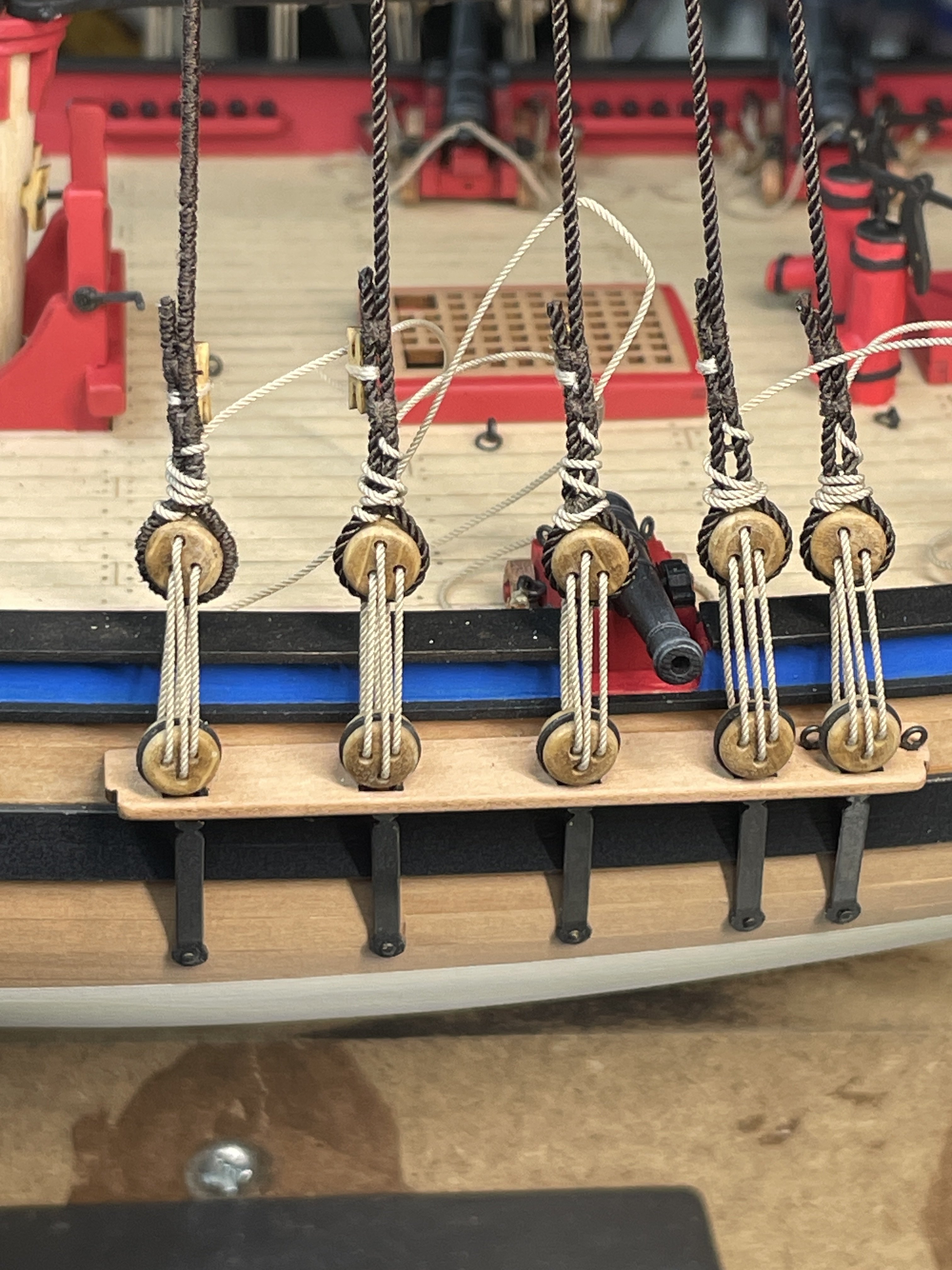

Thanks to everyone still hanging on. Work has been slowly progressing.

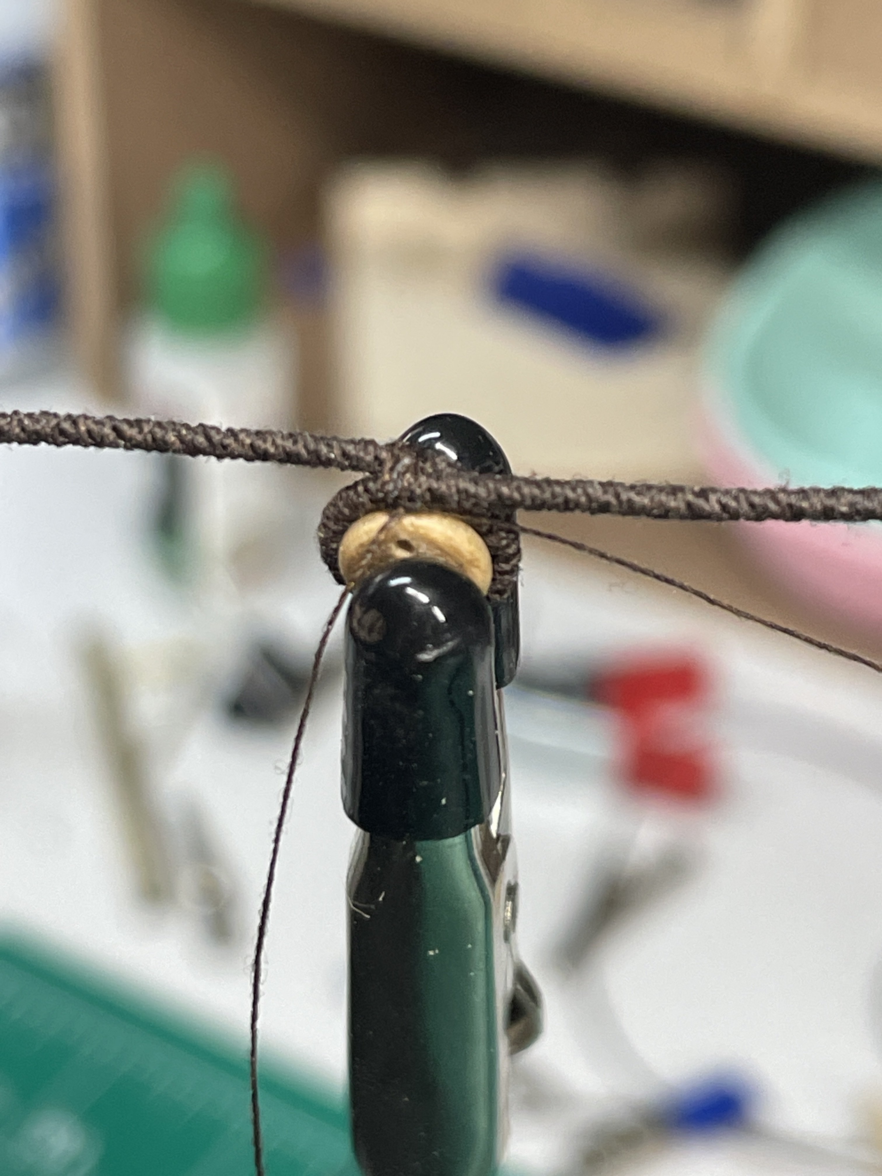

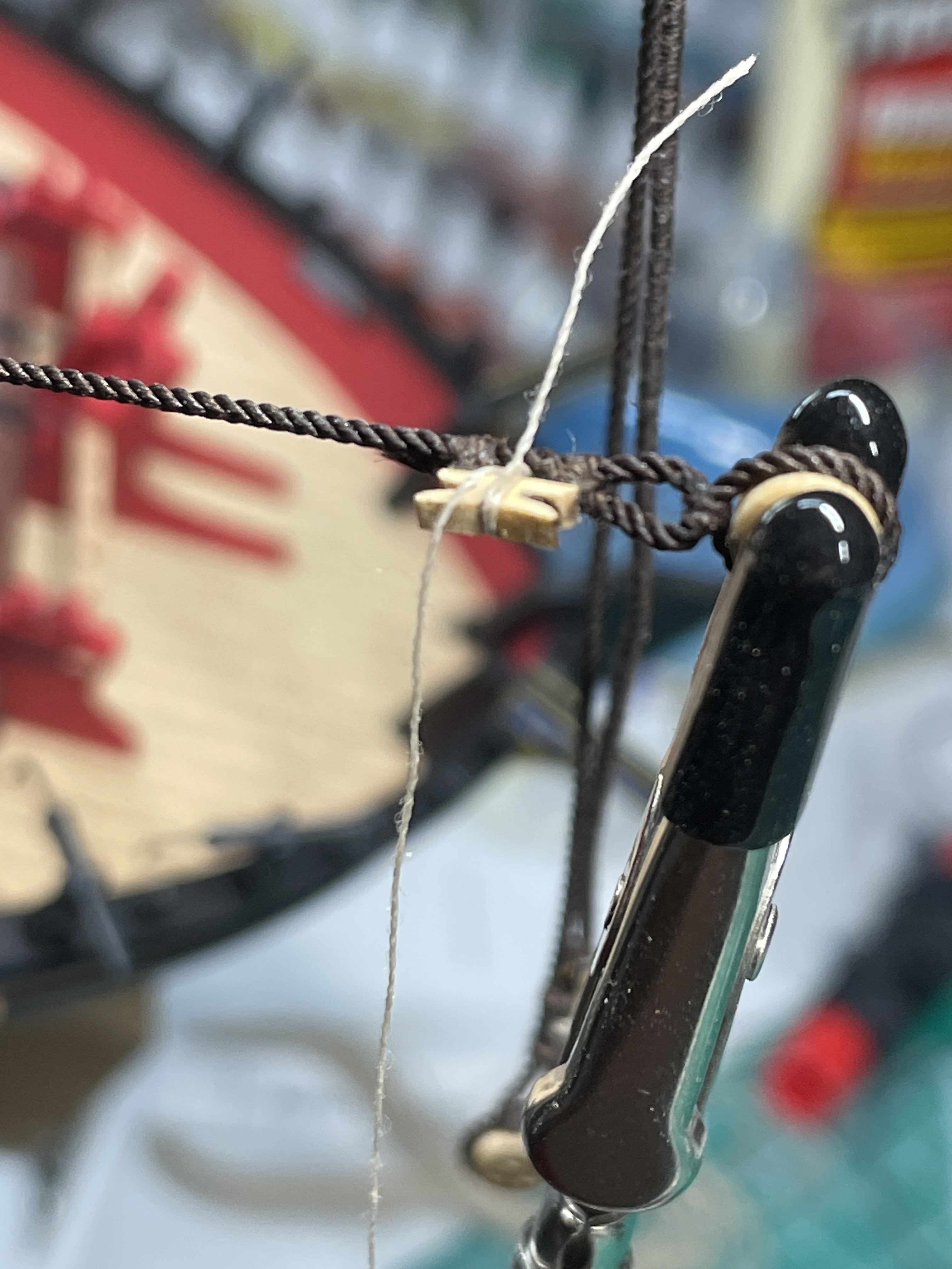

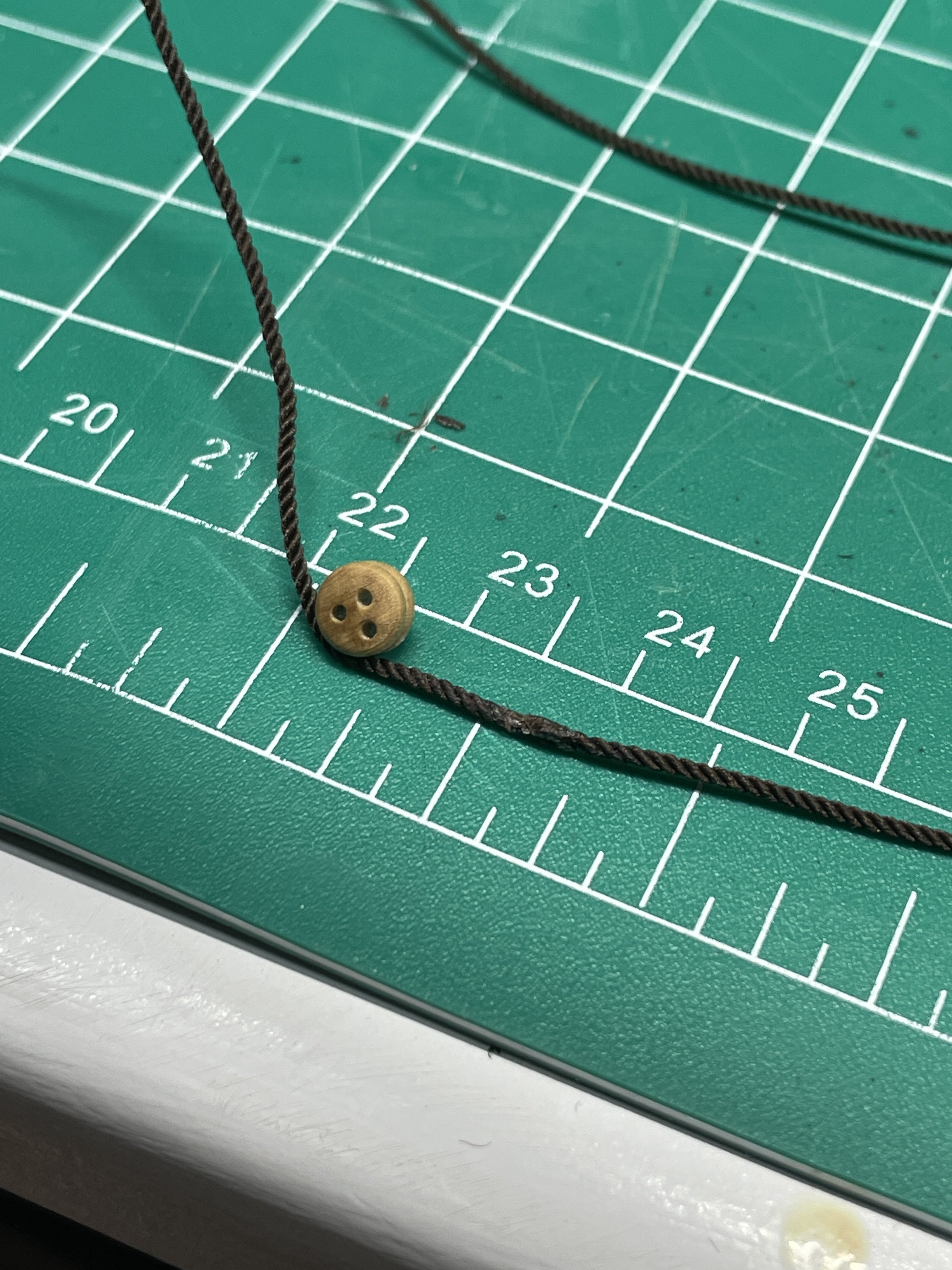

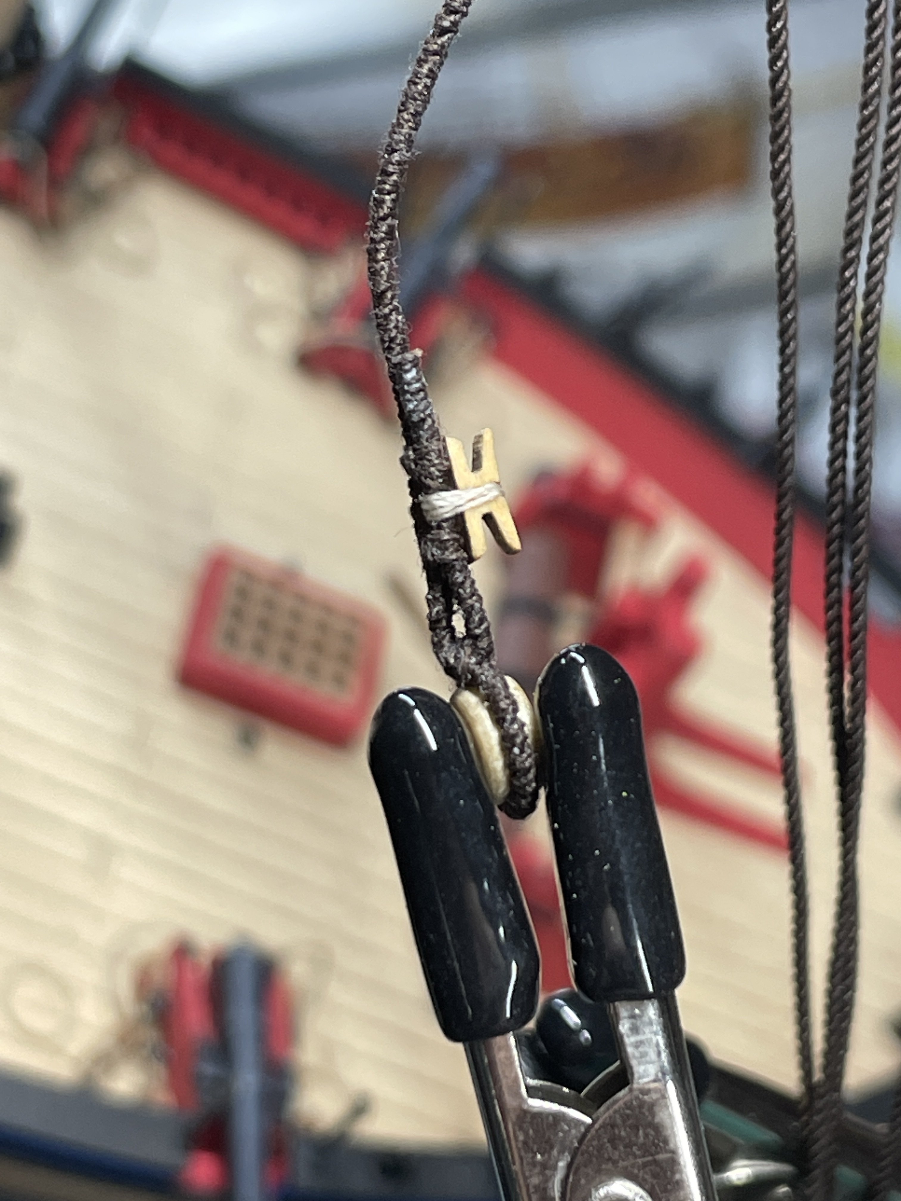

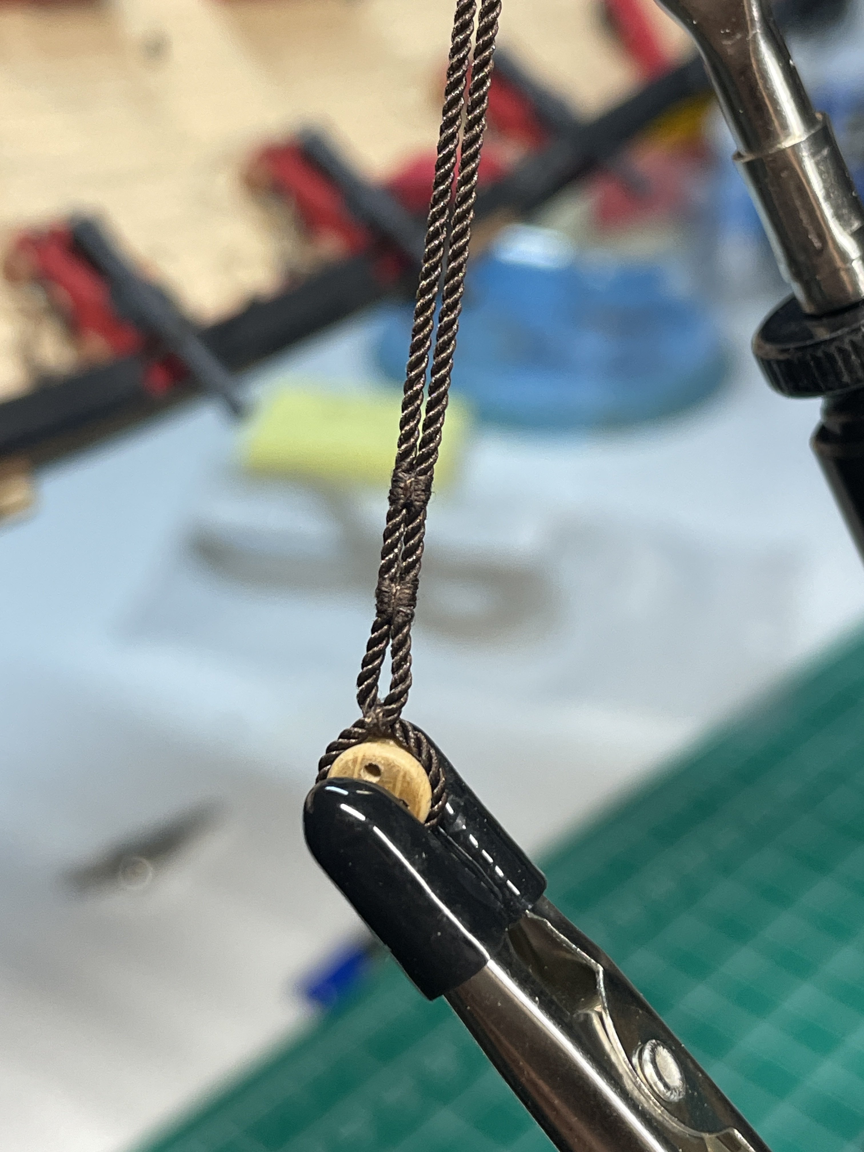

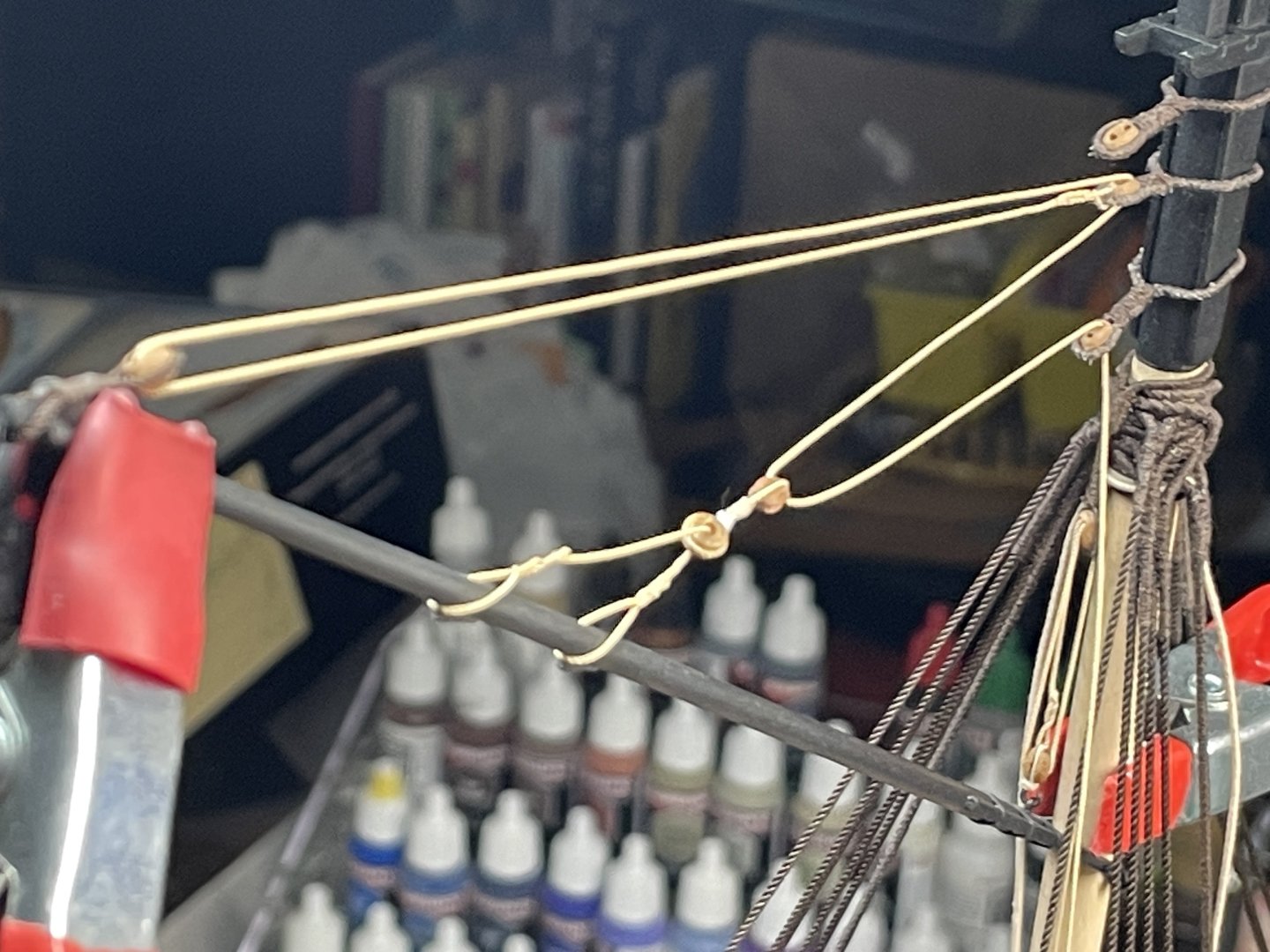

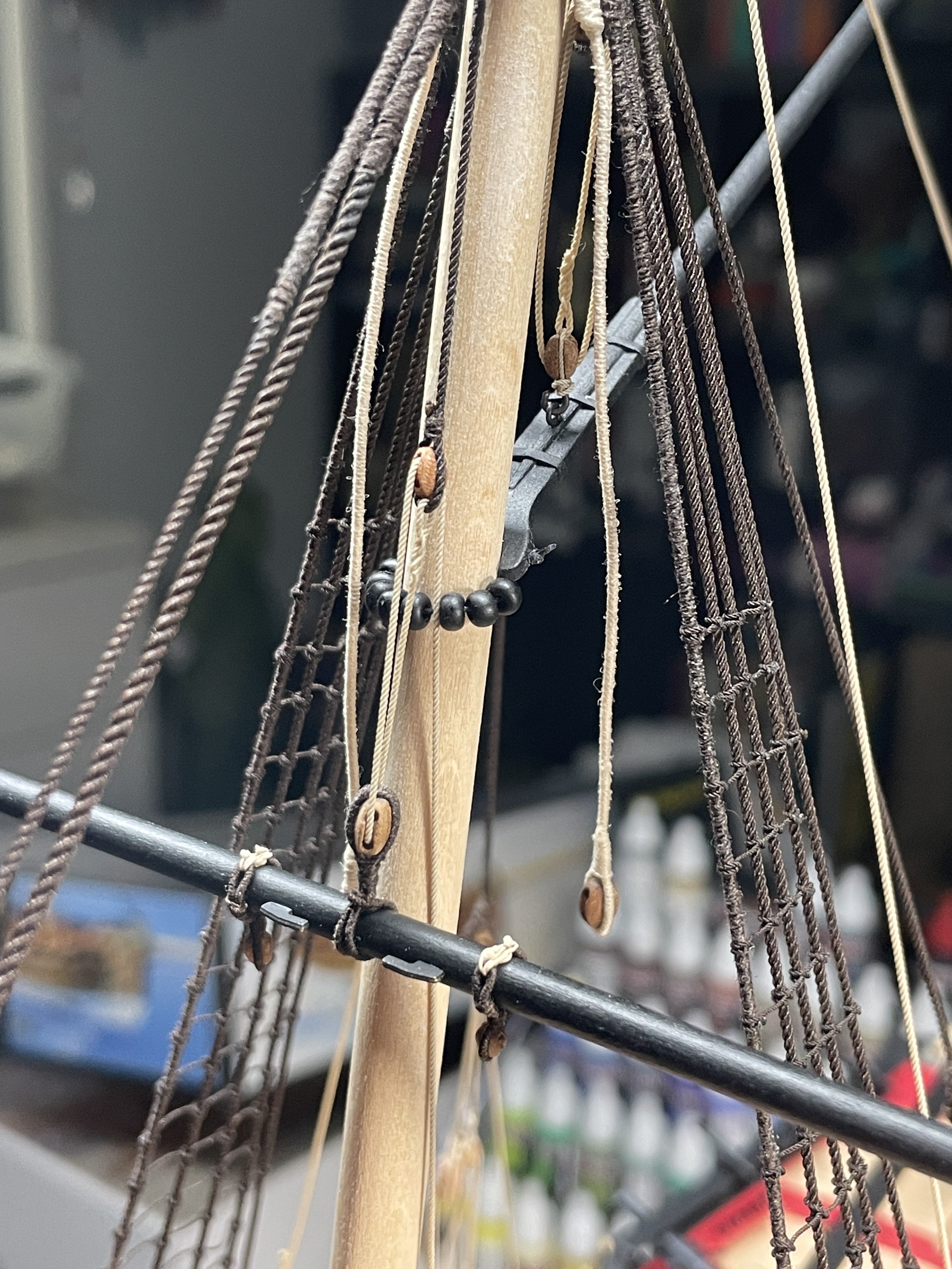

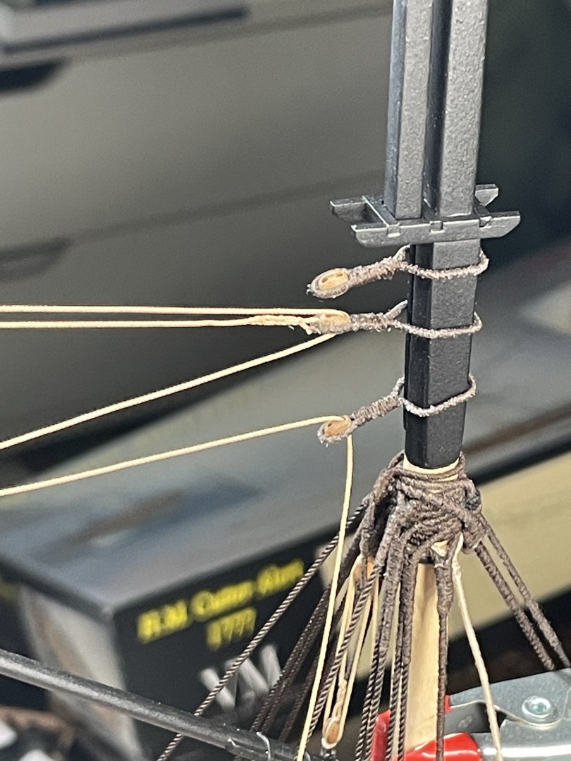

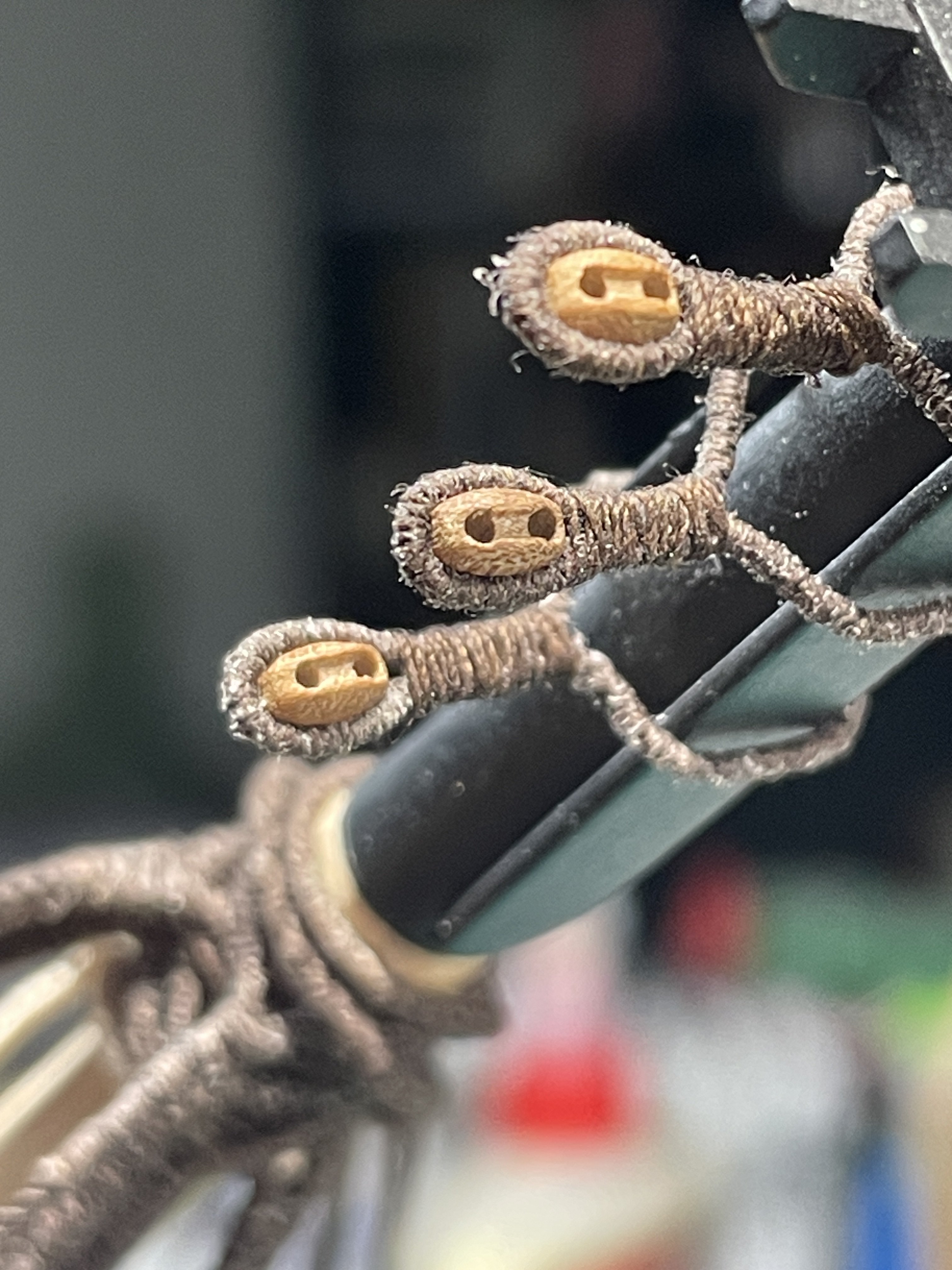

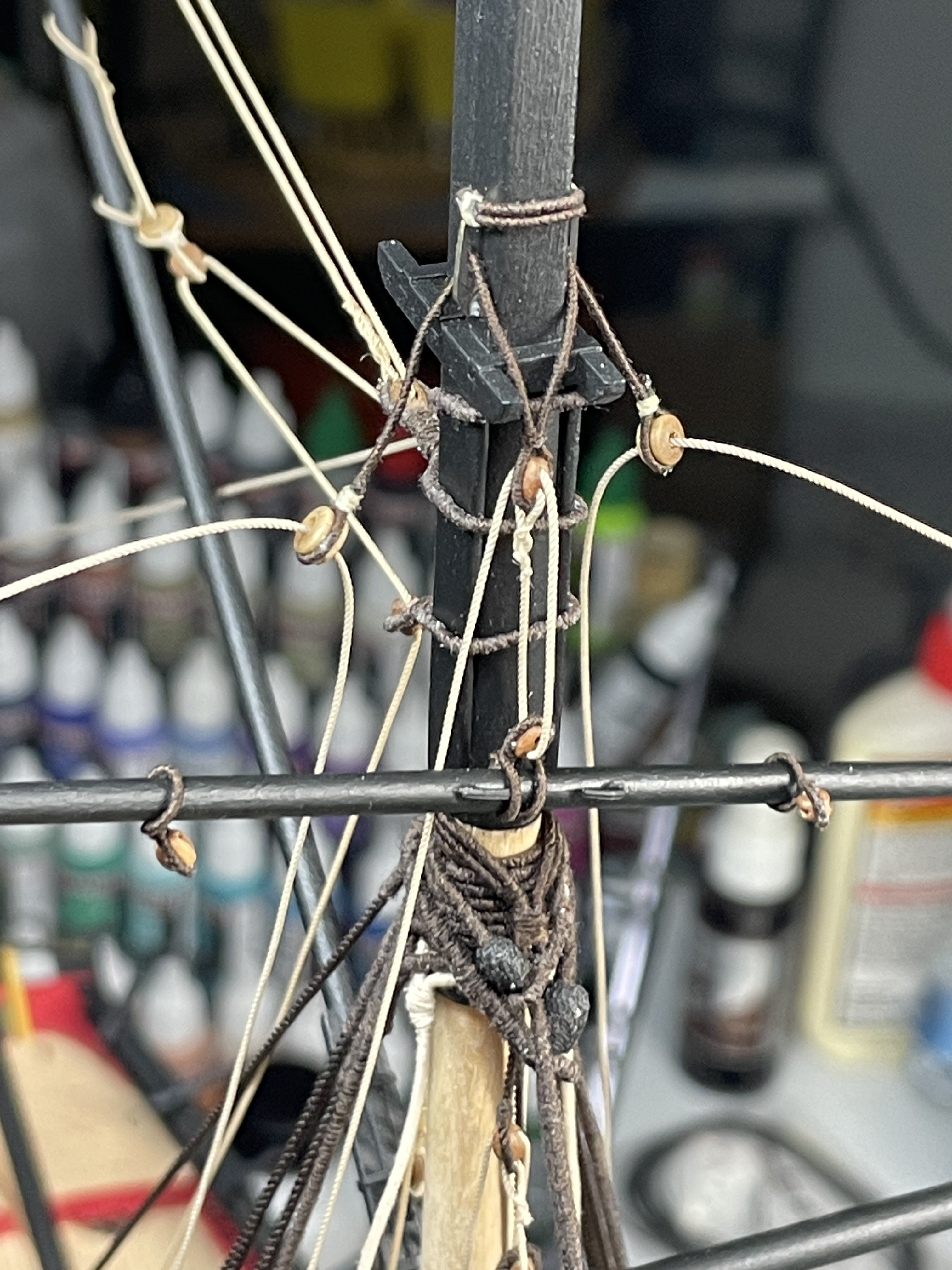

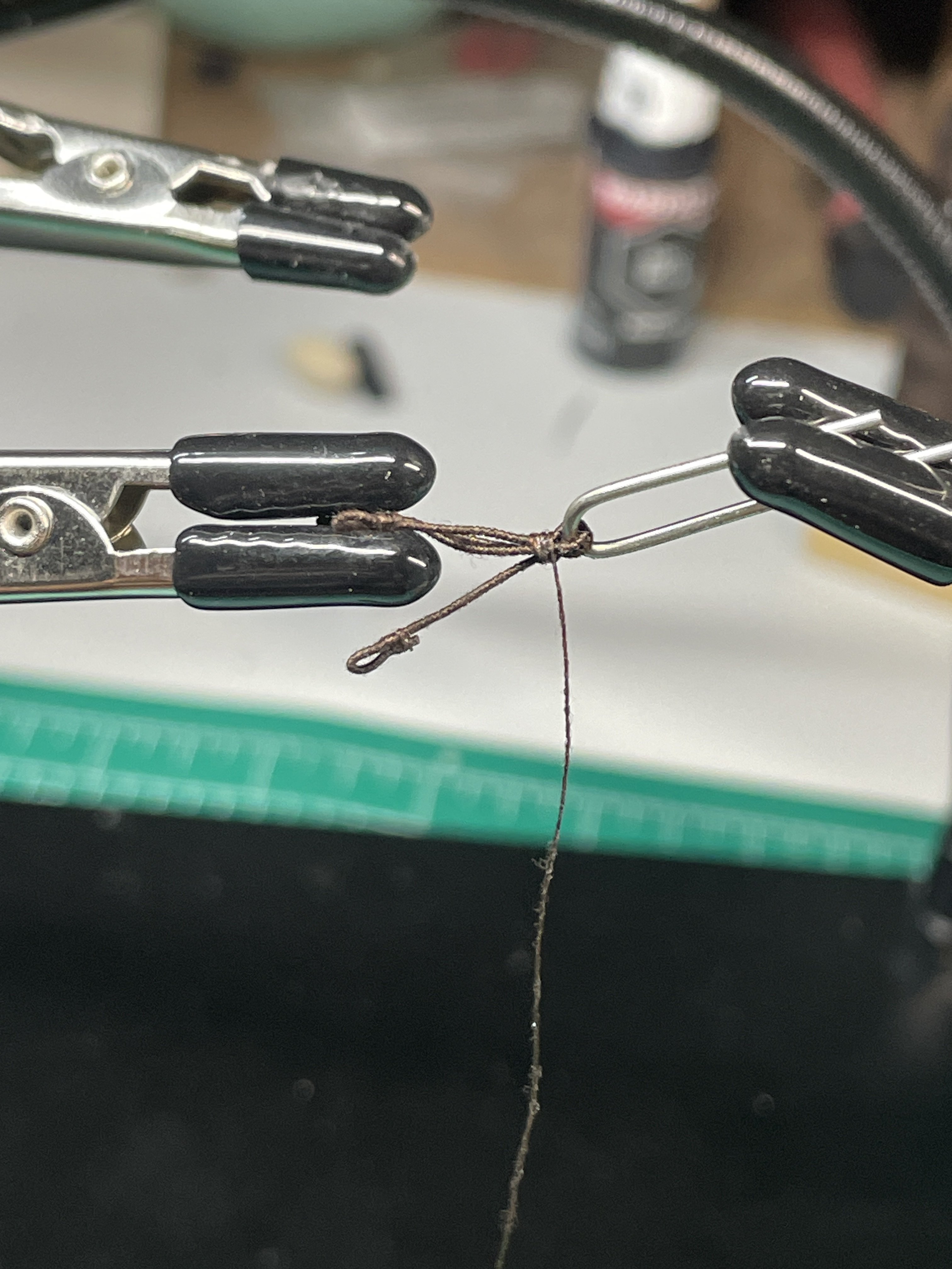

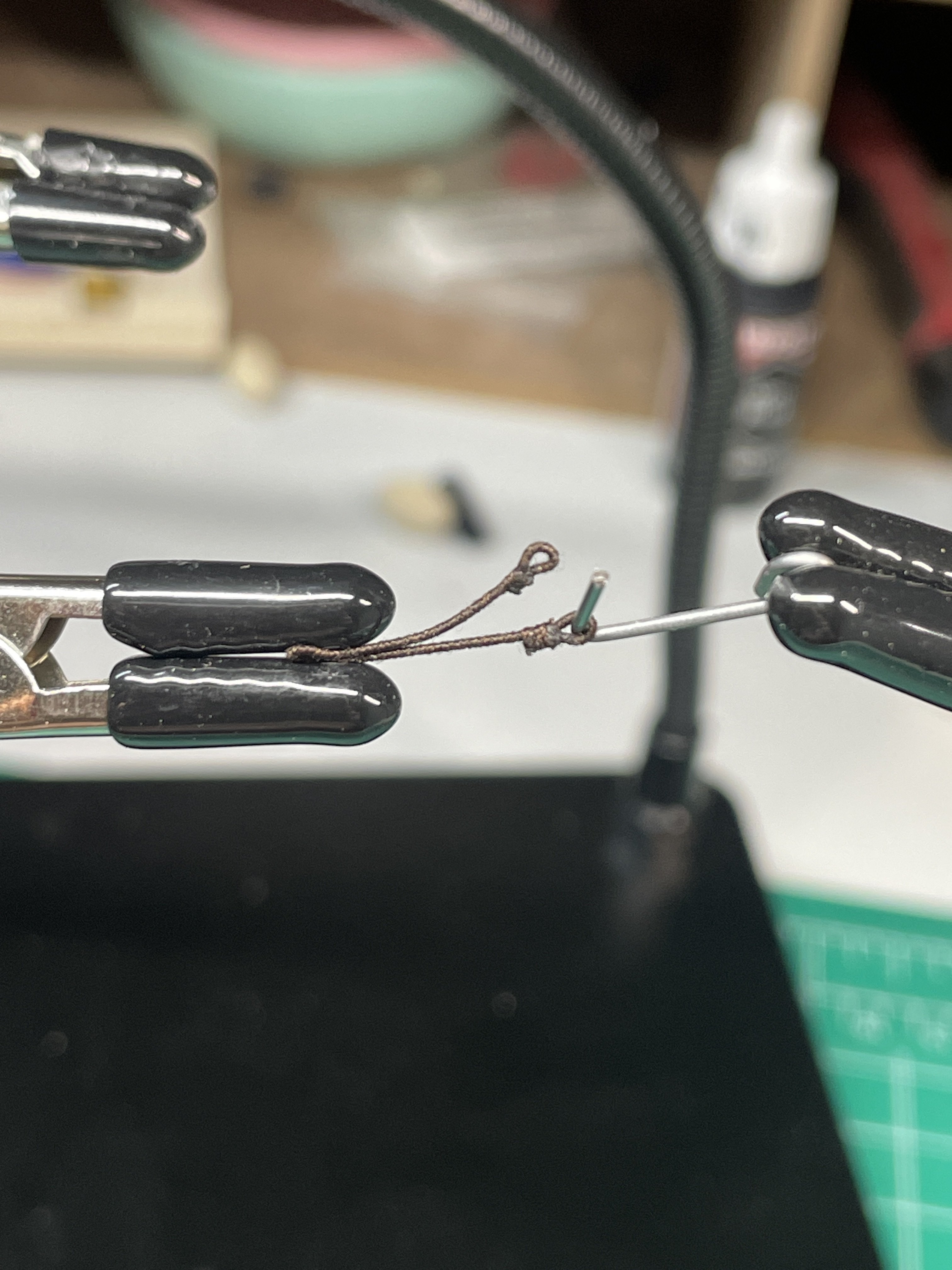

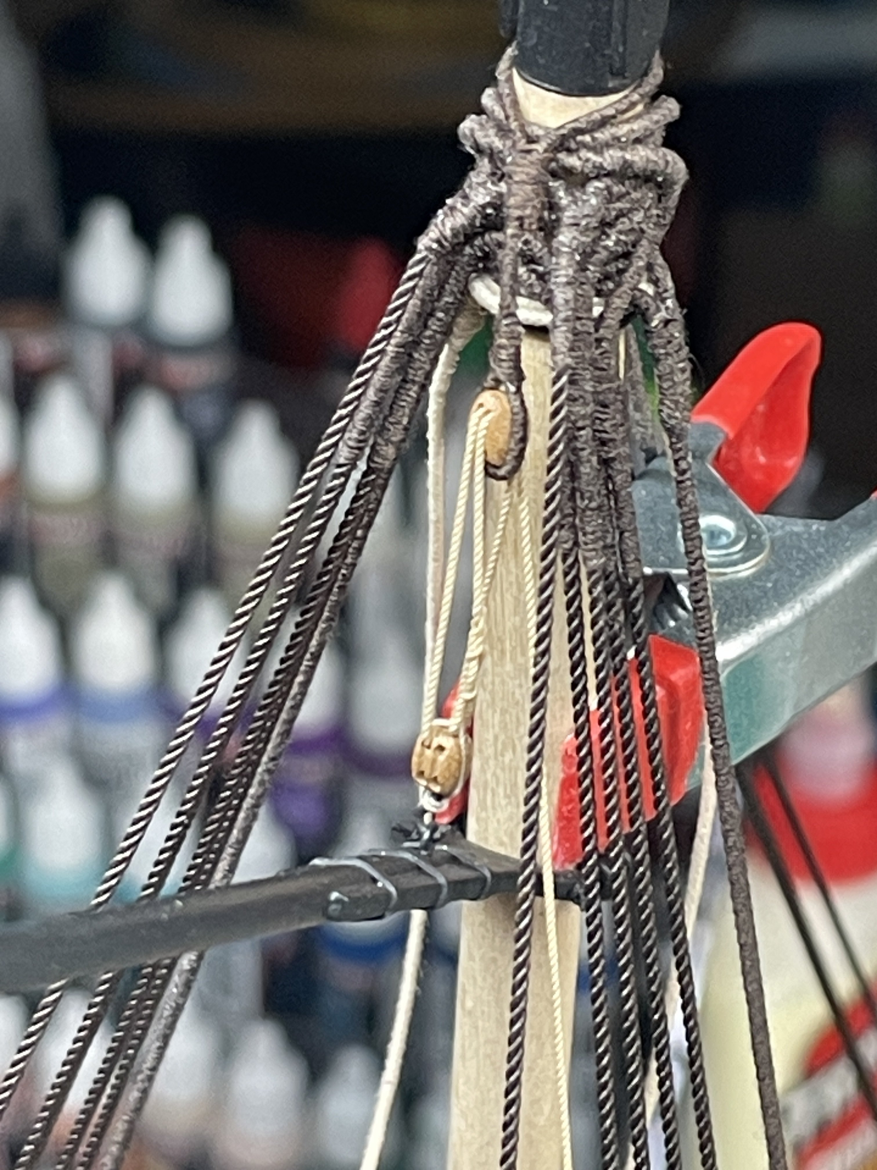

OK time to work on the shrouds. I used some bent paperclip wire to make a jig to hold the deadeyes at a consistent distance. Then I put a dab of CA at the bottom of the deadeye.

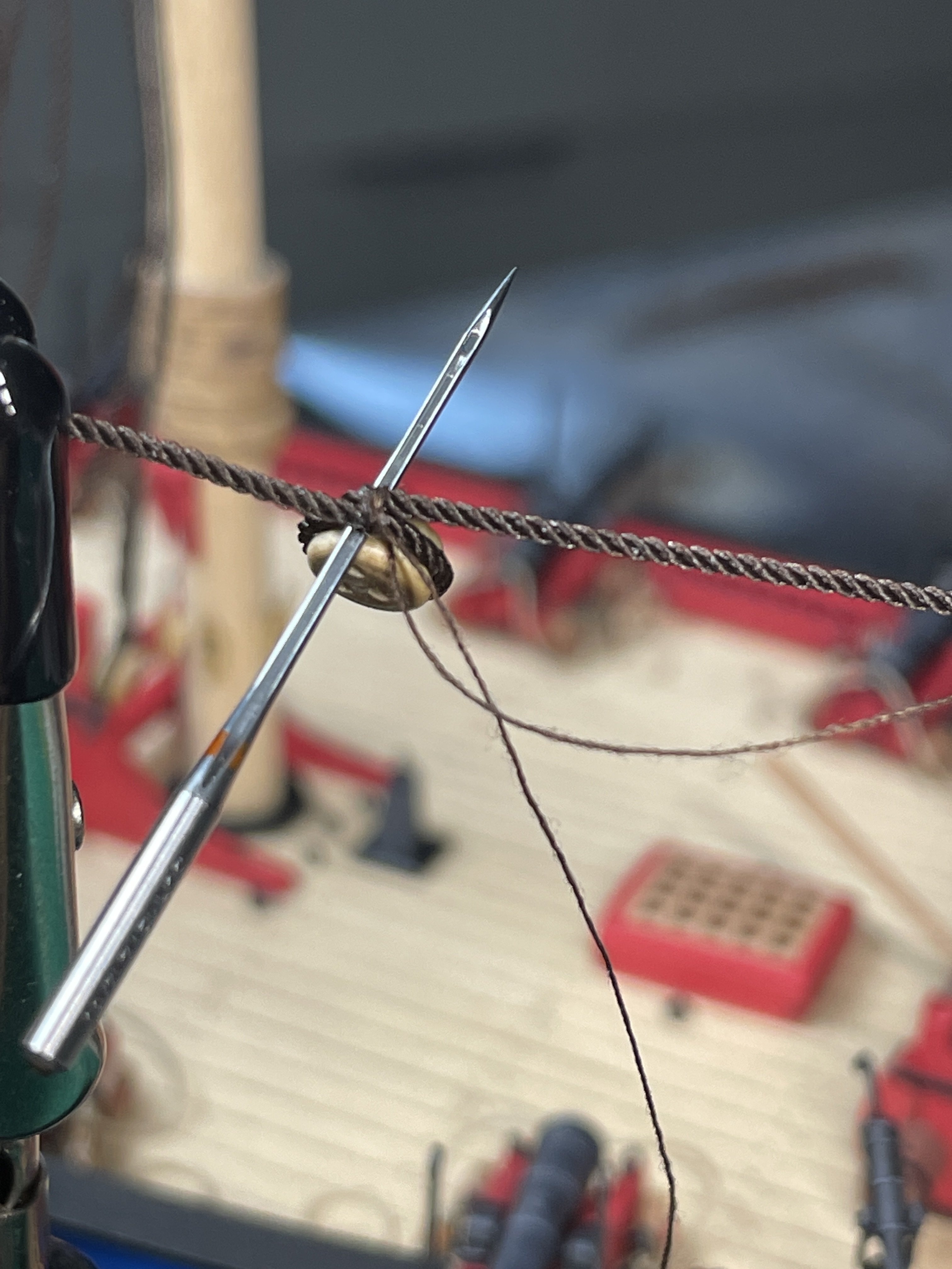

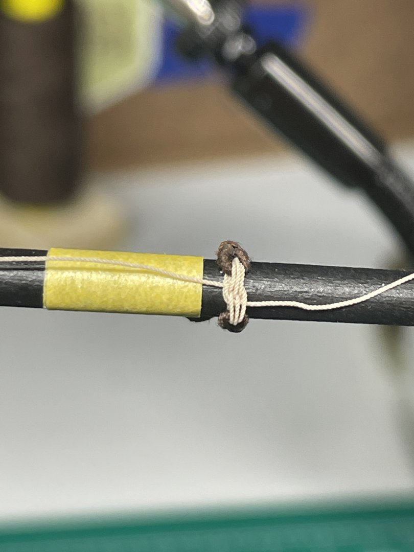

Then I used a sewing machine needle to pull the tiny thread under the crossed ropes. I think I did it four times. Finish with a dab of CA then a quick wipe with a finger.
Then pull the end up and finish the seizings.

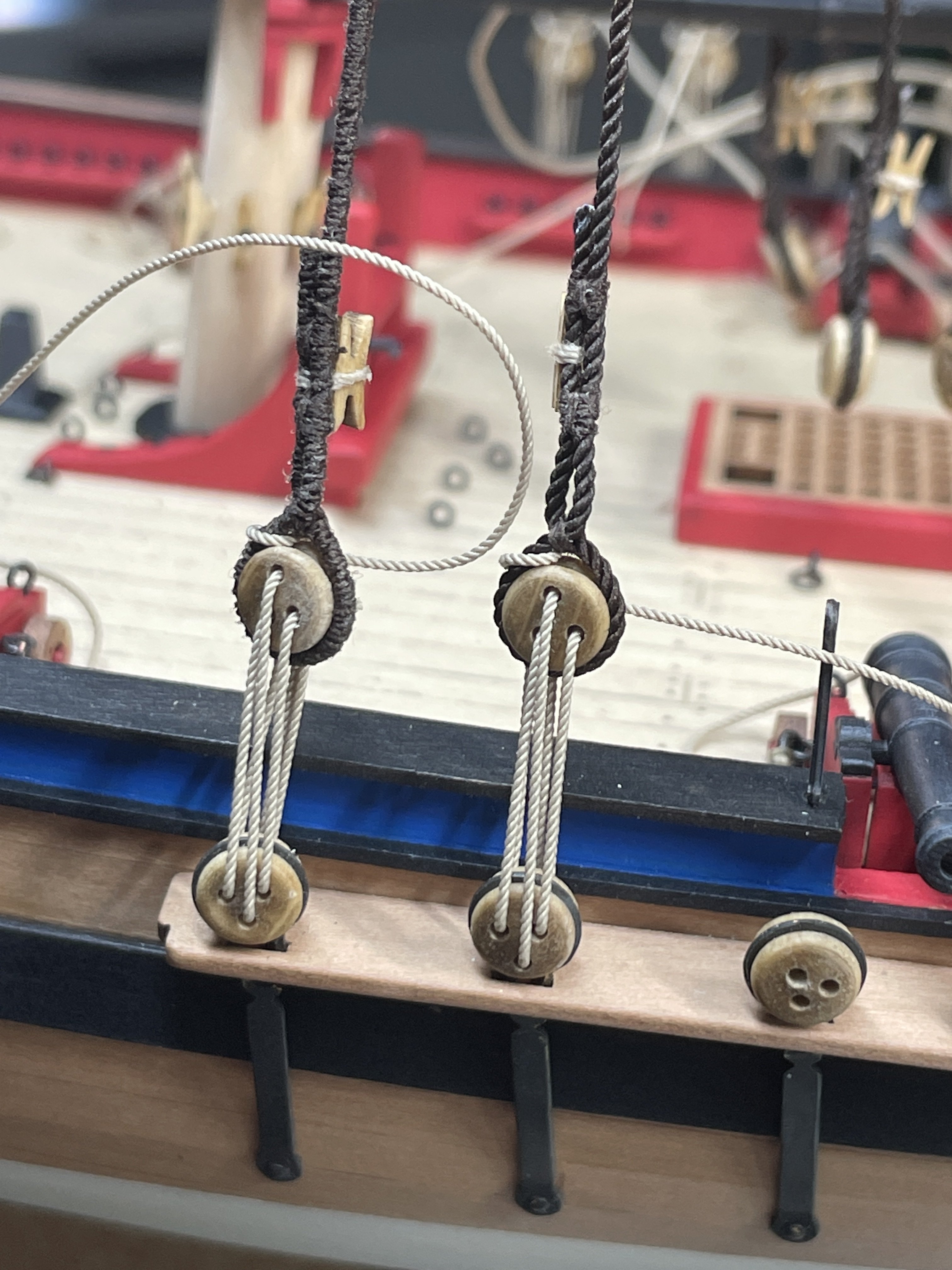

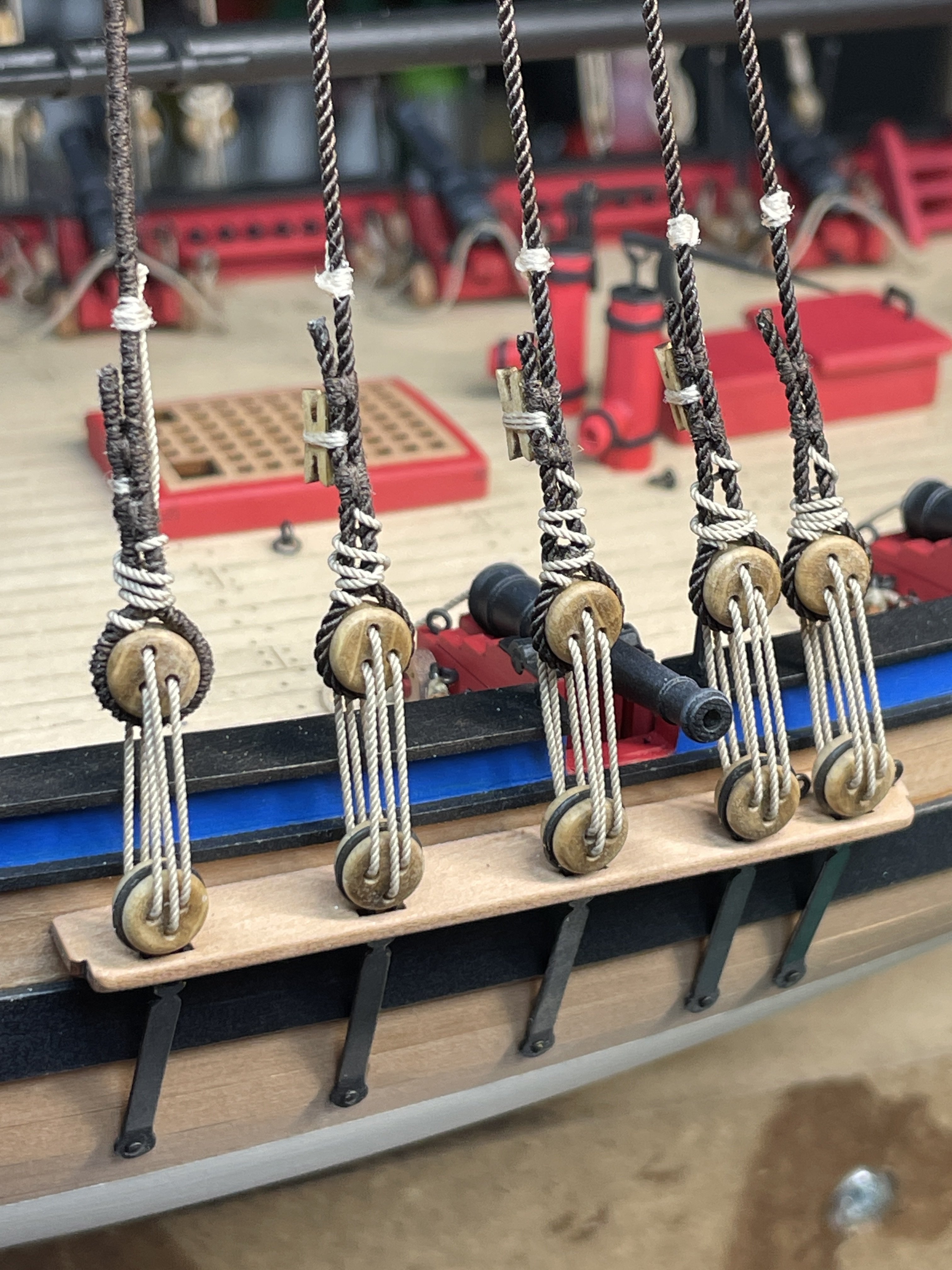

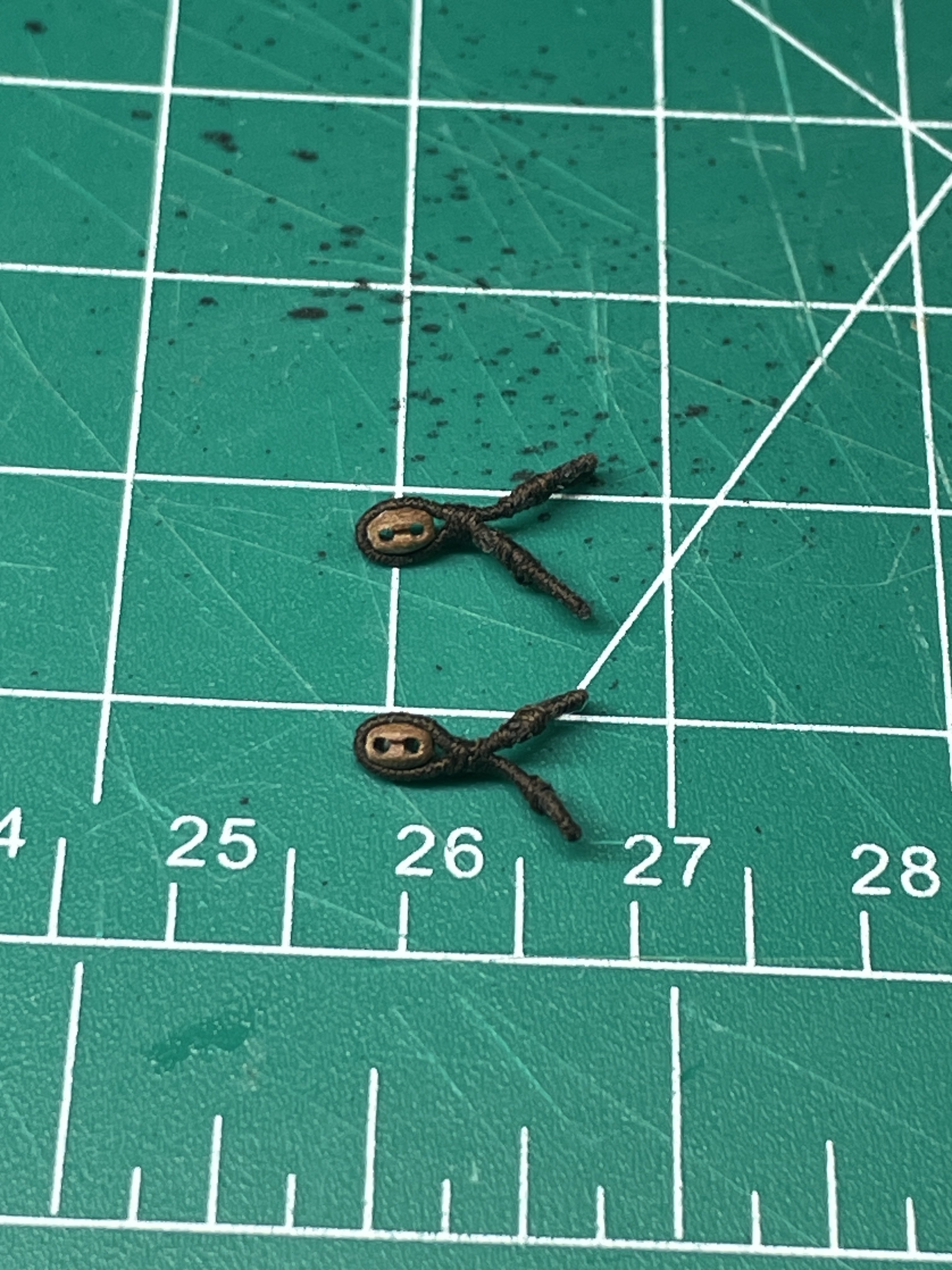

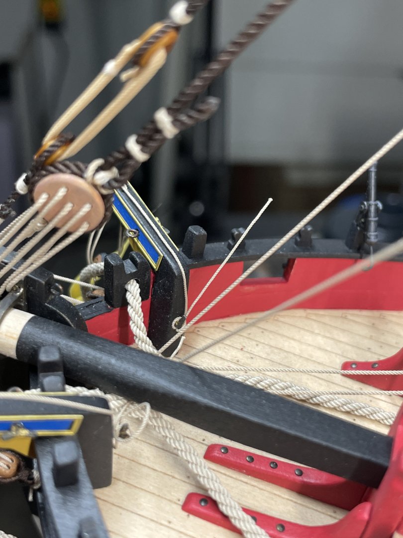

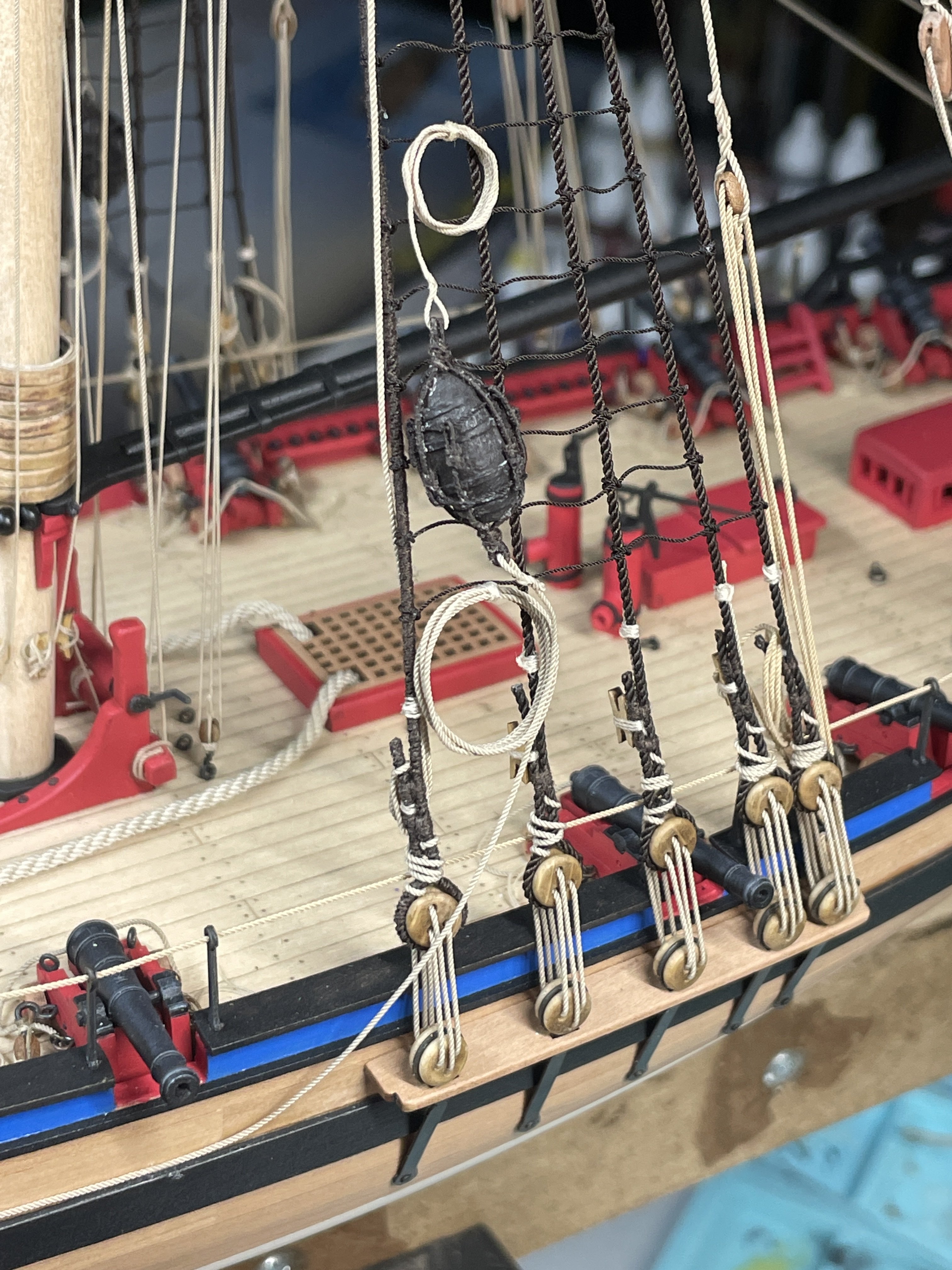

Then I tied on some shroud cleats from Syren. Looking at the photos now I’m thinking I should have spent some more time sanding them and giving them a little more roundness to their shape. I must have thought they looked good enough at the time.
IMG_4126.thumb.jpeg.ae47055e69b4f2f7670c9bded0fcf647.jpegIMG_4125.thumb.jpeg.155f722f0c84ece3f5948cb099ca8723.jpeg

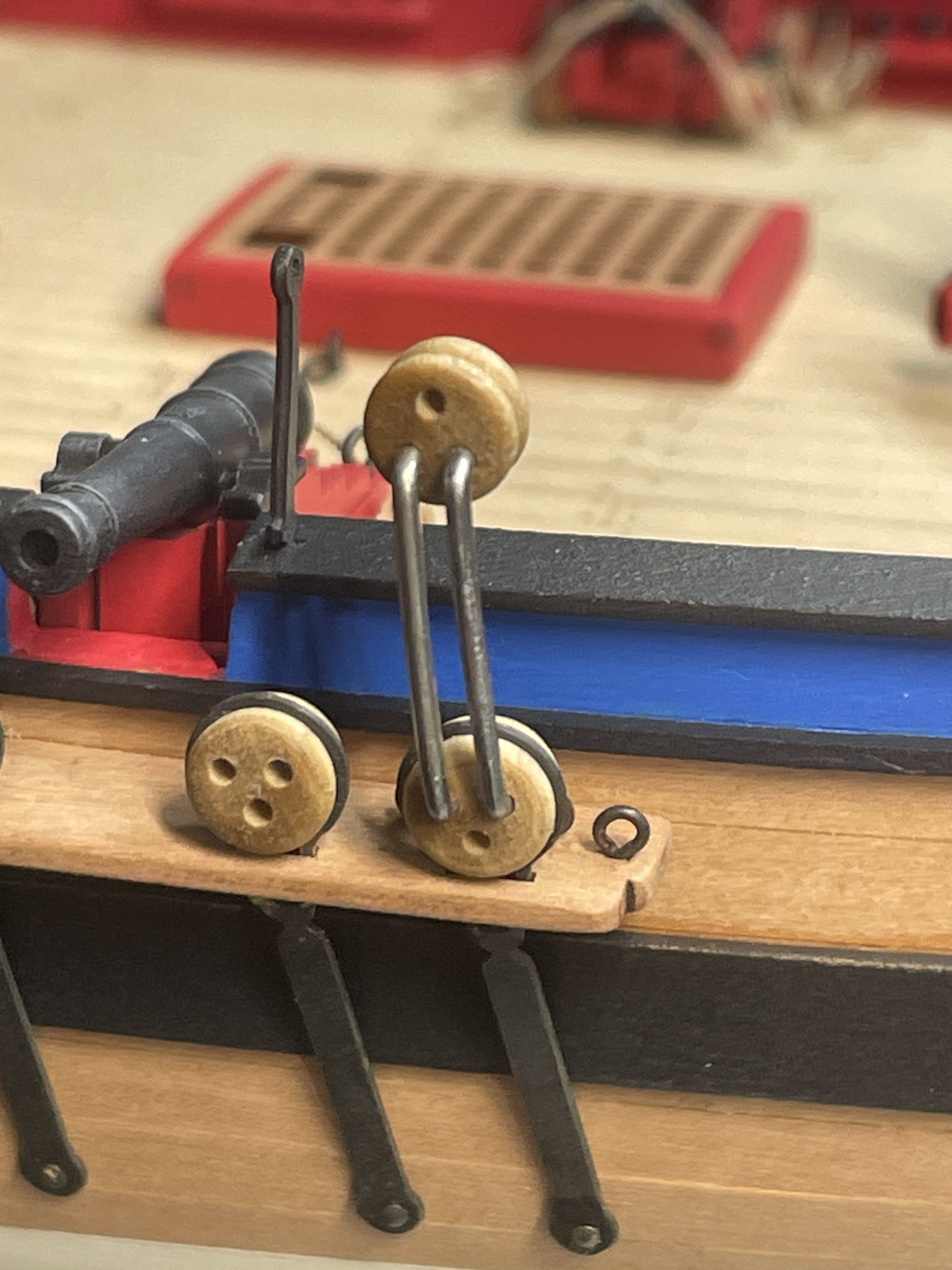

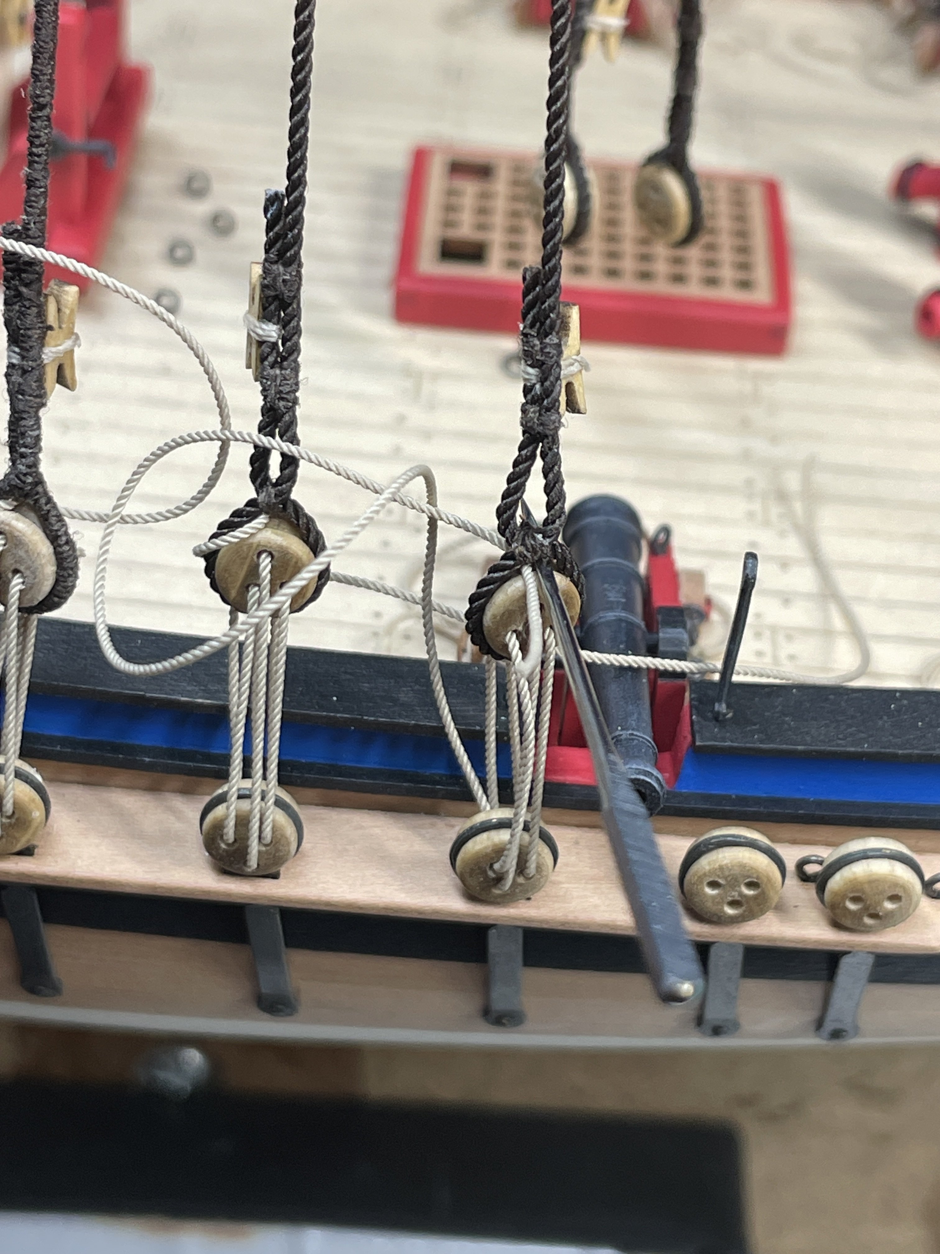

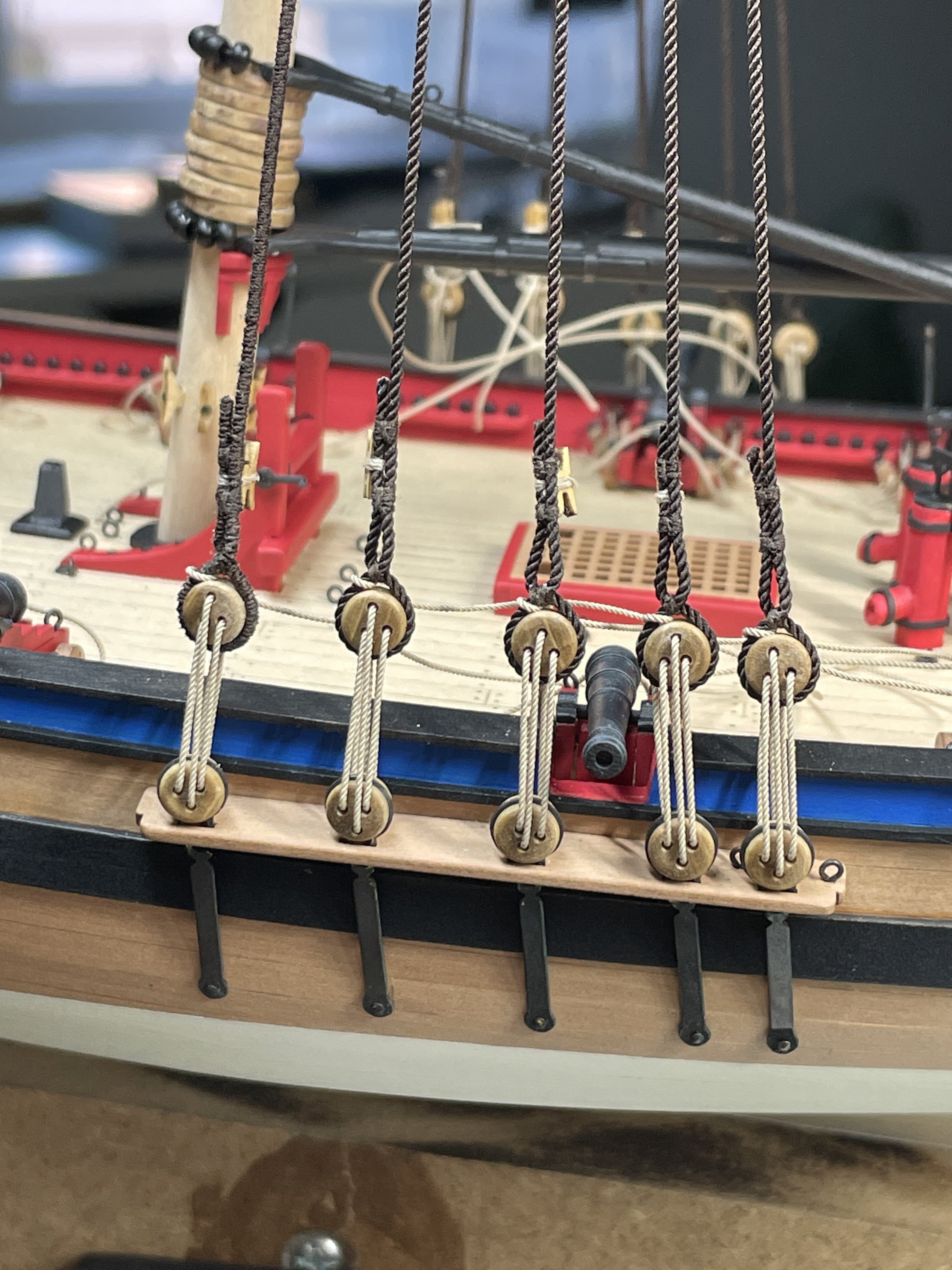

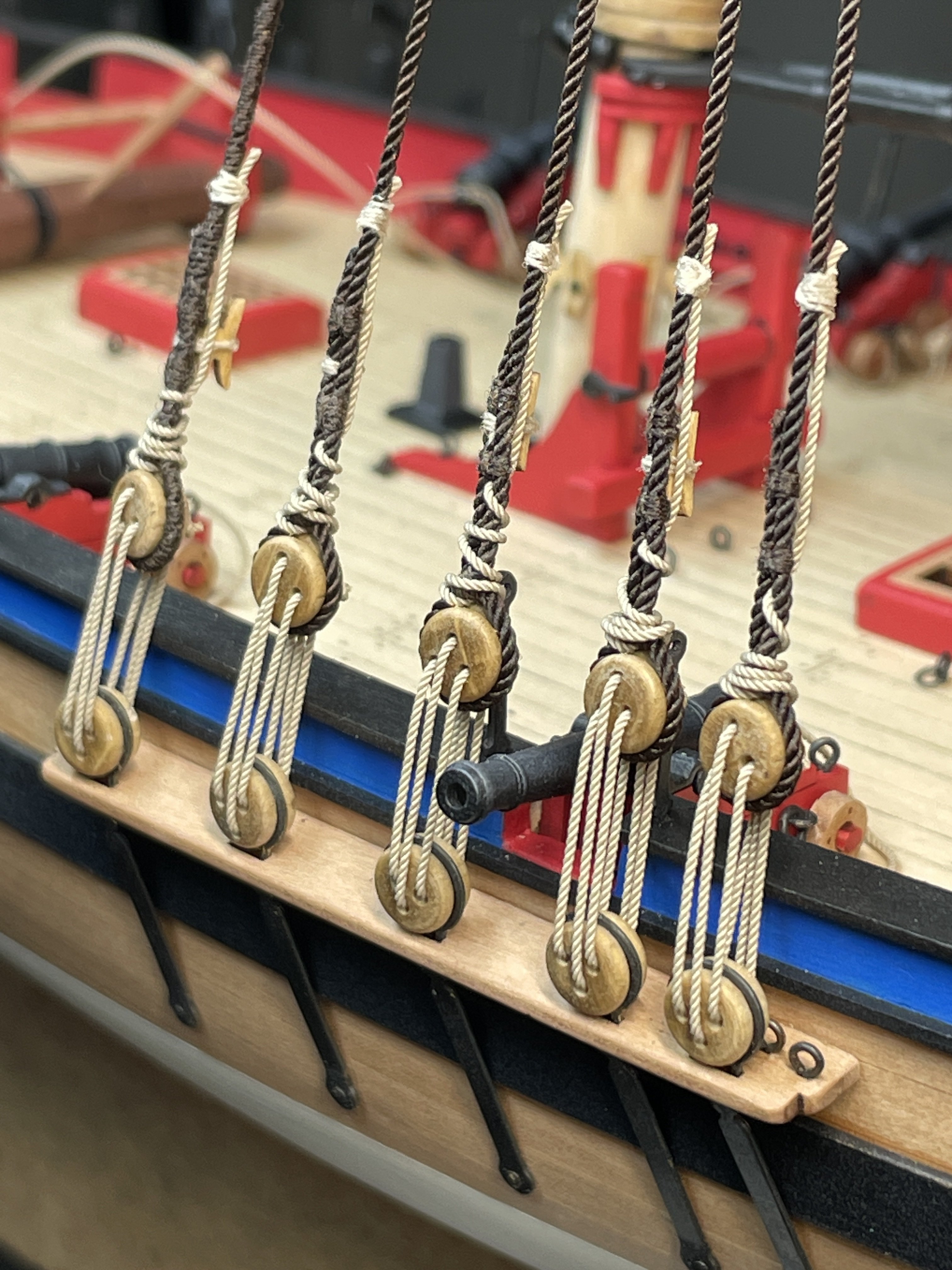

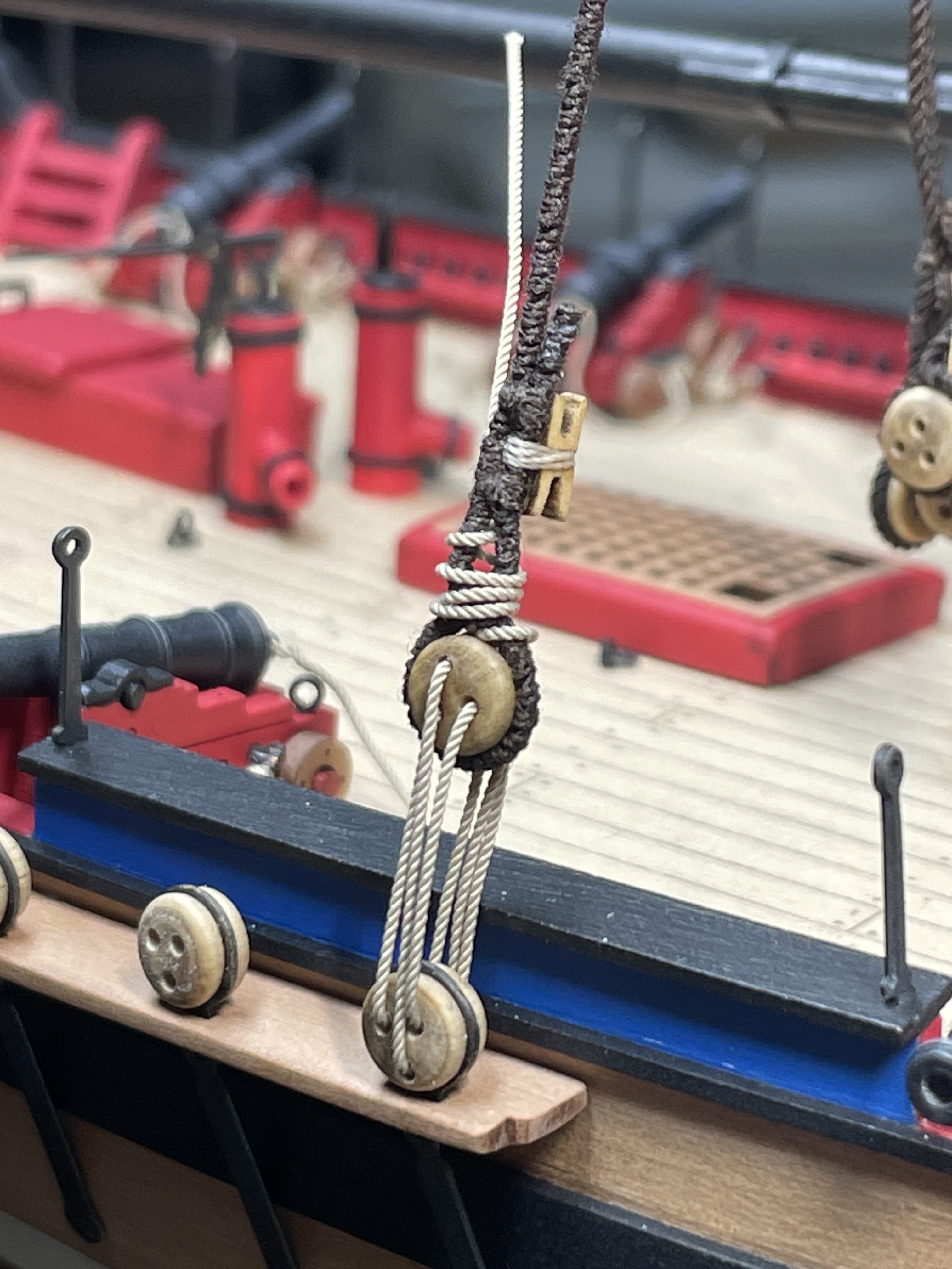

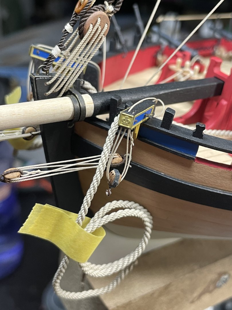

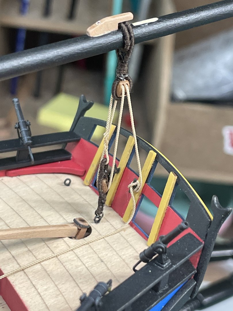

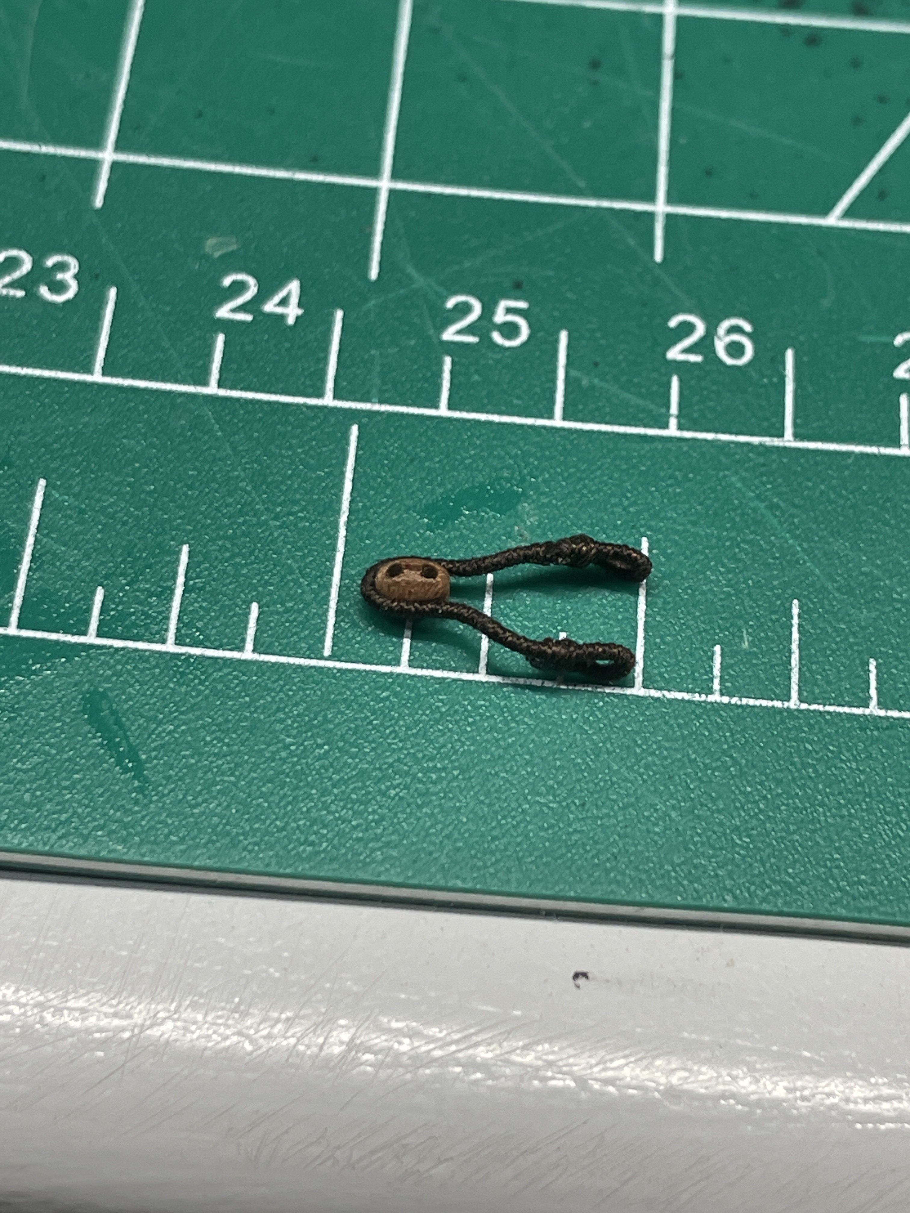

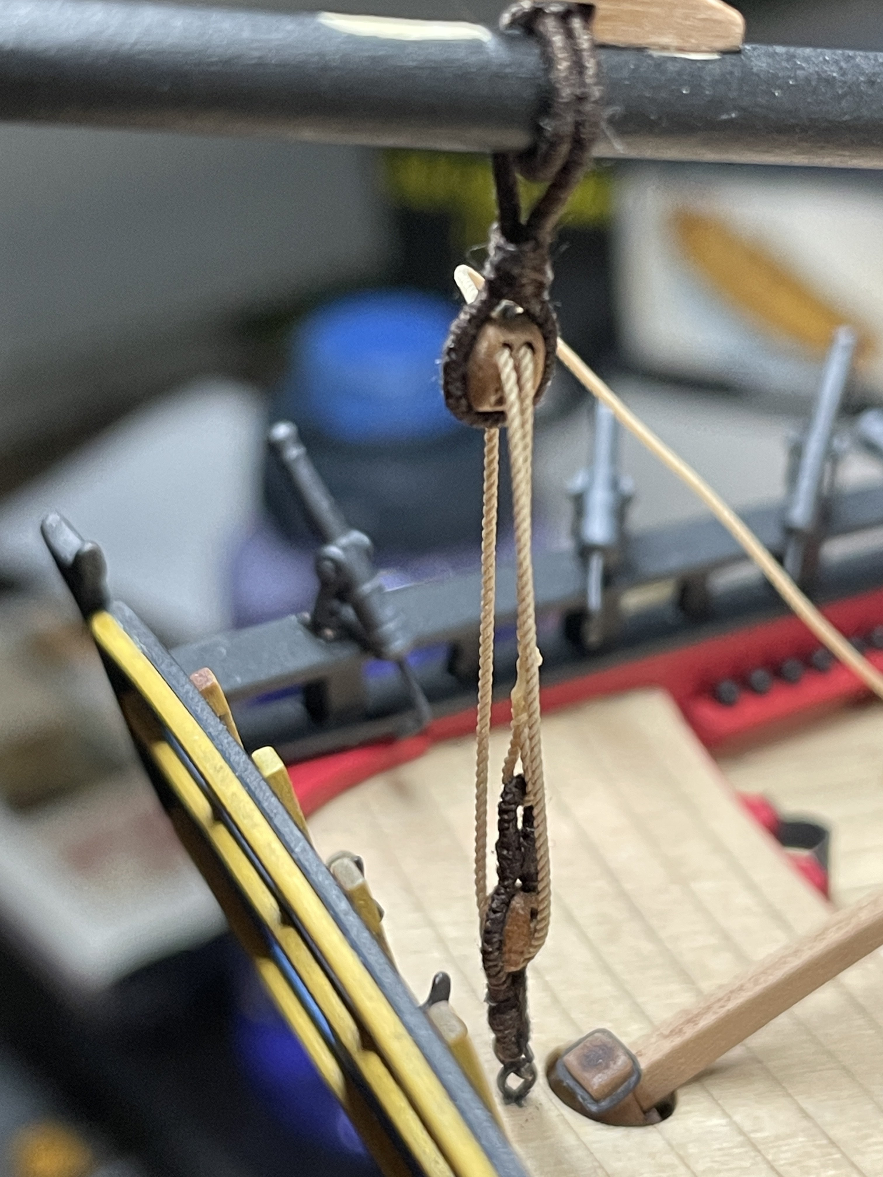

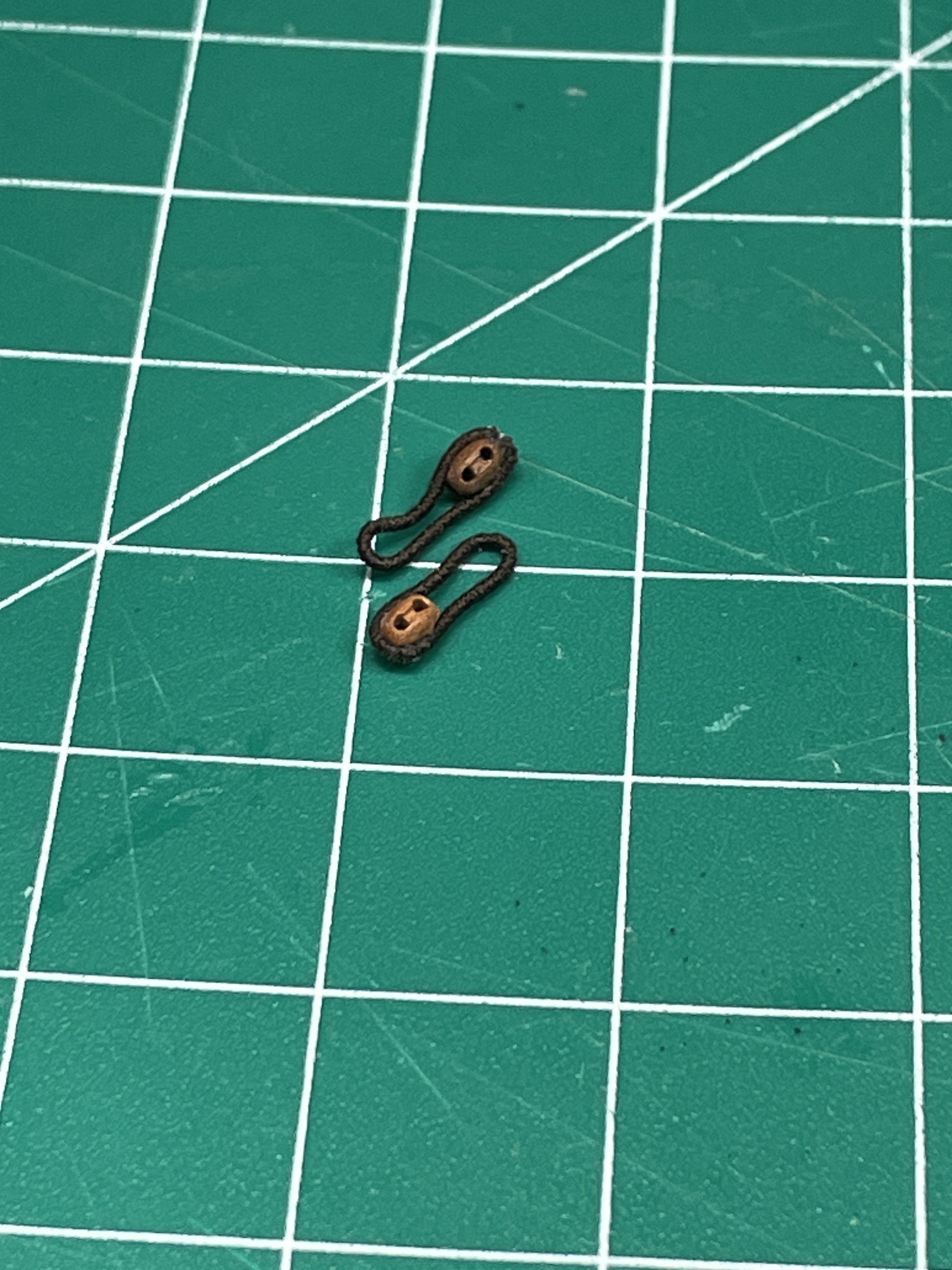

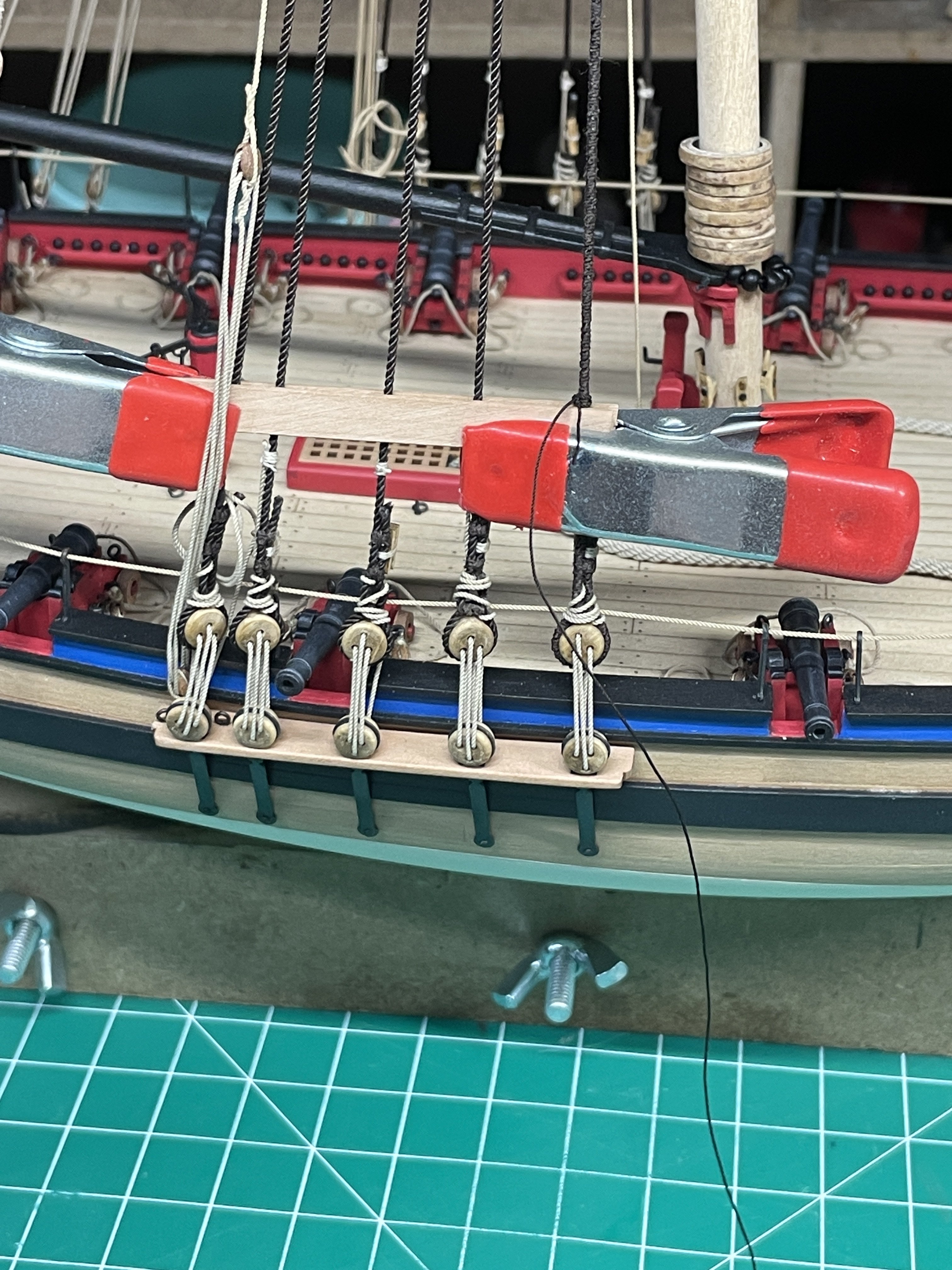

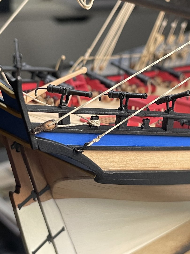

Then on to the tackles. These were a little fiddly to work through but I think the end result is very rewarding. It adds a great look to the boat. This is my first time doing them. I am pretty happy with how they look.
I experimented with a few ways to tie them off. I looked at build logs and the Peterson book Rigging Period Ship Models. I completed one by itself. Once I was satisfied I did the rest all at the same time to keep them looking consistent.
A few times it looked like a tangled mess, but it turned out ok. Slow and steady is always the answer for me, although sometime I forget the question…

Time to work on the backstays. Seems there are not only many ways to do it, there is no consensus on how it was done on Alert.
So again I default to those who have gone before and did them as @Thukydides and @Blue Ensign
I had purchased some violin blocks but they were way too small. So I needed to make my own.
I also needed to lash up some blocks with hooks and the circle thing. Is that called a thimble?
And here is the result of the backstays.
Next I made the mouses for the main stays. I guess I didn’t take a finished photo of them…
Here is the tackles up front.

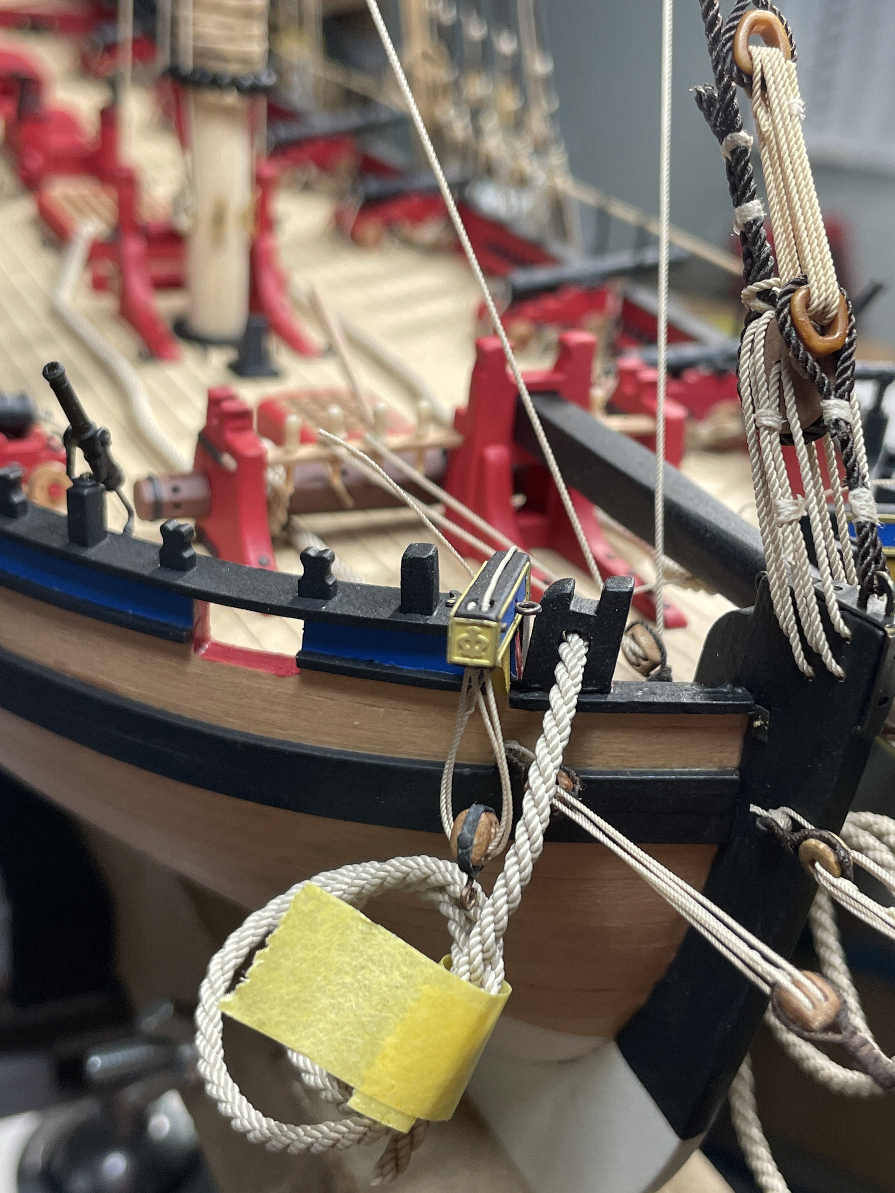

I was really itching to play around with the anchor ropes. I got cable laid rope and it looks so cool I just couldn’t resist at least getting an idea of how I wanted it to lay. This isn’t the final position but I was getting ideas.
Lashing these together was a chore with so much stuff in the way.

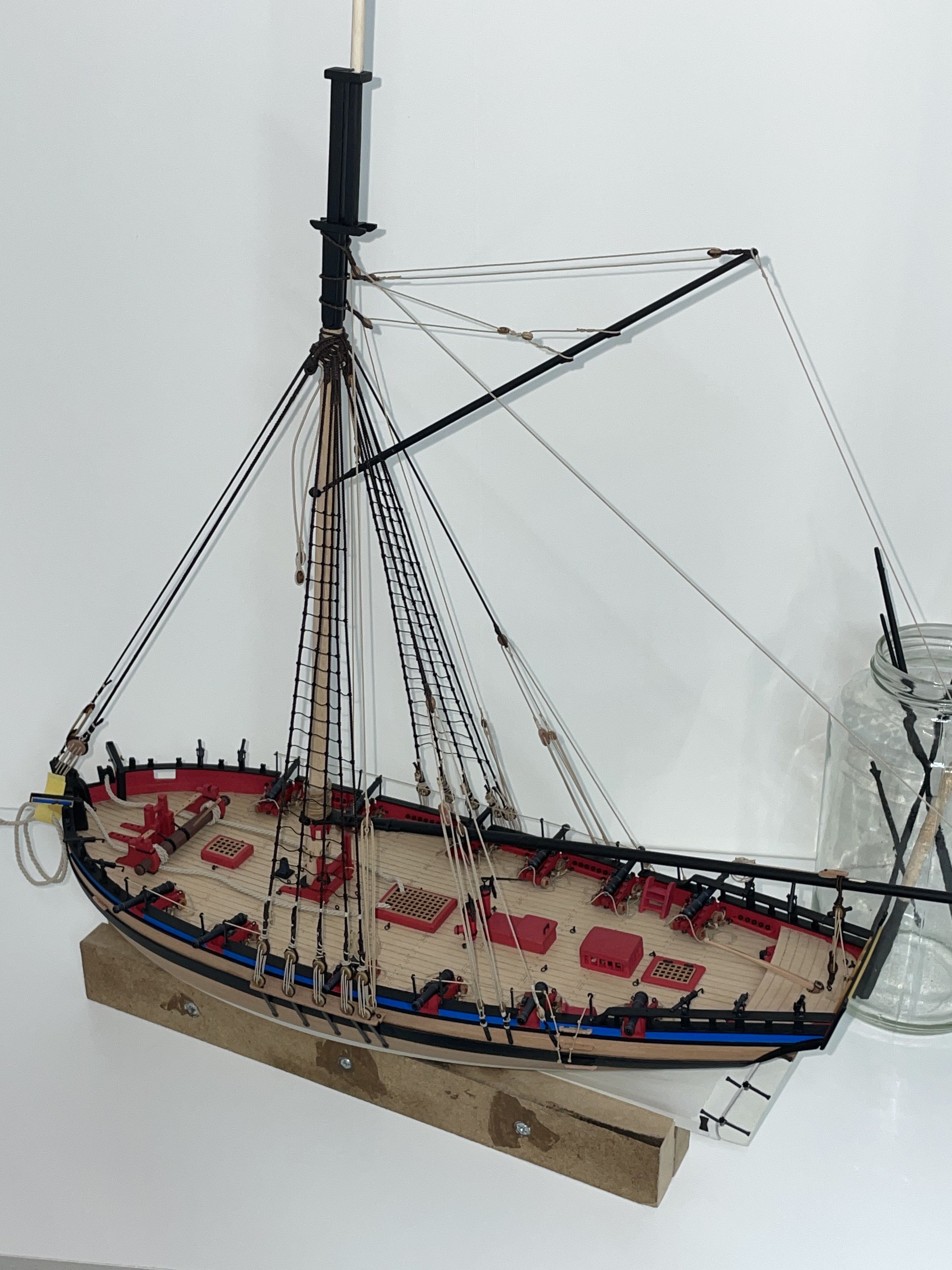

Moving right along we’re continuing with rigging and now it’s time to raise the gaff and the boom.
I had to first make some seized blocks to hang stiff on.
Again, these had to be served on the mast, not fun. Luckily I can tilt my vise and lean the ship over which helps.
Here are the tackles for the gaff. IMG_4284.thumb.jpeg.b93b845badd771c72b67e230c7ffba82.jpeg
And the boom..
I had to relocate the cleat on the boom.
Time for the ratlines. First time for me and I’ve been putting them off long enough. I used a method I saw @mtbediz post on another log. That is to use two small boards and clamp the shrouds to keep them from moving. Worked pretty well for me. I will not be taking pictures against any graph paper anytime soon either.
Made a traveler for the bowsprit.

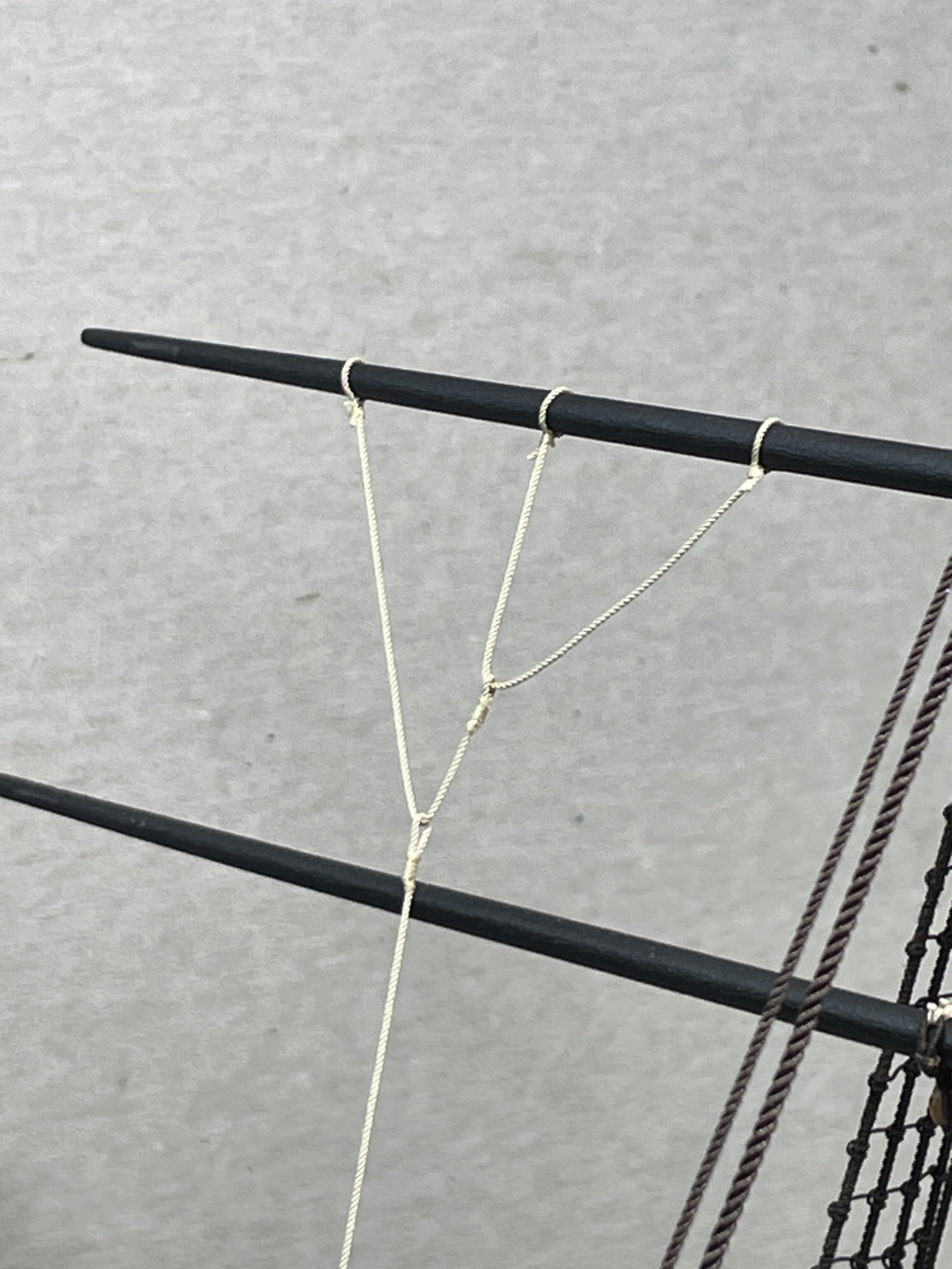

Again following @Thukydides log I decided to make the blocks for the spreadsail yard sheet the same way. Make some tiny eyelets and then bind them around the yard with rose lashings.
Here are the pictures.
IMG_4362.thumb.jpeg.ce9a37c366d9693ac0cb0ae2c617d784.jpegIMG_4363.thumb.jpeg.972f0d3a29ba2994ba8fc12b01fd0509.jpeg
Raised the squaresail yard and the topsail yard. Couldn’t bring myself to try the rose lashings up here. I don’t think I have the thread needed. It’s getting really tiny!
Starting to get really crowded up here!
I’m really still on the fence with rigging; I’m not sure if it was designed by the devil or if it’s fun. It’s not easy to do, added to the fact that I could have made things easier with more planning and it can be quite confusing. It sure does add a look to the model that can’t be beat though.
And a final glamor shot of how she sits…
She’s really starting to come together.

Still working on rigging. Just following along other builds at this point as I’m completely out of my element.
Working on the backstays…
I needed to remake the band for the bowsprit. This one is much stronger.
Bowsprit stays(?) and catfalls…

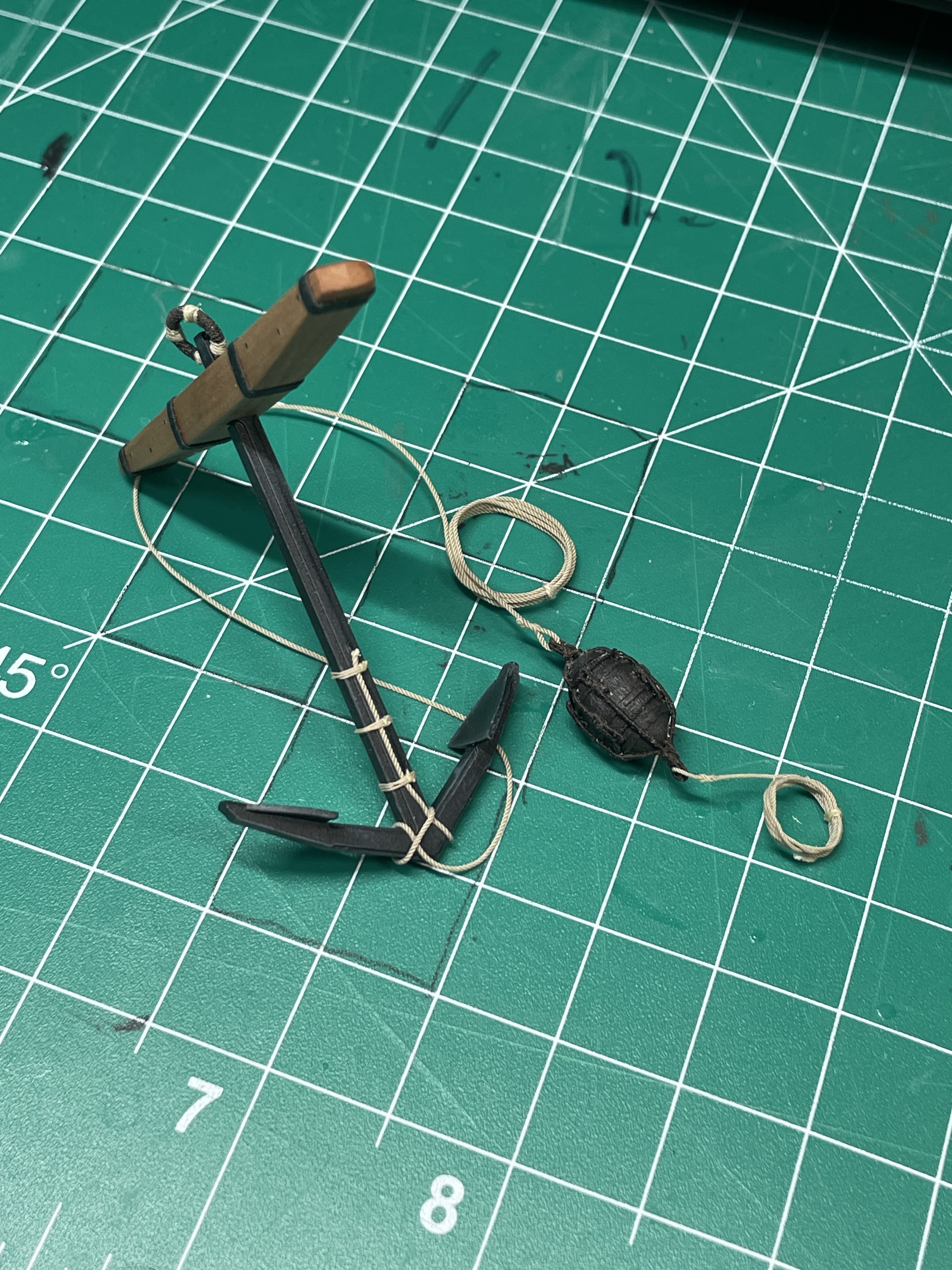

I’m really coming up to the end of the build. Time to work on the anchors. As many do, I also decided to make the tops from scrap pear cutoffs. Used the kit supplied black paper as the bands and fishing line for the nails. Then some WOP.
The printed parts needed a little cleanup. Then paint and a little dry brushing.

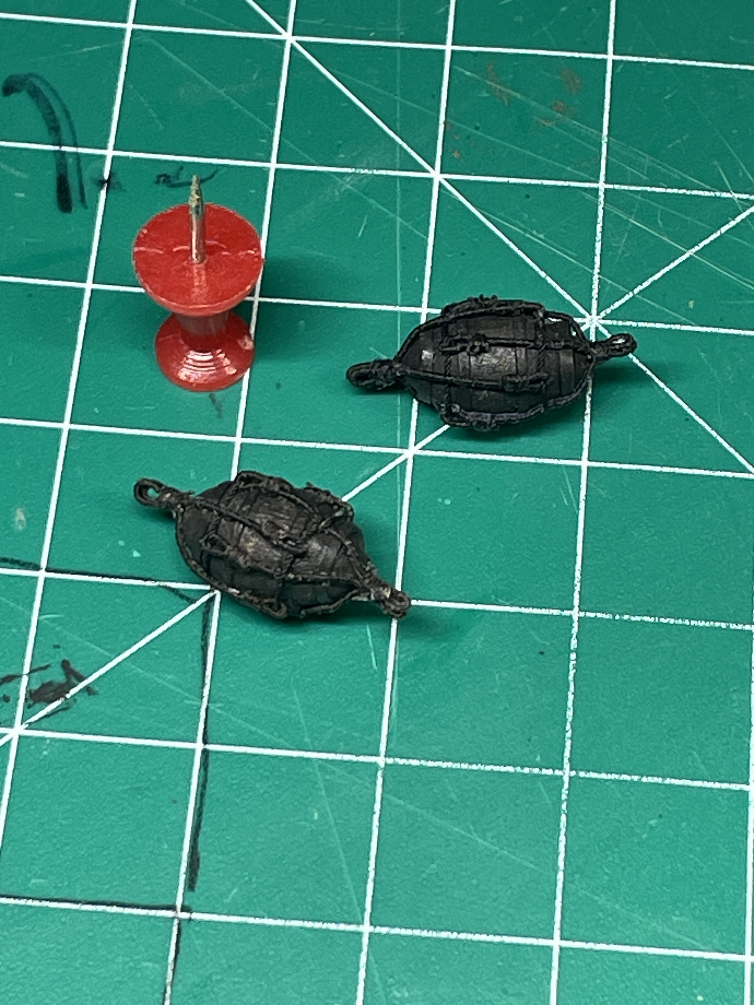

Now let’s scratch build some anchor buoys! One of the hard parts was getting the second one to match. Haha.

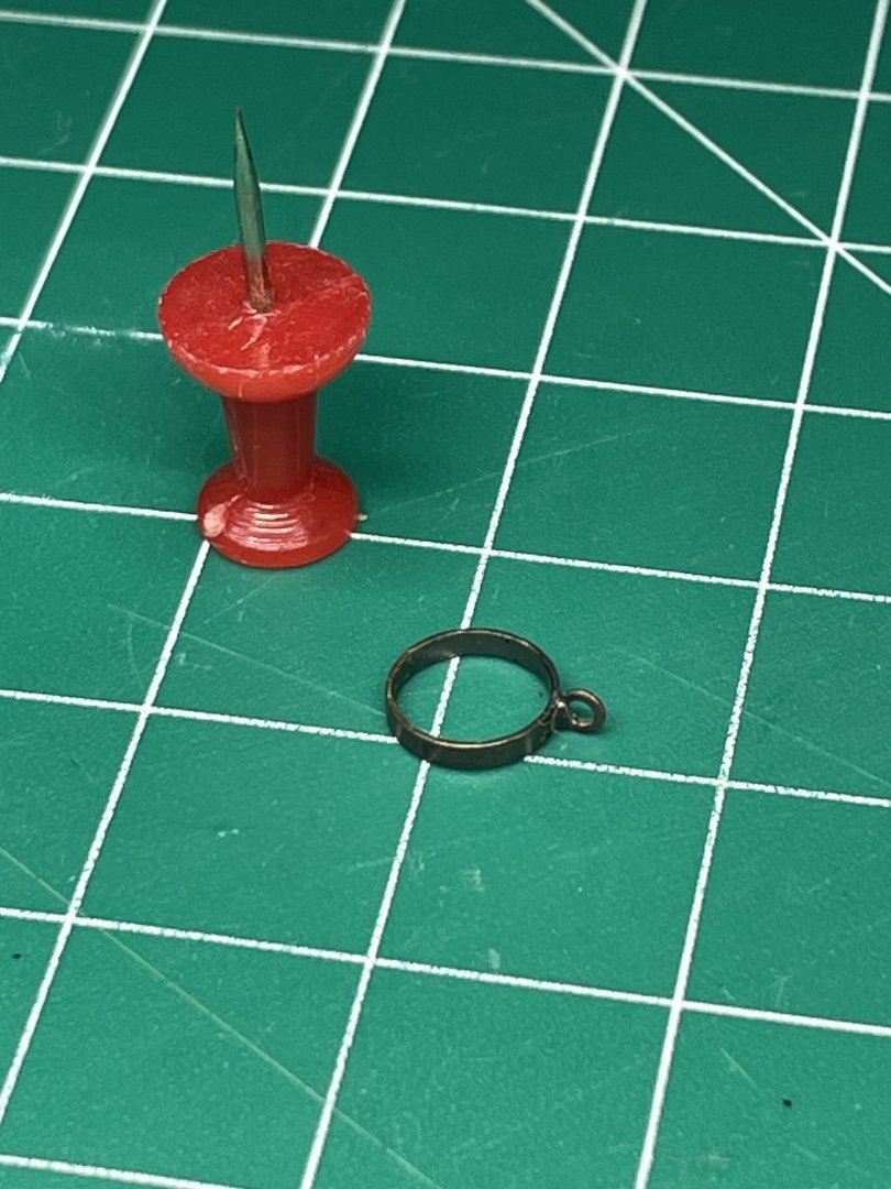

Then some shrink tubing for bands. I didn’t shrink it. I glued it in place.
Then the basket sort of thing around it. I served a bunch of .35mm line. Then glued and served 16 tiny eyes.
Assembling these little things was a chore. I could have used another hand that had 6 fingers.
I was a little disappointed when I coated them in very watered down matt medium and it darkened the ropes so it decreased the contrast and made that part a little harder to see. Still pretty happy as a first try.
Put it all together with the rope loops and mounted it to the ratlines. Lashed the anchors and that part is done!
