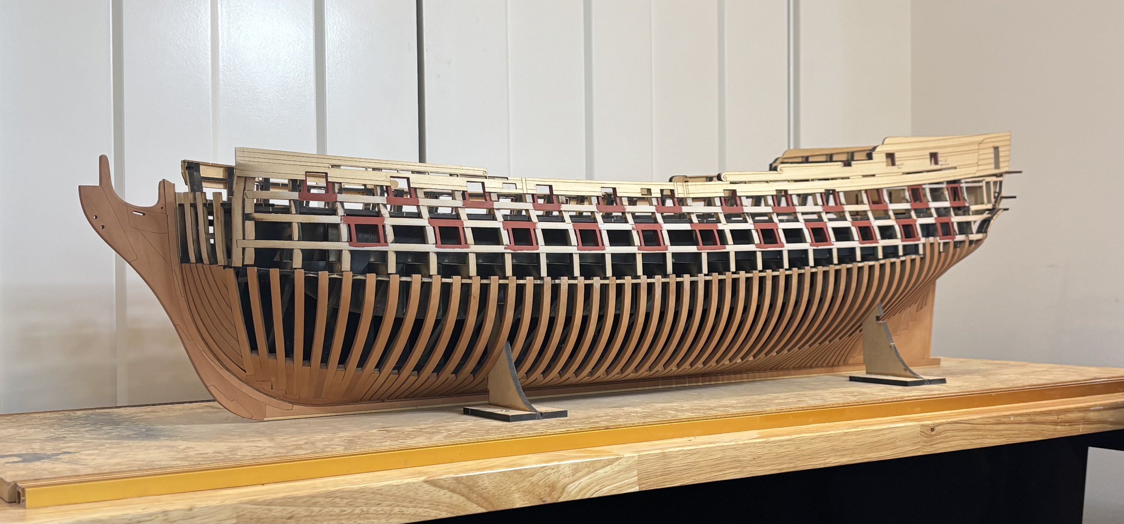

Would this be called a "Frame on Bulkhead" model (and if planked a "Plank on Frame on Bulkhead" model)? I don't think I've seen one like this. Will it be planked or partially planked or planked on one side?
Hi

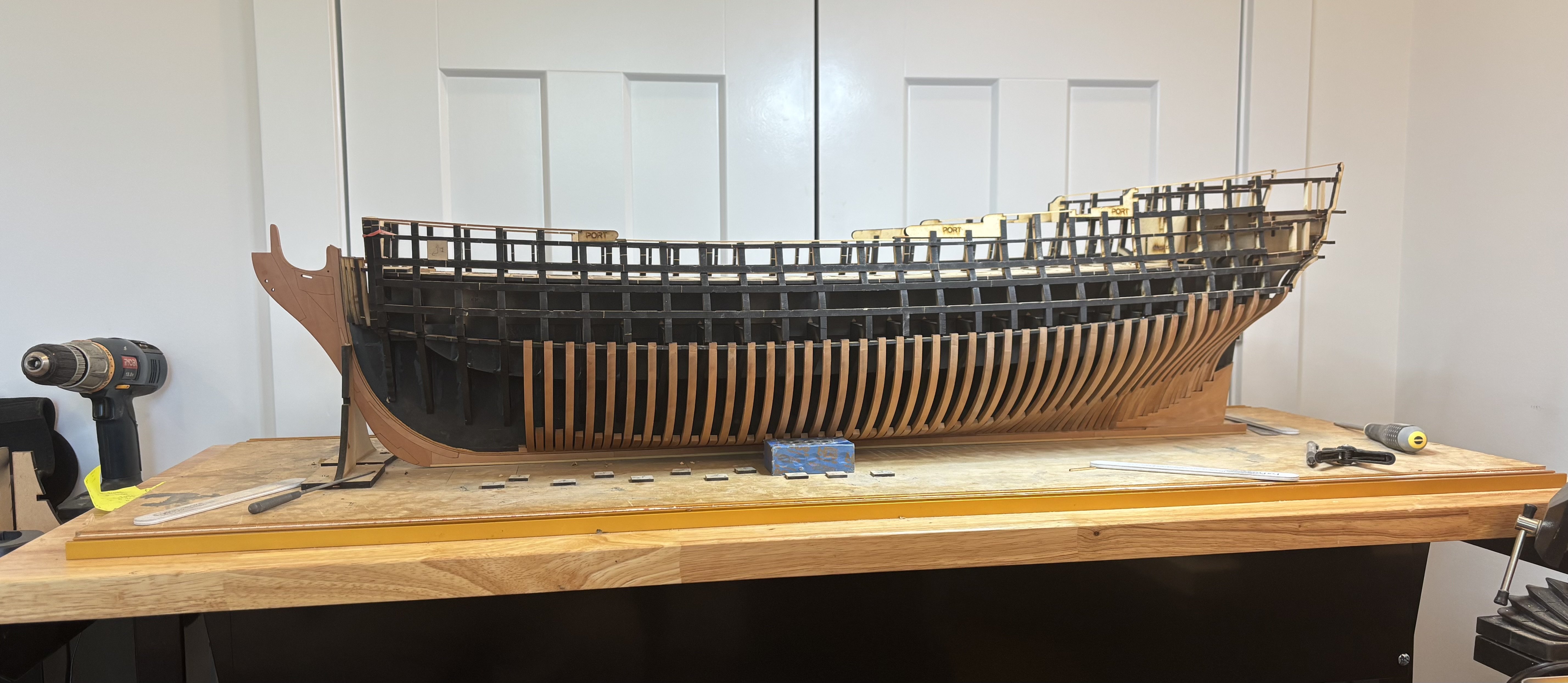

It will be planked from the wales up, and maybe one or two strakes below, posssibly even the garboard strake.

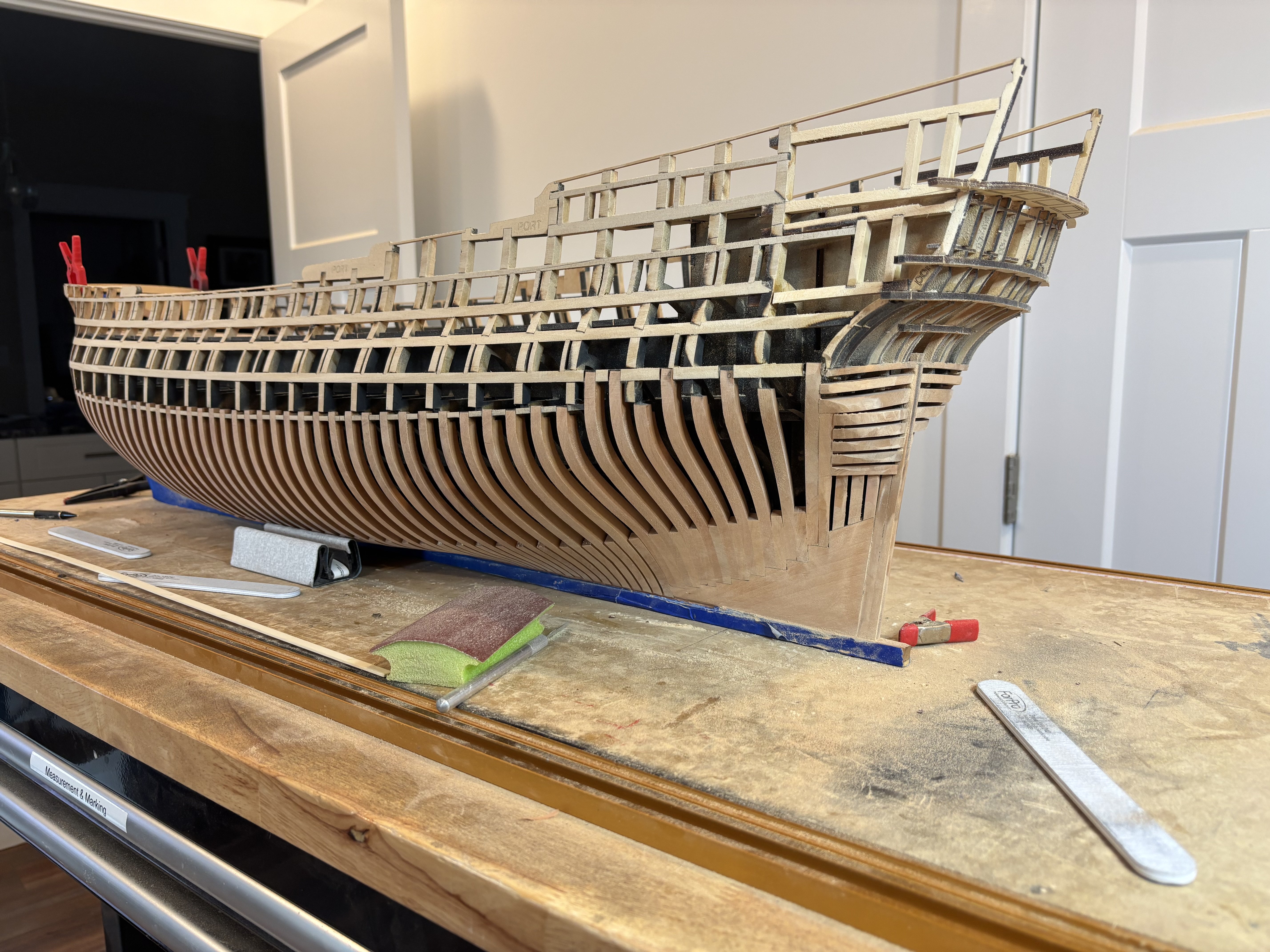

Chapter 1 has now been completed with all framing done.
Lots of sanding and fairing of the hull has begun, this is going to take time and make a lot of mess.
Then Chapter 2 will start with the painting of the gunports and installation of the frieze panels.

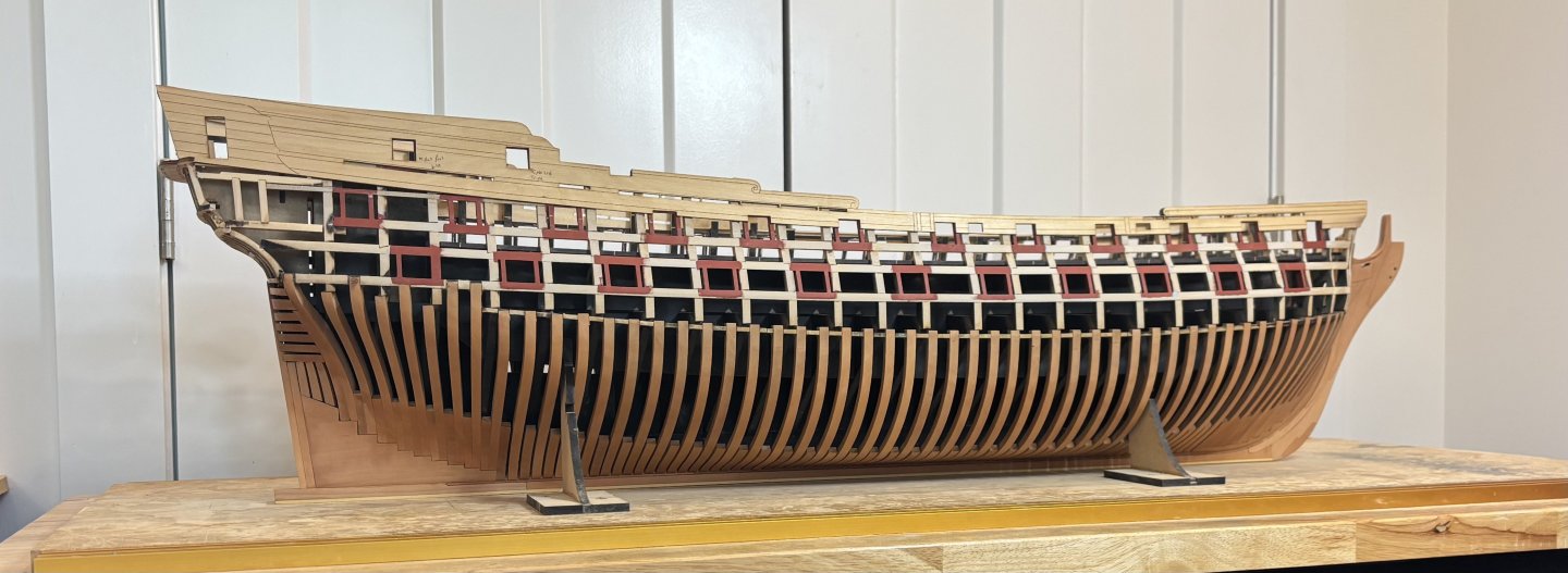

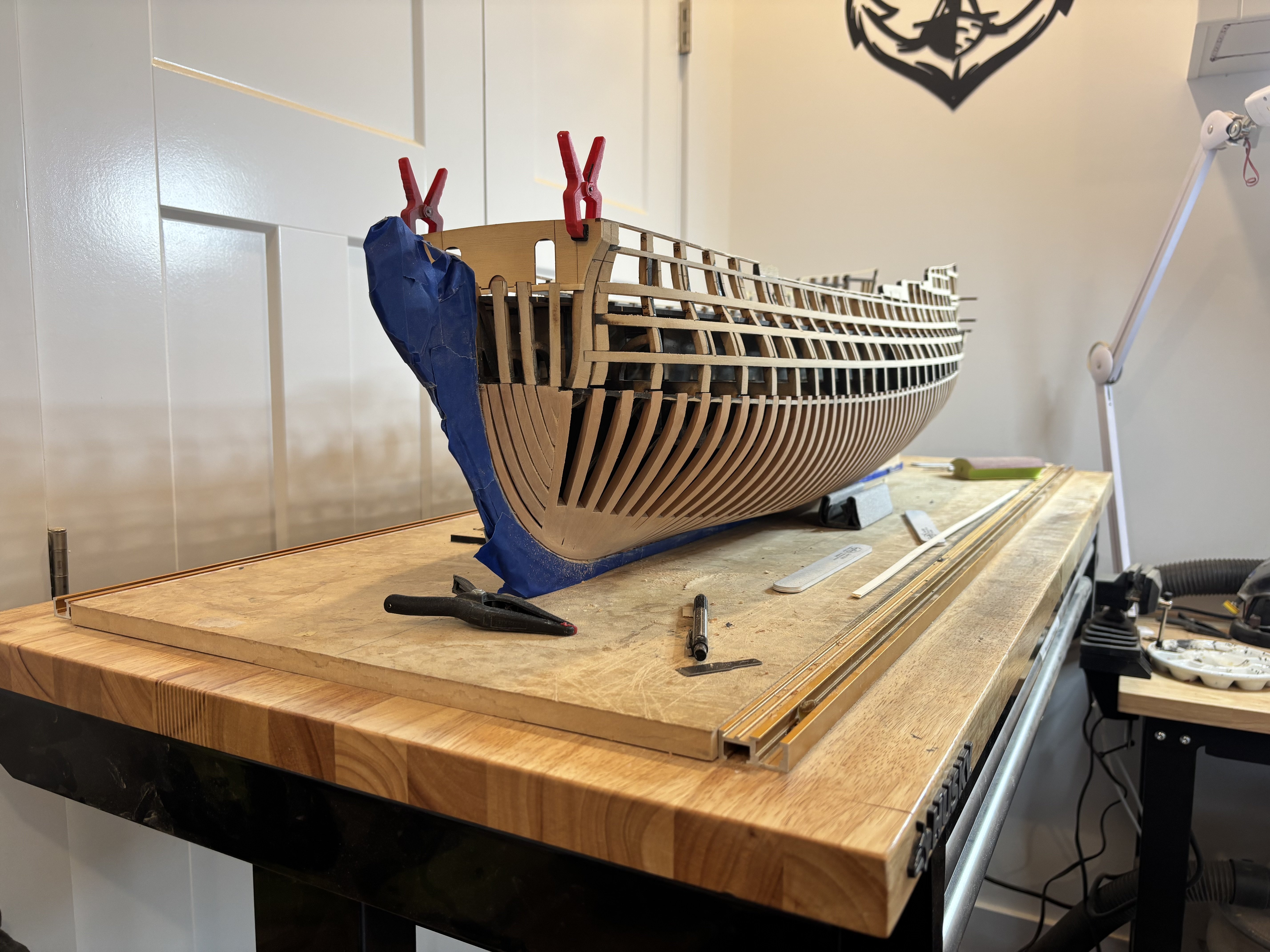

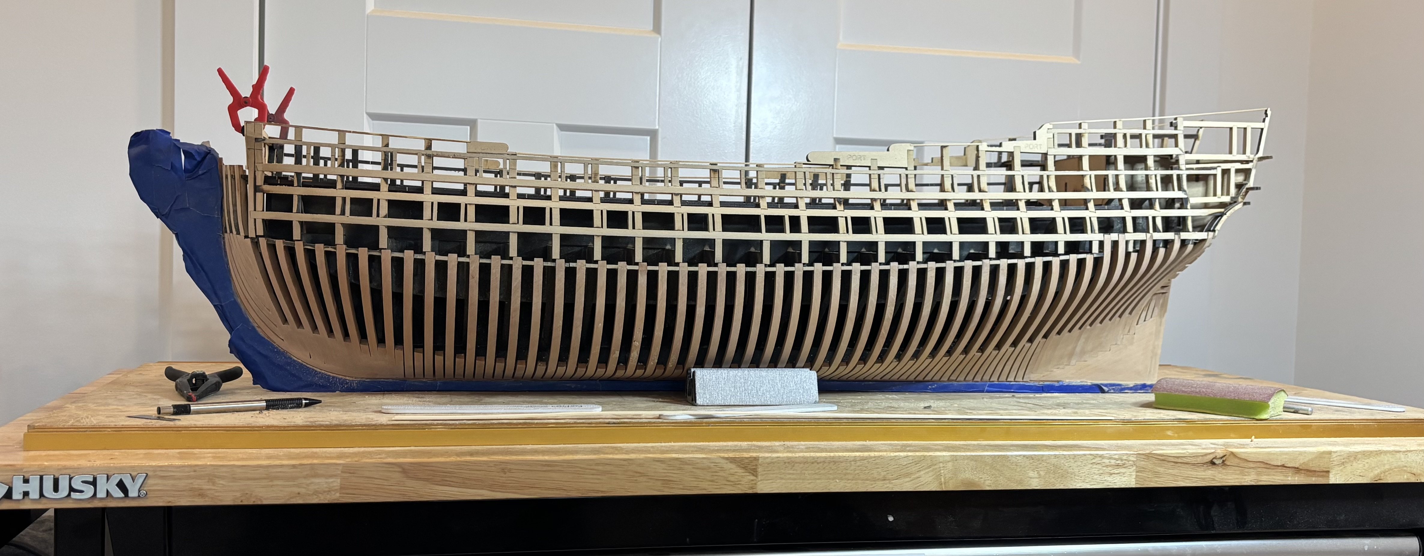

Upper hull sanding and fairing has been completed so I masked off and starting prepping the gunports for paint.
First any little gaps in and around the ports were filled with filler and then sanded gently back and then two coats of Tamiya surface primer was applied, next up will be painting the ports in red ochre, then fitting the frieze panels and finally to complete the lower hull sanding.

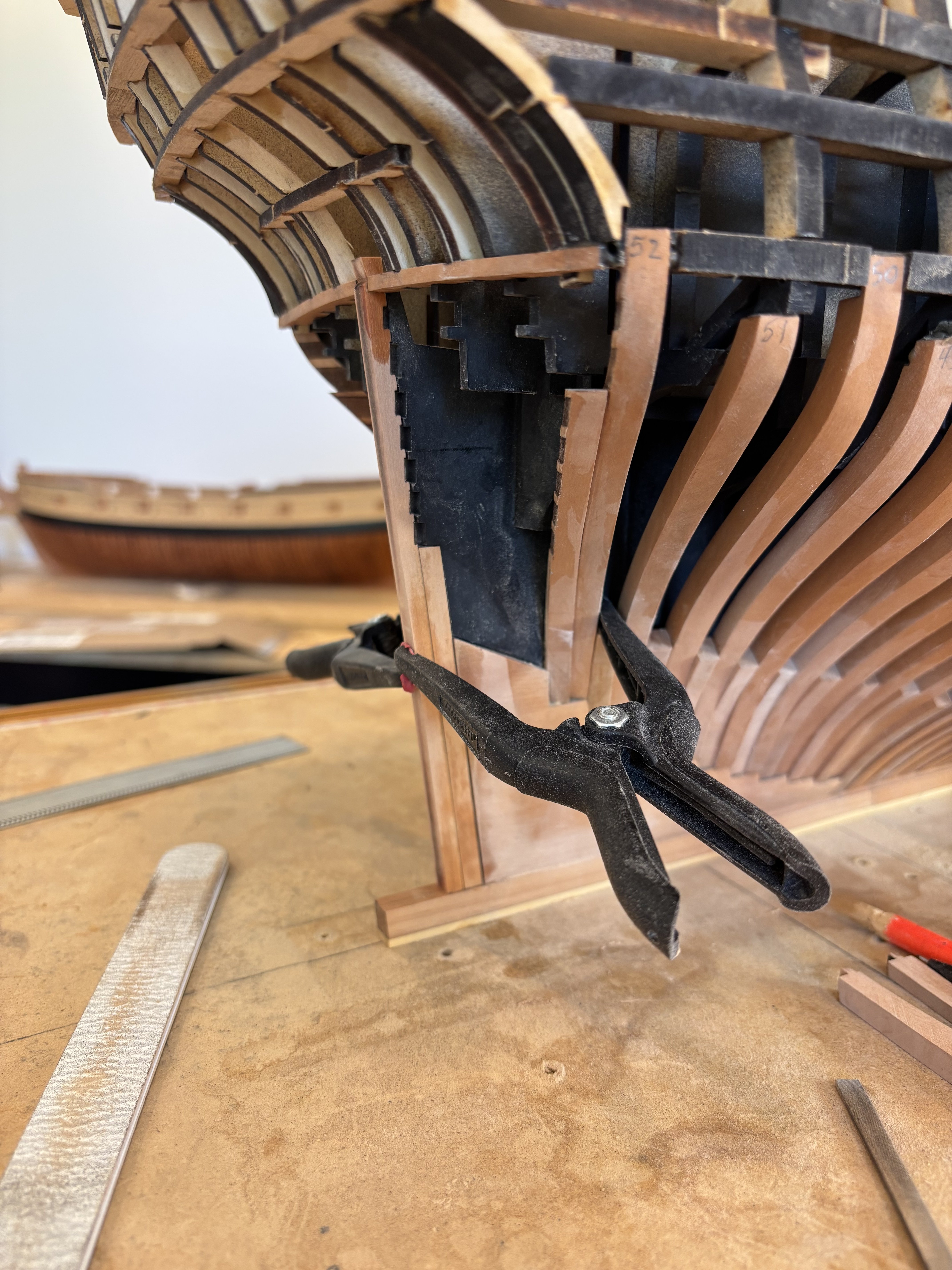

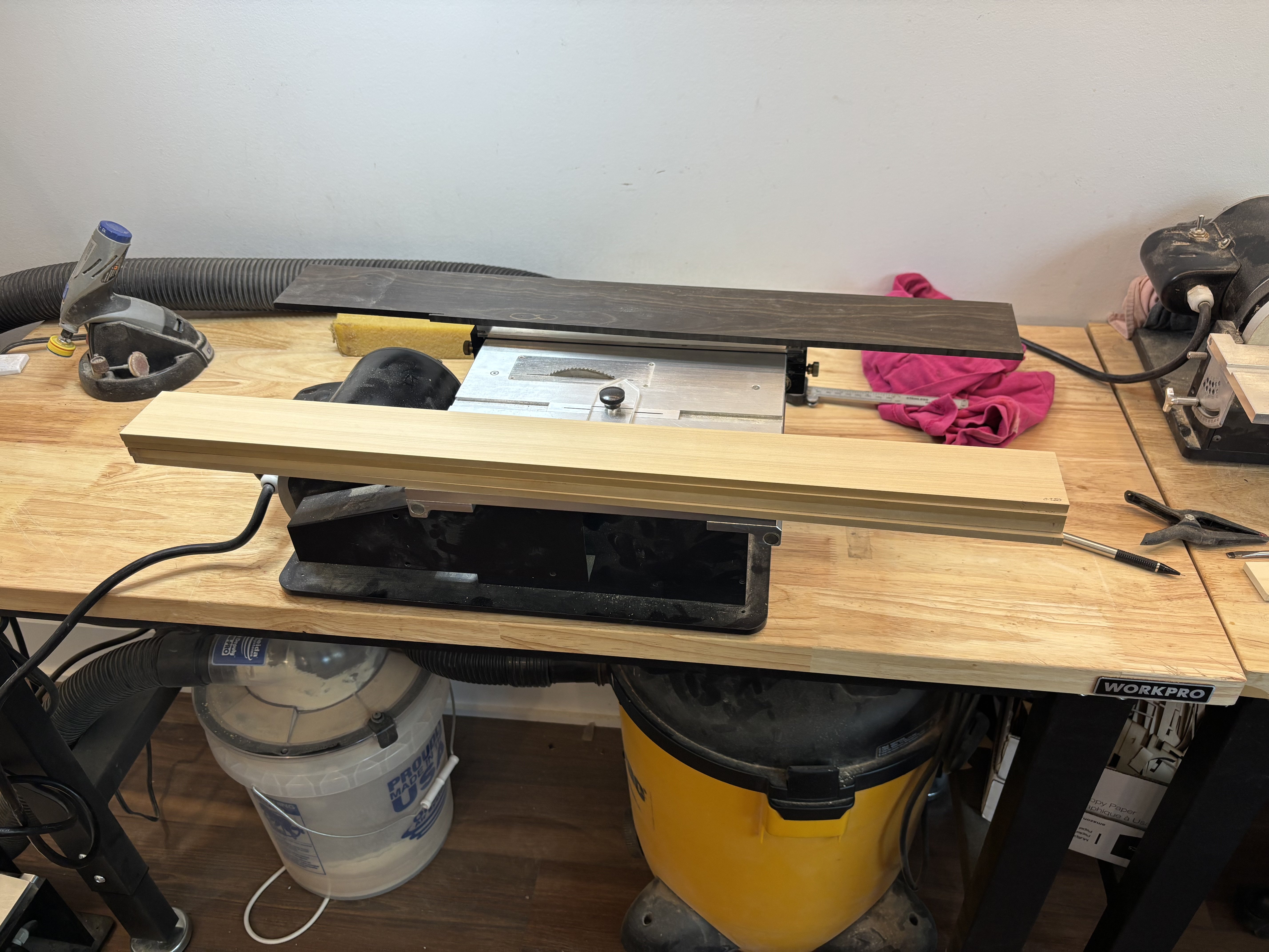

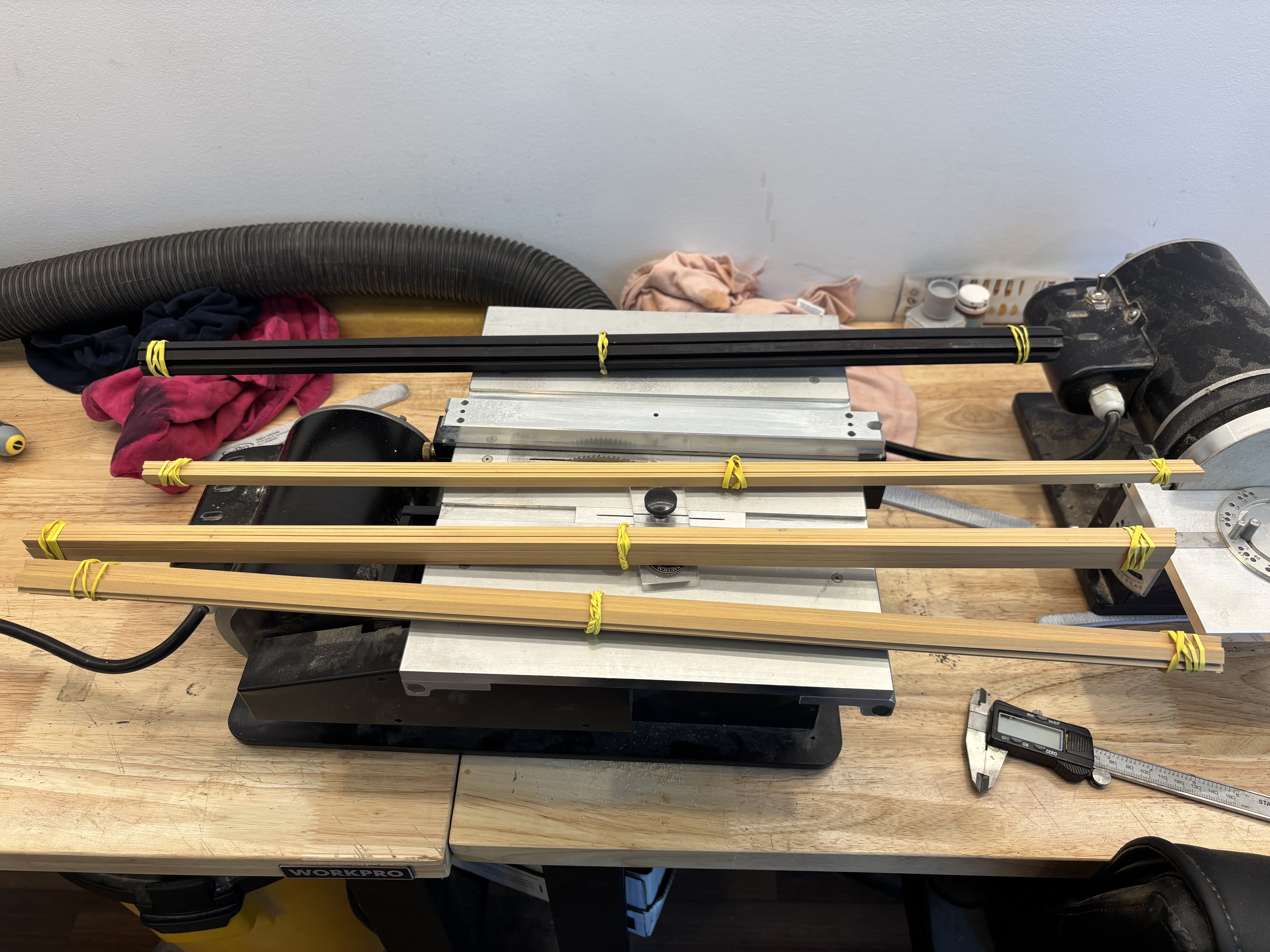

Lower hull fairing has been completed, gunports have had a coat of paint and the frieze panels are installed, currently machining down planking material while I wait for the Chapter 2 instructions.
Planking strips of different sizes all cut.
At full size and (1:48) they are as follows going downwards along the hull:-
3" ( 0.0625") thick basswood frieze panels as supplied with the kit.
3" ( 0.0625") thick boxwood from Channel wales up to the frieze panels ( 2 strakes ).
5" ( 0.1042") thick boxwood Channel wales ( 3 strakes )
4" ( 0.0833") thick boxwood thickstuff above wales ( 4 strakes )
5.5" ( 0.1145") thick ebony black strake ( 1 strake )
6" ( 0.125") thick ebony Main wales ( 4 strakes )
4" ( 0.0833") thick Holly thickstuff below wales ( 1-2 strakes as required )
The sizes above came from the "scantlings" book for a 50gun 4th rate ( steel's table ).

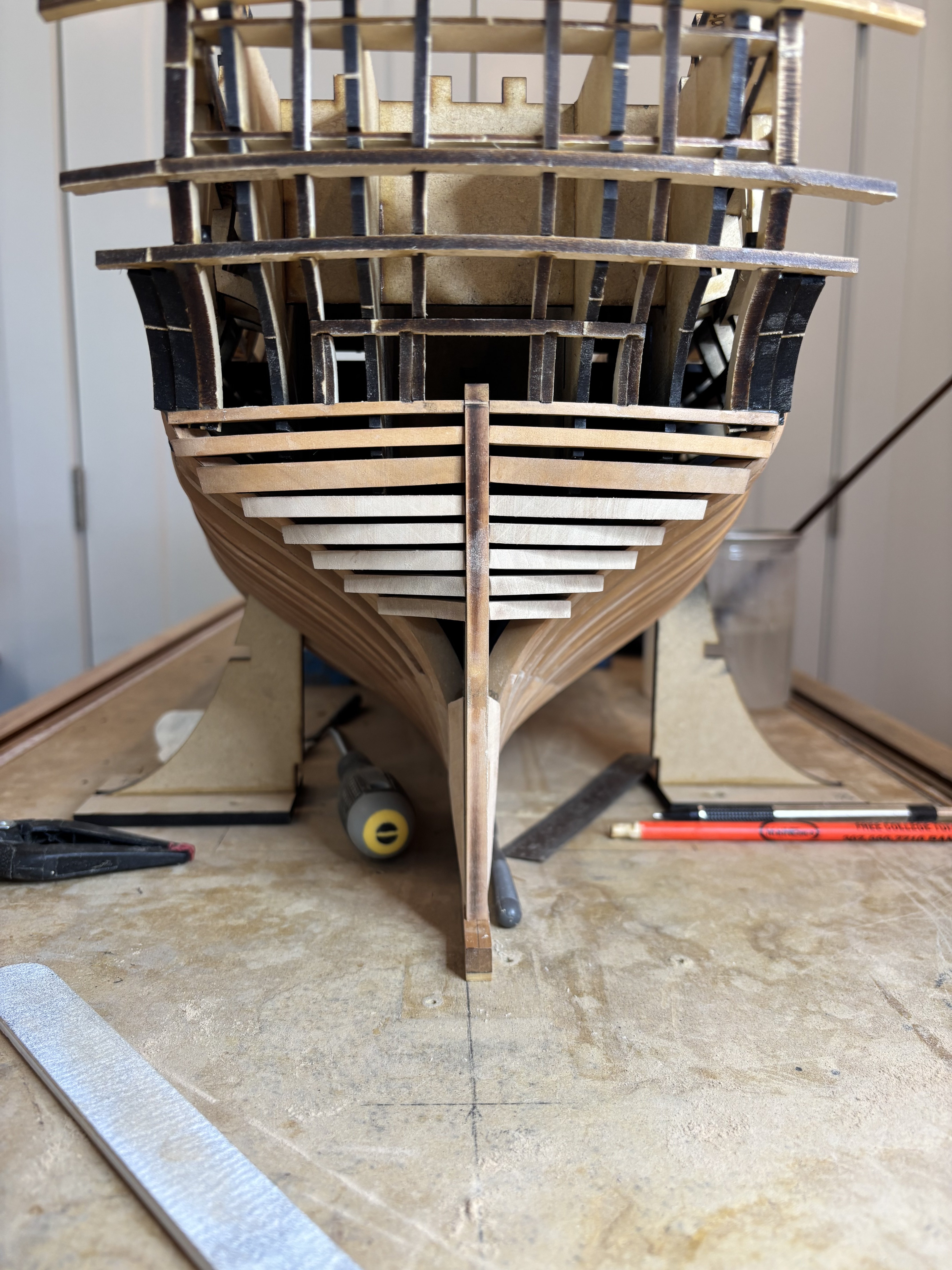

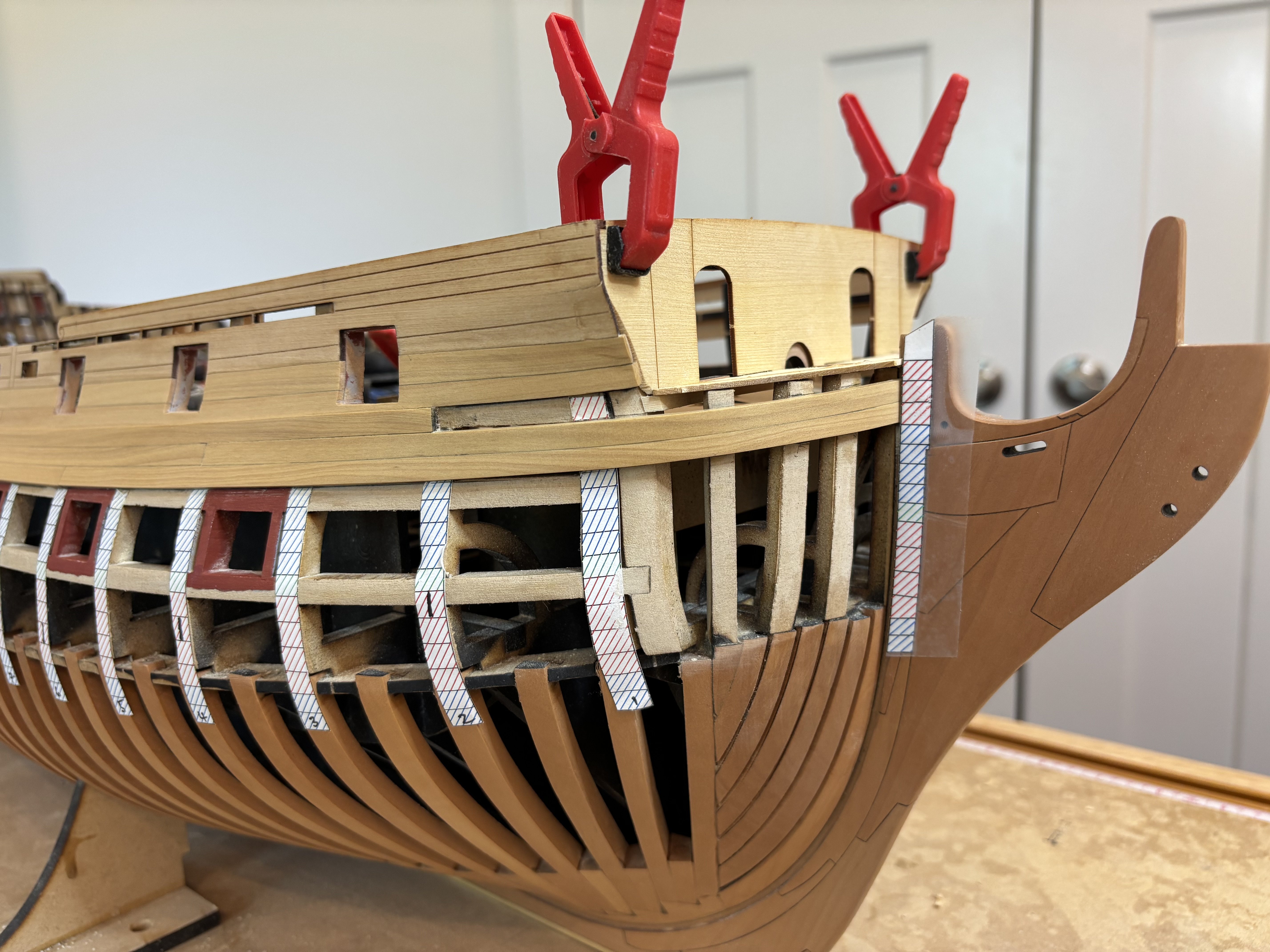

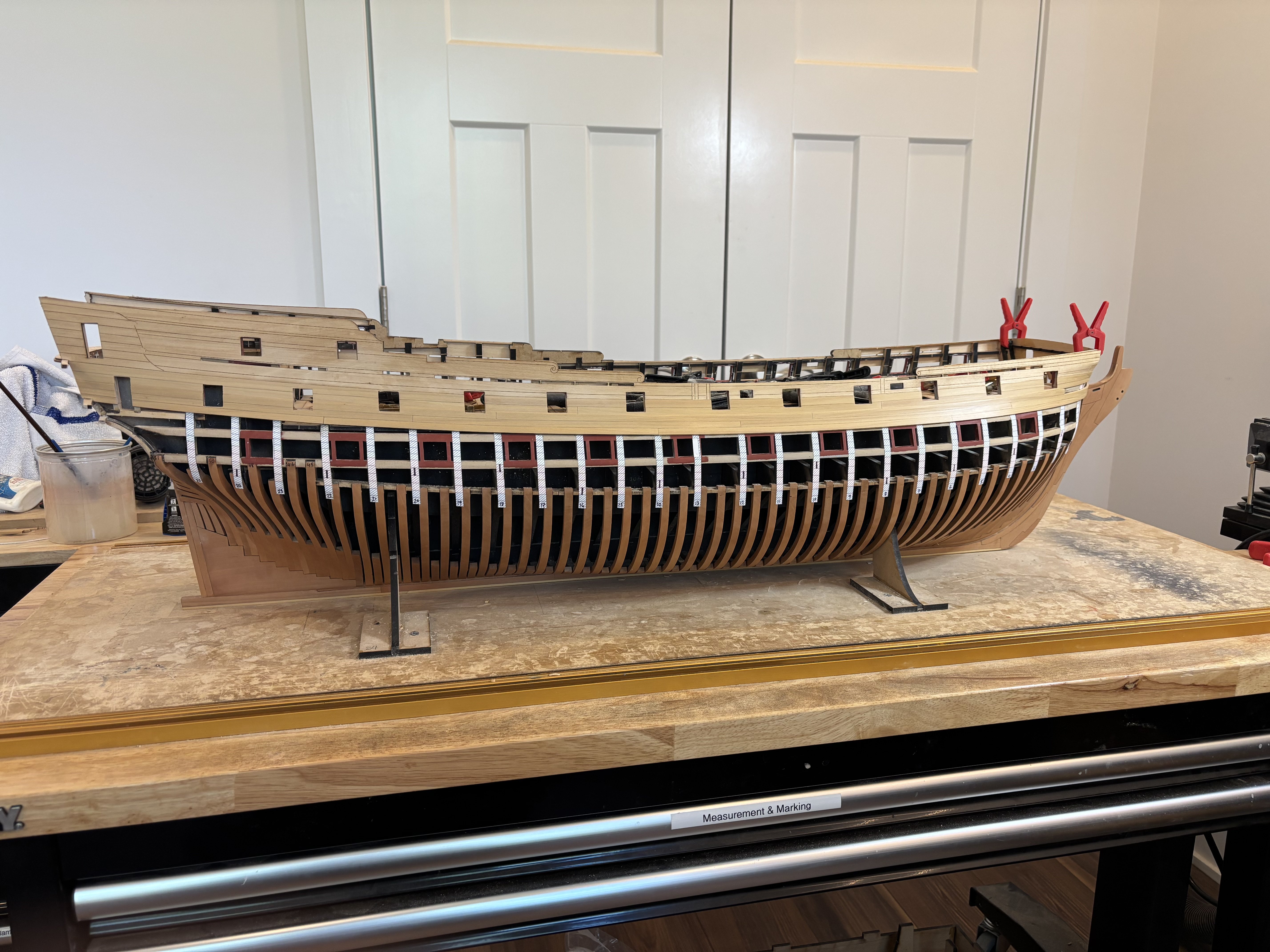

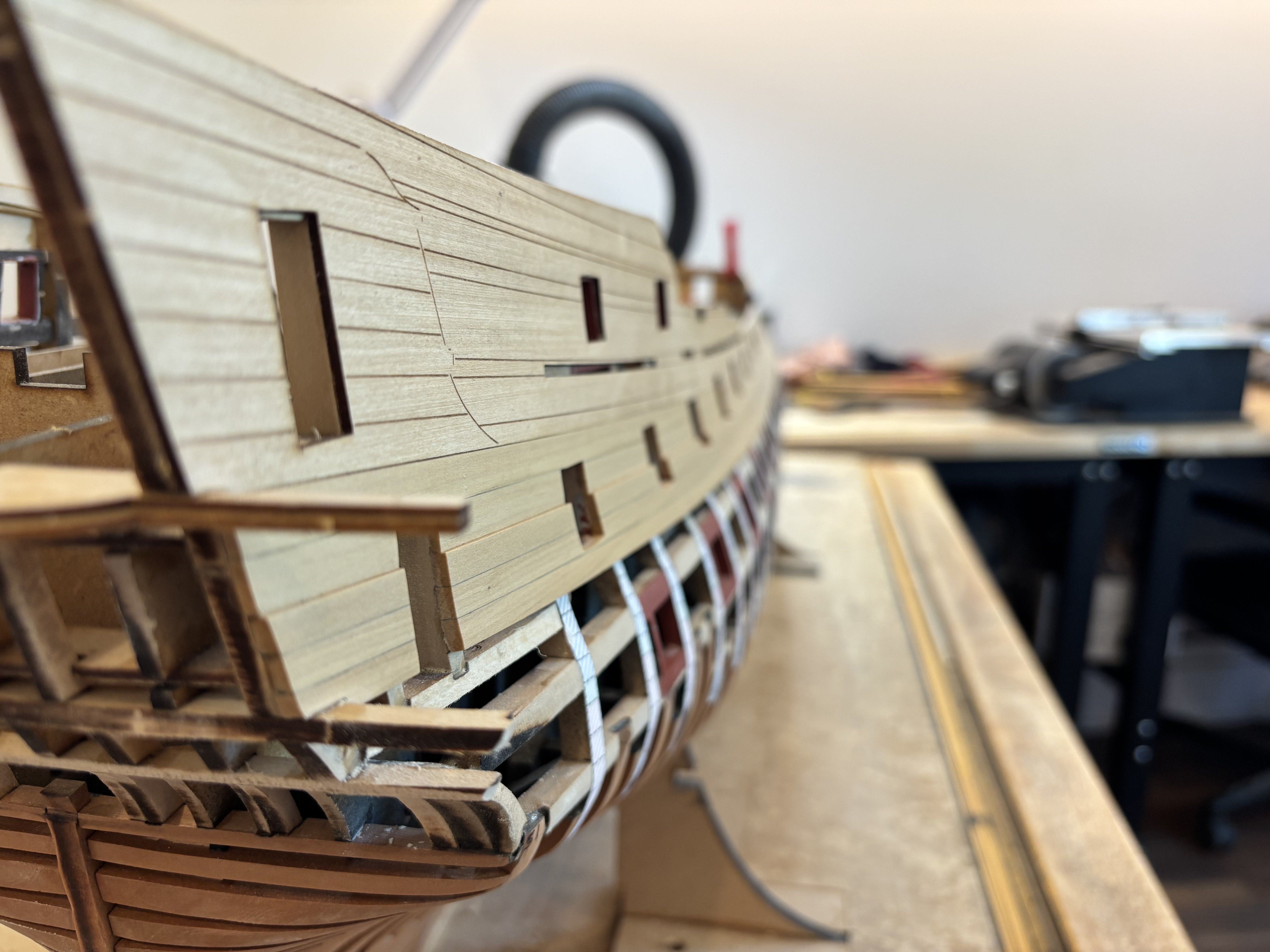

Planking on the Stbd side from the frieze panels down to and including the channel wales has been completed except for the foremost upper piece of the channel wale which the instructions say to leave out at the moment.
All of the gunports will need going back to, to be refined and repainted, the upper deck aft two and QD aft port will need the edges fixing for the port lids.
I will now move to the port side and do the same.
