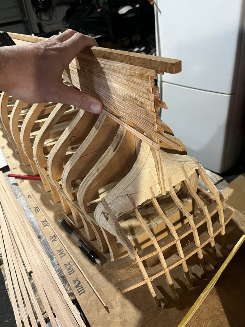

It's been some time since the last post but with other large projects like the dinghy finished here's an update.
After the frames sitting around for about a year as I dithered over how to fit internal components that were a long way down the track it was a case of just doing something rather than overthinking the project and suffering decision paralysis.
So, the frames were cut and assembled with the keel on the building jig.
Below is a test fit before glue with the frame interiors still solid. These were hollowed out before assembly.
The stern gallery frame has been assembled. This involved a lot of thought and trial and error due to the vagaries of transferring a 2D plan into a three dimensional shape. I worked on the theory that as long as I had fixed and known points at the taffrail (The building board base) and accurate gallery window voids (created with temporary spacer blocks) the rest should follow.
Fairing of the hull framing followed, with some blocks at bow and stern the help with the plank fit.
After adding upper and lower gunport sills planking is now underway. I'll double plank the hull to give a solid base for the more tidy second planking.
I'm using Douglas Fir left over from the mast build on my sailing dinghy and will use matai for the visible portions of the second planking to take advantage of the nice honey tone and hardness. The bottom will likely be coppered anyway.
I'll add a layer of wales as I get closer to them and the upper bulwarks will likely had a 1.5mm ply first layer rather than planking, allowing gunports to be cut and lined easily.
The lines are starting to appear.
