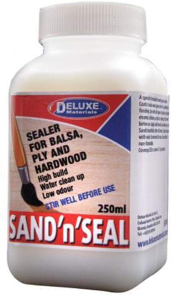

As an aside, I would always first apply sanding sealer to the applicable part(s), very lightly sand, THEN paint.  That way you won't get odd differences in paint absorption between the wood and any filler.
