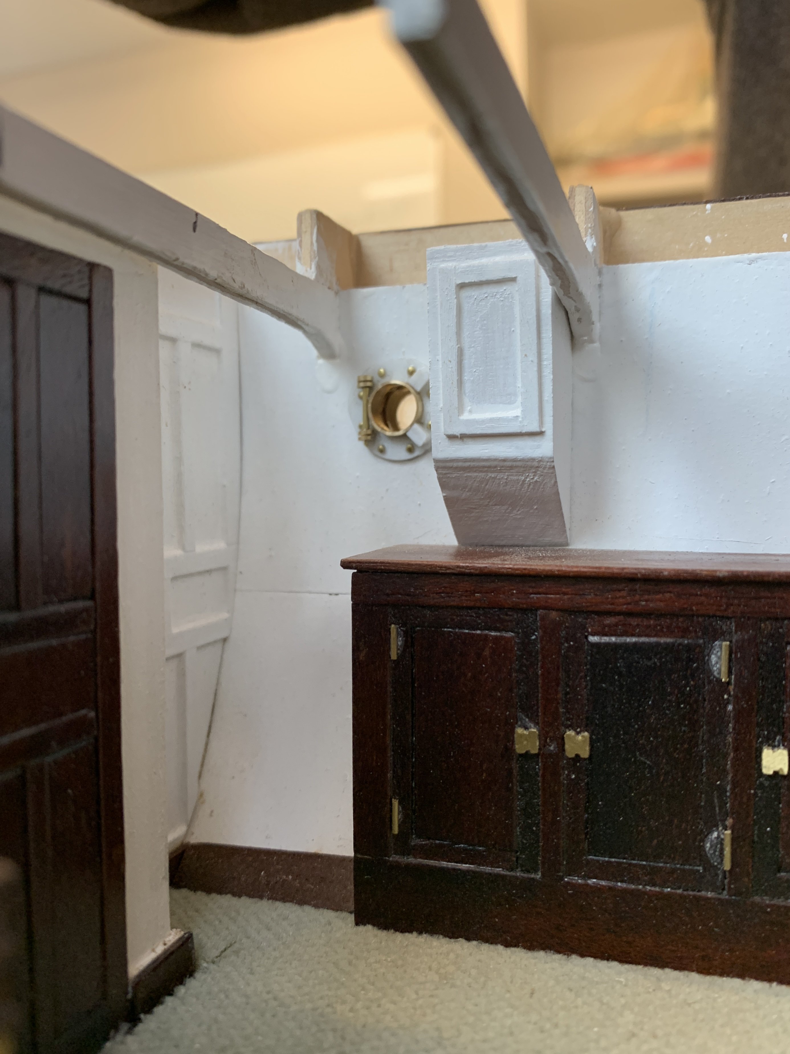

I need to finish off a few bits of internal detail in the owners cabin. The portholes were the major outstanding parts.

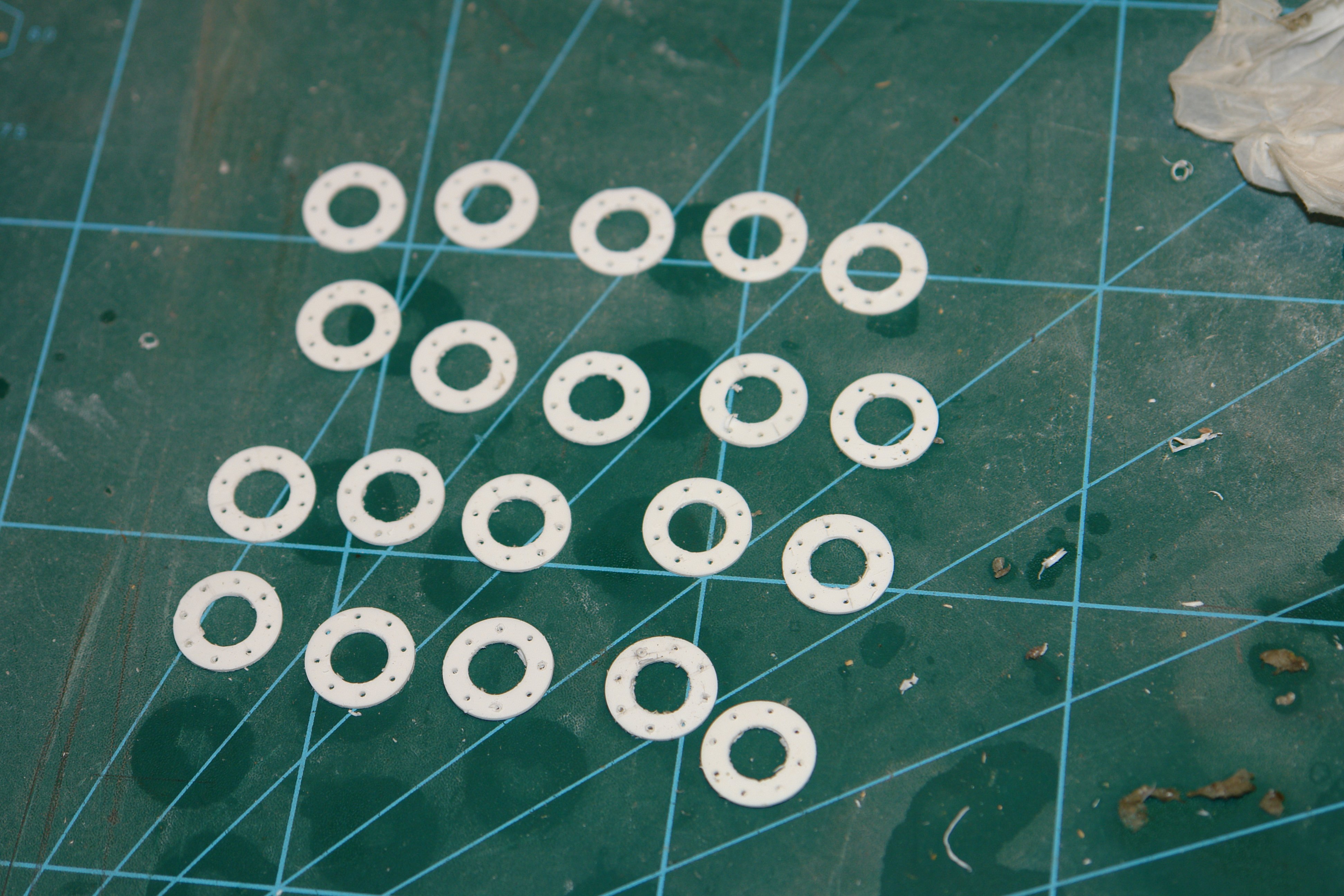

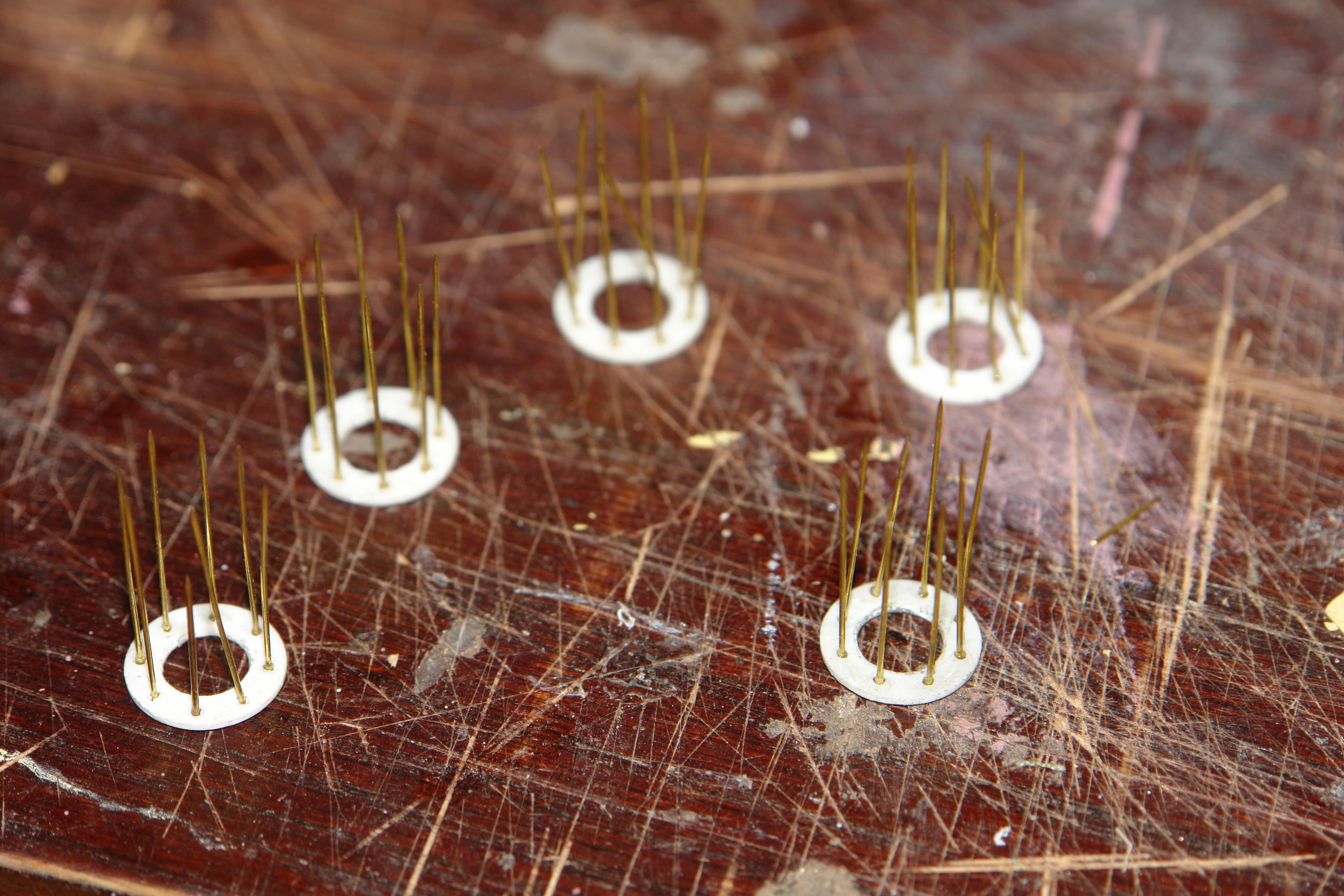

The bolted flange of the porthole is the most obvious feature. It is painted white to match the internal finish of the room. I made all the flanges that I needed in one go - 20 in all. I made the flanges from 1/32" plasti-card cut from sheet.
DSC03443.thumb.JPG.3f4b298d4c5240871dd5f67e9e3d32c5.JPGDSC03445.thumb.JPG.60a2958e5d14b6820f222cca46a5d6b7.JPG

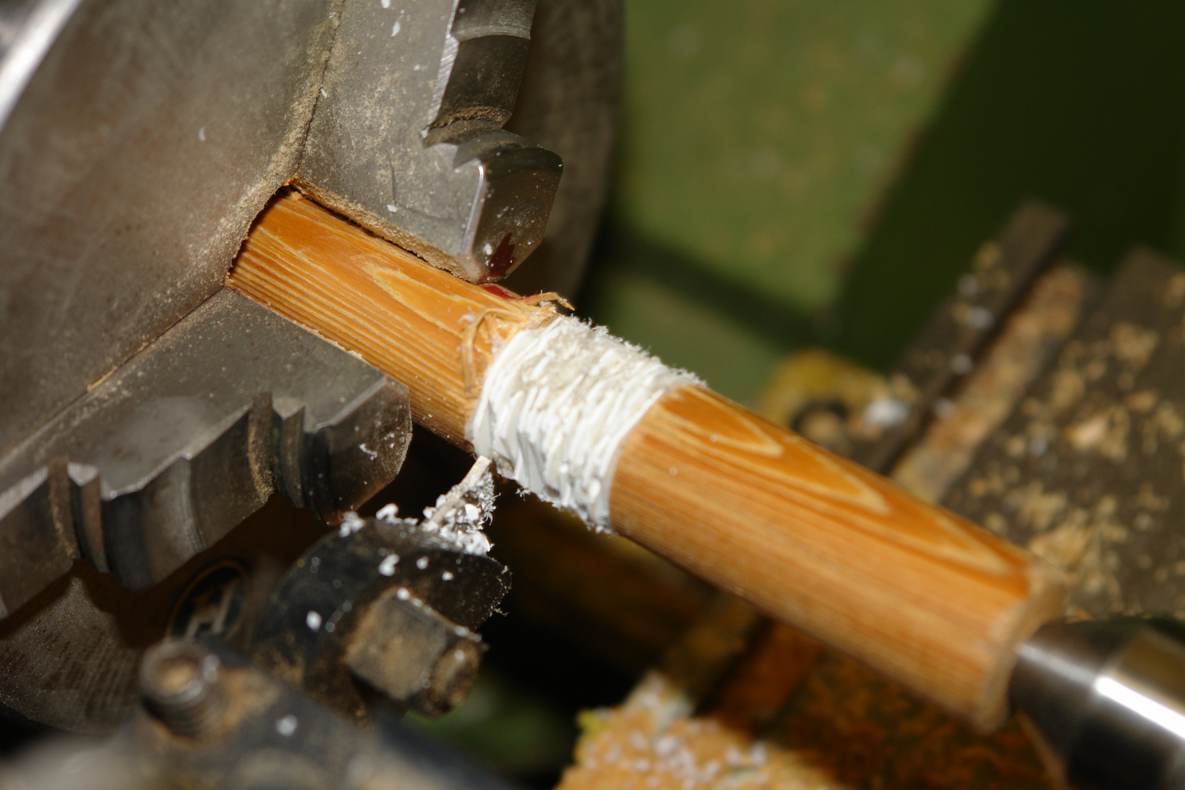

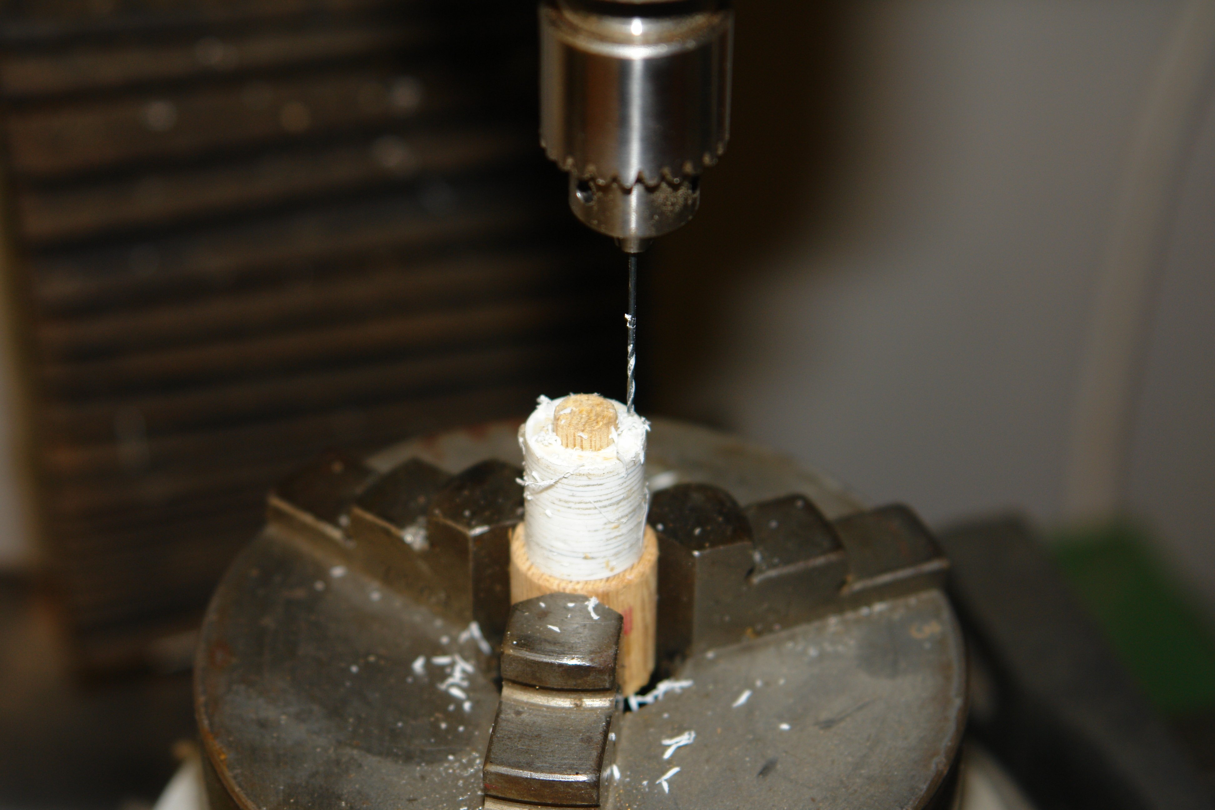

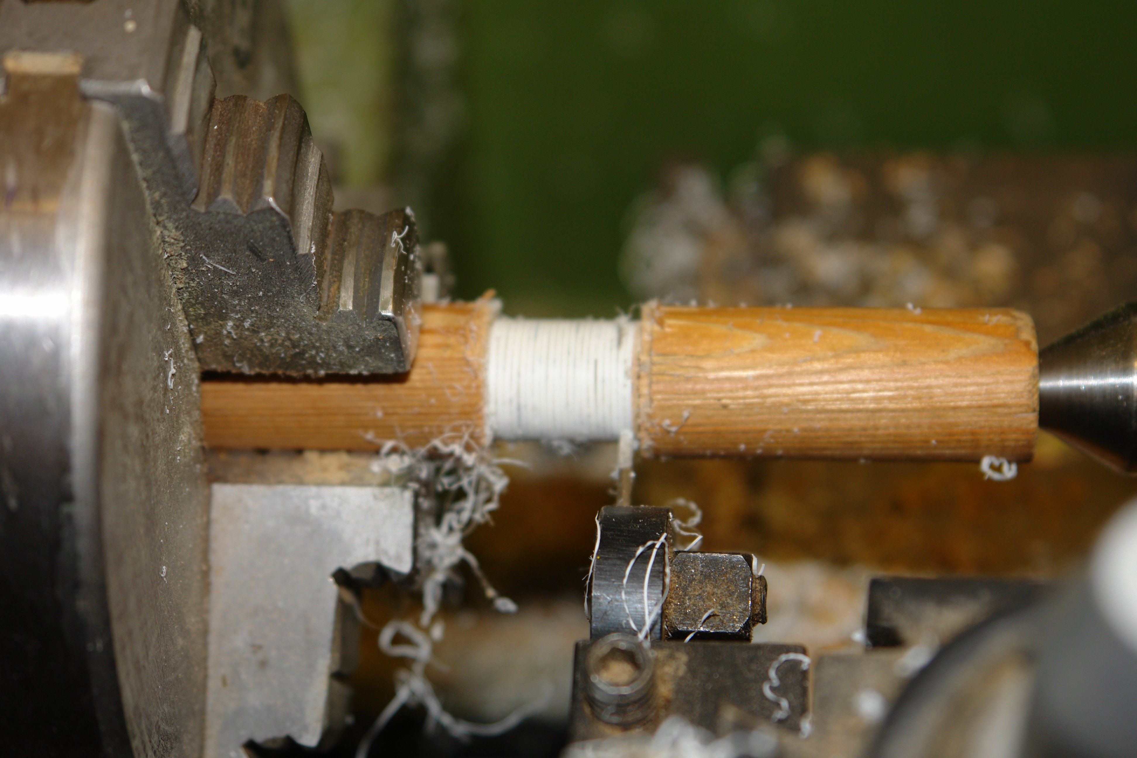

I then drilled each piece to form the bores of the flanges. These were all mounted on turned spigot of dowel with double sided tape holding them together. A hollow section of dowel was then used to compress and retain the pieces, the compression being provided via the tailstock.
The flanges were then cut to size on the lathe.
The assembly was then taken off the lathe and the flange holes were drilled on the mill using a rotary table.
The finished flanges were then separated using white spirit.

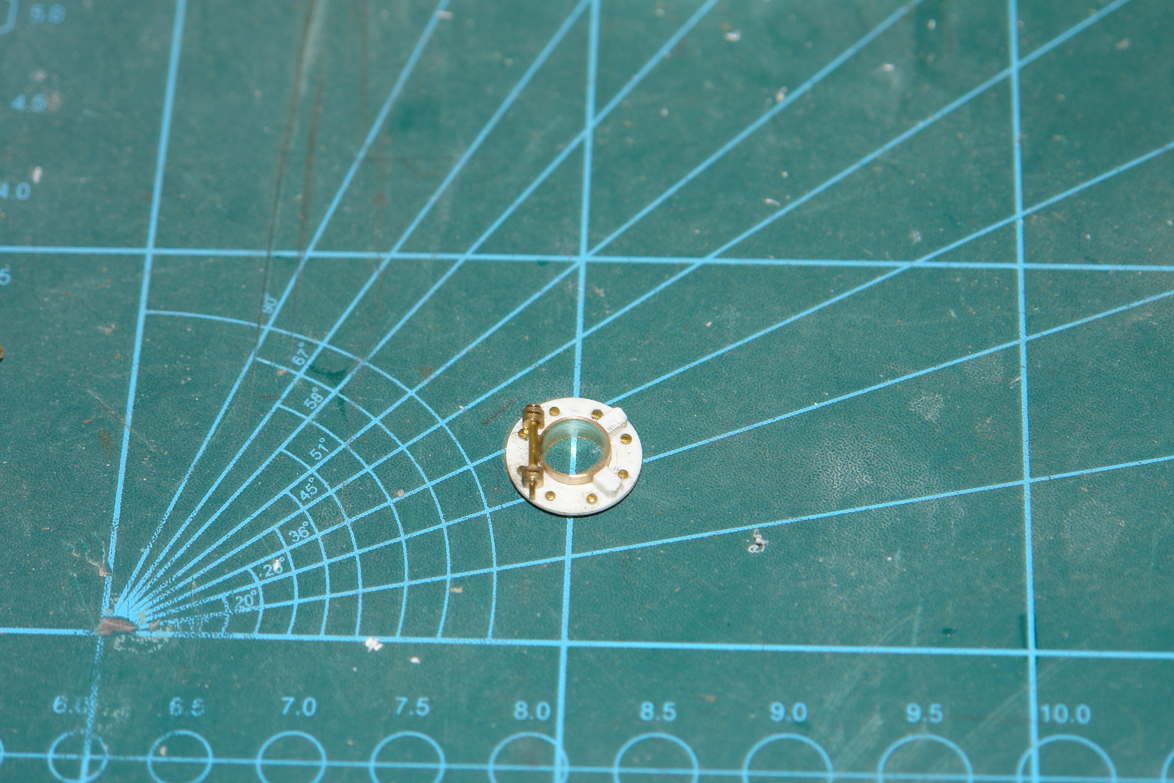

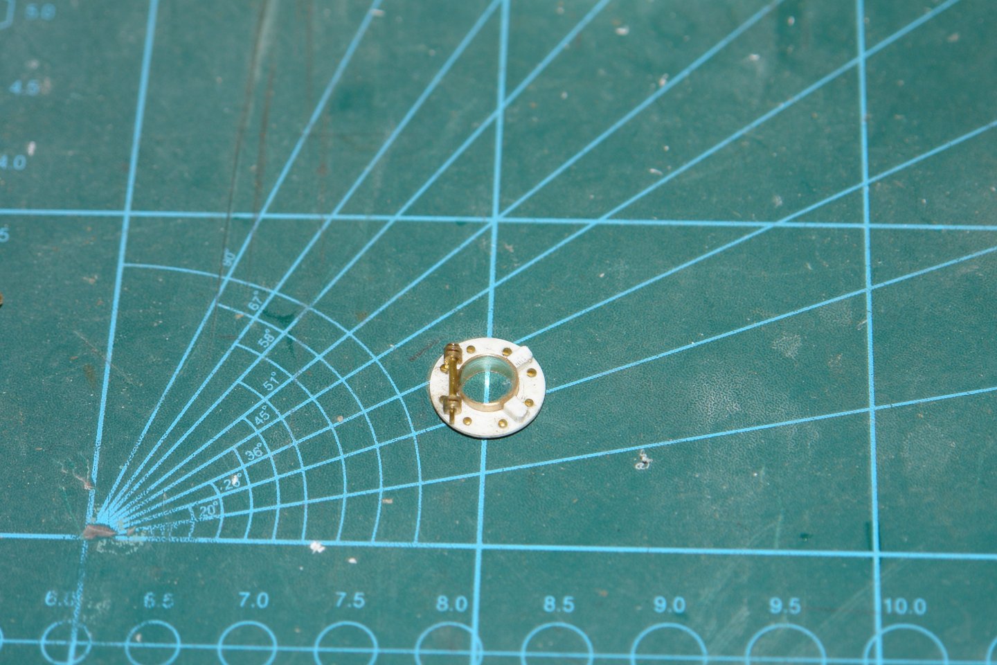

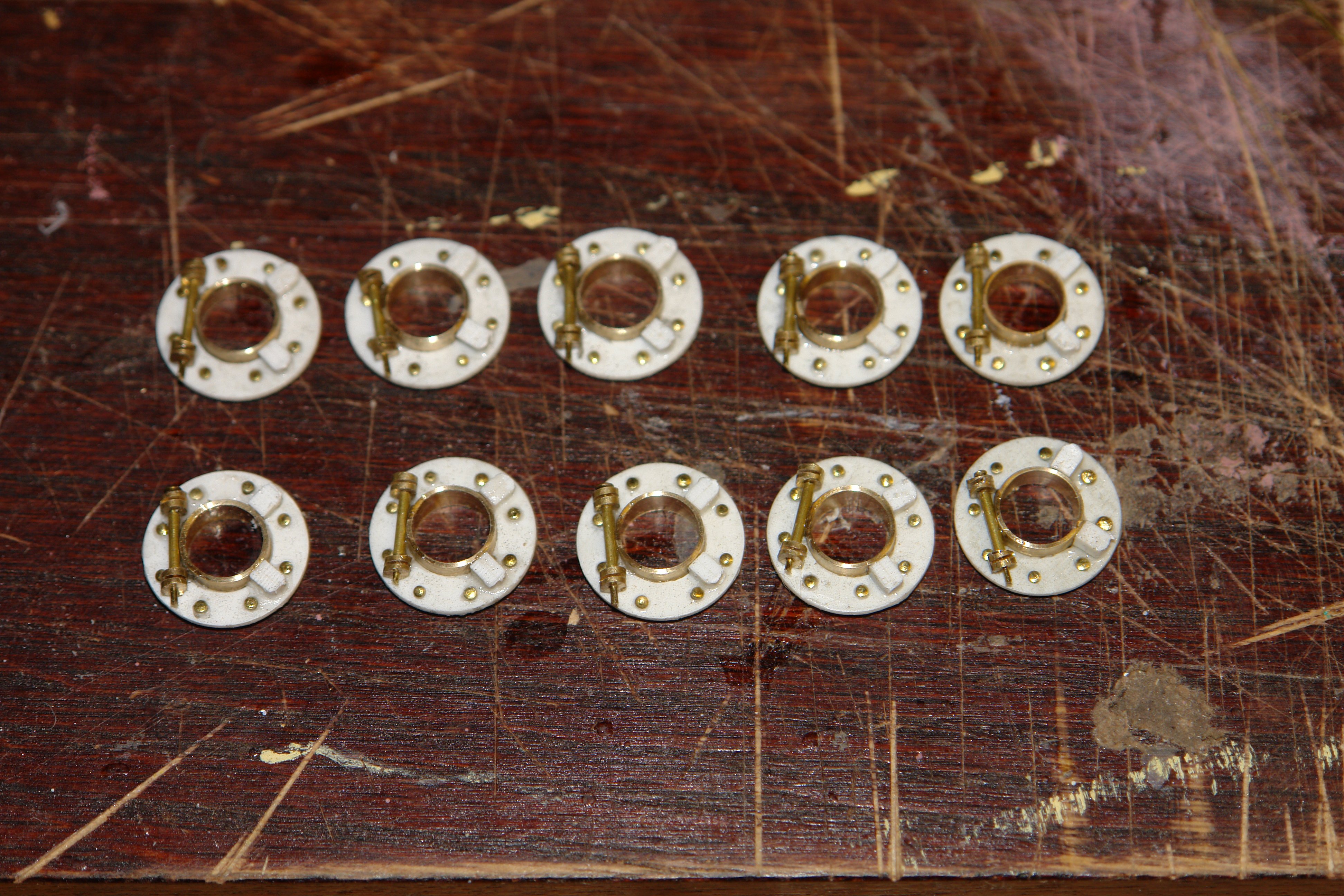

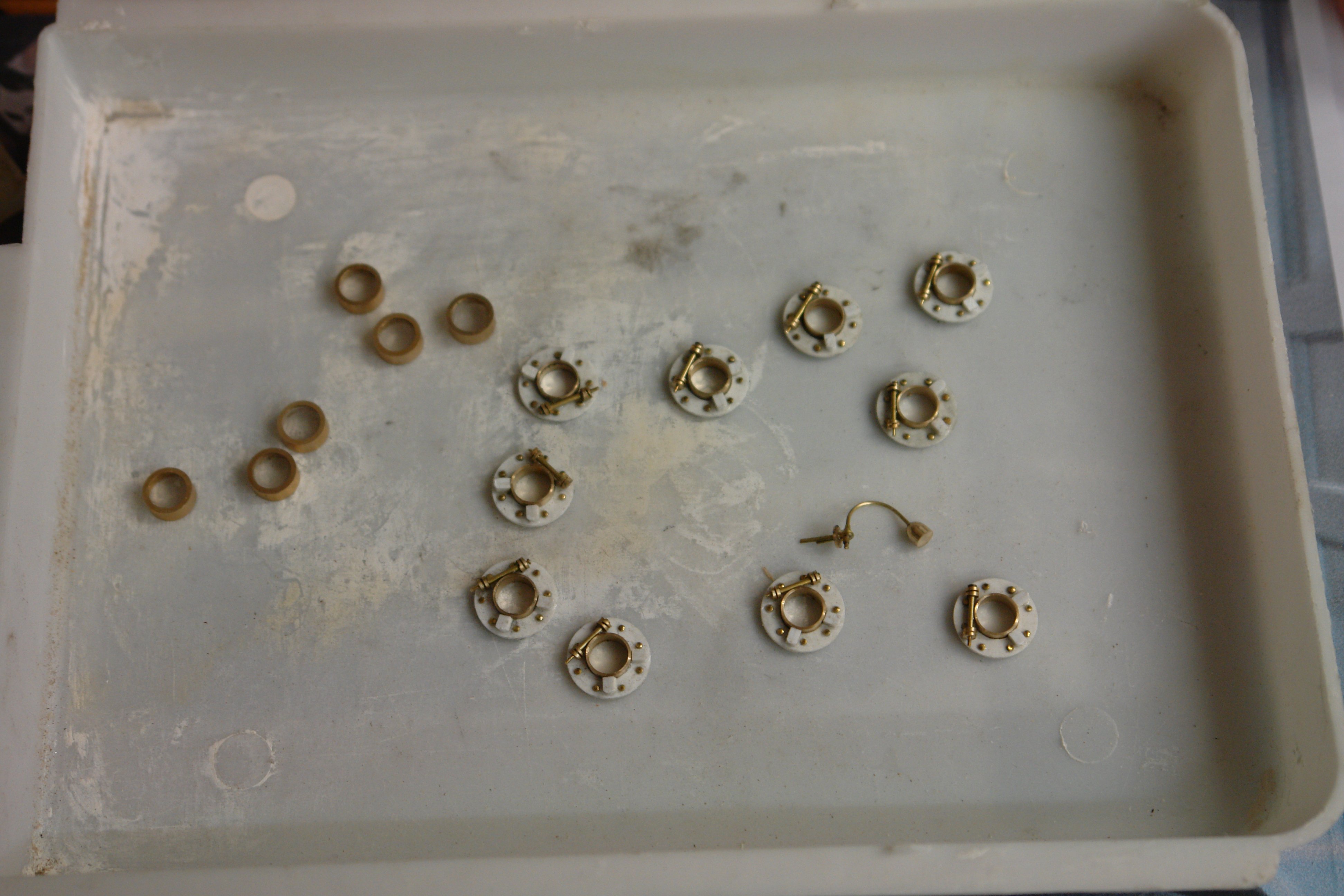

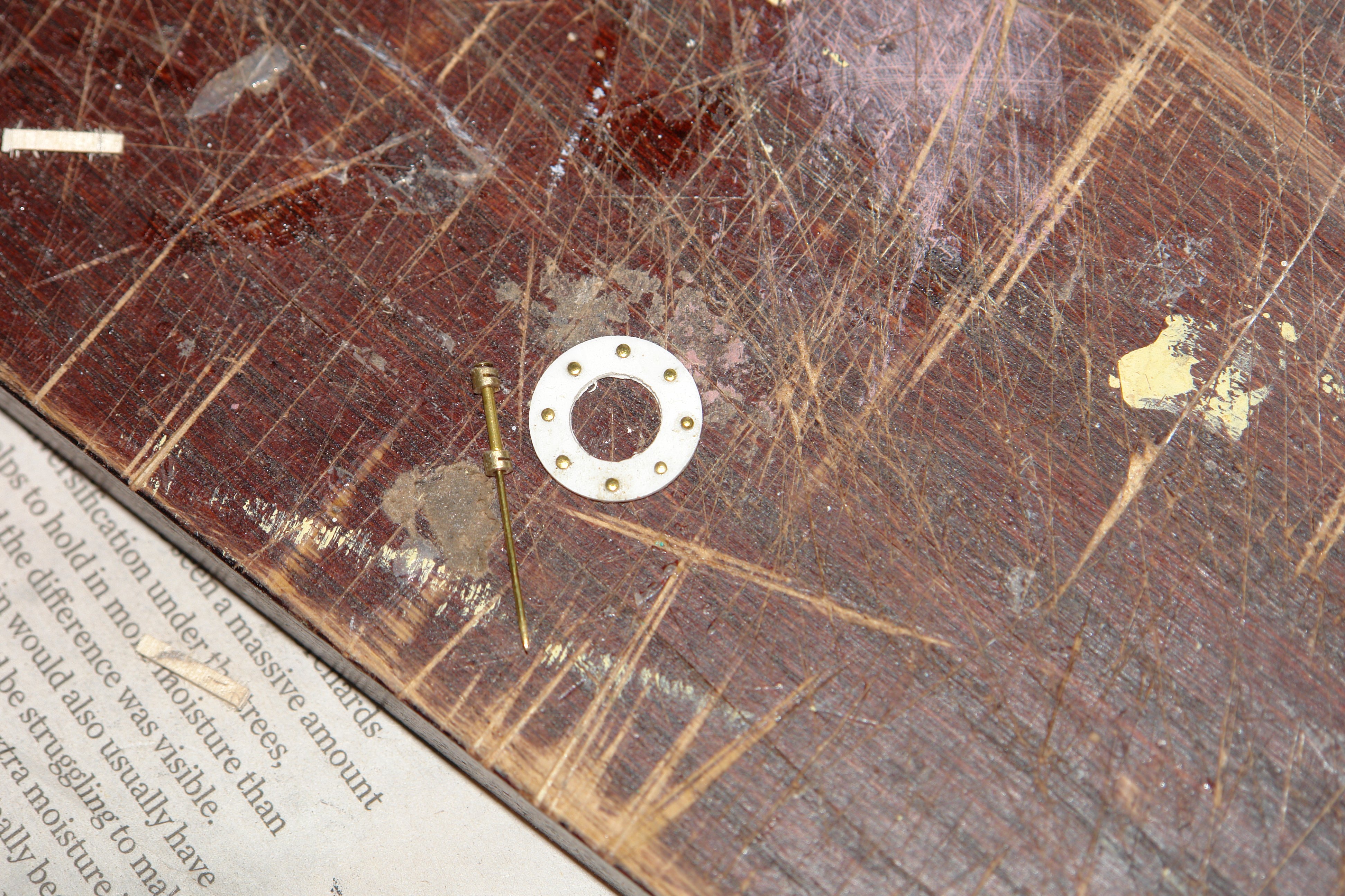

I then fitted the rivets (brass pin heads) to one flange and made a simulated hinge from a pin and bits of brass tube.
Simplified lugs for the closures were made from plasti-card followed by assembly.
Having made one I proceeded with another 9. The other 10 will be left for later.

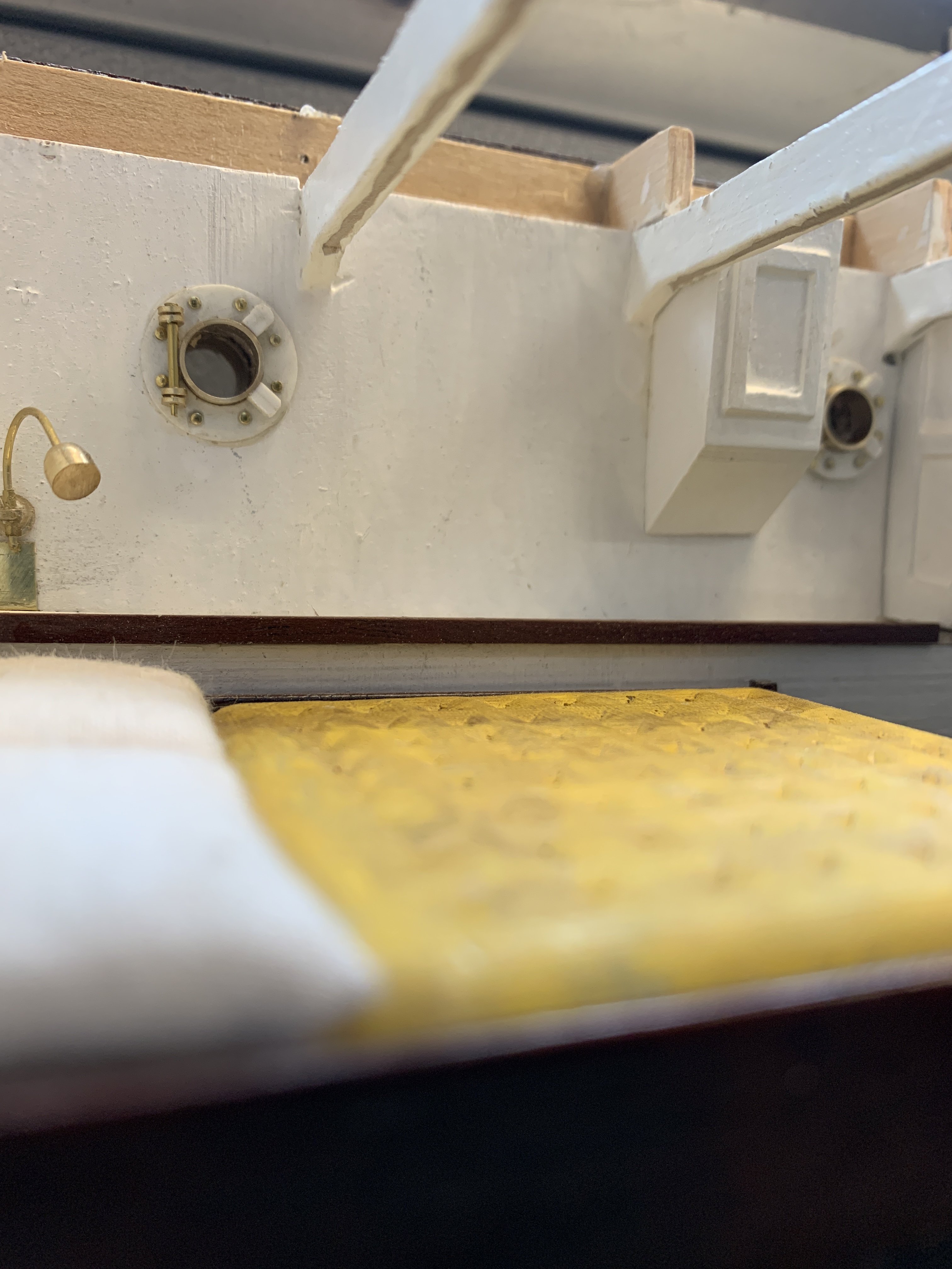

At this stage I also made the bedside wall mounted light - among the portholes in the next photo.
The portholes are actually mounted in recesses in the walls but this was a a detail that I thought I could do without.

On 12/8/2025 at 6:27 PM, Rick310 said:
Keith, how did you drill the holes in the flanges for the portholes?
Rick - Drilled individually using the mill as a drill press with an 8mm brad point wood drill.

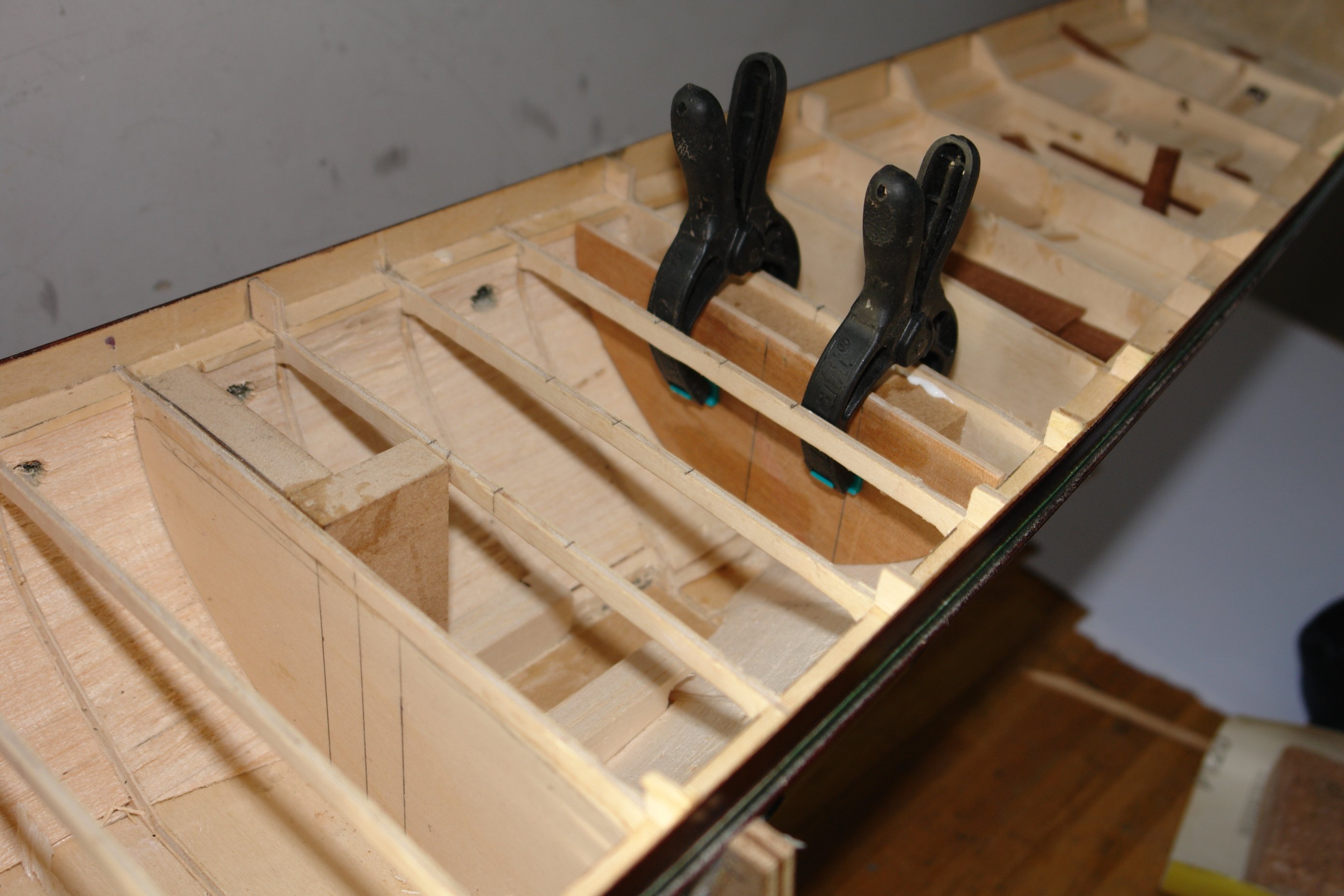

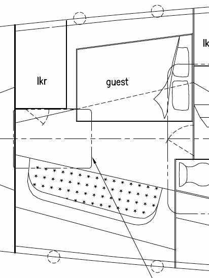

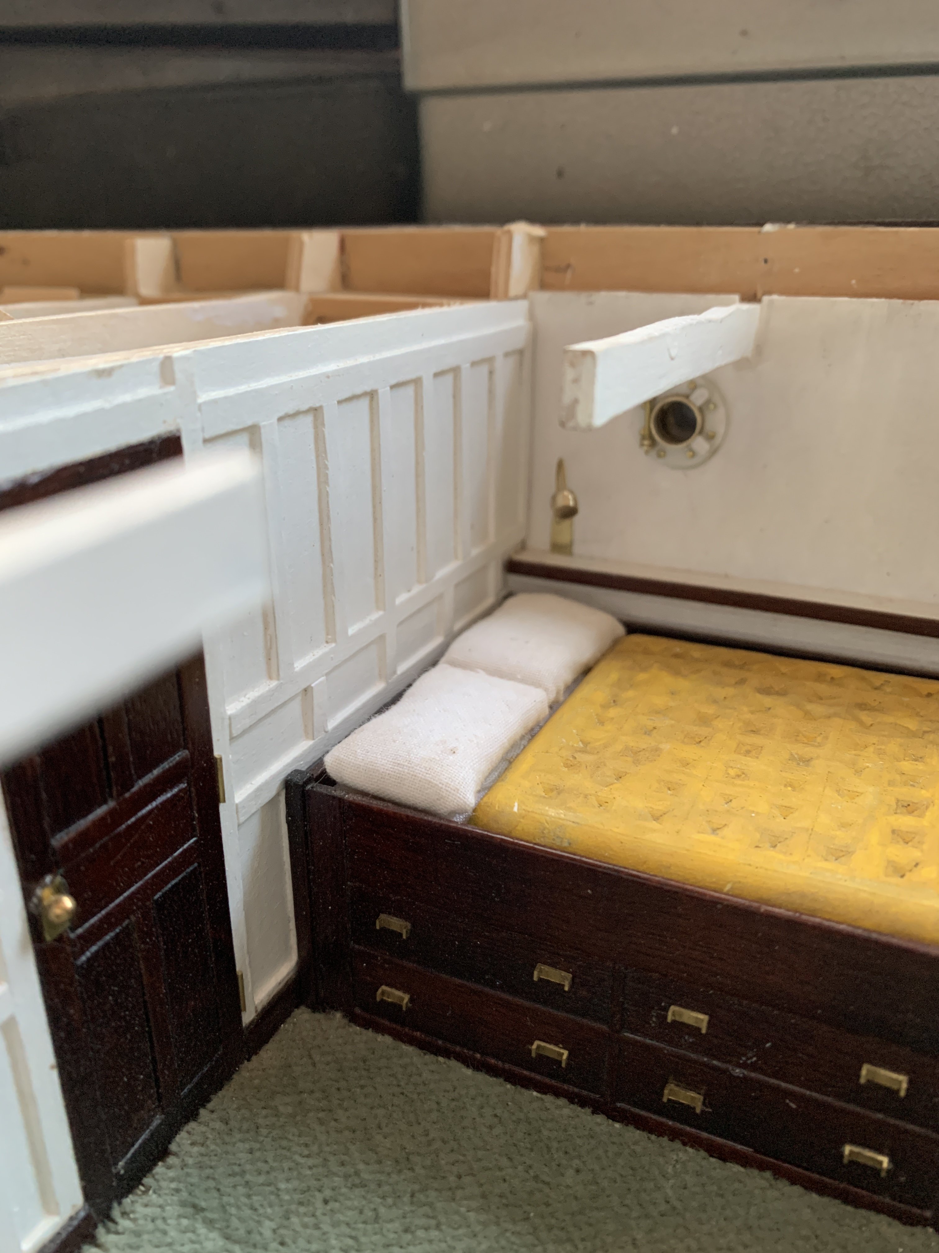

Moving onwards I have started the aft most guest cabin. Constrained to fit into the narrowing hull, over the prop shaft and near the screw this cabin was presumably reserved for the mother-in-law. The plans for this room are markedly different to the available photo's.
On the plan this cabin has a "sort of" double berth - constrained to narrow markedly at the foot end. On the starboard wall is a large seat. A large locker is shown on the port side aft with a door opening towards the centreline.
Only the double birth remained as per the plan.

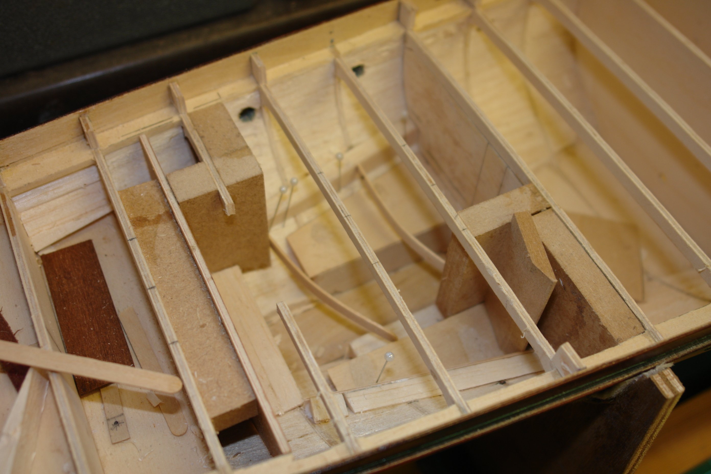

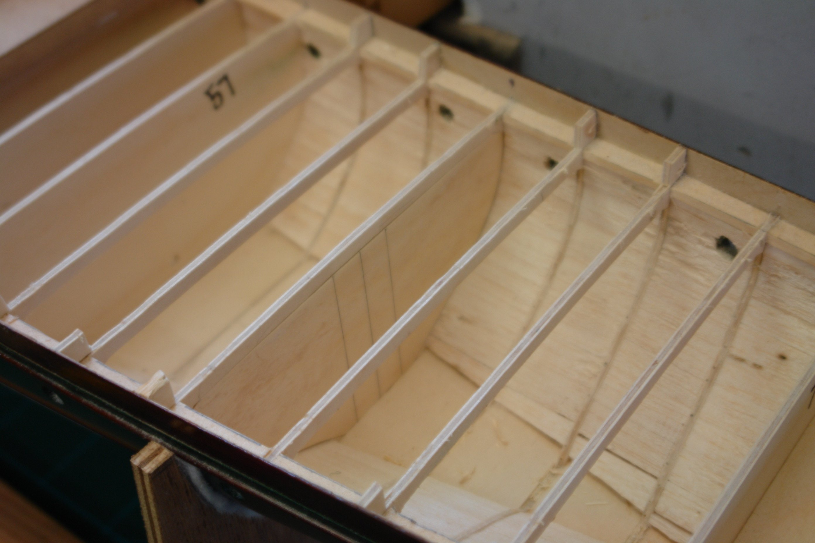

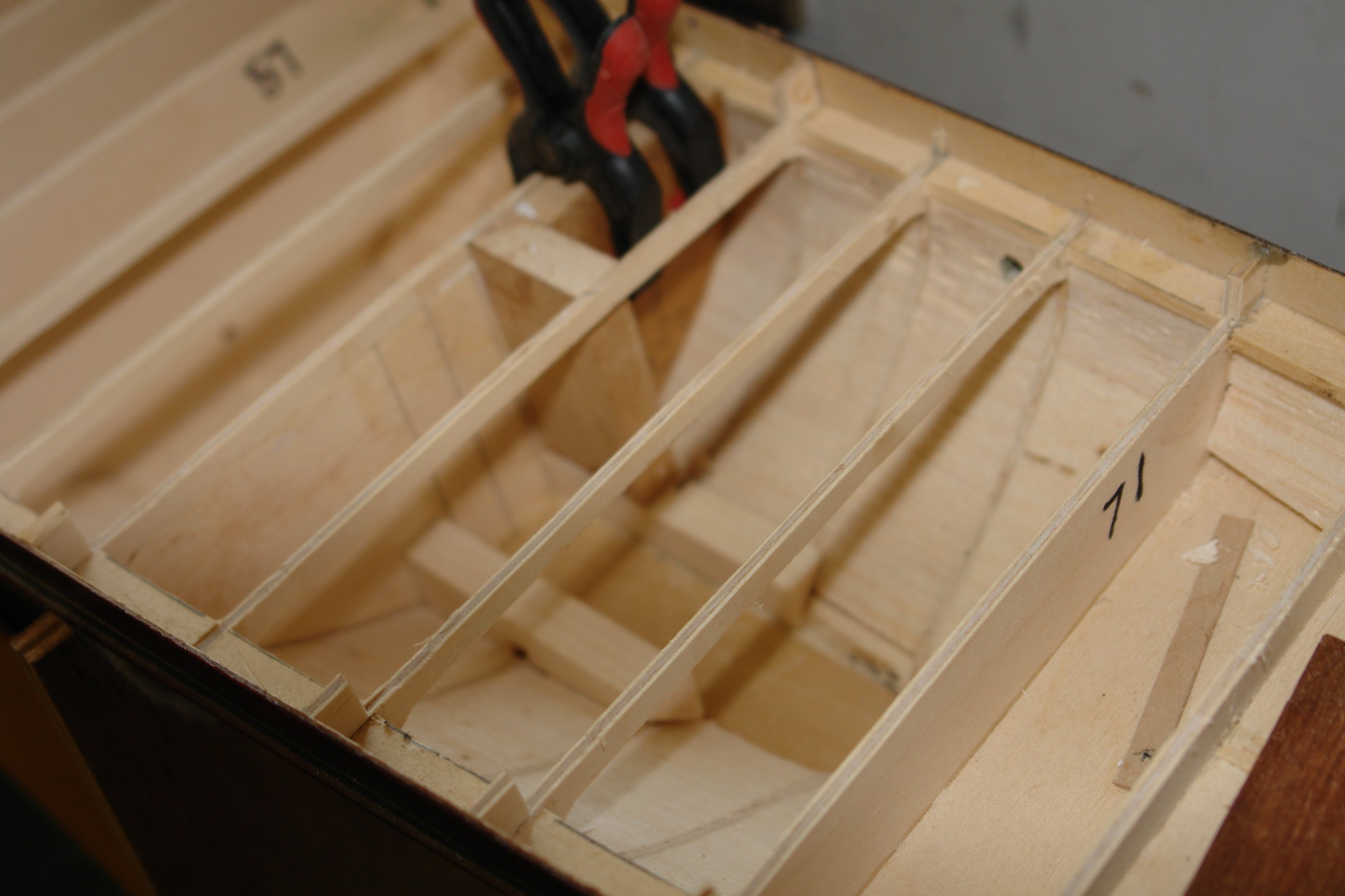

In the next photo - looking forward the double berth is on the port side but on the starboard side is a single berth. A narrow locker partially segregates the two berths.
The next photo is looking aft. The port locker door is no longer on the longitudinal wall. Both photographs show quite a lot of draws and one quite ornate ventilation grille together with one much smaller one at high level - supply and extract no doubt.

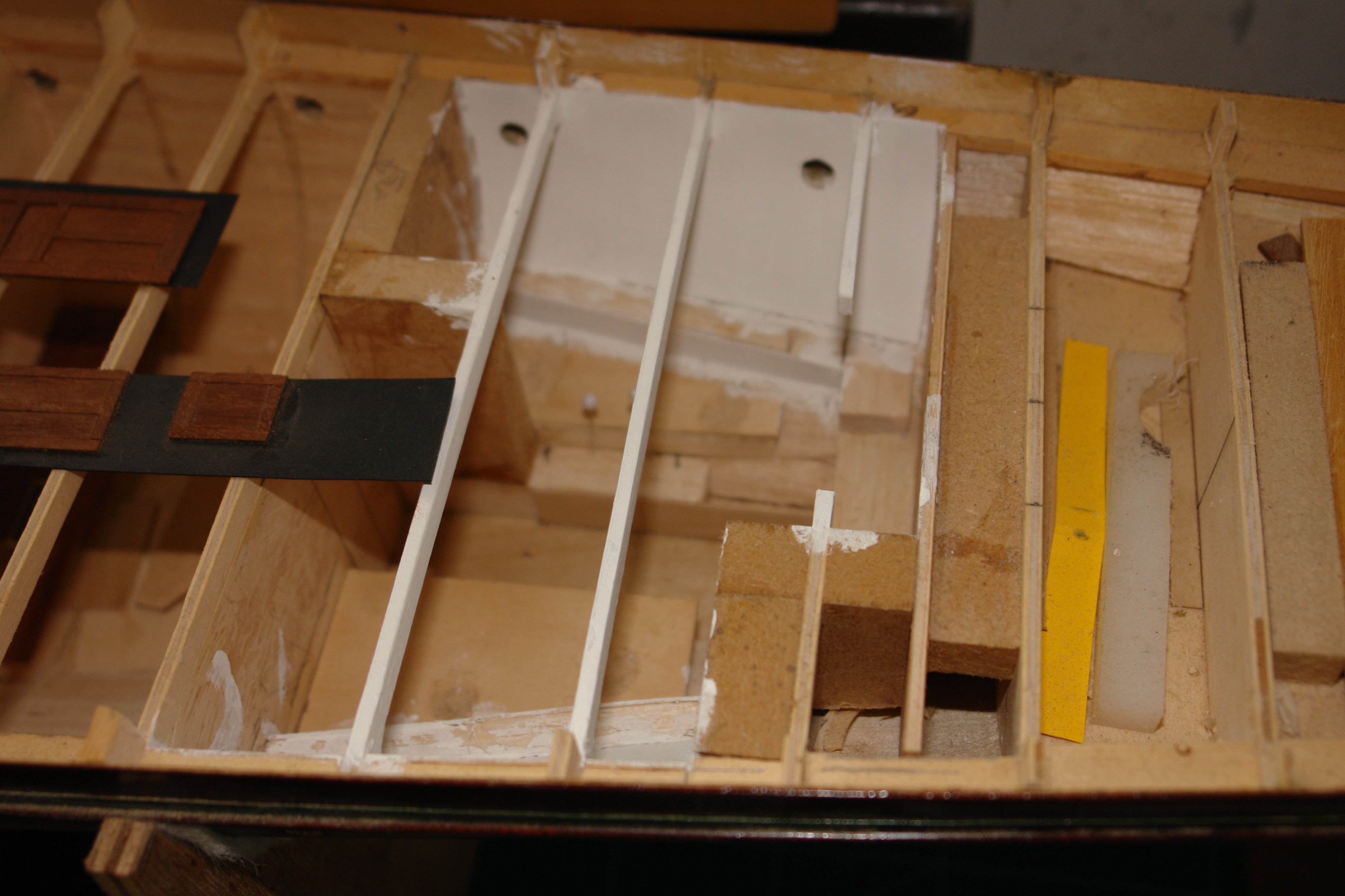

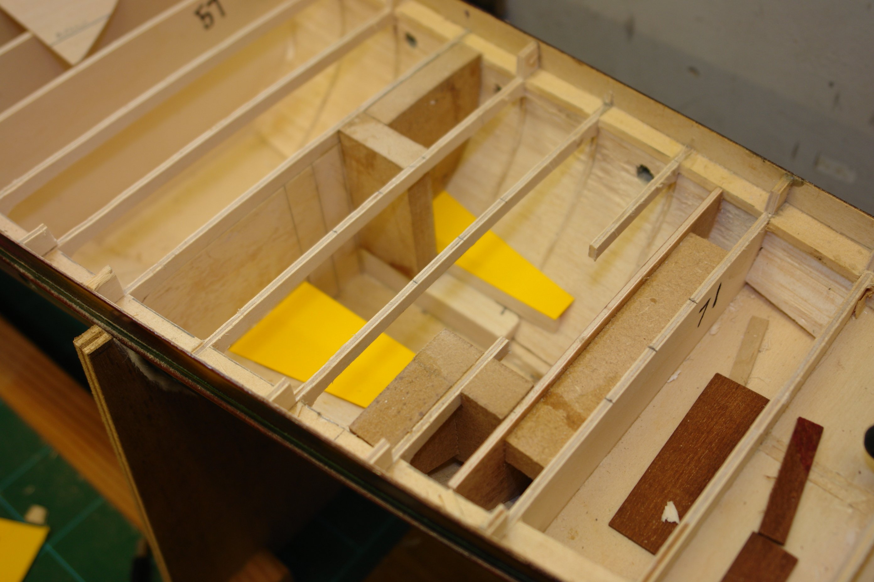

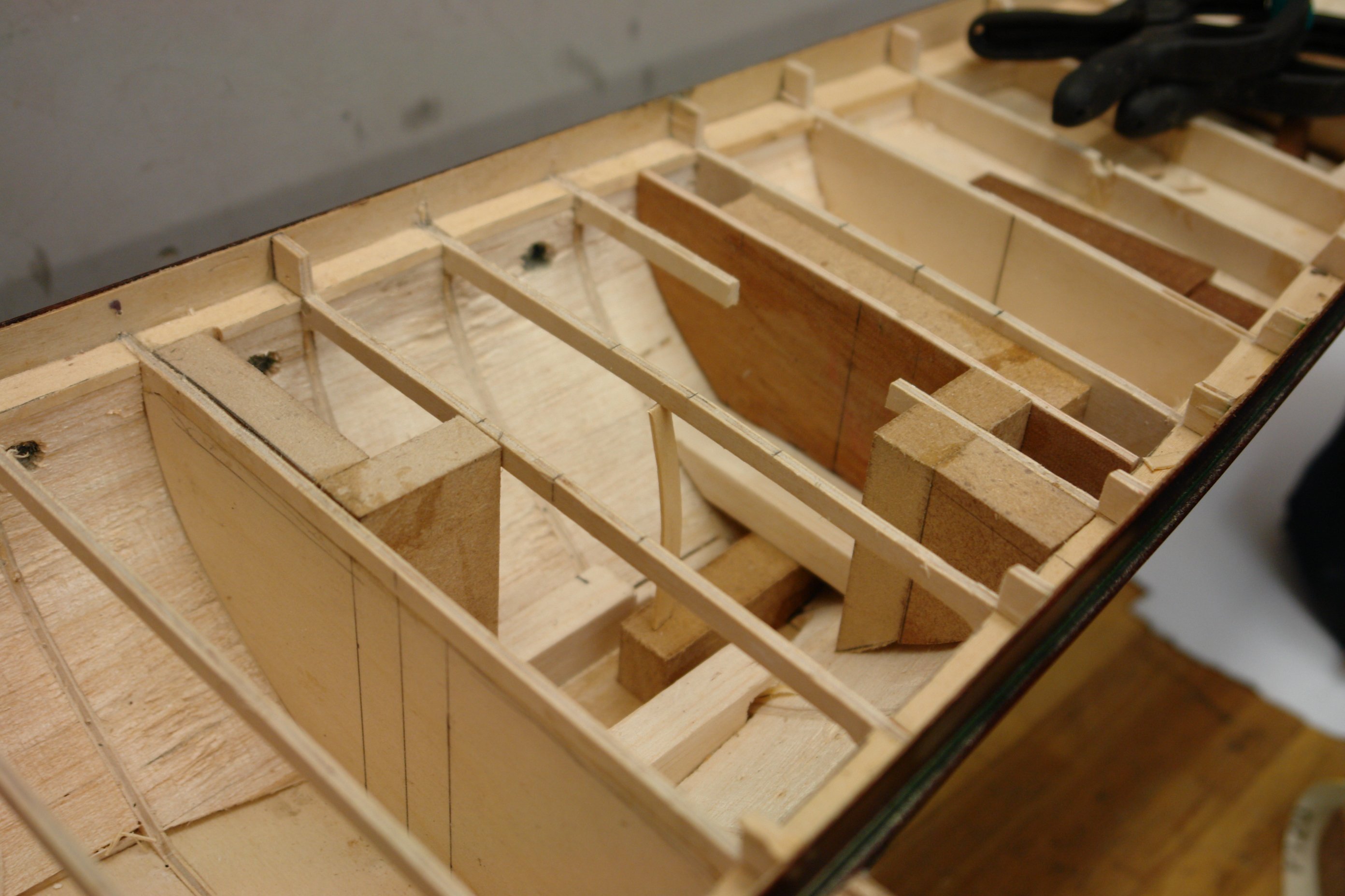

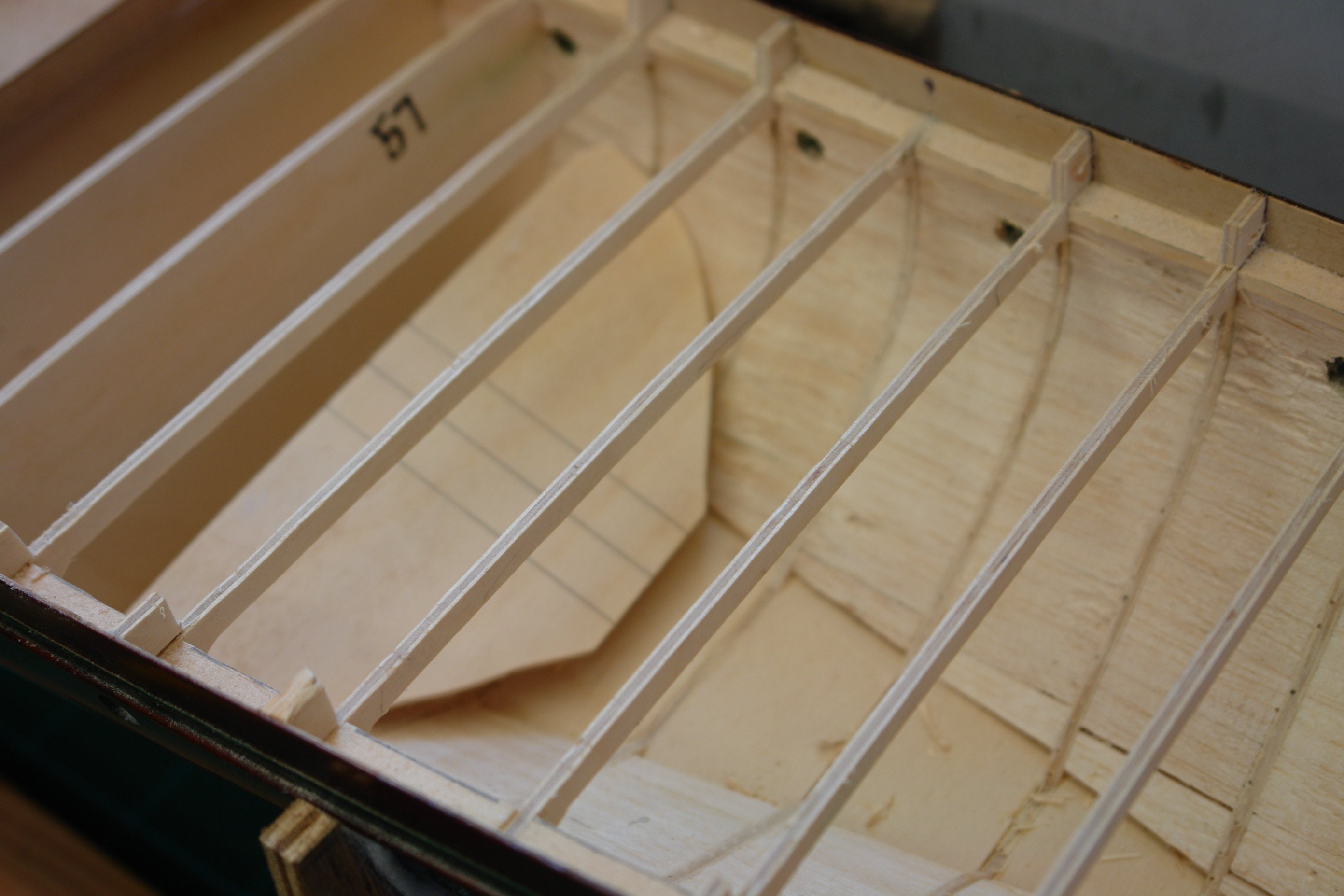

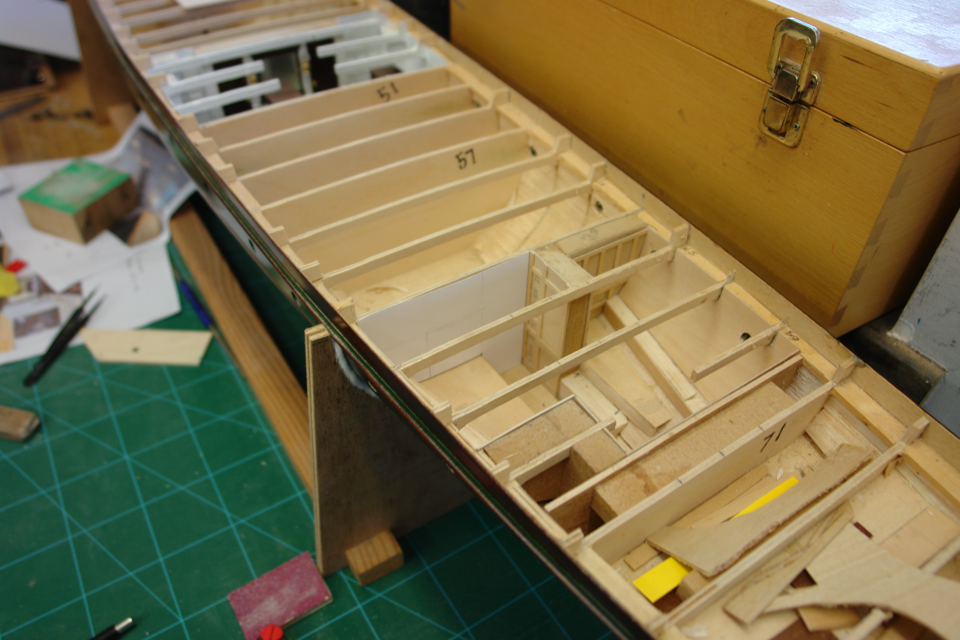

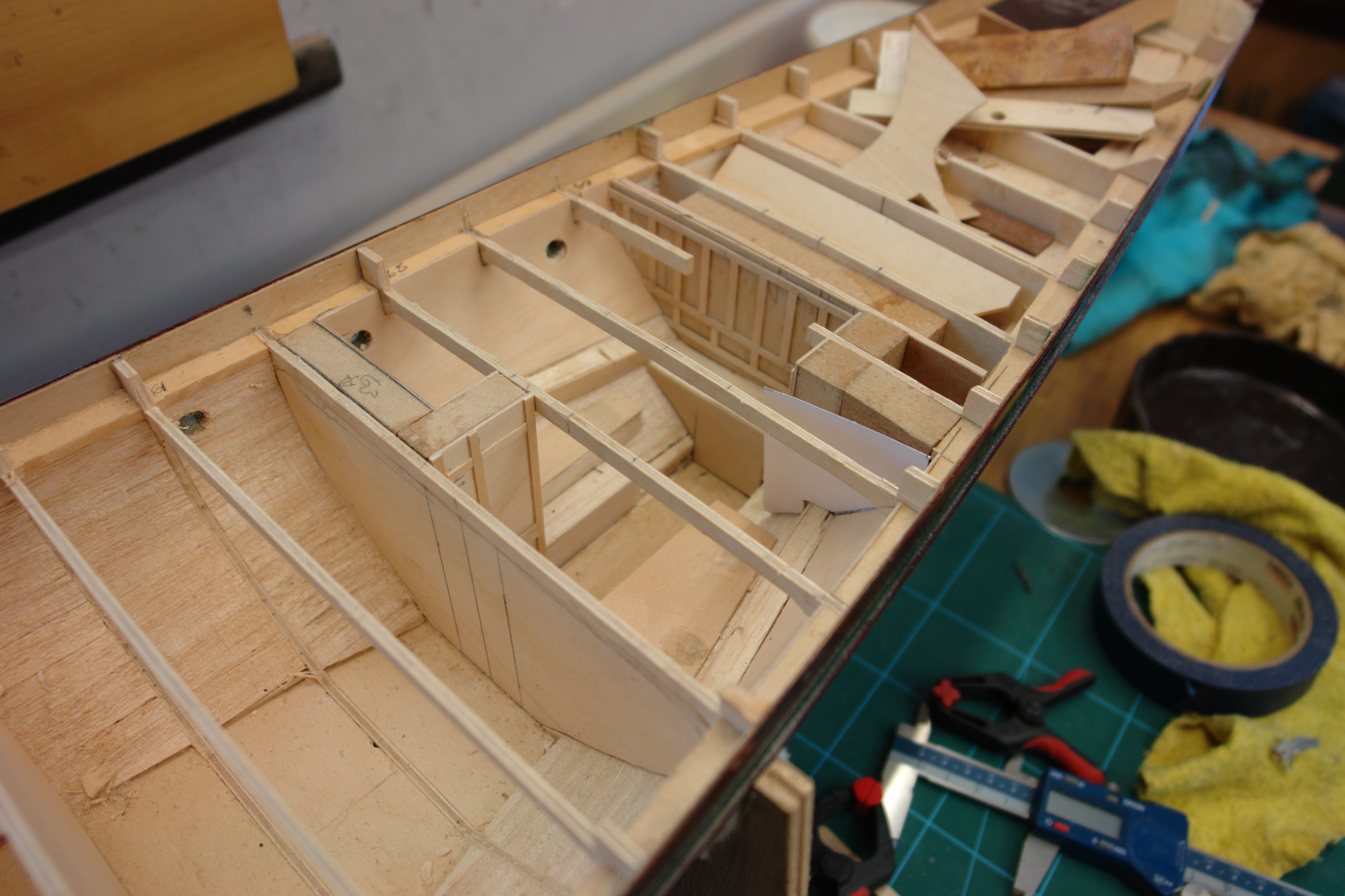

My late decision about the modelling of internal detail prompted some corrective works to the hull. The forward wall of the cabin sits at frame 63 but I had cut the middle out of this frame. The replacement middle can be seen lying in the hull ready for installation.
Now installed:-
The wall behind the starboard single bunk seems to be at frame 64 and MDF blocs were installed to create this wall and the centre line locker.
Some of you with long memories will recall that I omitted all the even numbered frames because I dint feel I needed them to get an accurate hull form. The aft wall of this cabin sits at frame 70 so once again lack of planning prompted some rework. A new frame was cut and glued in place.
The complex hull curvature is causing me a lot of head scratching as I struggle to work out how to model the various features as well as how it all fits together. I am starting to install various horizontal shelfs to pick up the positions of draws, bed bases etc. I have also blocked out the aft port side locker.
Not a very exciting update I'm afraid but progress is progress no matter how small.

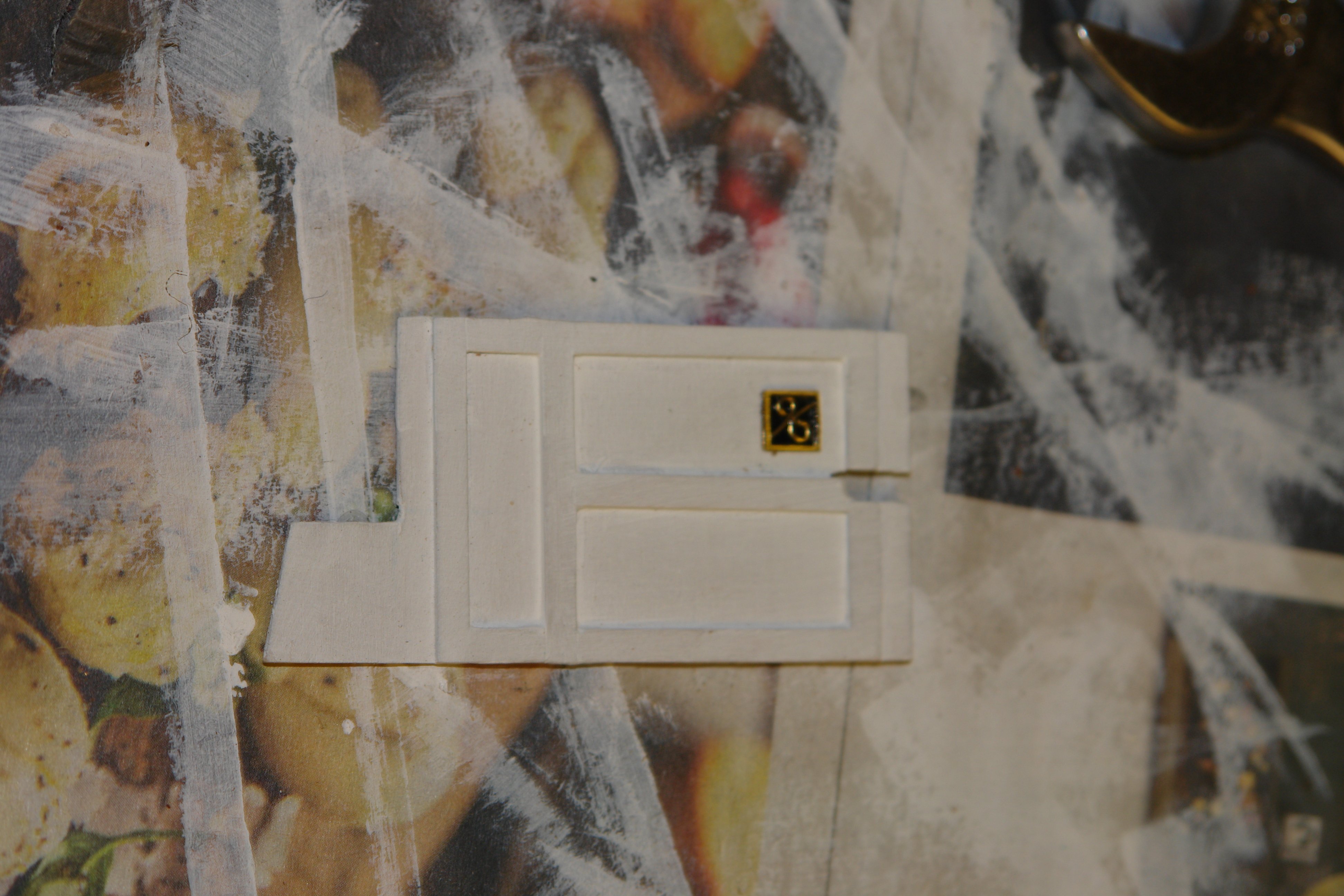

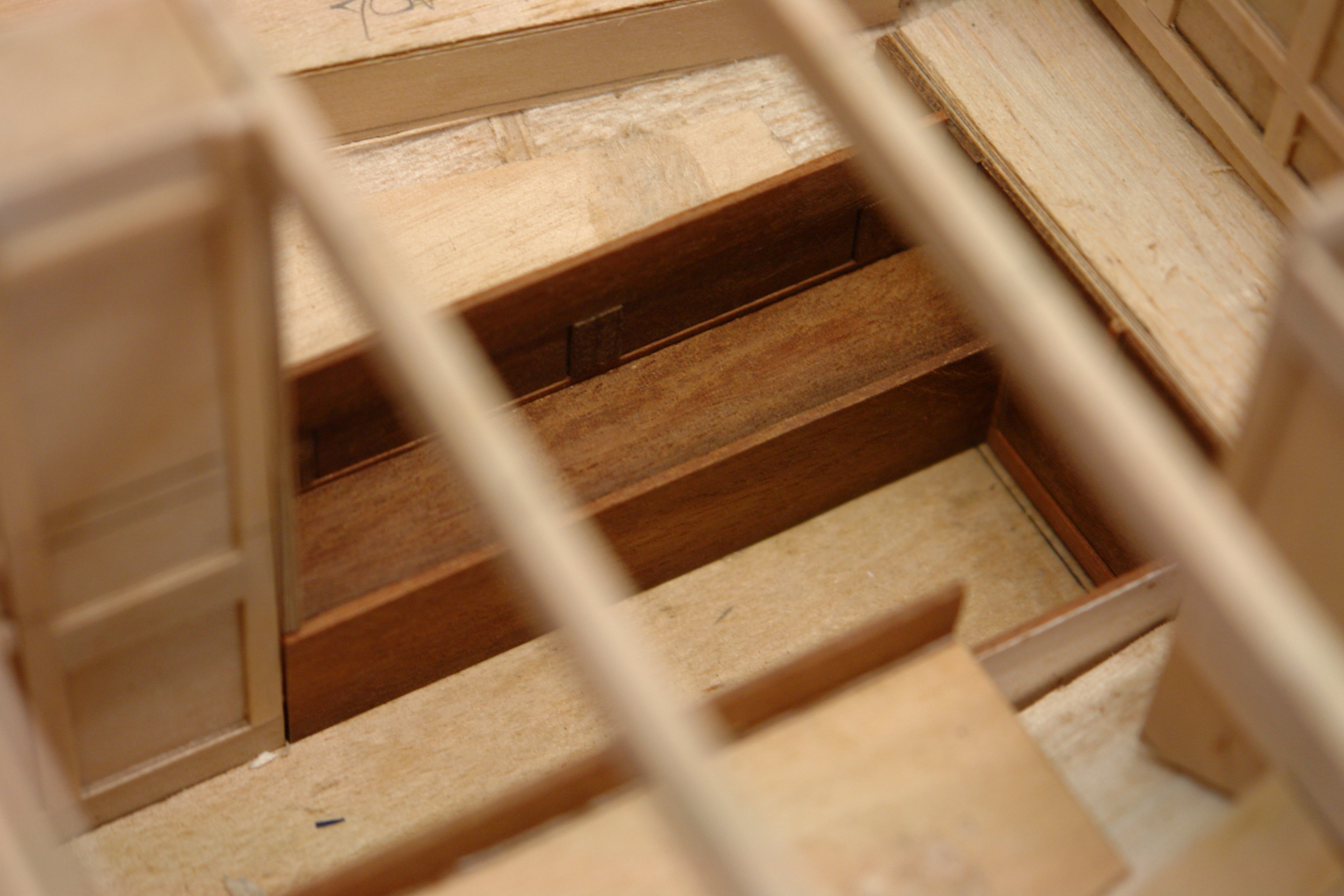

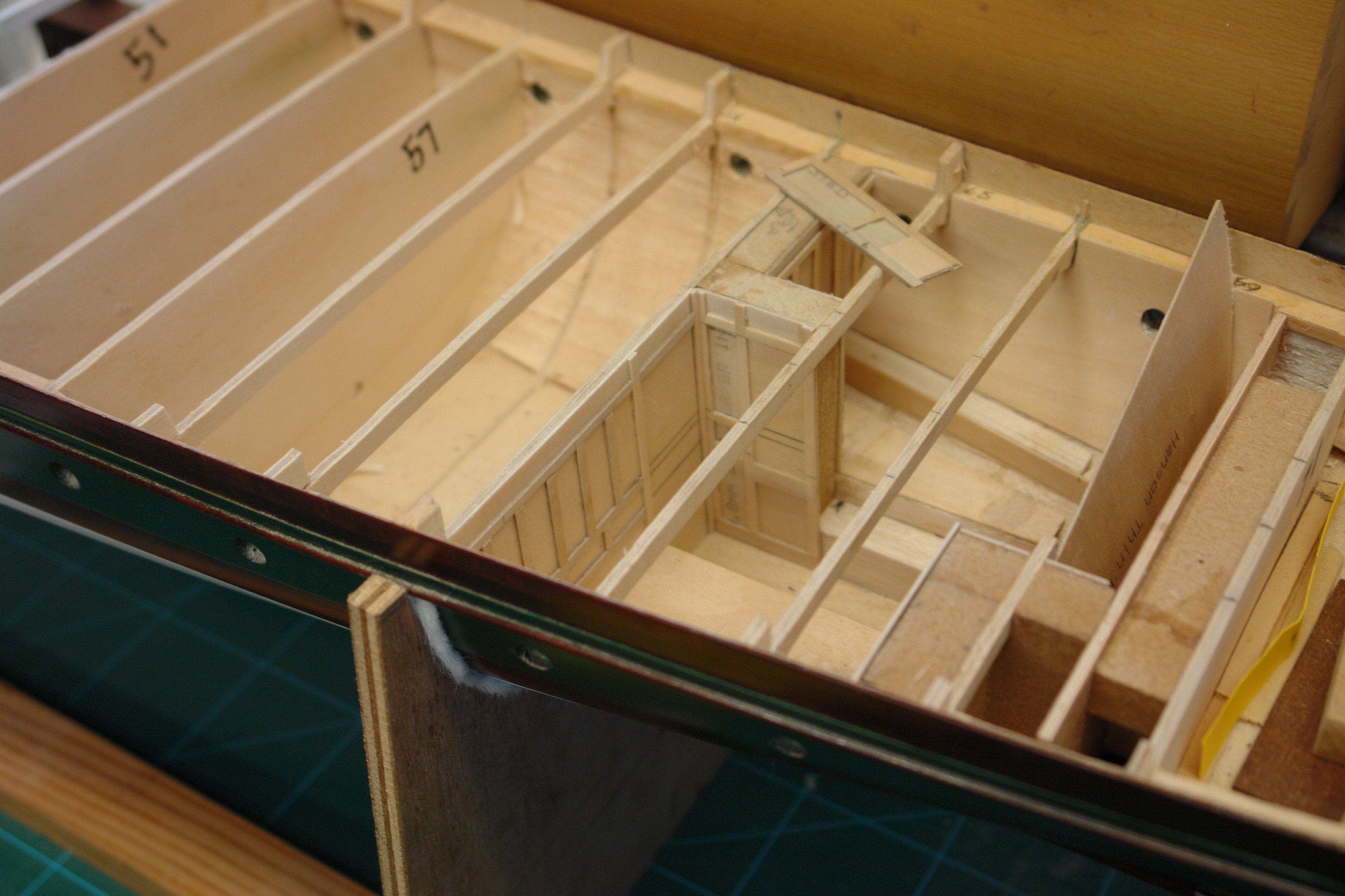

As I continue to unravel the contours of aft guest cabin i realise there are a few hidden areas that don't feature on any of the photos. The obscured areas lie between the foot end of the berths and rear wall on either beam. I am going to have to guess what is going on here.
I am finding that card templates are the most successful way of progressing.
DSC03390.thumb.JPG.0ee61374402e9cc4d945f563bcbe7d4c.JPGOnce the templates seem sensible I replace them with 1/32 ply. I continue to utilise my Starbucks sticks to hold surfaces while the glue sets.DSC03393.thumb.JPG.af0b71ff741f1812e769e9436e4d1846.JPG

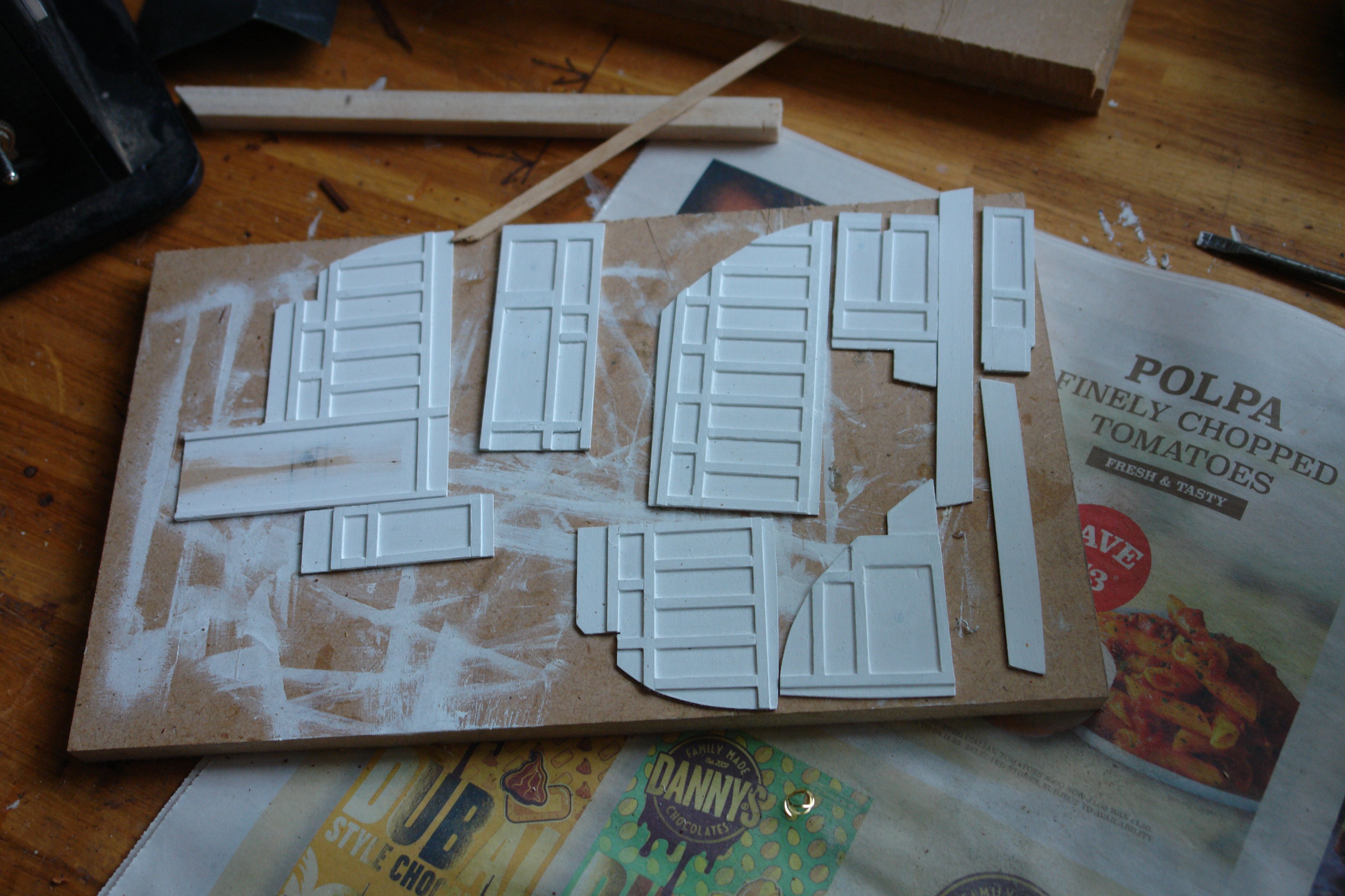

I am also using card templates to identify the shapes of the various walls. Below I have made the aft wall and some of the walls around the lockers. I have also clad the hull walls ready for painting. DSC03395.thumb.JPG.1ed9701cab1987099bbf599424a4d6d7.JPG
And then continuing with more templates and more wall cladding.DSC03398.thumb.JPG.1734a75a2fc40487bfd0b5946b5e7bda.JPG

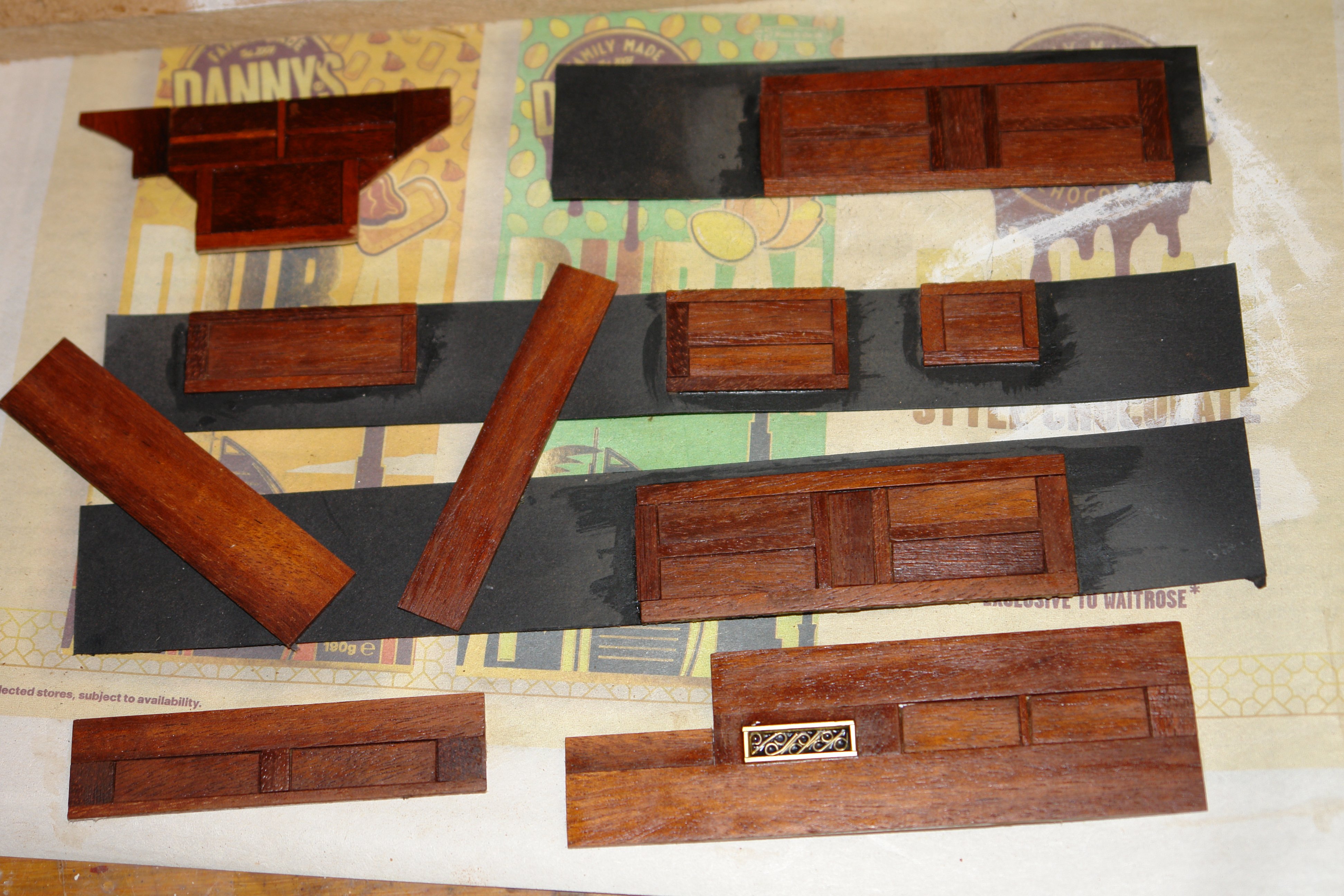

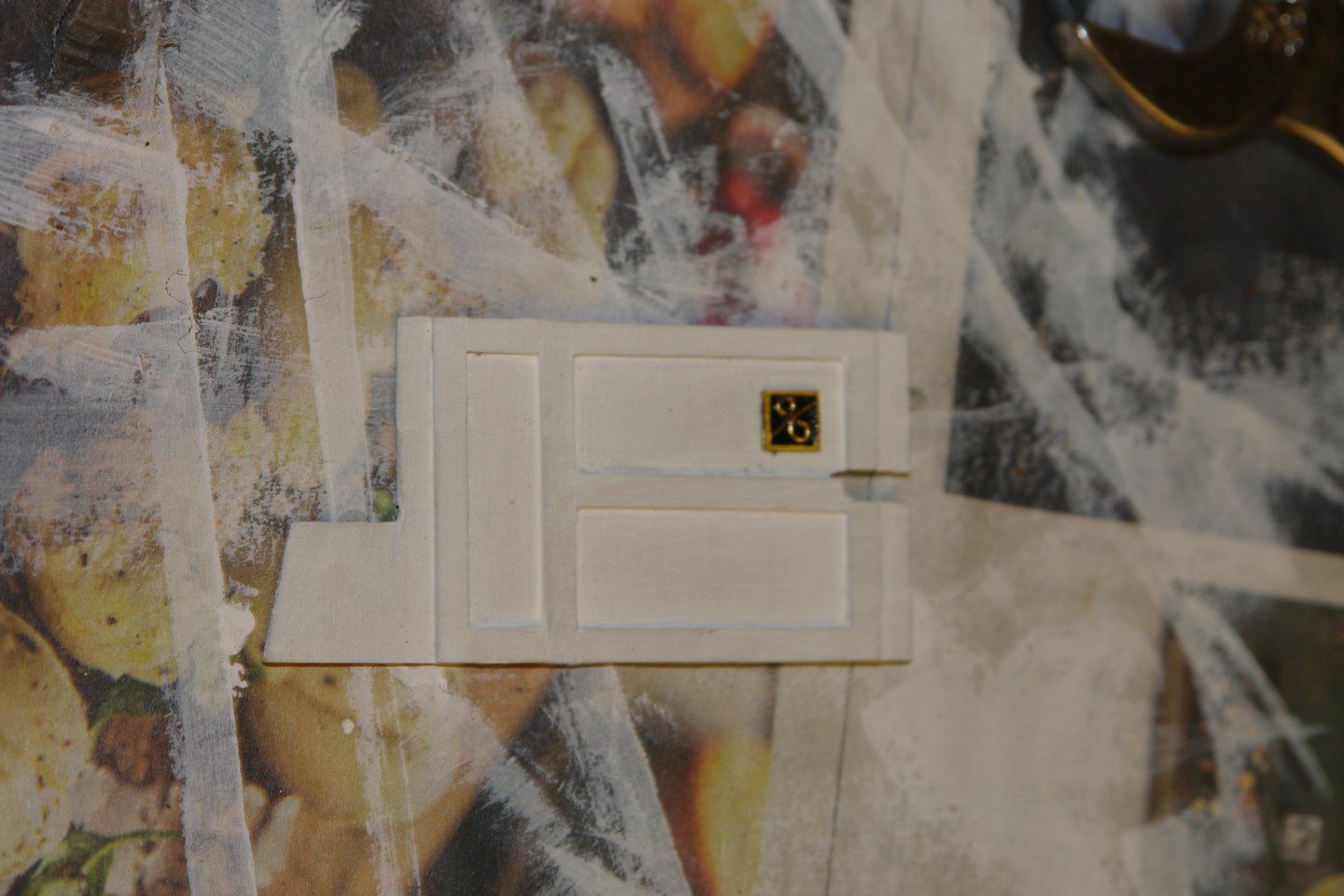

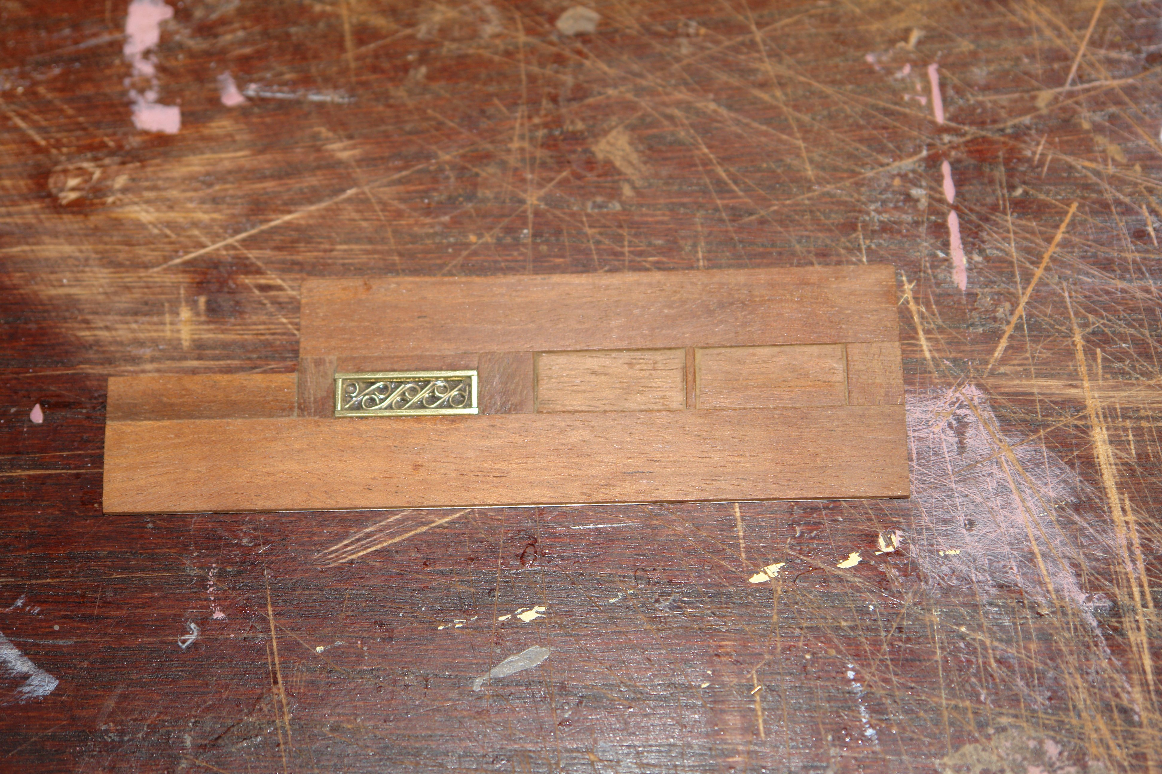

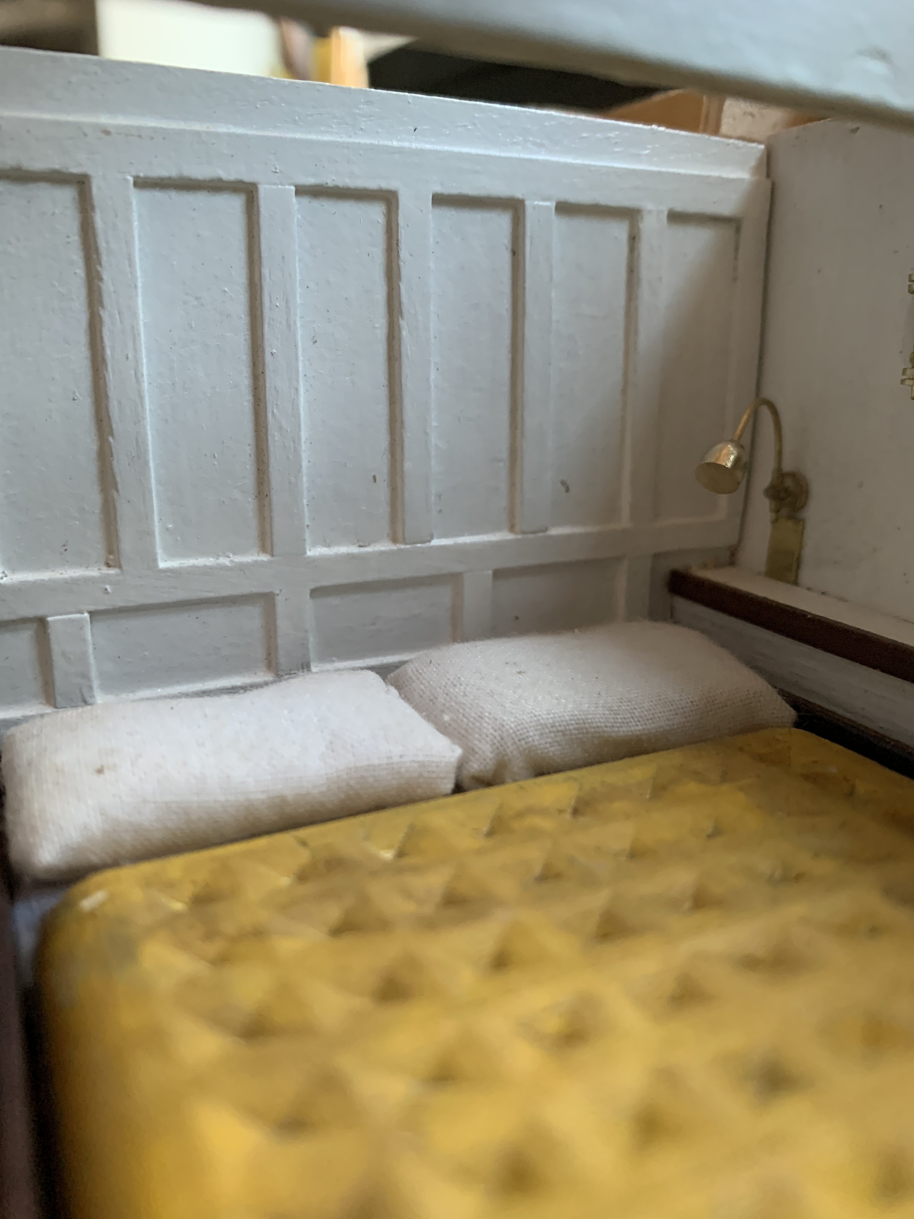

Once the wall cladding panels were complete I moved on to the mahogany panelling. Here is the panel to the side of the double berth with its brass ventilation grille and two draws.
Followed by many other mahogany parts. Including the aft end draw fronts, various doors, shelfs / steps and more draws.
Getting the fitting of the mahogany parts correct seemed to take an age.
All of the wall panels needed painting white.
DSC03406.thumb.JPG.518e5502b358bf21ed6cdce1d701409d.JPGDSC03407.thumb.JPG.0de7caad6ecae2e9e0e451f989e9af8a.JPG
Plus another small ventilation grille.
I now need to get on and glue it all together - but this may be after Christmas. A Merry Christmas to you all ---- Ho! Ho! Ho!.
