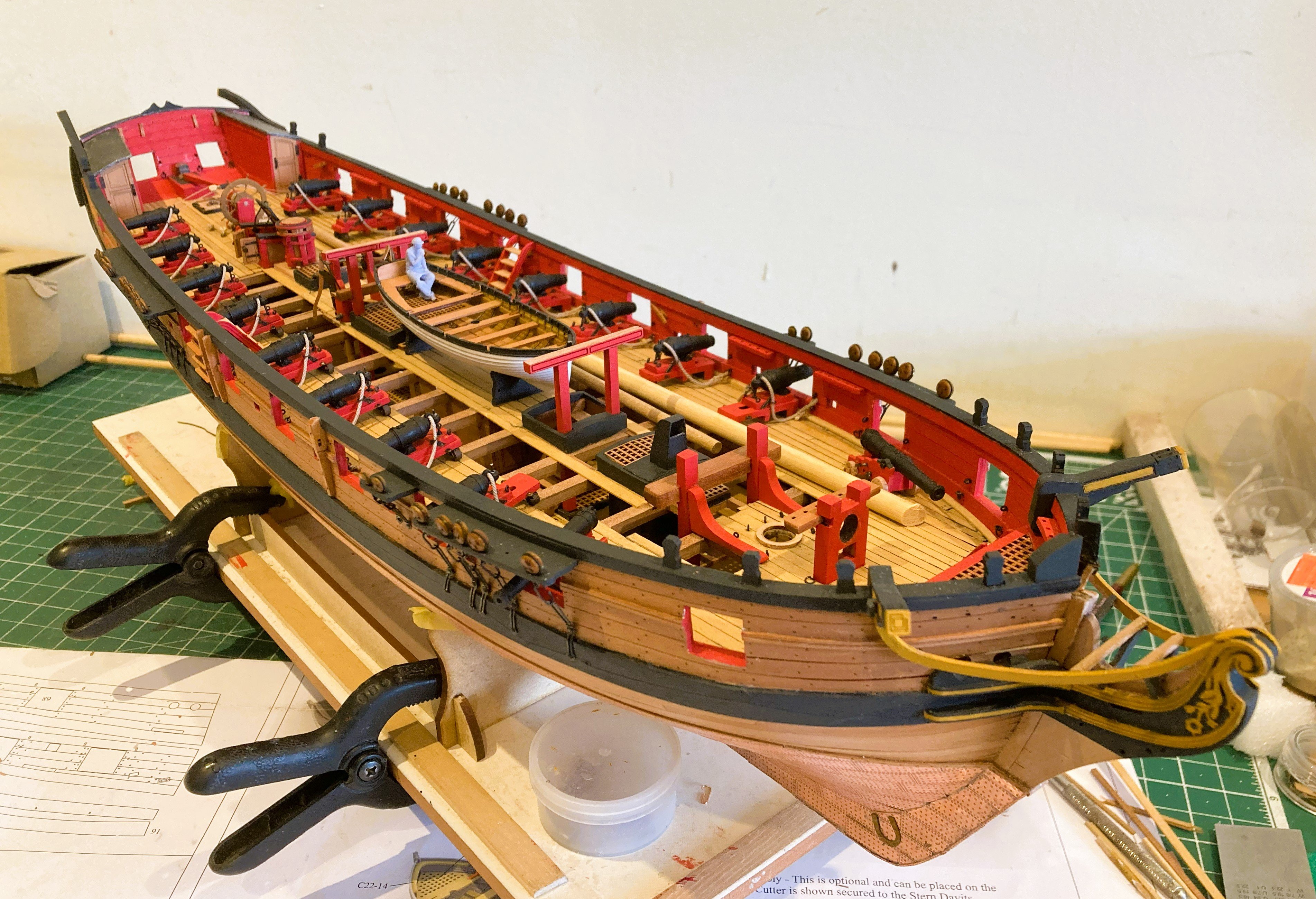

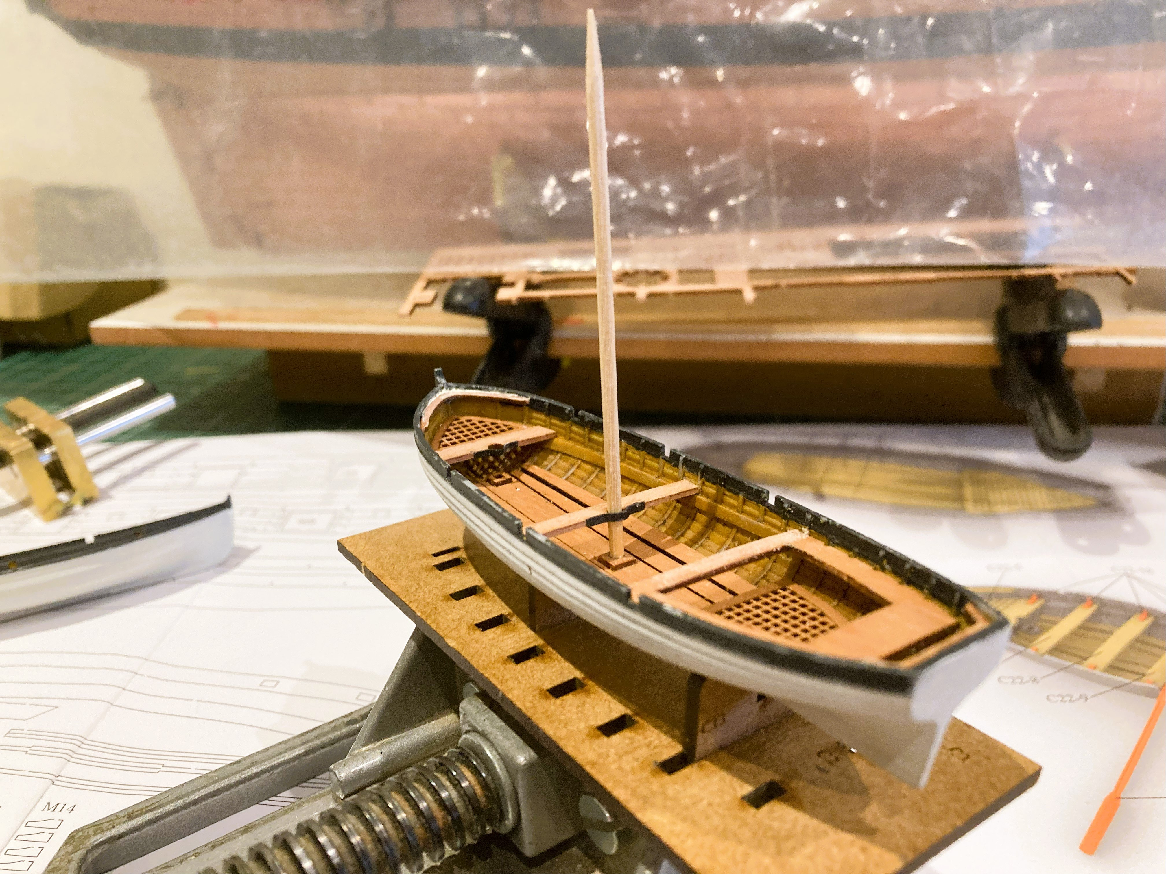

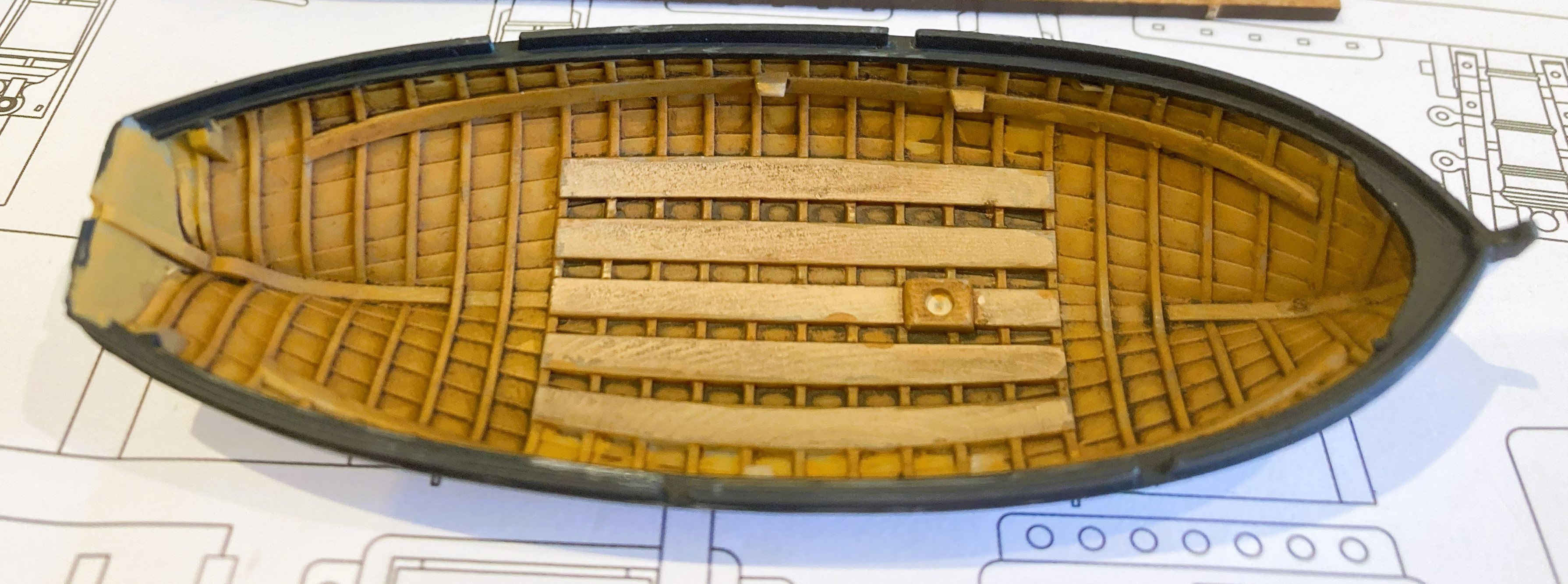

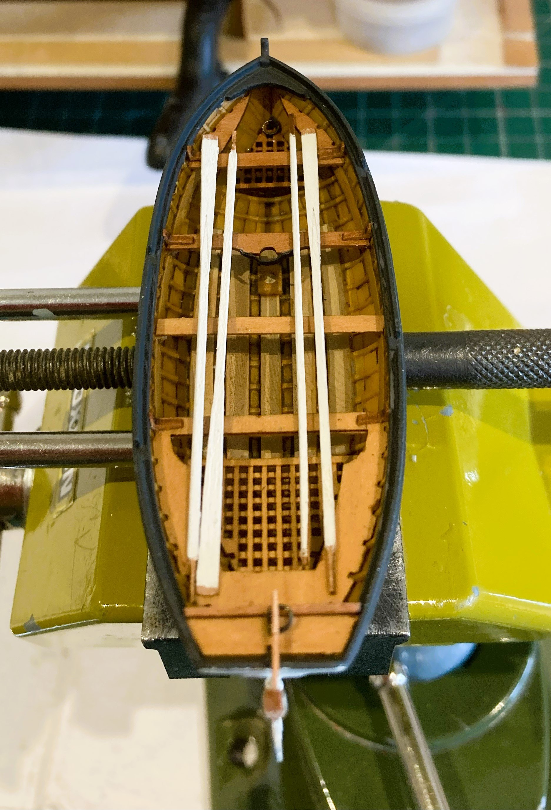

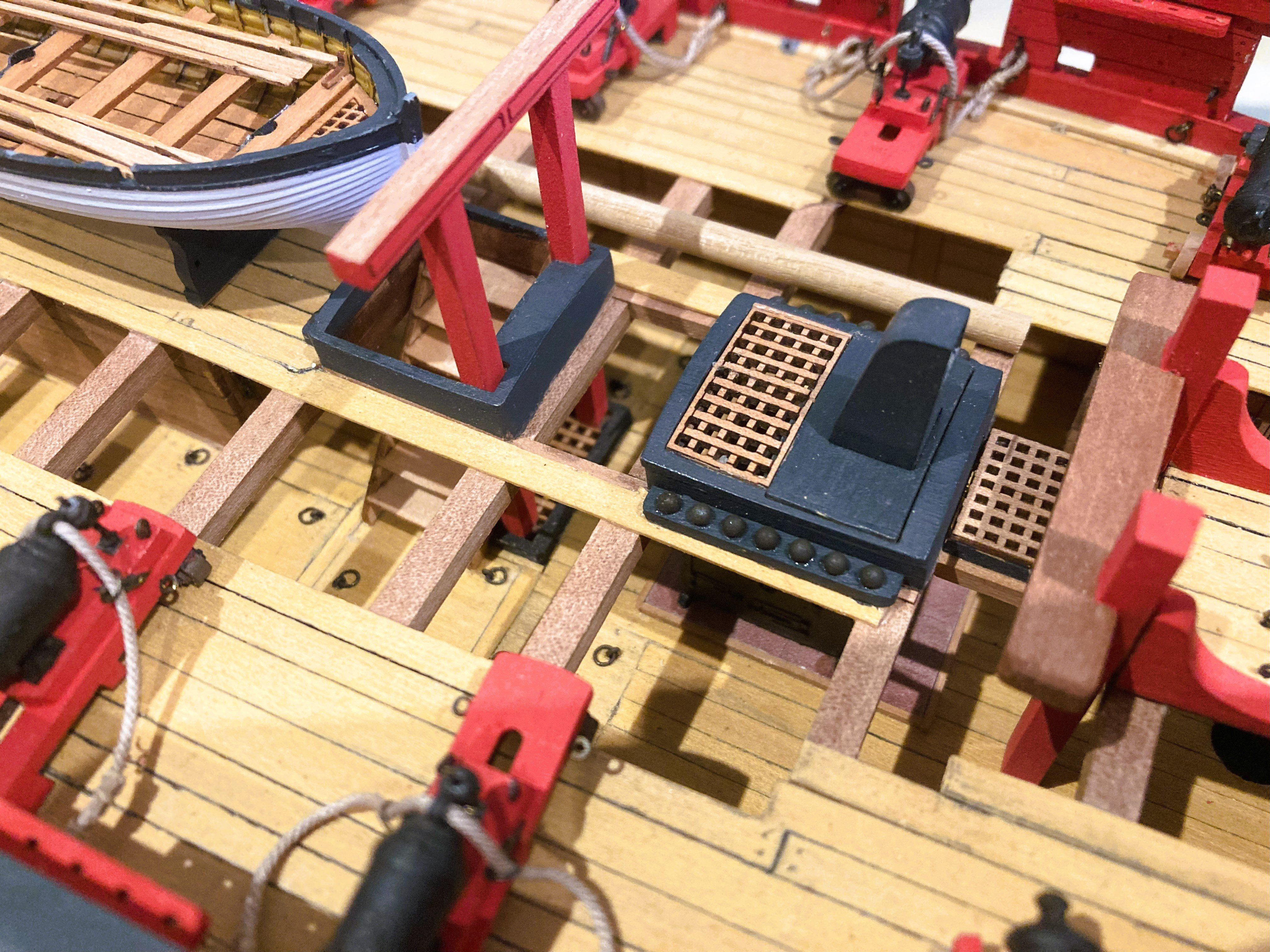

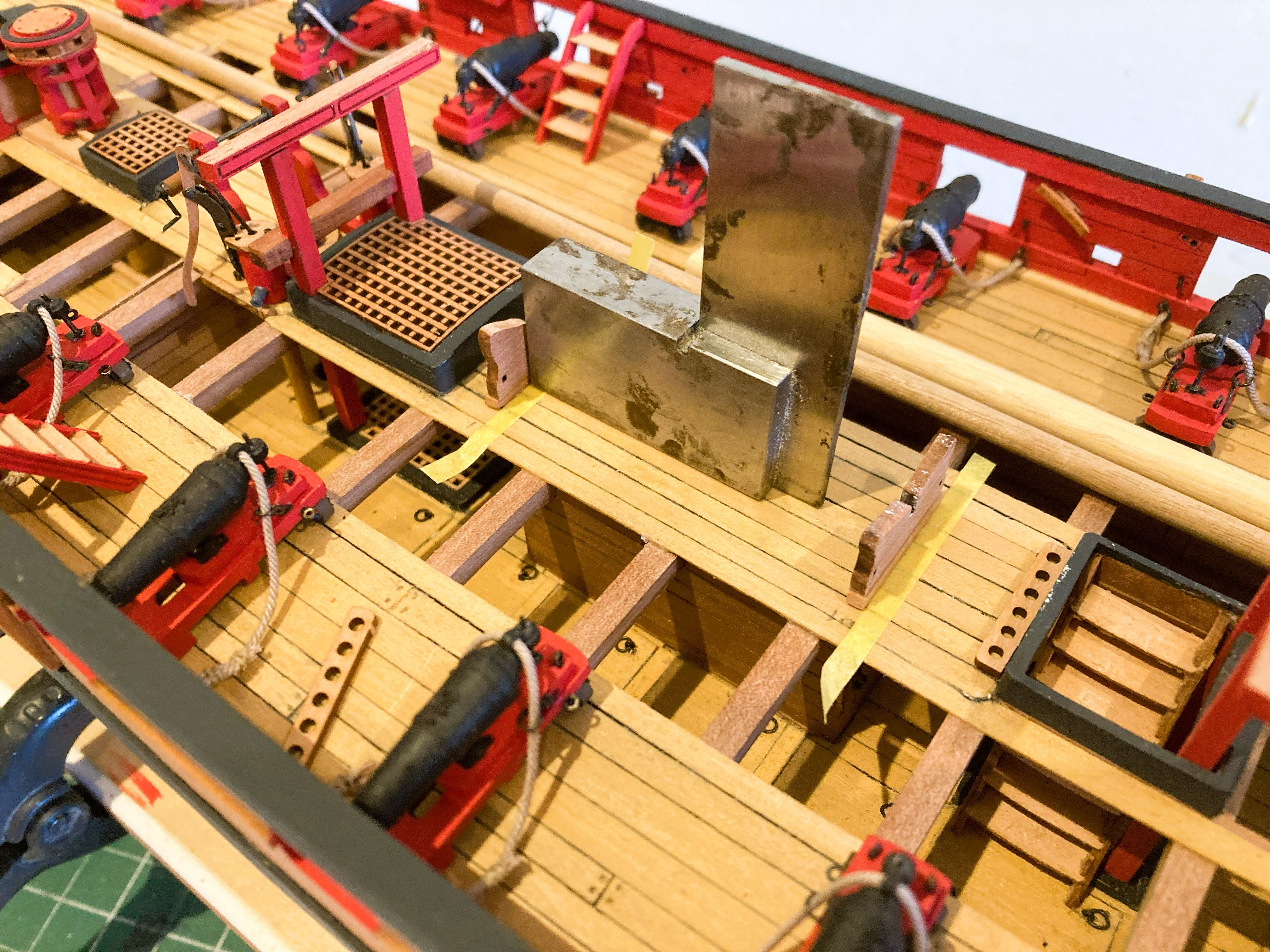

Completion of first stage.

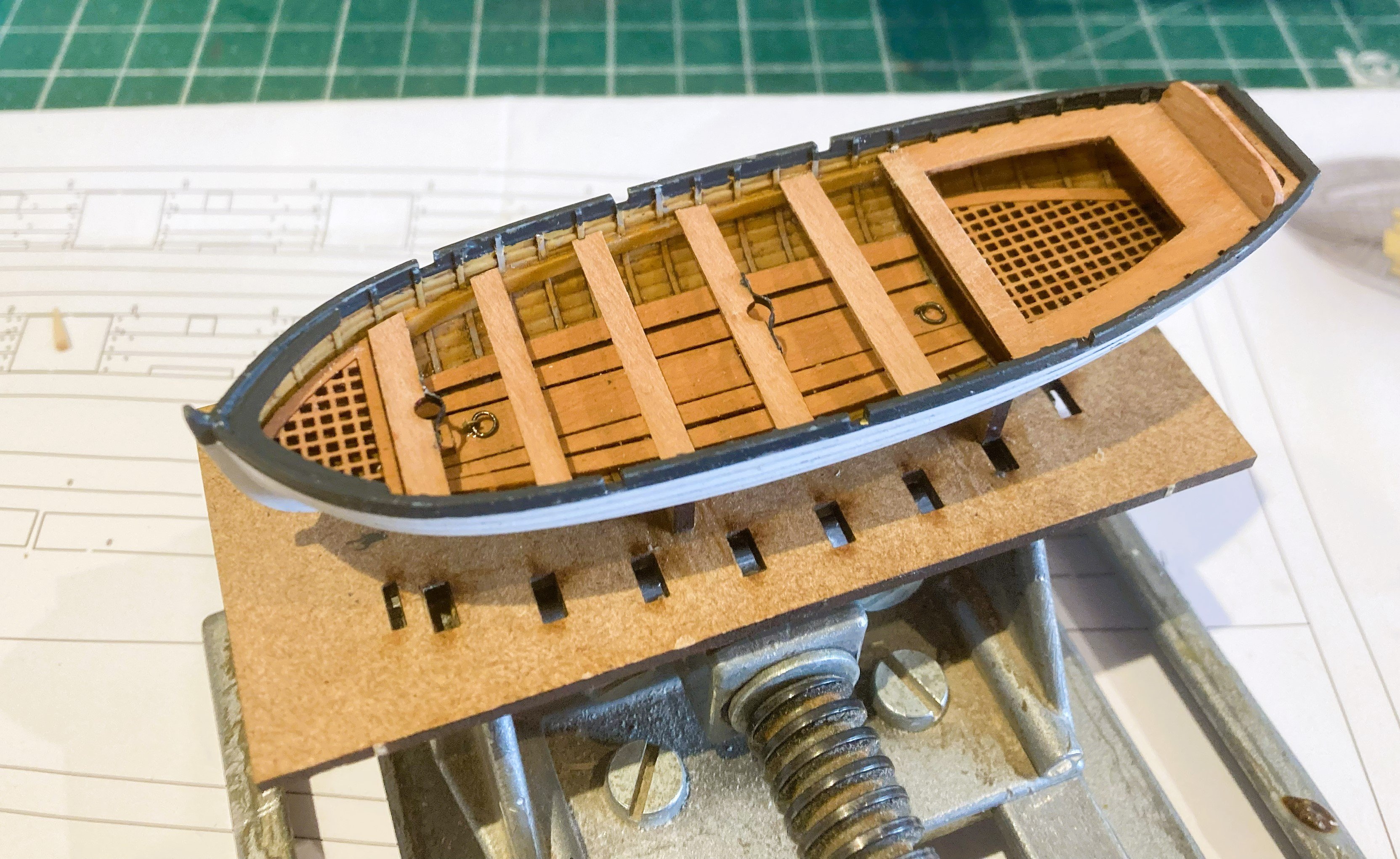

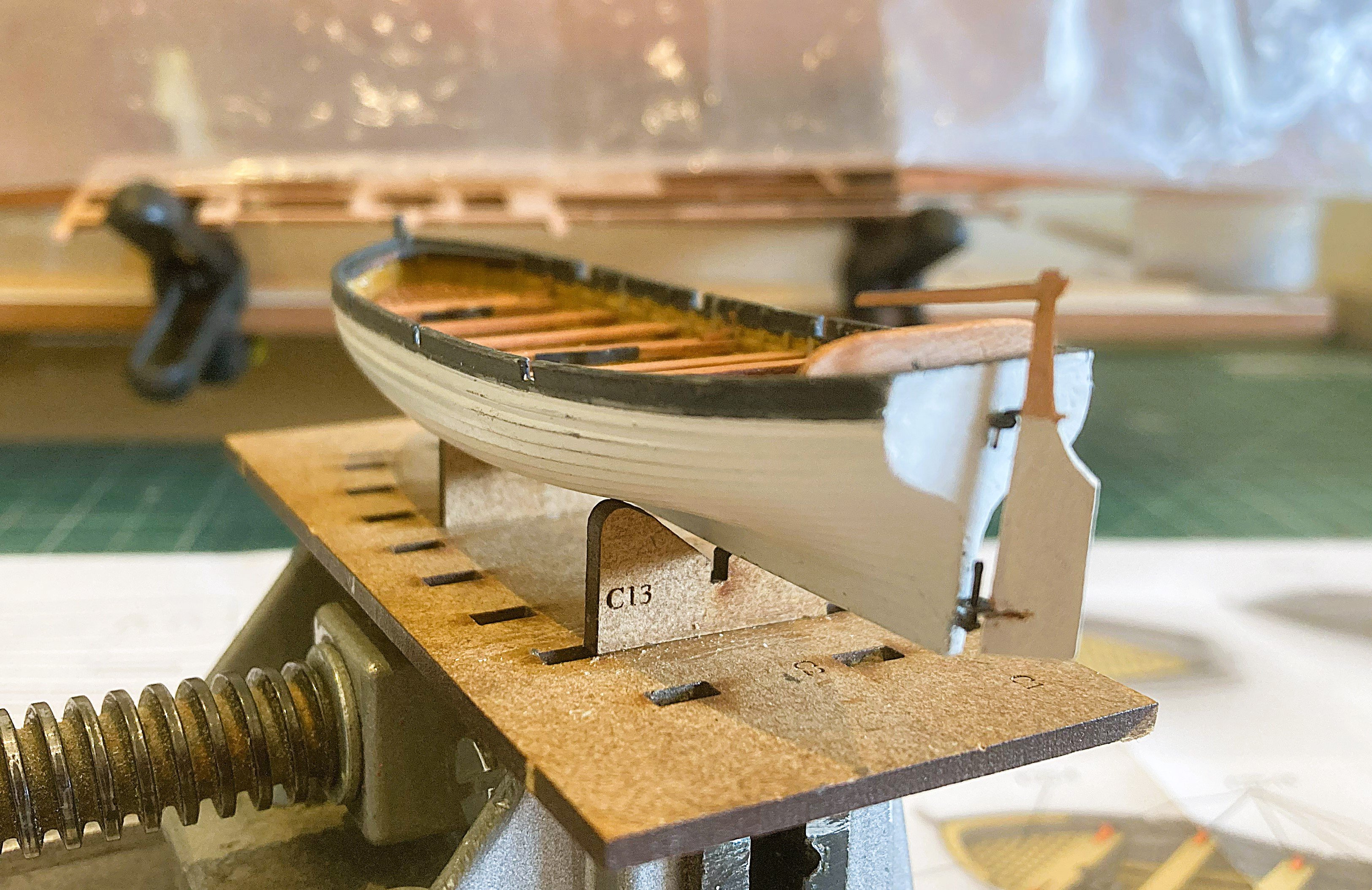

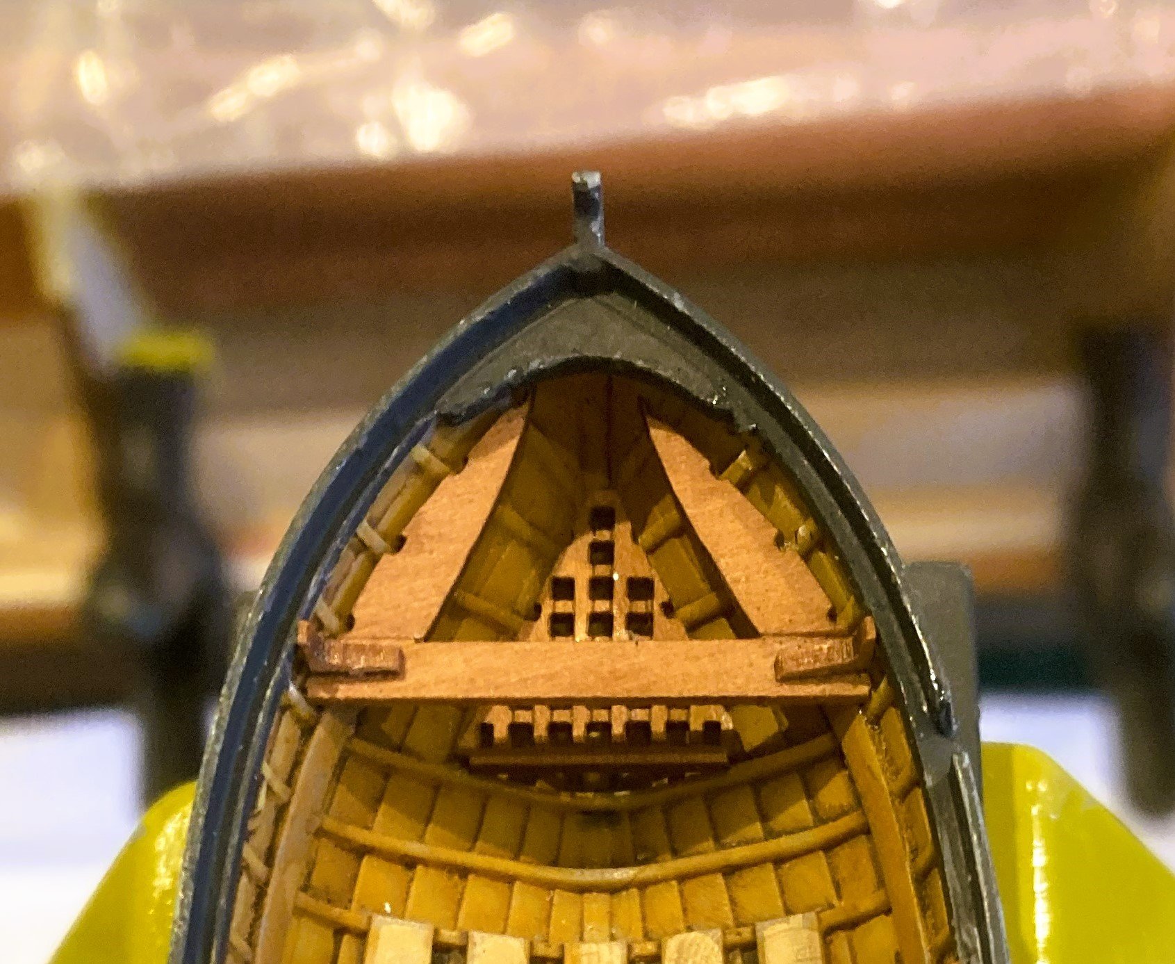

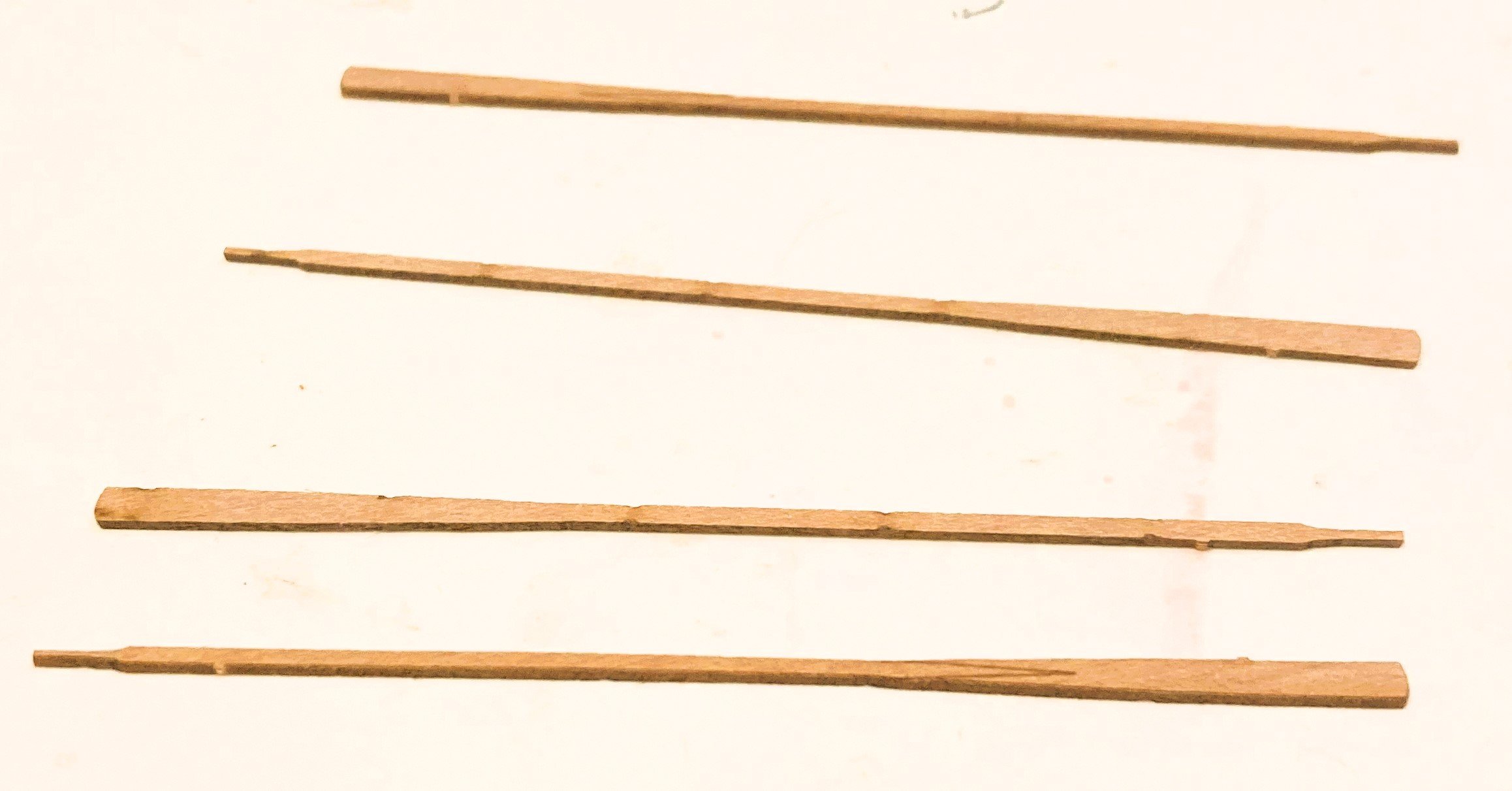

Five months into this build and time for a long overdue workshop GTU, and some stage photos.
4042a
4041a
4044a
4046a
4048a
4049
4053a
4056a
4061
4057a
4054a

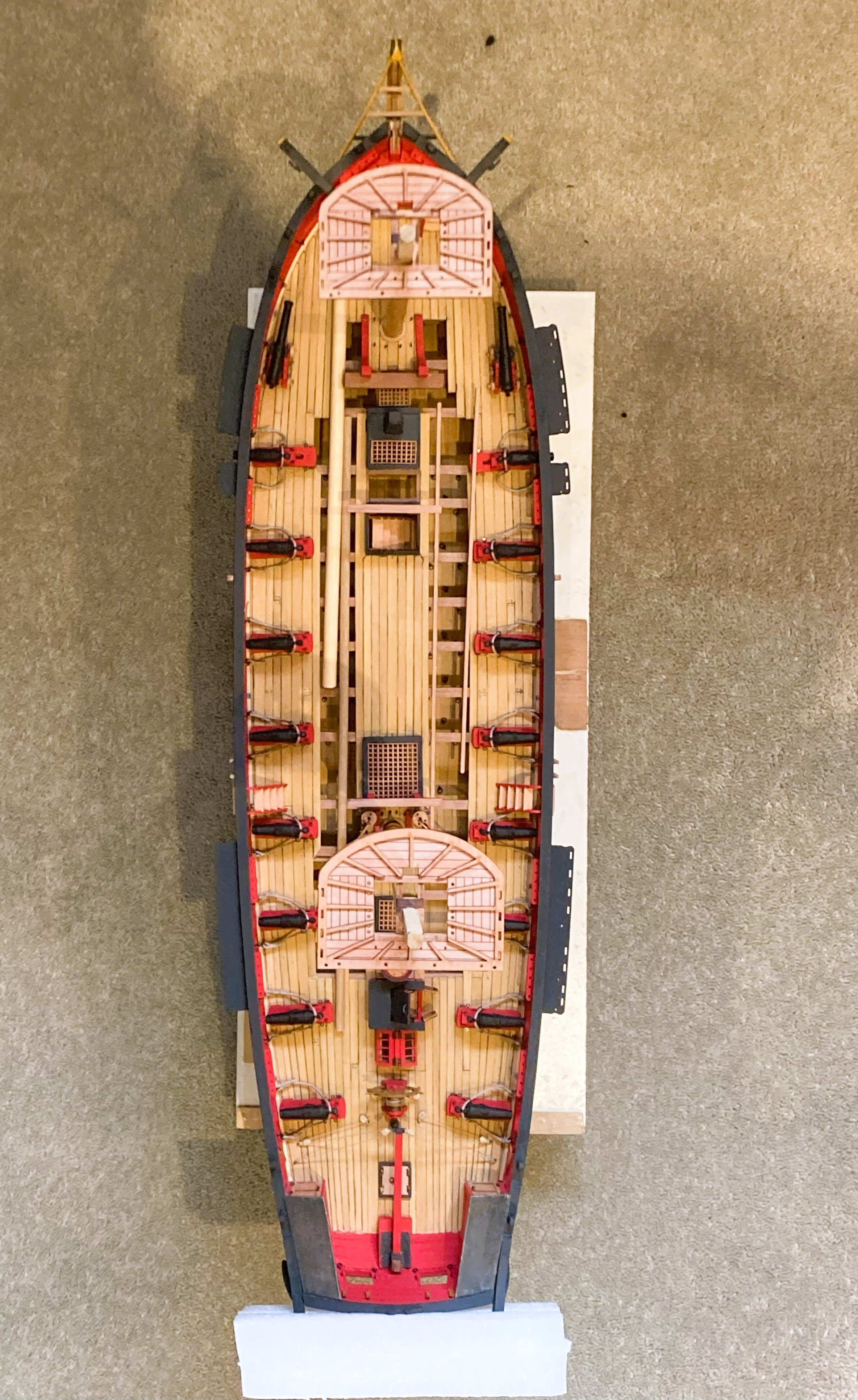

I now need to decide where I’m going with this build.
I completed my previous two builds ‘Navy Board’ Style with stump masts, but I am leaning  towards going a little further with Harpy.
My initial thoughts are to rig her with lower masts and standing rigging in place but without yards.
011a
I did this with my model of Victory.
I quite like this set-up on models and it has the advantage of space saving.
With Harpy, extending the build time, and deferring any concerns of what to do next are also a factor, and I fancy doing some rigging again.
I will start with a mock-up to gauge the overall space requirements, and then, once Mrs W has left the premises, wander around the house looking where it will fit in.
A plan of sorts.

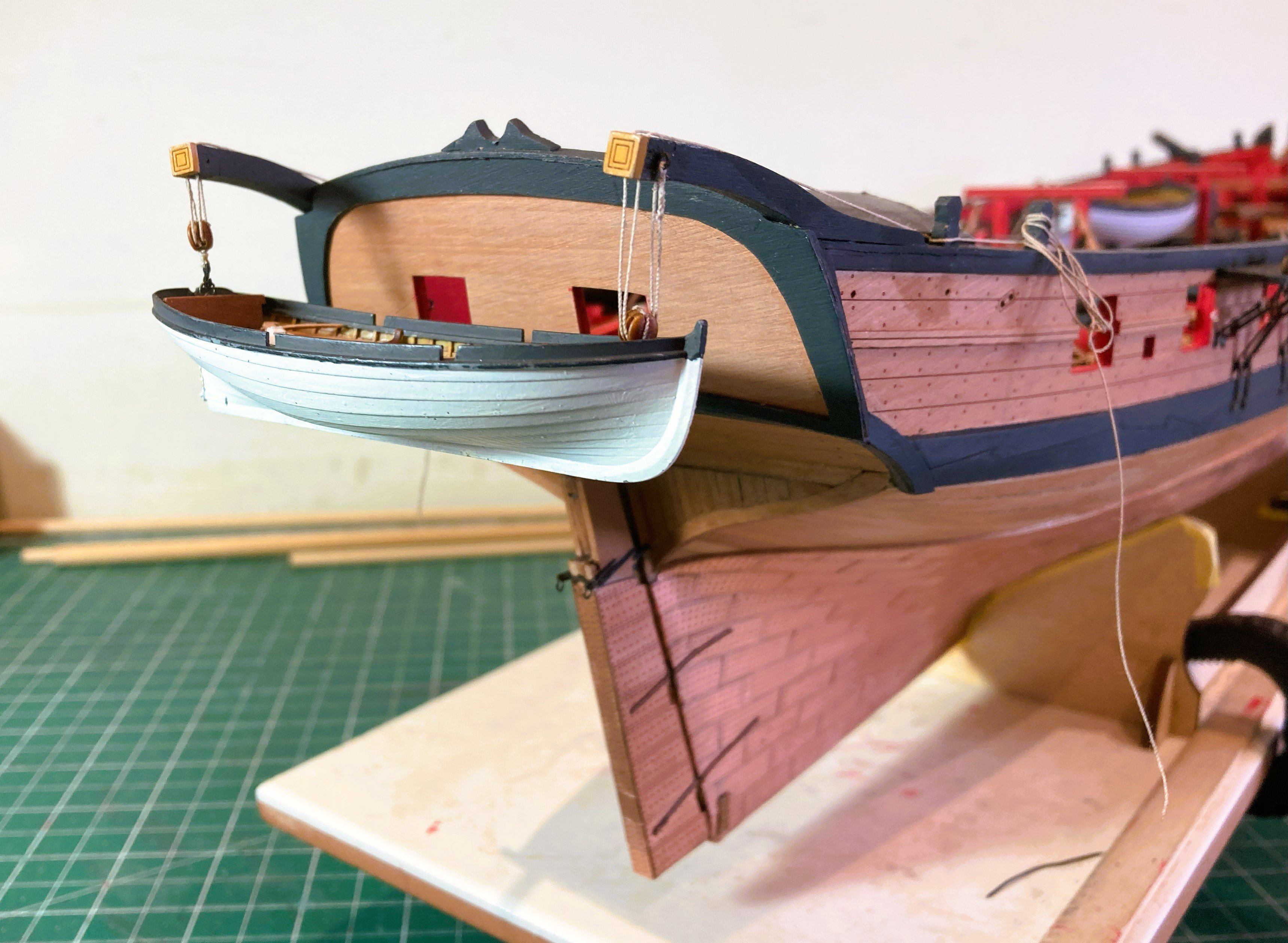

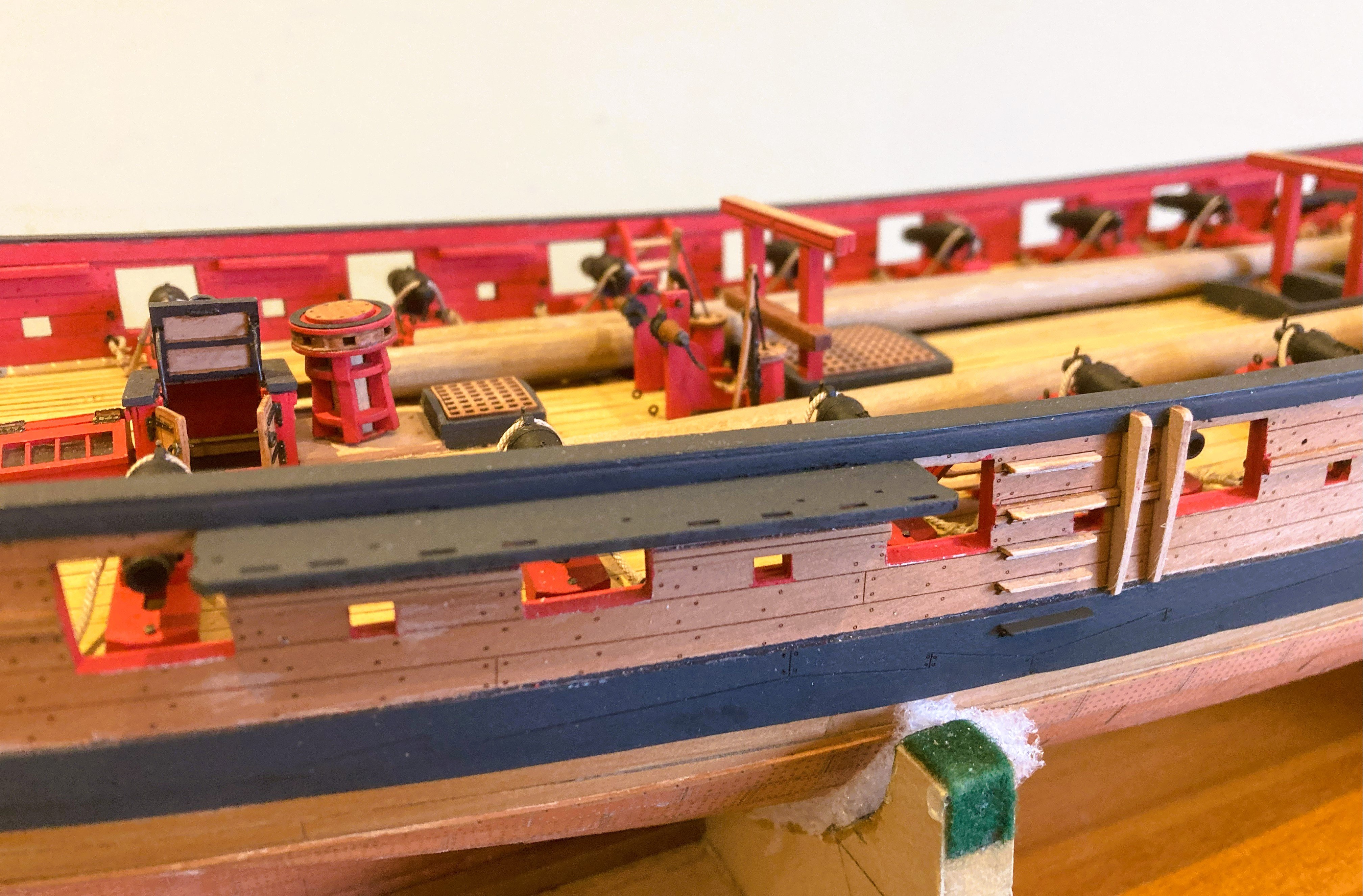

Channels and Timberheads.
These are the last main features to add to the hull exterior.
4084a
4085a
Channels and Timberheads slot seamlessly into place.
Side steps.
4102a
Annoying but necessary little beggars these, two tiny pieces comprising a tread and support glued together at right angles, five required each side. Fortunately the locations are engraved on the top sides which helps with this exercise.
With the use of laser cutters, shape and even a design is included on items that would prove very difficult to produce by hand accurately at this scale.
4079a

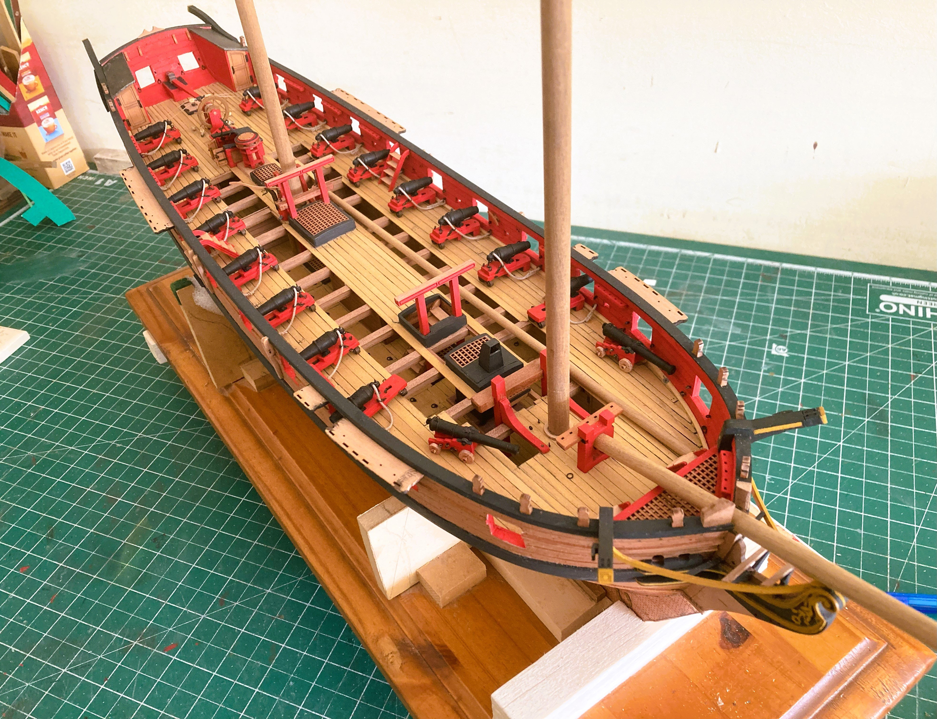

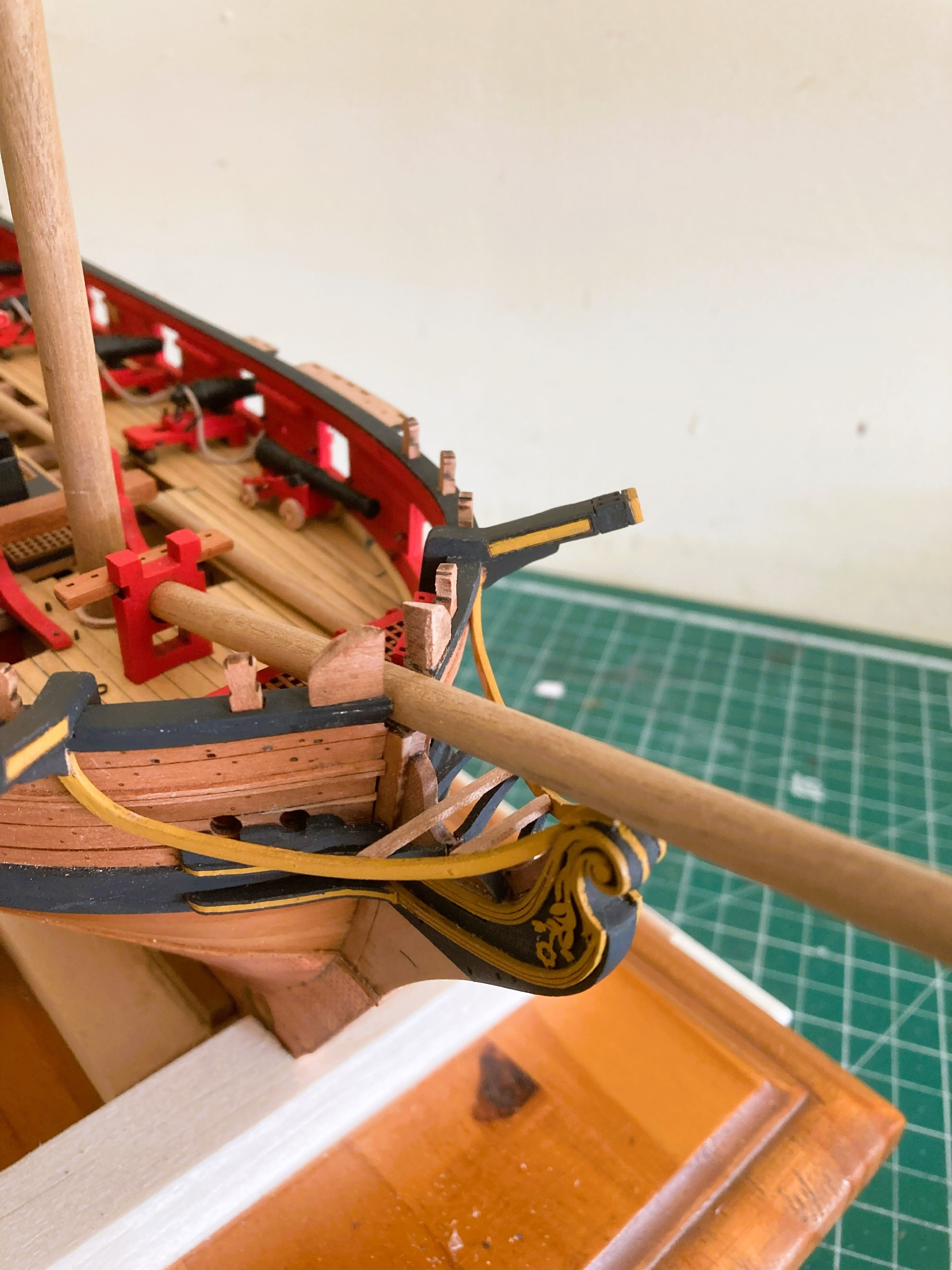

The  Bow bollards (275) referred to in the manual as  Gunwale bow timbers sit either side of the Bowsprit. They are a less fancy version of the Knightheads that support the Bowsprit.
These need  bevelling on their inboard faces to run parallel to the Bowsprit.

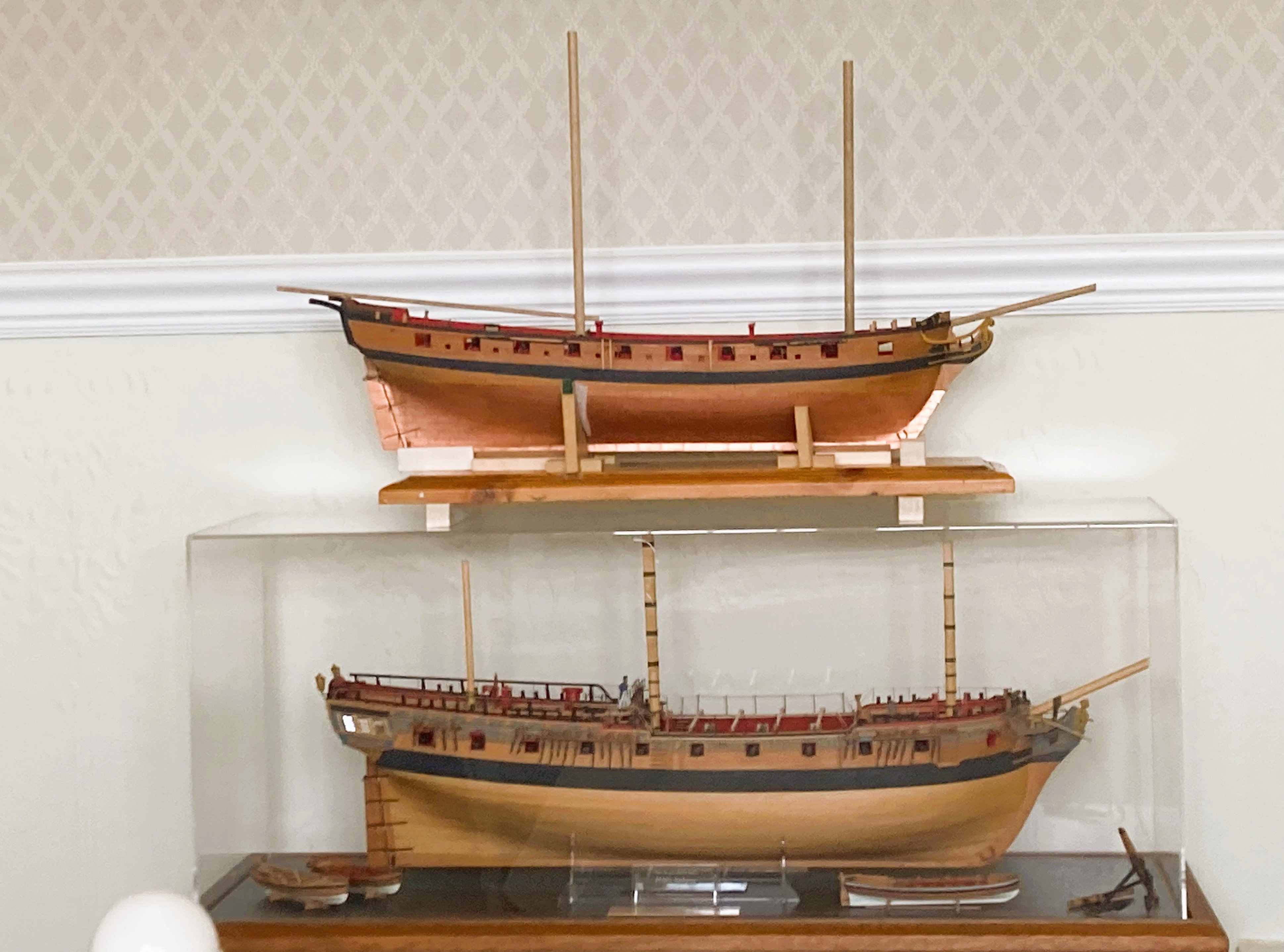

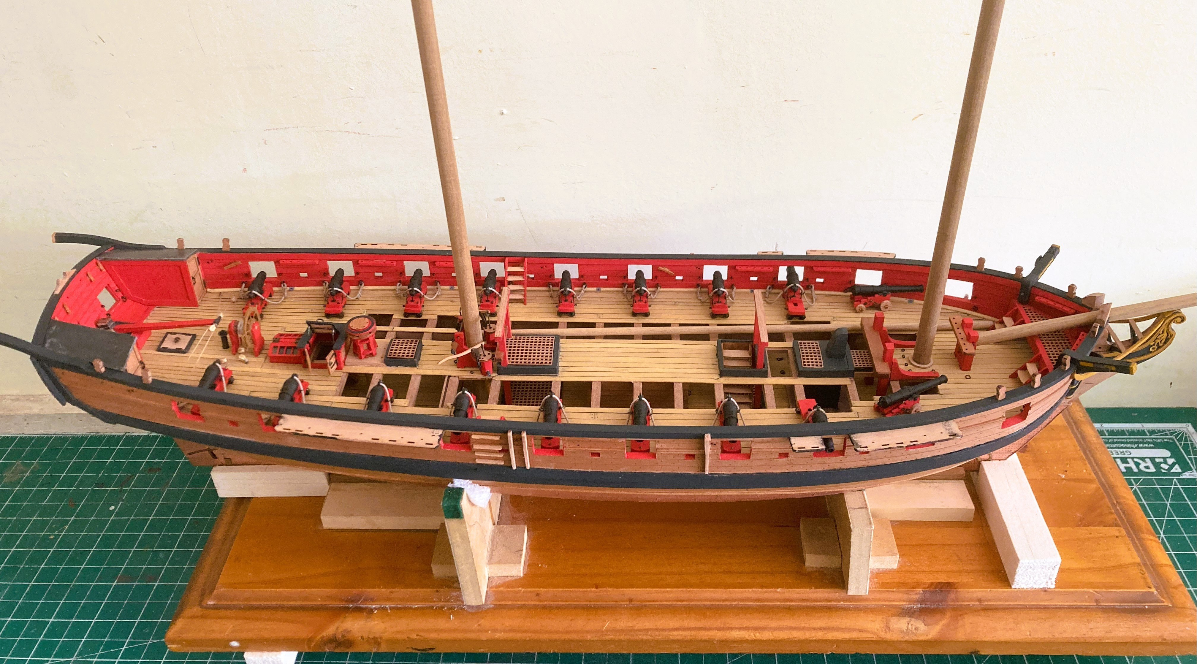

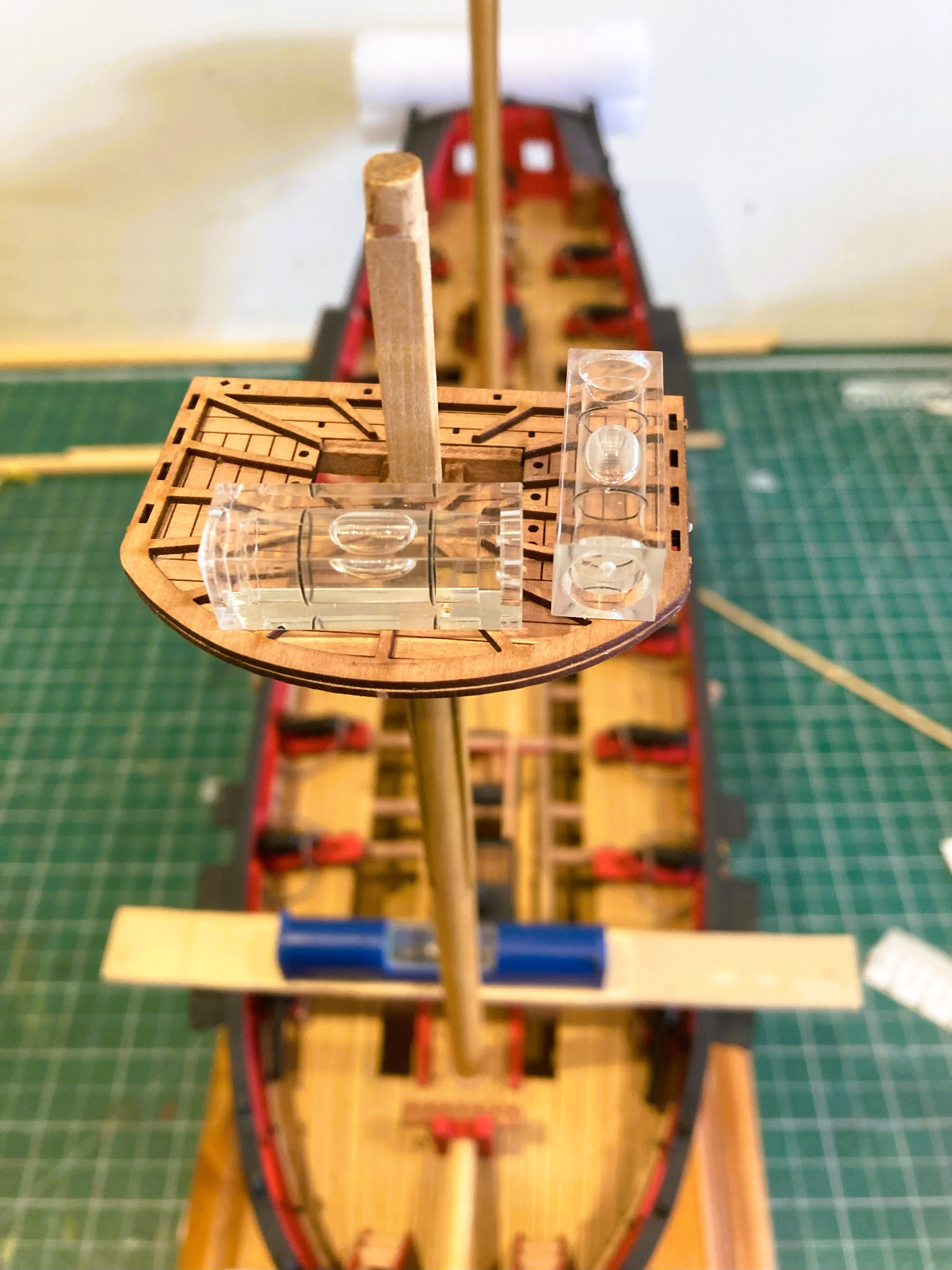

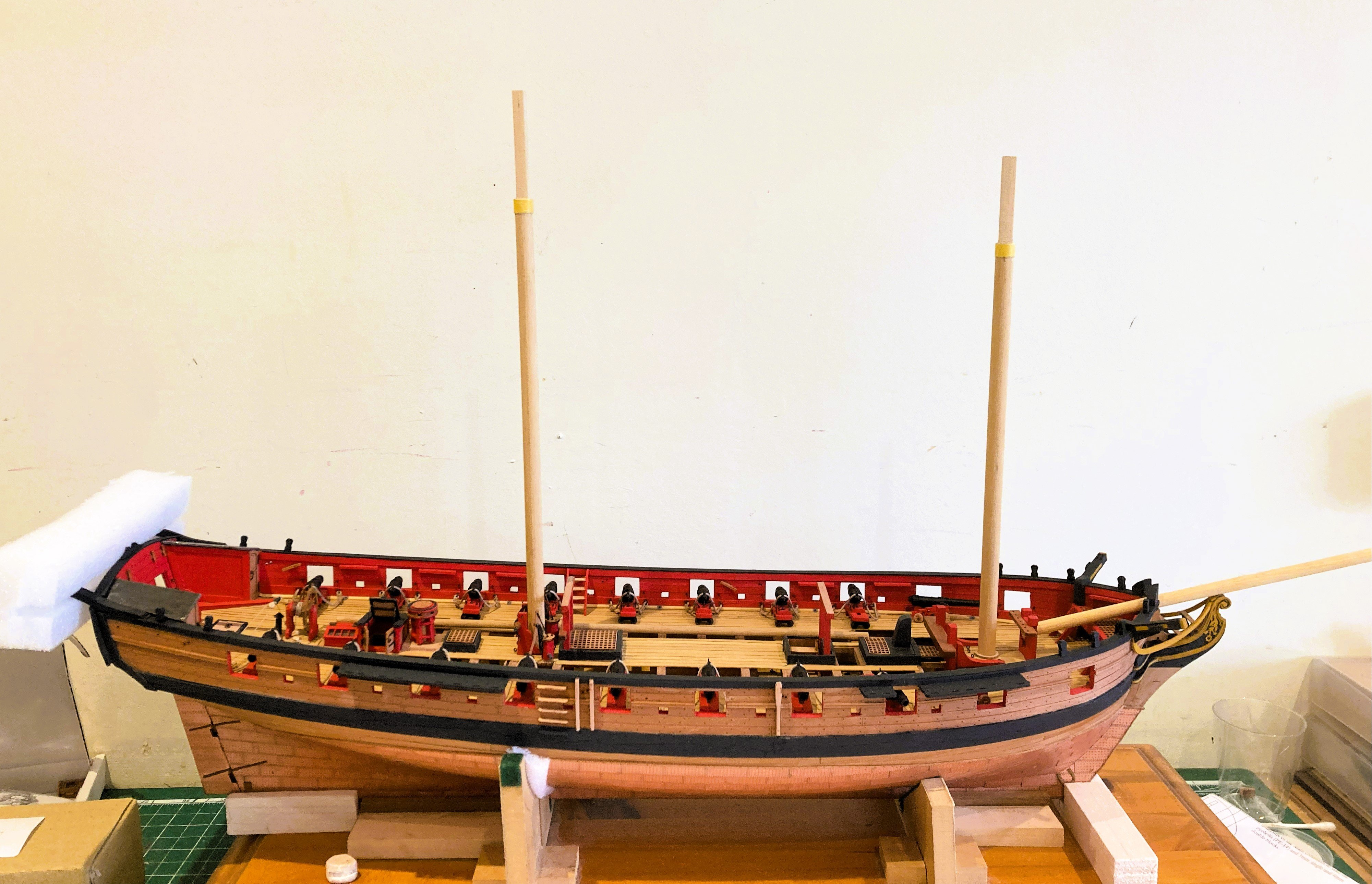

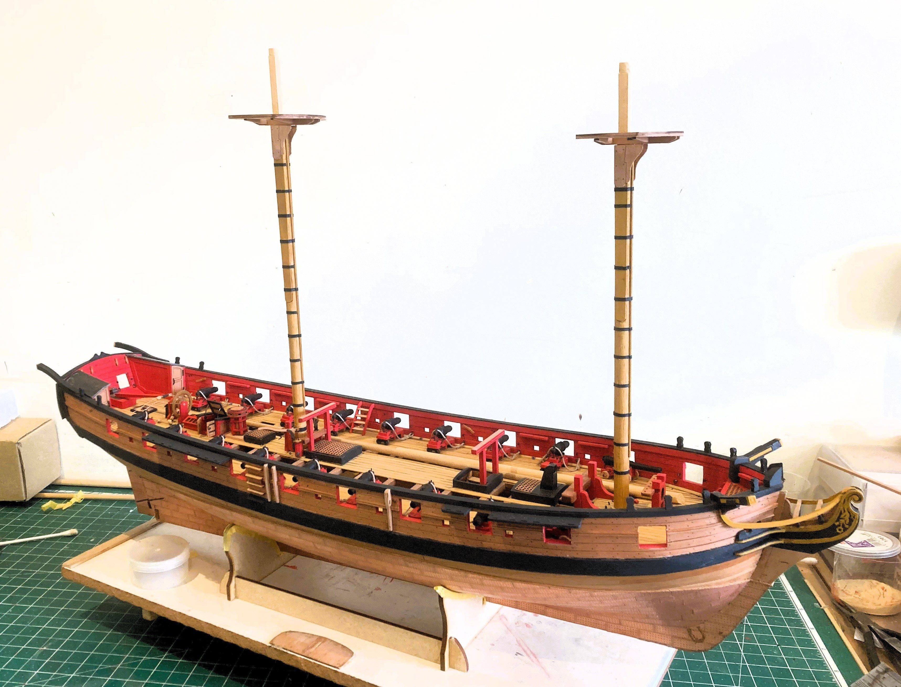

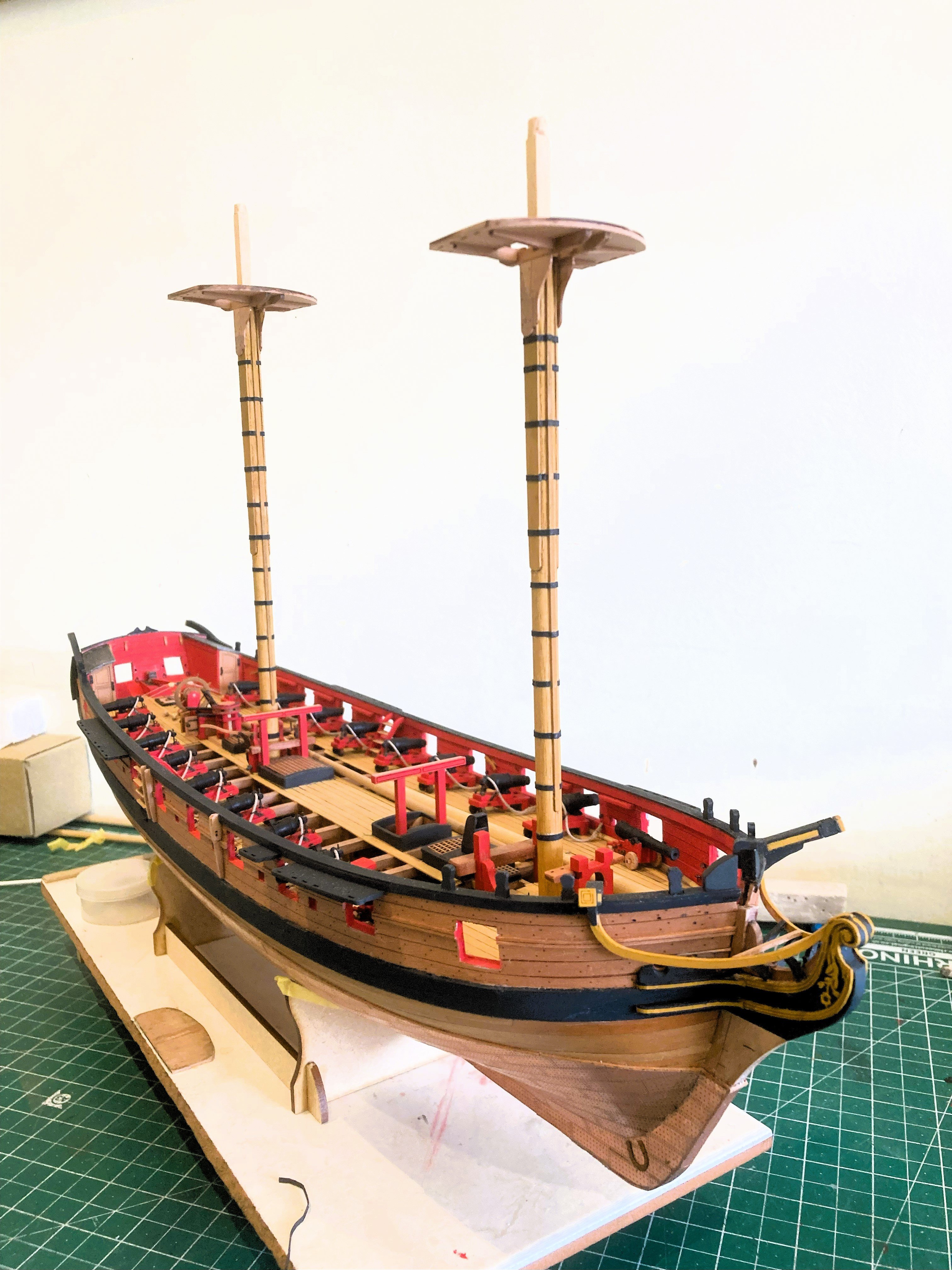

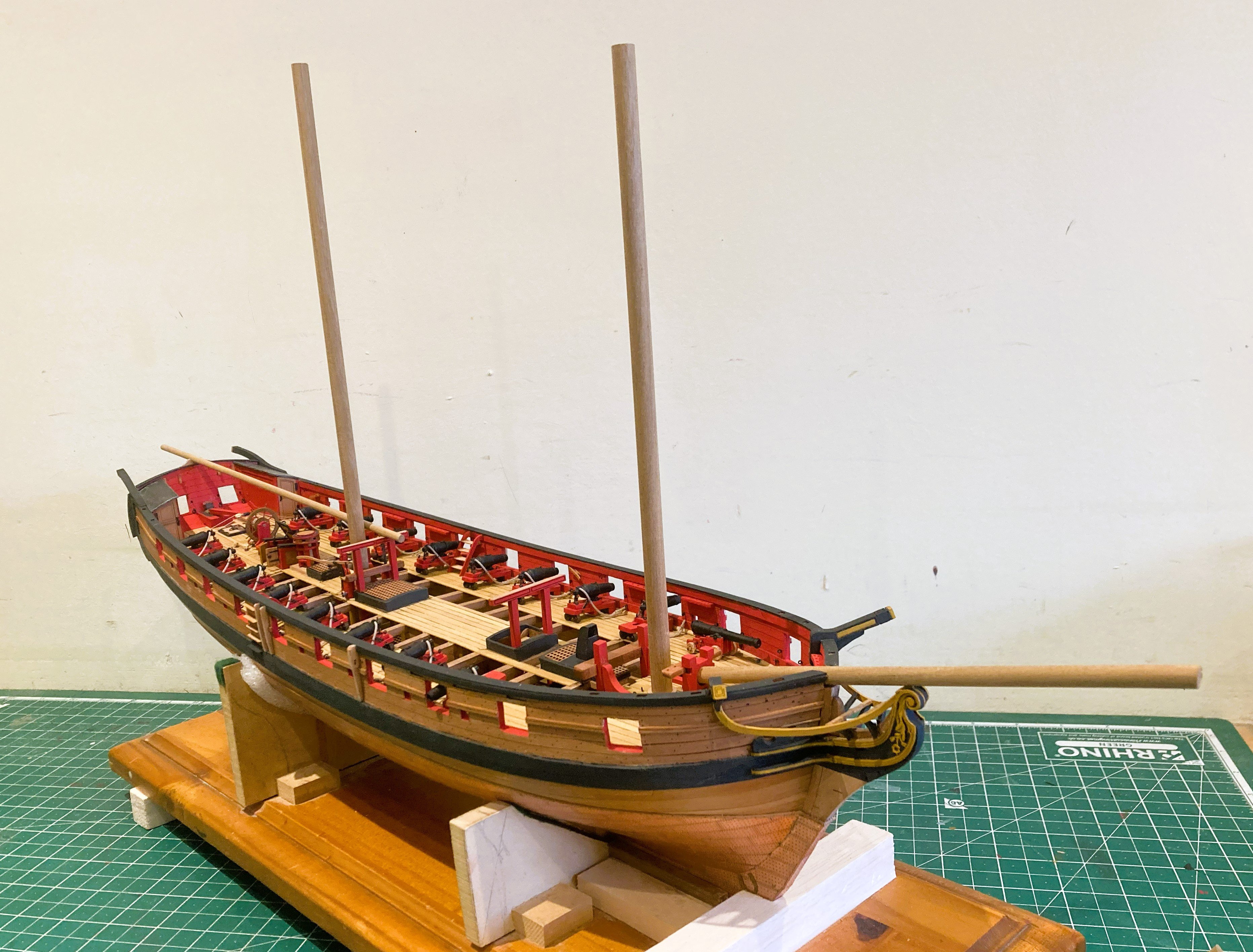

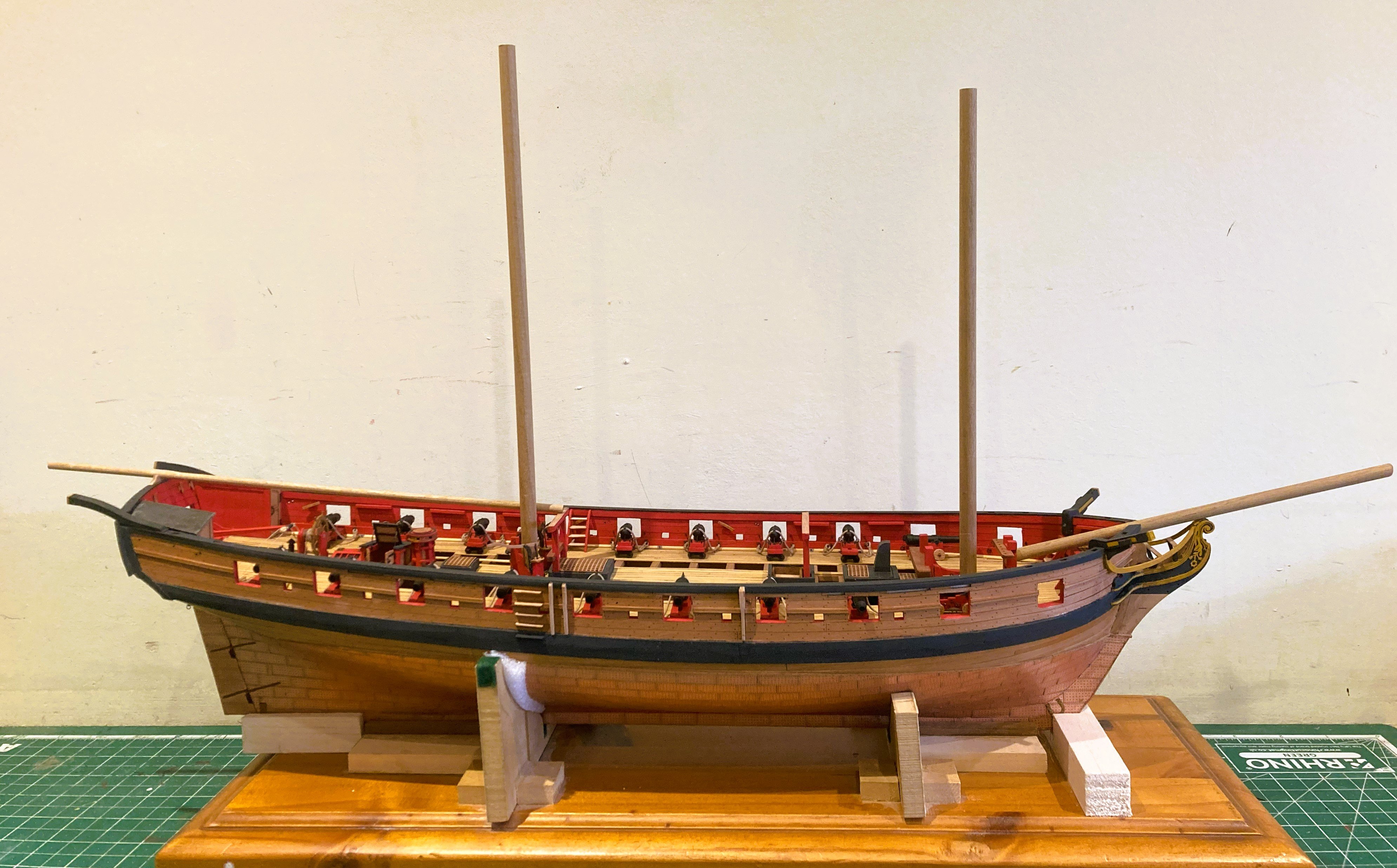

I have made up some test  masts and spars to gauge the overall size were I to detail the lower masts and standing rigging.
4068a
These are the full length Masts, Bowsprit, and Driver boom, as per the plans. How they relate to Steel I haven’t checked at this point.
4070a
The masts are in Walnut but I prefer Ramin for lower masts.
4090a
This is the space profile compared to Sphinx, I  think I can accommodate her with lower rigging in place but without the yards.
Decision made.
B.E.

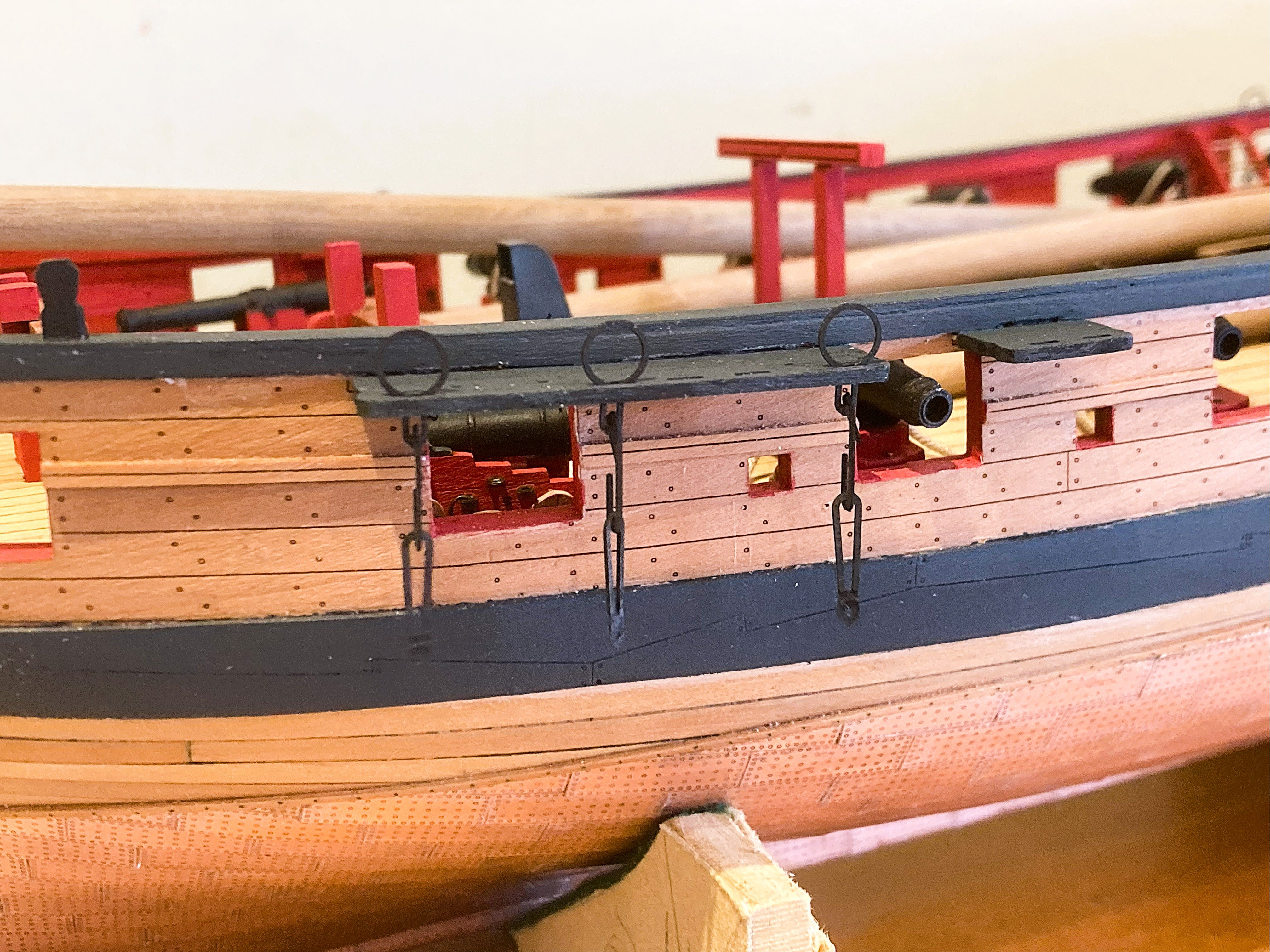

Strops, chains, and plates.

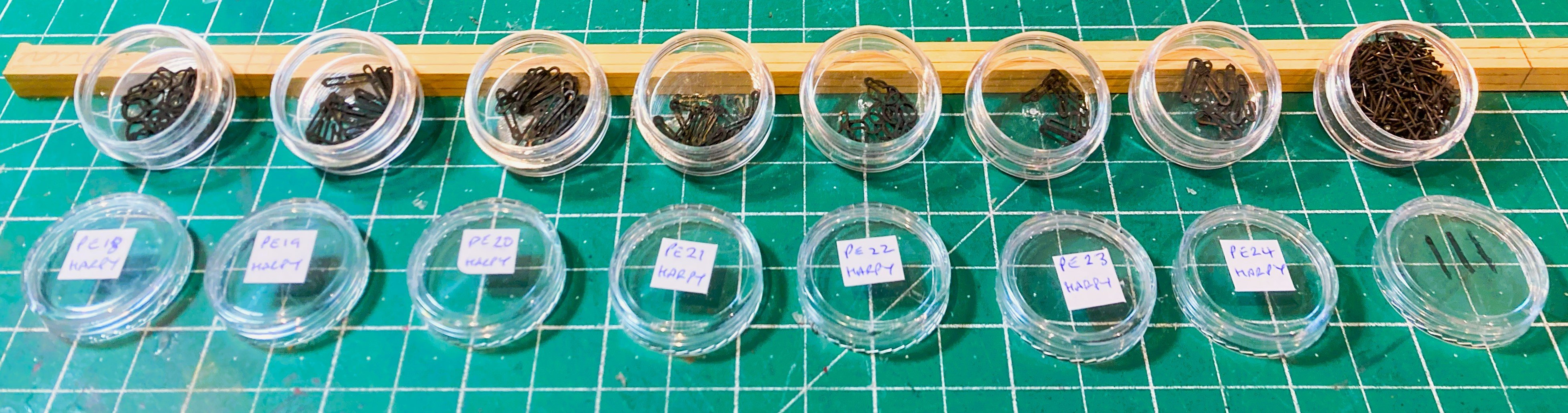

I prefer to chemically blacken ‘ironwork’ rather than paint it, as I think it gives a subtle and more realistic representation.
4105a
It is more time consuming, and there are several parts that make up the strops and chain plate combinations.
4112a
I test the assembled shroud combinations along the Channels to gauge where they fall on the Wale.
The positions shown on the plan accord with those on the Adm plan.
4111a

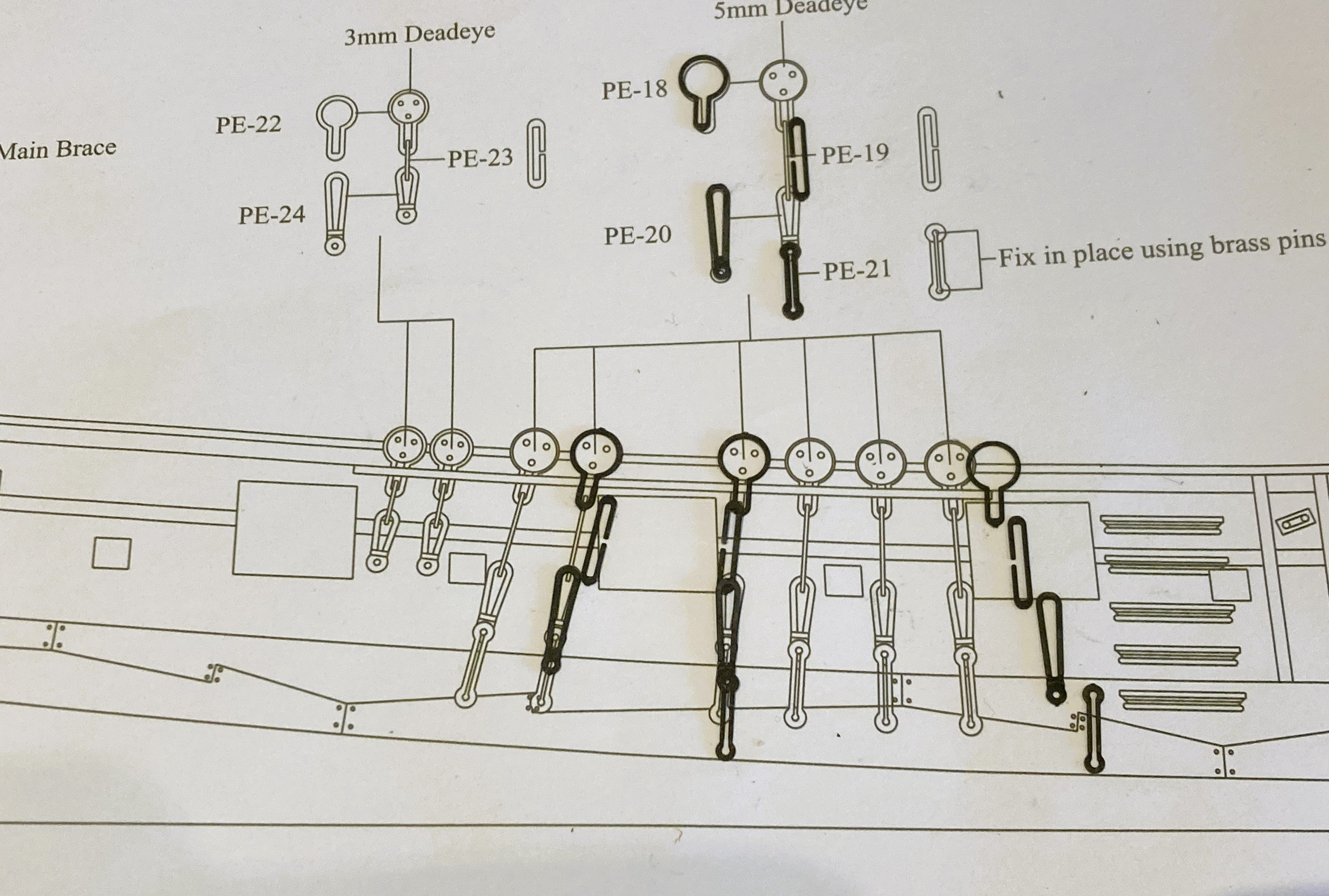

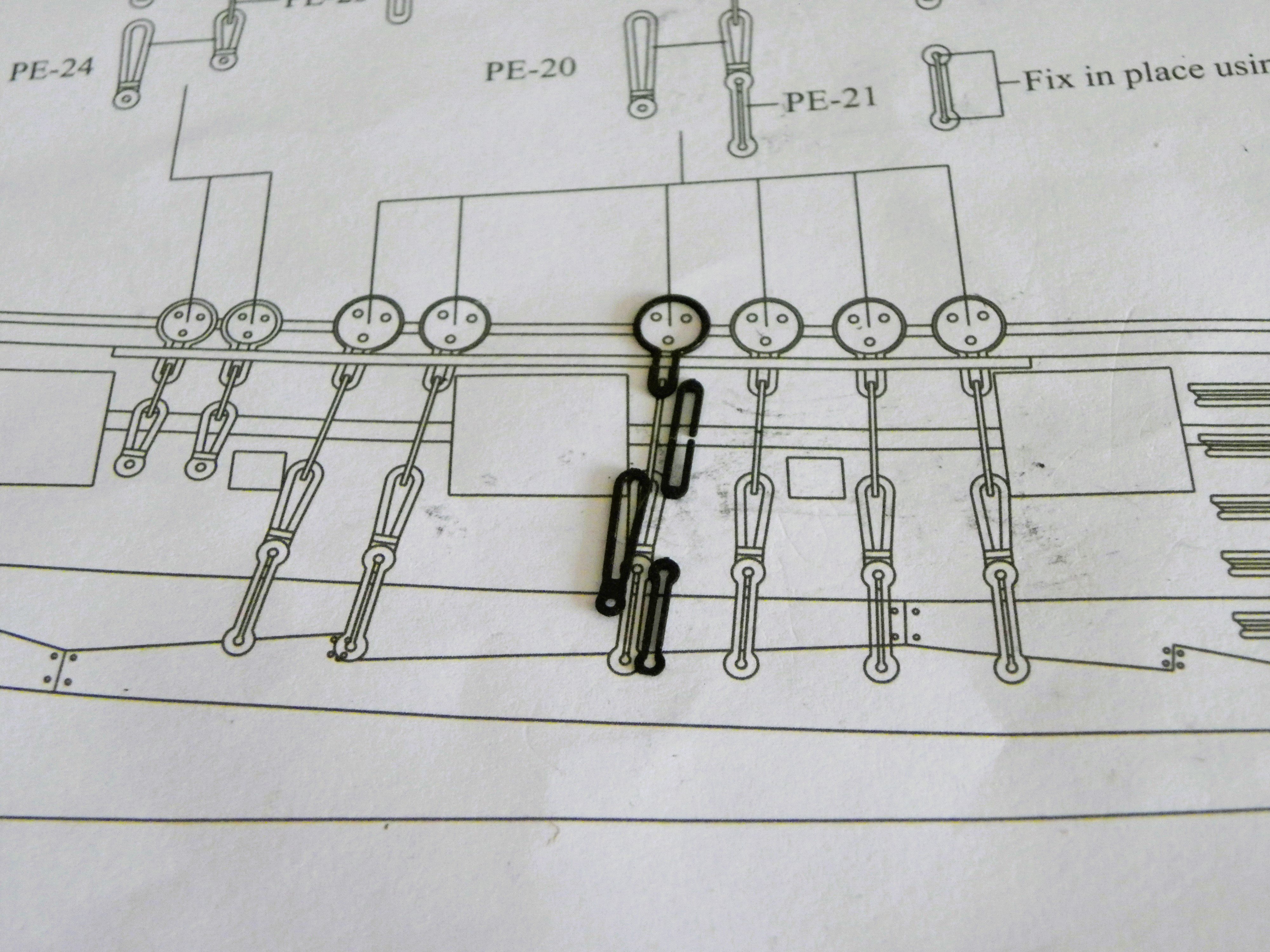

I may be missing something but I seem to have a potential problem; the lower link falls  awkwardly right on the top edge of the wale, and the preventer plate sits too low on the wale.
004
Compared to the Plan the lower chain (pe20) seems over-long which throws the Preventer plate (pe21) too low.
I have come across this issue on previous models where the answer is to adjust the upper chain link to bring the lower link and preventer plate to their correct placing, but a smaller lower link would be preferable.
This does however involve a fair bit of faffing around to get the correct size.

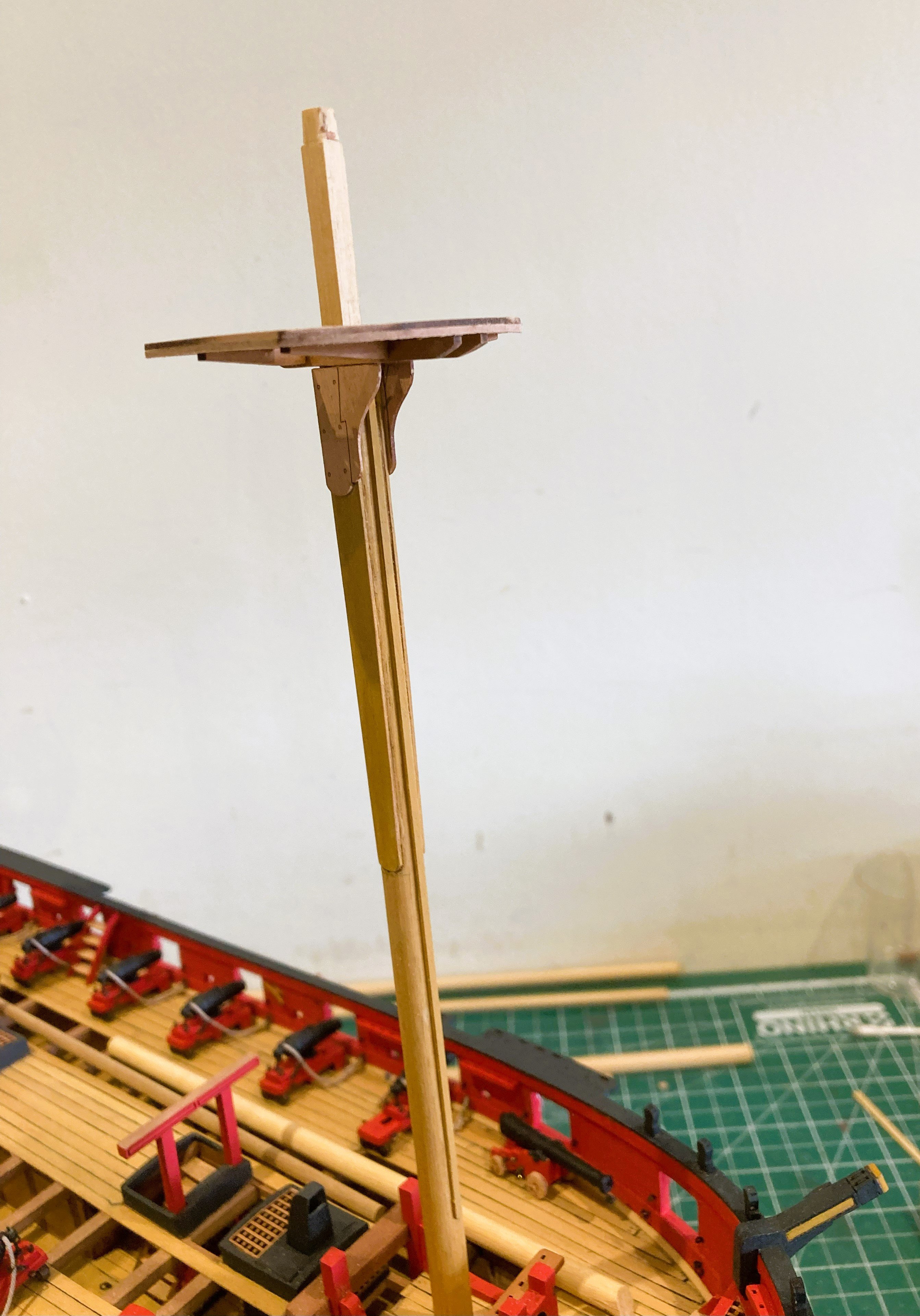

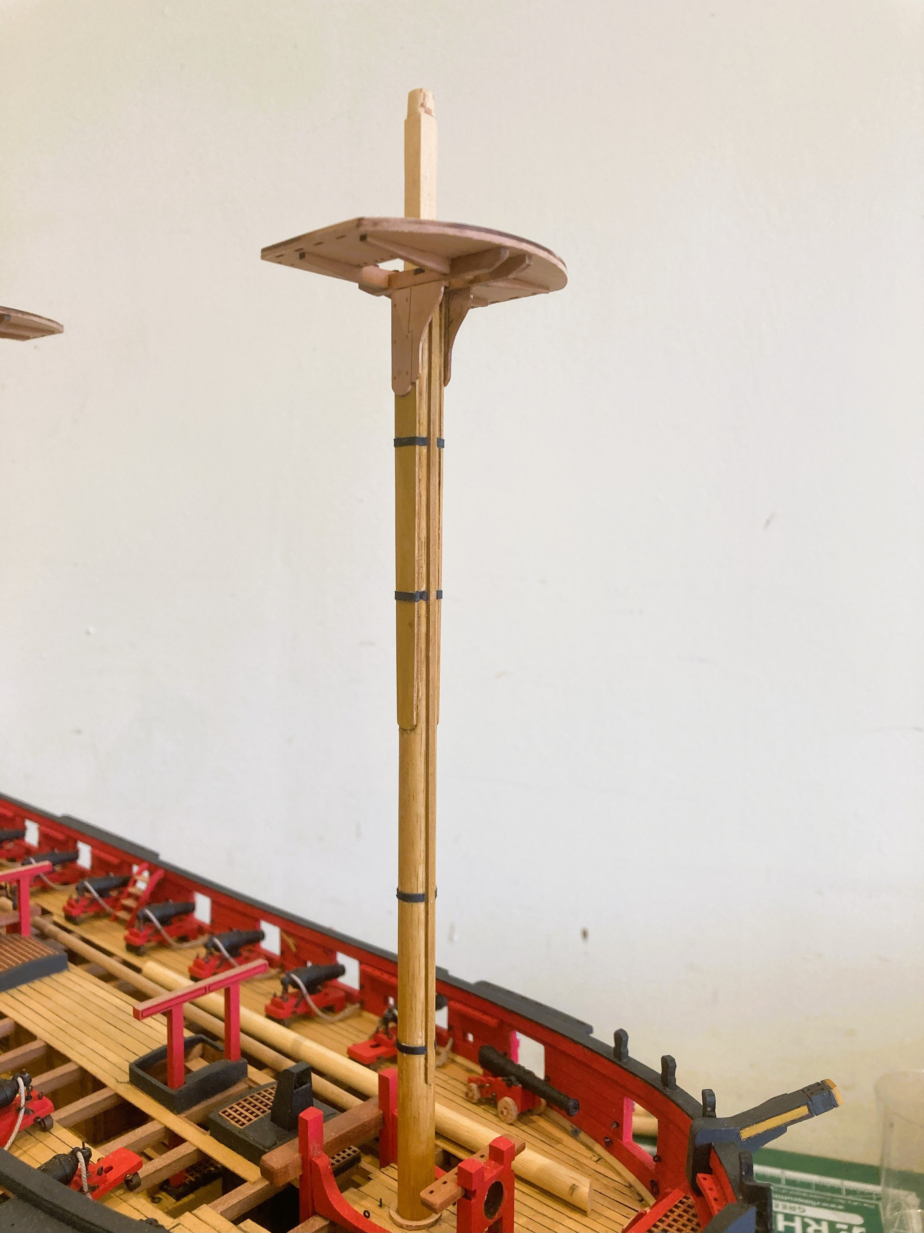

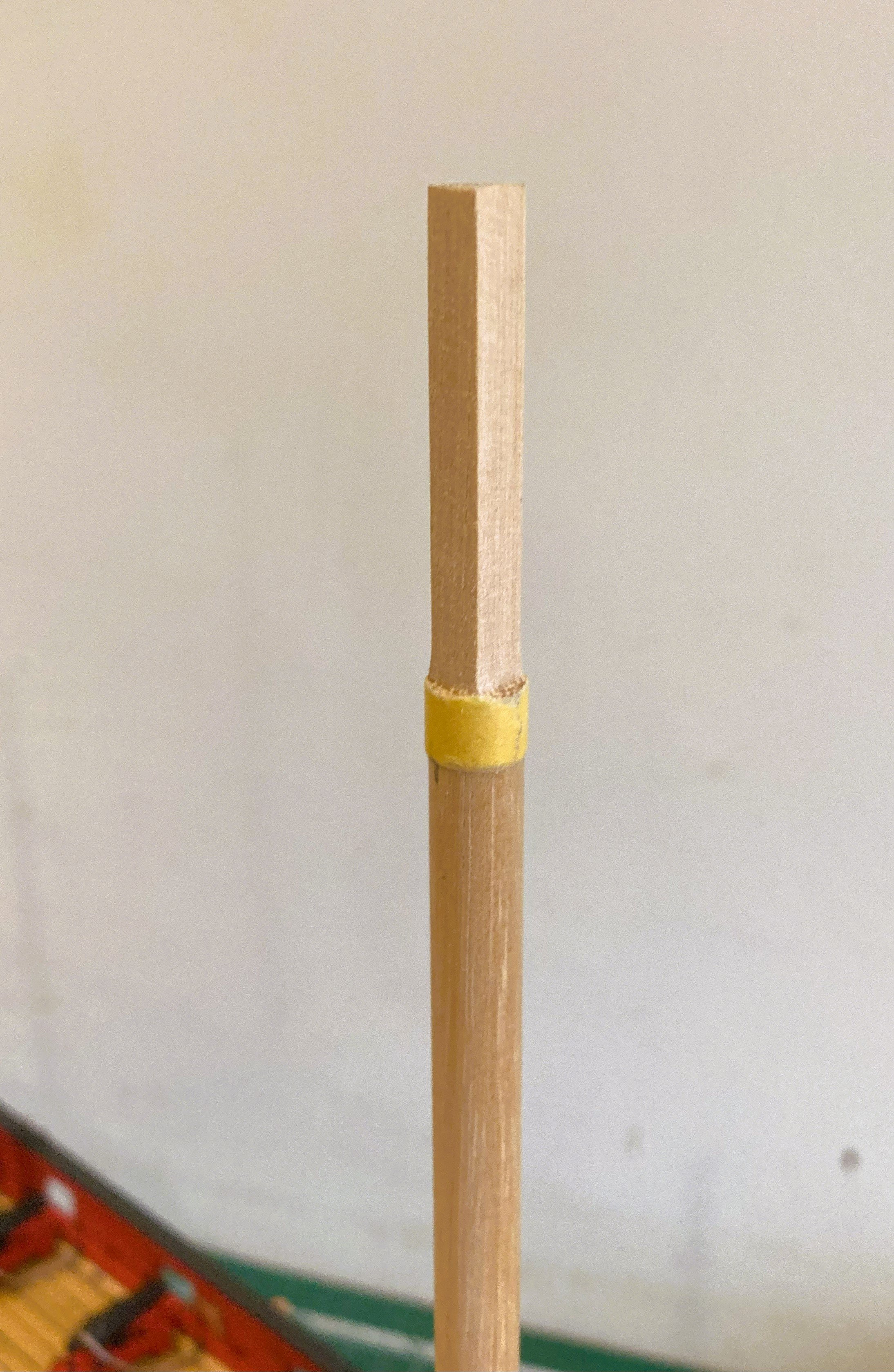

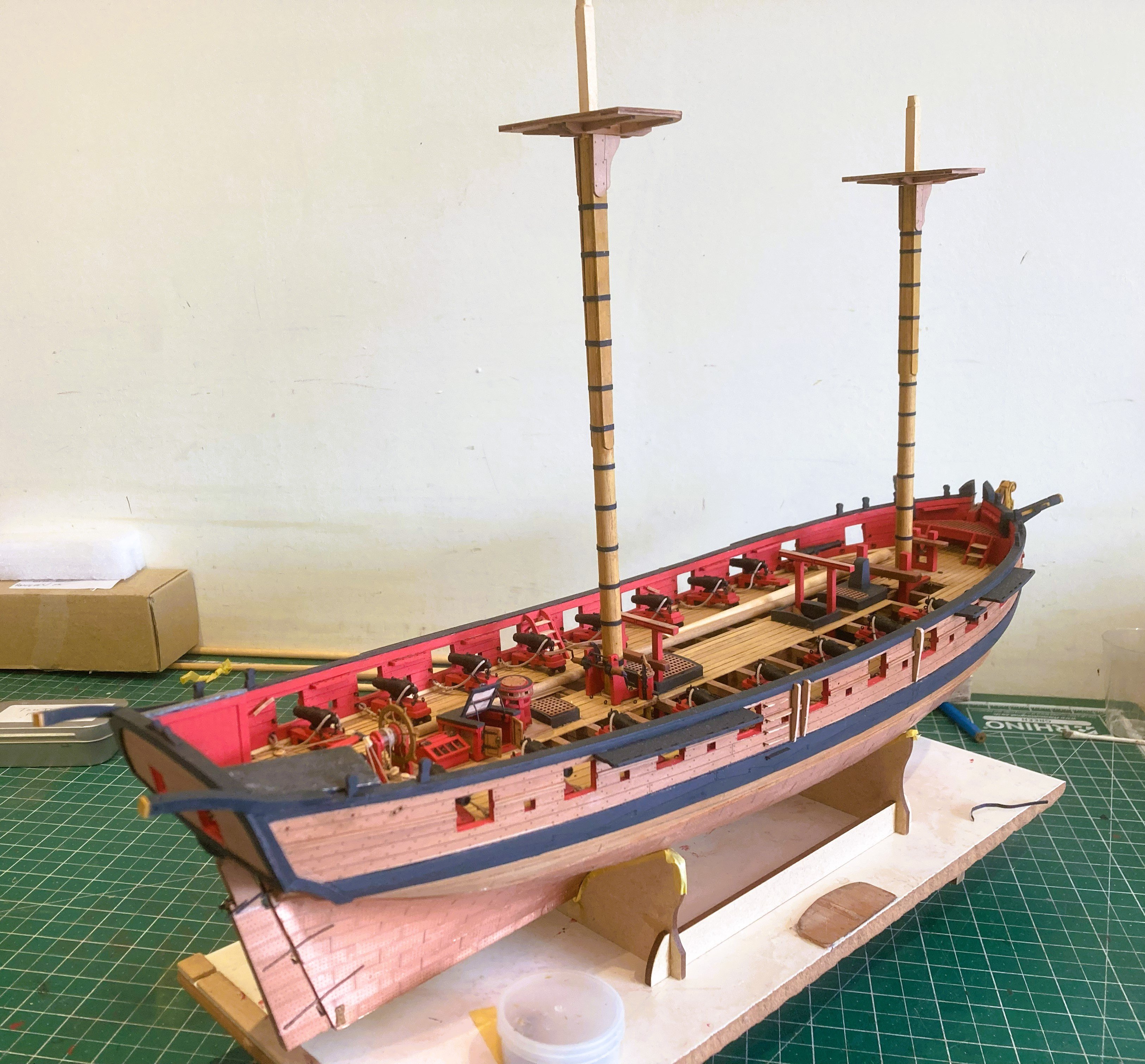

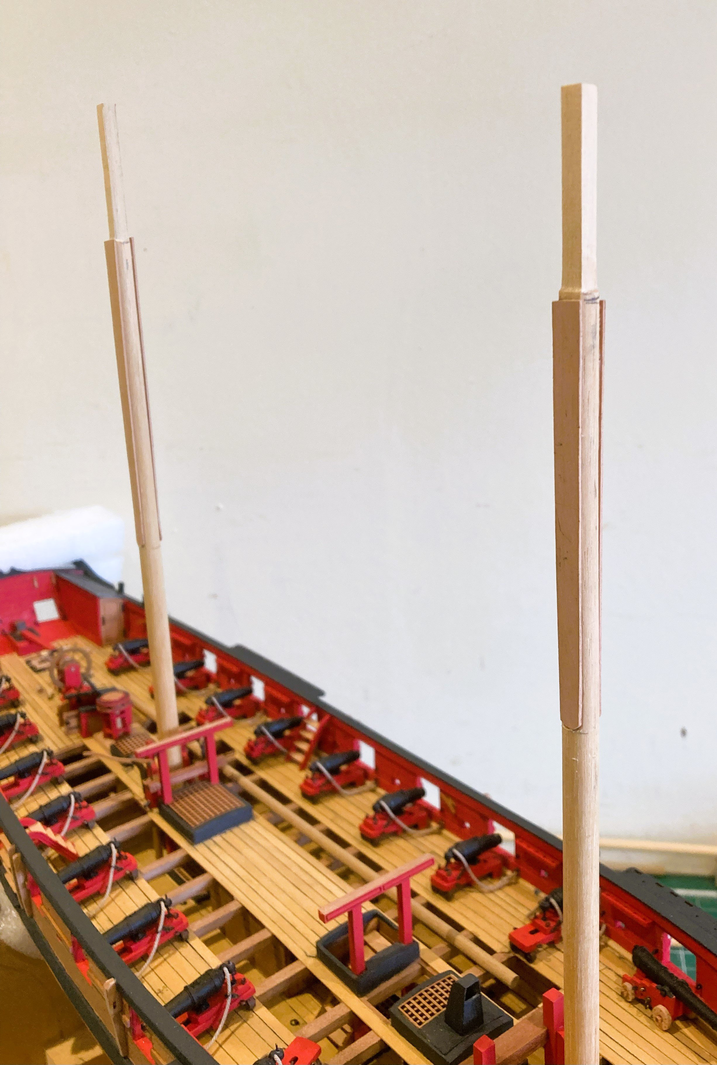

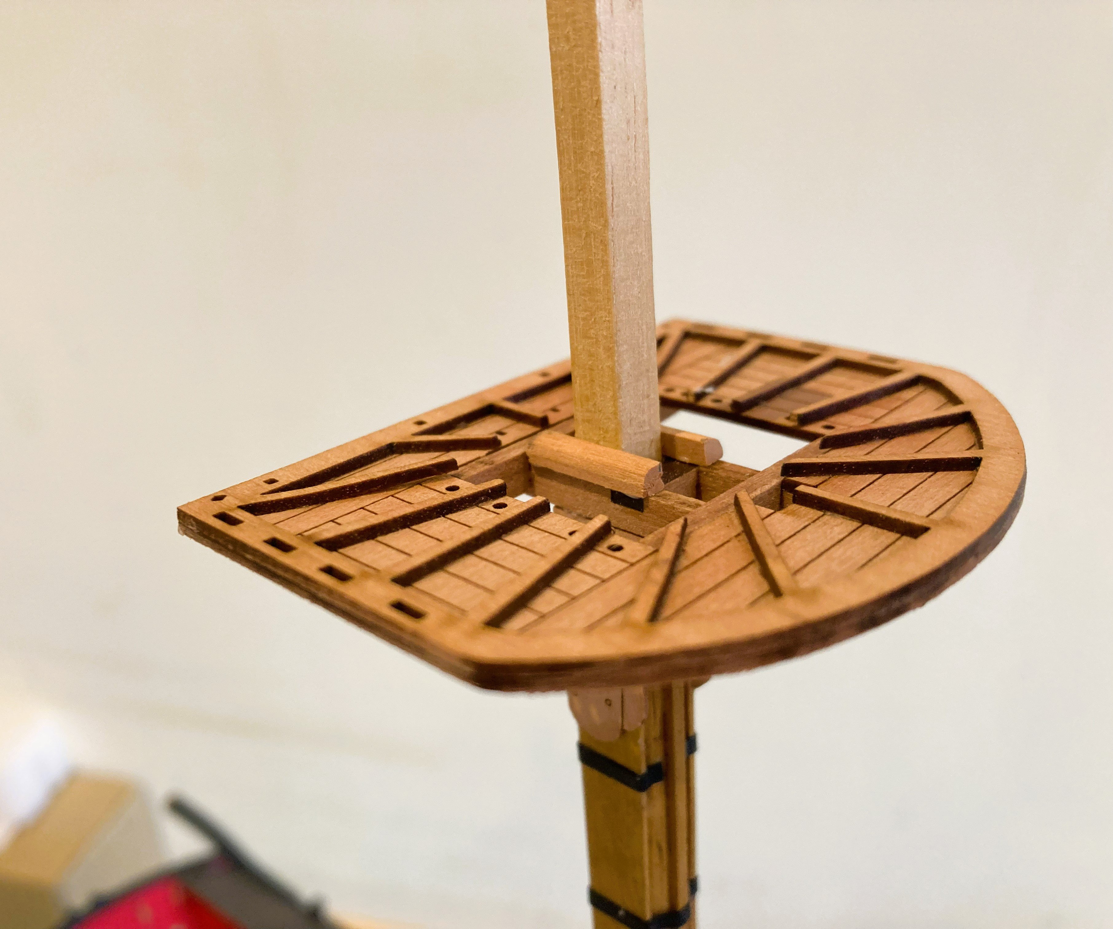

Fore and Main Masts. (Part 1)
I am working these as per the kit dimensions using 8mm Ramin dowel.

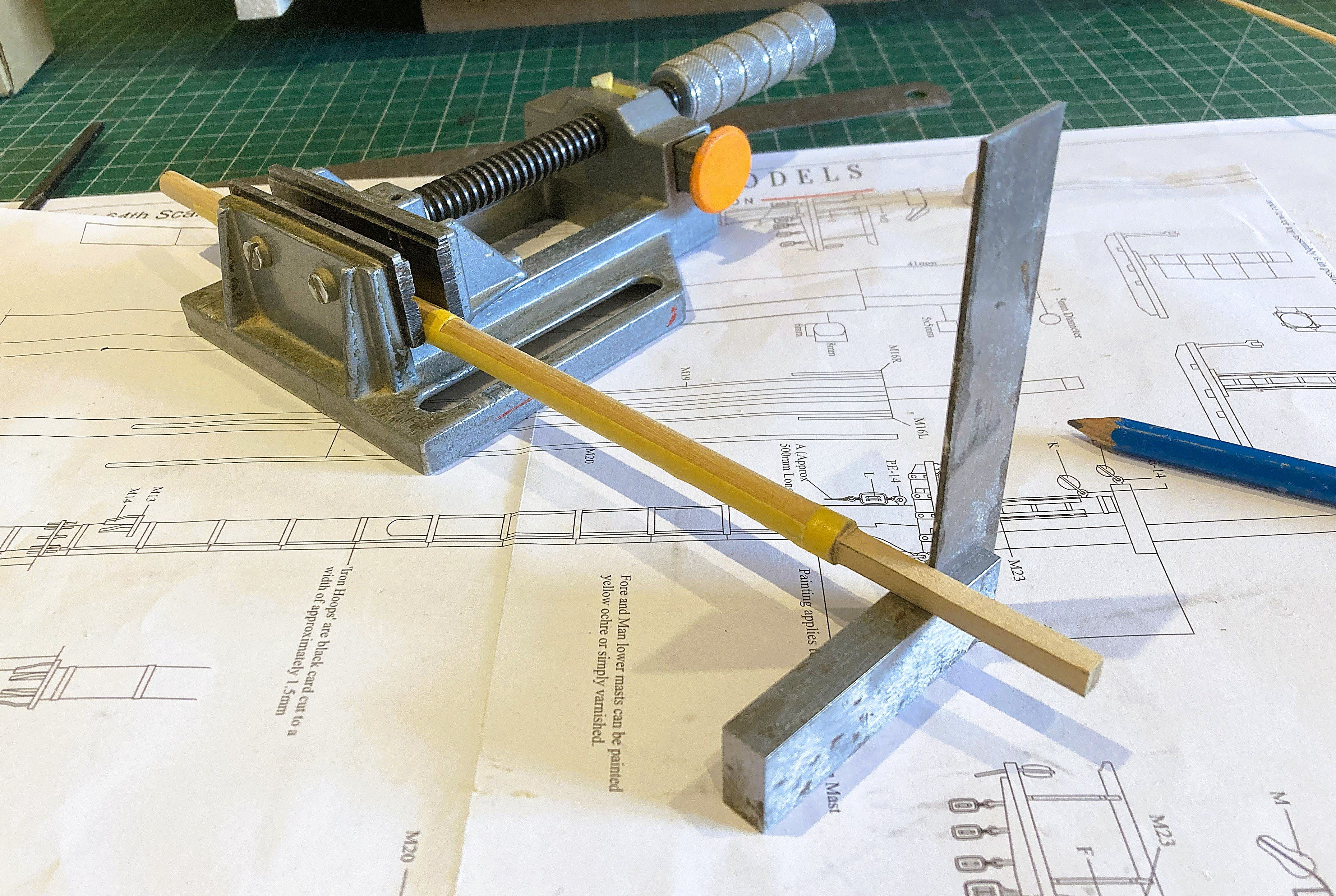

The trickiest part is forming the 5mm square mastheads from dowel.
I do this  by marking the square area on the dowel top, lining along for the required length, and filing using 120 grade sandpaper glued to a broad stick.
I gauge by eye with constant  measurement and square checks.
4138a
 I initially  pare down to around 5.5mm before checking with the cross trees. It is then a case of reduction by degrees whilst maintaining the square profile.
4142a
The sides of the stick are then sanded flat to accommodate the Cheeks.
4143a
I use Tamiya tape to define the  area to take the cheeks, again careful use of a broad sanding stick is all that is required with constant checking to ensure squareness.
4161a
The masts were coated with w-o-p, and I painted the Pearwood cheeks to better tone with the Ramin Masts. I then use a water based oche tinted wood dye to  even out the colour tone.

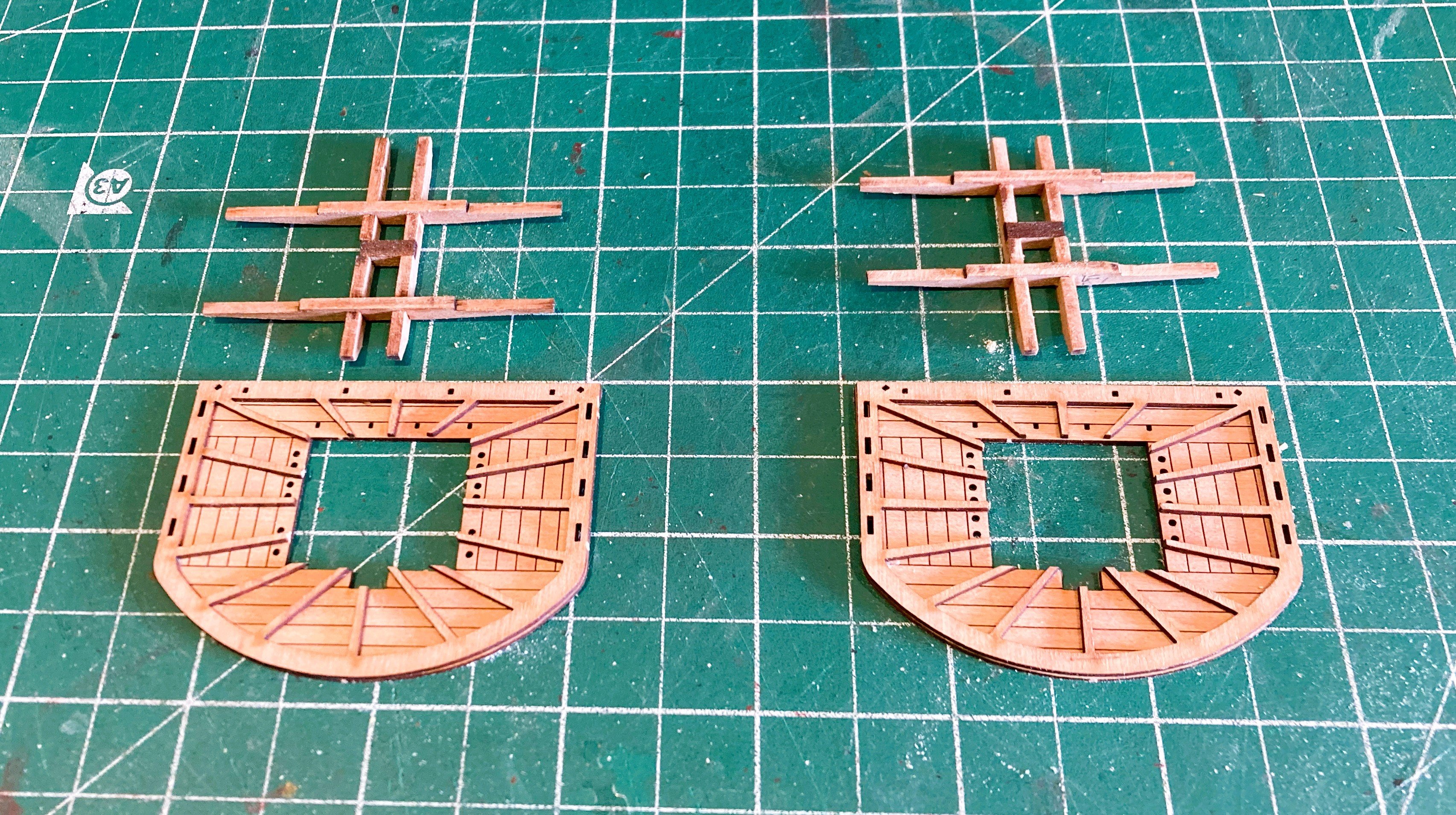

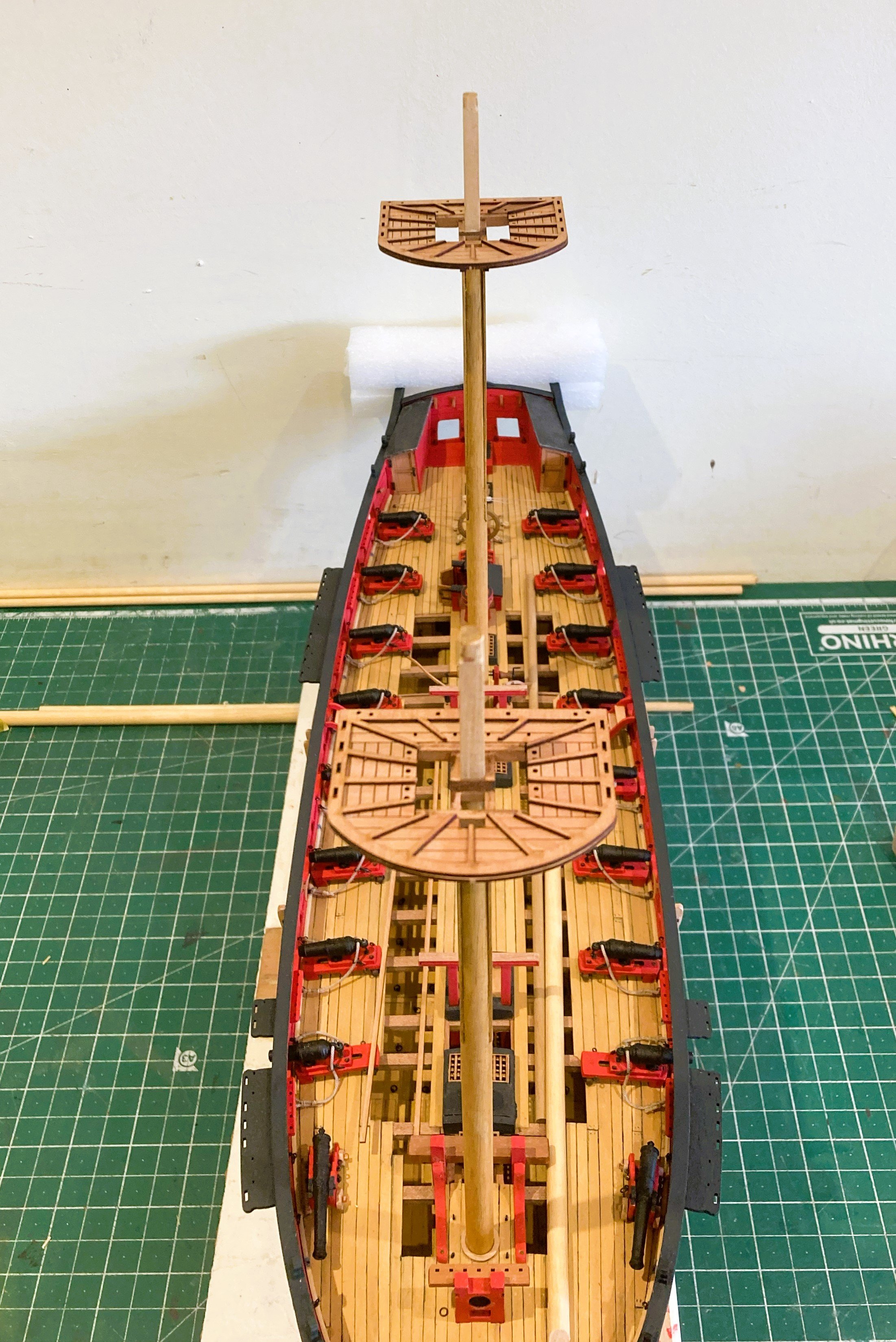

The laser cut Trestle trees in Pearwood slot together cleanly and firmly.
4164a
I very much like the Mast tops, beautifully cut and detailed, a joy to work with.

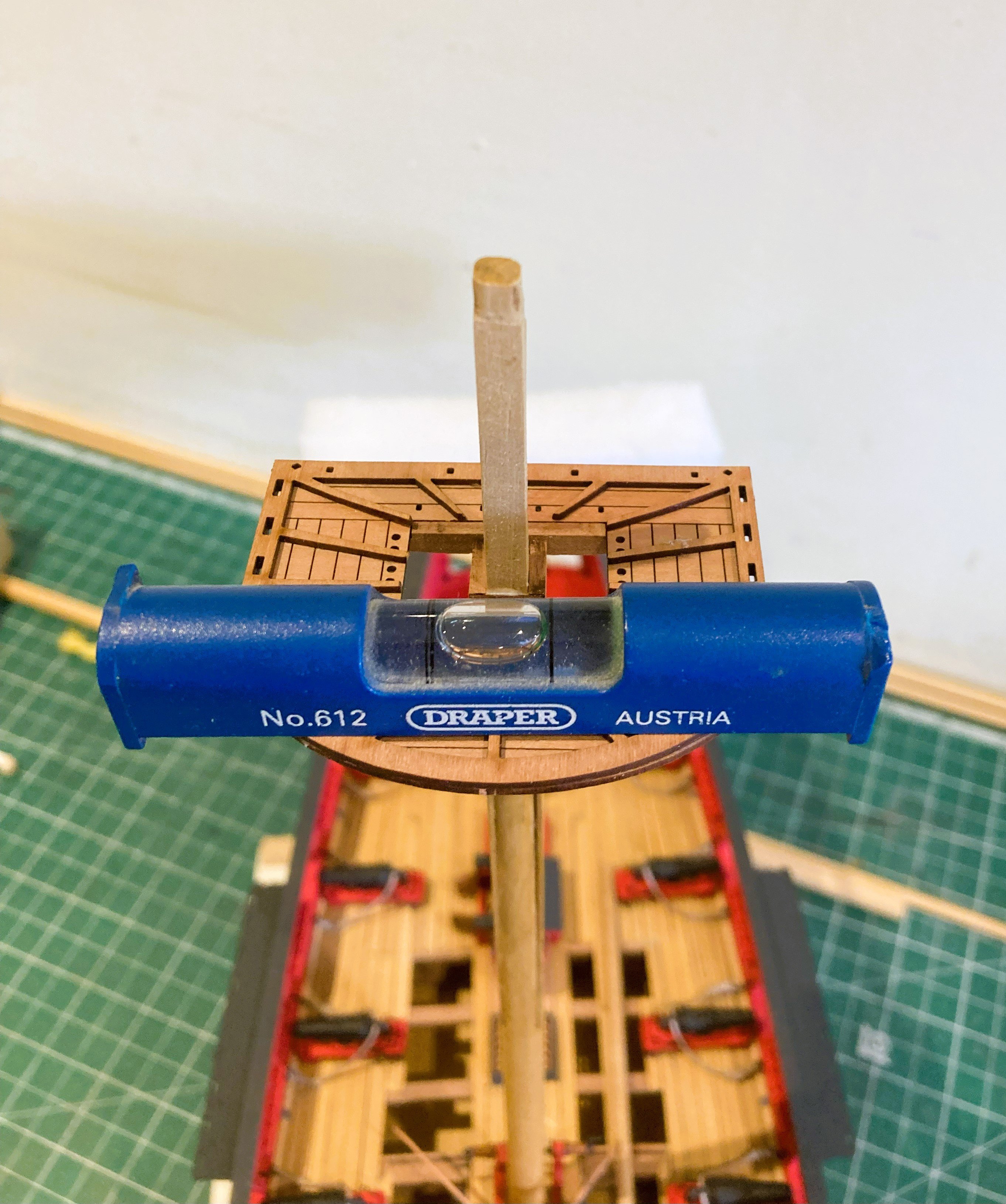

Regardless of mast rake the tops should be level to the waterline.
4176a
4179a
4183a
4188a
It seems to take me ages to ensure the Mast tops sit square and level, the final adjustments being made after gluing but before it sets.
4191a
Once the mast tops are firmly fixed, the  Bibs and  Front fish are added.
B.E.

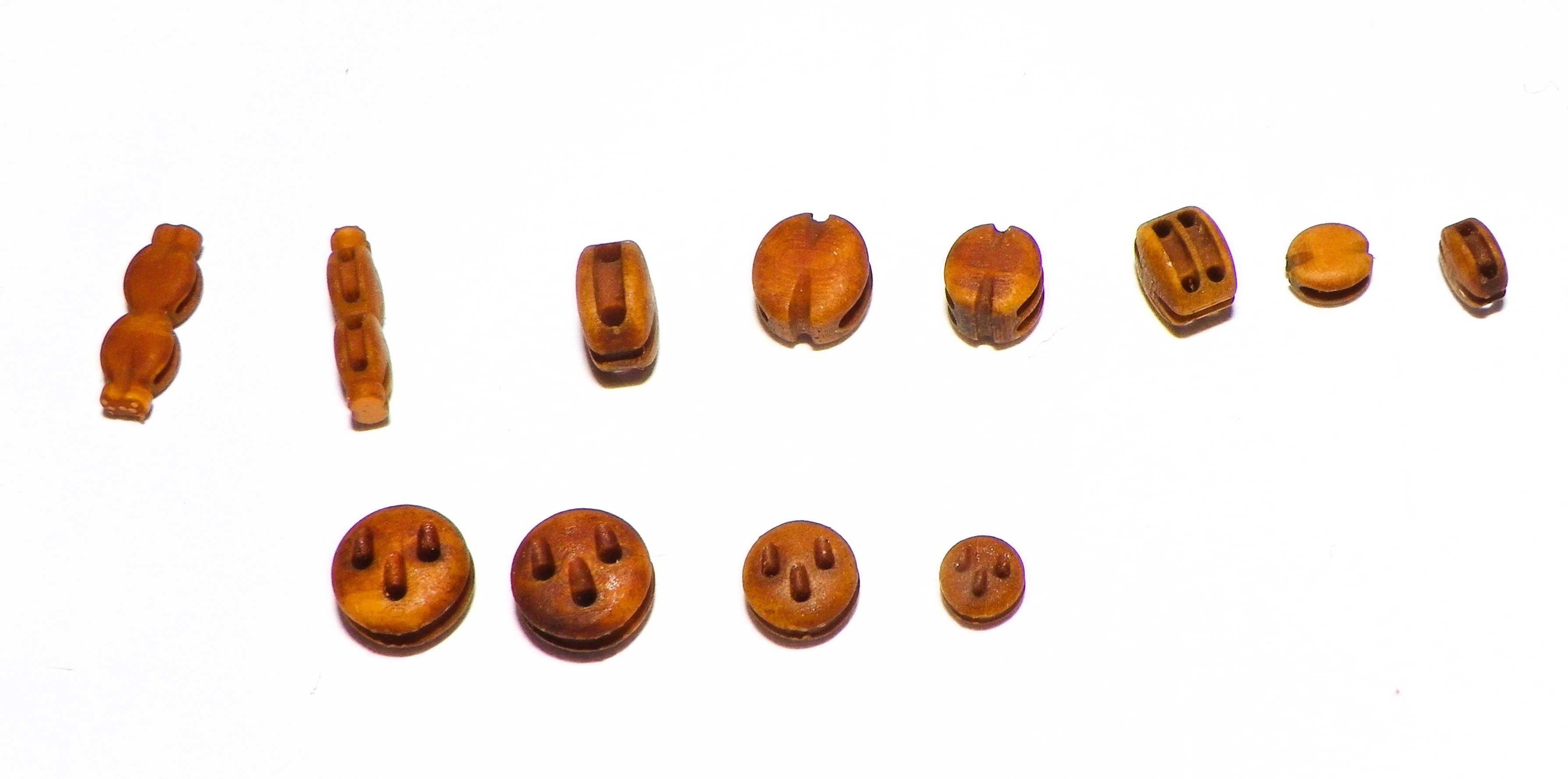

My supply of resin deadeyes and blocks arrived today, a mere seven days from order to door. Thanks Chuck, excellent service.
0012
Swiss Pear Resin versions from Chuck’s Syren range.
I am very pleased with these, the detail is way beyond the usual kit blocks. Note the shaping of the ‘eyes’ in the deadeyes, and the well formed sheaves and strop grooves in the blocks.
0014

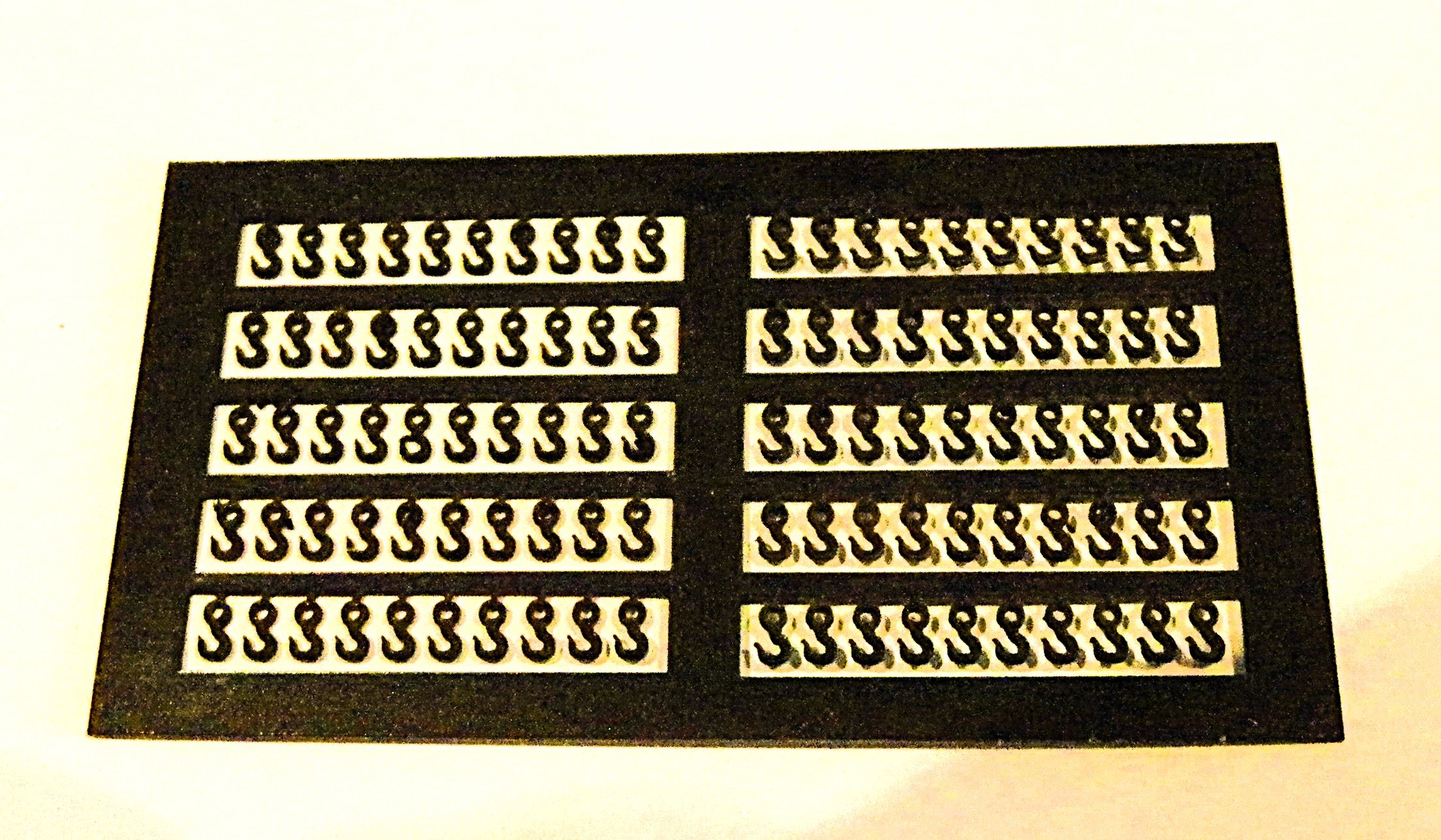

3mm rigging hooks
I also  like these black plastic hooks, saves all that blackening of brass versions.
I note that Chuck is contemplating making a 3/16”  scale version of Resin Belay pins that should suit a 1:64 scale model.
I do hope this comes to pass, they would be a nicer option than the rather two-dimensional brass etch versions.

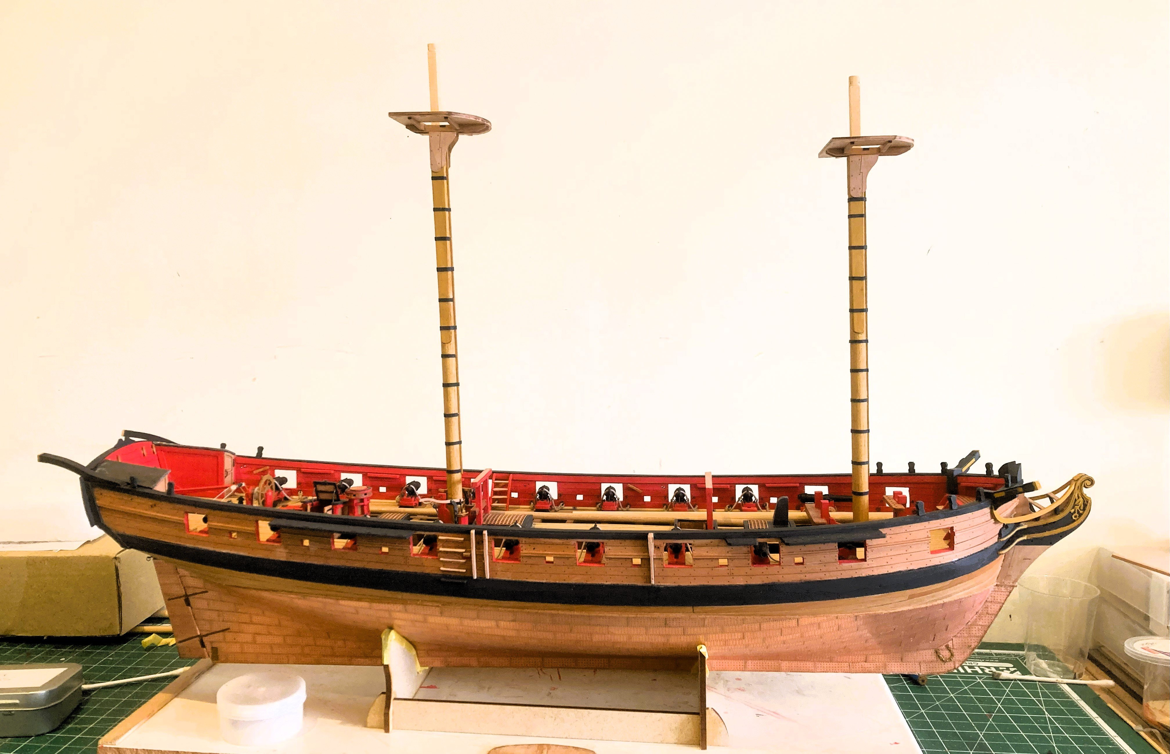

Post 75
Masts (Part 2)

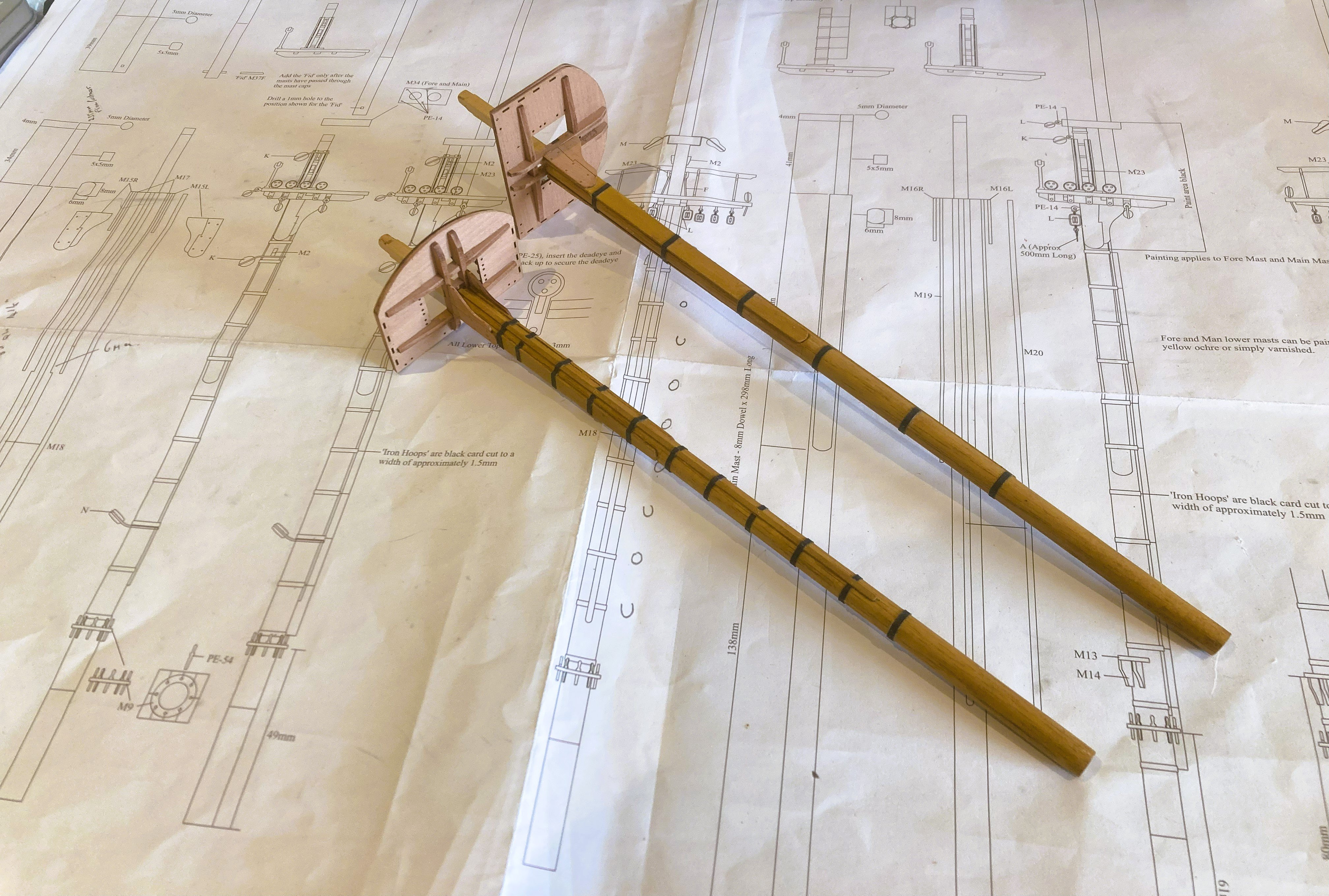

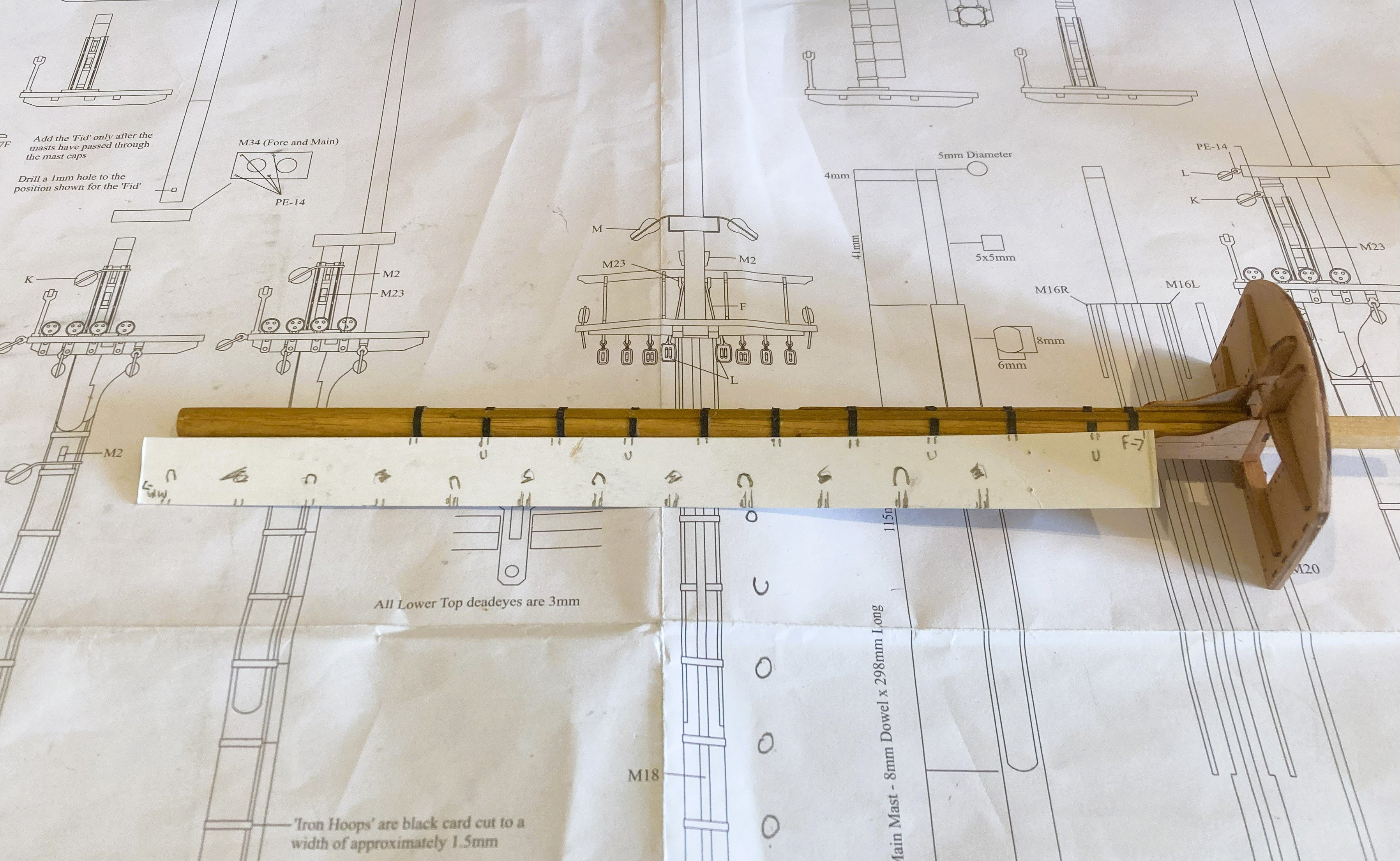

Mast Hoops
There are twelve iron hoops supporting the Main mast, alternating between under and over the Front Fish.
The Foremast has ten hoops but they don’t uniformly alternate, six sit above the front fish and four beneath.
There are no wooldings involved with the Harpy build.
The kit provides black card for the purpose of Hoop making and  a scale breadth of 1.5mm is indicated.
This agrees with the sizes given by Steel.
Breadth – 4” - 4½” breadth, ½” - ⅝” thick.
Whilst I often use  slices of  heat shrink tubing for hoops I will be using the card option which will better conform to the profile around cheeks and Fish.
4203a
I fit the hoops that fit beneath the Fish first, here on the Fore mast.
4208a
I use a template to mark the hoop positions down the mast.
4207a
Fitting the hoops is  a bit fiddly, care has to be taken to remove any glue  spread onto the mast.
4213a
4214a
4215a
4216a
I have left the hoops black as a contrast but in reality they would probably have been painted along with the masts by the early 19thcentury.
Bolsters
These are provided as short sections of 2x2mm square stock.
In my view they are a tad on the short side as a means of  protecting the shrouds, particularly if the shrouds are to be properly served.
4221a
I replaced the kit parts with quarter rounded 2x2.5mm  stuff. This also overhangs the trestletrees by a fraction as it should.
I’m leaving the masts for a while as my supplies of Resin deadeyes have arrived and I’m  keen to resolve the looming problem of over-long links, which has been on my mind since Post 73.
B.E.

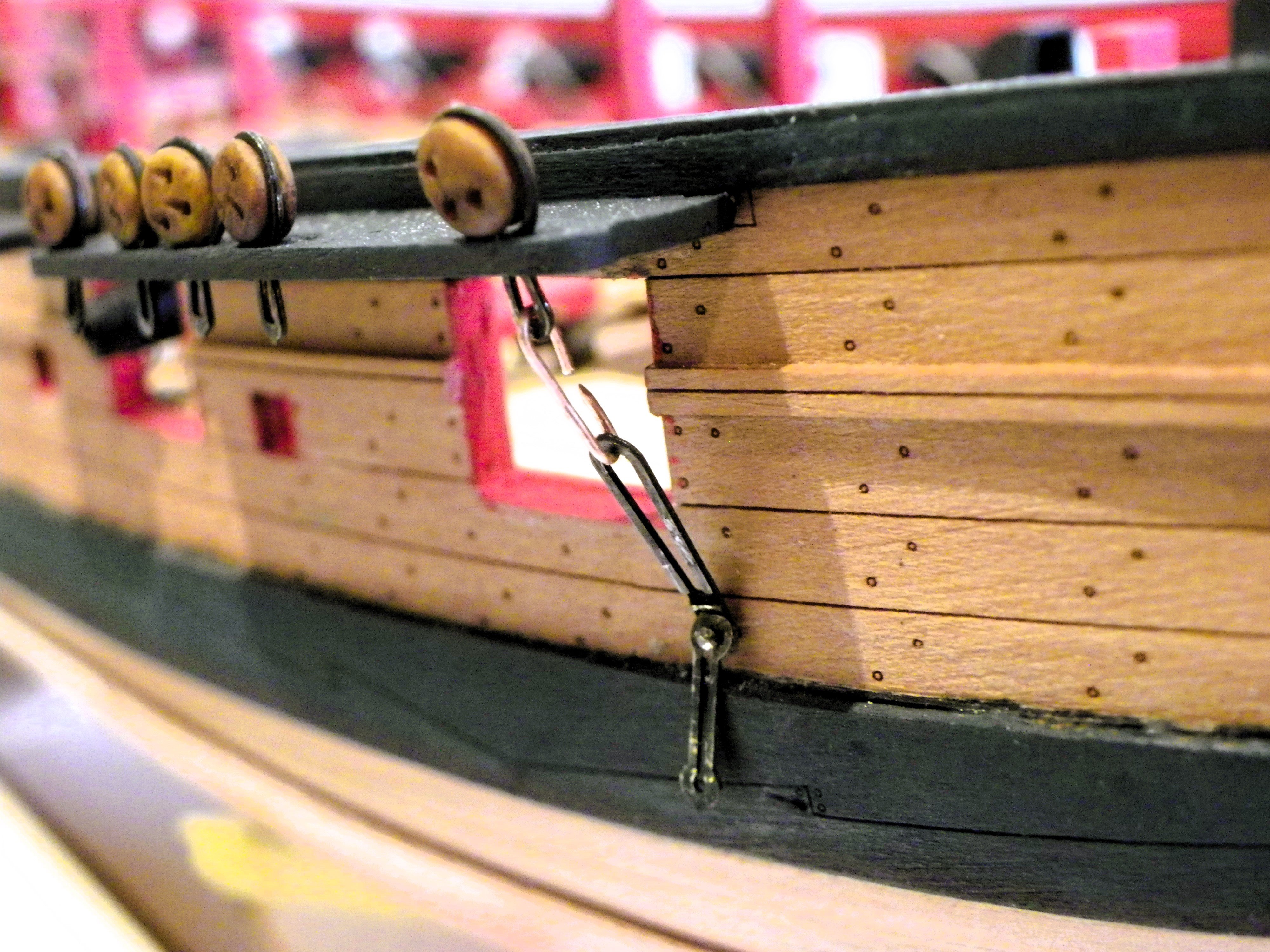

Strops, chains, and plates. – Part two
004
As I noted in Post 73, if I use the deadeye sets as issued the Preventer plates are thrown too far down on the Wale. They should be as per the plan as above.
4226a
I have completed the lower mast Deadeye strop fixing using the replacement Resin Deadeyes.
Stropping the Deadeyes does inevitably mar the blackening of the strops, but a test of the resin deadeye in the blackening fluid has no adverse effect. Once fitted the combination is re- dipped in the blackening.
The usual approach would be to make up the sets on the model, Upper link attached to the Deadeye strop, followed by the Lower link, thro’ which the Preventer plate would be pinned.
The lower fixing of the Preventer plate should sit around half way down the wale, with the lower chain link sitting just above the wale top.
I found this is not the case, so a tricky job ensues, one that I don’t particularly relish.

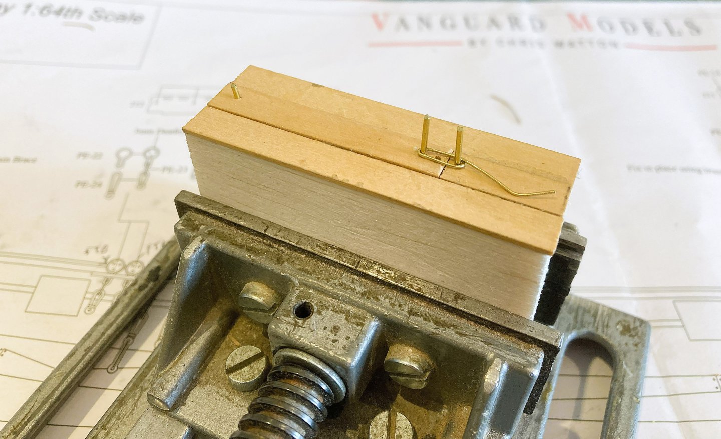

My approach will be to use Brass wire (0.5mm ø) to represent the upper chain link. It would prove difficult to modify the kit link because of thicker sections at the top and bottom.
4237a
I first need to make a jig to form the links. There is an excellent ‘how to’ in Volume 11 of  The ffm BY David Antscherl.
4238a
In reality the lengths of the upper links vary to accommodate the increasing angles of the aftermost shrouds.
The jig allows the  size to be adjusted as required, altho’ on Harpy the effect is minimal.
4242a
Strictly speaking the links should be closed but without open slots along the Channel fronts to insert completed strop and chain units, it becomes tricky.
0017
This test  link shows the correct position of the Preventer Plate.
4253a
The link at 8mm in length is 3mm less than the provided kit link.
With the masts in place I firstly need to mark the line of the shrouds. The kit shrouds are of 1mm ø black line, but I will be using 0.88mm ø Syren rigging line, which is spot on for scale for the lower shrouds.
I find provided black kit line too stark for my taste and my approach is to use natural line dyed with Dark Jacobean oak wood stain to represent the standing rigging.
4249a
Kit line used to mark the positions of the lower Preventer Plate bolt.
I think I can now proceed.
B.E.

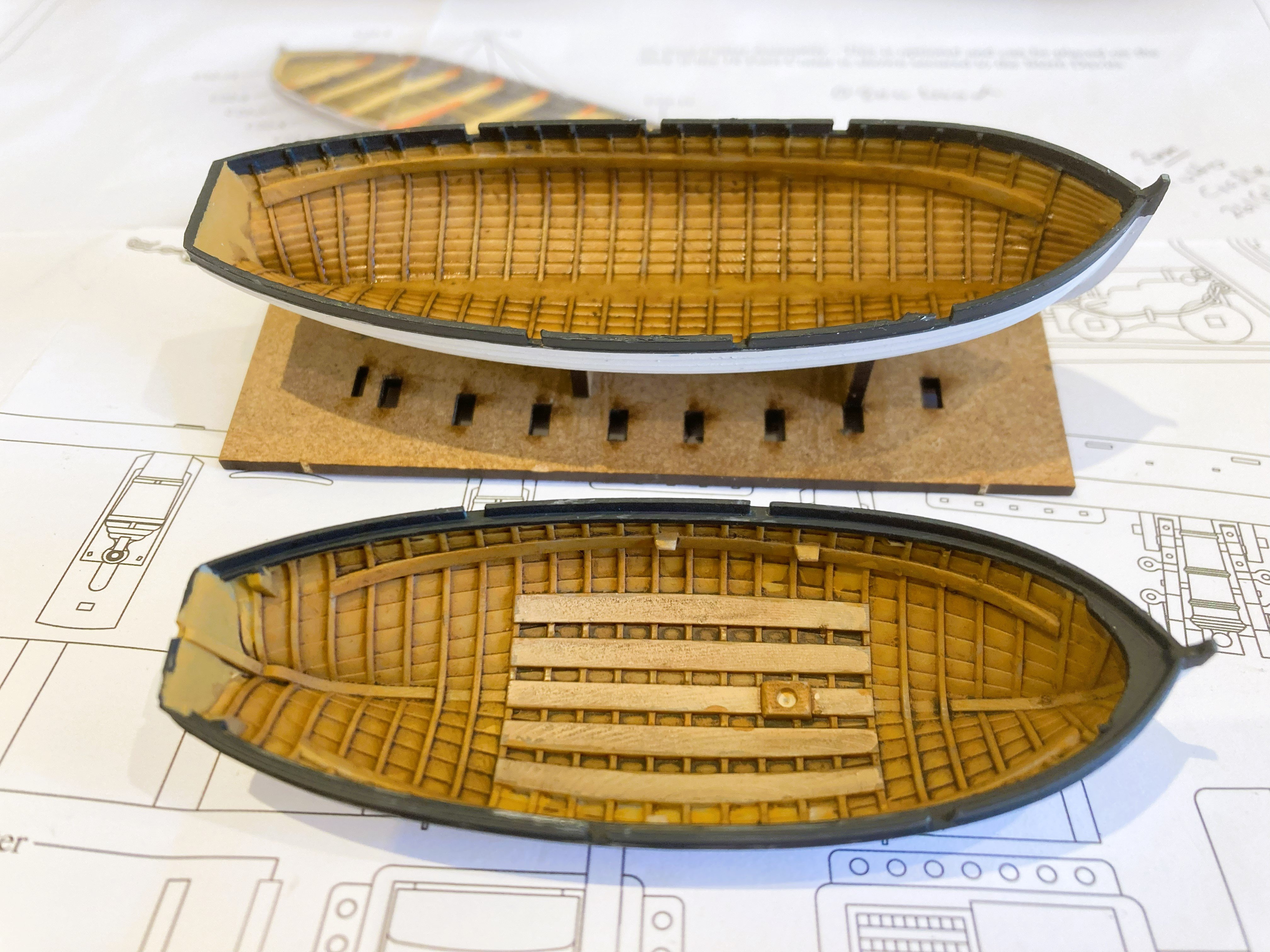

Cutters 18’ and 22’

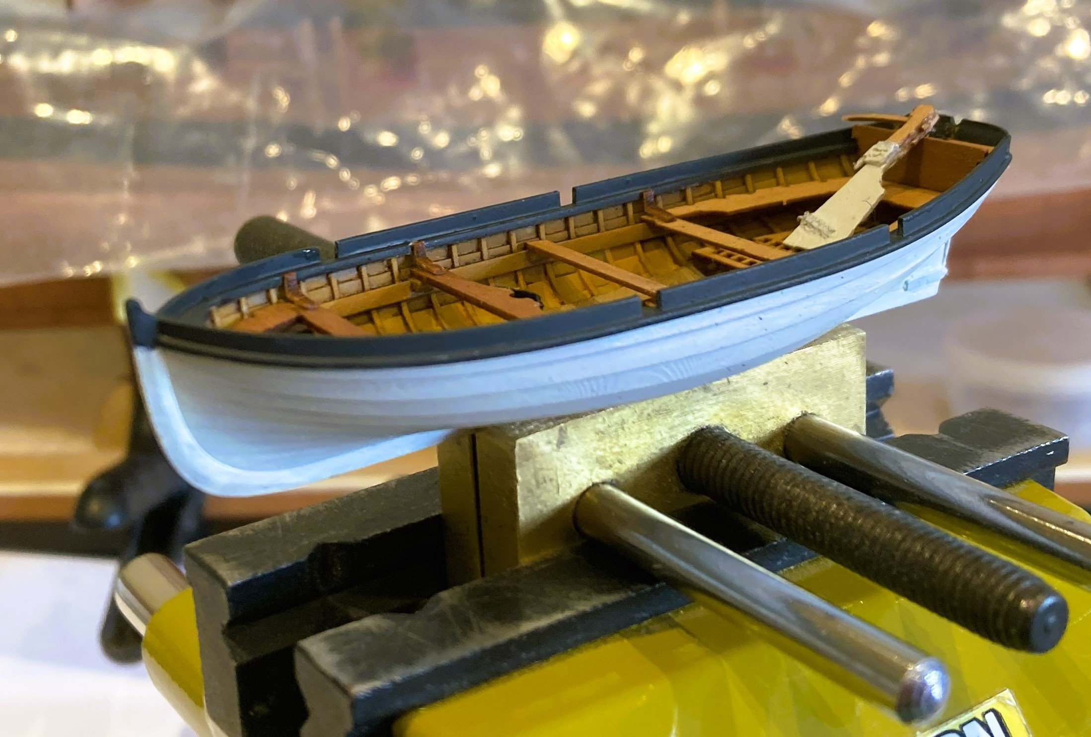

These are the new resin hulled version with Pearwood fittings.
Nicely formed with Lapstrake planking, detailed framing, mast steps, and rowlocks set-up for single banked rowing.
The colour scheme needs to be decided first, something that  co-ordinates with the main ship scheme.
For the outer hull colour I used Vallejo White/grey, and for the Gunwales Black/grey. I think this gives a more scale effect.
For the inner hull I used a combination of oche brown shade mixtures until I got a look I liked. I then applied a wash of Dark Brown.
4297a
This picked up the inner Lapstrake planking.
I applied the same scheme to both cutters.
The Pearwood fittings I left bright just treated with w-o-p.

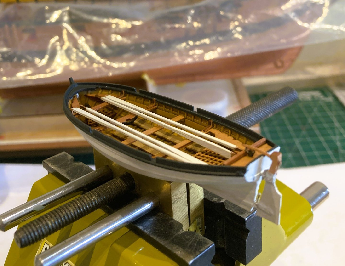

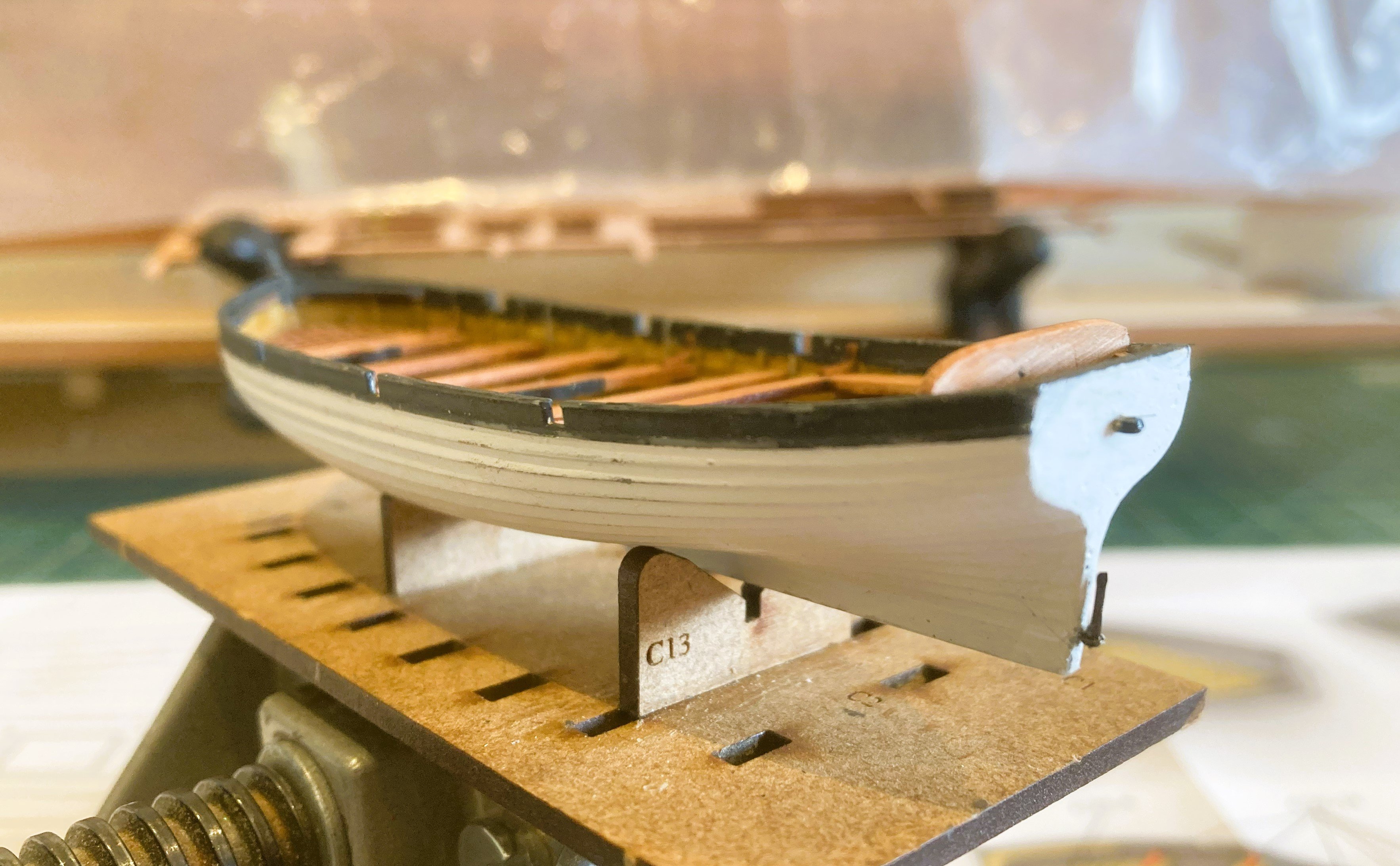

22’ Cutter

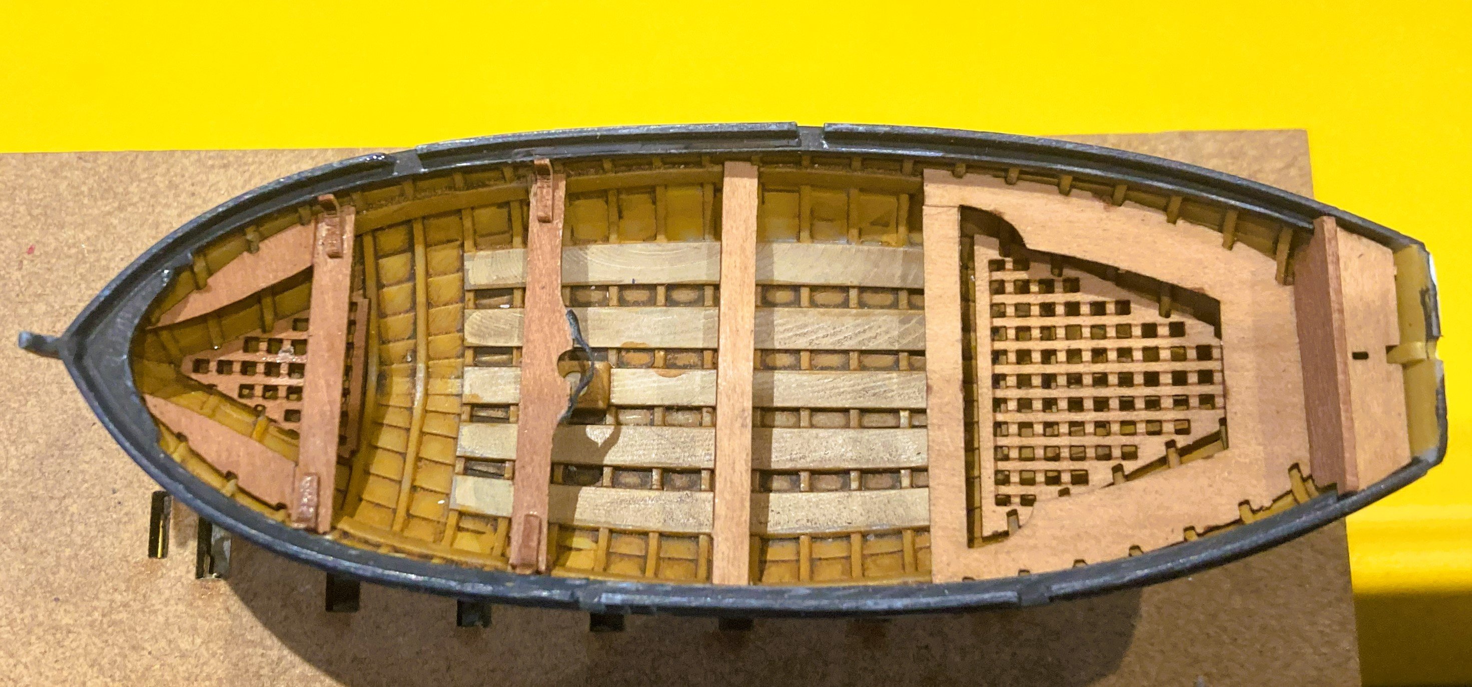

Inserting the Pearwood fittings, takes a little care, they are quite delicate, particularly the stern sheets.
They are accurately cut  to fit around the  hull ribs  but light pressure only should be used to fit into place.
 I used spots of cyano.
4308a
One thing I did note ; there does not seem to be a laser cut thwart for the aftermost position. A minor issue as one is easily cut from the laser fret.
Adding detail
Adding the mast clamps to the thwarts is a small improvement, easily done using black card.
4301a
Using a  stick helps align the  thwart with the mast step.
4309a
I also like to add lifting rings to the keelson.
4317a
At this scale it is feasible to add the rudder hanging ironware to the Cutter stern. This comprises a long  pintle, and  Gudgeon ring. Fiddly, but it’s stuff I like to do.
4316a
This particular arrangement is designed for quick attachment/ removal of the rudder.

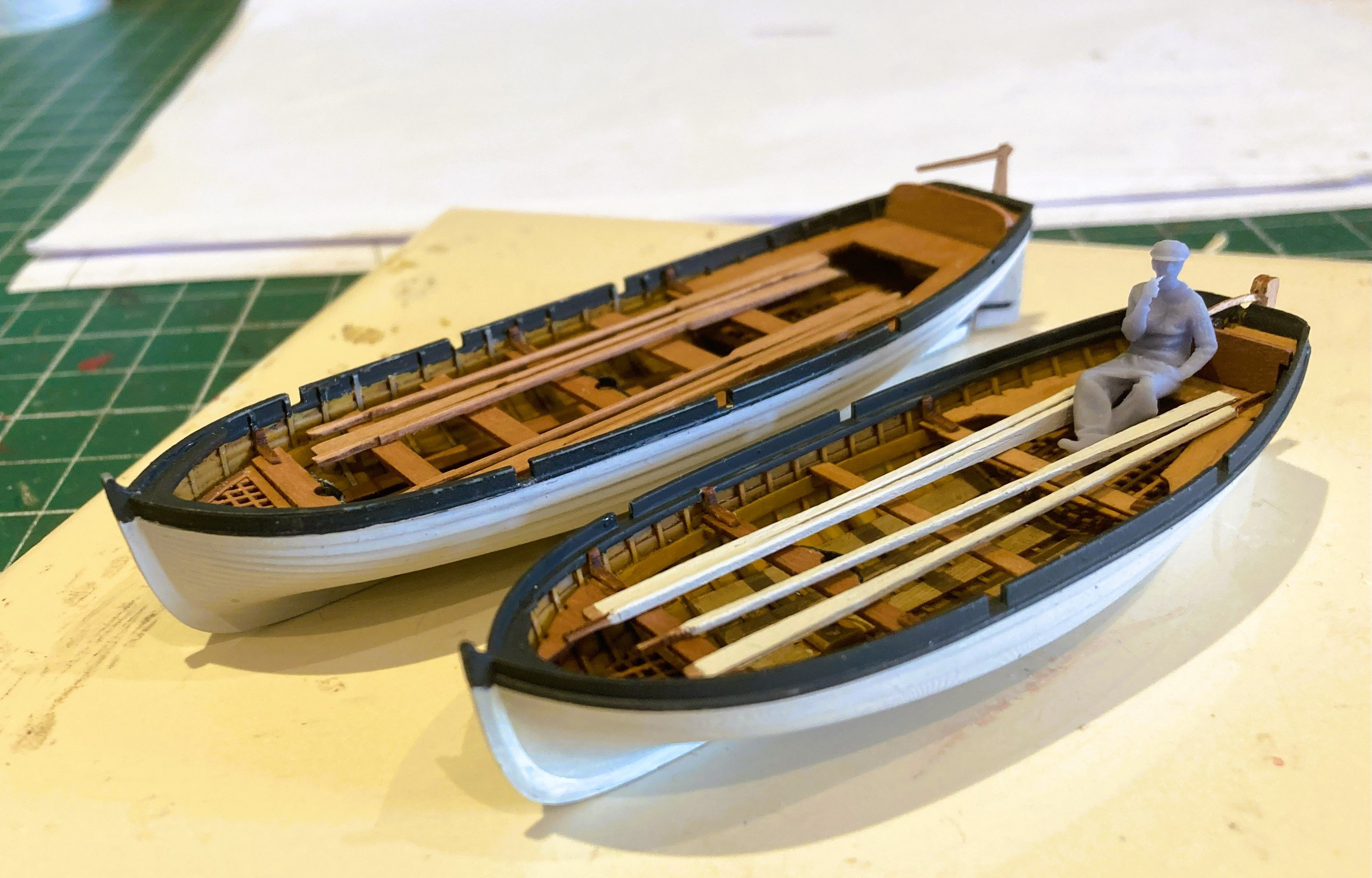

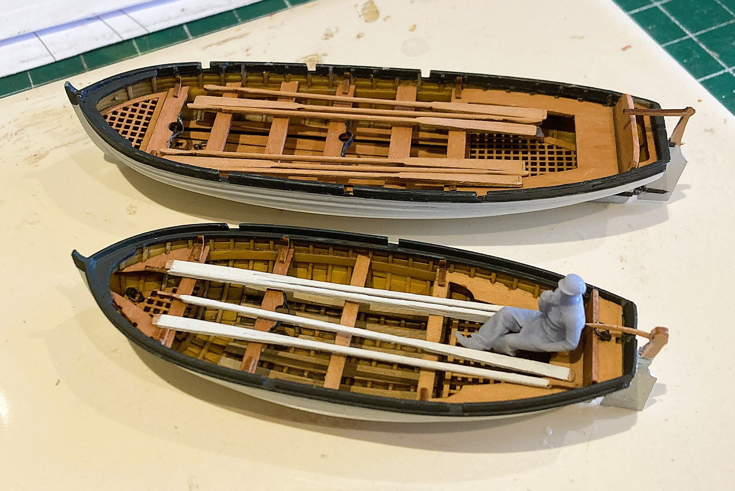

The set-up for rowing is three pairs of offset rowlocks which would suggest single banked rowing positions. The oar lengths would suggest  double banked rowing, so with this arrangement there would presumably be one rower per thwart, alternating port and starboard.

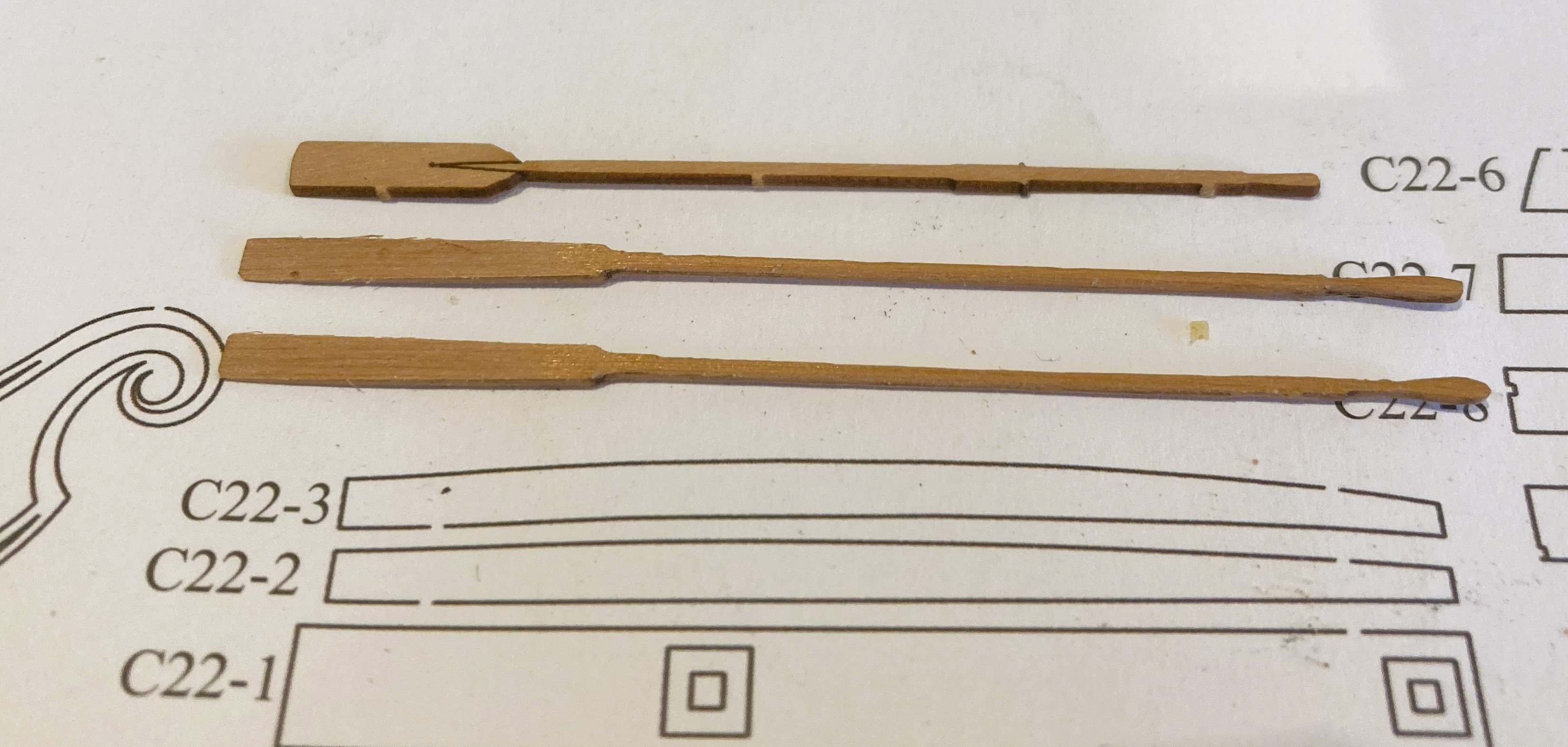

I’m not too keen on the provided oars for the 22’ cutter, the blade looks too short and paddle like for my taste.
4305a
The oar style supplied with Indy looks more the shape to my eye and fortunately I had some spares I could utilise.

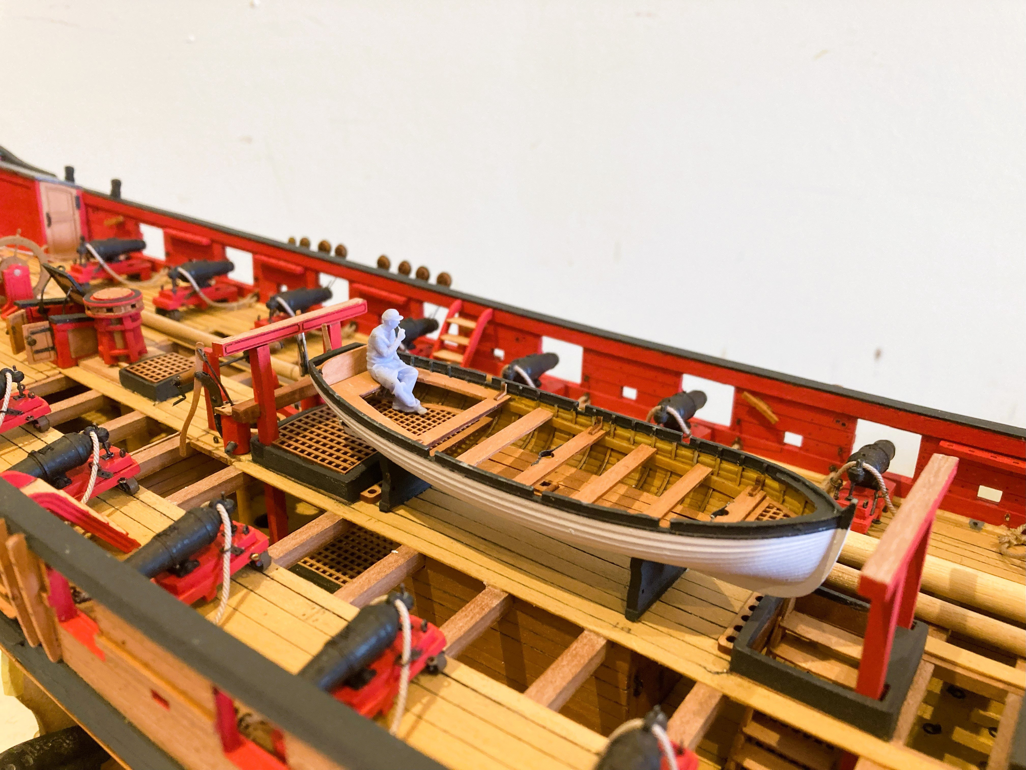

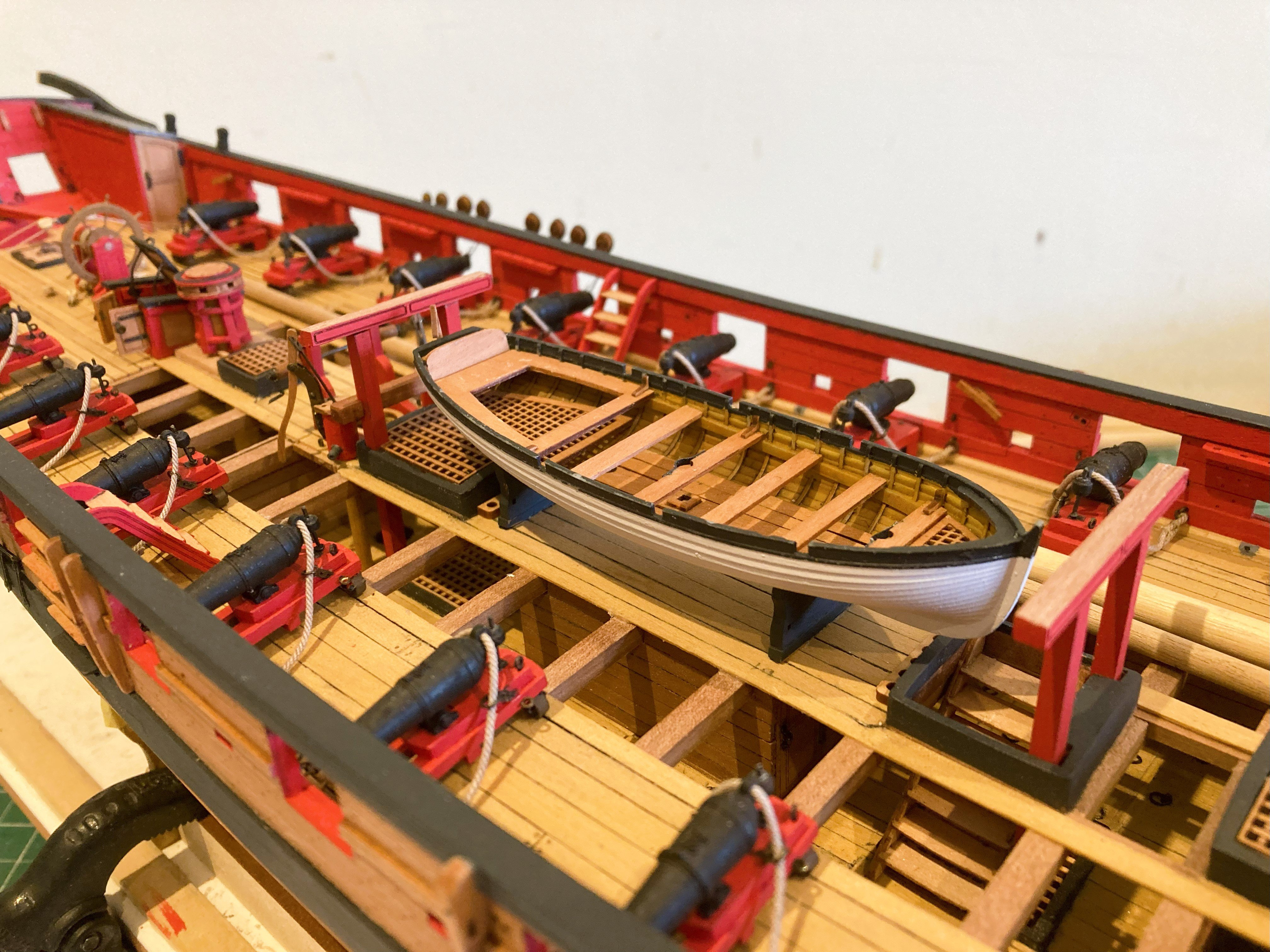

Boat cradles are supplied (for the 18’ cutter) but will fit the 22’ cutter. If the larger cutter is to be stored on deck, the cradles need raising a little to allow the boat keel to clear the coamings. I added 2x2mm Pearwood strip to the bottom of the cradles.
4324a
I always find fitting cradles a tricky exercise, getting them central to the deck, square, and  correctly spaced to fit the hull. It would be easier to glue the hull to the cradles before fitting, but I prefer not to do that.
4325a
4327a
4328a
Nice to see that my scale figure sits perfectly in the sternsheets.
4331a
4332a
Some paintwork tidying is still required, but I’ll attend to that in conjunction with the 18’ Cutter
B.E.

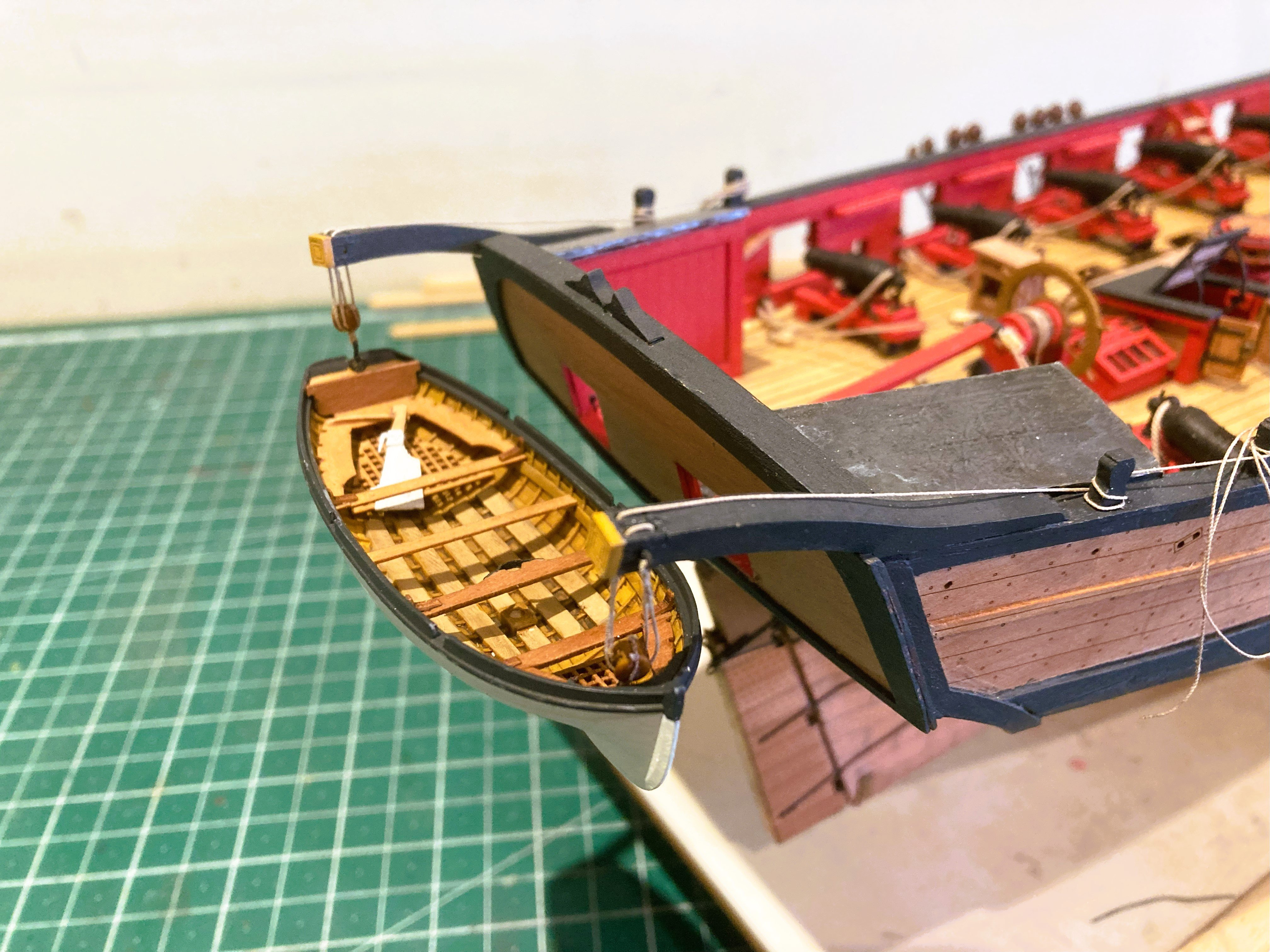

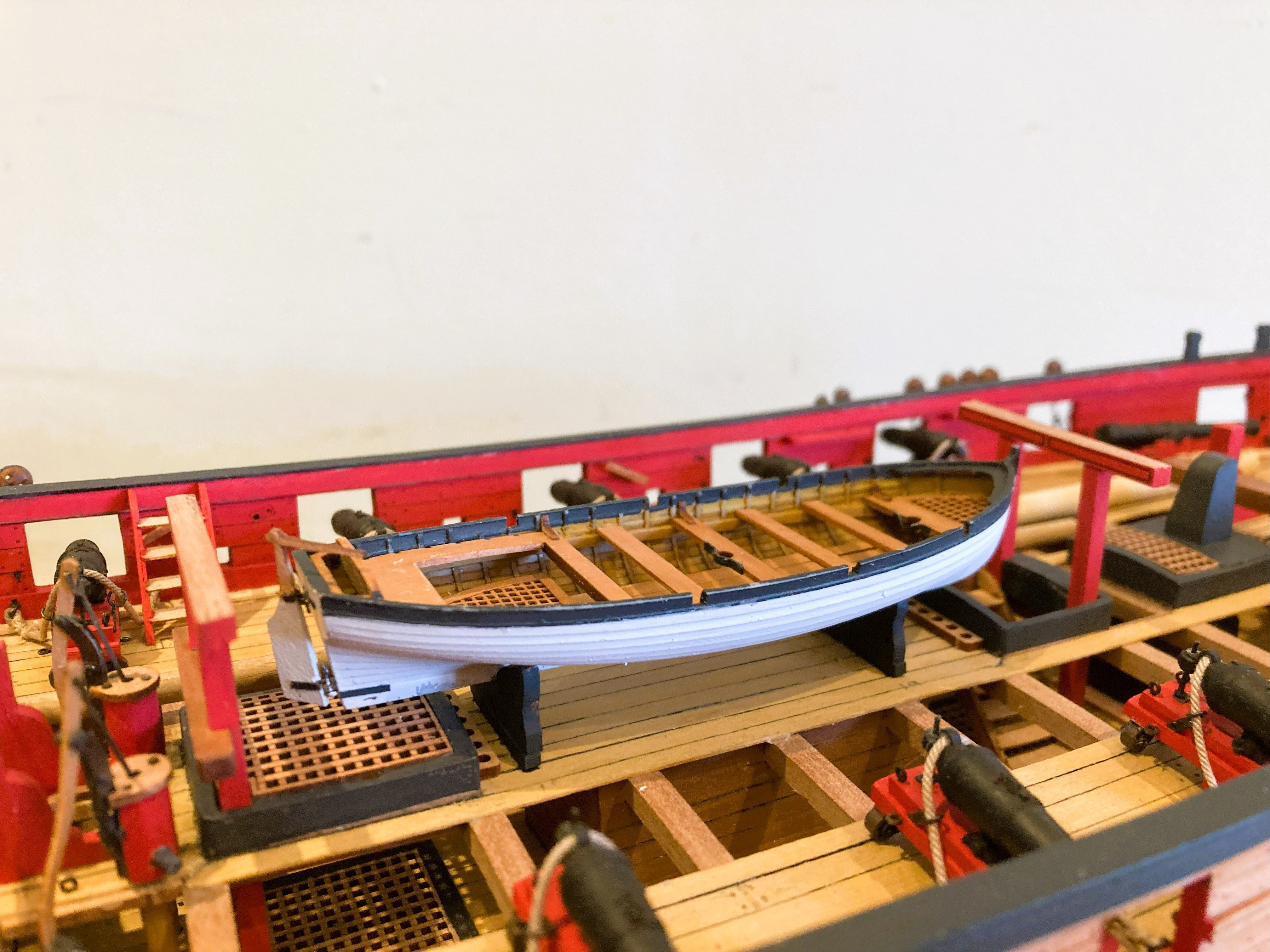

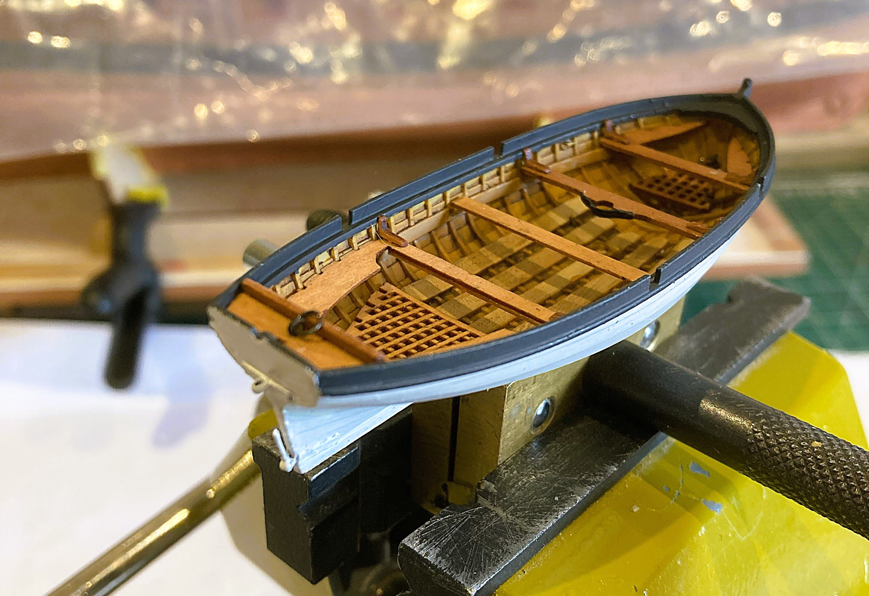

Post 79

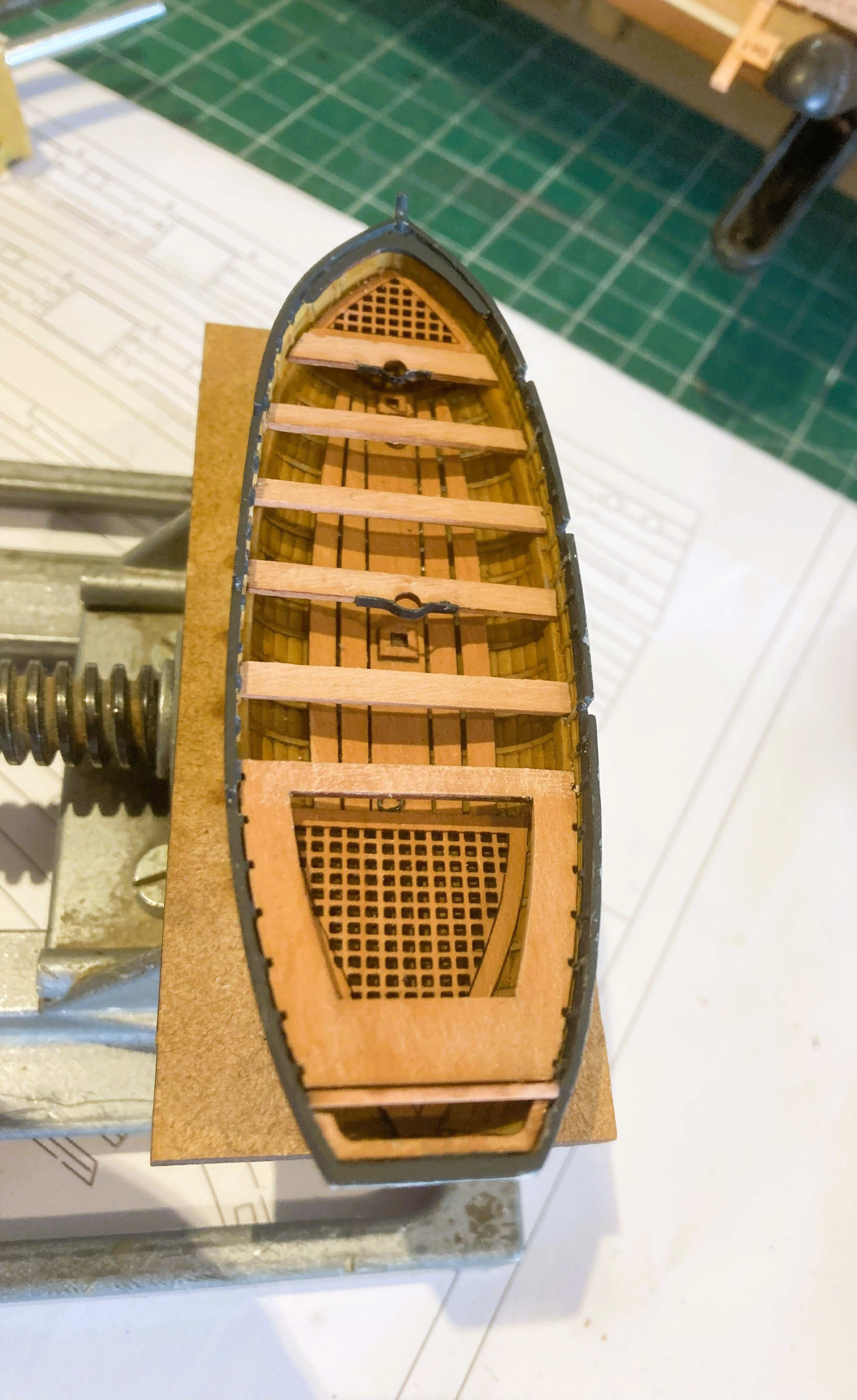

18’ Cutter

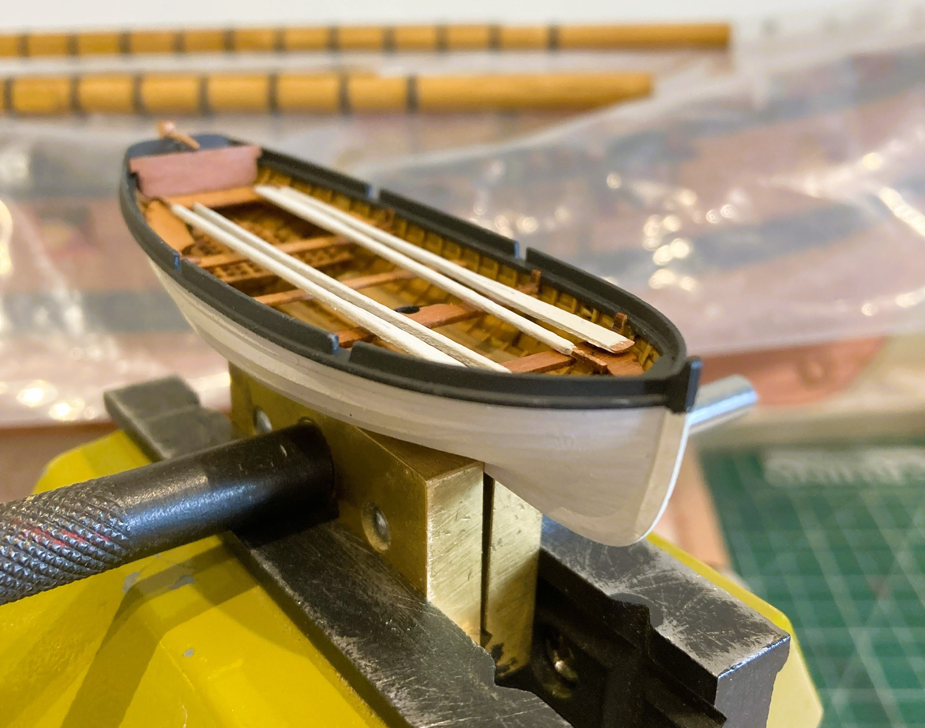

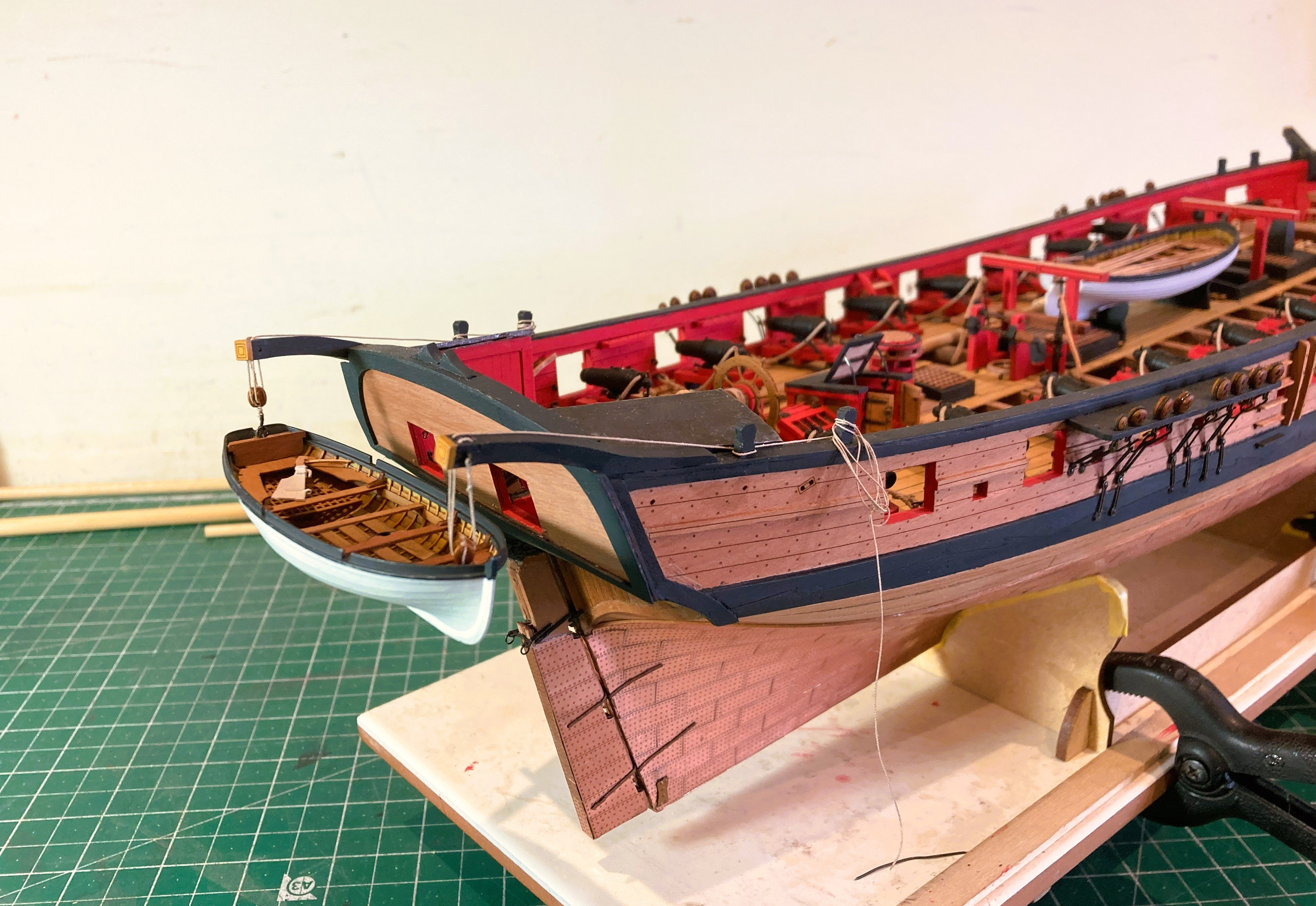

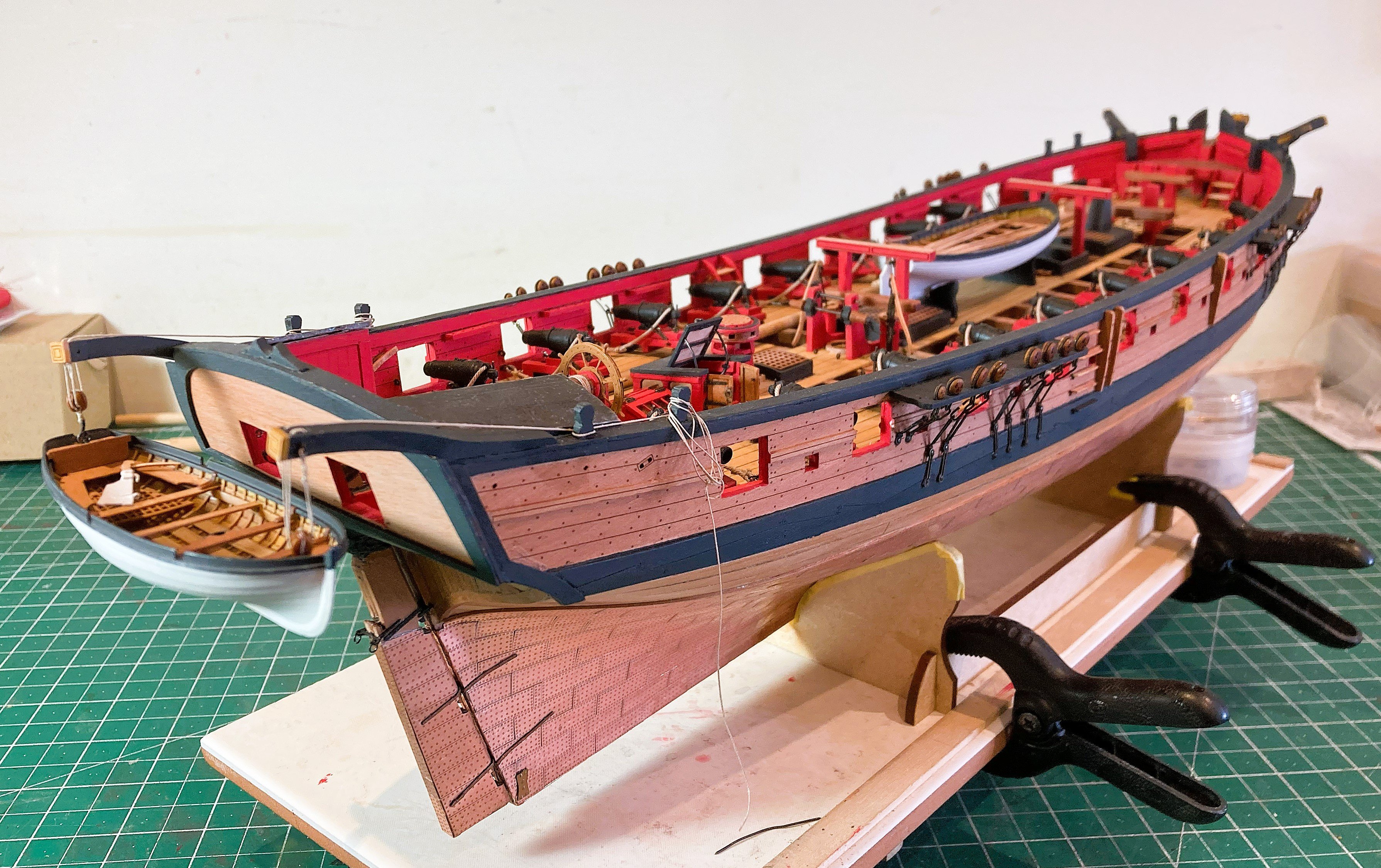

I had already painted the interior hull and applied a coat of Vallejo Black/Grey to the outer hull.
This small cutter will be suspended from the stern davits, which will provide interest and add the opportunity to add tackles to the davits.
Unlike the 22’ cutter the  footwaling is incorporated in the resin moulding.
4297sc
Works very well at this scale.

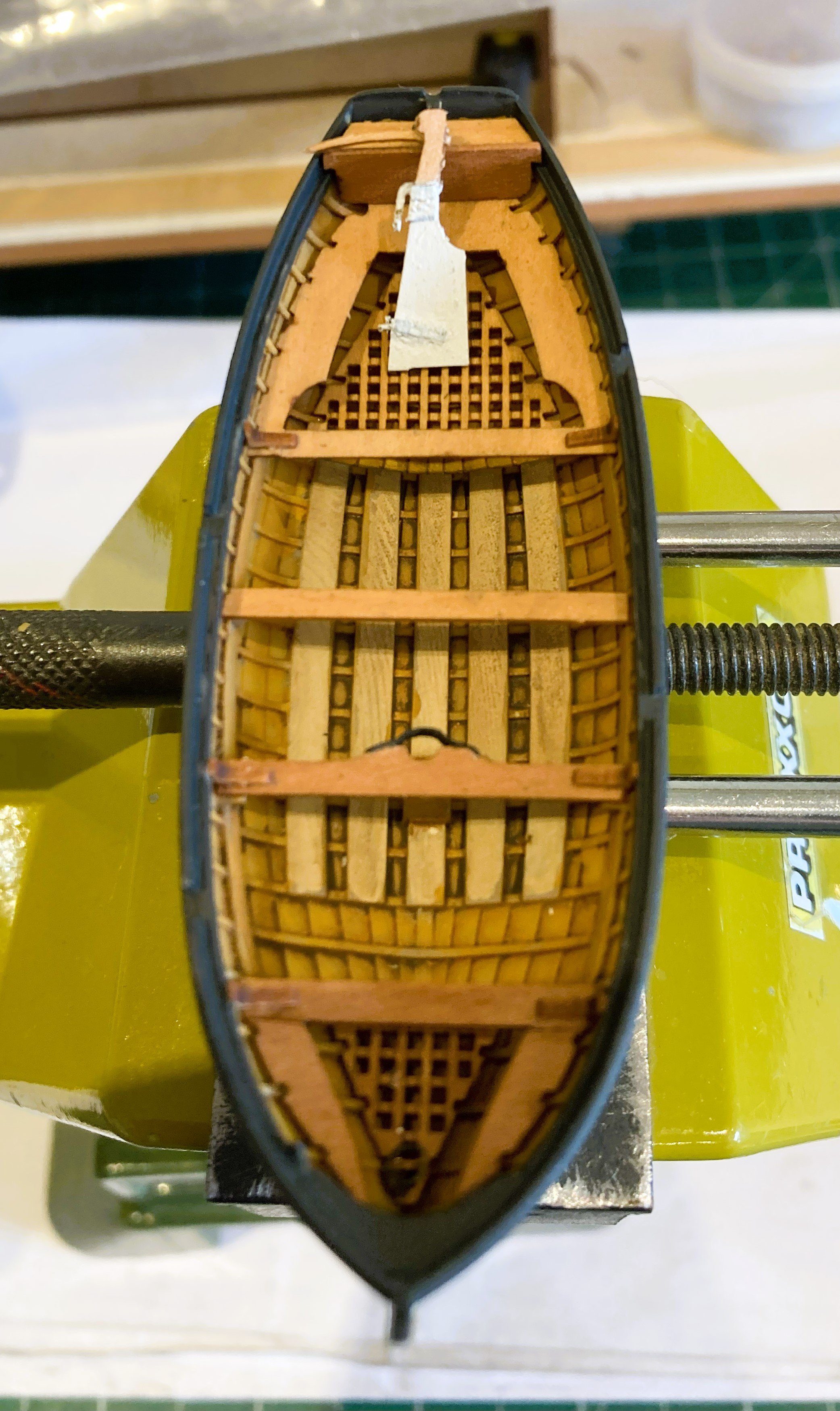

The inboard fittings are cut from 0.6mm Pear and are therefore very delicate.
4408a
The gratings are beautifully cut but won’t stand even the lightest pressure without risk of breakage. I did find it necessary to add a strip beneath the fore grating which was showing signs of splitting as I teased it into position. I also added a lateral support beneath the sternsheet thwart.
Even so, these fittings are streets ahead of the previous versions in brass etch.

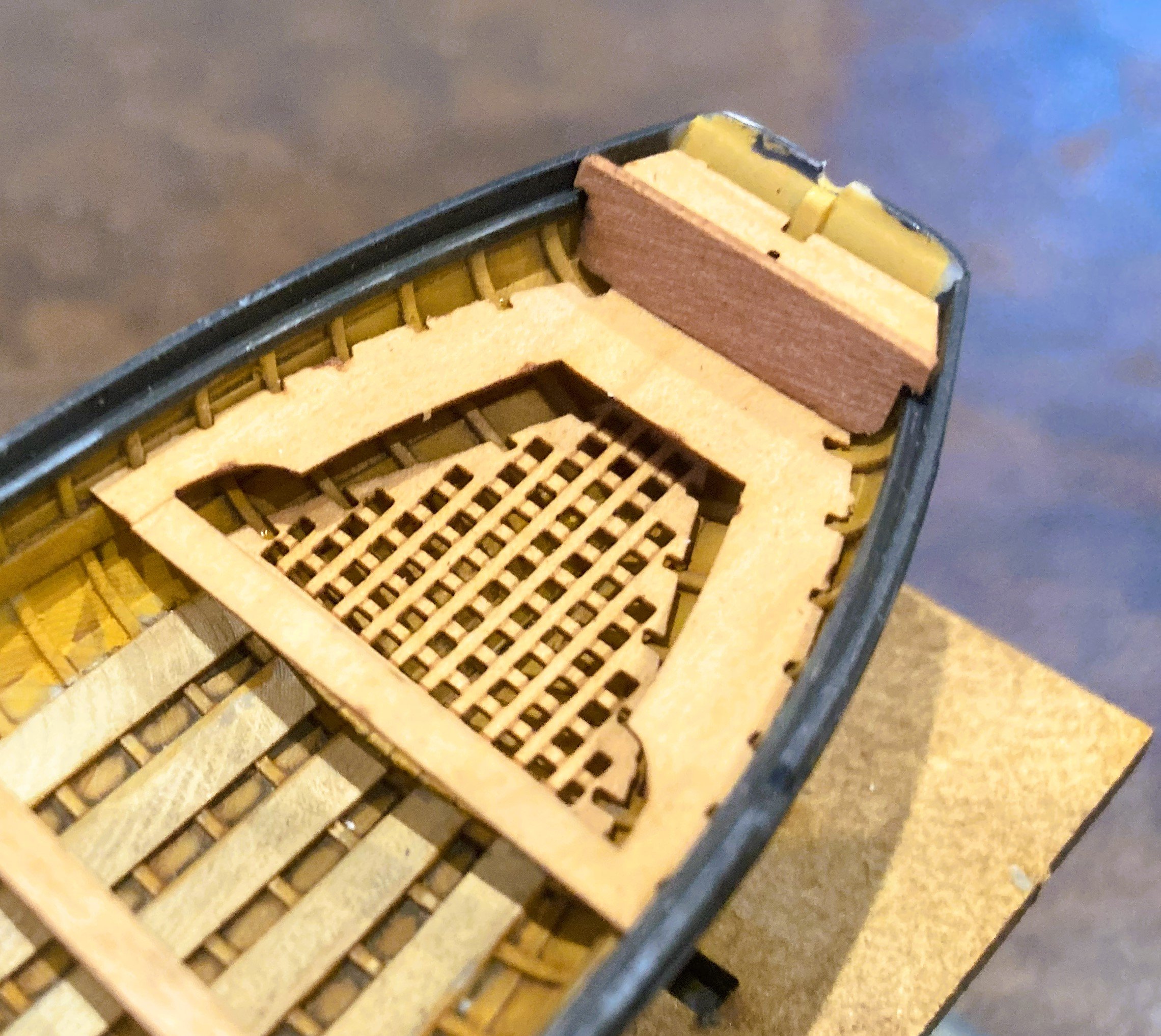

4409a
The sternsheets are another snap risk area.
To fit these I found it helped to slightly flex the hull outwards whilst  softly easing the sheets into place, so the notches aligned with the frames.

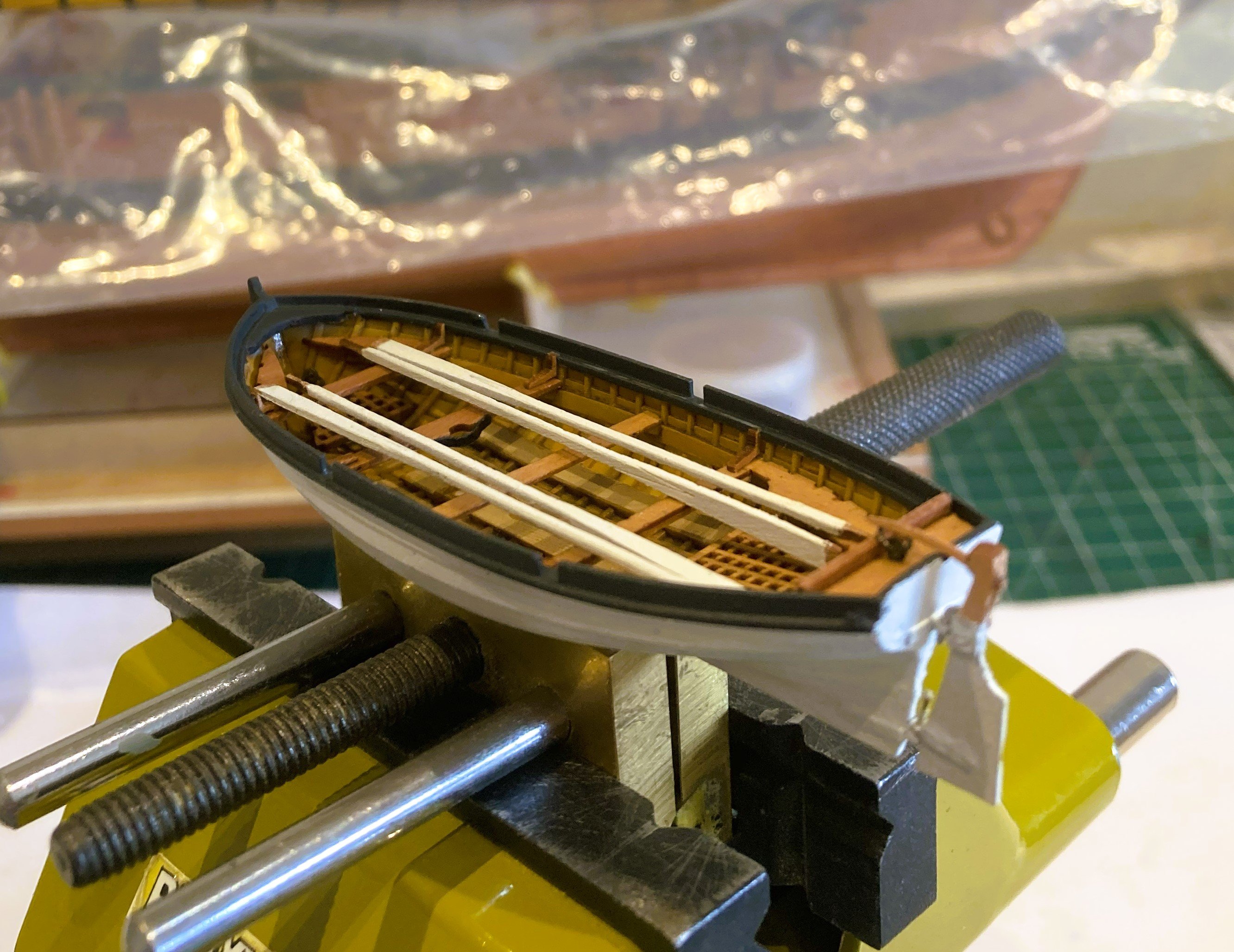

4420b
The Bow thwarts present another issue of getting a close formation to the round of the hull. I found it easier to remove the fore side pieces and fit the thwart first.
As with the larger cutter I added the Mast  clamp and rudder hanging details, altho’ the rudder won’t be in place with the boat on the stern davits.
4446
Fitting the pintles and gudgeons was quite tricky as very tiny eyelets and pins are required, the process not helped by fat fingers and dodgy eyes.
The oars for the cutter are of the style I would expect to see, so it is a puzzlement why the oars for the larger cutter, that I replaced, differed in style.
4414a
In a raw state here. A slight round is required on the shafts and the blades require thinning down.
4431a
4436a
4457a
4458a
4460a
4461a
4465a
I very much like these Resin boats, and altho’ we are saved the the effort of planking tiny hulls there is still a lot of work to do to get a good finish.
I think the all-wood versions still have a place for those who like the challenge, and satisfaction is certainly to be had from successfully completing one of these mini projects.
B.E.

Post 80

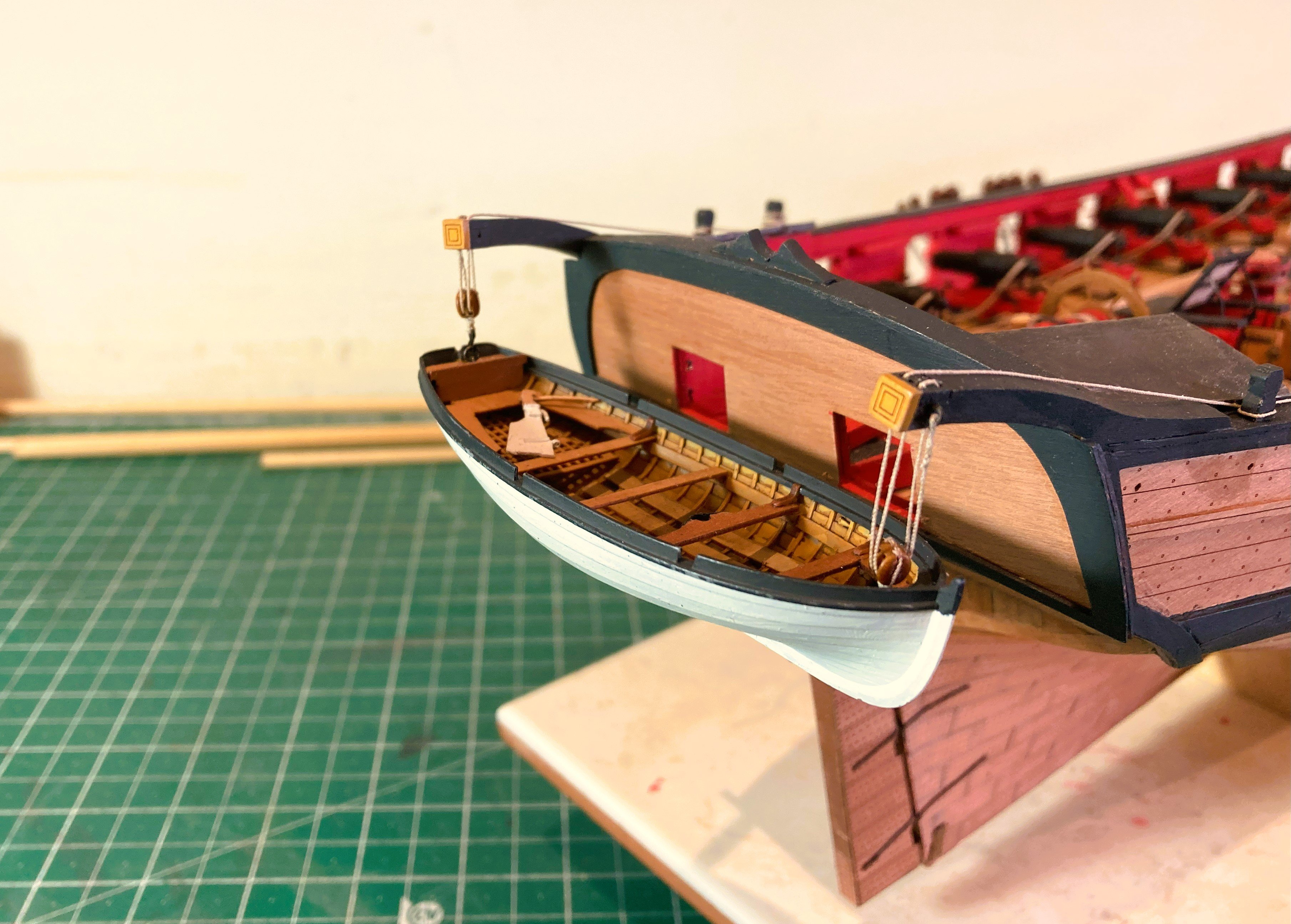

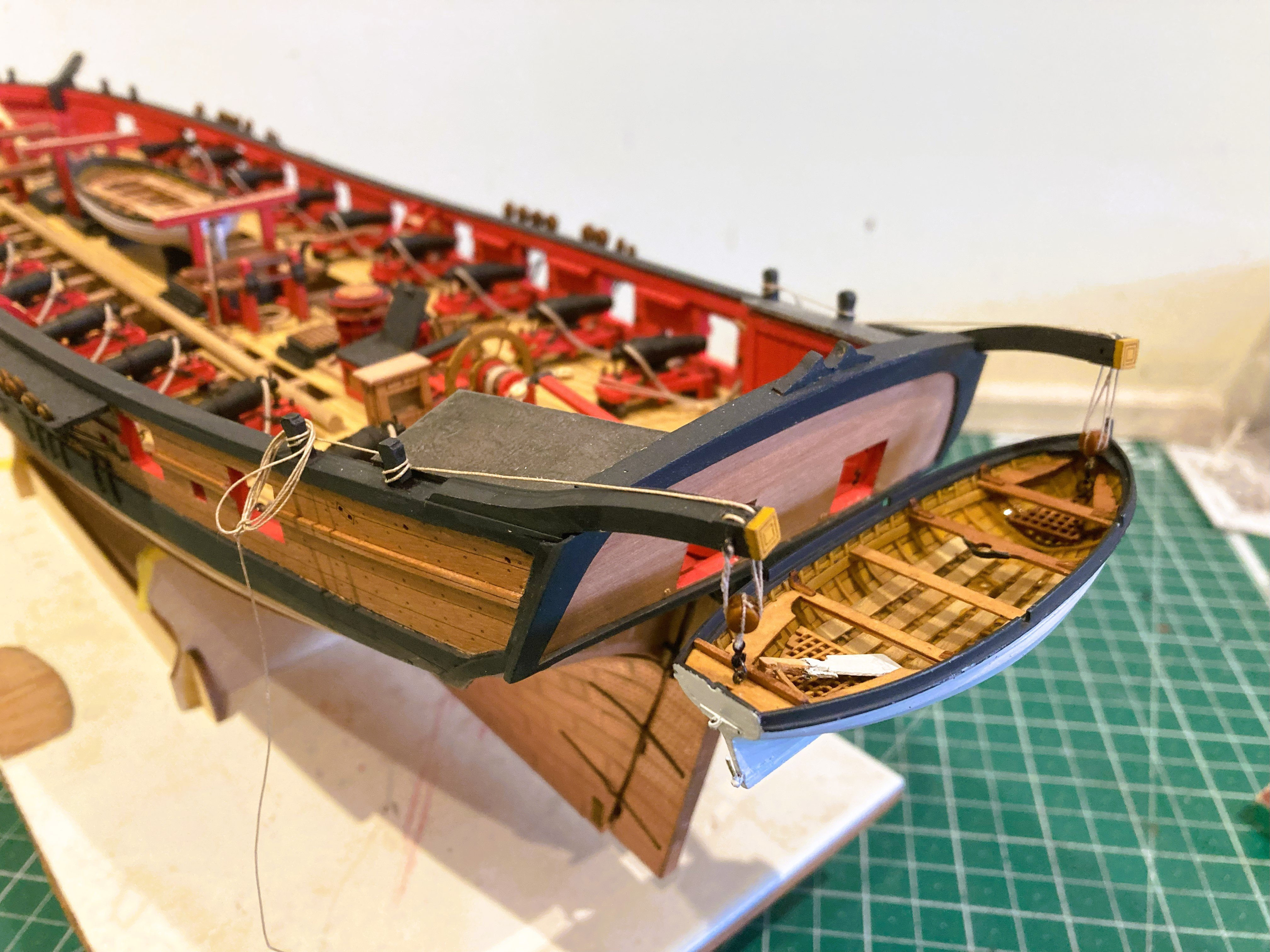

Rigging the stern davits
I used Syren 0.30mm line, 5/32” Double resin blocks, and 3mm  plastic hooks. 0.1mm line is used for seizing.
Chuck has produced an excellent method of block stropping, check out his pdf in the Traders and Dealers section.
Quite a tricky business hanging the boat on the tackle hooks, it helps to apply a spot of glue to the ring to keep it in the vertical position.
4466a
The handling during the attachment has rubbed some of the paint from the gunwales, so the boat will have to be removed at some some point for a touch -in.
4481
4471a
4483a
4472a
4473a
Not quite sure yet how to  belay the tackle falls. The kit plan simply shows them secured around the aftermost timberhead which sits against the cabin roof.

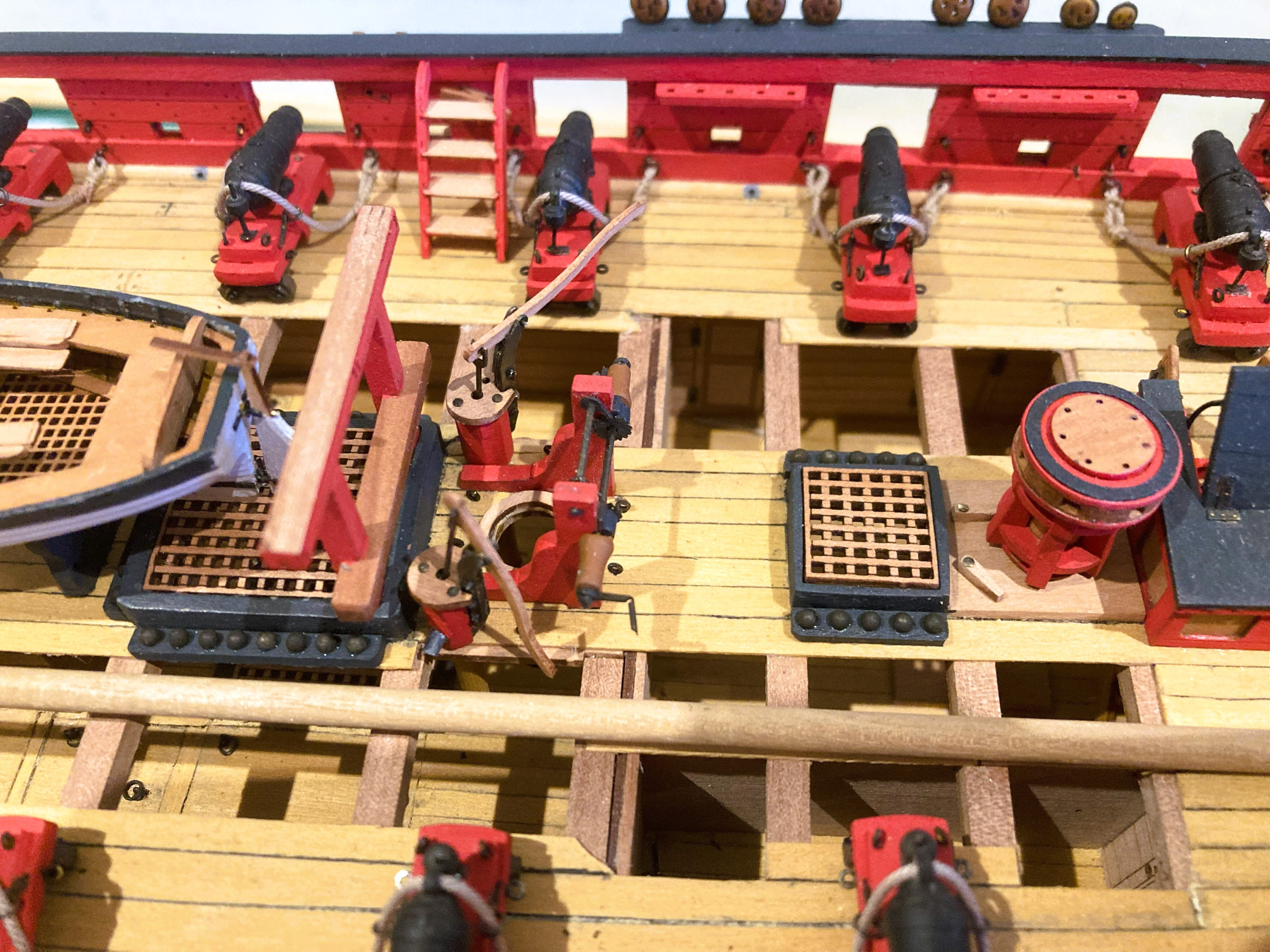

Shot Garlands
4478a
4476a
The shot garlands have been fitted, I used 2mm bearings rather than the kit supplied plastic versions.
Belay pins
Rather than fit the kit supplied brass etch pins I am waiting to see how Chuck's  testing of  1:64 scale pins work out,  I do hope they will be success.
On my Harpy build they won’t  be put under any stress as I’m not fitting the running rigging.
Back to the masts…
B.E.
