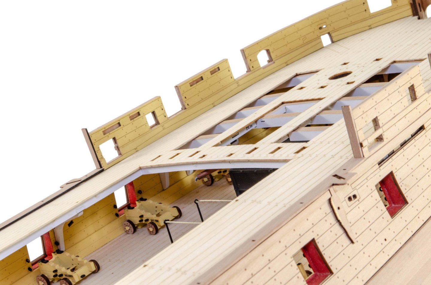

When not in action, would the gun carriages in the captain's cabin be stored facing fore or aft, rather than out to the side?
At the moment, they seem to be blocking access through the cabin doors while Aubrey and Maturin are relaxing with their music.
Prob artistic licence, simply for display convention. A bit like the figures 😆
Ongoing:
When a sea and not in action, all gun ports would be closed, gun quoins would be removed and canon and carriage lashed securely to the bulwark to prevent movement.
Models are nearly always shown with canons run out as this enhances the appearance of the model.

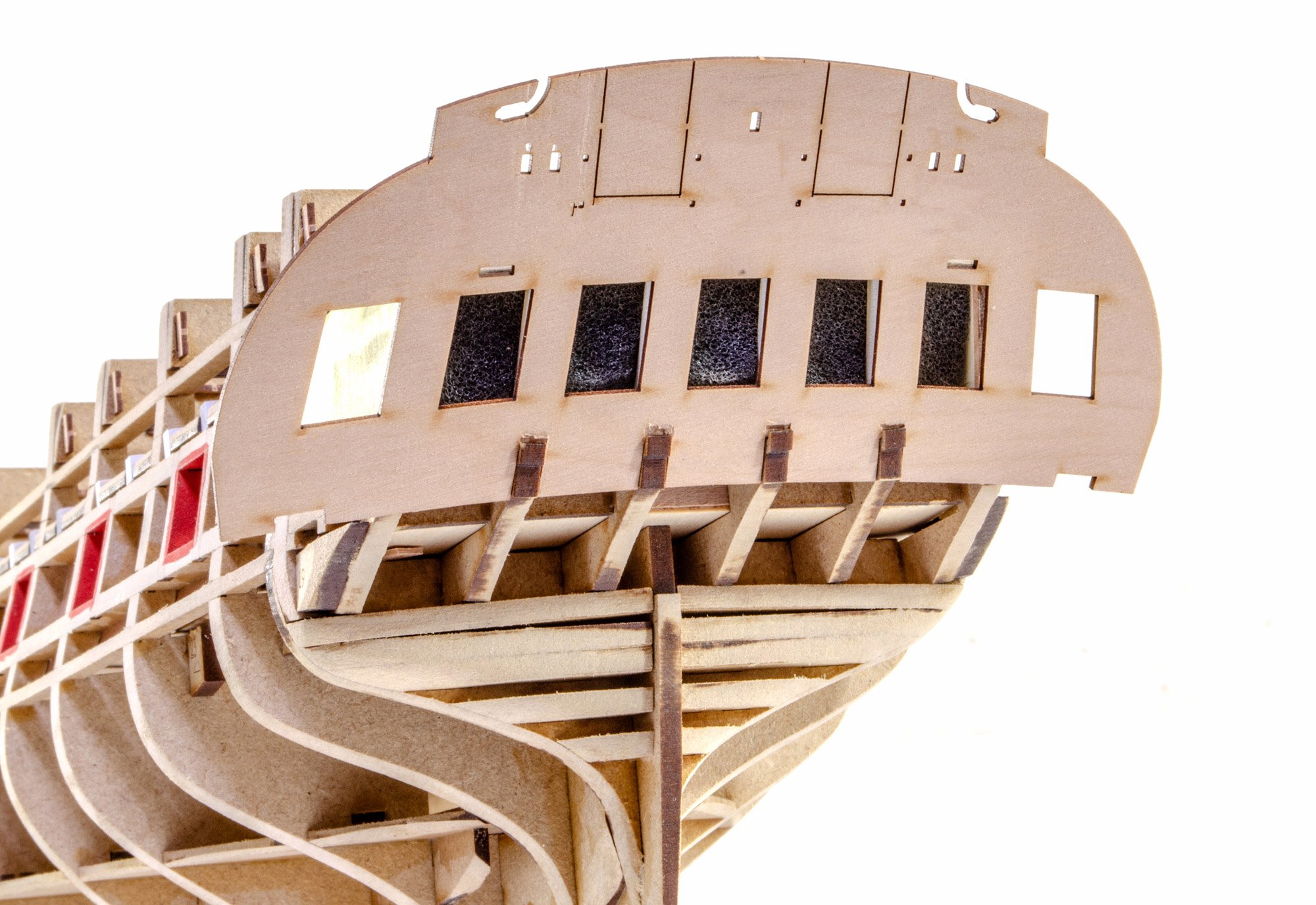

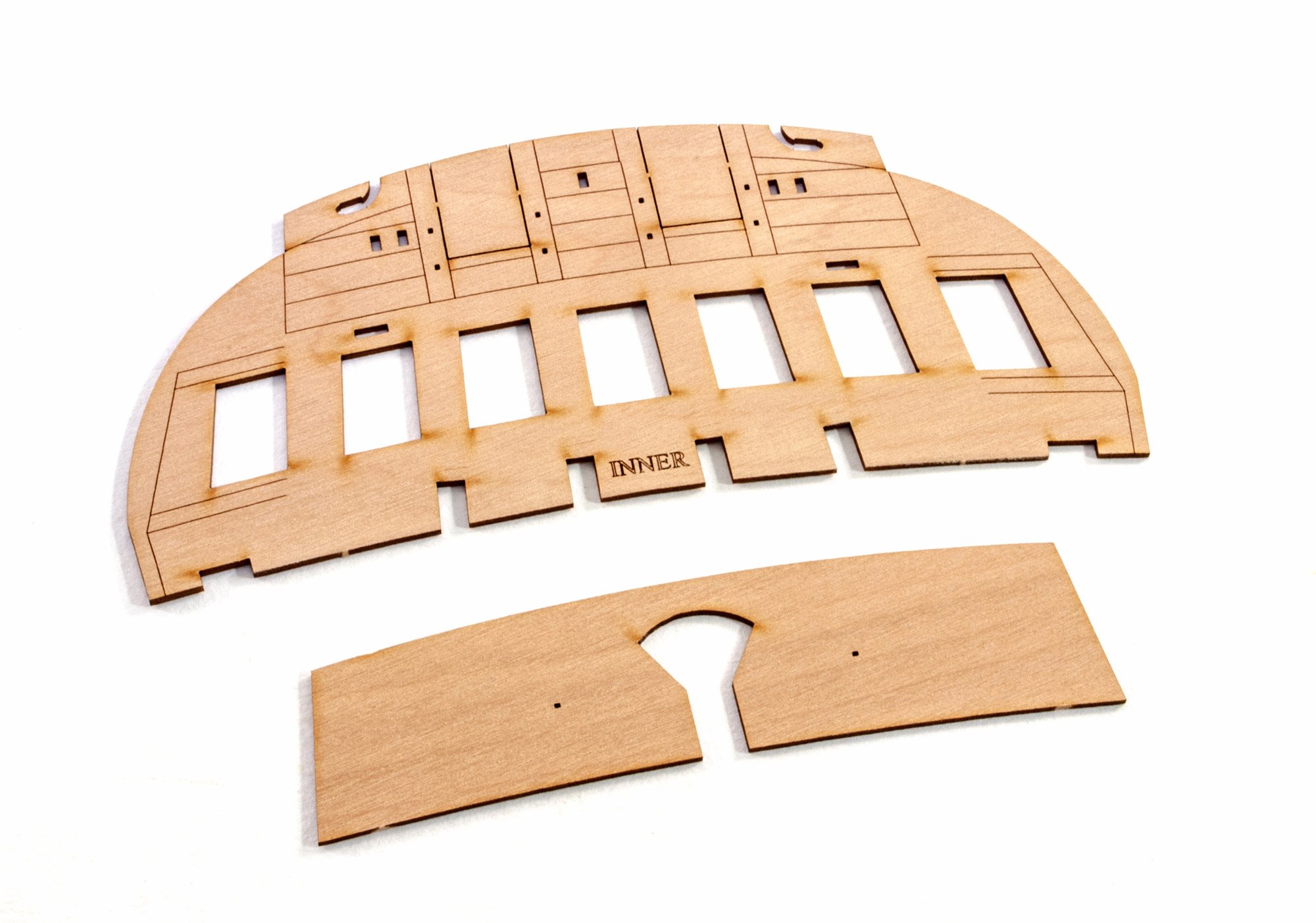

My apologies for being so slack on updates. Surprise is now unrecognisable from my last update, and some of you have already noticed the image change on the homepage of Vanguard Models website. Anyway, here we go...

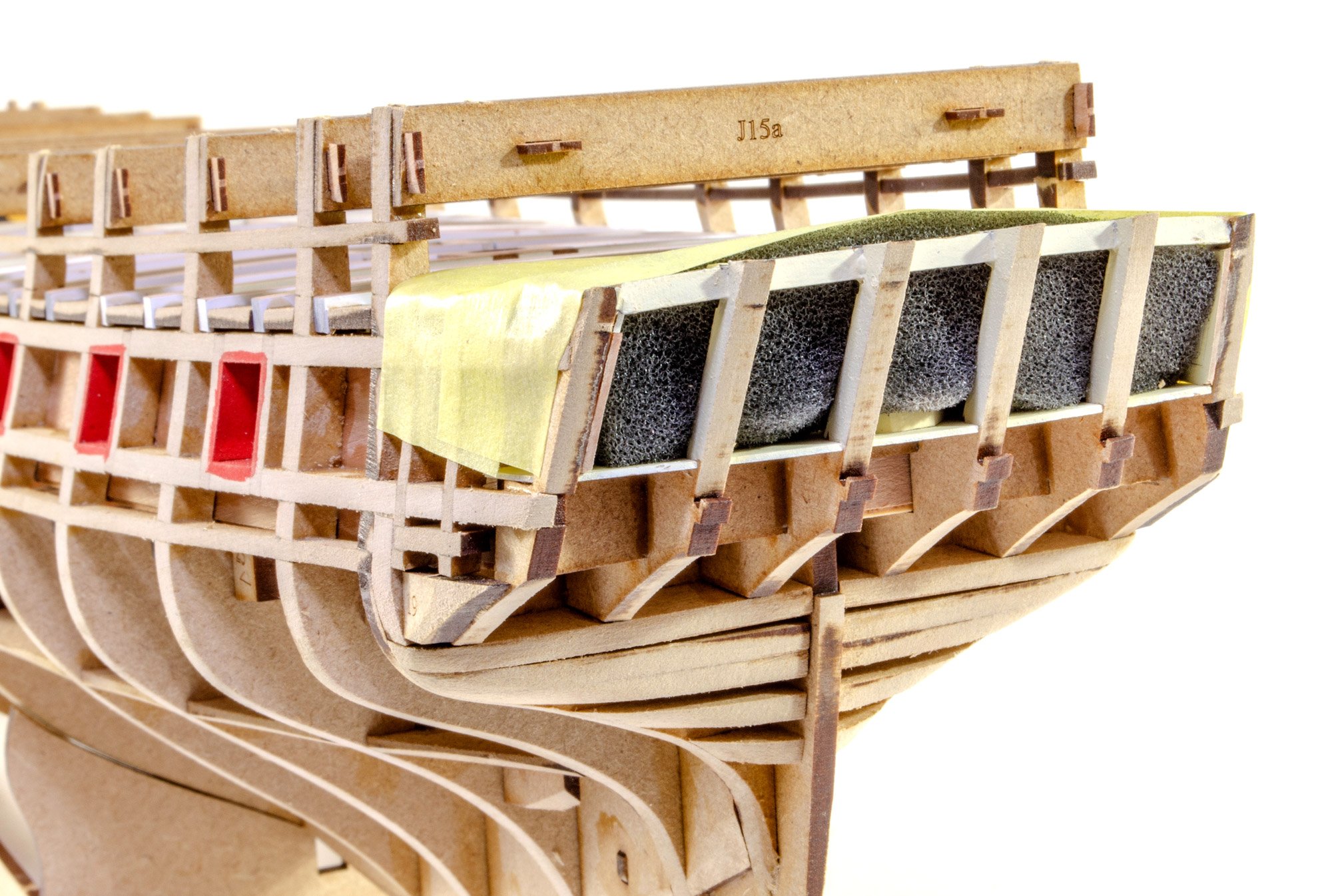

The stern of Surprise has been tackled in a different way that previous releases, removing any modeller error where the stern fascia could possibly be located too low on the hull. This release includes protrusions on the vertical stern timbers. These contain slots into which the stern fascia fits. Once the stern is chamfered to shape, the inner stern fascia is then temporarily slotted into place, and then the lower counter can be properly positioned and glued into place. The inner stern fascia can then be removed while other hull work continues.

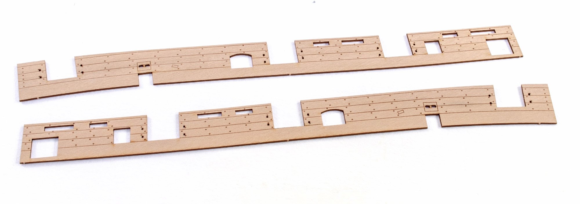

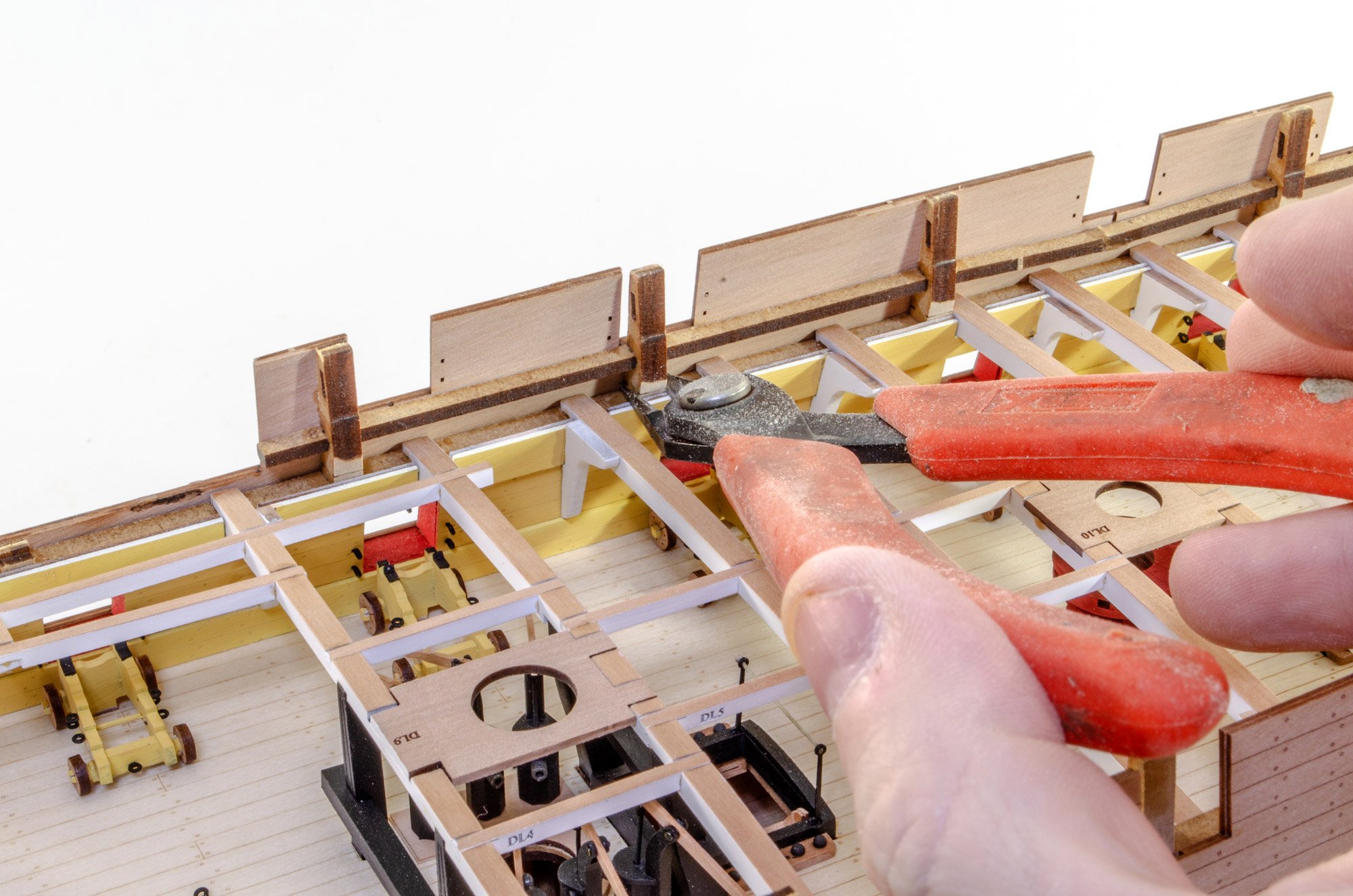

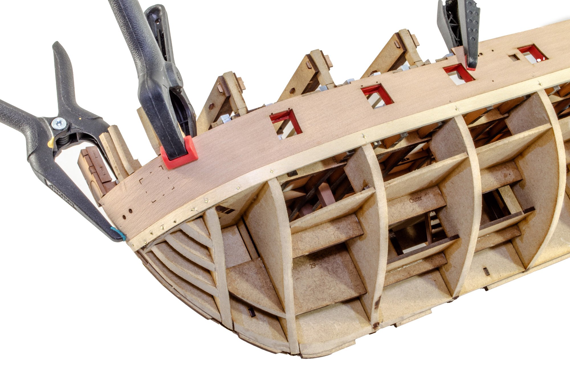

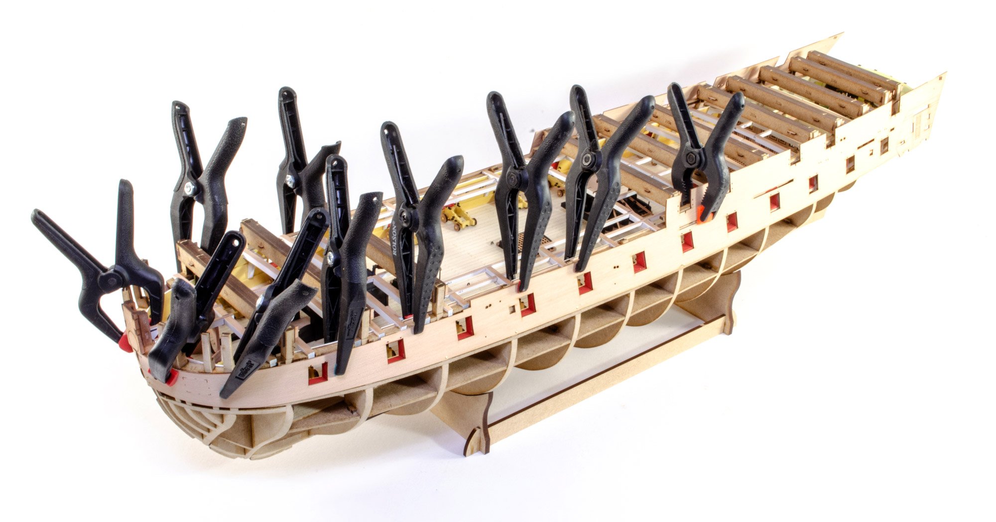

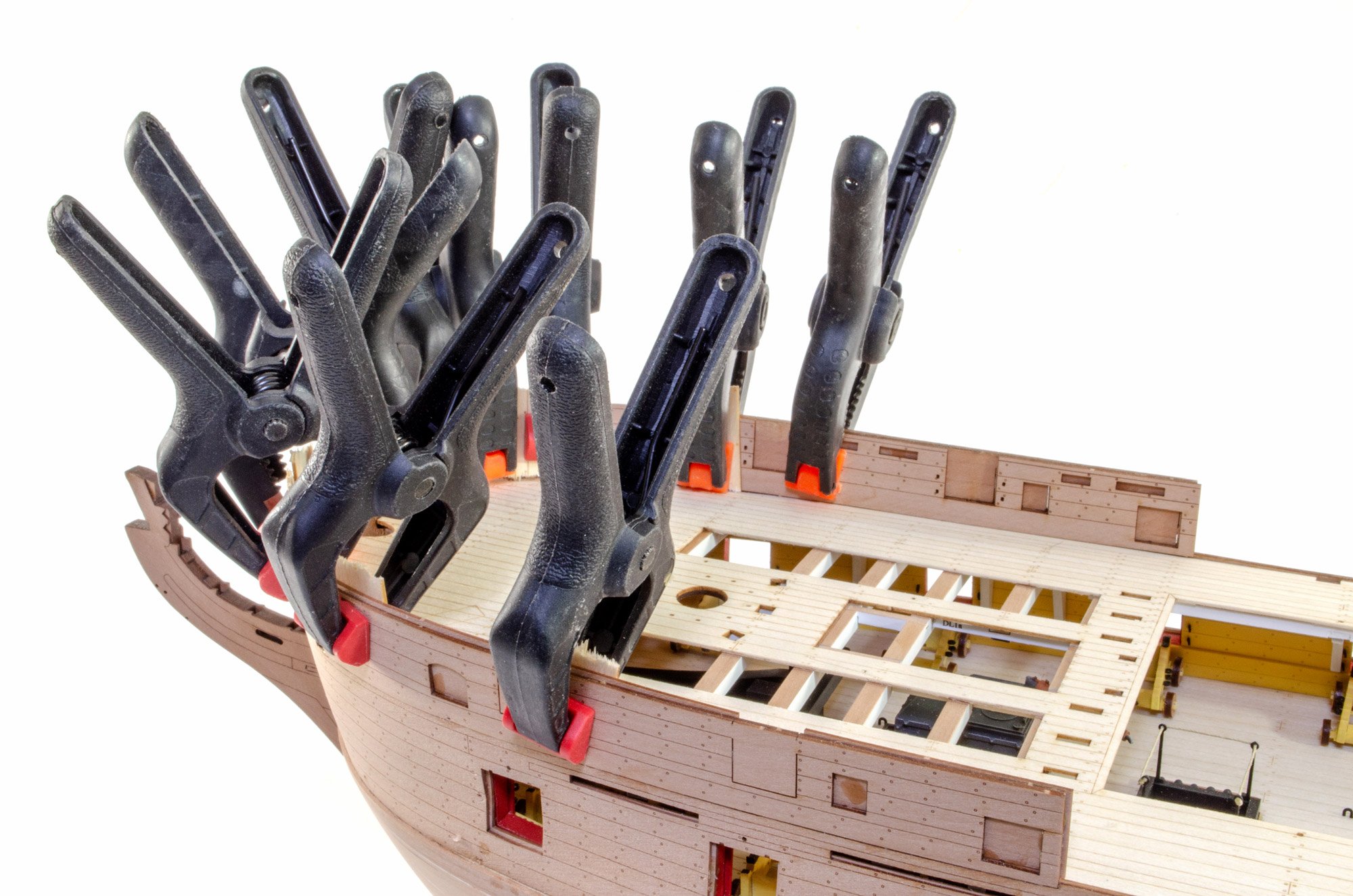

Some of the largest parts in the kit are the first layer of outer bulwarks. The front end of these are soaked in hot water and then clamped around the bow for 24hrs until dry and they regain their normal size. Once dry, the bulwarks are CLAMPED into place....NO GLUE! This is simply to help align the first hull plank.
The first layer of planking can now begin, starting with lime. With this in place, the bulwark can be removed until later.

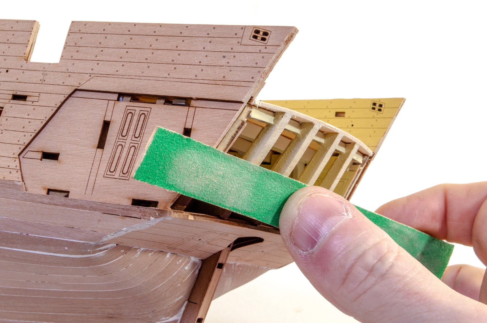

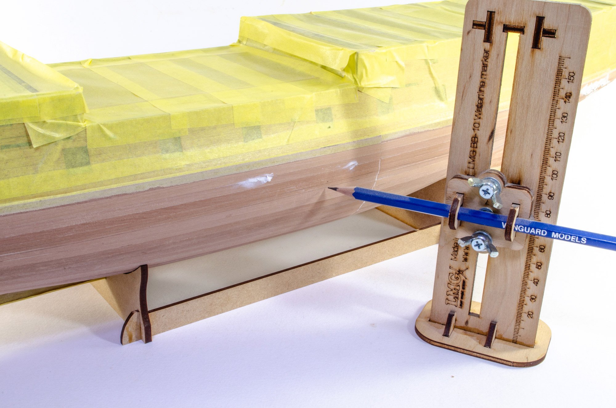

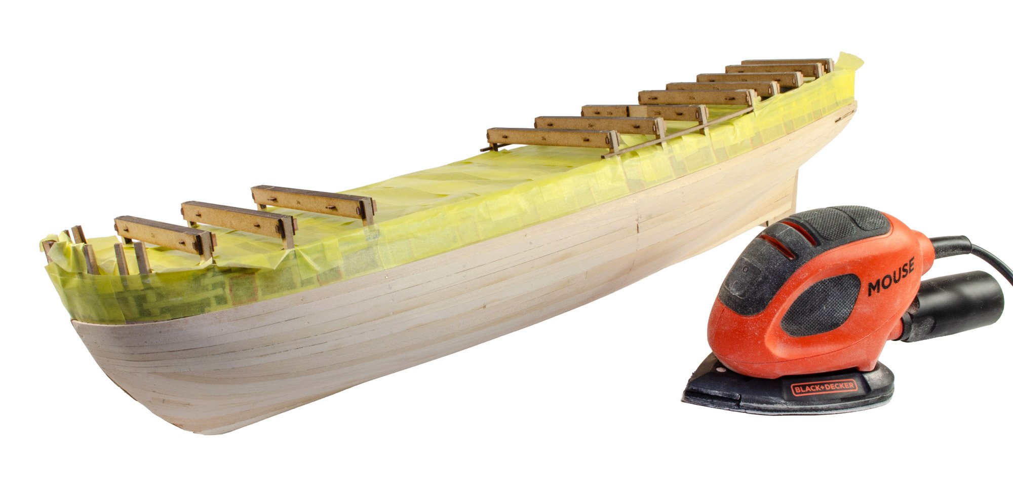

Once complete, the hull is sanded smooth. Before this happens, a temporary plank is placed above the first plank. Sounds odd?

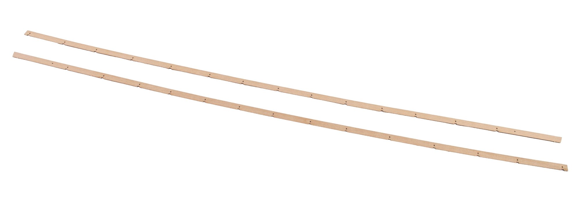

Ok, HMS Surprise does NOT have wales on either side. Instead, the main hull planking protrudes slightly beyond the bulwarks. To achieve this, we first use 1.5mm lime planking. (the inner bulwark was only 0.8mm). The temporary plank is to prevent the modeller from accidentally running inwards along the top side while sanding. When the hull is sanded, the plank and tape (to stop dust ingress), can be removed. Note the sanding mouse too. This is now what I use for large hulls.
I now add a waterline which is about 5mm below the actual one. Everything above this has any slight gaps filled. Below the waterline though, we'll of course be coppering.

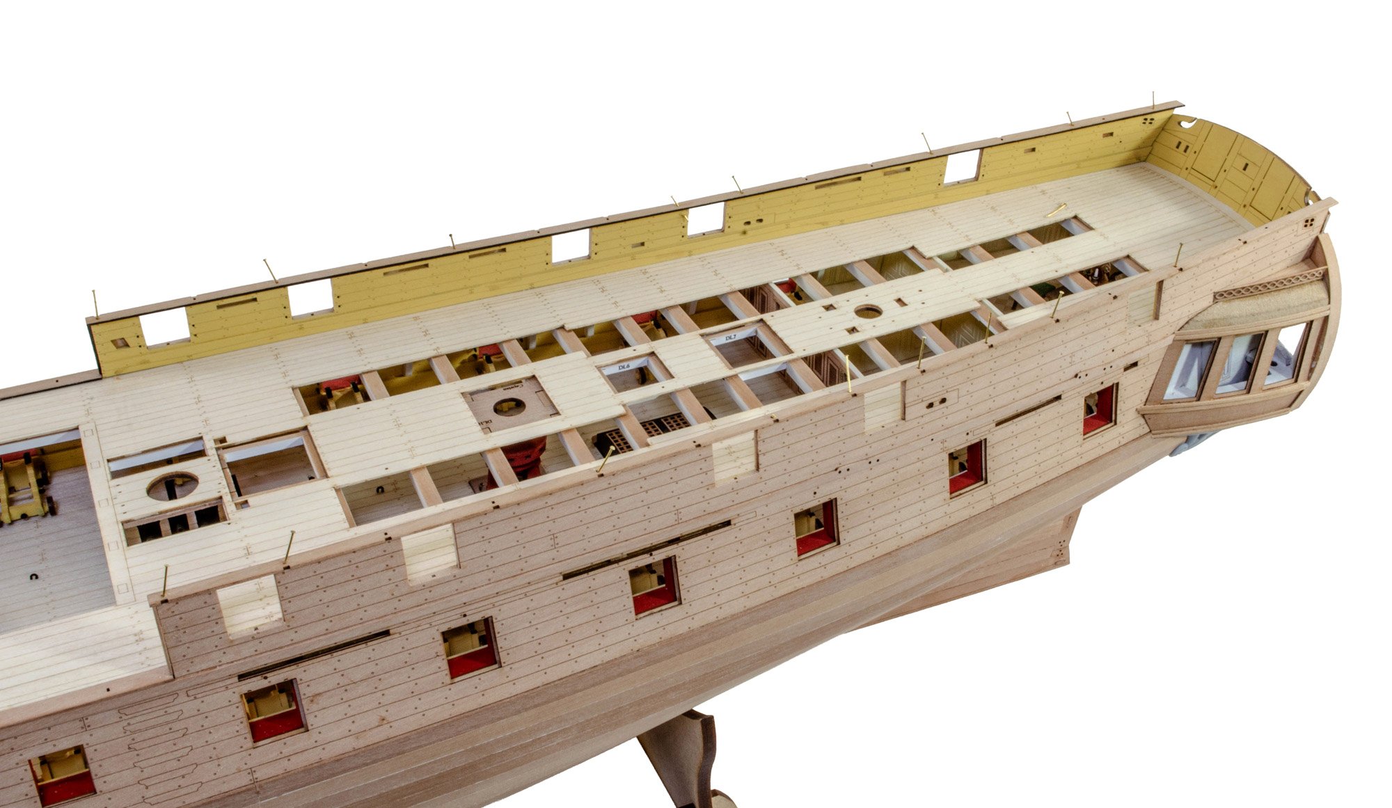

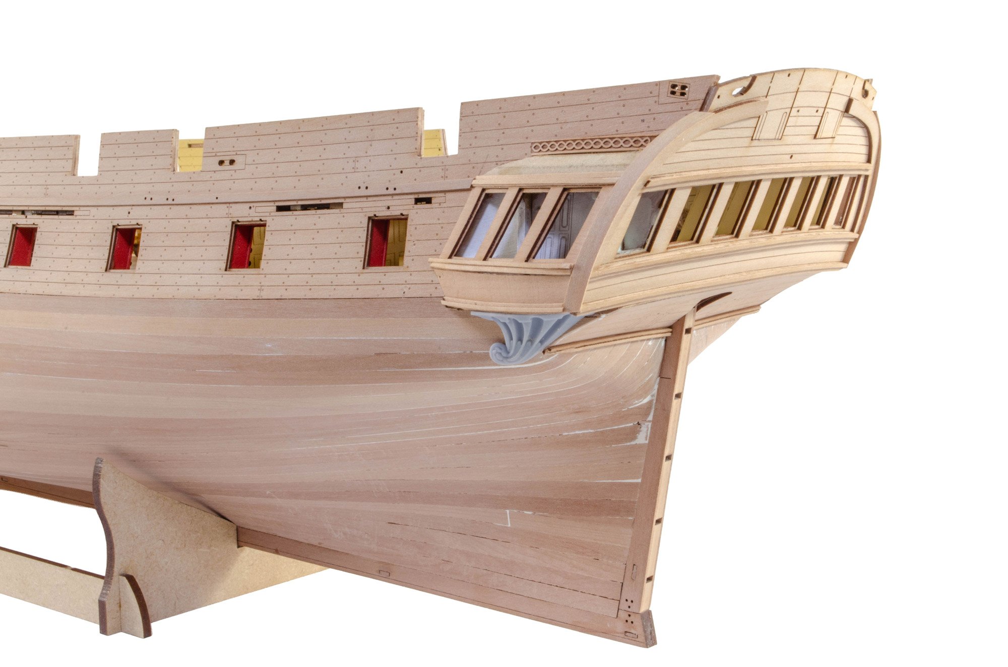

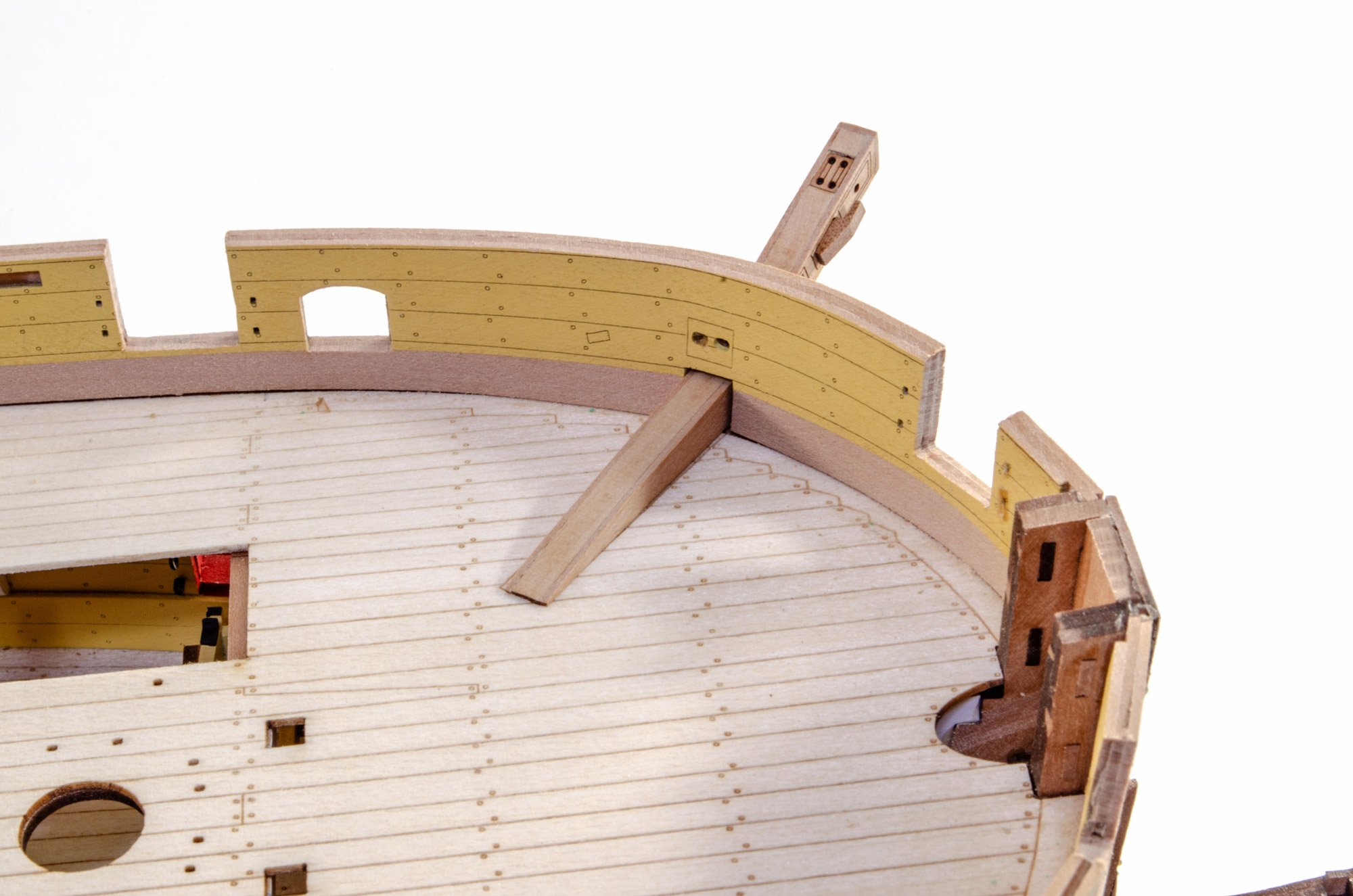

The hull now receives its pear planking and engraved outer bulwarks (once the inners are glued). We can now dispense with the remaining visible MDF structure. This is now snipped away, pending the main deck being laid. The deck is then glued down and it's time to add the inner bulwarks.
Here are the forecastle inner bulwarks. These fit like a treat! You need to soak the fore areas though and leave them to thoroughly dry while being clamped into the bow area. The bulwarks are then removed, painted and then finally glued, both here and on the quarterdeck areas.

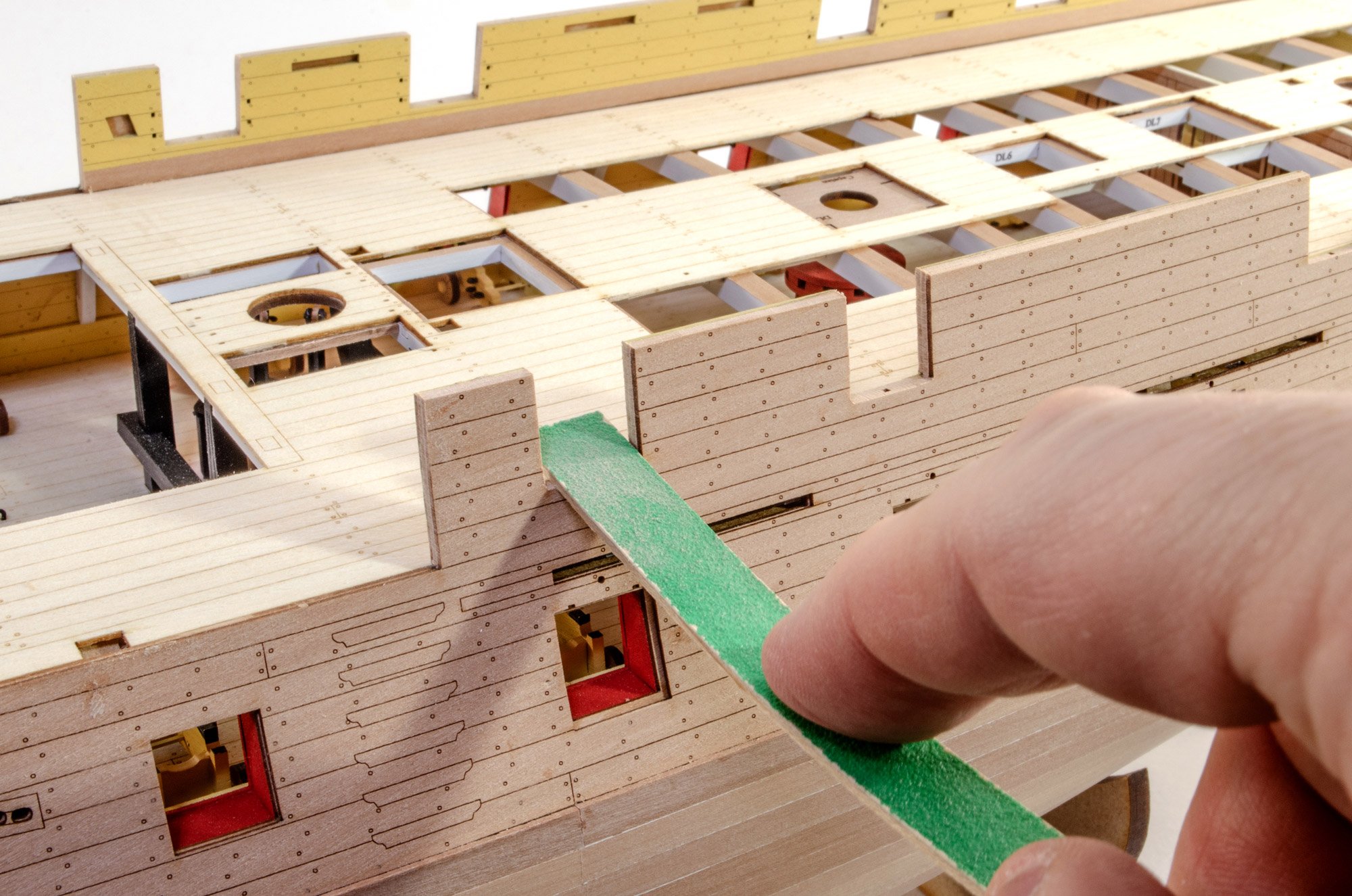

The triple-layer bulwarks are now levelled along their top edges and the various gun ports and other openings are cleaned up.

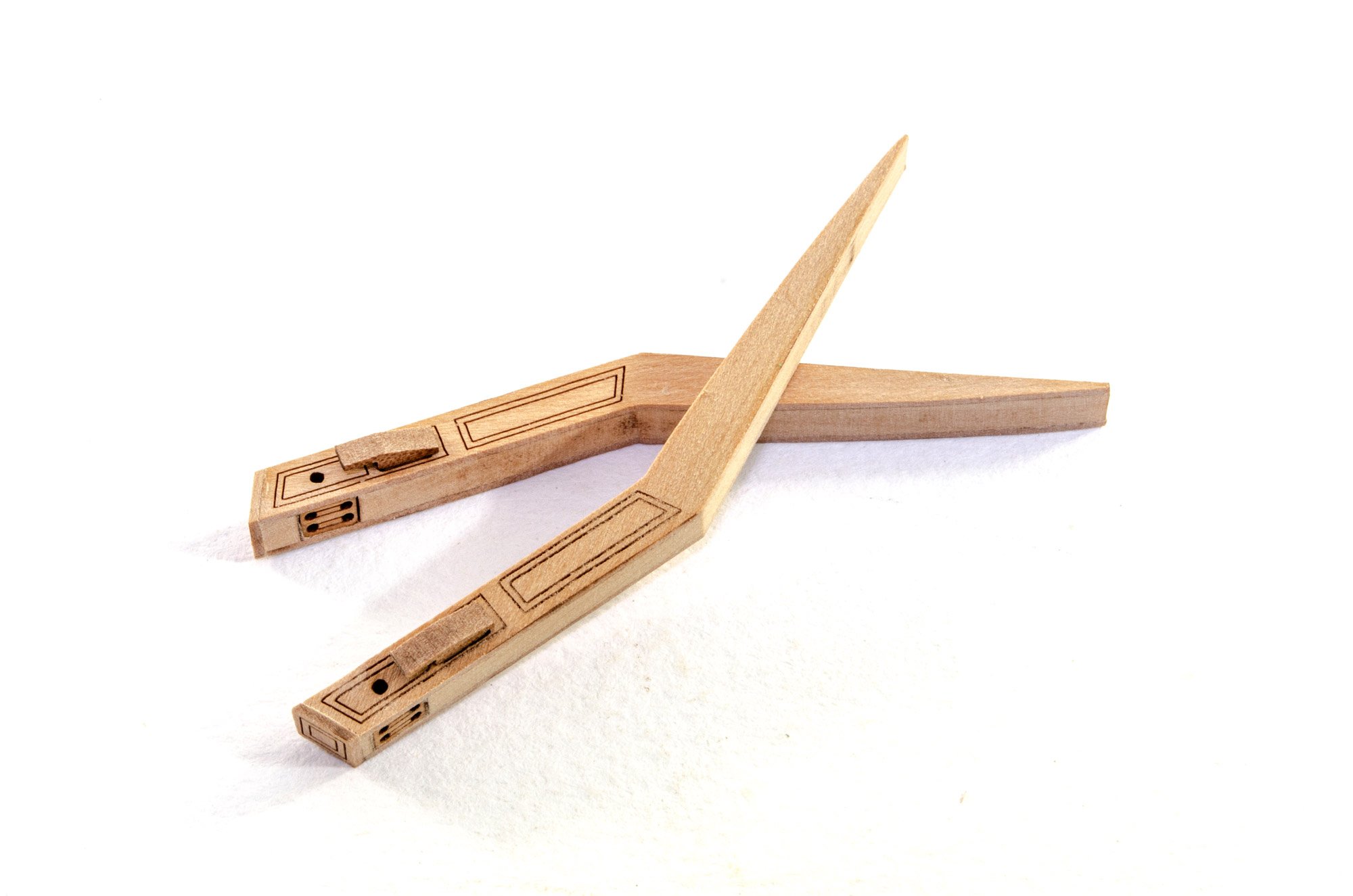

The catheads are built and then the forecastle openings are suited to fit these assemblies. These aren't glued in at this stage.

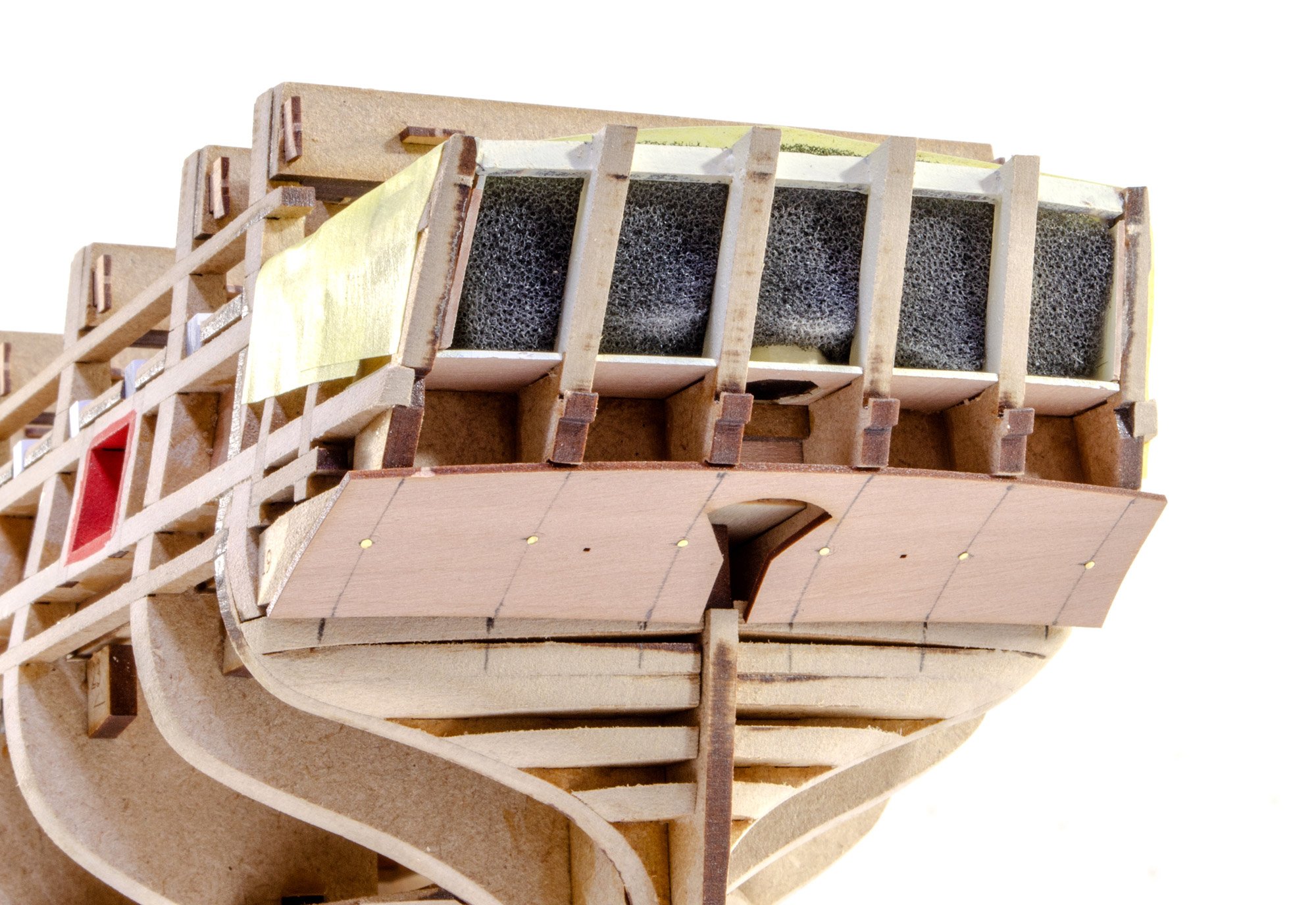

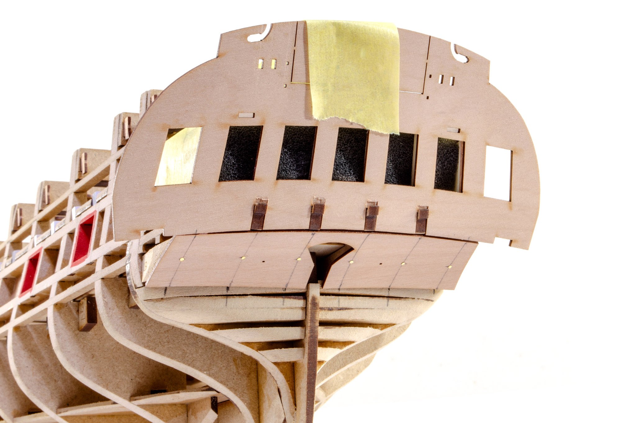

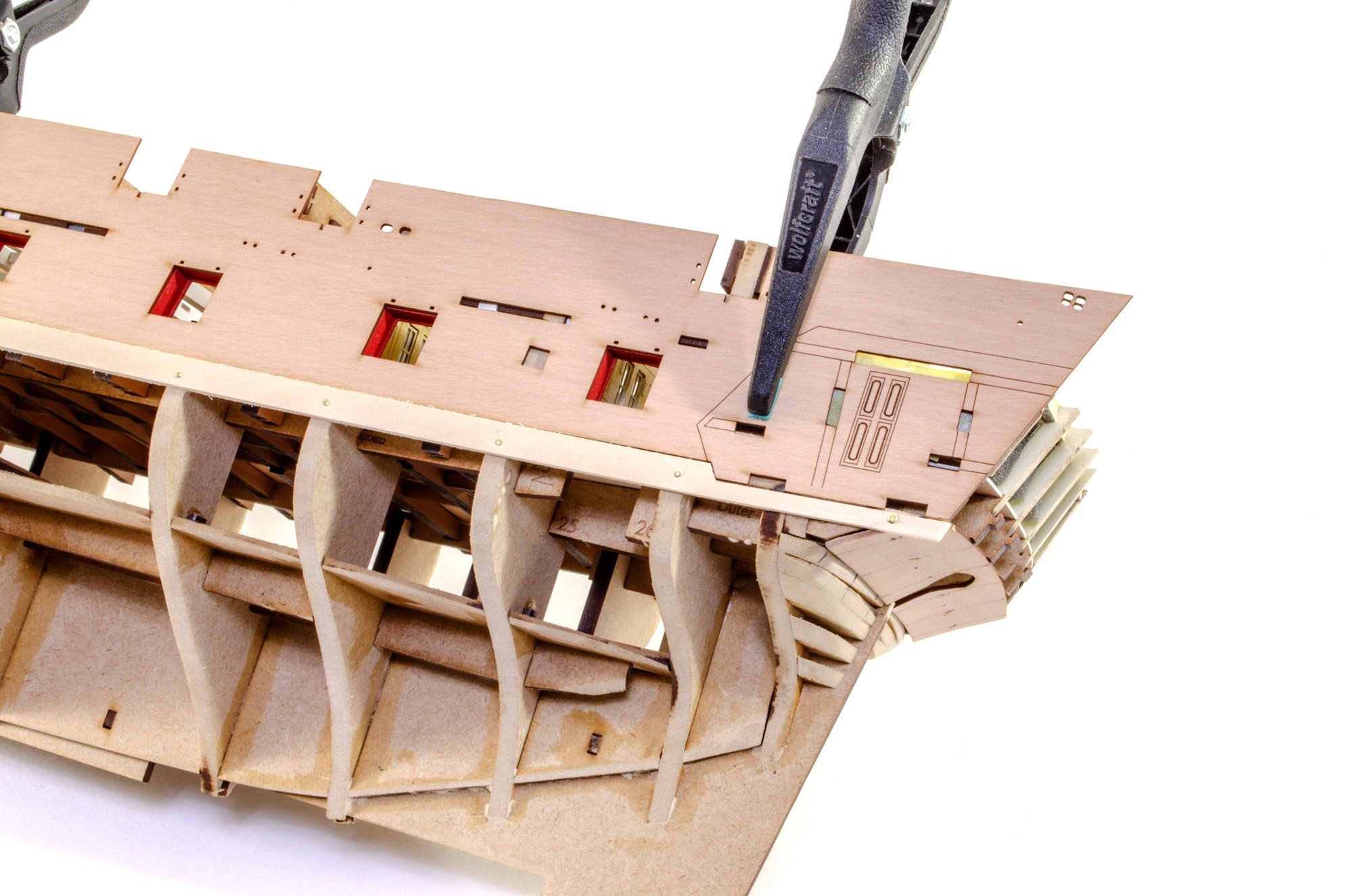

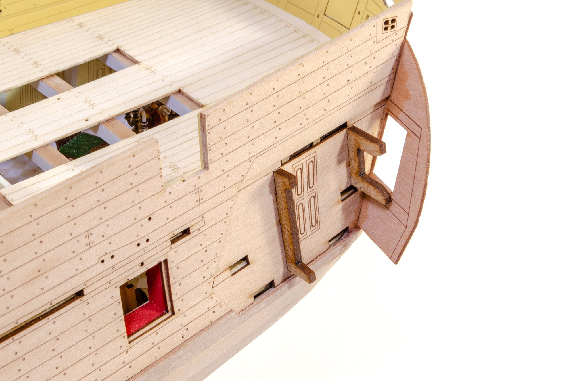

We can now return to the stern area. Before be can do any fitting here, the back needs to be flushed off, meaning the bulwarks and spirket will need to levelled properly.

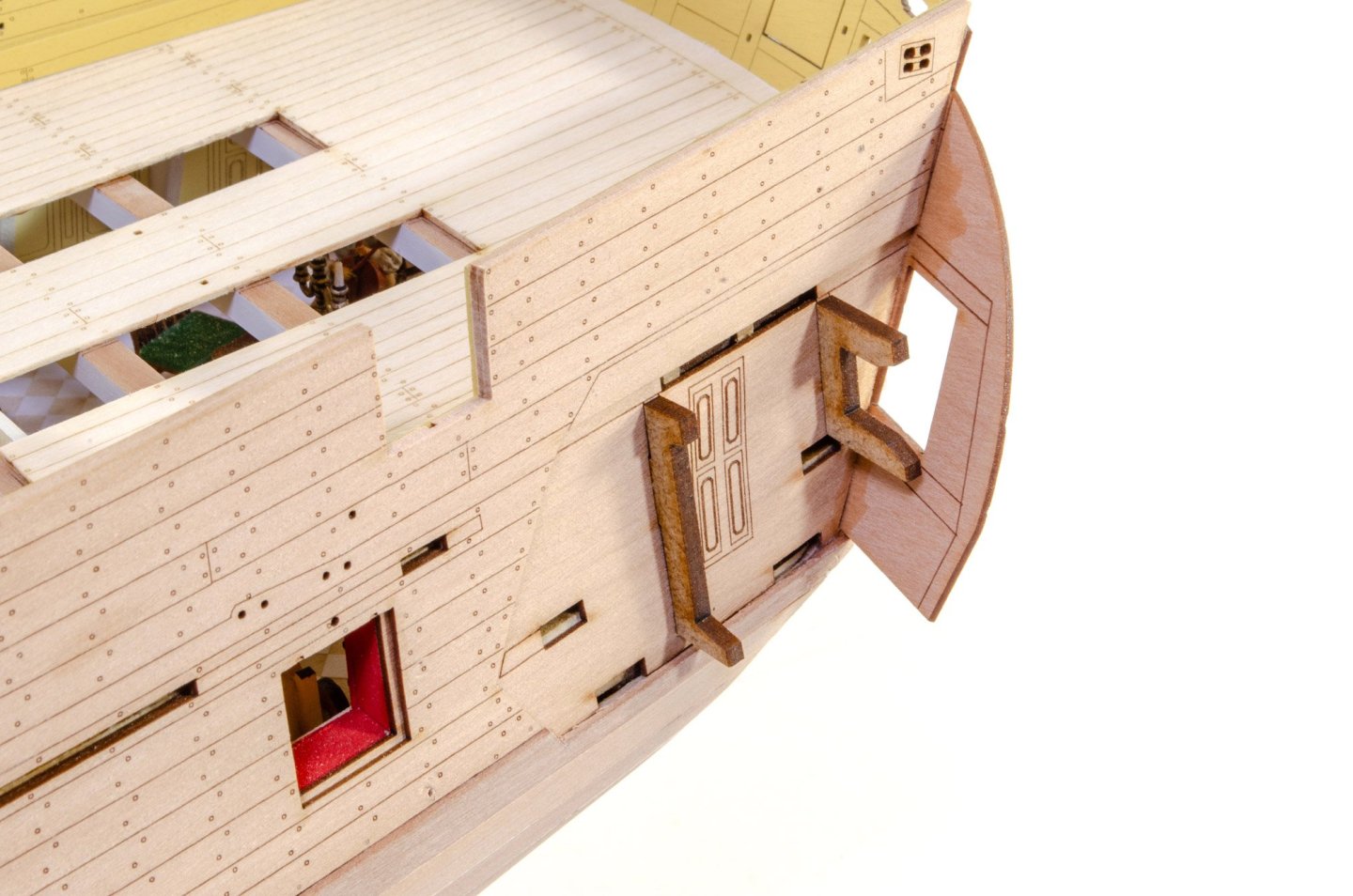

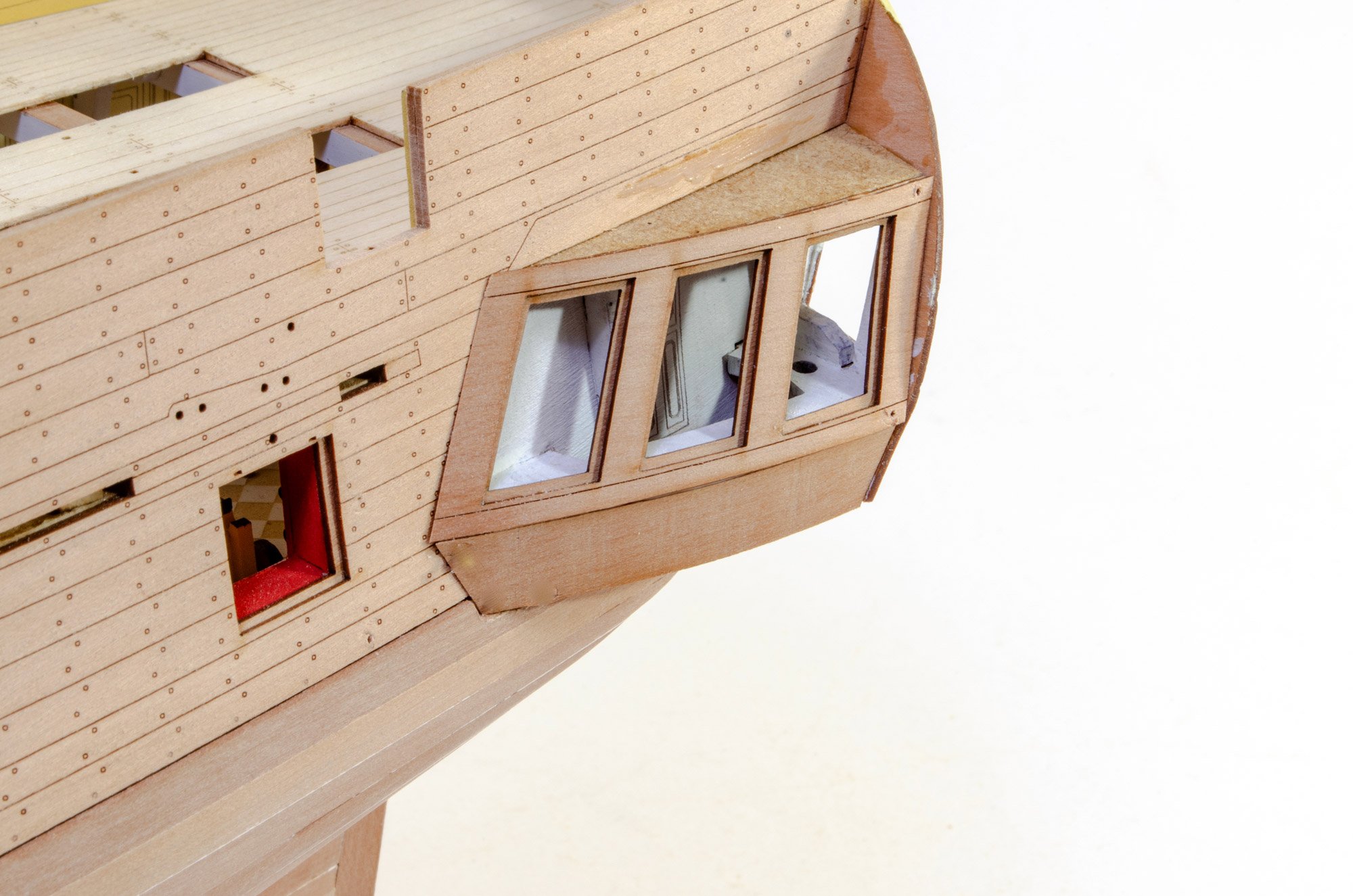

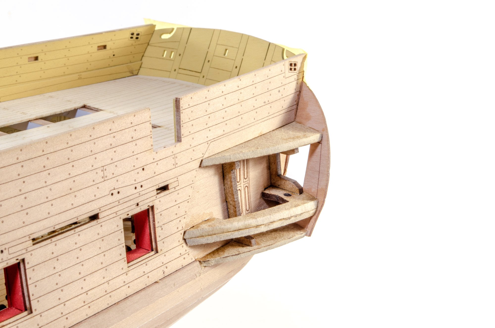

With the stern fascia temporarily in position again, the quarter gallery frames are now constructed. The inner stern area has the framework angles engraved on them, so getting those MDT frame parts in position is foolproof.

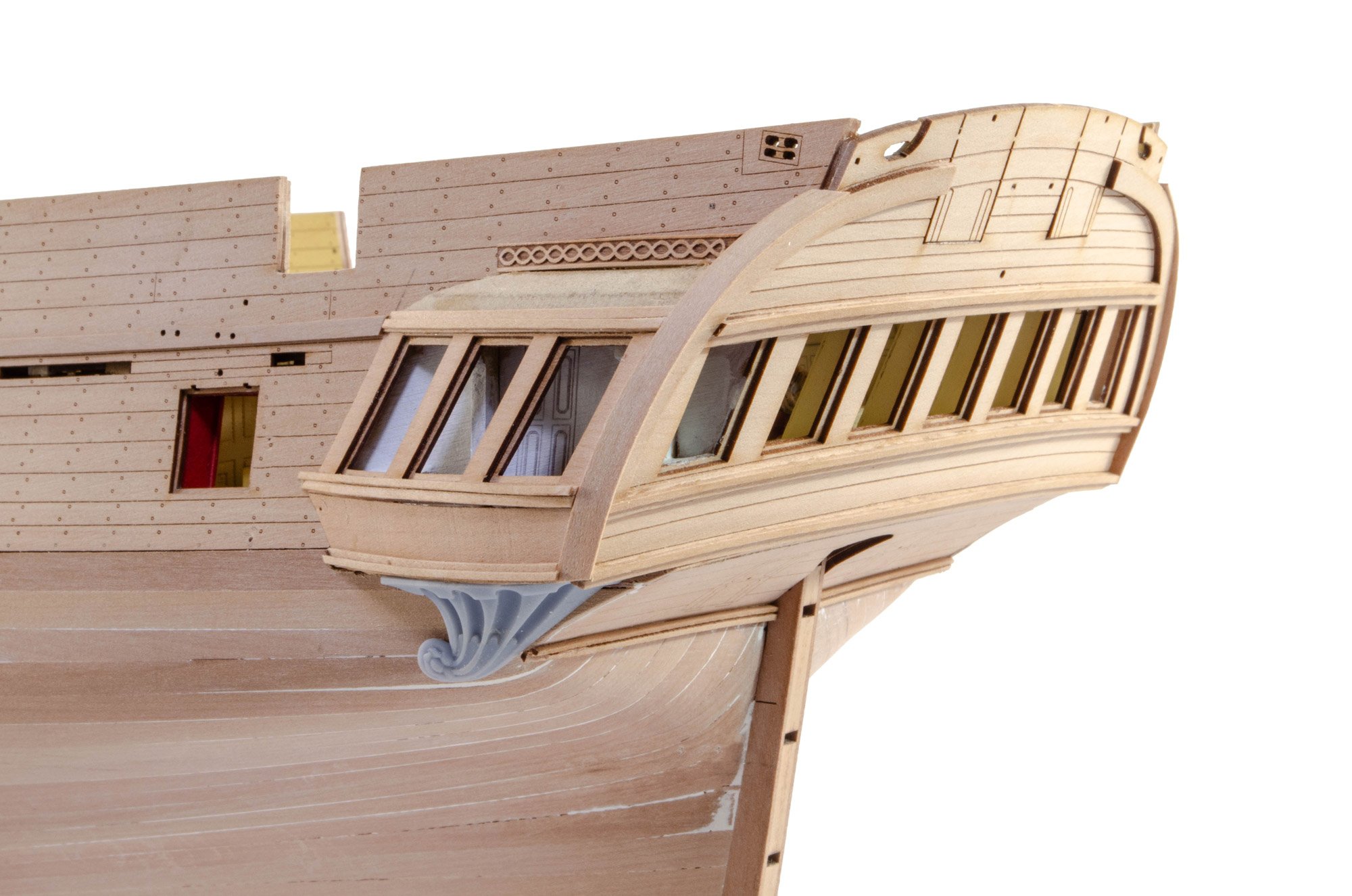

There are two layers of pear around the windows area, creating those recessed areas for the panes. The lower panel is a single piece of pear. The stern fascia can now be glued into place.
To finish the stern (almost) various rails are fitted, as well as some beautiful 3d-printed drops for the quarters. The only decor to now be fitted are some engraved laserbak details around the outer circumference etc. At that point, the whole stern will change again.
Hope you like the work so far.

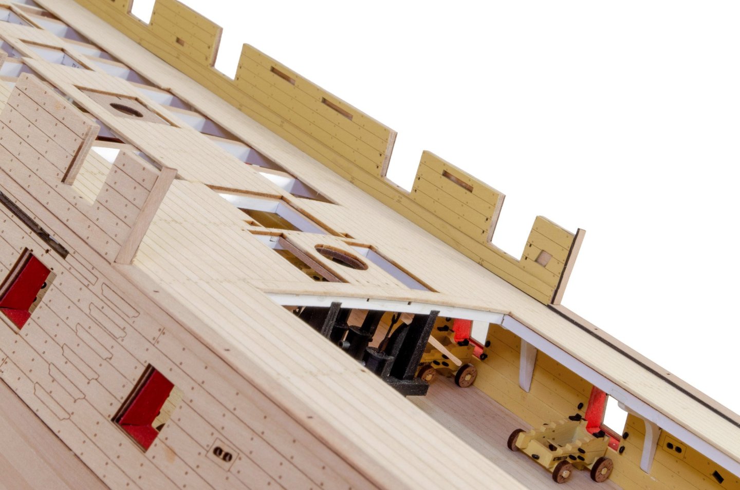

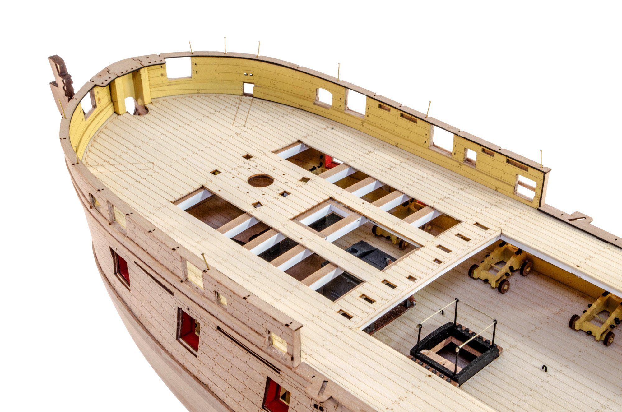

Recent work has been fitting various gunwales etc. It's real nice to see the finishing caps to the bulwarks, and the laminated areas finally disappear. These are the waist gunwales. Note that I have painted the inner edges of gunwales etc. in black. This just means I don't have the scary job later on, when the main colour is added to the hull.
These parts are the verticals for the ends of the bulwarks, tidying off those areas. When dry, they are flushed with the top of the bulwarks.
The forecastle bulwarks have been tackled slightly differently with Surprise. To begin, there is a section which is glued in right at the front. This means that the side pieces are now easier to manipulate around any inconsistencies that the modeller might've built into their specific model.
Now the quarterdeck gunwales are fitted.
I should've posted this photo a while ago. This is the flag set for Surprise. The quality is excellent....no stiffness in the material. It already hangs far more naturally than previous flags. These weren't a cheap addition, but thought to be worthwhile.

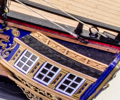

Beautiful work so far.
In your last photo of Surprise showing the quarterdeck from above, it appears to me that there is nothing behind the engraved wavy decoration on the quarter gallery. Will there something be added at a later stage?
On the bench:  HMS Indefatigable - 1794, Vanguard Models - 1:64
                             HM Trial Cutter - 1790, Vanguard Models - 1:64
                             HMS Victory, DeAgostini - 1:84
Nothing goes in that gap. It's purely decorative.
I do need to add the shingles to the roof areas though.

That ‘gap’ is pretty standard, it is also on my Winchelsea.
On my Surprise I’ll defer adding that rail until most everything else around the stern is finished. While building Winchelsea I became very good at knocking it off multiple times. I’ll also paint that top to match either the trim or the shingles before adding the rail, me having less nimble fingers than James.
I like how it’s coming together.
