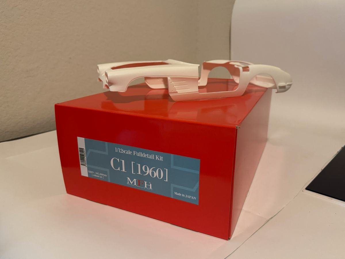

And here are all the resin parts after I washed them in some warm soapy water but before I removed a few extra tabs left from the molding process.  You can see a particularly large one on the body behind the driver side rear wheel.  Fortunately that area of the body will be covered by the rear bumper in case I do not get it perfectly smooth.
The two pieces lower right are jigs, one for making the convertible top and one for bending the aluminum wire that serves as trim on the body.  Otherwise it is mostly body and interior pieces as well as the engine block.   Note that while the doors are resin, the hood, trunk, and soft top cover are all metal.   I hope I am able to get an identical paint finish on the resin and metal.

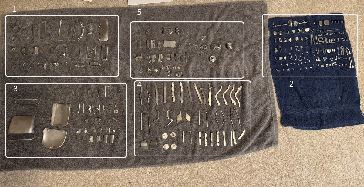

One more picture of "what's in the box".  I've cleaned all the metal parts in the tumbler, at least the ones I plan to do.  Some of the smaller and more delicate parts I did not tumble.  I then laid them all out again.  Within each batch of parts, they are laid out the same as the pictures on the web site, though the batches are a bit scrambled so I labelled them.   Oh, and I even found the missing part #81 though mine looks slightly different from the picture.   I guess my plan now is to put the parts into new containers based on which step in the instructions the part is used in.
There are additional photoetch parts, tires, wires, screws, rivets, etc that I have not shown.  In fact I have not really even inventoried them.  Perhaps I should do that.

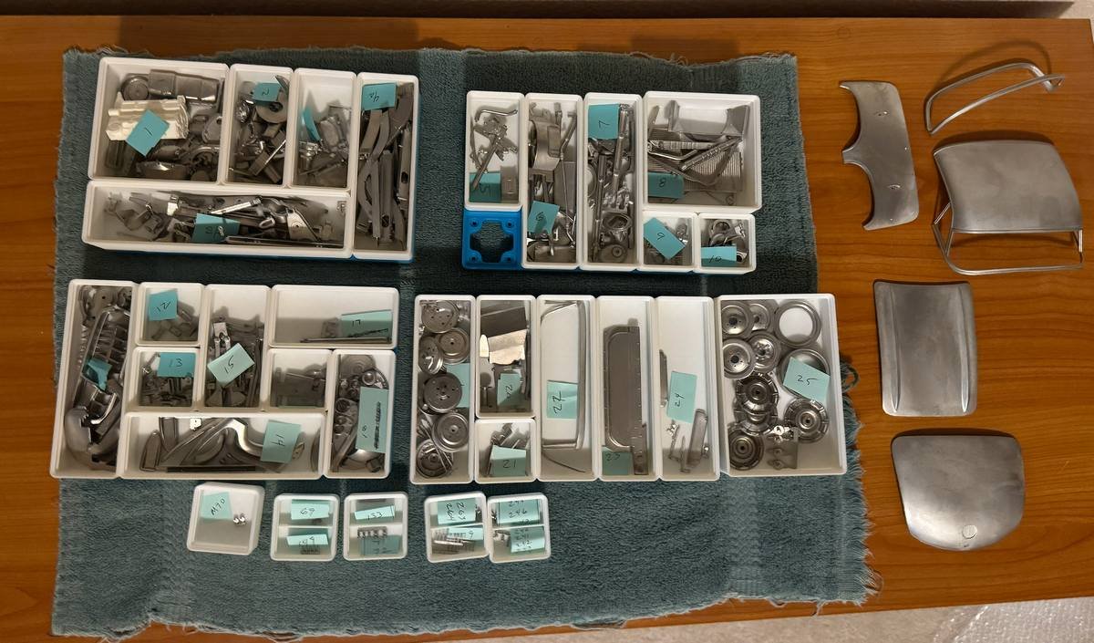

I don't know if this will be useful or if it was a complete waste of time, but I now have most of the metal parts sorted by the step number where they are used.  This is just the cast metal parts, not any of the photo etch.   Obviously I left out the large parts off to the right, and across the front are some tiny parts on little metal sprues that are often used in multiple steps, so I just identified them by part number.  You can see the step numbers/part numbers written on the little scraps of blue paper.  Each step has one white storage bin except for step 4 which has two bins.  That step builds the frame of the car, so has many larger parts.
And if you are curious, the white bins and the not very visible blue trays that they sit on were all 3D printed, based on the "gridfinity" system.

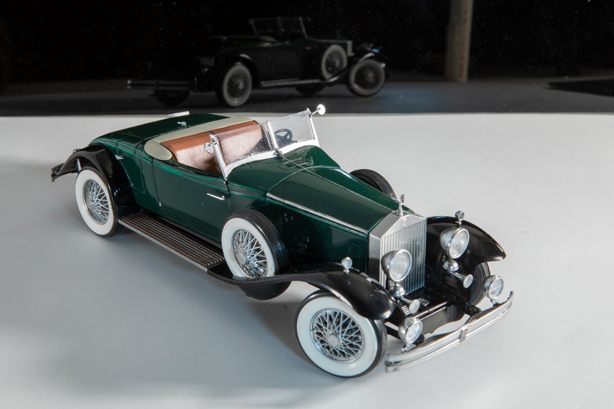

As you can see here, I've finished my prior project, a 1931 Rolls Royce coupe based on the old kit from Monogram (and yes I fixed the passenger side mirror that I knocked askew during the photo shoot).
I then cleaned the hobby table and got started on the Corvette.  Here is a picture of most of the "part 1" engine pieces just stuck together, no glue yet.
Getting to that point required drilling out quite a few holes, as the holes in the resin engine block for the alignment pins in the metal parts were generally not deep enough and in some cases not wide enough or not spaced correctly.  And I have more to drill....the valve covers are attached to the cylinder heads with 4 "rivets" each, and those holes all need to be drilled in both the valve covers and the cylinder heads.
My first impressions of the kit from going through all the parts and organizing things were great but I have to say my second impressions are a bit less positive.   It felt like the resin engine block was about 97% of the size it needed to be.  The pins on the back of the cylinder head were 38mm apart but the holes in the block were about 37.25mm apart.  Likewise, the front of the oil pan hung over the front of the engine block by a tiny amount, causing the front cover to not fit well.  I glued a 1/32" square styrene strip as a sort of gasket for that front cover to get it to line up with the oil pan.  And then there is the incorrect paint call out: the instructions specify red for the engine block but in 1960, GM used orange for its engine blocks.  And, as for the "rivets", the instruction sheet says I have 22 "rivet-S" and 14 "rivet-L".  The S and L might mean short and long or maybe small and large, who knows.  All I know is that I have 36 identical rivets.

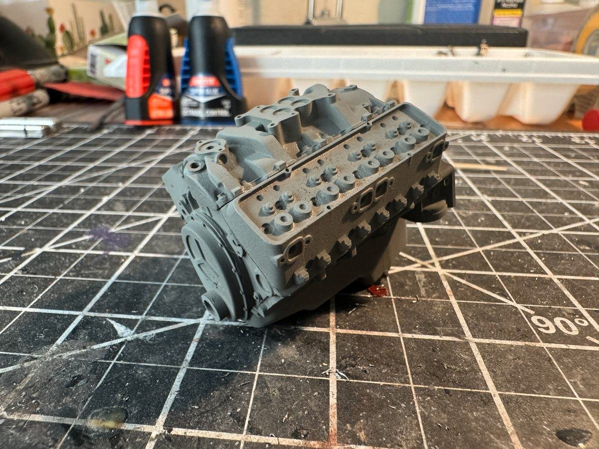

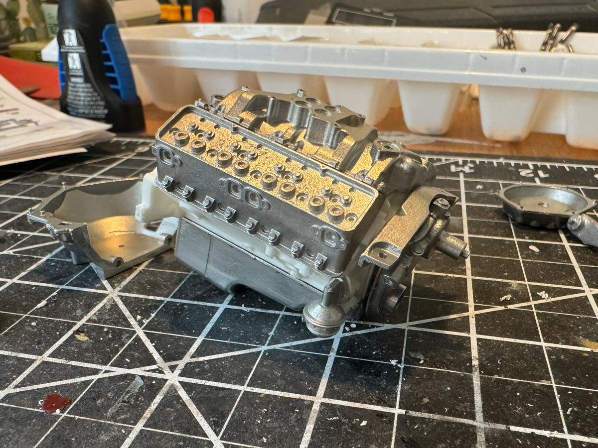

Anyway....here's the kit engine with some parts glued up and primed with grey primer from scalefinishes.

The orange parts are looking pretty good.  But, I probably really should have used the pink primer instead of the gray primer for parts being painted orange, but I did not think of that until too late.  I may do one more coat of orange after these cure a bit more.  Then might do some highlighting and detail painting.

- the partially assembled engine with 5 metal parts is actually quite heavy.  I don't have a small scale but I would say 6 ounces or so.  My usual methods for holding parts while being airbrushed do not handle such heavy items so well.

And just like that, steps 1, 2, and 3 are done, completing the engine.  It is certainly not the most detailed MFH engine, but I think it looks pretty good.   Of course in the prototype, the plug wires are hidden in that chrome shroud above and around the engine, so that hides one of the most obvious details one could add.  The rest of the engine went together fairly well, though the fitting of that shroud and the distributor were a bit bothersome.  Of course there were more holes to drill that I missed the first time around, but fortunately they were all accessible.  I know they say to pre-build these things first to catch such issues but I just don't see how that is possible.
I may attempt to add a few more details, but likely only after the engine is mounted on the frame and the firewall and fender liners are in place, or perhaps as I am doing those steps.  In these pictures, the air cleaner is just pushed on, not glued, so it can be removed to provide better access to add details.  e.g. the real engine has the throttle linkage on the left side of the carb, heading back to the firewall, under the plug wire shroud.
The bell housing was stripped and painted with alclad aluminum, per egilman.  The transmission and exhausts were painted with alclad steel, which I find to be far too dark, so I started with a very thin coat of steel over the metal, then misted over some aluminum as well.
The instructions suggest painting the valve covers silver but I just left them as is, with a little polishing and clear coat.
