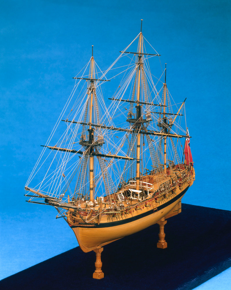

Beautiful work on the cutter, Peter, she's looking great, I really admire the amount of details that you and the other Pegasus/Fly builders are putting into your boats  :)
I am ashamed to confess that due to my lazy nature, I would probably use the Contemporary Swan Class Model in the link below as my excuse for not adding any boat to my ship:  :P
http://s3.amazonaws.com/magnoliasoft.imageweb/nmm/supersize/d4085-3.jpg

I got the impression that you are taking a break in the work on your Pegasus, concentrating on your wonderful Triton. Another one lost to the dark art of scratch building…?
Take care
Peter
Thanks, Peter, I'll return to my Pegasus once I finish planking Triton ;)
