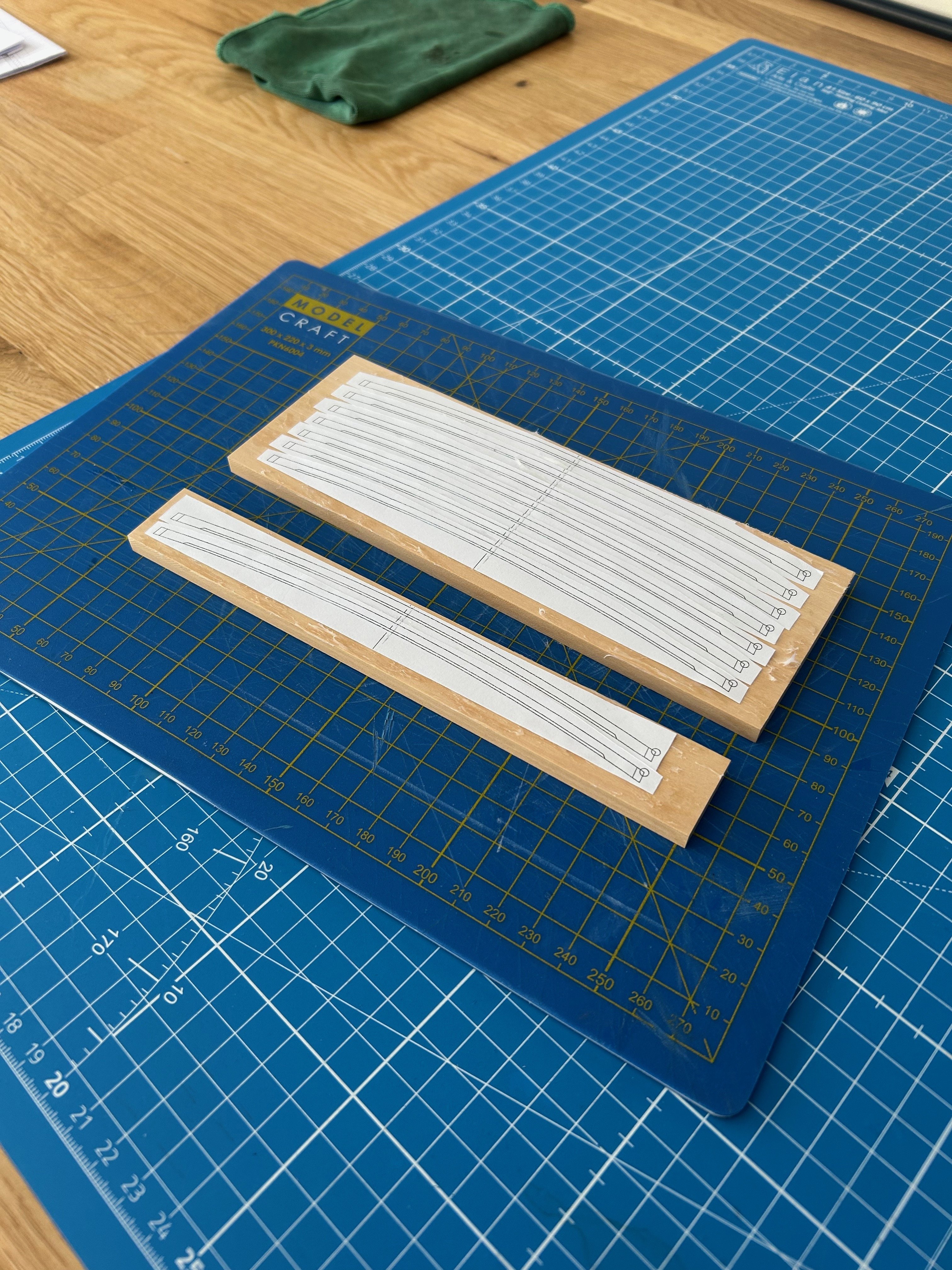

These planks are curved and I wanted to make them off of the model so that I can cut the window holes on the mill.  So what I did was first was to just roughly edge bend some planks on a really simple jig.  I use foil underneath as if the wet Castello touches steel which is the base it turns the wood black.
I then made some vice jaws which matched the curvature on the drawings
I then put all of the planks into a really simple jig and squeezed them all together with glue.
I have ended up with what will hopefully be the planks that I will shape and use.  If not I'll just make another one now that I have the jig.

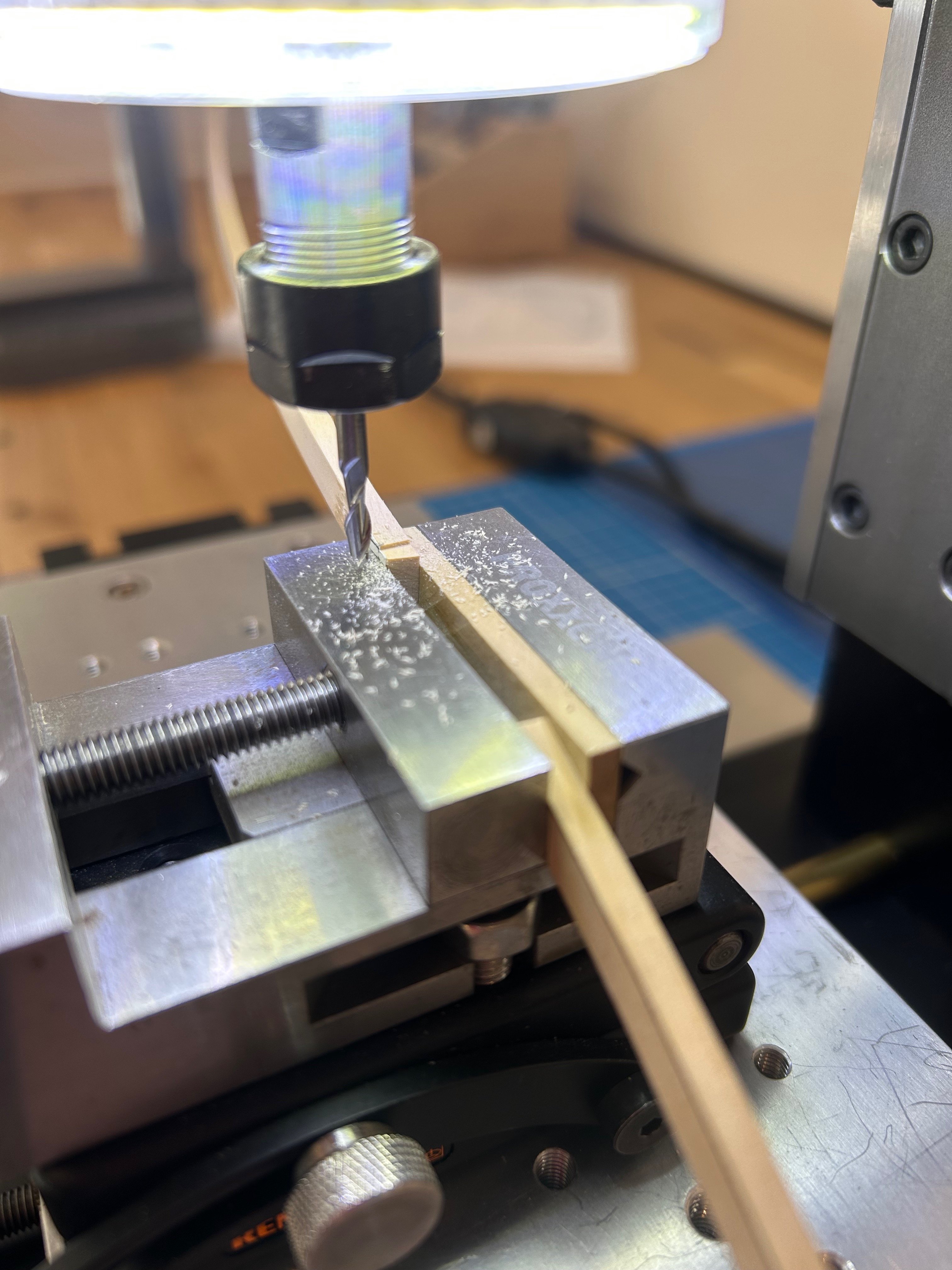

I've been trying to figure out how best to make the windows as they are a parallelogram in shape but also all of the parts are angled to suit the angle of the stern.
I tried a few mock ups using separate parts but they really did not go well at all.  So I thought that the best way was to try and mill them out of a single piece.
So I marked them up to roughly match the drawing
Then I set the required angle and using a 1mm mill bit I cut the windows out.
The result actually isn't too bad - sorry about the poor quality pictures and I just balanced it into the ship to give a rough idea of how it looked.
One down although it needs tiding up and one to go.  I can then complete the window frames and plank the inside to tidy it all up.

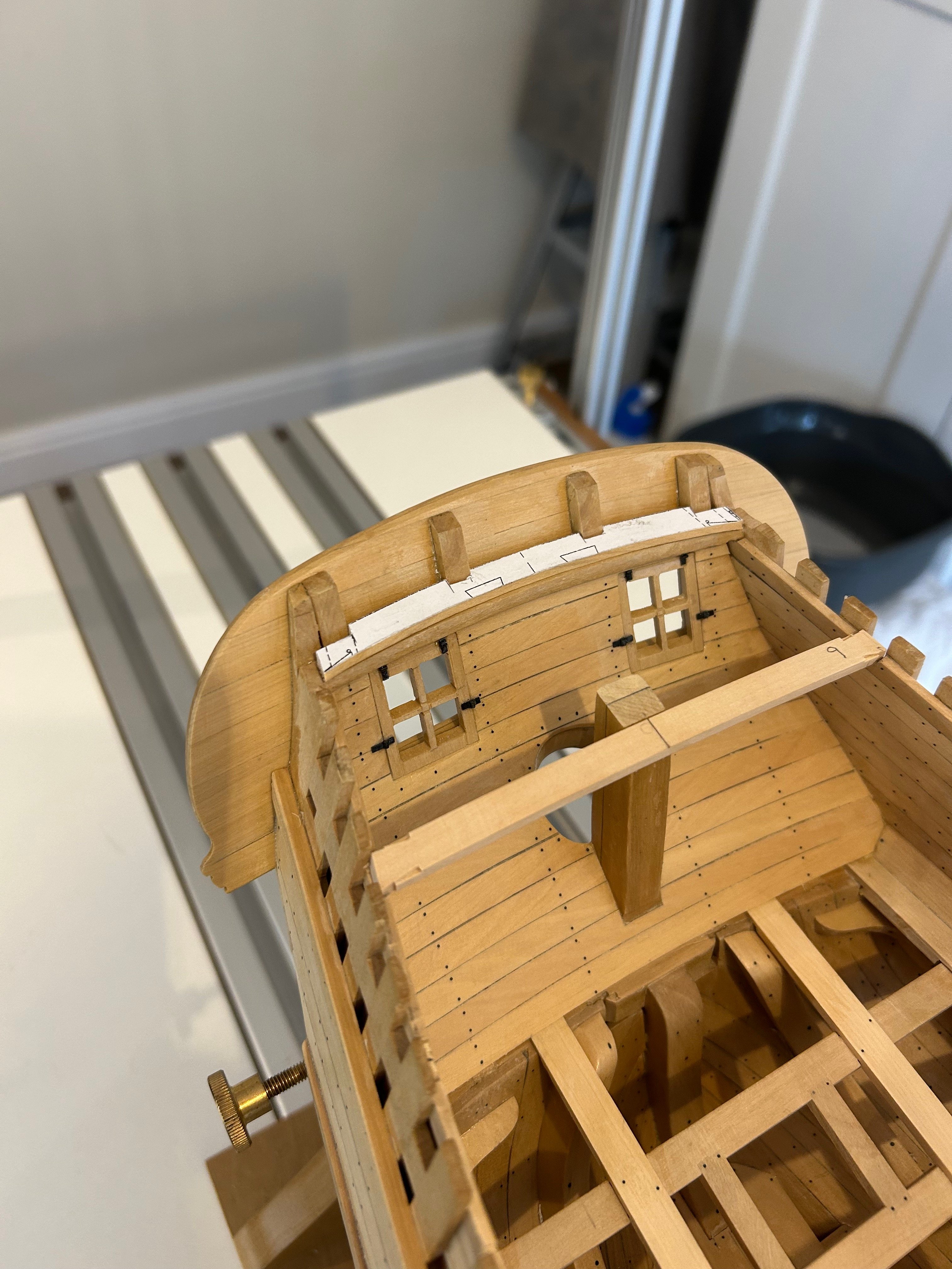

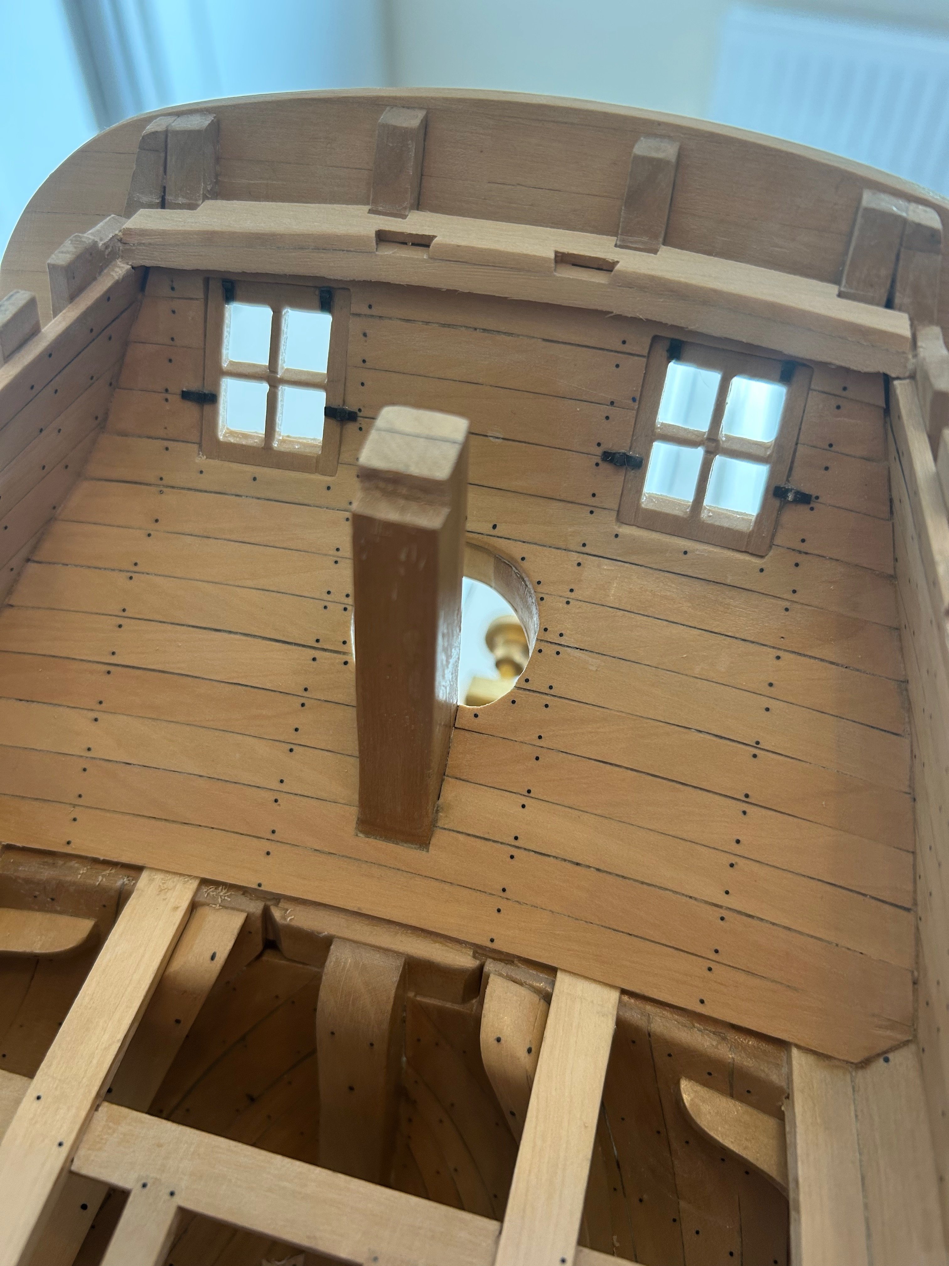

Another update from me - I've now closed off the stern and finished the stern windows.  There's not too much to say about this work other than the planking is not straight but curved.
I tried bending planks but pretty much got no where with that so in the end I made them from a 13mm wide plank by sanding them to shape.  The hinges and closers are blackened brass.
I still need to place the nails on the external planks but thats a nice easy job.  I think I'm going to make the quarterdeck beams, supports and waterways next.

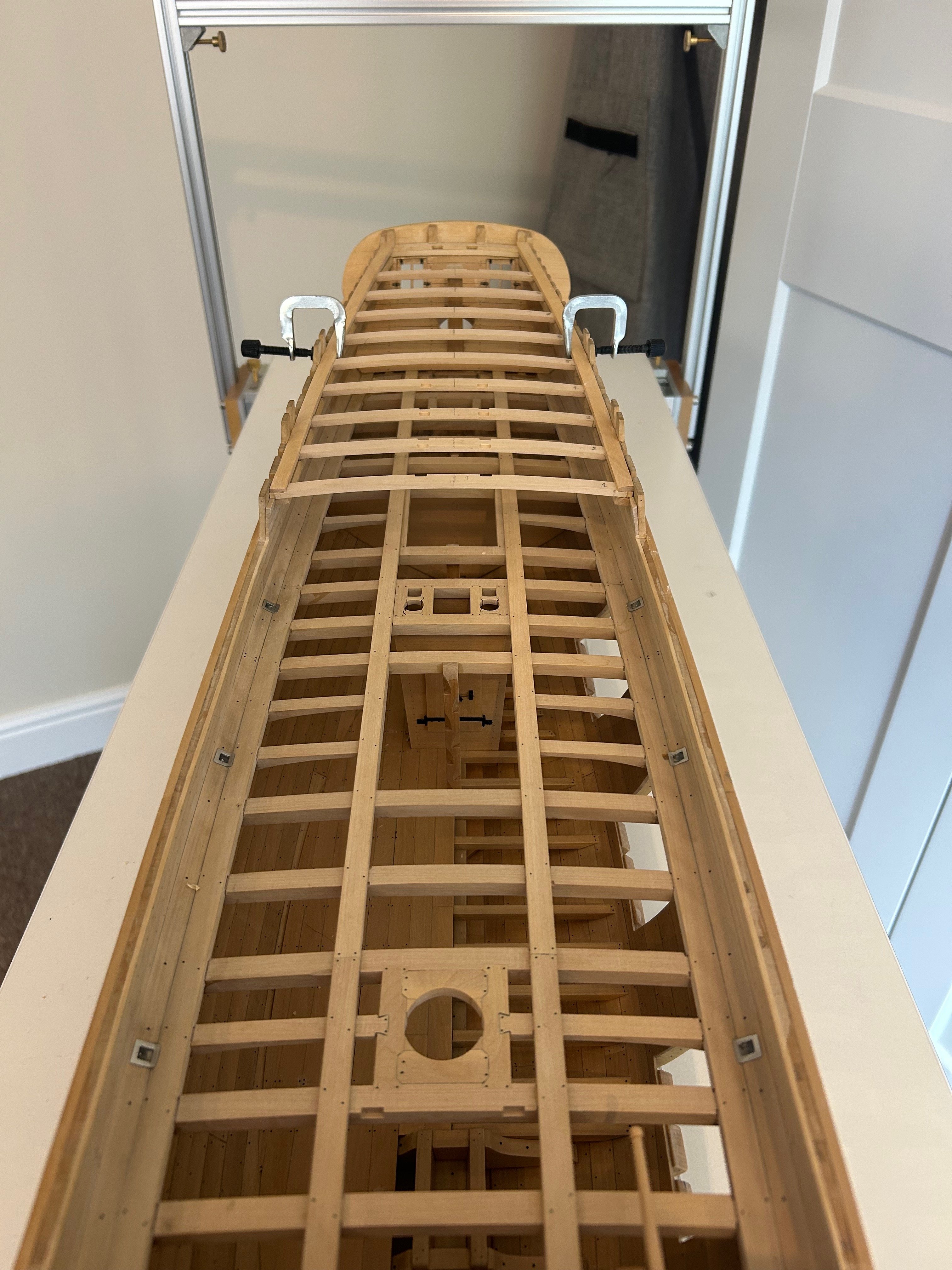

Hi All
I've not posted in a while as I found an issue with my build that began 3 1/2 years ago when my building skills and general ship understanding were very much in their infancy I guess.  I first noticed this problem when I fitted the stern timbers and stern windows.  I could see that the counter timbers did not go fully to the top of the stern timbers and the quarter deck rear beam seemed far too close to the top of the windows.  The issue is -  I have set the counter timbers at the wrong angle which to correct at this stage would be very difficult indeed.
I felt that this would be the end of the build as I have tried my very best to keep as accurately to the plans as possible.  I decided just to have a break and come back to it later with a fresh outlook and see how I felt about the problem.
So with a renewed outlook I took loads of measurements of the entire ship.  I discovered that everything forward of the stern post is fine.  I also discovered that everything rearward of the stern post is 5mm out of spec.  So I have a ship that is 5mm longer than it should be and the issues that accompany it.

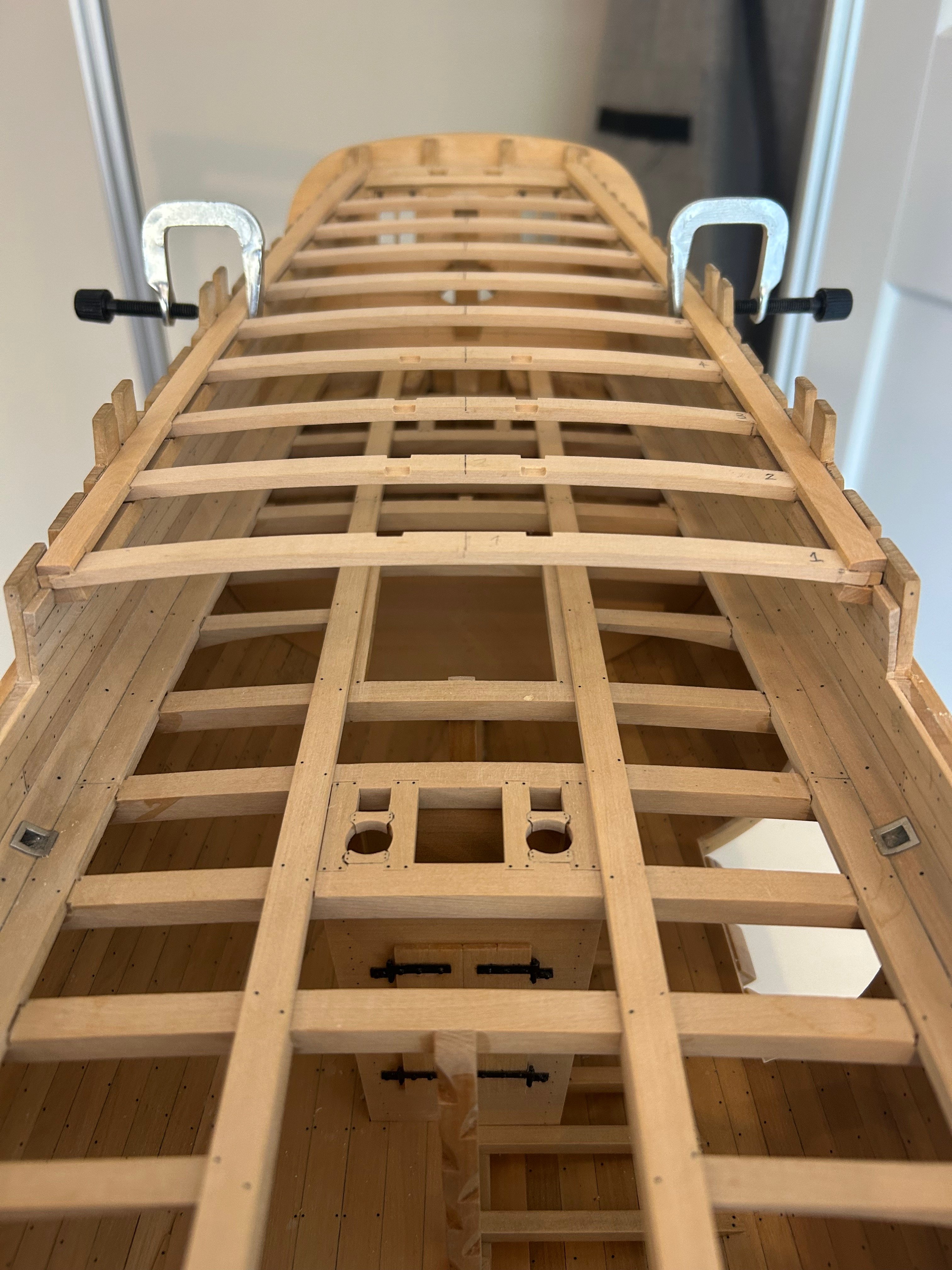

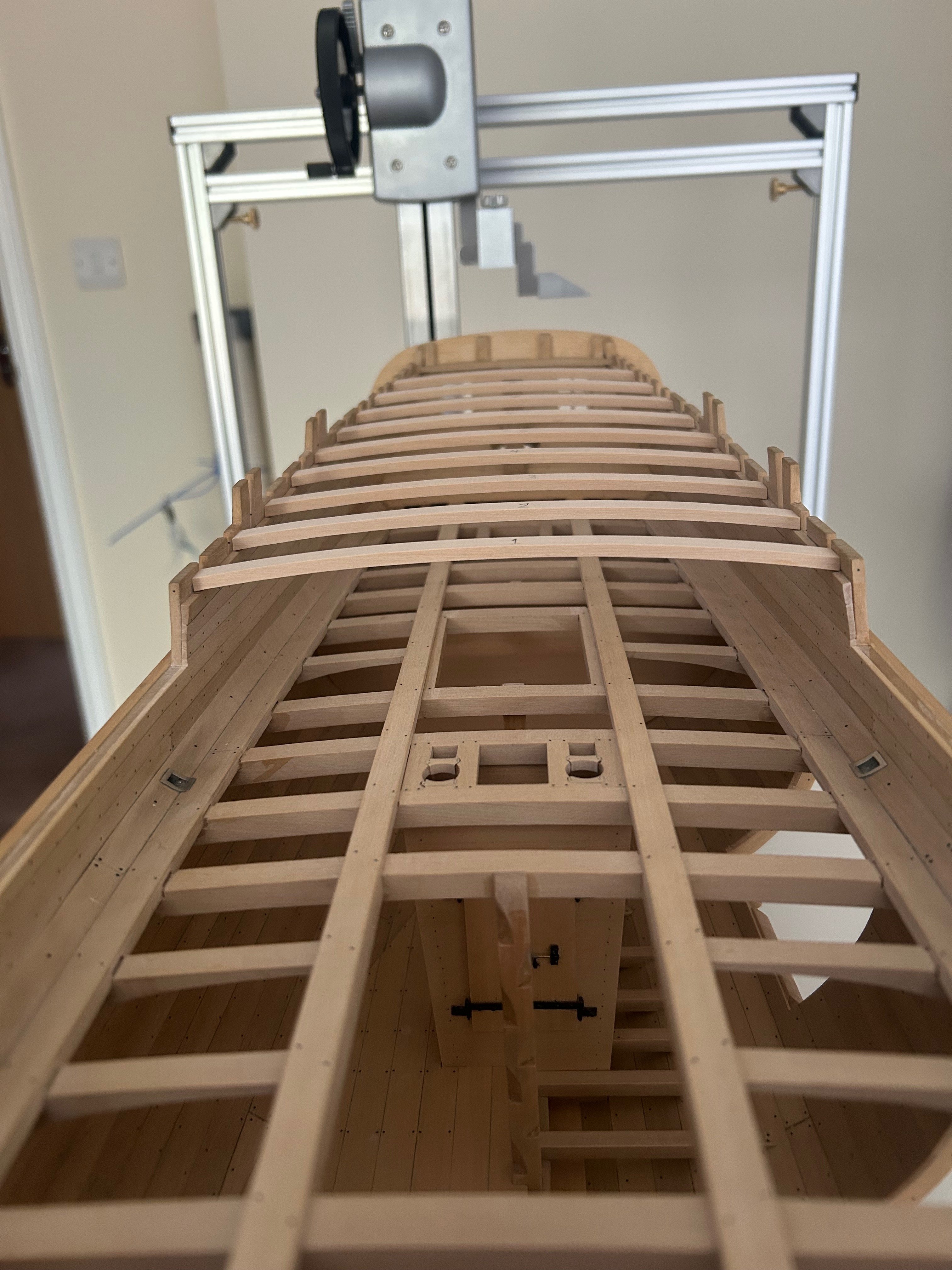

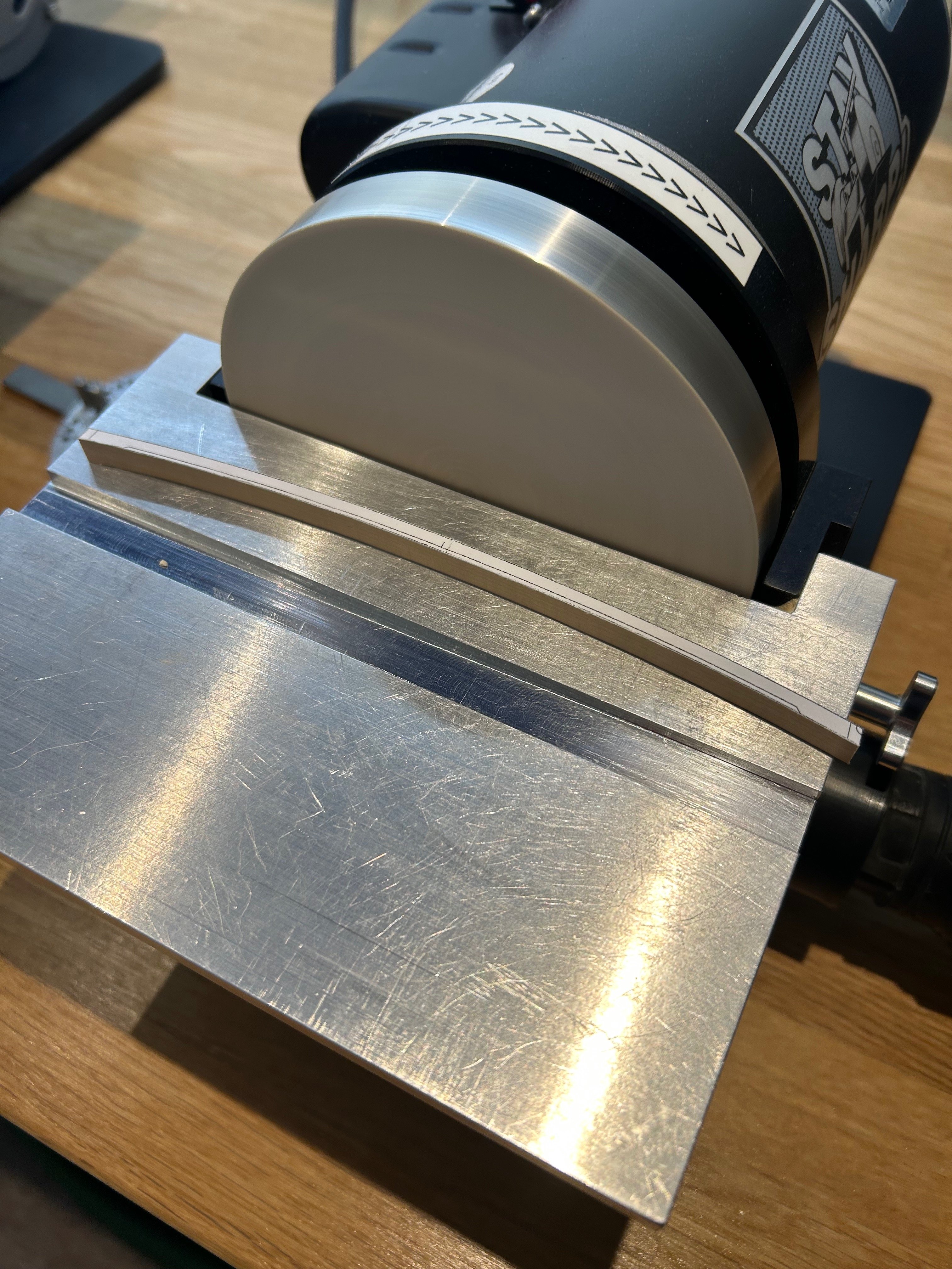

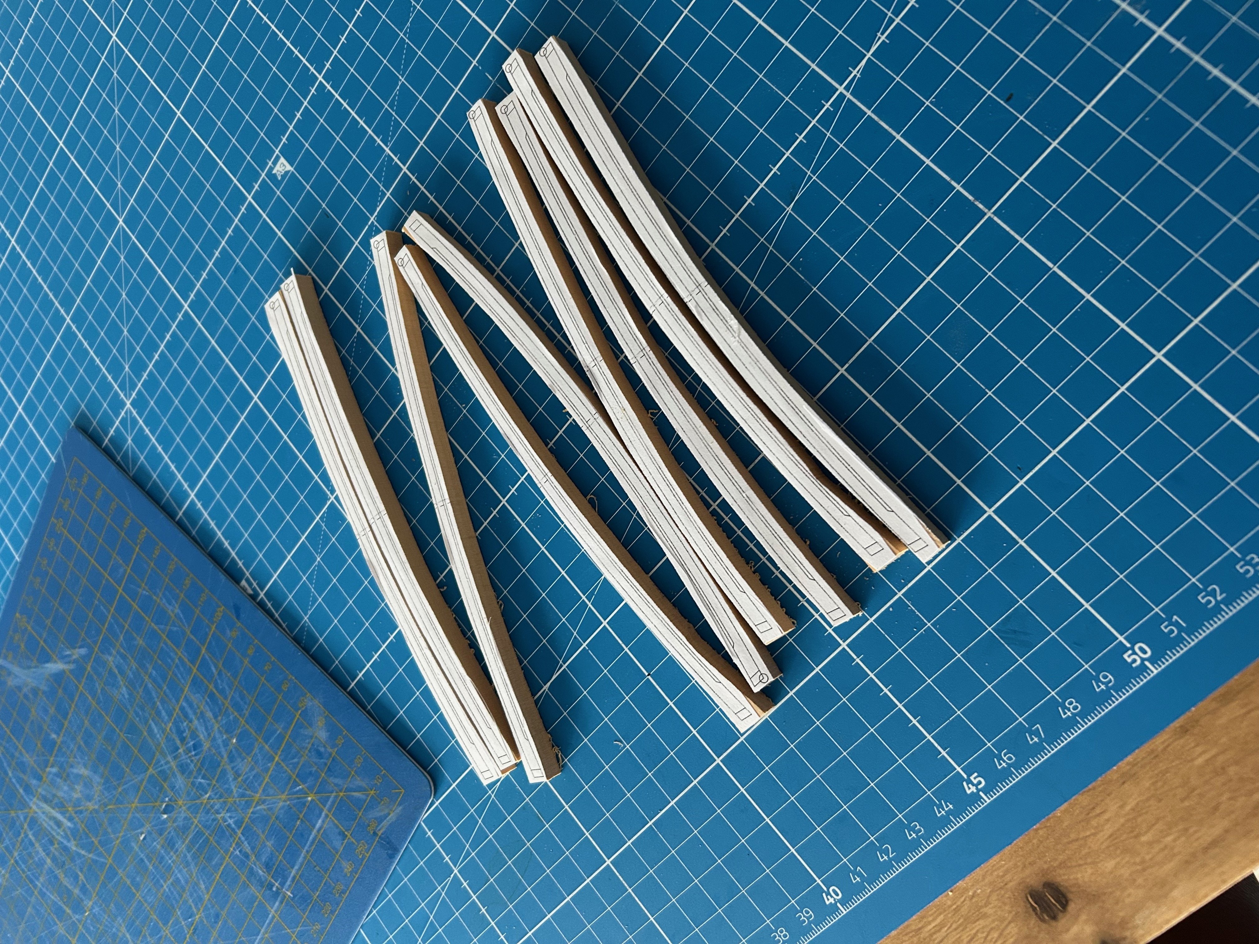

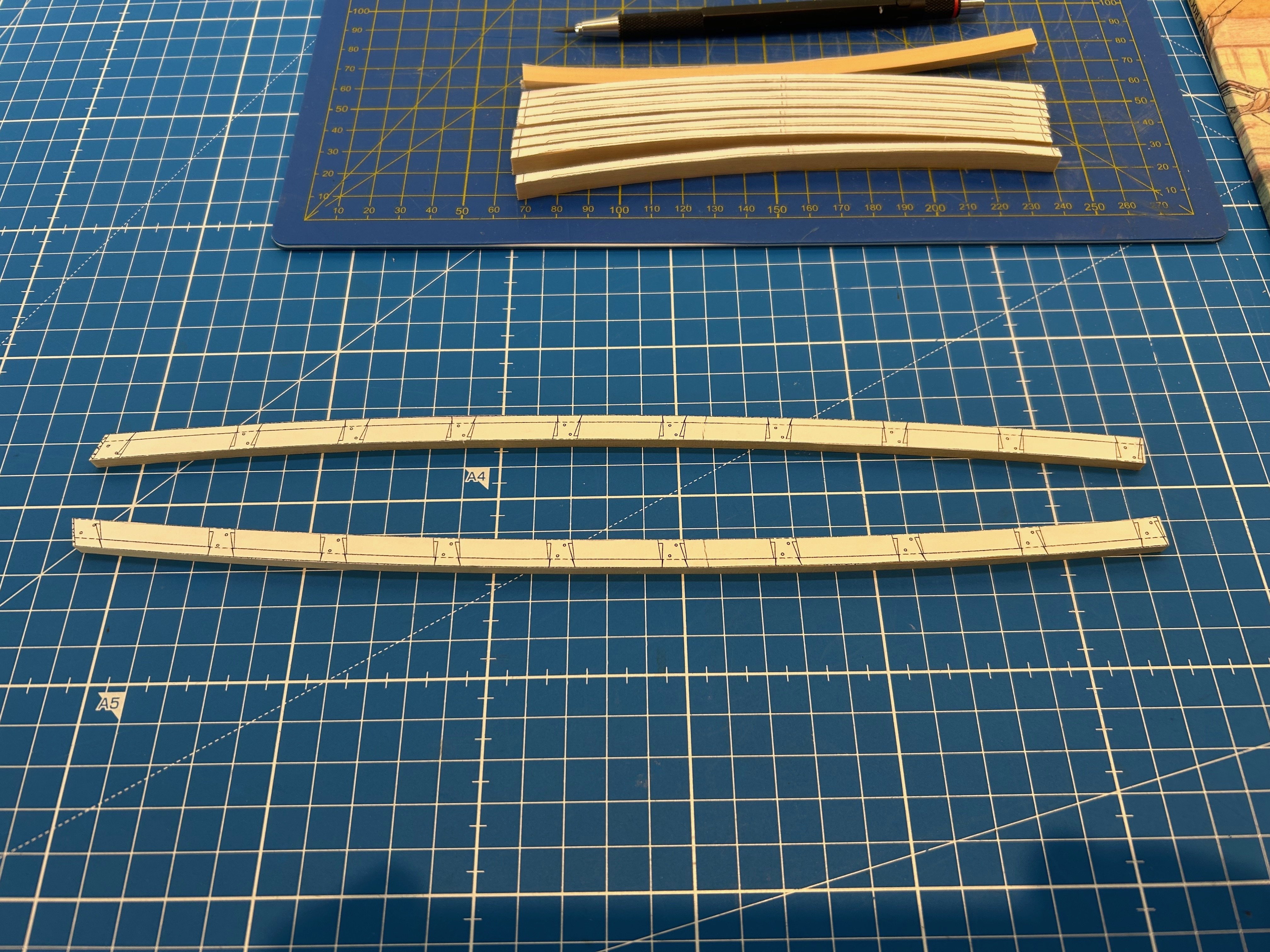

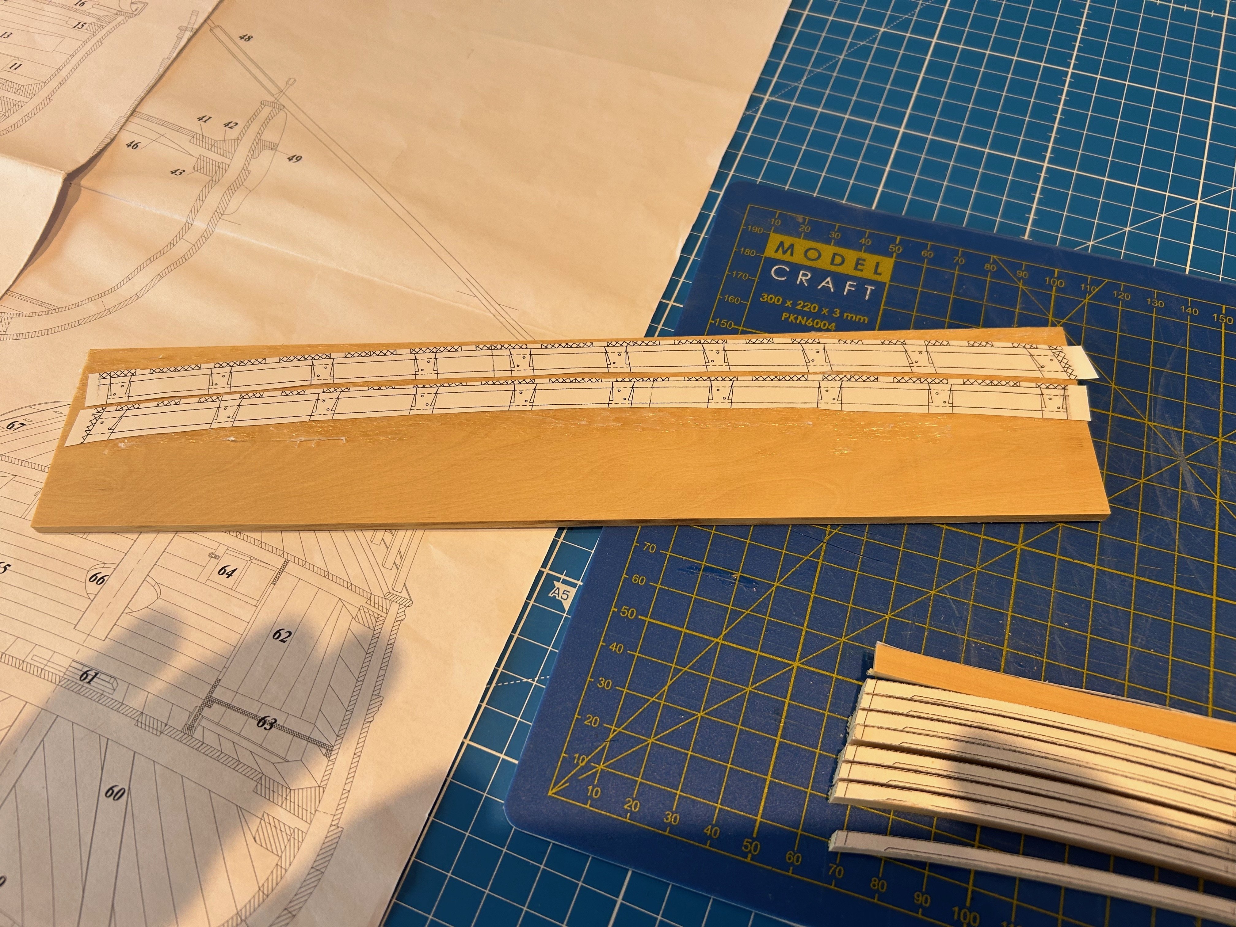

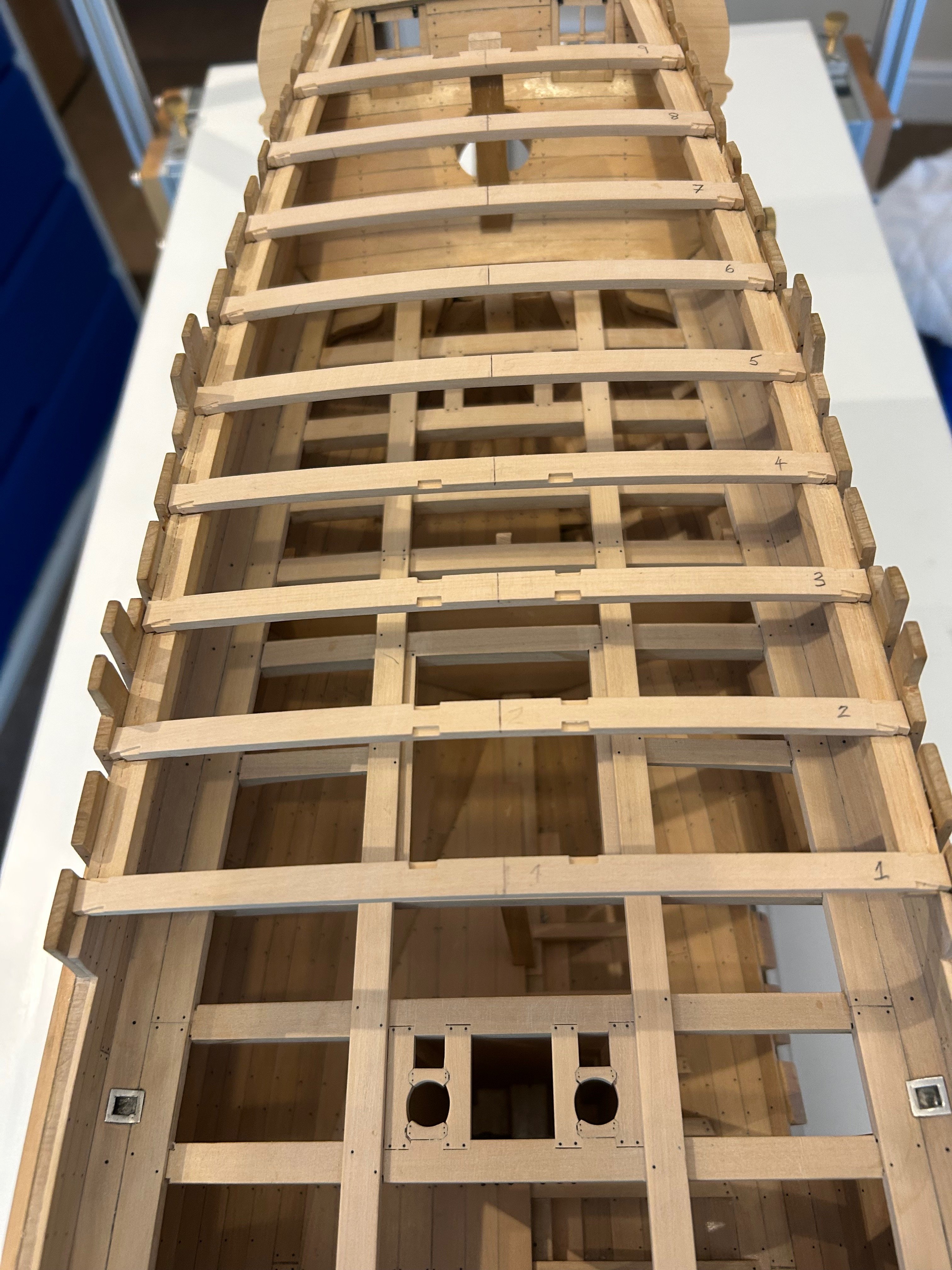

Upwards and onwards - The build continues but first I had to address a couple of problems.  I would need to lift the rear beam upwards to the correct height and the quarter deck would have to be bespoke behind the stern post.   So firstly the rear beam - Rather than remove the beam I have just made it 1.5mm thicker by adding a piece on.

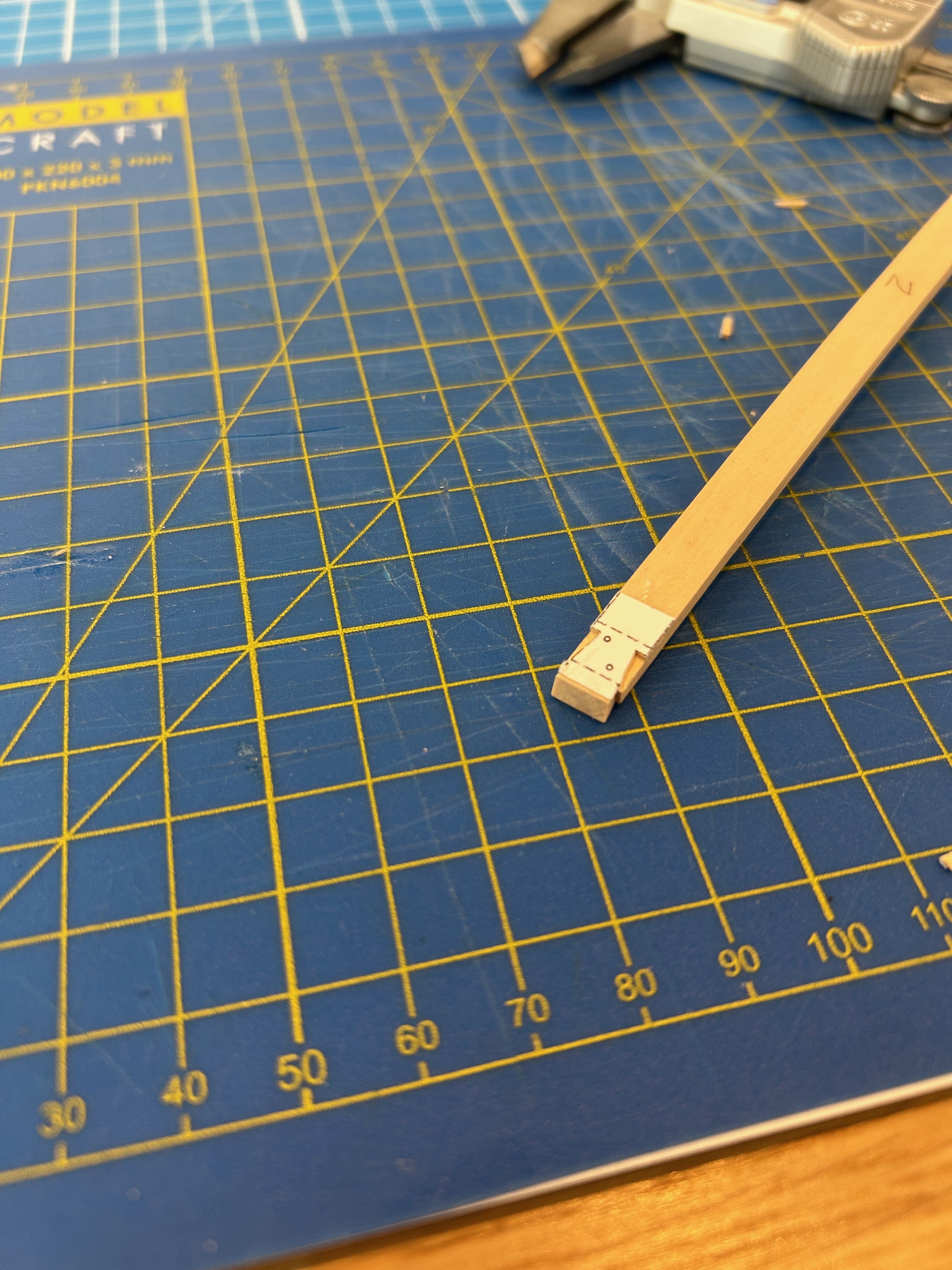

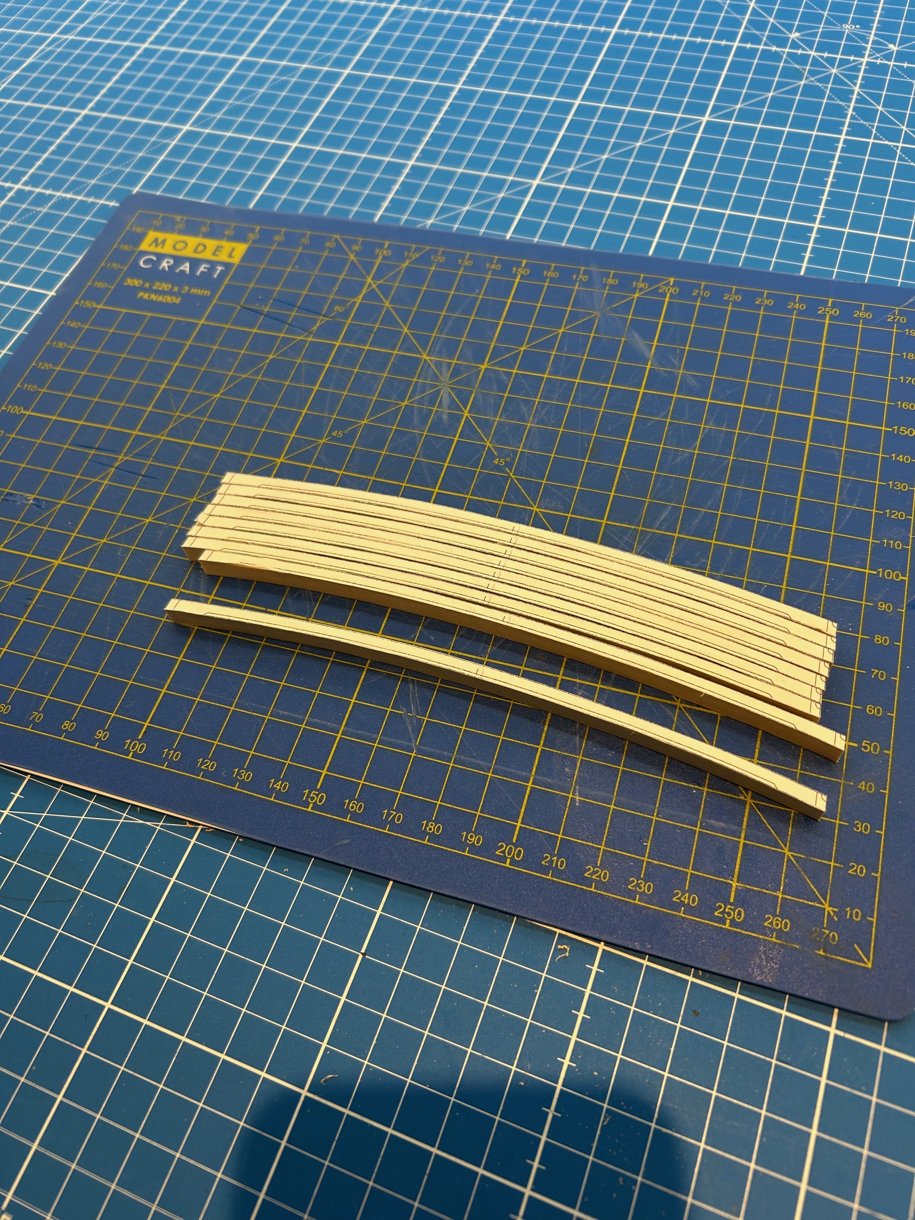

Next I made the beams  - here's a few pictures of the process that I use.
Just rough cut on the band saw

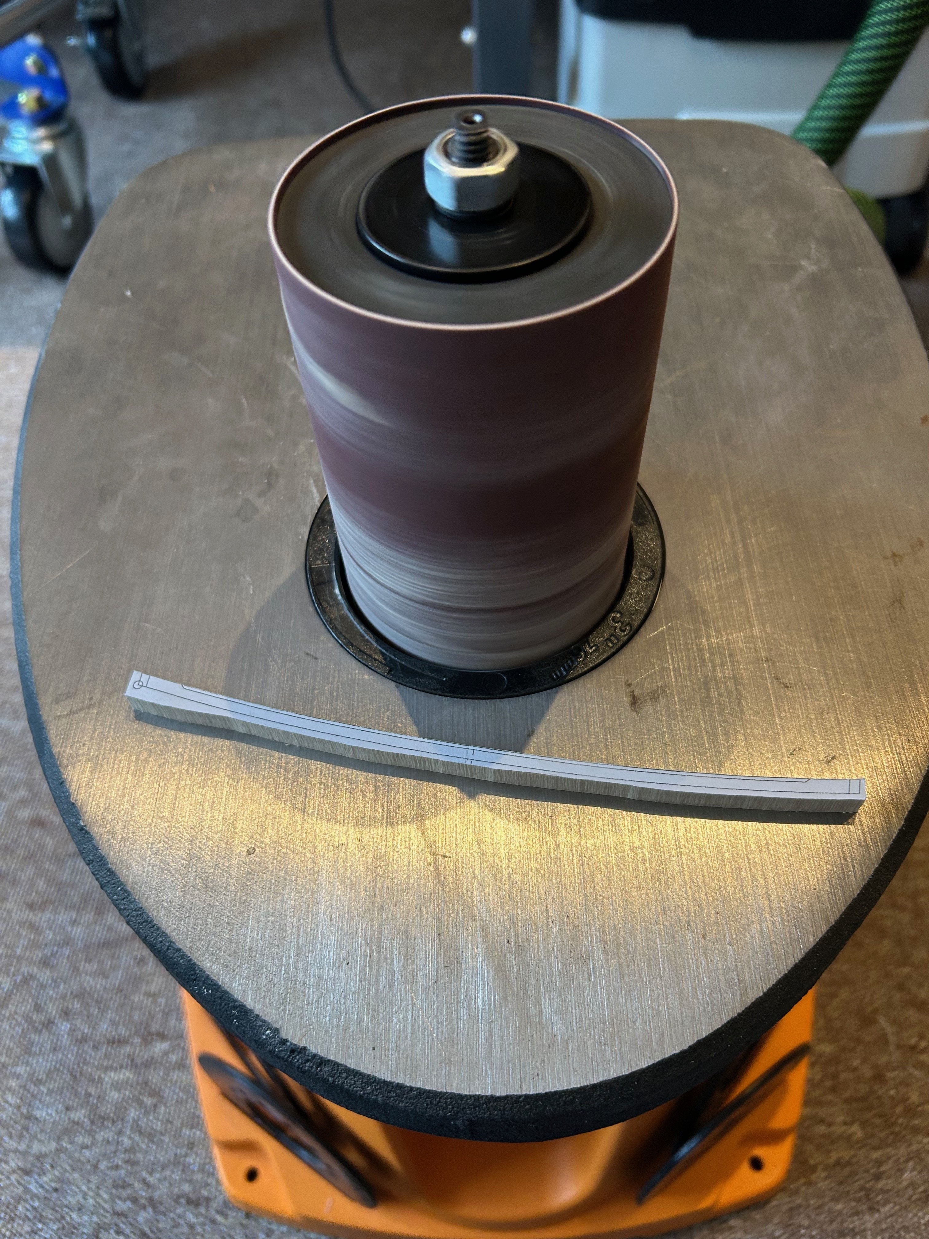

I prefer to sand the inner curve first but I'm sure it makes no difference
Then the outer

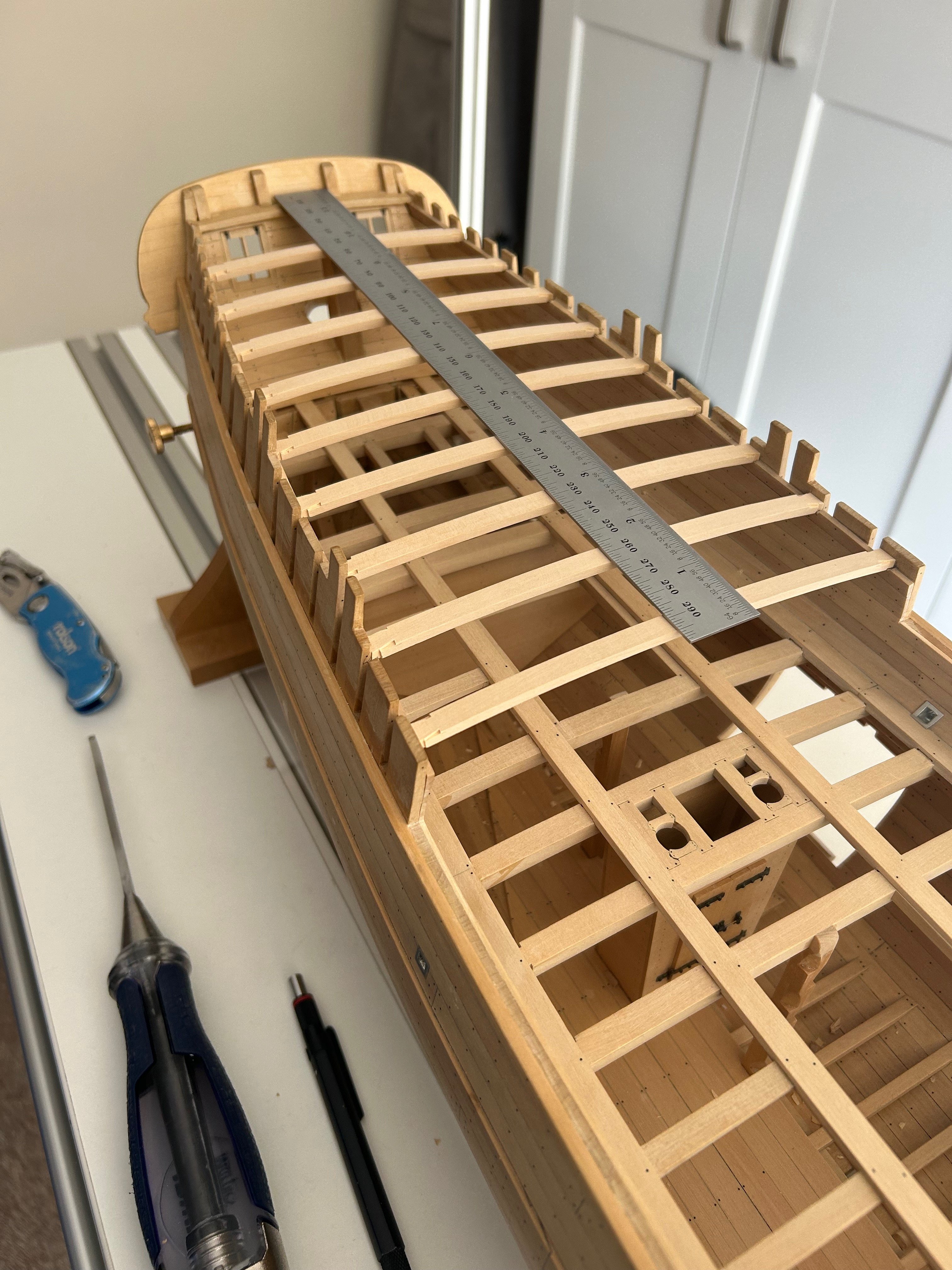

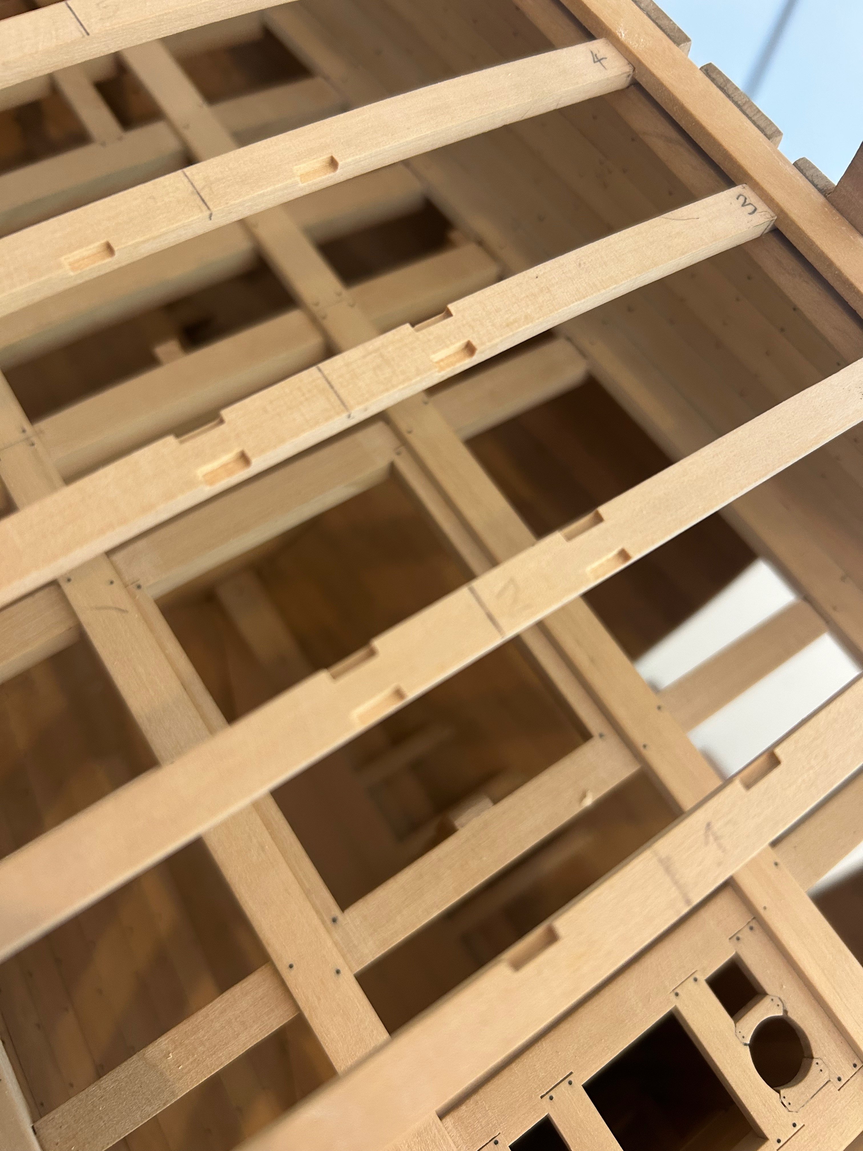

Next I cut the dovetail joints - I really like doing this part its so satisfying
Then I cut them into the clamps using a height gauge to make sure that they are at the correct height.  I also sense check the alignment with a steel rule as they must be level with the stern post.

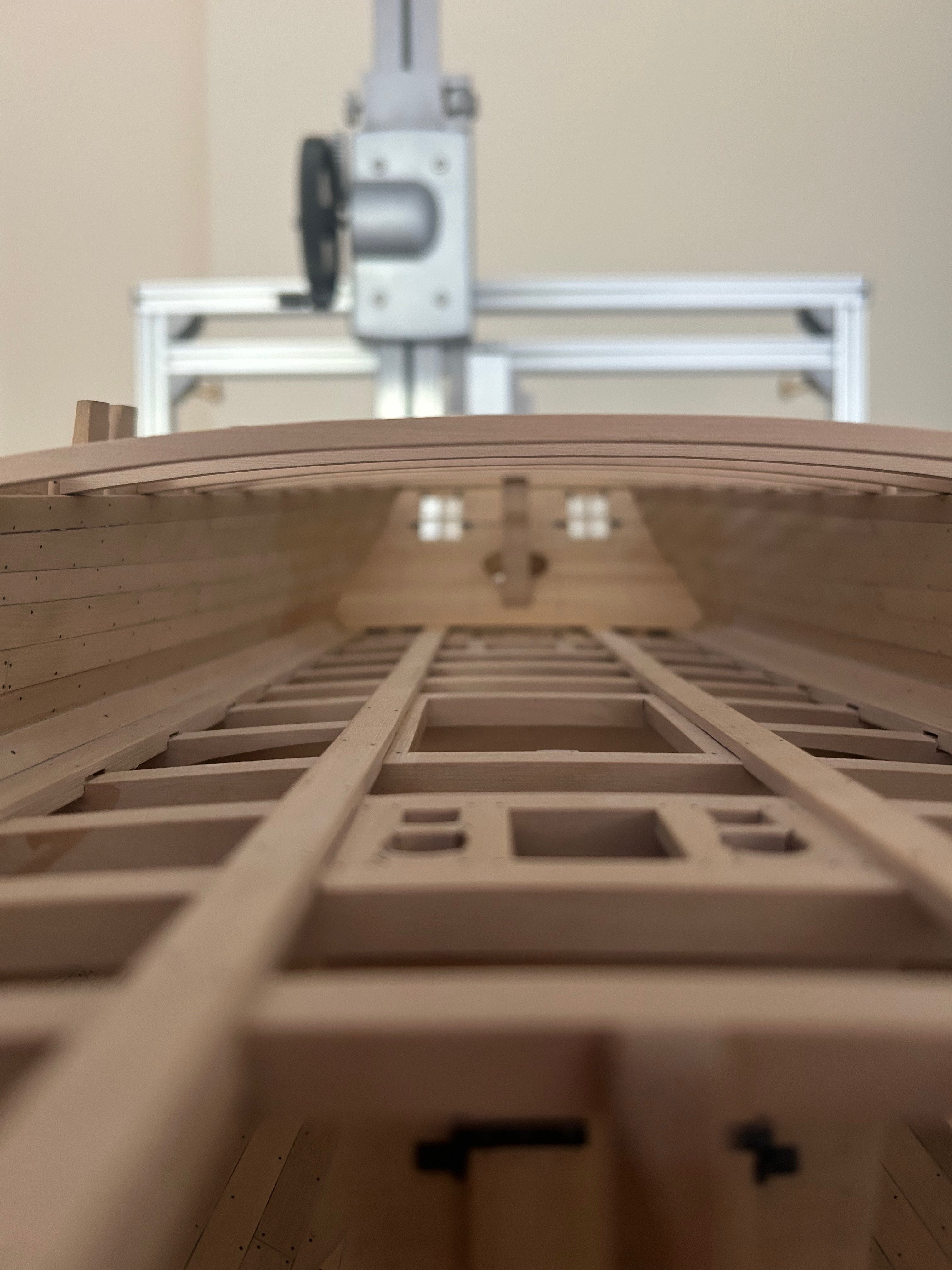

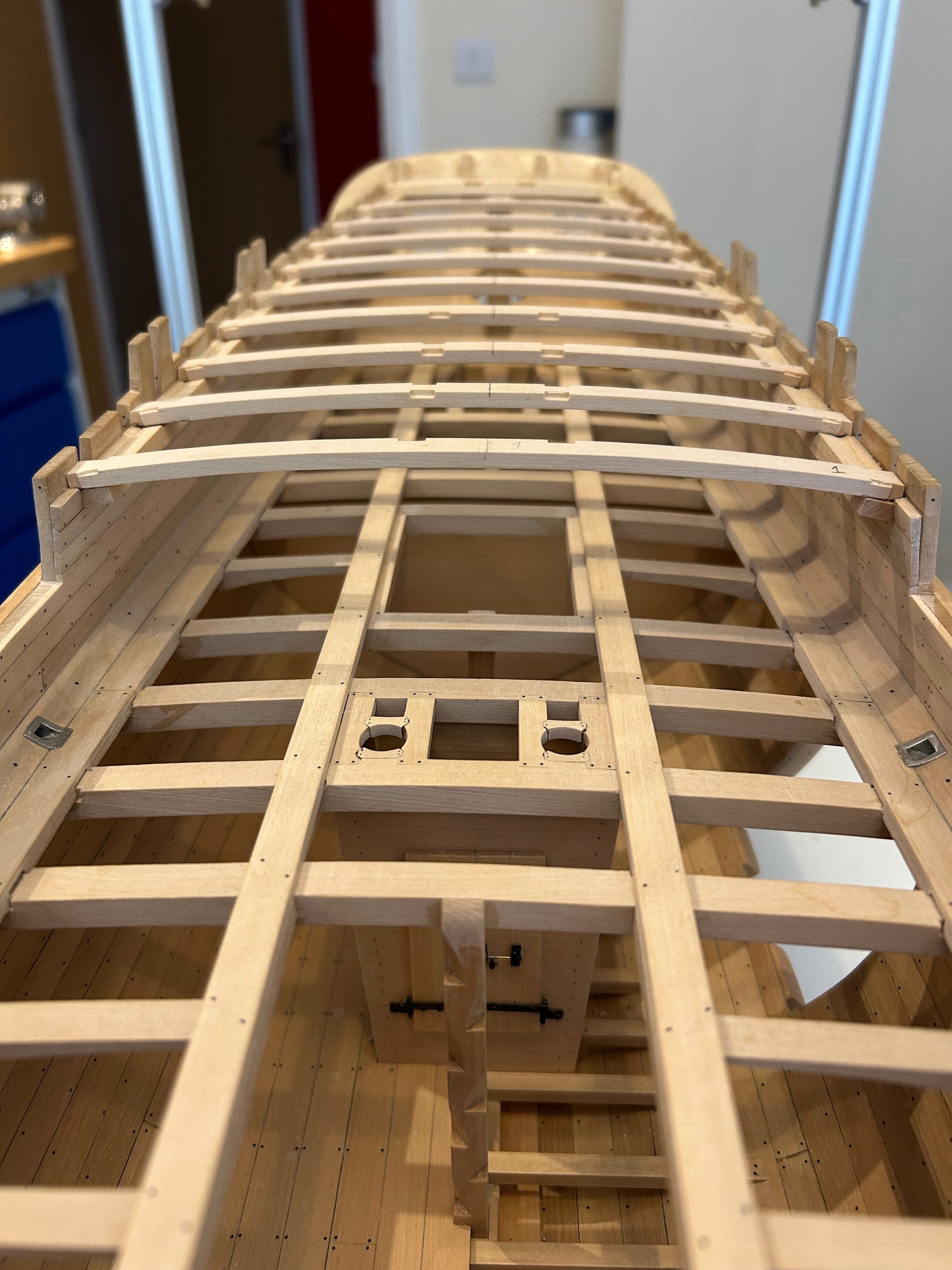

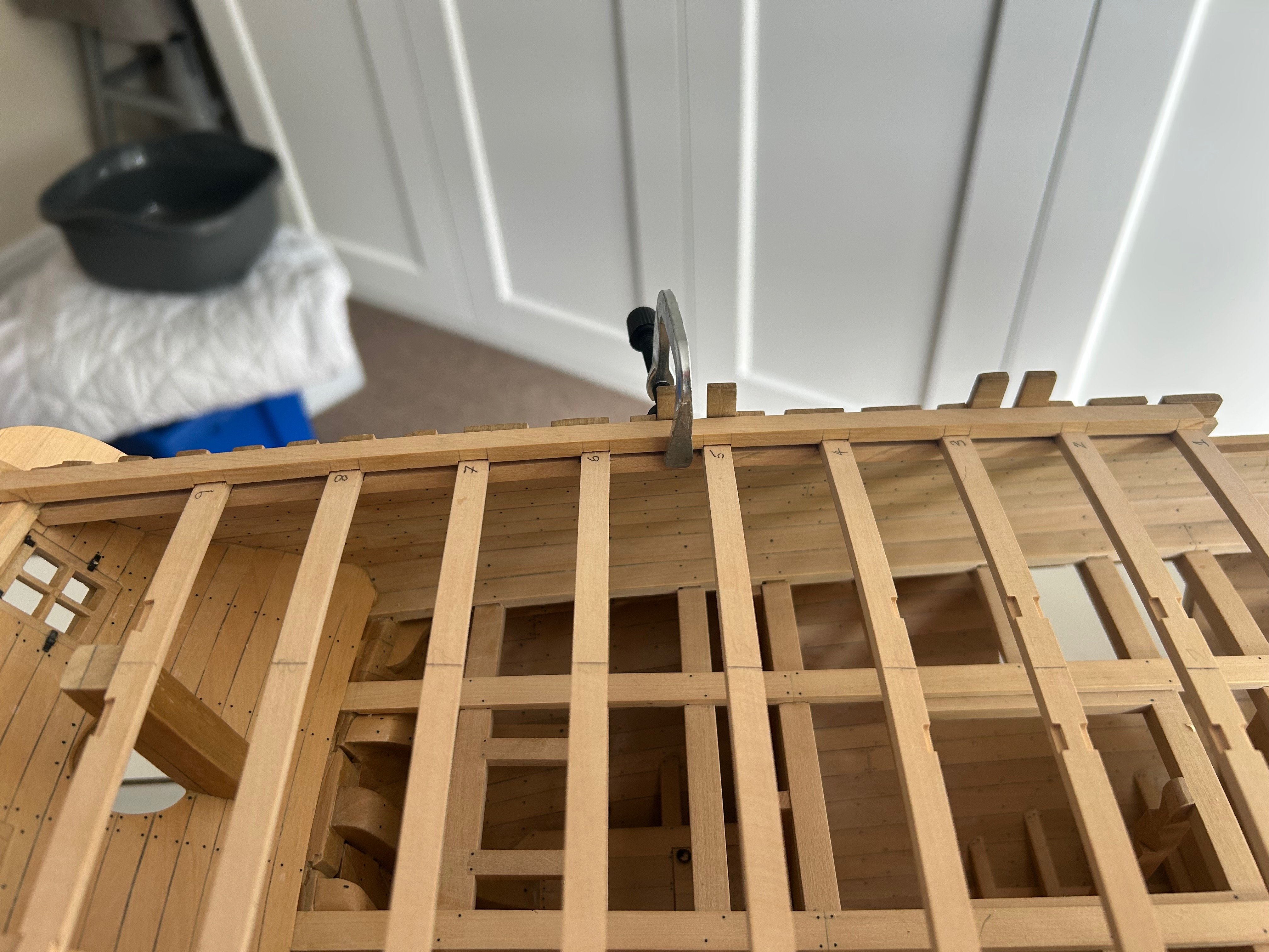

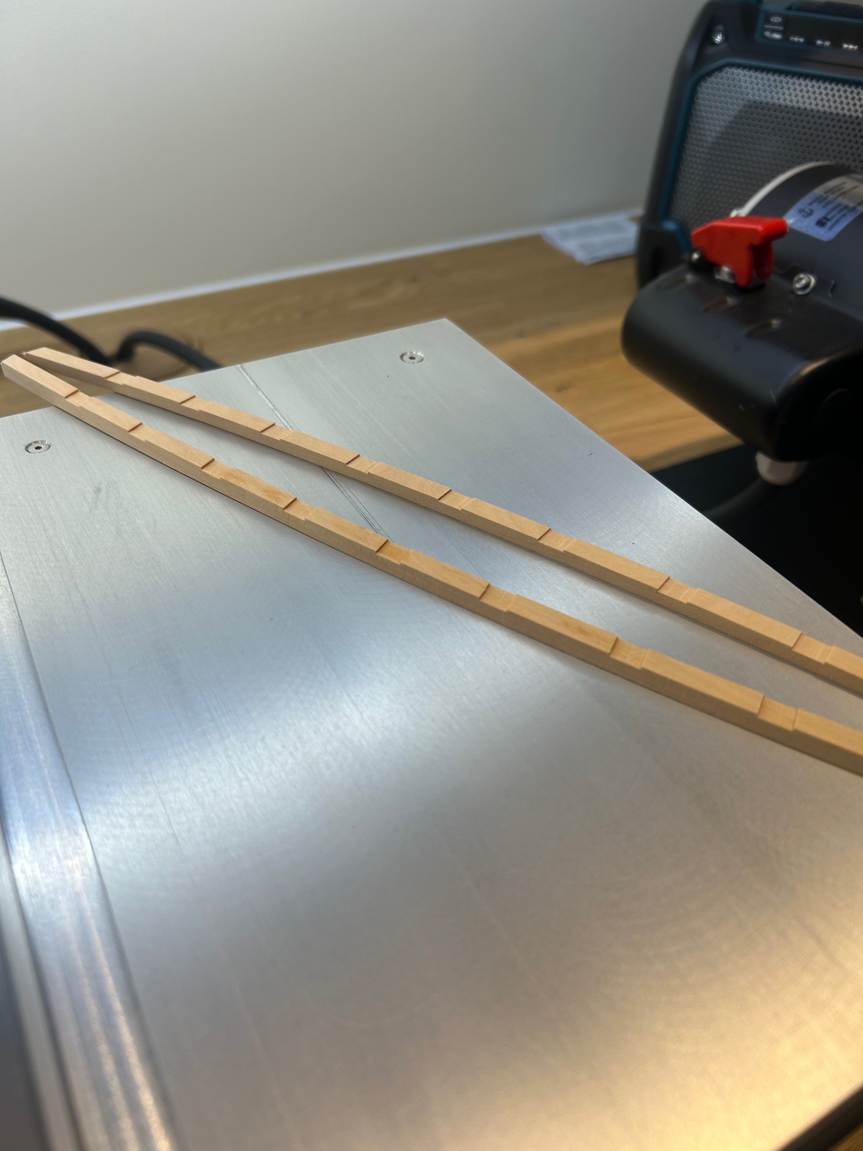

Then I made the beam supports
Finally I made the waterways which sit nicely on the level of the planksheer
So although I'm not exactly to the plans anymore I think I've pulled it back enough to get away with it.  I do have knock on issues such as the taff rail will be longer etc etc.... but I've got my head around what needs to be done.  On the positive side you are getting 5mm more ship for your buck!!!  Also stepping away sometimes is a very good thing to do!  I'm very much back into it now - A slight delay though as it's my wife's 60th birthday next week so we are off to Crete for a fortnight to celebrate.  I can now remove all of the beams and start some of the interior detail.
