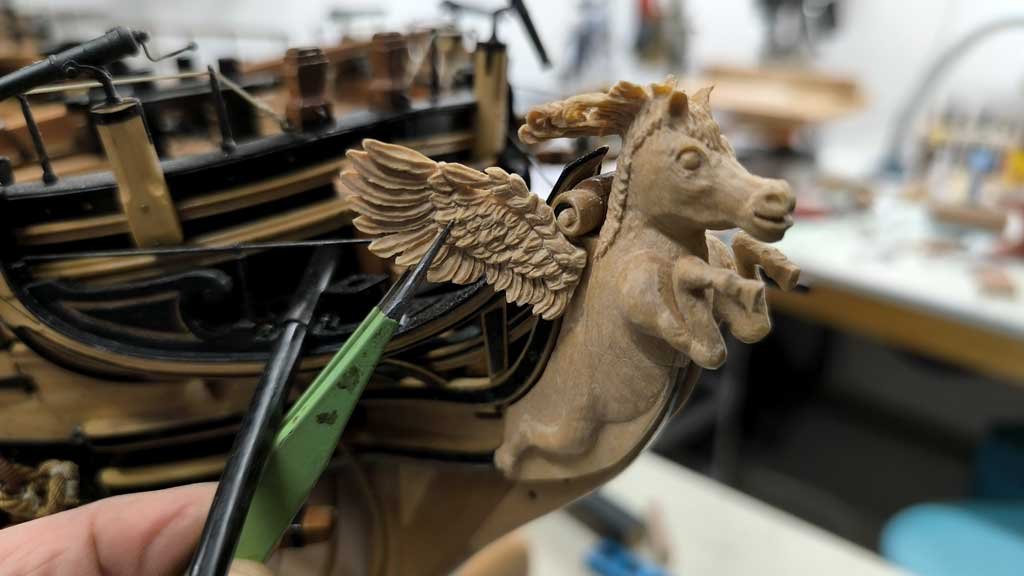

I have no doubt that your figurehead will be magnificent Giampiero. I do fear that that extended right leg will be amputated over time though. Perhaps that's why when horses rear up both fore legs usually are pulled in (see David Antscherl's pegasus below).
Greg
