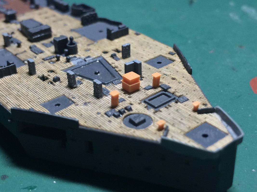

Evening all,   hope everyone's  holidays are going well   - so I decided that one days  tv and couch  was enough  so I did a wee bit more  on Hood,  there was some more  ammo lockers and vents to be added  including some rather nice resin  vents, they will  receive a few coats of paint  next.
Current builds
Completed works.
Revell  1/48  Mosquito  B IV
Eduard  1/48  Spitfire IX
Really excellent work OC.
It's a reminder of just how much detail there is in this kit and we need to remember that the pictures are 8 to 10 times bigger than in real life.
Amazing.
How do you intend painting the resin parts now they're fitted on the wood deck? By hand?
Amazing.
Thank you for the very nice comments   -  yep  I will get out my tiny brushes  to  paint  the small details, will probably do the same with the PE railings that still need to go on, as I can not airbrush them when on  and think the  paint will  be  dameged  from the handling  with tweezers  etc.

Evening all,  this evening was  taken up with  mini brush painting  of the boat deck  details I added  yesterday.
OC.
Current builds
Completed works.
11 minutes ago, king derelict said:
Very neat painting OC. Its starting to look busy. Its going to be great.
Alan
Thank you kindly Alan   - still have the rails to go on  that level  - they will be primed  then  painted  (again both layers by brush)
