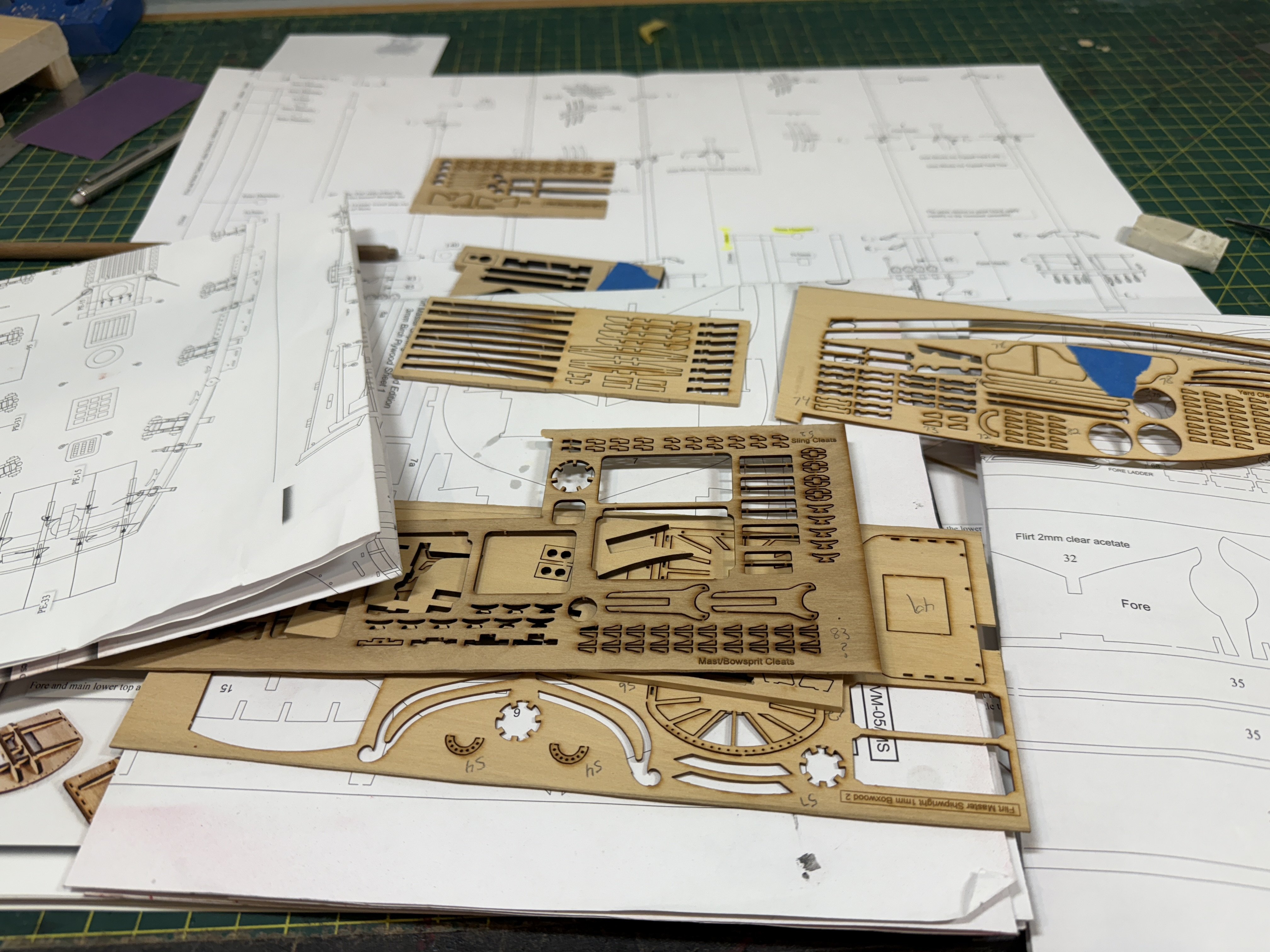

On 8/9/2021 at 6:16 PM, glbarlow said:
I added filler parts 19 and 20 to the bow area, and thinking I knew what I was doing without consulting the instructions I added part 21 next to those. However part 21 is for the stern area, not the bow. It won’t hurt anything to be there and in fact probably helps, so I just fabricated part “21b” from the bulkhead sheet scrap and added it to the stern, problem solved.
OMG, I just did the very same thing! So I'll be a scratch making a part "21b" tomorrow too. This is too funny! 🤣

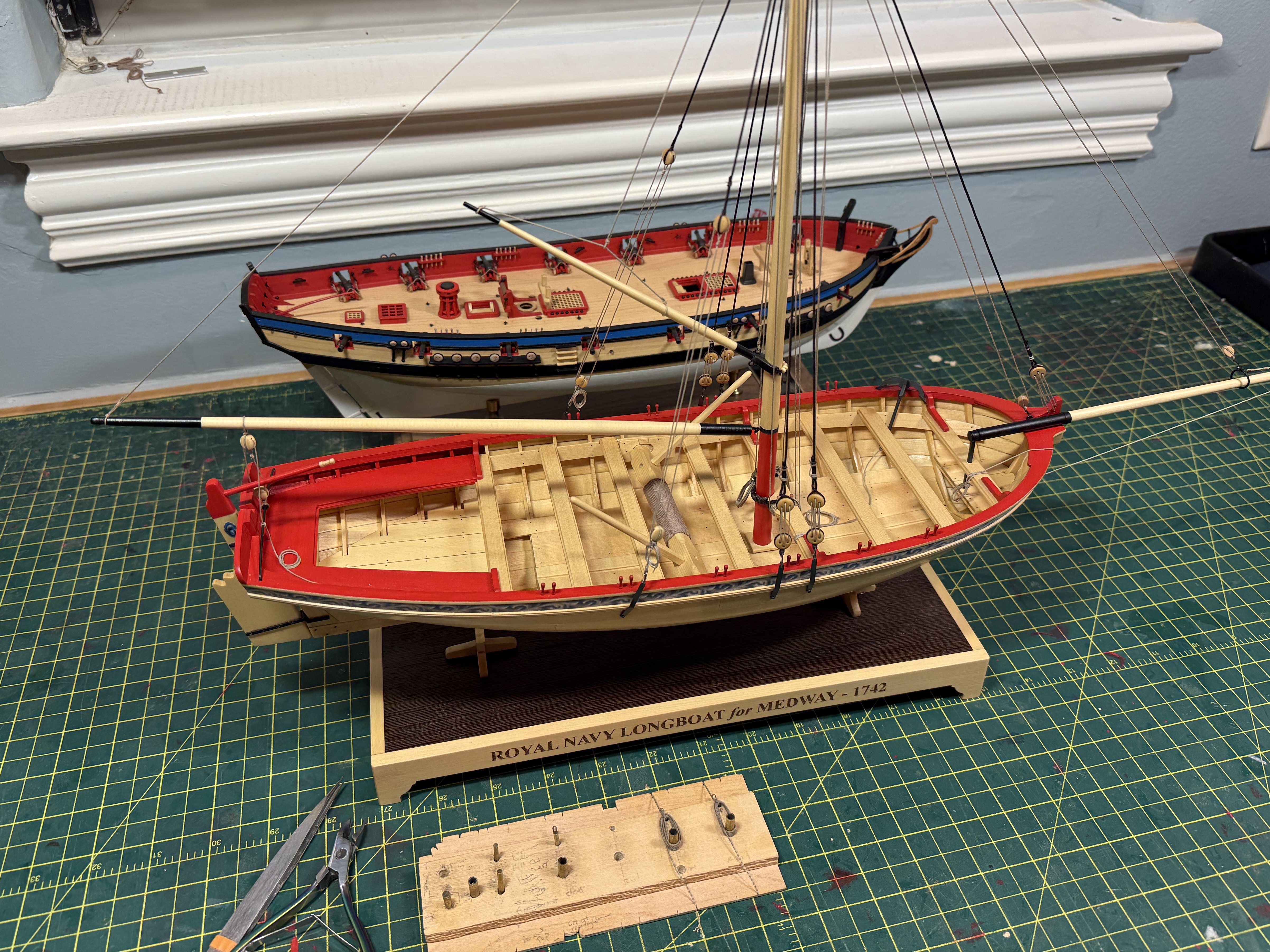

Turns out my Flirt did gather dust for a long while. Following the 3 years to build Winchelsea, then a few months with the Royal Barge and with just a few extra rope coils for my Medway Long Boat it’s time to revisit Flirt for some masting and rigging fun.
Interesting to see the difference between 1:26 and 1:64 scale.

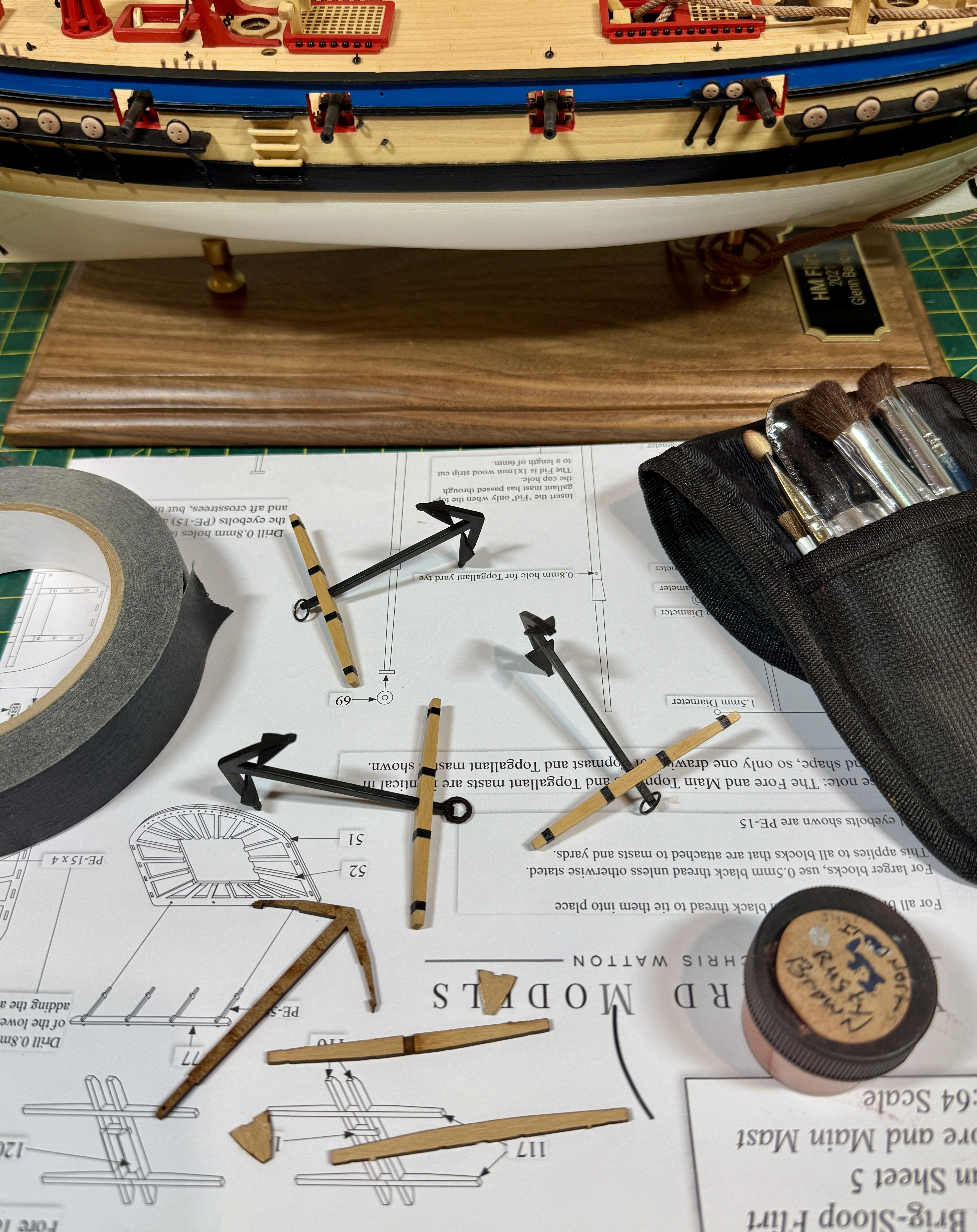

A slow re-start, beginning with the anchors.
Amazing how 5 pieces of wood can be turned into realistic anchors with Admiral Ironwood Black paint and Rusting Red weathering powder.  I made the rings with 22 gauge wire, going for a larger ring than the PE one supplied with the kit. I did the puddling on one, but not sure I like it so held off on the other two for now.  Flat black masking tape was used instead of the traditional black card, I find it a better look. It’s not going anywhere after applying WOP to the stocks. Not very exciting I realize, but it’s a start.
The box has been on my shelf four years now waiting for this re-start.  I decided an inventory to get reacquainted was a good idea. I was once again amazed at the quality of Vanguard instructions, and especially amazed at the detail of the rigging plan sheets.
I’ve already starting shaping the masts, I also need to get back in the habit of taking photos. Since completing my Winchelsea log I’ve built both the Syren Royal Barge and Medway Long Boat, but didn’t do a log for either. As those of us who create build logs know, it’s a chore to keep up with both building and posting, hoping others find the latter useful.

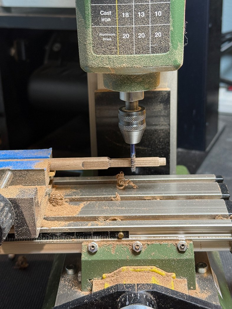

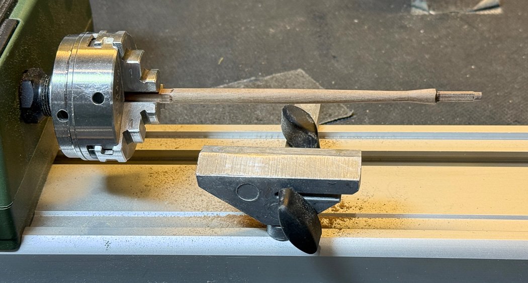

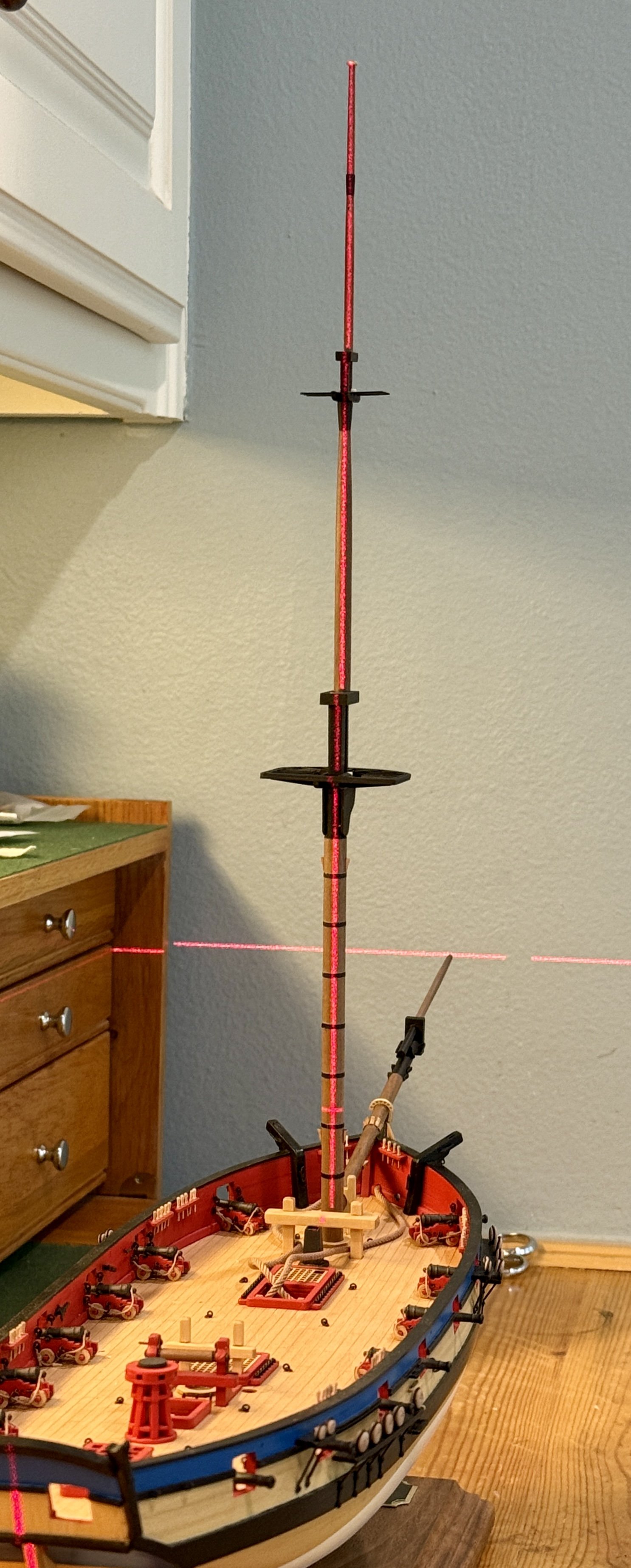

I decided to make all the sticks first, if it doesn’t work out I can always start a small fire. And because I can use the fun tools I haven’t used in a while.
I have a friend who has a mill, lathe, planer, sander, and table saw. His take up most of his garage, mine all fit in the corner of my much smaller workshop. His of course are a bit larger.
First up the mill. With Cheerful and the Long Boat I started with square stock and rounded them. I’m back to doing the opposite. I have the Limited Shipwright edition of Flirt, everything is cut from boxwood. Everything except the same old walnut dowels.
The mill makes the squaring off a fairly easy task, just have to get the measurements right. I was going for the 5x5mm required by the plans and despite my careful measurements my cuts were off. I was thinking I needed to start again until I realized I was off by 0.24mm, seems like an acceptable tolerance. These precision tools….
Because it has been 4 years and I stopped before doing this, it seemed like a good time to check the now shaped main and fore mast will mount up ok.  Good that I did, I had to pop off the mast bases, easy as I’d used PVA, and correct minor straightening issues, much easier than after the full mast is completed.  All good.
Next the lathe, an easier way to spin the dowels to create the semi-hour glass look of the tops. A log of spin-stop-measure following the plans. Even more so since the main and fore tops are identical. This photo was after the fact for the photo. I wrap whatever is in the chuck with blue masking tape to prevent marking. The Proton lathe is nice for many reasons, one is the ability to insert the dowel deep through the housing so the part being worked is closer to the chuck.
I’m enjoying my return to Flirt - thought there are still a lot more sticks to make, and the opportunity for future kindling if that doesn’t work out.
Trying to get back in the swing of writing logs. Hopefully I can make them more interesting as I proceed. Thanks for stopping by.

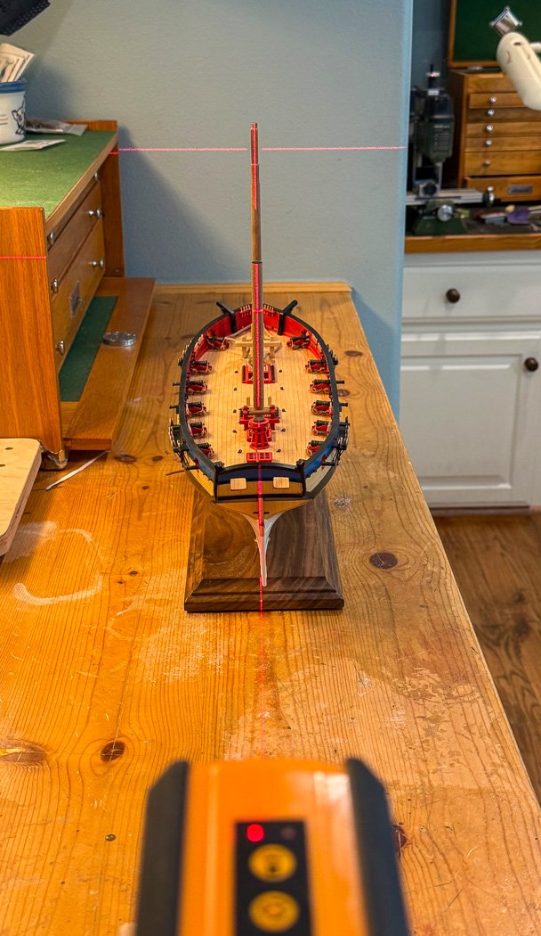

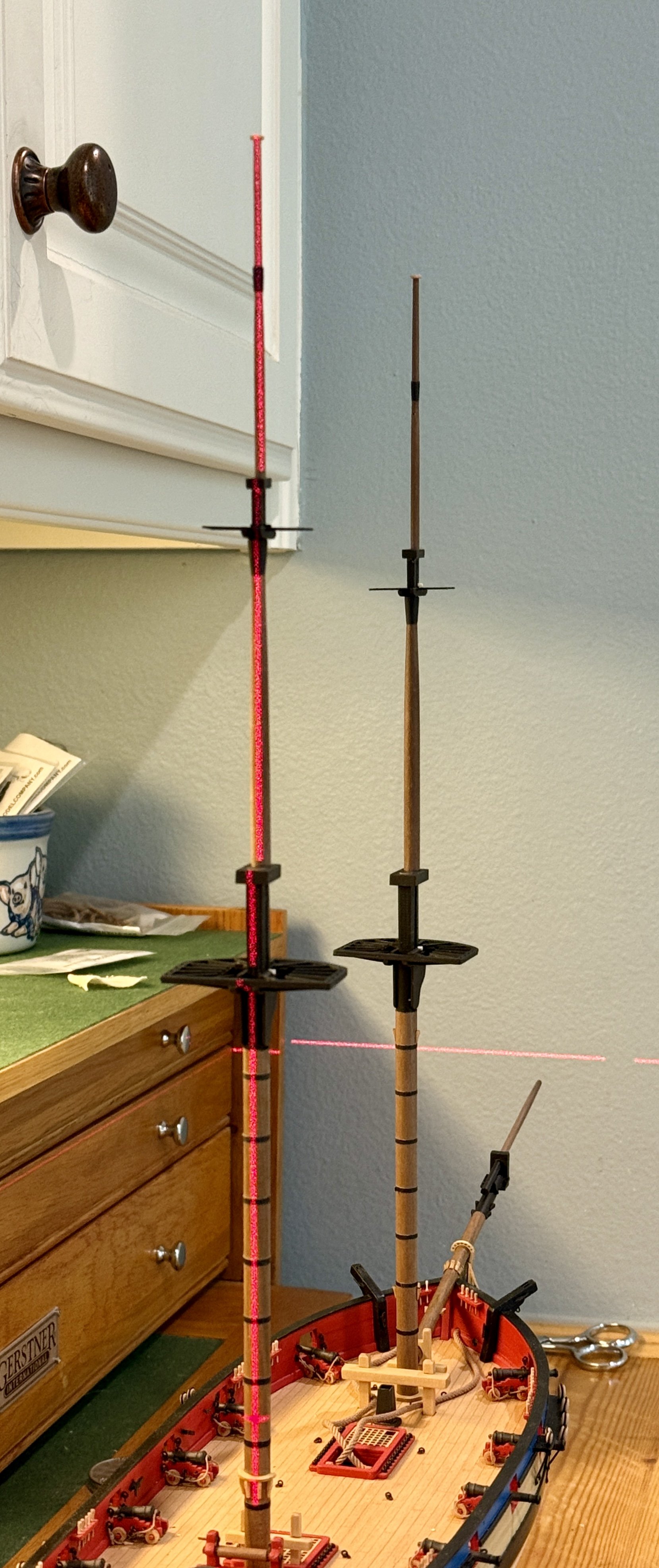

Mast Assembly
The plans for Flirt are well designed, mast assembly is simply a matter of following them. No real instructions aside from the plans are needed, nonetheless Chris and James provide nice photos and a few hints in the manual for referral and maybe a little positive affirmation. I couldn’t add anything so I didn’t repeat them here.
The real challenge is getting three masts with their accompanying platforms stacked up in a straight and level line. That takes some patience, time, and a great deal of care in the fitting. The laser level is invaluable for this process. I glued and leveled each mast one level at a time from bottom up, waiting for the glue to set before the next was added. While I used CA in some of the subassembly, I used Titebond for quick setting with enough time to twist and turn for stacking the masts.

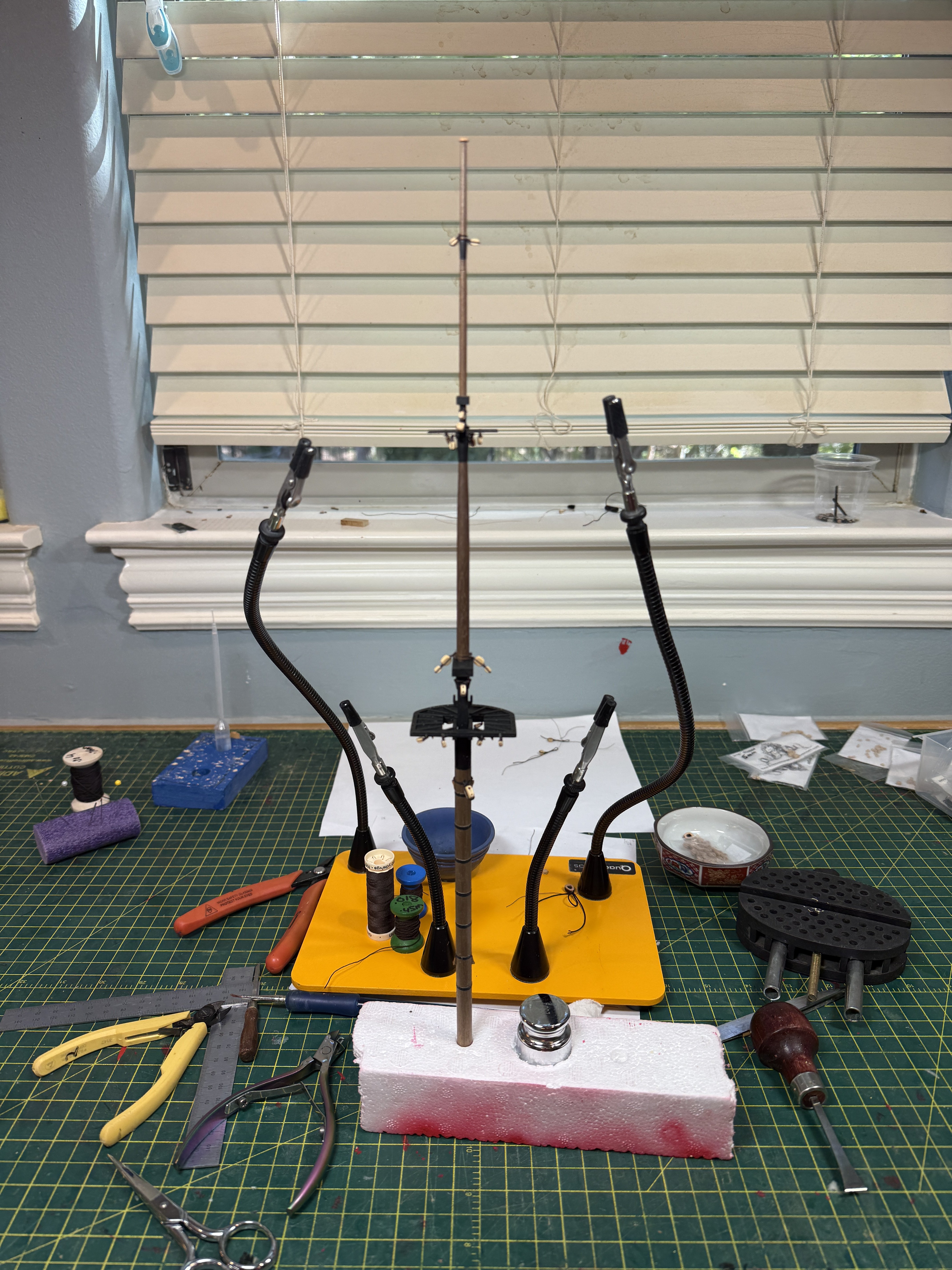

Plugging along.  I’ve now completed rigging blocks both masts and bowsprit off the ship, there are 22 on the foremast alone. After three years on Winchelsea and then the 1:26 scale Long boat I’d lost the skill of repeatedly rigging 3mm blocks at 1:64. I’m amazed at how many different tools I use to do them. I know I’d be lost without this helping hands stand.
Moving on to rigging on the ship starting with the bowsprit. Just discovered the boomkins are needed for later rigging, I didn’t add them when building the ship, adding them now should be fun…

Yeah I purchased that on your recommendation in one of your many logs. By far one of the most useful purchases I have made. And great idea with the styrofoam to stabilize/hold the mast. I’ll have to utilize that next time!
Johnathon
Current Build: Lady Nelson
Completed Build: NRG Half-Hull Planking Project
The counter sunk weight kept it from tipping over. Simple contraption but it has been useful.

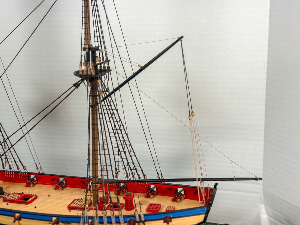

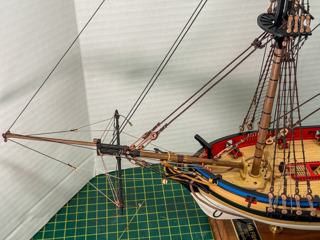

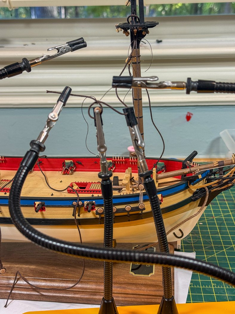

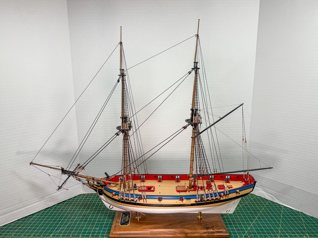

t’s been a long while since I posted. Mostly because there isn’t much new I can offer on rigging. However I didn’t want to abandon a log on such a nice Vanguard model, so here’s a bit of an update:
The standing rigging is complete other than the crows feet, not sure I’m going to add them.
Once again, I do like my quad hands, really not sure what I’d do without them. All sorts of angles and height I can reach, not to mention a steady platform for tying the endless amount of block and rope combinations. I’m using all Syren rope, great stuff. I’m also using my leftover actual wood Syren blocks, hopefully I have enough to finish.
Nothing as exciting as the meditative peace achieved by the tying of clove hitch after clove hitch. Long ago I adopted the method of both using scaled grid templates (easily made with Excel) behind the shrouds each marked for every 10th and 5th lines. I tie the 10 marks first then the 5 then alternating the remainder in between. All finished off with watered down PVA brushed lightly over each knot.
I sorta like the rigging process one minute and want to toss the whole model the next. It is a challenge to work in ever tighter space, especially at 1:64, keeping the run of the lines straight and not crossing each other incorrectly. Didn’t take any photos of the process, so here’s Flirt with the standing rigging complete, against the most basic of backdrops.
As I’ve said earlier in this log and others,Vanguard makes a great model including this one. In my opining there is no better 1:64 model on the market than Vanguard, everything else is a distant second.
Thanks for stoping by. Merry Christmas to all.
