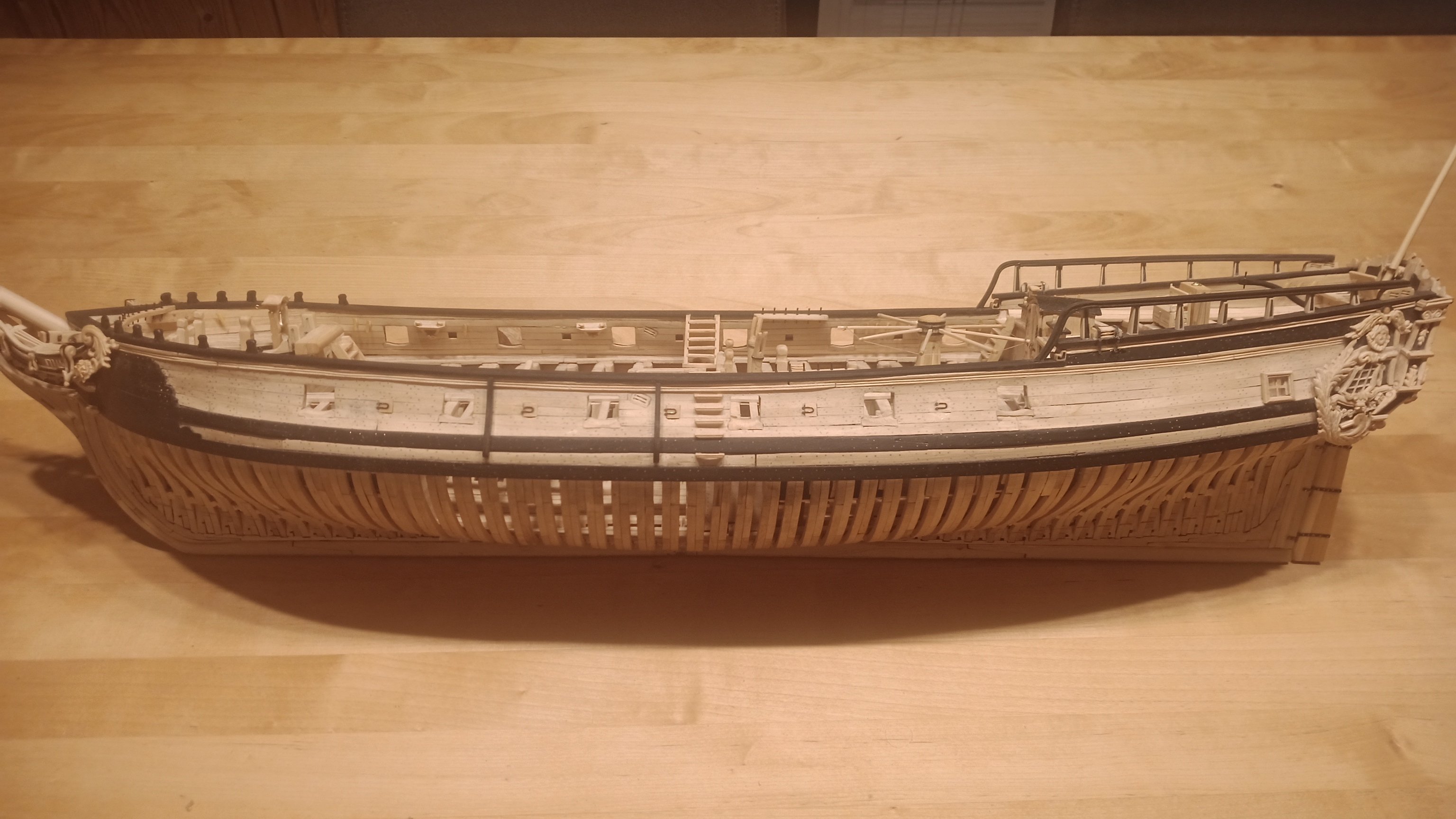

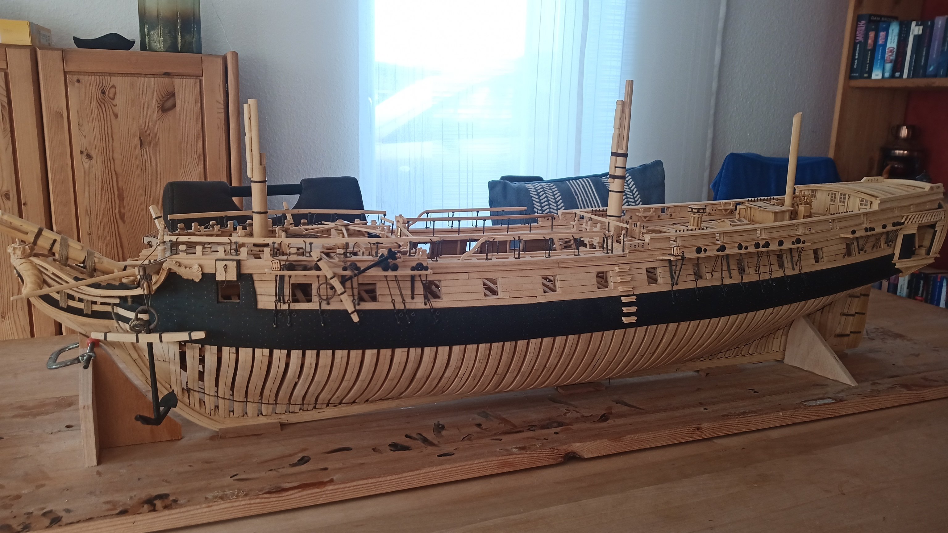

Because the ships sail better then, they are built very large, which led to a lack of space in my house. So, some time ago, I started building static models. My first project was the French frigate "La Vénus" in 1:48 scale.
I'm currently working on the small French corvette "L'Anémone," based on the plans of Gérard Delacroix's "L'Amerante," also in 1:48 scale. It will certainly be interesting to put the two ships side by side and compare their sizes.

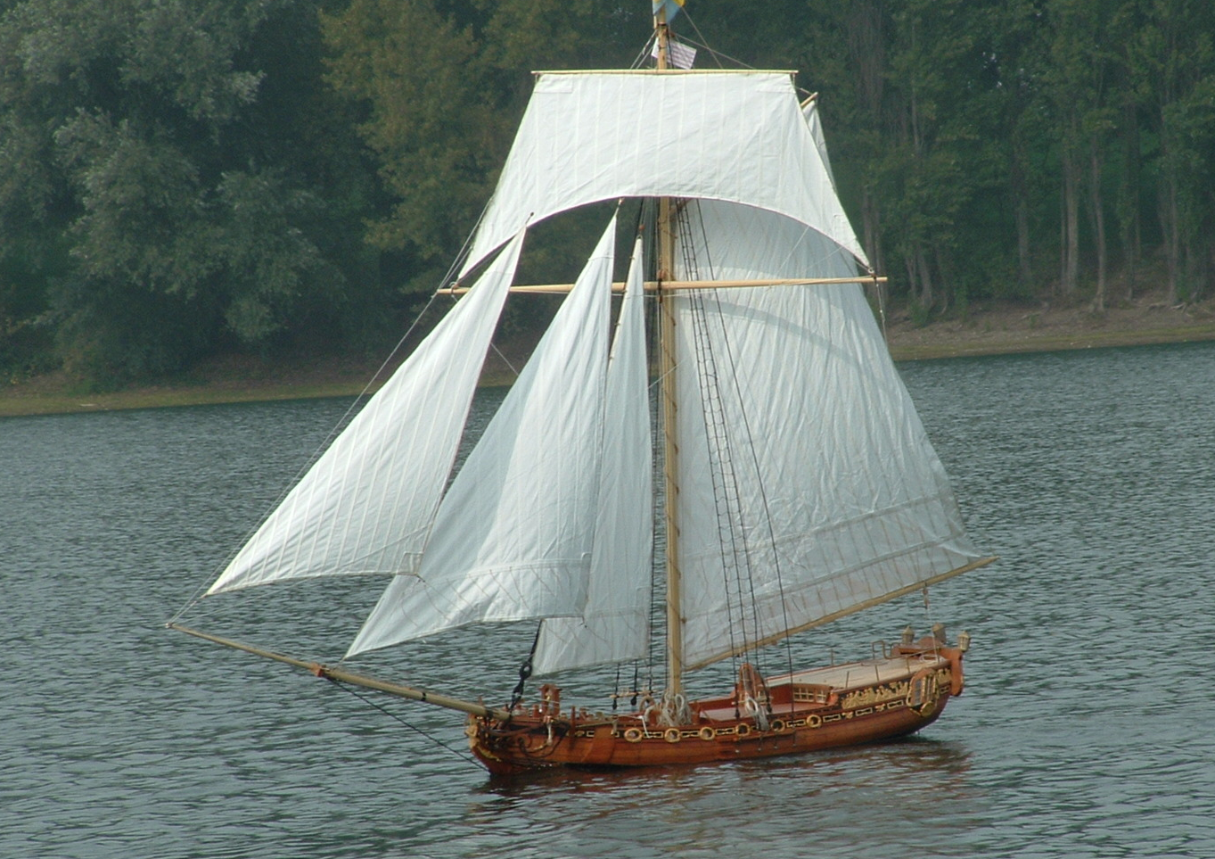

Swedish Scooner 1768 from Chapman (ANM Page 50 Pl. XLII No. 4)

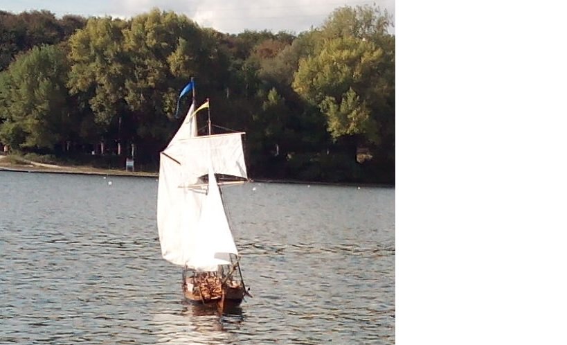

Swedish Yacht 1768 from Chapman (ANM Page 52 Plate XLIV No. 3)

La Vénus
L'Anémone

How did you waterproof your models?
Thomas
Hello Thomas
Thanks for your interest.
Regarding your question:
After some experimentation with different varnishes, I achieved very satisfactory results with a polyurethane resin, which can be purchased in Germany under the trade name G4 from Voss Chemie. When applied in several coats with decreasing dilution, it provides good protection against water. It's transparent, so you can still clearly see the wood structure. The only drawback is that it has a very high shine.
This can be remedied by applying a coat of matte stair varnish after the actual varnish has cured. This should also be based on polyurethane resin.
A fiberglass mat was laminated on the inside with epoxy resin.

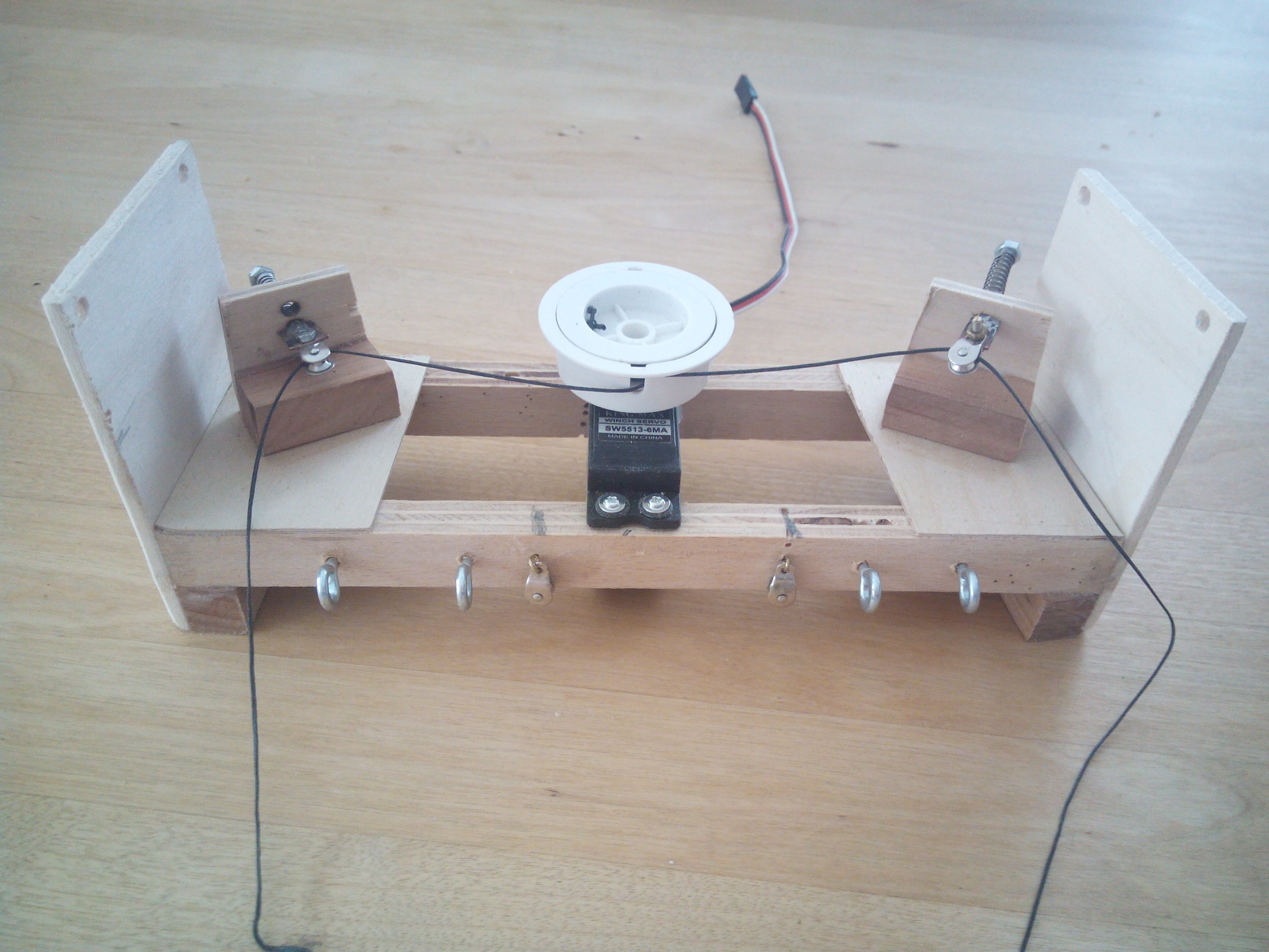

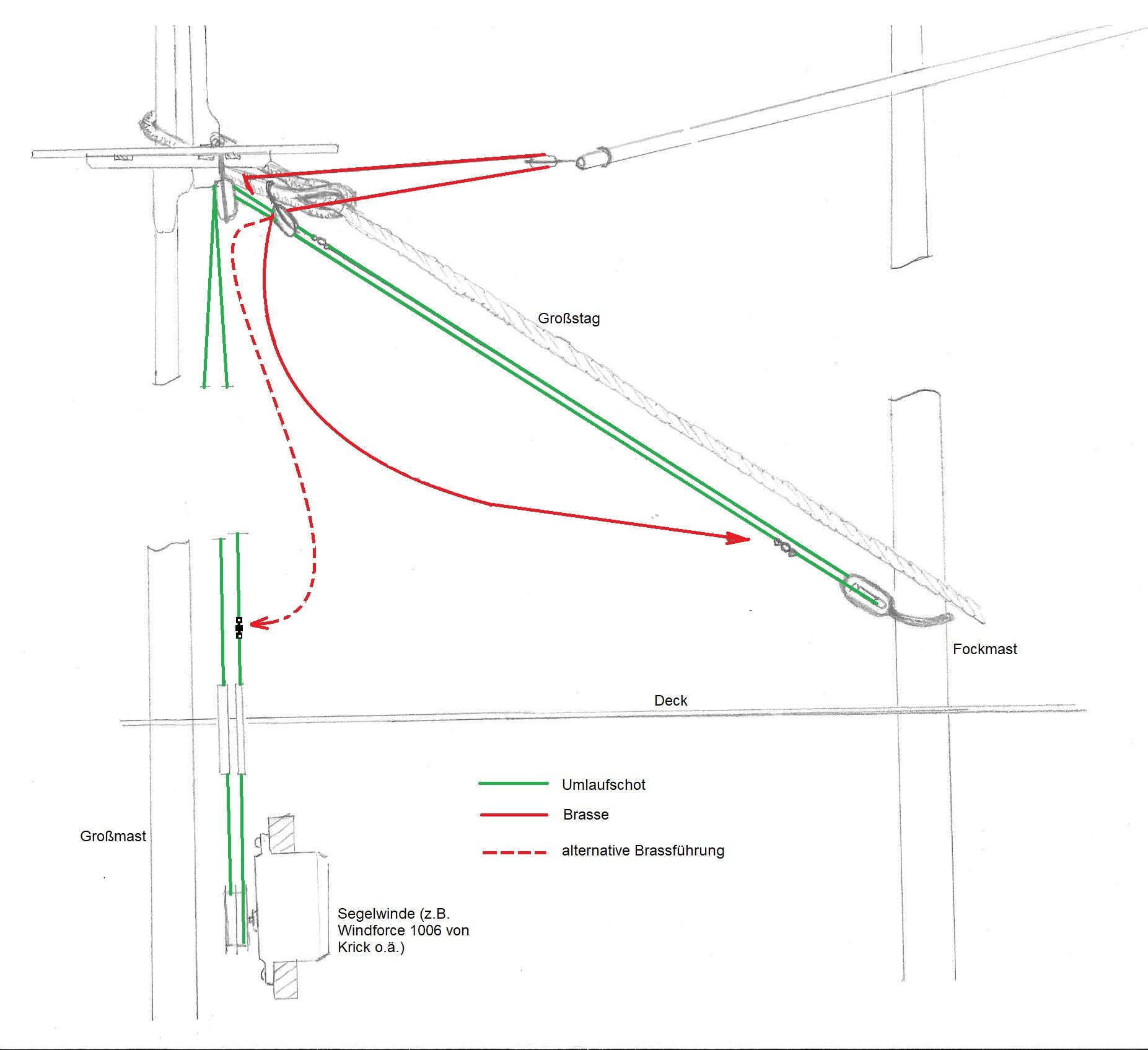

I have a preference for boats with square sails. This presents a problem. If the braces are shortened on one side, the constantly changing angles cause the brace on the other side to hang loose. To prevent wooling, I use a system developed by a member of the mini-sail group.
The principle is a wraparound sheet to which the braces are tied. This circulating sheet can be installed below deck, but there are other options, as the drawing shows.
The drawing shows the steering of the sails on the foremast of the Chapman frigate.
How exactly the technology is installed depends very much on the options offered by the model.

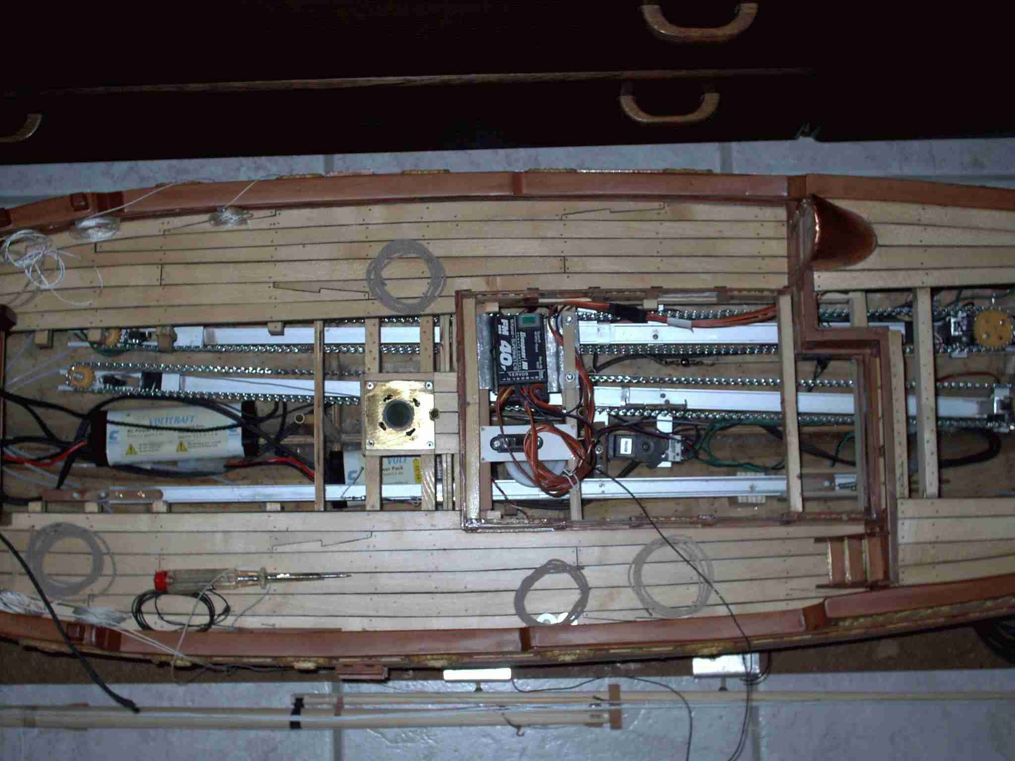

This picture shows the technology in the Chapman yacht.

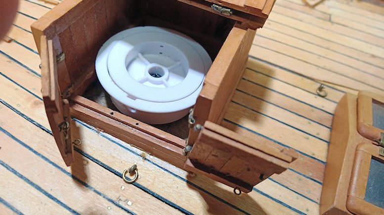

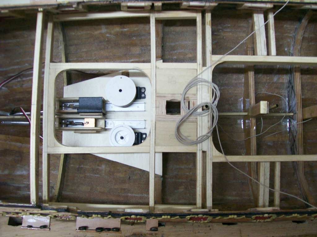

The following pictures show the technology installation on the cutter "Le Cerf." The sail winch is installed in the companionway, and the circulating sheet is led forward and over the deck through small holes (not yet installed on this photo). All braces are led from the bowsprit onto the circulating sheet. The foresails and mainsail have their own winches.
Different models, different solutions.

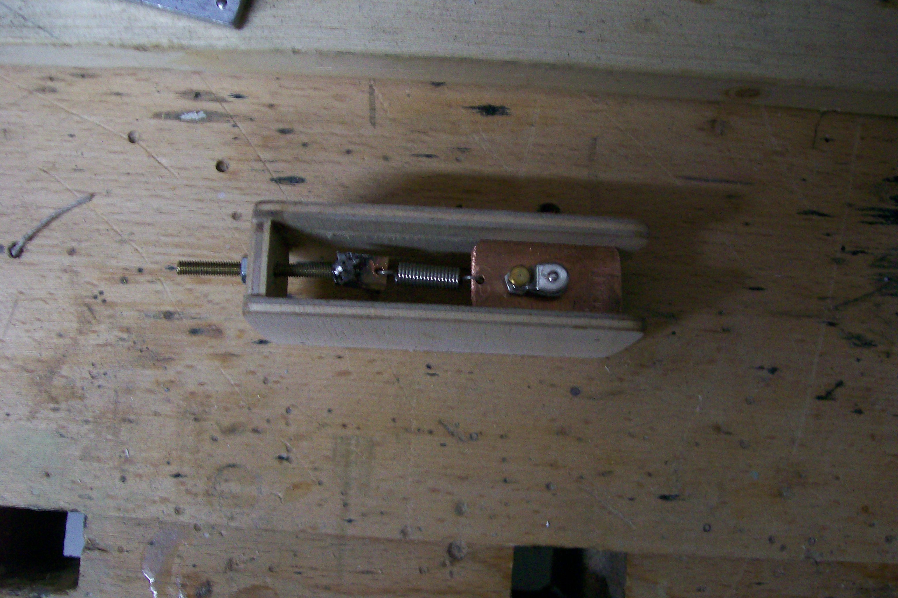

The circulating sheet has a winch with a double spool. When one spool is wound, the other is unwound. Since the circulating sheet is wound onto the spools in multiple layers, the length pulled out changes with each revolution. To compensate for this, it is important to equip a block with a spring at the turn point to keep the sheet taut at all times.
This could look something like this:
Not all systems always work flawlessly. It has proven advantageous to run the circulating sheet above the deck. This provides easy access and makes repairs easier.
