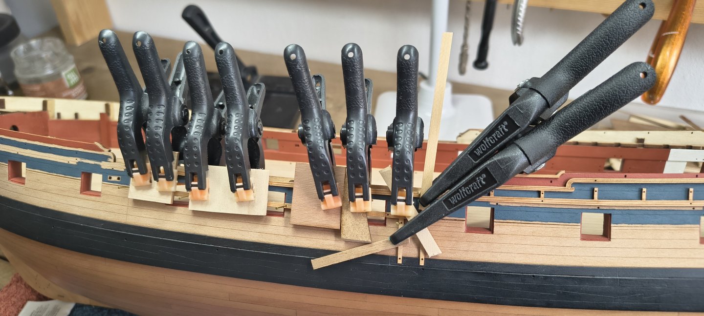

Interesting clamps.  Are they still available, I could not find them on the Wolfcraft web site.

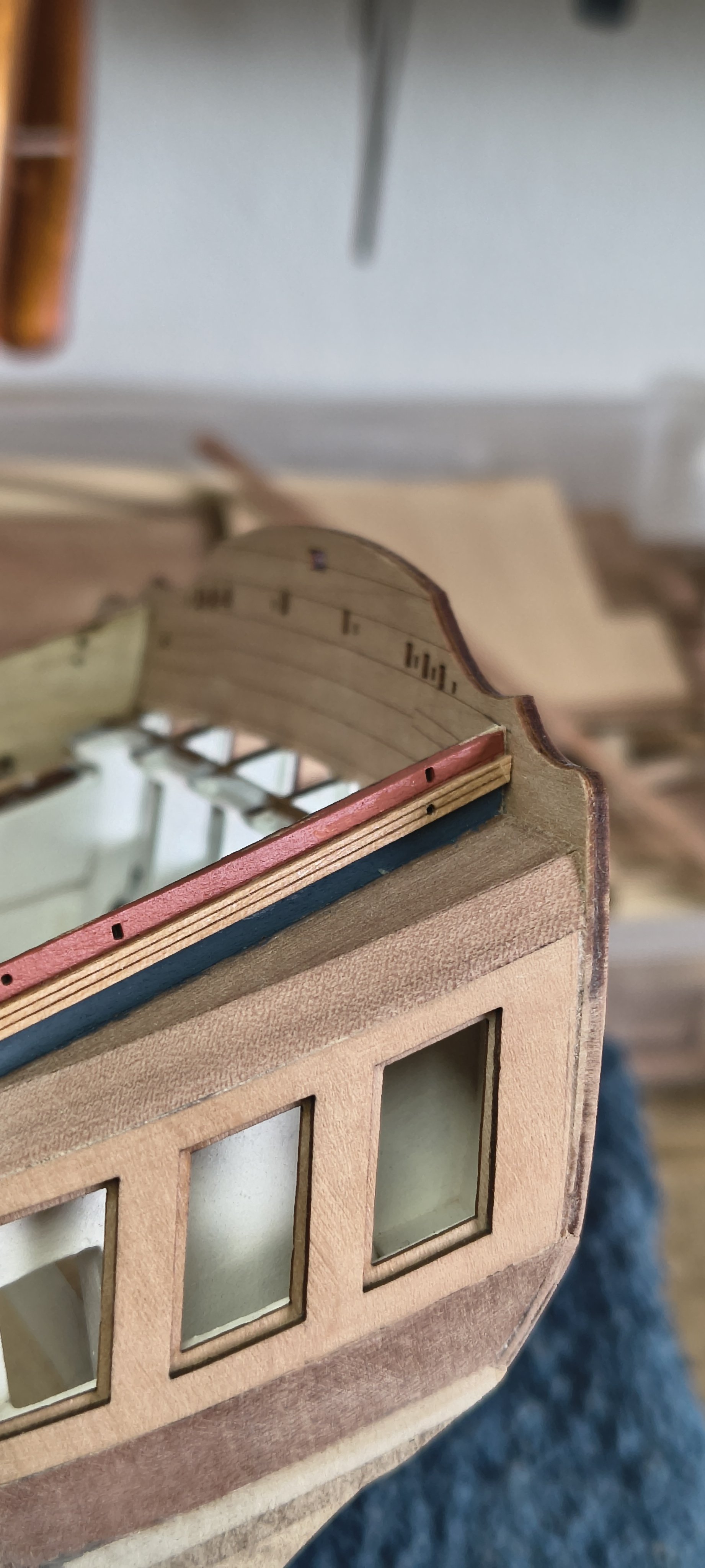

Just a very small update to show what I'm working on. Installing the quarter galleries, or at least one of them. Took me quite a few days to really figure out how it should look exactly (my head is a bit messy at the moment, so a bit difficult to concentrate). But I'm starting to get the hang of it. Also with the help of the other Sphinx build logs.
It looks like I've added just a millimeter to the length of the quarter galleries compared to the original that James built, but that doesn't seem to have any real implications going forward. Will do a more extensive report from the other side so it's clearer how I'm approaching it. (spoiler alert...pretty much the same as Blue Ensign did it) :)

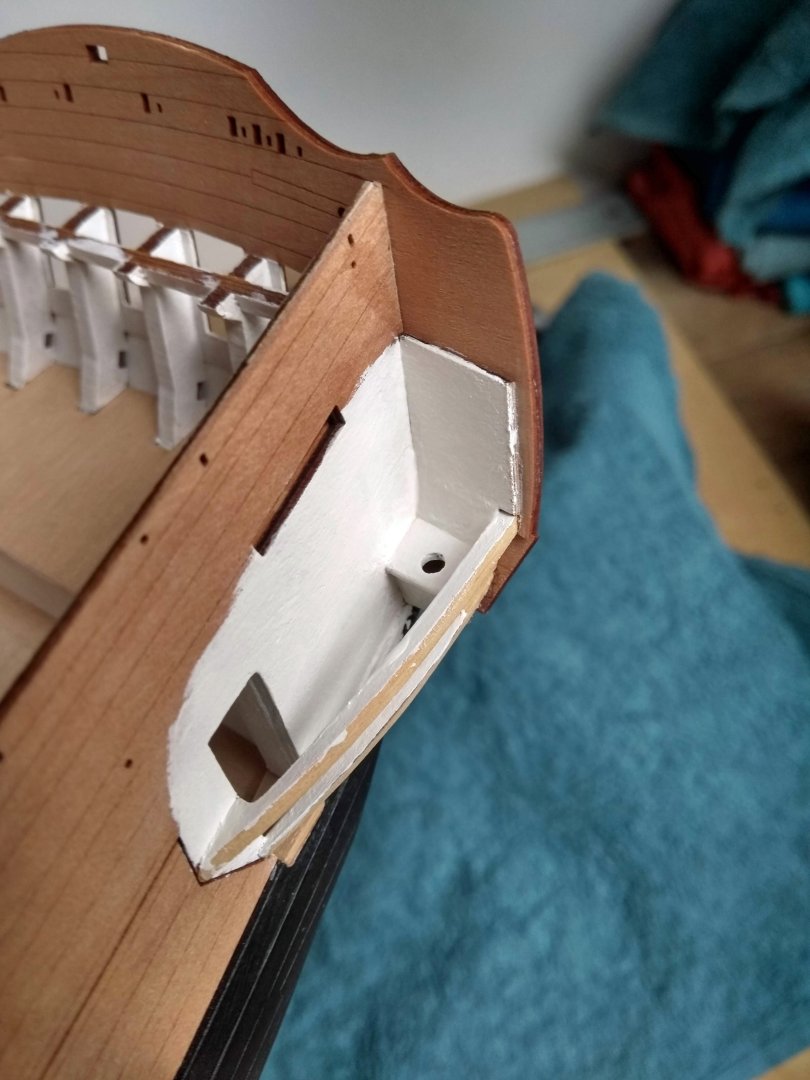

Then started with the construction of the "seat of ease". First a base plate on the back so that there is a flat surface
The "seat of ease" made from various pieces of boxwood. I found the sanding disc easy to use here to get the right angles. Just work your way up to it slowly instead of sanding away large chunks.
 Painted it a nice coat "off white", like the rest of my interior

Then the first underlying window piece. Used many different clamps here to get it right. Tip: practice clamping without glue beforehand...so you know when you're working with the glue where everything should go...less stressful ;)
I extended the window piece that goes over the base layer because I want to use as little filler as possible afterwards. This way I can slowly work towards the perfect shape. To be honest, I have to say that it didn't work out as well on the port side as on the starboard side. I was still a bit too impatient or something and had a small seam here and there ;) . I worked these away with some glue and sanding dust. Eventually there will be a layer of paint over it anyway so it doesn't matter. But I think these are fun challenges (which don't always turn out well haha :D

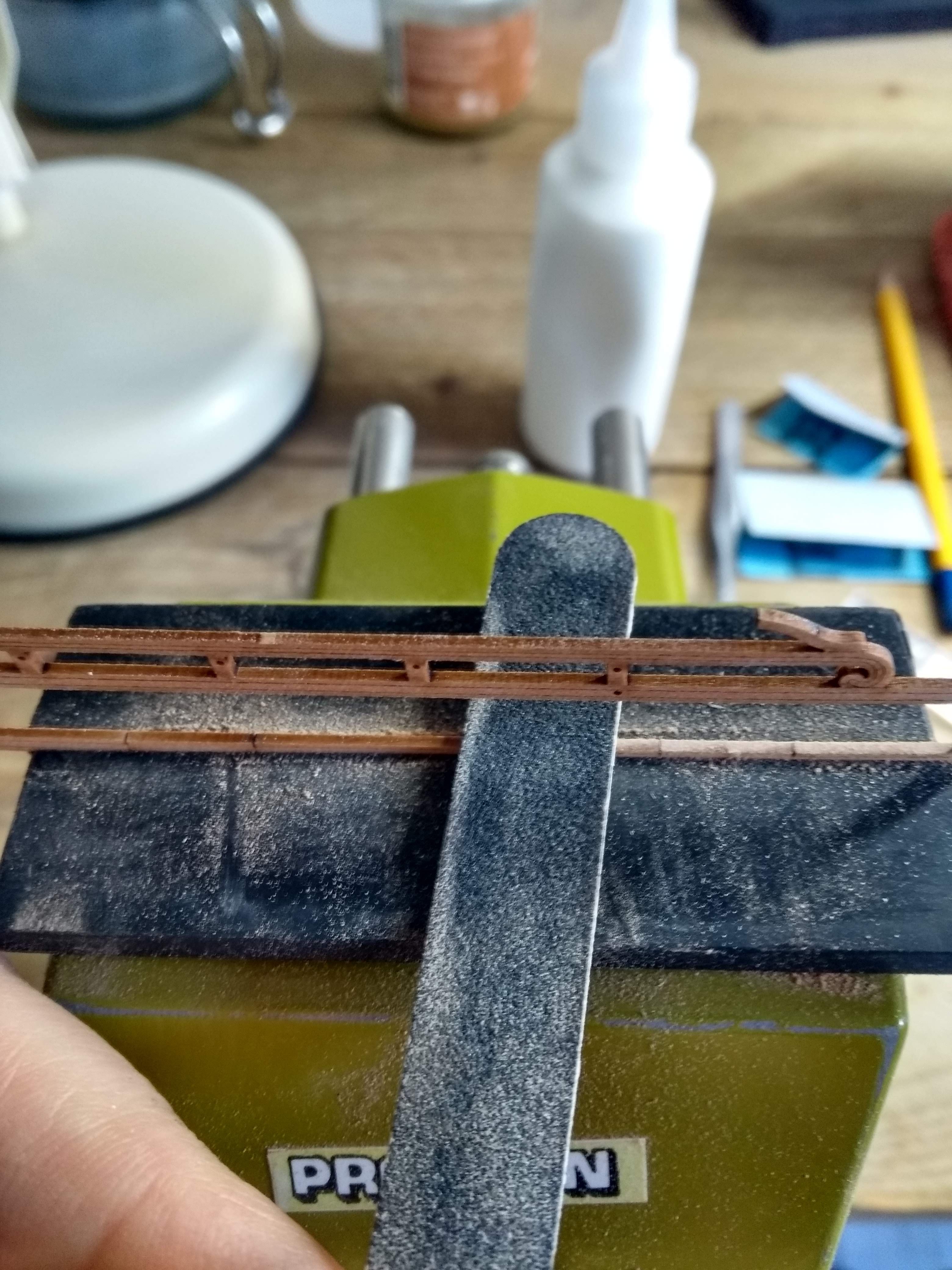

First of all some support for the lower part. Again made from boxwood and of course the dimensions taken from the original kit partsIMG_20250421_122420831.thumb.jpg.5d1de33bb96f57e98ba445331bfa2715.jpg
Then I copied the "berthing patterns" but with larger dimensions so that I have room to make a seamless connection with the top and bottom of the quarter gallery. Maybe it would work with the original part, but personally I find this easier. And with a table saw and sanding disc it is almost no extra work
A bit of bending with the original MDF parts glued to a piece of scrap wood. It's not all super precise but that's not a problem. I noticed that with a plank nipper from Amati I did get the final curves that were needed
Fits nicely! Here and there I cheated a bit with some glue and sanding dust. ;)  I try to make it very precise, but it doesn't always work out as intended. Beyond my skills haha.
Then it was time for the "lower finishing parts". Again a piece extended at the front with a piece of boxwood, so that I could get a reasonably close connection with the "stern upper counter pattern".
I placed these parts loosely on the wales and glued them there on each other (so not on the wales, but on each other). This is because the wales have a vertical curve and you also need this in the "quarter gallery finishing patterns". Especially the "drop shape" must be sanded at a slight angle on the top so that it lies flat against the wales and pieces 29 and 45b.
Most of this rough shape sanded away with the sanding disc and the last with some sandpaper. Of course left something so that when glued to the hull it can get its final shape
Just glued here but not yet in its final shape
The final shape was obtained with a mix of small files and sandpaper. As you can see the wales are a little bit damaged in terms of paint, but that can easily be touched up. I used a little bit of filler on the front of the finishing pattern, where it flows into the "berthing patterns". This is because the berthing patterns are lower because they are lying  against the wales and the finishing patterns are ON the wales. So I had a bit of a strange transition there..solved with some filler.
By the way, I think this should be approximately the shape that the whole thing should have. I didn't find it the clearest and it seems that there are some differences between many builders. The most important thing I think is that it should look aesthetically pleasing, so a nice flow with the rest of the quarter gallery. I chose to place the drop shape at the bottom a little forward (towards the bow), a small millimeter from the upper counter. This is because the PE decoration that comes on top had exactly the shape of this drop. So it was important to keep the shape (this also answers the question I asked myself in post #280)

Oh yes...a nice glimpse into the "seat of ease"

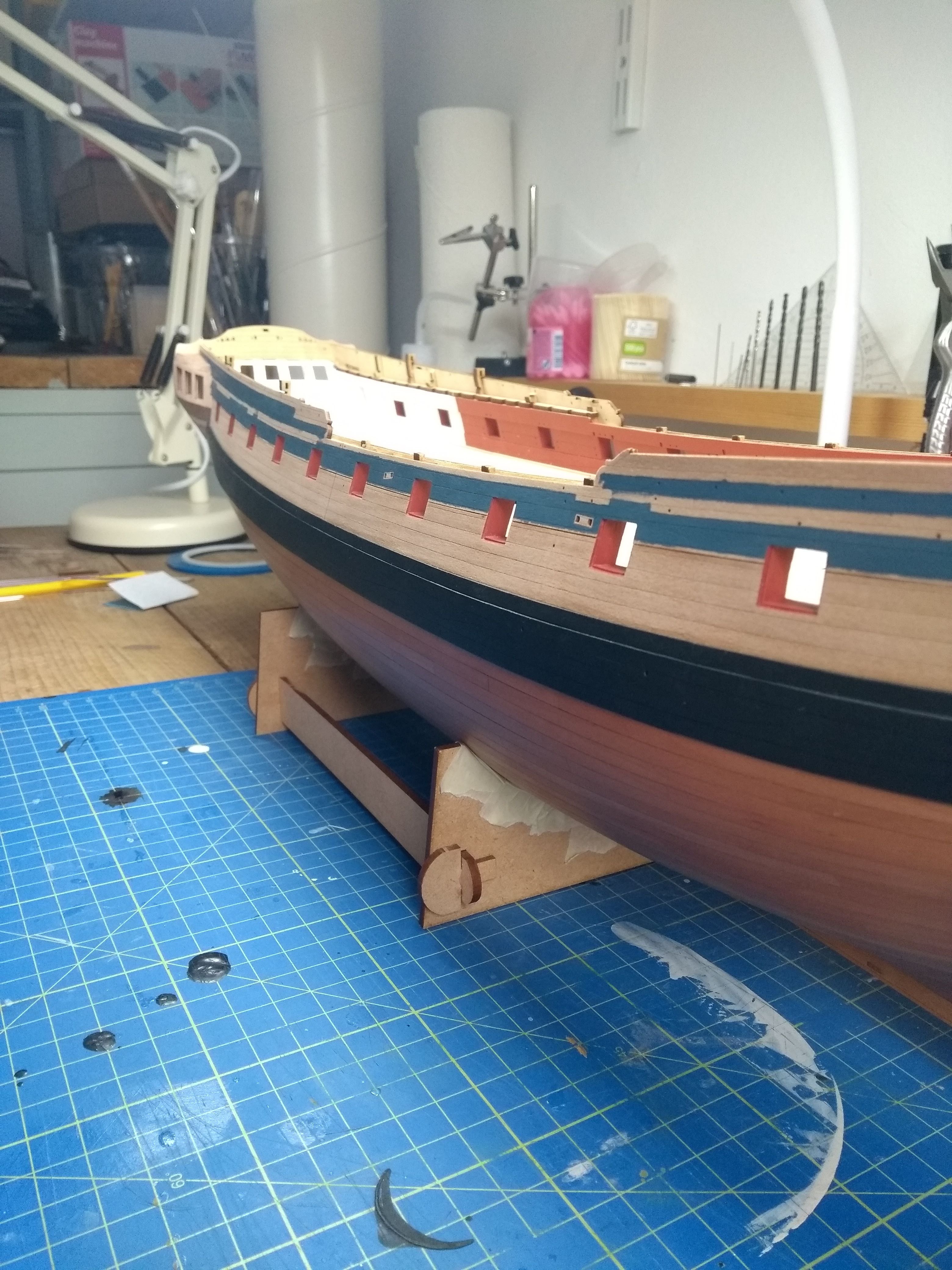

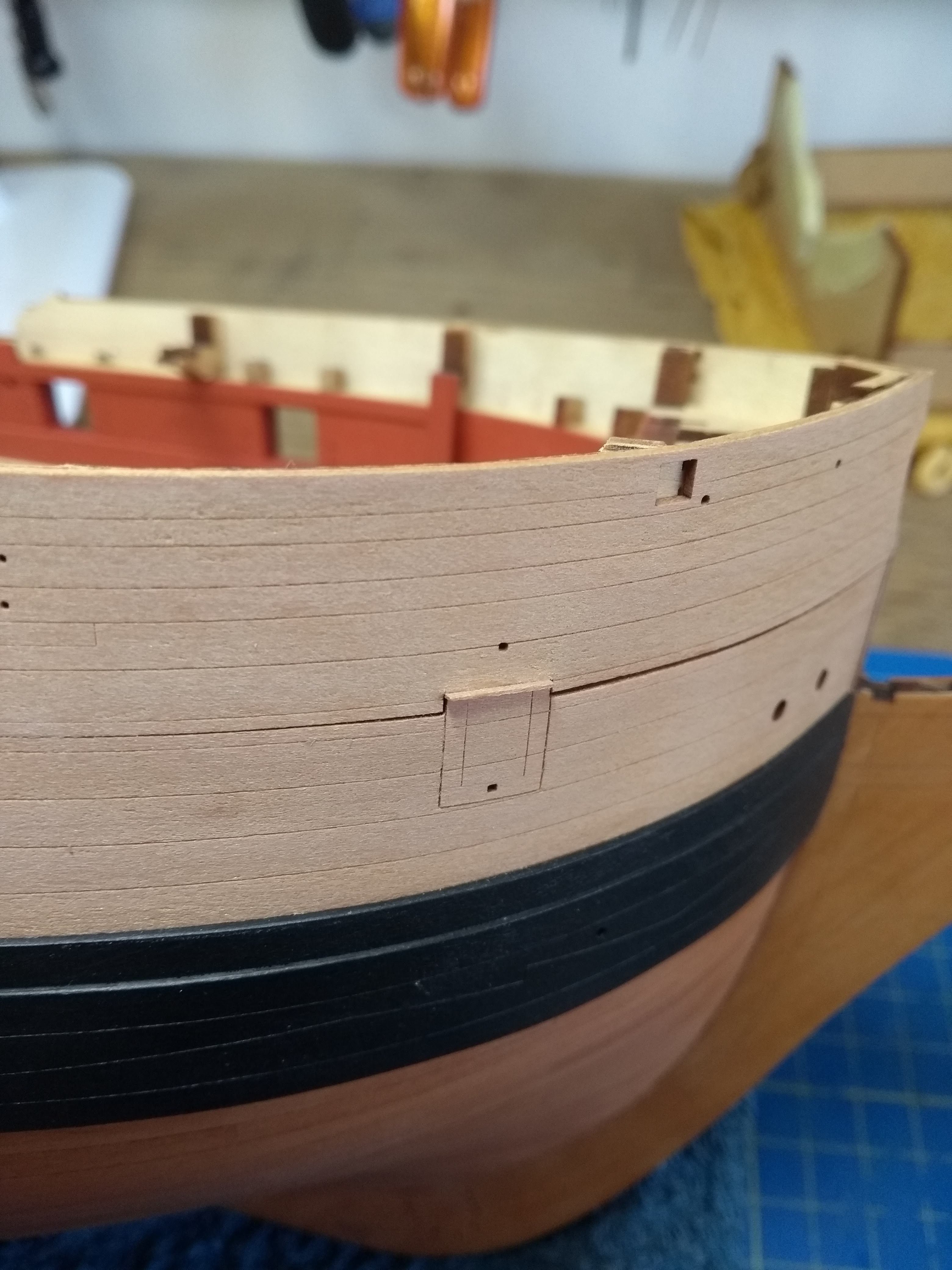

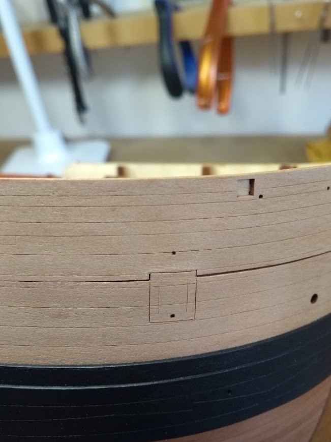

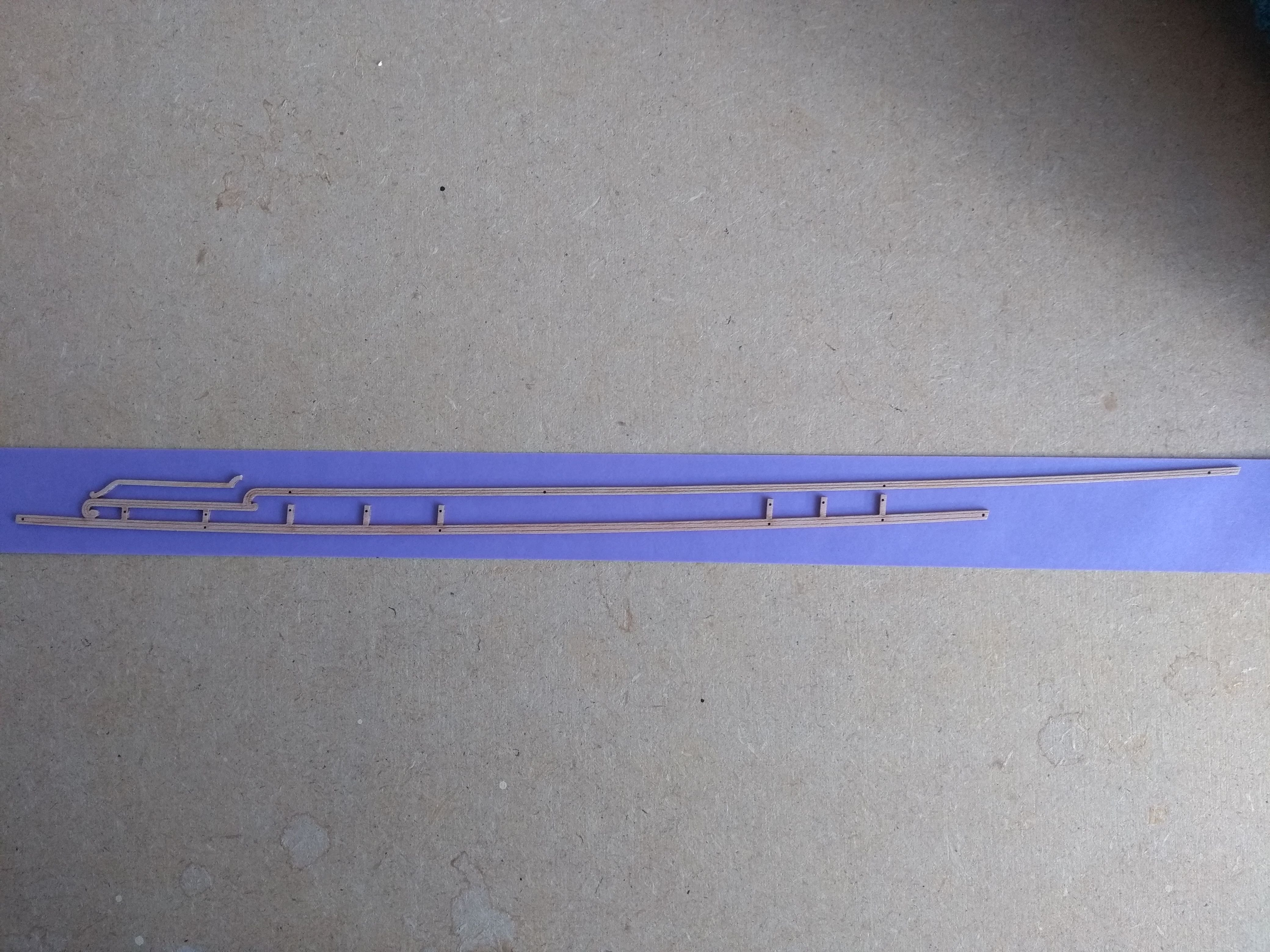

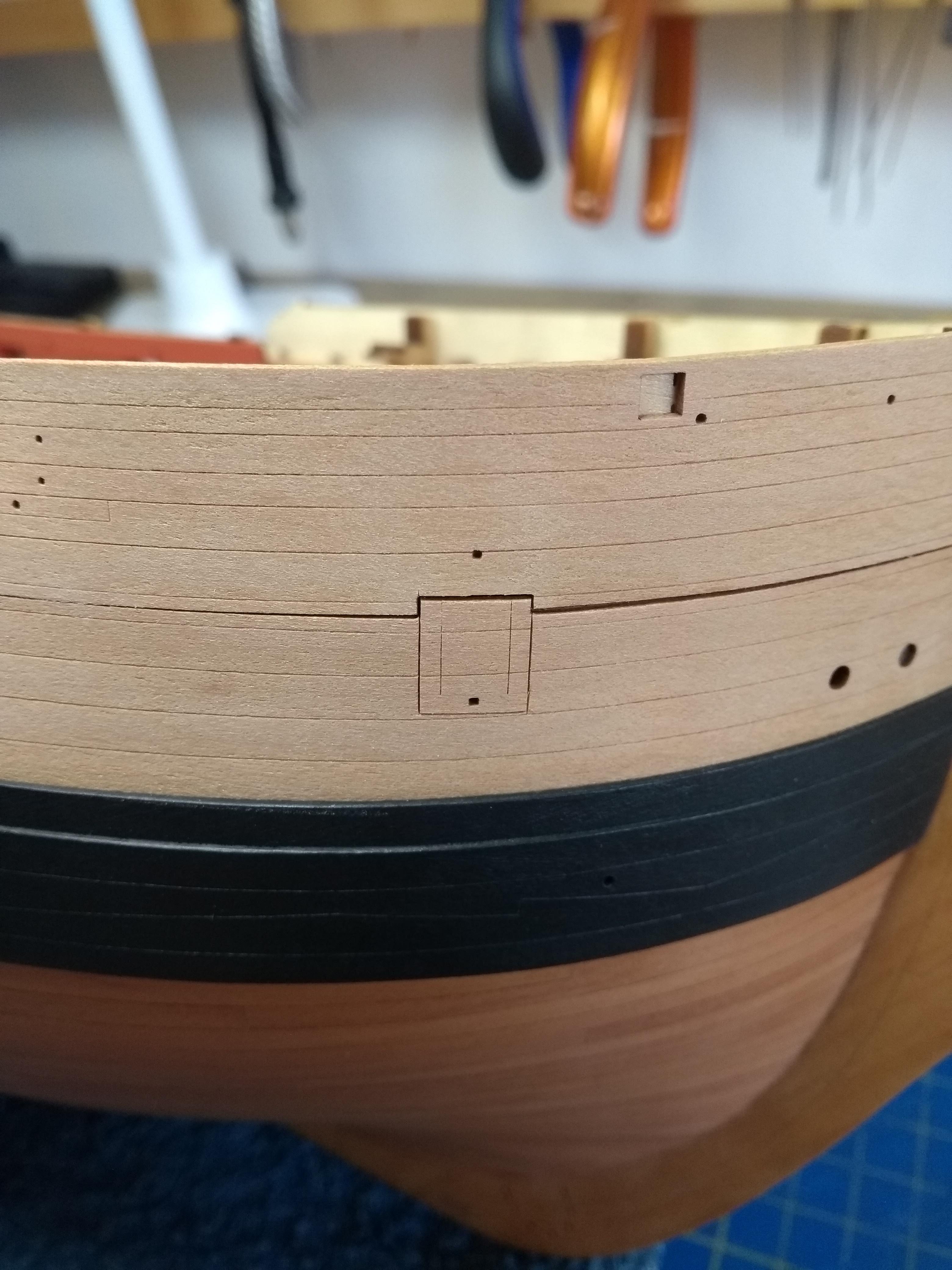

I am now busy attaching the rails on both sides. First I wanted to tackle the seam above the front gun port.
I had a considerable seam here and I filled it with a piece of scrap wood. Then I ran a knife through it to give the impression that it is a gunport lid.

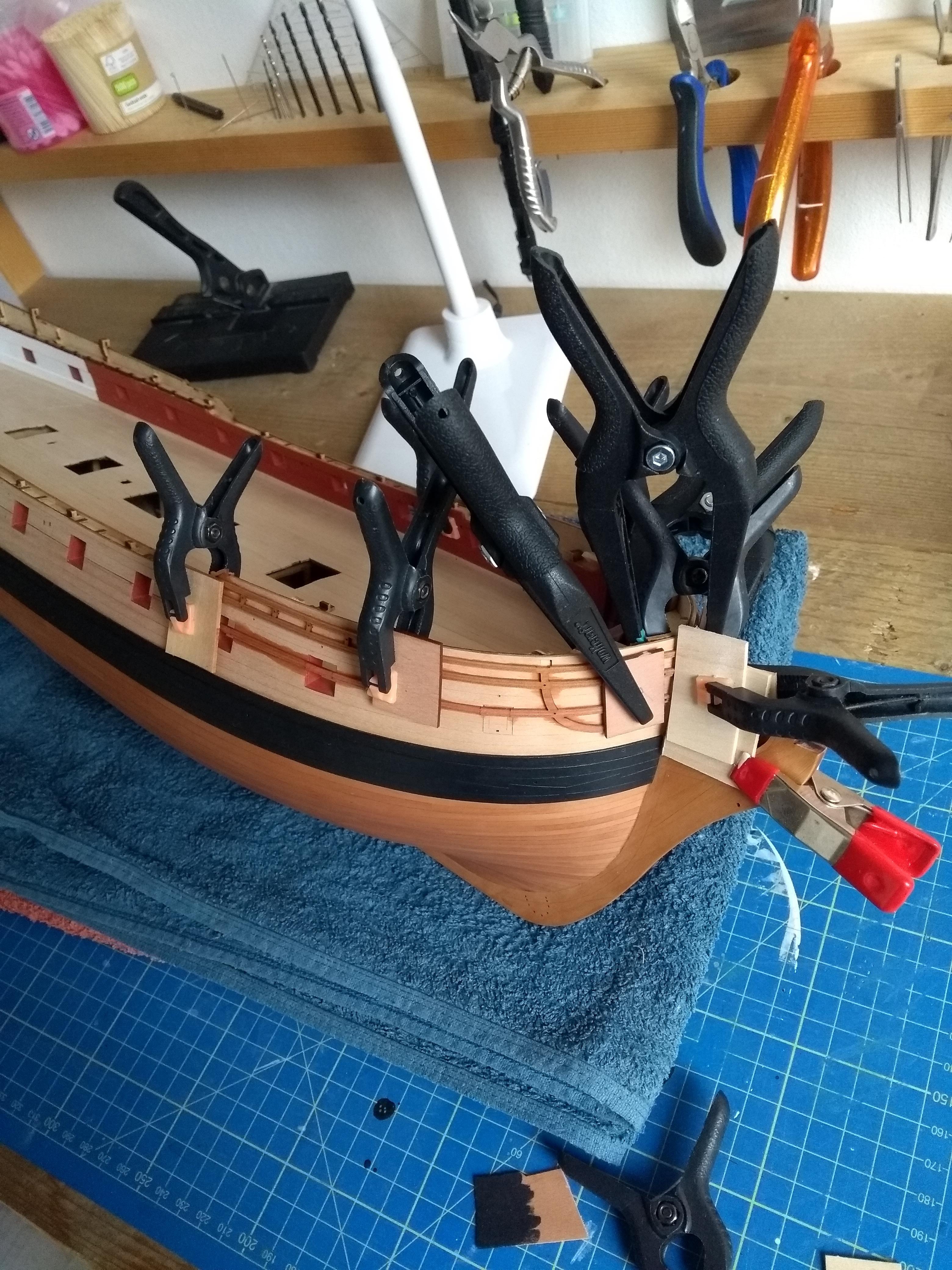

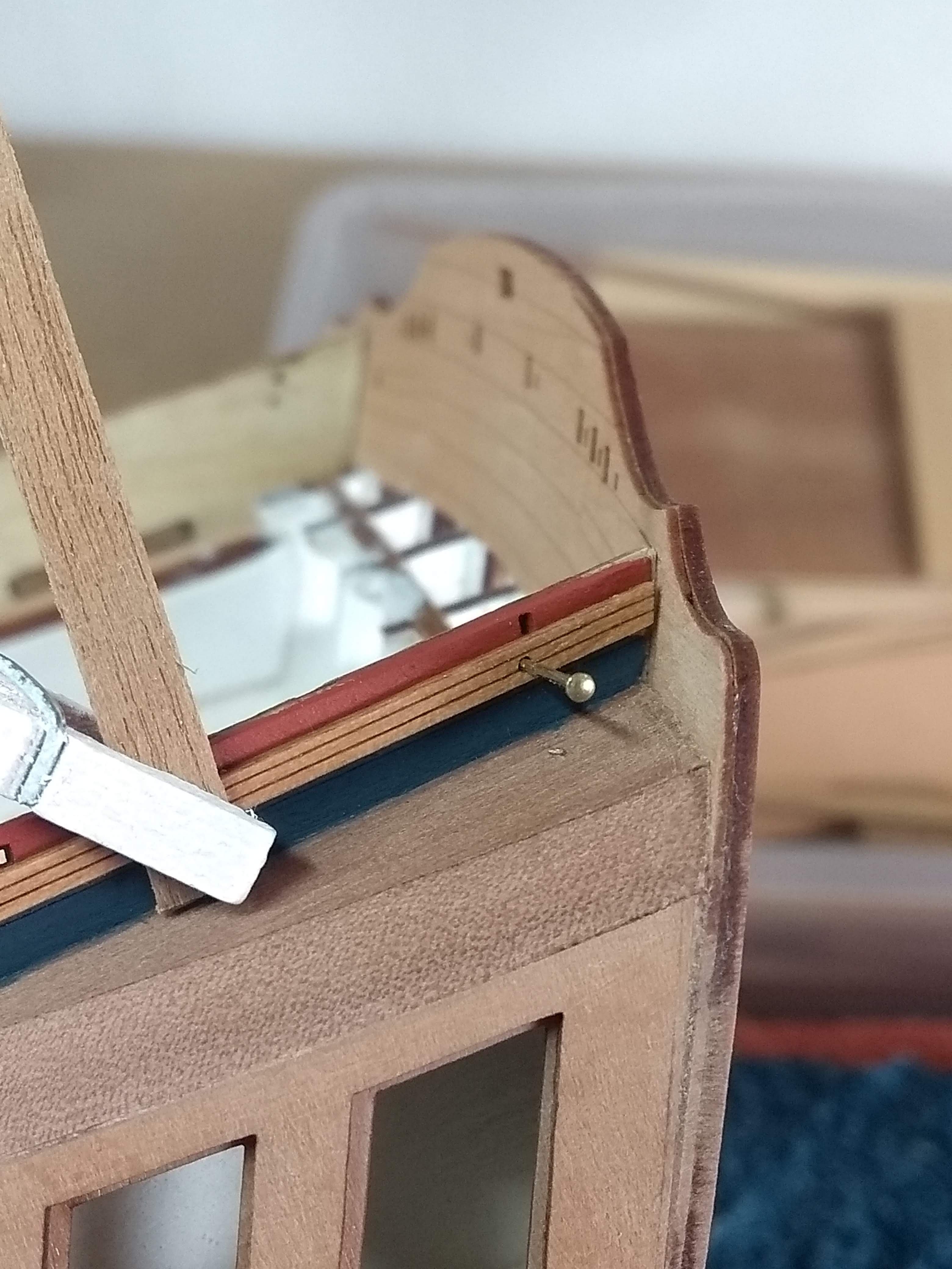

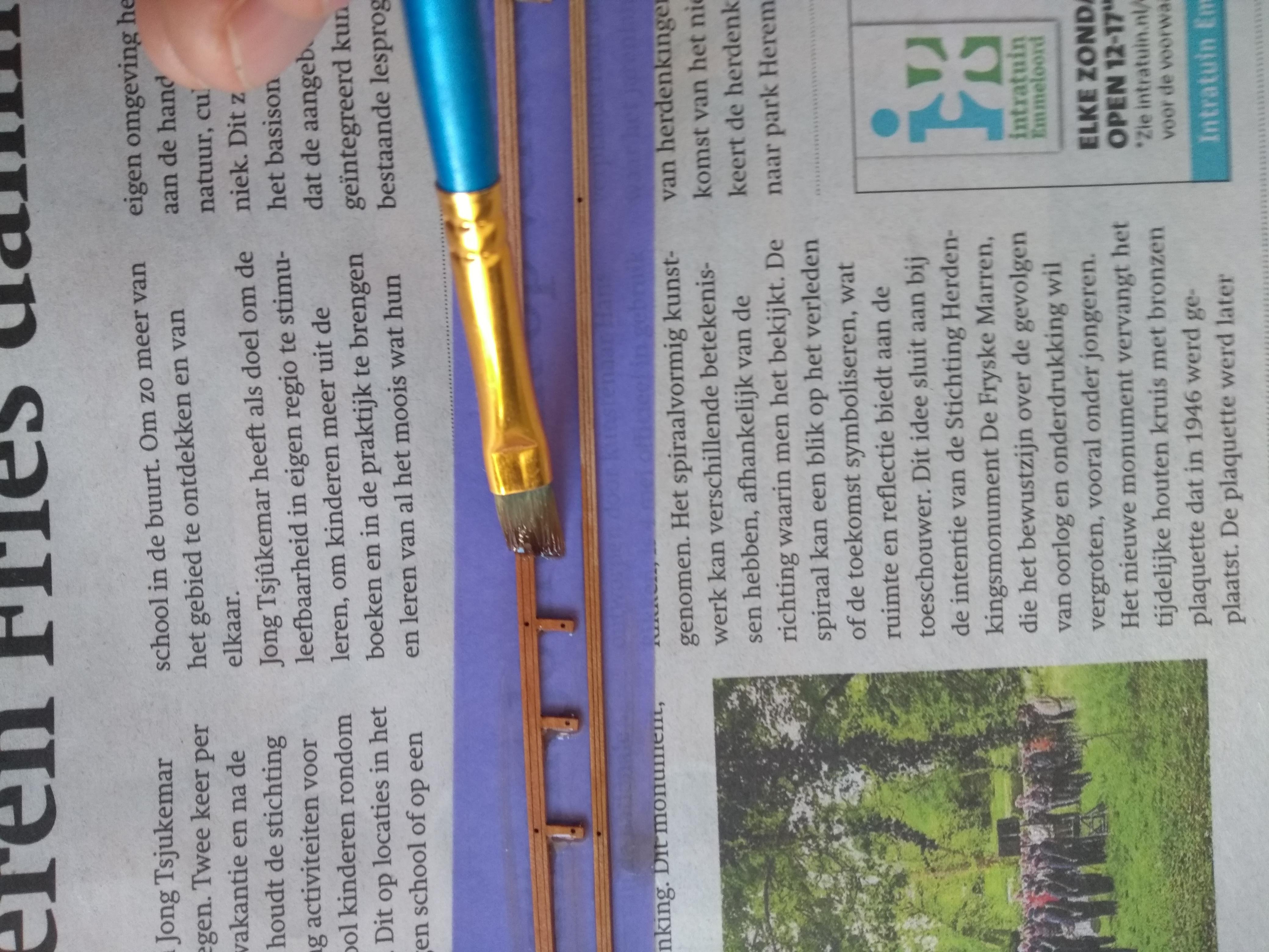

From this point I had to soak the front rails and attach them to the hull to get the shape in (without glue of course). First of all I removed all char from the laser. This by means of sanding stick, files etc. If you decide to remove the char beforehand... be very careful, you can bump into it in a careless moment and it breaks... ;)

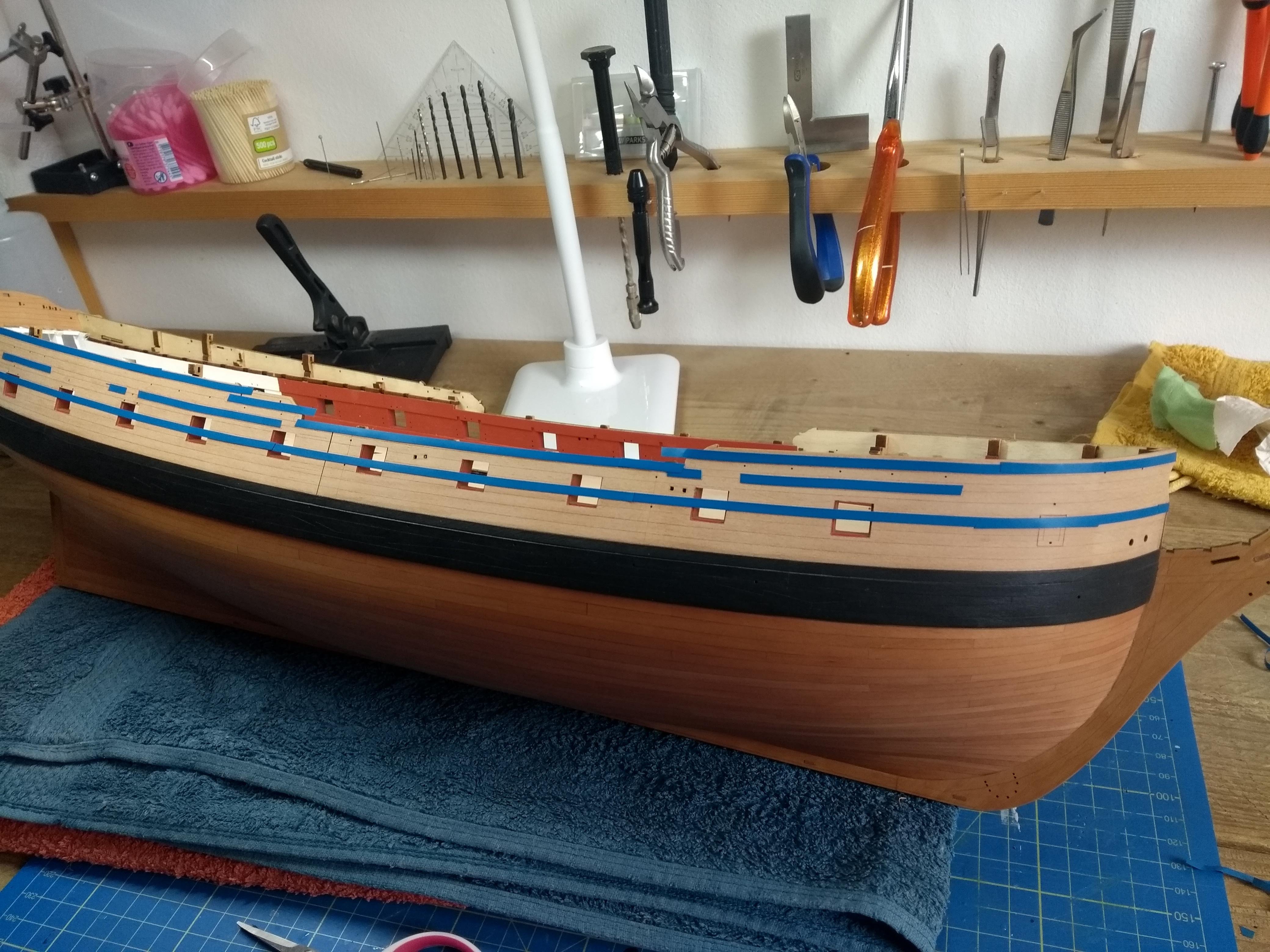

Then finally apply some color to the hull. So that the rails will finish the lines nicely and you don't have to paint very precisely along a rail... ideal! For this I used "Admiralty Red Ochre" and "Tamiya Medium blue XF-18". I thought these colors went very well together (inspired by the HMS Jason from Beef Wellington here on the forum). I used a little masking tape where possible. This to make it a bit easier for myself with the painting.
After removing the char from the rails beforehand, I gave it two layers of WOP. By sticking them on a piece of tape, the bottom was somewhat protected from oil so that the glue can adhere well. Plus it is also easier to handle when they are stuck on a piece of tape.
The reason I gave them a WOP layer beforehand is so that the blue and red paint do not get under the varnish. I checked on a test piece beforehand whether I would like this... and I did not think it was really right. I thought the paint color became too shiny and the WOP did not absorb well into the acrylic paint (logical I think). That is why I varnished the rails beforehand.

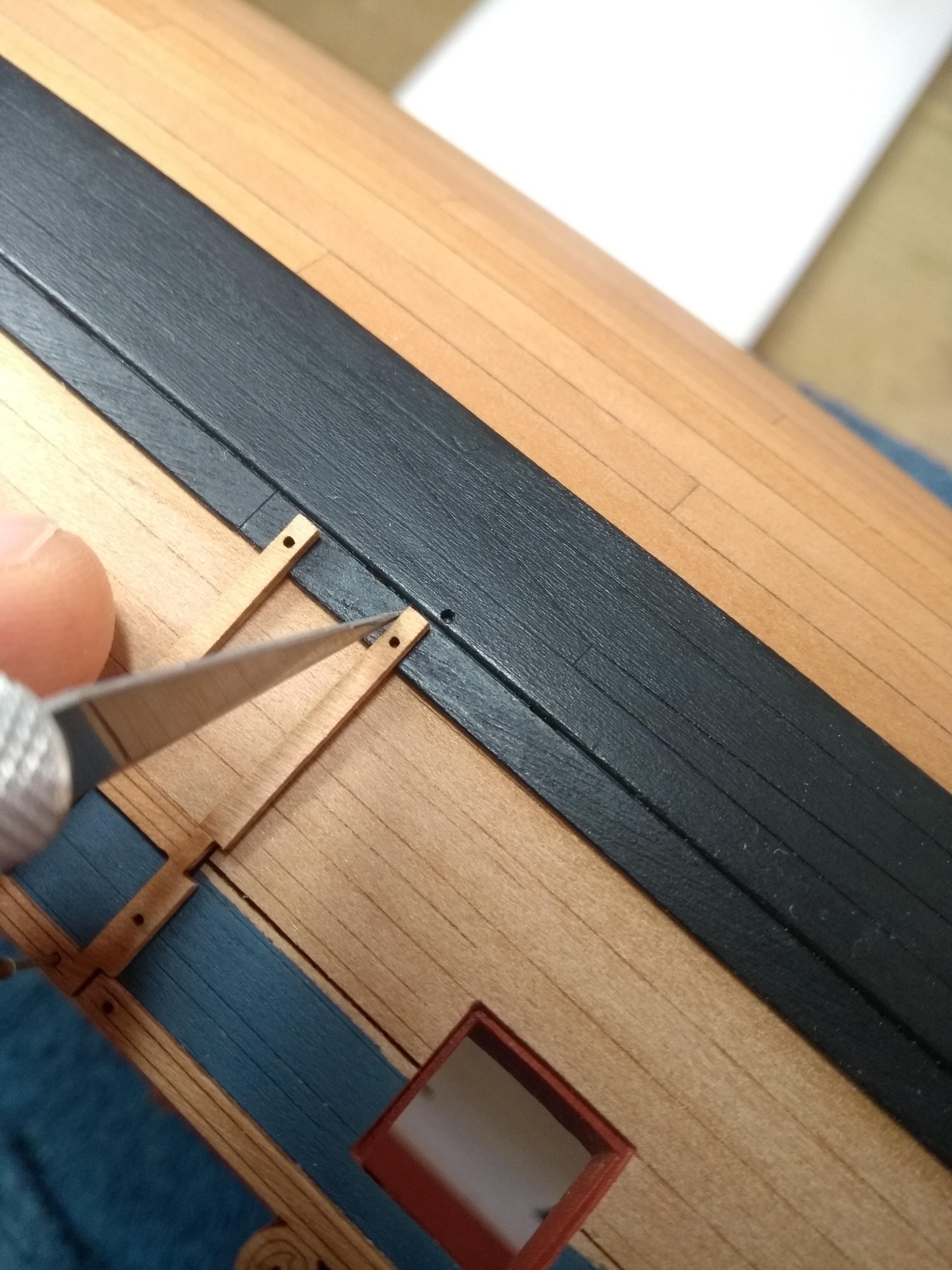

I noticed that the top rails didn't quite fit the counter, so I glued a small piece of scrapwood to the rails, sanded it, re-scored the lines with a knife and applied two layers of WOP. The end result is still not perfect haha, but these are fun little challenges in between (that take way too much time lol)

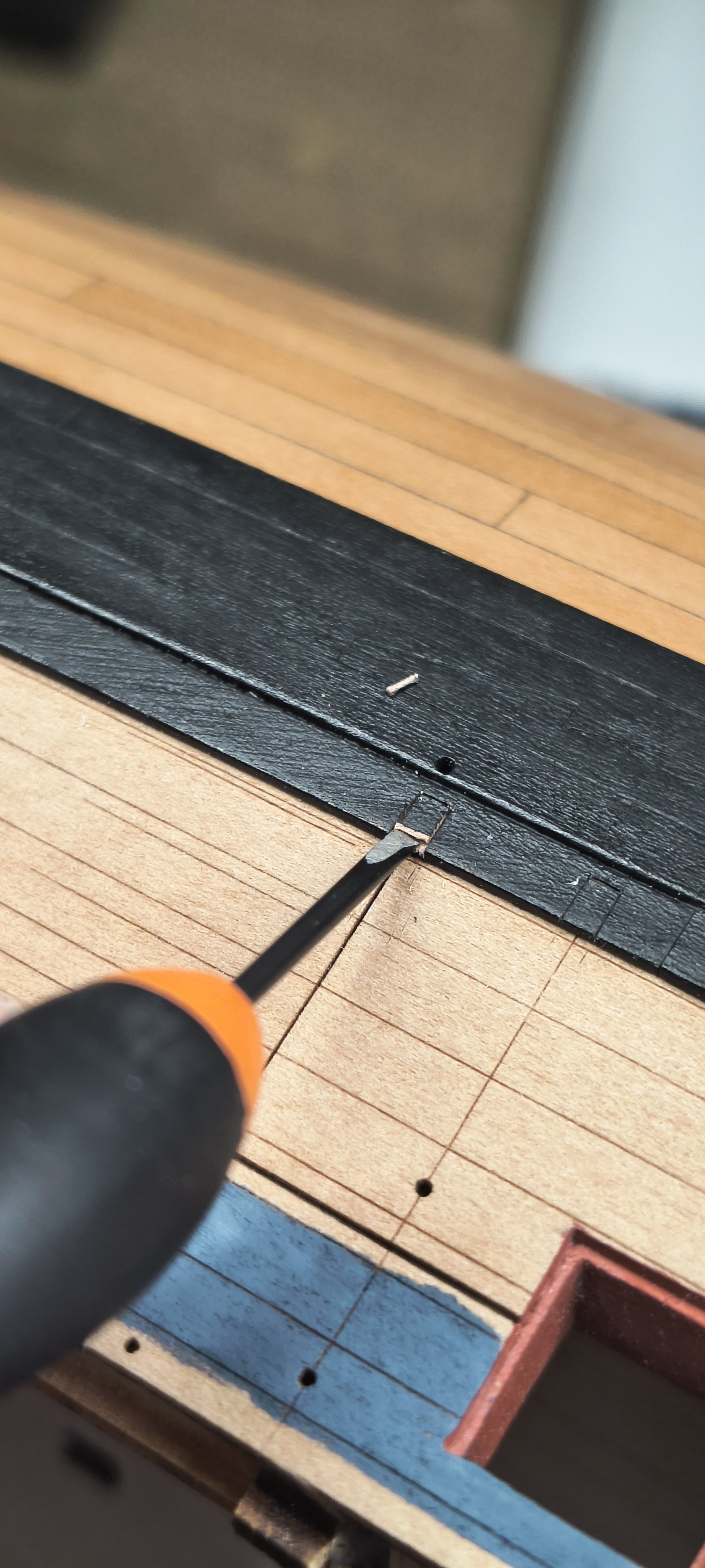

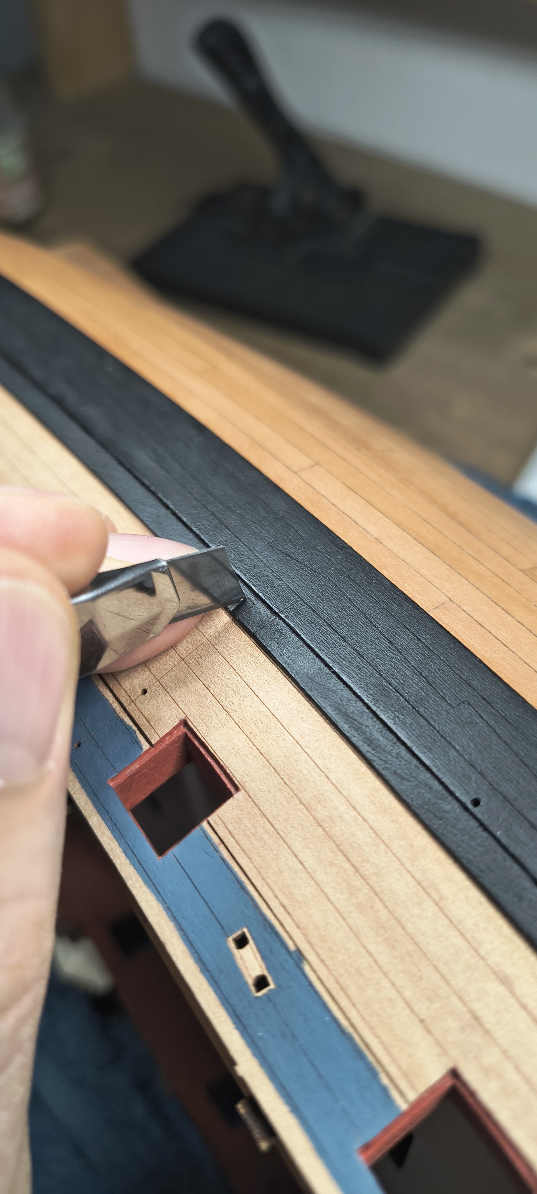

The middle rails required me to make two small recesses in the upper wale. First marked with a small knife and then with a small knife carefully scored the lines on the side and then with a small chisel (I ground a small screwdriver down to a fine chisel) very carefully removed the middle wood. From this point on I also finally got a better camera, so hopefully the pictures will be a bit better.

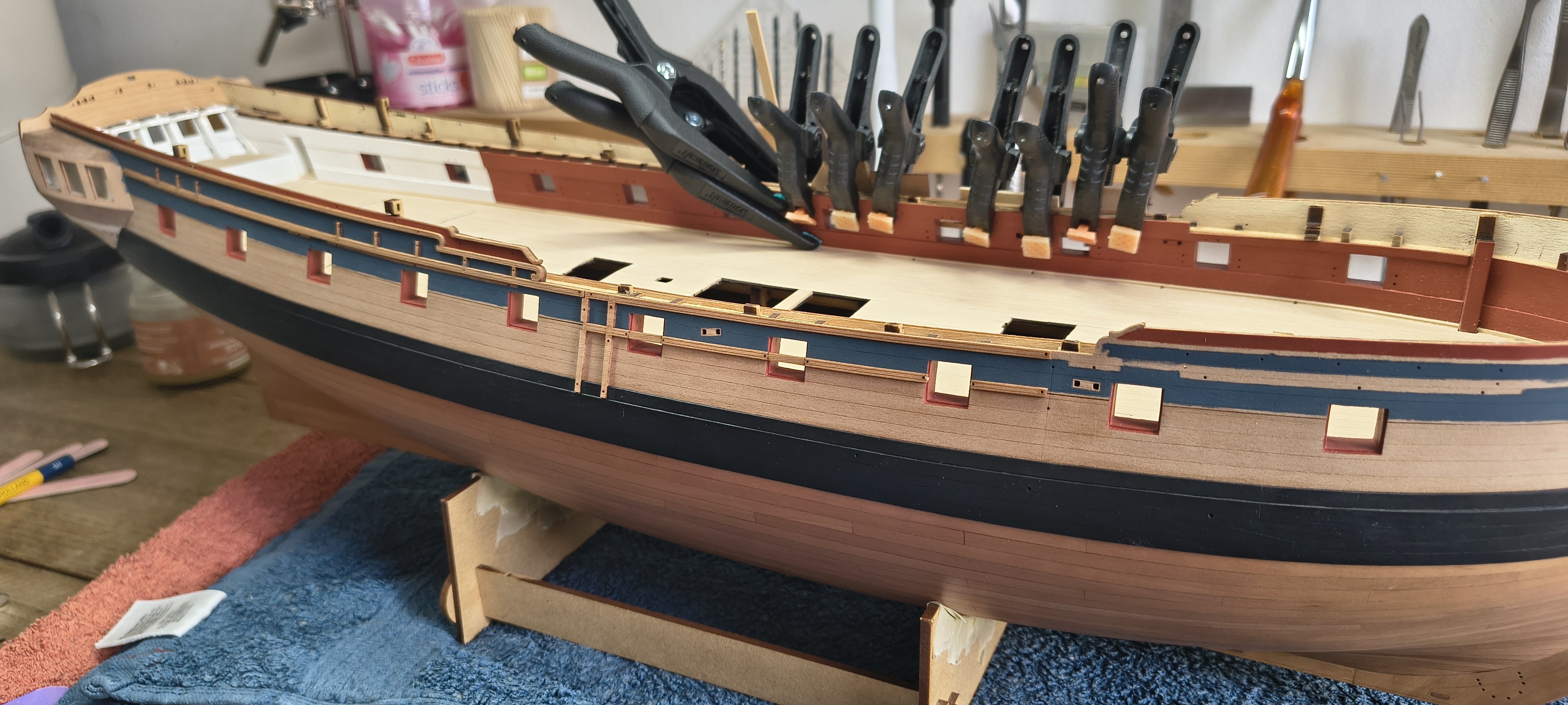

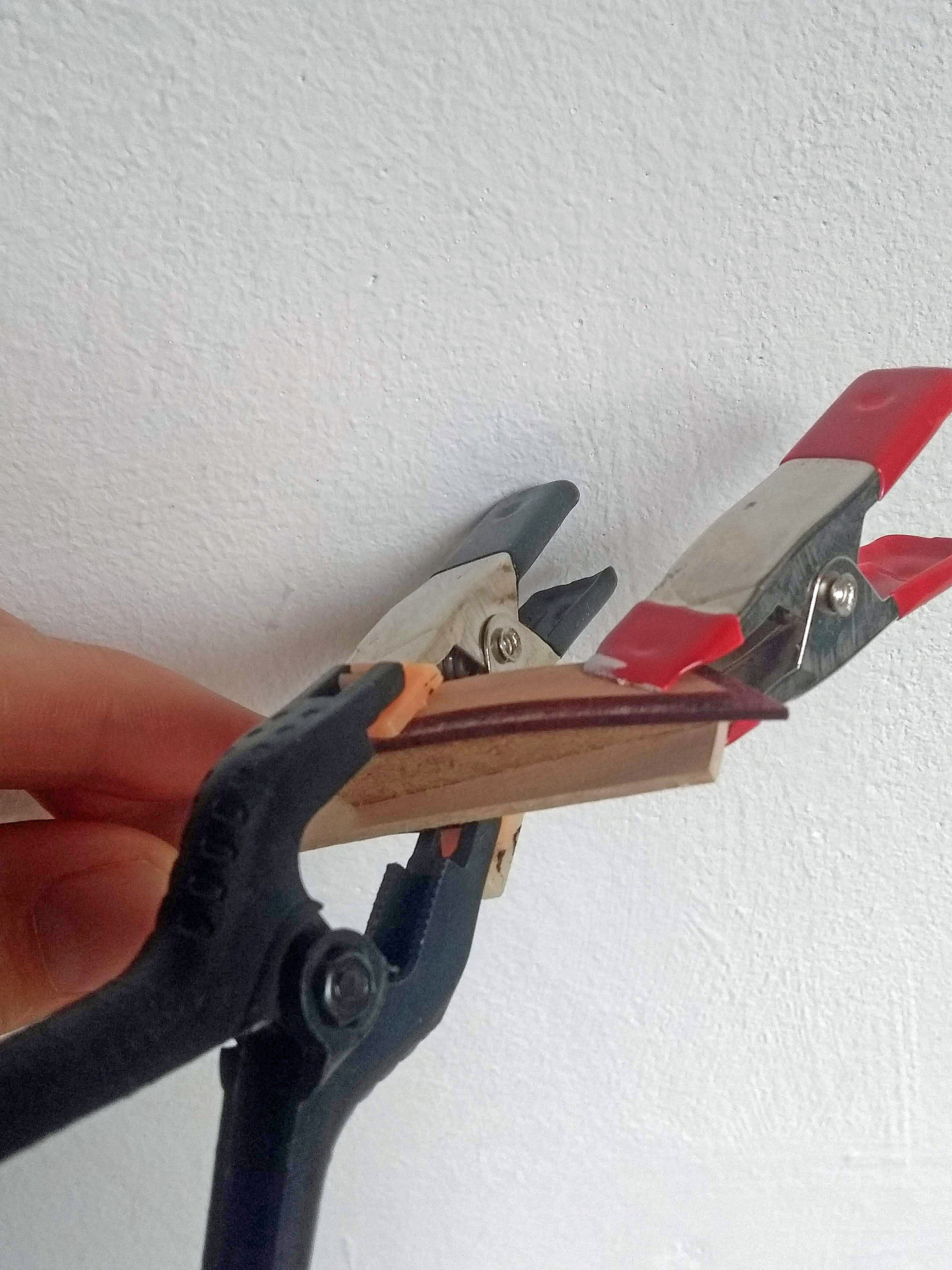

Here I clamp the middle rail piece. I glue it with diluted PVA. I diluted it so I have more time to apply it with a brush (otherwise it is already dry before I have spread all the glue on).
And at this point I am now...kind of halfway through all the rails :)

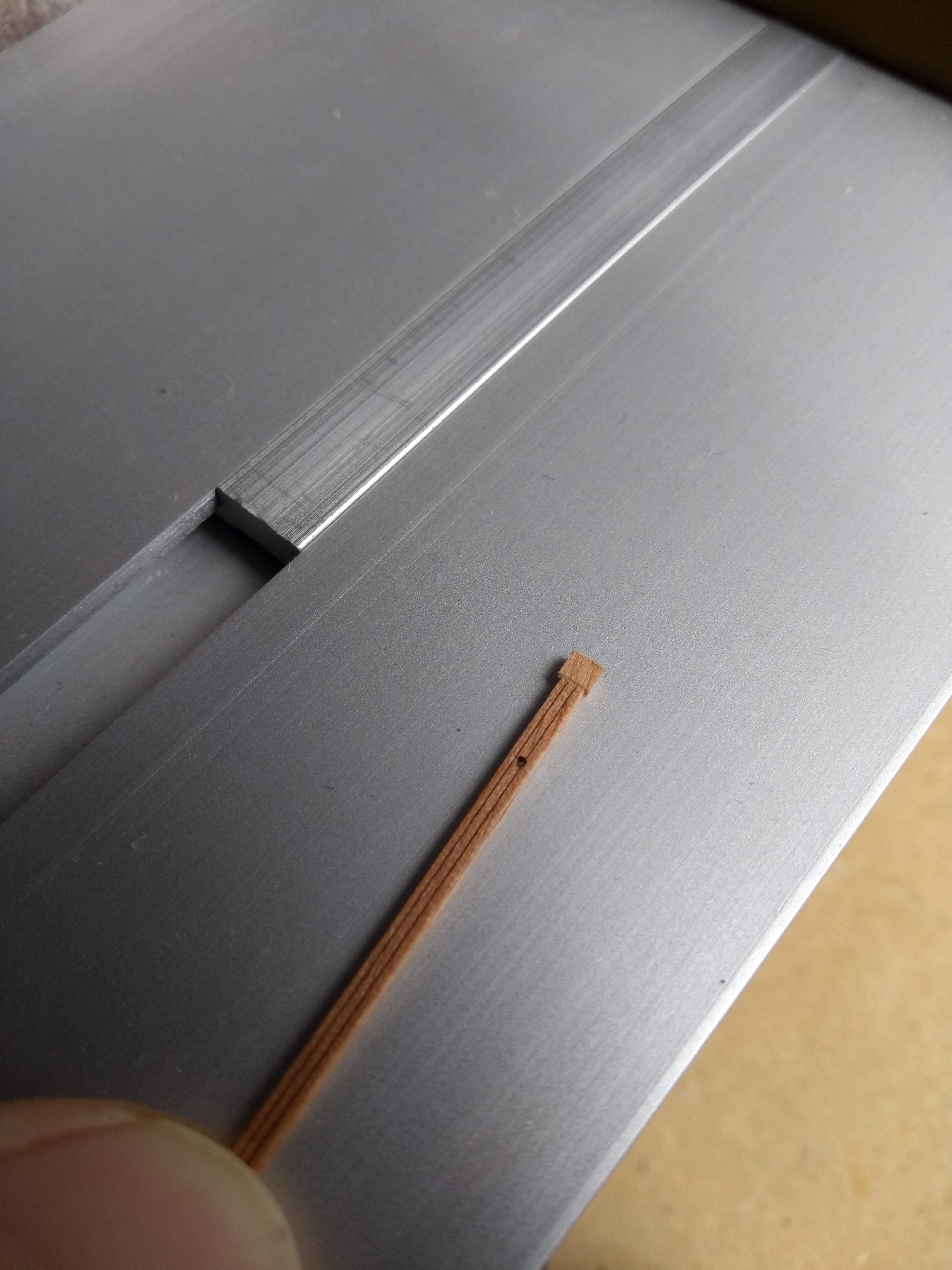

Sidenote: the little holes Chris put in the rails to get them in exactly the right place... genius! :D
