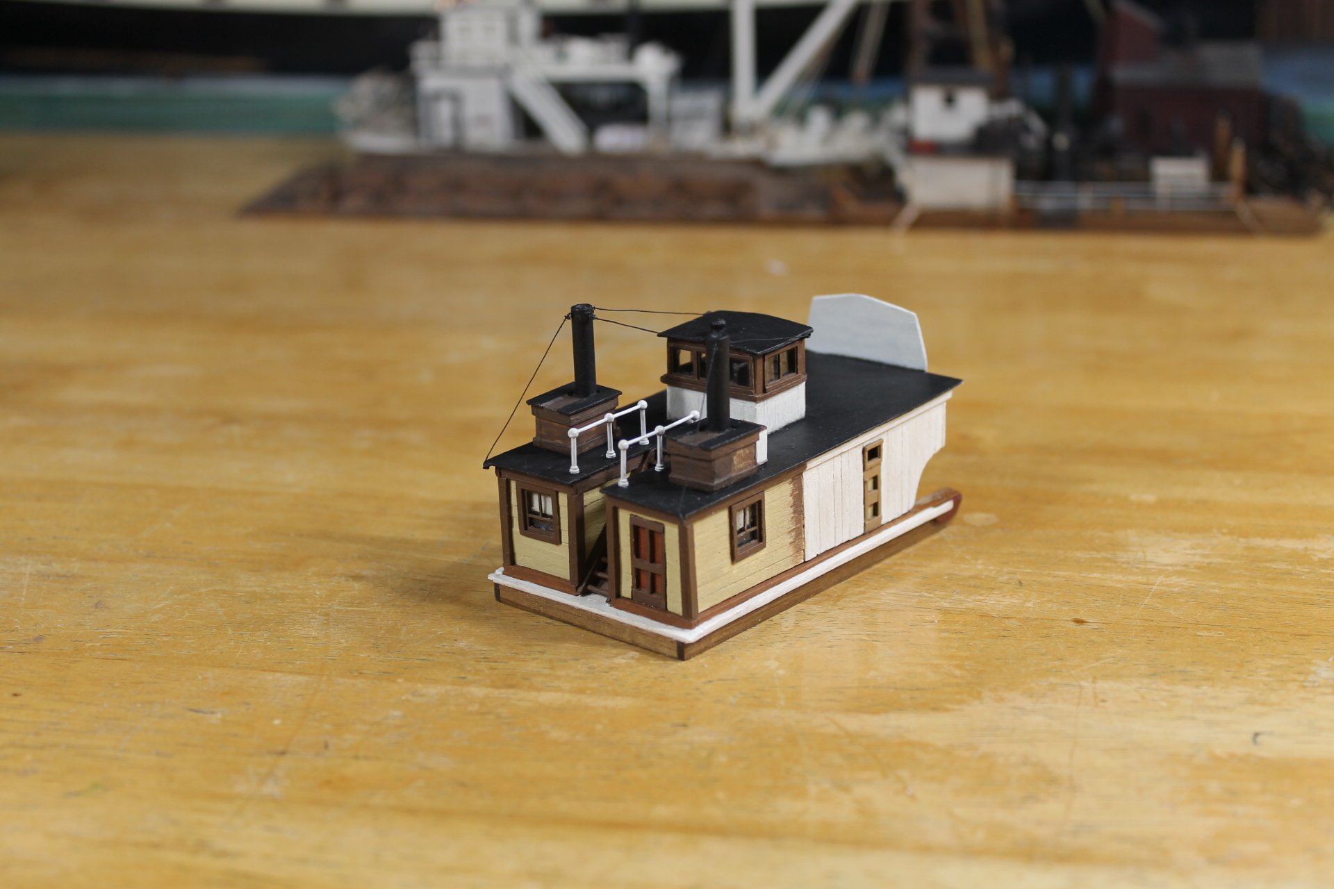

 I'm calling the boxes that Capt. Engel built for the dummy stacks to sit inside, stack boxes. Pretty stinkin' original, huh? :)
After a couple of months of trying to recreate Engel's work I have a pretty good feel why he did some of the crazy things he did but these stack boxes really puzzle me. The port side one looks unfinished and the starboard side one looks like Elgel ran into something. I'm going to build the starboard side box just like the port side with the dummy stack straight.
The boxes are six sided measuring 0.30" x .030" x 0.50".
 Sorry for the lousy photo.
 It took 19 pieces to make the finished box not including the stack. With the stack and the three eye pins for the stays each box will consist of 23 pieces.in the assembly. That packing crate aft of the port side box will not be repeated on the starboard side. We'll see what interesting bits I can come up with to add aft of the starboard stack box.
 I'm leaving railing 2.0 as is, the more I look at it the less it bothers me.
 I was hoping this post would find me finished with the boiler deck, the next post for sure. That will leave adding three pieces of pipe and the paddle wheels. Billy is getting close to being finished.

I'm not all that pleased with the way the dummy stack stays turned out. I used 32 GA brass wire for the stays and my go to small photo etched eye pins for connecting points. It's all a bit flimsy for my taste so there maybe a stays 2.0 at some point. I've had more revisions with model that any of the previous.

Very nice work, it's great to see this odd little vessel coming together! With the details added, I was going to say that it's really starting to look like a boat, but to be honest, I think it looks more like a floating house--I mean that in the best possible way, of course.
They look fine to me Keith.

Keith I agree with Keith, they look great, besides  once you post your paddle wheels everyone will not be looking at your stacks lol. Just curious,  after Billy, Tennessee?

 Thank you, Jacques. Without the paddle wheels it does look more like a houseboat. Billy was a heck of a lot more colorful than any other sternwheeler I'm aware of.

 Thank you, Glen. It's not the wire itself, it's the connecting points. I will differently be redoing the stays.

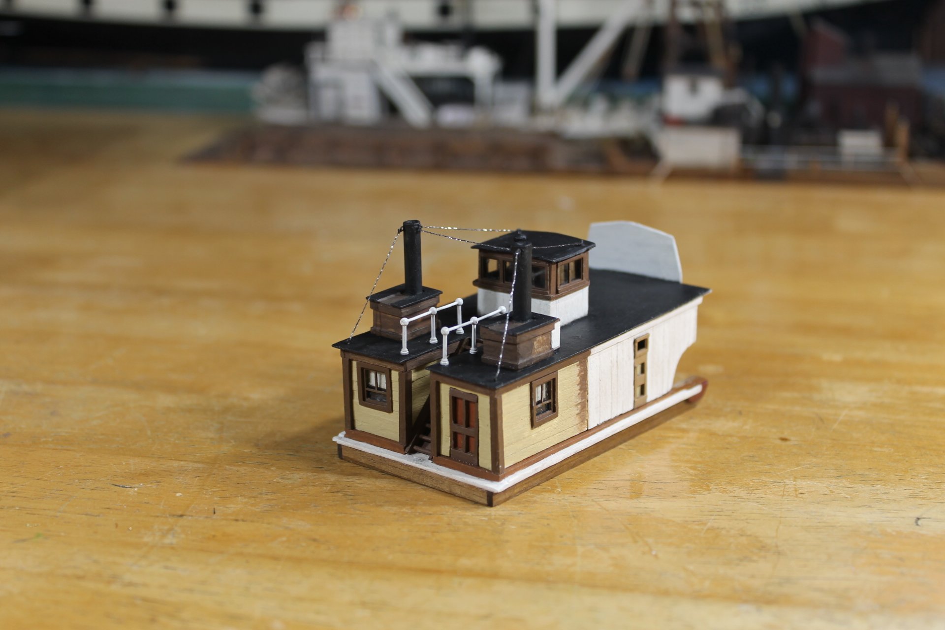

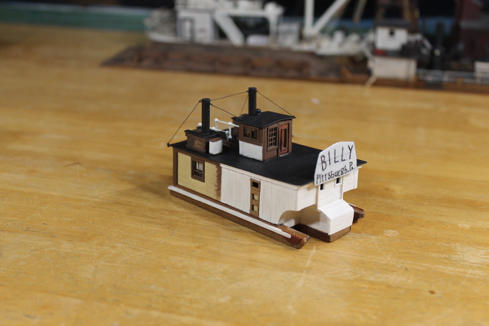

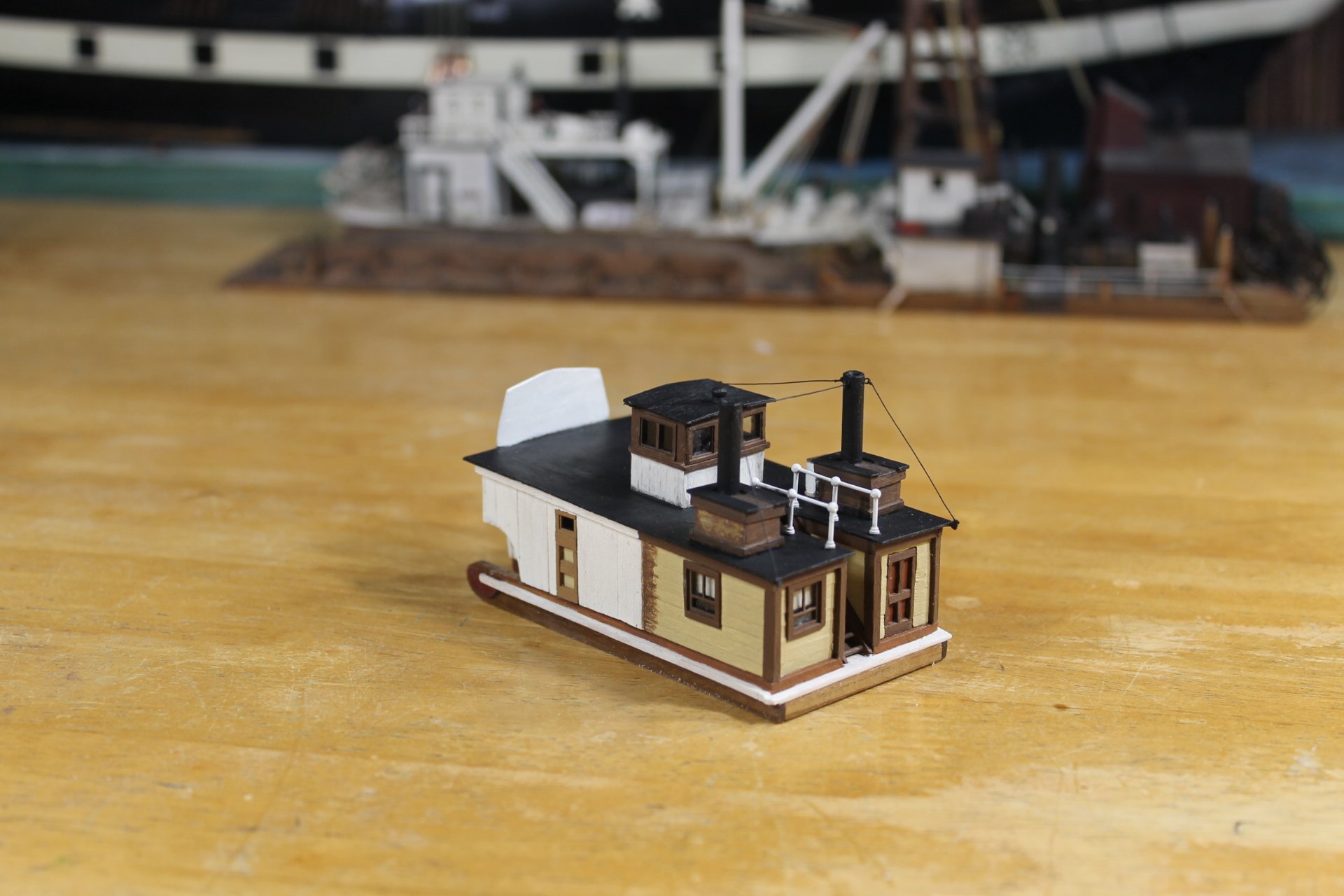

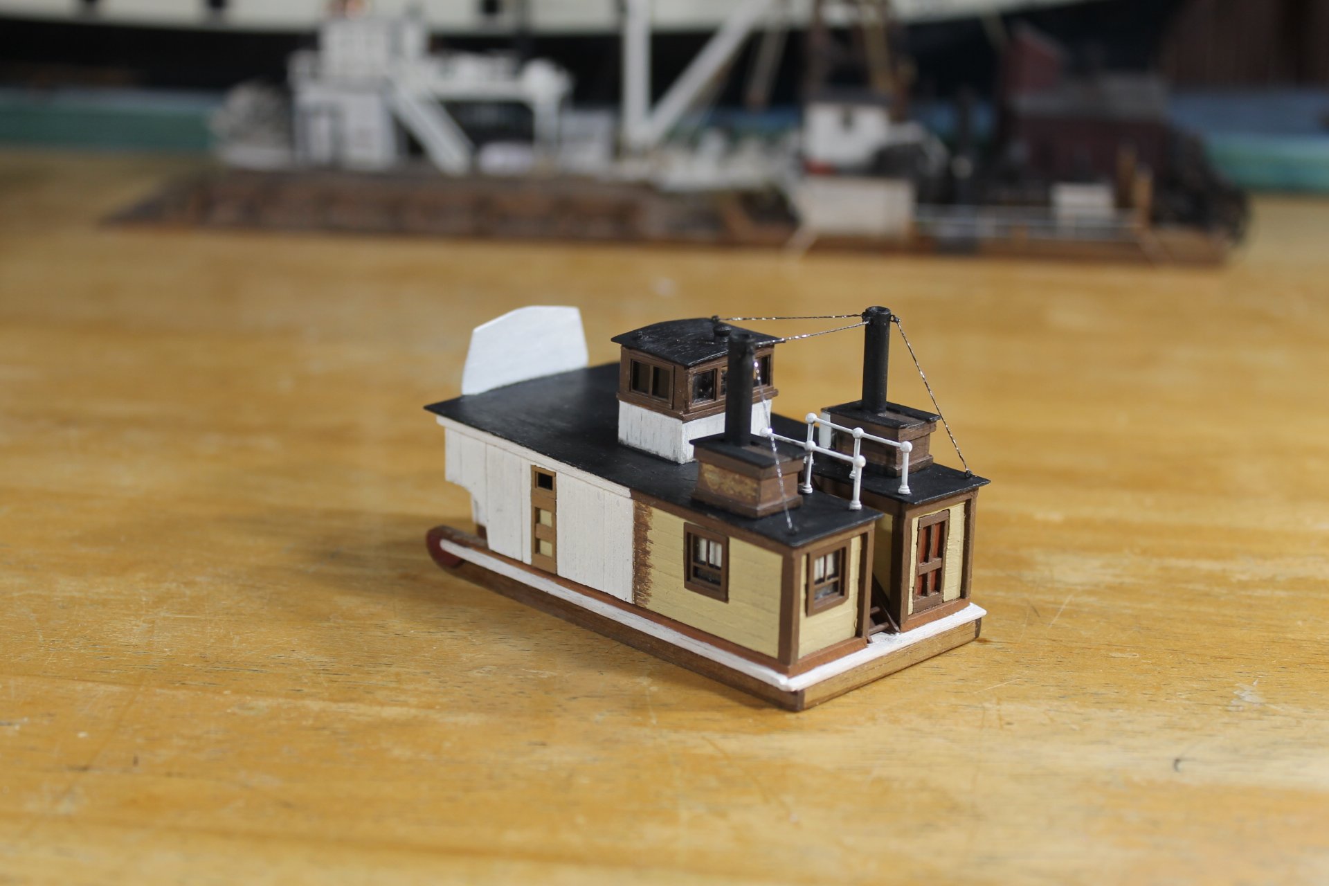

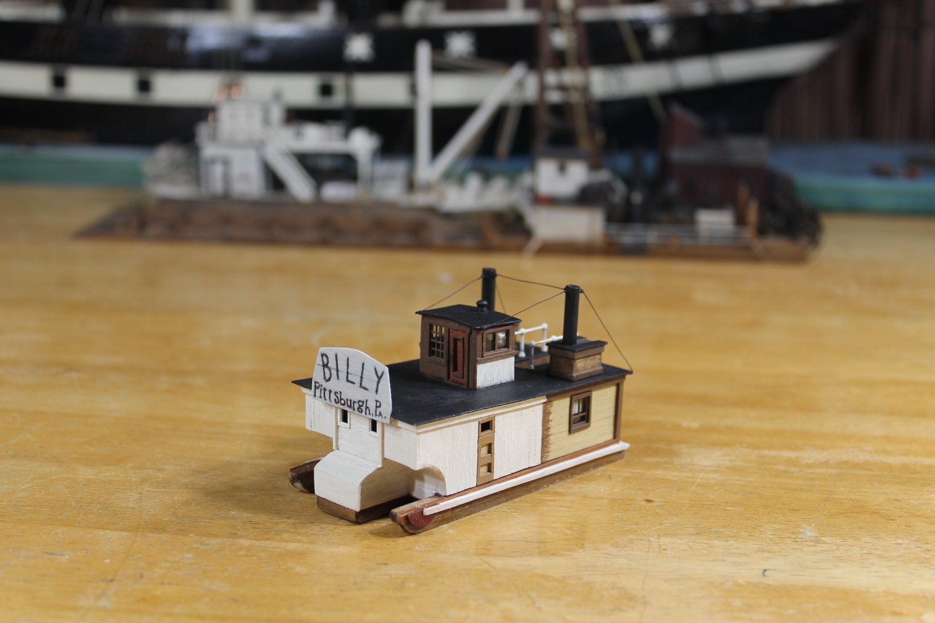

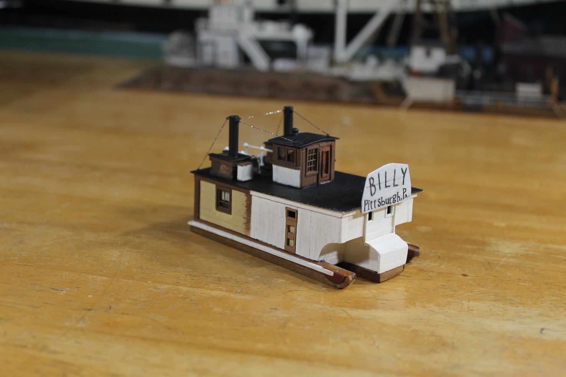

Stays 2.0 are done. You the viewer may not be able to tell the difference but I sure can. I am much more pleased with 2.0 than 1.0.
 I kept fighting that 32 GA brass wire and kept failing so I dug through Maggie's thread stash and found some silver metallic thread that was the right diameter. This was my first time using metallic thread, what a treat and it turned out to be just the ticket! Most of our models have some weight to them and when running line or wire through eyes the model is heavy enough to add resistance when tying a knot. My biggest problem is Billy doesn't weigh anything. I weighed Billy tonight and as pictured Billy only weighs 0.8 ounce or 24 grams! The metallic thread when looped through an eye and pulled tight will cinch on itself. This allowed me to CA the thread at the eye without issue using just two hands. :)
 Stays 1.0
 Stays 2.0.  All the connections look the same The thread is tight and not wavy. As is off the spool the tread is pretty bright, I gave the thread a very light black wash. Depending on how the light hits the tread the metal in the thread shows differently. It's kind of a cool effect but still might be a little too bright. A second light black wash maybe in order and is not a problem applying.
 Stays 1.0
 Stays 2.0  682F2689-0274-4B96-82A8-281352F3A121.thumb.jpeg.9750f17a0e3f3dc1158d6611fb18e822.jpeg
 Stays 1.0
 Stays 2.0. I also changed the eye connections from under the eaves to the boiler deck and the wheelhouse roof. Much more sturdy and it looks better, IMHO.

Yes, I can see the difference alright, Keith. Well done on the updated stays.
 Thank you, John. I'm glad you could tell the difference. By the by, I've started on the wheels. :)
