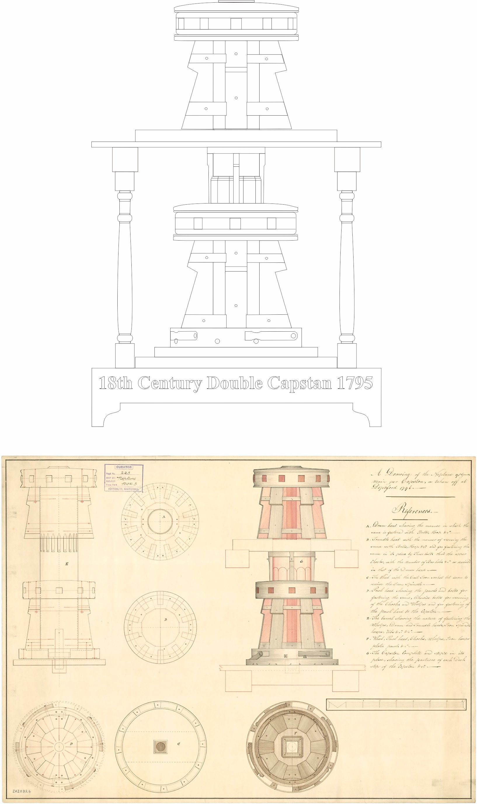

And below is another project I have been playing with.  No limited edition for this but it will be a nice group project for my club.  We have since completed the battlestation project and so I am now working on our next project.  Working pawl mechanism and all.  All of these parts also made using just tinkercad.  All of the hard parts are no designed and completed.
1/2" scale...
It will make a great desk top model.  I am sure you guys have seen the various contemporary models out there.  The "Box" or display varies.  But they are all quite nice/

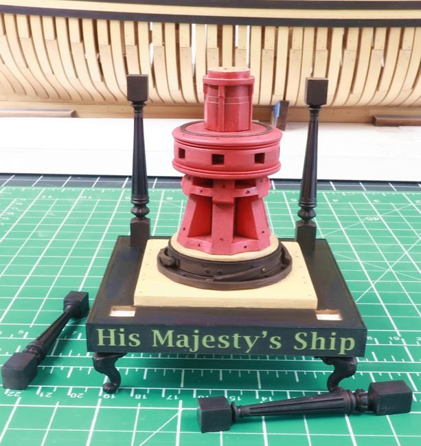

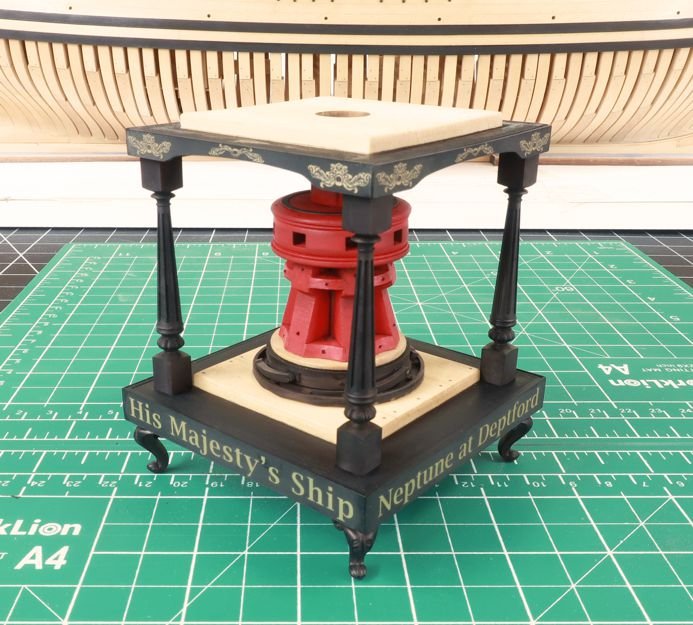

Lastly...some pics of the latest on the Capstan Project.  I will start a build log when I return.   Its something different will really make a nice display.  It will also make for a nice tutorial on 3D printing and laser cutting if everything goes to plan.  You can see some of the designed resin parts in the photos.  The columns, legs and central drum parts with pawls.   The balance will be done with laser cut wood parts.  You dont have to go black like I did but I just prefer this.  The letters around the base were laser cut on special material with gold leaf letters on a black background.  Most of the parts are not glued together yet and just test fit.  Its all good so far!!!

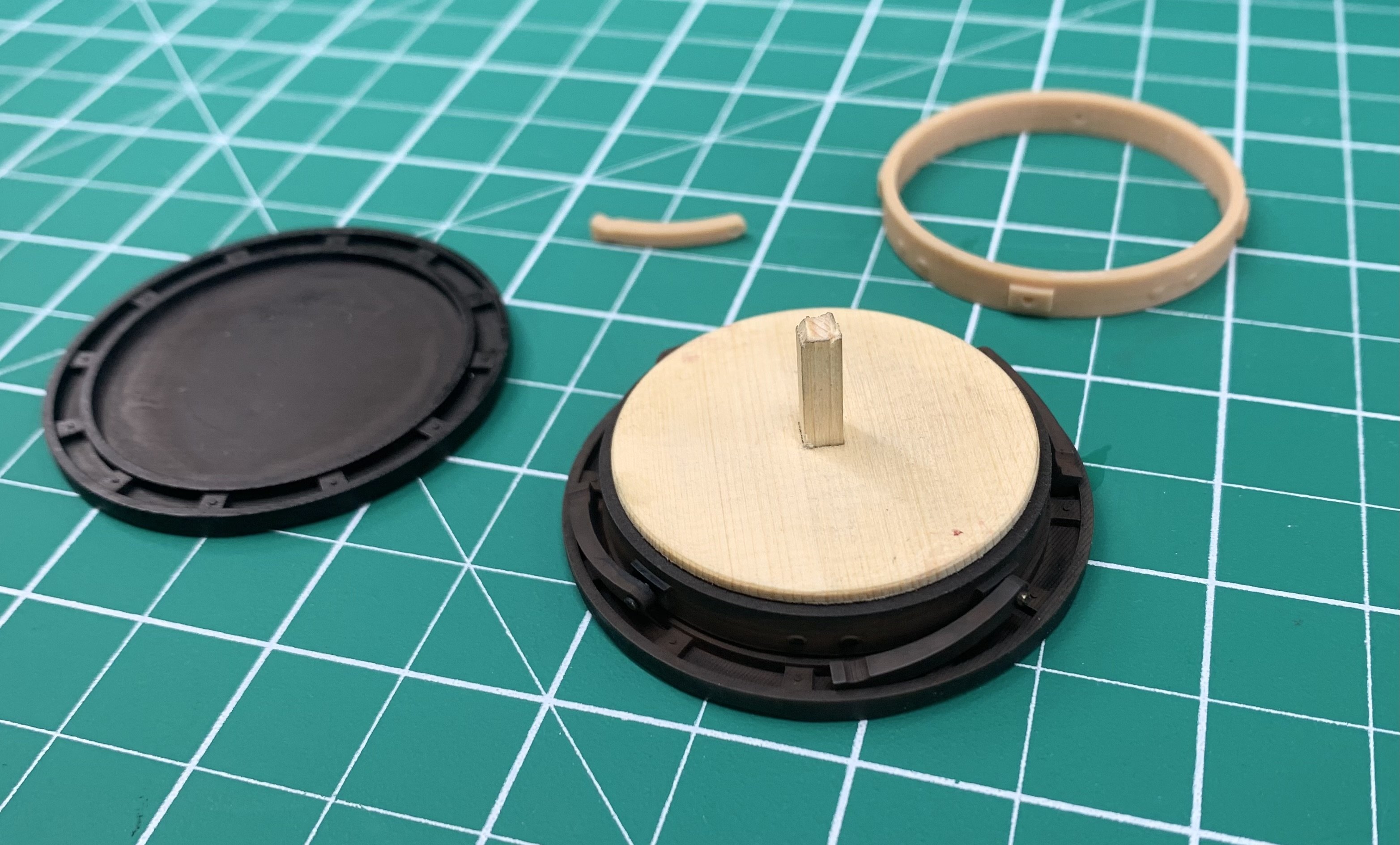

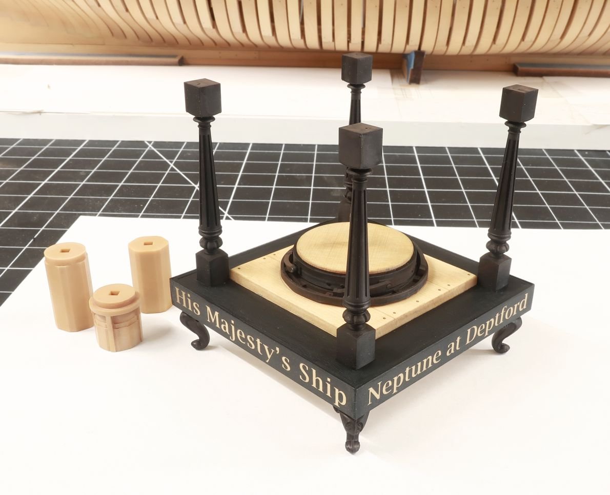

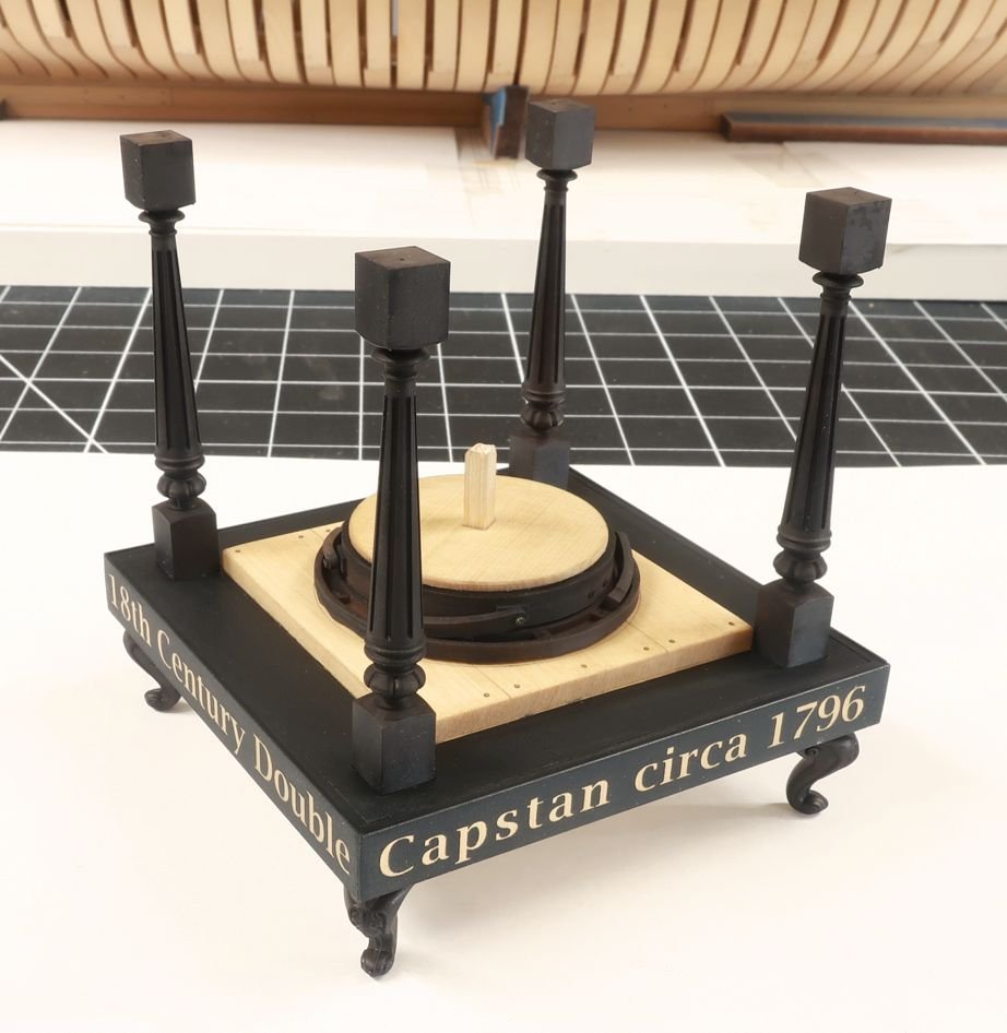

More progress...only the upper capstan left to build and some paint touch-up.  This is a quick project.
Thank you…Its a working capstan.  So far I havent glued the center drum so it wont turn.  If I can manage putting the upper capstan in position when its done without gluing it to the hole on the top platform…it will turn freely and the pawls actually work.
