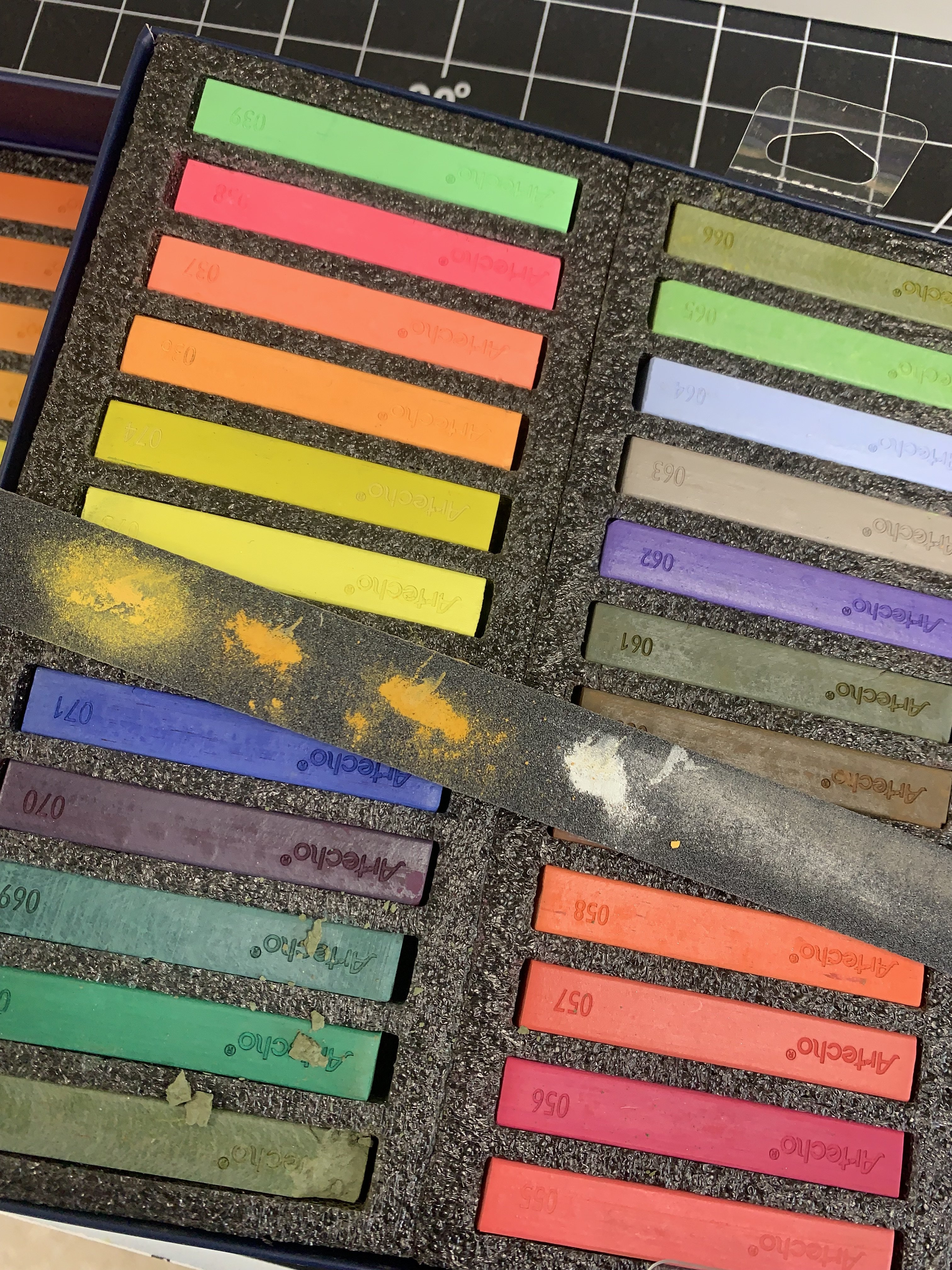

And while we are discussing finishing techniques.  Many of you have seen me use weathering powders for a million different things on a ship model.
weathering powders are great but they are ridiculously expensive.  I still use traditional weathering powder sold in small jars.  But for several years now I have switched to artists powder pastels.  They can be quite expensive too.  But a medium quality set works just as well for our applications.
I use a sanding stick as my palette or a small square of sandpaper.  The pastels will last you forever and come in a much wider range of colors suitable for our ship models.  Look at all the variations of browns and yellows and ochre shades.  I use them everywhere including on my 3d printed parts so they can look like wood.
just rub the pastel on the sanding stick.  You would be surprised how much fine pigment powder this makes.
Then use a dry paint brush or “stomp” to pick up the powder and apply to your part.
Yes you can even dip your brush in some water to give it a more painted or different look.  This also helps it settle i to the grooves and cracks much like the wet on wet acrylic technique.
sorry for the long post I I hope you find this useful and might try it some day.
This pastel set cost me $20 on Amazon.  It comes with about 75 colors.  Try and buy that many jars of weathering powder and see what it will cost you.

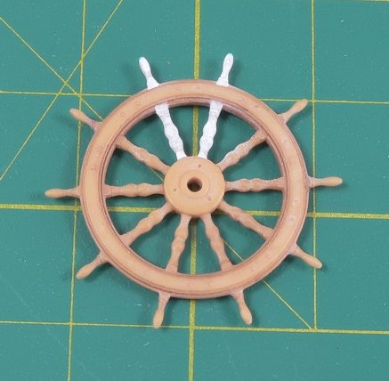

And finally....those pastel weathering powders can be applied to good effect.  On that very same test wheel with the wet on wet wash.  I then applied some white and gray pastel powder to two of the spokes.   I am sure you have seen those wheels on contemporary models where the spokes are made from ivory but the wheel rim and center drum are boxwood.   This is an easy effect to make with weathering powders or even paint if the wheel is a decent shape and color to begin with.  I have no idea why most companies who sell 3d printed parts insist on using that battleship gray color.   So many more possibilities when you use a tan or wood colored resin to begin with.
Can you imagine what this wheel would look like if all the spokes were treated to look like ivory.  Its a little blown out in the photo because of my bright lights on the work bench.  But you get the idea.  This took me about 2 minutes.  You just have to be careful not to get the powder everywhere else and blow it off.  Dont brush it off the areas you dont want weathered.

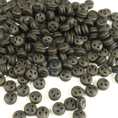

Lightly Buffed and Ebonized Deadeyes.   These are not just dyed black.   These are specially dyed and buffed to a dark golden brown color much like real ebony.  For those of you who like this finish on their blocks and deadeyes, Over the next two weeks you will see these made available.   I am starting with Deadeyes of course.

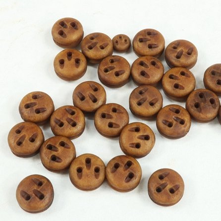

Swiss Pear 3D printed deadeyes are all now back in stock....enjoy!!!  Hot out of the oven....so to speak...

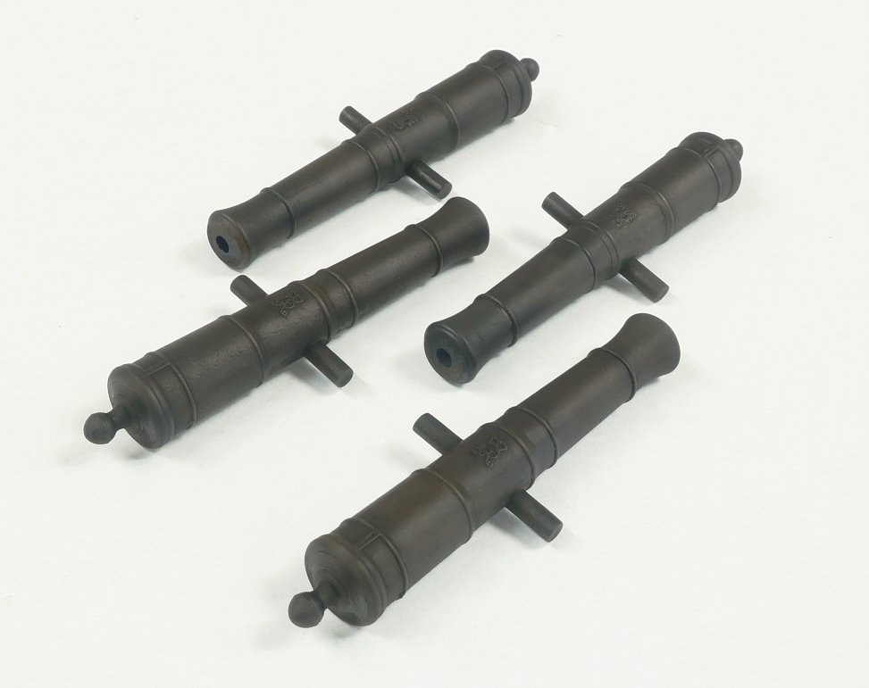

Restocking 3D printed Cannon now guys...
I realize some of you have been waiting for certain sizes for a while.   Should have them ALL restocked in a few days.   These below are hot off the printer.
Please examine the color and finish and texture closely.   Most 3D printed guns really look fake and plastic.  They look so black and with an odd texture.  I am quite proud of the texture and finish on my Cannon.
Hope to have them all back in stock shortly.
So would you recommend using your cannons unfinished? Or painting them?
These are ready to go straight out of the package.  If you like a more weathered look you can of course do that but these are already blackened and look as though they have a bronzed gun metal finish already.  What you see above is what you get...
Now the trunnions are left a bit long so they will fit any carriage width.  Just in case you dont use mine.  So when you shorten the trunnion to fit any carriage you will probably have to just paint or dye or weather the trunnion ends.  A small price to pay for such nice detailed cannon with a proper quality finish.
