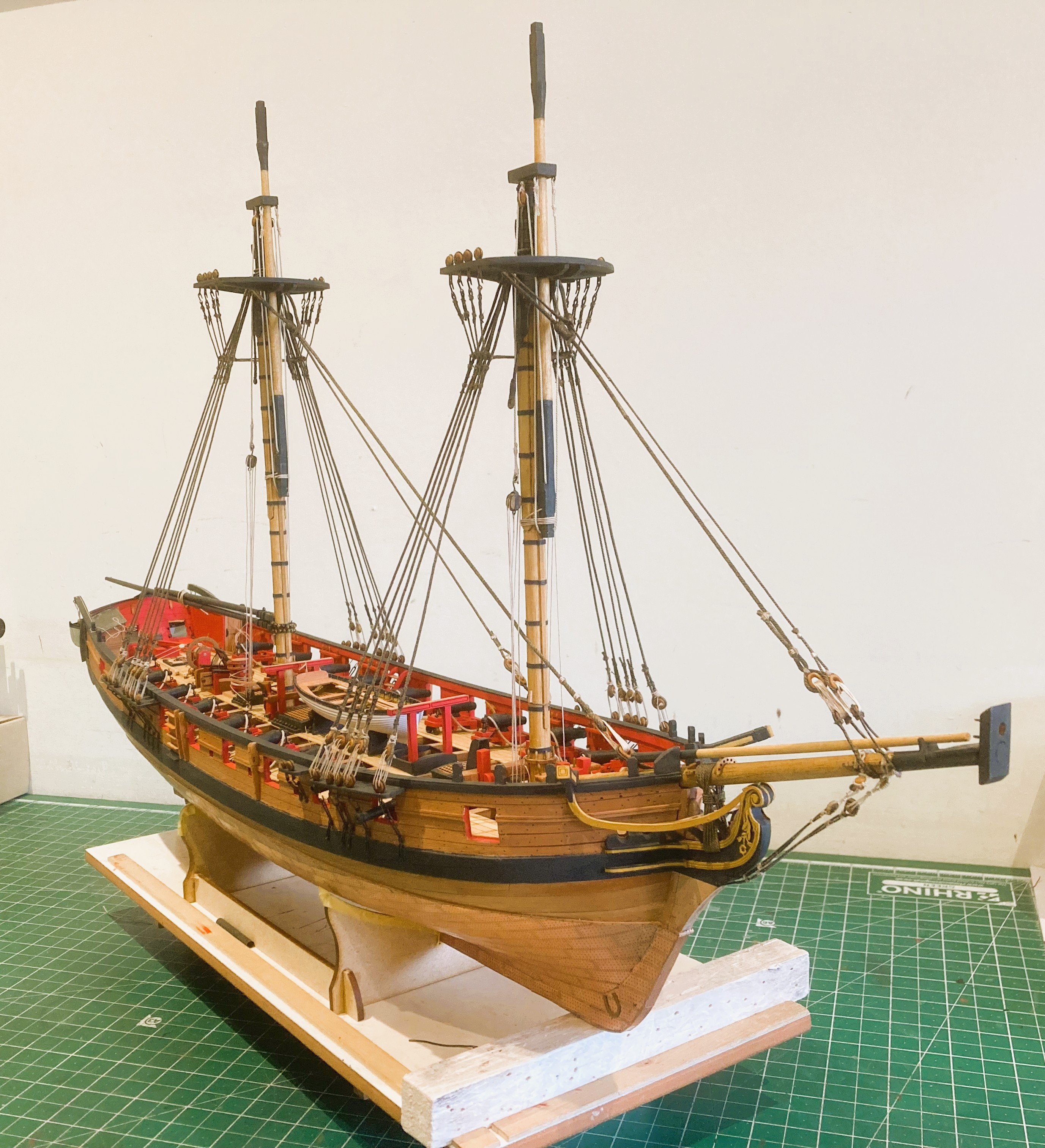

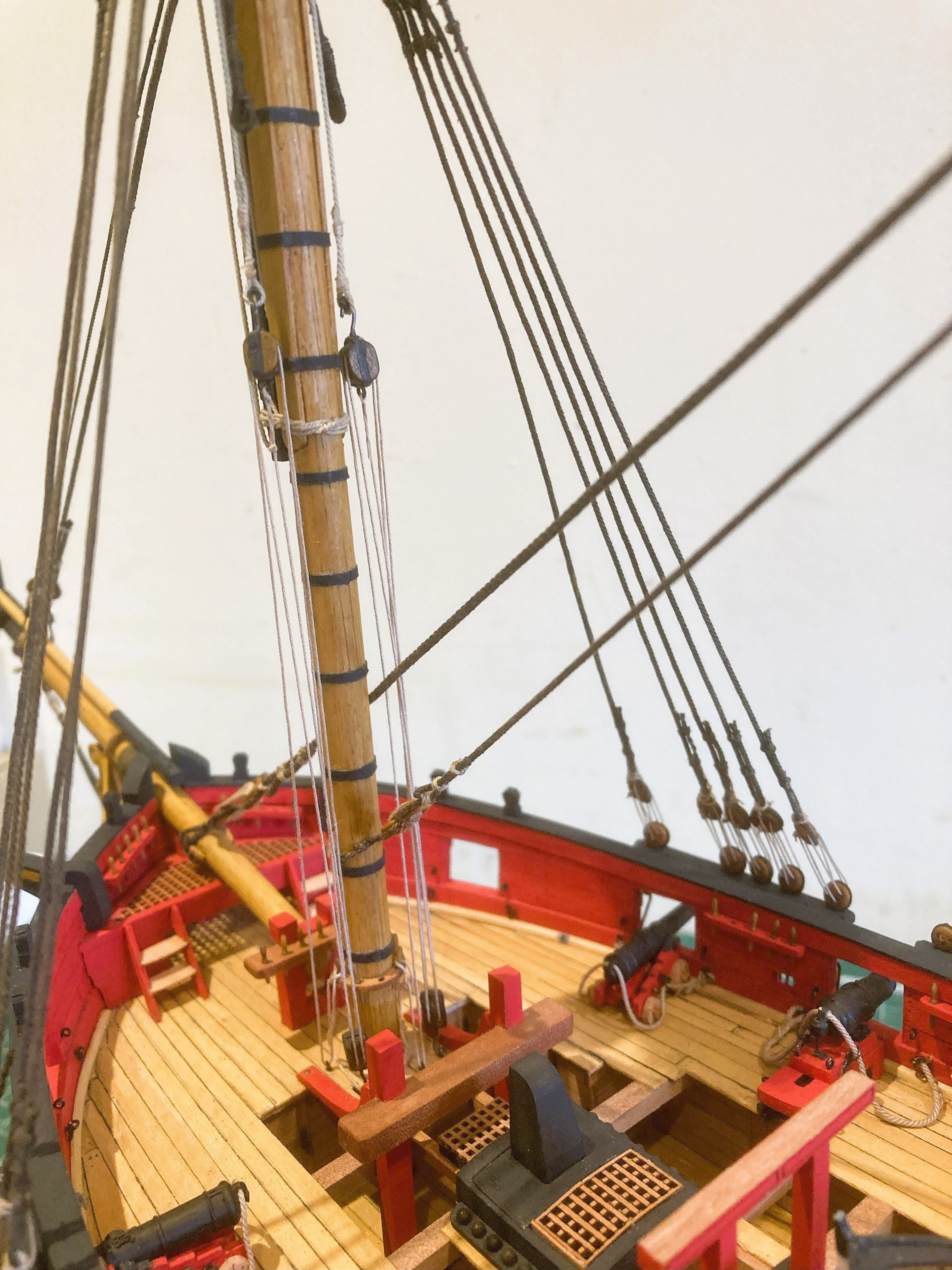

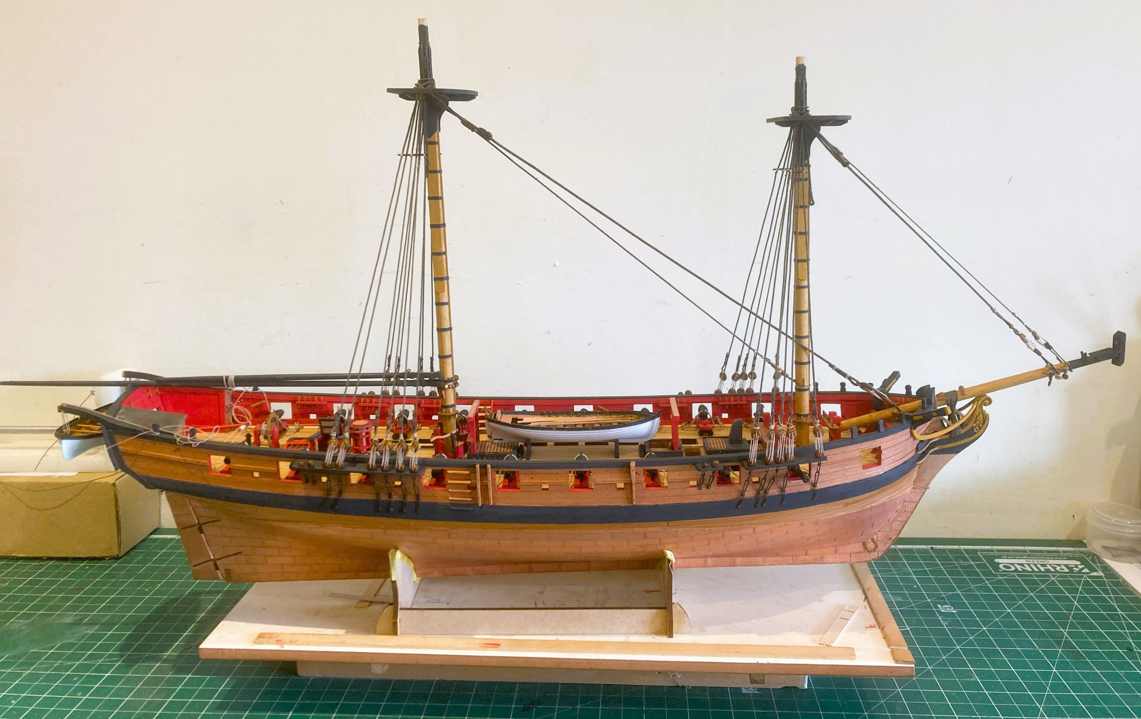

In the lowered position would be an interesting and somewhat unusual way for a model to be displayed B.E. and therefore adds an extra degree of interest to the model. I’m liking this arrangement.
6 hours ago, CiscoH said:
I agree the lowered topmasts look most interesting and least obscuring.  Gets my vote, if you were looking for opinions
This has my vote too, BE.
I like the appearance of a working ship because it adds a great deal of interest and uniqueness to the model.  On my slowly building Sphinx, for example, I intend to have one of the boats being lowered from the pendants.

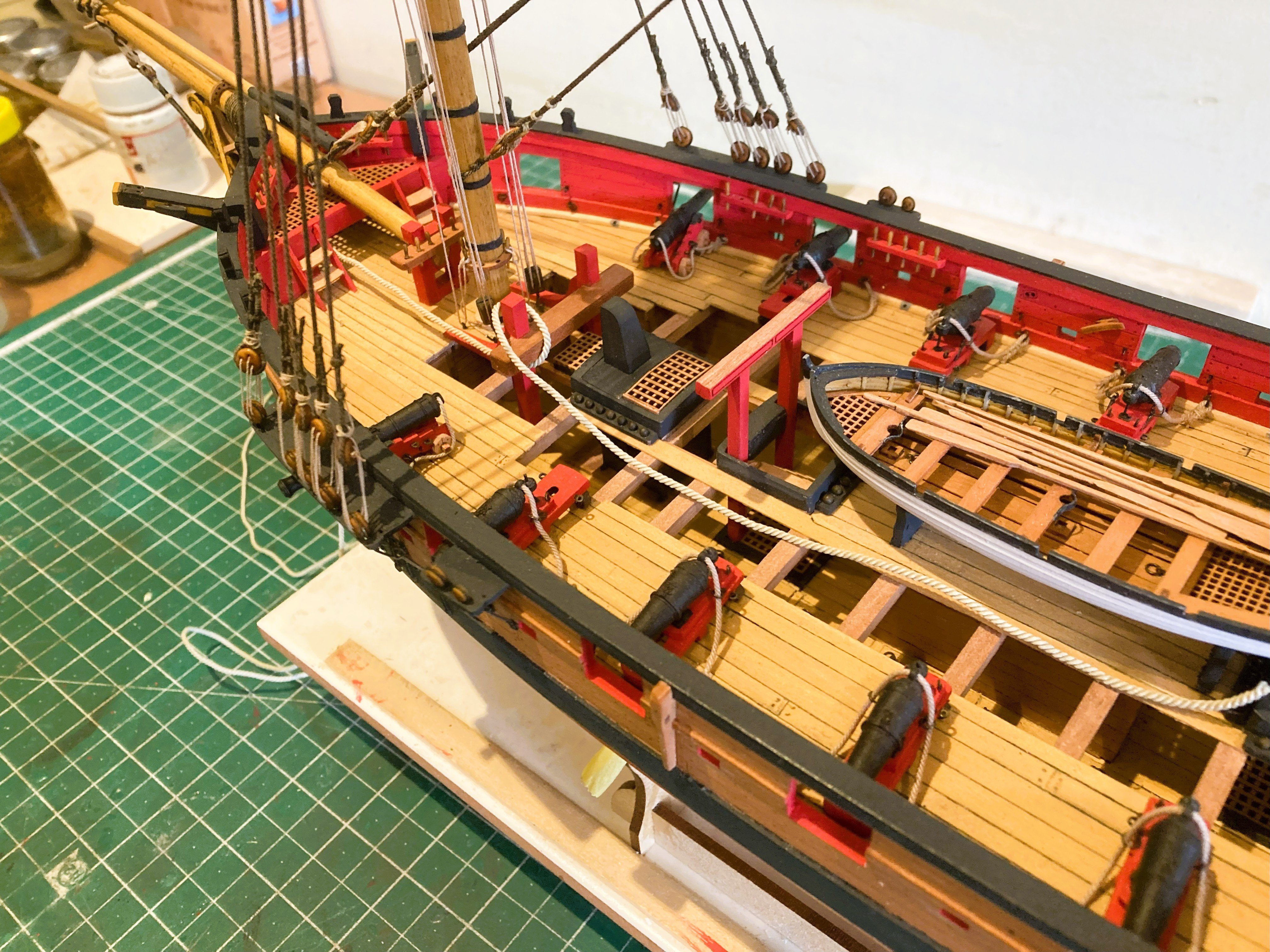

Gaff and Main Boom
This is an opportune time to attach these to the Mainmast, easier before the shrouds are rigged.
I used Boxwood parrel beads rather than the shiny black kit versions.
4854a
4855a
4848a
These were coloured using Dark oak wood stain.
4843a
No rigging for these items but seized together for convenience.
I may rig the sheet simply to hold the booms in place.

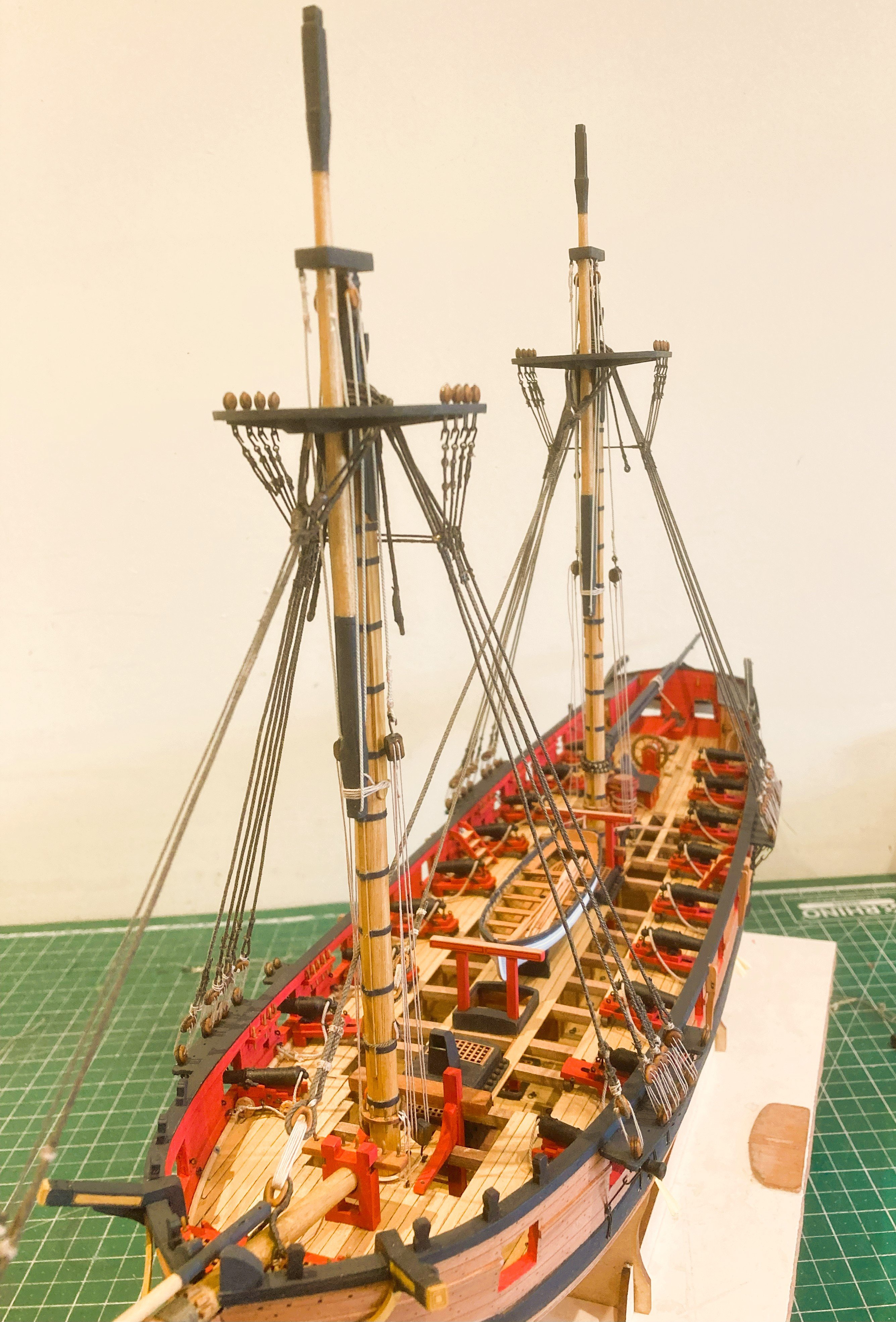

Post 93

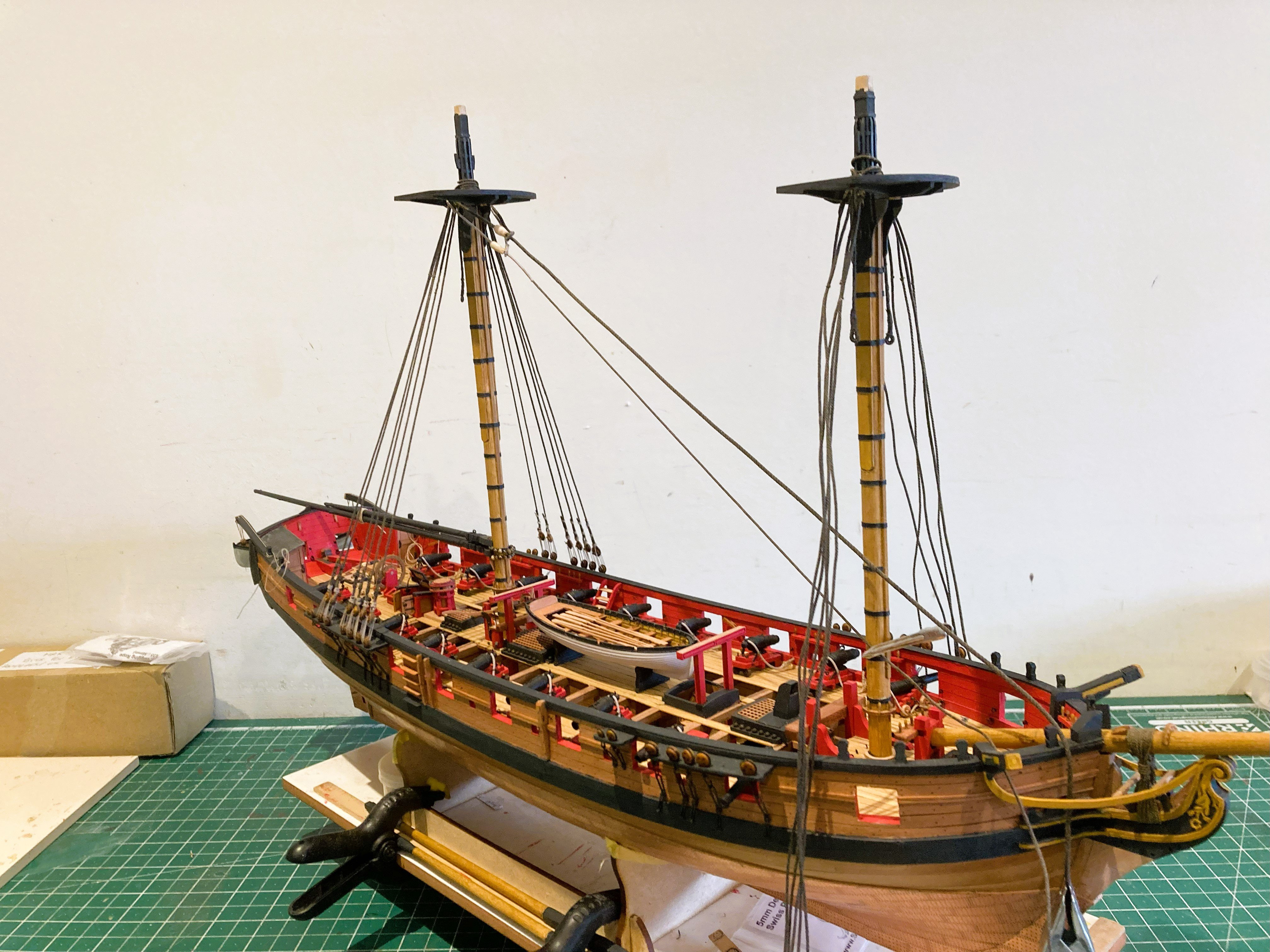

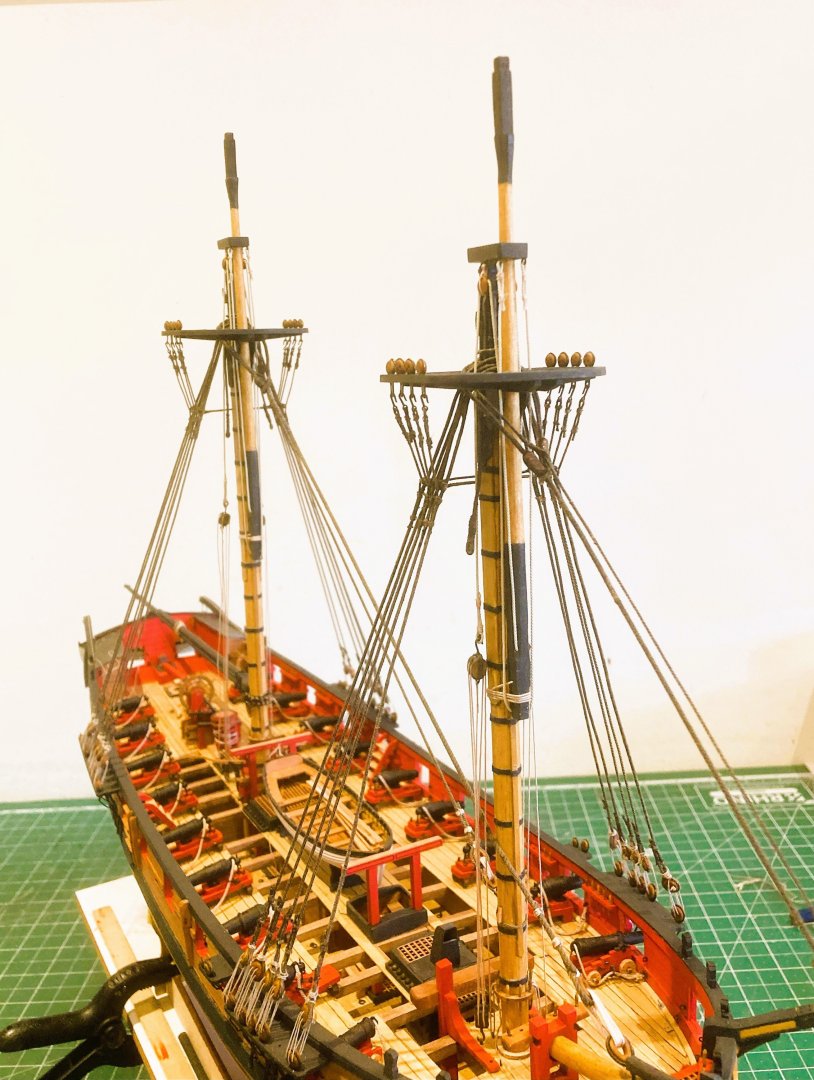

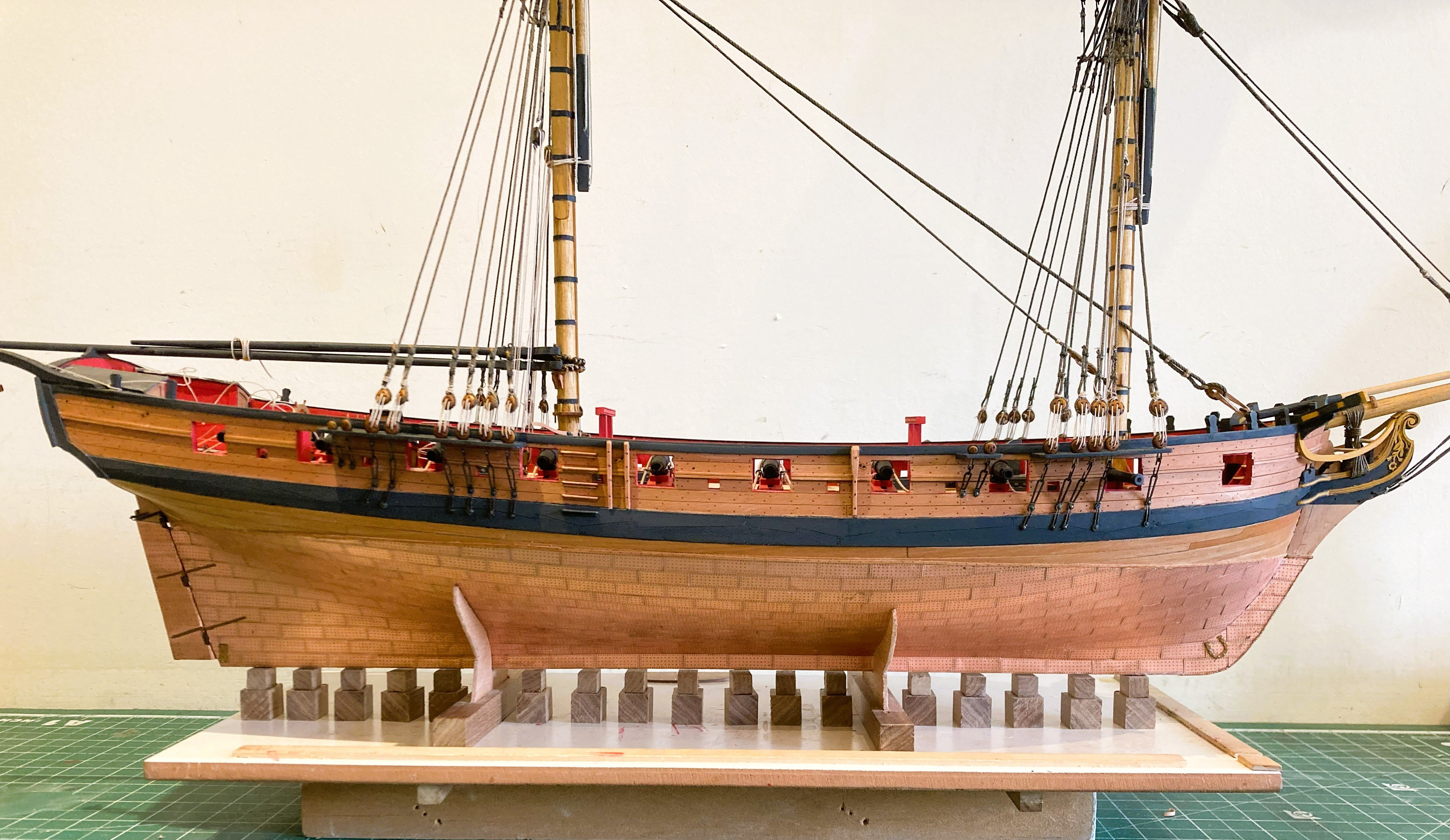

Fitting the shrouds.
It has been some five years since I last did any shroud rigging and I’m feeling a tad ring rusty, and getting the first shroud rigged took a while, including a full ‘re-do’.
4878a
Each pair of shrouds were stretched before fitting.
4828a
The first shroud is slightly more awkward due to the thicker ‘served’ line.
4847a
My approach is to set the first shroud deadeye (Starboard side) to the distance that suits my eye bearing in mind the norm of around  2-3 times the diameter of a deadeye.
The finished space between the deadeyes worked out at 7mm.
4868a
The tricky part is getting the shrouds level along the channels.
4872a
I prefer to rig the shrouds purely by eye, carefully adjusting the upper deadeye to suit the line as I move along the channel.
4869a
Not decided yet whether to dye the round seizings to match the shrouds.
4875a
4877a
The next stage is to make up the Main stays which are fitted before I attend to the Fore shrouds.
B.E.
23/06/2025

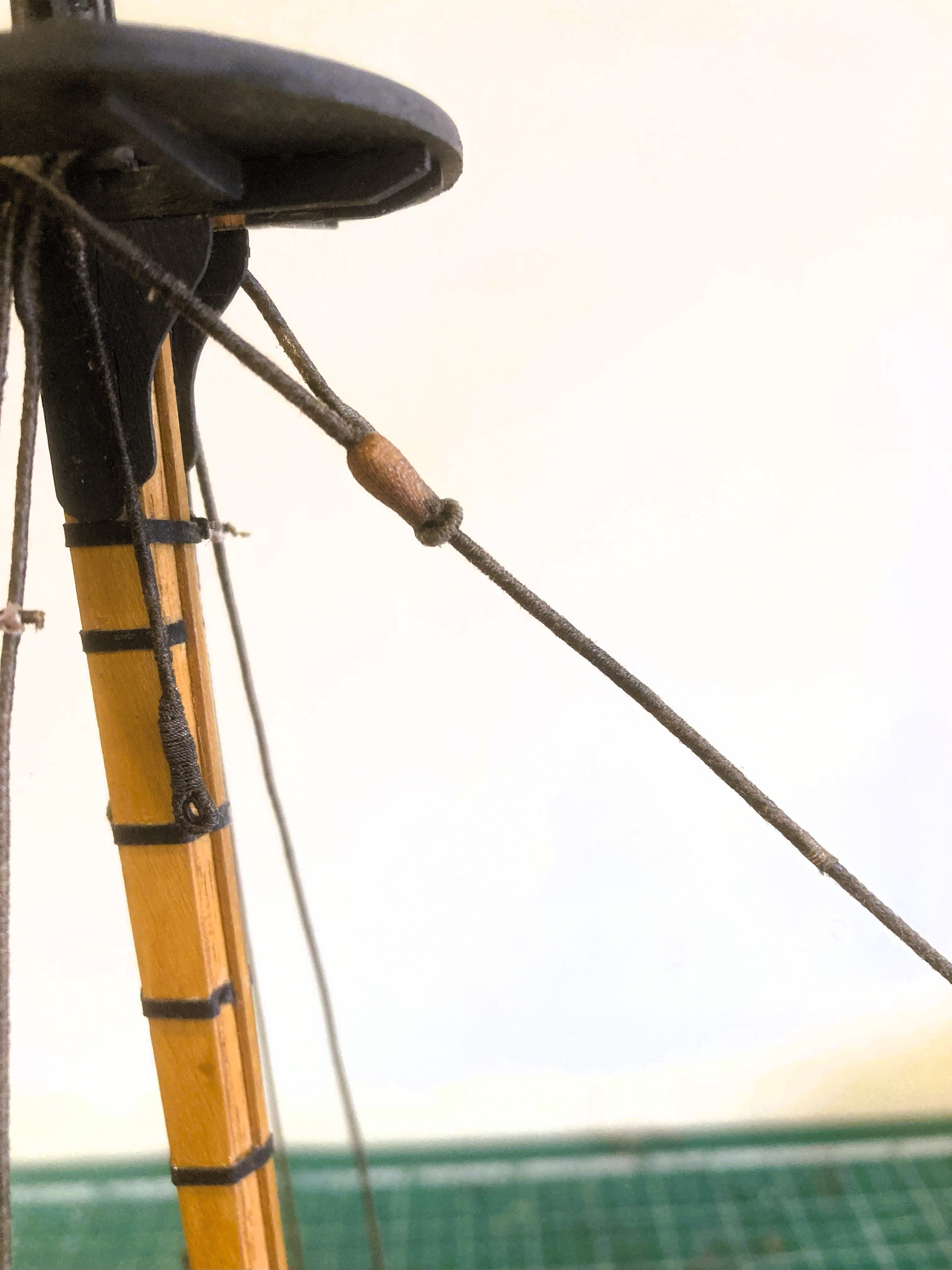

Post 94

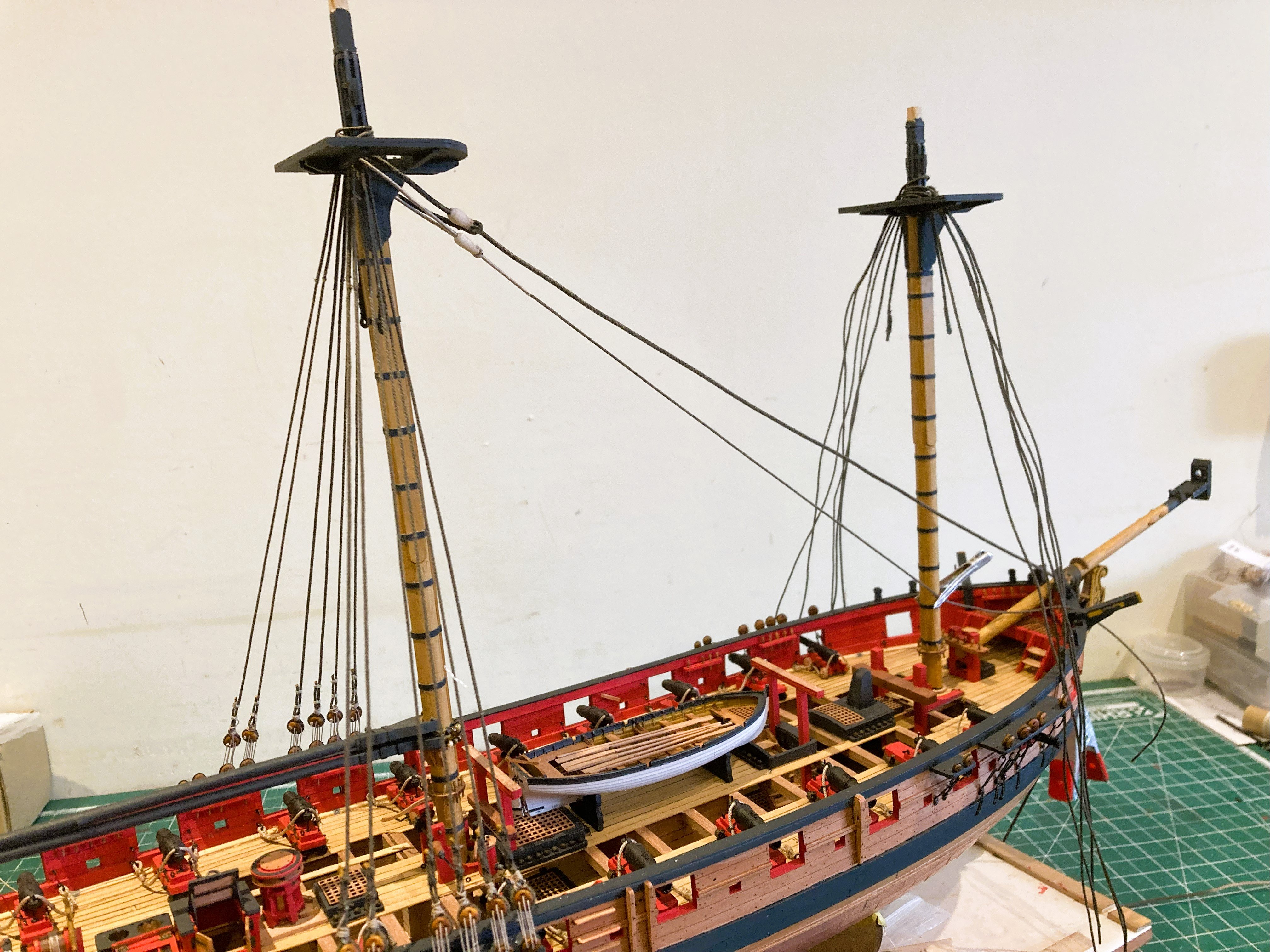

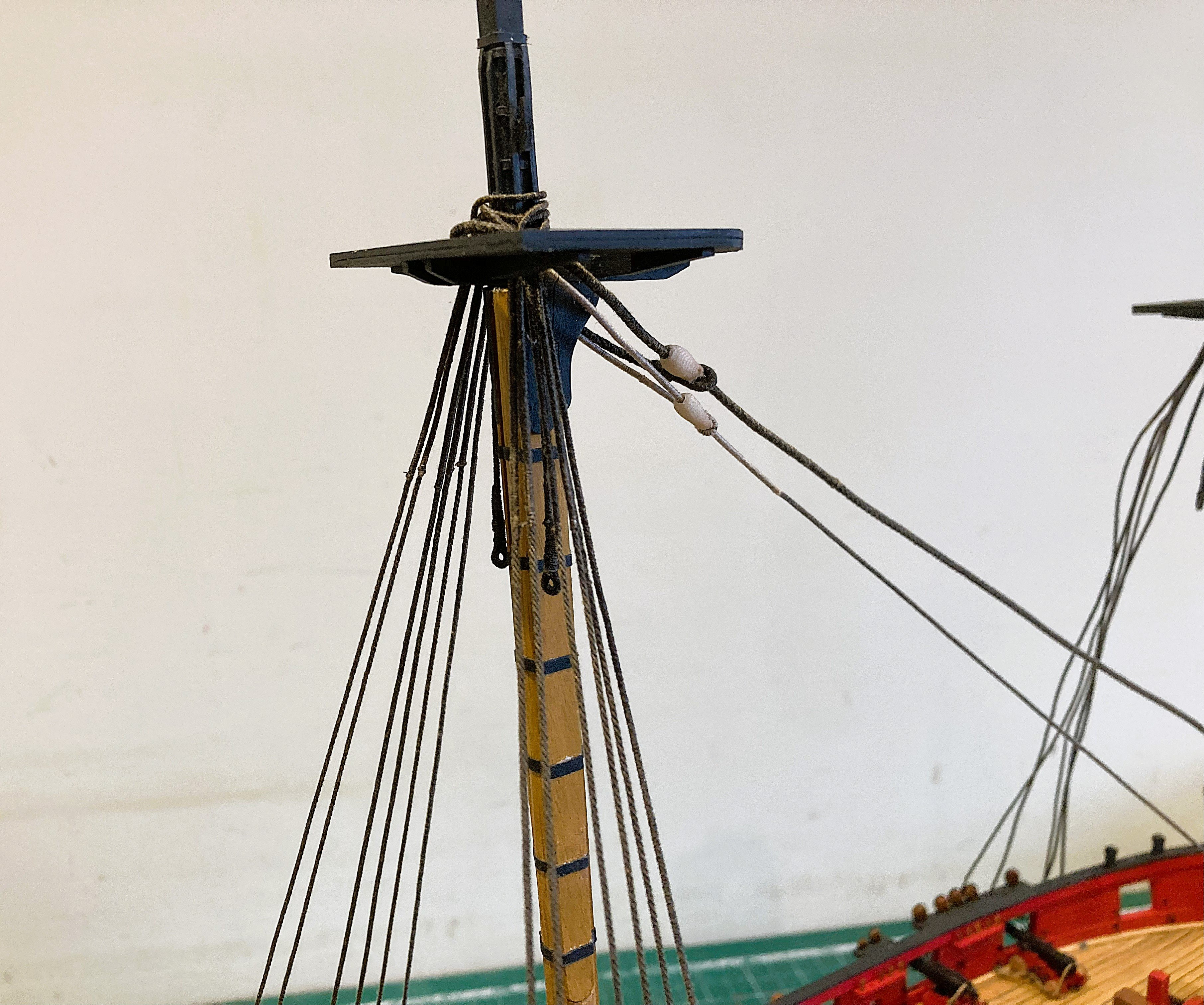

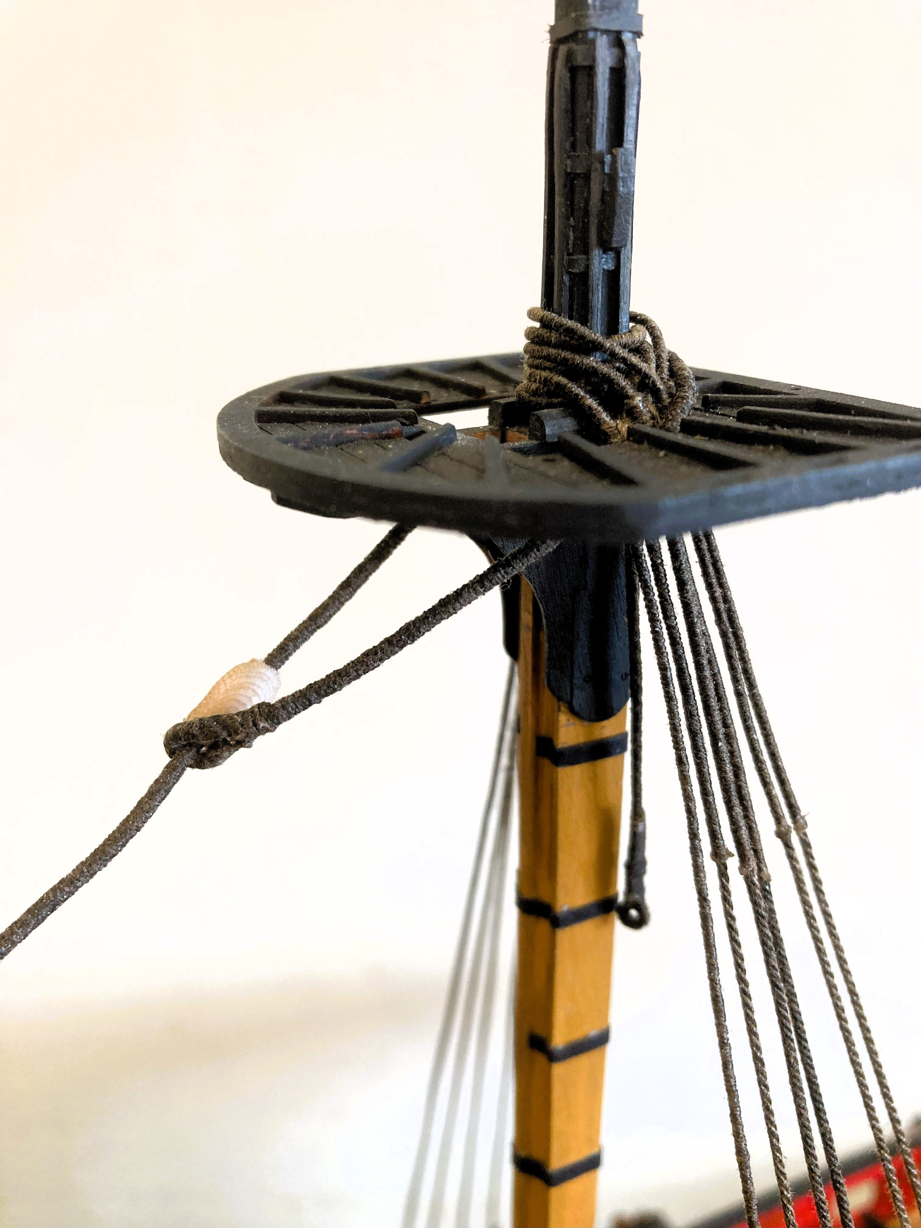

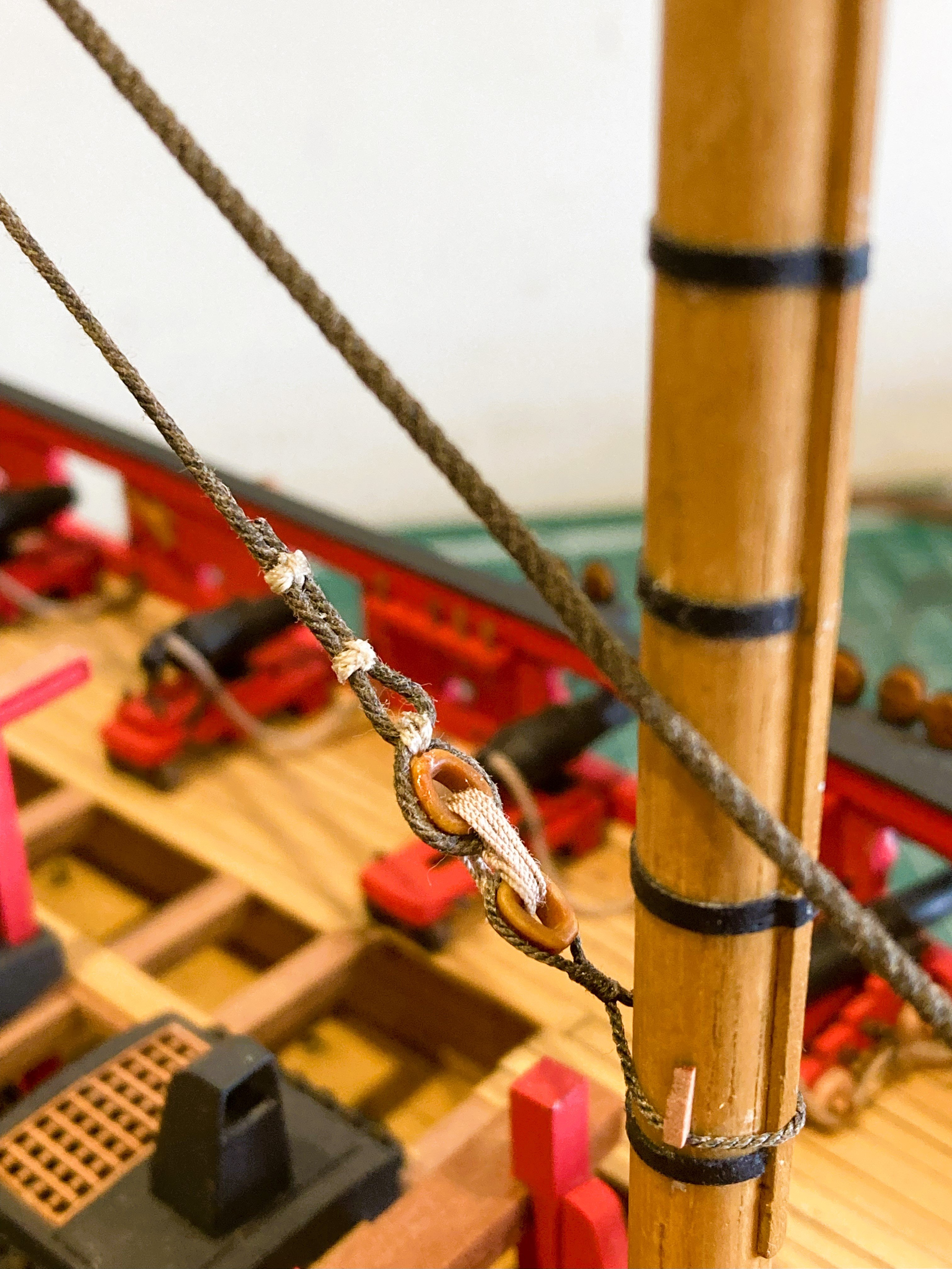

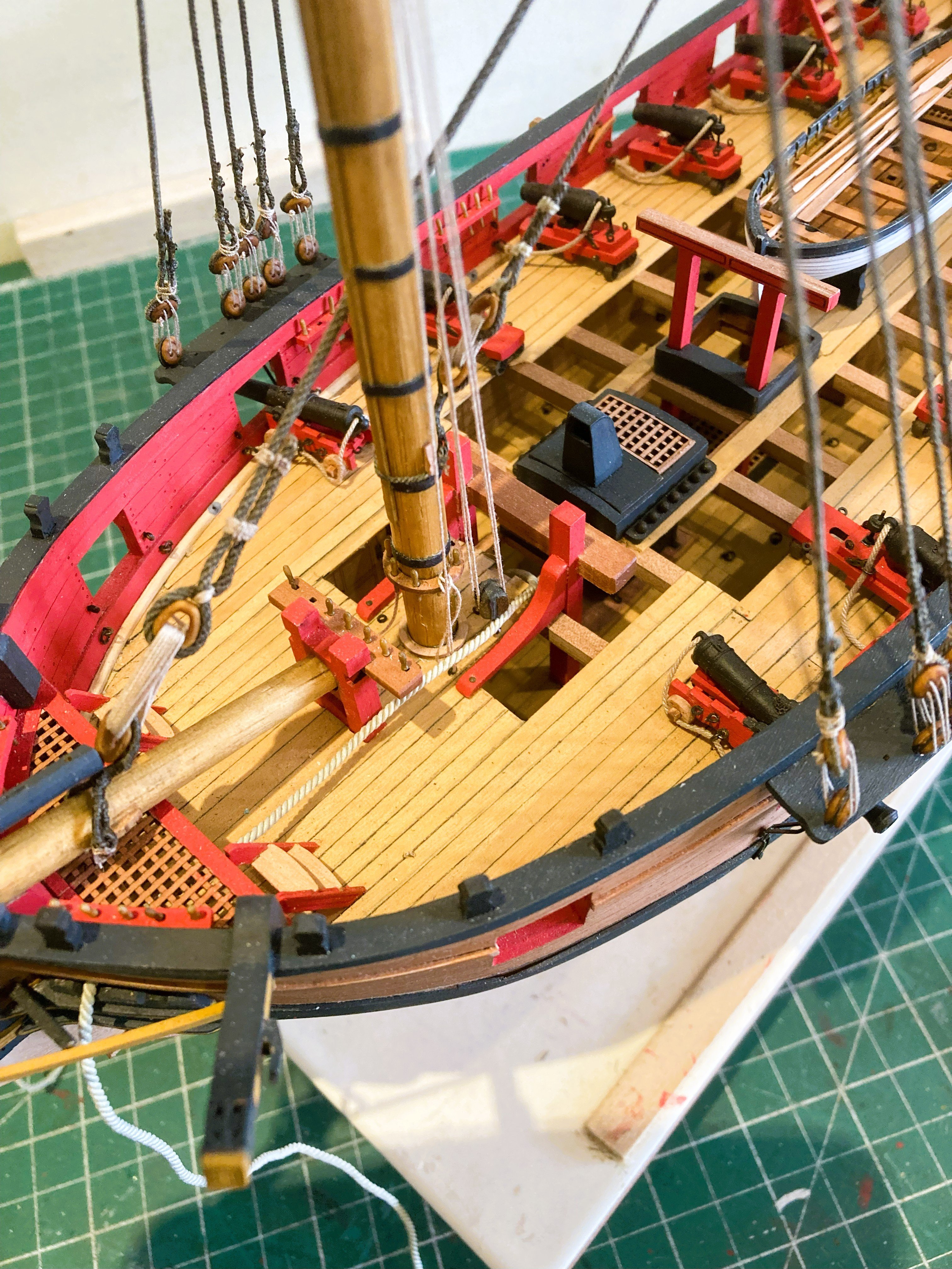

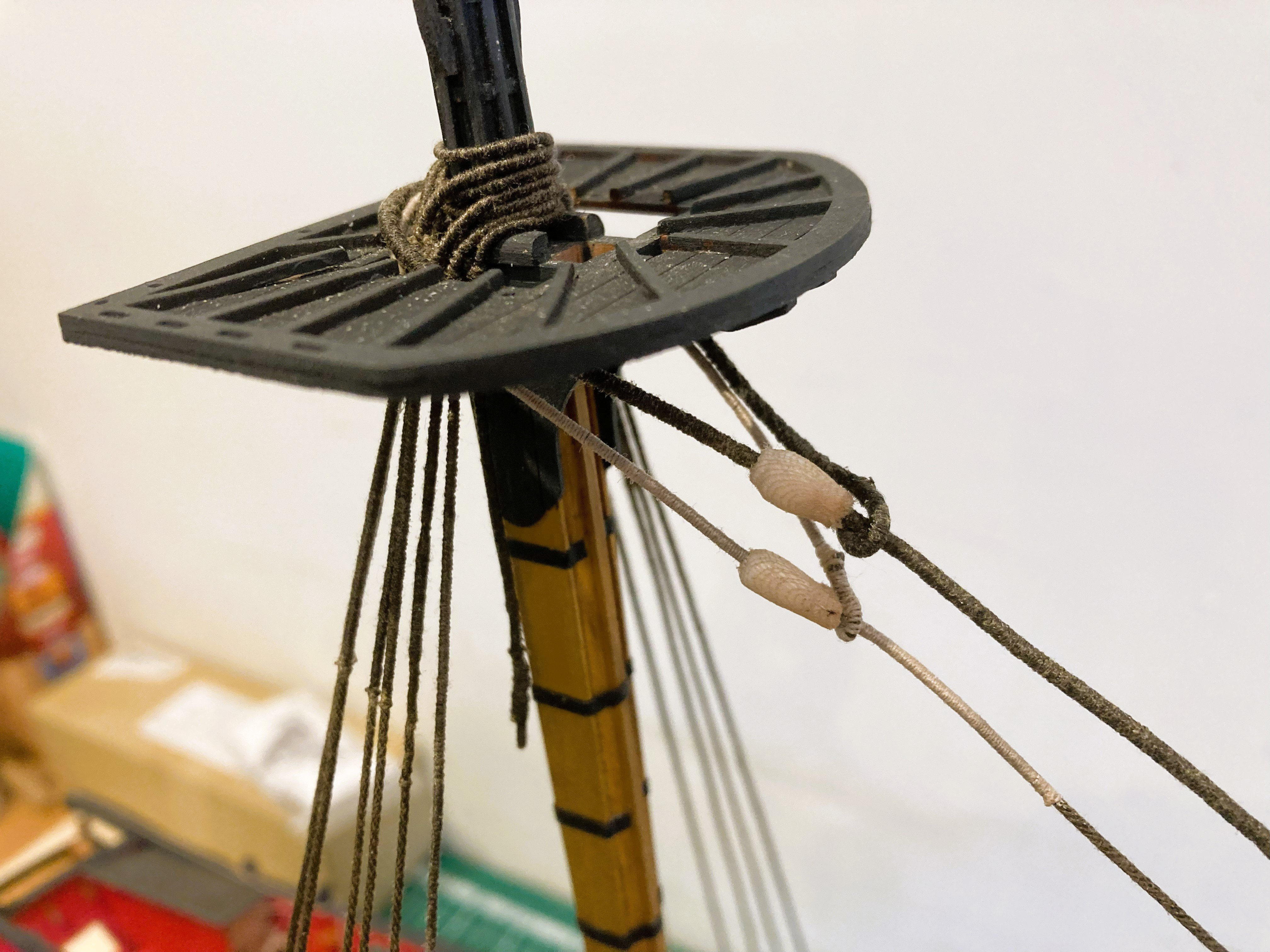

Main stay. (Part 1)
The kit plans show a simplified form of the Main/Preventer stays.
A more authentic version includes serving of the stay collars including the eye splice through which the stay passes, and a more stylish mouse to replace the kit plastic version.
The kit indicates use of deadeyes for securing the stays but I have opted for hearts which were more common during this period.
I am using Steel’s tables for an 18-14 gun ship.
 Mainstay                - 10”  - 1.26mm   - 15” Heart  (6mm)  Main Preventer Stay - 7”  -  0.88mm  -  10” Heart  (4mm)
The kit line dimensions are close to this using 1.3mm line for the Main stay, and 1mm line for the Preventer stay.
For the Mainstay I am using Syren 1.37mm line, and for the Preventer 0.88mm line. The lines are stretched under weights to remove the spring before fitting.
4880a
The position of the mouse needs to be tested on the model.
4881a
4884a
Here the  un-dyed Preventer stay serving is apparent, and the ‘weave’ of the mouse shows through.
4889a

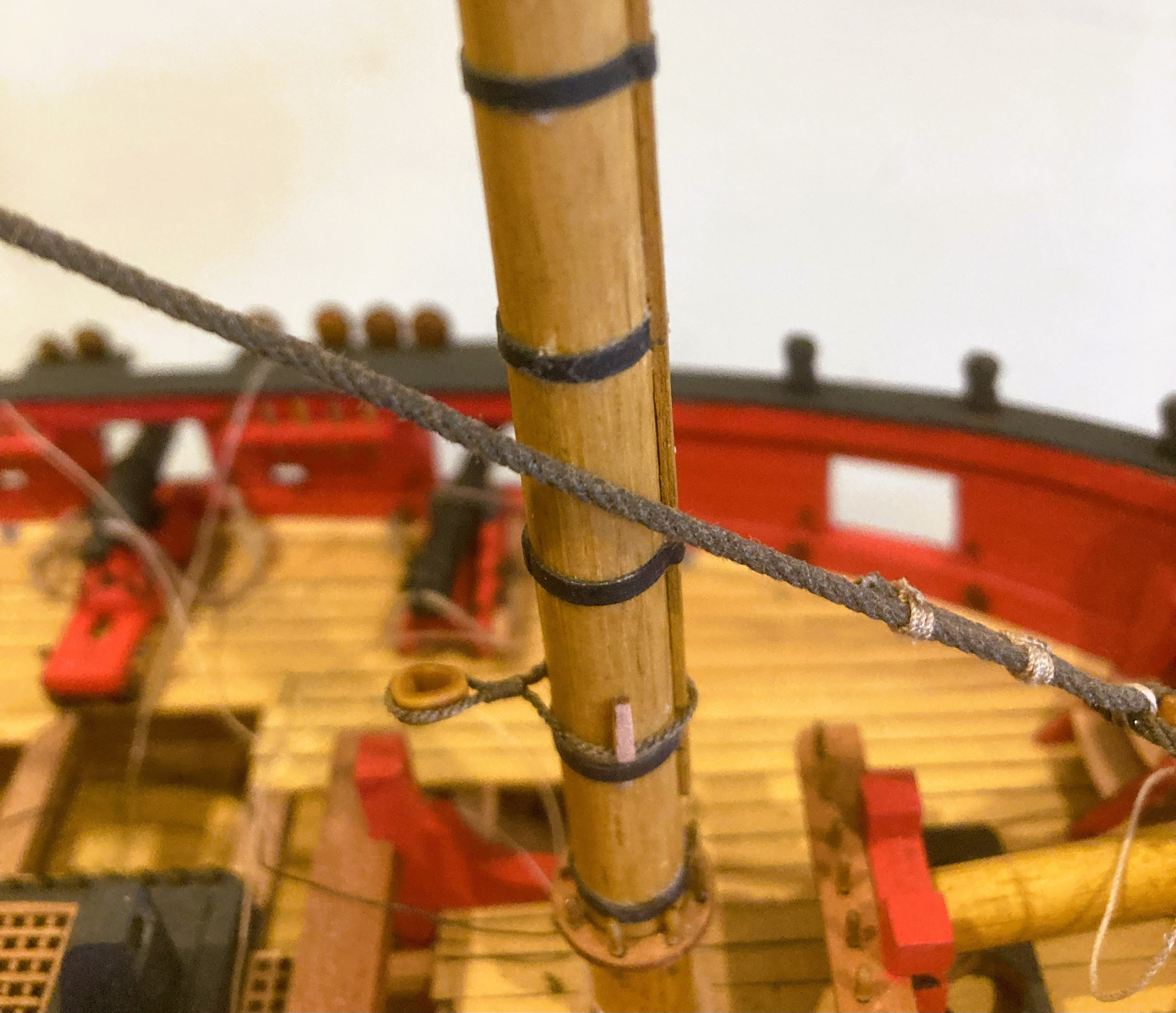

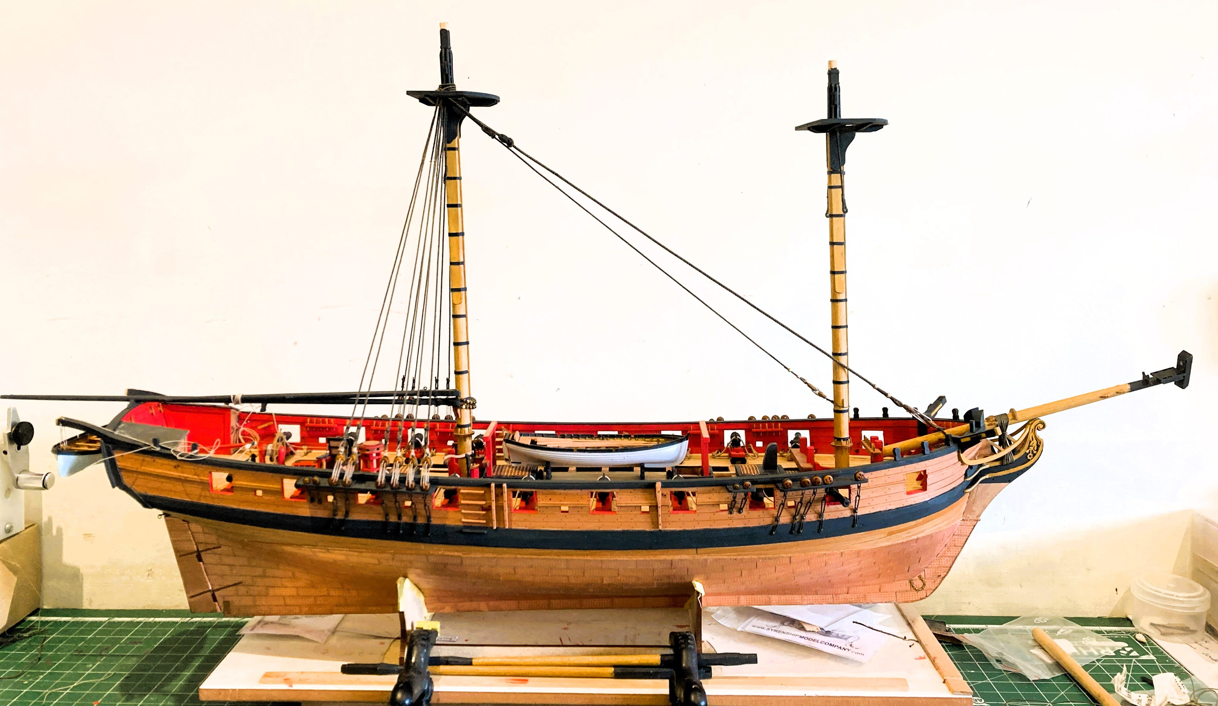

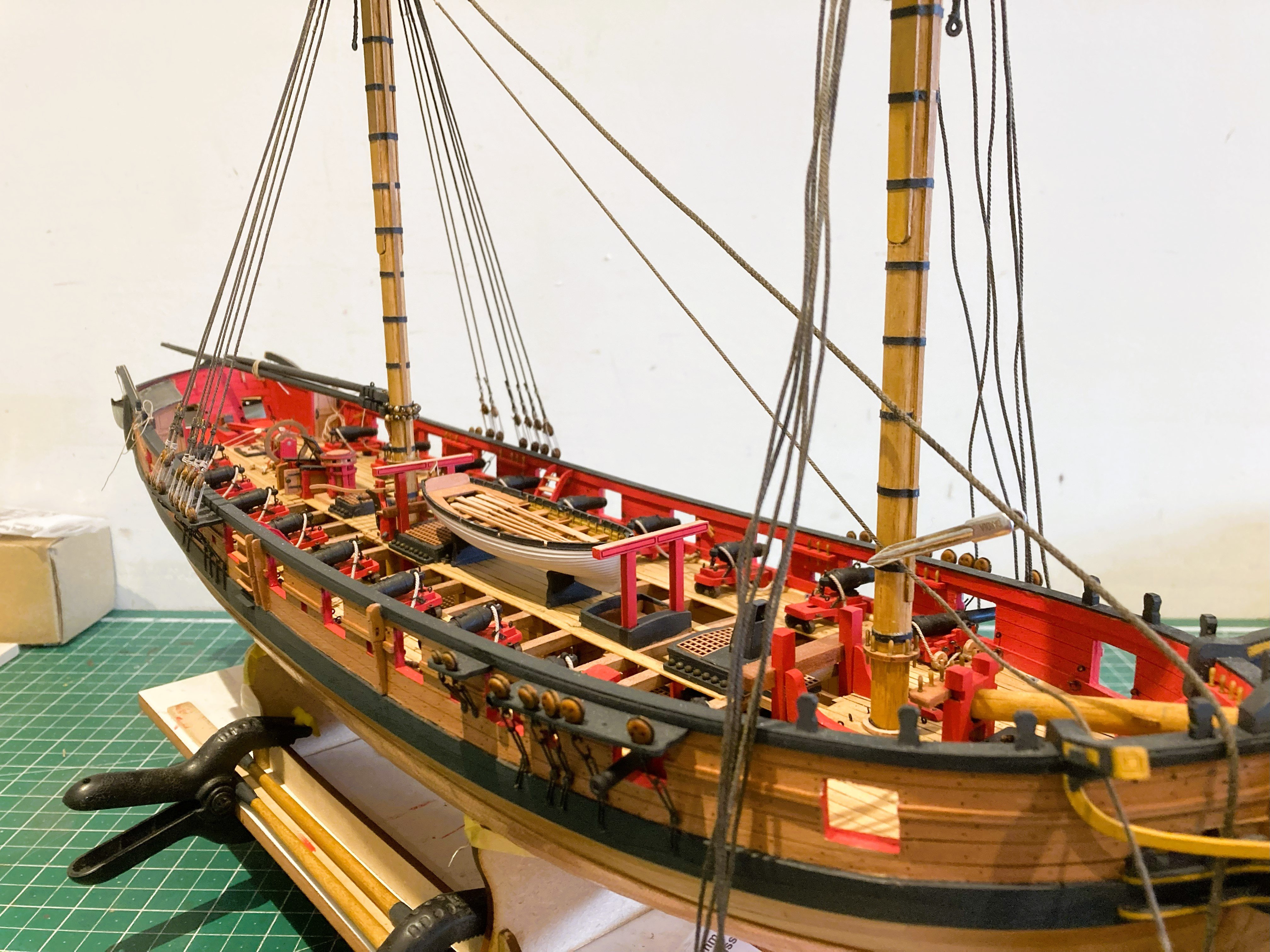

I have been thinking about the positioning of the stays.
The kit arrangement has the Main stay fixed by a collar to the Foremast, and the Preventer stay  running above it and beyond it to a collar on the Bowsprit.
I have some doubts about this arrangement, generally Mainstays run beyond the foremast to the bow.
Steel says that The main Preventer stay is lashed to the Foremast and the Main stay to the Bowsprit chock.
Lees comments that the Preventer stay was usually carried above the stay but that on small ships was sometimes carried  under it.
4888a
Full details of my preparing and fitting of the stays and the related Mouses is fully covered in my Pegasus log, so I won’t repeat it all here.
4883a
4890a
4885a
In the case of Harpy I have decided to run the Preventer stay below the Main stay, and reverse the locations of the lashings.
Onto the lower end stay fixings.
B.E.

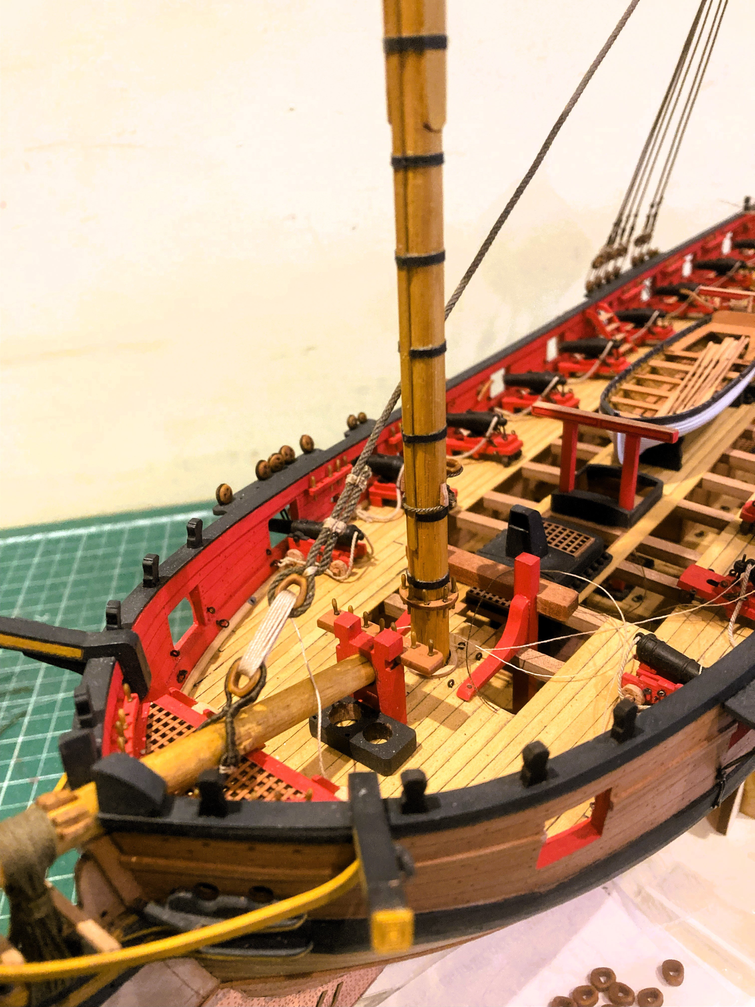

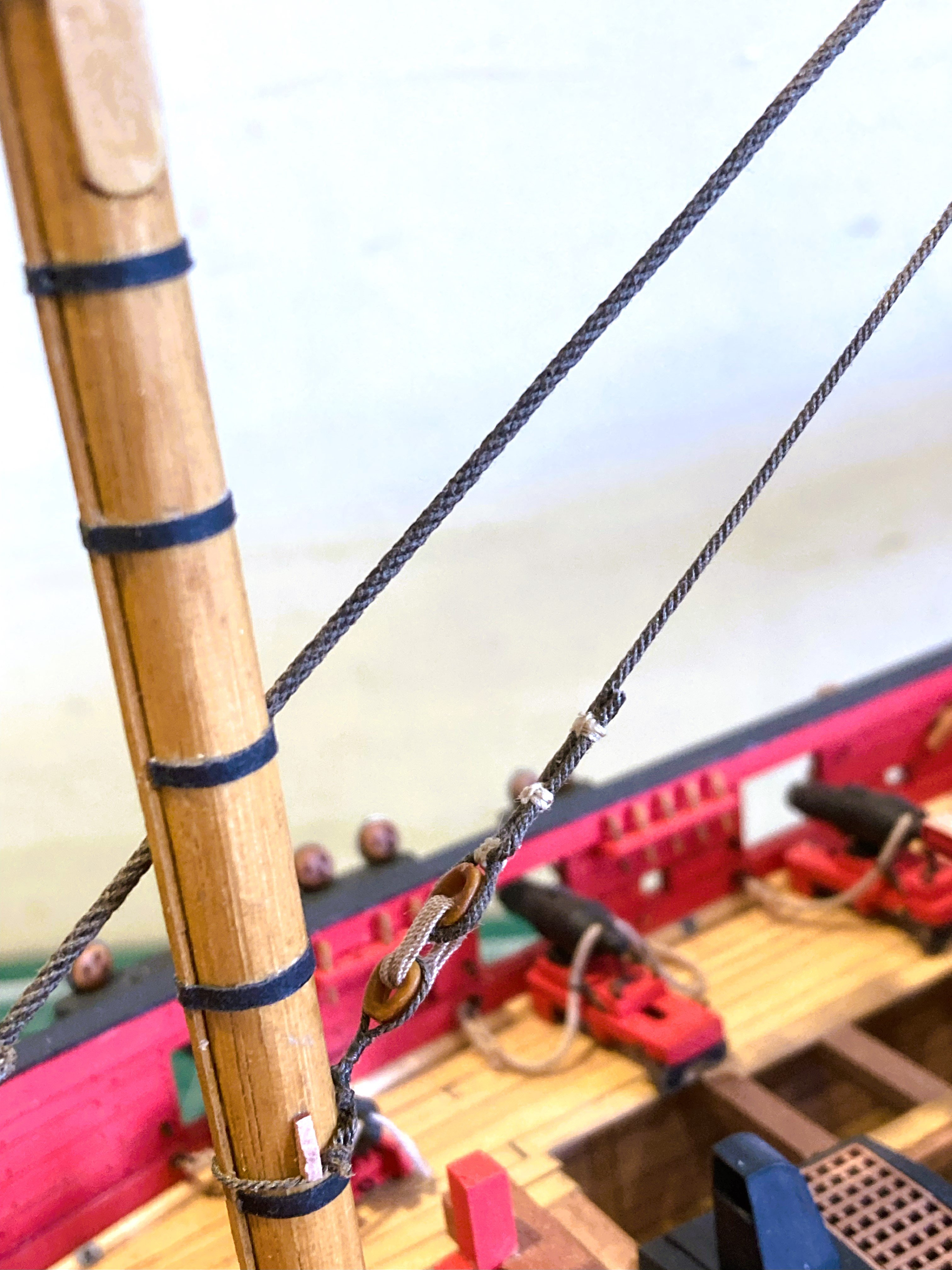

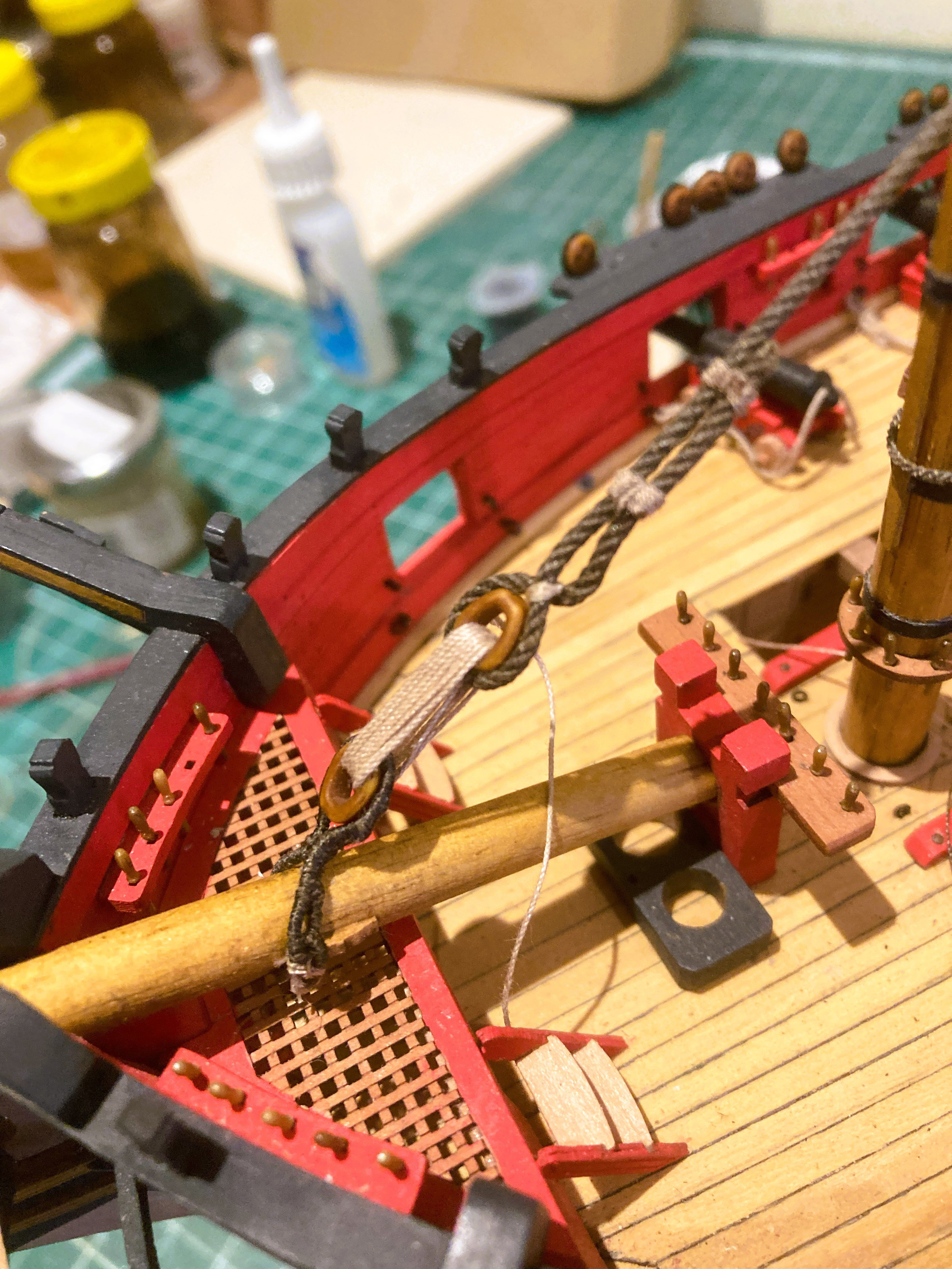

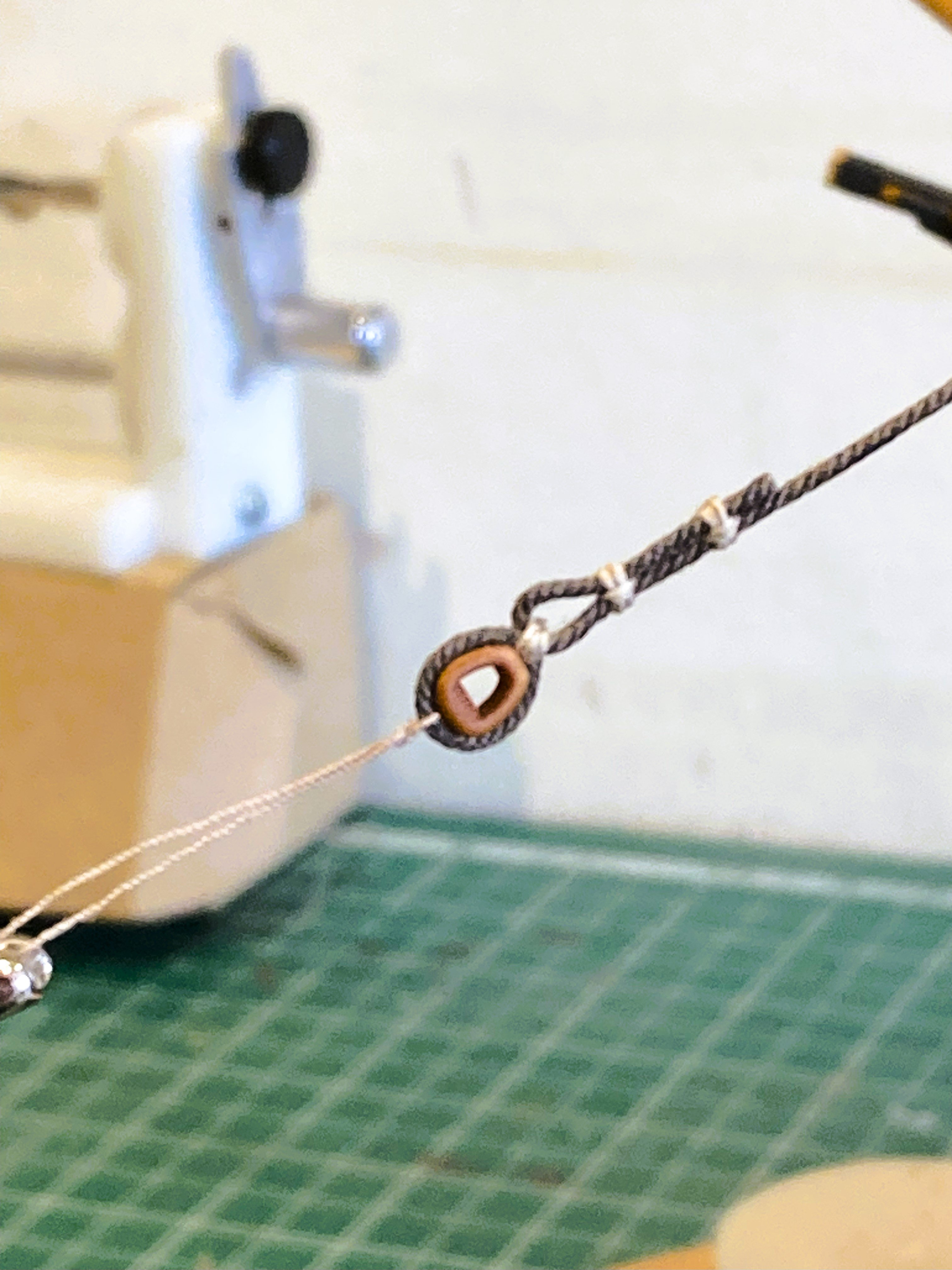

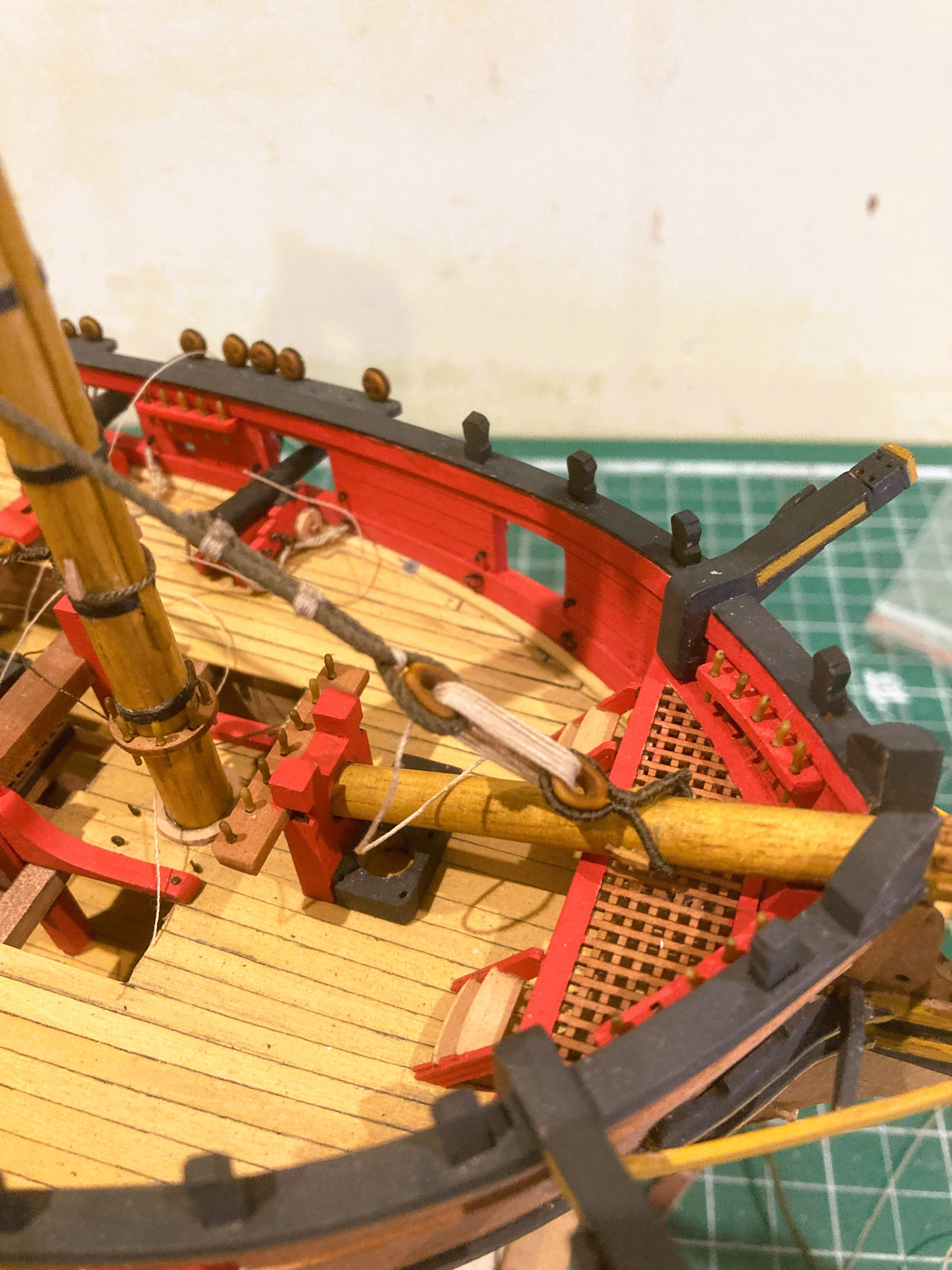

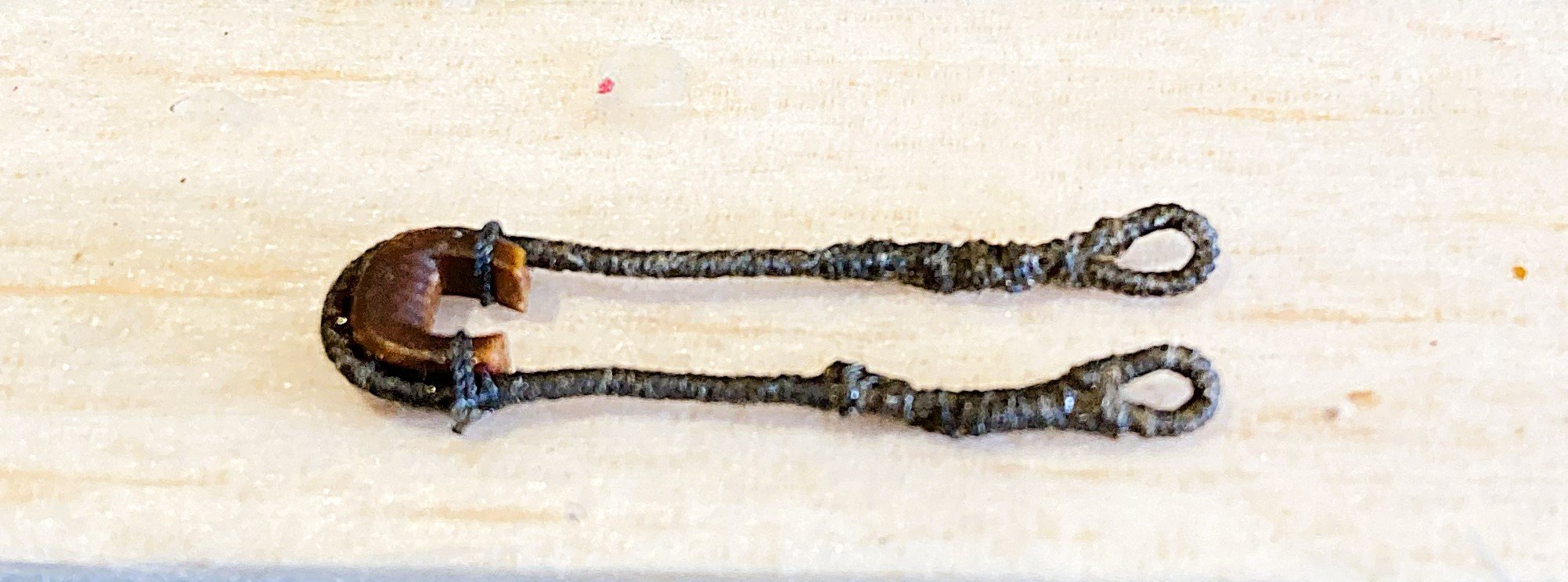

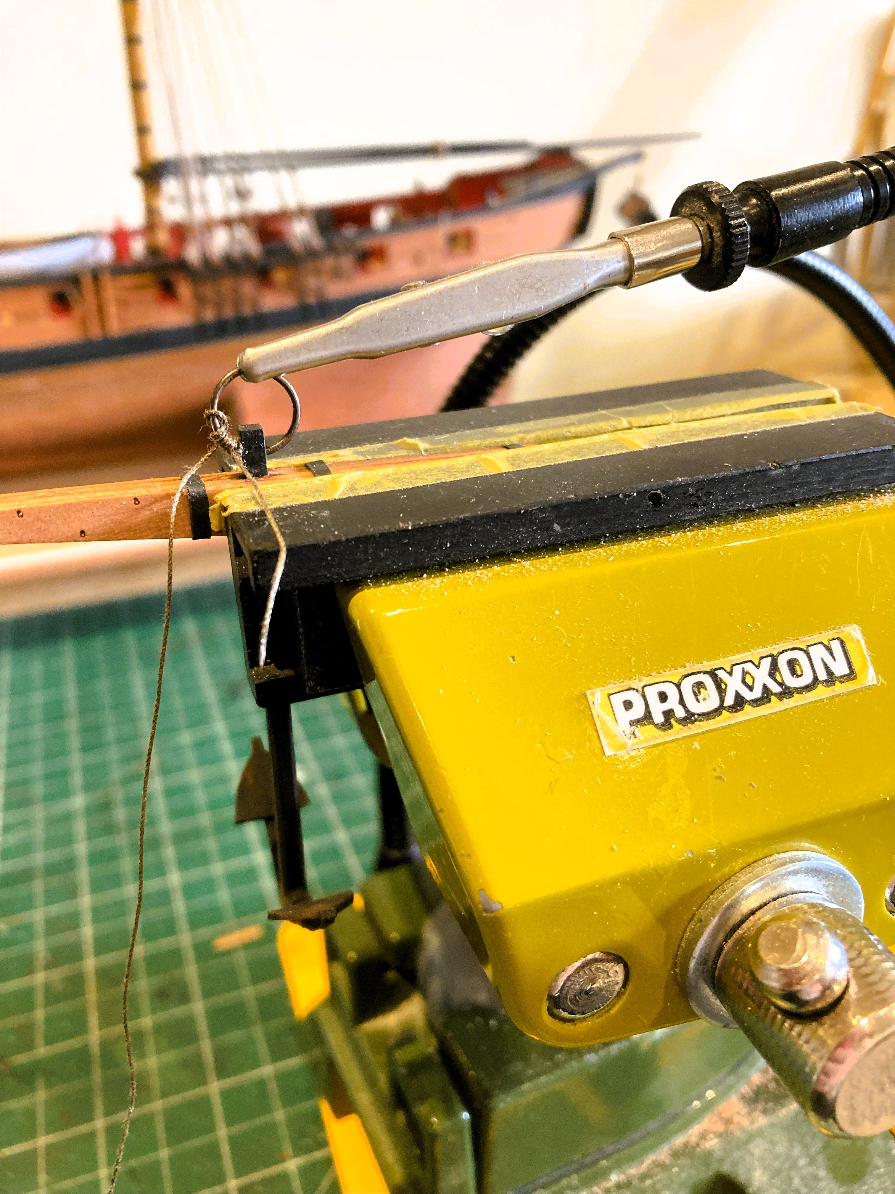

The lower end of the stays have hearts turned in.
I am using Syren Resin versions, (6mm) for the Main Stay and (5mm) for the Preventer.
The kit provided deadeyes for this purpose are easier to fit than hearts and lanyards, but were an old fashioned option by the  time of Harpy.
4901a
It is easier to fit the Preventer stay and collar with the Main stay and Fore shrouds out of the way.
I had fitted the Preventer stay at this point but found I had fed it incorrectly through the mast top.
Annoying when you have spent  time doing tiny seizing and fitting of lanyards, but I couldn’t let it stand.
4895a
4897a
4898a
Lashing of the Main stay I used Syren 0.45mm line.
For the collar 0.88 mm line served with 0.1mm line was used. The tricky part of the collar is forming the eye in one short leg.
Main Preventer stay
4904a
Stropping the Preventer stay heart.
4905a
4908a
0.3mm line used for the Lanyard.
4909a
4910a
I can now attend to the Fore Shrouds.

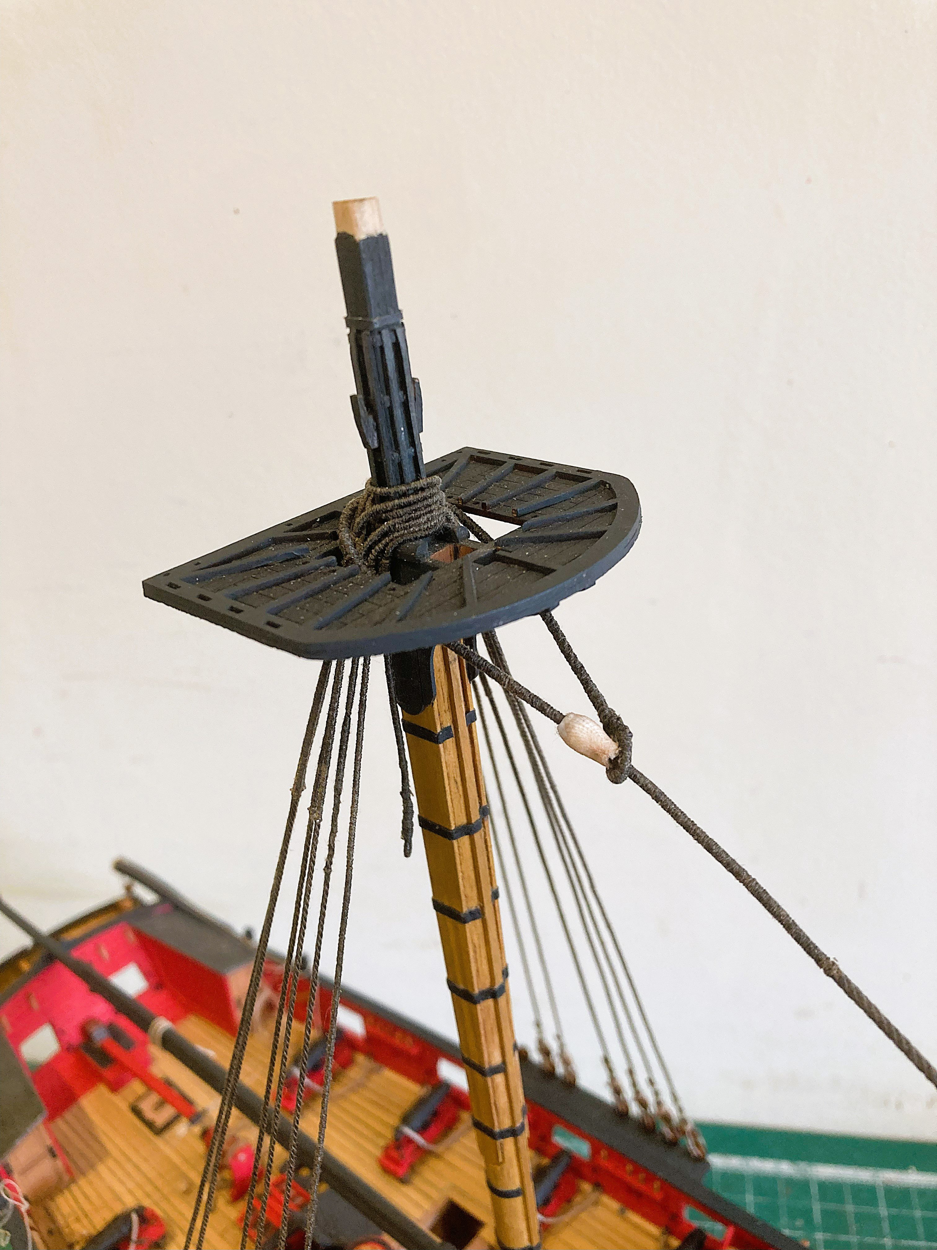

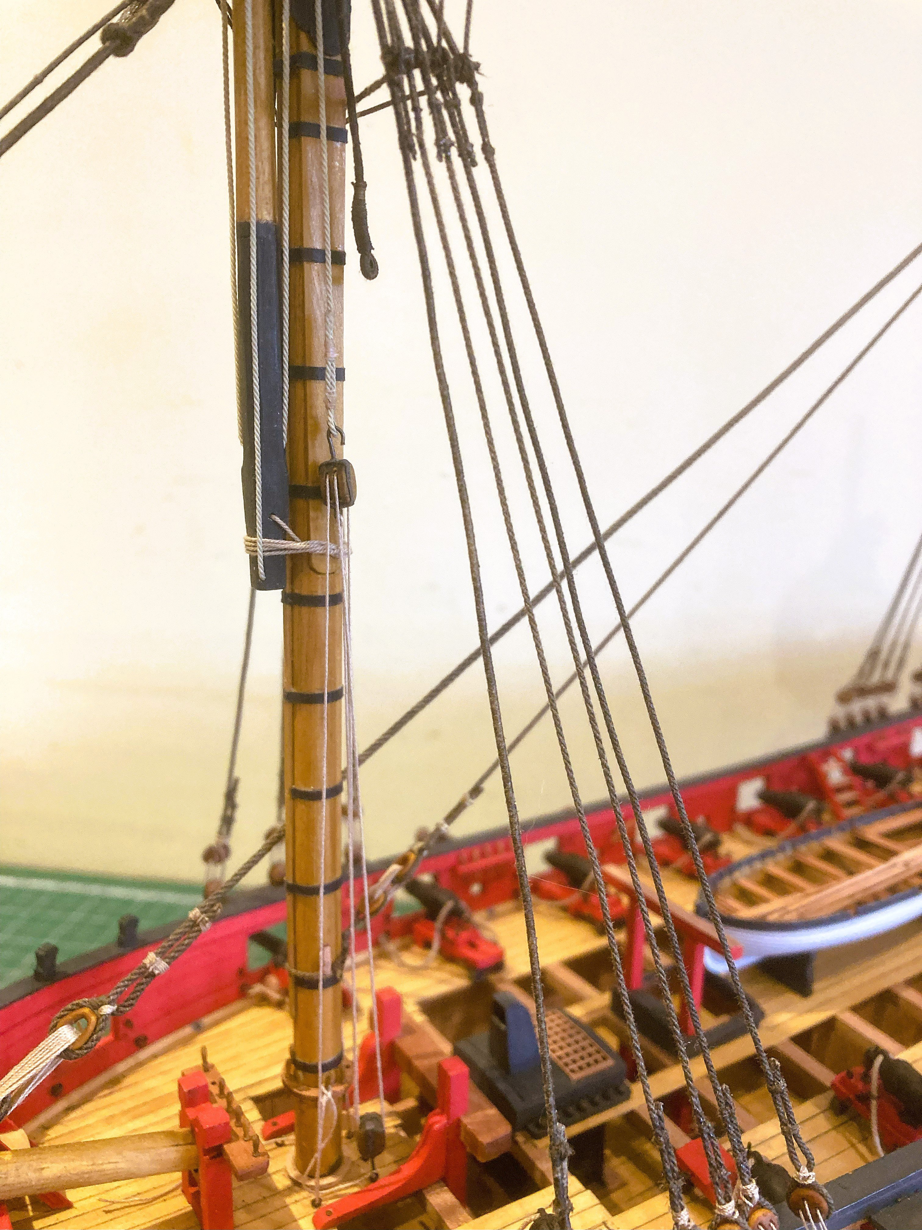

Completing the Fore shrouds.
Shrouds are a very fiddly business, and applying the throat seizings is a tedious thing.
4915a
I find that using a fine needle helps with the threading of the line  between the shroud and its return.
4924a
4921a
4922a
The Fore shrouds  gave me more trouble than the Mains;
I seemed to spend an inordinate amount of time tweaking the  shroud length before the Lanyards are eventually tied off.
This involved unpicking previously seized upper deadeyes and re-setting.
On a model a sloppy line of deadeyes is not a pretty thing.
4930a

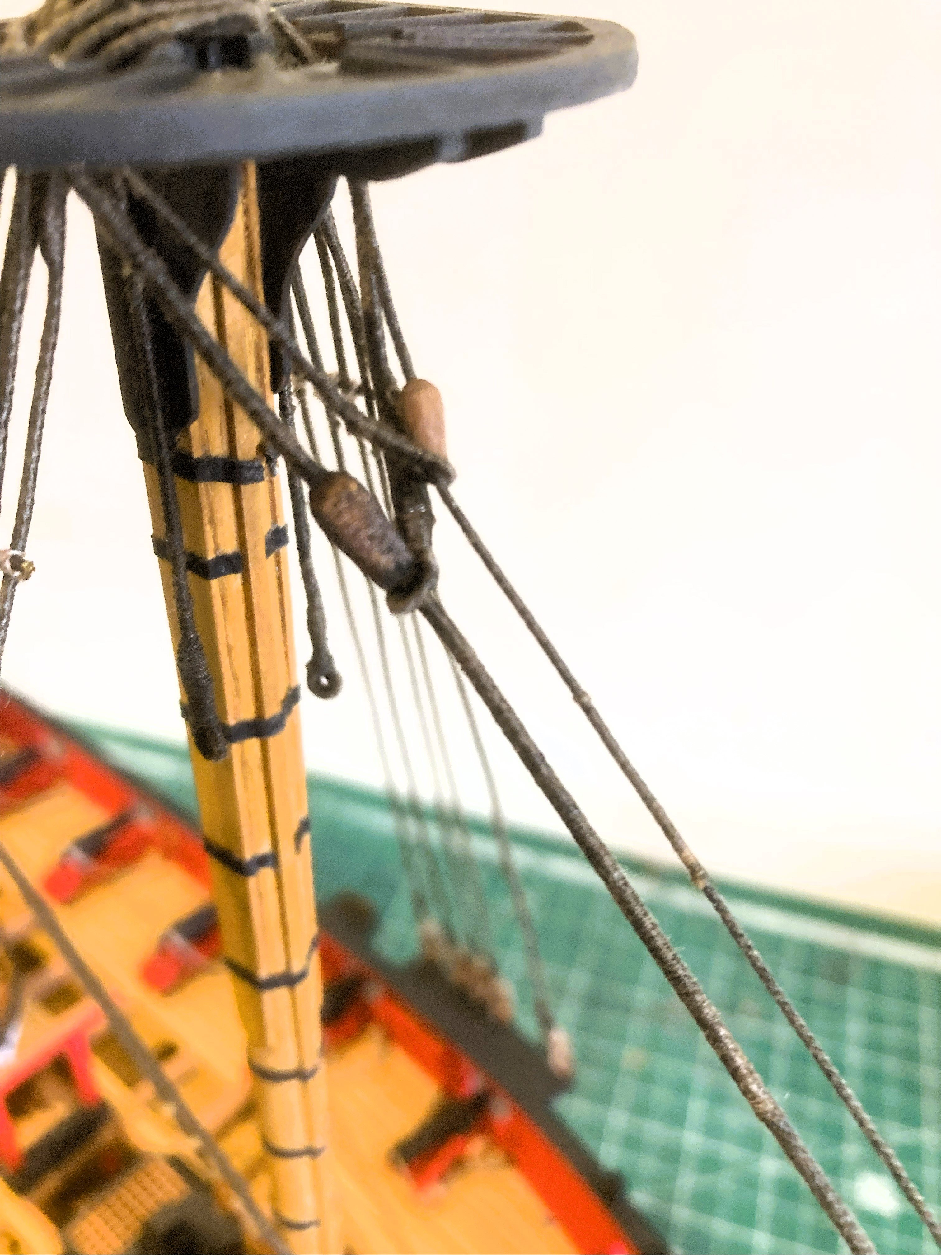

The next step is the application of the futtock staves.
According to Steel these are set as far below the trestletrees as the mast cap rises above.
4931a
In reality the staves were of 4” circ served line, but it makes sense to use something more solid for model purposes.
I used 0.7mm ø Brass rod served with 0.1mm line.
4932a
‘Quad hands’ are a useful tool for this job, holding the bar steady whilst the outer lashings are applied.
4936a
The Futtock staves are a great device for evening out the shrouds, as well as providing the anchor point for the Futtocks and Catharpins.
The Fore stays beckon….

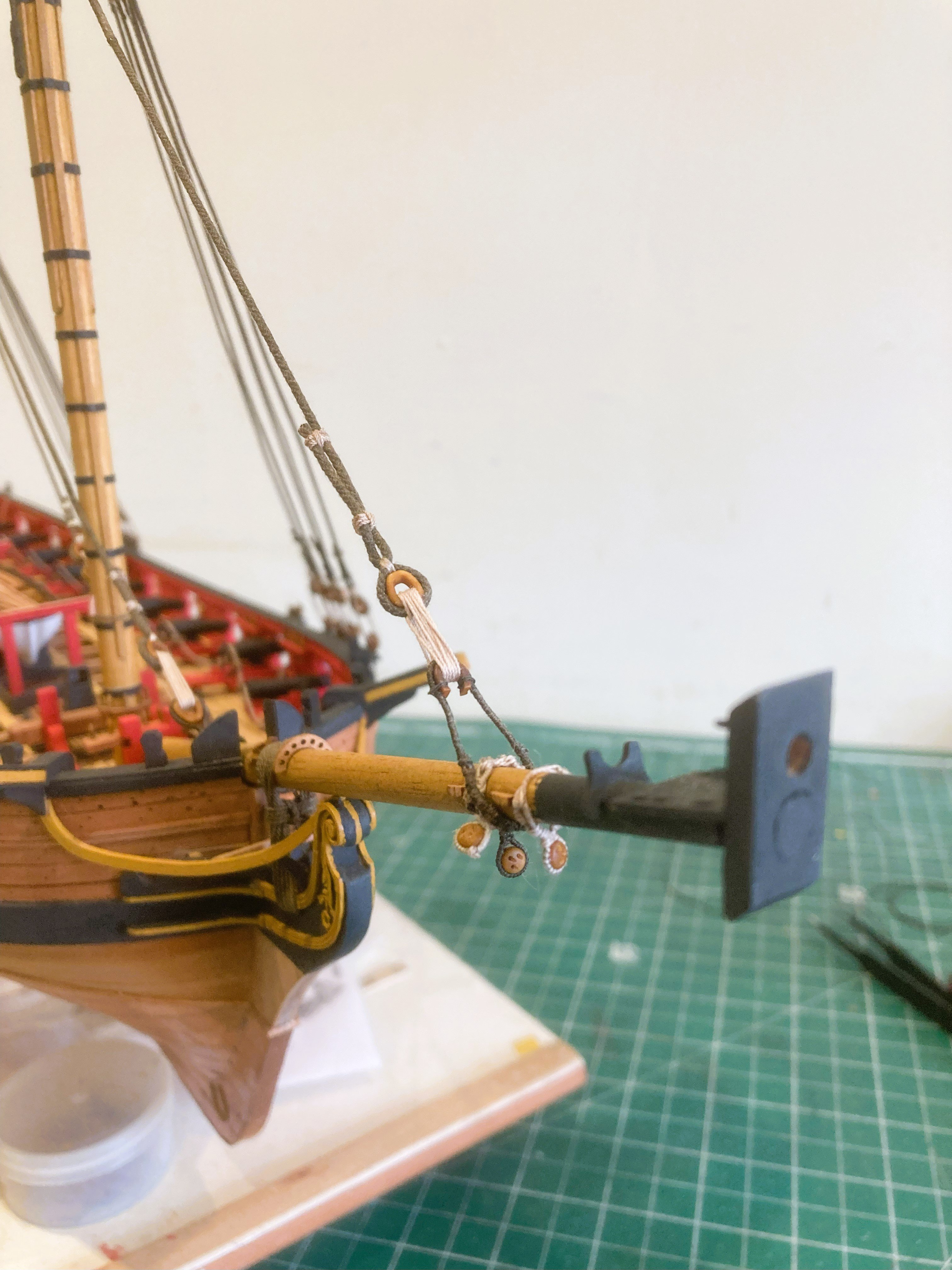

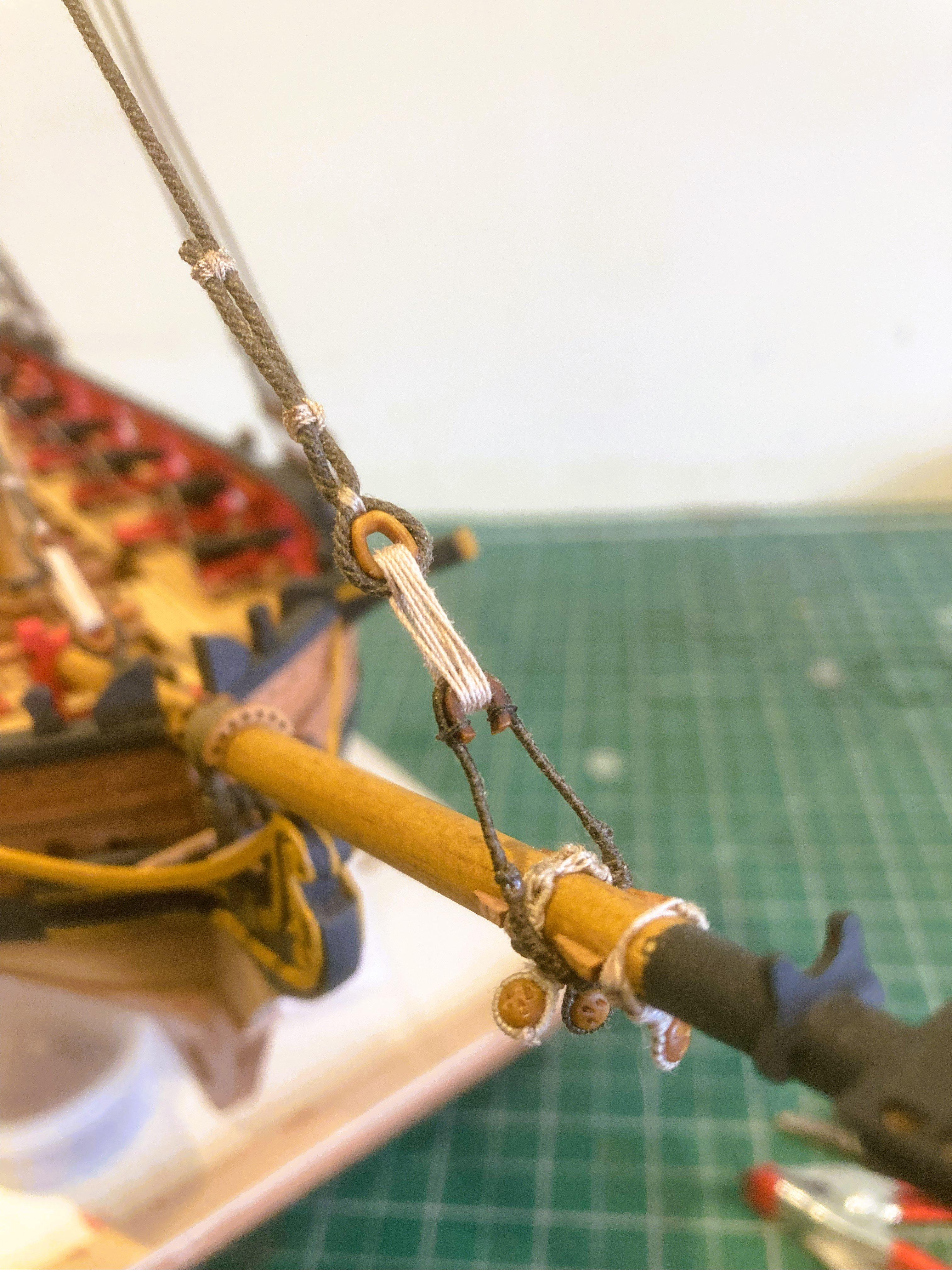

Post 98

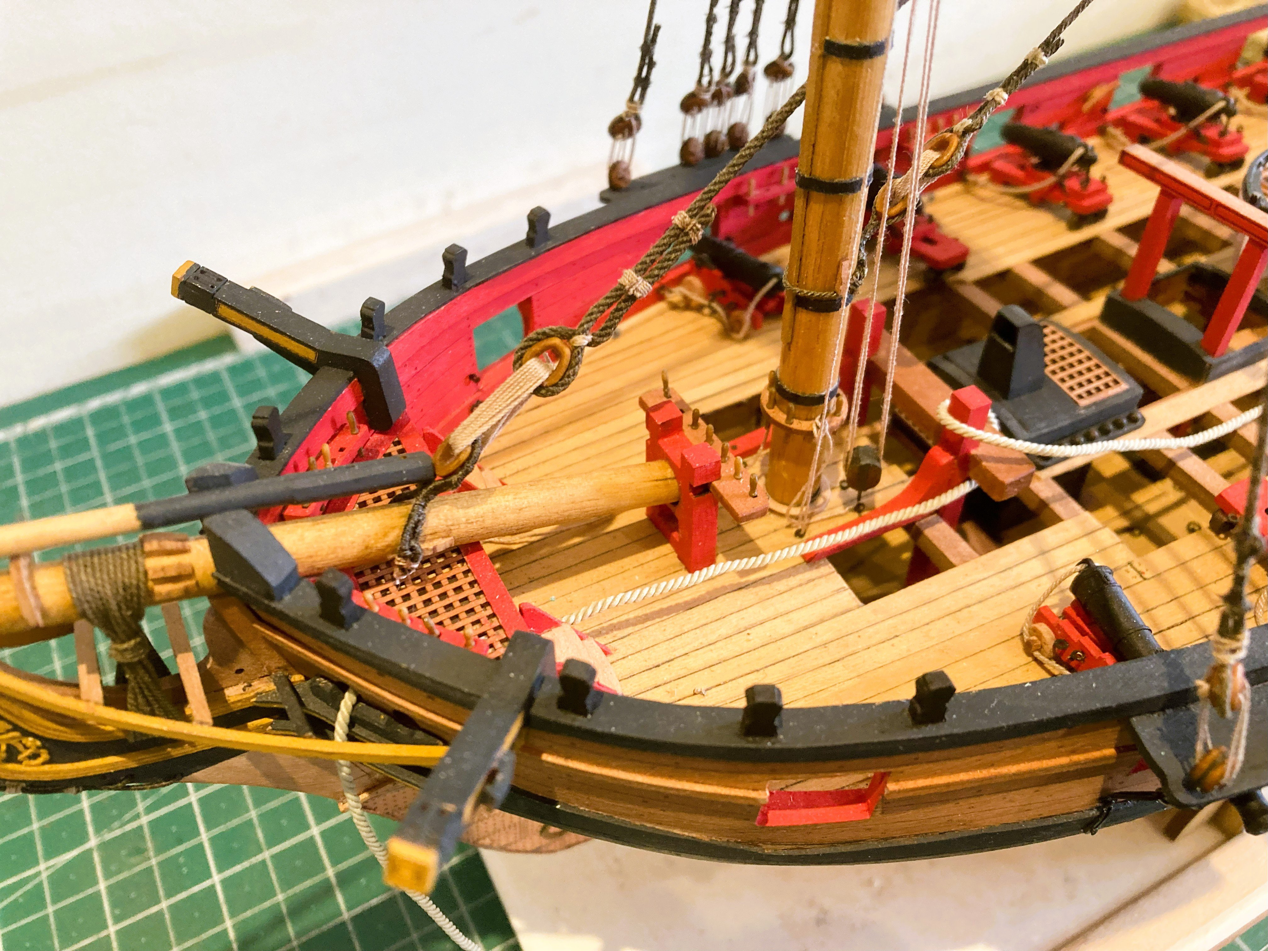

Bobstay and Bowsprit shroud fittings
I have decided to add these because the  strops are fitted against the stops before those of the Fore Stays. The Bobstays will also be fitted.
The kit indicates the use of 3mm deadeyes to secure the Bobstays and Bowsprit shrouds which is an acceptable  alternative to hearts.
As the smallest hearts I have are 5mm, a tad on the large side, and as I have no appetite to make tiny 3mm hearts, I go with deadeyes of which I have a supply of the Syren 3mm resin versions.
Bobstays
4993a
These are quite tricky to represent authentically, as they involve served line passing through a hole in the Knee of the head before being spliced to itself, with a Deadeye or heart seized in its bight,with the splice sitting in the top groove of the Deadeye/heart. The now double line is seized together below the deadeye/heart and above the knee of the head.

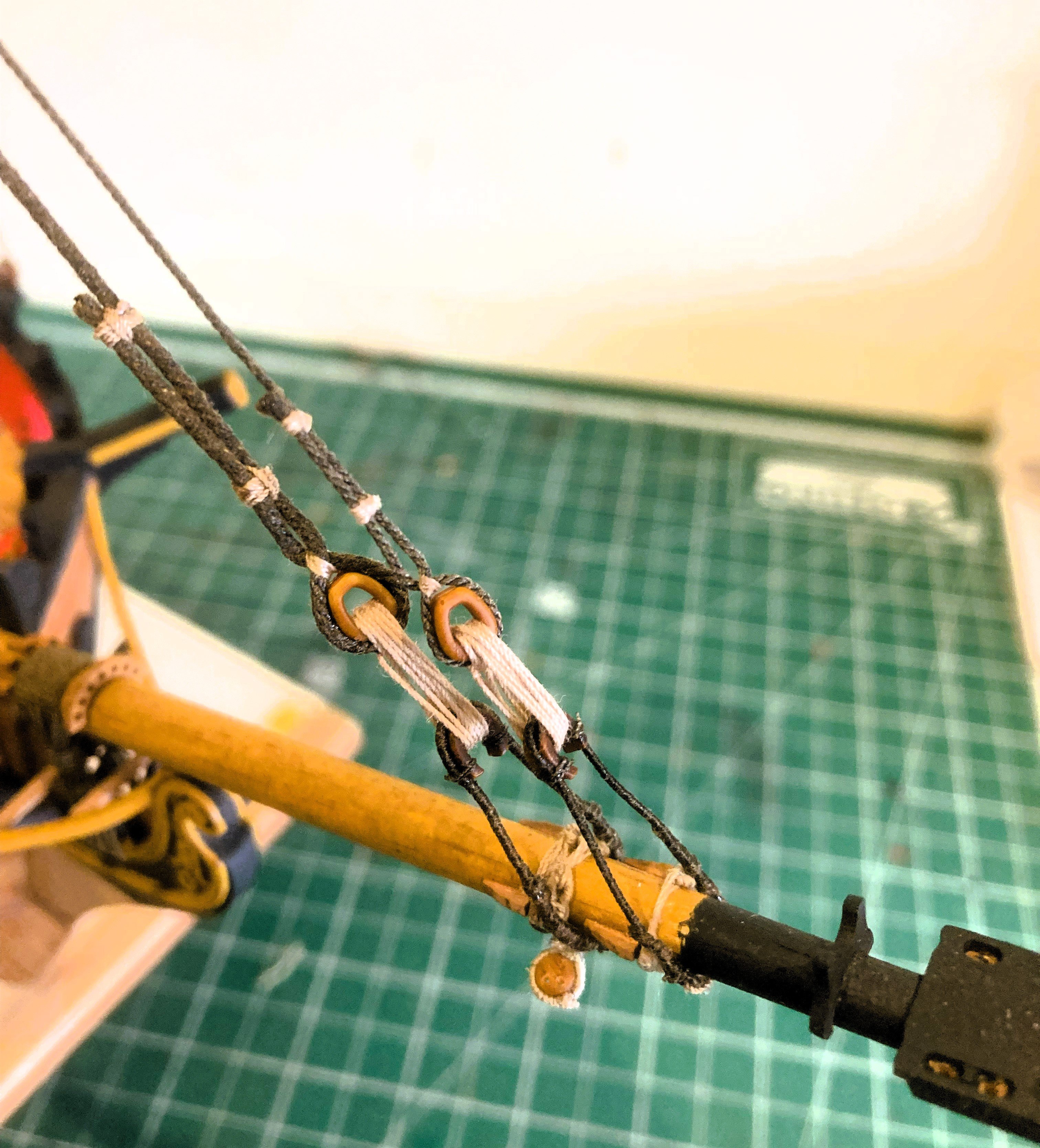

4997a
You sometimes have to get inventive to hold the lines taut for seizing.
4995a
5001a
The 3mm deadeyes are tiny things to secure within the served line and look a little overwhelmed in the bight.
They also don’t take the 0.30mm line which is the correct scale size for the lanyards.
I used 0.1mm line as per the kit plans, but which seems very under size for these important  stays.
I’m not entirely happy with these and may revisit using slightly larger hearts and lanyards.

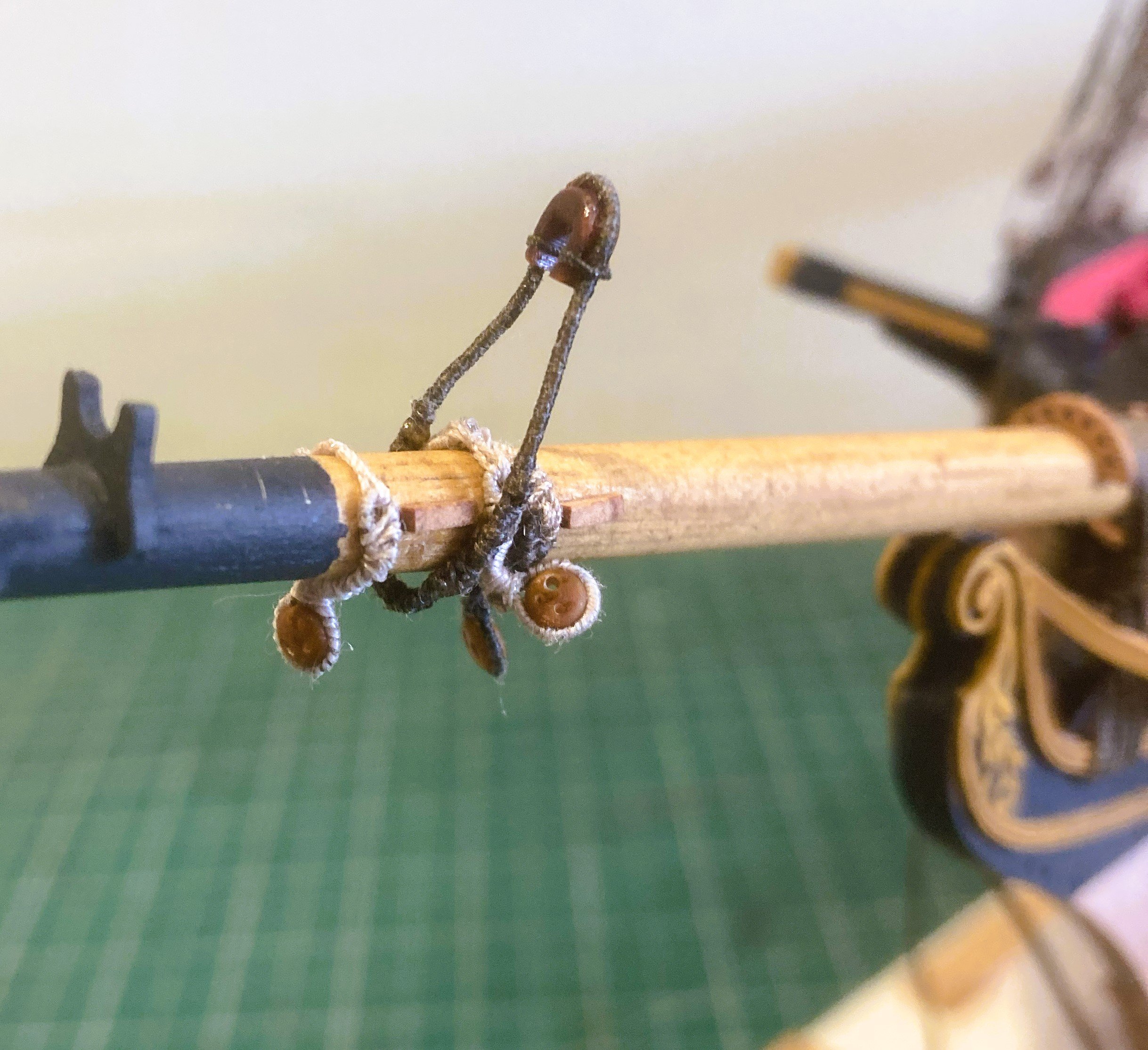

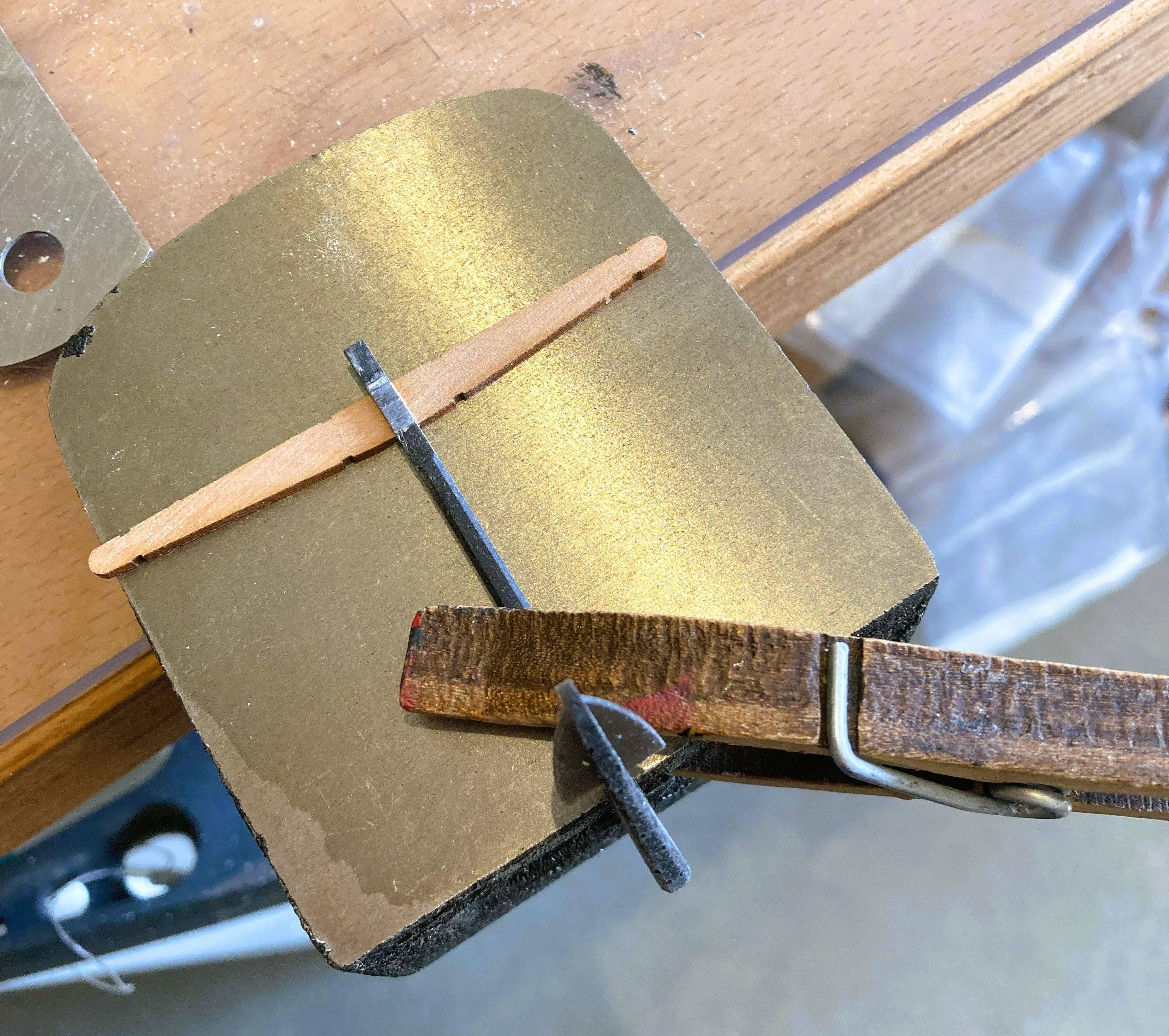

Jib boom
I have decided to include the Jib boom albeit in the inboard position. This allows fitting with a minimal increase in the overall size of the model.
4984a

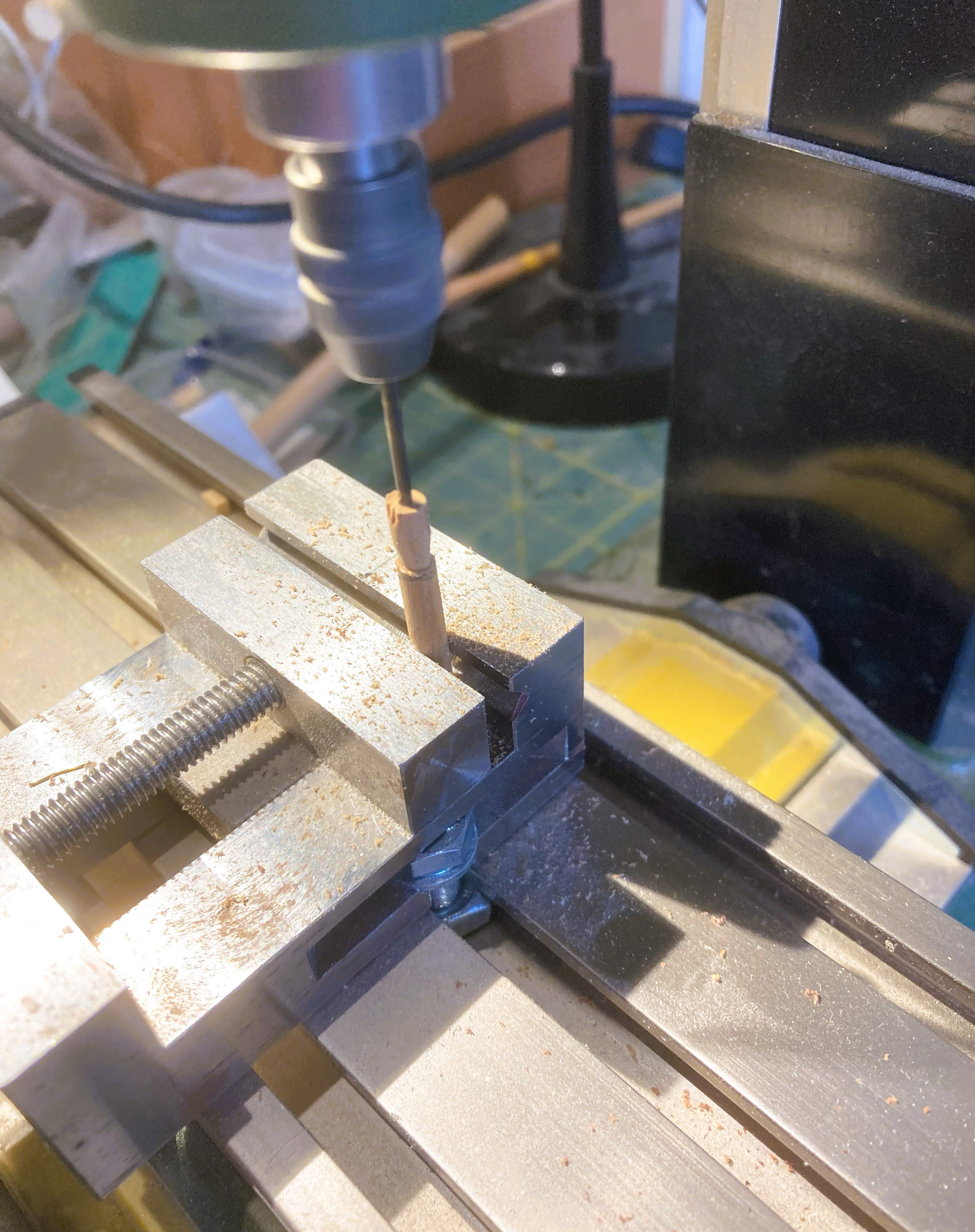

The boom was  formed from 4mm square stock. The heel is of octagonal shape with sheave holes for the top ropes. There is also a crupper hole for lashing the boom to the Bowsprit.
4988a
5002a
5004a
5006a
B.E.

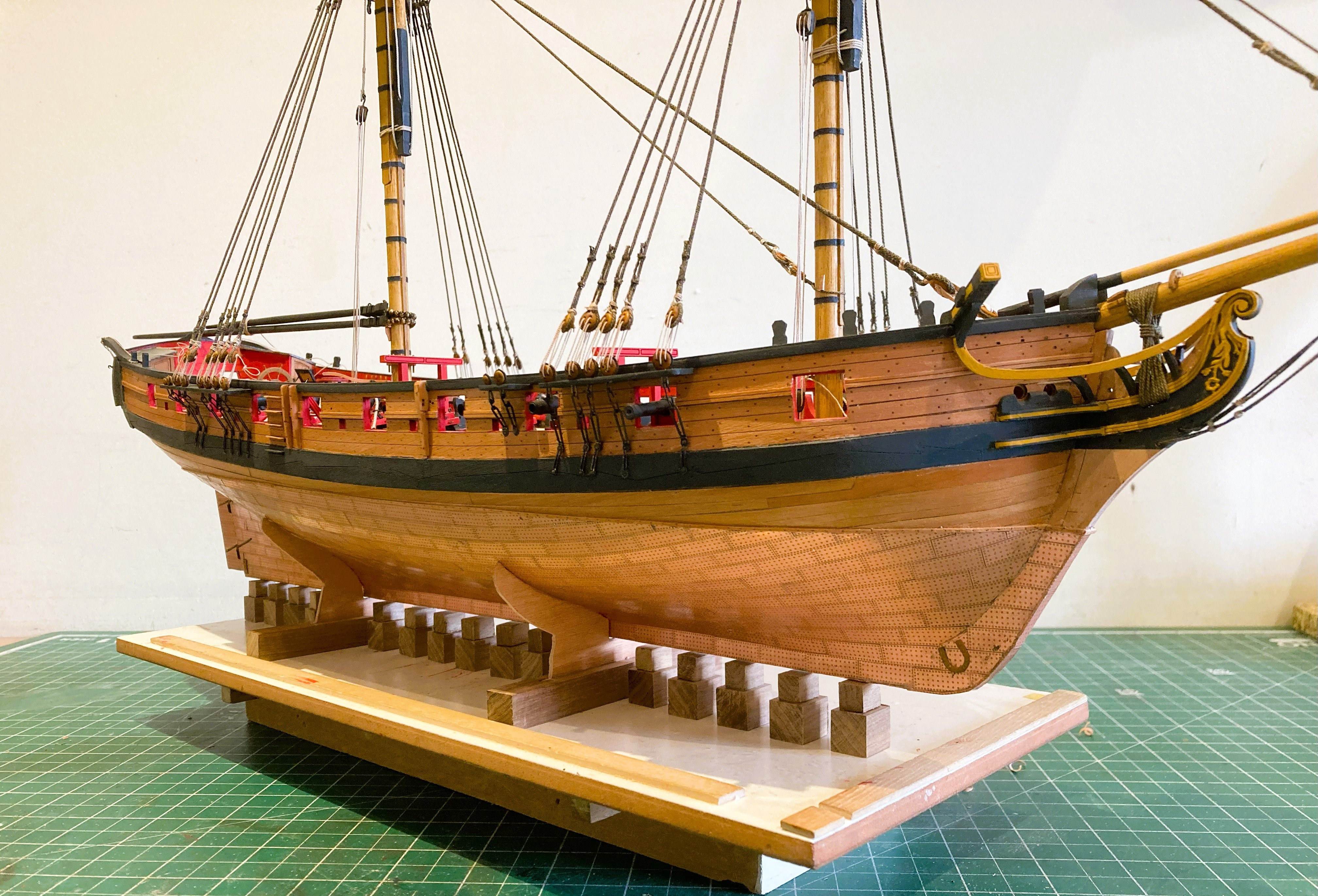

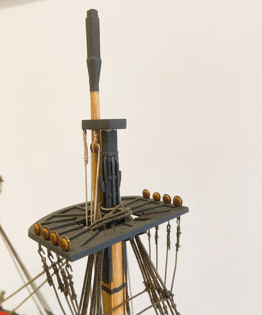

Post 99
Futtock strops and Catharpins.
By scale the topmast deadeyes are 7” – 3mm at scale.
5011a
The kit provides 3mm deadeyes(F16) which in reality are closer to 4mm, and the provided Futtock strops would be too large for true 3mm scale blocks.
I substituted Syren 4mm blocks  which are a good fit for the  strops.
5013a
On a visual level the kit/Syren deadeyes look better than a true 3mm would.
I blacken the strops prior to fitting the deadeyes and then re- blacken post fitting.
Catharpins -3½”c line – 0.44mm ø at scale.
These prevent the Futtocks pulling the shrouds out of shape, therefore they are fitted before the Futtocks.
5014a
It is far easier to make these from 0.5mm brass wire served with line. An eye formed at each end  makes fitting fairly straightforward.
5031a
I say straightforward but they are quite fiddly to make and serve, and use of a needle to do the fitting certainly helps.
5028a
5034a
Usually there were four Catharpin legs per mast but the kit plan indicates only two.
5035a
Looking at the model it would prove quite tricky to fit  a set of four in the available space, so thankfully I’ll move swiftly on…

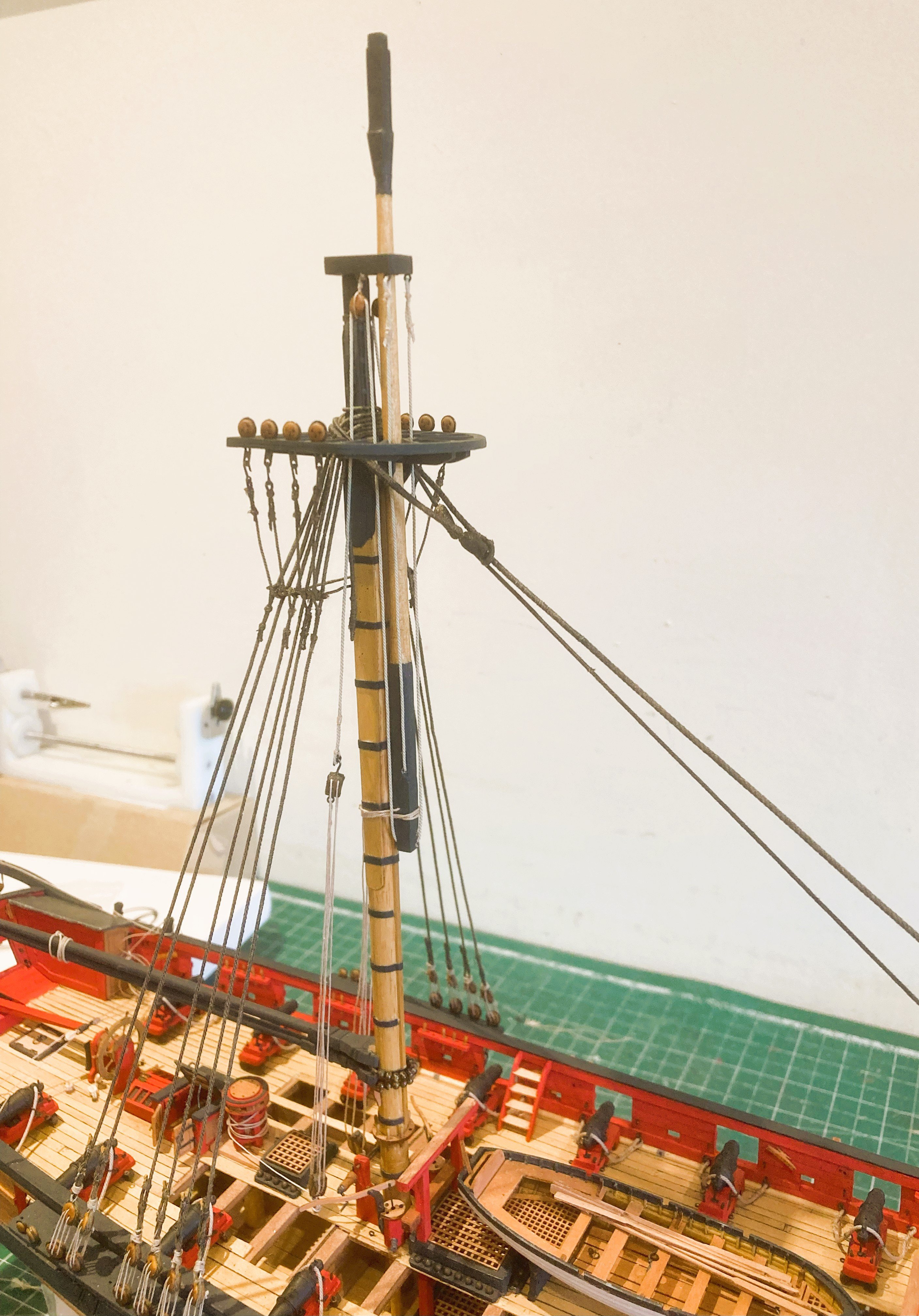

Fore and Main Futtock shrouds
From Steel
Futtocks 4½”c line - 0.56mm  ø at scale.
I am using Syren 0.63mm ø line.
5049a
My approach is to firstly attach the line to the lower shrouds below the stave and then tauten the line thro' the hook eye whilst attached to the futtock strap. The line is then seized.
Care is required to avoid pulling the shrouds out of line.
5042a
5054a
I am using the kit supplied Gütermann line for the seizings. They will be blackened once completed.
5051a
5055a
There is no doubt that rigging the Futtocks is a tiresome business with a set of four round seizings to each one.
Onto the Starboard side…
B.E.

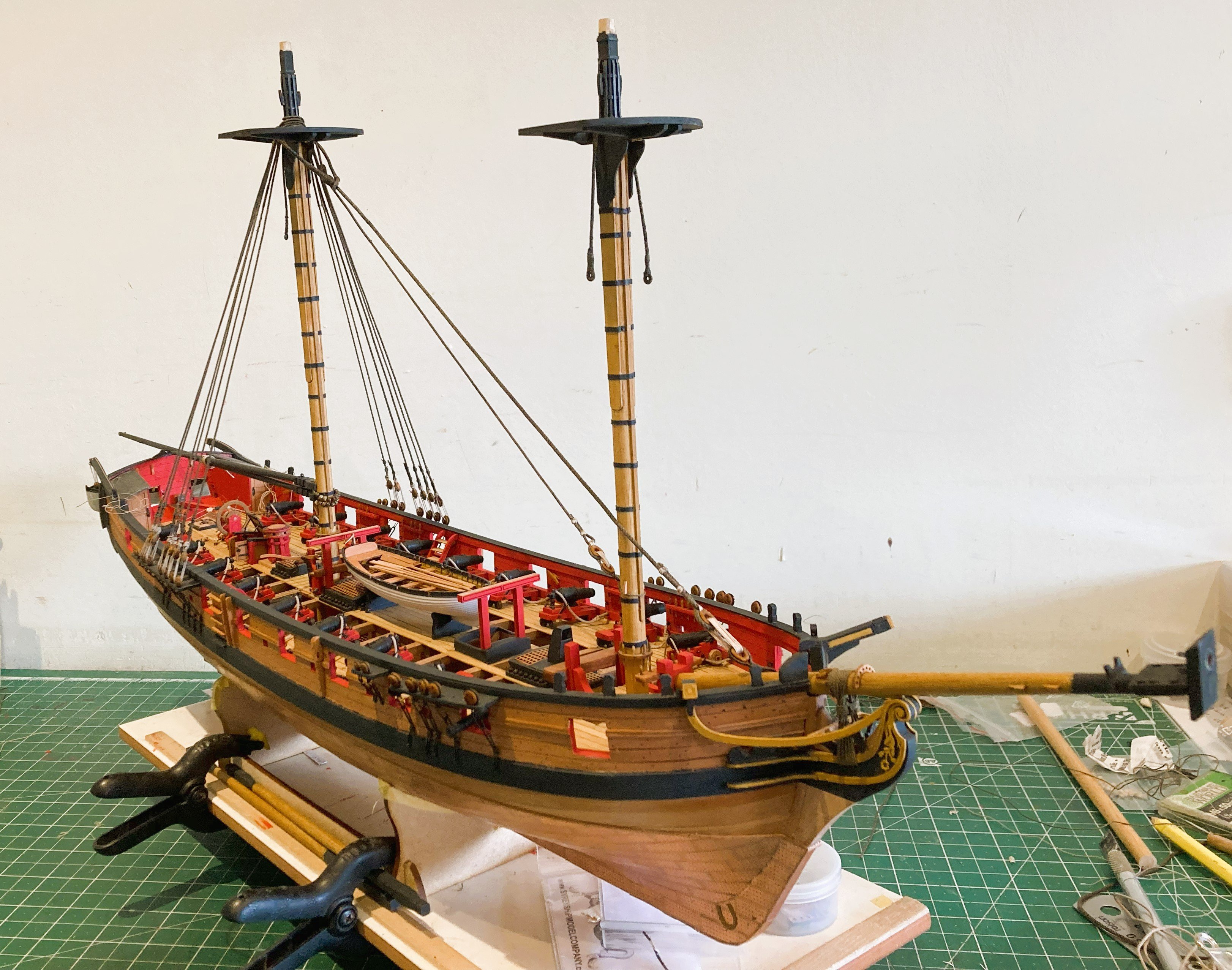

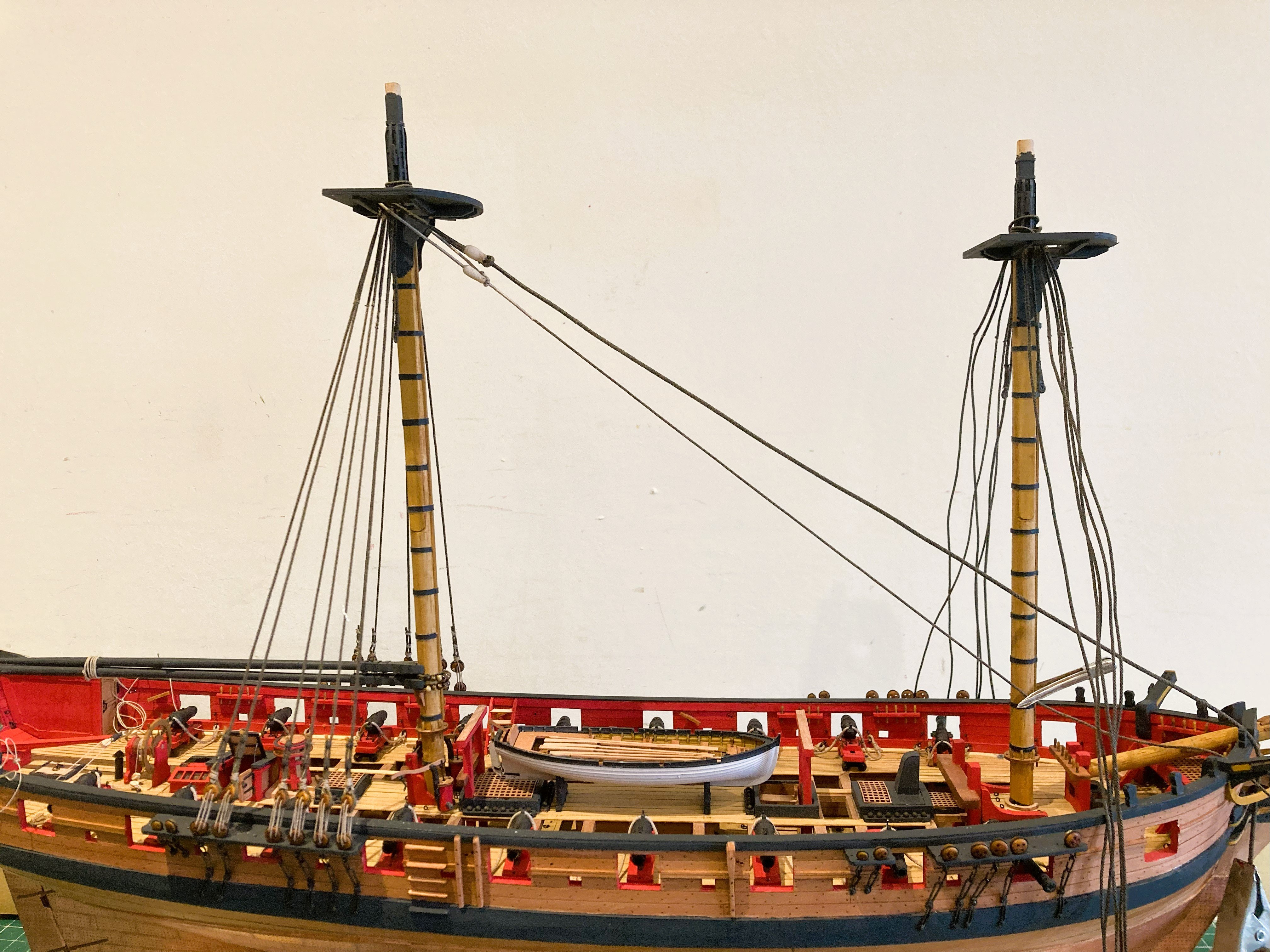

Topmast Rigging

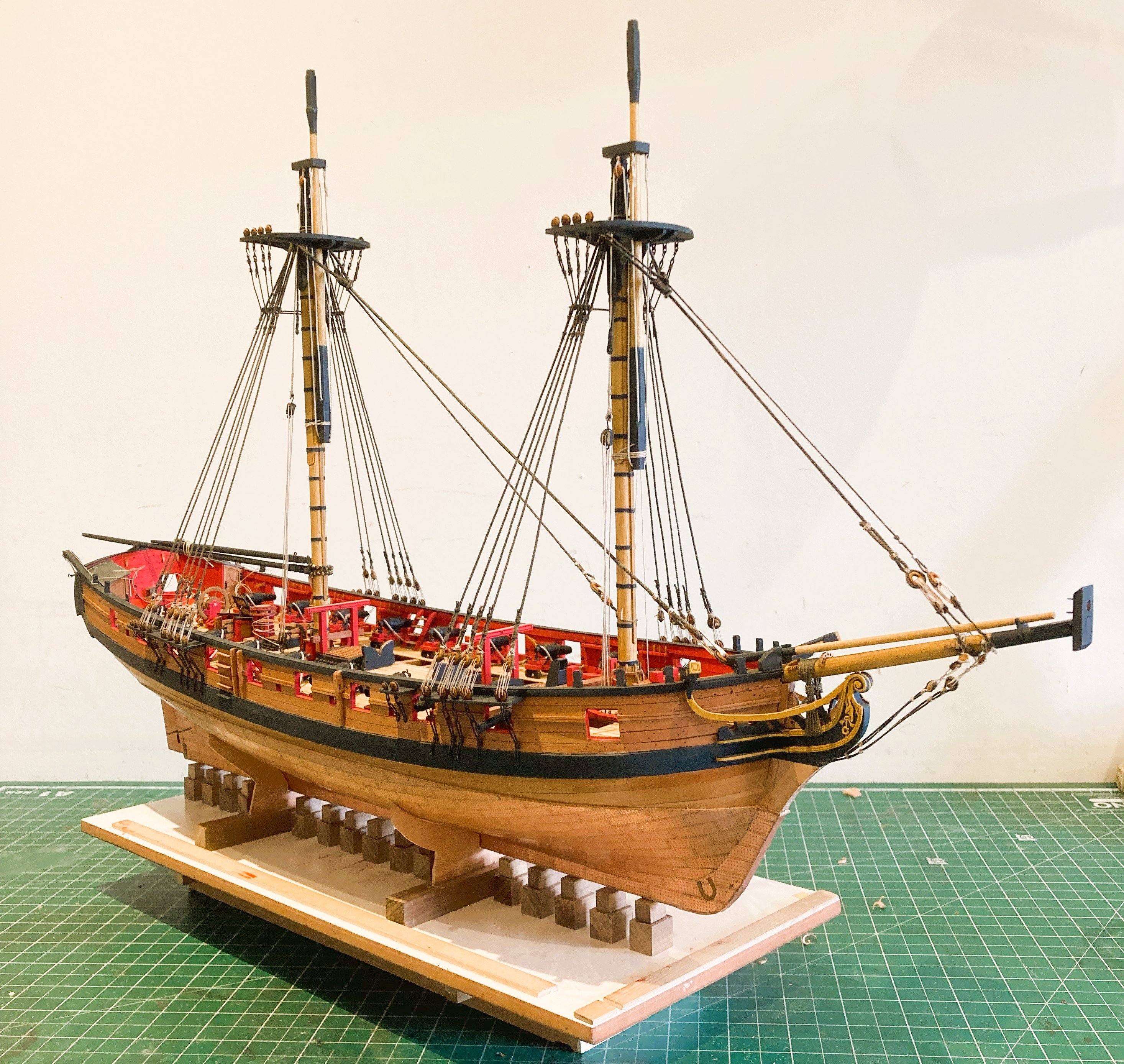

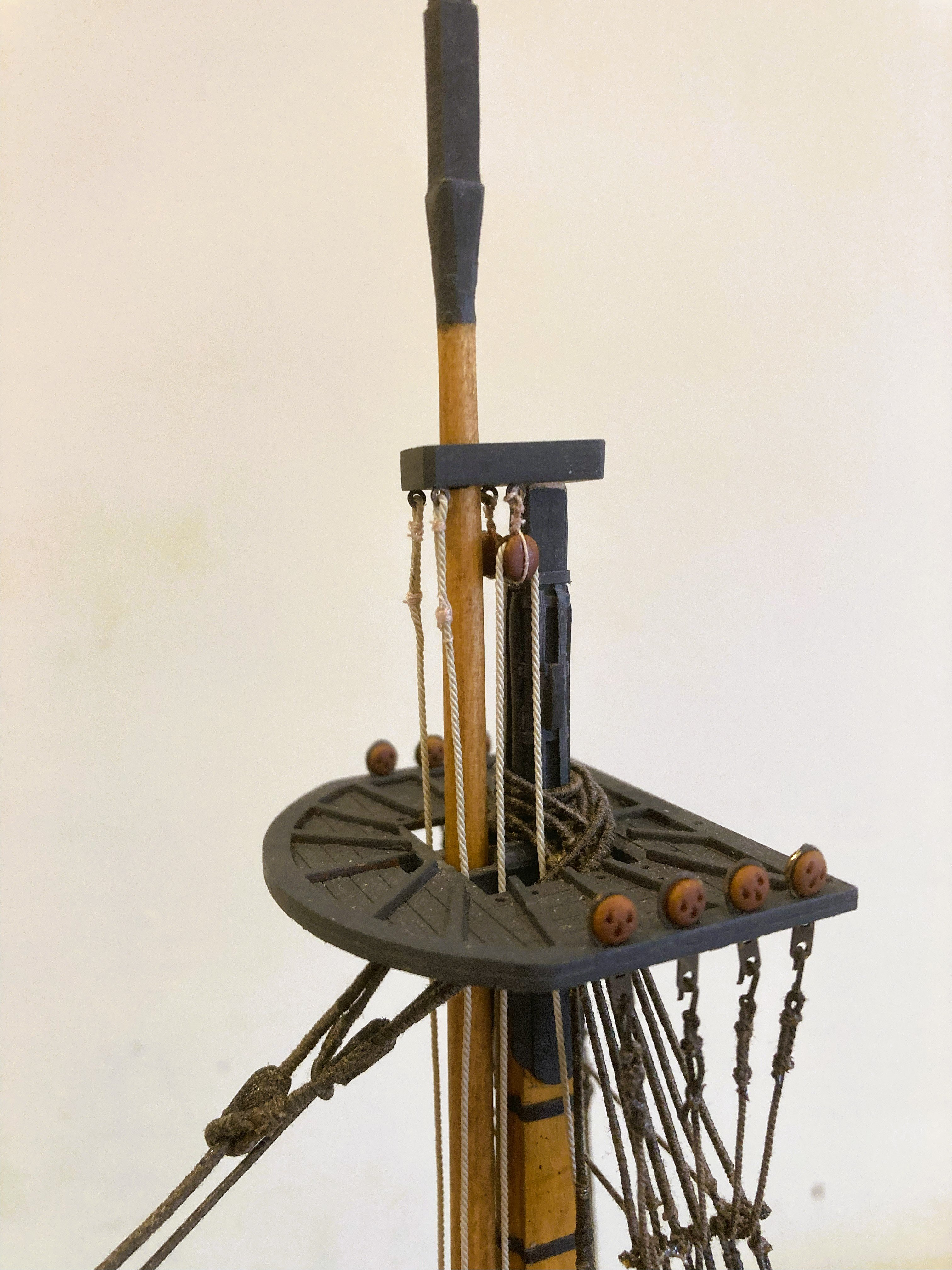

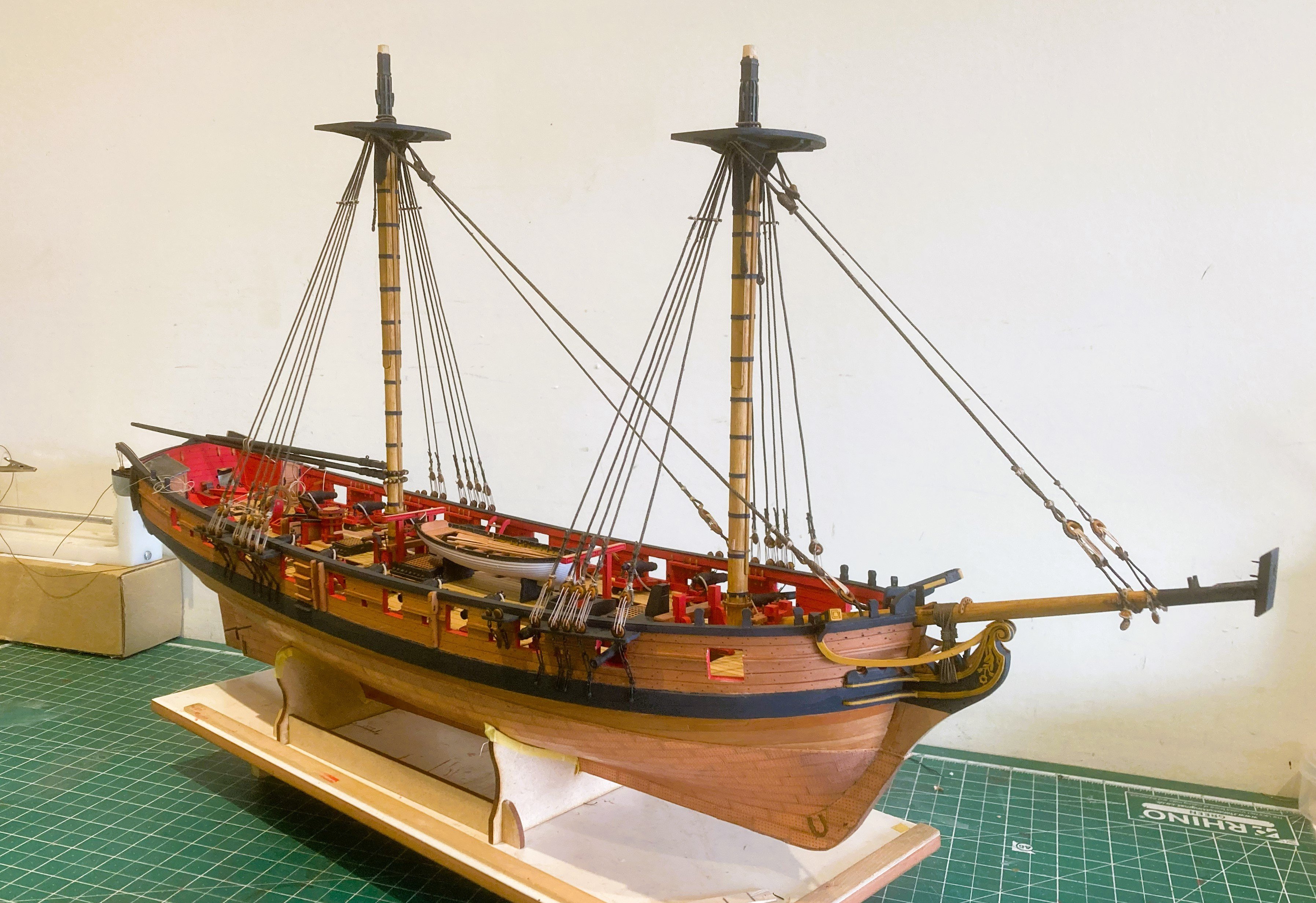

I have rigged the Topmasts in a lowered position mainly for space saving purposes, but also  as an alternative to storing them on the Gallows.
This involves rigging the Topropes to support the masts.
Fortunately  this procedure is covered in the books Seamanship in the age of sail by John Harland, and The Masting and rigging of English ships of war by James Lees.
For the Toprope Pendents I’m using Morope 0.8mm polyester line, coupled with Syren 3/16” resin blocks, and 2mm thimbles.
For the Falls  I am using Syren 0.3mm line coupled with ¼” Boxwood Double blocks.
Strictly speaking these should be iron bound blocks so a sliver of heat shrink tubing will be used to represent the ‘iron’
The masthead caps are fitted with eyebolts for the Toprope pendent blocks which are attached prior to  fitting of the cap. The caps do not require gluing, as they are a snug fit to the masthead.
5151a
5152a
These photos shows the Standing part of the Port side lower sheave pendent, and standing and running  part of the starboard side pendent.
5157a
Here the Port and Starboard pendents can be seen running respectively thro’ the lower and upper mast sheaves.
The falls of the pendent are hooked to deck eyebolt aft of the mast.
A lashing is applied thro’ the fid holes to secure the Topmast.
5158a
This photo shows the falls and  double block tackles attached by hooks into thimble spliced to the pendent ends.
5166a
Main Topmast tackle.
Consideration has to be given to the length of the tackles to at least give the impression that in the position fixed they would raise the Topmast sufficiently for fidding.
5164a
5165a
The run of the pendents through the mast sheaves.
5171a
5170a
The Topropes would not normally be seen on a model as they were generally removed once the Topmasts are in place.

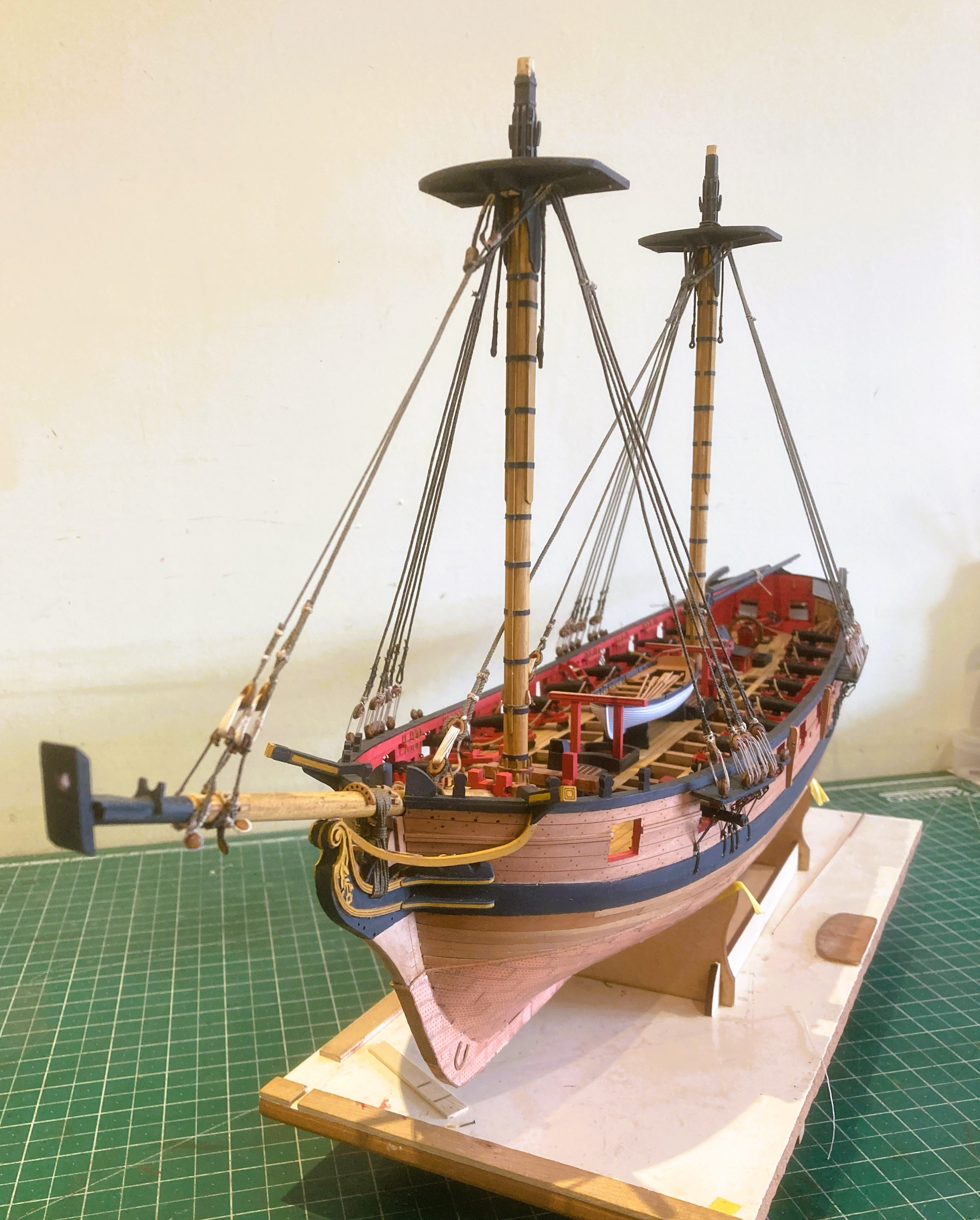

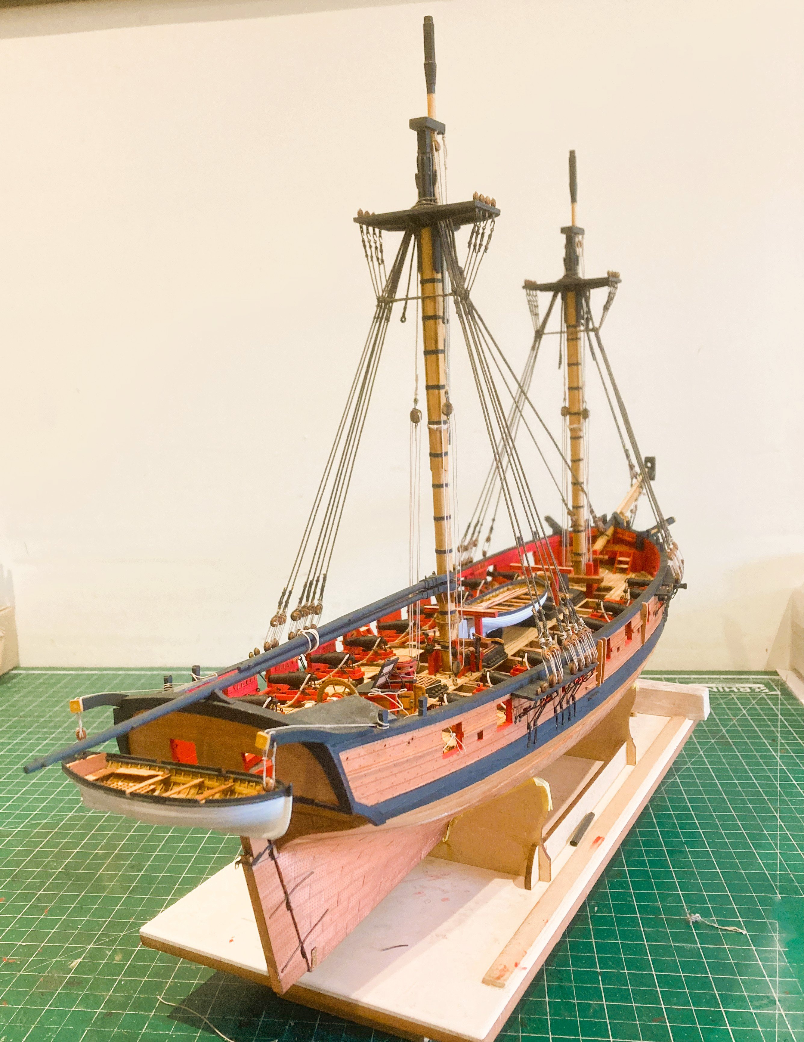

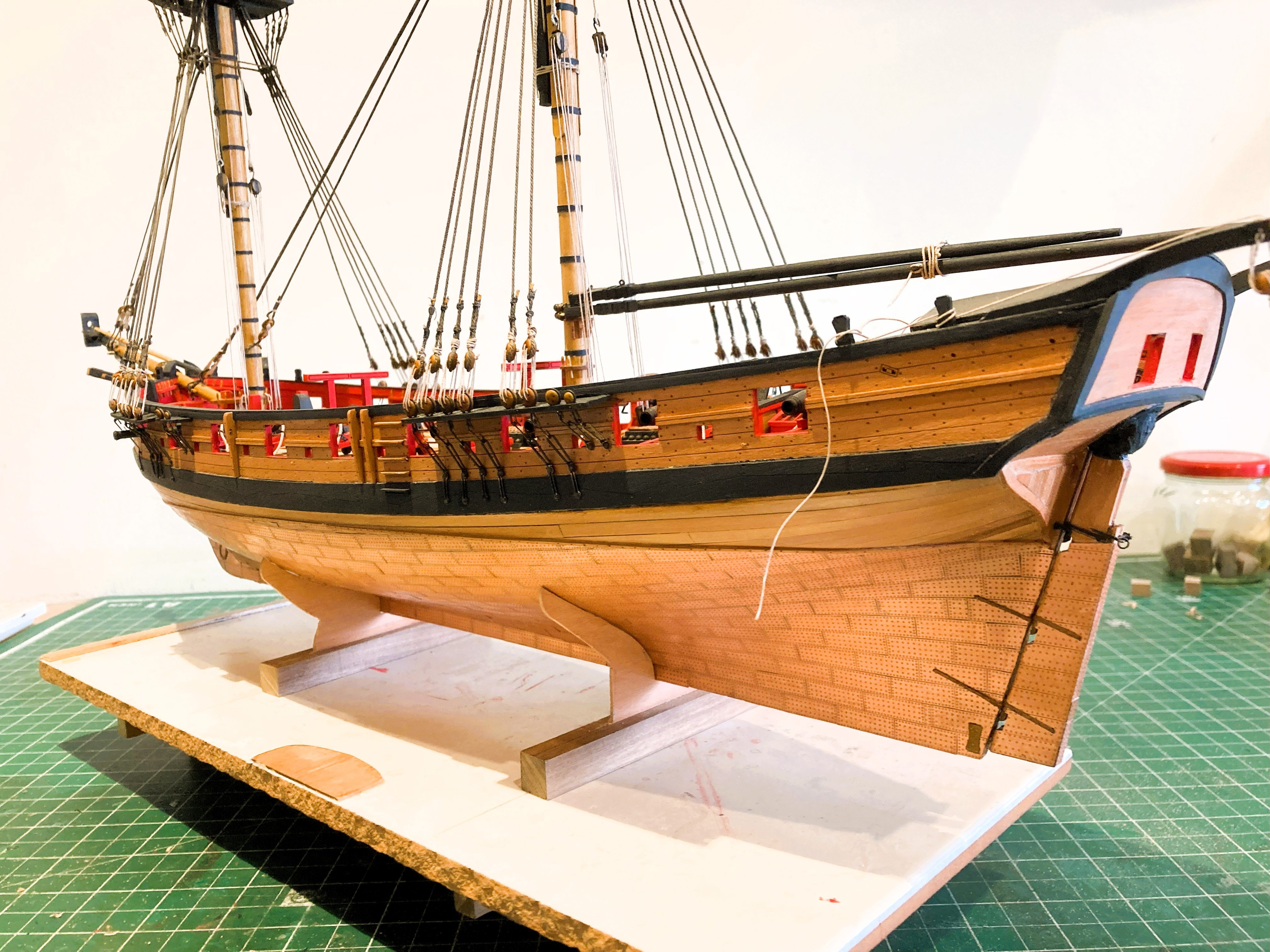

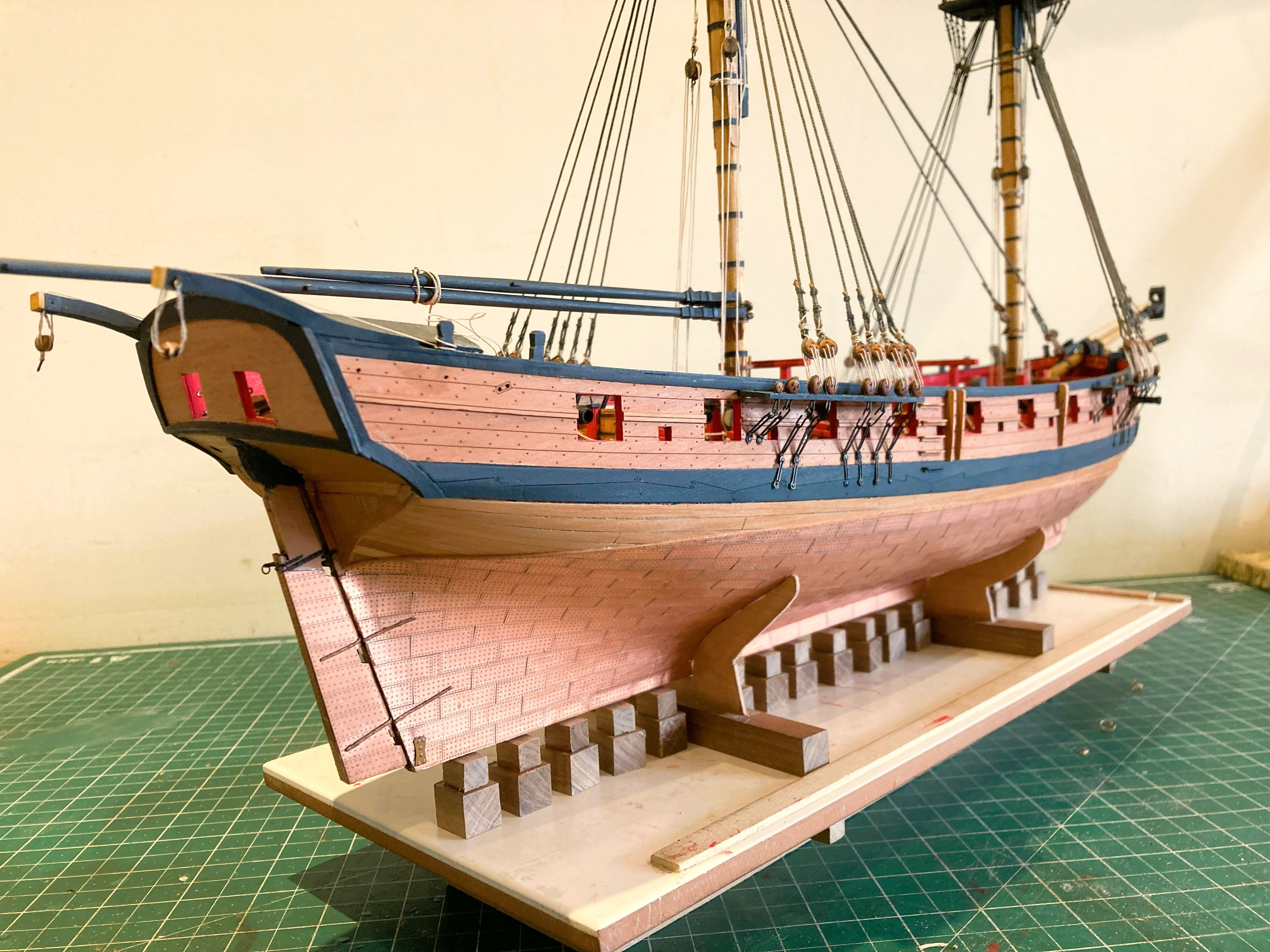

Thinking about display

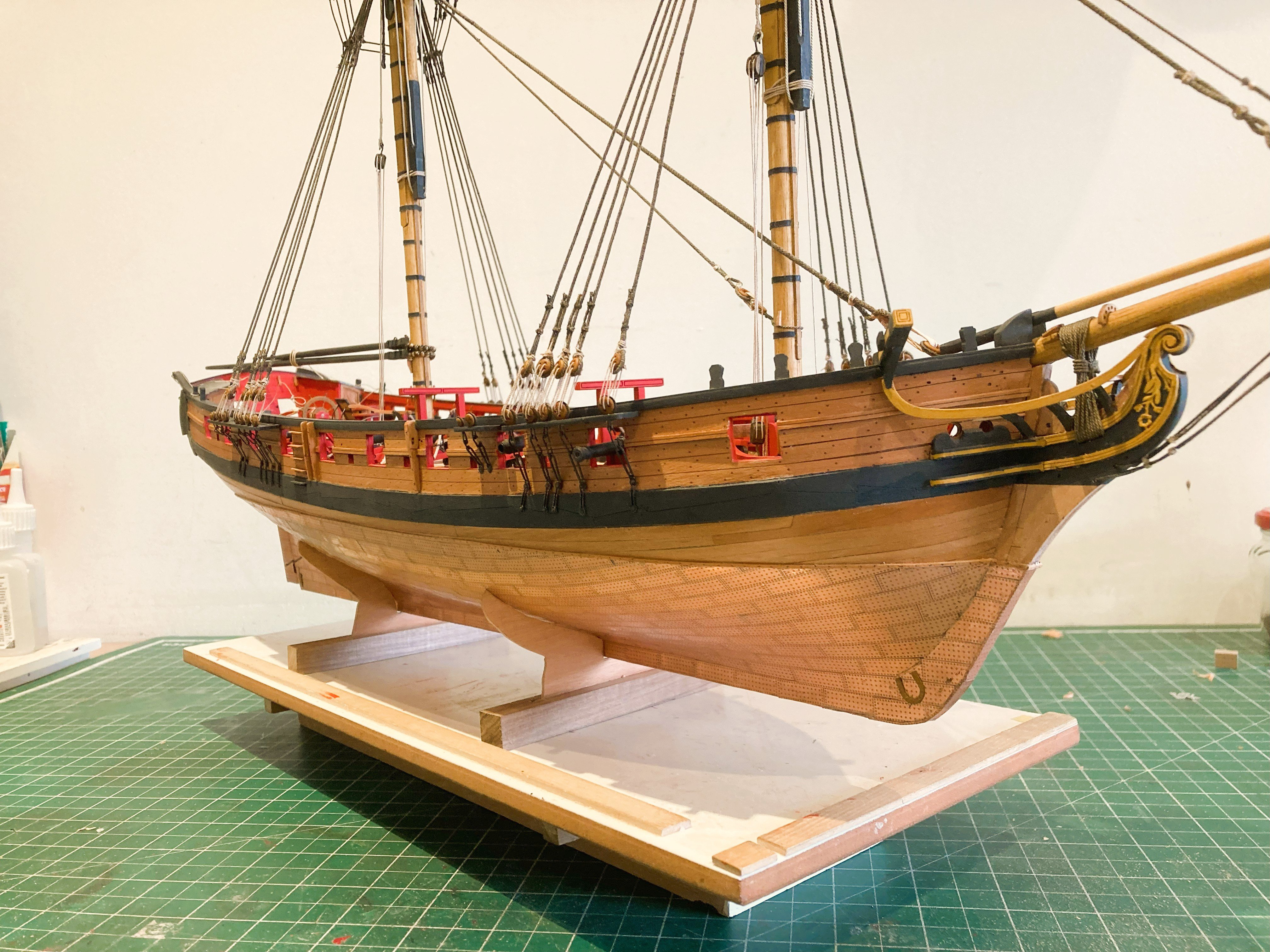

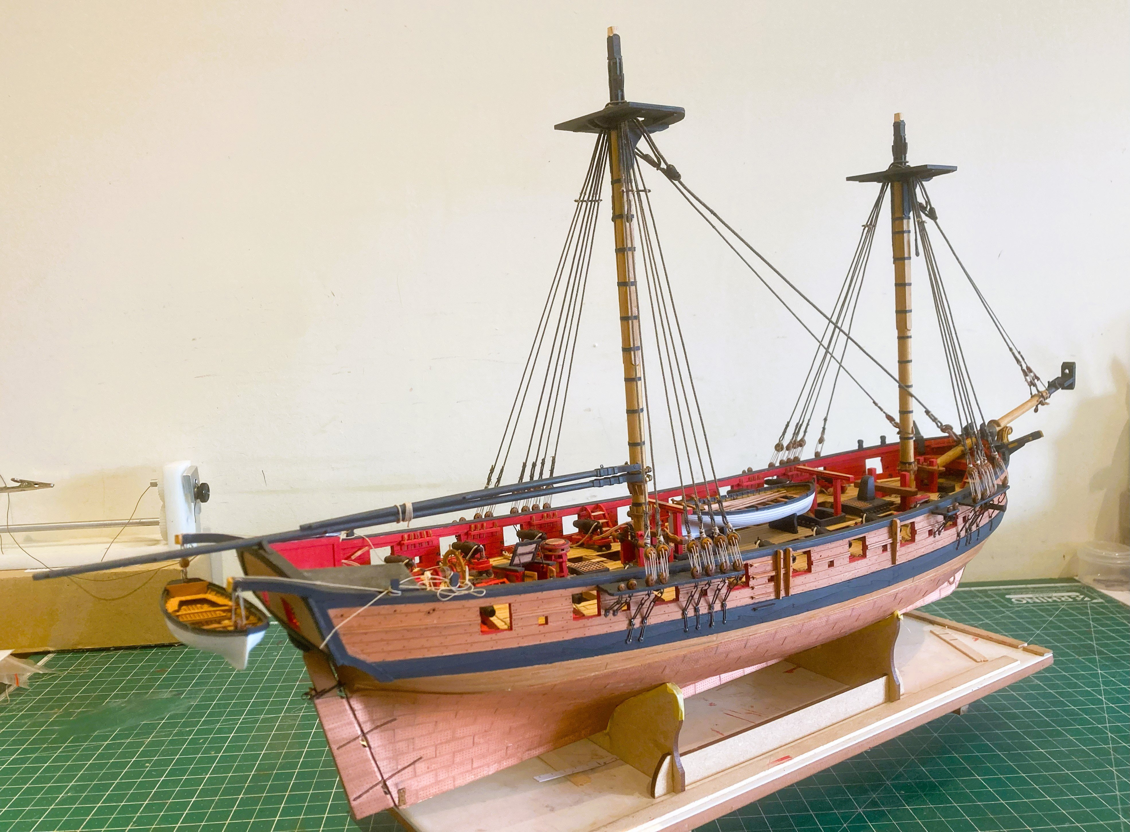

At this stage I am beginning to formulate how the completed model will be displayed.

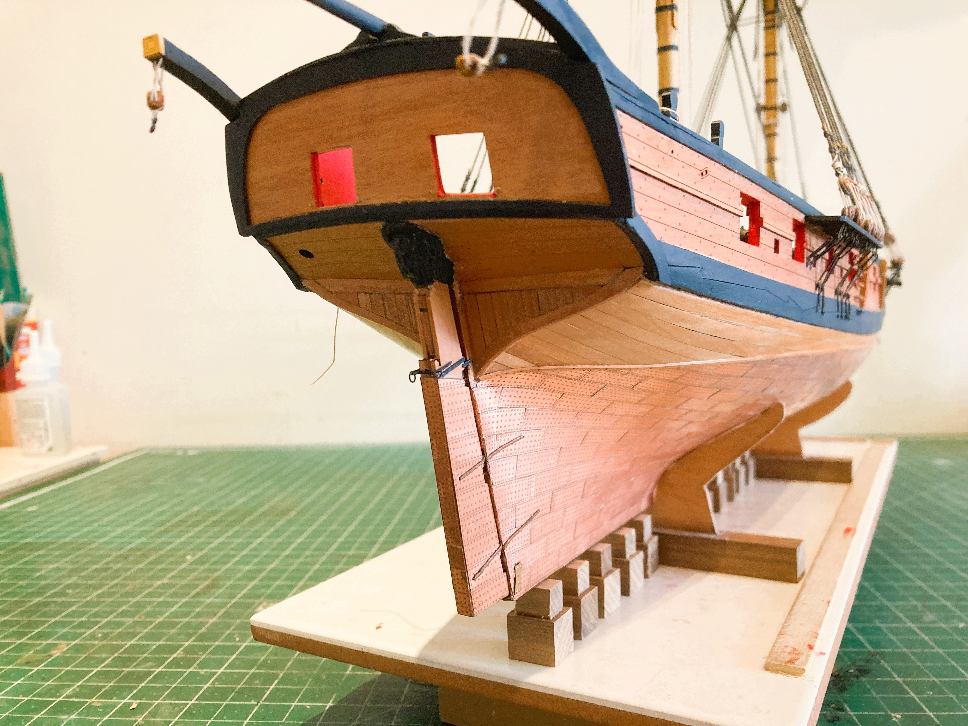

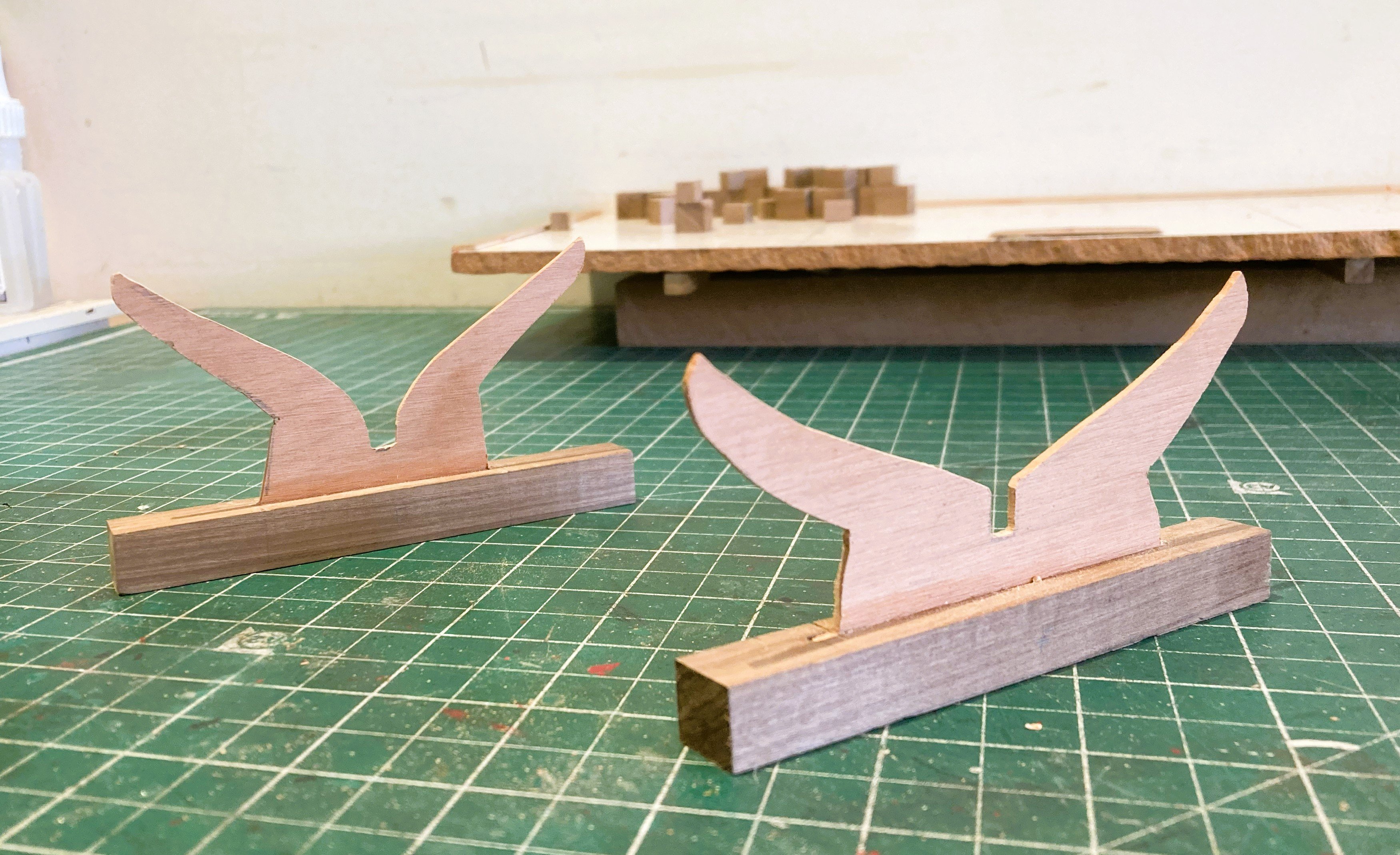

I have decided She will sit on keel blocks, an arrangement I used both in my Pegasus and Pickle builds.
Sections of 12mm and 8mm Walnut square stock are used to form the blocks, and cradles of reduced profile cut from 2mm  Pearwood sheet.
5172a
Two lengths of 12mm square walnut are slotted to take the cradles.
5174a
5175a
A fair bit of tweaking required to get a reasonable fit.
5177a
5179a
5180a
5178a
Trying out the keel blocks. The tricky part will be setting them out on the base board, yet to be made.
5176a
An Acrylic cover to protect Harpy has been ordered.
The dimensions of 800mm (w) x 450mm (h) x 190mm(b)
are the minimum I can get away with, but a significant saving on space.
B.E.

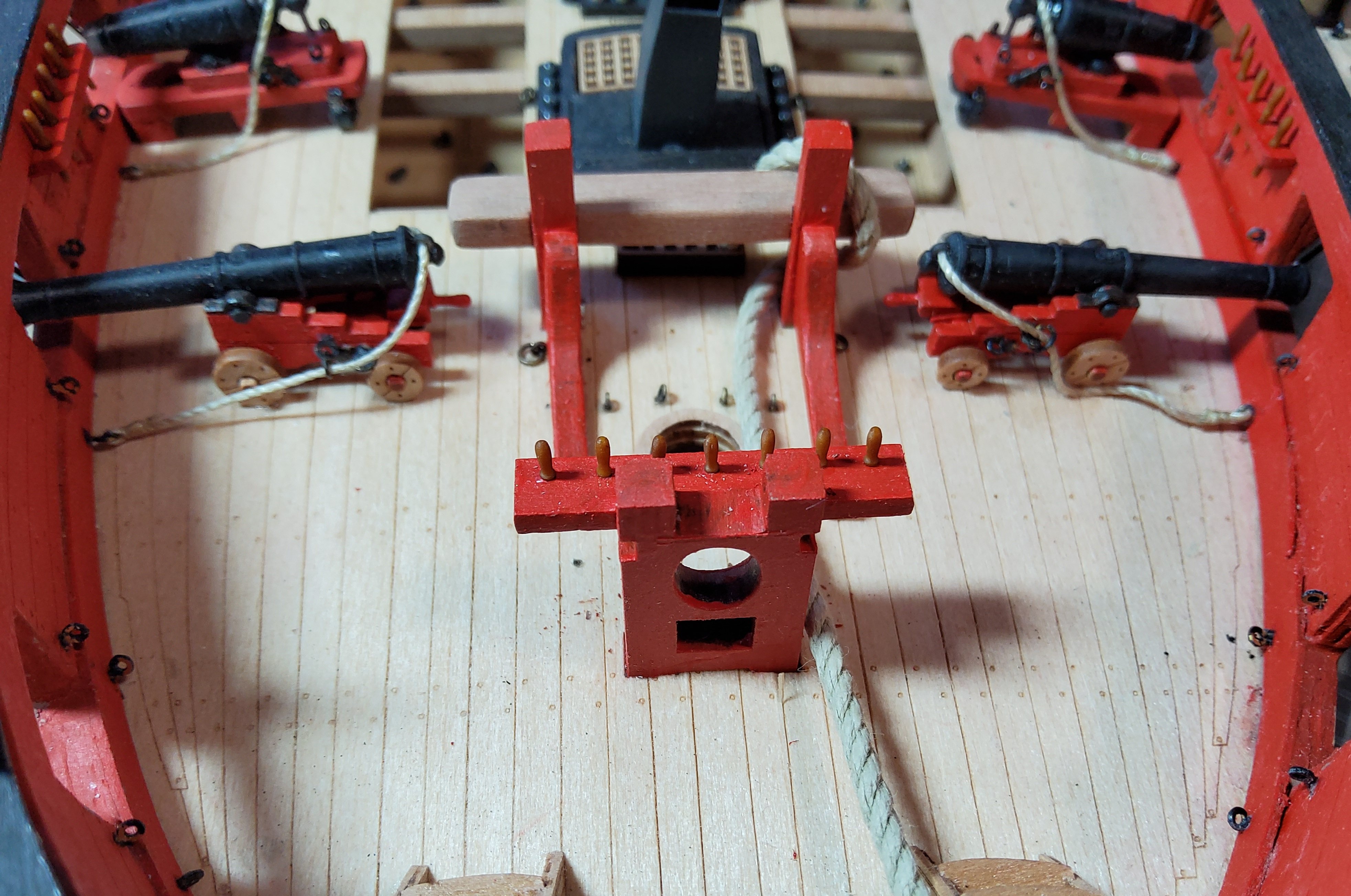

The business of anchors and cables are a puzzlement to me where Harpy is concerned.

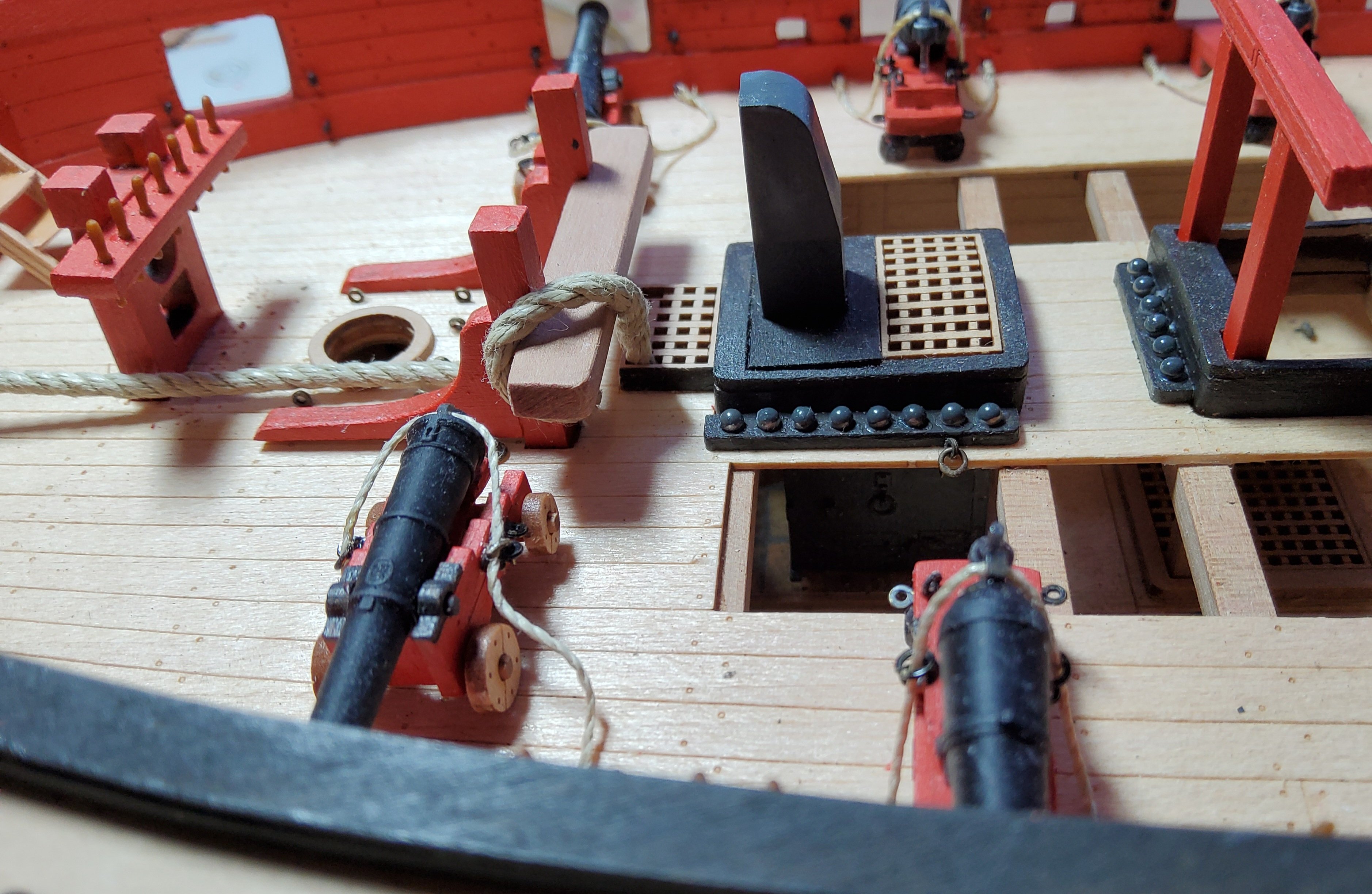

I have doubts about the kit set-up where the large cables are shown feeding thro’ a small grating just above and forward of the Galley stove above the open hearth.
I think this is a steam grating for the stove and a fair run of these heavy and often wet cables would appear to be impeded by this arrangement.
5205a
The cables with the kit arrangement would exit the lower deck almost vertically to the Riding Bitts in a position that would involve tight bends of the cable if the Riding Bitts are used for their purpose. The run of the cables also risk fouling the rigging connection points around the partners of the Foremast.
5203a
My view is that the cables would run to the Main hatch as was the usual practice.
5204a
With this arrangement stoppers could be used to take the strain whilst at anchor.
I usually like to display anchors with the cables secured to the Riding bitts but there are issues that preclude this with Harpy.
On a fully decked model this would not be a problem as the cables would run below decks unseen. With Harpy the lower deck is on view so simply feeding the cables down the main Hatch with a short loose end is not an option.
It is difficult to imagine how an anchor cable with a scale length of 120 fathoms would even fit on the Harpy model.
We know from the Adm. plan the location of the cable storage compartments running either side of the ship on the Lower deck.
These are nicely depicted on the model, but as with the Adm. plans there is no indication how the compartments were accessed to stow the cables.

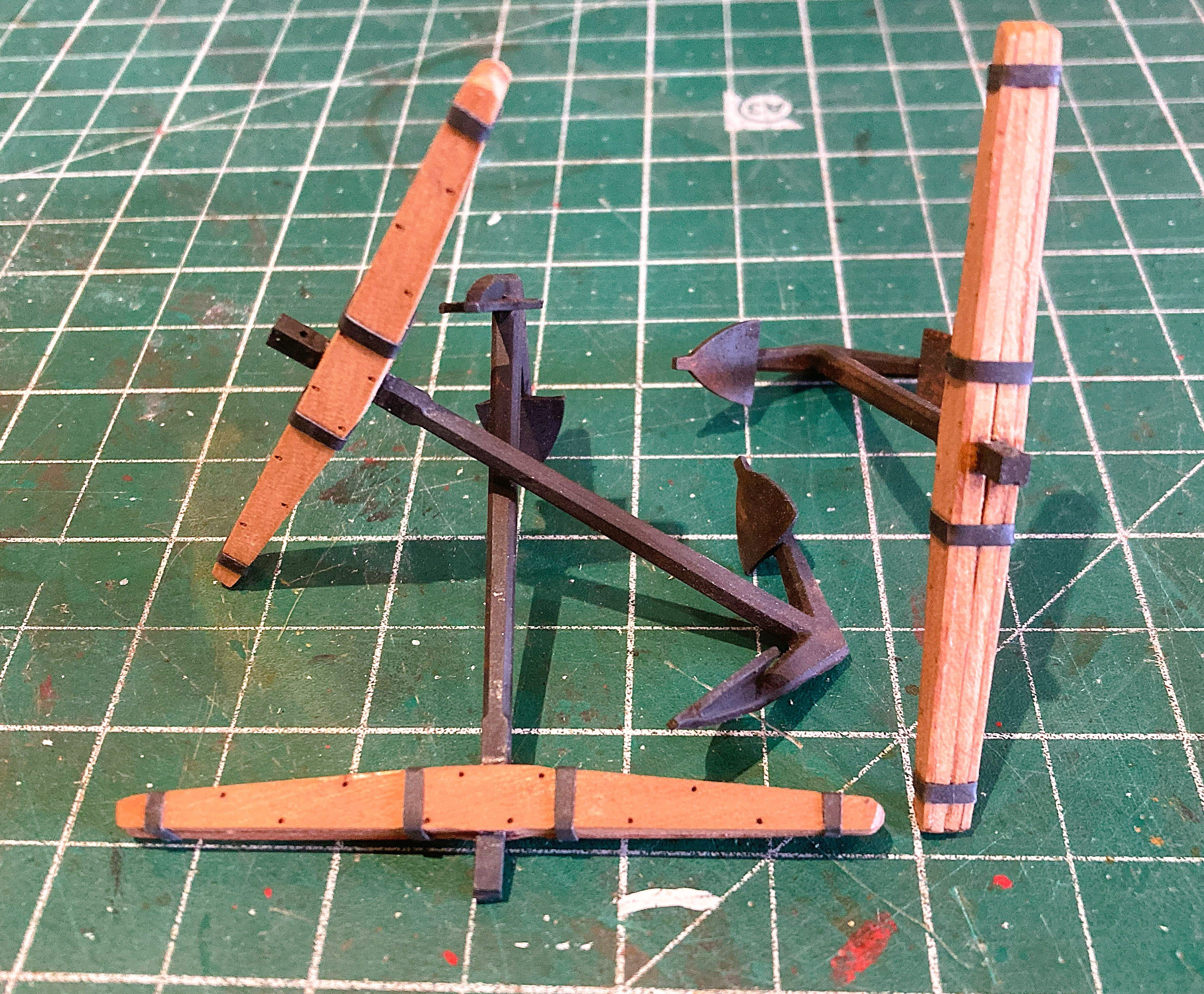

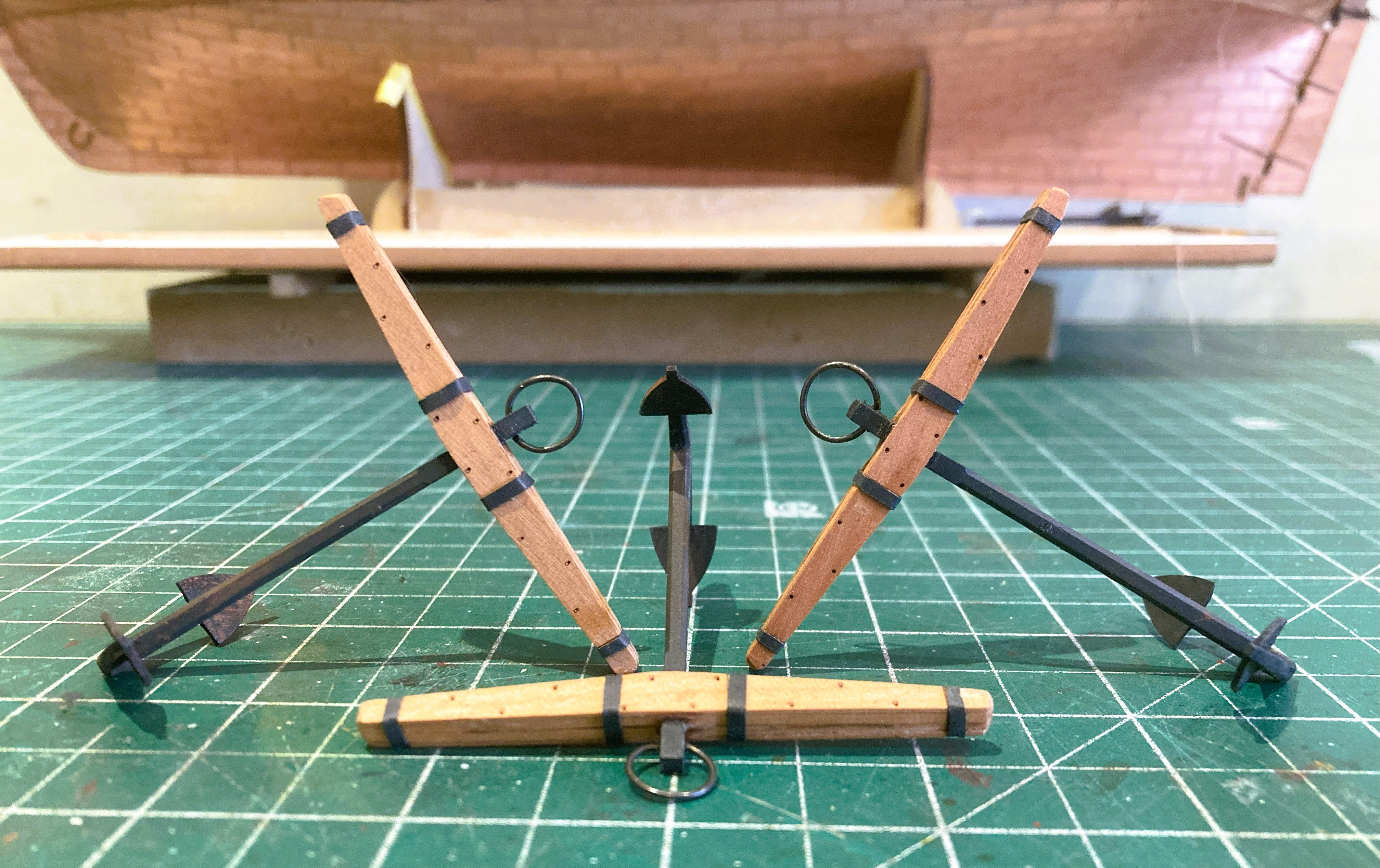

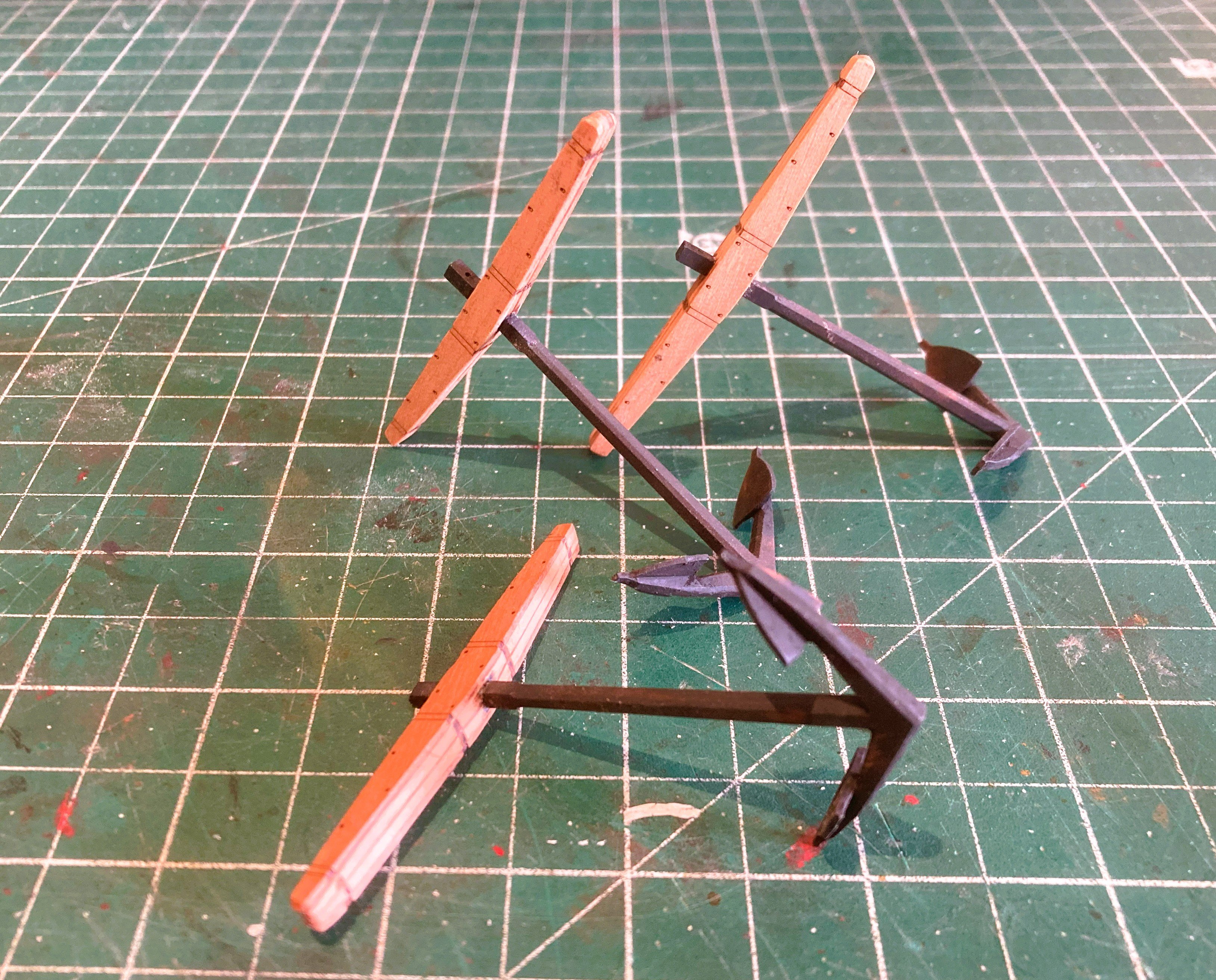

Assembly of the Anchors
The anchor stocks are correctly formed in two halves fitted either side of the shank. I found it necessary to broaden and deepen the slots on the stocks and also file down the resin shank so that the stocks fitted together allowing for a narrow gap between them adjacent to the shank.
5207a
I assembled the stocks and shanks before adding the facing pieces. A slight taper was formed toward the stock ends.
5216a
I used Vallejo Black/grey to paint the anchors followed by use of Dark Brown and Rust weathering powders.
5219a
The iron bands are represented by Heat shrink tubing on the model.
5220a

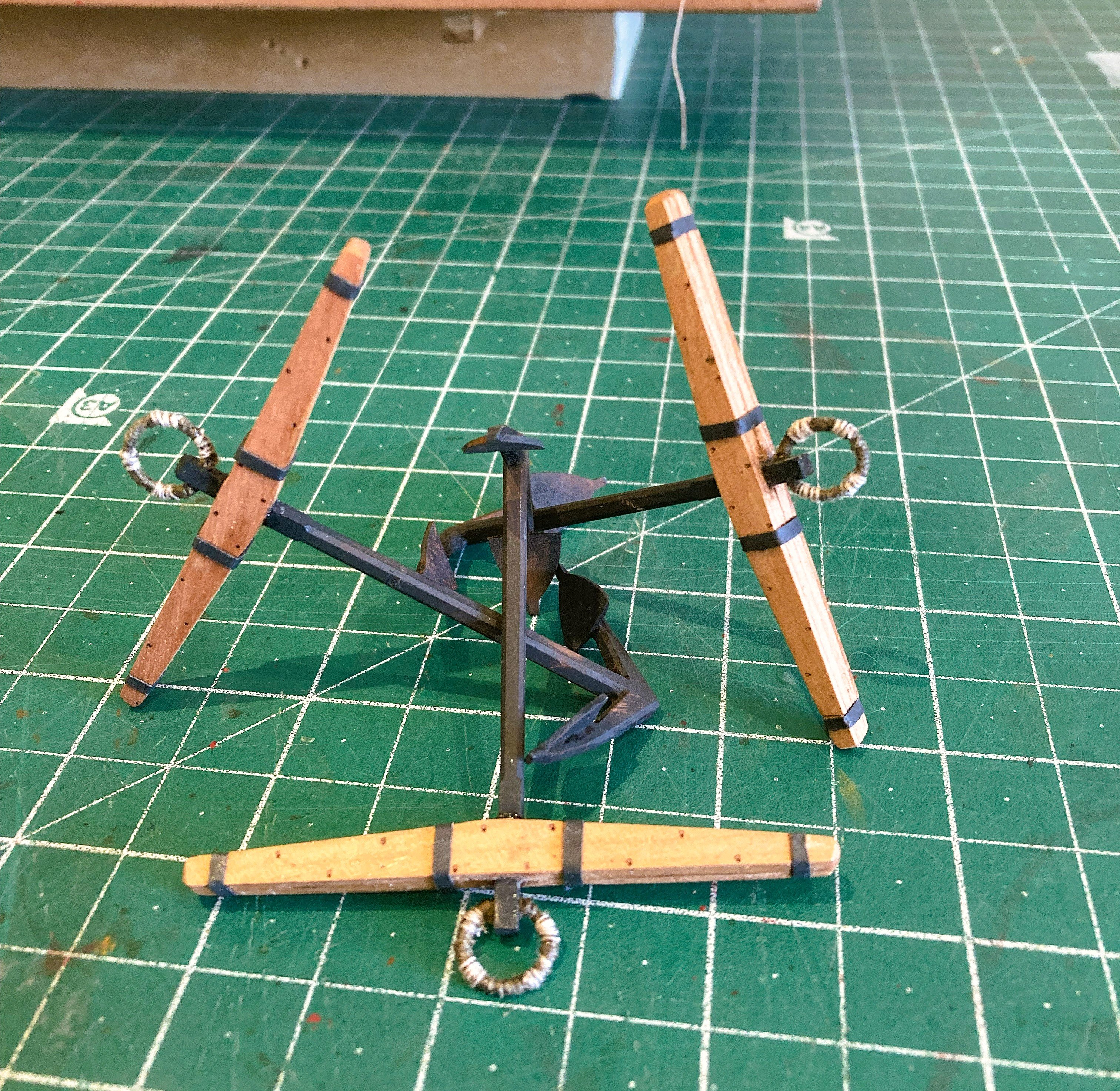

The Anchor rings are provided in etched pe.
I replaced these using 1mm brass wire with an outer diameter of 8mm. For the Puddening I used 0.30mm line.
5223a
Applying the puddening can be a bit of a faff unless the Anchor ring can be held secure during the process.
5231
The anchors are now completed, and I’ll decide on the display later.

Looking at the location of the capstan in image 1588a I tend to agree with you as to where the anchor cable ran utilizing a vyol (viol) and nippers.
The cable would be coiled below in a heaping stack, one to the port side and one to starboard (or larboard) and it involved a major portion of the crew over a good portion of the day to accomplish the feat.
Alan O'Neill
I'm hijacking Maurice's thread here a little.
I did a trial fit of the anchors on my Harpy but ran the cable around the bitts and then down the hole in the foremost grating as the instructions suggest.20250728_164910.thumb.jpg.f3784be88639c11dc63560ec075d124f.jpg
However, I can see a potential problem with my method and and also with Maurice's. If I've read the rigging plans correctly, there are four rigging lines tied around each end of the horizontal beam of the bitts. Some interference would almost certainly occur between the rigging and the anchor cable if the latter is also wrapped around the bitts. Maybe the rigging lines have to be moved. A bit of a puzzle.
Cheers
Richard
