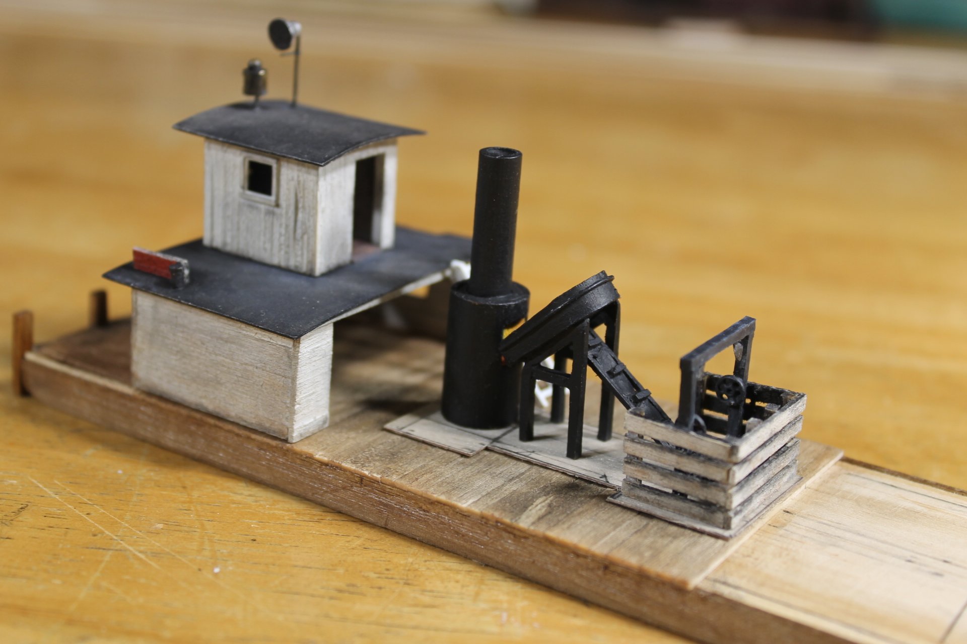

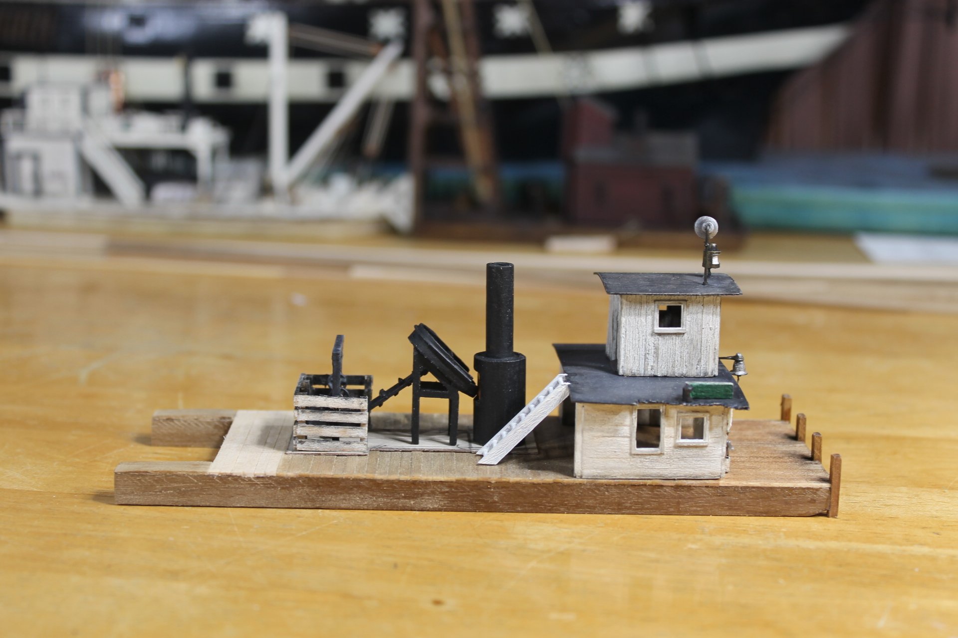

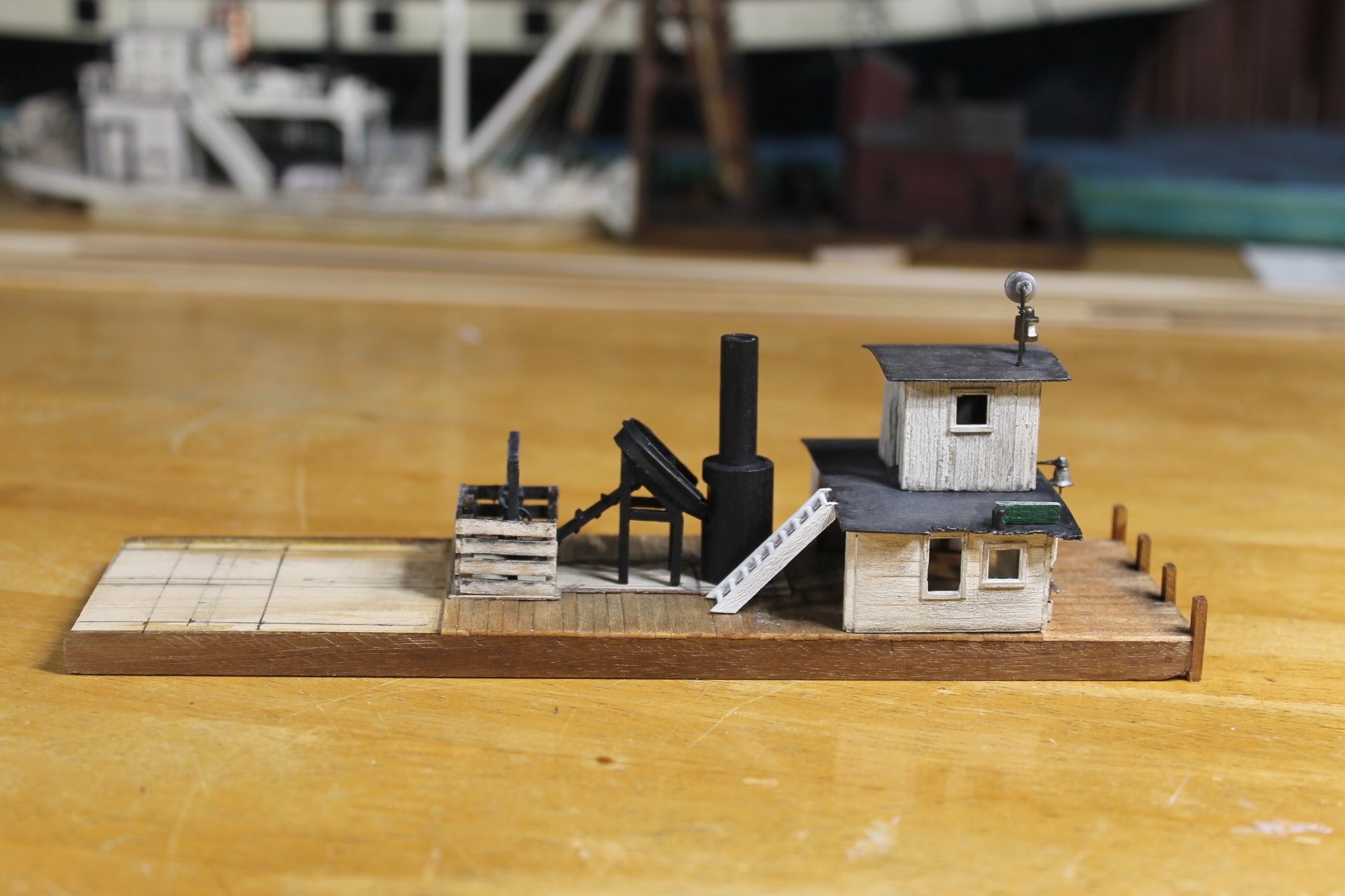

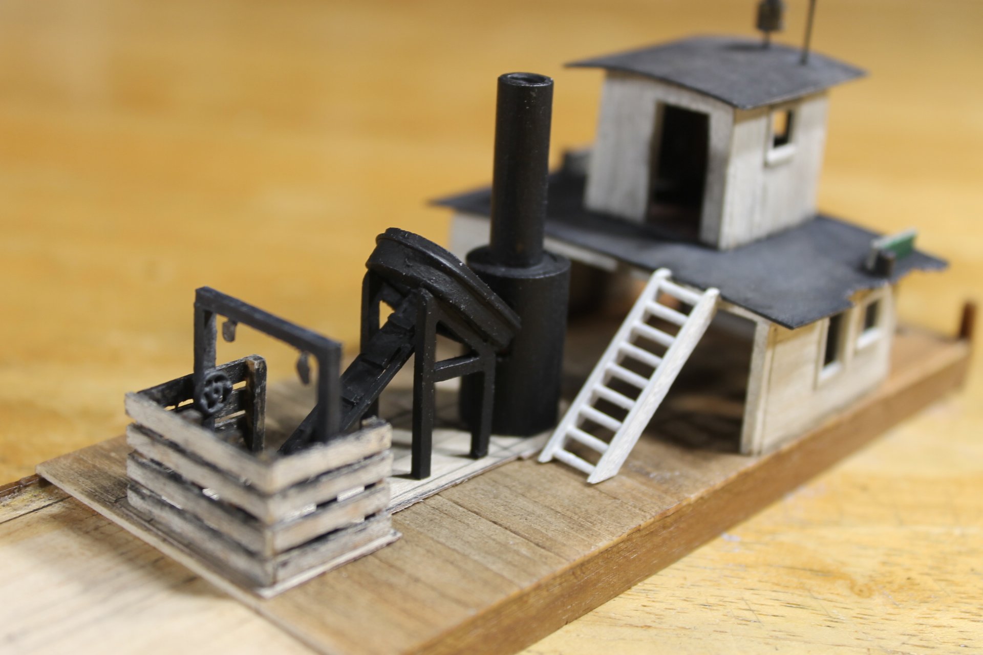

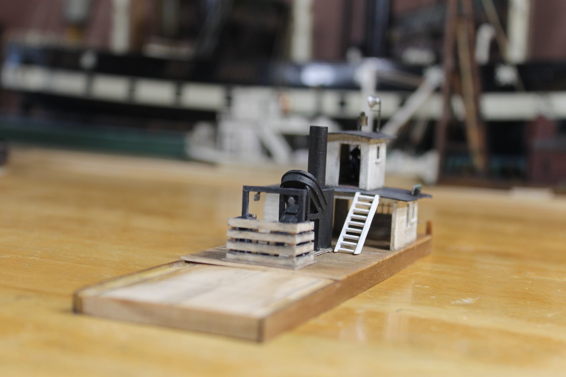

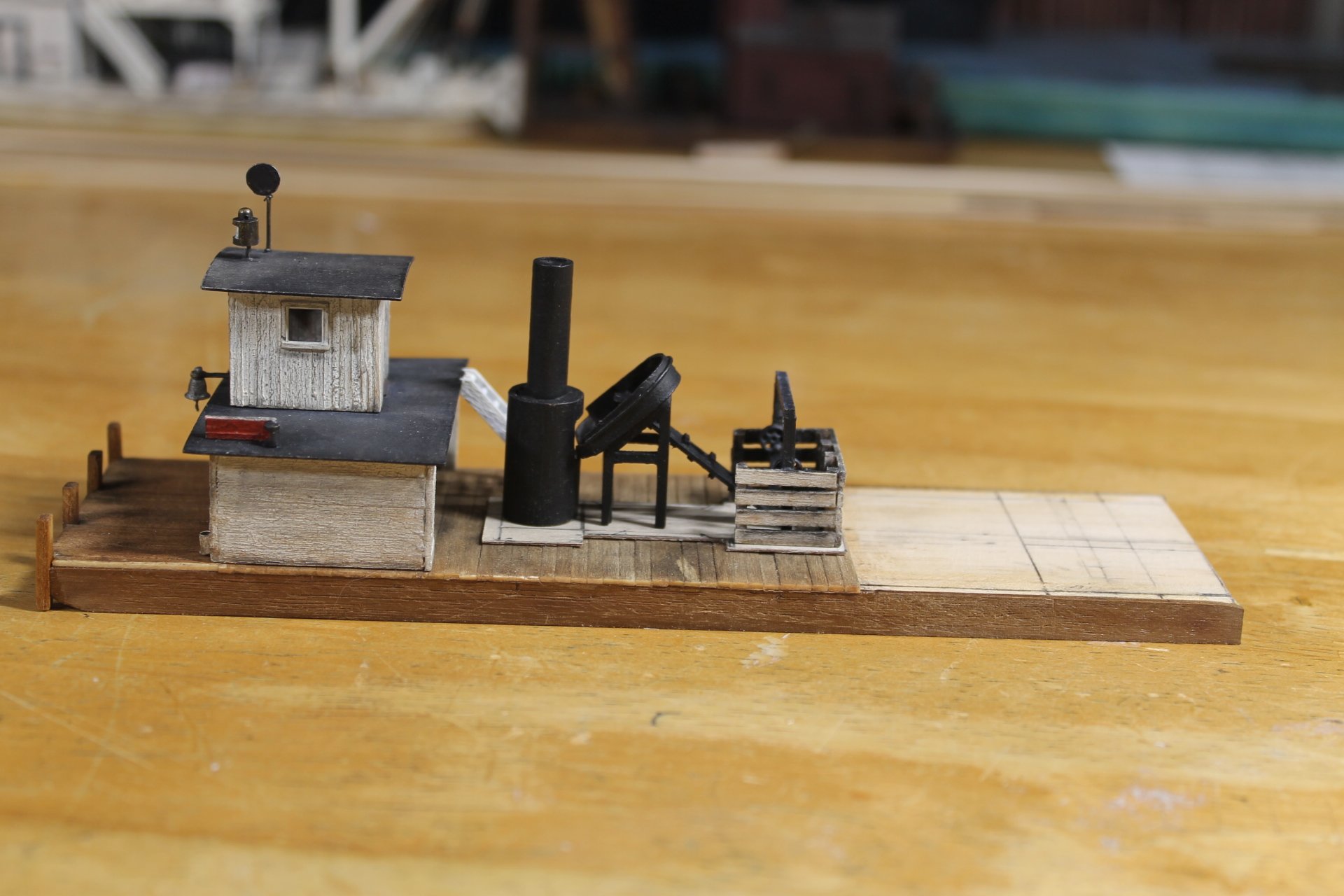

 The coal feeder body is done, sorry I just realized I didn't add a photo of the table throat. I still need to add lever, gears, rig the lines to conveyor tail, and put coal on the conveyer.  There is a sequential gluing order to that list and I'm still trying to figure out the best way to do that.
 Once I have the boiler's port side fire and clean out doors added I can the glue the boiler to the steel plate. I can add coal to the conveyer at any time but the trick is adding coal to the coal crib without the crib being glued into place because I need to be able to lift the crib to rig the blocks to the conveyer tail. It's kinda like needing three hands to do something.
 As you can see in this photo I got the boiler lit. :)
 I'm going to add five feet of deck space (0.5 inches) aft of the coal crib and then make the wheel's cutouts. Once the cutouts are made she should start looking more like a towboat.
 View as seen in the original from aft photo.
 Thoughts
 The steam engine is directly underneath the pilothouse in the engine room. This allows the Skipper to control the engine without need of an engineer to do so. This means the shaft ran below the boiler, coal feeder and coal crib in the rudder chain tunnel.
 The deckhand's bluejeans, teeshirt, and baseball cap wasn't normal work clothes till the late forties early fifties. The photos show a vessel with antiquated machinery in a general rundown condition. Had this ole gal been pushing barges for twenty/twenty five years? Other than electricity, what other "modern" updates had been added through the years?
 I am fairly certain there was a water tank connected to the boiler on the port side up next to the pilothouse.  Water would be pumped to the tank and from tank to boiler. With that setup there would always be water available for boiler startup without the need to start a pump as the boiler water on startup would have been gravity feed.
