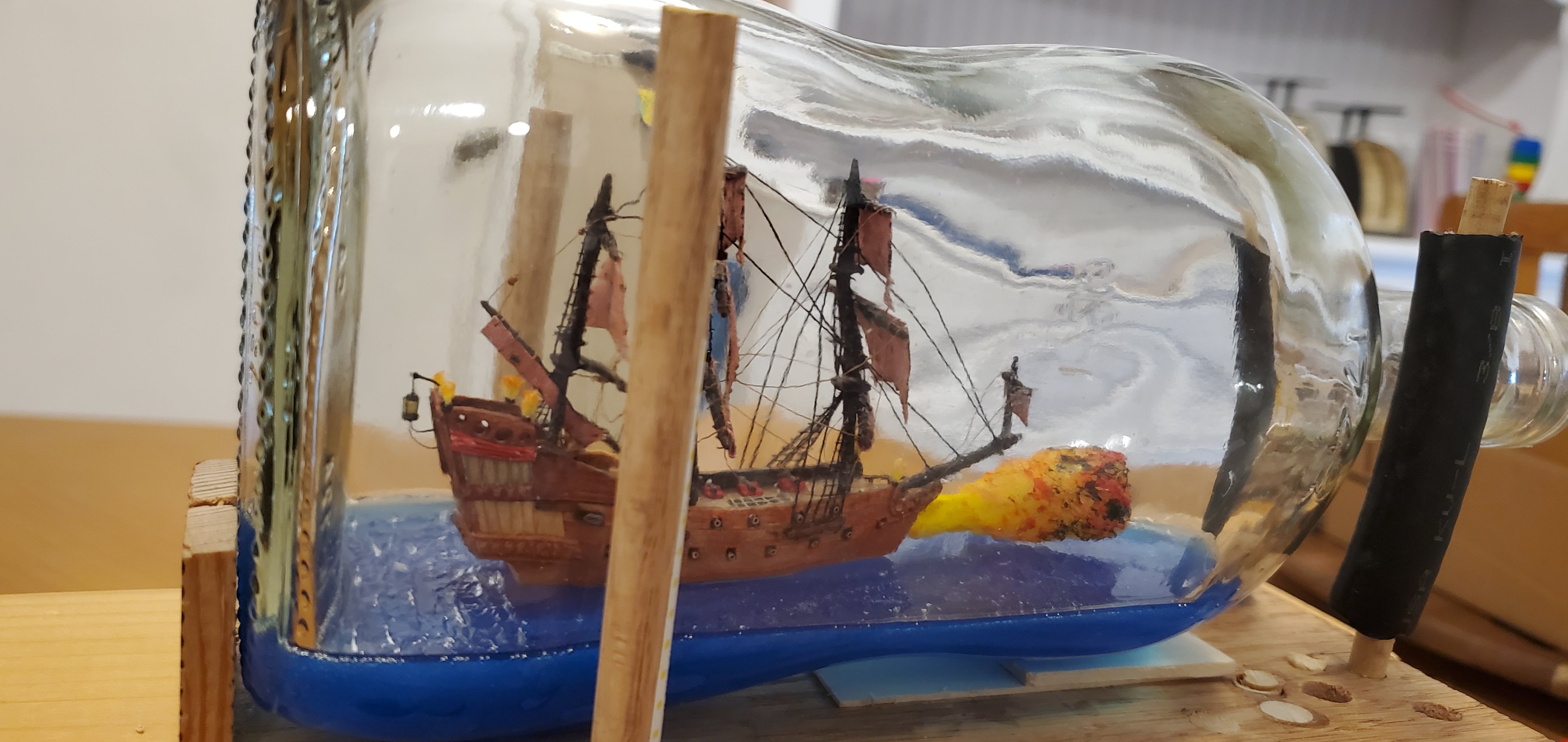

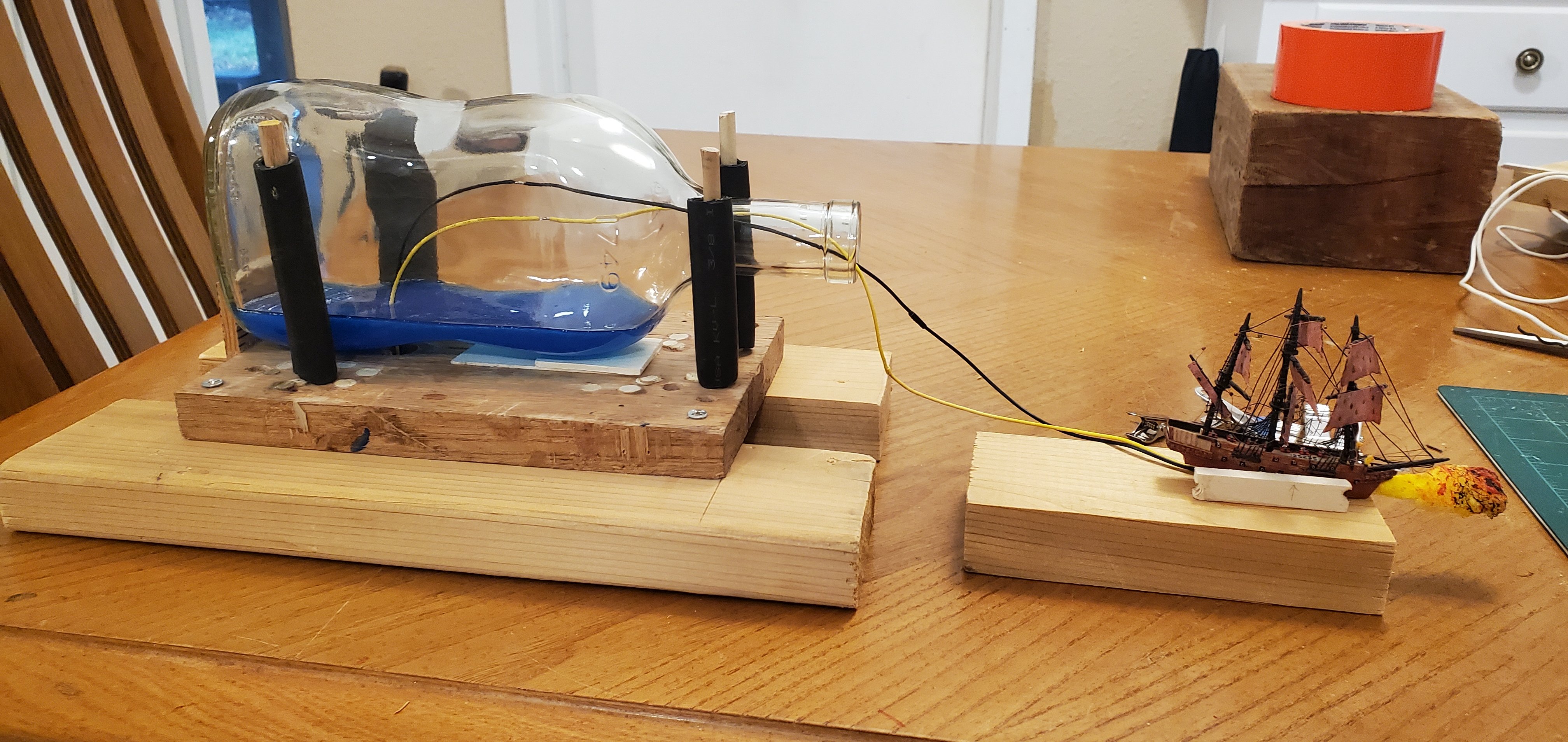

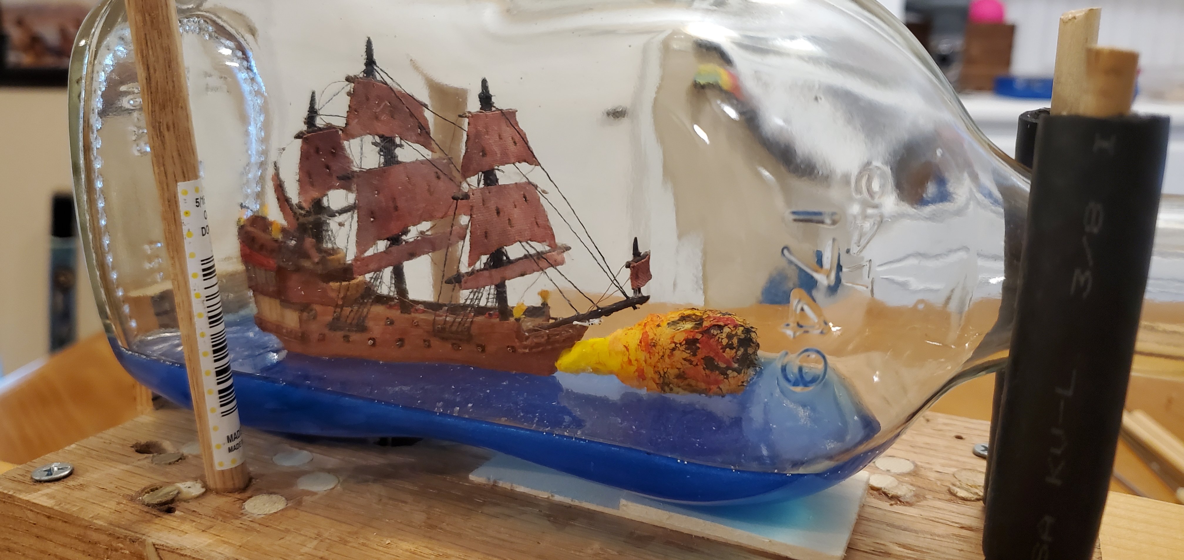

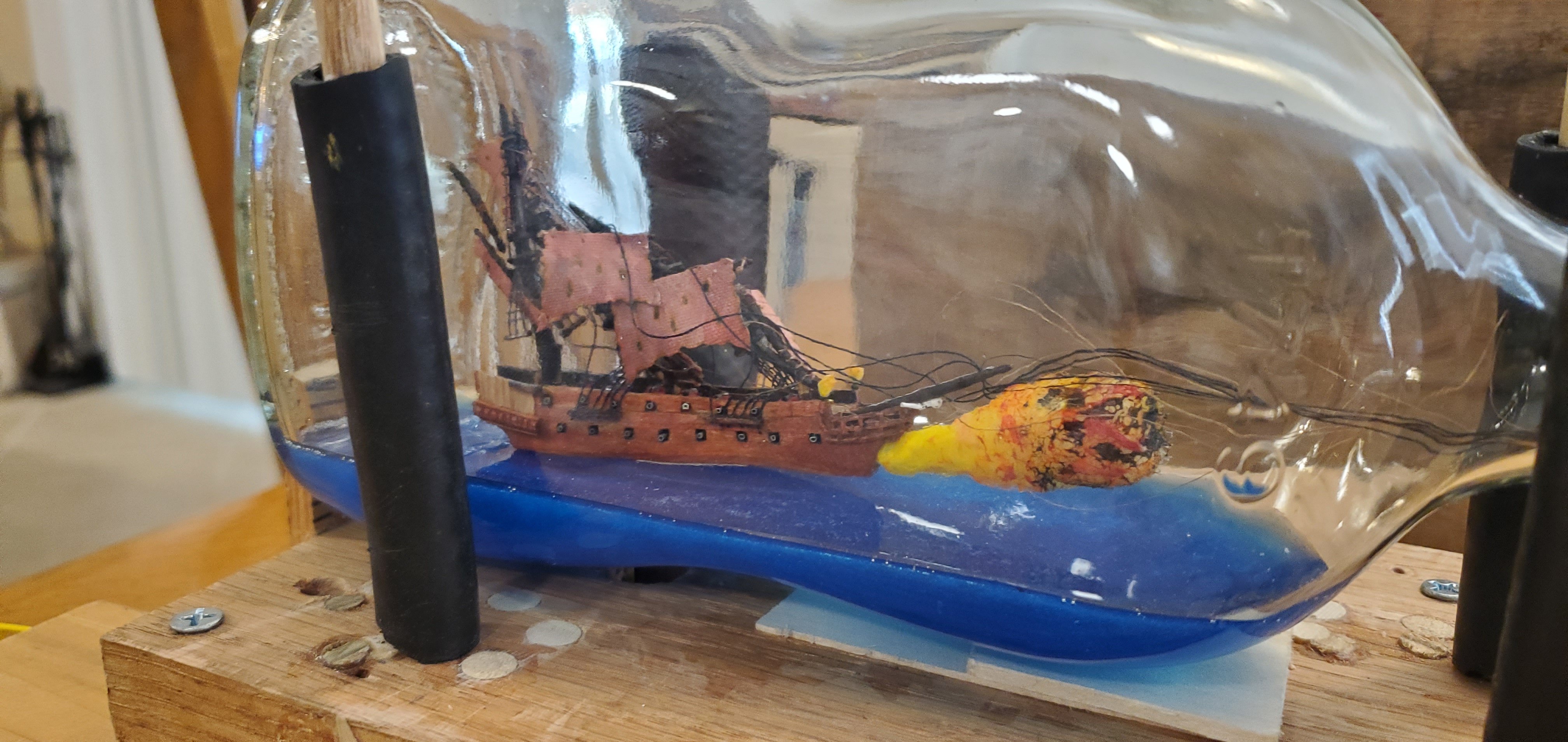

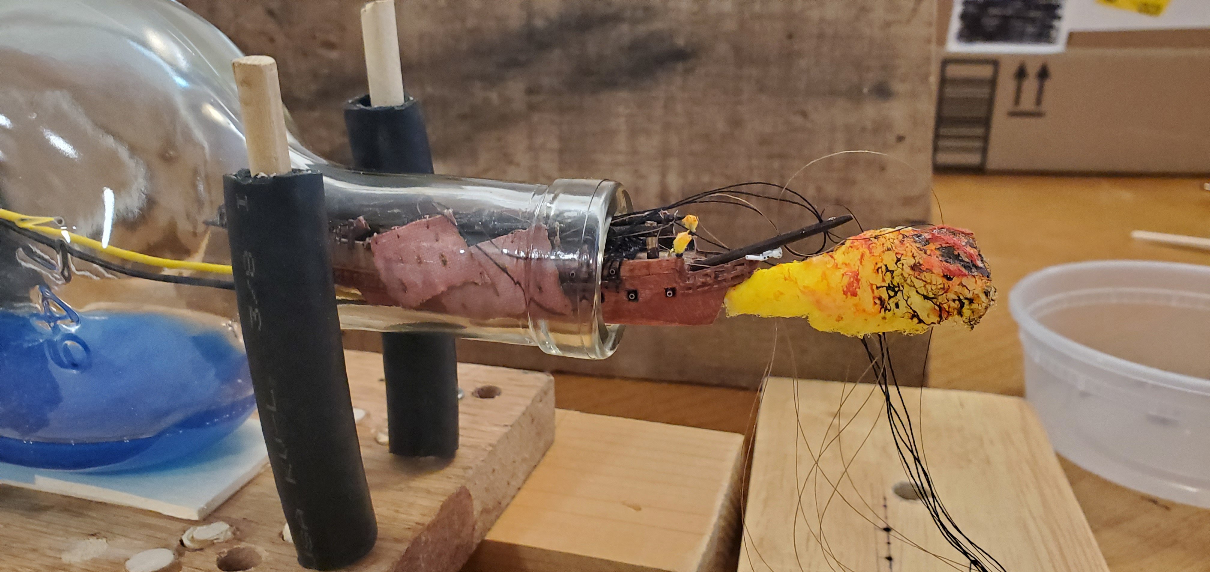

It was a long and frustrating day on Saturday, trying to get that dang ship in the bottle (while watching college football games out of the corner of my eye).  Here's the Revenge on the playing field with her back to the opponent, right before kickoff,
Things began ok.  I had to wad things up VERY tight just to get the end of the ship barely in the bottle.  Of course the wires sticking out the base of the ship did not help, but fortunately, they kind of fit in the bottom curvature of the bottle's neck.  I started pushing the ship in, but hit a snag snag right off the bat.  So I pulled her out, mashed her a little tighter, and tried again.  I'd push her in some, pull her out, mash some more, then push her in a little further, pull her out, mash again...  Rinse and repeat.  I kept thinking something had to break, but I didn't hear any cracks or snaps, so I kept working her in.  Finally, after about 45 minutes, the Revenge dropped in.
It's always hard to tell at first, if anything got damaged or if lines are tangled beyond hope.  But at least the fireball looked like it survived.

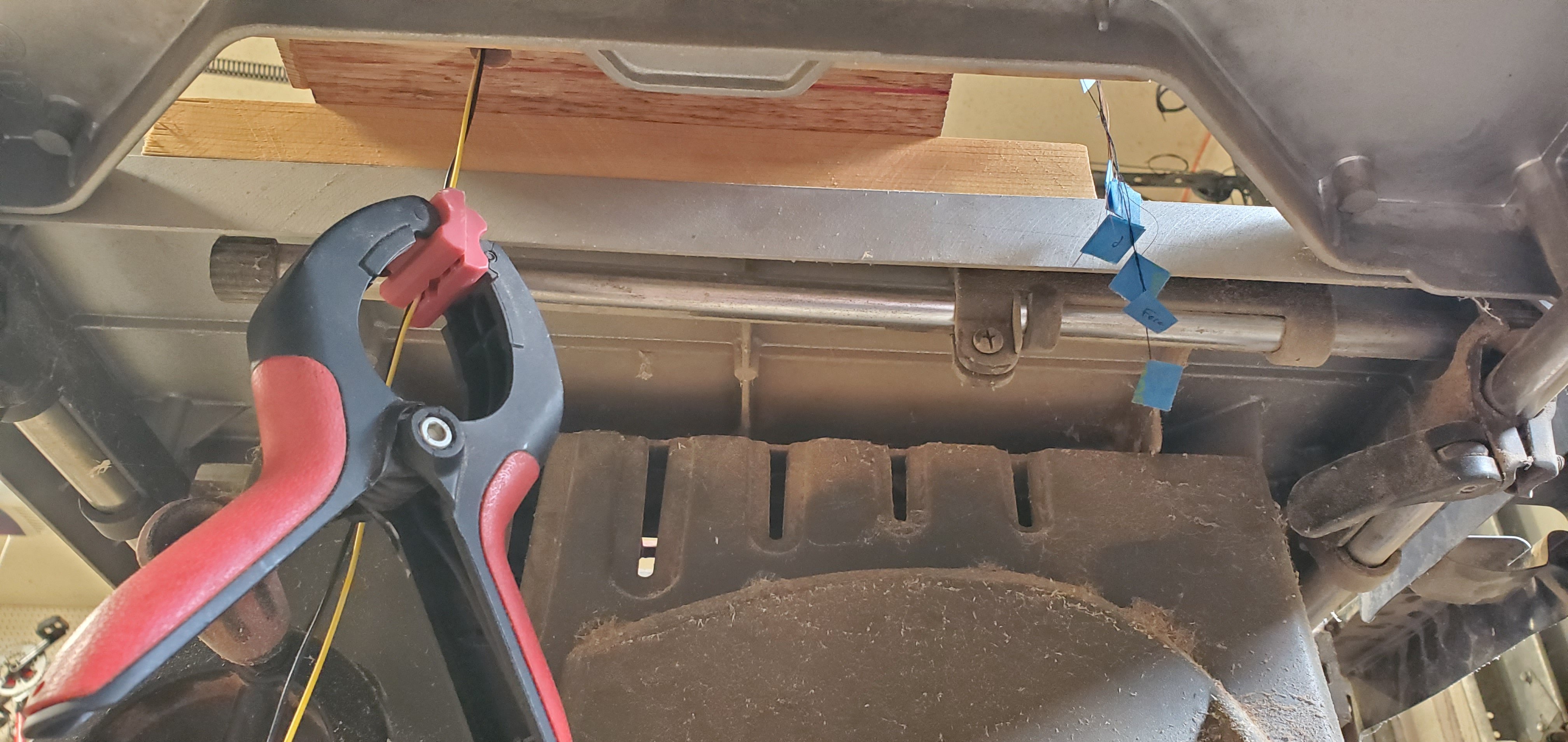

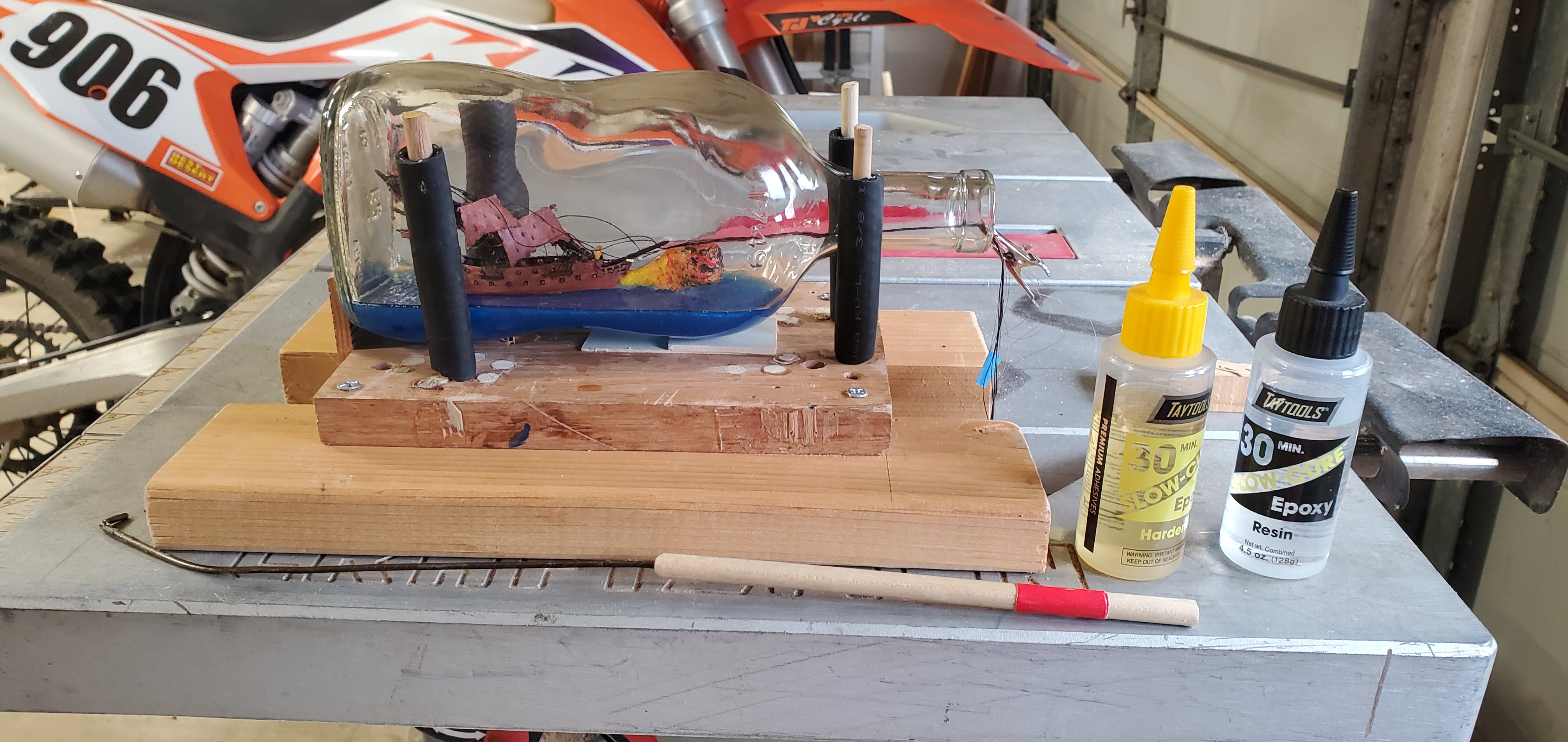

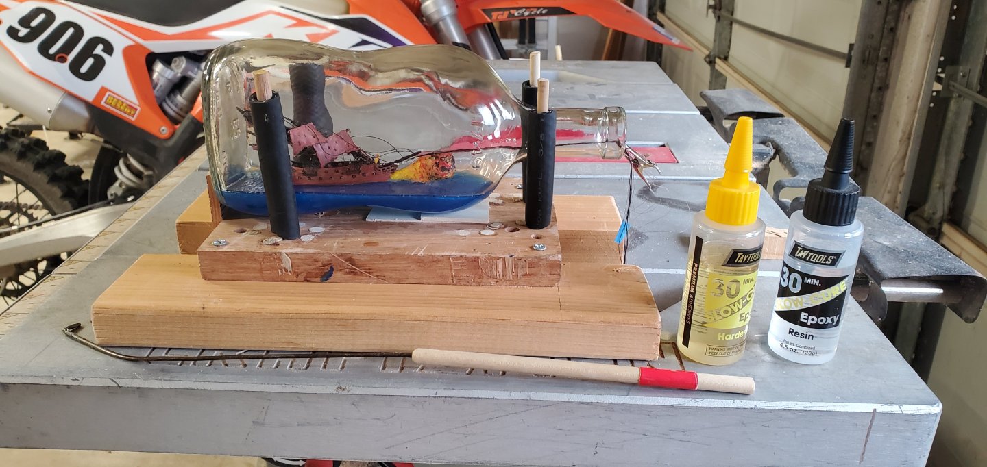

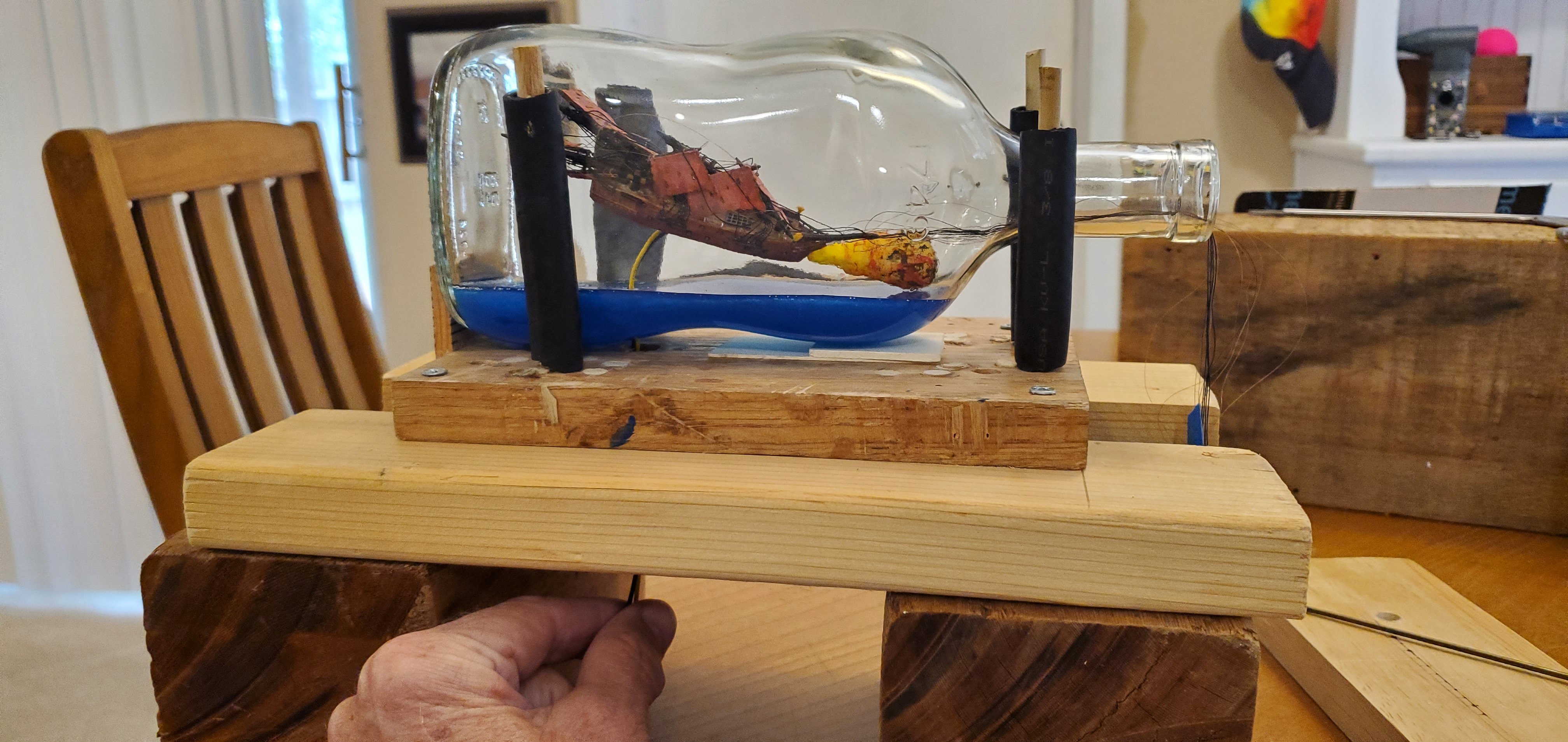

The next major obstacle was securing the ship to the water.  Normally, that's a piece of cake.  But the LED wires presented a problem trying to get the bottom of the ship to lie flat against the surface of the water.  The good news was that the wires allowed me to push the ship upwards and hold it so I could easily get some epoxy in place.
To get the ship to lie flat against the water, I took the whole thing to my table saw and used the gap for the side extensions to run the wires straight down.  Then I attached a large clamp that was just weighty enough to pull the ship flat, but not pull the wires out.

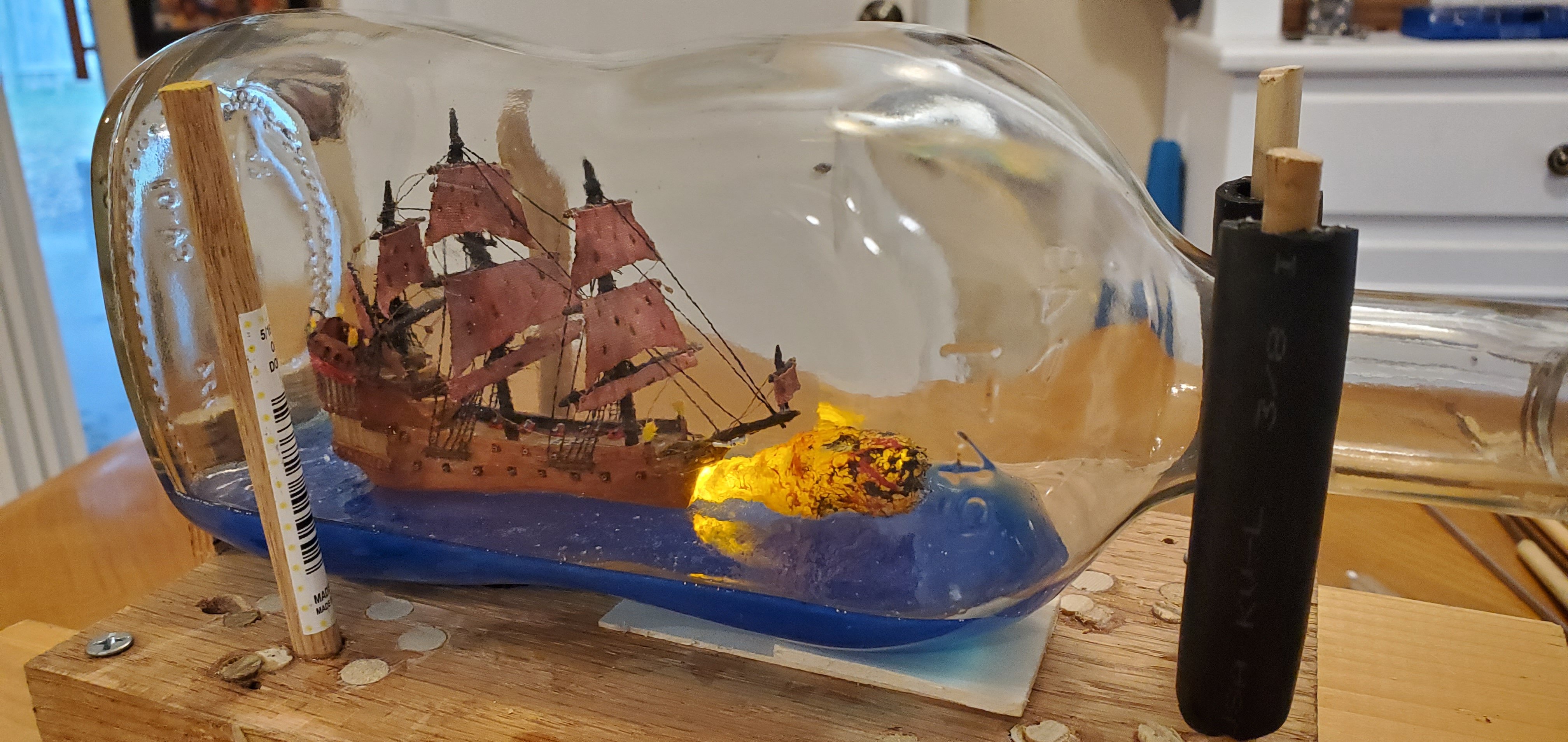

Once the epoxy set and the ship was secure against the water, it was time to untangle the lines and raise the masts.  That was an hours-long and nerve/patience testing process  After that, I added the stern structure behind and the double-balcony piece in front of the mizzen mast.  That took a couple of hours.  Despite the custom tools I made for the process, I still kept dropping the pieces and having to retrieve them from the bottle and start over.  It was quite a relief to finally get them in place and glued down.
Next was gluing the mizzen channels to the stern structure.  After that, I added the sprit mast and its tiny rigging.  That was pretty easy.  The final part of the ordeal was tightening all the lines and cutting them off.  Here's how she looks resting comfortably inside the bottle.  And the fireball lighting still works!  Whew!
I like how the fireball light reflects off the water.  It will look different after I add waves, but hopefully I will still get a cool reflection.
There's still a ton of work left, but at least the scary part is over!

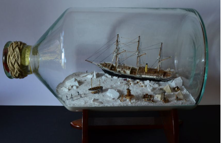

Another subject that may be of interest could be Shackelton's Endurance stuck in the Antarctic ice flows with the crew camped on the ice next to the ship

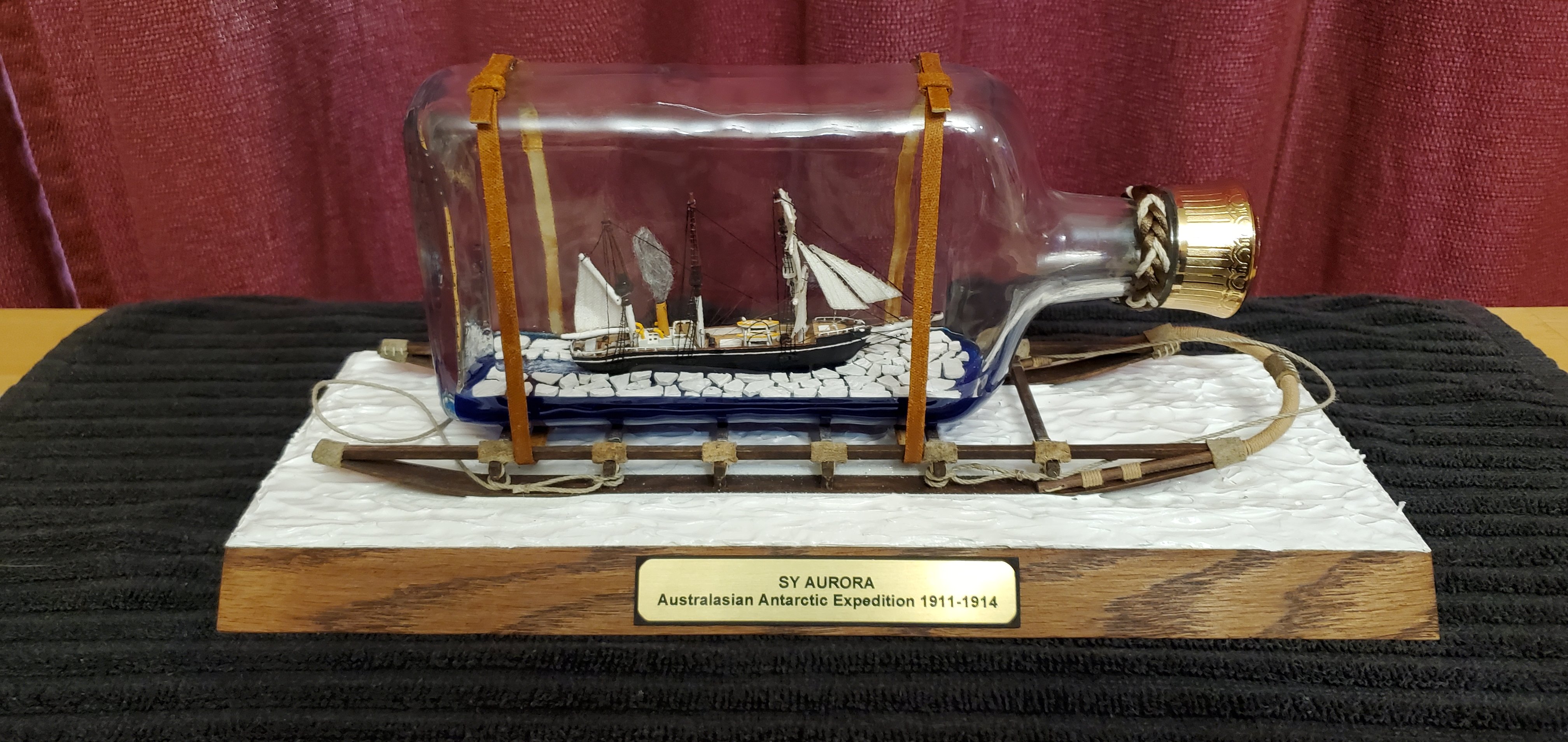

I have always been fascinated by the Heroic Age of Antarctic exploration - Shackleton, Falcon, Amundsen, etc, and my personal favorite subject, Sir Douglas Mawson.  The scene you describe, Kenny, has been done masterfully by a professional SIB Modeler named Gabrielle Rogers.  So I would not want to go there.  My second SIB effort ever, 4 years ago, was the steam yacht that Mawson used on his expeditions, the Aurora.  I hate to put a picture of my work next to hers, but you can see the Aurora in the 2nd pic below.

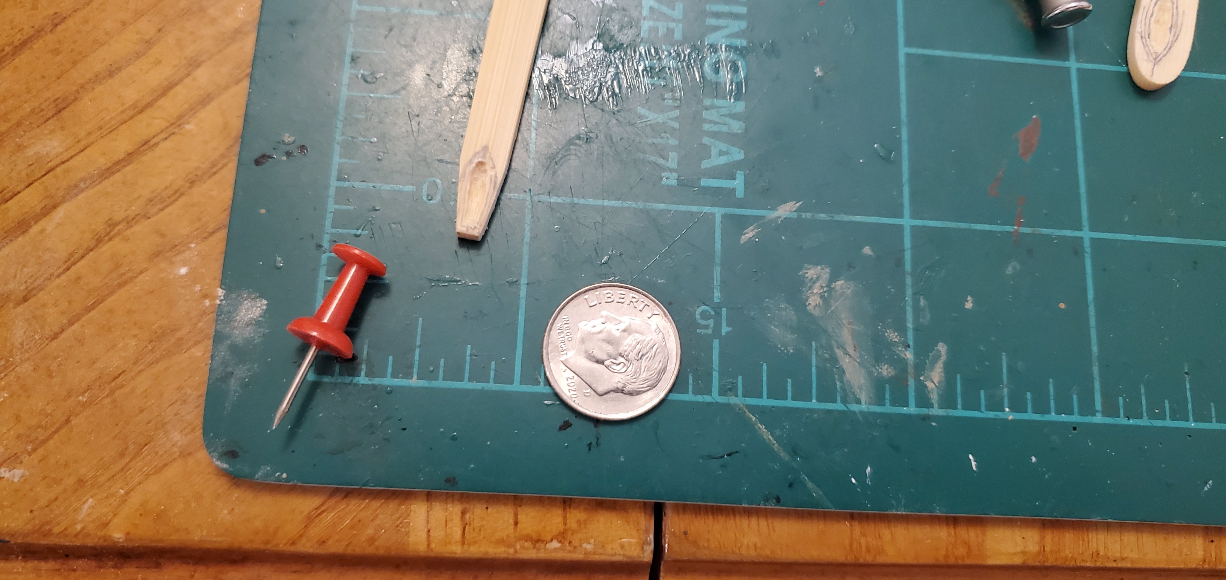

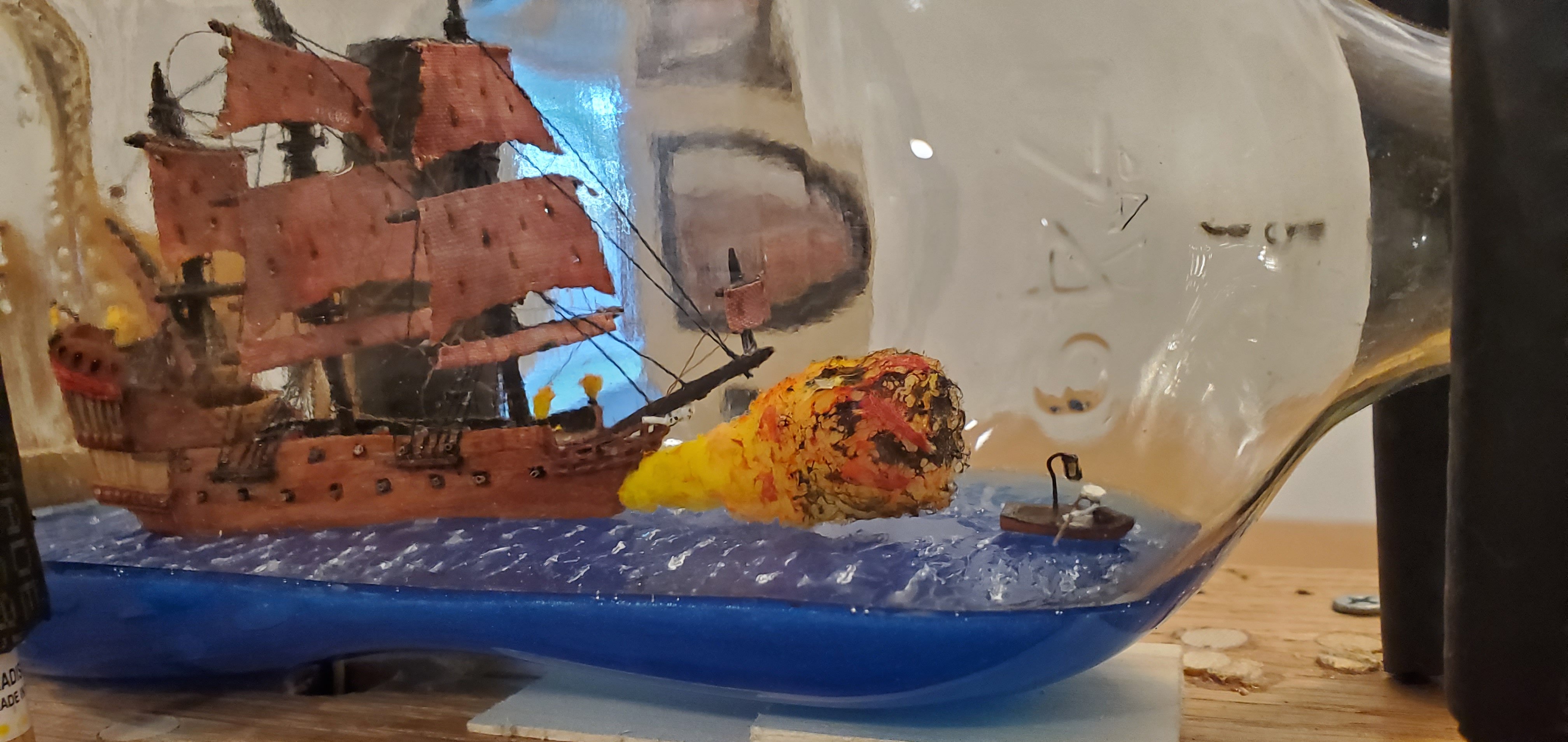

I love discussing ideas for future projects, but as I mentioned earlier, there's still a lot of work left on the Revenge.  @Javelin mentioned above that everything was a perfect fit in the bottle.  What Roel did not realize was that I still had one more thing to float on the water - the hapless cook in the longboat rowing frantically trying to escape the fireball.  Here's a screenshot from the movie.

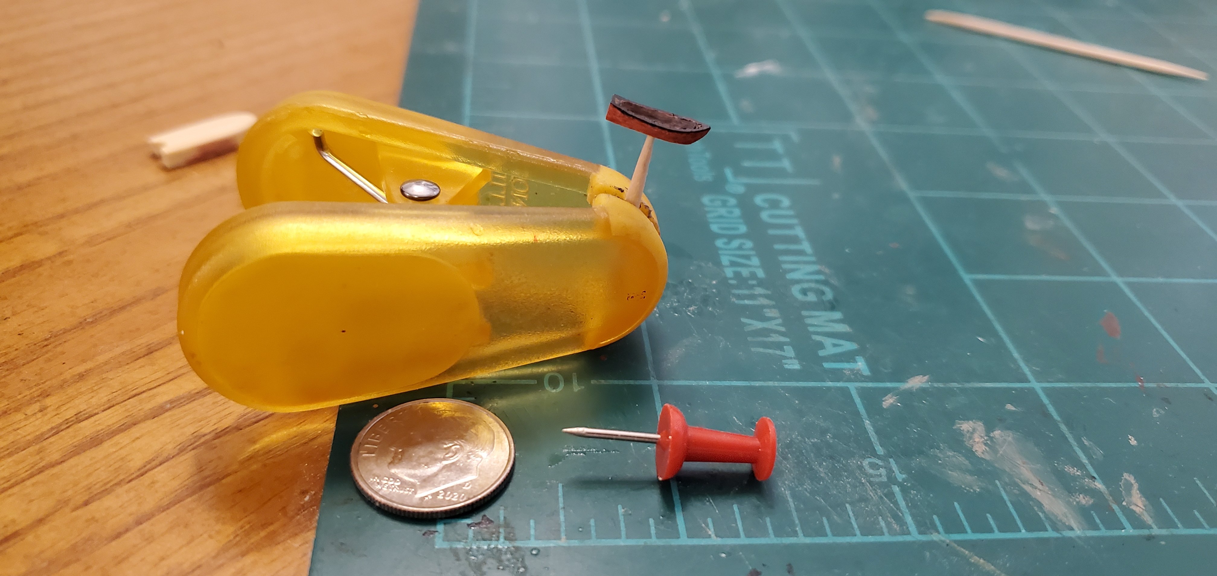

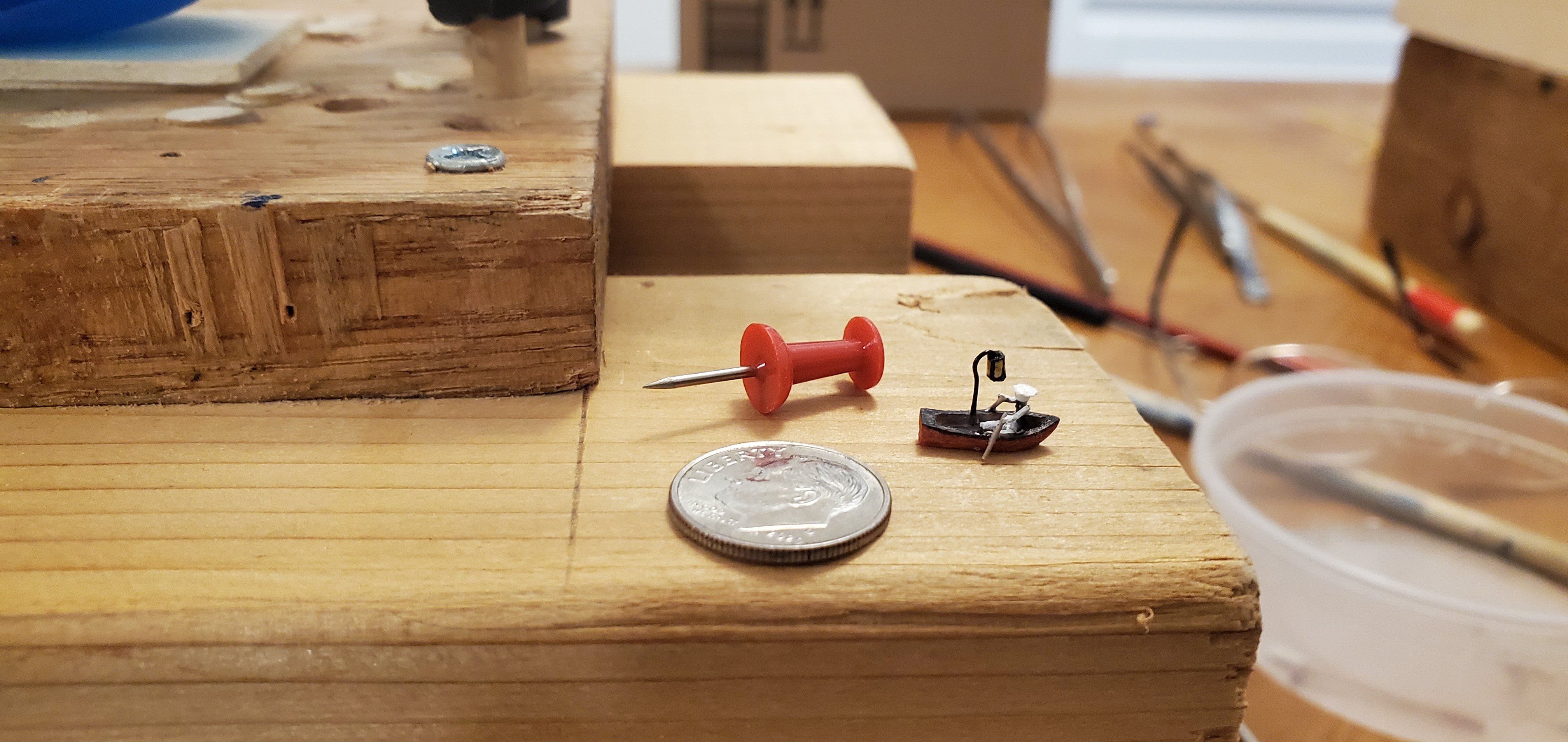

I've made mini-longhorns for a previous build (Zheng He Treasure Fleet), but this was my first try at making a very tiny person.  First though, the long boat carved from a bamboo stir stick borrowed from Panera's.
Here's the little dude in the boat with a hanging lantern.  His body was made from Play-Doh and arms from brass wire.  His head is a tiny bead.
And now in the bottle, a moment before he pays the price for all the mutineers.
And with that, I believe I'm done with everything inside the bottle, except for some spot cleaning.  Now I can turn my attention to the presentation.  Still working on ideas for that.

Glen, the picture of the Endurance in the bottle is absolutely a work of art.  I don't think that I would want to attempt it either because I would not be able to come anywhere near that level of craftsmanship.  The artist/modeler did a fantastic job.
Now, your model of the Queens Ann Revenge is equally a masterful work of art.  I cannot wait to see what you come up with for the display base.
