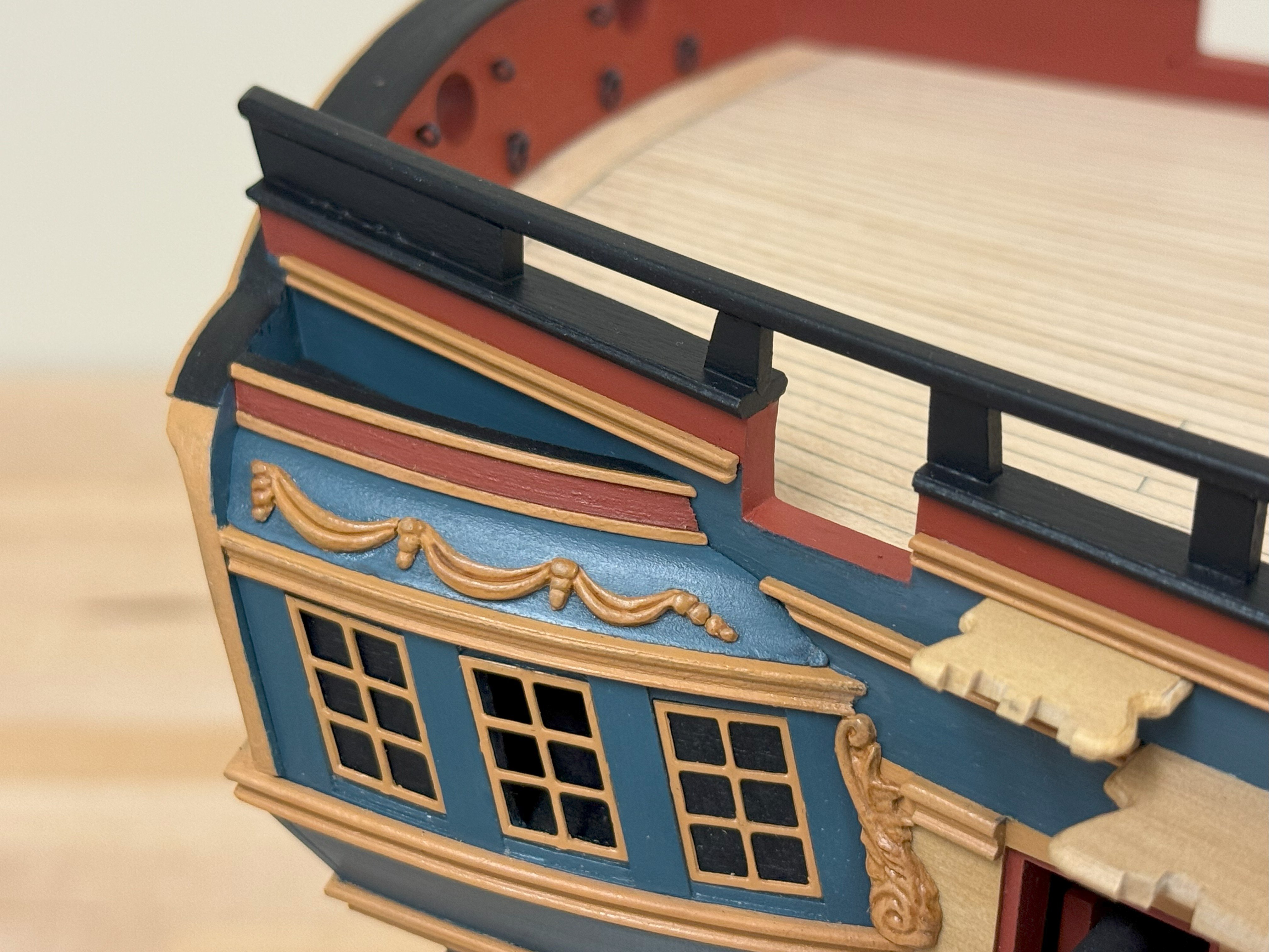

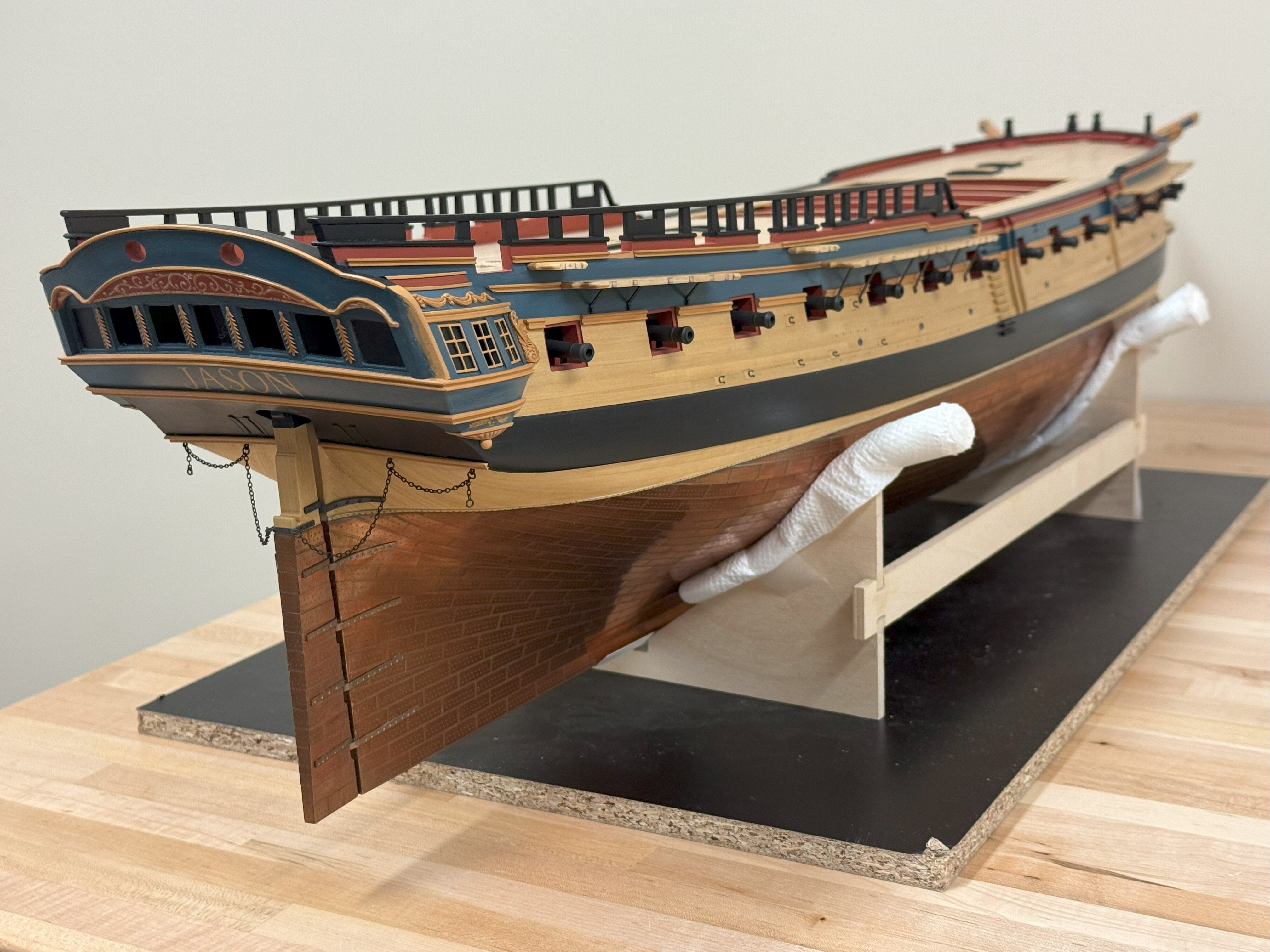

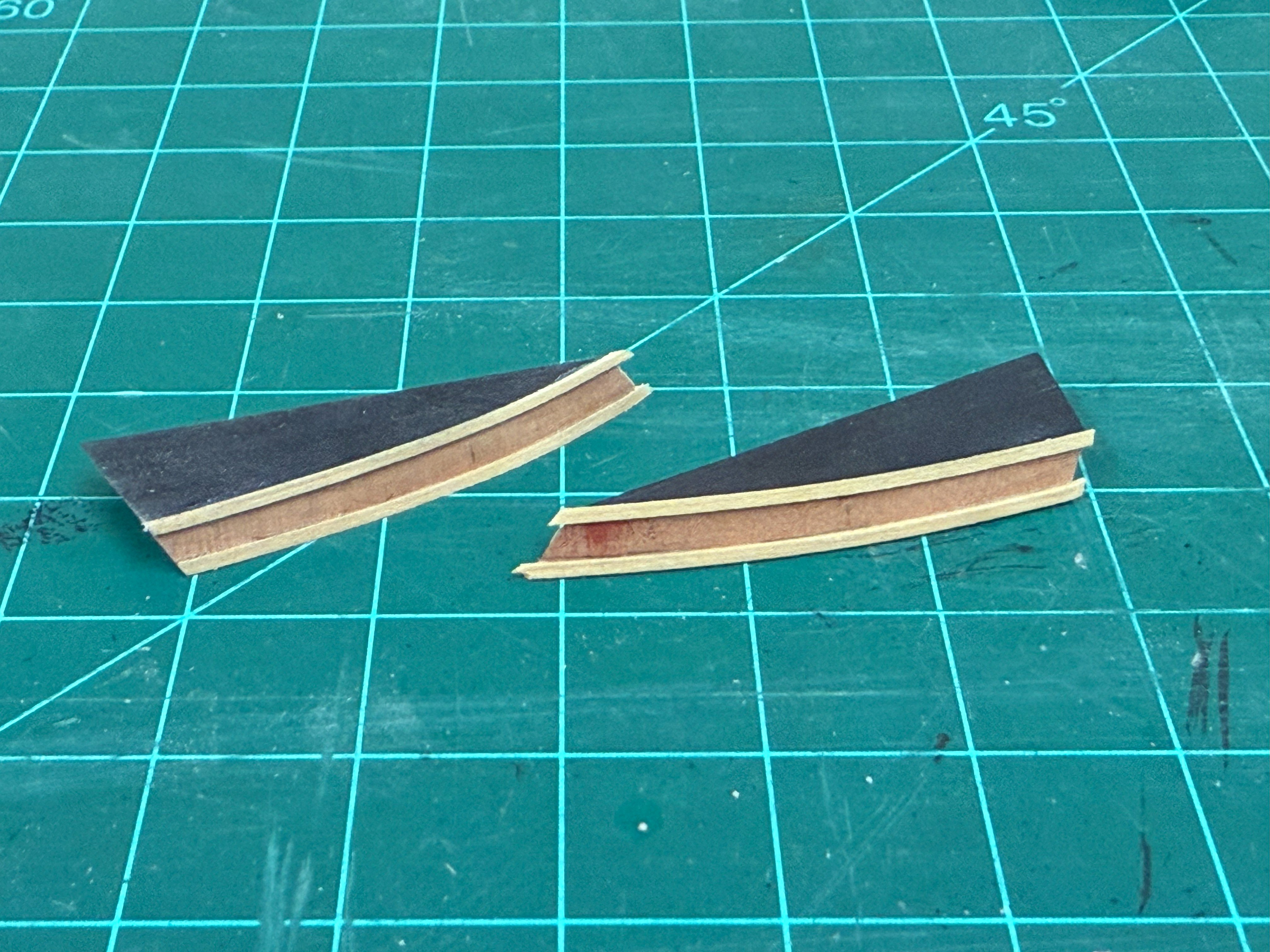

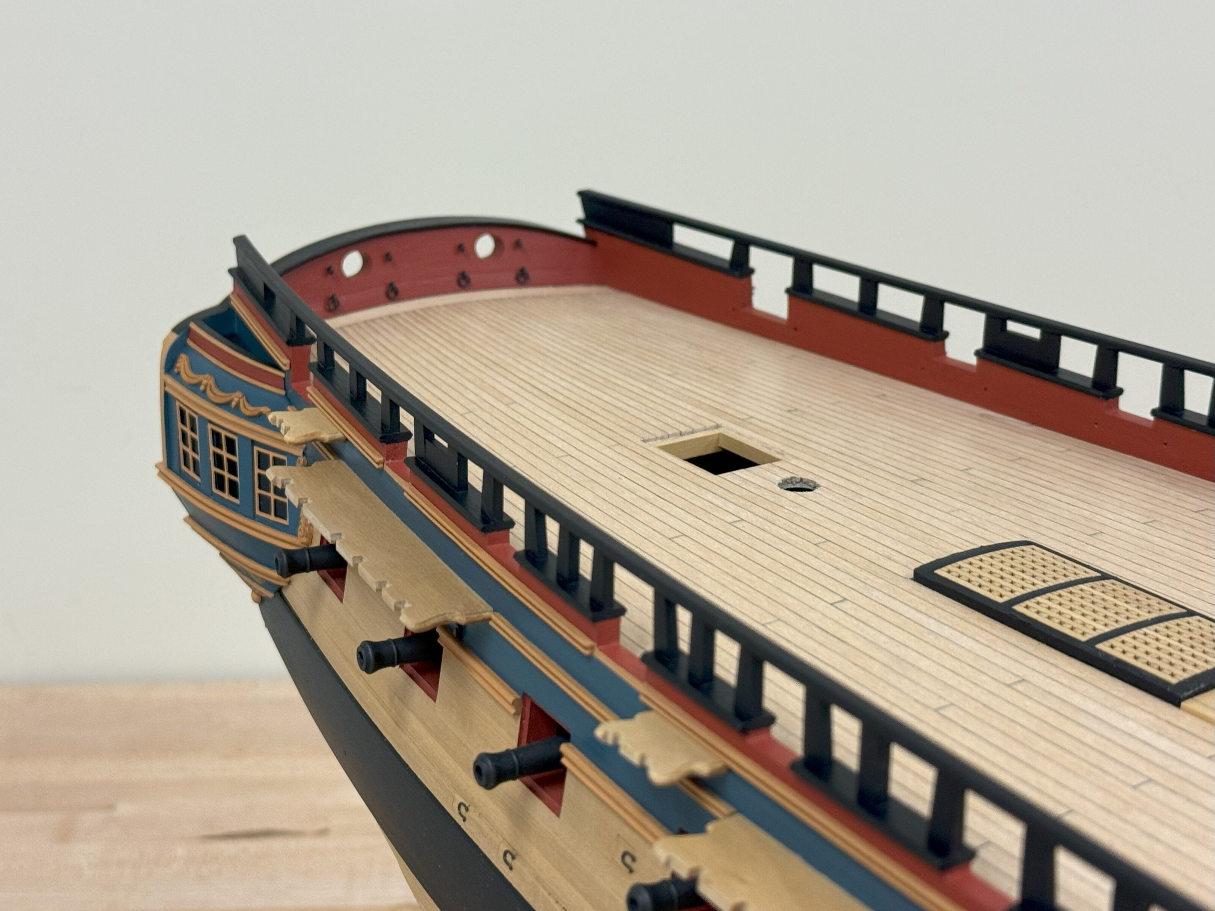

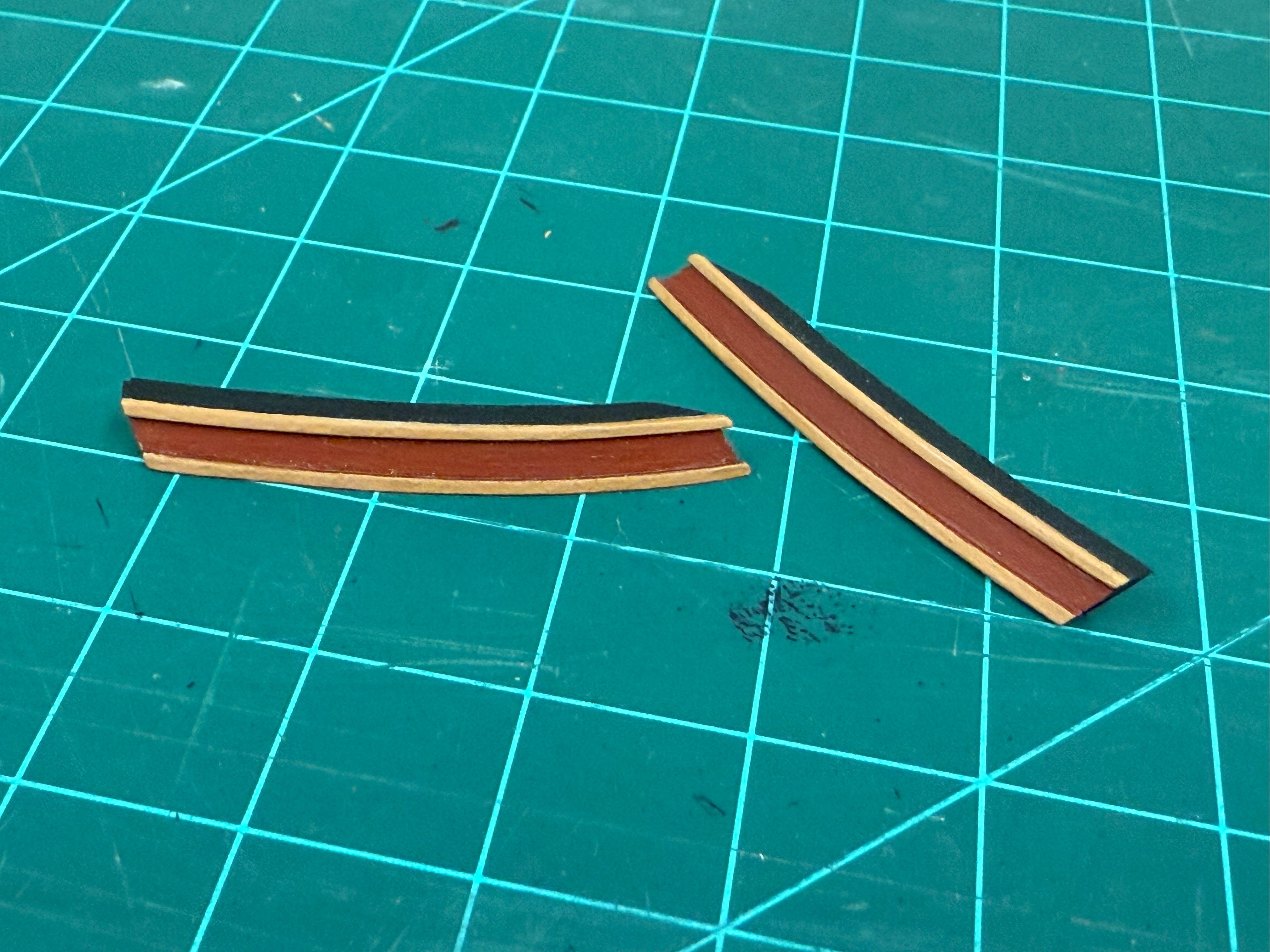

It has clearly been a very long time since last I was here and I hope that people remember me!  Suffice to say it has been hard to make any progress beyond a snails pace.  I last left off after focusing on the complex bow structures.  To keep moving I needed to install the rough tree rail and the various supports as well as the Fretwork to the upper finishing.  Dimensions were estimated from plans and contemporary model, and these all seem to vary to some degree.
I had held off making the fretworks as I wasn't sure of the approach, and I wanted to get a curved profile.  In the end, shaped billets were made to size and shaped, thin 1mm square boxwood strip (which I had hand sanded down to ~0.5mm) was then glued to the upper and lower edges.  Once dry, the back was cut away and finished by hand.  This is where the piper must be paid for any prior size and alignment estimates- as things stood I'm estimating that this is maybe 1mm shorter than it should be per the various plans and diagrams (4mm vs 5mm), but this was necessary to sit appropriately.IMG_4519.thumb.jpeg.fcb54b5c890562e0332e7855e75d2bf5.jpegIMG_4509.thumb.jpeg.3adaf05ba41ac33d9dbdfc22bd553e28.jpegIMG_4520.thumb.jpeg.c28d17a2ad0e7615db6fa3bbbdcf6ea7.jpegIMG_4531.thumb.jpeg.d501ff55714031b0dd8dd603a52fd577.jpeg
Unfortunately, my progress was so slow making the rough tree rails that I neglected to take photos.  These were cut from 2mm boxwood following the profile of the hull and were 3mm wide.  The curved for'ad sections were made separately using a similar technique as taken for the decorative rails and then joining to the main rough tree rail.  This follows the sheer of the deck, rather than the wale, so a template was made to ensure that these were positioned correctly.  The timberheads were then added using 2x5mm pear strip., because these are continuations of the frames, they need to be perpendicular to the keel.  There seems to be a huge amount of small variation on how these were constructed and captured on plans and models, and a variation even between the plans I have for HMS Jason showing these and the various Artois class models.  The template was once again used to ensure the consistent height above the deck.  Much of this process required fine adjustments using the Mk. 1 eyeball which seemed to take a considerable amount of time.  In the end, I drew inspiration from model 1794-3 illustrated on page 19 of the AOTS Diana book.  This has 2 curious semi-bulkheads installed in the timberheads, as well as being solidly built up at the stern.  I have no idea what these are as I haven't seen them anywhere else.  The mizen and main backstay stools have also been glued into position.  Finishing up with some overall shots of where things stand (The quarter gallery lights are not attached, but were placed to get a sense for proportion when finalizing the fretwork)
IMG_4521.thumb.jpeg.c594f4fc6099f11e3ee4ec959c88fd66.jpegIMG_E4525.thumb.jpeg.01ba1433d573be8f9108f83a5e992728.jpegIMG_4523.thumb.jpeg.0f57466eb8b9963e7db8c8c17c0e69b9.jpegIMG_4530.thumb.jpeg.1e024ef2d902daac62ff760b63023d95.jpegIMG_4532.thumb.jpeg.7e37d47e30f7bbcf84663ea46706d6fb.jpegIMG_E4529.thumb.jpeg.041d5250aa3b2ef1d8db86285ac582a9.jpeg
