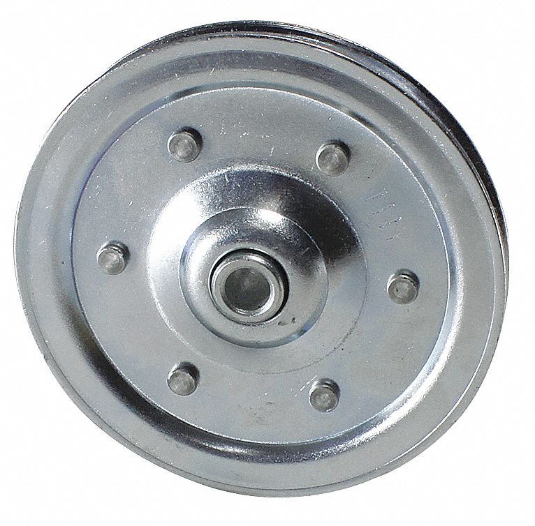

Your results may vary as I said.  BUT after you lay up your rope, make sure you tie a knot on each end.   Poly wants to unravel.   Remember Morope!!!  Its crazy.    Then get yourself a toaster oven....or use a real oven.    Wind your rope around a metal sheave or pully.  I have these!!!!  Garage door pulleys.  They work fantastic.
5MVF5_AS01?$mdmain$
Then place these in your toaster oven at 350 degrees for no more than 5 minutes.   If you approach 400 degrees yo will make a mess.  The poly will melt.   After much trial and error this is the best temperature......also, no longer than 5 minutes because it will also change the way the rope looks and feels.  Let it cool off on a rack.   Now you can cut the ends with a sharp blade without any worry that it will unravel.  This recipe and process makes perfect rope out of 100% polyester like Guterman MARA.
