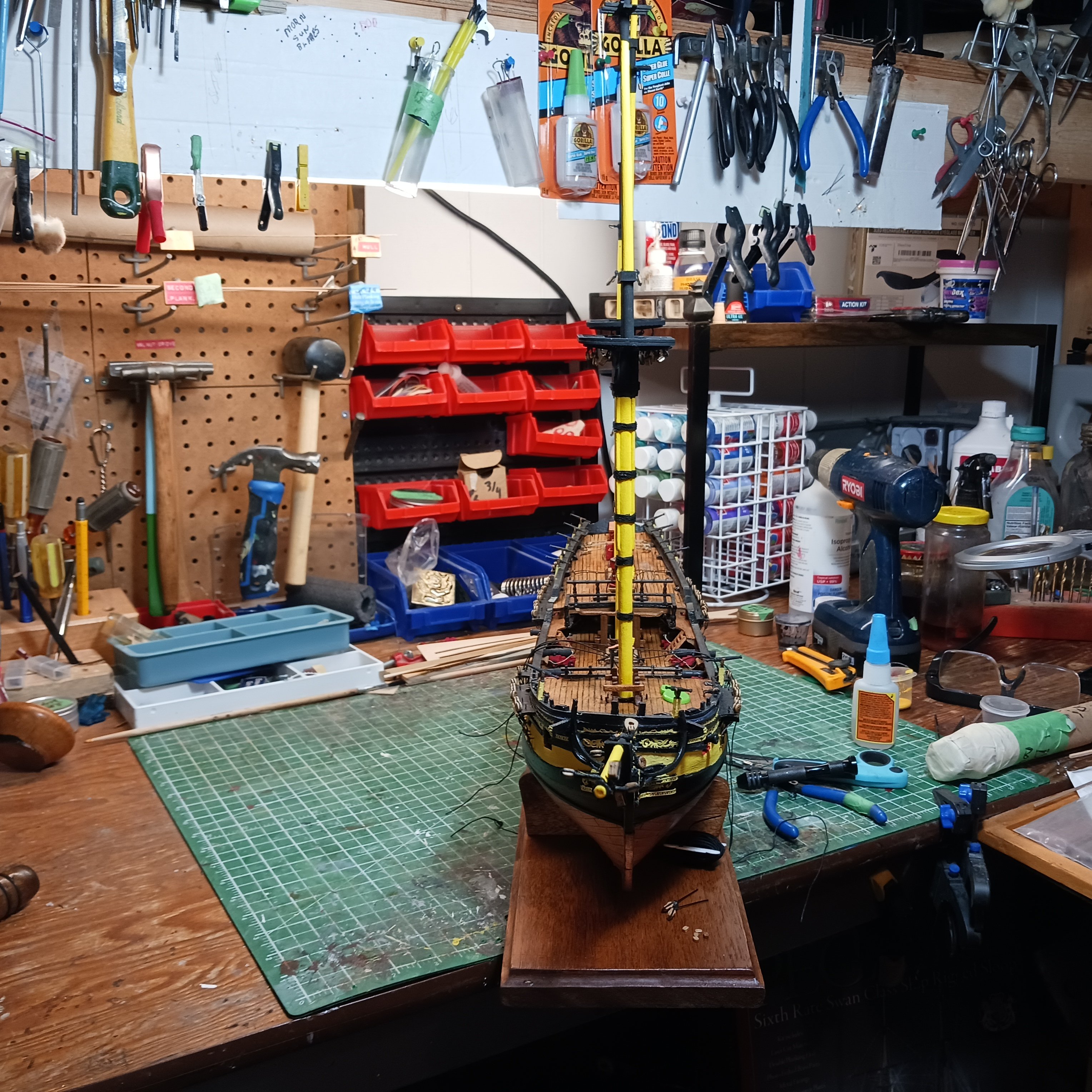

This is my shipyard before the pests moved in.And this is what happened.

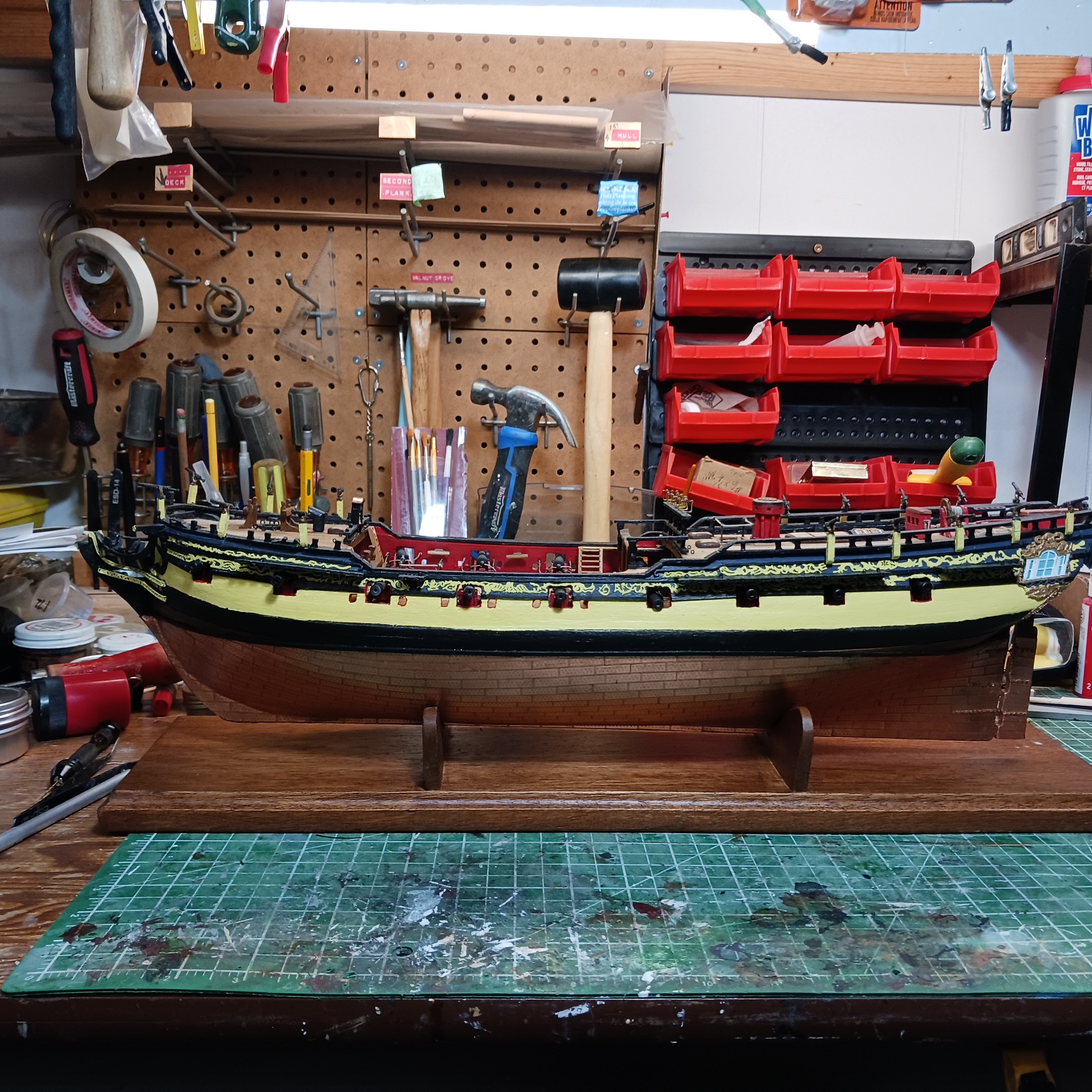

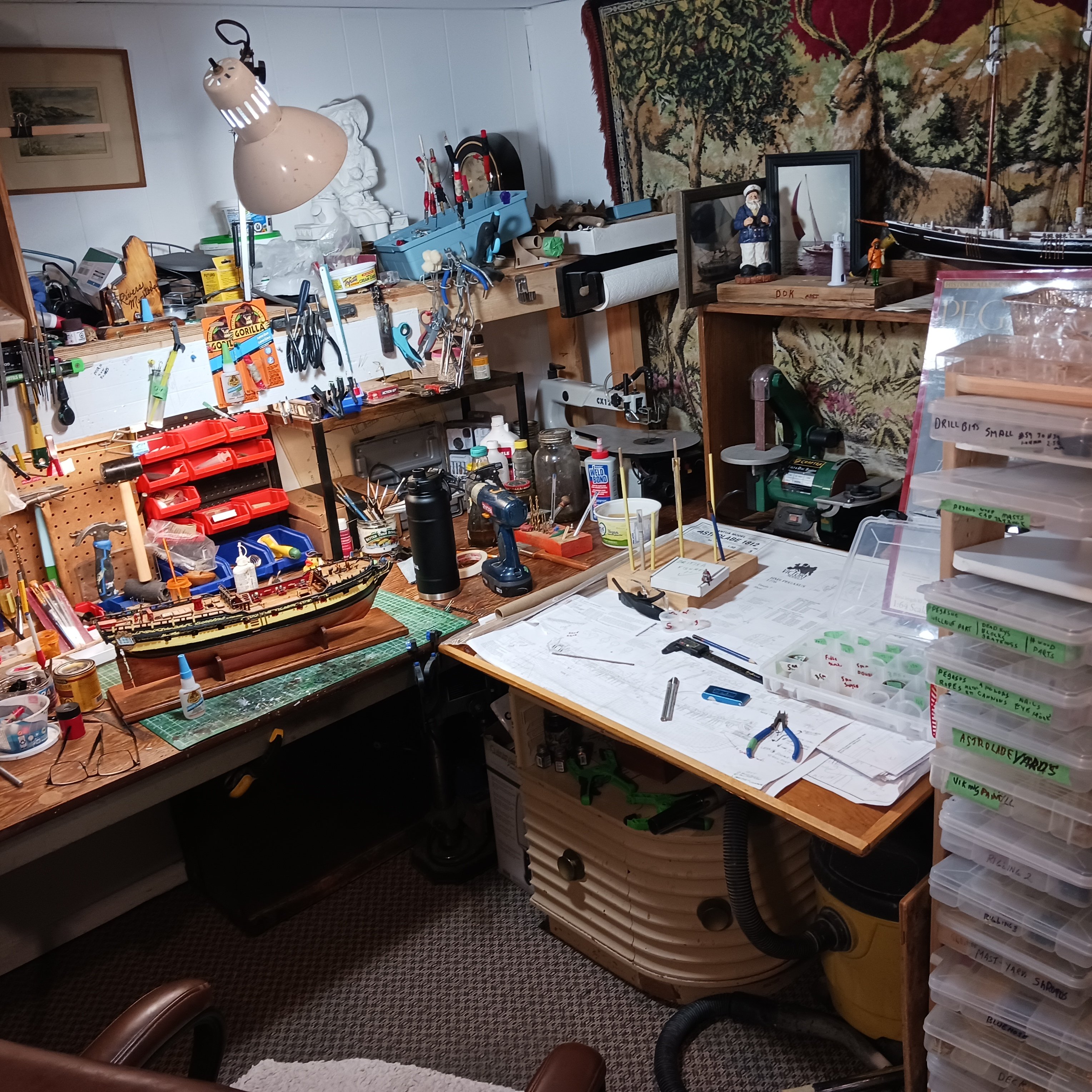

But I am happy to say that the shipyard is open again. Although I am not ready to build yet, it just needs a little  cleaning up and organizing .
 It's a lot brighter now , which is good.20240303_125613.thumb.jpg.a8ebc0aba35b29b13ff2b32bcc9db068.jpg
Notice my newest tool for the shipyard to the left lol.:D
 I brought the ships back down today, wow I can not belive how much dust got on the ships. The Pegasus was not so bad, but the Mayflower was very dusty . So I decided to shelf the Pegasus20240303_123748.thumb.jpg.72de3ef4c9e5a14a55884f51dbdd1342.jpgand clean up my Mayflower.  There is not much left to do on her so I want to clean her up and finish it.  Then I can put her under the display case.

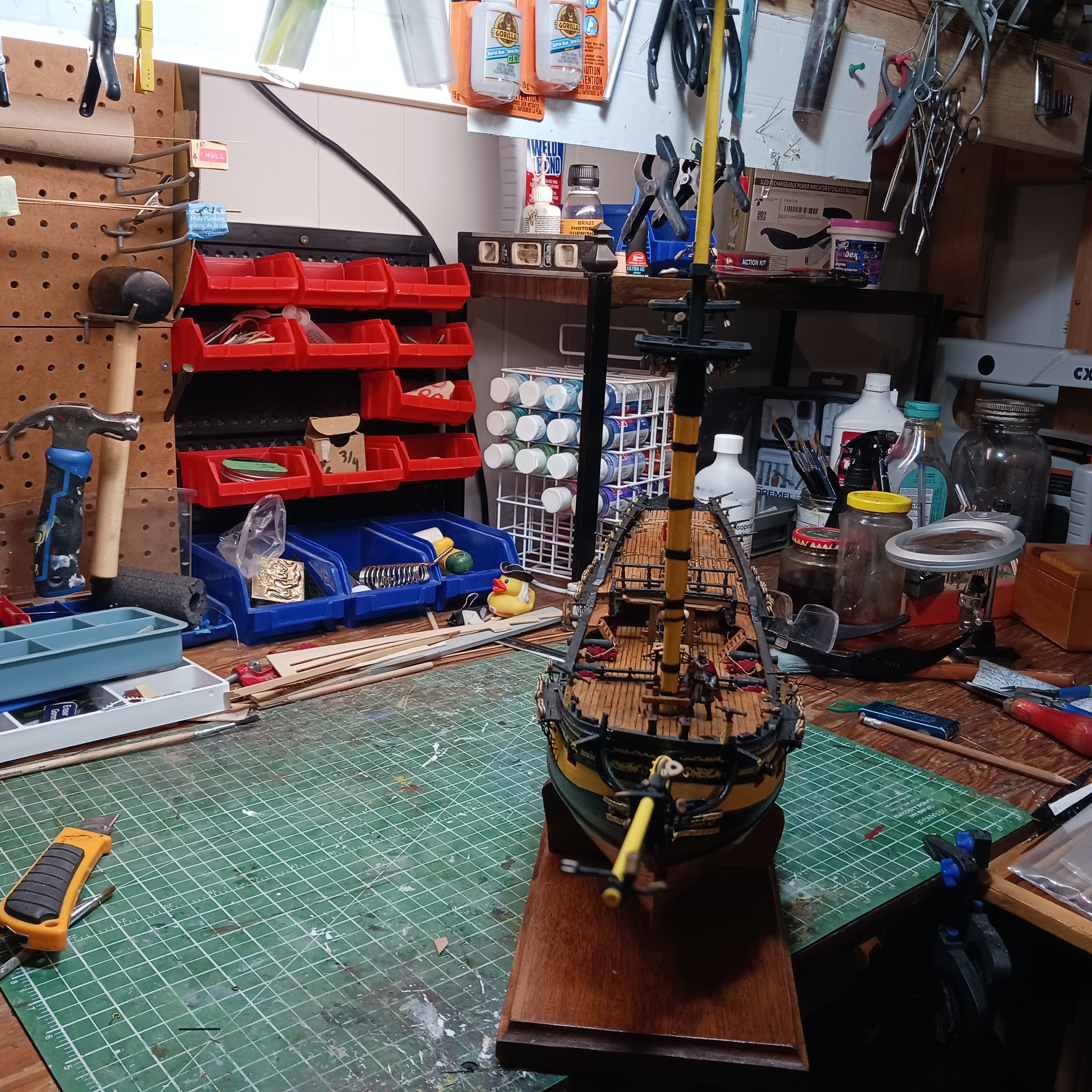

Well  now it has been awhile. I am putting  this  Pegasus  back on the bench as of today.20250811_150221.thumb.jpg.2d594e4c5fef655ed02152d2d21562d1.jpg
I have to get everything  back in order for building  the masts , the point that  I stop.
  It will take me some time to get the ship yard running smoothly again but I just want to finish the Pegasus.  It was a gift from Emilio Marletti  of Amati Models,  I want to finish  it for him.

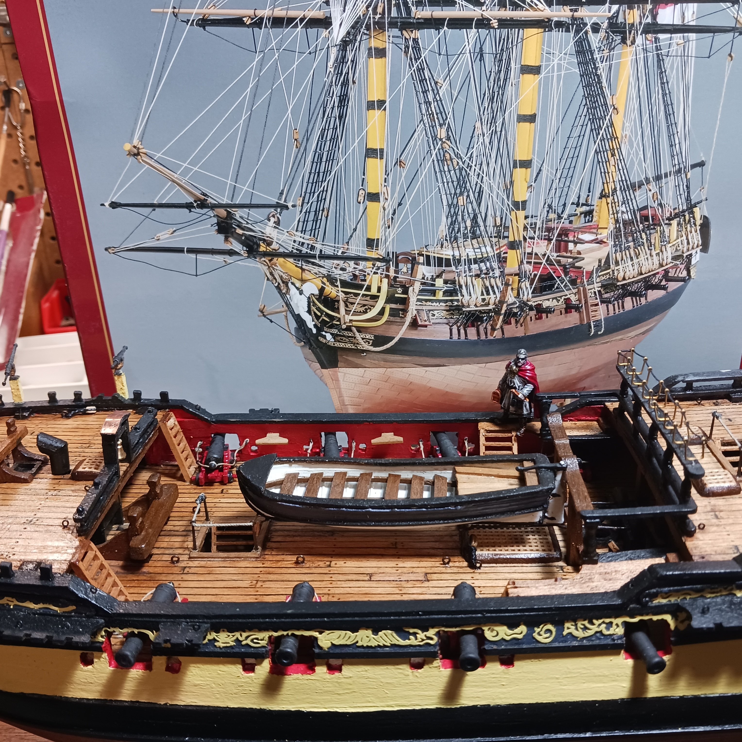

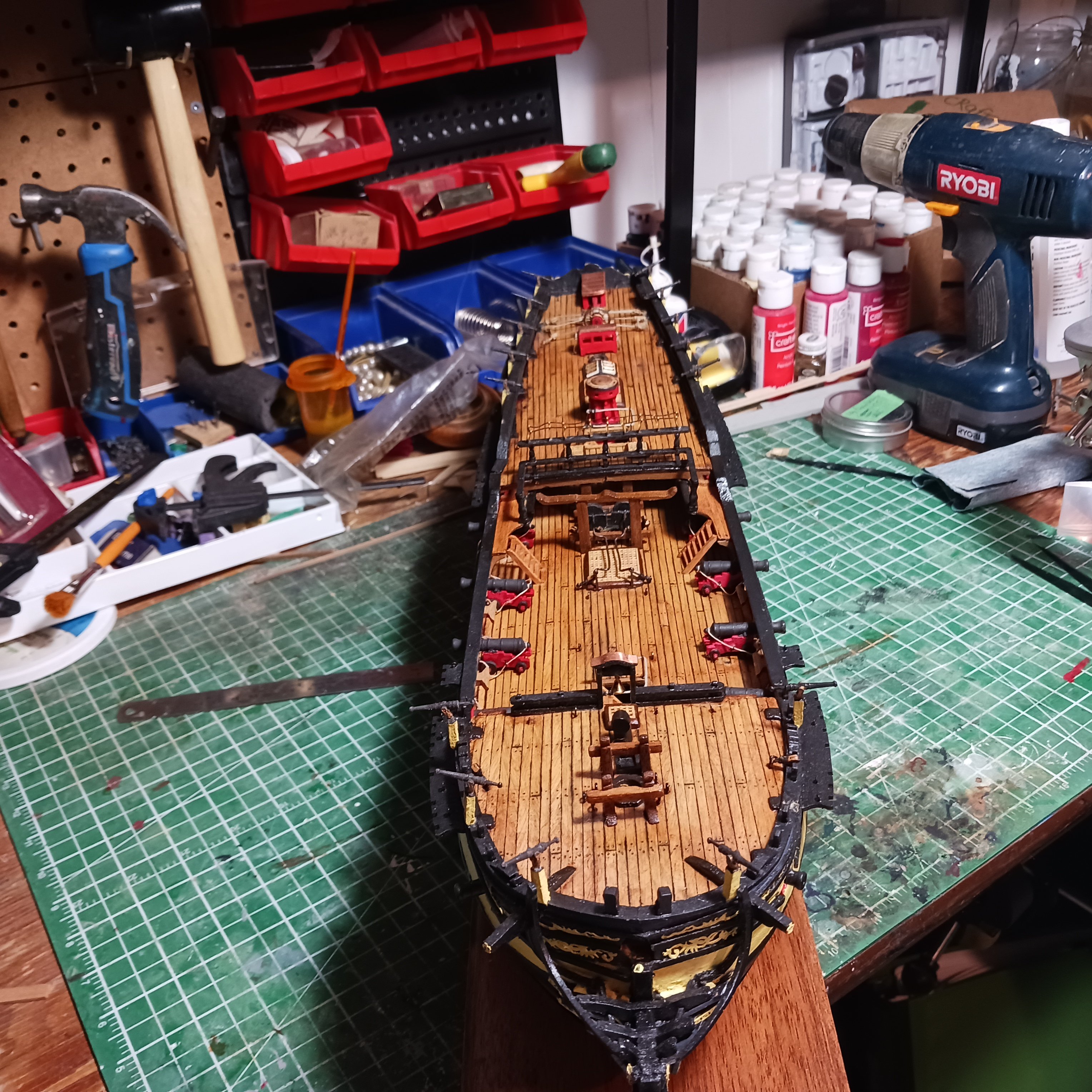

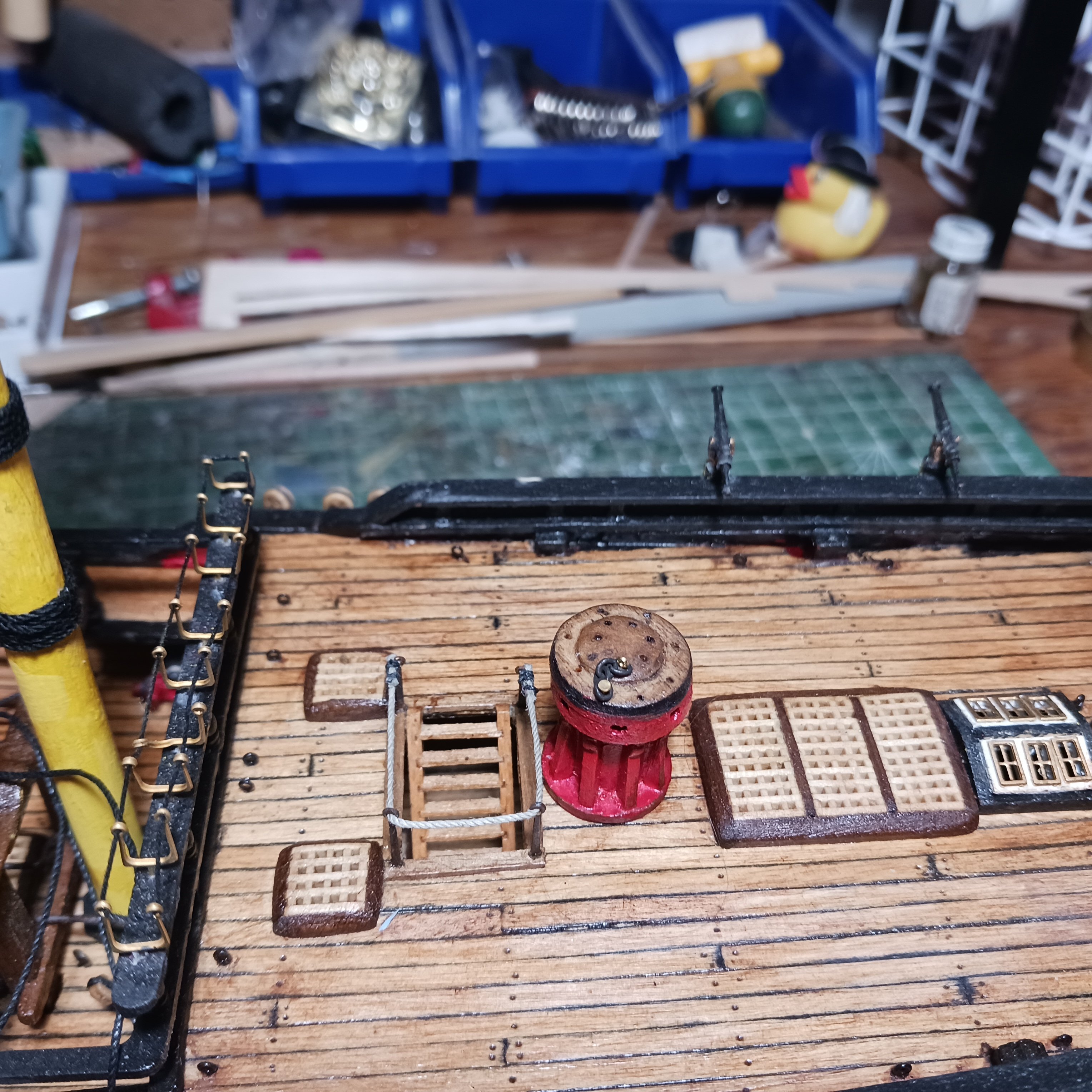

I restaind the deck yesterday,  then gave it two brush coats of  shelac.
The next thing is I got to un pack all the trinkets, I am looking  at the box for inspiration  on how I want mine  to look. I had this picture  that Rodney  had of the Pegasus,  but moved it and put the box on the table. I will try to make it look like this picture,   and @archjofo , guess what I noticed  first  the studding sail boom irons  lol , I will add them to this build for sure thanks again for the tip.
I don't remember  making  this ships boat lol , I have to go back in my log to see when I did it.
Many things to decide  now, colors,  rigging,  the masts. I will be up until the wee hours of the morning  , just trying to organize things  lol.

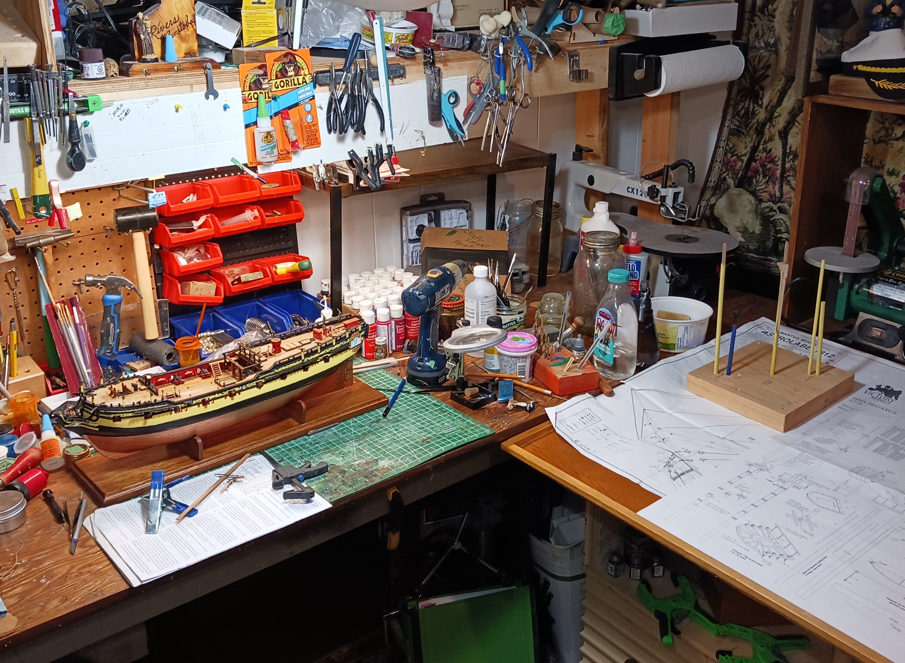

AaHhh, listen,.... the grandkids  have  gone home, last night.  We sleeped in today lol.
  This morning after coffee  , much coffee  I ran down  to the ship yard,  eger to get back to the Pegasus.. Up frist I am putting  the chainplate assembly together. A trip to @Moonbug log for his Pegasus for information and inspiration  the frist thing crank the tunes.  In which I was told to turn it down just a bit  lol
I crabed my thrid hand and got things set up, and "looky " here the missing piece of the chain plate front  that  I broke doing the Duchess of Kingston,  it got stuck to the side and I never notice it, and I use this lots lol.
Kurt says we have lots to do.

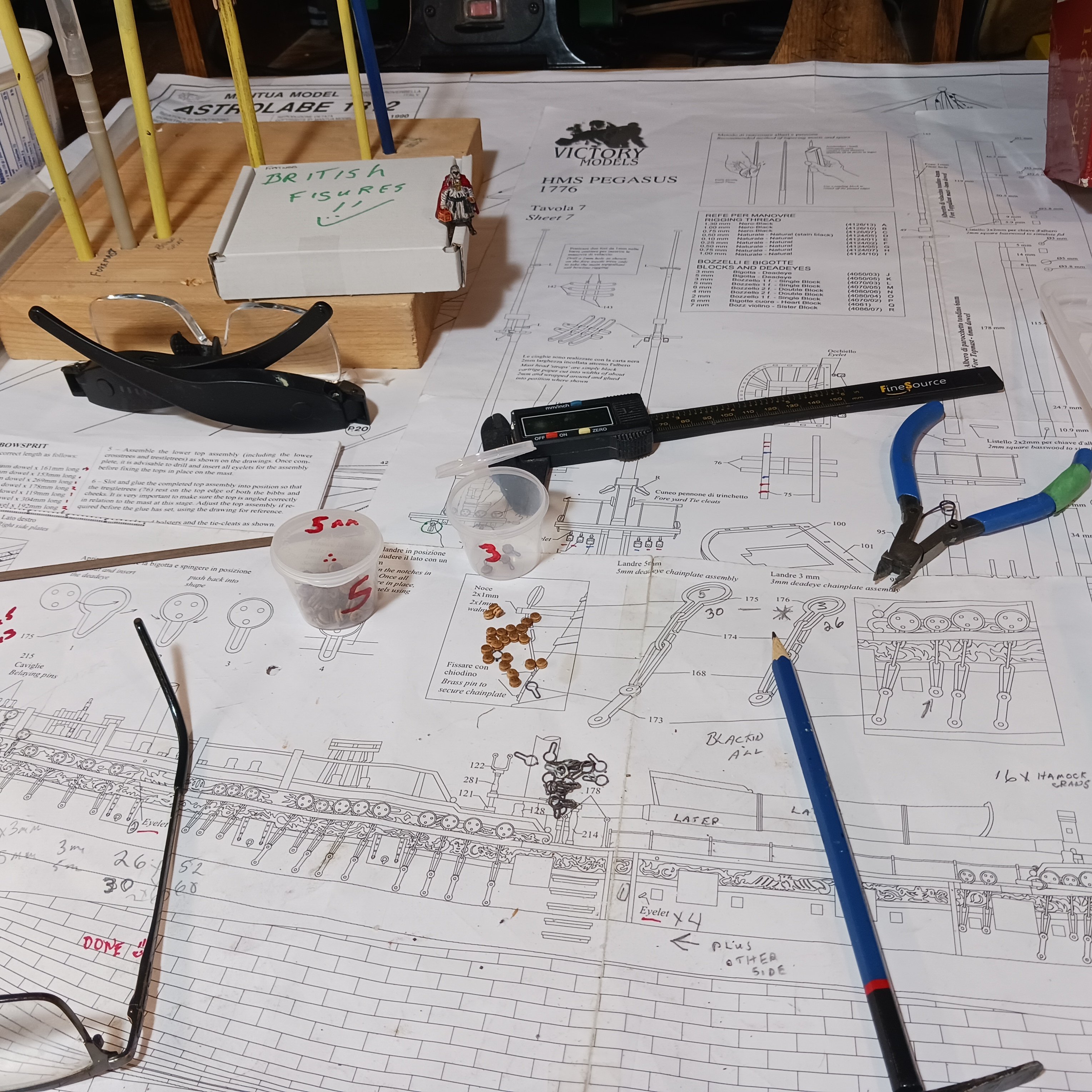

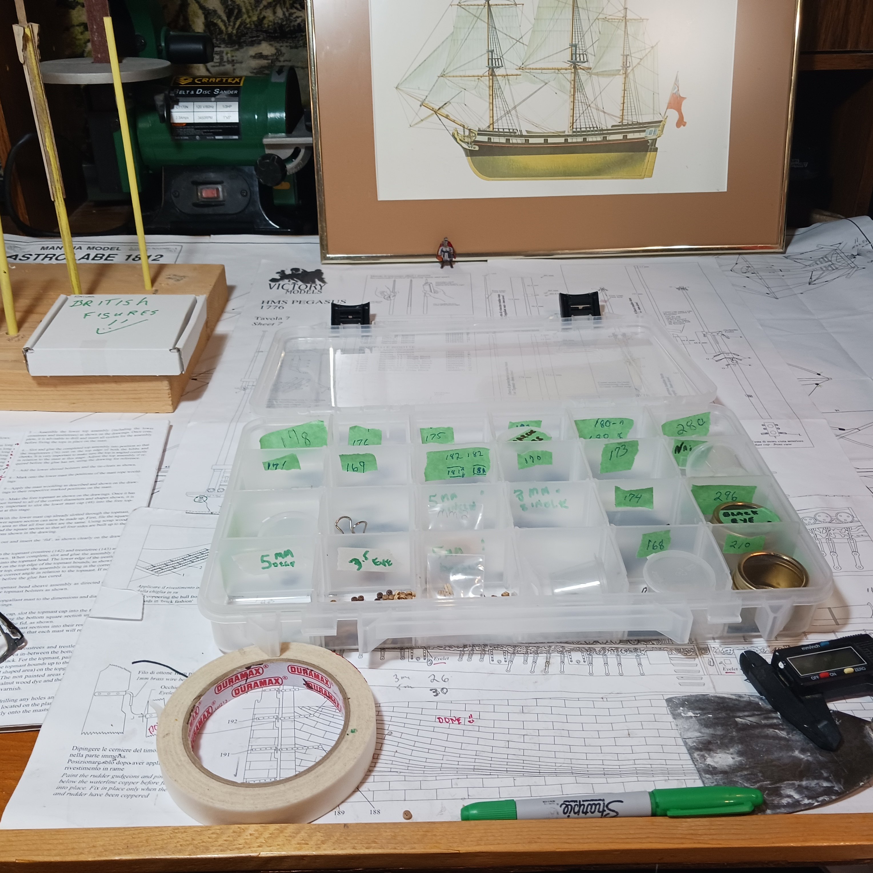

30-5mm and 26 -3 mm, deadeyes  to make up. Then clean all the holes up and put them away. This will take awhile I am sure, 168 pieces to add after that, then figure  were they go, what angle that sort of thing,  I have lots of great logs to look at here on MSW, priceless  information
 I know my Pegasus  will be Knocklouder  attempt at building the Pegasus,  and she will have mistakes,  but we are having  the time of my life.
Ok, so I turned down the tunes,  change to Gordon Lightfoot  She like him better then than the Moody  Blues.
  Many hours of fidleing  with tiny things is apon us. Add to that , every  deadeye has a partner,  so I going to clean all those up as well.
 It sure is nice to have leg room back after putting  the Astrolabe in the corner  for a bit. The oldest grandson  said he will make a display  case for the Astrolabe  this year in school, for his woodworking project.  So I will jump  back to the barge and finish the rigging , just a couple of weeks work there and I should have it tied up lol 😆

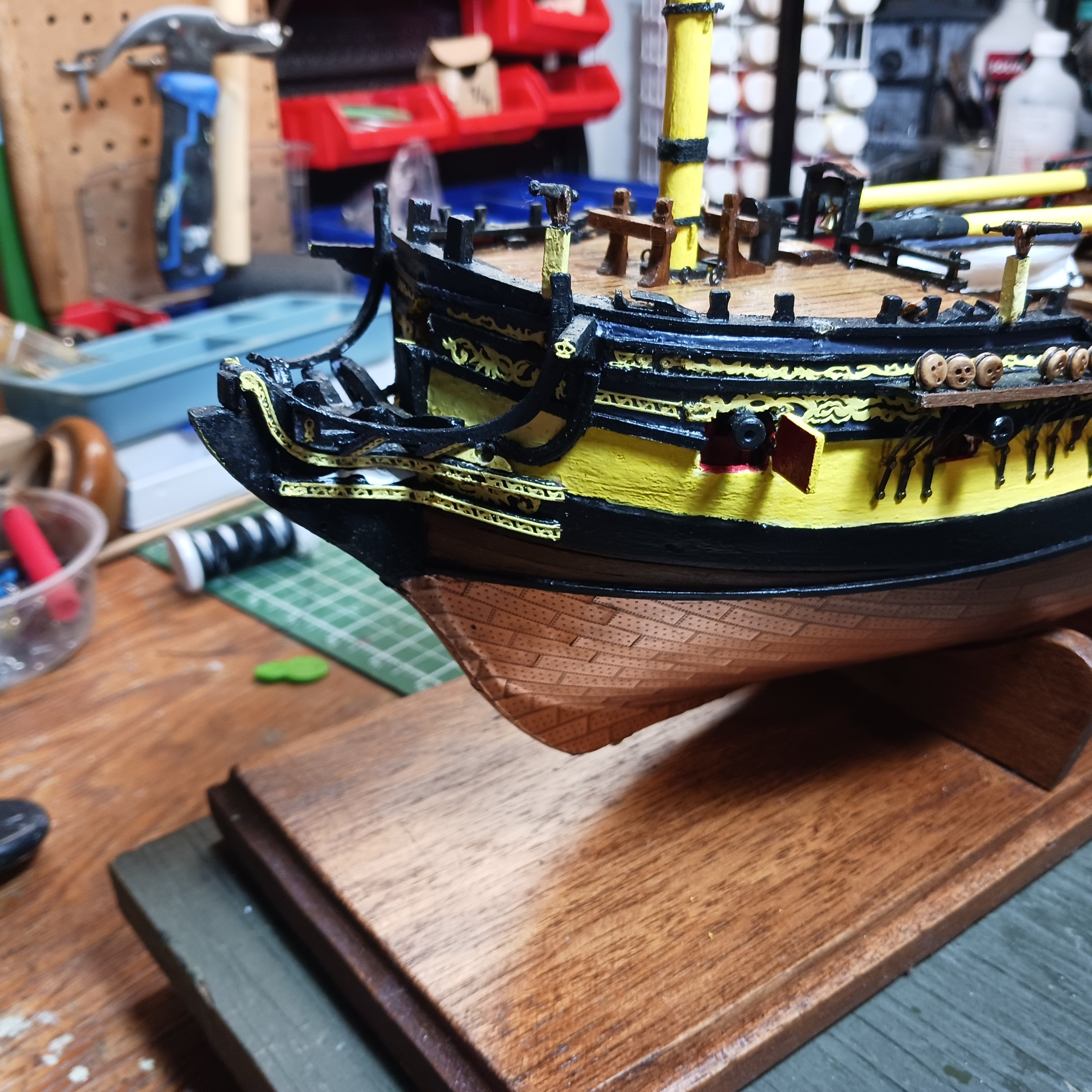

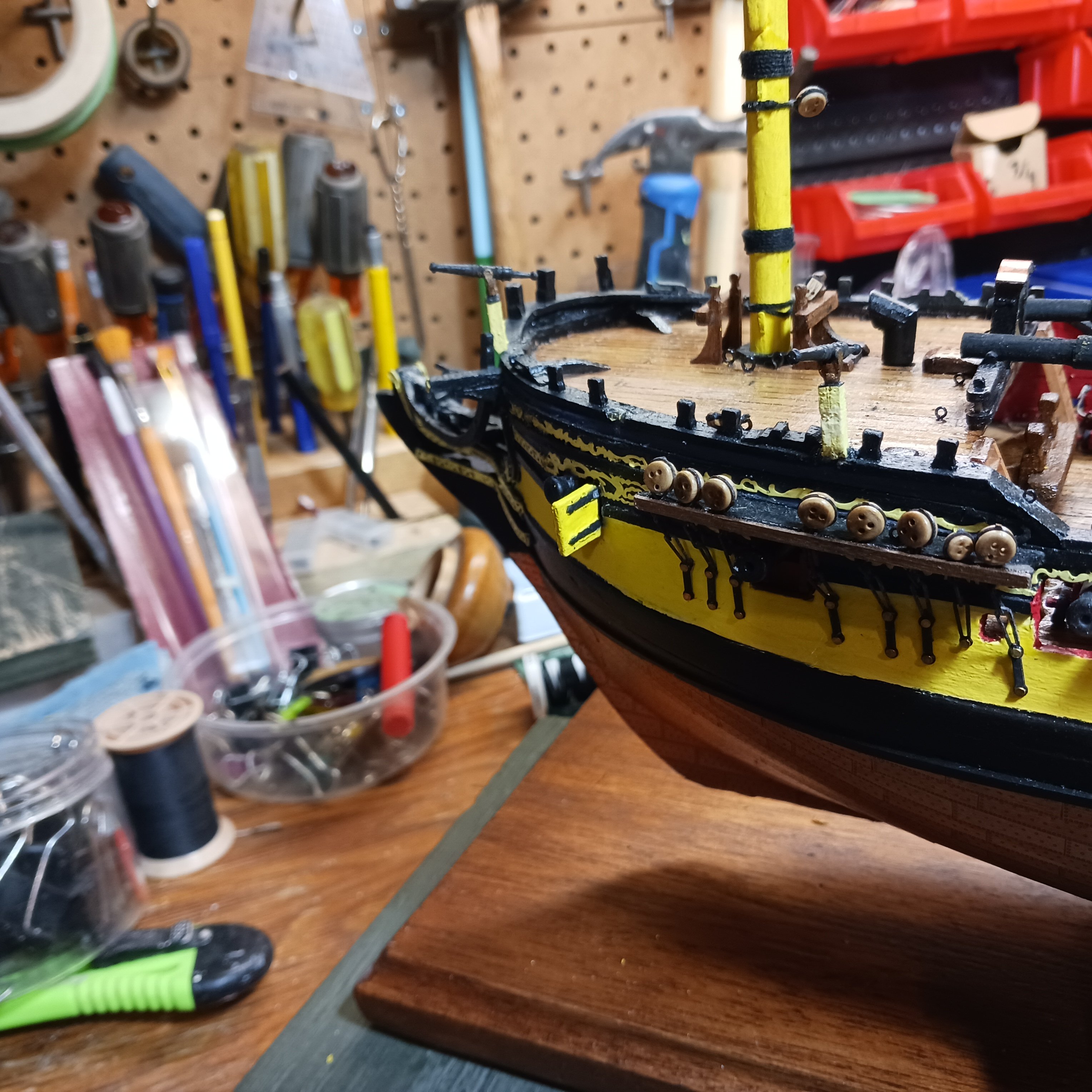

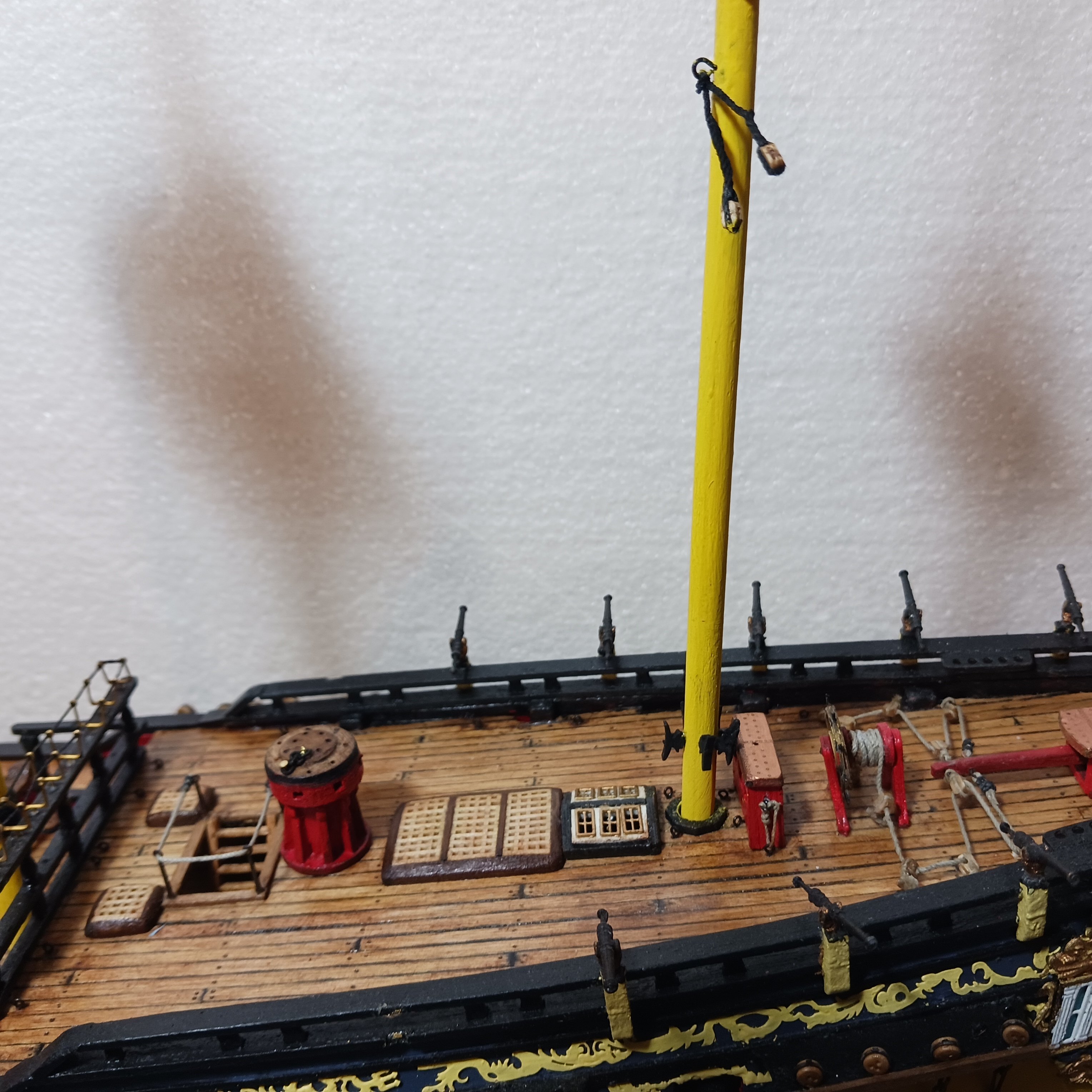

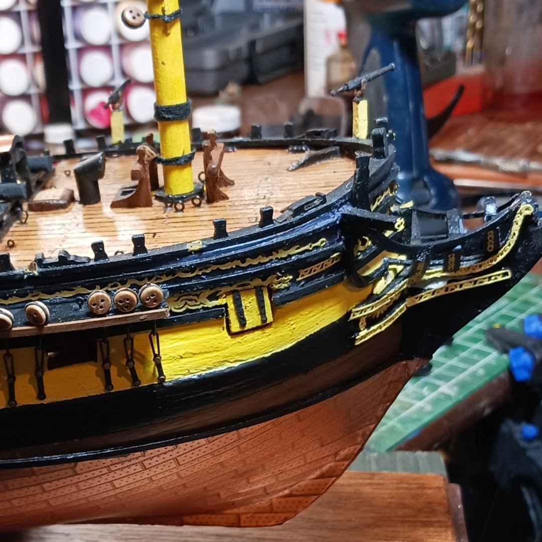

Can you all see the difference  in the yellow,  from the portside  to the starboard side  😁.  Lol. One of the rules in painting, mix enough to do the job lol hard to rember  which  yellow I used. 😉  so going with the starboard side,  I had to do a little  thouch up and by the time I was done ,it was all done.
Painting will be eazlie done this time, no chain plates in the way.

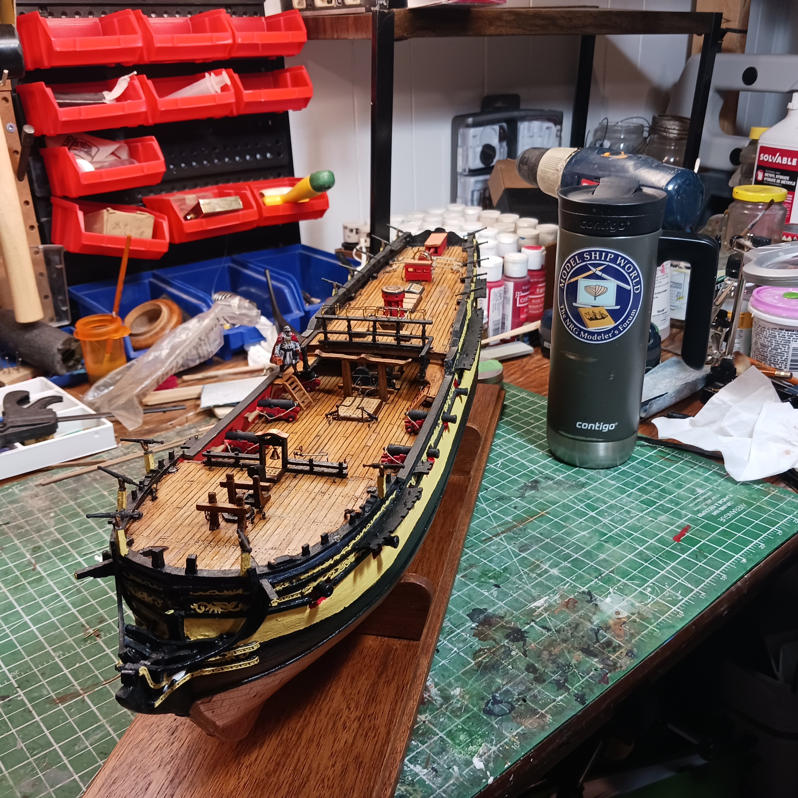

All the chain  plates  assembly  are on, just have to touch up the black a bit , but I am  Likeing it very much.
That went so well, I am going to go double check.  Lol. Kurt and I are going over the mast plans. Going to build the mast up off ship, I find it easier this way. Lots of holes and blocks to add , things  are moving along.  🤔
We have to make up some spare masts for the ships boat, it is hard enough making one mast , this ship has four spare  masts.:cheers:. .
we will be making another  ships boat of a different size, just need to pick the right one  out of four choices.  :)

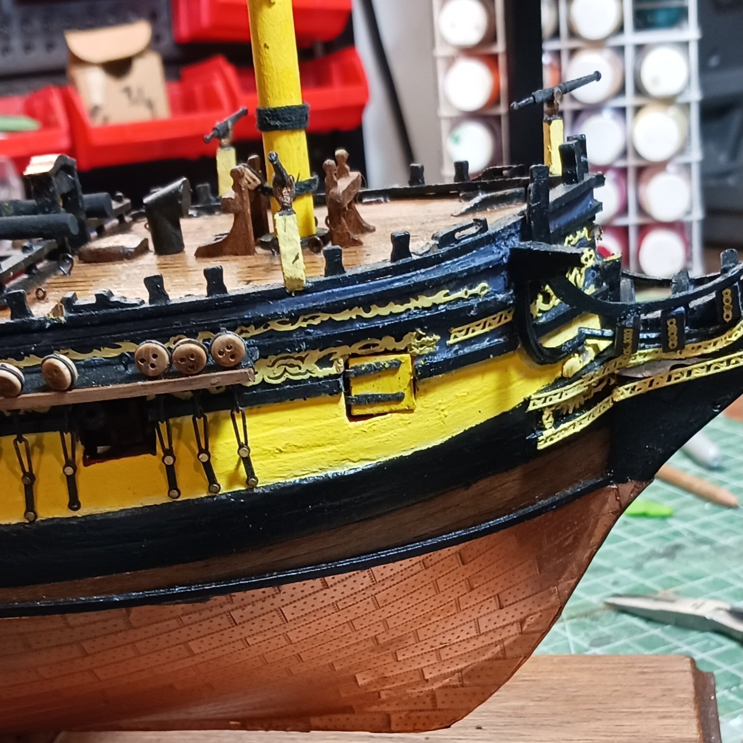

Another mistake :), but a good one lol. I am mistaken  about the number of  spare masts and ships boat  there were. Only  one boat and two spare masts.
A lot of sanding and shapping  but soon they were ready  for the paint shop so I can add the black.
After they are painted  it's time to add the blocks and woolding,  lots  of work ahead.

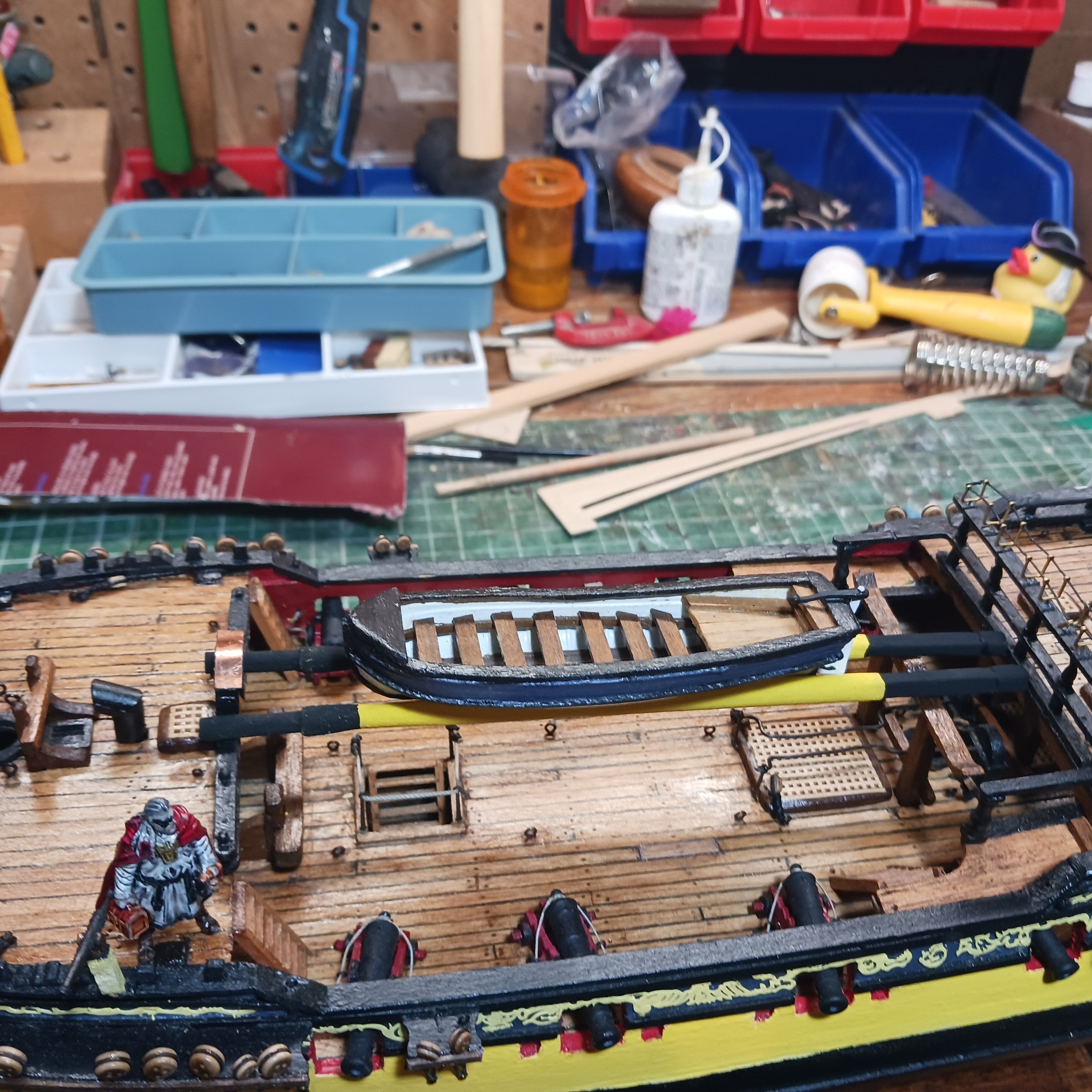

Kurt says we should stow the ships boat until much later in the build ,

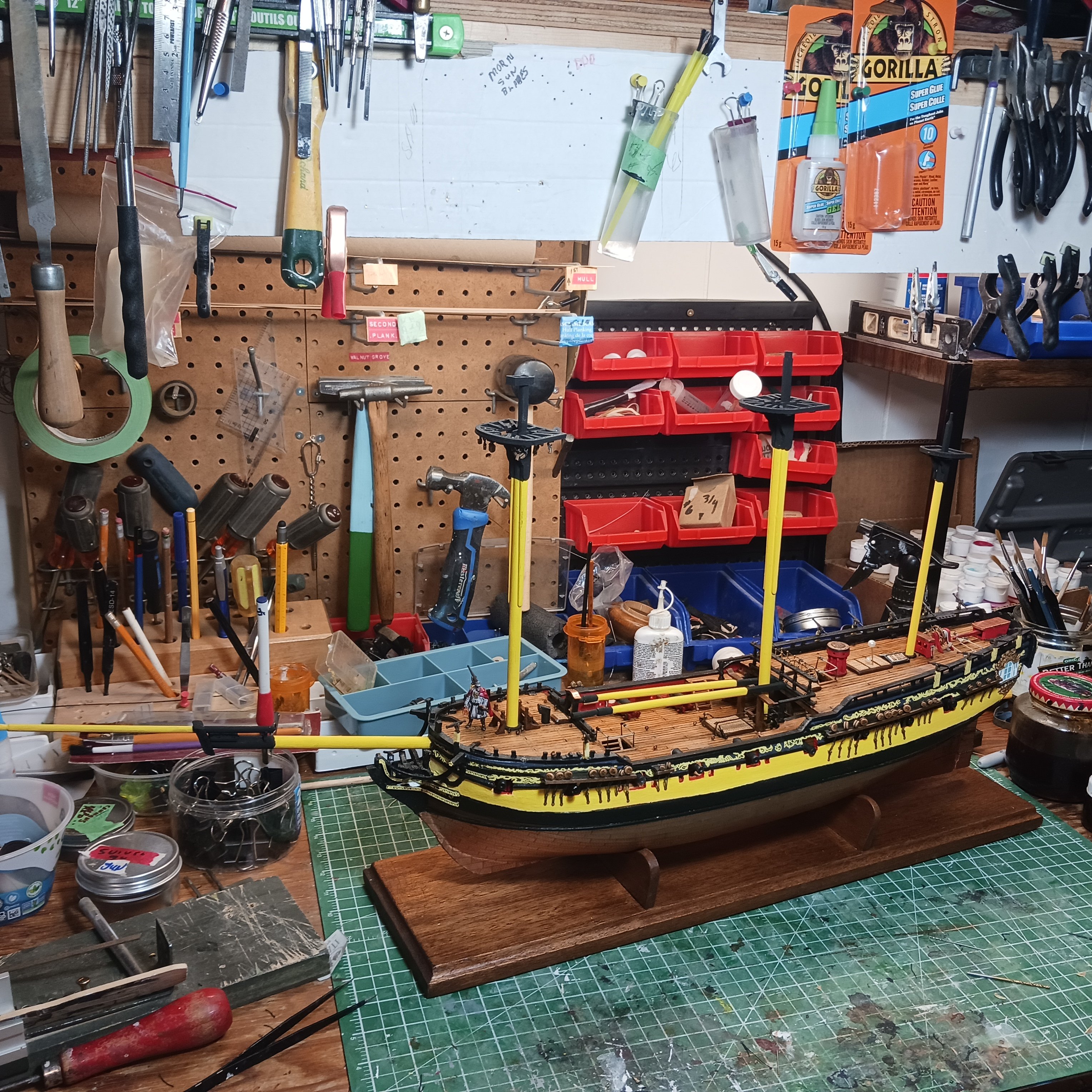

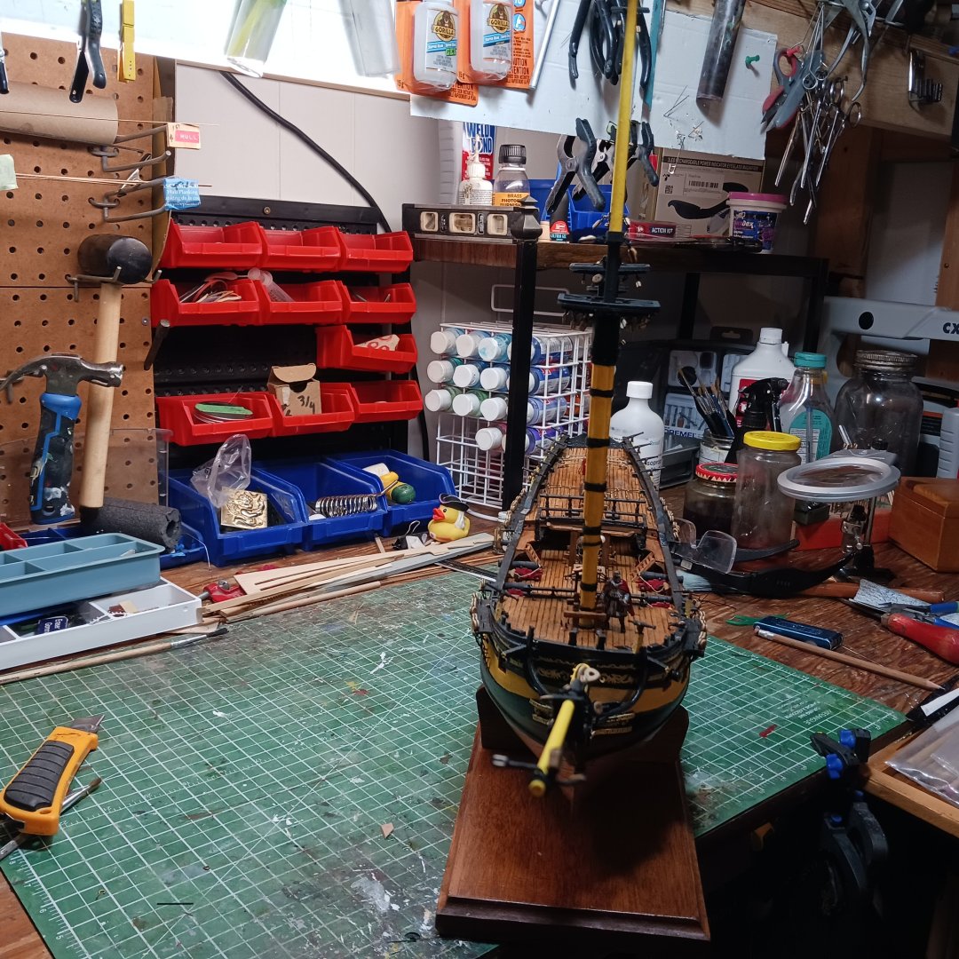

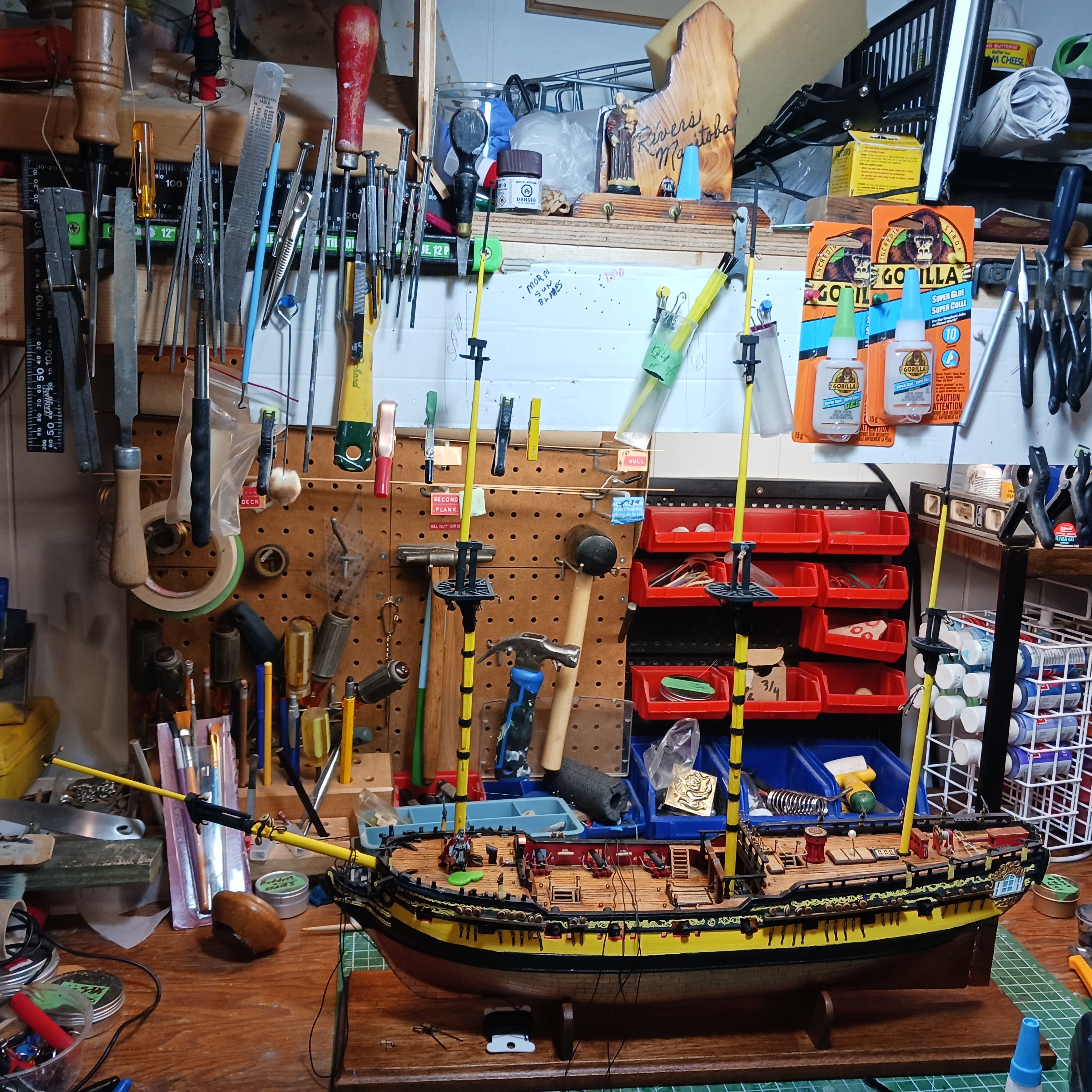

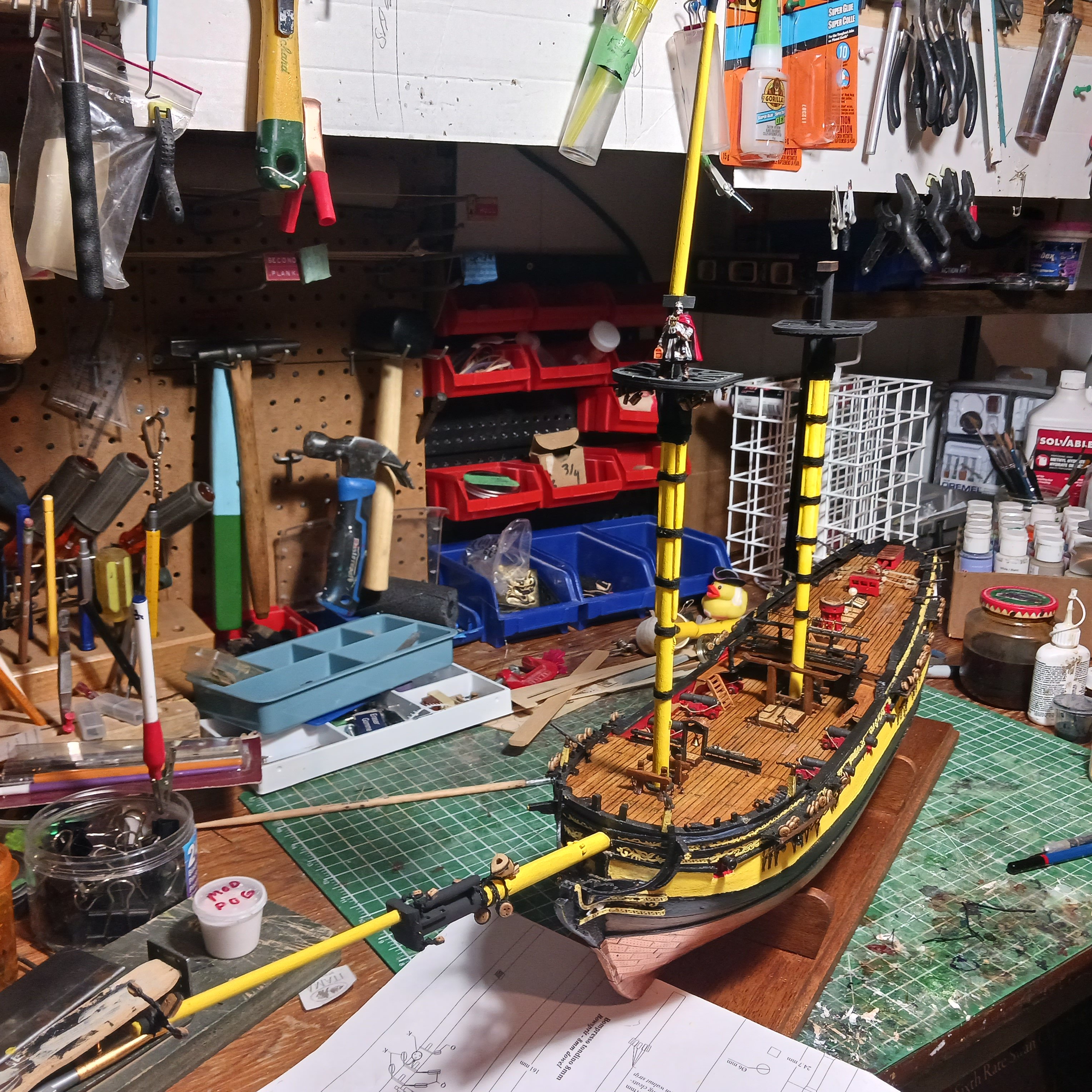

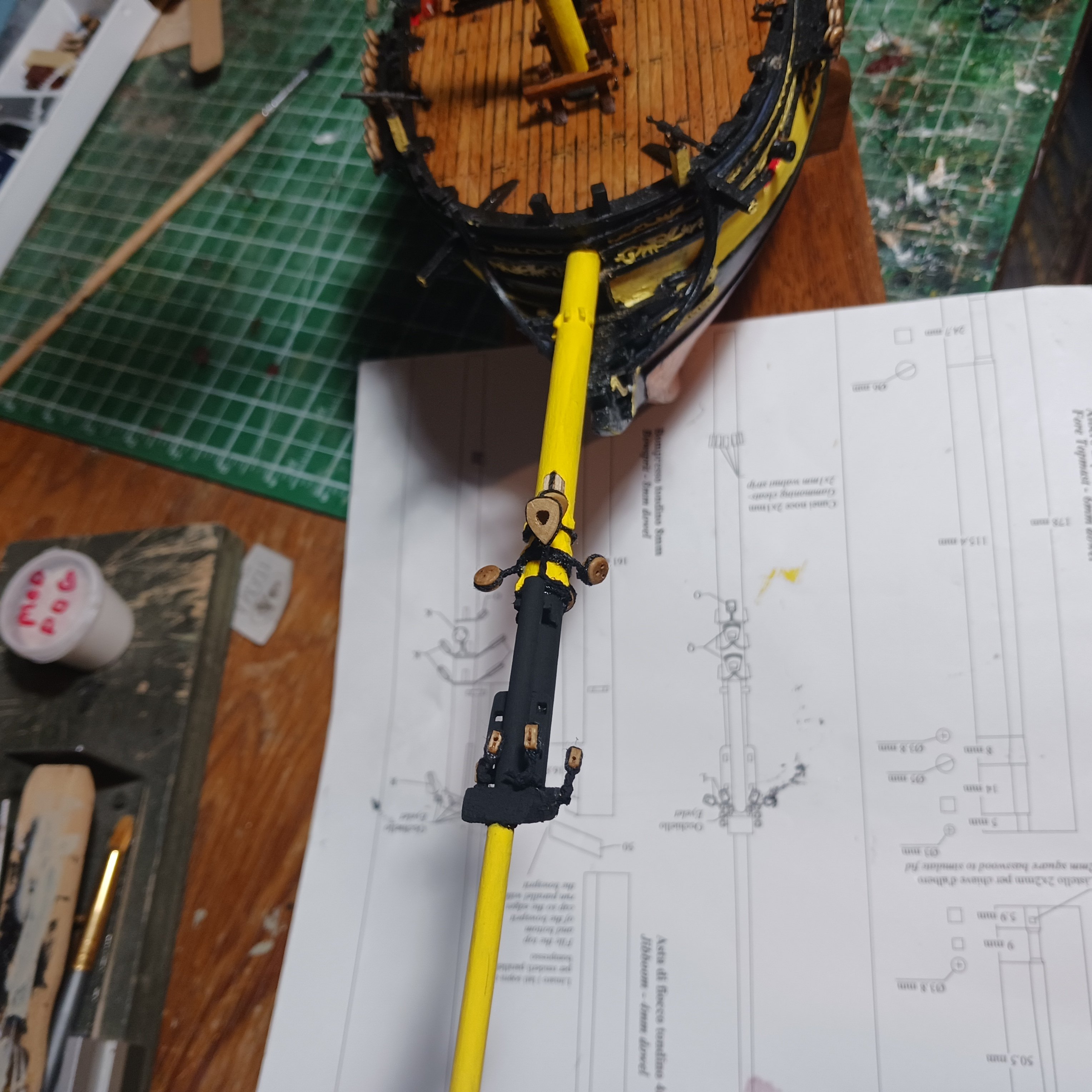

I  got all the masts  back from the paint shop, time to drill some holes,  add some blocks and send her back to the paint shop for thouch ups.
So on to the drill  the holes for the Bowsprit mast.  Close to 30 blocks just for the Bowsprit and the foremast, wow.
Then  I will do the wooldlings  shrouds  and dare I say the R word. Lol 😆
Thanks for popping in for a look. The greatest hobby of all time.    :cheers:

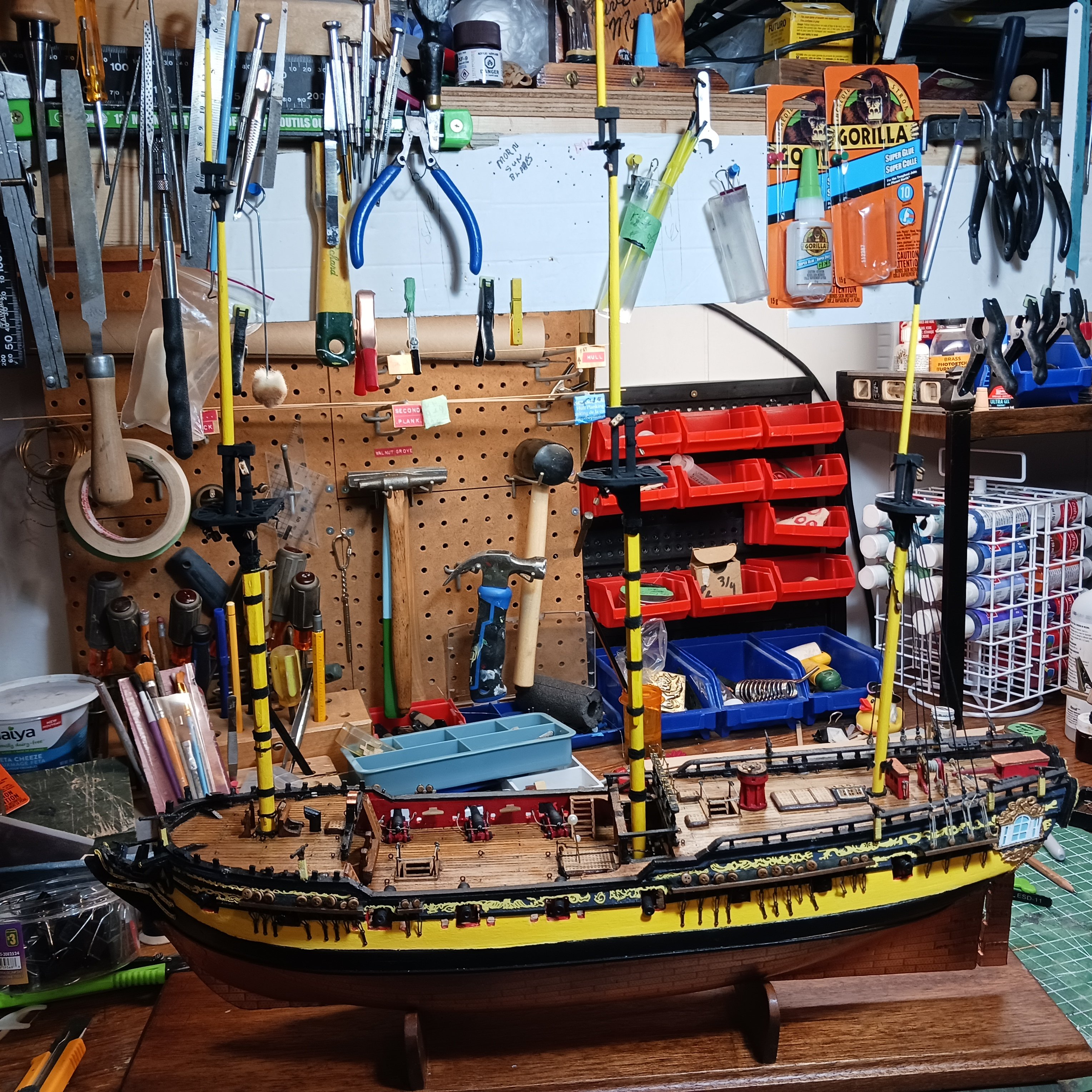

Thank you so much,  :D20250829_095609.thumb.jpg.9e35035a6e757ecf4c21dacb99af9b3a.jpg
With all the masts  painted it was time to put some blocks on.
Just on the Bowsprit mast there is single blocks,  double blocks,  heart blocks , fiddle blocks  and deadeyes. I hope I got them all.
Five more blocks for the foremast,  then I must go do some serving . Lots of serving lol. Looking forward  to adding  the shrouds.
This is a great ship to put together,  I am just so excited  about building  it, for what ever the reason. Talk soon my friend's. :cheers:

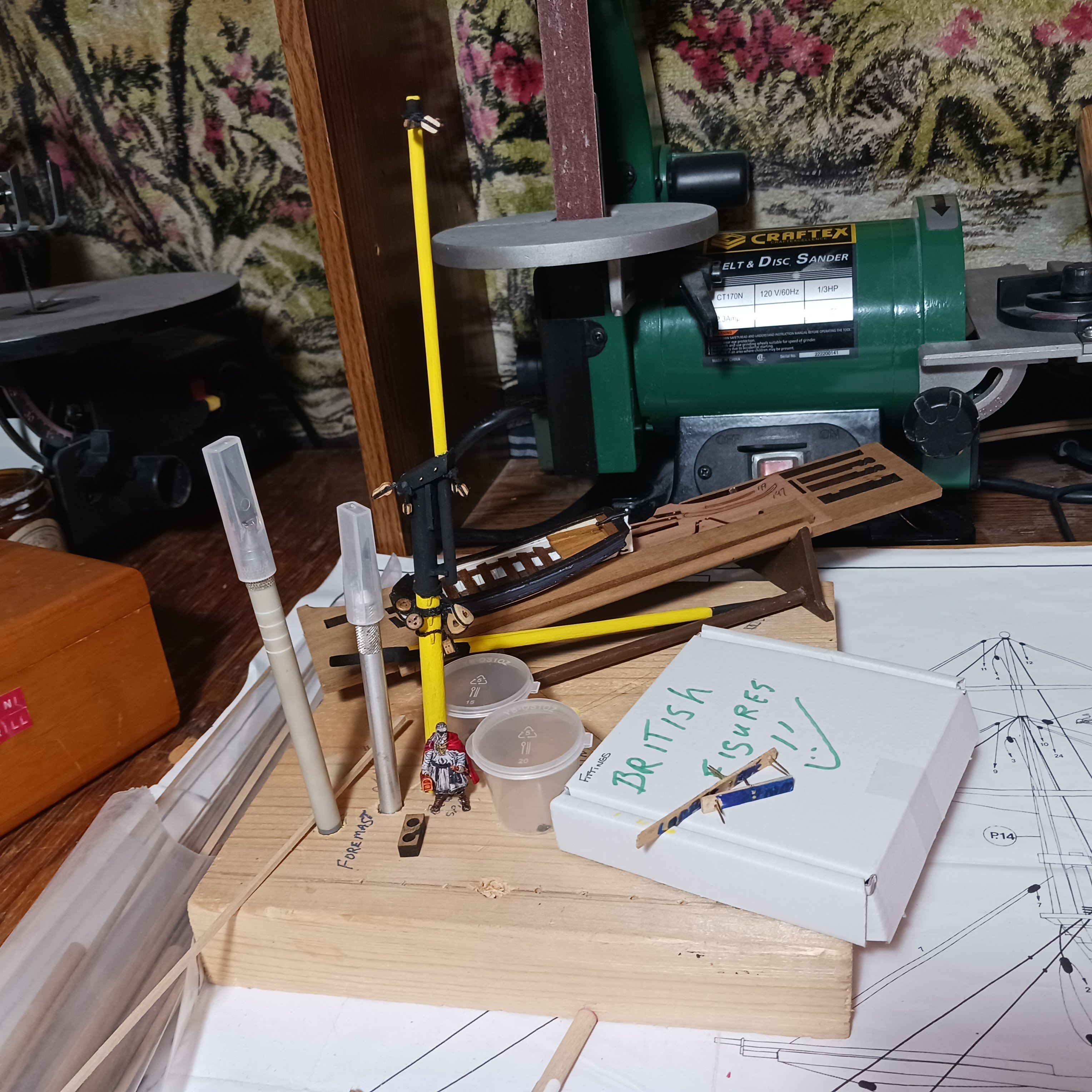

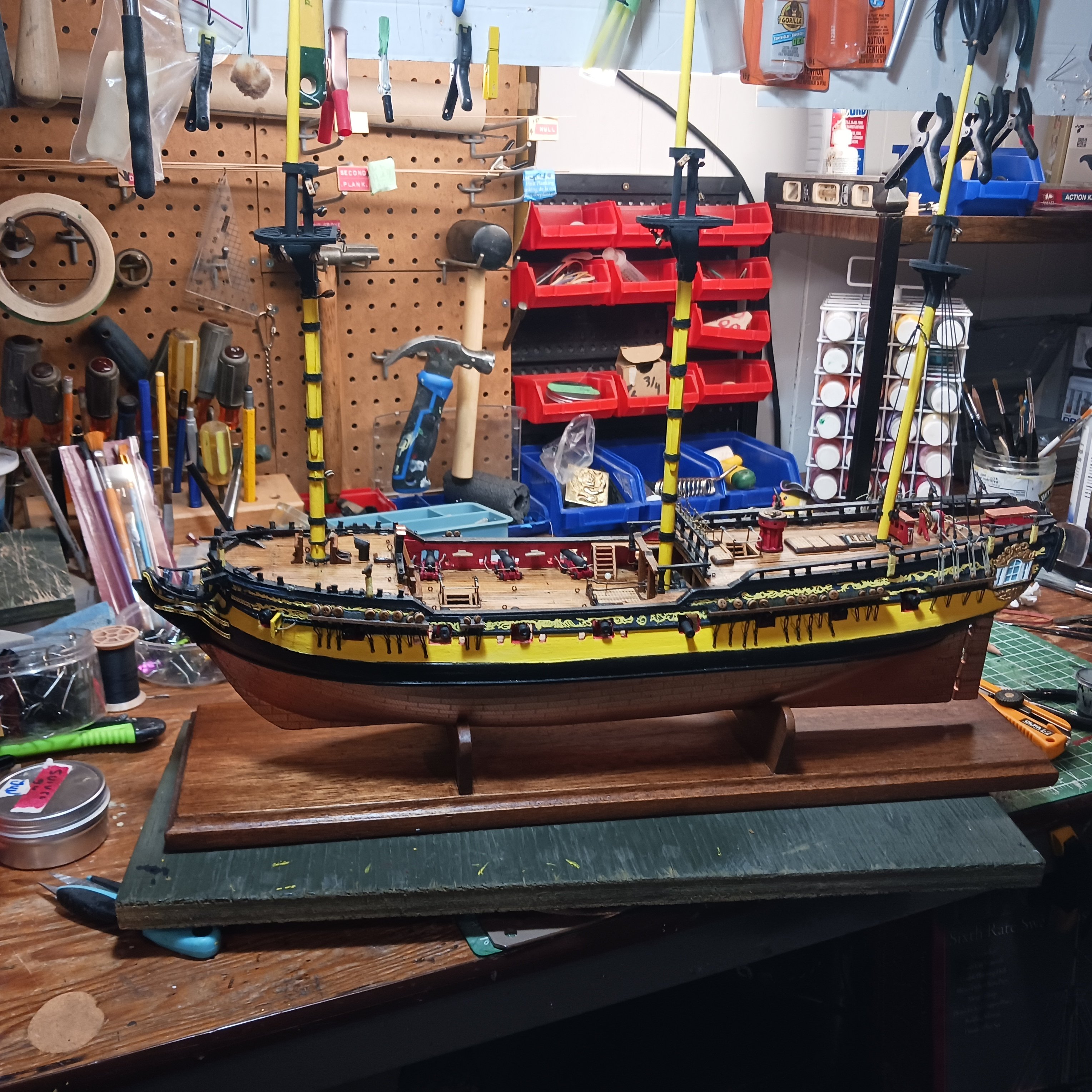

I have two fiddle blocks and 3 singles  left on the foremast,  then the blocking is done..20250901_183350.thumb.jpg.1b23dc6f2163d0281ffe370c32a6466c.jpg20250901_180733.thumb.jpg.e83300762fcf95fb3f495e6b4833f5ac.jpg

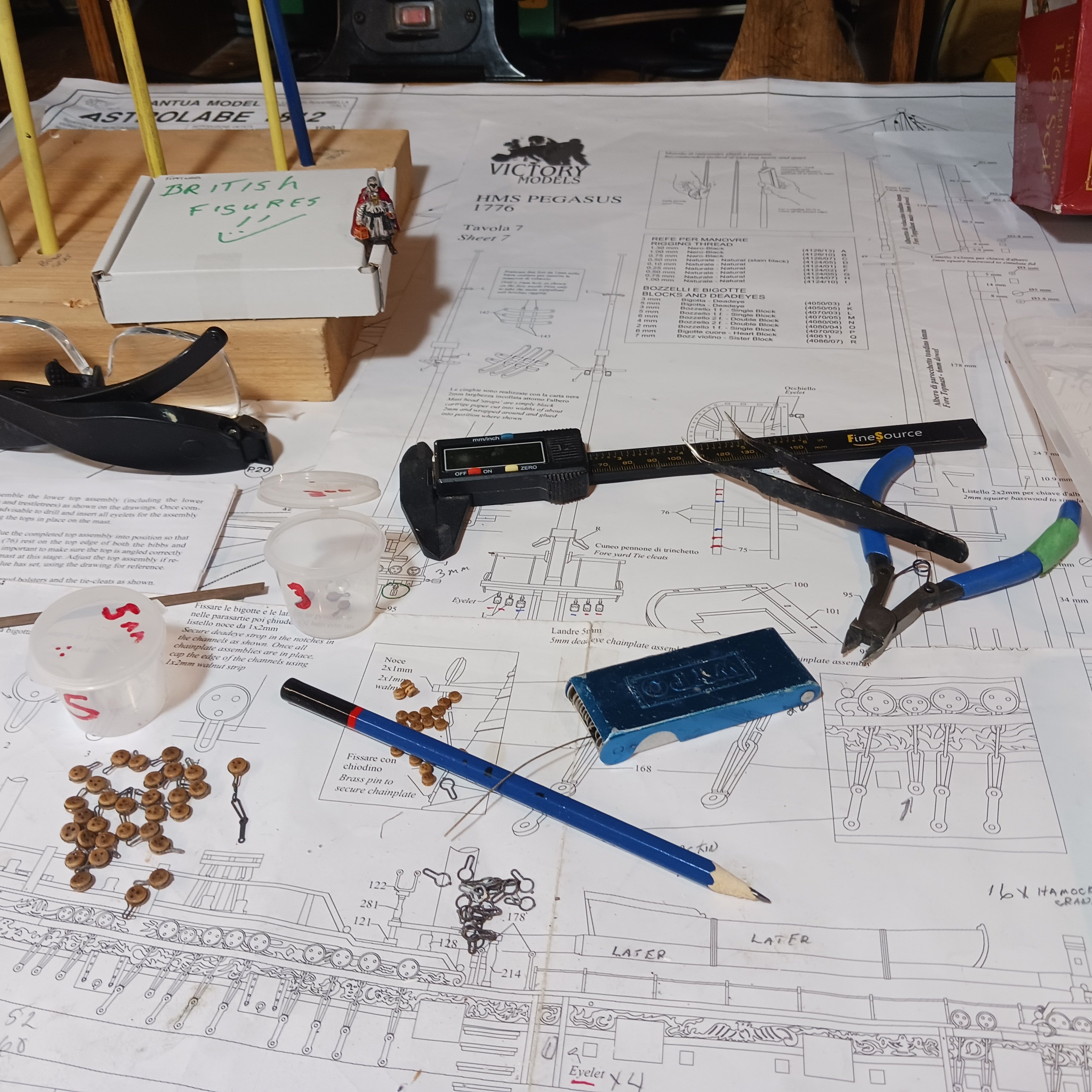

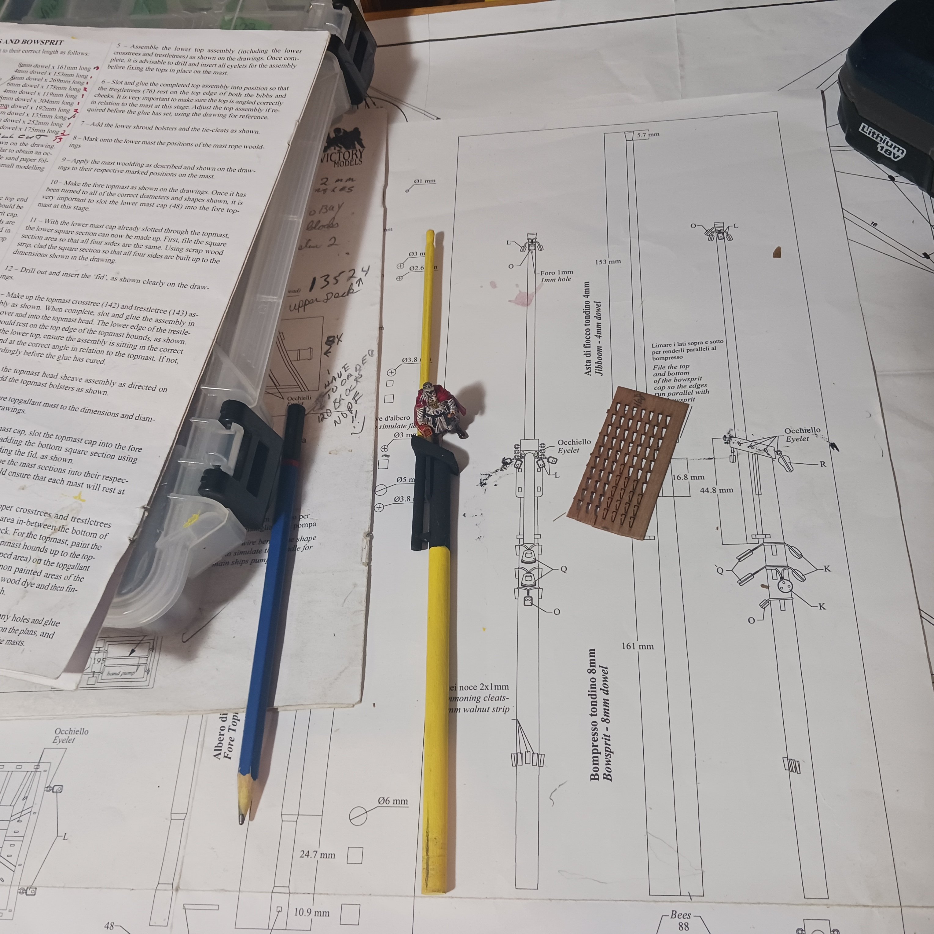

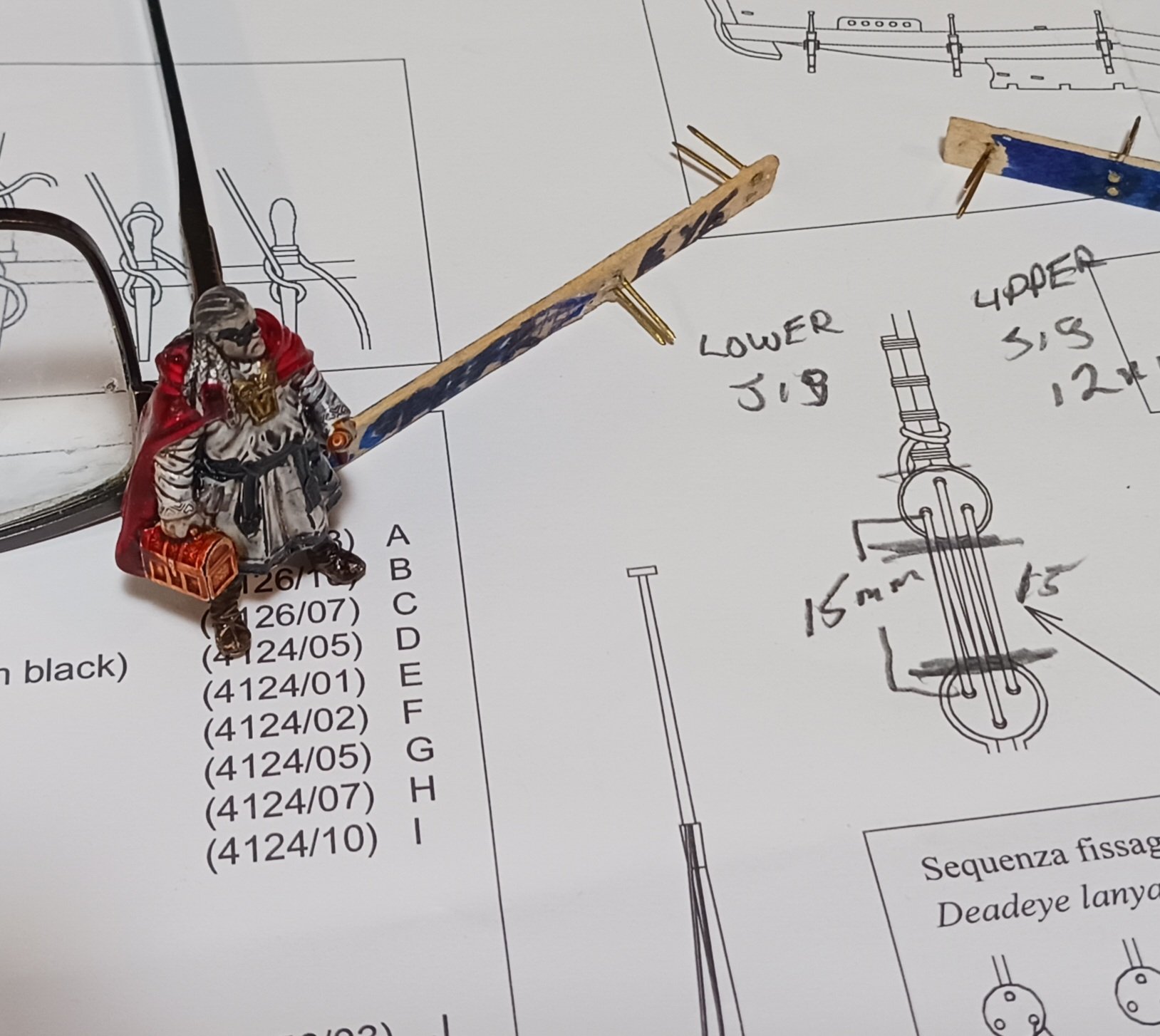

A couple  of jigs were made for the deadeyes , an upper and a lower, the lower is spaced at 15 mm and the upper is spaced at 12 mm
one of the first things I did was put the Bowsprit mast away for save keeping, rembering how many times I broke the Bowsprit mast on my Dutchess of Kingston .

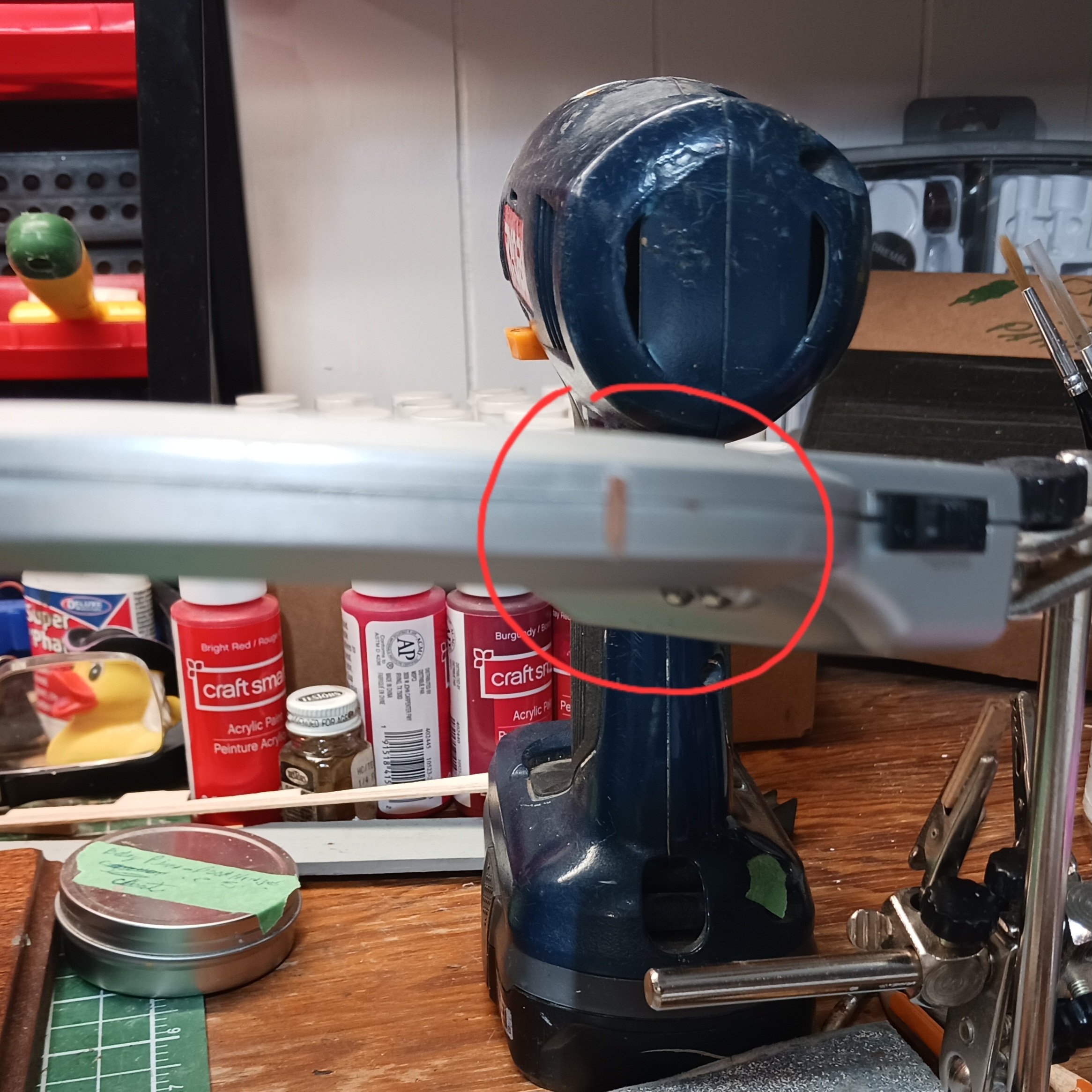

   I am attempting to add chains to my capstan,  I read somewhere, (words I seldom  say lol), about these pins that hold the poles on when turning,  I used an eye hook for  the center and a pin nail for the outer. Three links of chain was added to connect the two. Not sure if I will go with this idea, might just fill the holes and paint it if I don't like it.. That will be decided latter in the build.

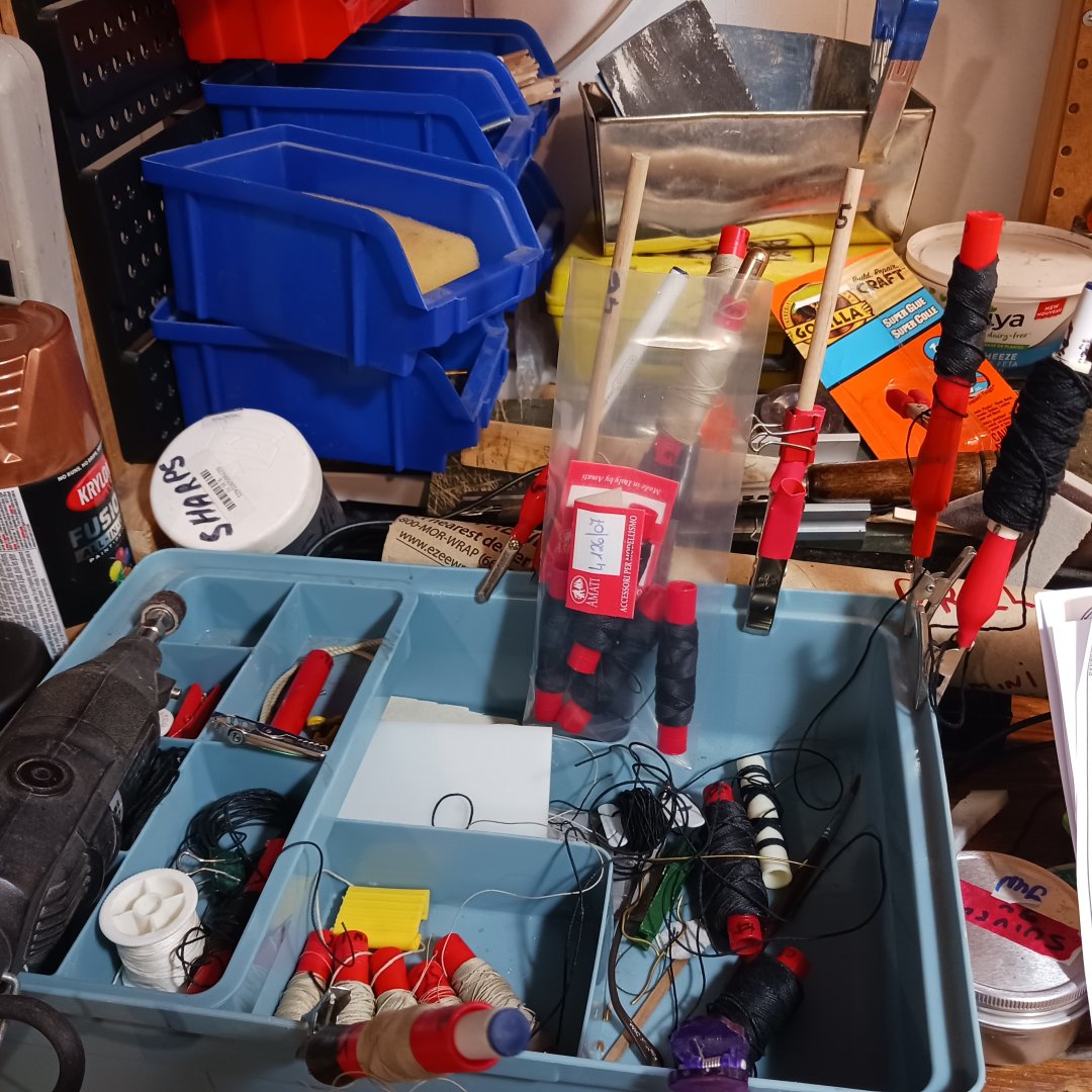

I served 20 feet of line to 1mm - 1.1 mm for the lower shrouds  on the foremast  and  main mast, this wont be enough to finish, but it is a good start.. The Mizzen mast is rigged  at .75 mm, Also a few stays are .75mm as well so I will serve up some 75mm  latter today
Last night I started cranking  the sevring machine and said this will take for me forever , so I hooked up my cordless  drill and in 90 minutes  i had 20 feet of 1.o mm line ready for shrouds.  After it was served I soaked it in Mog pog , then hung to dry.
  so with that, I am going to set up the serving machine and make  some more Lines, .75mm and some 1.3 mm, after I figure out how much of each I will need.  I never serv anything  smaller than .75 mm , in my opinion  serving .50 mm line is to much time spent on something you cant really tell you did. I can tell you adding the drill to the sever was a good idea, lol I only hope it does not fly apart using the drill lol.
A lot of time severing lines and tieing  shrouds are on the horizon,  a most enjoyable task. It gets even better  @Moonbug has told me that there is 874 clove hitches to tie,  I hope that is for one side lol. I love ratlines.
Well that's my story so far, we have lots of outside interferences so progress will slow for a couple of weeks, winter is coming  so I be able to go full time soon . 😀
 Thanks for looking in on my Pegasus build,off to do some speed serving lol.

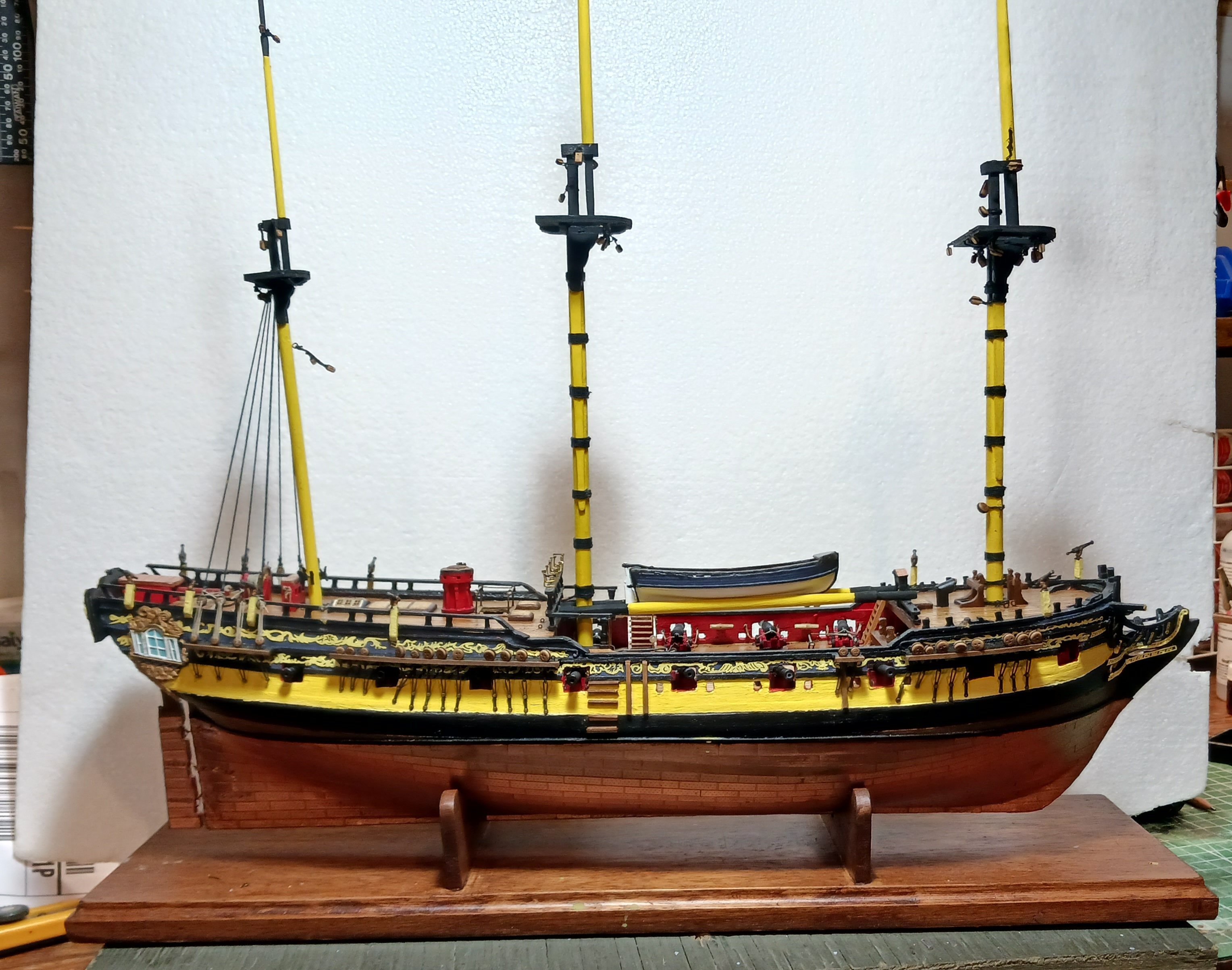

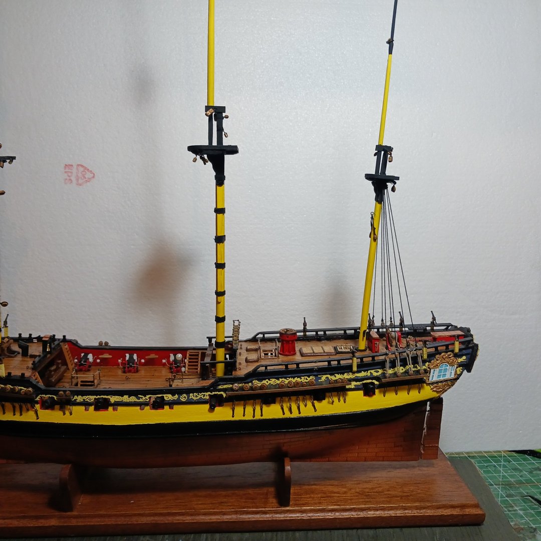

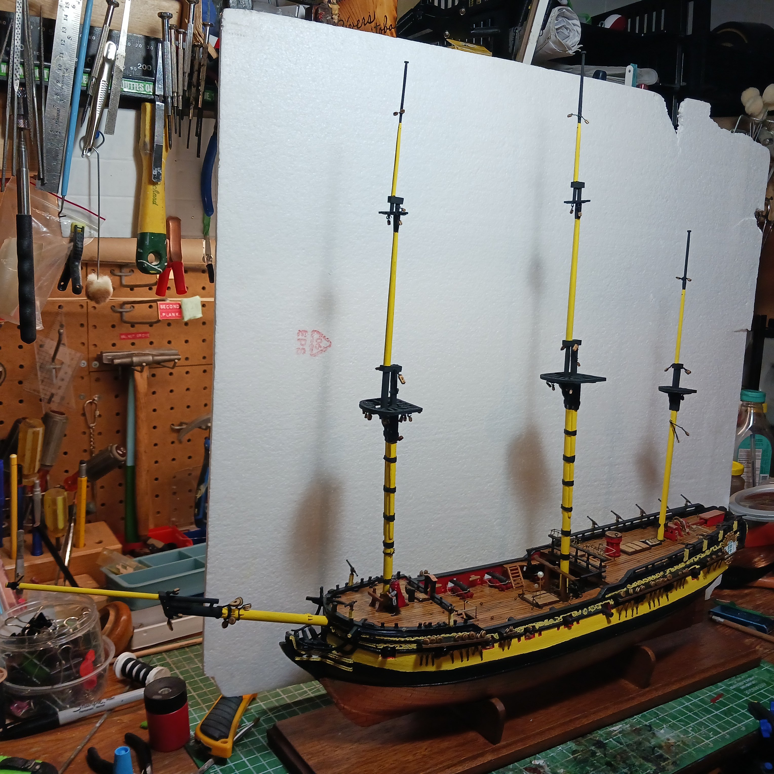

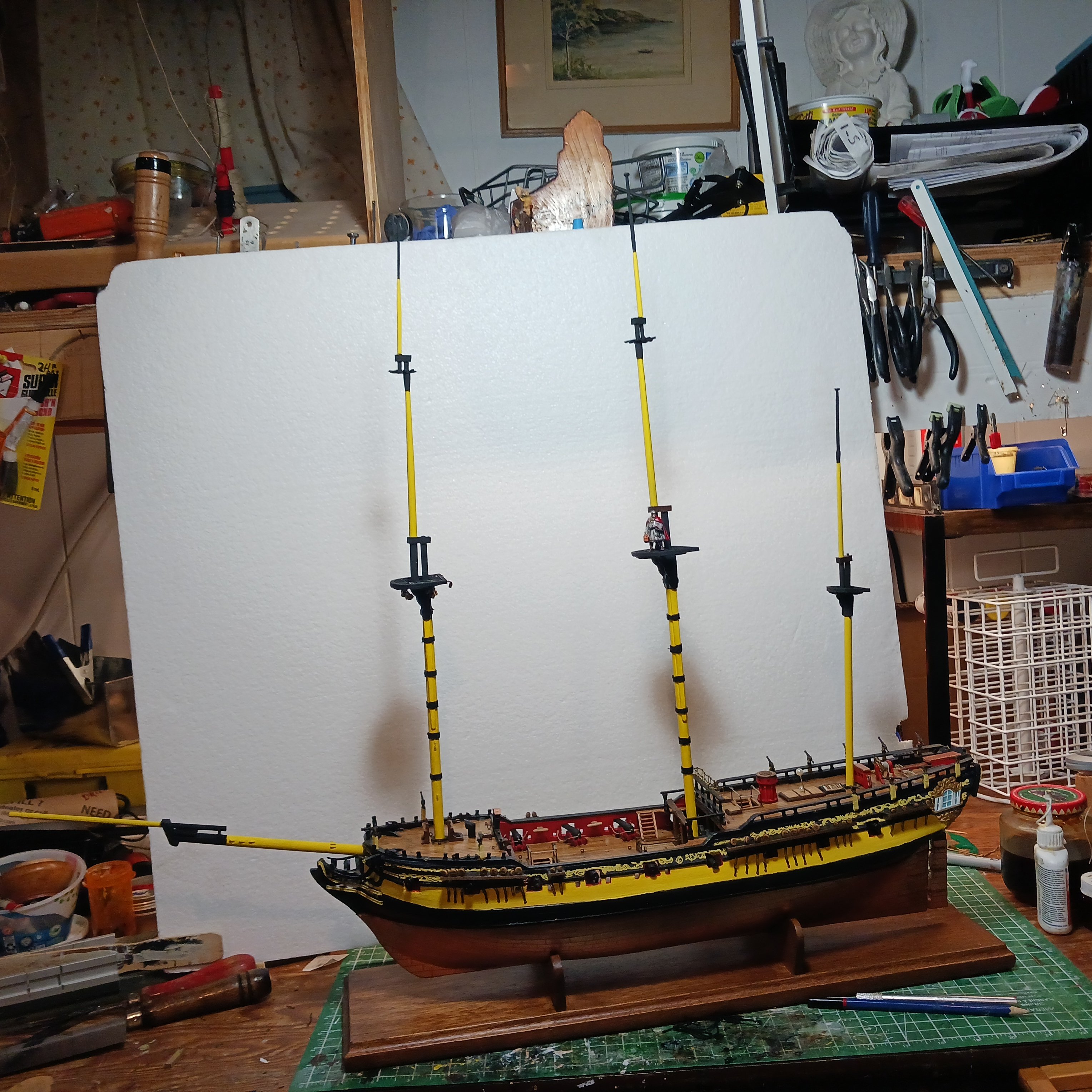

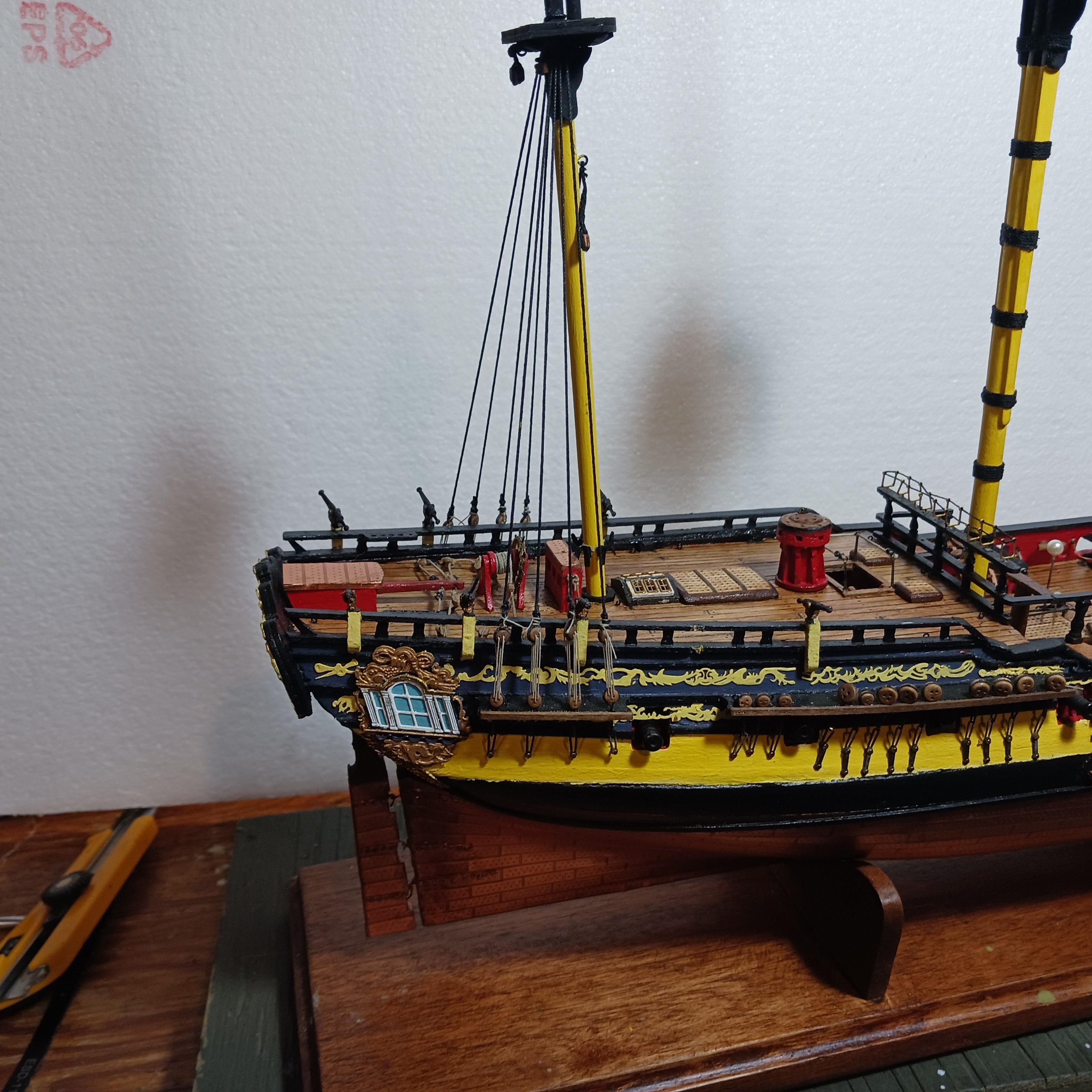

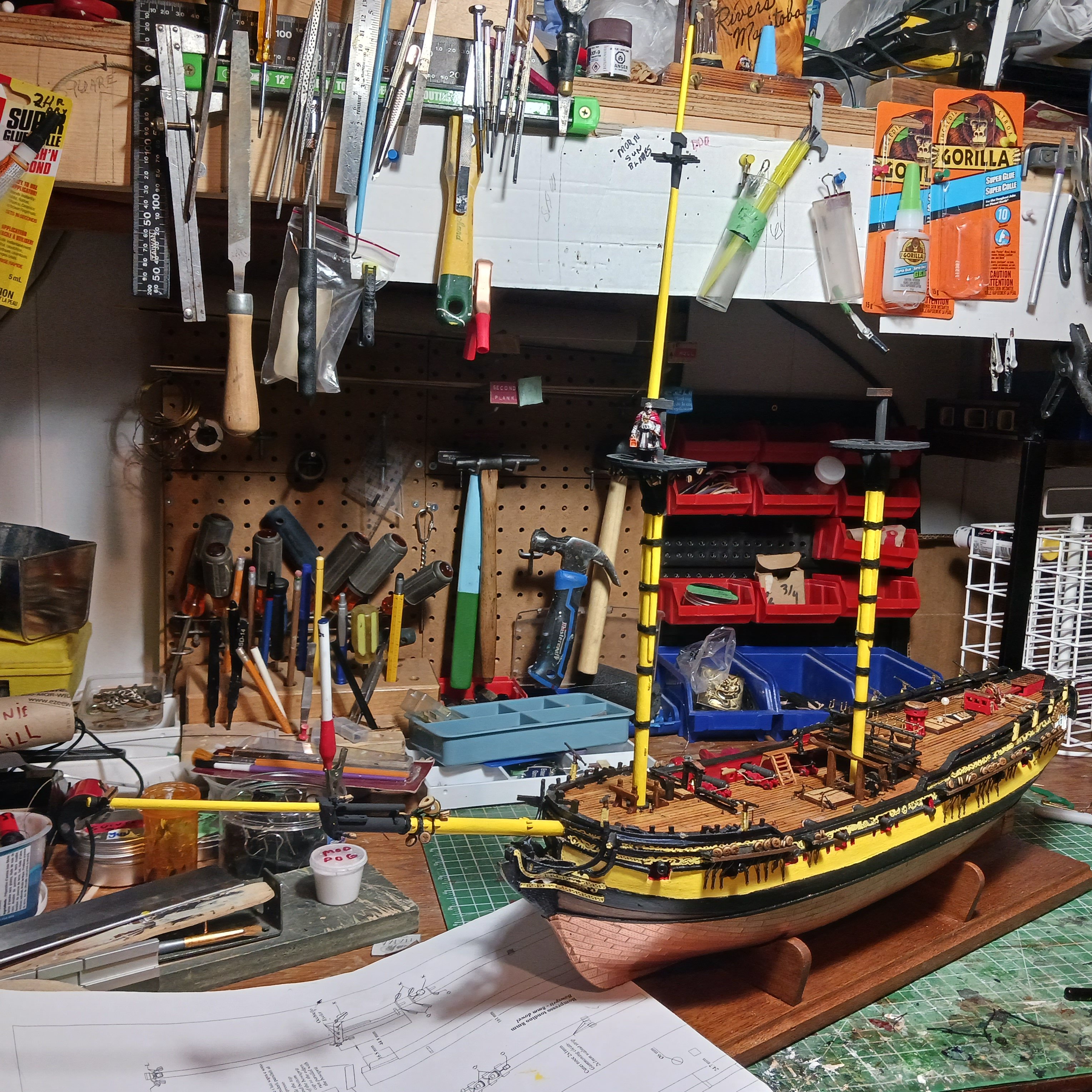

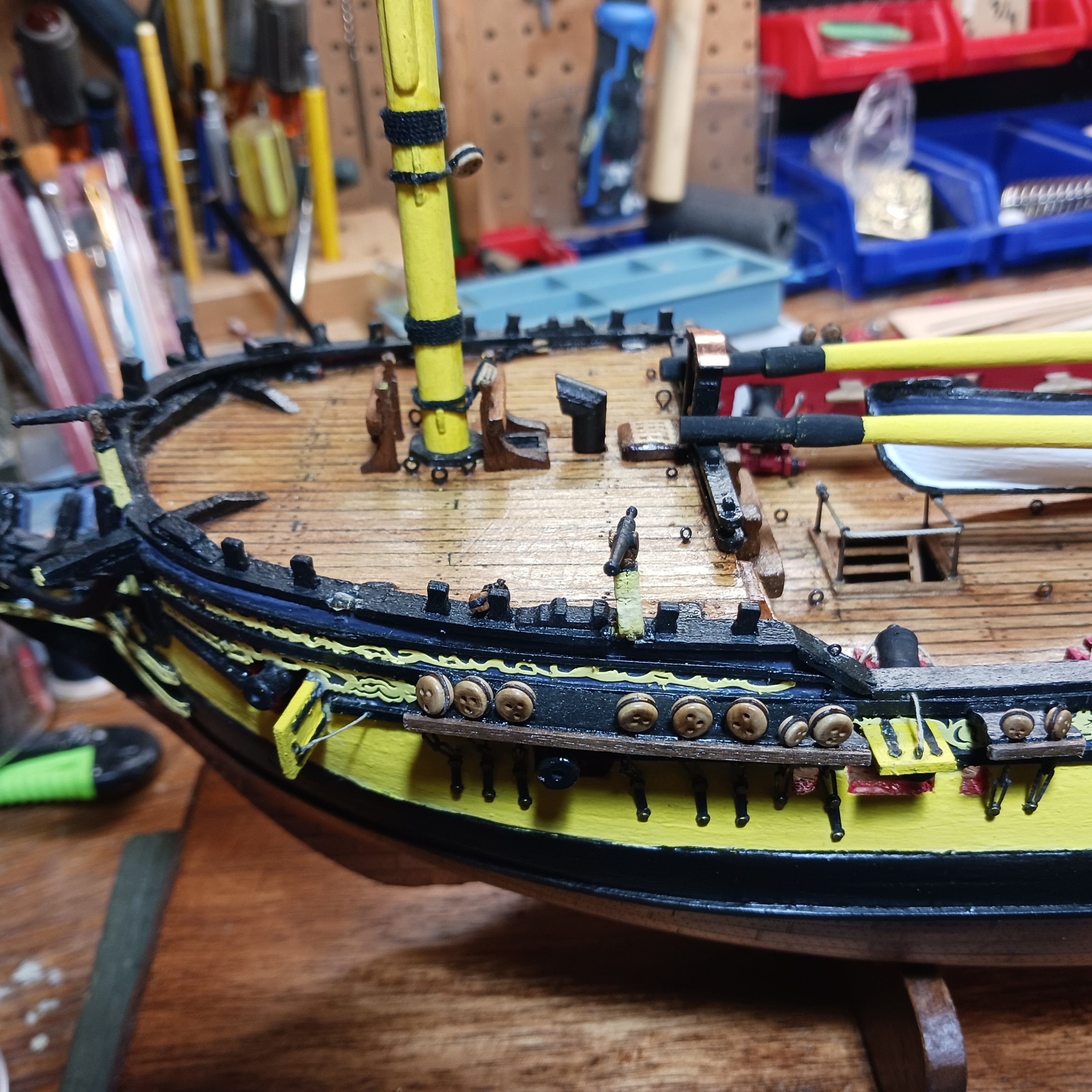

The masts are set, ready for shrouds. The Bowsprit mast is not glued, in fact it is in storage lol. For safe keeping. I only put it on for pictures  lol.20250904_101609.thumb.jpg.fe2531be47569b654d4187010c48b23f.jpg
The plan showed a Mizzen belaying rack, I Went with  cleats. @Blue Ensign idea, @Moonbug log I was not able to get a good look at what he did. So I looked at B.E . Log and got the idea for it. The plan Mizzen belaying rack  made no scene  to me, sideways pins. Oh well thanks to the logs here on MSW, I was able to move forward. Thanks for posting.
I tied on the Mizzen lower shrouds, the jig works OK, they look even. Four on the port side upper deadeyes  are upside down but only we will notice  lol. I do let a lot slide,  Of course that will not  be the display  side :D
Moving on to the main mast lower shrouds.

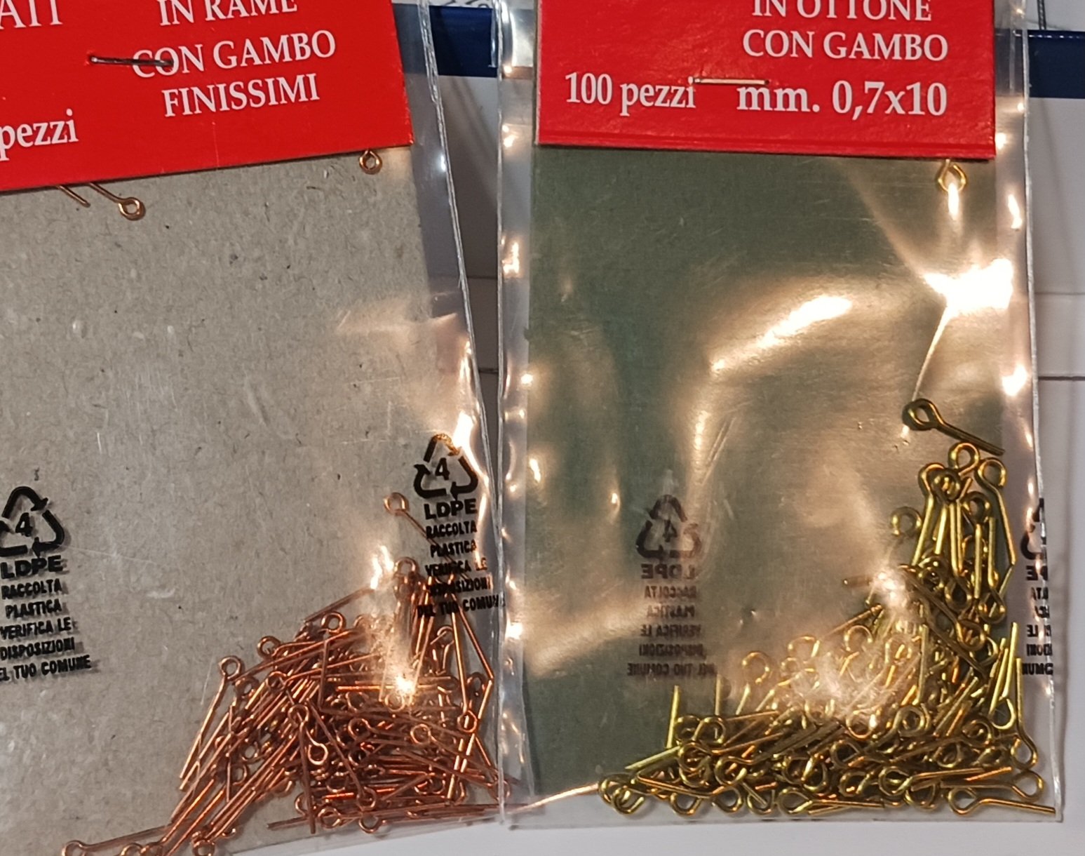

Today more supplies arrived,  a small tariff was applied what  can you do.20250905_160140.thumb.jpg.c8ae31bc09b468b3455392afe0538a4b.jpg
I needed eye hooks and ordered lots, and from different  stores  as well, in total, 416 eyehooks, now I can ride out any  traiff :D.
Rope, yes four more roles of black thread, I have no idea were all my thread goes lol. Rodney's Astrolabe  took it all.

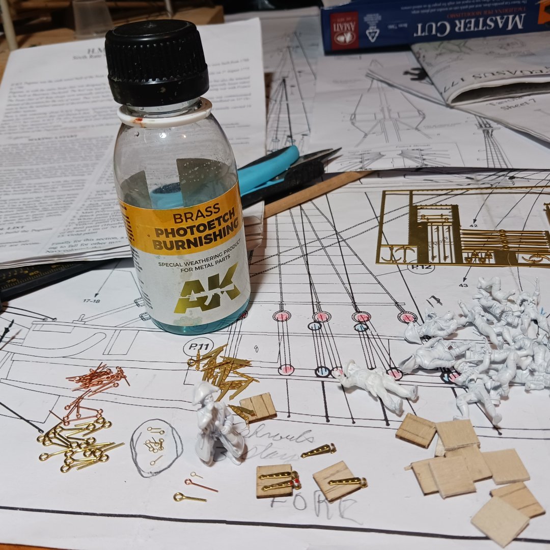

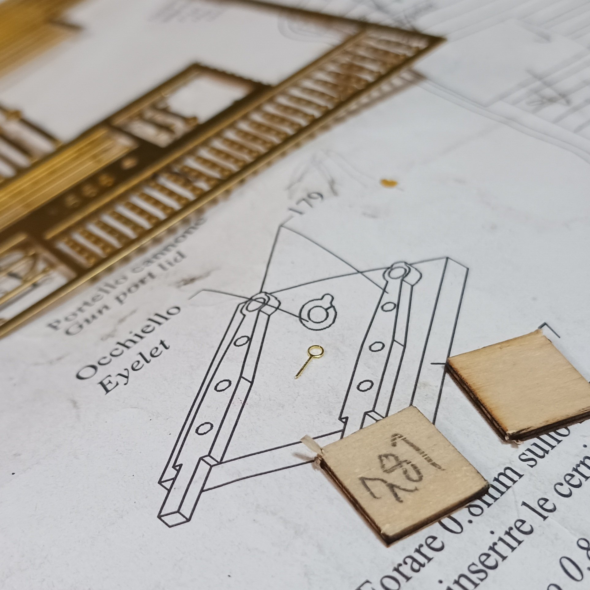

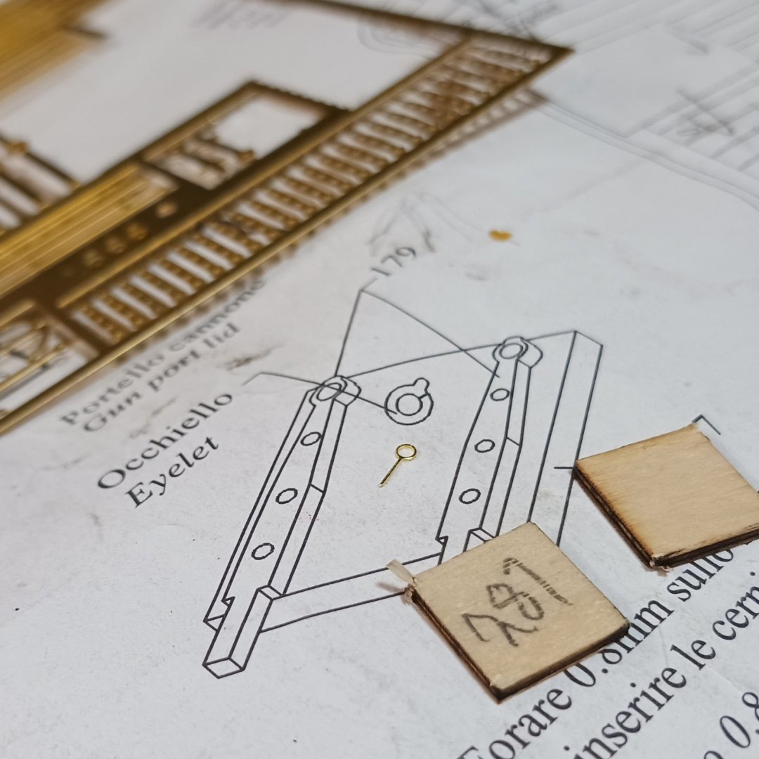

Now that I have replaced my stock of thread, time to turn my attention  to the gun port lids.

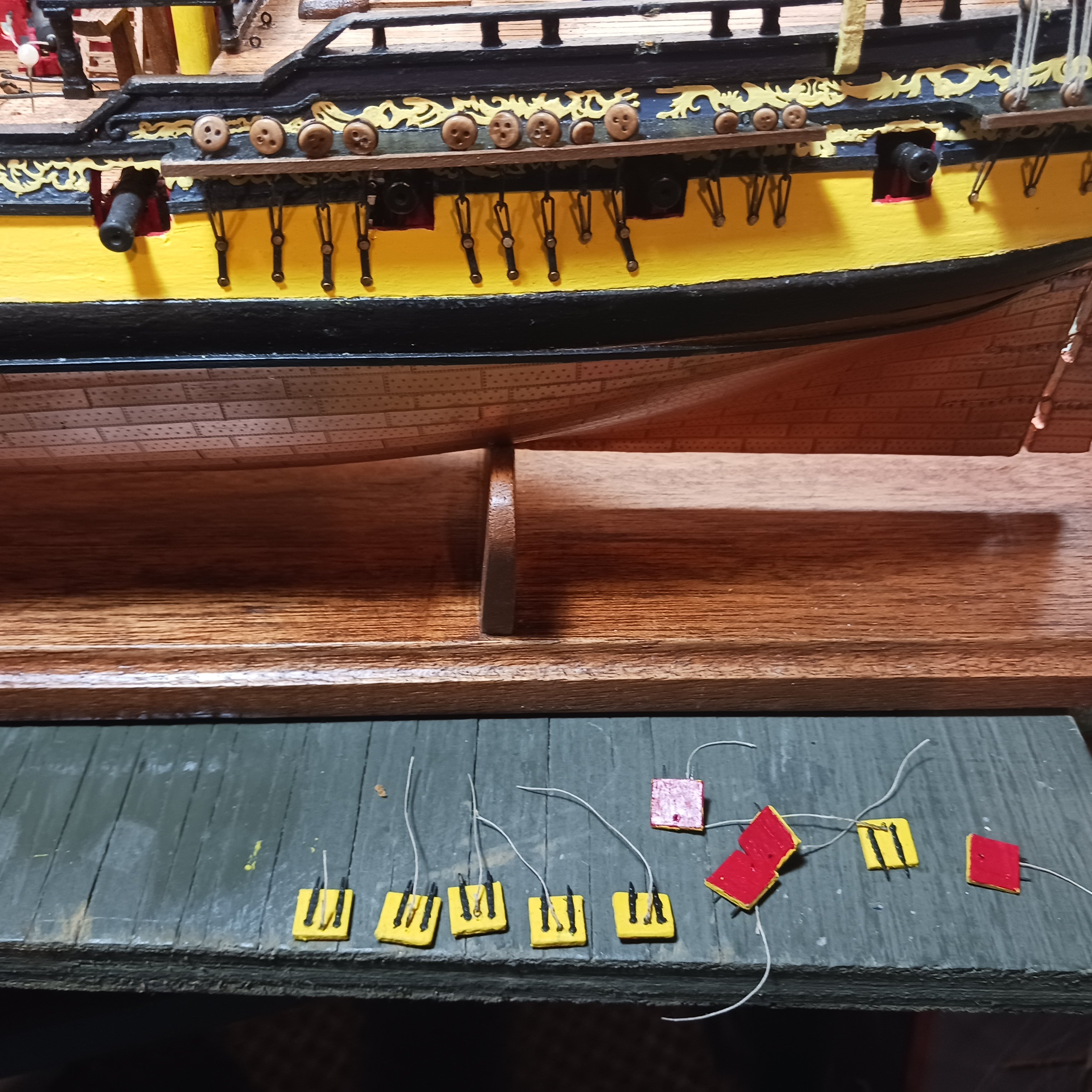

Kit comes with 8 lids, enough  photo etch to make 12 lids, my plan calls for 12, some open, some shut , two sideways lol. Can you belive all this fun.
T hanks to @Blue Ensign and @Moonbug for posting your logs, all my idea come from looking at those  two logs, everything  you need to know about the Pegasus  is in there just go to find it lol.
The lids will take time to make, I have to come up with four sets of hinges and two sets of hinges that are for the sideways  lid., but I have it all in Rodney's stach of trinkets.

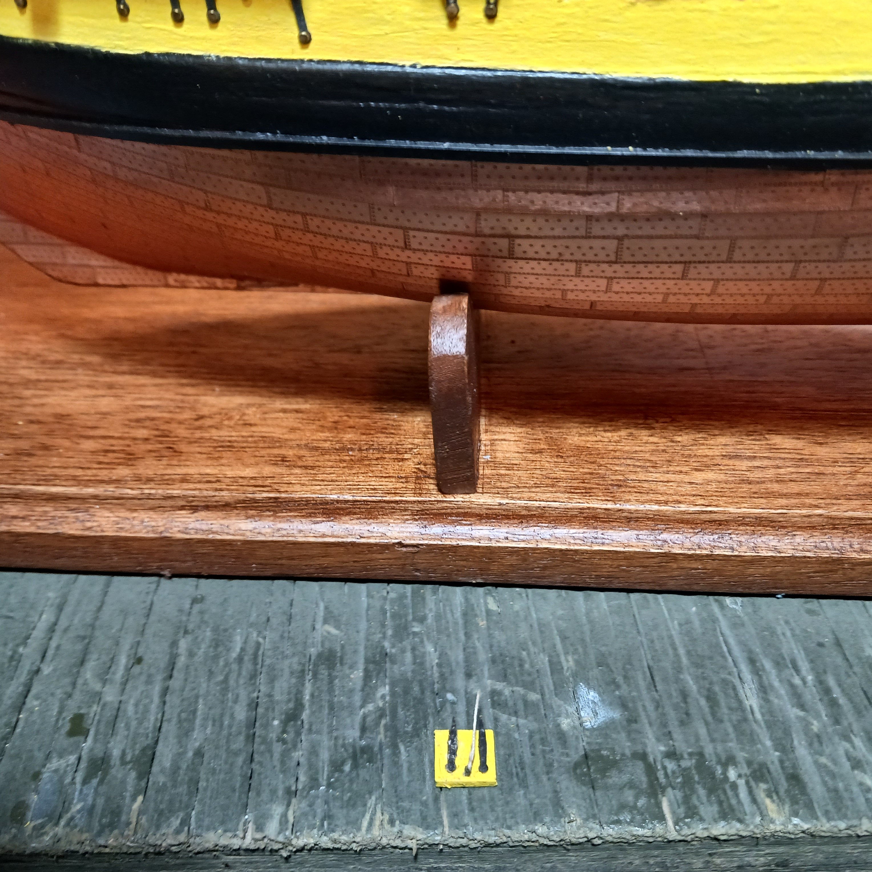

 Two lids down, 10 to go. I got the parts together,  had to blackin some, decided  to blackin a few eyehooks for later. The smallest eyebolts  will be for the gunport lids .
The plan was to go sideways for the this lid, but I didn't like it,  so I turned it.

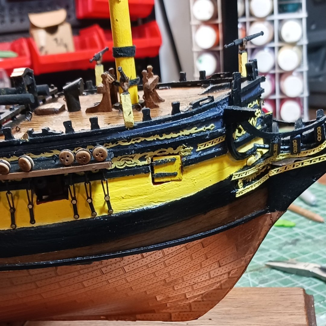

I think it looks the lesser of two evils lol. That was the starboard side,  port side was a different  story, lol
Although it is mounted sideways,  there was no moving the cannon so I left it open. I will add the little eyehooks and ropes later. I will make all the lids , but won't put them on till later in the build. ,this all has to dry, at least 4 hrs while the Banjo  Bowl Game is on , lol. 20250906_150854.thumb.jpg.bf8208f94fdd74ad712e740095bb15ef.jpg
Five bucks says she off before I finish  all the rest of the lids. lol.

Gunport lids are all painted and ready to install,  later.lol. if it hangs off the ship I will surely  knock it off, so I am just letting them dry  then put them away.
The tiniest eyebolt I have and then tied on with a .o1 mm rope. Good enough  for me.20250907_170040.thumb.jpg.f9c4e5614811432b9fda211ac6efb985.jpg
I belive that was the last things I have to paint,  not sure , but it is all rigging from here on :D. Oh yes I will repaint all swivel guns,  as soon as I knock them all of, lol
Half of them are in the tin now.
The frist lid is glued in  but the rest I will attempt latter.
 So with that , on to the shrouds,  all the  lines are served and ready to start cutting  it up to see If I made enough,  lower Mizzen are on and the main lower are cut , it going to be close , but it really doesn't  matter because I have to set up the serving machine for the stays, main stay is 1.03 mm, I also need to make up some 1.0 mm and some more .75 mm. I don't  serv any lines under .75 mm , it can be done just for me I cant see the difference,  so its something  I will just skip.
 I remember  making  .5 mm for my Duchess of the  and the Astrolabe  1812. The .5 mm I get from Amati  is just as good.
So I am going to install the lower shrouds then it time to start making a list of lines I need and how much 🙃
  I just read that my serving  machine  is Not intended to be motorized,  lol to bad she's getting  hooked up to the cordless  drill 😅 🤣.  I know where to by a new one,
And I will if I have to, I like serving lines, to me it part of modeling, my models  may not be the prettiest 😅 but I am just learning how.  If I may say the Pegasus  is turning  out to be a fine ship, I am looking forward to trying new things that I see on the logs here on MSW. Thanks everyone for all your help.

Pegasus is looking very nice Bob.  A fine ship indeed sir.
Steve
