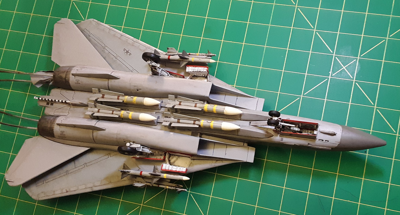

I added a piece of brass tube for a gun barrel.
Big mistake. After researching, it should just be a hole, as the barrels are farther back.
I would remove it, however, it would be difficult without damage, so incorrect it will be.

Brother, I assume you used CA to glue it to a bulkhead or along the side, I would use a drill bit larger than the brass tube ID but slightly smaller than the OD in a pin vise and slowly remove it till it's gone or it spins off it's mount....
The drill bit will either remove the brass to the point of pushing the residual back into the fuselage where it cant be seen or grab it and twist it off... without damaging the plastic.... I've done it in the past for the same mistake...
Don't use a power drill for this technique, way too much torque and if the bit grabs then you lose the model... Do it by hand so you have better control....
It's an easy mistake to make.....
