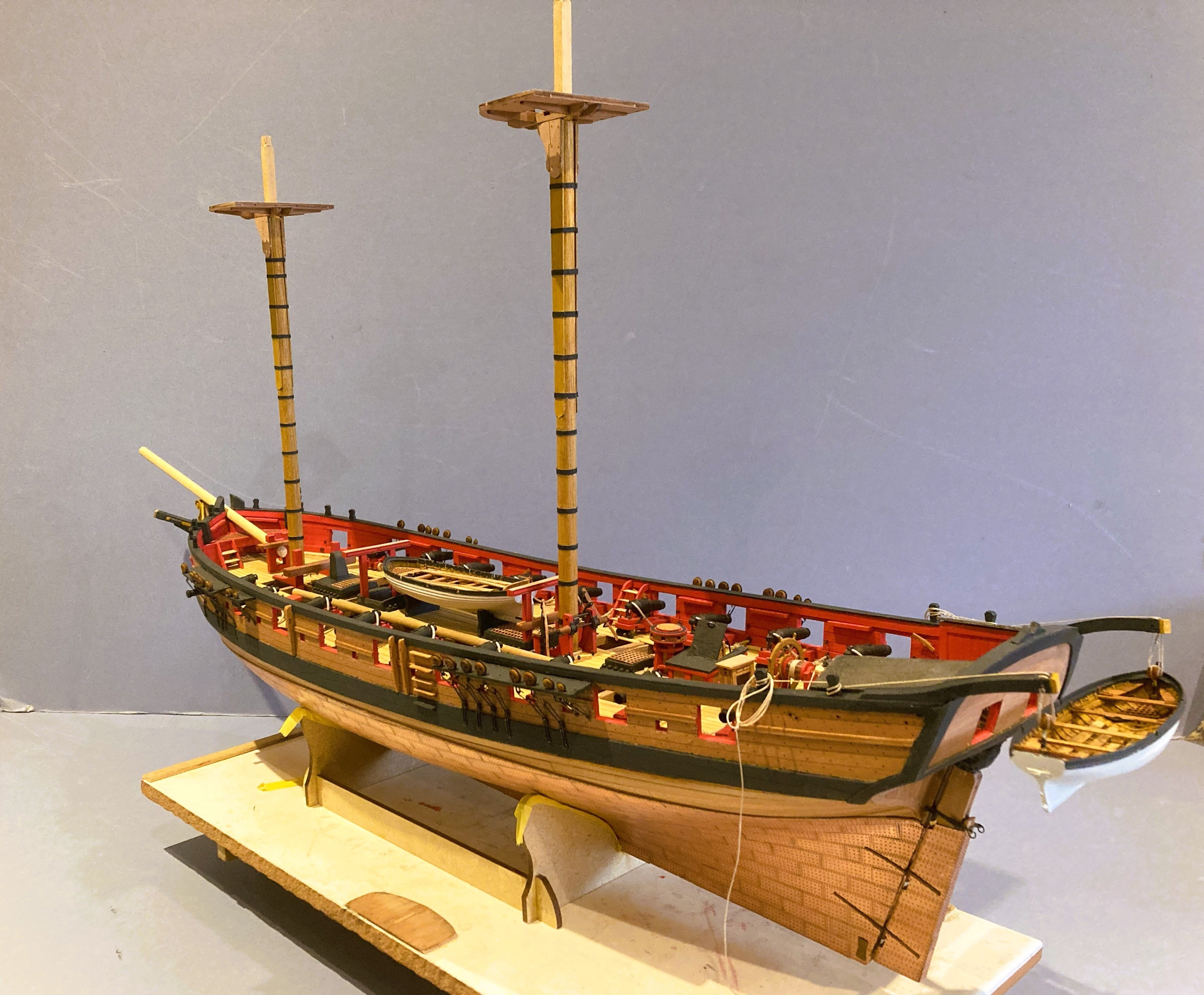

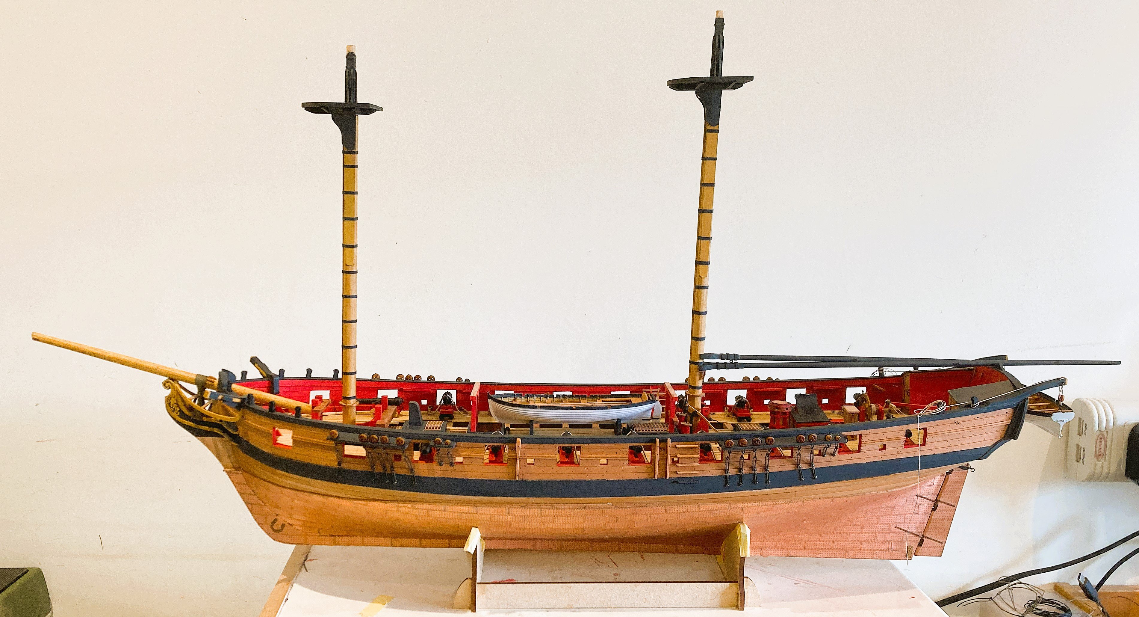

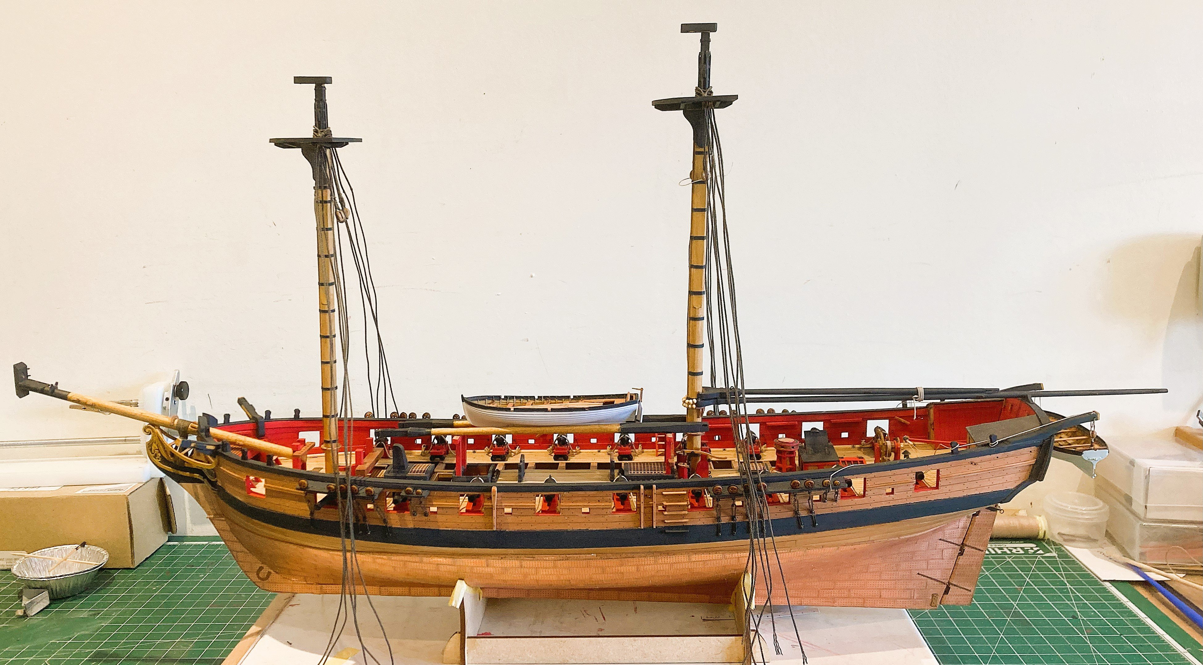

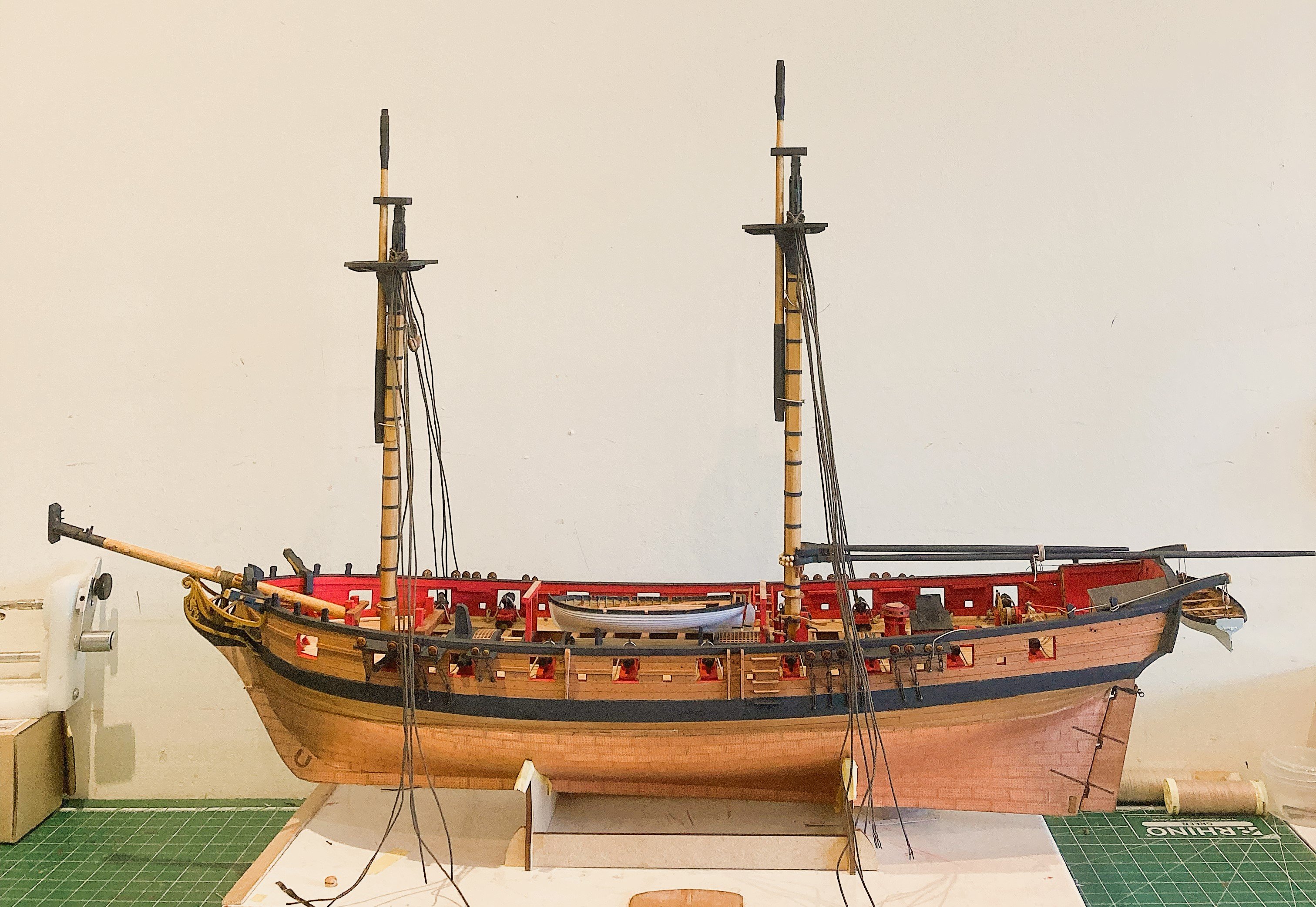

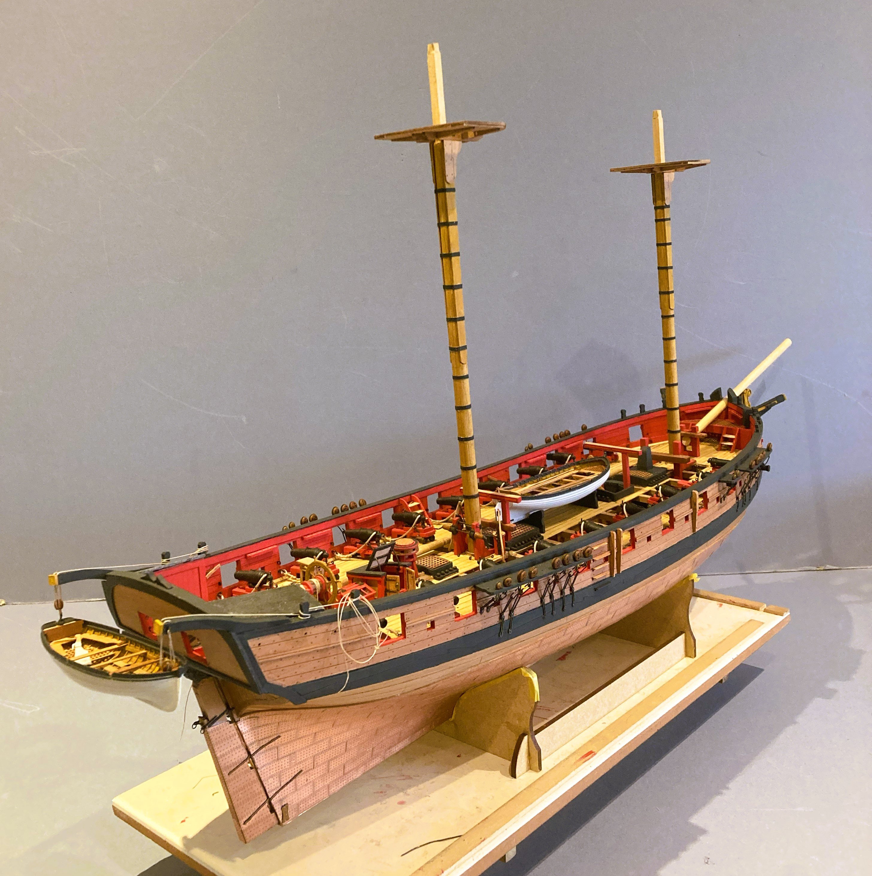

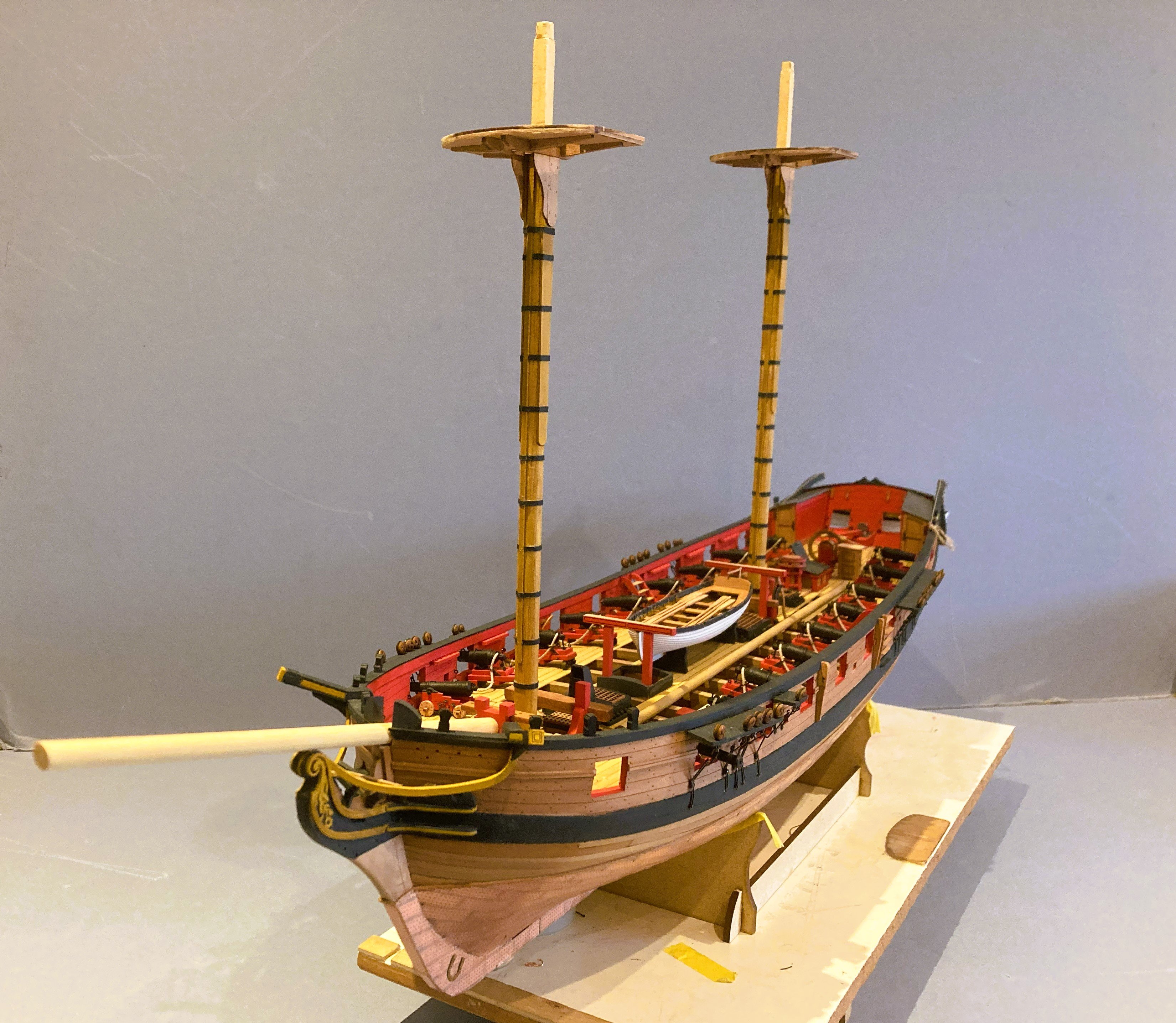

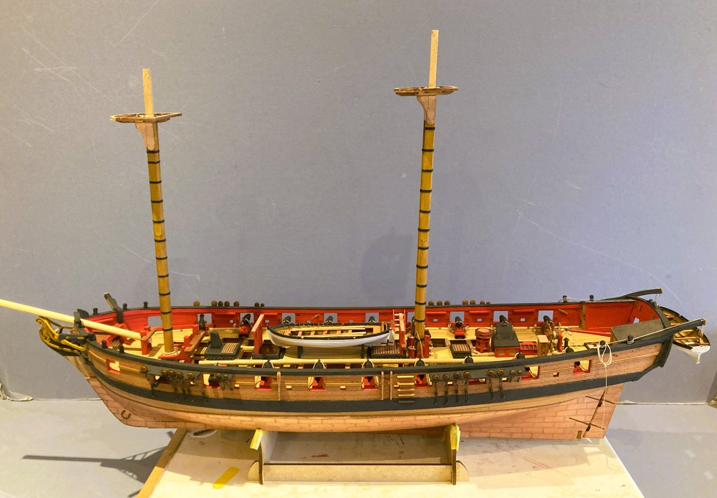

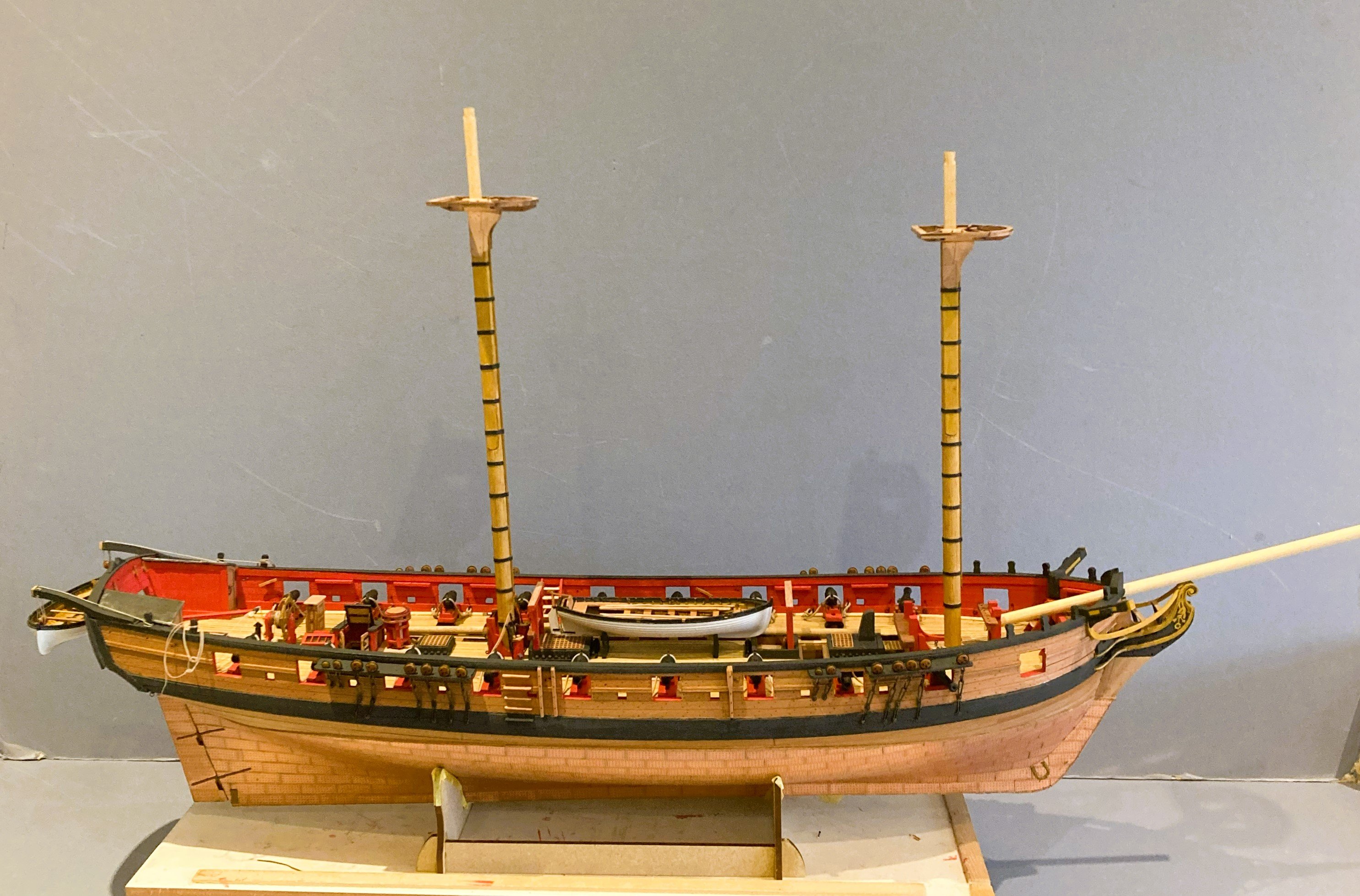

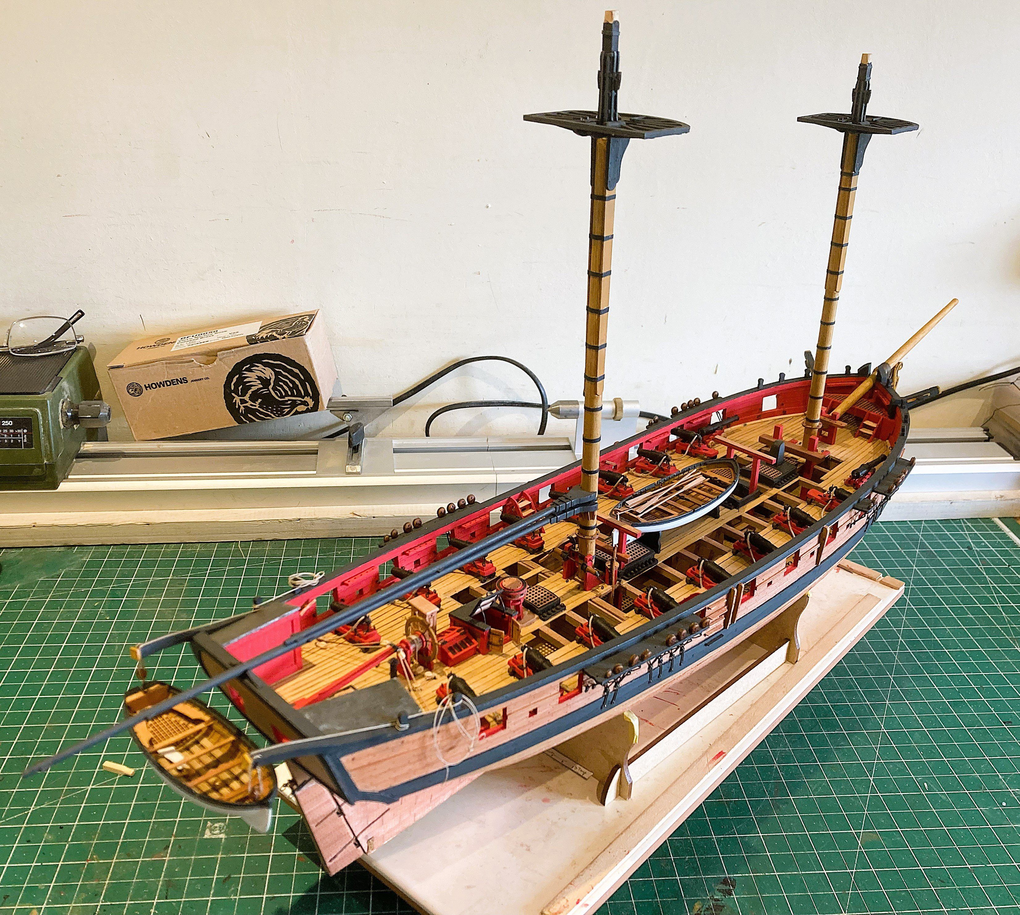

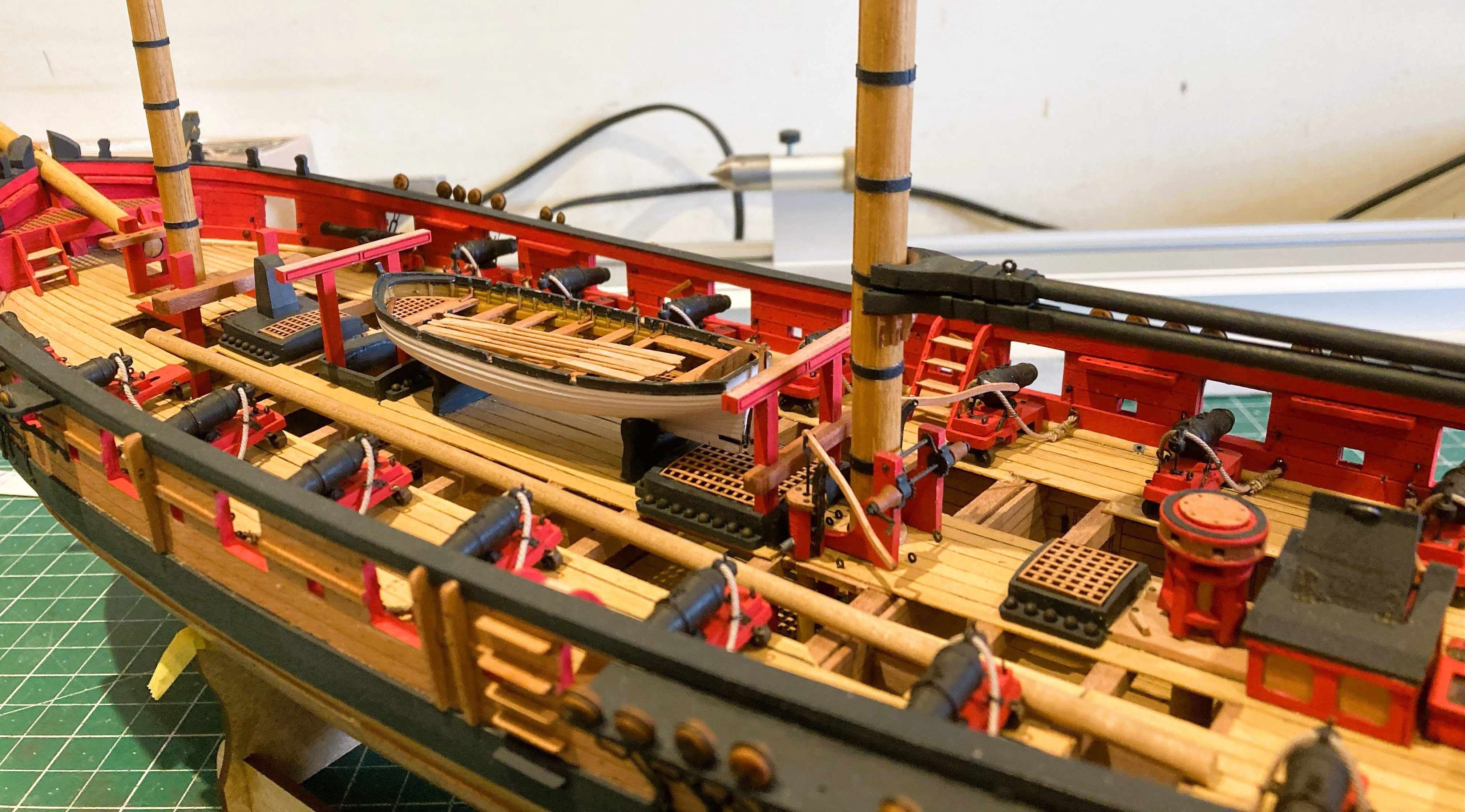

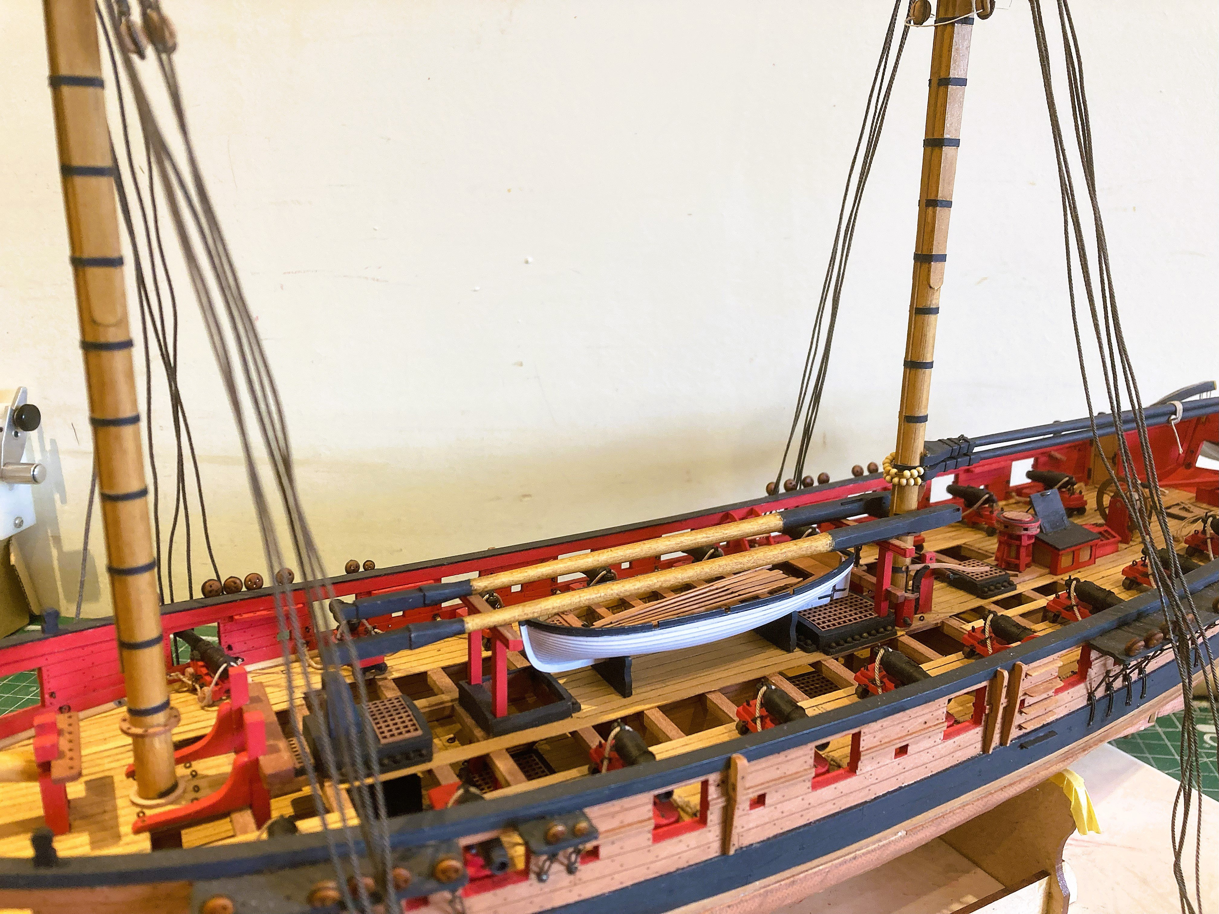

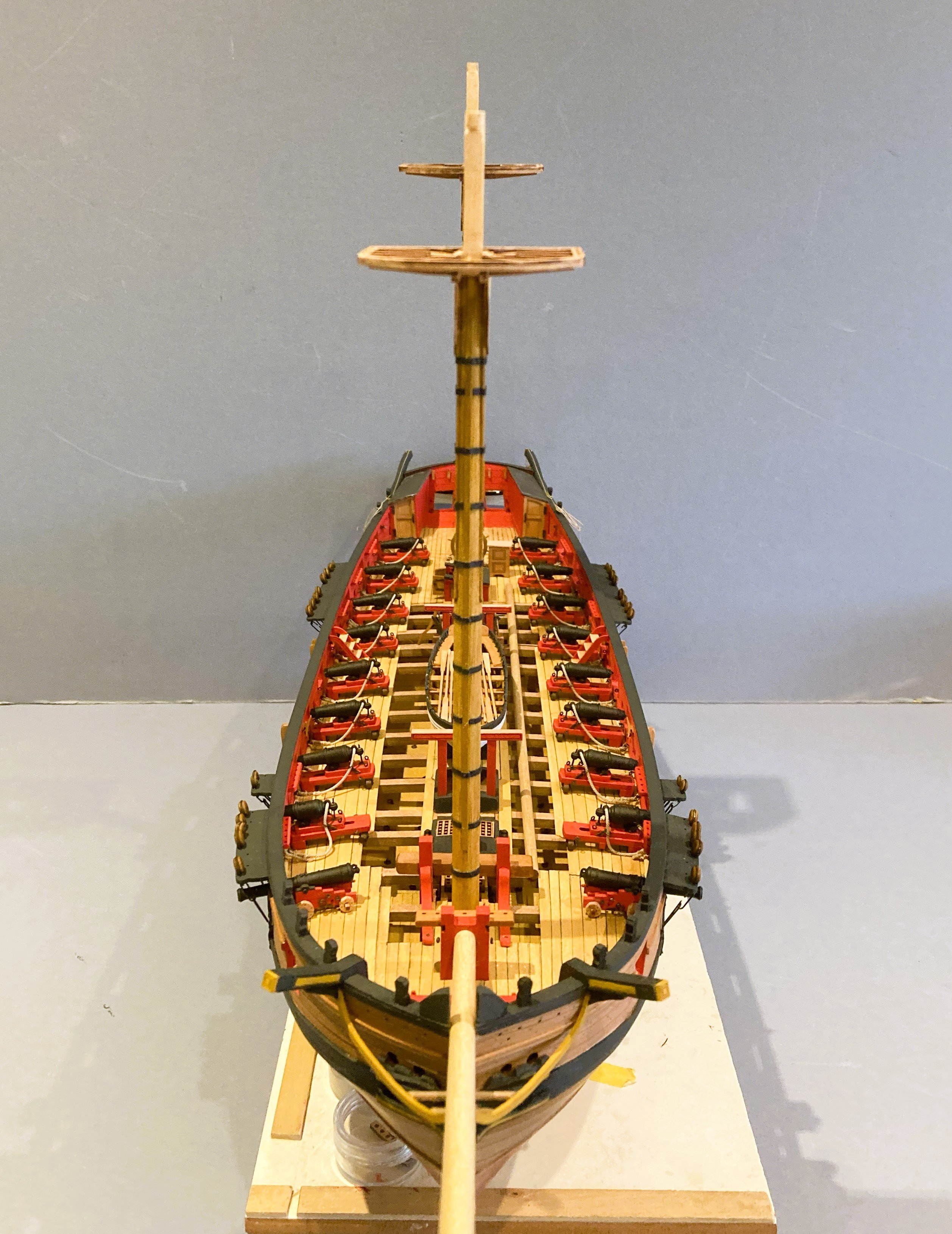

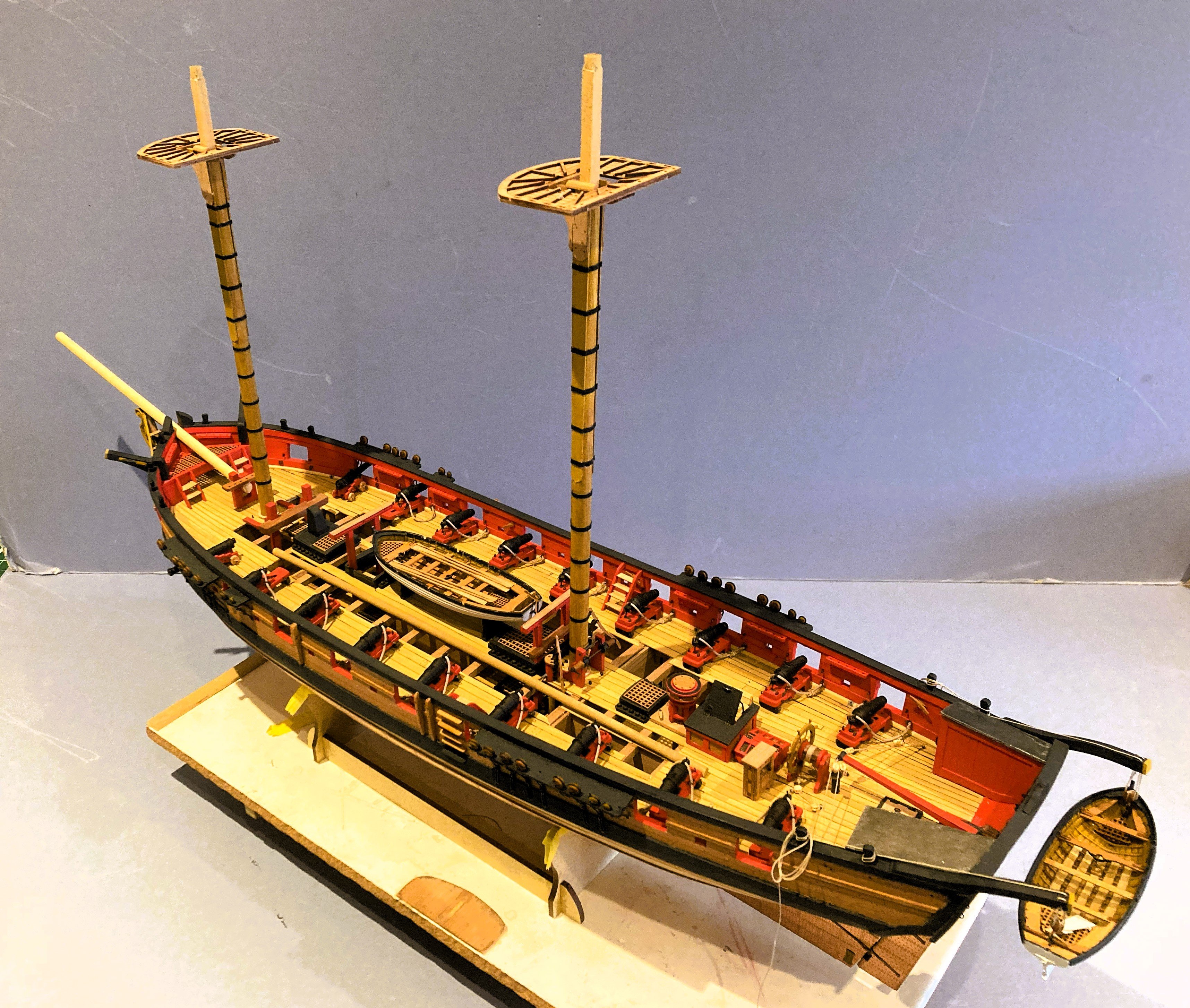

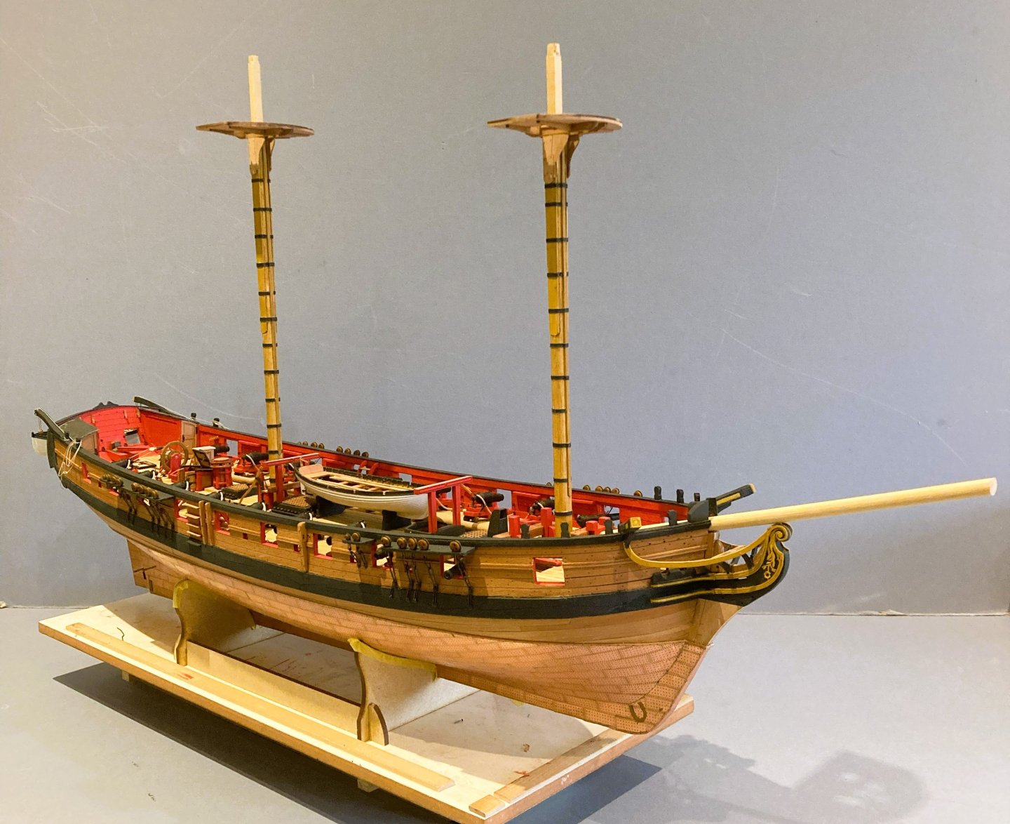

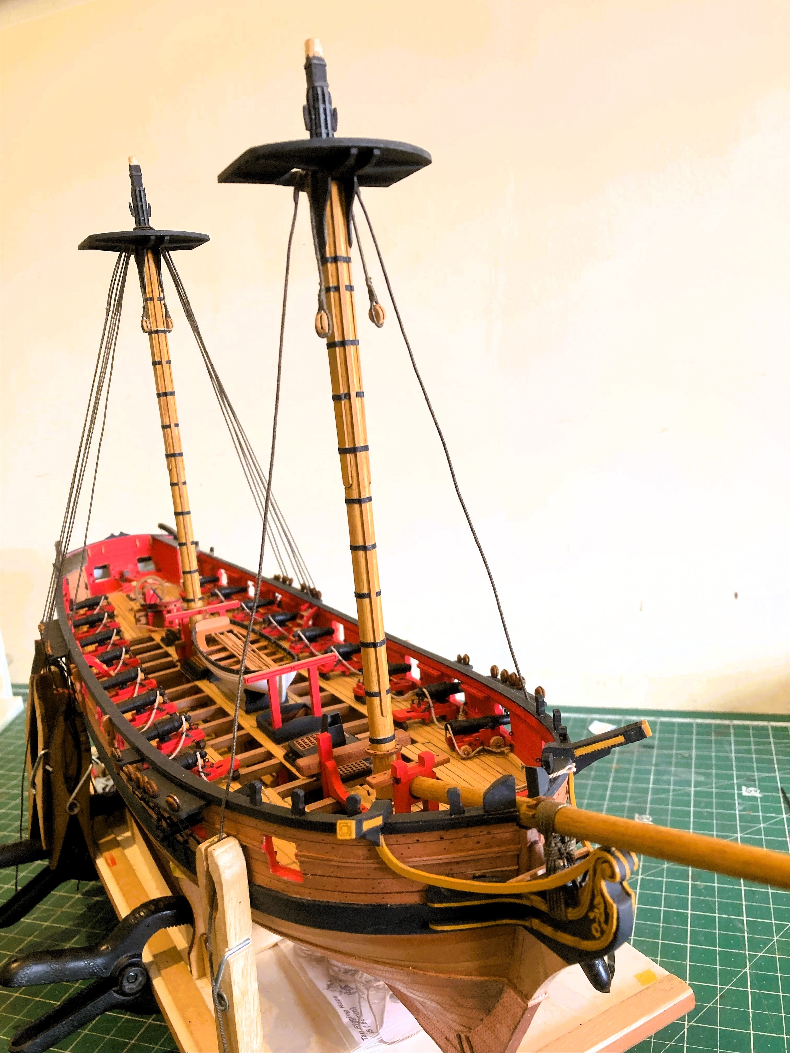

A look around Harpy at this six month build stage, a very enjoyable experience overall.
In my search for authenticity, there has  been some frustration with detail queries, and some things still remain a mystery.
Even so, she is shaping up into a fine model, Harpy is a worthy addition to Chris’s  range.
4487a
4488a
4489a
4491a
4492a
4493a
4494a
4495a
4495a

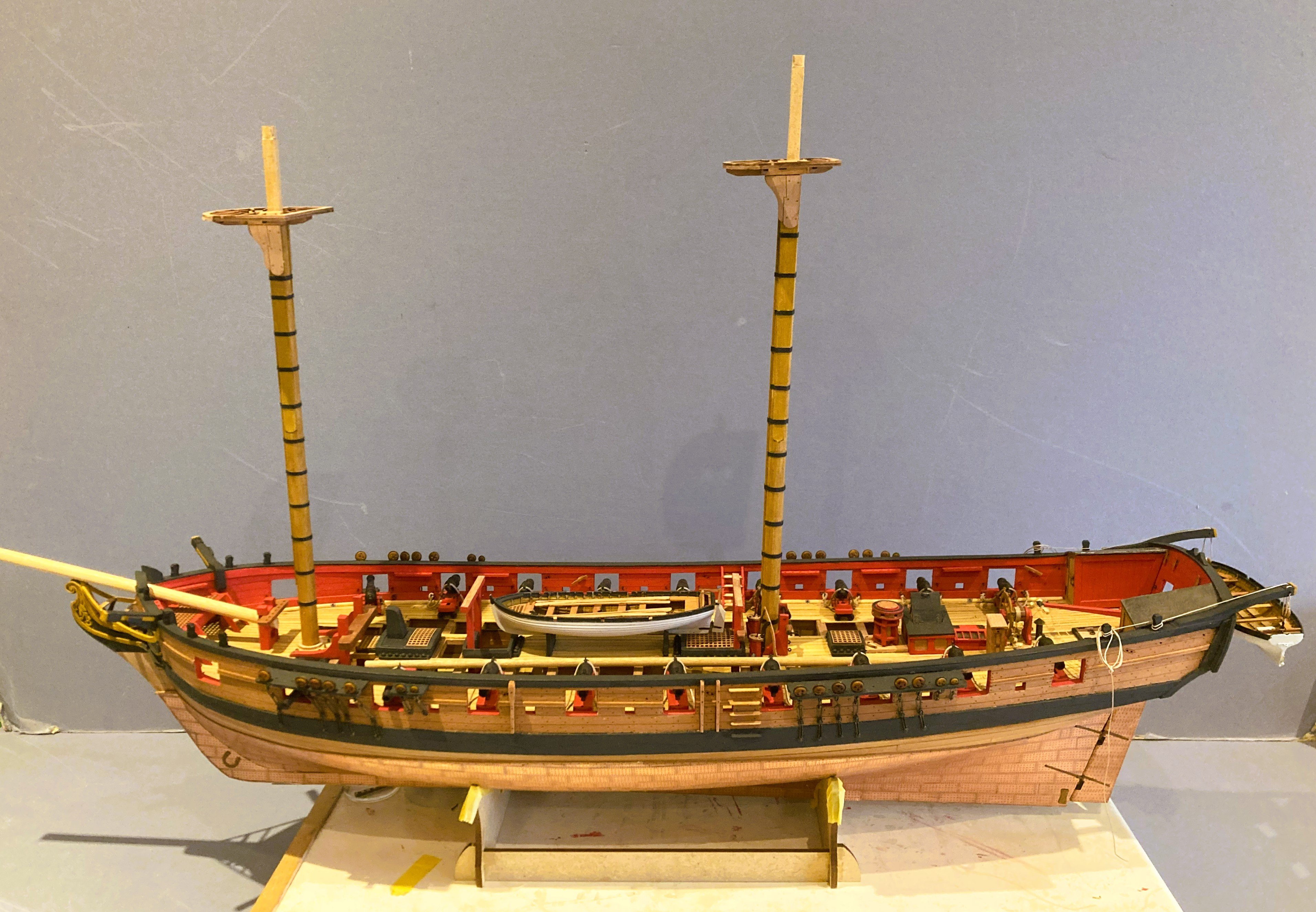

All the hull work bar some minor fittings, is now essentially complete, time to move onto the Masting.

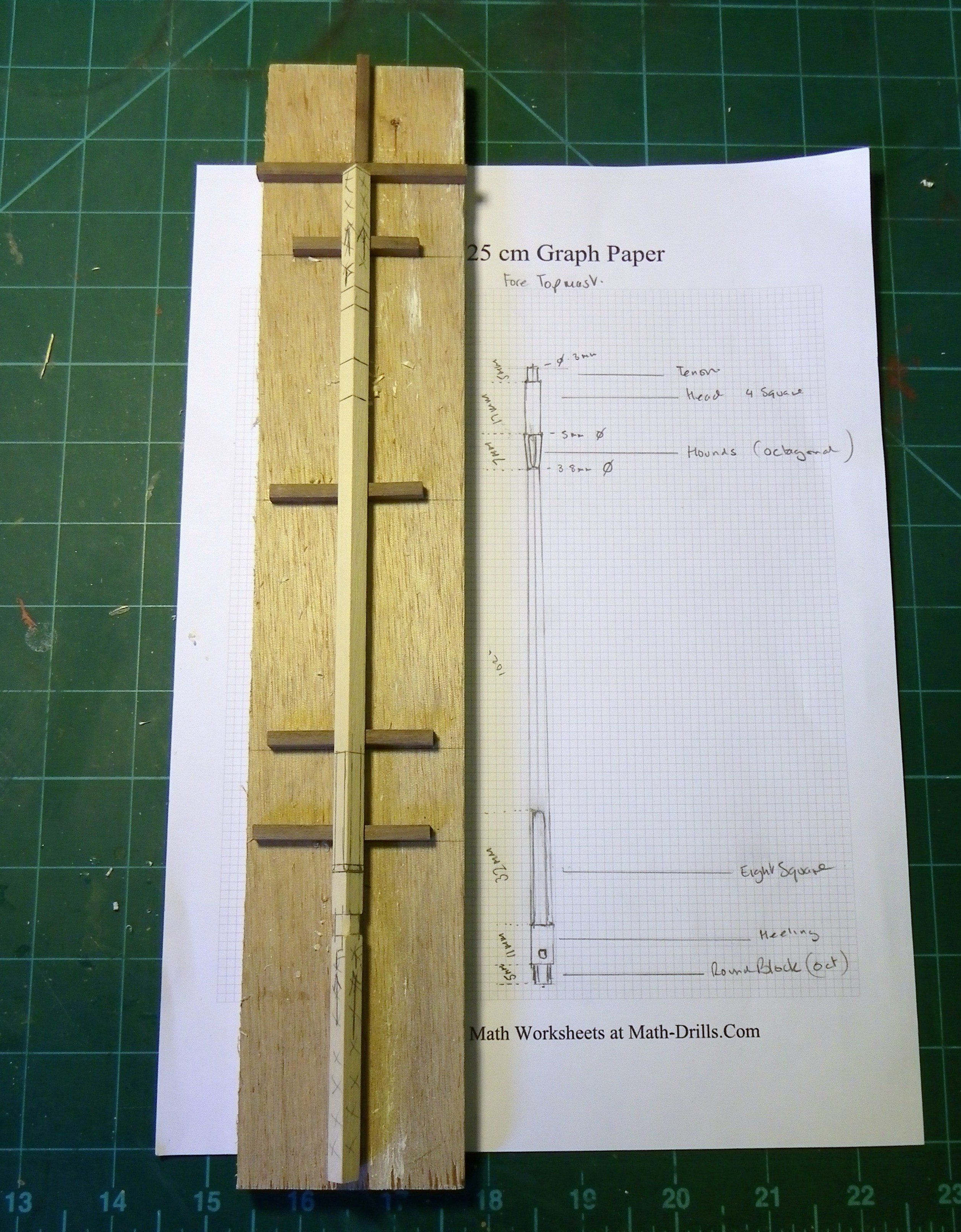

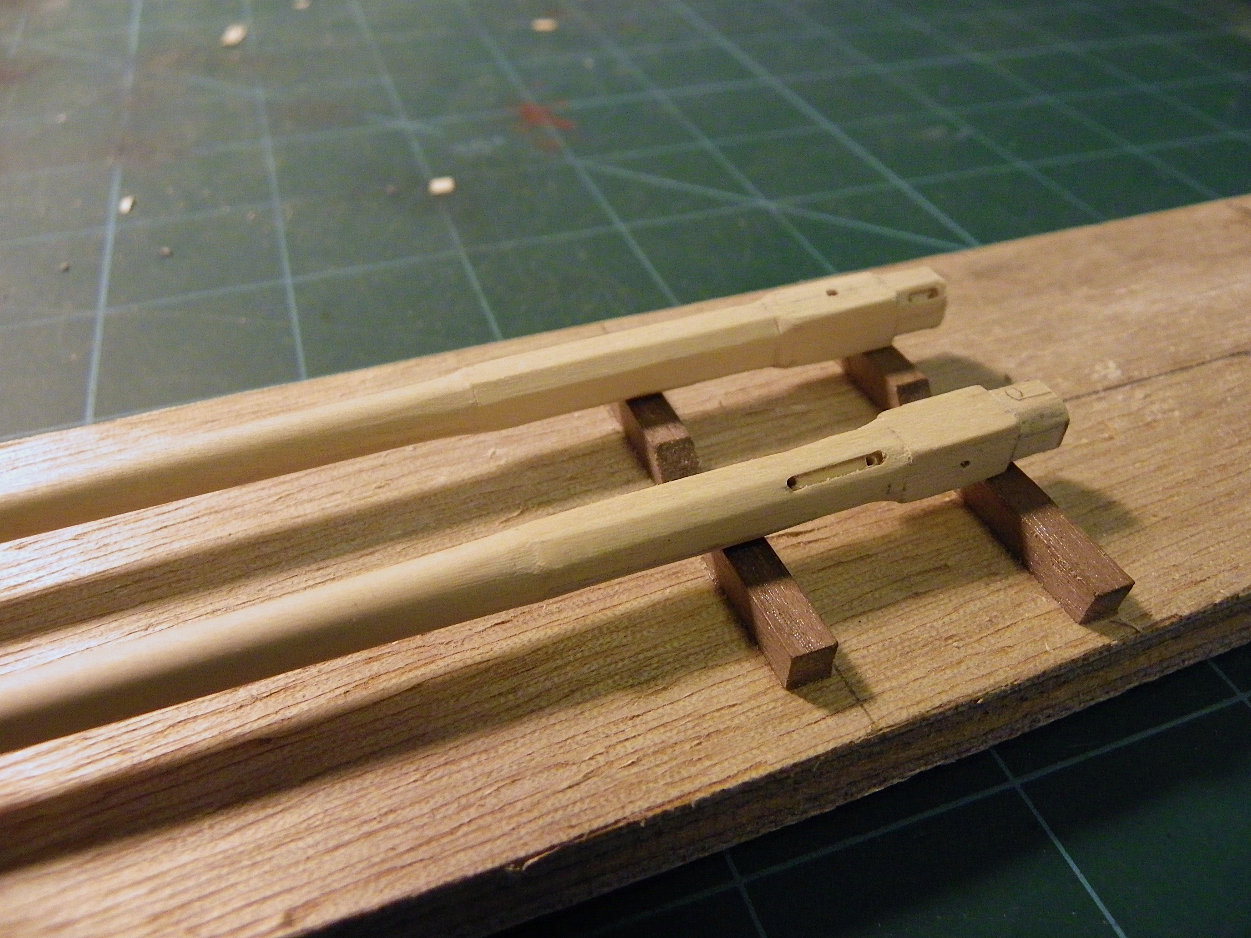

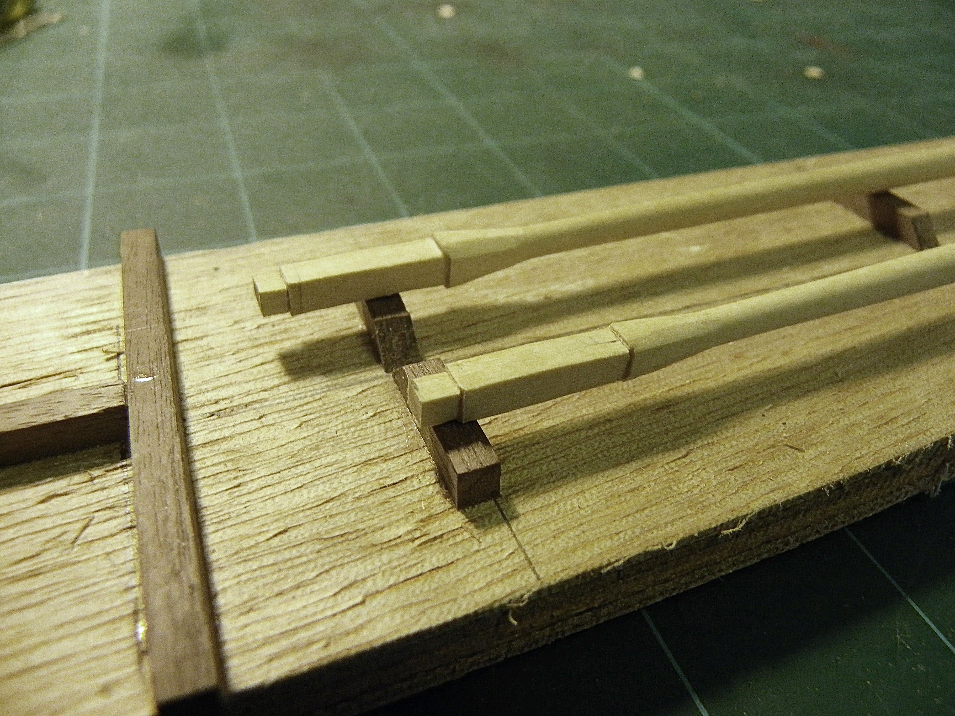

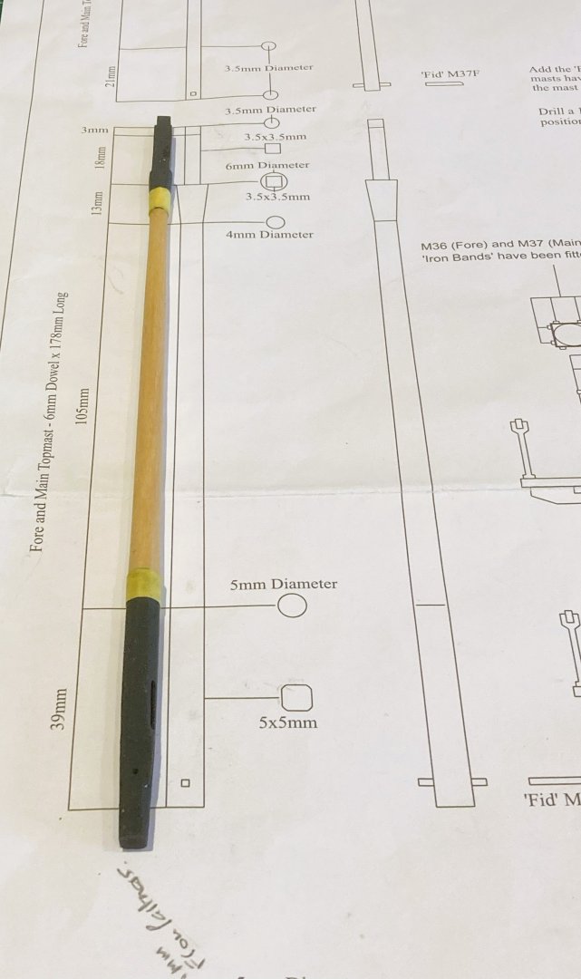

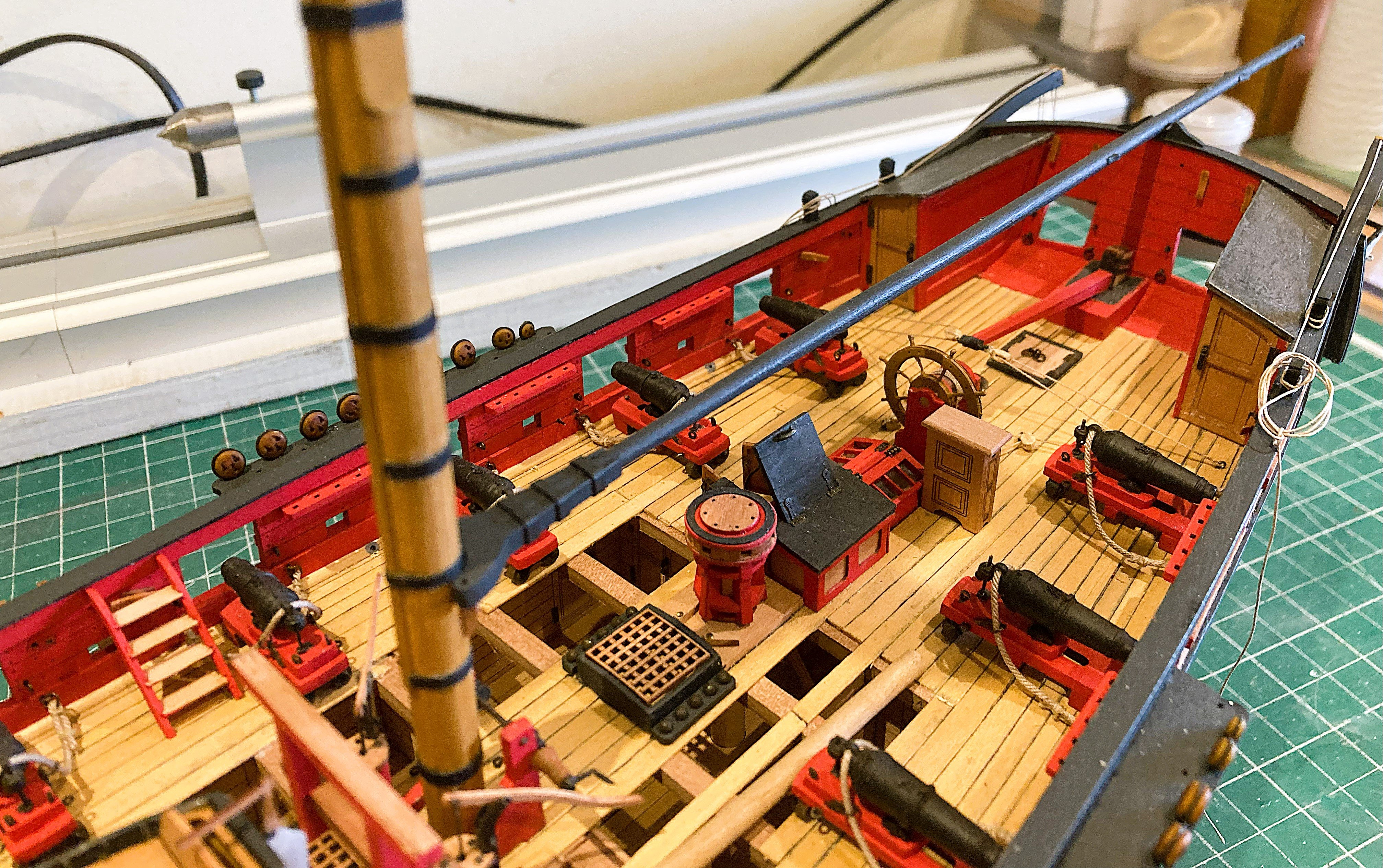

Boom and Gaff

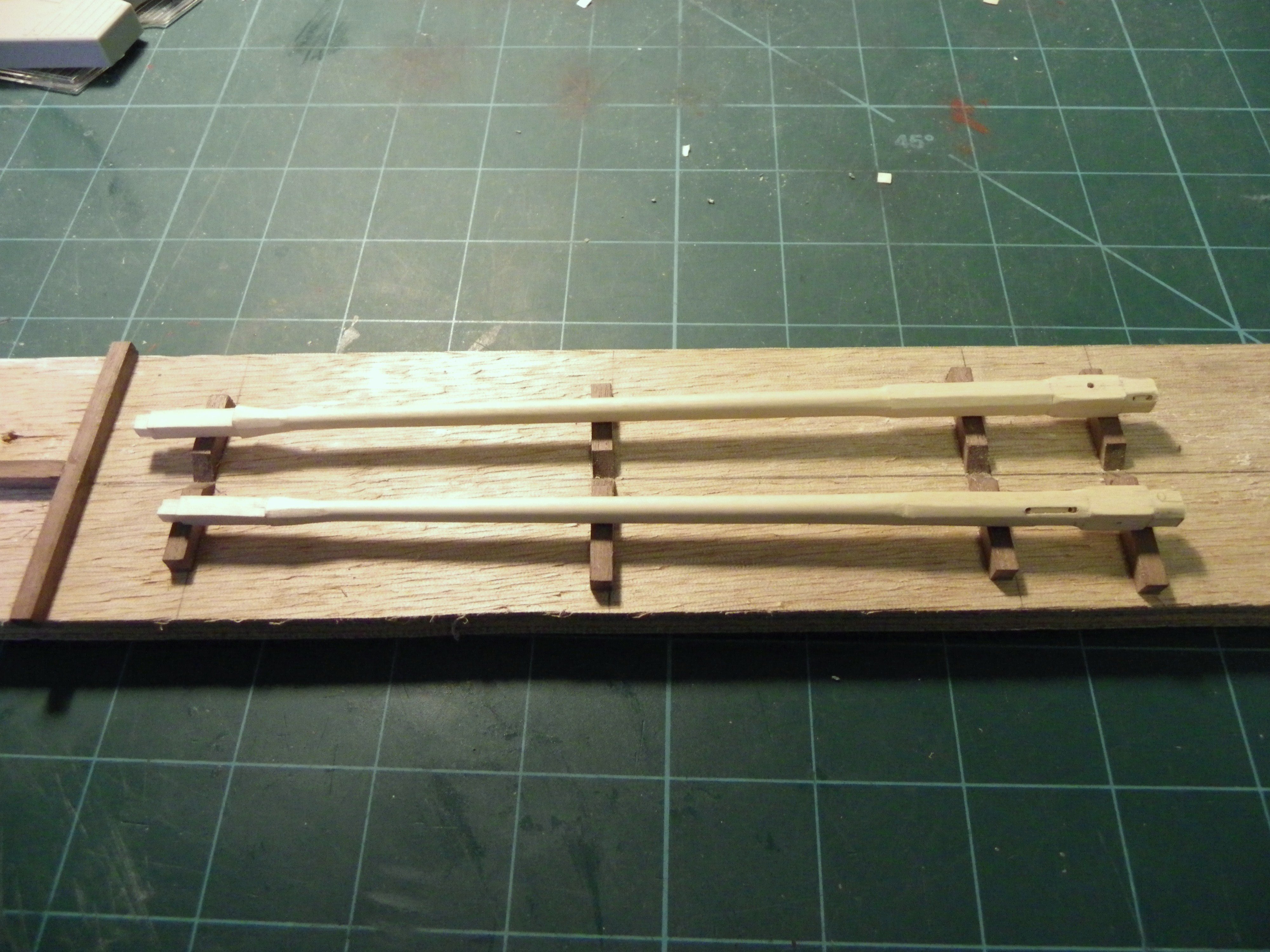

I have spent a couple of days looking at the two booms I will include with my model.
An interesting use of terminology here.
What we may generically know as Driver Booms are referred to by Steel as Main Booms in relation to cutters and Sloops.
Again, there are defined proportions relating to Driver/Main Booms.
The Steel tables indicate subtle differences in the taper arrangements between  Driver booms and Main Booms, mainly in relation to the position of the widest diameter, but the differences at  1:64 scale are minimal.
Driver Booms – largest diameter – mid point along the boom
Main Booms  -   largest diameter - Position of the sheet – just inside the Tafferal.
The  sizes of booms is confusing, it must be tricky to decide what to apply to the Harpy Kit.
Unfortunately Steel doesn’t have tables relative to Brig Sloops.
The kit Main Boom seems to be based on a 200 ton Brig with a Boom diameter of 10½” – 4mm at scale.
Harpy is a 316 ton vessel, yet a Sloop of 300 tons has a Boom diameter of only 7⅜”-  3mm at scale.
There are also defined proportions set out in Steel for Gaffs
Length of Gaffs 5/8 of respective booms, diameter of Gaffs -same as booms.
The kit seems to follow these proportions.
4529a

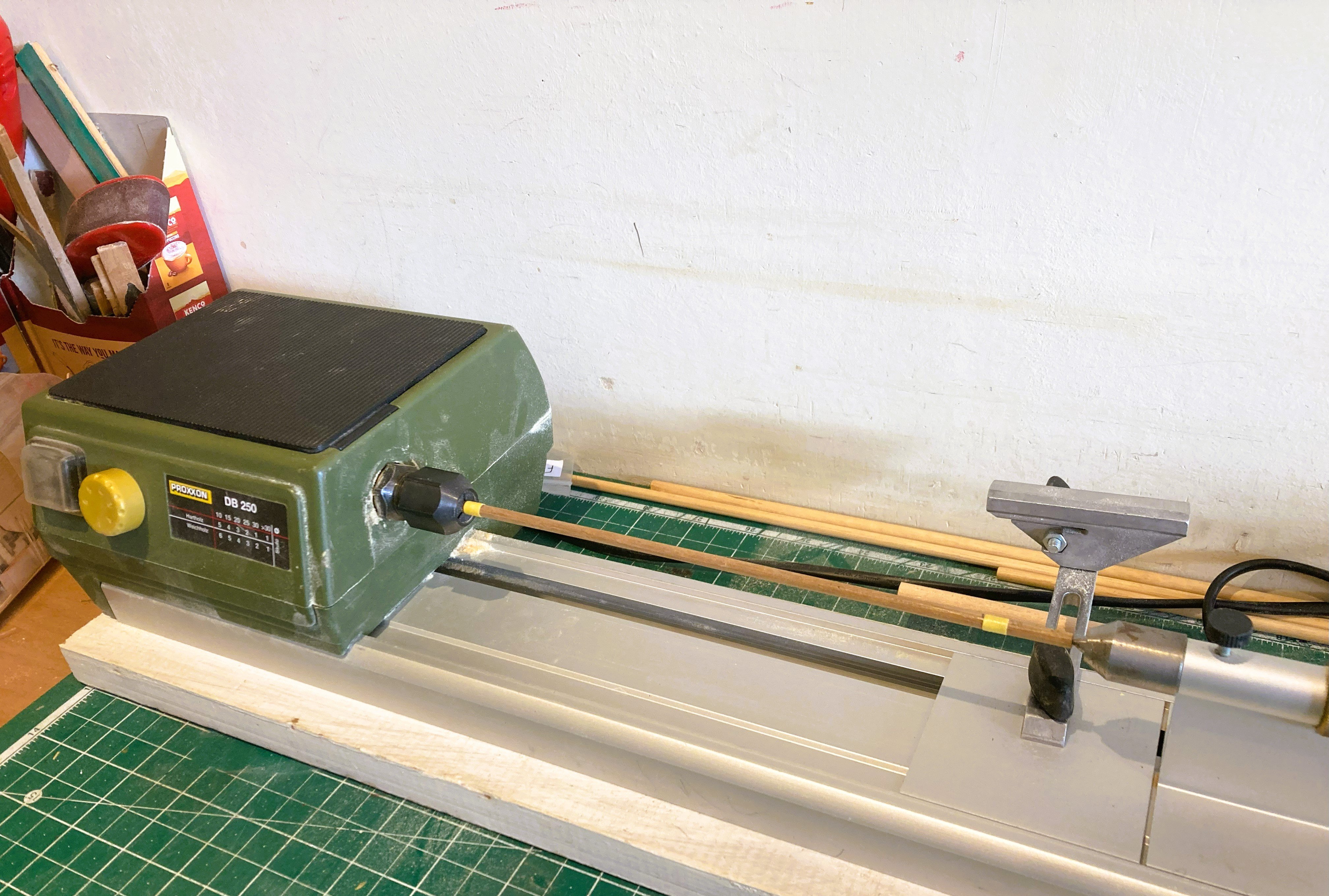

Both booms were shaped on the lathe using sanding papers.
4540a
4542a
I note that the boom jaws lack iron bands which were common for these items.
I used heat shrink tubing for the purpose, but black card would suffice.

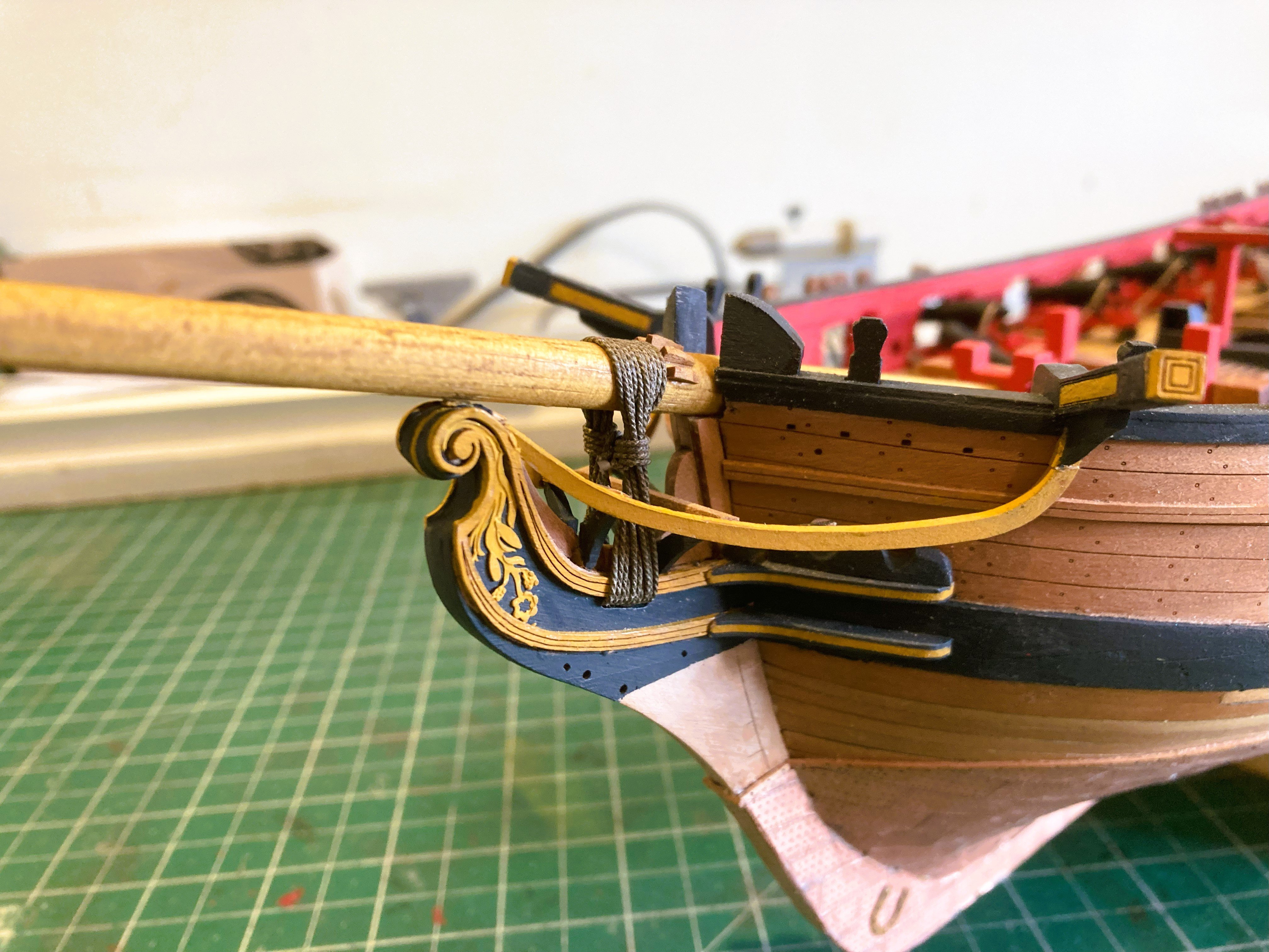

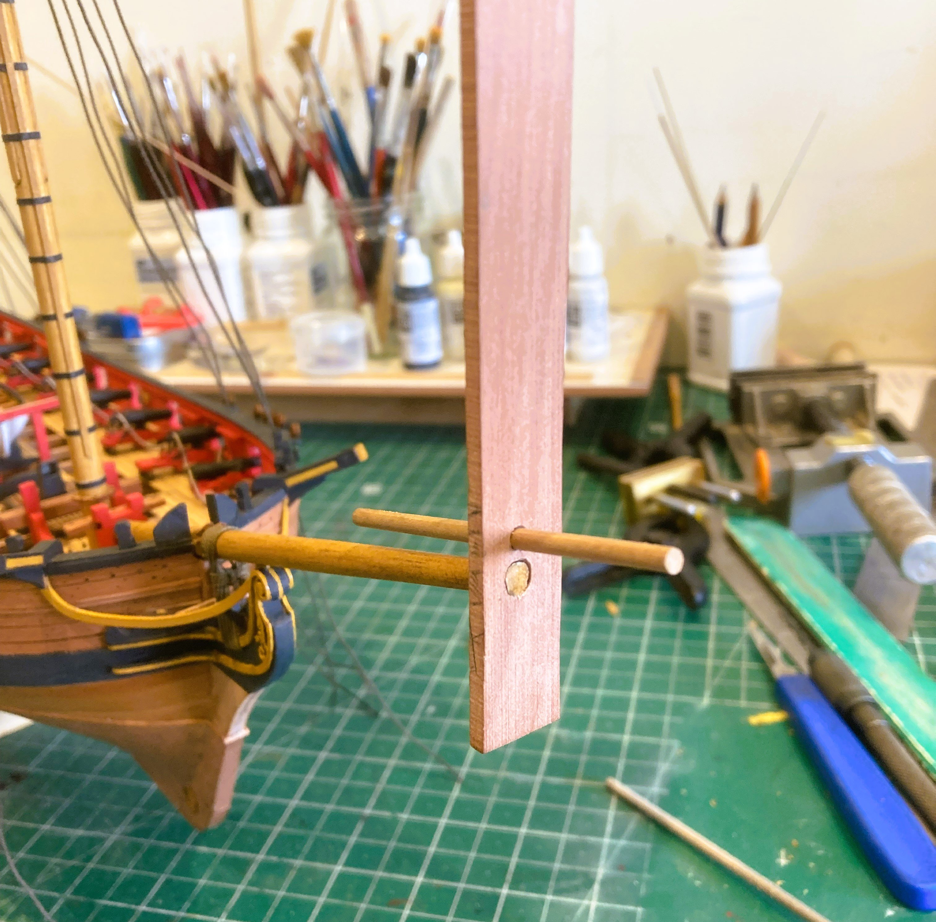

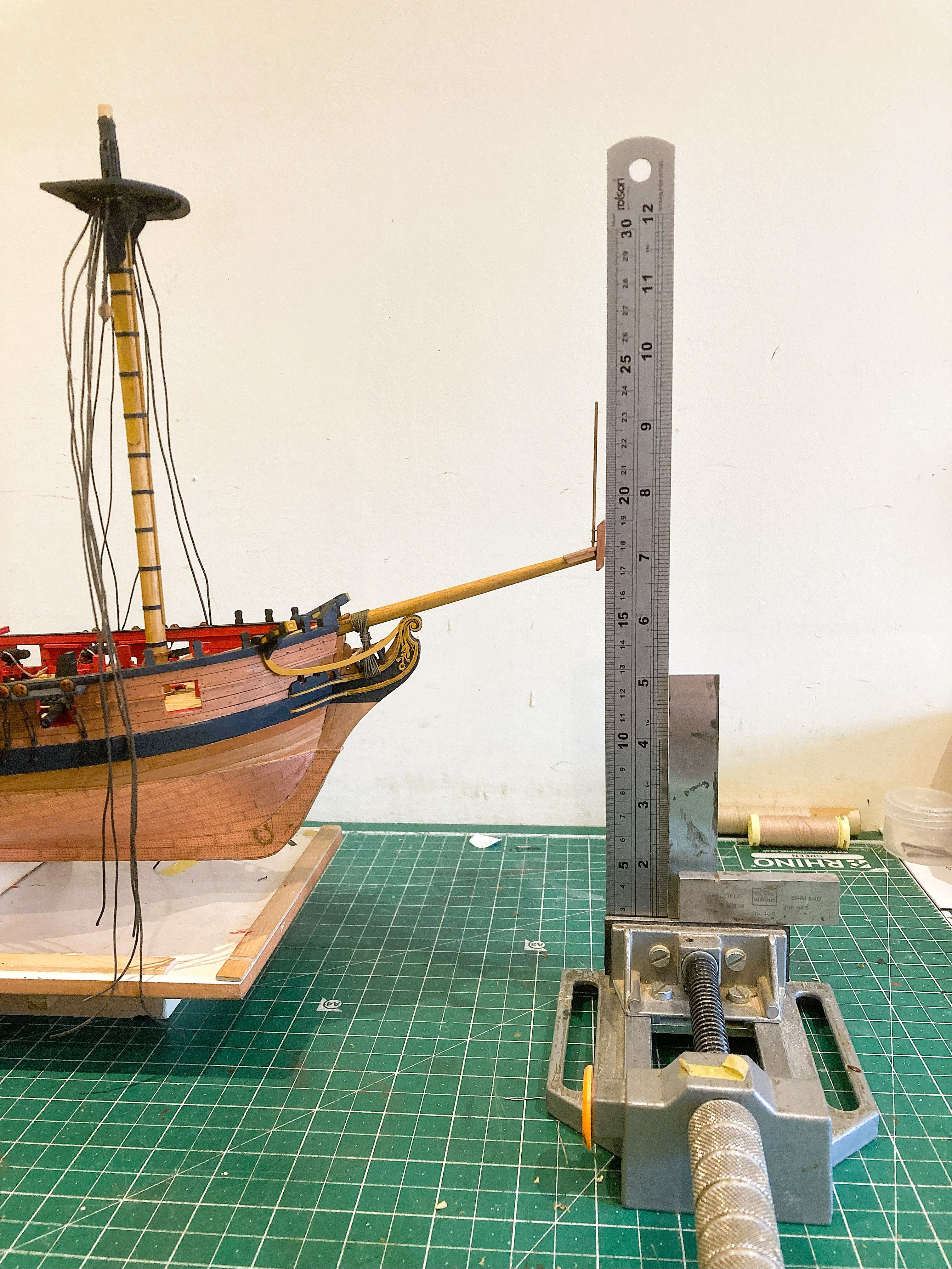

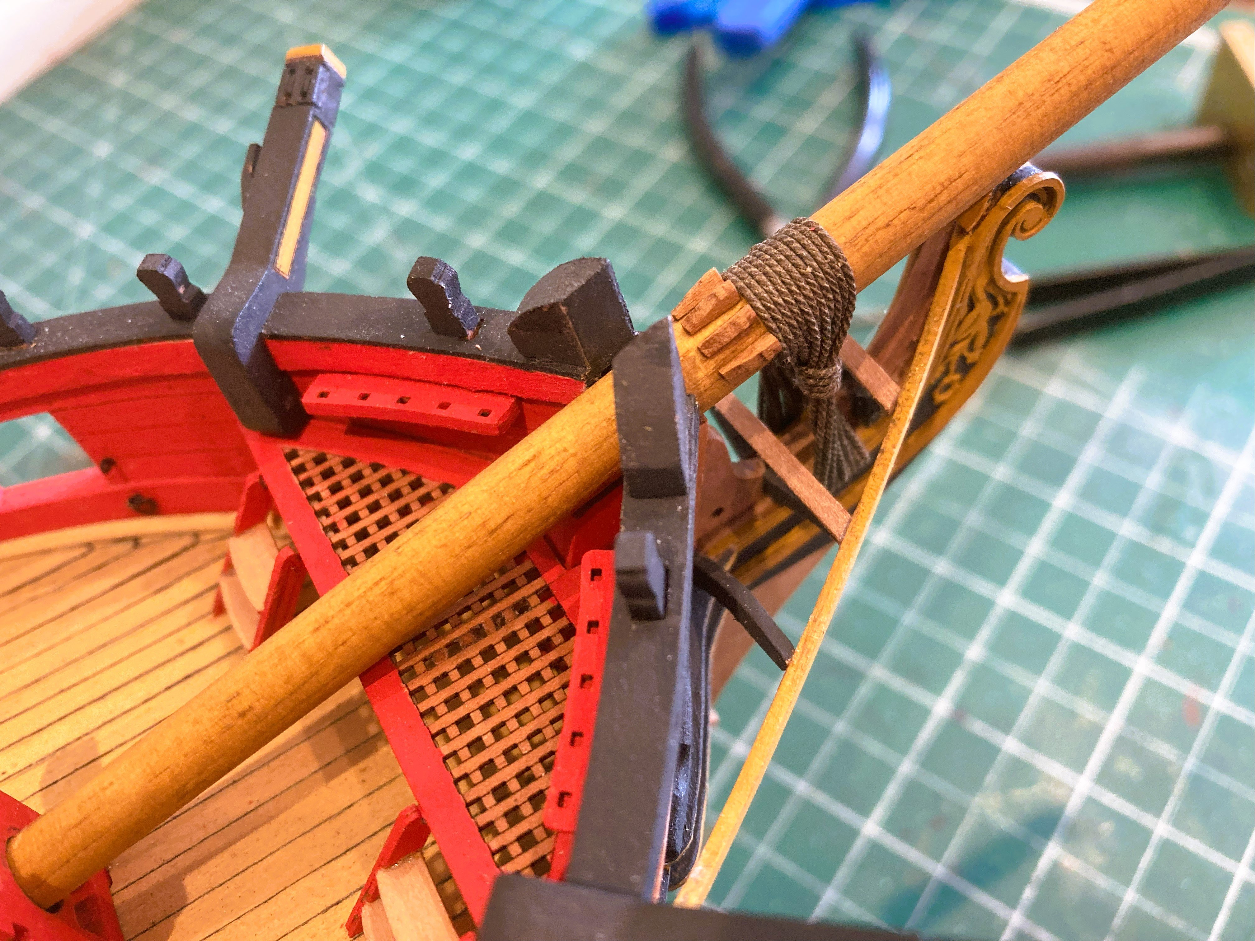

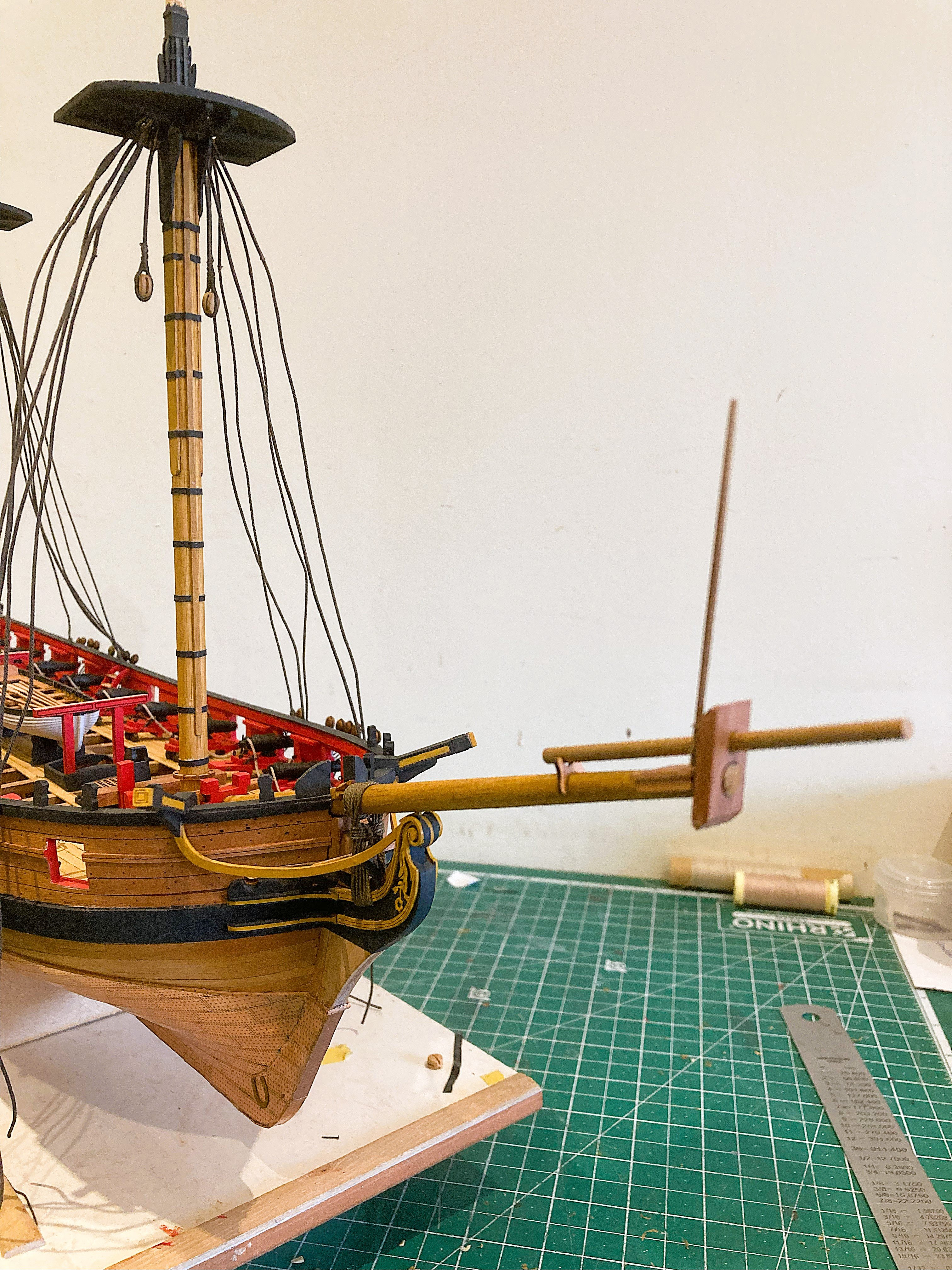

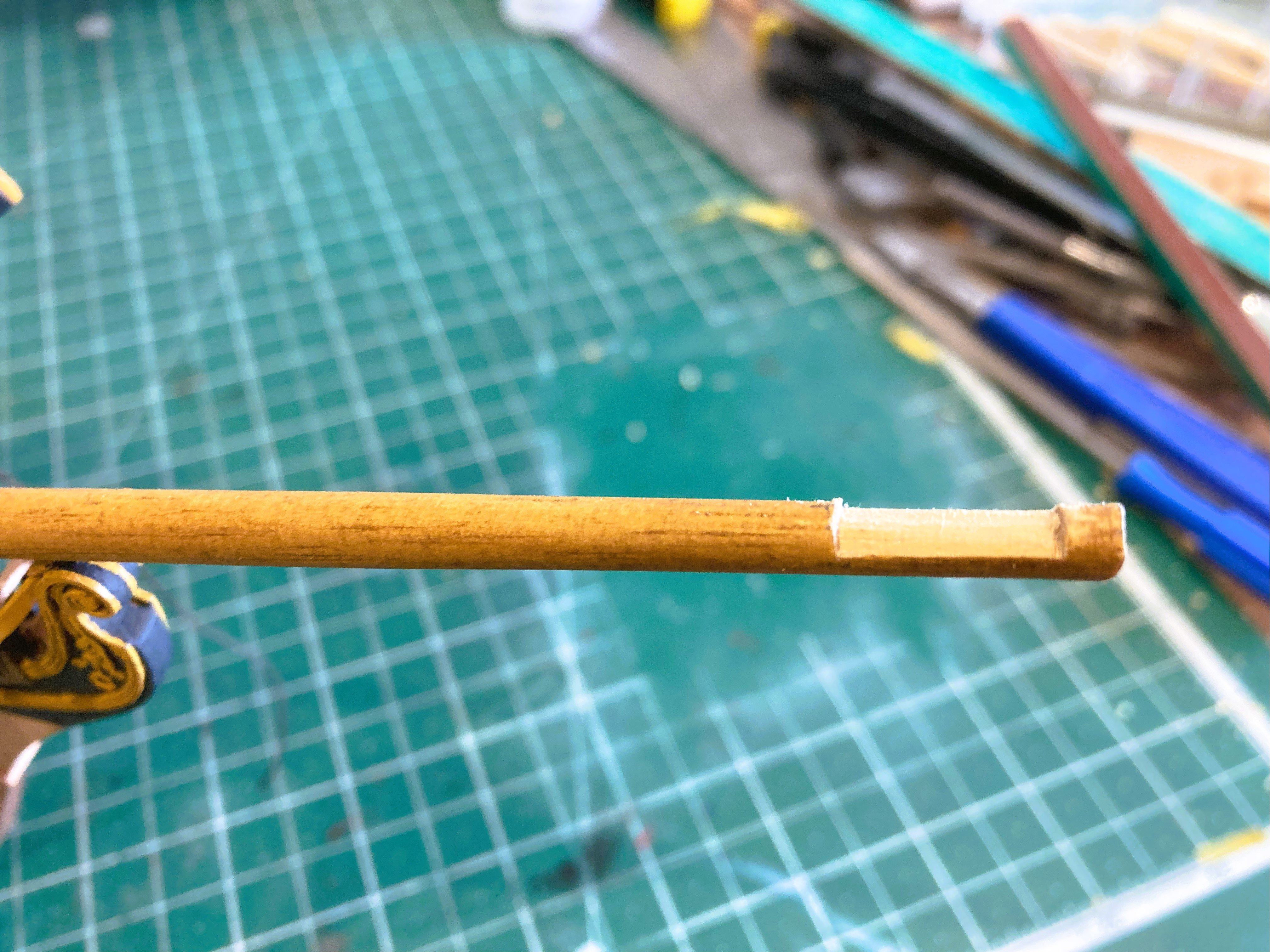

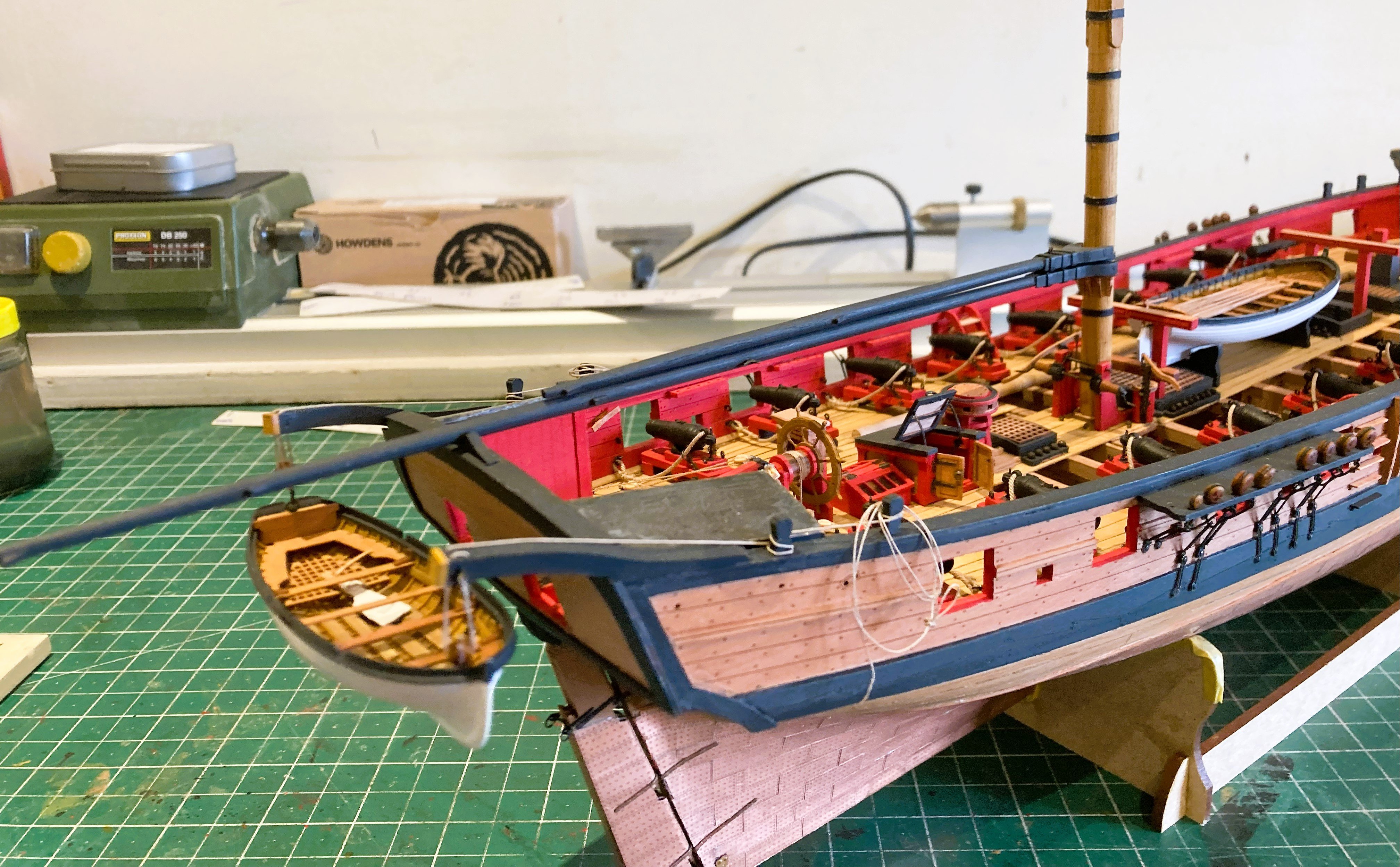

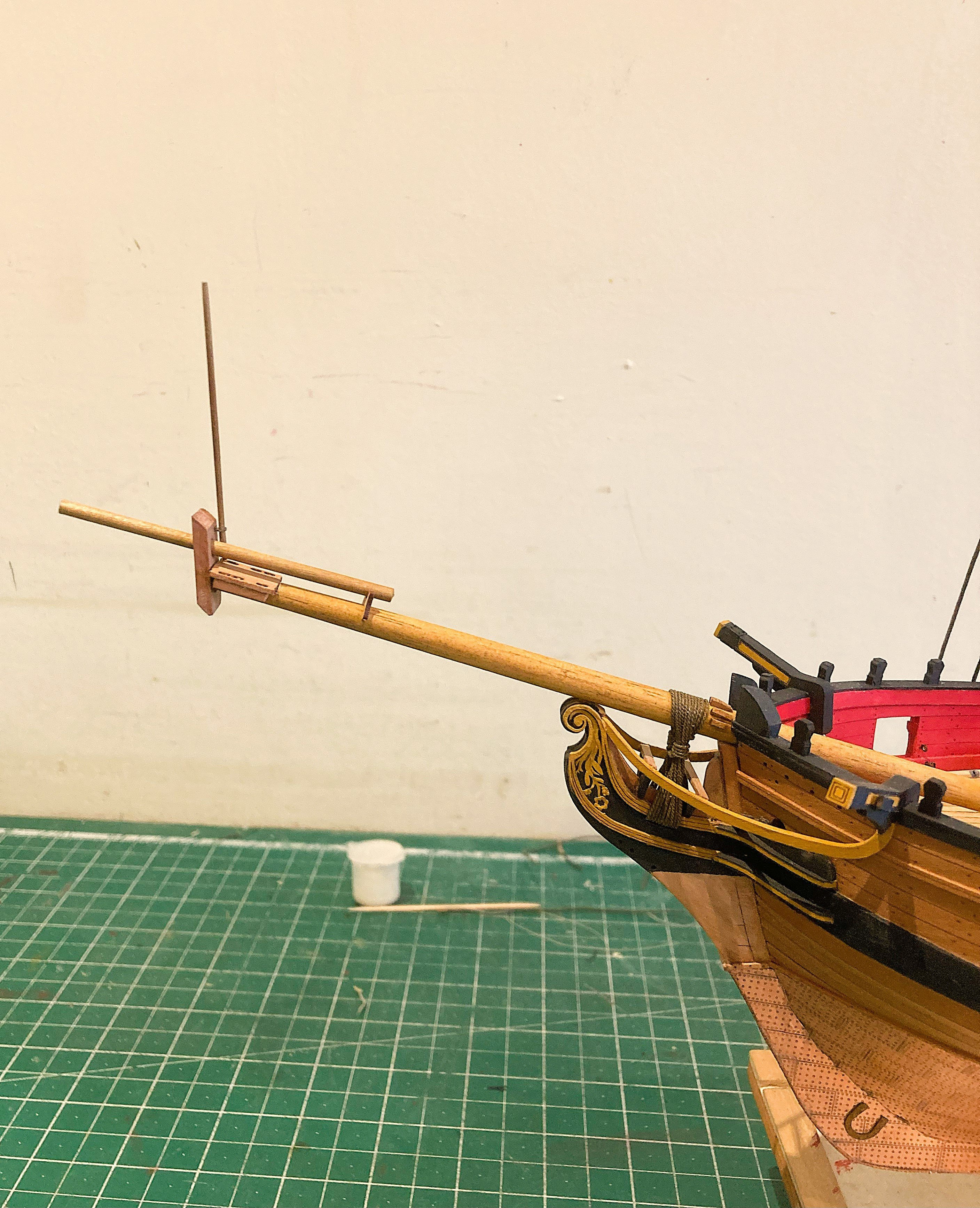

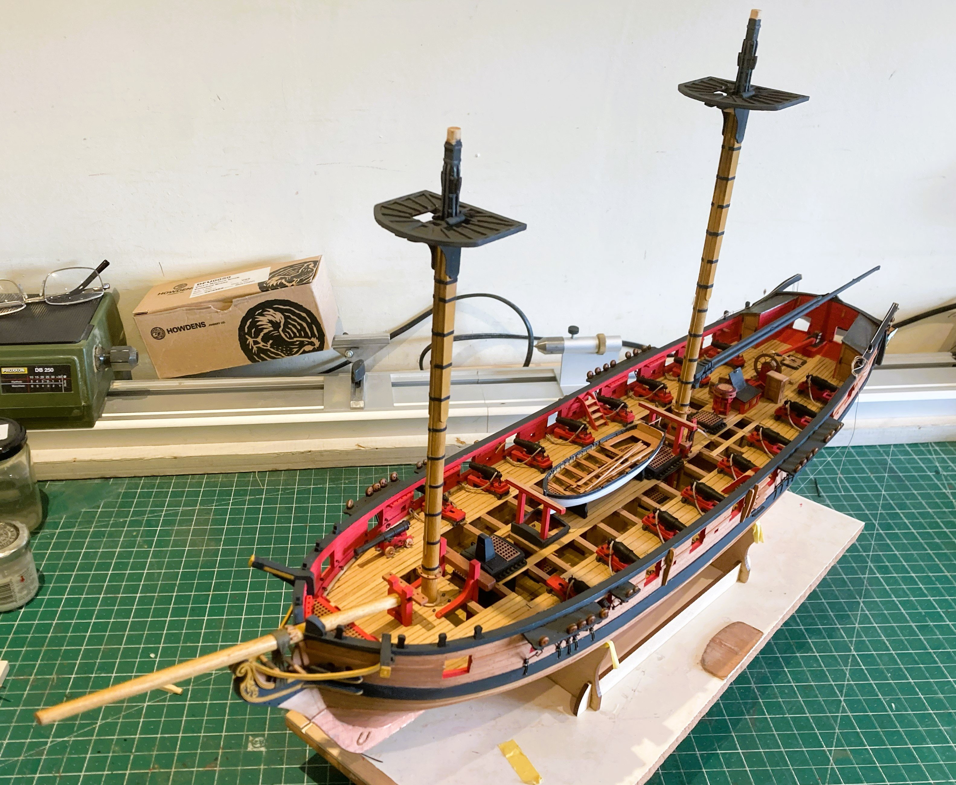

Bowsprit

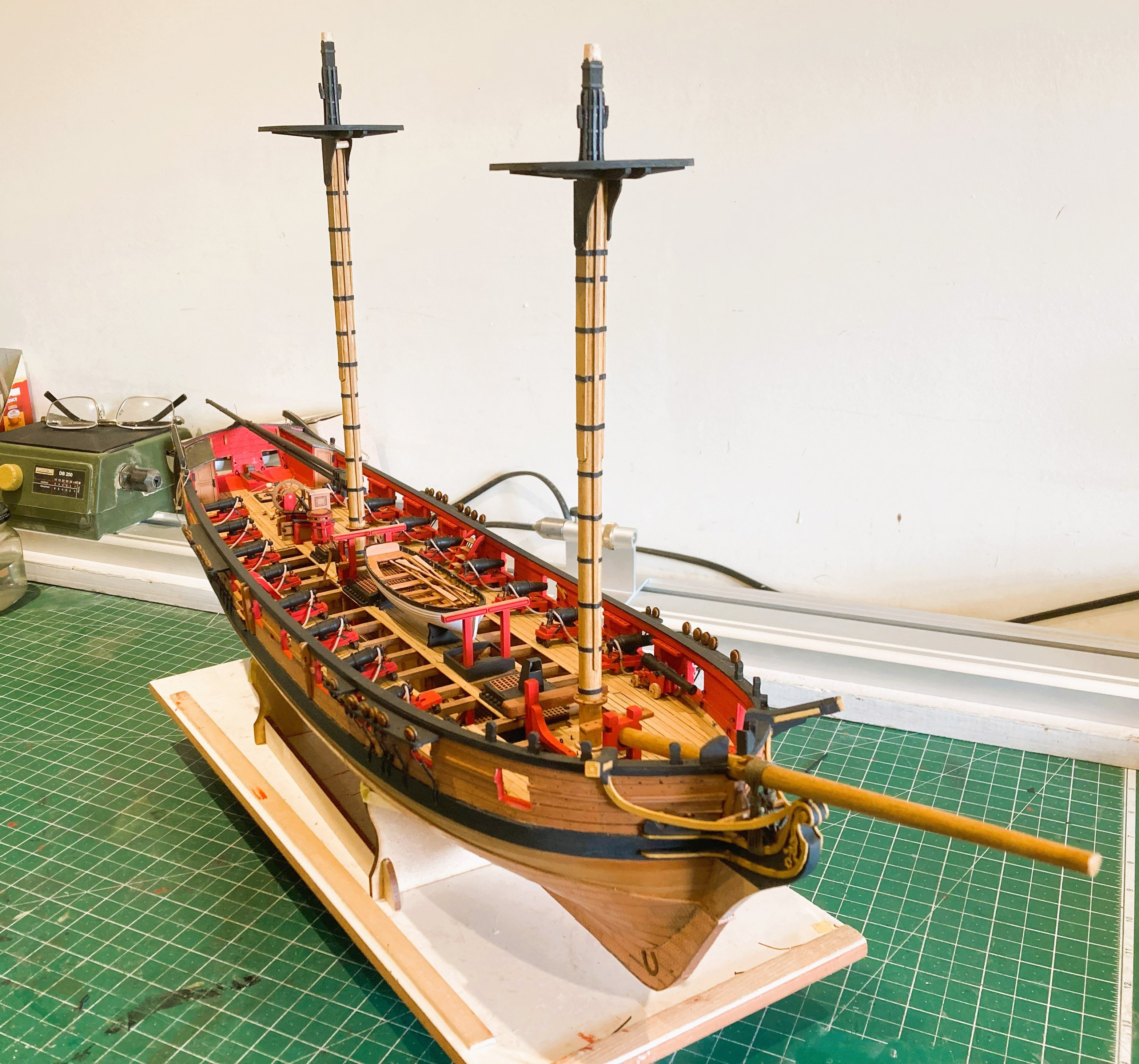

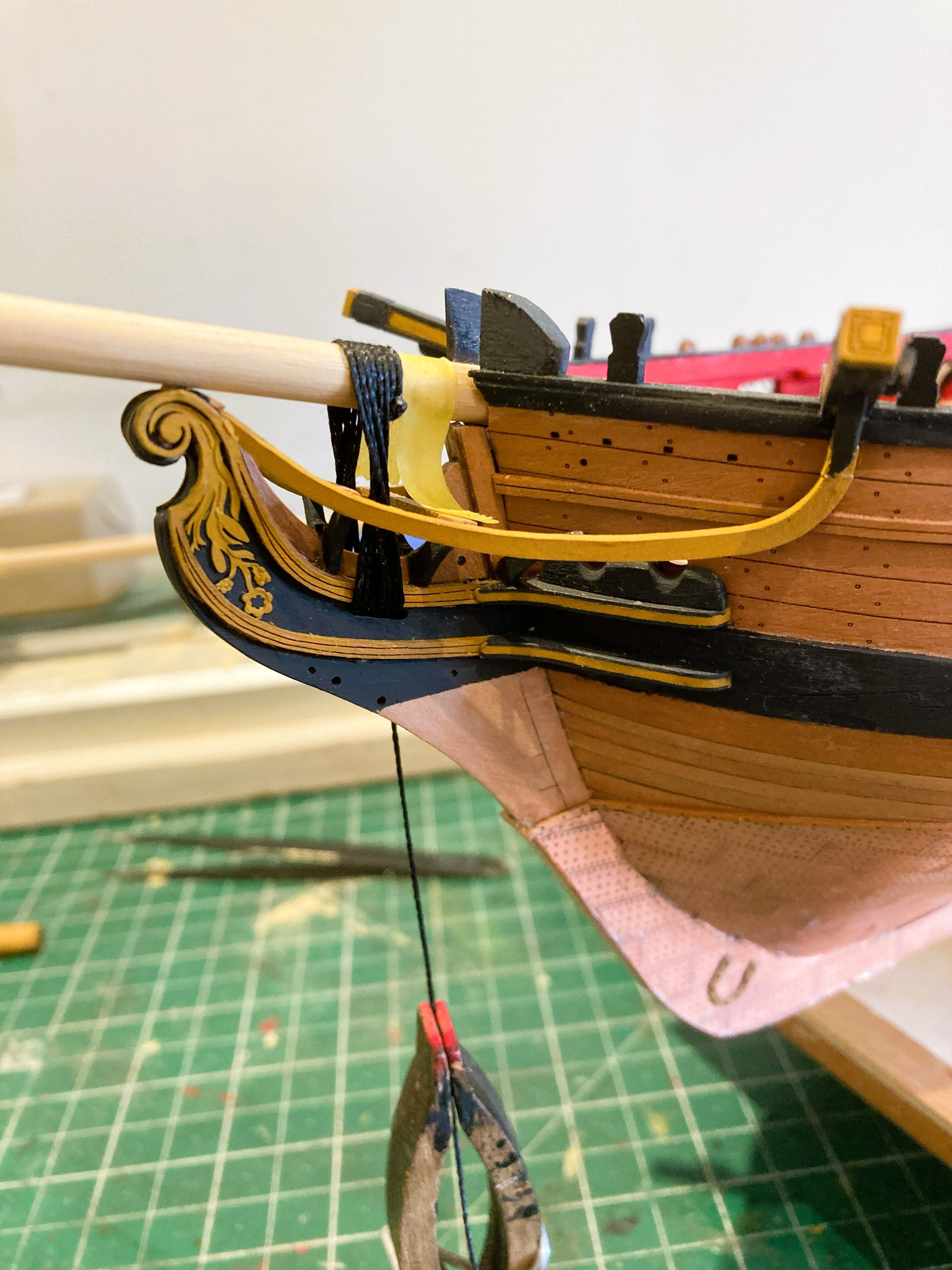

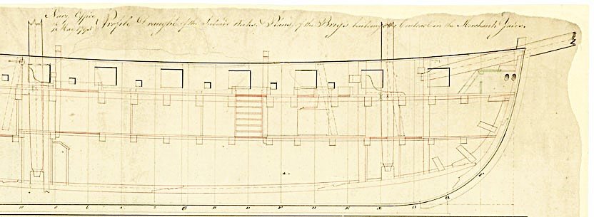

My eye had been drawn to the Bowsprit as looking a little underweight compared to the Mainmast. My understanding is that Bowsprits are generally the same diameter as the Mainmast (at the Partners).
The Adm plan does seem to show the Bowsprit diameter as being comparable to the Mainmast.
As you may expect there are rules, and for Bowsprits of a given gross diameter  a proportional taper is applied at  each quarter along the length to the outer end, and inboard to the heel.
Heel   1stQ      2ndQ     3RDQ   Outer end.
 6/7   60/61    11/12     4/5        5/9
Long story short, having compared information from Steel I decided to use a 8mm dowel reduced to 7mm+ on the lathe, before the proportions were applied.
Between the Head Timbers (Knightheads) I had to accept a degree of compromise, settling for a diameter of 6.6mm. This also involved a little sanding of the Head timbers to allow passage.
The Bowsprit was tapered to 5.8mm at the step, and 4.7mm at the outer end.

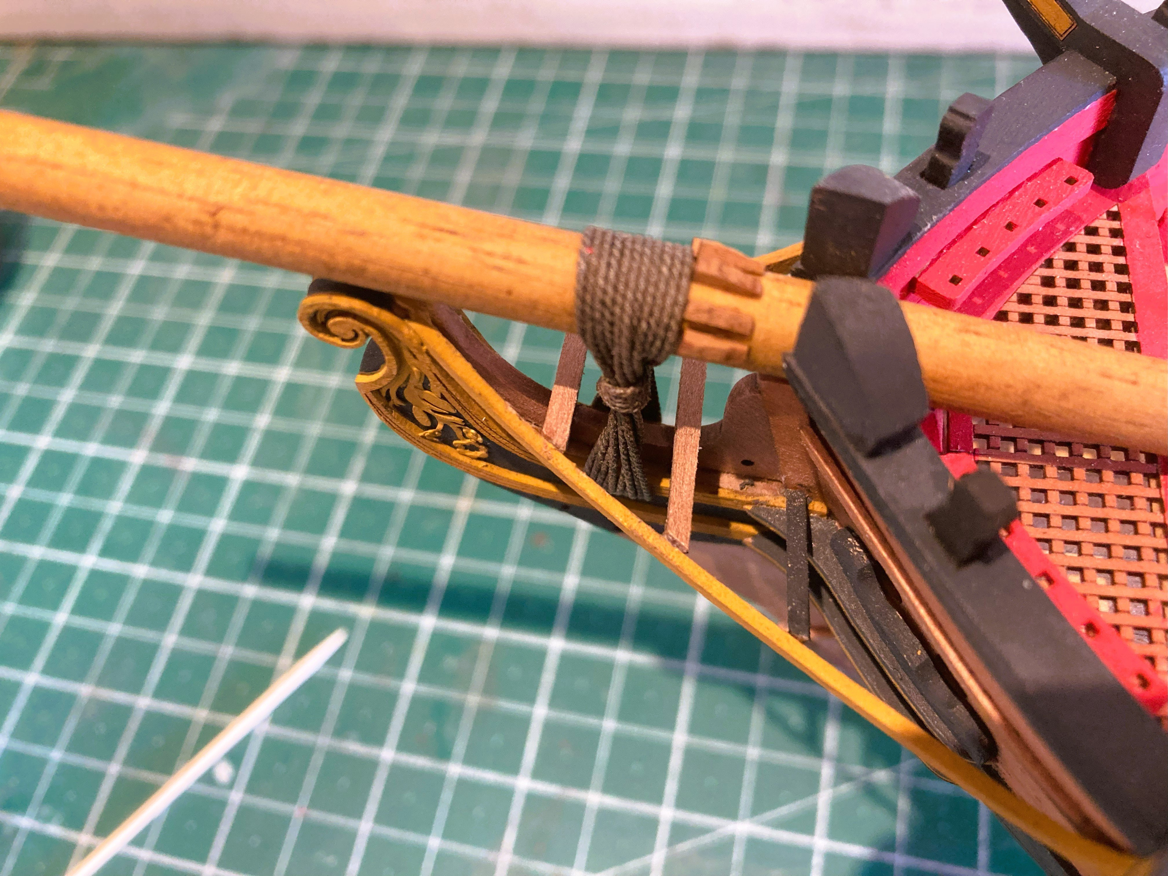

I had initially used a 6mm dowel to check the position of the gammoning cleats.
4503a
A Gammoning test line was applied to mark the position.
4556a

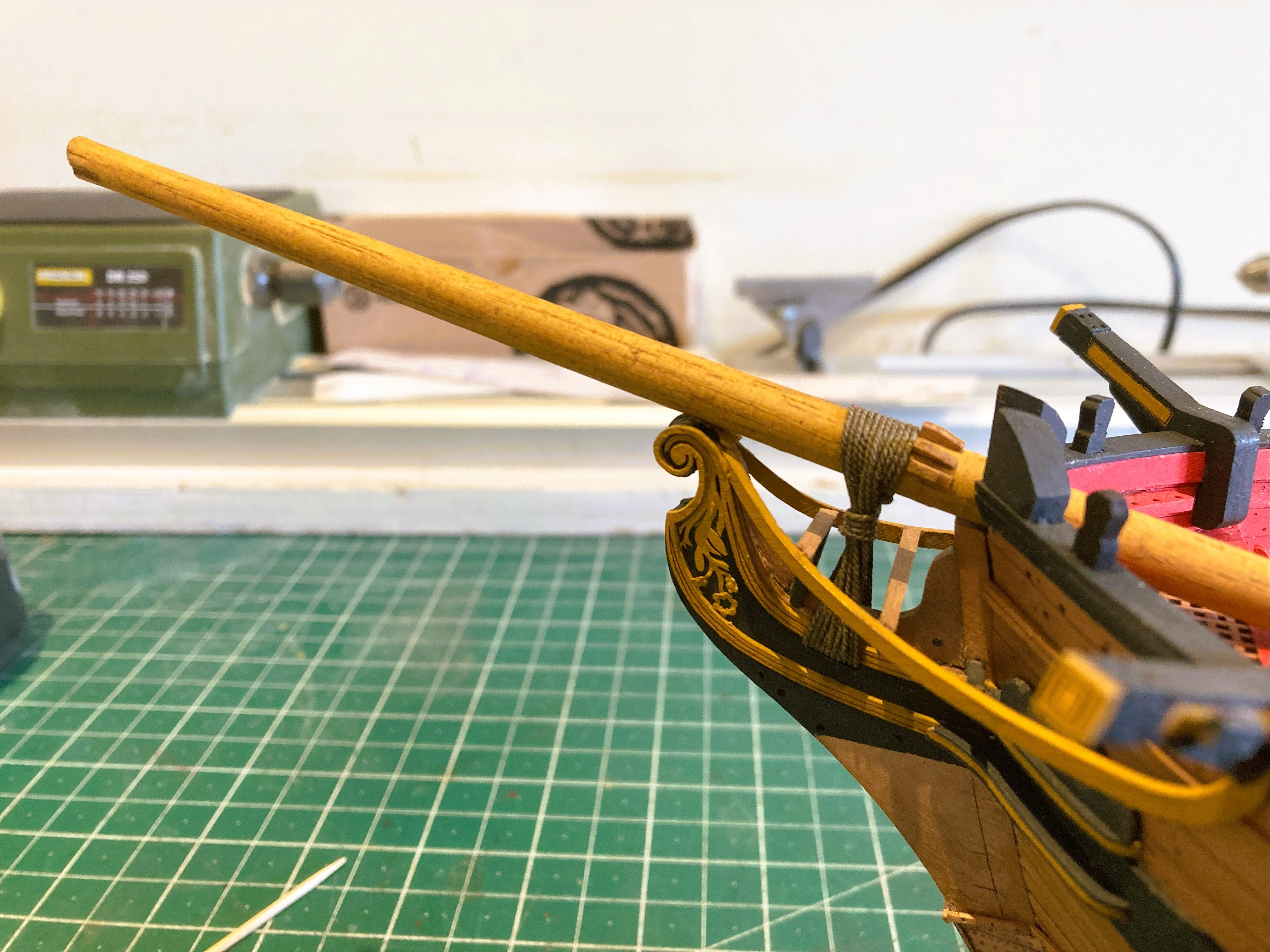

I used Syren 0.63mm ø line for the Gammoning which I dyed using Dark Jacobean wood dye. This is something I do for all standing rigging as  I prefer the look to kit supplied black line.
Note: The Gammoning line has twist in it; Starting on the port side each successive turn  goes over the Bowsprit forward, and crosses the previous line aft as it runs thro’ the gammoning slot. The line is completed with frapping turns around the centre and seized off.
4565a
Gammoning completed on the replacement Bowsprit.
The Gammoning cleats are very small; I found that attaching them to double sided tape was sufficient to hold them for a light cleaning up.
4564a
Ramin dowel was used to make the Bowsprit
I used w-o-p  on the Bowsprit followed by a light oak dye concoction to match the masts.
4558a
I am not quite decided how much more detailing of the Bowsprit I will do, it is there primarily for the attachment of the Fore Stay.
The next stage is completing the mast detail and onto the shroud rigging.
B.E.

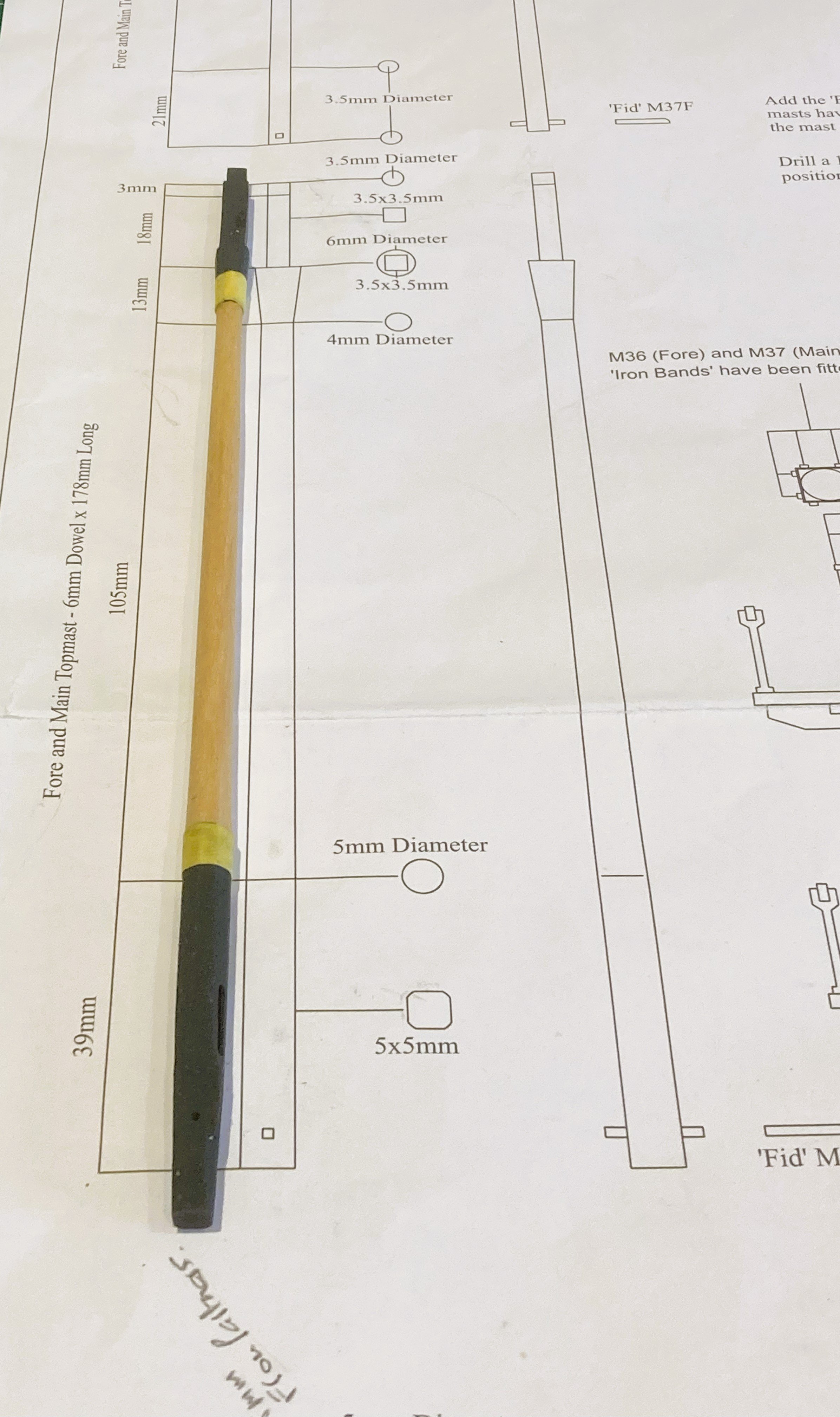

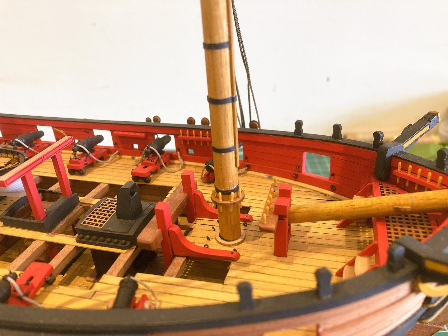

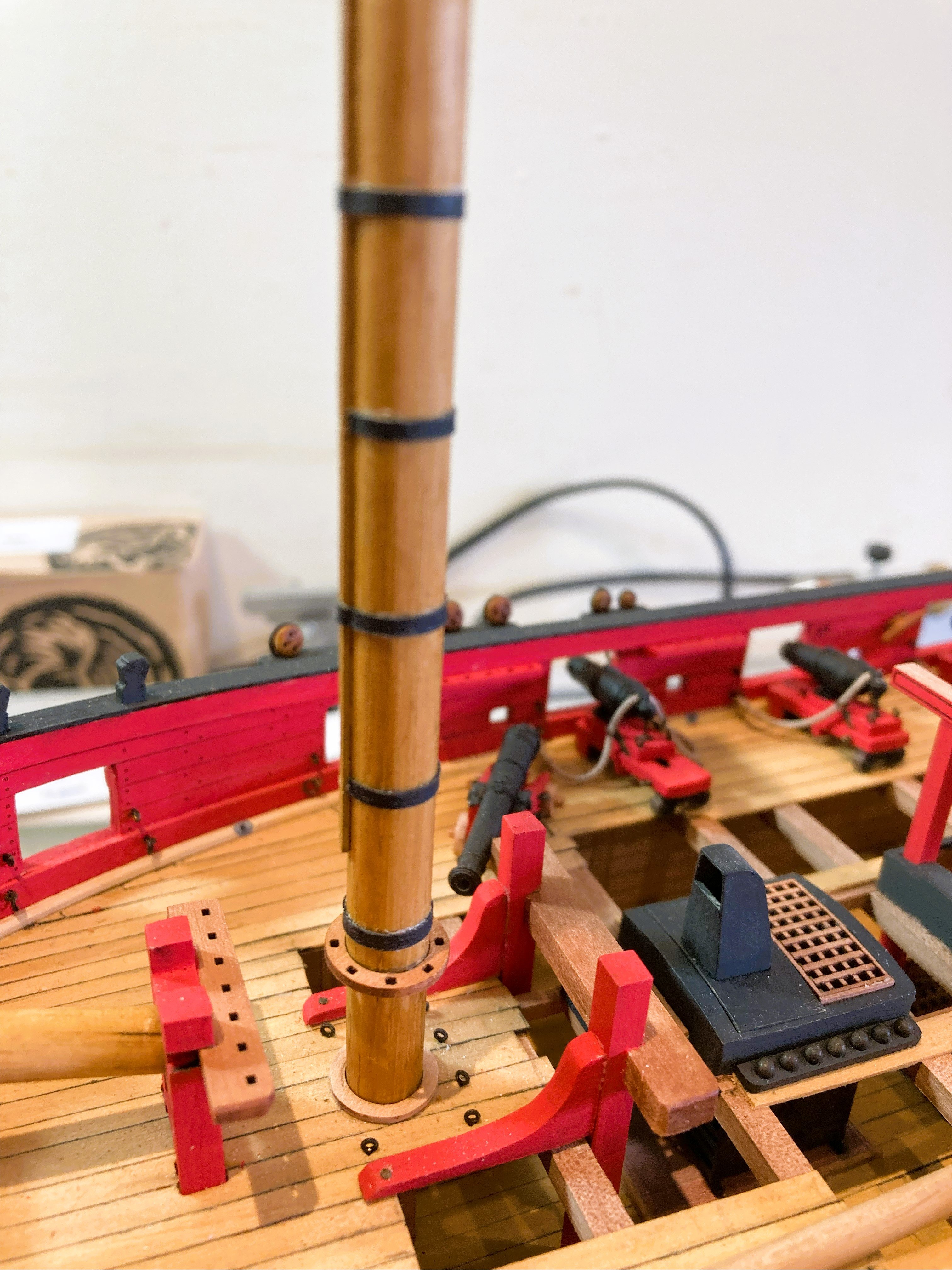

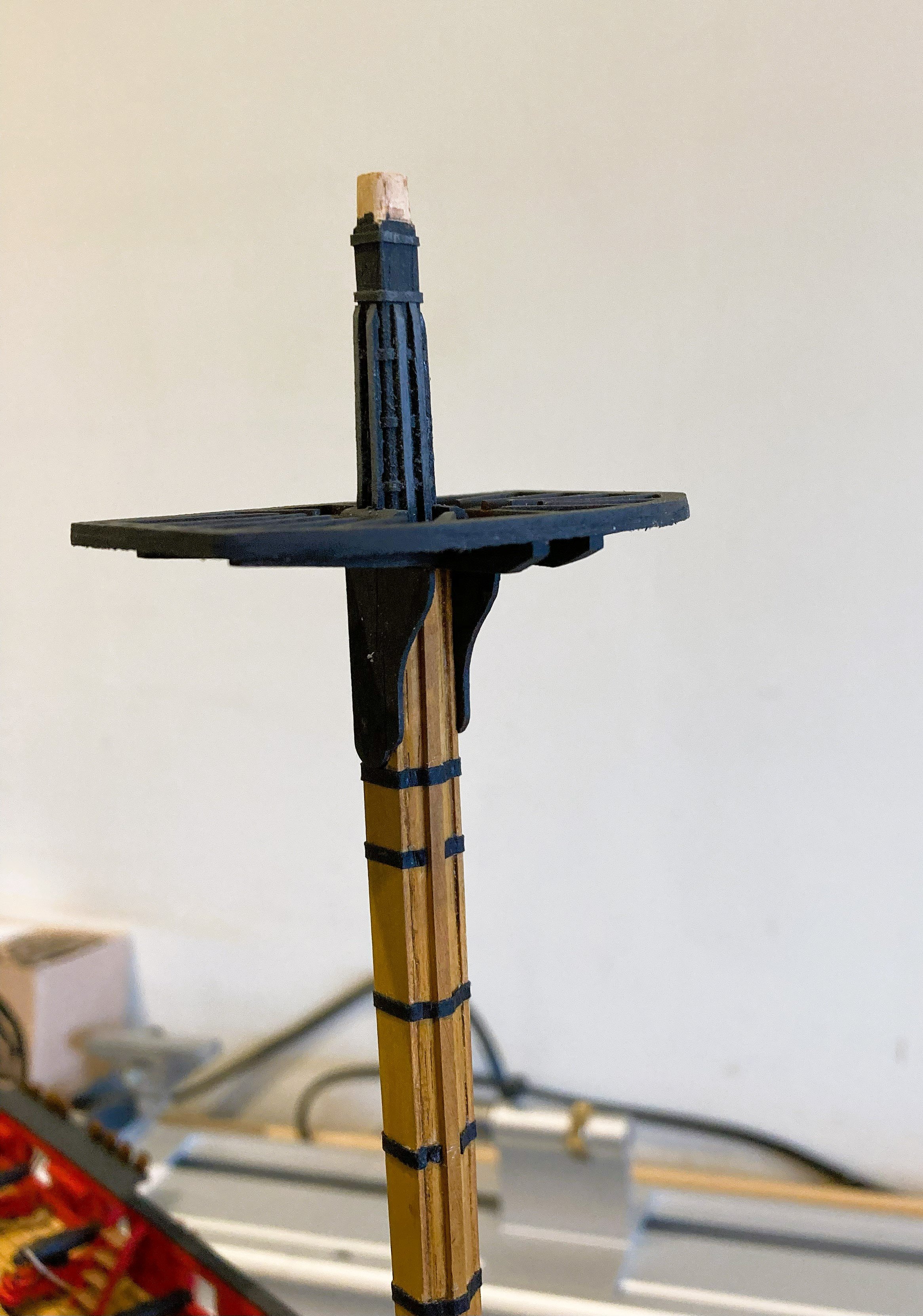

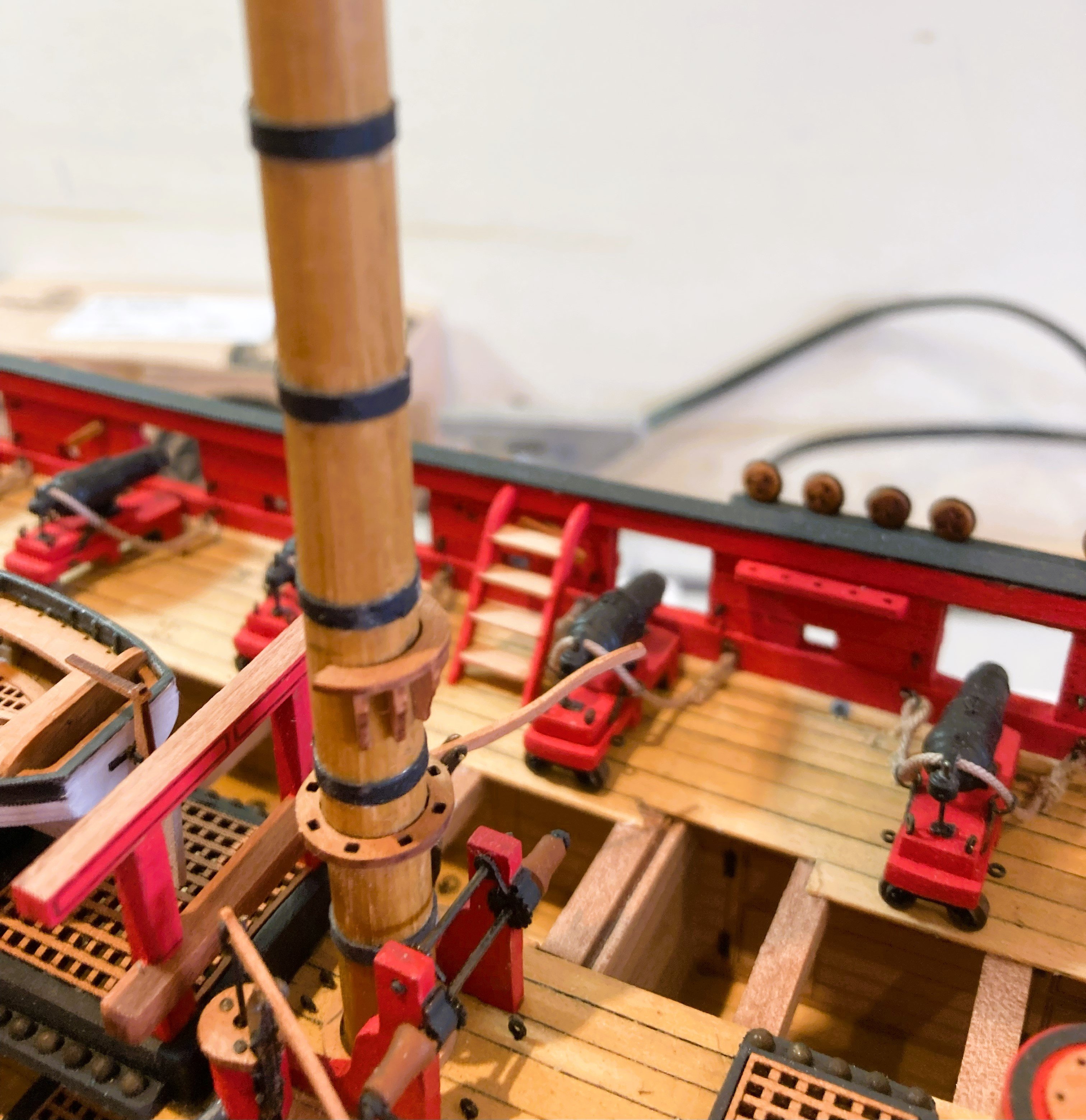

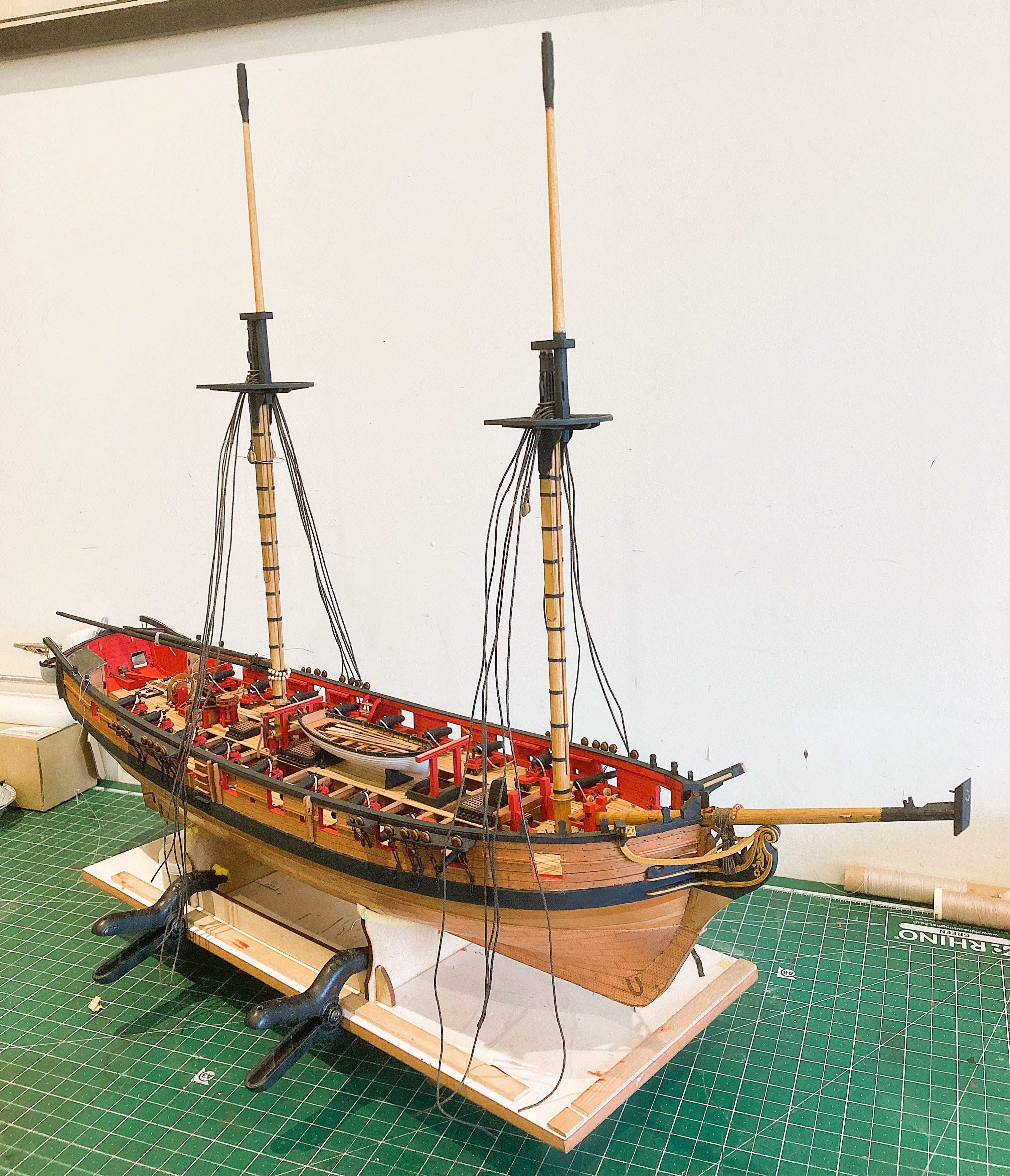

Completing the masts.

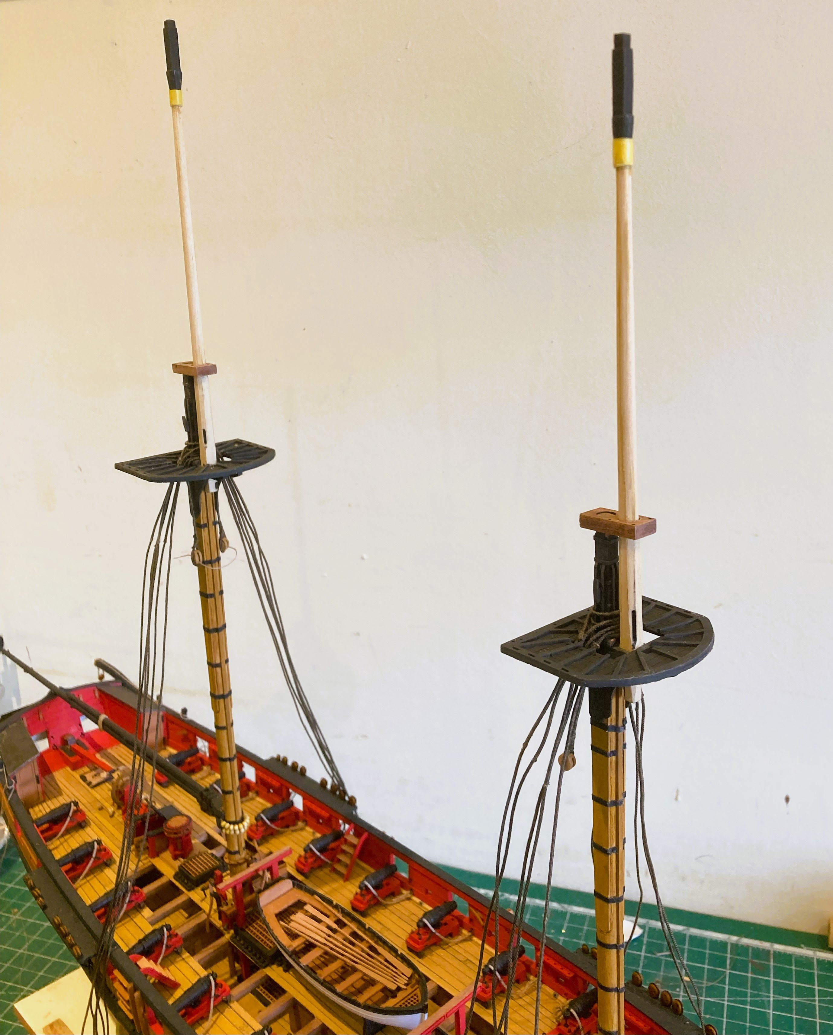

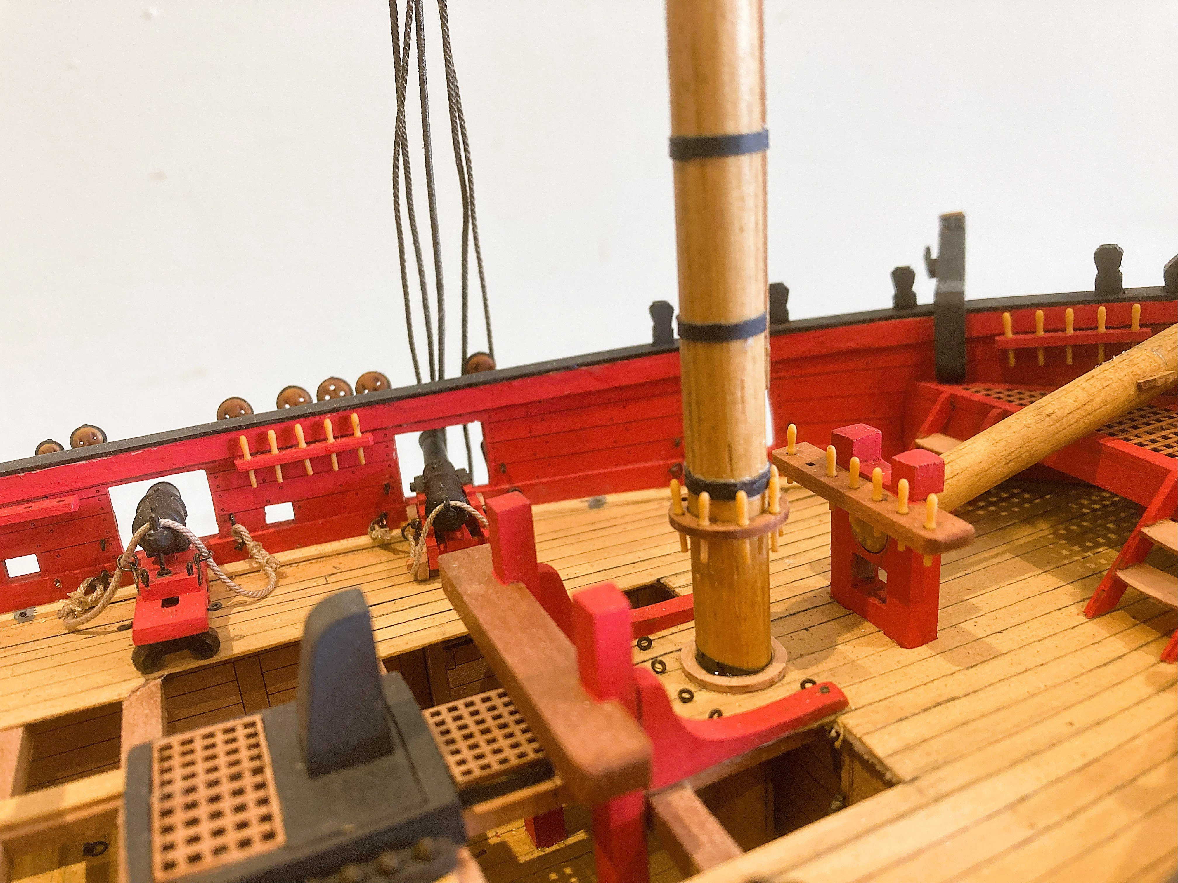

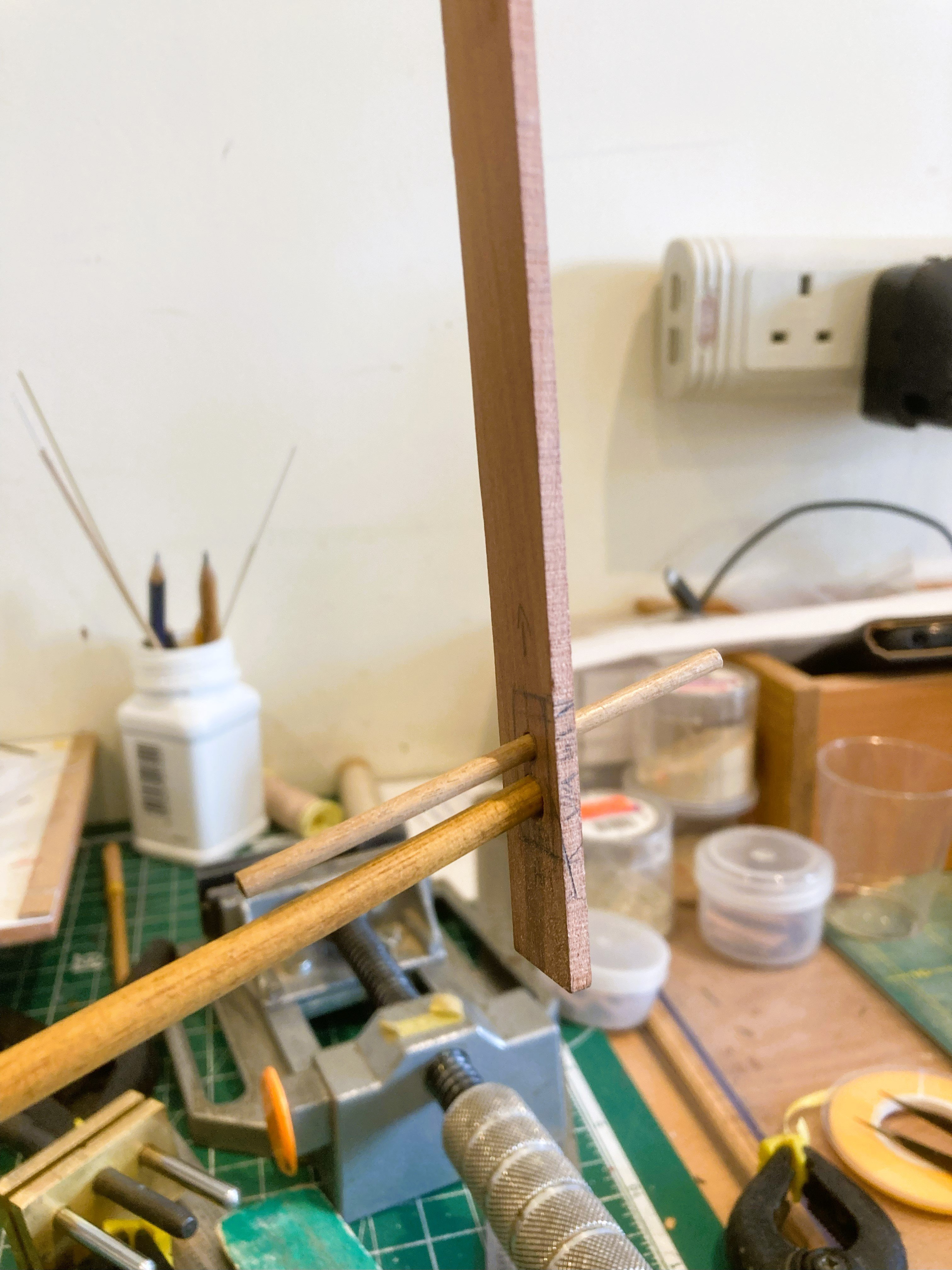

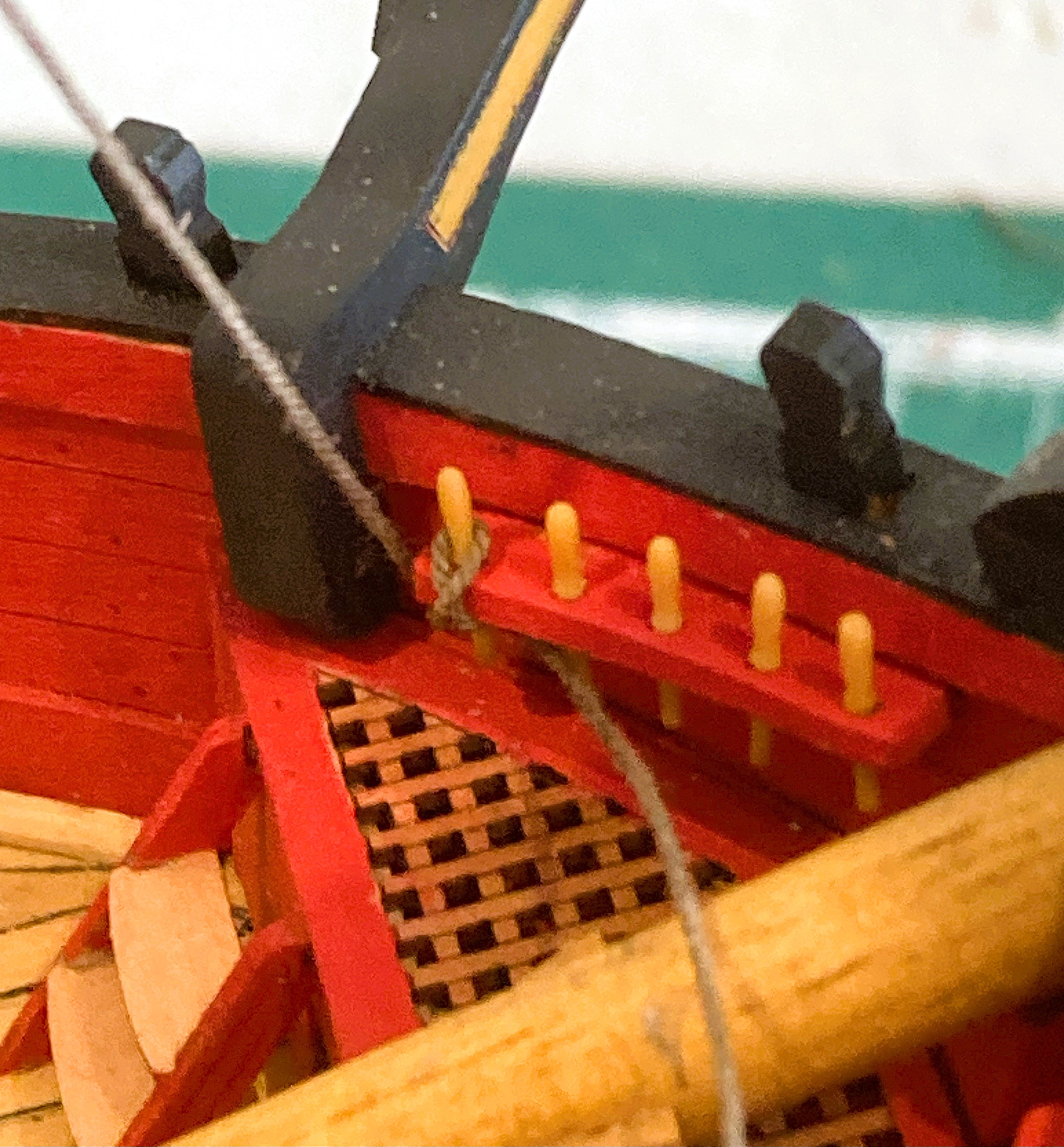

The Pin rails and a driver boom saddle are added to the lower mast sections.
4576a
Fore mast Pin rail, beautifully cut slots for the pins.
4575a
The Pin rail on the Mainmast really needs fitting before adding the lowest  ‘iron’ mast band otherwise it won’t slide up to the correct position.

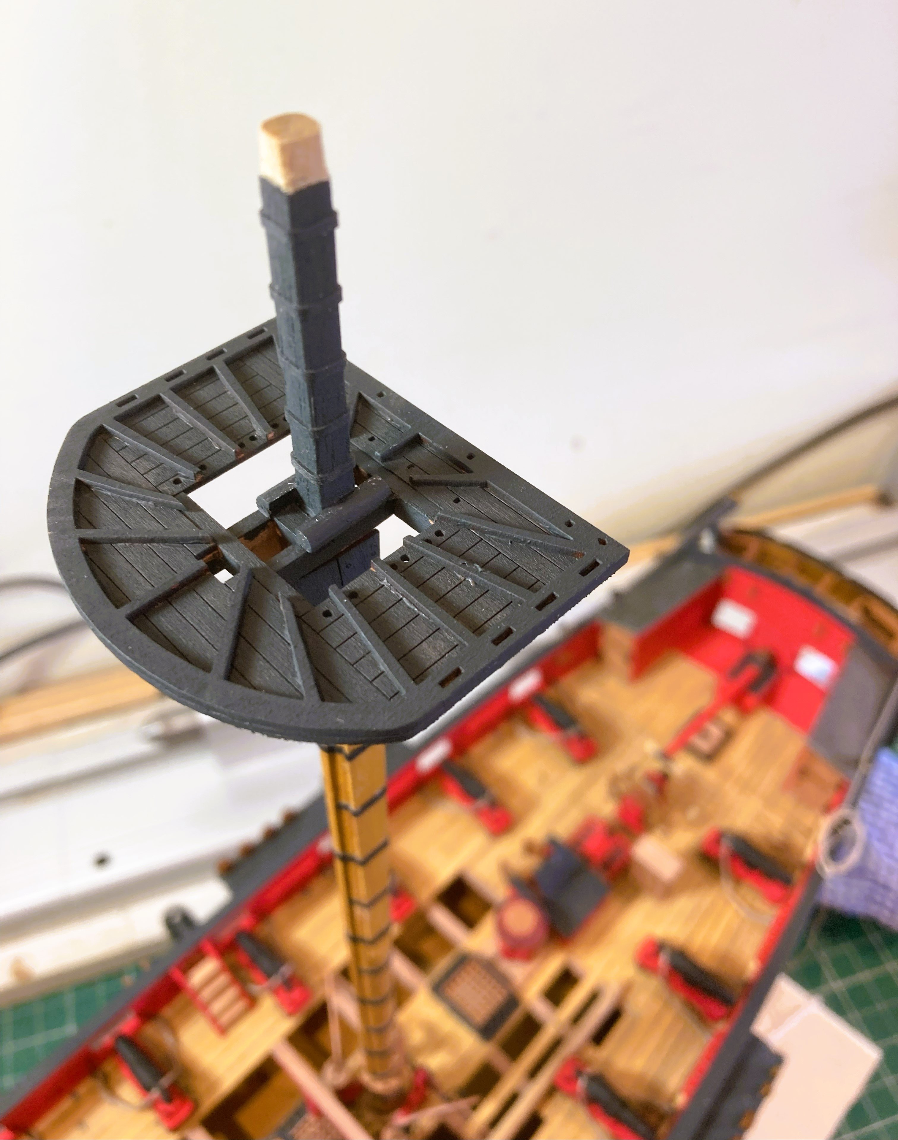

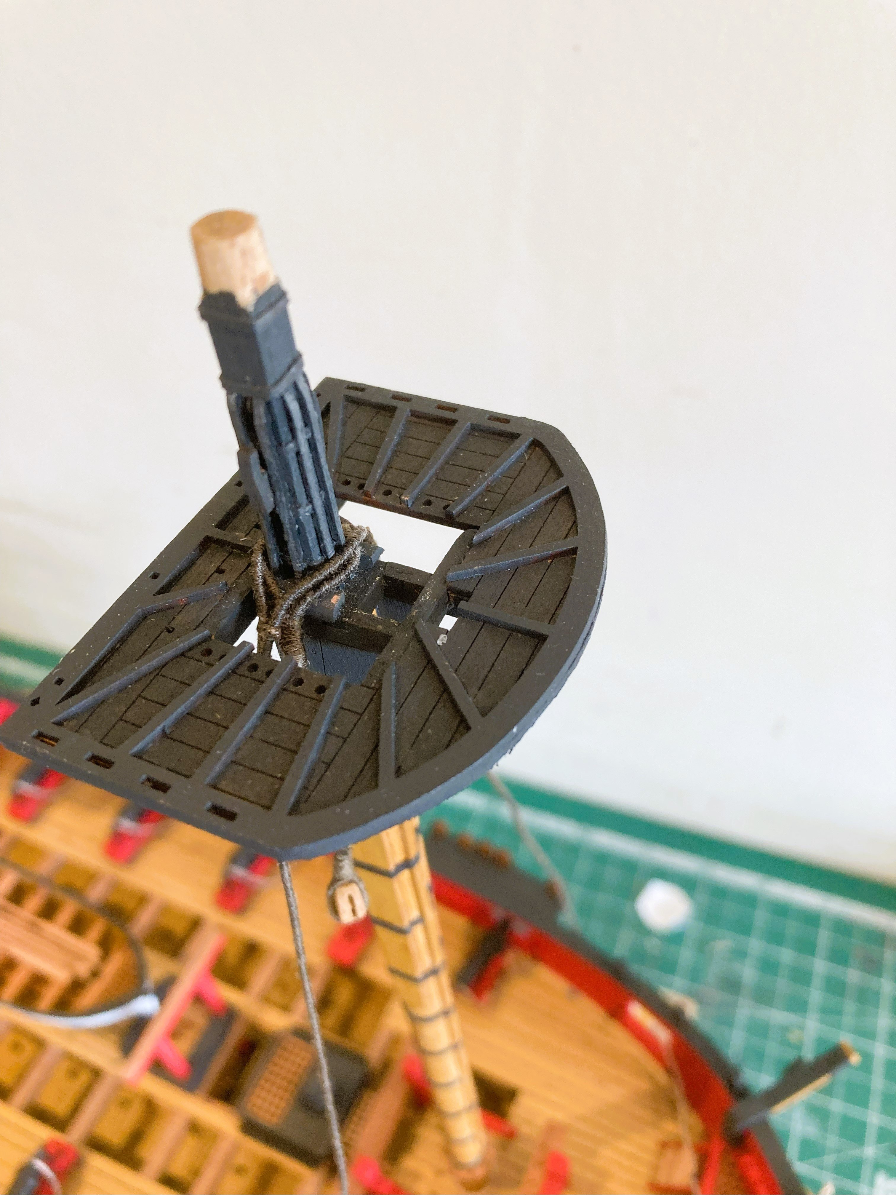

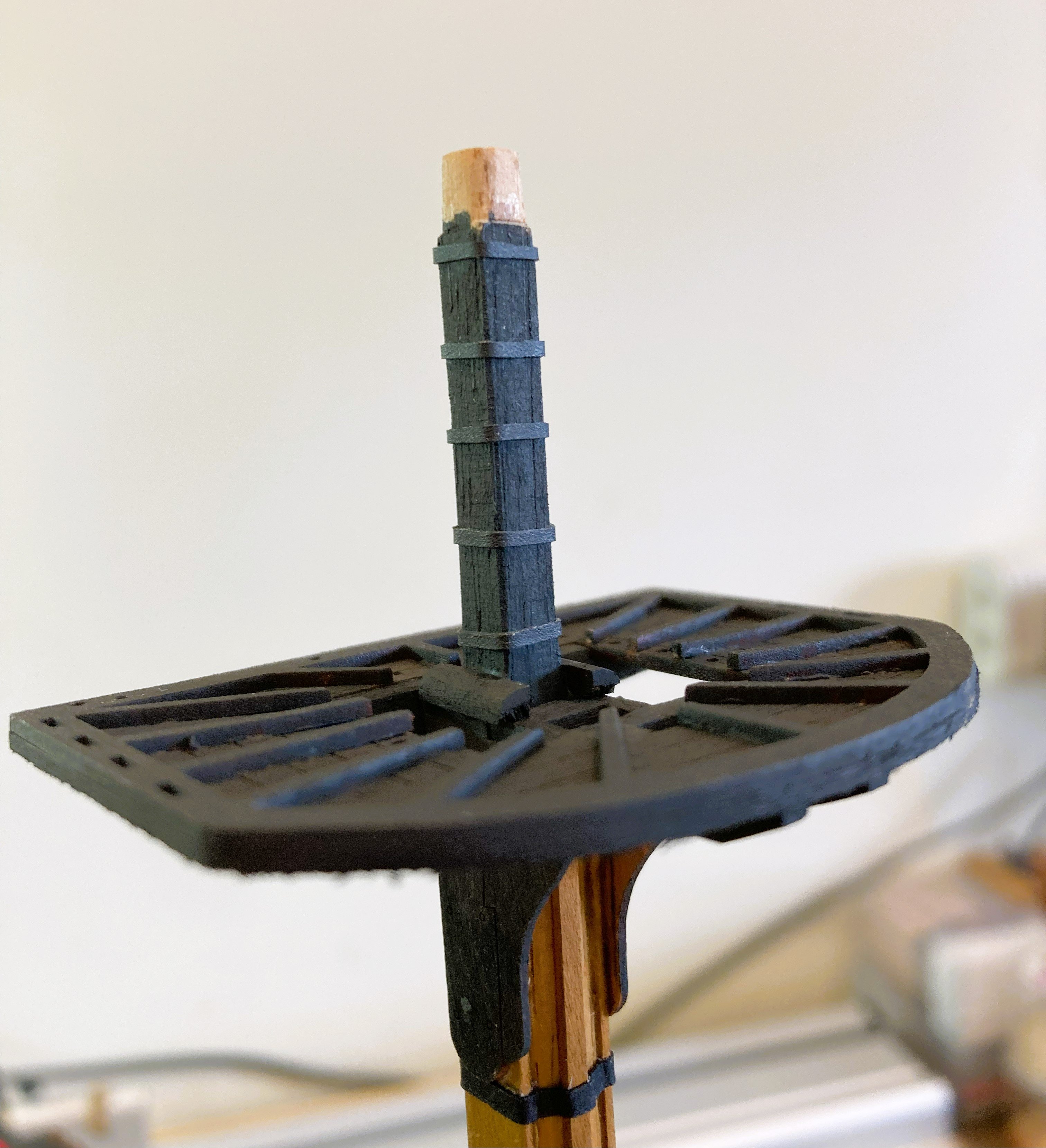

The tops which are traditionally painted black down to the hounds, are now attended to.
I used Vallejo Black/grey for the purpose.
4570a
I love the planking detail Chris has engraved into the tops, I used a slightly thinner mix of paint in this area so as not to obscure the detail.
4579a
There are five iron bands  spaced equally along the Masthead. For these I used 1mm slices from heat shrink tubing. This gives a subtle shade difference to the painted head.
Atop the iron bands are a series of battens designed to protect the rigging from wear.
4581a
Kit provided pieces are of 0.6mm strips which I found a little thin to notch over the bands. I replaced these with some slightly thicker strip which allowed a shallow notch to be cut.
There are eight of these on each masthead; a small detail the top ends should be sniped to follow practice.
Steel also notes that; battens should have rounded edges for the rigging to slide down easily.
4603a
Steel also notes that; The afterside of Mizen masts  in ships, and mainmasts in brigs, to be coppered in the wear of the gaff and boom.
An easy addition using copper tape if so motivated.
4604a
4606a
4607a
I now have the overall size of my model version which will require a cover of 30”L x 9” W x 16” H.
I can get this organised while I continue with the build.
B.E.

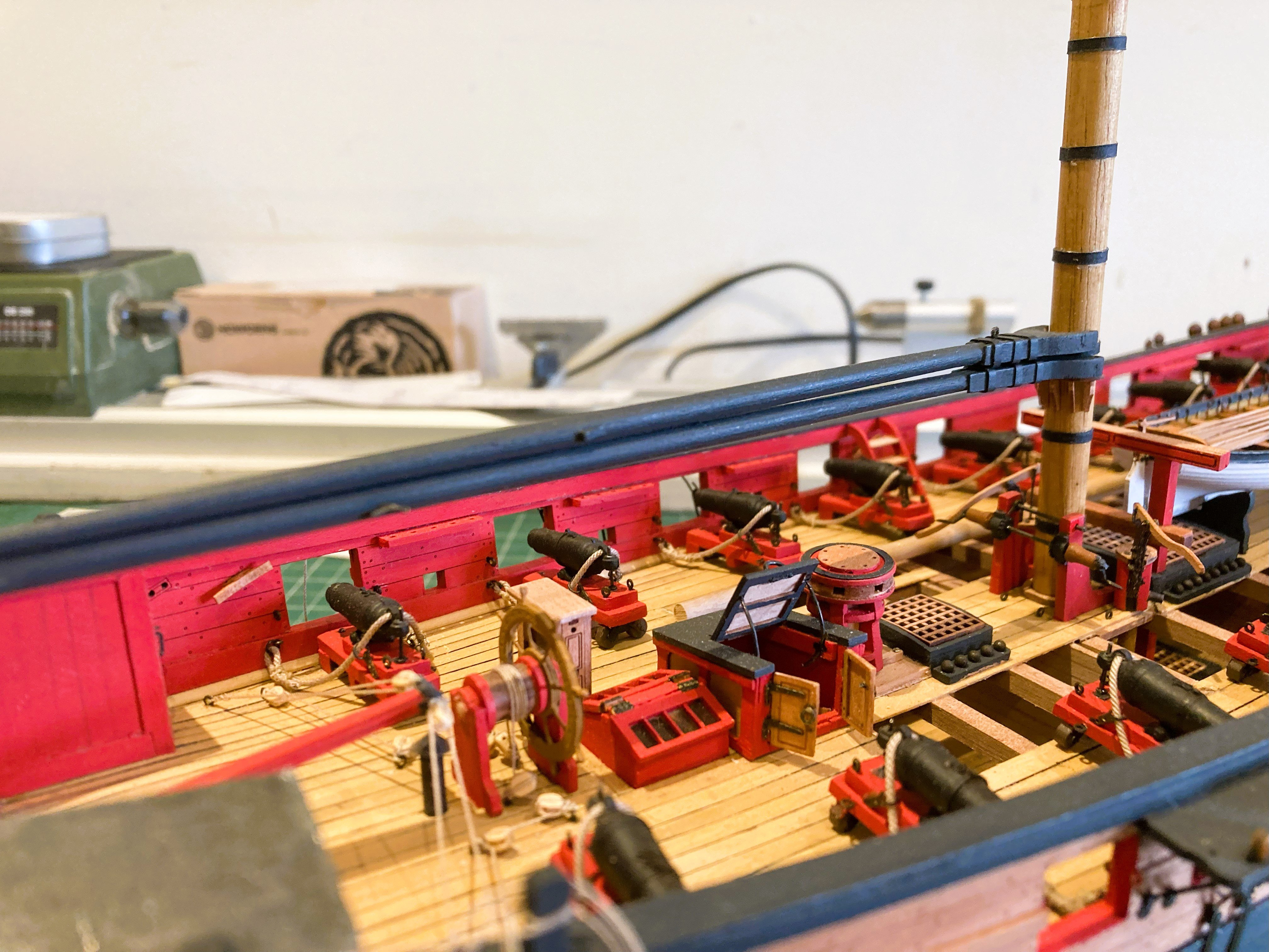

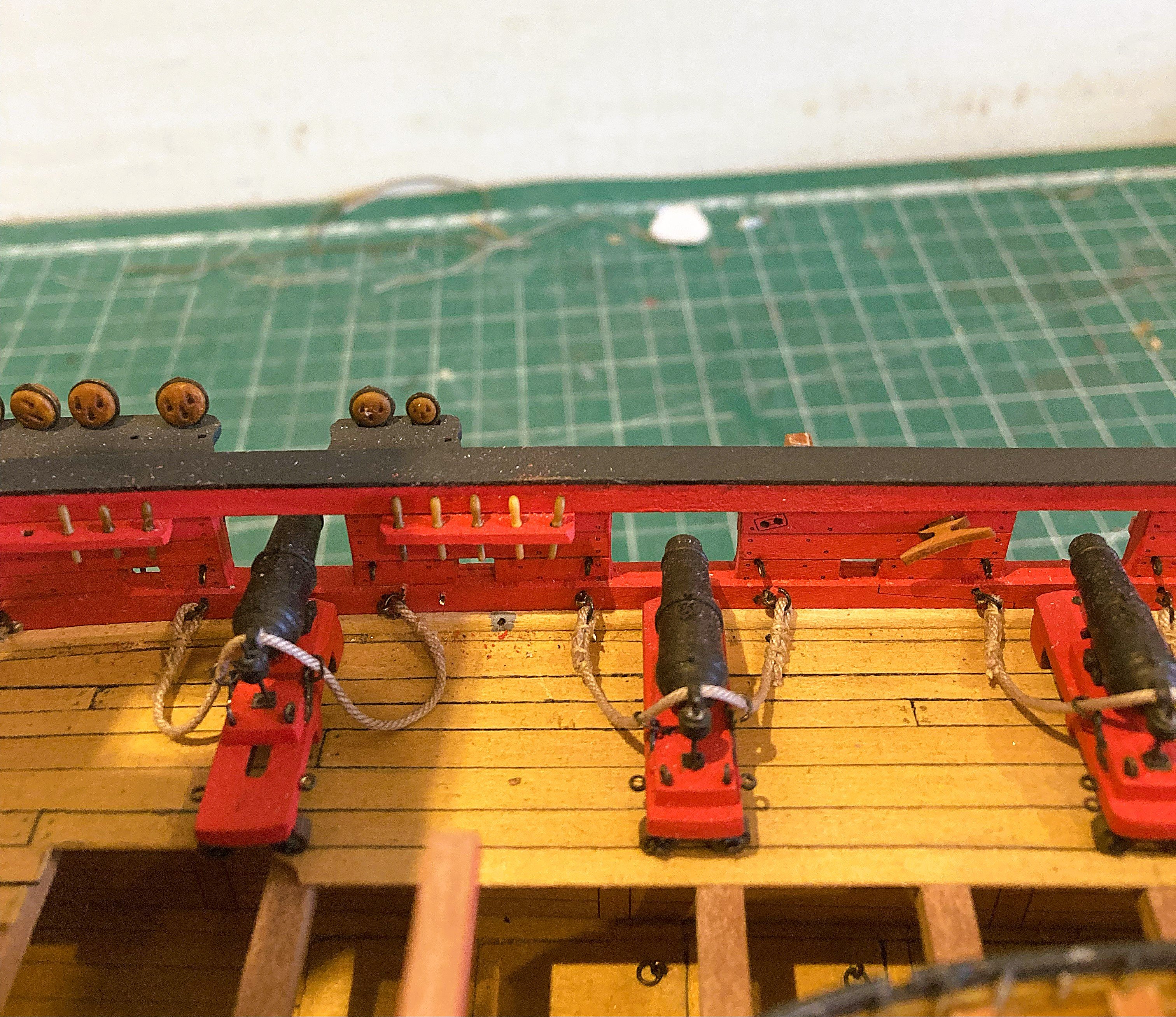

A short post about Long Guns

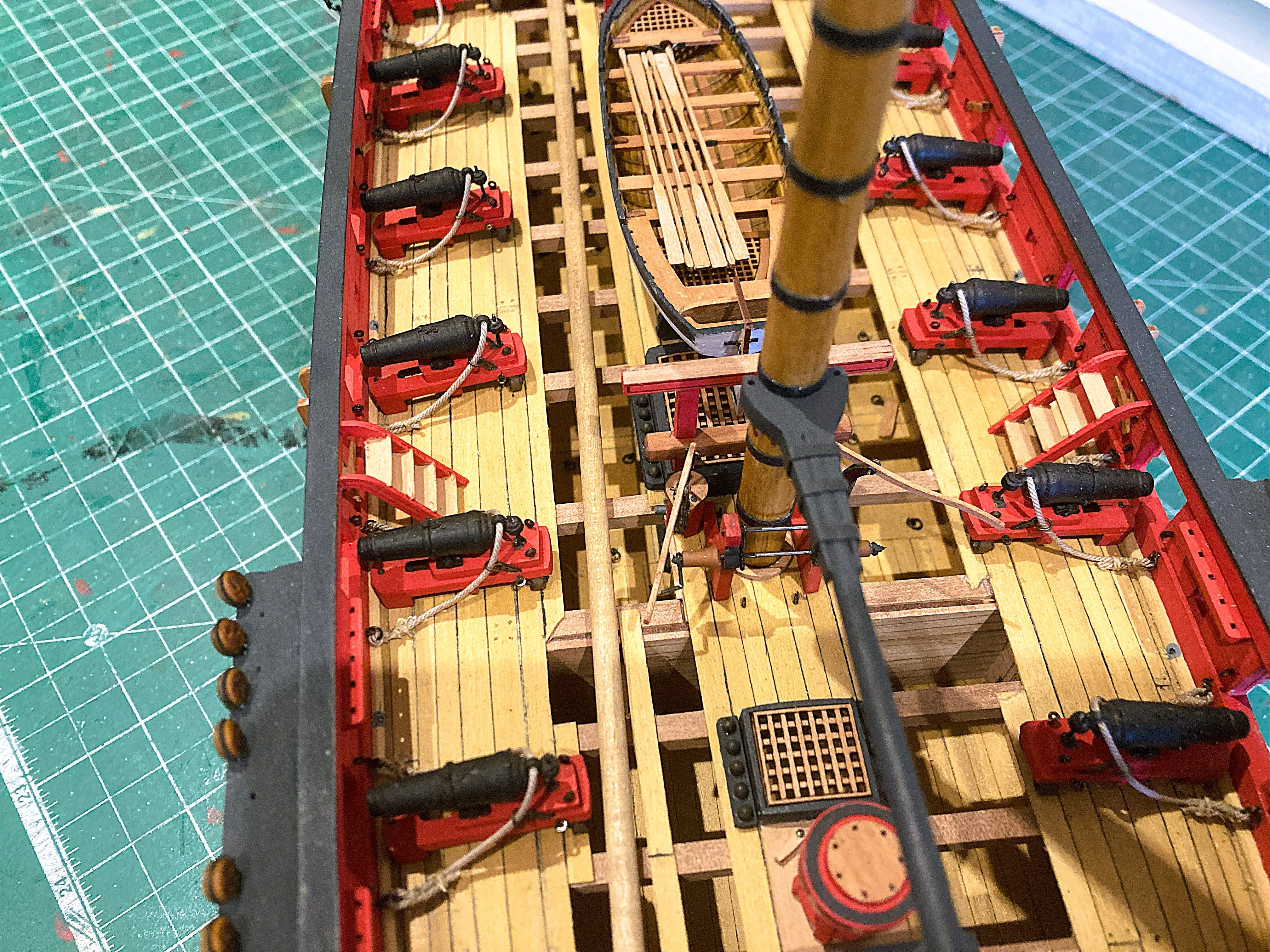

Harpy has two Bow chaser six pounders which I have been thinking about how to display.
These are the last two items to be  fixed to the deck, ideally done before the masting and shroud rigging begins.
I had thoughts of lashing the Long guns inboard, parallel to the ports, but I couldn’t quite decide  on the lashing approach, so I took the soft option and positioned them run-out.
4638a
The breeching rope is 3 x the gun bore length, using 4” circ line – 0.50mm dia at scale. I actually used Syren 0.63mm ø line.
I will only be attaching the Breechings, as I did with the Carronades.
For those in mind to attach the side tackles:-
Tackles 1½” circ line - 0.20mm ø  at scale
Rigging blocks single  5/6” size -2mm-2.5mm at scale.
4641a
I find it useful to use small sections of tubing to secure the breeching line for addition of the seizings.
4649a
I used Morope 0.1mm  Polyester line for seizing, it is the finest 0.1mm diameter line I have found.
4647a
Quite fiddly to seize the breechings on the model, a better job can be done using an off-model jig.
The downside is that it can also be fiddly fitting the bulwark ringbolts with other deck fittings in place, and the guns may have to be fitted at an earlier stage of the build.
4650a

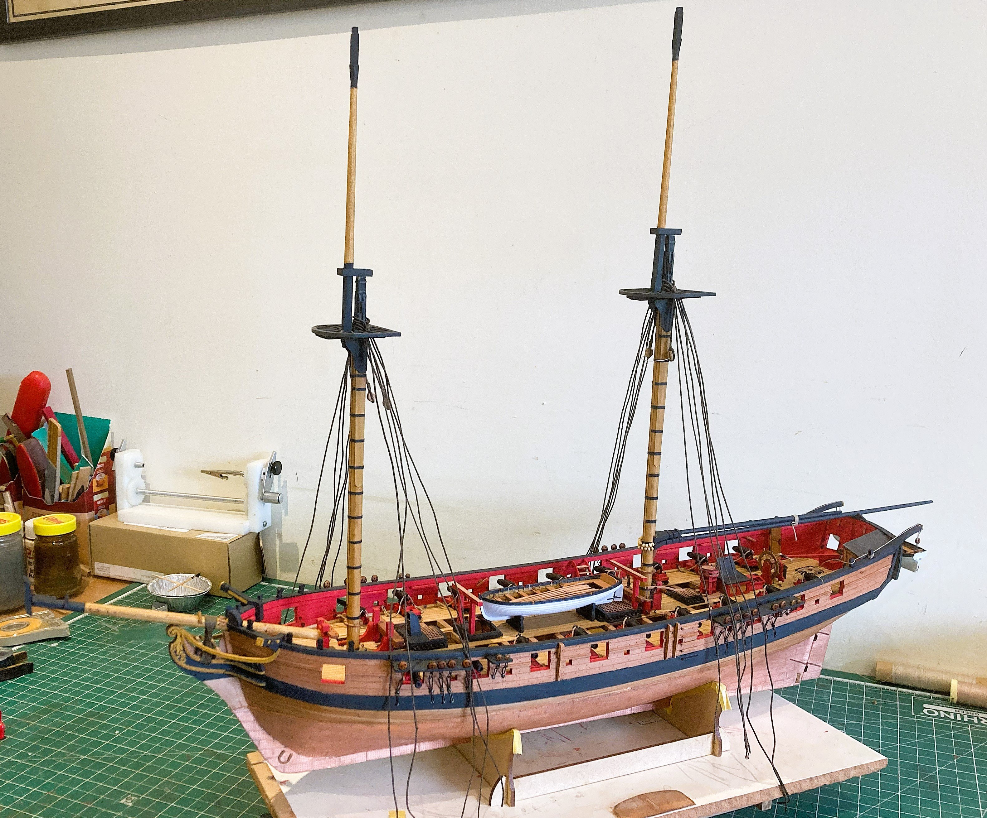

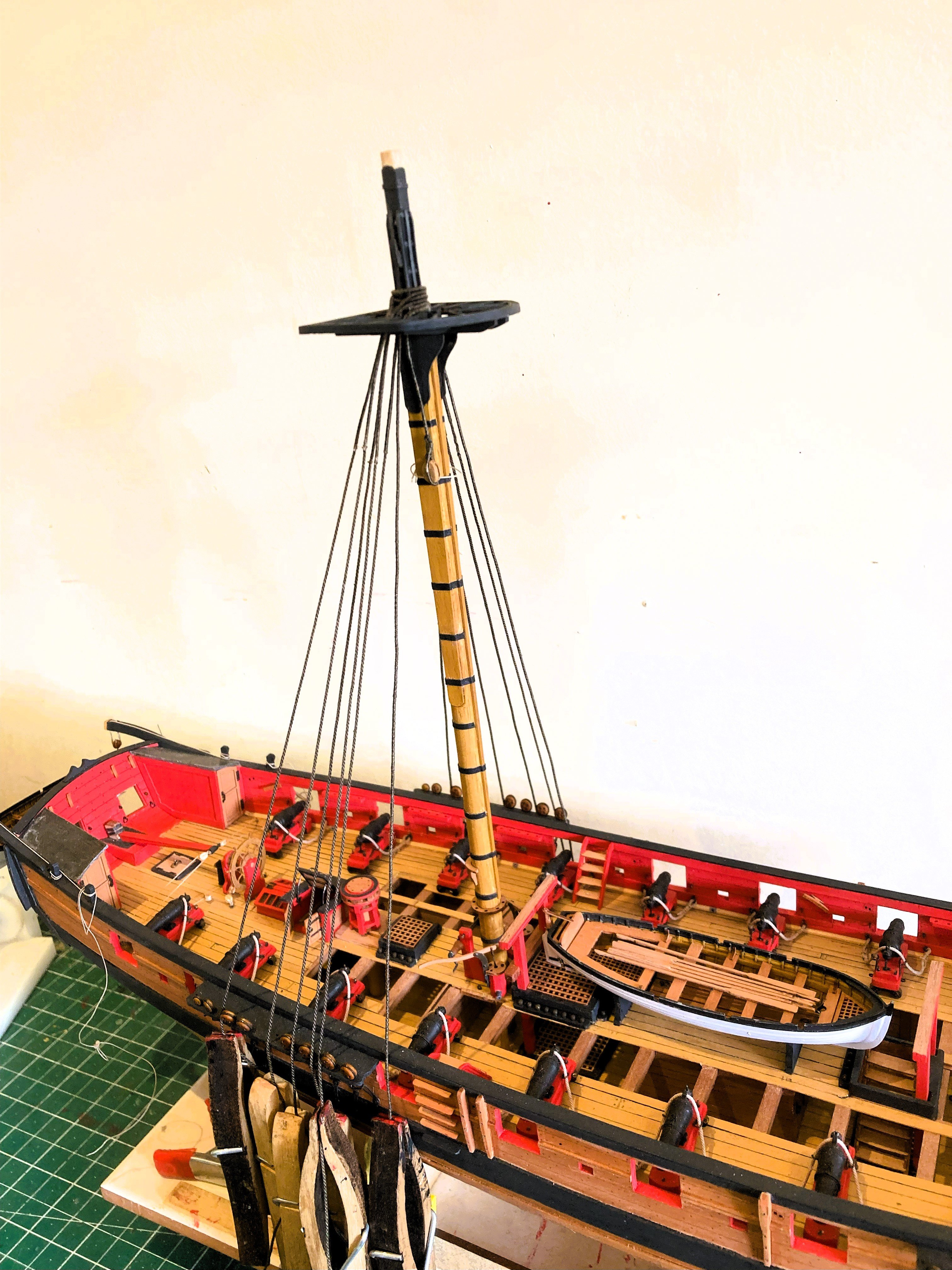

Post 86

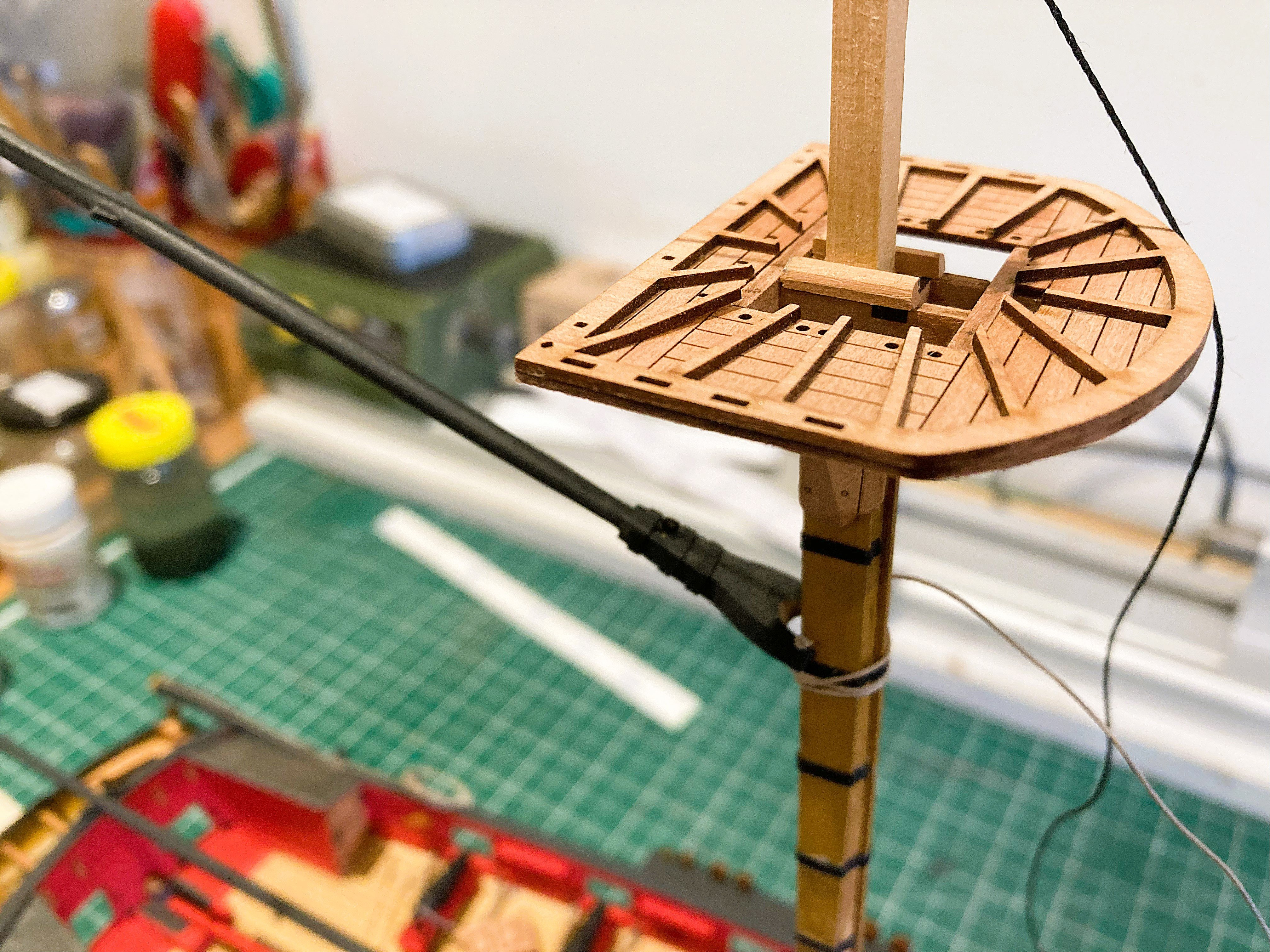

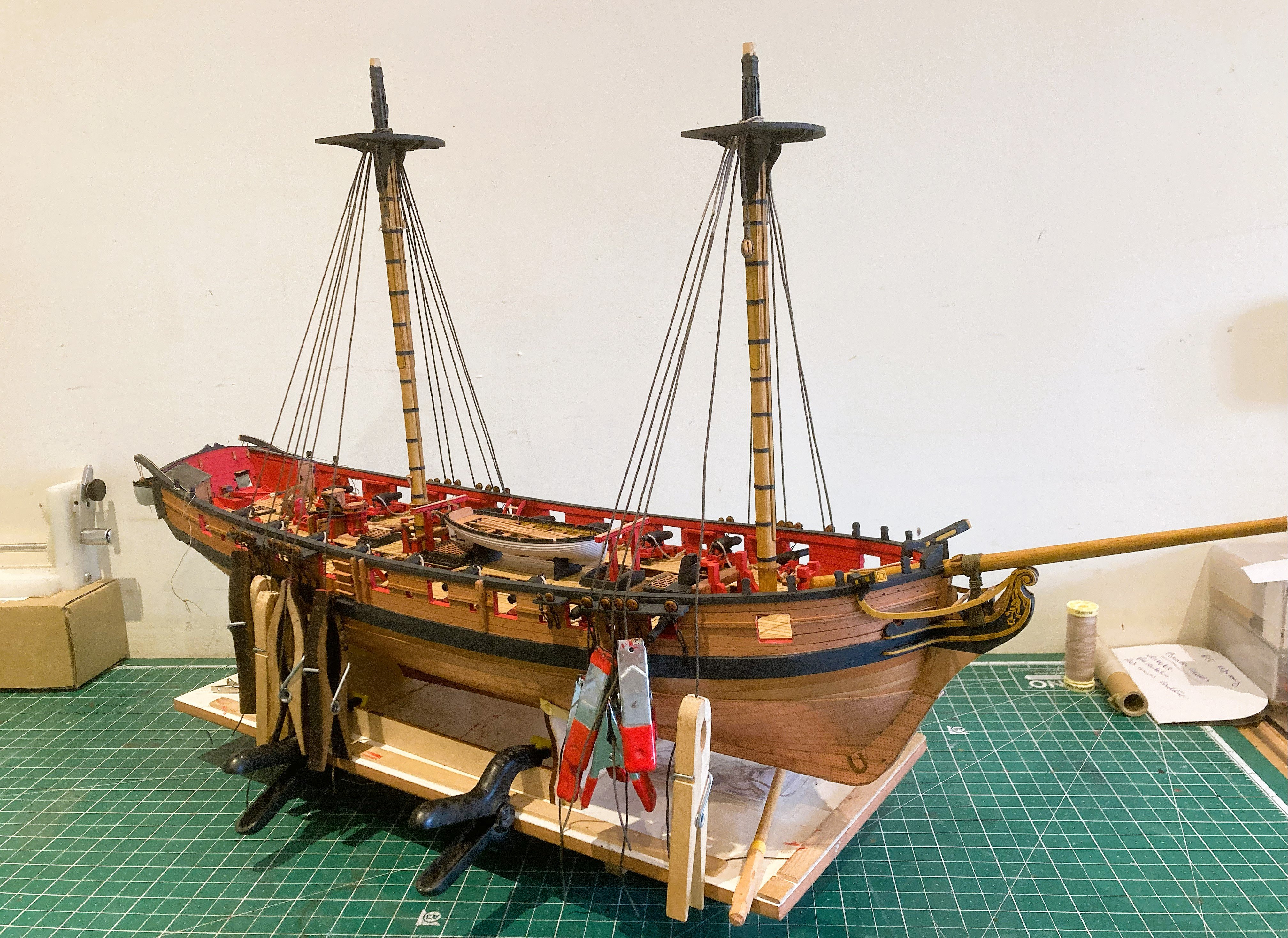

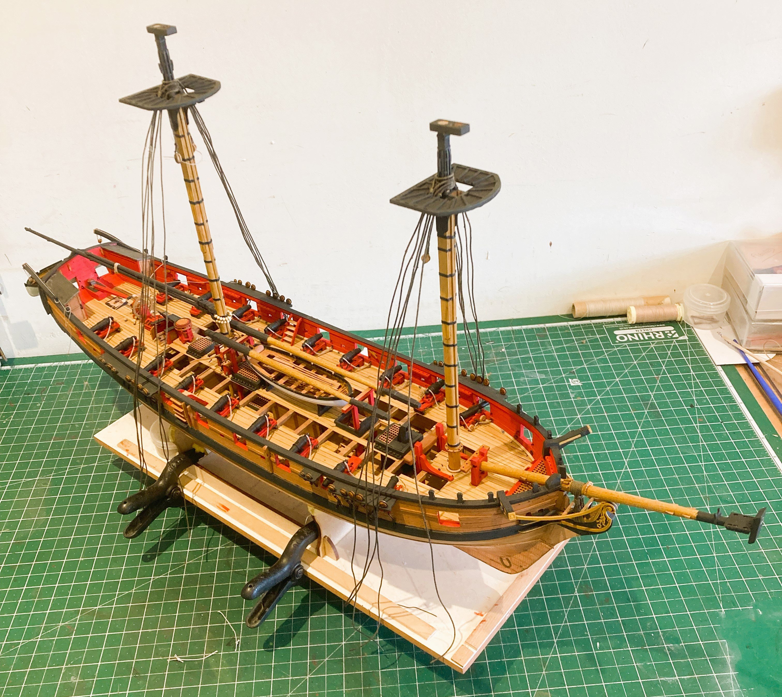

Lower mast rigging -  Part 0ne
My approach to rigging.
The limited rigging I will apply to this build will be based on Steel tables for a vessel of 18 - 14 guns of  300 -250 tons.
The principle rigging will consist of:
Pendent of tackles –  7”circ – 15” Single block-  6mm
Lower Shrouds       - 7”circ – 0.88mm - (5mm Deadeyes)
Forestay                - 9½” – 1.19mm  -  13” Heart. (5mm)
Fore Preventer stay - 6”   -  0.75mm   - 10” heart  (4mm)
Mainstay                - 10”  - 1.26mm   - 15” Heart  (6mm)
Main Preventer Stay - 7”  -  0.88mm  -  10” Heart  (4mm)
The kit line dimensions are close to this using 1mm line for the shrouds, and 1.3mm line for the stays.
The kit indicates use of deadeyes for securing the stays but I have opted for hearts.
I begin with the Pendent of tackles, which are omitted from the kit rigging plan, but are an important feature of naval ship rigging. These go over the head before the shrouds are rigged.
I covered my approach to making the pendents in my Pegasus build log.  They are spliced over the mastheads, and I followed the method described in TFFM book Vol 1V.
4654a
4657a
Syren 0.88mm line is served overall with 0.1mm line, I used the kit provided line which is Gütermann Polyester.
Steel indicates use of a  single block attached to the pendent, but a  thimble would also be appropriate, an opportunity perhaps to try out one of Chuck’s new additions to his fittings, a 2mm option would be about right.
4669a
4666a
4674a
I used 6mm single blocks, mainly as I had them to hand.
4665a
At this time period the pendents extend a little below the Hounds.
B.E.
08/06/2025

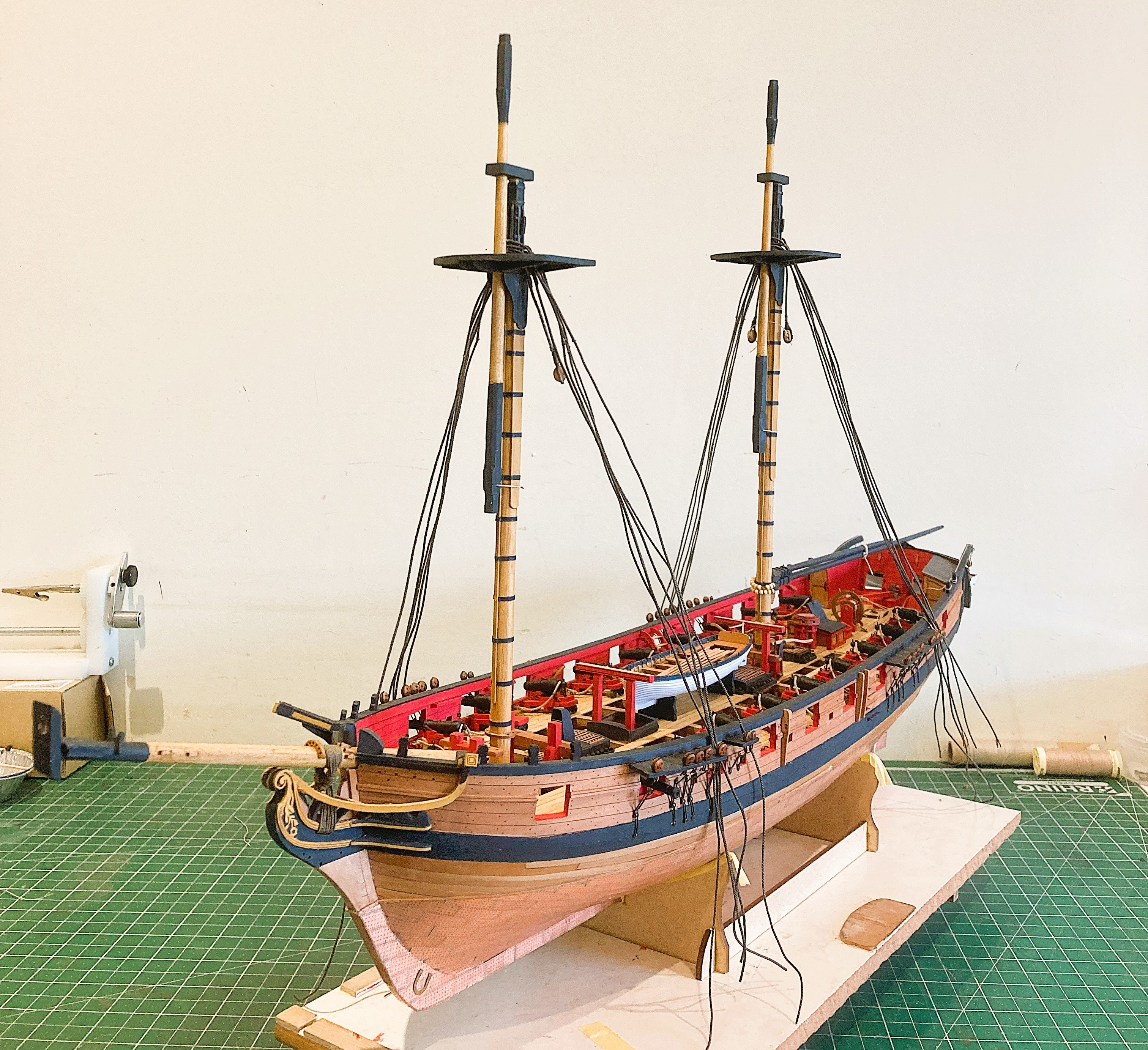

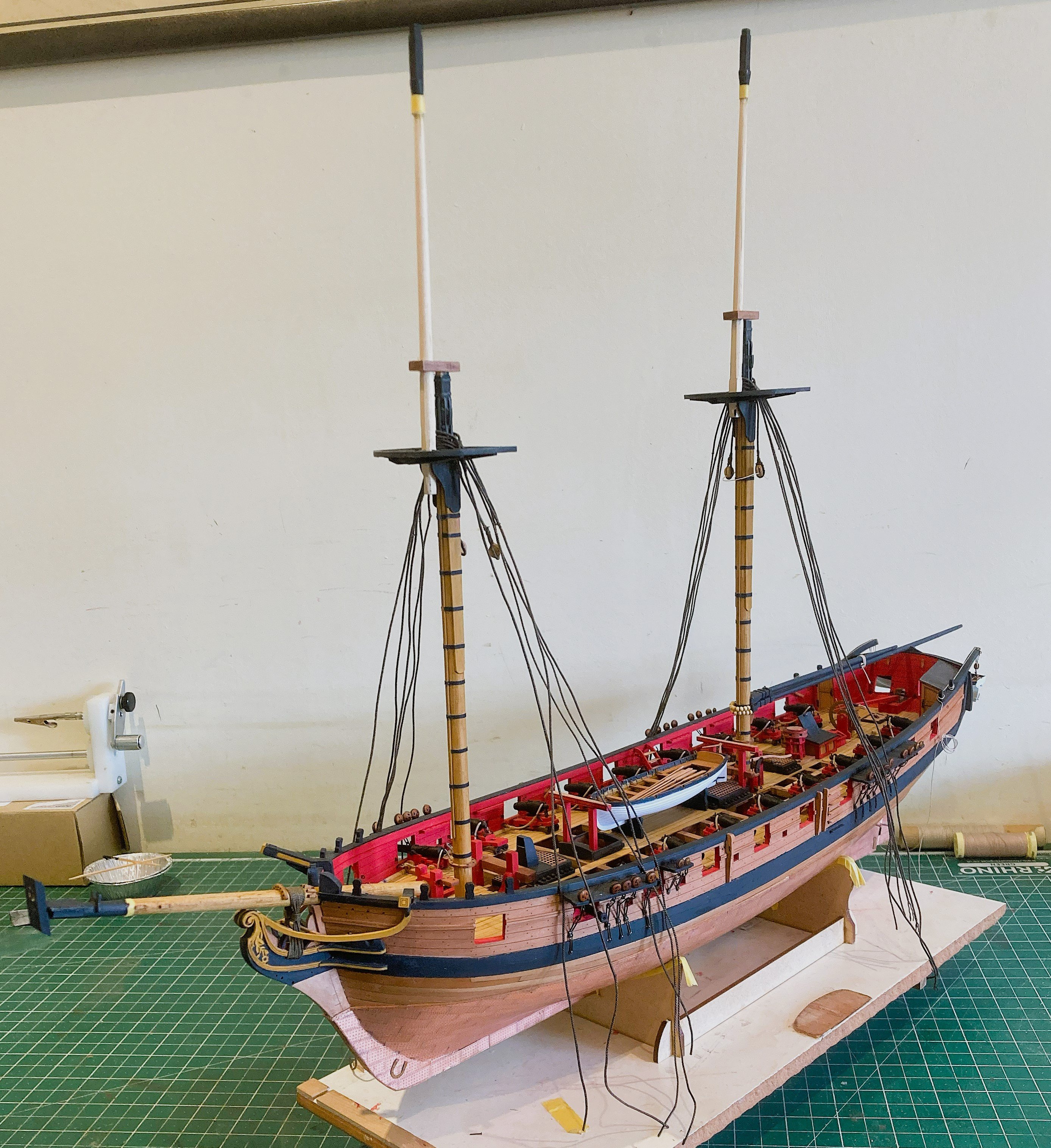

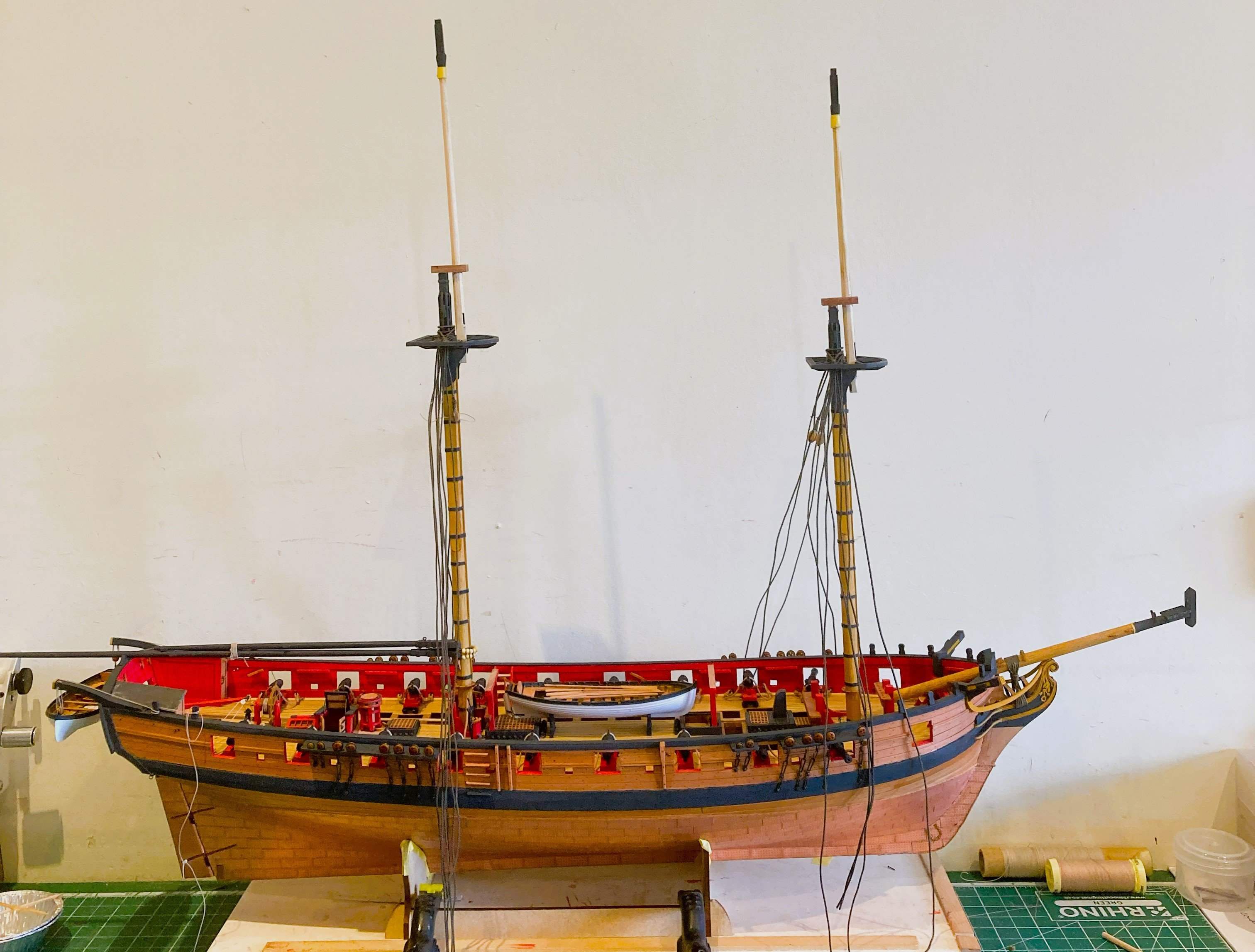

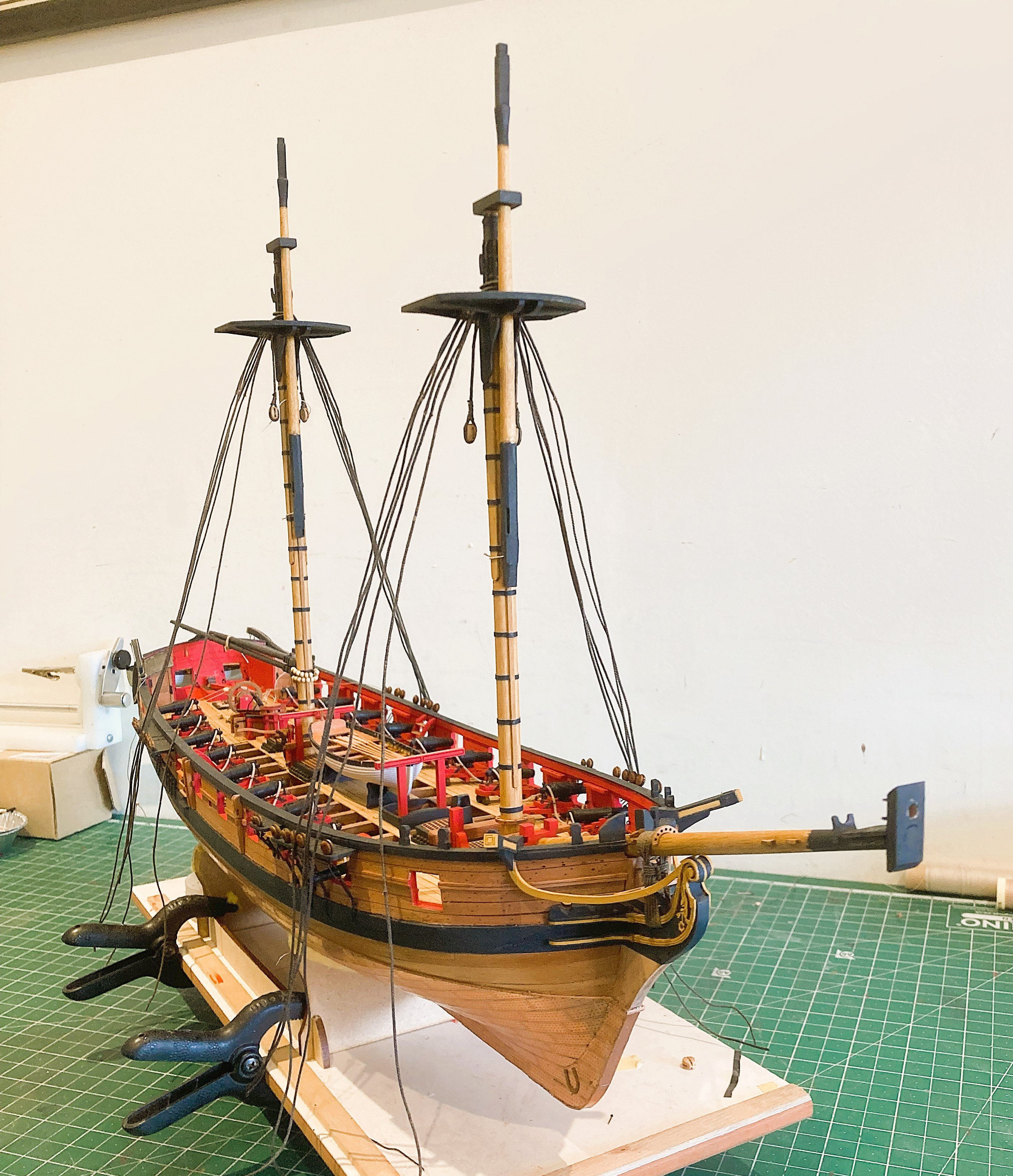

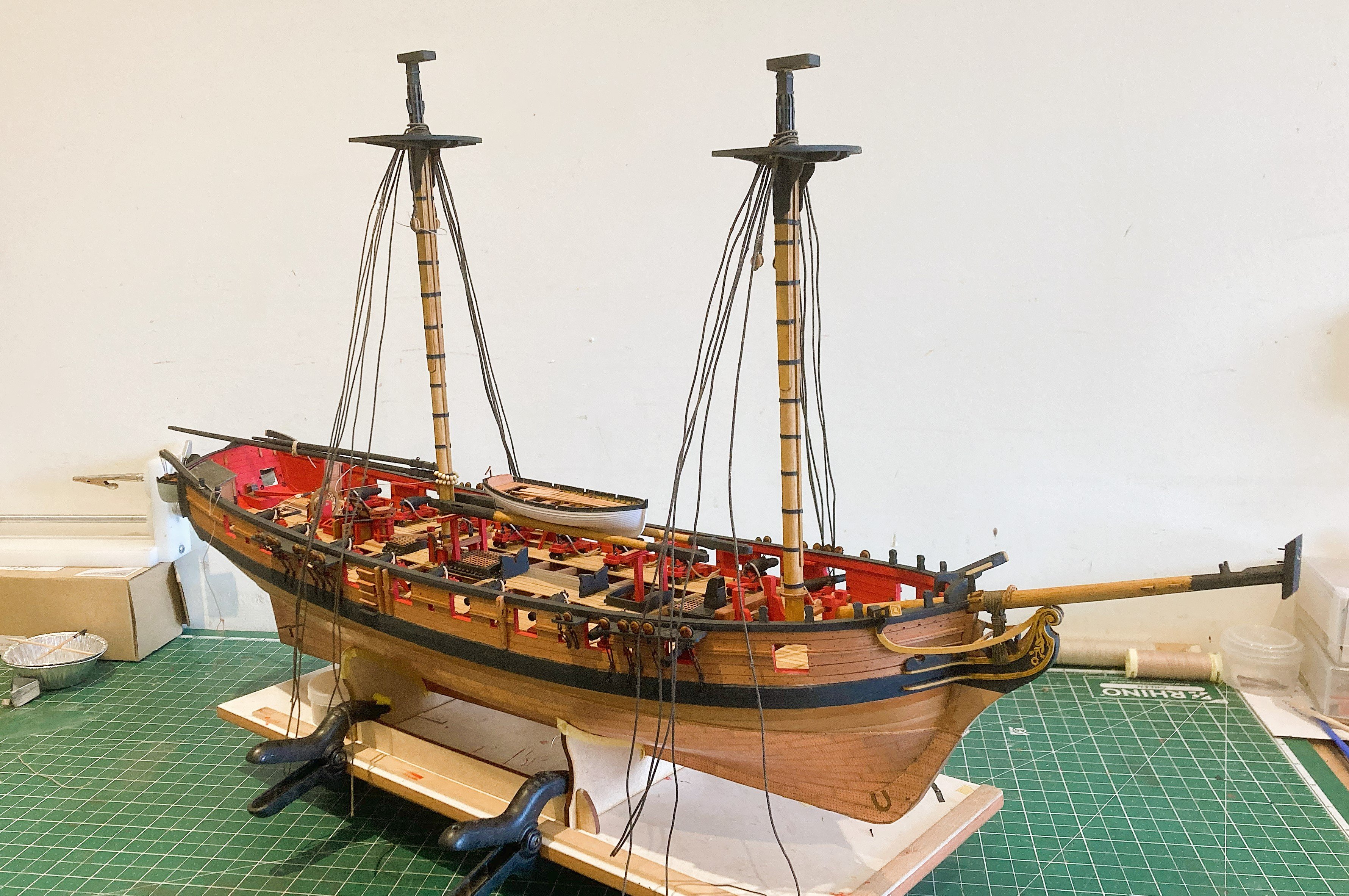

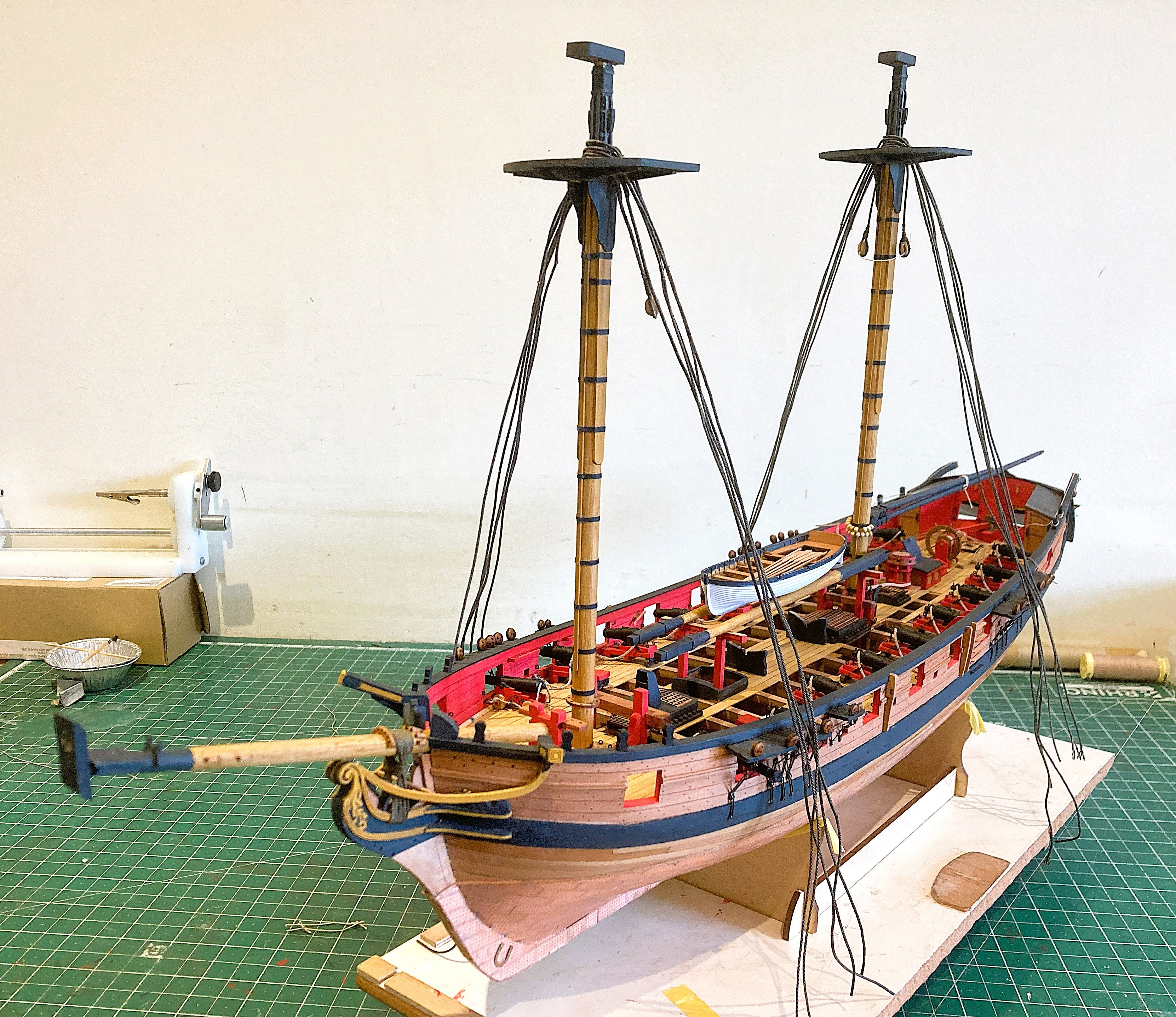

Post 87

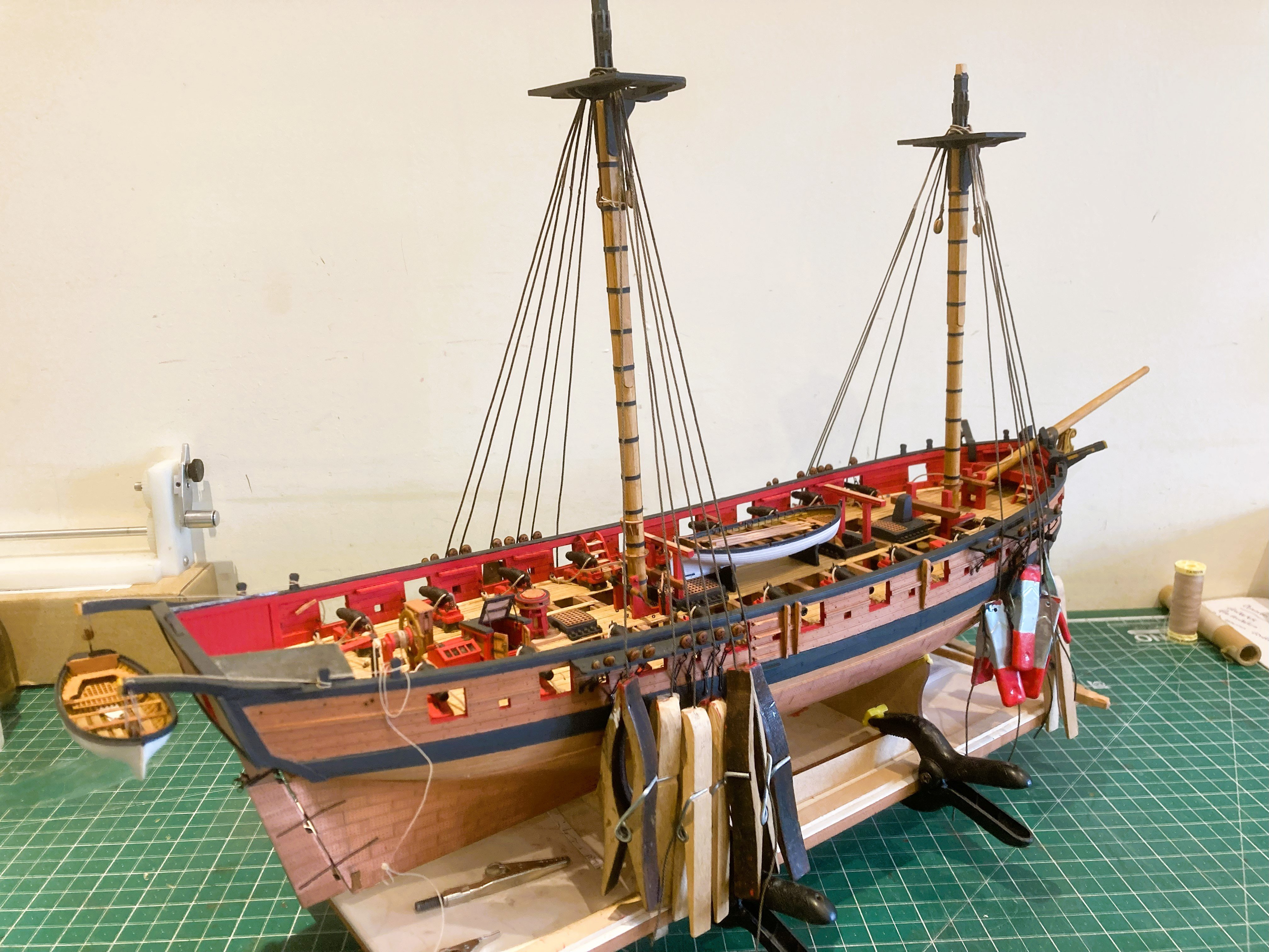

Lower mast rigging -  Part two
Fore and Main shrouds
I will be using dyed Syren 0.88mmm line for the purpose.
4653a

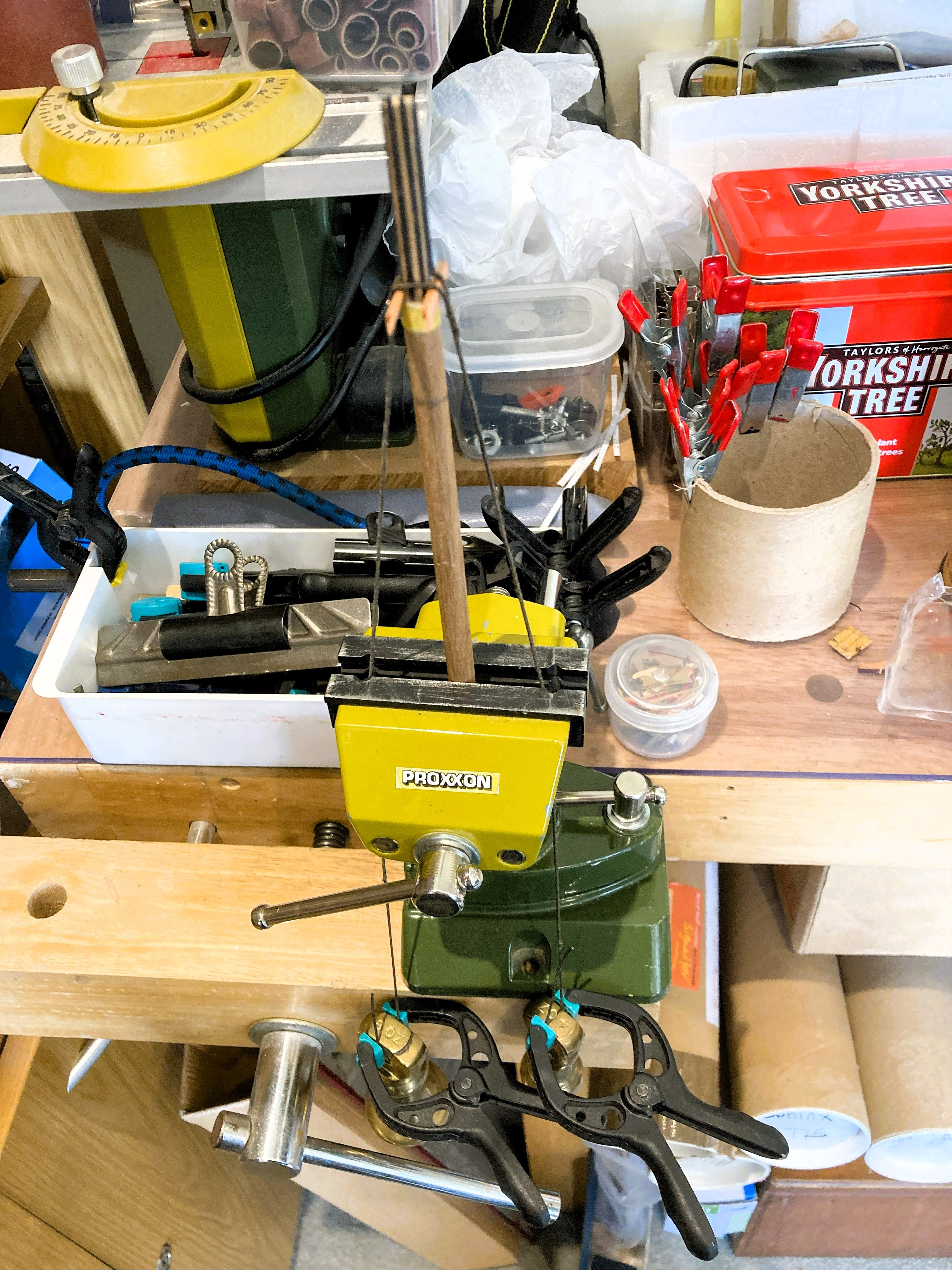

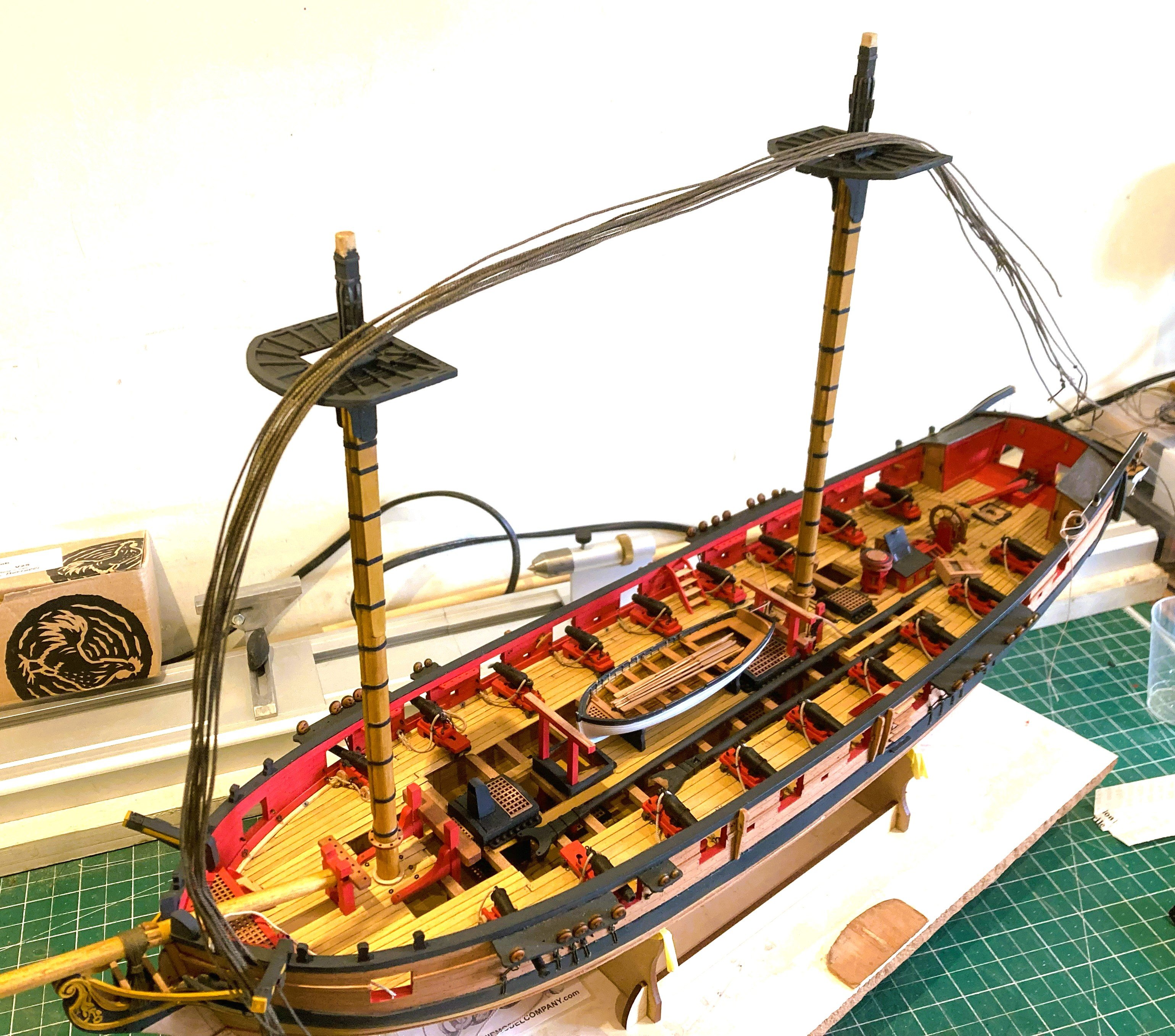

The line lengths are held under tension for a few hours before fitting to take any spring out of them.
The shrouds are put over the masthead in pairs starting on the sb side, then working alternate sides.
The shrouds are served  for the centre section around the masthead and  down to the futtocks.
The Foremost shroud is usually served overall to counter chafing from the  sails.
4679a

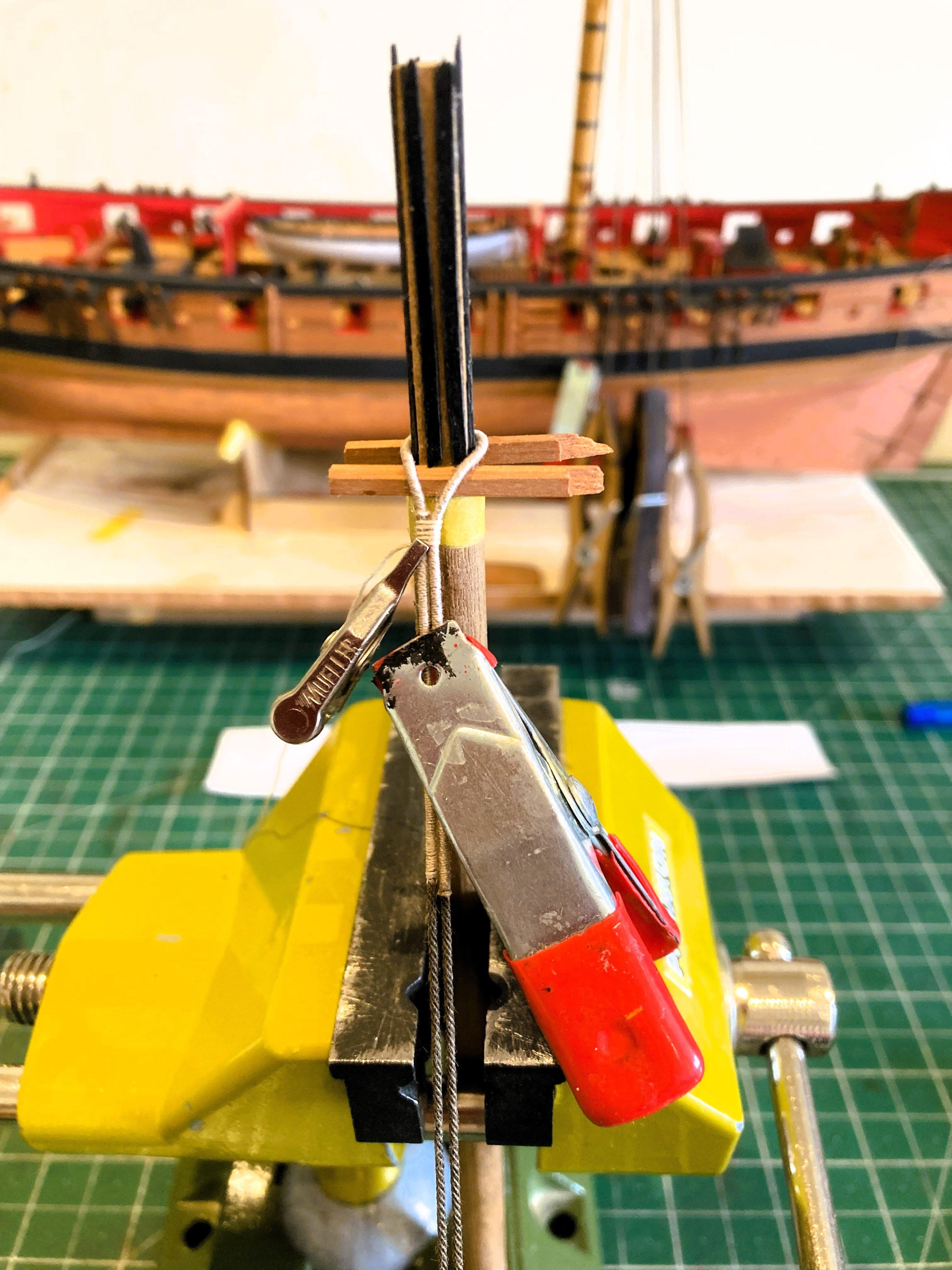

Once served I attend to the seizing on a dummy masthead and then slip over the  real thing. This is much easier than making up the full mast sets off model, and then doing the work with the masts in place.
4682a
The shroud is  re-dipped in the colouring solution.
4688a

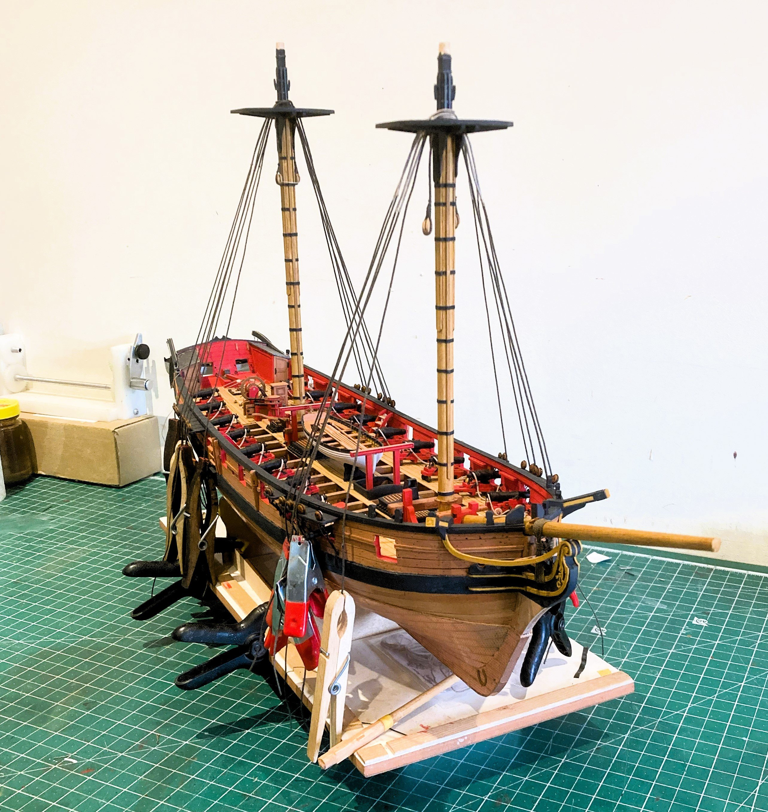

When rigging I always work from aft forward so I begin with the Main mast. Fortunately there are an even set of shrouds so  on this mast I can avoid the complication of a splice.
Fore Mast
There are two sets of two and a single spliced shroud that I have fitted over the masthead first.
4684a
This foremost shroud, as with the Main shrouds, is served overall. The spliced section needs to be formed first as with the Pendent of tackles.
This is a lengthy piece of serving covering 650 mm overall, and as can be seen there is a degree of kink in the line  by reason of the serving.
4687a
I put this set under weights to even the line out.
4692a
4693a
4694a
The shroud sets are all made up; they will now be removed for final fettlin.’
I have been having second thoughts about the Pendents of tackles. I think the 6mm blocks (15”) look a little heavy, and the seizings a little bulky.
I have some of Chuck’s  new resin thimbles on order, so a replacement set will be made up.

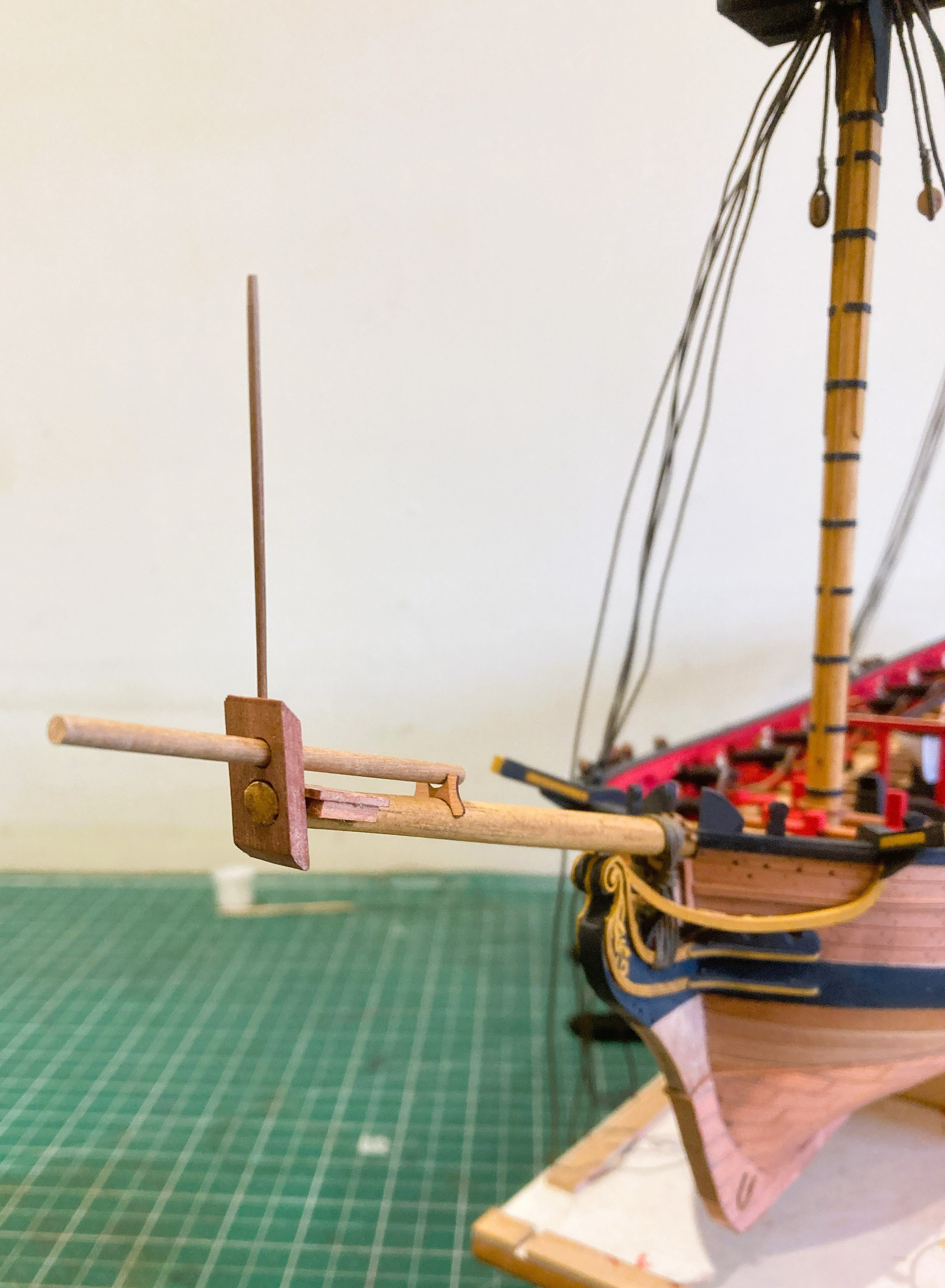

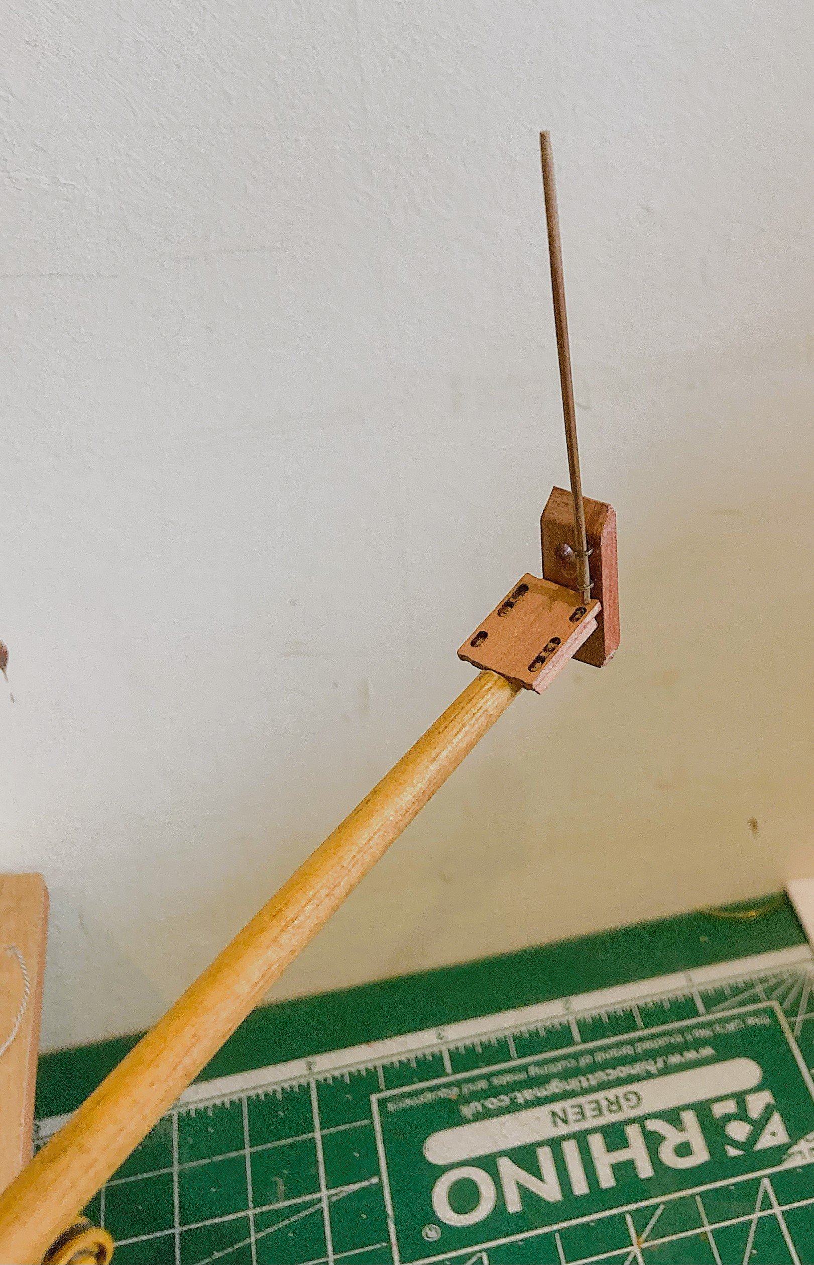

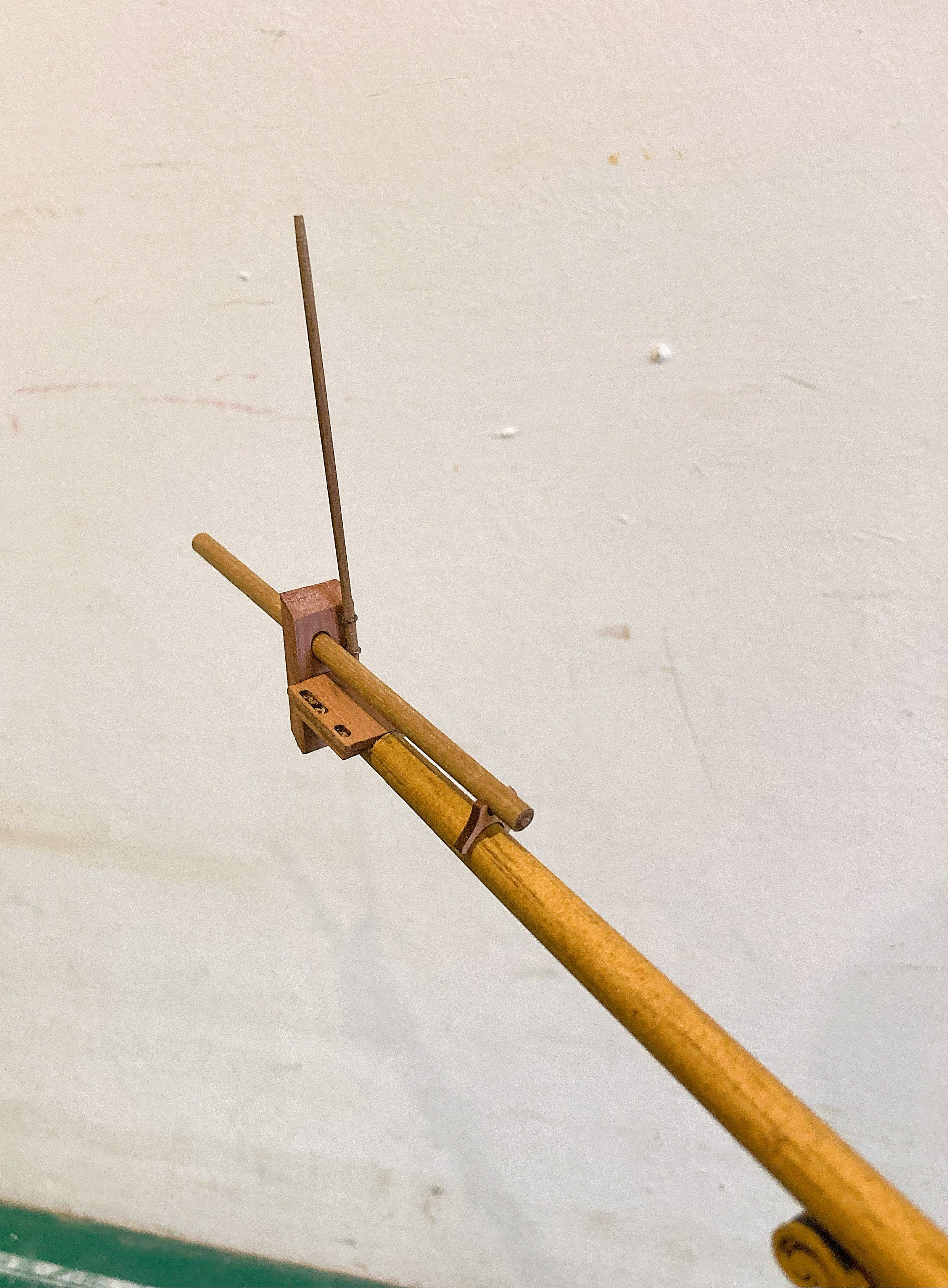

I originally thought I would not include the Bowsprit Cap on this build because I knew what modifications would be required to address the kit simplification of this part.
On my build the cap would be fully exposed without the distraction of rigging.
Although still a tricky exercise it is easier to re-make the cap rather than fiddle with the kit part. The real thing is angled top and bottom to match the Bowsprit stive, and holes  cut at an angle to the cap which should be vertical to the waterline. The holes are slightly offset to port to accommodate a Jackstaff on the starbaord side.
The kit dimensions are 19.3mm(L)  8.1mm(B) 4mm(thickness)
I worked the replacement using Steel as a guide (300 ton sloop)
Procedure.

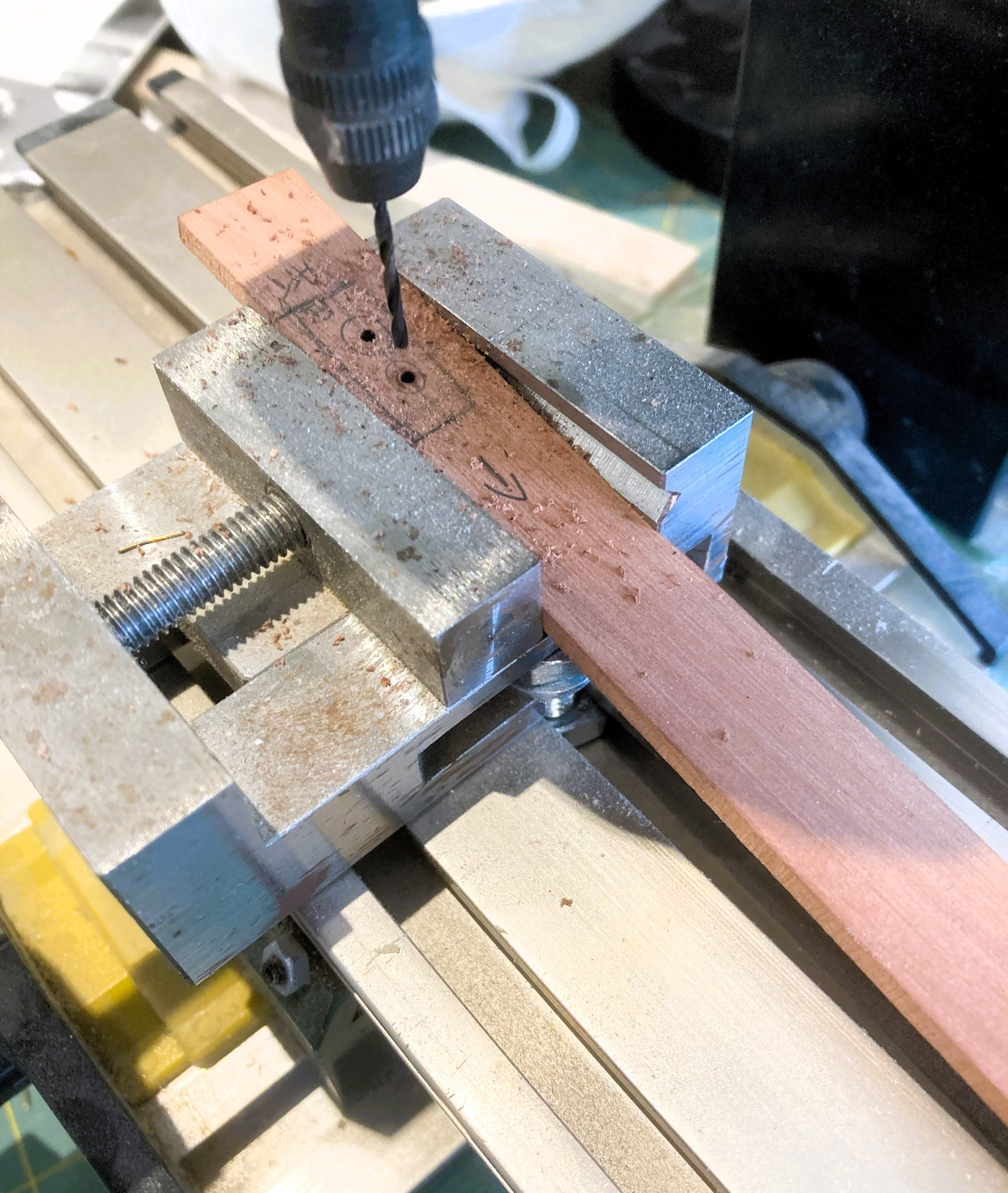

The new cap is cut from spare Pearwood fret. I used a length of 15mm wide strip of 3mm Pear.
The finished version worked out at 20mm(L) 9mm(B) 3mm(thick)
4702a
The holes are marked using the kit piece as a template.
The tricky part is deciding on the angle and holding the piece at that angle for drilling.
4701a
I used the mill for the purpose of drilling the initial holes that were then progressed using files, maintaining the angle.
4703a
4707a
I had to cut the rebate for the Bees with the Bowsprit in place, not ideal but fairly straightforward.
4729a
Here a trial fit of all components.
The Bees are provided with the slots for the Topmast stays but lack the Bee blocks that should sit beneath them. I added these using small lengths of 2 x 2.5 Pear strip.
4716a
4731a
The extra width of the cap allows for the Jack staff which is made from some 2mm dowel reduced to around 1.3mm ø.
Blackened, drilled out brass eyes support the staff.
4717a
A check is made to ensure that the cap is vertical before the glue sets.
4726a
4730a

Now for the tricky bit -Topmasts
The kit version Topmasts are simplified but will still take some careful work using 6mm dowel. There is tapering  and creating the flared hounds, and a clean rectangular head.
Accurately shaped topmasts are the most complicated masts to make because they have both square and octagonal lower sections, a tapering round mid-section, rising to flared hounds, and a rectangular head.
Additionally sheaves set at a diagonal angle are required in the heel.
I do happen to have a couple of topmasts I made earlier during the course of my Pegasus build.
These were made to Steel’s specifications, and again by luck closely match the kit sizes.
007
The Topmast drawn out and prepared for shaping on a ‘V’  cradle.
Square stock is used throughout, it is easier to round the section between the lower mast cap and the Topmast hounds, than create the non round sections from dowel.
028
The lower section showing the square and octagonal detail and the Top rope sheaves.
029
The head section detailing the hounds.
025
The completed Topmasts.
4744a
4739a
I had to adjust them slightly to fit Harpy, the critical area being the fit between the fid hole created by the crosstrees and trestletrees.
In reality the Topmast should slide up through this section using the Topropes.
The kit has the Topmasts at the same length for both Fore and Main. This follows the Steel table for a 200 ton Brig.
4740a
The masts I have used  are based on a 300 ton sloop where the Main Topmast  is slightly longer by around 12mm.
Harpy is a Brig sloop, and in my version I have gone more Sloop than Brig, based on the vessel weight.
4748a
As it happens the Fore Topmast matches the Kit plan drawings. The extension at the bottom is the block below the heel, which has the lower Toprope sheaves.
Onwards…

Amongst the contents are a supply of Chuck’s new 1:64 scale Resin belay pins.
I have been keen to see how these fit Harpy, and you might say I’m highly delighted.
4777a
These pins slot into place as if made for the kit, and in an instance have made all other kit provided Belay pins at this scale, obsolete.
4779a
These are fitted as supplied without any colouring, but could be darkened if required.
On my build they won’t be used for their designed purpose as I’m not rigging her, but they do look good in the racks.
4789a
I did do a strength test on the pin and they performed just fine.
More likely to pull the rack off the bulwark before the pin breaks.
Thanks Chuck, a great job.👍

I have now dipped the pins in a dark oak stain which I think tones them better with the model and provides a range of subtle shades.
4811a
An original pin is second from the right. (excuse the working detritus)
Working on the thimbles now, modifying the Pendents of tackles, I think they will be 👌

Post 91
Topmast options
I’ve yet to decide  how to display the Topmasts, so I’ve been having a play around before the shrouds are fitted.
The possibilities are:
In the usual raised  position.
4751a
.. but this is a non starter, I haven’t room for another tall masted model, but she would look beautiful fully rigged.
In a lowered position secured by Top ropes.
4755a
4760a
4756a
This has the advantage that it doesn’t increase the height very much. Also provides an interesting rigging arrangement.
Secured on the Gallows.
4761
4766a
The simplest and obvious location for stowing non fitted Topmasts, but tends to obscure somewhat Chris’s beautiful little cutter, particularly if I decided to store Sweeps on the Gallows.
With the Cutter atop the masts on the Gallows
4768a
4770a
4771a
a recognised arrangement, which on a practical level clears the deck and displays the cutter to the full extent.
I don’t need to decide  until the shrouds are fitted, but the lowered Topmast position is the one I’m favouring.

If you don’t mind a casual observer’s opinion, I like the version with the top masts lowered, it gives a sense of impending activity, and goes well with your setup for the gaff and driver boom.. But I also like the cutter raised up, as it makes viewing the deck easier, or, at least, less cluttered. Perhaps instead of the top masts, it could be resting on the main and fore yards instead? Maybe a little more work but it would give you the best of both options.
Andy
Quando Omni Flunkus, Moritati
USF Confederacy
Decidedly esoteric. But that's what many of us do!
I don't see that the ship's boat are too obscured by the topmasts on the gallows; I like this detail given your choices on a minimized rigging presentation. Looking wonderful!
