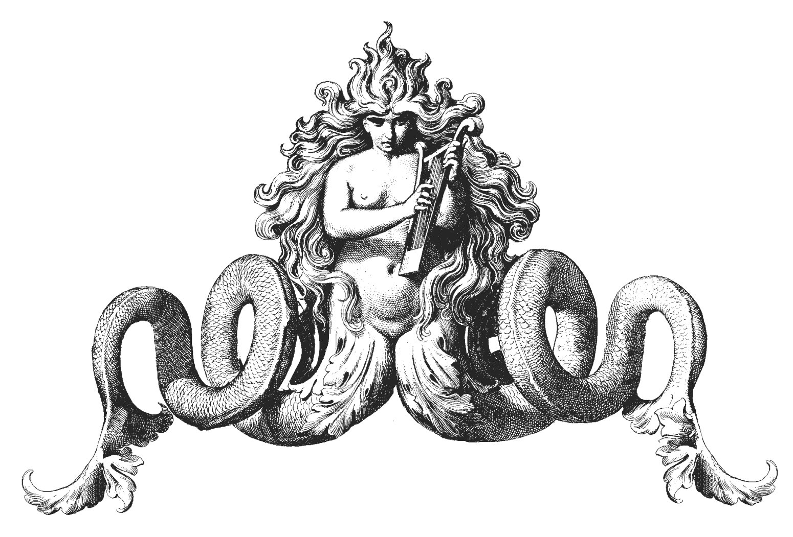

Continuing the conversation...a more complex carving
Using drawings...I really hate how easy it has become to steal stuff but it doesnt take a rocket surgeon to figure this stuff out.  If you are using it for your own model its fine.  It is just another tool.  If you use it for commercial purposes then its not cool at all.
Here is my drawing, a very bad one done for one of the speedwell transom carvings.  It is right from my plans.  So if you have decent plans for your model....you are good to go.  If you can draw even better.   All you need is a good line drawing.
Plugging this rather doodle like drawing I made into Meshy.  I wanted to show you what a line drawing would turn into.   Or from a plan drawing.
You get this.  I couldnt carve this.   You can adjust the relief thickness in other programs as well.
If you are curious and ask it to try again....you get another version...can you spot the AI weirdness.  I m not saying it is perfect yet.  But I couldnt come close to carving this thing.  And certainly not in 45 seconds.  By the way I paid a CAD guy to create mine and this figure or any one figure like this would cost me $250 to $300 to have done.  I feel sorry for those guys in the next few years as the programs get better and better.

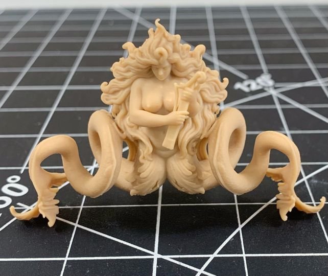

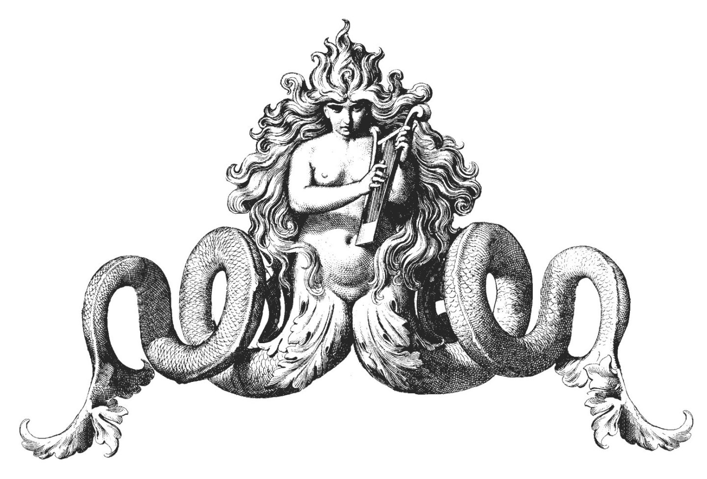

One more example because you are correct it is all about what you put into these generators.  Garbage in and garbage out.  So you need to change your thinking a bit.
I used the text to 3D method for this one.  And how many people would have have thought to ask it this question....see my text entered on the top left side?  I wouldnt know where to begin to create this in CAD from scratch.   Way too complex for me.
And what do you think this object will be turned into for me with a little editing so I can sell it to you guys.  If the resulting prints prove effective.  Ten points to whoever can tell me what this will end up being!!
Just guess?
The surface quality is excellent by the way.

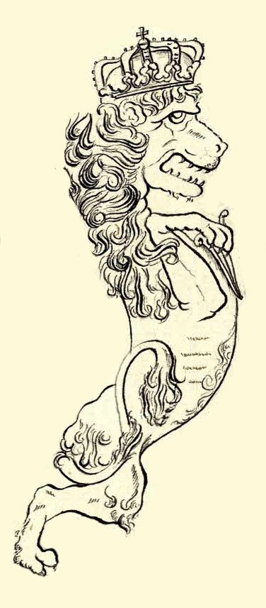

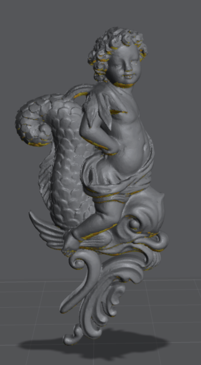

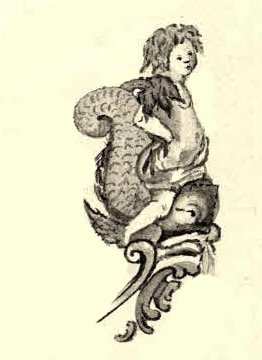

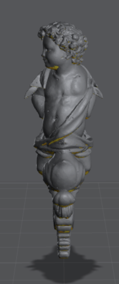

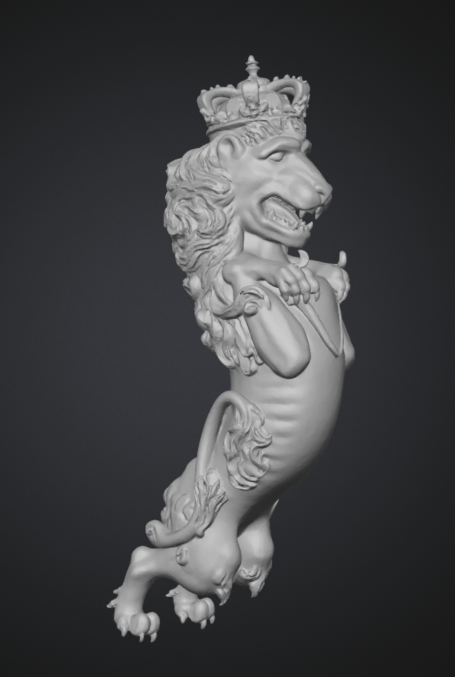

I tried a few examples of using original construction drawings to get figurehead stl's and I am blown away.
Heres a 'standard' lion:
G2868-figurehead.jpg.177326965ccc2b69c1cd2c695ffe39d1.jpgScreenshot2025-10-27at21_00_33.png.5f7c715787cf38043c02c69ec8e9c1ef.png
To me this is crazy! All I did was take 5 min in photohop to remove everything from the drawing that was not part of the lion, fed it to meshy and voila!
And here is a non-symmetrical one where it had to extrapolate the left side:
You can see that there is not really much to go for in terms of detail, especially in the face of the cupid, but look what I got from the model:
Screenshot2025-10-28at06_34_22.thumb.png.5cdcefe36ad02ad9d2492dac73479220.pngScreenshot2025-10-28at06_33_39.png.af1a14b291234ab21e857844ebb5494c.png
For a 3 cm tall figure, this is going to be all fine.
Basically, this was the last big nut to crack for me in my effort to design ships from the original plans. Lot's of learning and experience still to go, but the tools are here now.
I am really amazed. Thank you chuck, for pointing out that AI have come to this point now!

This image is then imported into the 'studio.tripod3d.ai' program (the free version limits the program to generating 3 figures per day).
This program converts the jpeg file into a 3D stl file.
You can then retrieve the STL file in Fusion360 to scale it.
All that remains is to print the figurine...
I was impressed by how easy the process was.

Its all very exciting.   Now what good is all of this if you cant print these things.   Or if the quality of the print is sub par.   So on one of my tests earlier in this mini tutorial I went ahead and printed the file.  This is a very very complex object.   I wasnt sure it could be printed in one piece and how it would work with the supports I added to the object.  Adding supports and establishing the optimal angle for 3D resin printing is an art unto itself.  It really should have a topic of its own and there are so many discussions about this on the 3D printing boards.
This was my logo....the fully in the round STL generated by Meshy.   The drawing below.
The STL File in Chitbox
And the finished 3D print
You can see how complex this object is and how well it printed out. Its very detailed.
A bonus is that it stands on its own!!
