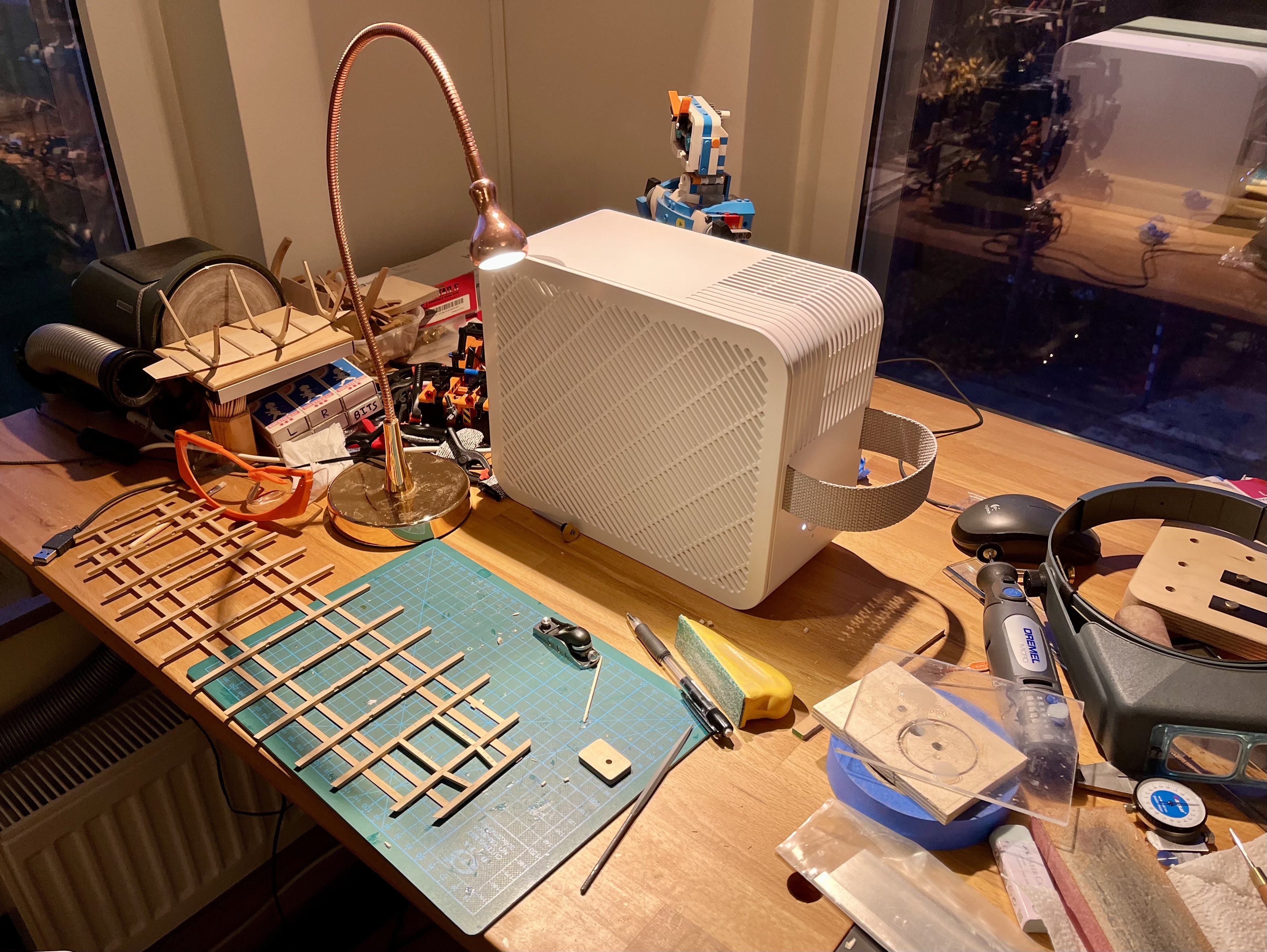

Discovered a very neat solution for sanding dust that is not coming from a particular tool (e.g. manual sanding).
I work in a living room, so putting any workshop dust filter on a ceiling is not an option.
But IKEA has a purifier UPPÅTVIND of just the right size - you can put it right on the table, capturing dust very close to the source.
Impressively quiet (55db) even on the max speed (with a flow rate of 55 CFM), has a decent filter (EPA 12 class) and is very cheap (35 USD in Sweden, 50 in US. Filters are 5 and 15 USD respectively).
Making a DYI version would cost many times more, and there is nothing in the market in that form factor. Proxxon ASA is mysterious, haven't seen one in the wild, and it is 4 times more expensive.
Now I always have it on when modelling, just in case. It is that quiet, that you do not even think about it - just turn it on max for hours, you might even forget to turn it off afterwards :D
Thanks! Just ordered one :)
