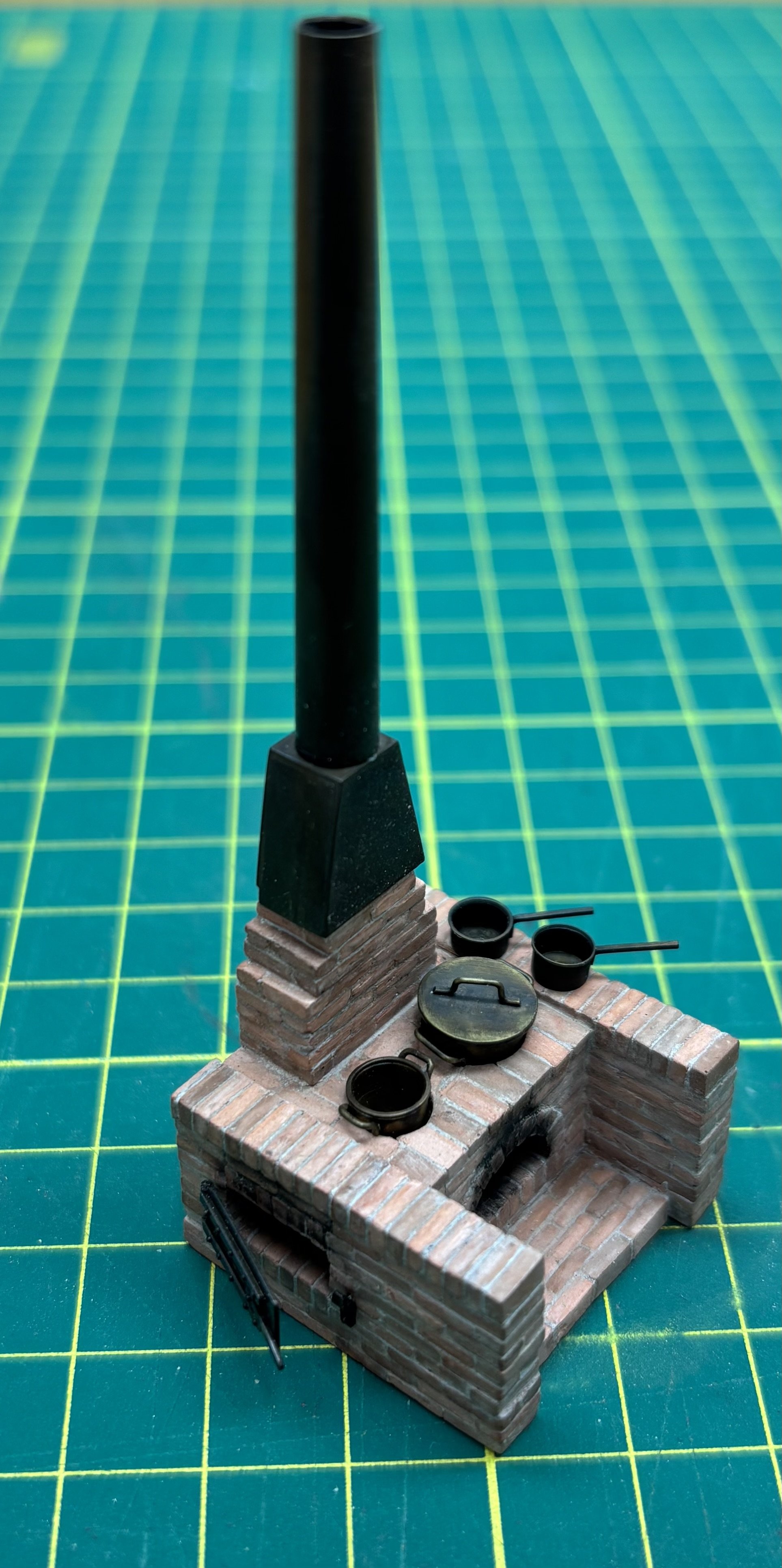

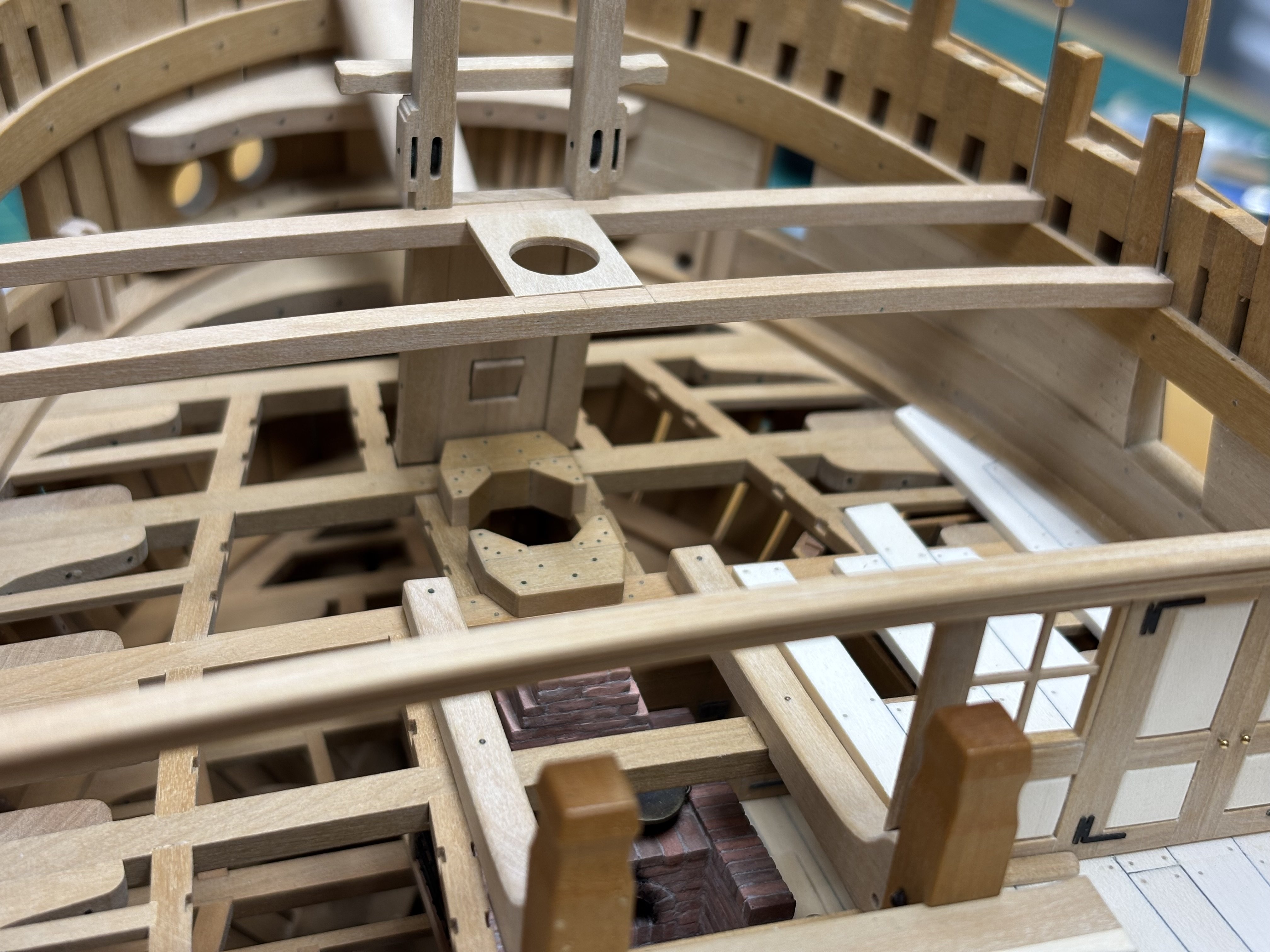

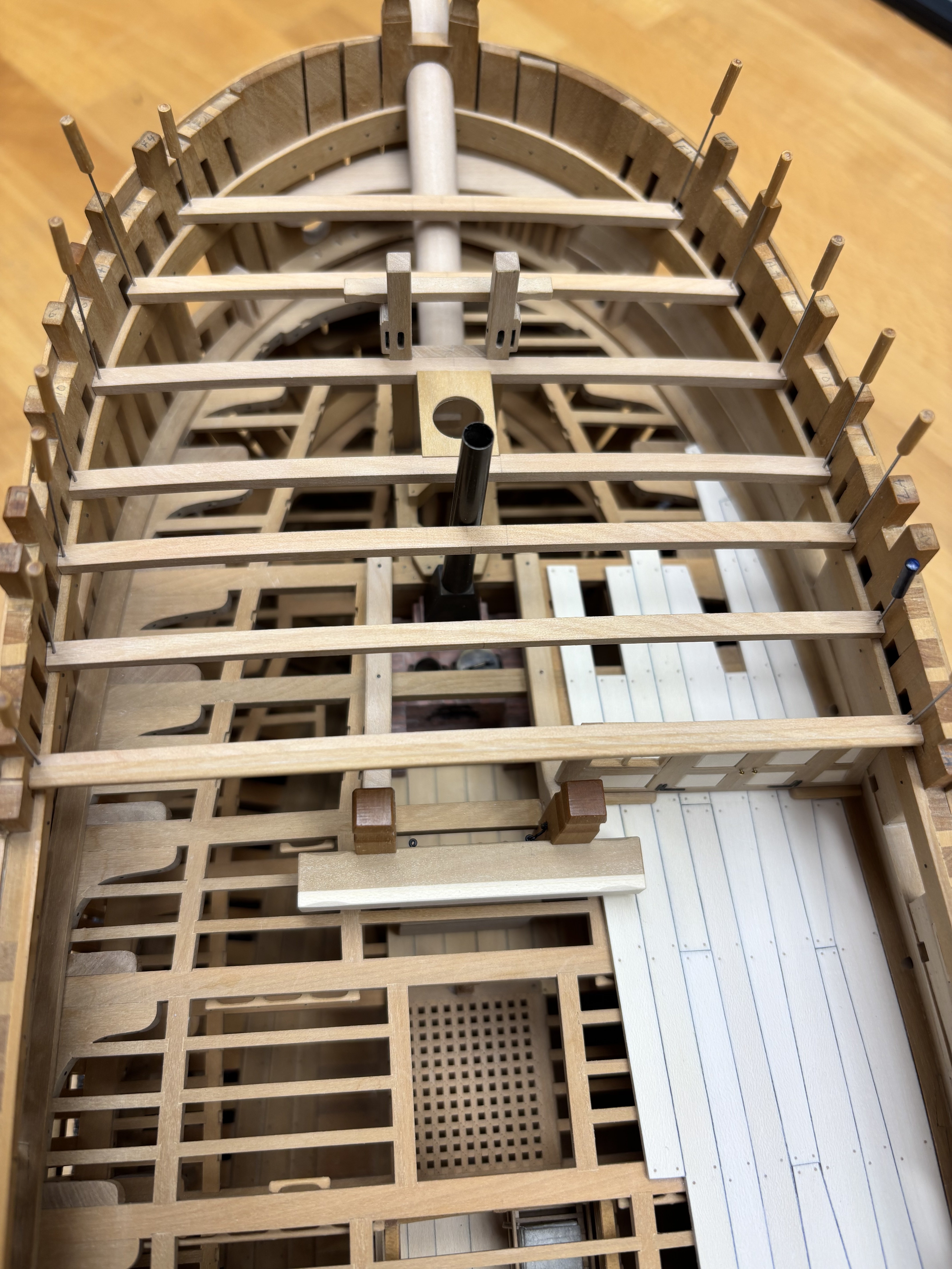

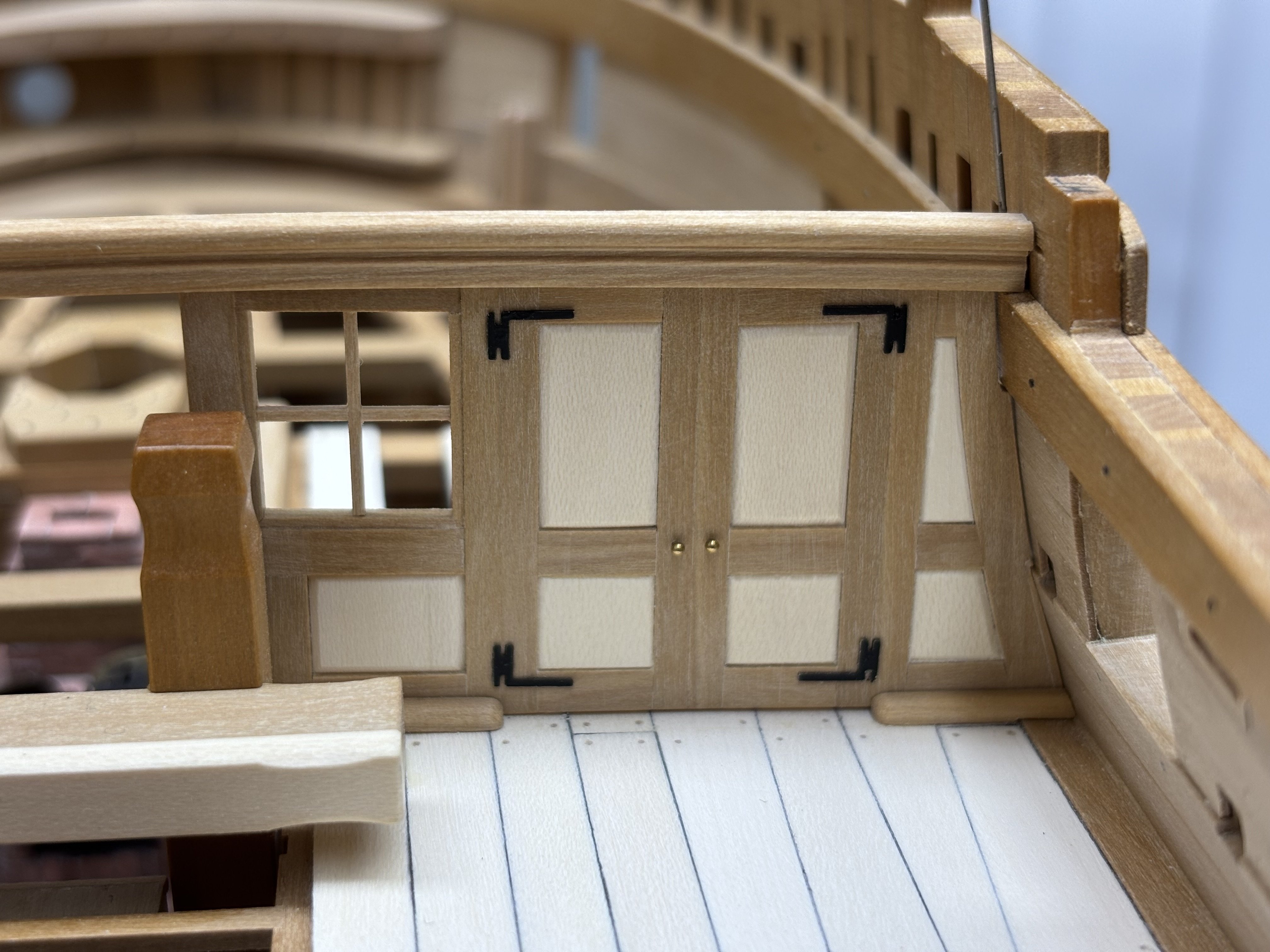

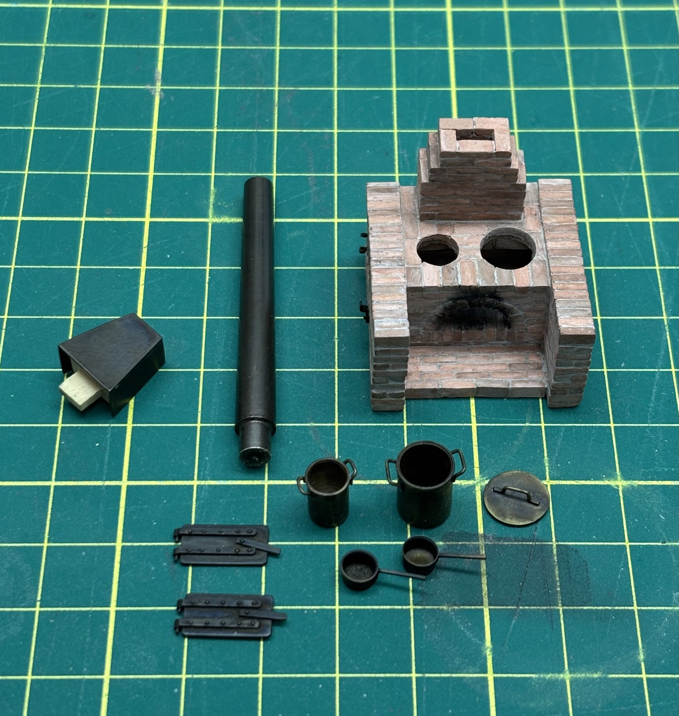

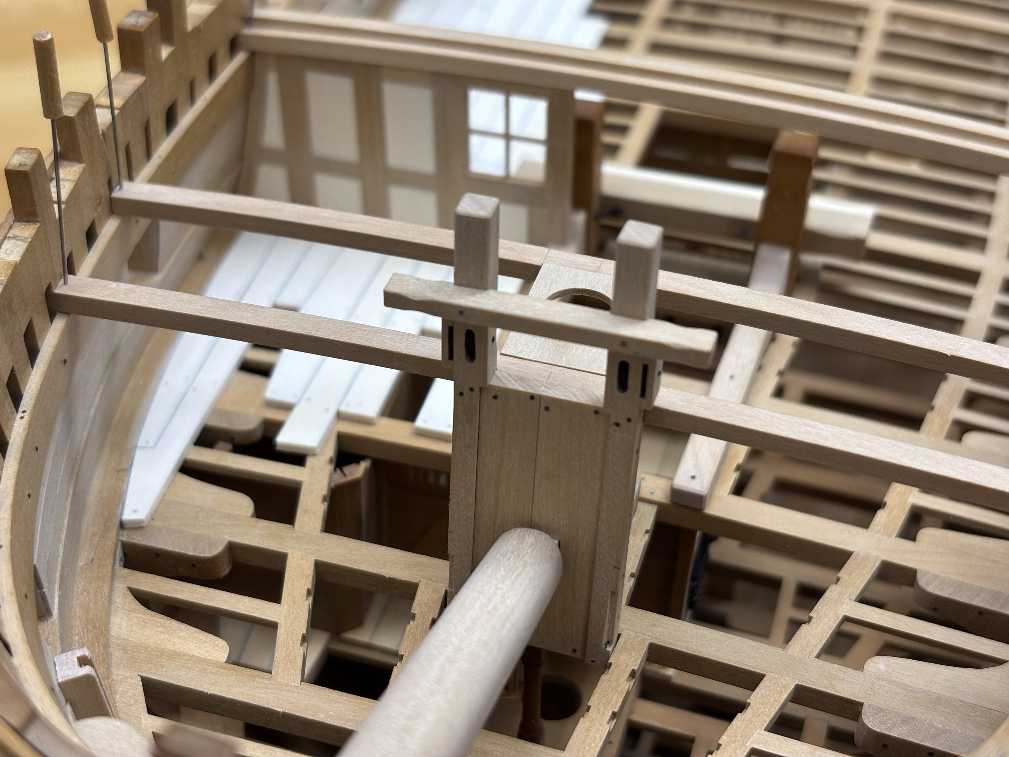

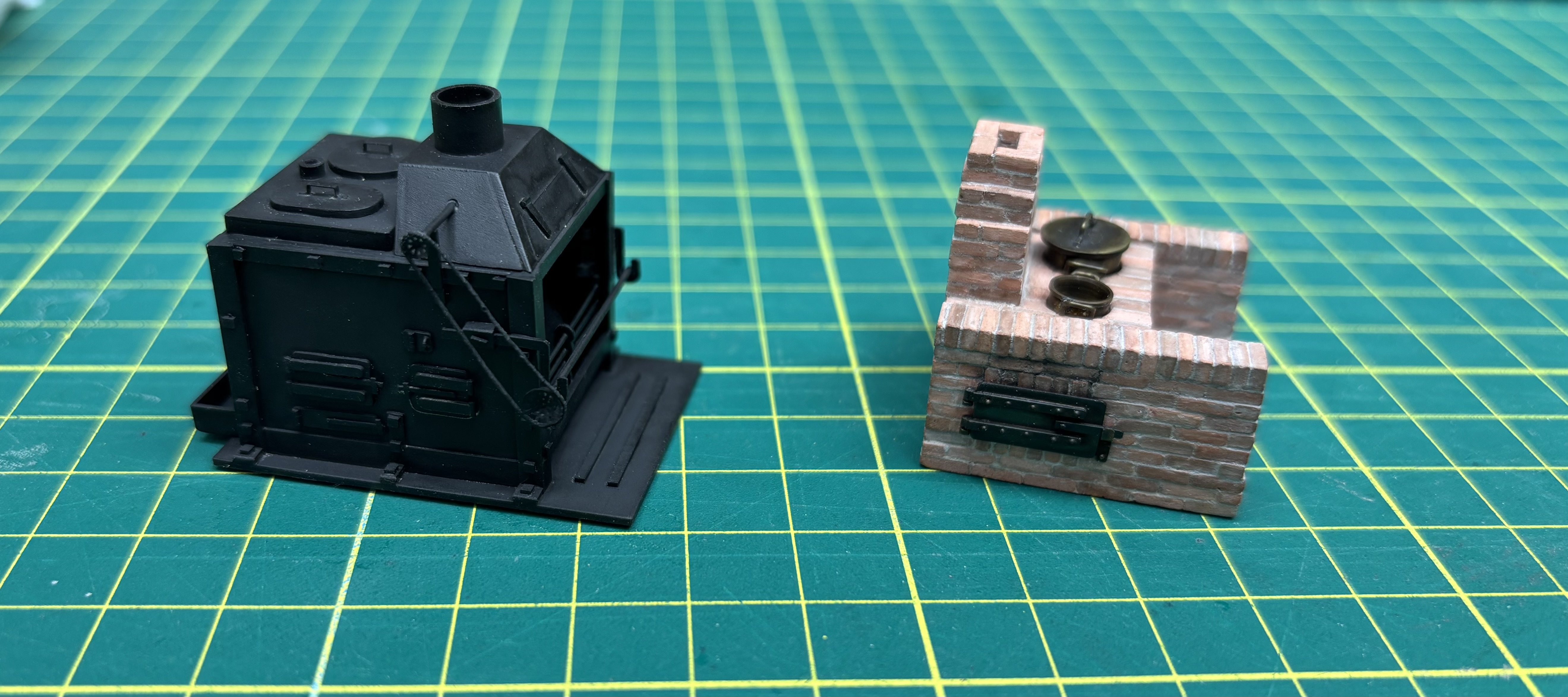

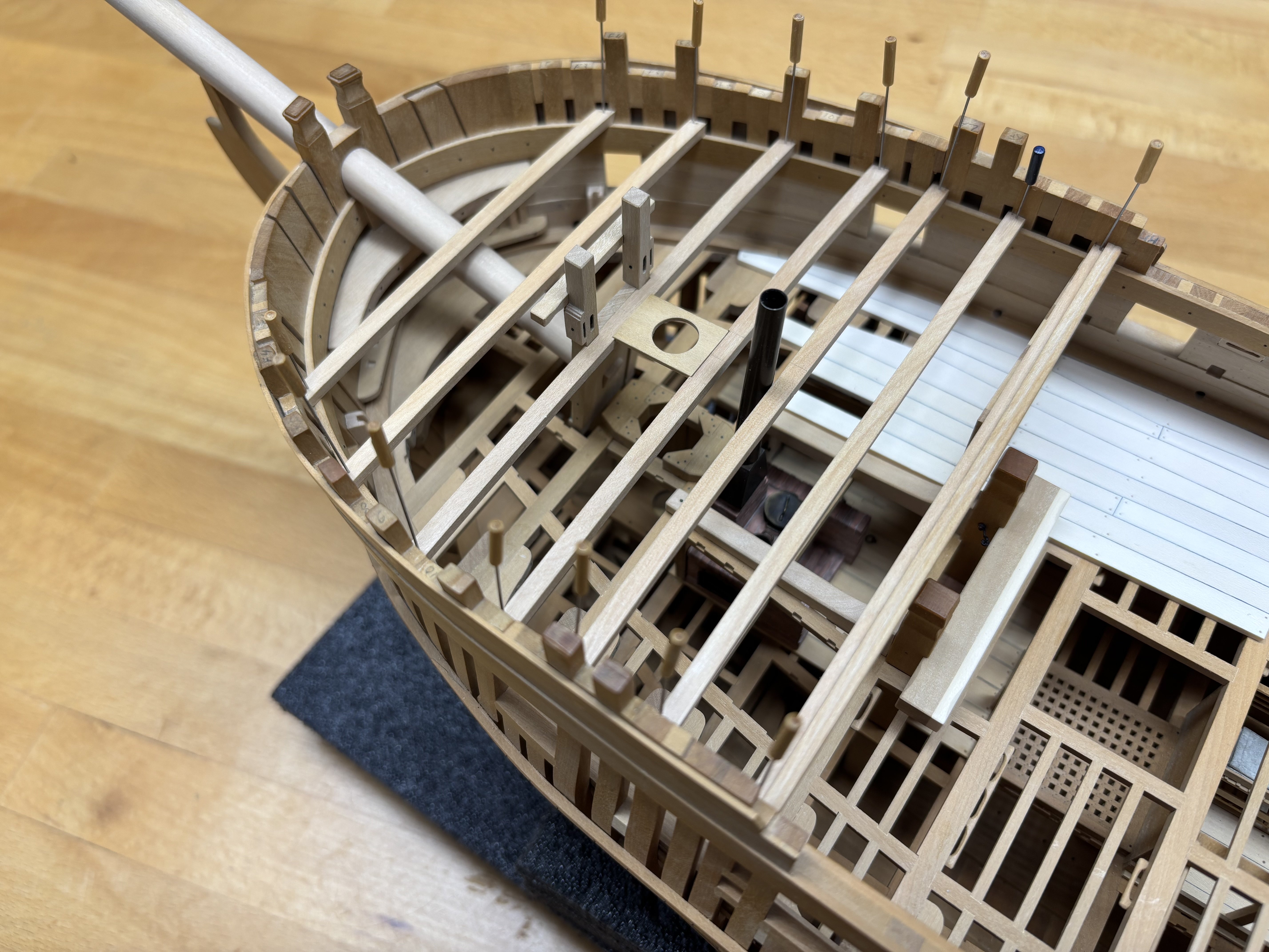

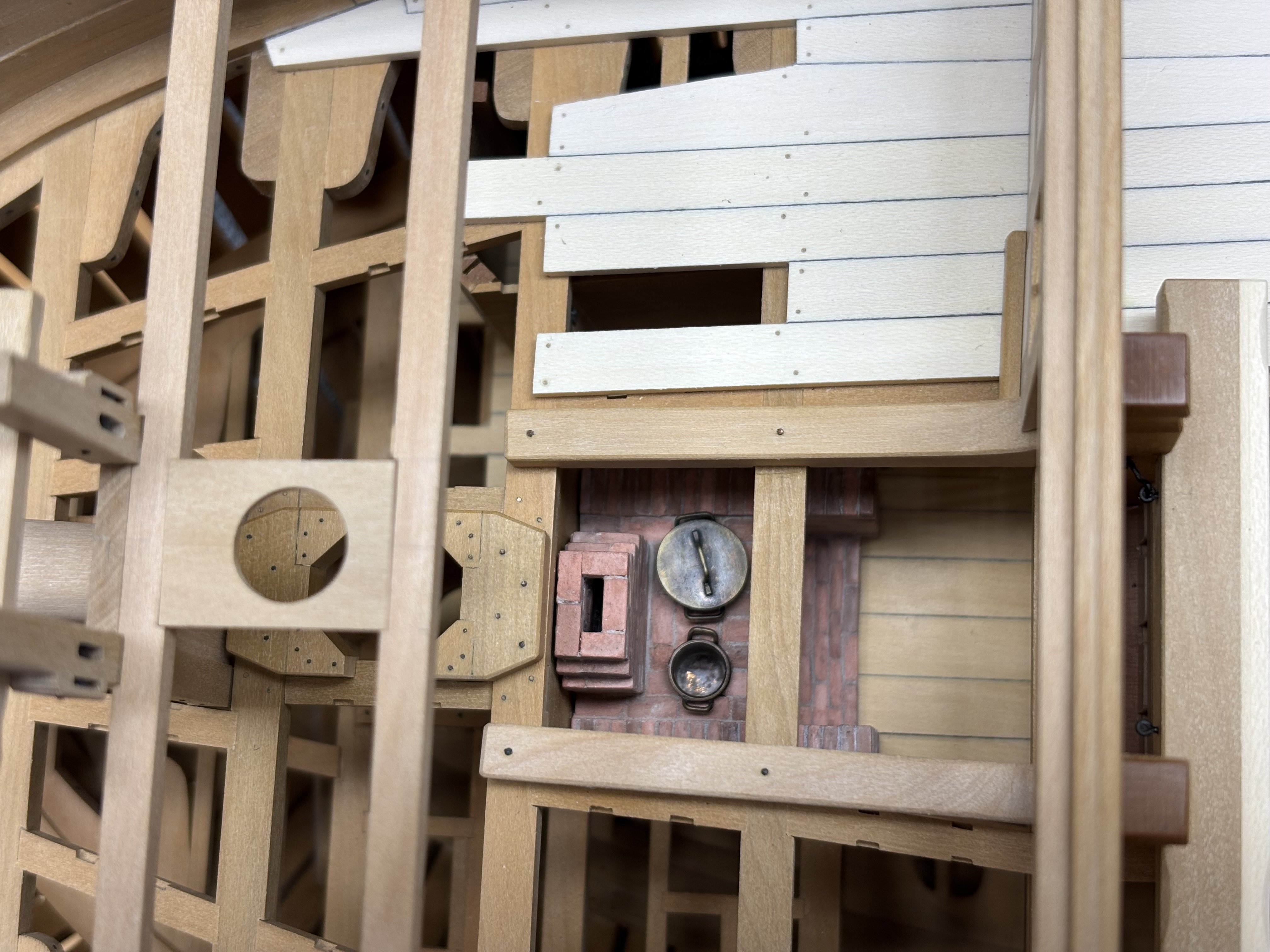

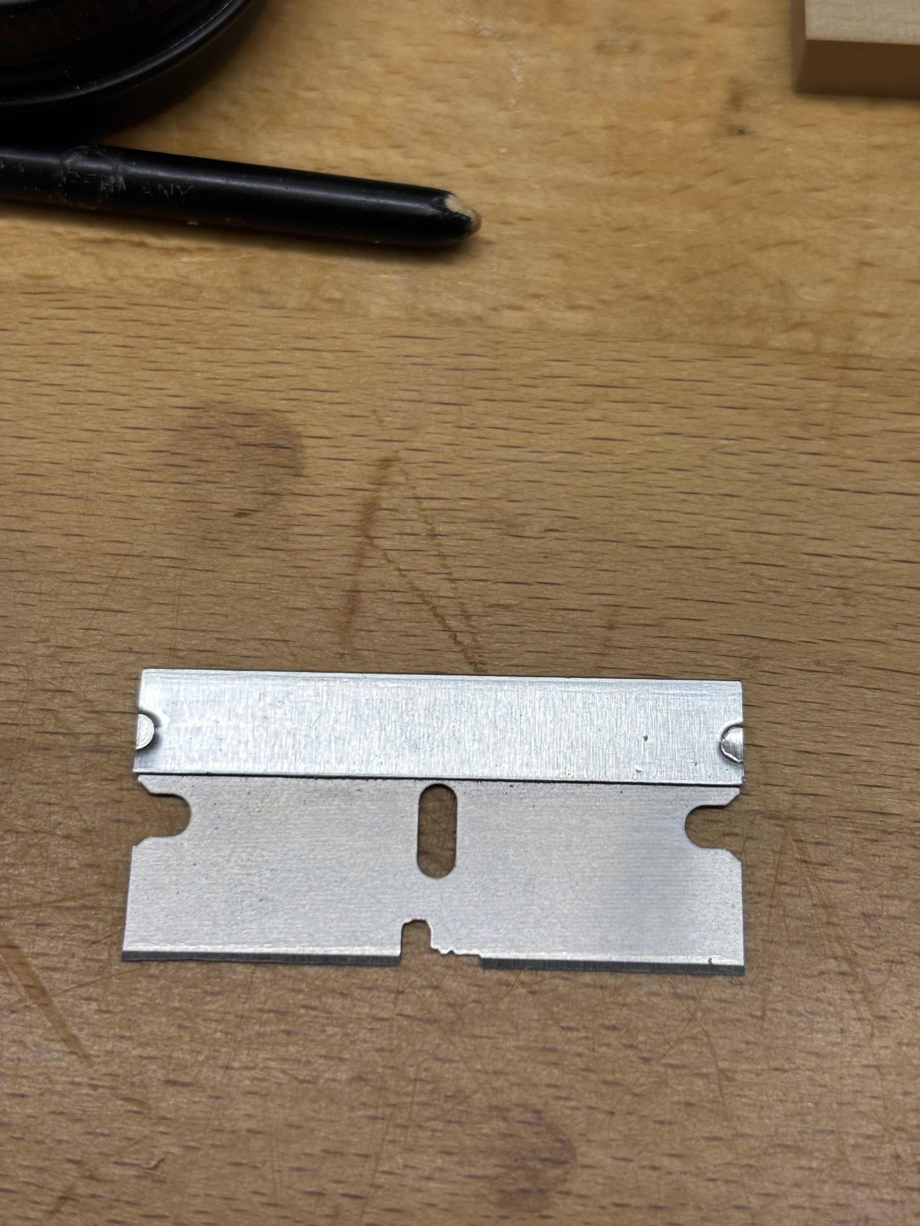

I added the bowsprit step, finished the riding bitt standard, the stove was finally put in place. I made the stove a long time ago, based on the NNM plans I decided not to use the Brodie stove but a brick stove. The Brodie stove I have made too, eons ago, but it will stay in the parts drawer. Also the forecastle bulkhead was build and added. The Breastbeam (the aft most beam on the Forecastle deck) took some extra care because it has a molding. This was carefully added with a custom scraper

Lovely work, as usual! The brickwork is very convincing. Why did you opt not to use a Brodie stove, as these were pretty standard by this time. Do you have evidence to show the old style stove fitted? Or is it simply personal choice?
This was discussed a long time ago ;-):
 Short story my plans suggest the stove was on the lower deck.

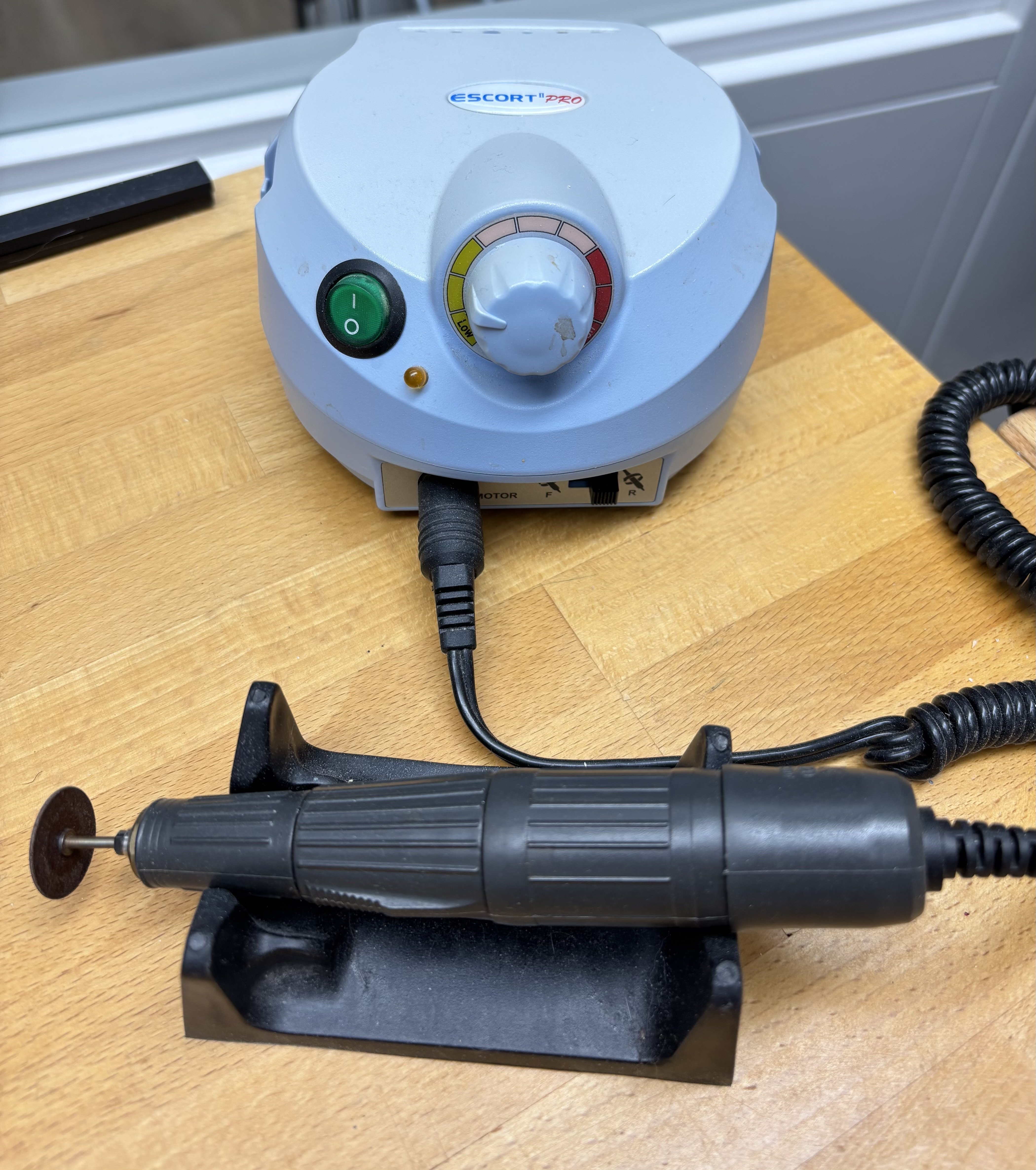

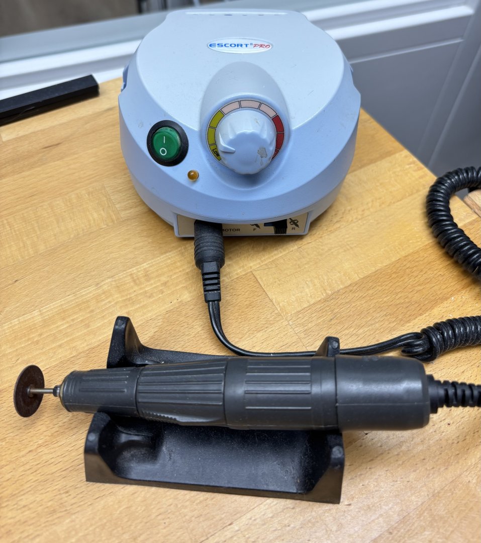

@CiscoH I used a Dremel like tool and a little patience:
