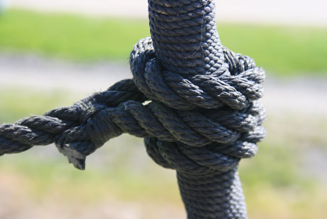

Something I always look at in a ship model is how the ratlines are tied. In actual practice on ships that used rope ratlines the clove hitch was used for all the inner shrouds but the ends of the ratlines were not tied or knotted to the shrouds, each ratline end terminated in an eye splice. These eye splices were lashed to the shrouds with small stuff. Its my opinion that using a knot for the termination of the ratline ends leaves too big of a lump- the eye splices and lashings were more of a smooth taper that did not protrude outboard or inboard of the shrouds at all. . . . . I assure you this is how it is done on actual ships.
Here is a closeup of the ratlines on the USS Constitution and it shows what you are talking about. The picture is a bit fuzzy, but it does show the eyespice on the ratline and the lashing to hold it to the last shroud.
