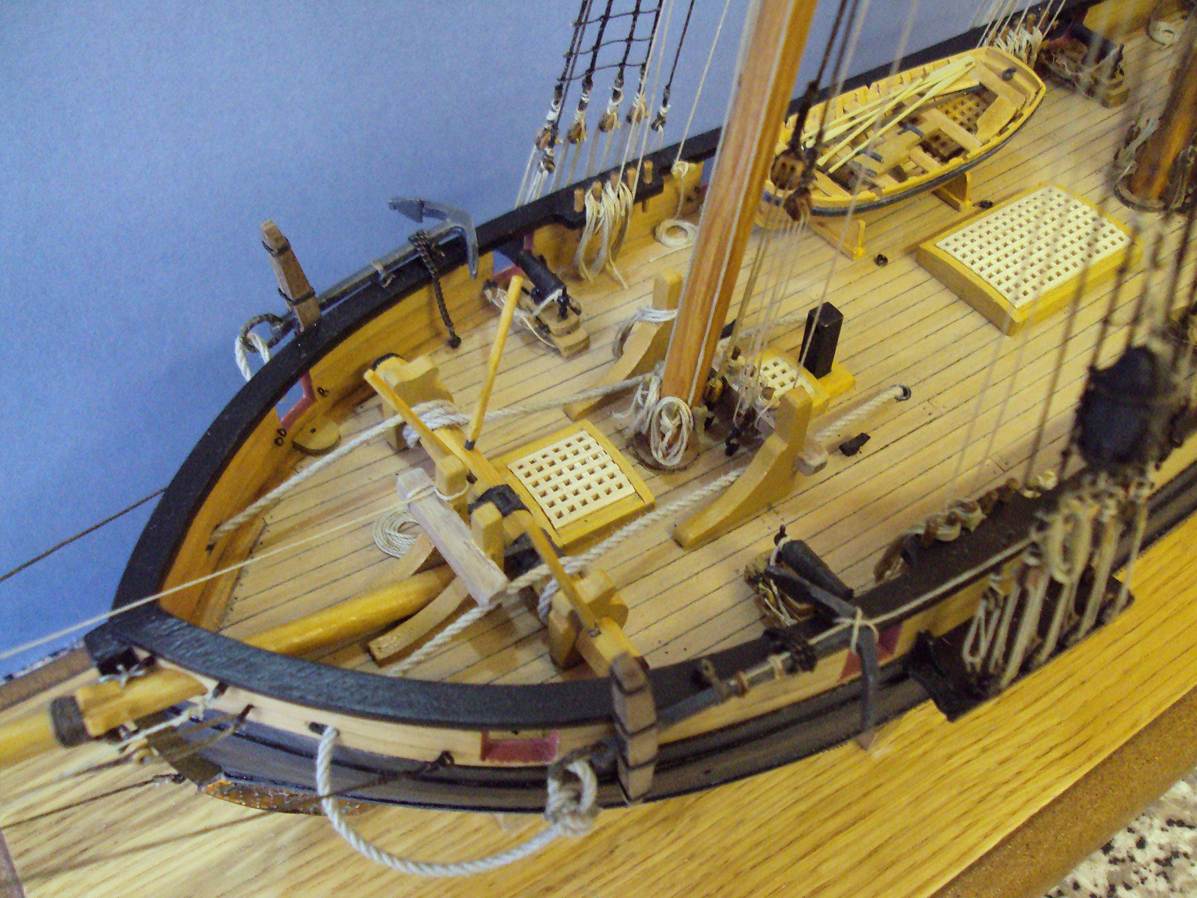

As important, could someone explain how the anchor could be raised (man handled) in such a short distance between the hawse pipes and the forward grating when the capstan is way back aft?
Seriously, I'd like to know.
I don't understand.
Alan O'Neill
Thank you, Alan,
I can’t reconcile the set-up either.
Such an arrangement seems more appropriate to smaller vessels where a windlass is used to raise the anchor and also act as the riding bitts.
075
This arrangement on my Pickle build makes more sense, altho’ I did puzzle about the use of Navel pipes in that era, but visually it worked for me.
Thanks for chipping in Richard, your Harpy is looking very good.👍
The photo’s indeed clearly show the problem, how is the cable to be handled in that short space. The large cable rising vertically thro’ a very small grating so close to the stove, just doesn’t sit right to my eye.
Using the Riding bitts does involve using the bitt post as well as the cross piece.
As you gain knowledge of the subject over the years it becomes harder to ignore apparent discrepancies but then find you can’t resolve them because of gaps in historical information.🙄
The Harpy set-up is a mystery to me, but I will dodge the issue by not fitting anchor cables. Were it fully decked I would have run the cables down thro’ the Main Hatch.
To keep things in perspective this is a minor fitting on the model that doesn’t detract from the overall appeal of Harpy.
I have made many changes to my kit for my own interest that the casual eye wouldn’t even notice.
I very much doubt that in many years ahead nautical historians will be poring over my model wondering why did he do that!

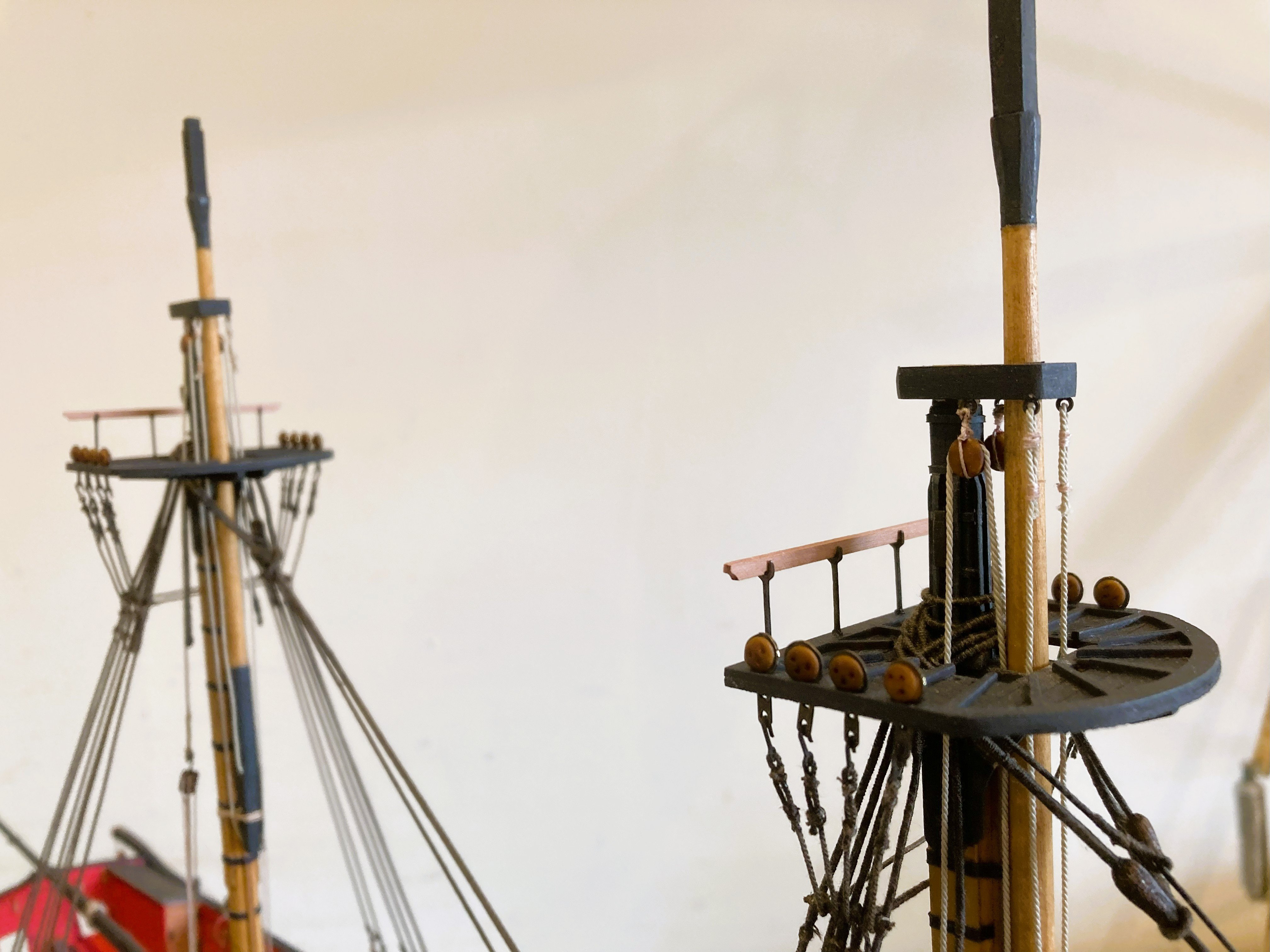

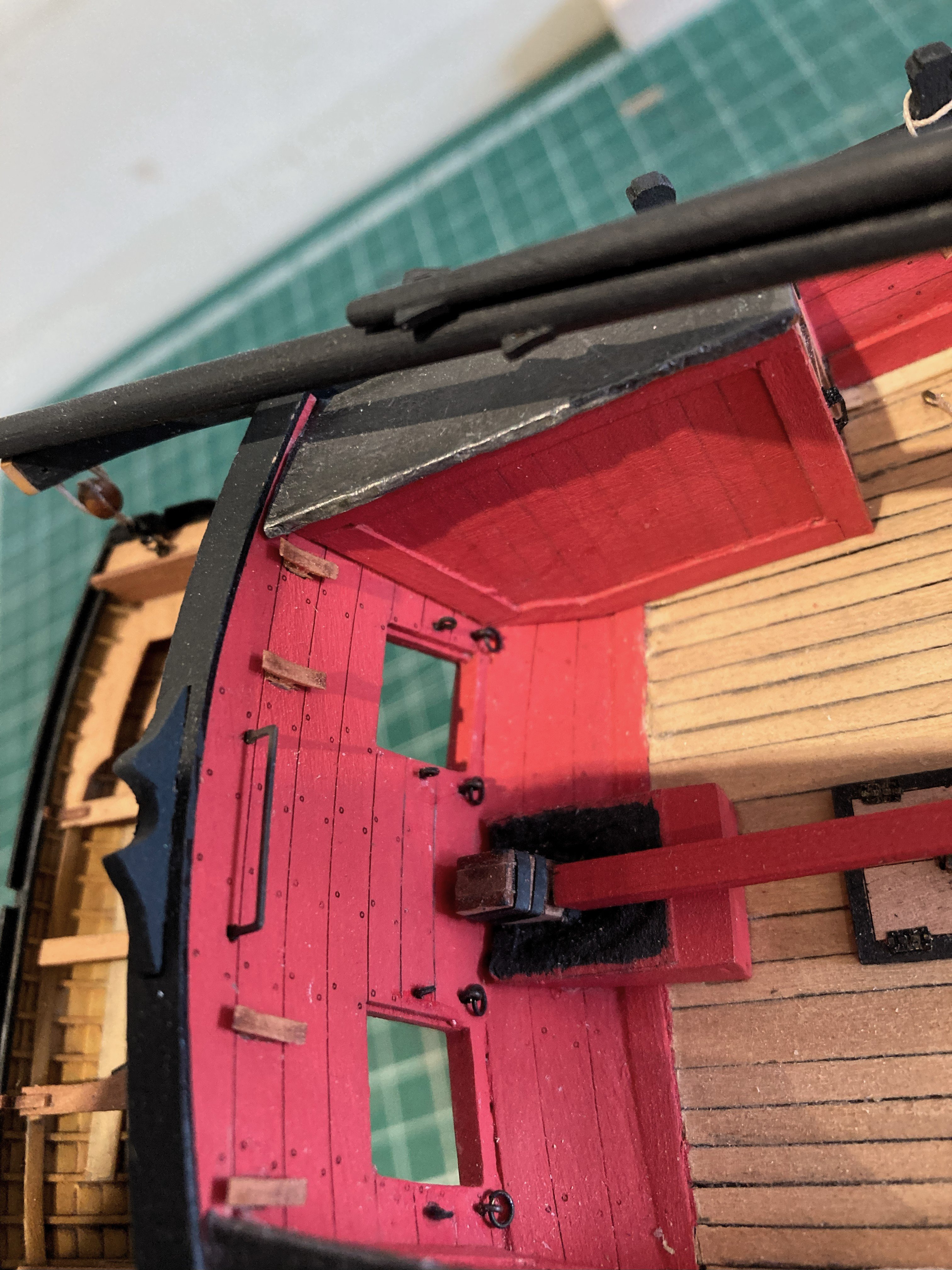

The stanchions and guard rails are added to the Mast tops, a perfect fit with nicely shaped rails in Pearwood.
5271b
The Iron horse has been added to the transom.
I am still pondering whether to add limited rigging to the booms and fit the sheets.
5266a
I added Entry steps stanchions, not sure if they were indicated on the plans, but I have a lot of these items in my spares box.
5277a

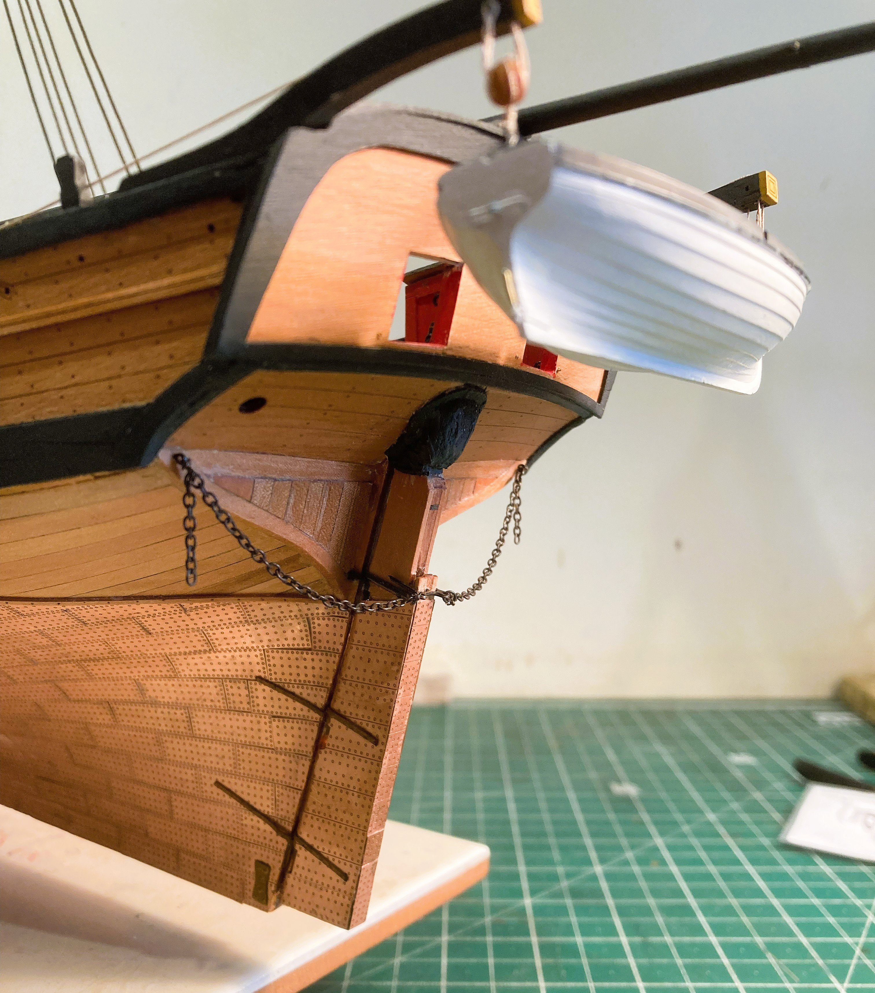

The Rudder chains are added but I have omitted the pendents.
The chains of 1mm size were in my chain stock.

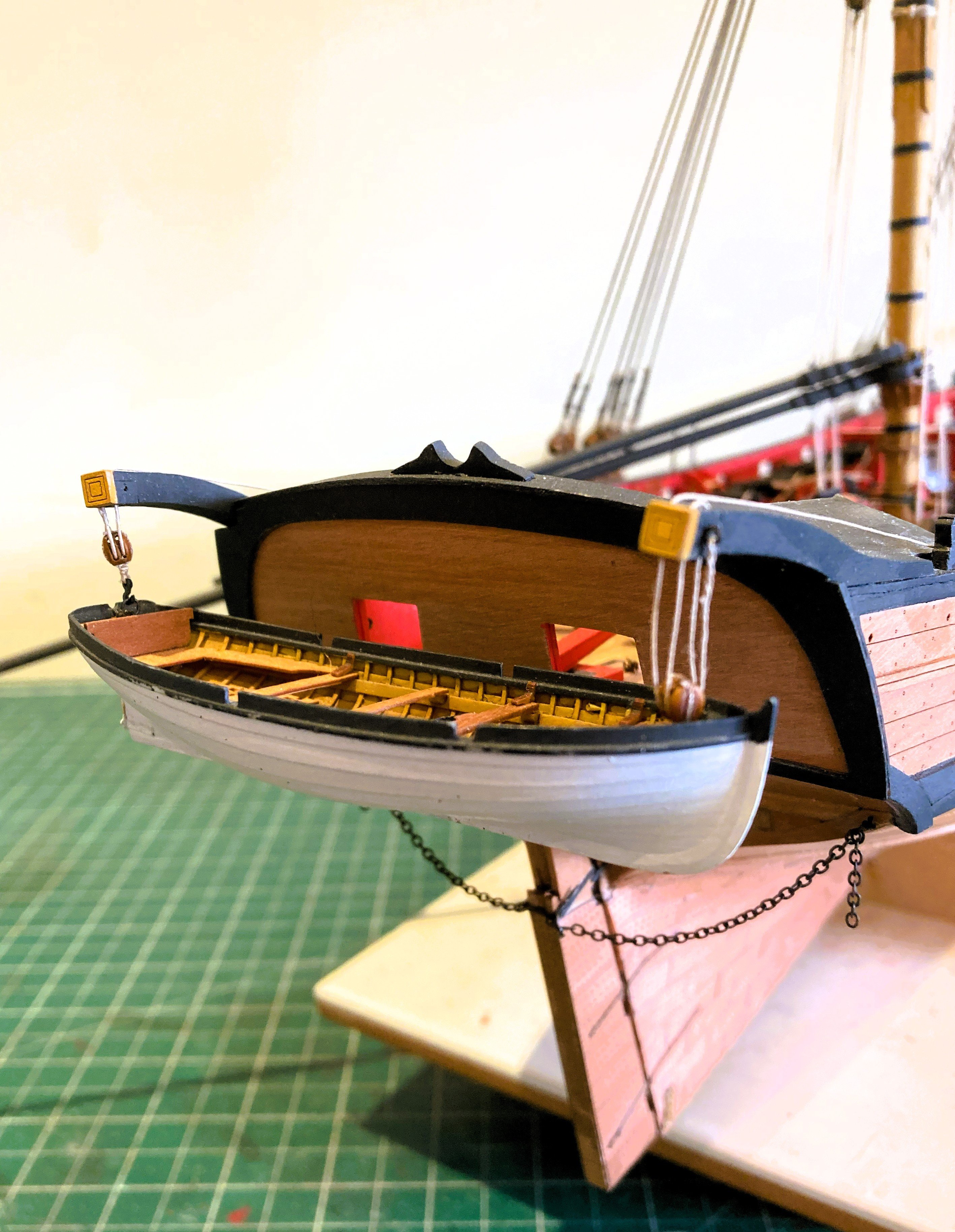

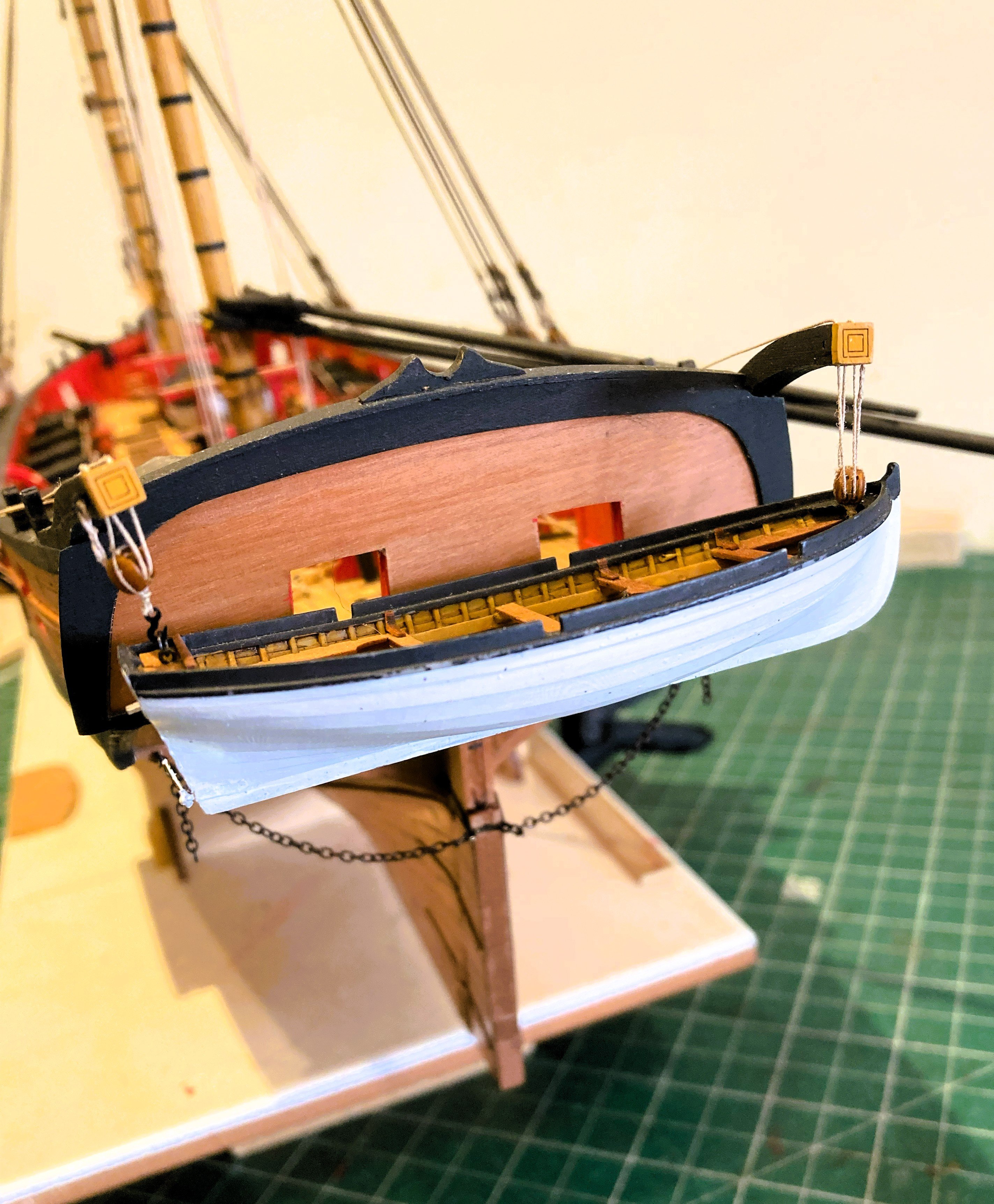

I had to re-visit the stern davit rigging which had become twisted. Attaching the boat is like working one of those Fairground crane grab machines, multiple goes, but at least success is obtained eventually.

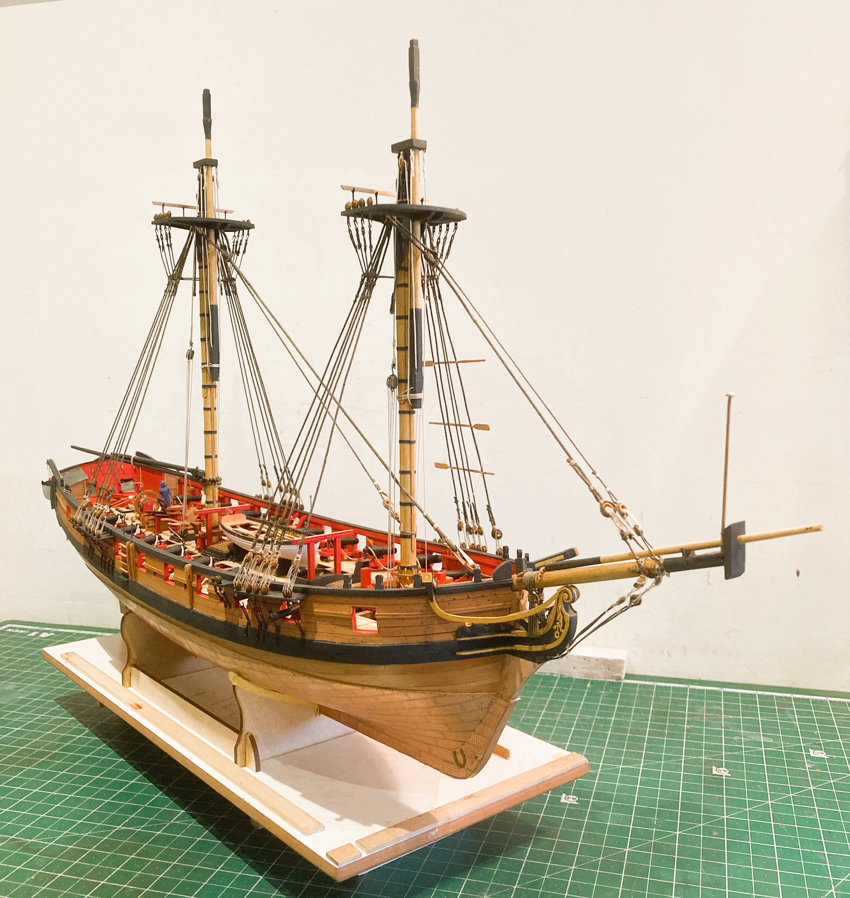

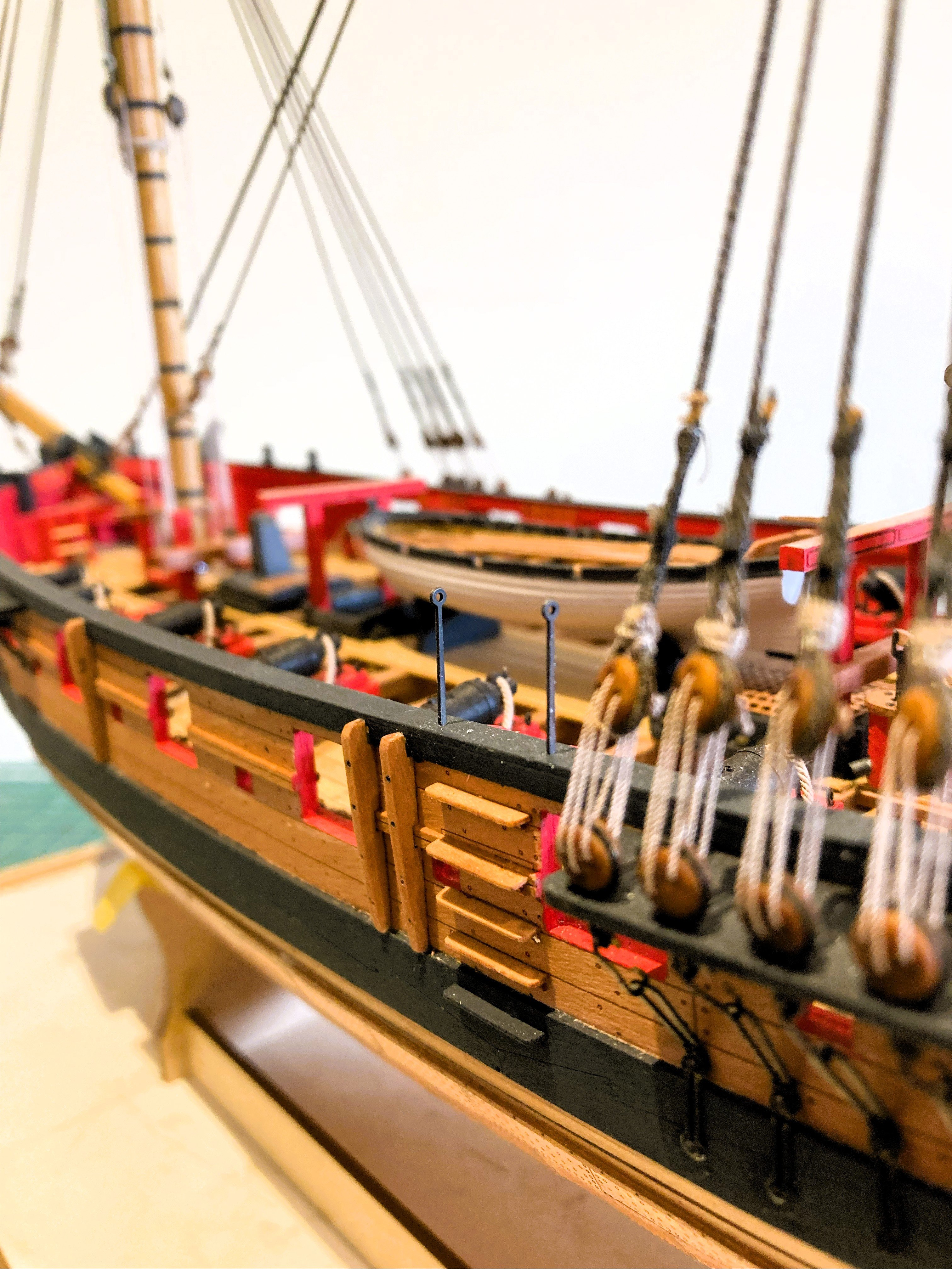

After eight months of fairly concentrated work this project is now complete.
This has been an interesting kit to make and one that has taken more time than I had initially imagined.
I had a lot of questions in my mind about certain details and fittings etc; for which there is scant information, and which remain unanswered.
Even so, Chris has done an excellent job of creating ‘Harpy’ which makes up into a very attractive model with lots of deck interest.
A fine addition to the Vanguard range of kits.

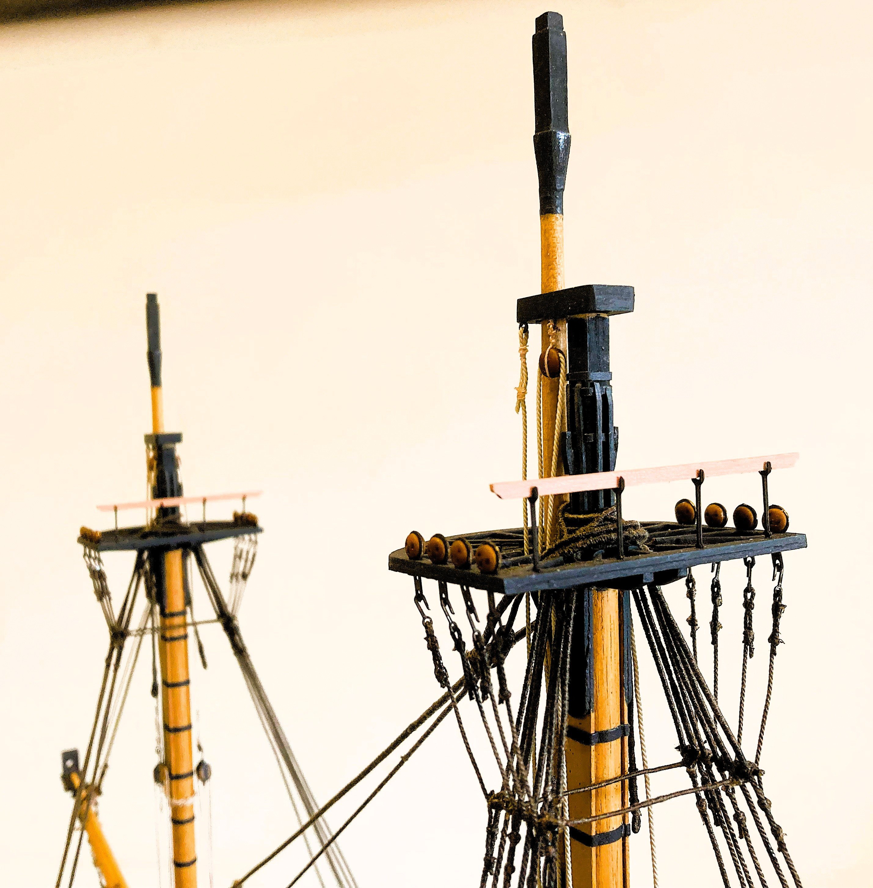

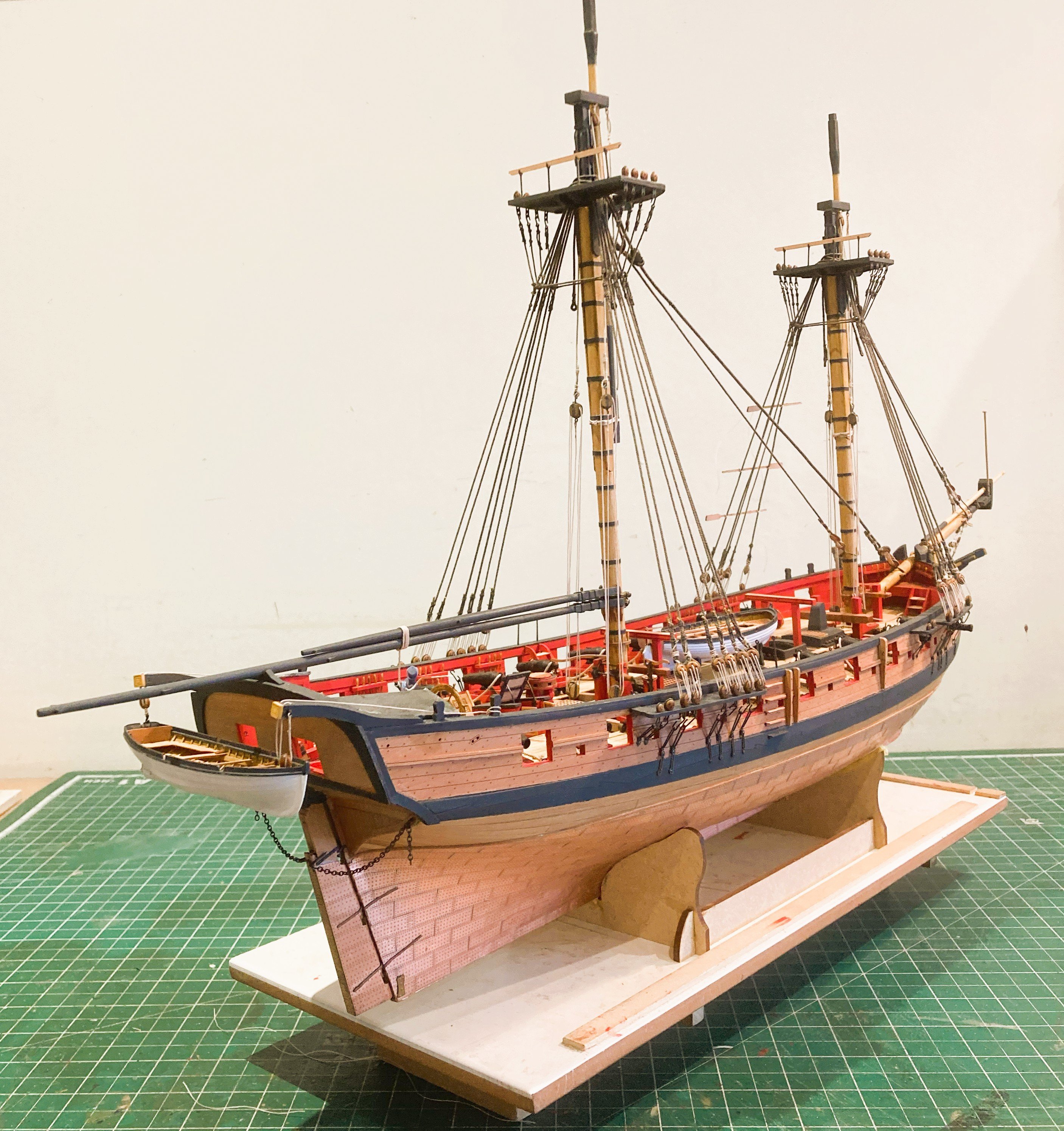

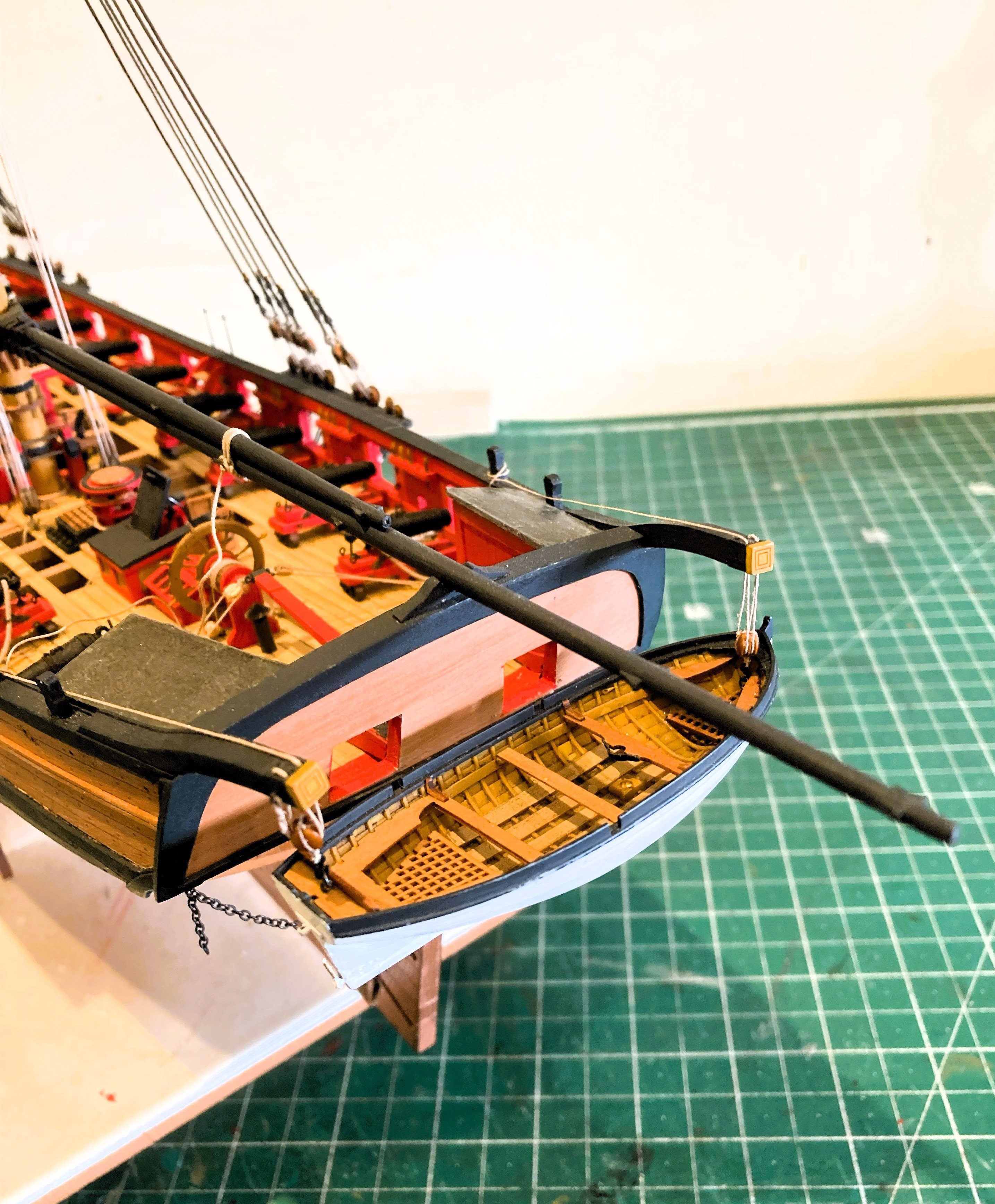

The completion Photos (part 1)
These are the full hull shots that will feature in my usual build Photo book.
5446b
The display stand has been completed, I do like keel blocks as part of the support, a design that has featured in several of my models.
5448a
5450a
5461b
5452a
5453b
5458a
5462b
5472a
5474a
5476a
5480a
