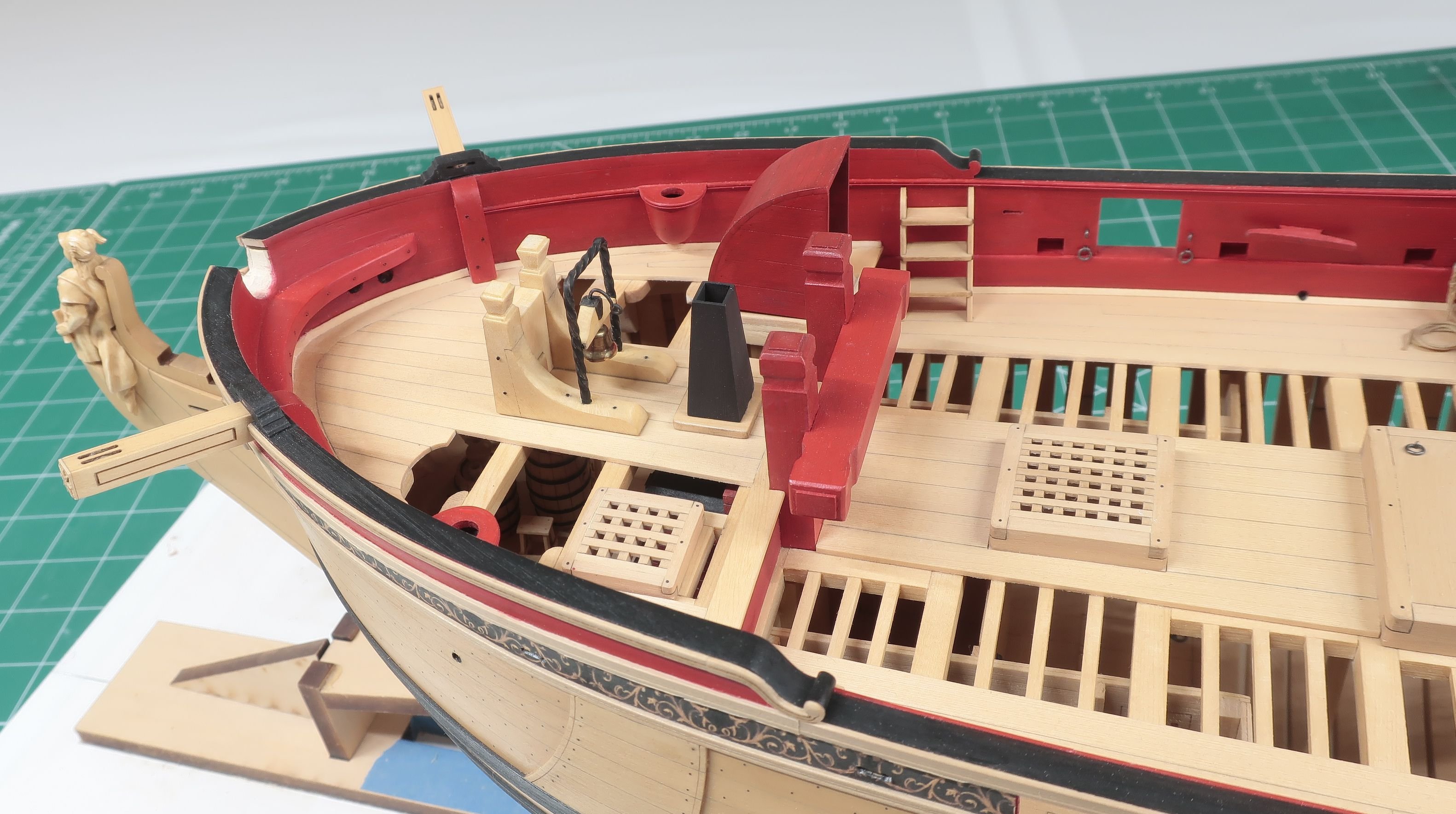

There are four ladders to be built.   Two leading to the poop, and two leading to the fcastle deck.  These were made exactly like the others we have made for speedwell.  Everything is laser cut.  I just cleaned the char and assembled them.  One note however...because of the deck roundup, the ladders leading to the poop deck need some tweaking after being built.  The bottom of each side was left a tad longer so you can sand the inboard side shorter.  You will need to do this so your ladder doesnt slant when you place it against the bulkhead.  You want it vertical with the columns of the bulkhead behind them.  So that inboard side will need its bottom edge shortened slightly.
Its the little details.

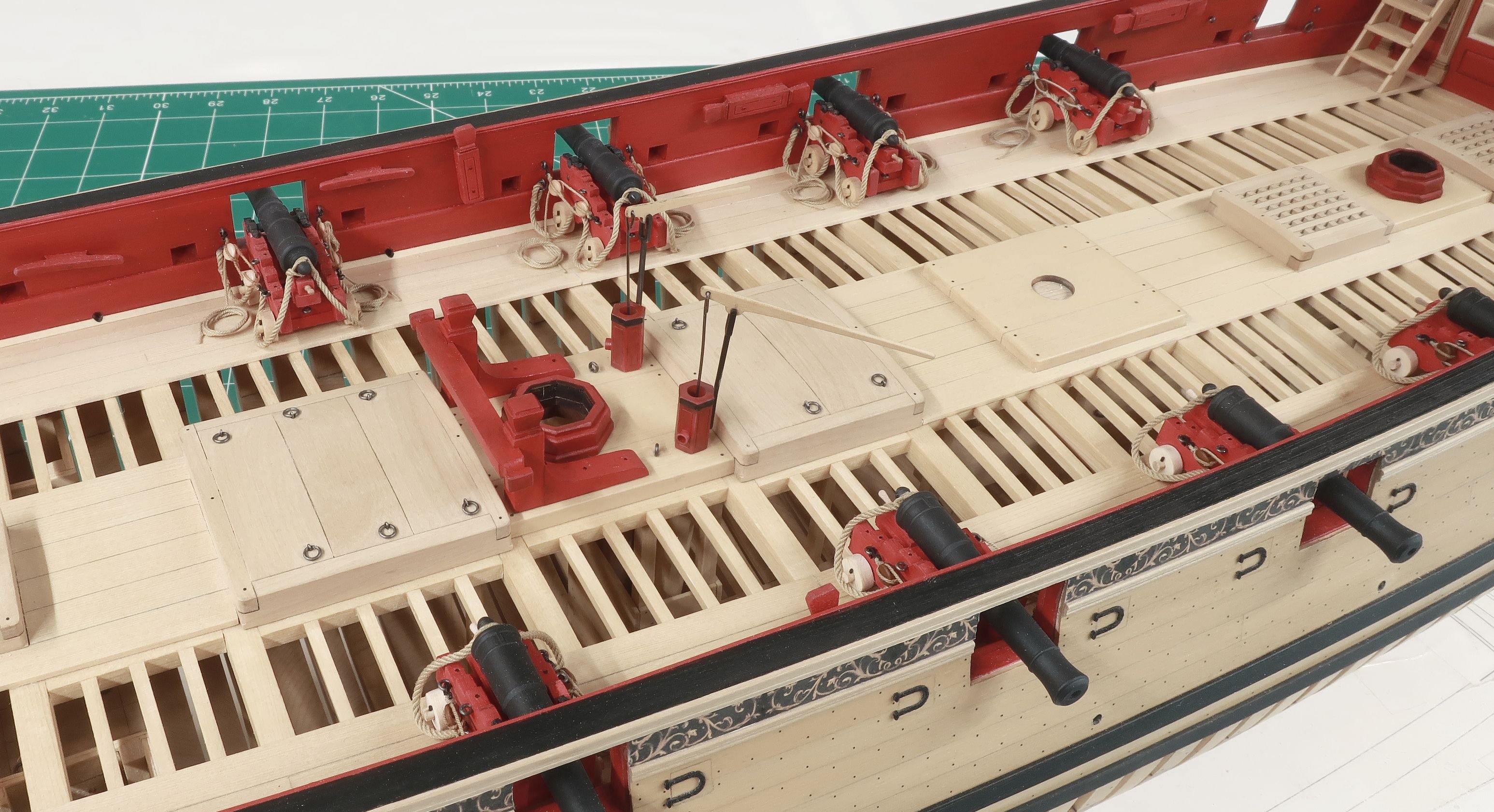

Here is the shorter ladder up to the fcastle deck...and you can see the guns that I finally finished rigging.  Those are my Swiss Pear color 3D printed blocks used for the guns this time.  I switched them out to try both colors.  I think I will fully rig her with the Swiss Pear blocks now that I see them on the model.
In addition, I also finished the stack for the fire hearth...I had built this a while back when I made the fire hearth but it must have gotten lost during the move.  So I made a new one...I will also include those parts in chapter 9 in case anyone loses theirs as well.  Nothing difficult here...fake it till you make it.  We wont be using a real coaming here.  Its just a laser cut boxwood square basically.  Sand the char off and apply some WOP.  Then center the hearth stack where the laser etched reference is and you are finished.  I also knocked off the top edge all around this simulated coaming.  No hard edges for me!!
Here is what the stack looks like on the model.

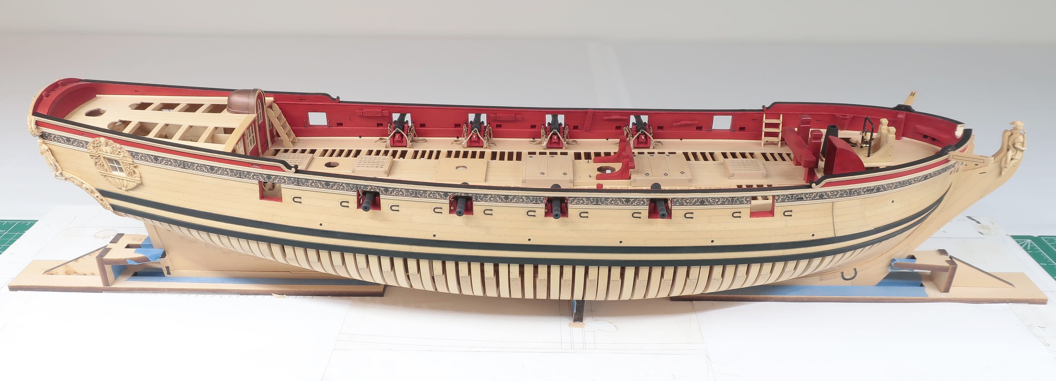

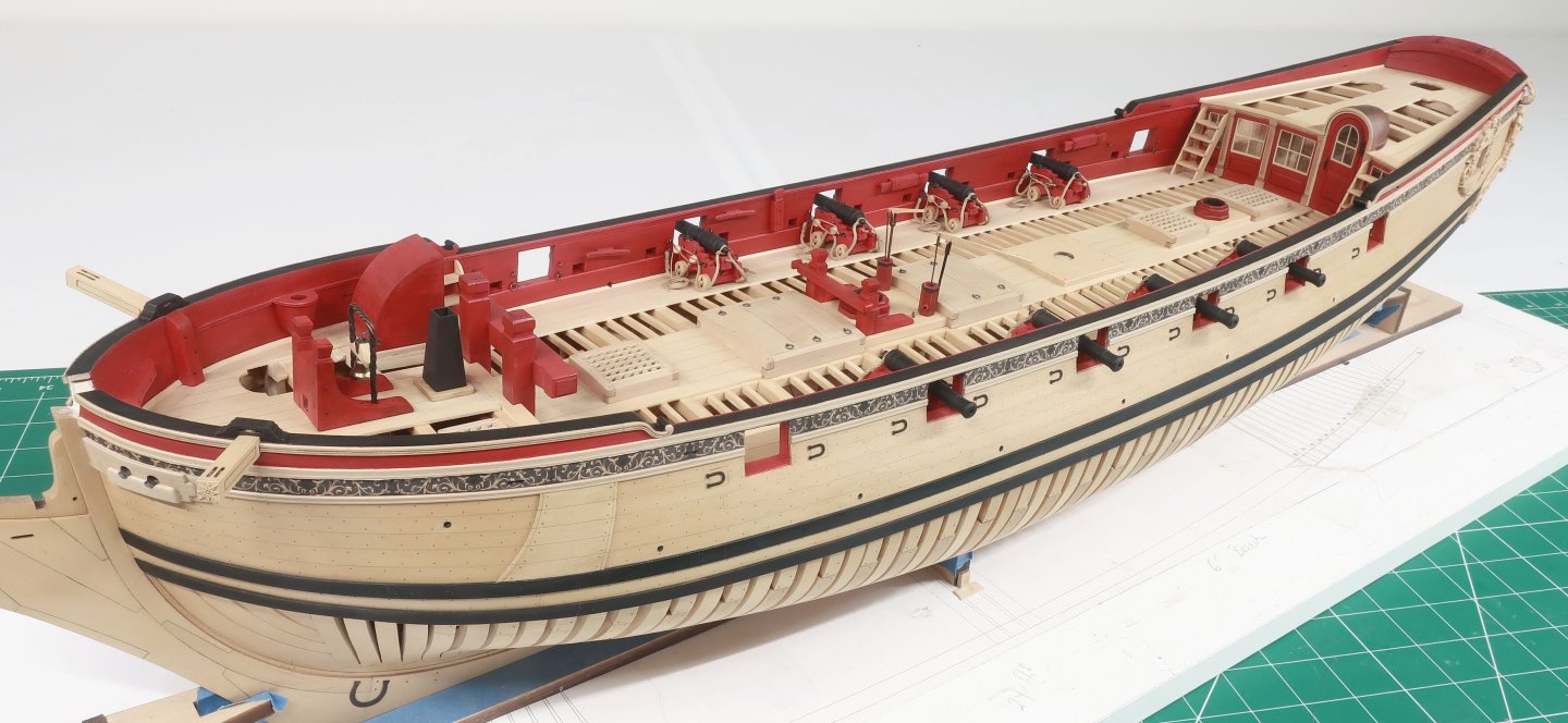

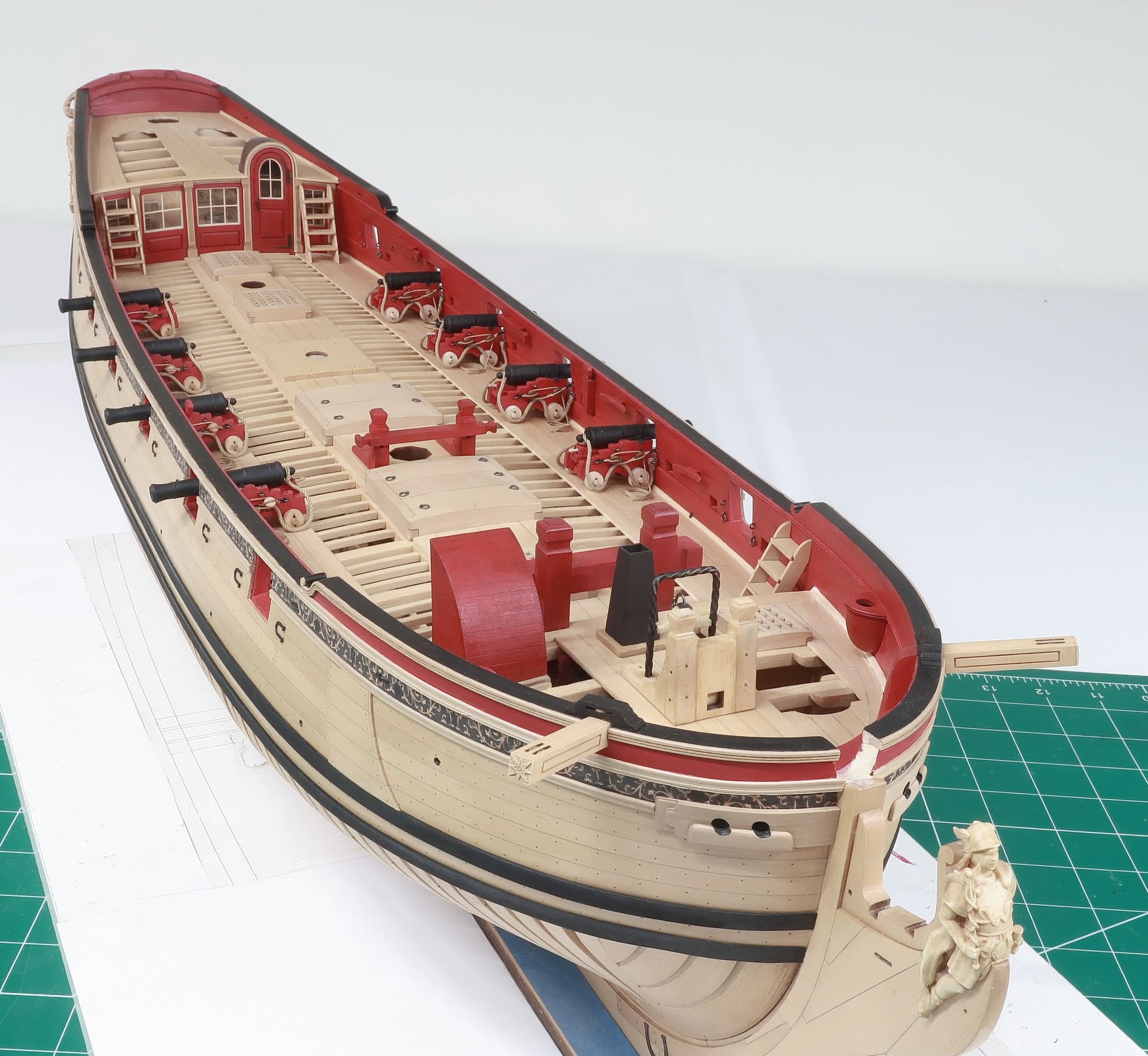

And here is an overall shot of the progress to date although I have some paint touch-up to do and some dust clean-up.  But its really nice to making some progress again.  Next up I will be finishing up the fcastle deck fittings.

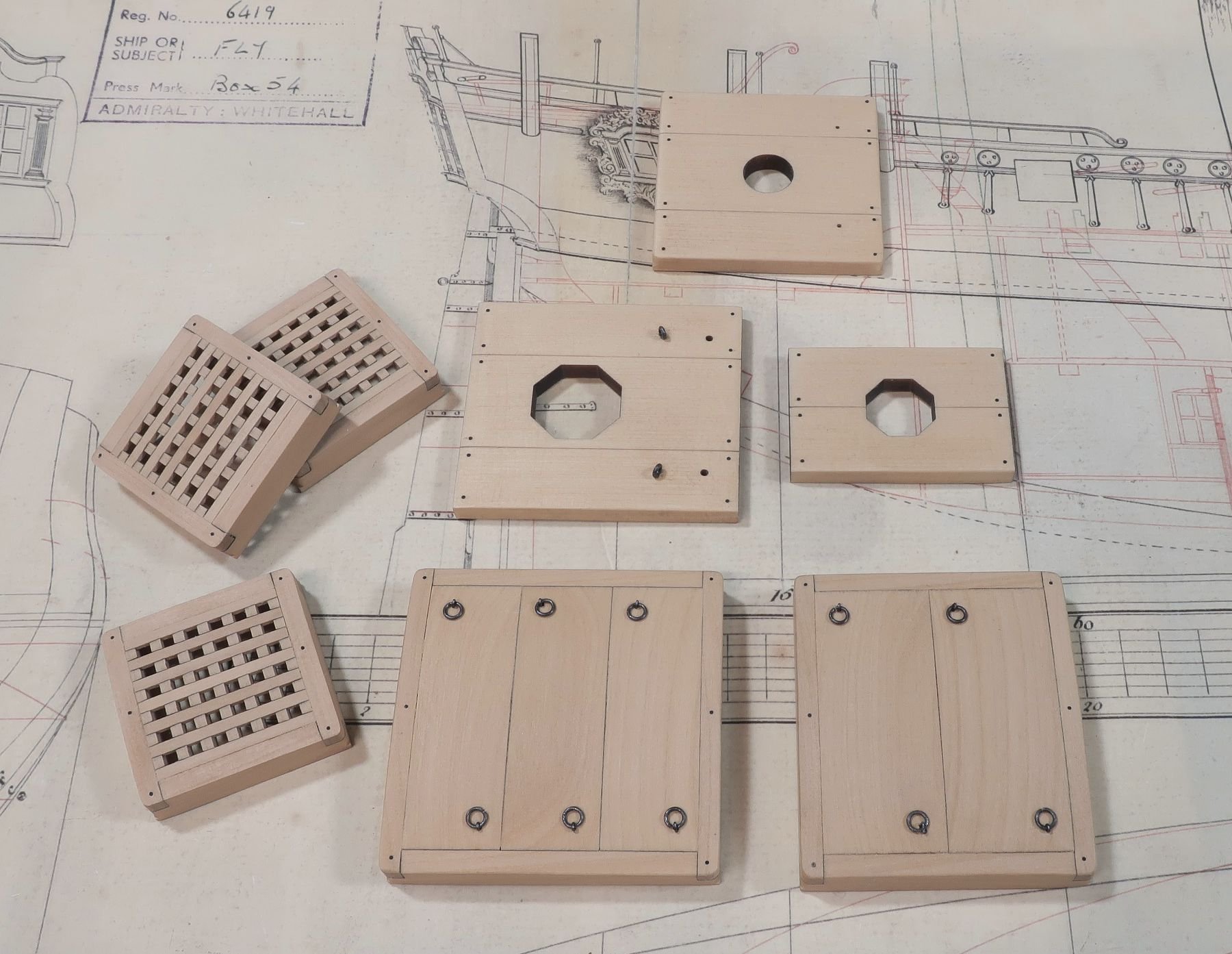

Making the hood for the fcastle companionway it is pretty straight forward but you have to be careful to align the sides properly before adding the top planks.
It is all laser cut.  Here are the pieces.
The two thick squares are crucial to its fit when completed. They are laser cut slightly wider than the coaming.  You need to sand the sides until the square is a nice press fit inside the coaming as shown below.
Then you can glue the two squares together to form an "L".  This "L" is the proper width if your squares were a nice fit in that coaming.   Then clamp the two side panels to them so you can start gluing the thin cover boards to it that form the roof.  The one thing you must be sure of when clamping the sides onto this fixture....dont glue it to the fixture!!!  Its just used to properly align the two sides the correct distance apart.  In addition, the two sides are no the same height. One side is longer than the other....the starboard side is longer.  This is because of the deck round-up.  So when clamping them to the fixture you must make sure the top edges are lined up and even.  See it below in relation to the squares on the mat.  The bottom edge shows each side being a different length.  But the top must be squared up and even.
Then start gluing the cover boards onto the sides.   One at a time.  But as you proceed, you must bevel the side as you are placing them on a rounded shape.  But dont over-do the bevel.  You dont need too much.
When you are almost done with the boards, the last final board is laser cut wider and at an angle to compensate for the bottom of the hood being at an angle.
When its all done you can sand the sides flush which were slightly longer than needed to clean it all up.   Then its time to test its alignment on the model.  It sits on top of the coaming...not within the coaming.   Look at it from dead on and from the side.  Make sure its straight and vertical and leaning to one side when viewed from the bow.   Make sure it is not leaning when viewed from the side.  You can sand the angle of the bottom of the hood to adjust any leaning.  Once satisfied, move onto the next step.
Now its time to cut small lengths from a 1/8 x 1/64" strip.  This is glued half onto the inside of the hood with the other half forming a nice lip.  This will be inserted into the coaming when done.  It should fit perfectly if your two squares and fixture was the correct width.
I am guessing that this hood was portable and removable.  So you dont even have to glue it in position if you have a good fit.  You can leave it natural or paint it bulwark red.  Its your choice.   I have painted it red to continue following the look and color scheme of the contemporary model.  The seams and joints and nails do show through after painting it but its very subtle which I prefer.  Mine is not glued in and it will prove useful as I may be removing it from time to time as it may get in the way of doing other work up there.  Now onto the bowsprit step....and belfry.

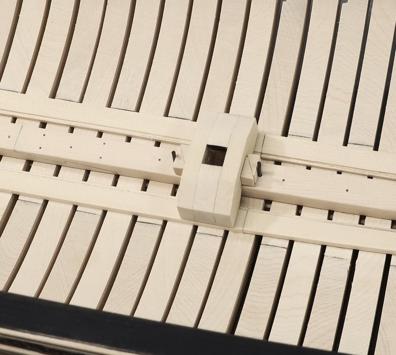

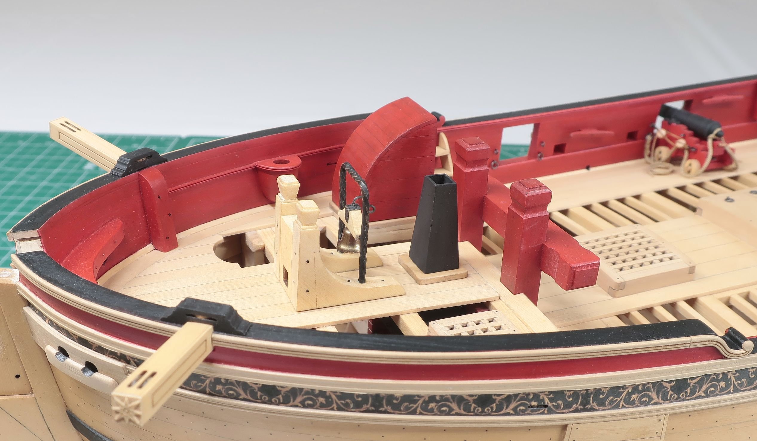

Anyway...the bowsprit step/Belfry was up next. At this point none of the fittings are glued on deck.   I am not yet sure if I will paint it red or leave it natural.  The contemporary model has it painted red but the paint is so worn and light on that model it all pretty much blends in to everything else.  So I will wait until all of the fittings are made to determine whether I paint this.  I know the heel of of bowsprit inboard will be painted red so I will wait to see if painting the bsprit step red would be too much.

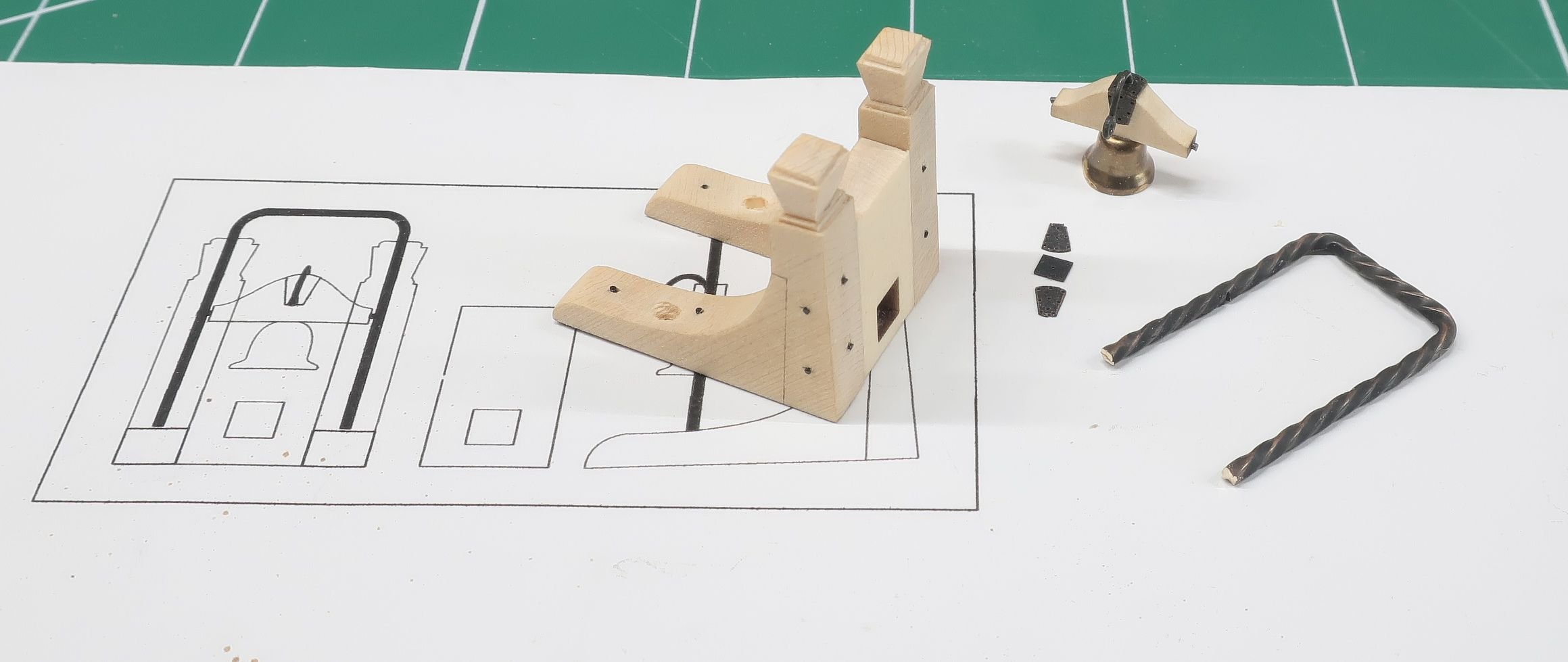

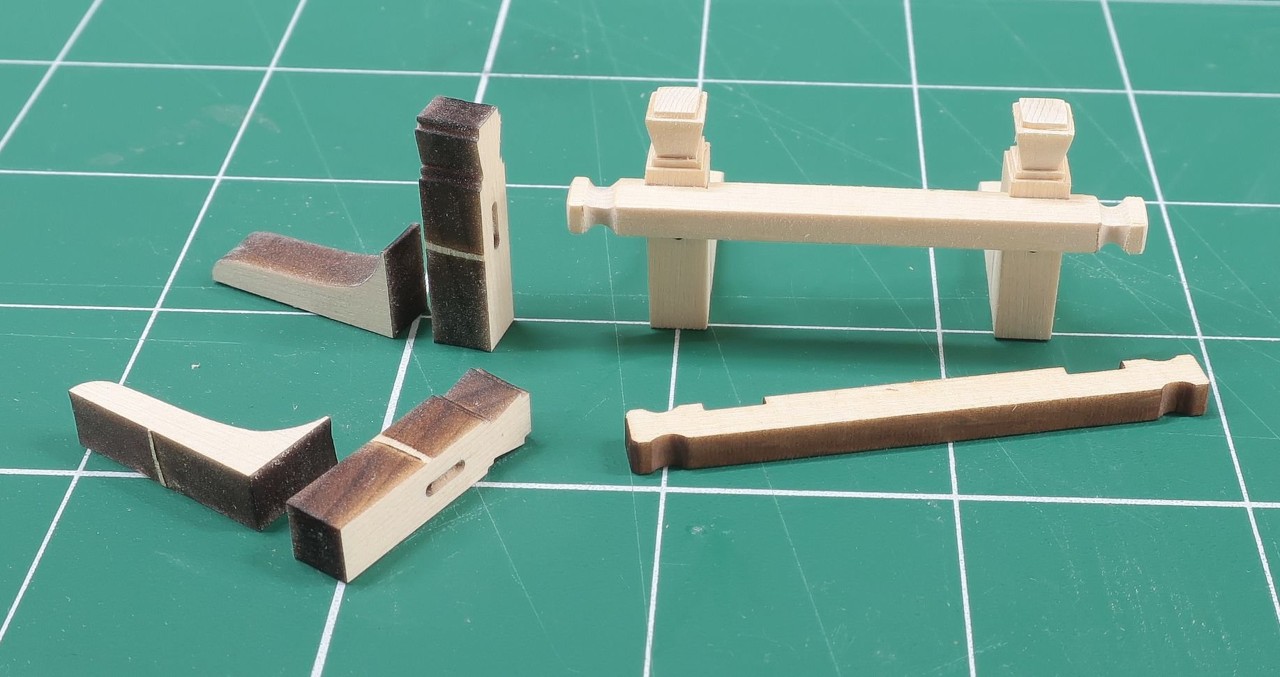

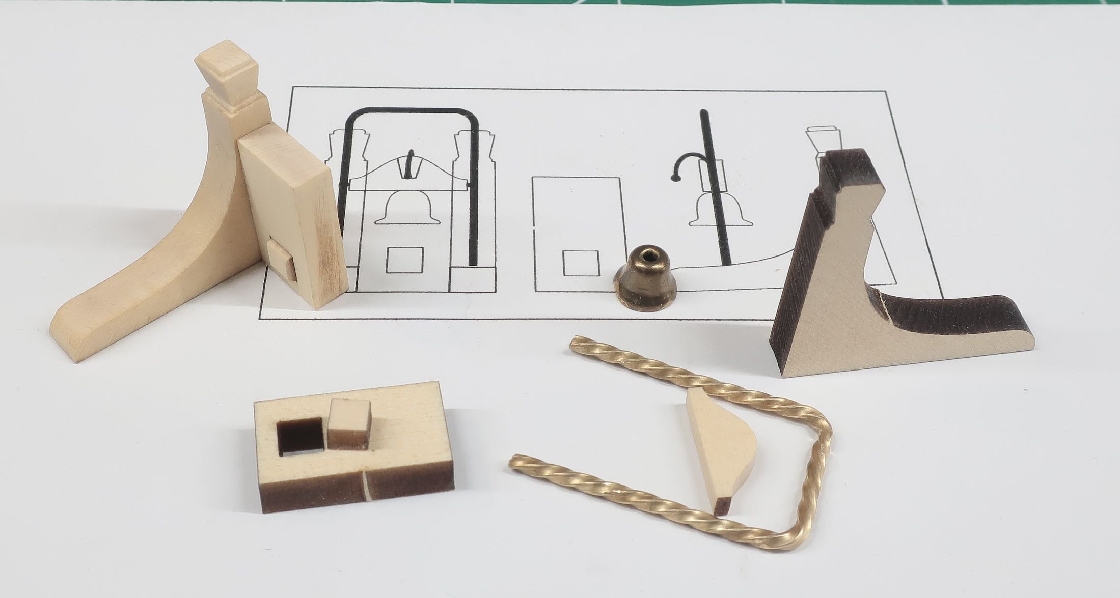

Here are most of the elements laser cut for the bstep/belfry.  There is a bunch of faking it on this fitting but in the end you wont be able to tall.  First I cleaned these Cedar pieces of laser char.  Dont be shy here.  It will all come off and look clean but takes time and care.  I used some 220 grit and 320 grit sanding sticks and even a sharp #11 blade.   You can see one side of the bstep all cleaned of char.  The other has yet to be cleaned and shaped.   You must finish the top and match the shaped timberhead.  For this a sharp blade was used to make a series of "stop cuts" and then basically carve the two sides that needed shaping.  This was after char clean up.
The center where the bowsprit will be stepped was cleaned and assembled.  Note the aft side of the step.  I have inserted a small laser cut square to simulate the tenon of the bowsprit.  Its just easier and cleaner this way.  Leave it standing proud a bit.  The forward side sill has a nice deep mortice for the actual tenon of the bowsprit.
Then there were the belfry elements.  This includes a length of twisted square wire.  This will be proved.  Yes this is commercially available.   You must use the plan to shape it which is shown.   Then blacken it.  The other elements are also shown.

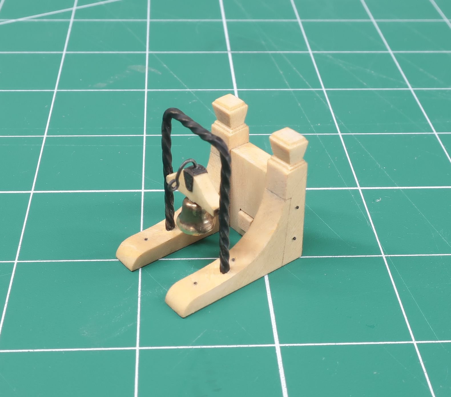

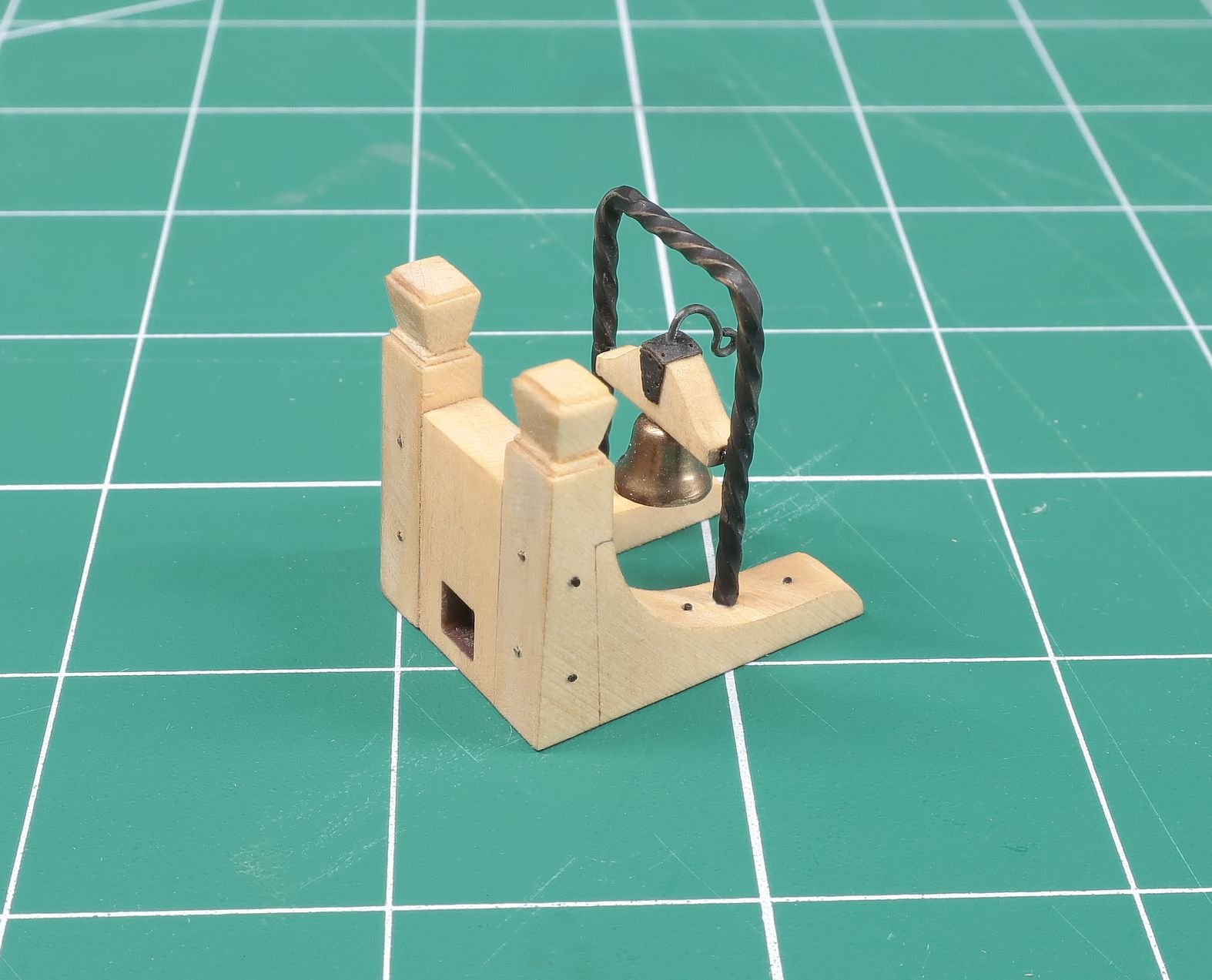

Moving along...the step is now completed and drilled with simulated bolts.  Once again these were black fishing line (30 lb).  Note the laser etched seam which should go on the outside if each side piece...dont mix up the side pieces when assembling.  I also drilled the holes for the wire belfry.   That wire was blackened.  The stock for the bell was completed at this time.  Some laserboard elements simulate the ironwork.  I glued the top on first and then the two faces.   Some 24 gauge wire was inserted into the ends of the stock.  But you can attach this to the wire frame anyway you wish.  I knew it would be a challenge to drill through the frame for most so once again this is simplified.  I just filed some slots on the inside of each frame of the twisted wire at the height needed. I used the plans to establish where.  These tiny grooves were enough of a slot to slide and glue the belfry stock in position.  Its pretty secure.   Its not under any pressure so it should be safe and secure.
Before doing so however, I added the handle to the top of the bell stock.  I just bent it according to the plans.   I used 22 gauge blk wire.  You can add a tiny length of rope if want to.  I have decided not to as they always seem to hang left or right or curl up and that annoys me.  The bell was simply glued to the underside of the stock.   Then it was glued within the frame as described.
There is a little bit of cleaned up needed as my fingers must have been dirty.  But this is the result.
And finally shown on deck but not glued in position yet.  The companionway hood is also not glued in position yet.  No hurry with that.  This completes the fcastle deck fittings.  Now we start the gun deck fittings.  Ignore the dust!!!
Comments and questions are always welcome!!!

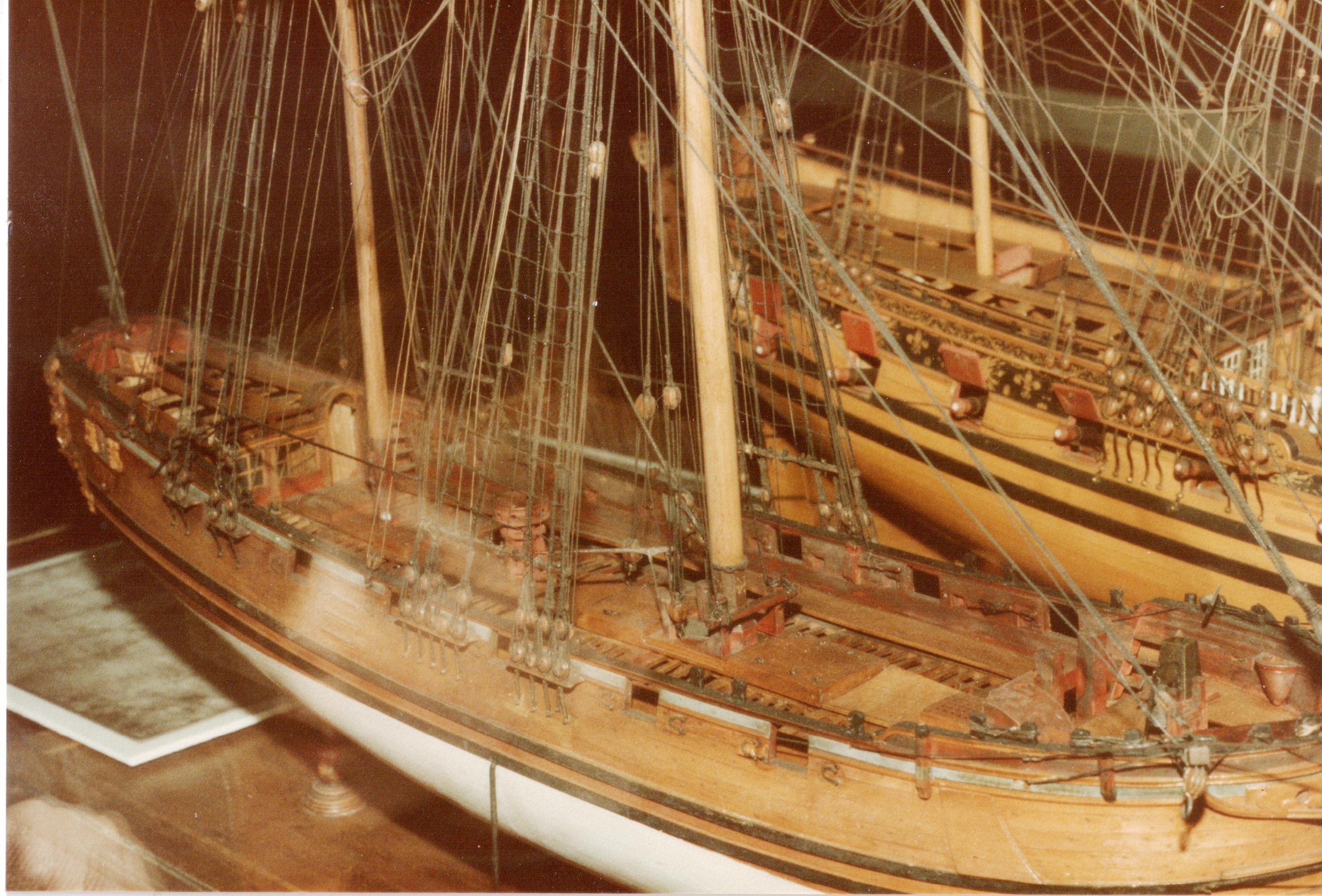

I have placed the bitts on the model but not yet permanently.  I will do that later.  The bitts were painted bulwark red as on the contemporary model.   As more fittings get completed I am still thinking about painting the belfry bowsprit step red as well.  Time will tell...what do you guys think?

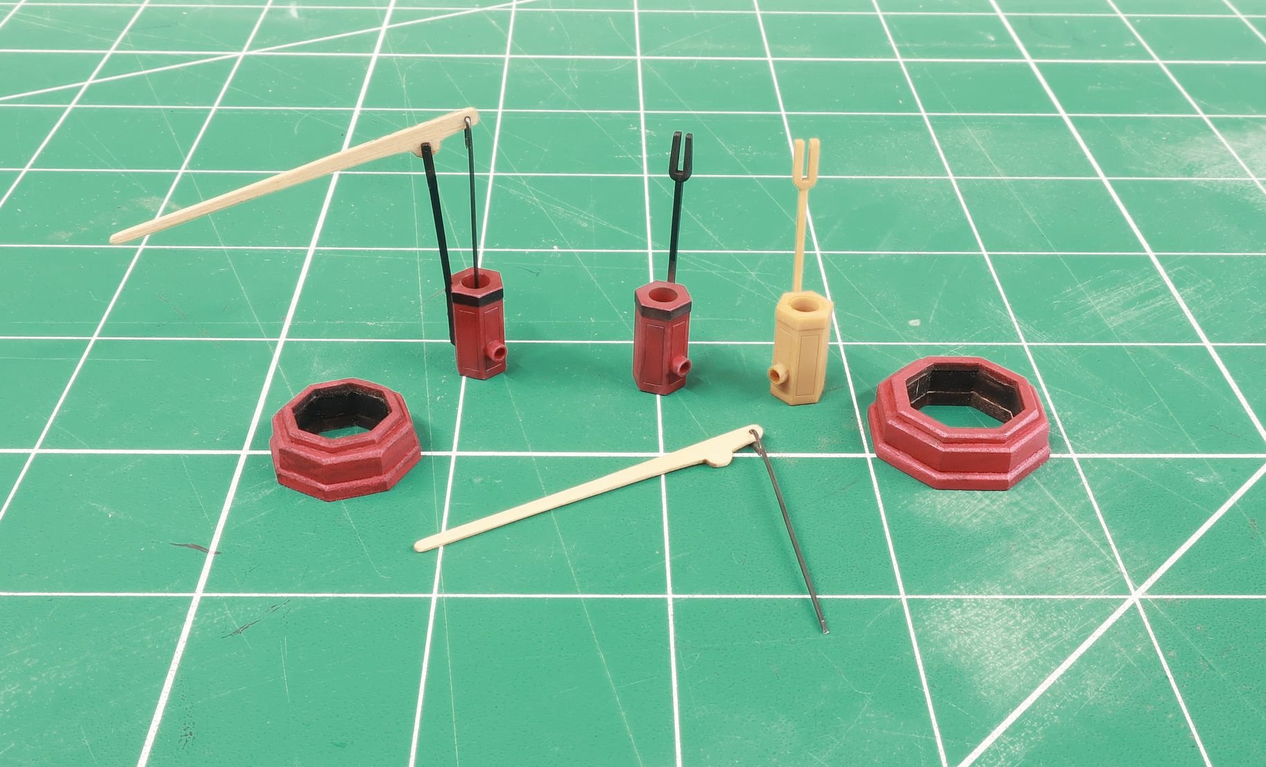

The elm pumps and mast coats were completed.  The mast coats were straight forward.  They were made by gluing three lasercut layers together.  The same as on the Winnie and other projects.  These are interesting however as the are octagonal.  So are the masts partly up their length.   The laser char was removed and the top edges were beveled or rounded off.   Then they were glued together and painted as on the contemporary model.
The pumps were a whole different story.   On the contemporary model these pumps are quite elegant and light.  They are shown with very thin parts and slightly different than others I have seen or built.  There is a long slender metal post that supports the handle.  The handle is also very thin and long.  How these builders achieved this detail at 1/4" scale just amazes me.  They are also painted red on the contemporary model.  Just look at how thin and delicate the pumps are on the model below.  Note the small carved panel detail on each face of the pump.  I really wanted to see if I could replicate this same delicate look on my model at 3/8" scale.  Although less worn and dusty, LOL.
Anyhow...I decided to try my hand at 3D printing this.  Not only to make construction easier but maybe I can incorporate some of those more delicate details this way.  The photo below also shows the mast coats completed and painted.   For the pumps I had to create a left and right matching pair.   The body and its long slender metal post is all designed as one piece.  My attempt at those very subtle carved panels can hopefully be seen in my poor photographs.  You can leave the pumps natural and just paint the metalwork or go red as I have done.  Its up to you and they are printed with a tan/boxwood color resin for this purpose.
The handle is laser cut from actual boxwood since it will be left natural and ties in an actual wood element to help pull off the realistic look.  I added a piece of 24 gauge black wire to the handle before gluing the handle onto the pump.   There is a hole in the bottom of the pump hole for this but I did drill it out larger for the wire.   I glued the handle in position trying to establish the same height and angle for them port and starboard.
Here is what they look like on the model.   There were holes in the deck where the pumps will go to help with placement so you can kind of match them to the pump tubes below deck.  Its not very difficult to do.
While not a perfect match to the contemporary model I think the slender and delicate look has been faithfully recreated.  I also decide what the hay...and painted the bsprit step red as well as I complete more deck fittings.  Oh and the mast coats are not glued in position yet.  That will be left for later when we step the masts.
