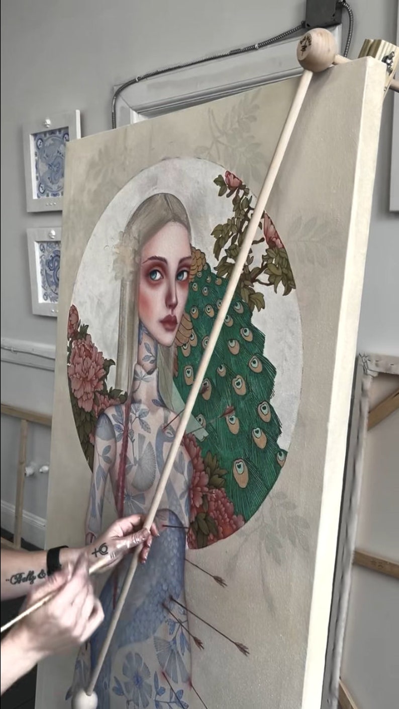

6 hours ago, Gaetan Bordeleau said:
there is the same thing  in art painting and it is called painter mahl stick
Mahl sticks are routinely used by sign painters. A skilled sign painter uses his mahl stick not only as a secure rest for the painter's hand, but also as a guide for the brush. By resting the heel of the brush hand on the mahl stick and moving the end of the stick in an arc, a true curve can be quickly and very accurately made. Similarly, the stick can be held in position and the brush in hand, or resting on the stick, can be moved across the painting using the mahl stick to yield a perfectly straight line.
Actually, I've never seen a mahl stick used such that it rested on the painted surface of the piece. The padded end of the stick could smear the work unless one waited weeks, if not months, for the oil paint to solidify. I've only ever seen the padded end of the stick placed on the working surface at the edge or margin of the work surface. (Some mahl sticks have a "hook" at one end so it can be hooked over the top edge or side edge of the canvas.) On a larger painting, the sticks can get pretty long to accomplish their use without placing the end in wet paint. Some fancy ones are even telescoping for ease of storage.
Mahl Stick  Ball Mahl  New adjustable stabilizing tool for image 1
