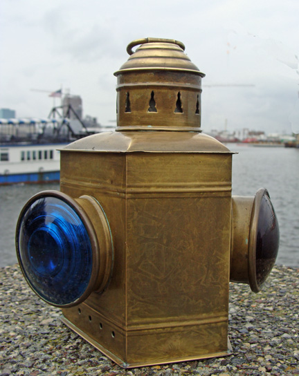

Thanks for the reference, Michael! I must confess to overlooking the Skipjack build log. I noted some prior references to "the skipjack," but erroneously presumed it was a reference to a Chesapeake Bay skipjack and not a launch. Turn of the last century launches are a particular interest of mine, especially steamers. (I once restored a now-100 year old model of steam yacht, including its working steam plant, and modeling a steam launch with a working steam plant has been on my "bucket list" ever since.) I've scheduled a couple of hours to pore over that log, too. (Thank you for your generous sharing of so many tricks, tips, and techniques! I've learned so much from your posts.)
I answered my own question as soon as I realized it was a bow light that would have probably been used under one of the old "inland rules" powered vessel light systems instead of a running light on a sailing skipjack. The "headlight and sidelights" combination evolved, IIRC, into today's sidelights and 360 degree white masthead "steaming" light navigation lights regulation.
The prototype is a product of the Persky Lantern Company or its descendant companies.  The company was started by Frederick Perksy, who later changed his name to Perkins. Eventually, Perkins' company became the Perko Company, still family-owned and in operation over a hundred years later and one of the giants of the marine hardware industry. https://www.perko.com/about_us/ I was unable to locate an old Persky/Perkins/Perko catalog on line, but I expect the prototype of your lamp would be found there if an ancient Perko catalog could be found. (Mystic Seaport may have one in its library.)  Here's a couple of articles on the history of the Perko Company, one with some nice photos of their older lamps, many of which were in production for nearly a century. https://www.perko.com/about_us/  http://skipjacksnauticalliving.blogspot.com/2012/12/
Now, to the regret of some of us, Perko's lights are all electric fixtures and their once huge selection of oil lamps are no longer manufactured. (Sadder still, many early examples have been "electrified" by well-intentioned, but nonetheless barbarian, interior decorators to make "nautical décor" lamp stands and the like!
The "Christmas tree" shaped ventilating holes in the chimneys of all Persky/Perkins/Perko oil lamps has always been their company trademark.  The below photo of a sister prototype to your miniature depicts this trademark feature well.  I will also point out the blue lens on the below prototype.   It is a detail that, if models are any indication, is frequently overlooked... or ignored in the interests of "artistic license."  The lens on starboard oil burning running lights is always blue. (Or, where the lens is clear glass, there will be a blue colored piece of glass behind it inside the lamp.) When the oil lamp is lit, the flame of the lamp is yellow. The yellow flame projecting light through the blue lens yields a green light. Similarly, the port lens will be a very dark red, so as to yield a red, rather than an orange, light when lit. This is apparent in the below photo. (This isn't any criticism of your magnificent miniature lamp, Michael, but if you decided to replace the green lens with a indigo blue one and the red one with a darker red one, ...  but, never mind, lest I push you completely over the edge.) :D
12206_brass_port_starboard_running_light
Edited by Bob Cleek

Very true indeed Bob.  My father owned several old railroad lanterns that used blue lenses such as you depict and he explained it to me as the very reason you just explained.  The light omitted was green.  Yellow flame + blues lens= green light.   Smart folks back in the day.....
