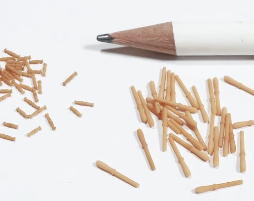

Belaying pins...9.5mm and 14.3mm
And some teeny tiny toggles.  3mm, 4mm, and 5mm long
To begin with just the boxwood color.
The belaying pins are in no way as strong as brass.  But they are plenty strong enough as long as you dont over-do the tightness....which you shouldnt be doing anyway.  The toggles are also quite resilient.  Pictured are some tests in 3 and 4 mm long.
So look for them on my fittings page when I reopen next week.

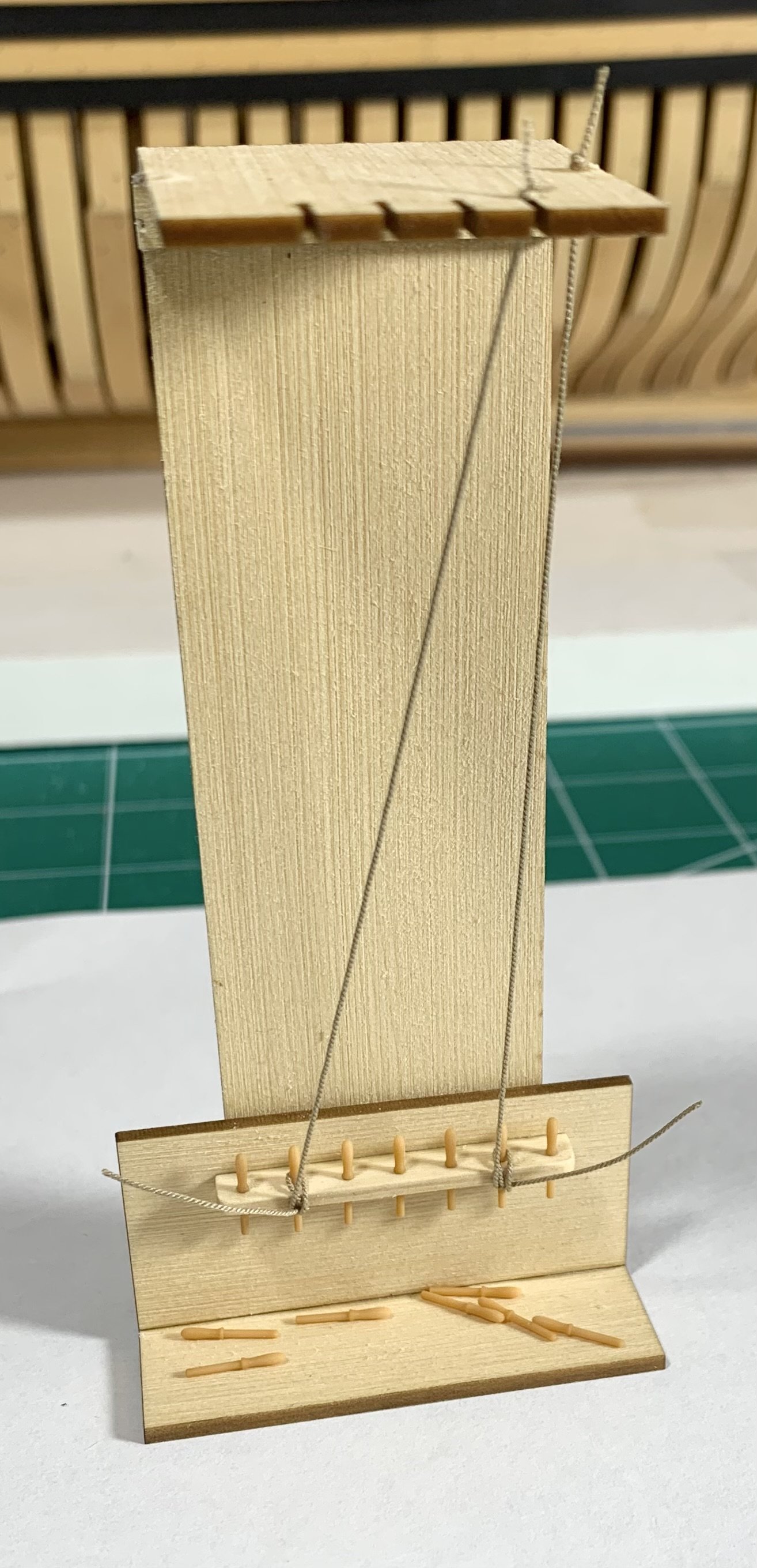

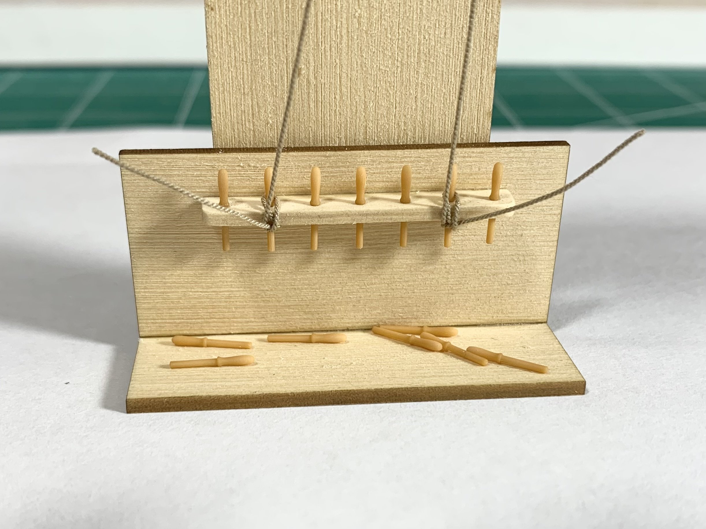

see how I tested the viability and strength of the belaying pins.  I made a crude mock up which you see below.  This allowed me the opportunity to test in actual use various belaying pin iterations over and over again.  I must have tested so Many different resins and resin mixes until I found the correct mix of two that would be strong enough and look good.
There is no glue holding the pins in the rack and they are press fit.  There is also no glue on the rope.  This is the way I actually rig my models.  If a pin breaks you can easily remove it and insert another although I never came close to breaking one.  They will flex if you over tighten the line ridiculously.  But normal rigging tension works wonderfully.
These are 1:48 scale belaying pins.  It actually is very encouraging and may also test 3/16” scale pins as these worked so well.
We are lucky to have people like you and Chris Watton to push the envelop and use new technology to advance our hobby.  I recently purchased some of your printed blocks, the level of detail on the 3/32 and 2mm blocks is just incredible.  I will  be practicing stropping the 3/32 inch blocks for use in my next build, either the USF Essex or US Brig Syren.  The belay pins look great.  I will be interested in how the 3/16 pins work out.

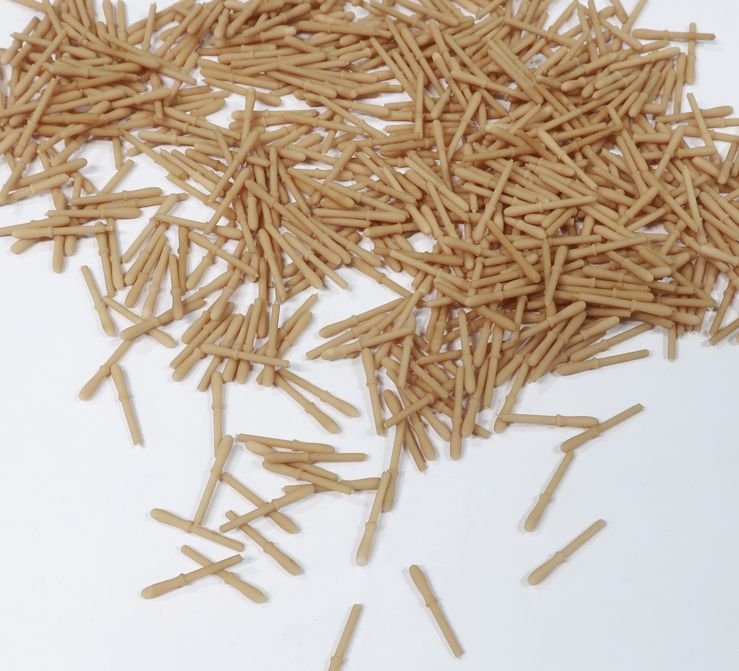

Thank You for saying guys.  Some 1:48 scale swiss pear color belaying pins.   Just stocked a bunch of them.  I am not sure which folks will prefer but I made both colors just in case.
I am gonna do some tests on 1:64 pins next week.  I am about 50/50 on whether they will work.   I know a lot of heavy-handed riggers out there!!!

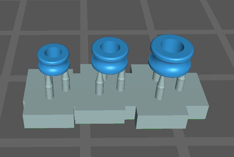

Next up.....3d printed thimbles...I hate making them so I am trying to print these tiny things.  Should know by next week if they work. Black resin is the goal.  Starting the test with 3 sizes and will adjust from there.

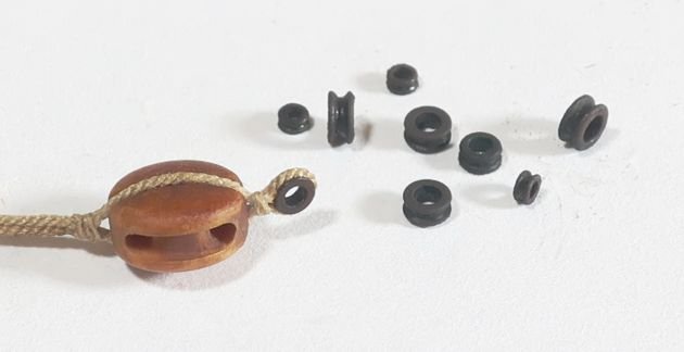

Thimbles are now in stock...only 2mm today but the other sizes will show up over the next few days...a couple of new sizes per day starting tomorrow.   Packaging these things are a pain.  A massive pile on the table of round items that roll.   I count by two's
2, 4, 6, 8, 11....15....25 thimbles.  ugh.  Repeat.
Chuck,
Push a pin into a piece of wood. Stack thimbles on the pin until you get to the number you want to package (25?). Clip off the pin above the stack.
Now to measure the number of pieces you don't have to take the time to count them. Just stack them on the pin, dump into a bag, repeat.
And I would do this over a large bowl or baking pan, with the parts in the bowl/pan. That way they can't roll away.
Phil
Just a thought Chuck - could you fill/count packages by weight rather than counting individual items?
Tried weighing them even with a very expensive scale but there is too much variation.  I basically count out my blocks and these like a pharmacist counts pills.   These are just very squirrelly.   I am used to it but its a pain.  Putting them on a pin is fine but that would take three times as long.   I have to be quick.   Too high a volume.
Chuck
1 hour ago, knightyo said:
Maybe a small funnel into a tube of the proper length and diameter
Drop them in in ones and twos, so they don't jam. Pharmiststs tray to funnel.
Ron Thibault
In our office pharmacy we use a pill counting app on our cell phones. It works great for similar sized pills (or objects). You obviously wouldn't use it for small groups but for packages of >10 it might be a useful app.

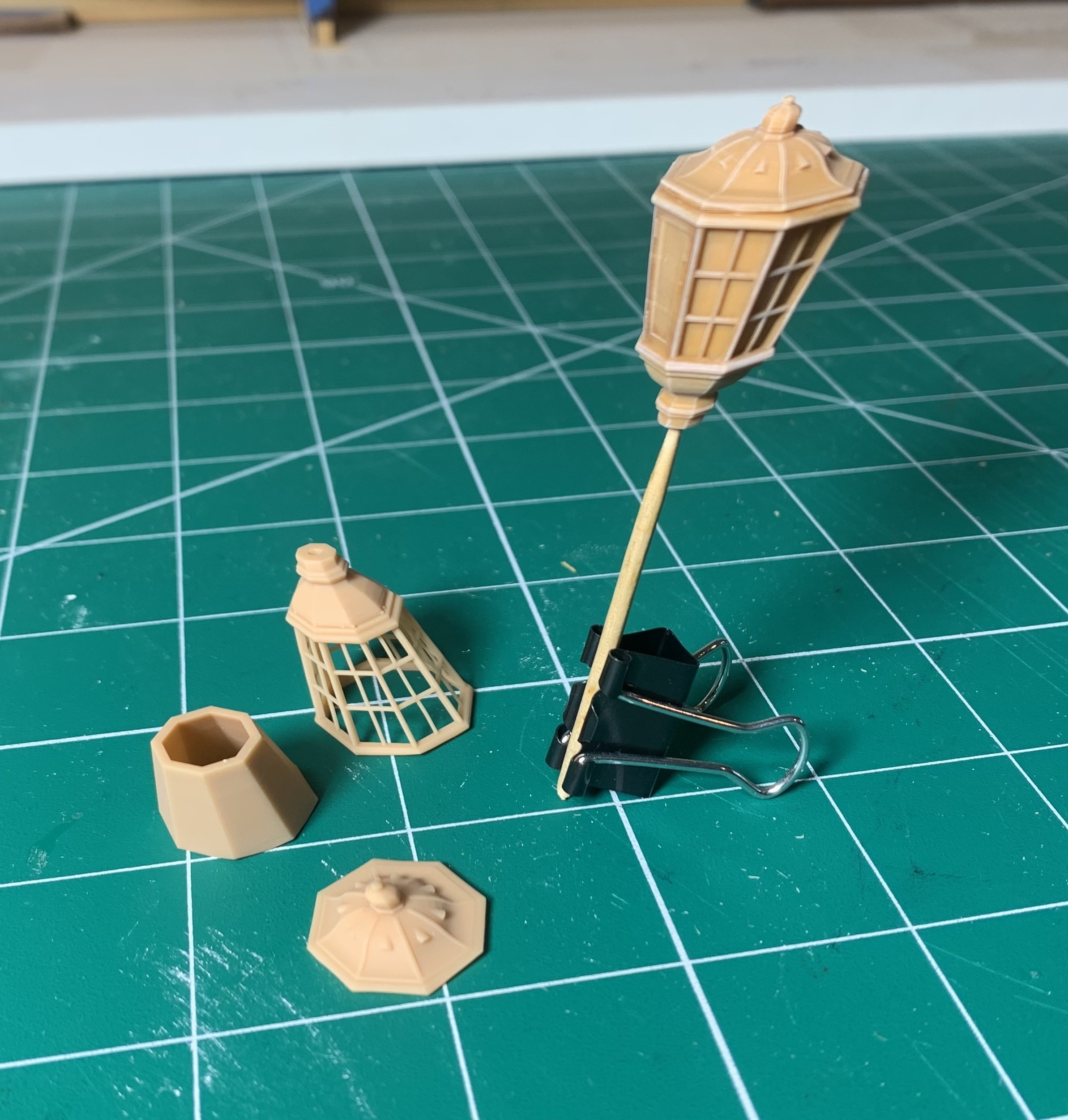

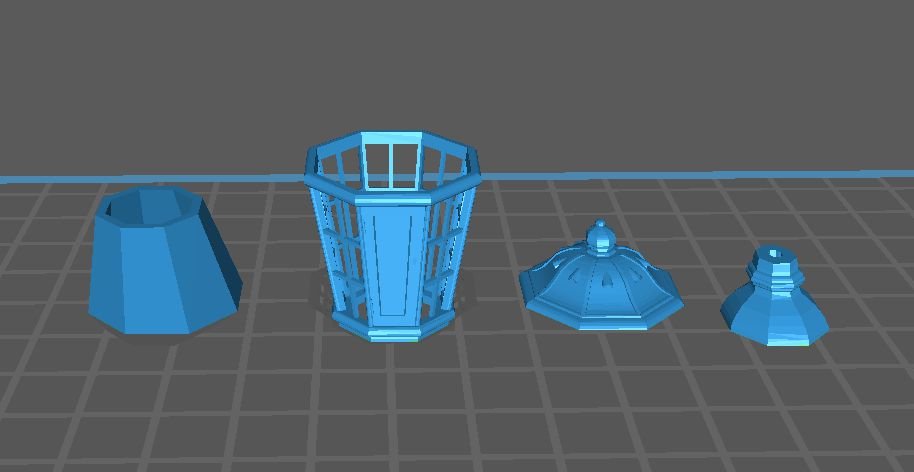

And just to keep me busy...a new Lantern...typical but detailed English Navy circa 1770-1800.  I have so much to do and lots of new stuff in the works.  This will be printed in four pieces if all goes according to plan.  The glass will be an insert and printed in clear resin.
First print test.  I have a few modifications to make and I dont have any clear resin…its on the way.   This resin is just plain old elegoo resin which I use for my tests.  Then I dipped into some wood stain.  When I get my delivery of the good stuff it should make a huge difference as well.  But this test proves the parts actually fit...I am pleased about that.
Anyways…I will make some tweaks and print again.
Lantern test in 3 sizes....
3/16" scale and 1/4" scale and one size in between.
19mm, 23mm and 27 mm tall without any crank. Top to bottom.  That isnt a really big dime so you can imagine how thin those individual window frames are on the sides of the lanterns.   No clear glass insert yet.  But that test is coming.
