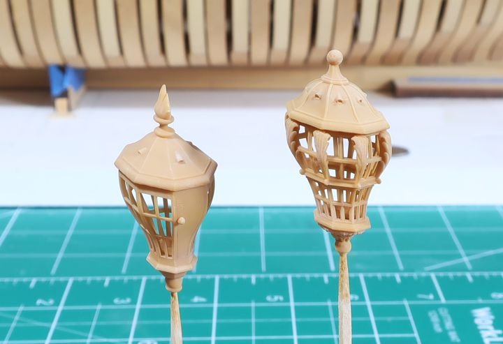

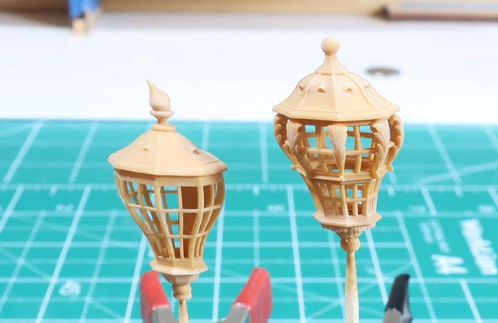

First 3D print test and assembly of two French style lanterns after Boudriot.  There is no glazing insert in these....yet.  Thats a bit more complex than the other Royal Navy shaped insert.

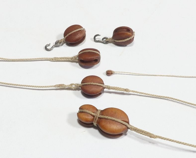

working on larger blocks now...
11/32" singles and doubles now available and I am cooking the 5/16 as I write this. Below is an 11/32" (9mm) single block with 3mm thimble and a hook fashioned from 22 gauge black wire.  The sheave was also darkened with a #2 pencil as you can easily do that with these bigger blocks.  Once the 5/16" are done I will make 9/32" blocks.  I think 9mm or 11/32" blocks are the biggest I will make.  I cant see much need for larger blocks?  But I may be wrong.

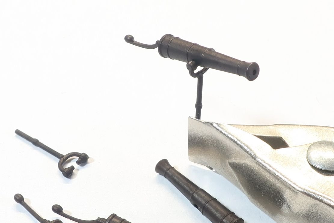

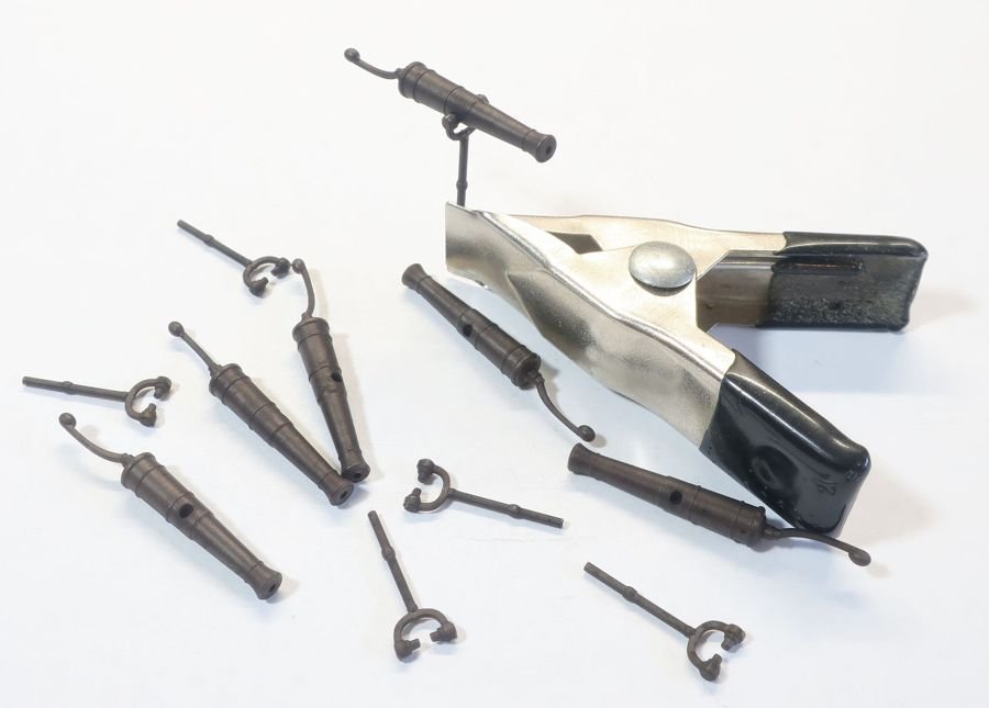

Another new item will soon be in stock.  I had run out of my old swivel guns.  Those were cast in the traditional way and not 3D printed.  They has casting marks etc.  So now that I ran out of them I figured I would do a redesign.  Here are photos of the new 3D printed swivel guns.   Two pieces.   The yoke is flexible-ish.  This enables some manipulation to just slide the yoke into position from the bottom of the barrel and into the the holes.  Once you get one done the others will be easy.
I am pretty thrilled with these results because as some of you may be aware, black 3d printing resin is somewhat less than desirable.  The results often look too much like plastic or are too shiny and doesnt really show details well.  So I have conducted many tests yet again on my resin of choice.  The black finish is not to stark a black or but nice and warm and on the touch of a dark warm gray.  Very dark.  The material is also matte or barely satin.  So its a win-win.  I tried very hard to make these look like blackened brass or brushed metal which I think I achieved pretty darn close actually.  This batch is 13/16" long not including the handle.  (What is used for the Winnie).
Use these straight out of the bag.
I should have some more sizes and these will be fully stocked in a few days.

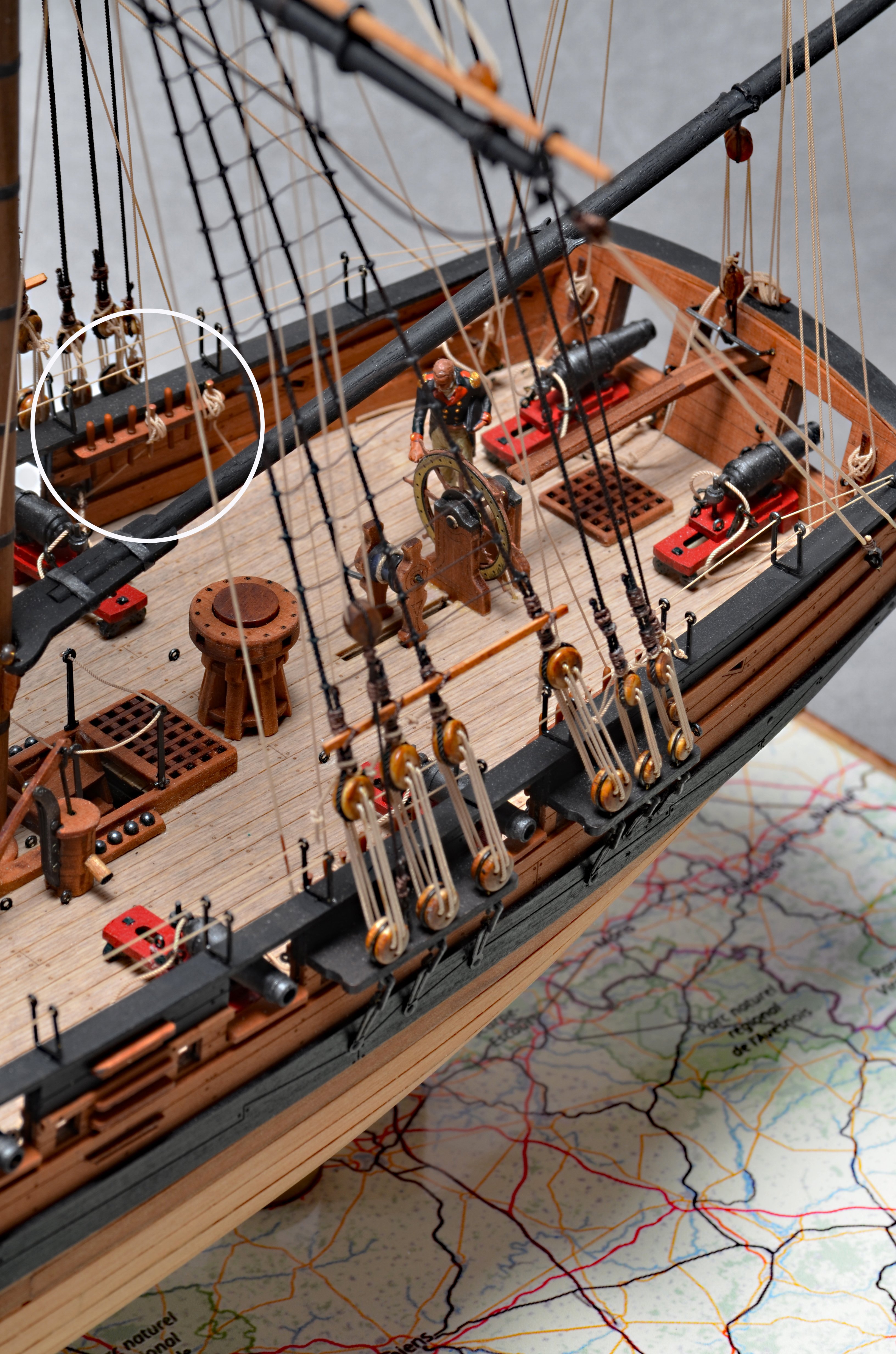

Excellent. I've added a number of your 1:48 pear wood pins to my latest model. My scale is 1:64, but the 9mm ones don't look terribly out of scale. However, as soon as you've stocked the 7.4mm in pear wood color I'll jump on my next order!
To see how good Chuck's new 3D belaying pins look I'm attaching a close up of my just completed HM Cracker gun brig. Keen eyes will note that adjacent to these pins are slightly smaller ones with rigging lines tied off to them; these are the smallest available (old school) brass ones: I paint these guys brown. I also use them because I have been paranoid that tying-off to the resin ones might be problematical with taut rigging lines. I'm anxious to see if the smaller 7.4 mm ones will hold the belaying line tension and not break.
AND – your new 3D swivels look wonderful. A tip: I apply a light dusting of metallic weathering powder to black 3D resin (as well as some P/E parts) to create a more convincing metallic finish. The plastic modeling guys use this stuff everywhere. The photo here also shows this effect on the carronades and the straps on the gaff jaws.

Those look amazing!
