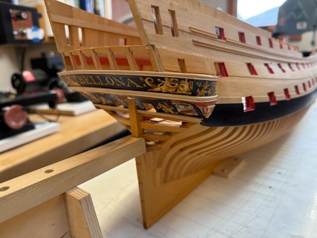

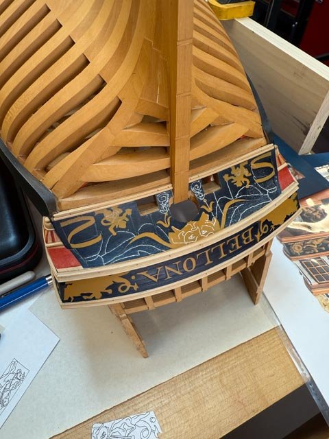

HI everyone,

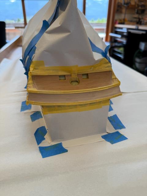

A long time since my last post. I realized that I was getting to far ahead of myself, building up the stern with everything just pinned. I needed first to paint the lower and upper counters before I could actually start assembling things.
And learning how to paint the friezes was a major learning curve!
I greatly followed David Antscherl's advice on painting in the Fully Frame Model, vol. II section 7.26. It was exceptionally helpful for everything from paint and brushes to technique.

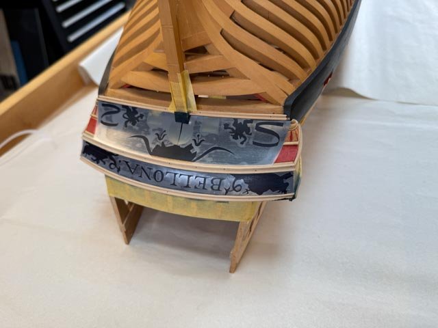

Alas, I discovered after a great deal of experimentation that hand painting alone did not work well for me. Particularly for the background Prussian blue and the letters "Bellona" on the stern, I needed a way to get things sharper and more even in tone. So, I turned to my airbrush. I masked everything but the counter and sprayed away.
I glued artist's frisk onto a print of the upper counter letters and frieze elements (a woman riding a sea monster, a man riding a galloping horse). I could then turn the frisk/print every which way on my light table, and very carefully cut the frisk with a scalpel. I then attached the frisk and sprayed everything that would be the yellow ochre base for all of the frieze work:
I then used white graphite transfer paper to trace the rest of the pattern onto the surfaces:

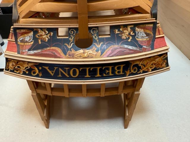

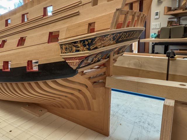

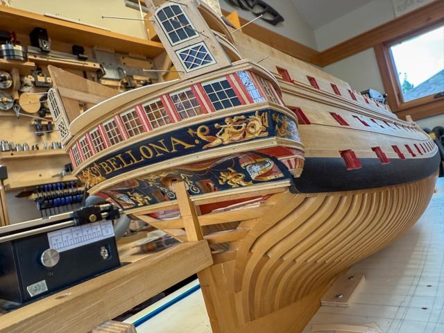

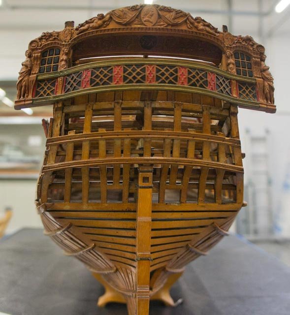

Then following David's advice of painting highlights and shadows on the basic forms, I eventually got to an imperfect copy of the original Bellona model:
I learned to admire those original model builders for their painting skill. Try as I might, I just could not get to the same level of skill. But as good as I can do! So, moving on to actually gluing together the stern!
I did learn a few good things that I will pass on for anyone else attempting these kinds of friezes.
First, after trying a number of airbrush and hand paint brands, I settled on Golden. They have the same colors in different densities, for airbrushing and hand painting; the colors match the historic colors I was looking for; they come in plastic bottles with ball bearing inside, for mixing. They spray without problems through my airbrush. And they are highly regarded in the artist community.
Second, I struggled with the acrylic paint drying too quickly on the palette when I was trying to mix colors. My son introduced me to the model gamers' favorite tool, the Army Painter Wet Palette. This tray holds a water saturated pad, upon which is placed a parchment sheet. Paint mixed on top of the parchment can stay wet and mixable for as long as 48 hours. A huge help!
A glass of wine tonight in celebration, and on to assembling the stern!

Thanks so much, everyone. This was a major hurdle for me, thinking about it for many years, and now able to move forward.
A couple more thoughts, for those working on paintings like this.
1. Using frisk to lay down the base yellow ochre actually accomplished a couple of things. Not only did it allow a smooth application of airbrush paint, but it also solved part of the problem of getting the design transferred to the hull. Because the frisk is based on an accurate drawing, there is no need to worry about sketching in the design on the model itself, trying to keep faithful to proportions and sizes. It is as accurate as the drawing used to cut the frisk.
2. To get an accurate underlying drawing, I scanned photos of the painting on the original Bellona model, and imported them into my CAD software (HighDesign 9 for Mac). I then resized them to approximately the correct sizes and printed them. When I cut out each print and laid it onto the hull, I could see where the shape needed to be adjusted for more or less curve, a little wider or narrower. I would then make these adjustments to the CAD drawing, print again, adjust and so on until the CAD drawing was an accurate fit. Then I knew the frisk would fit well in its assigned space.
3. Regarding airbrush paint, I also started with Vallejo, which is highly regarded by many modelers online. But I also had problems with these clogging my airbrush (Harder and Steenbeck Evolution). Although I tried a number of suggestions for thinners seen on YouTube videos, nothing seemed to work reliably for me. It may be that I did not work out a good way of mixing the paint and thinner, or it may be that spraying on wood rather than plastic makes a difference. Golden High Flow paints worked without thinning, which does allow for a greater consistency in what is going to happen when you pull the trigger. And they match the Golden Fluid acrylics for hand painting.
4. As David Antscherl pointed out in his section on painting in the Fully Framed Model, the base layer of yellow ochre is a translucent paint, not opaque. So when spraying or hand brushing yellow over Prussian blue, the resulting color goes green. David's advice of mixing some white into the yellow ochre for hand brushing helps, while a number of layers of airbrushed yellow ochre eventually goes opaque. They dry so quickly that it is possible to get an opaque finish in one session of airbrushing.
I look back and wonder why it took me so long to work out this painting business; and now I remember the many experiments, dead ends, different products....

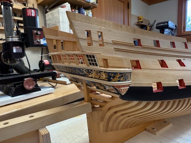

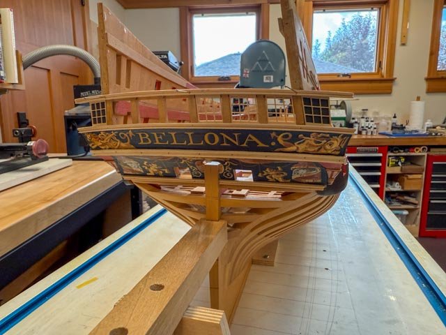

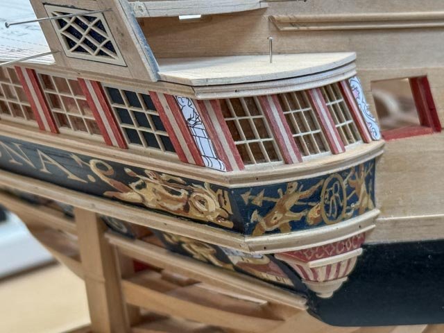

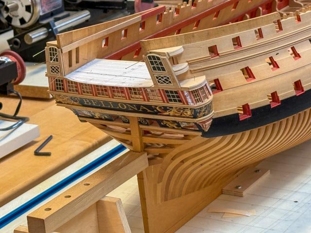

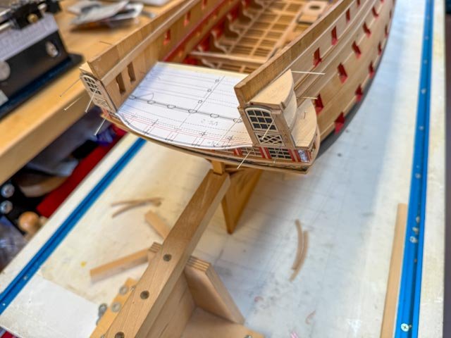

A quick update. I finally installed all of the upper deck lights, with the red cover plates holding them in place with the help of a little LockTite Extreme glue. This was necessary for bonding the plastic window frames to the wood, giving a few minutes repositioning time to settle everything in the right location. I had considered using superglue, but it has no leeway with repositioning time.
I placed mica behind the frames for the glass. It was easy to cut, and as thin as the windows ought to be in scale, greatly facilitating the construction details.
Chuck's laser cut window frames look fantastic! Thanks so much, Chuck.
I still have to construct the architectural columns in the centers of the red cover plates, and I am showing here some paper placeholders for later carvings.
But I have decided to move onto the balcony for now, which will probably be the most challenging part of this build. It has open fretwork between stantions, and the whole thing is a serpentine curve, as seen in the original 1760 model (here the fretwork is carved out of a solid blank; they are open in the second model which I assume is the intention of the model shown here).
Chuck already laser cut the fretwork for the side panels, as seen best in the last photo below the curved top window. This again shows the beauty and delicacy of Chuck's work. this same pattern will hopefully run across the balcony, and then around the quarter galleries at the same level.
